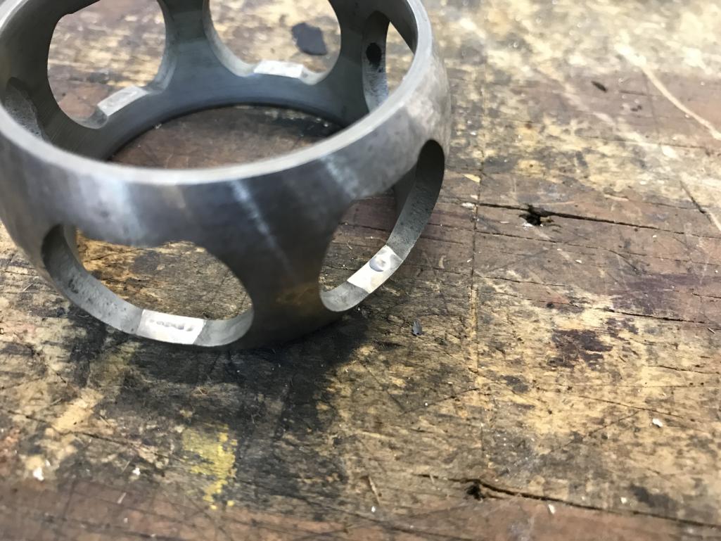

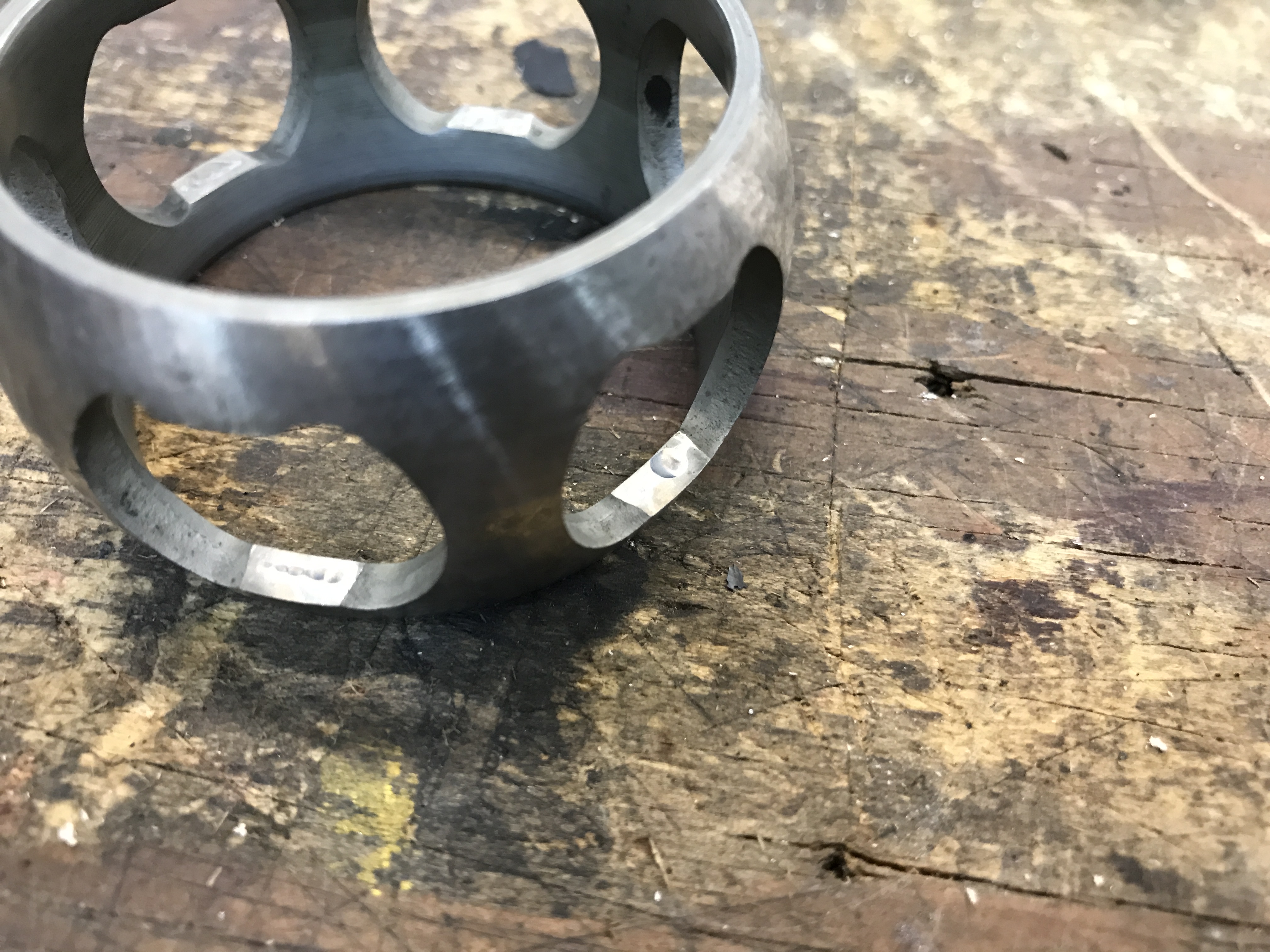

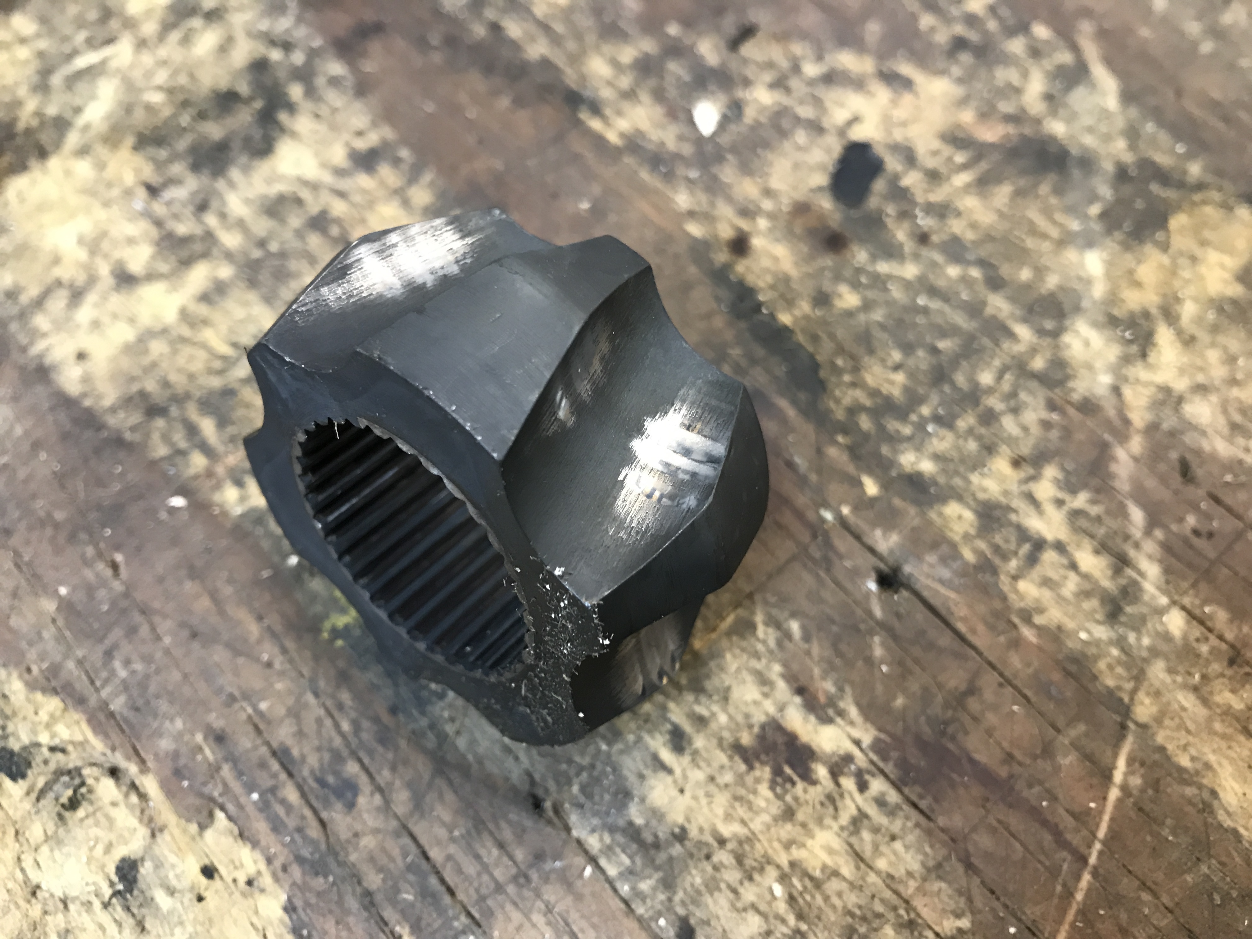

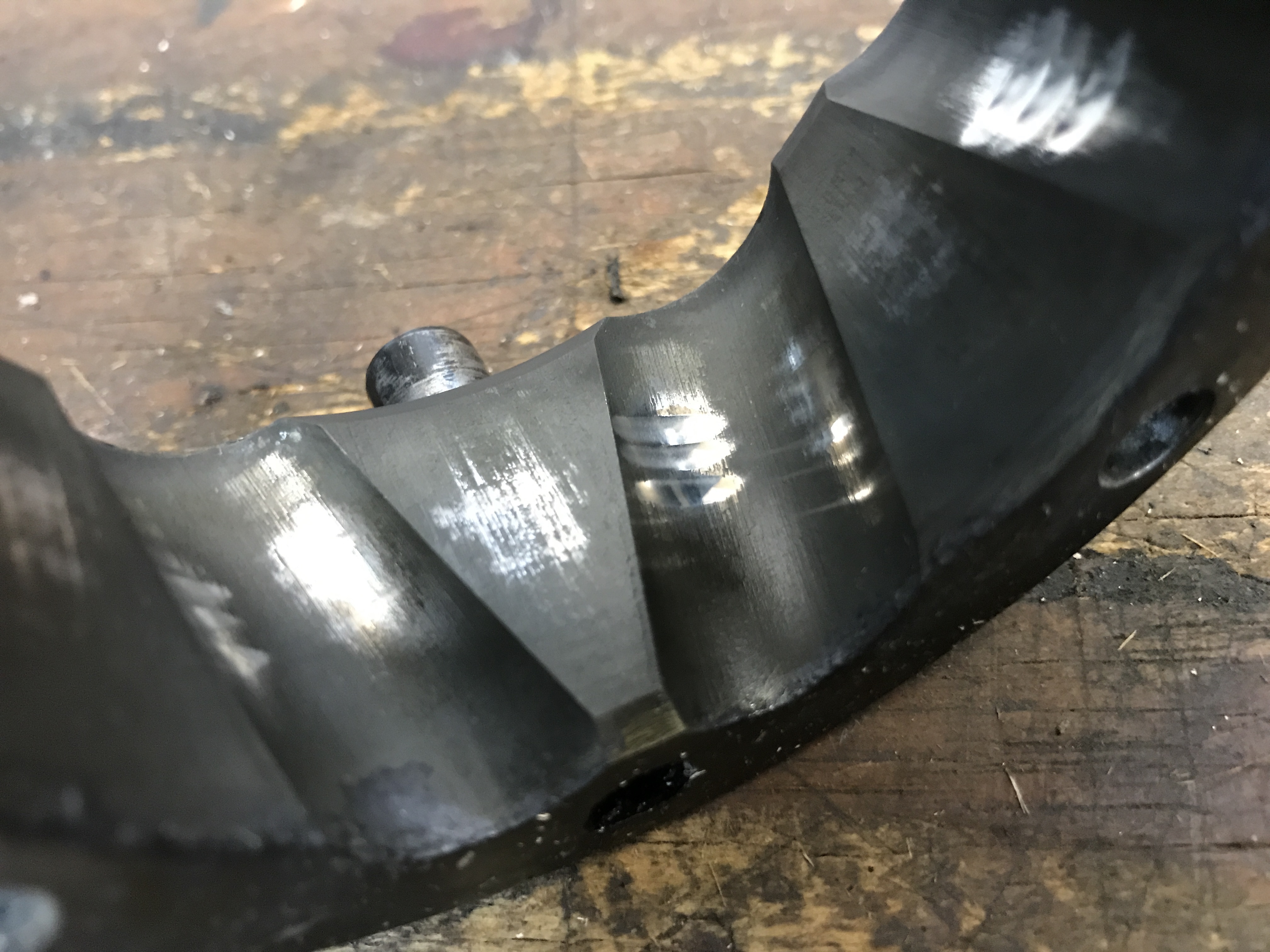

I took a closer look at one of the CV joints, with all the parts showing lots of wear. Here's the outer housing.
post Sep 15 2020, 07:41 PM
Post #1324
Posts: 8,343
And the cage.
post Sep 15 2020, 07:43 PM
Post #1325
Posts: 8,343
And the inner flange. I suspect these show extreme wear. Time for new CVs?

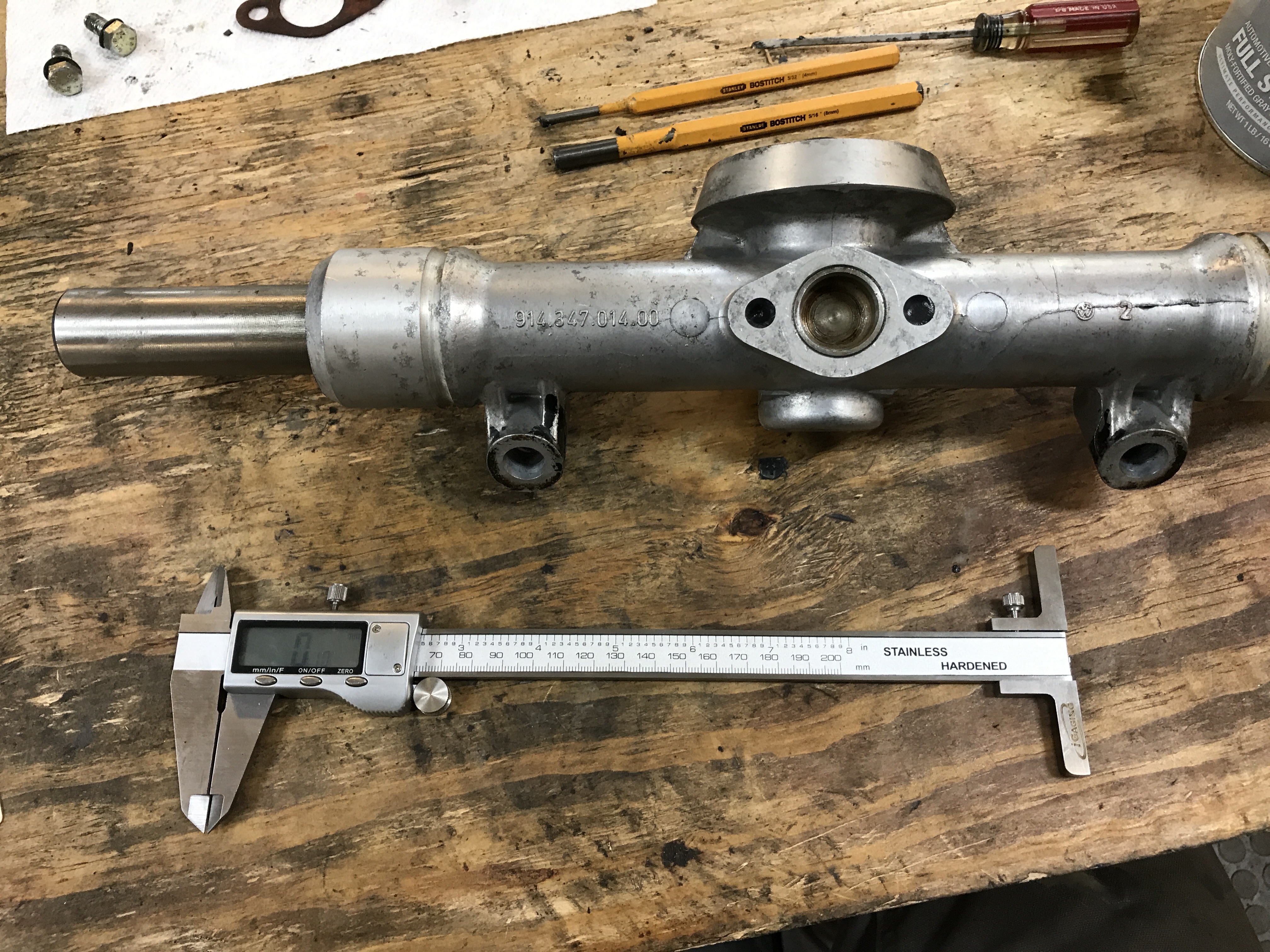

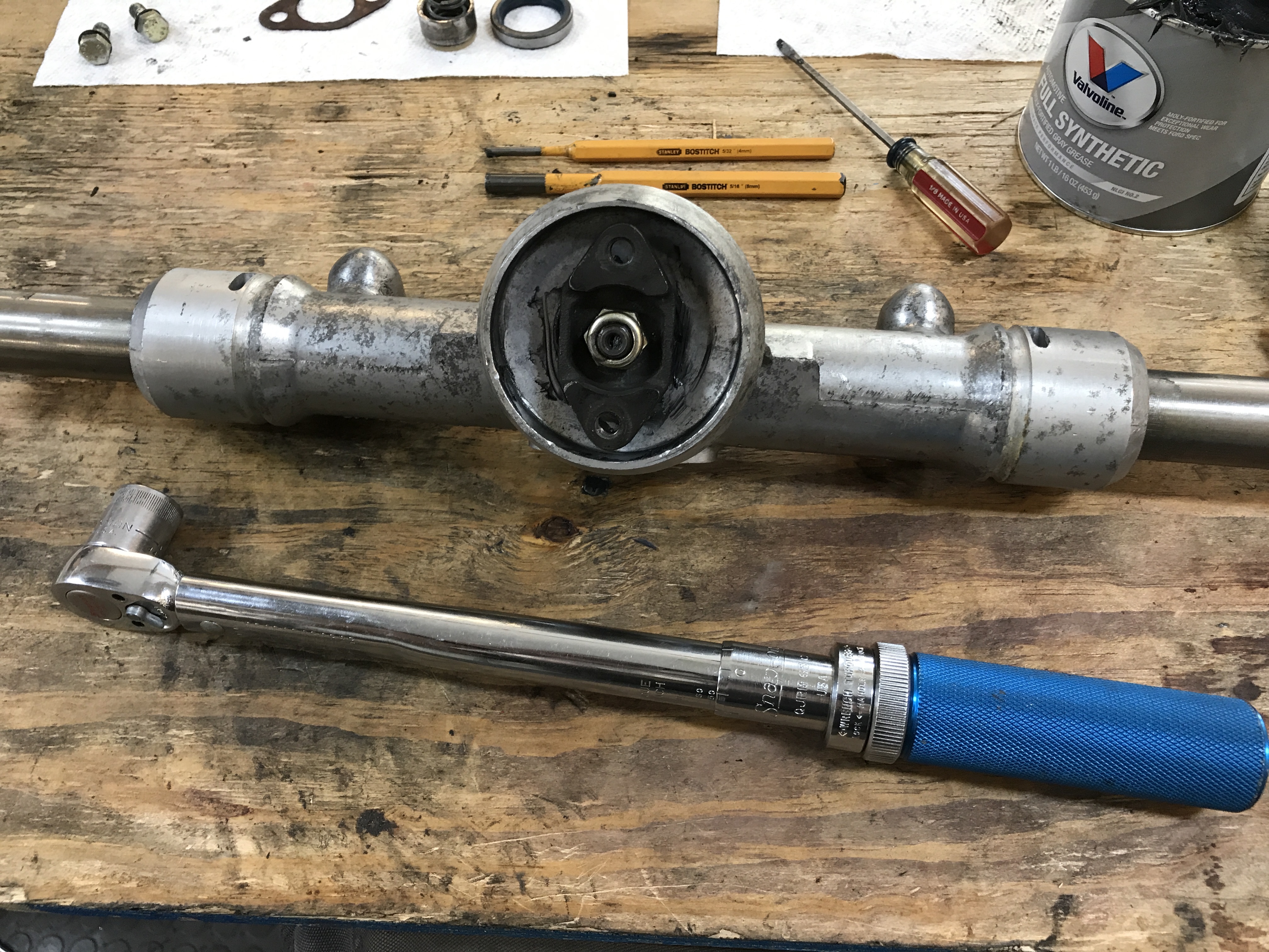

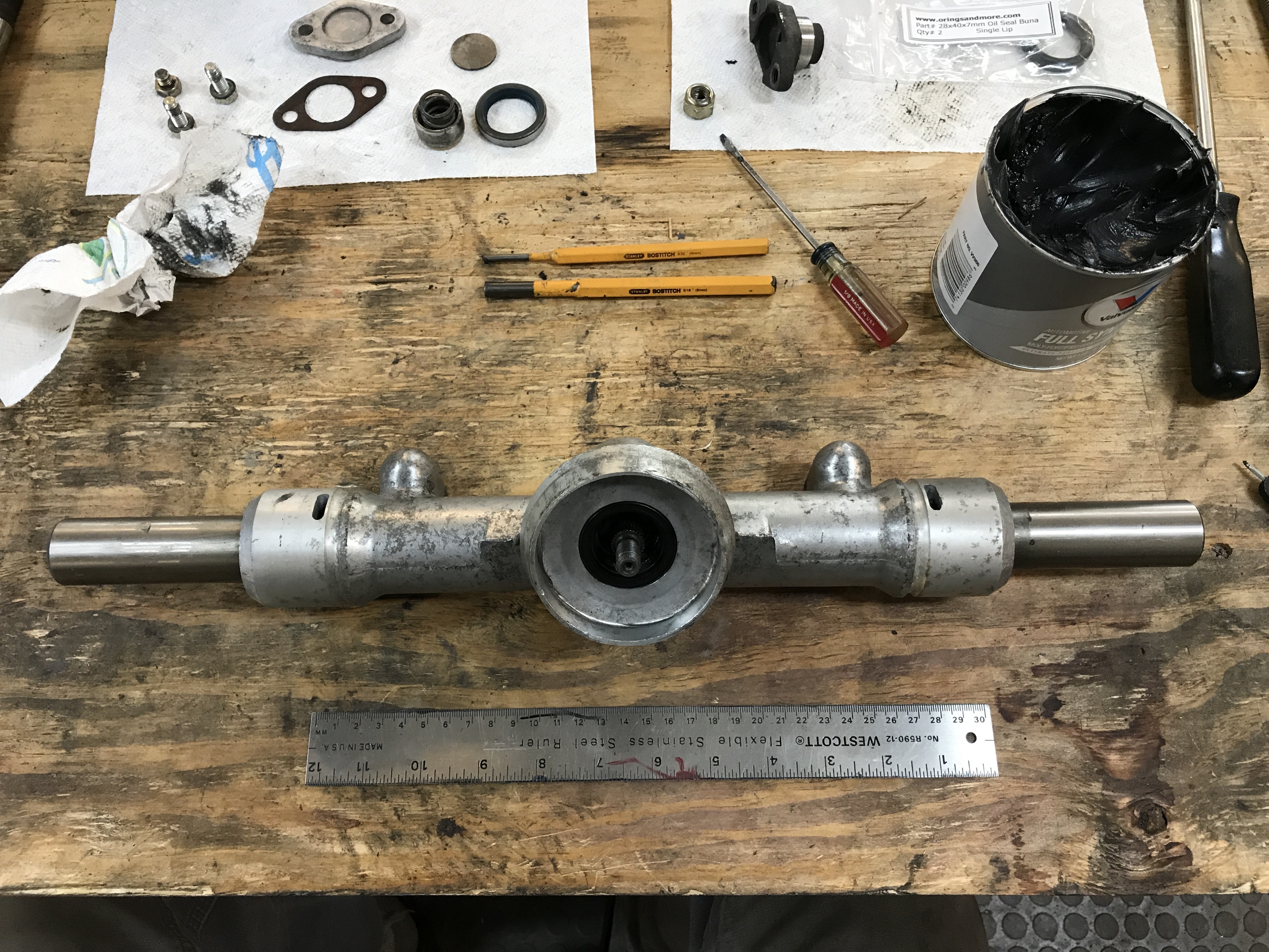

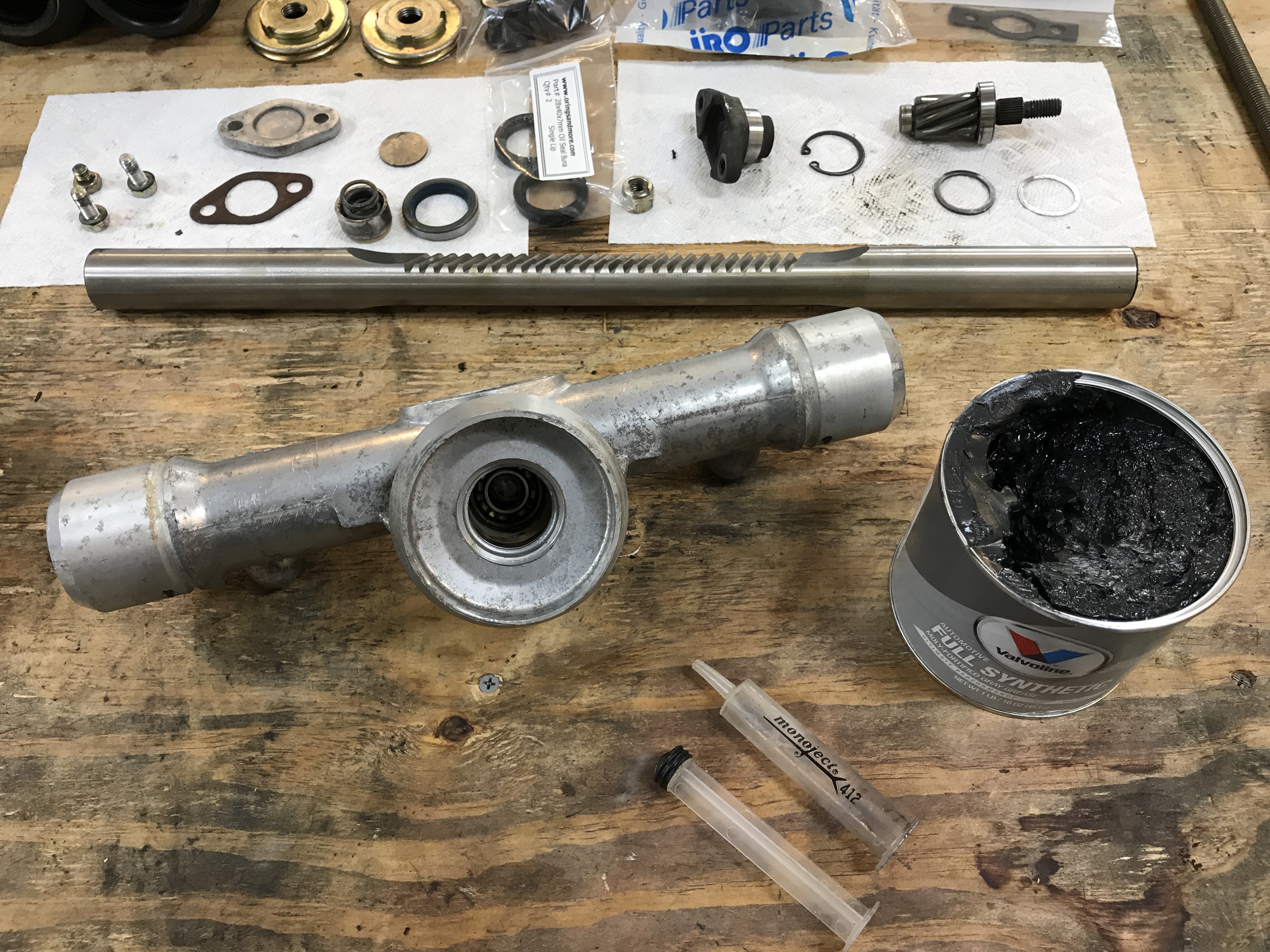

With all the parts and supplies in hand, I started rebuilding the steering rack.

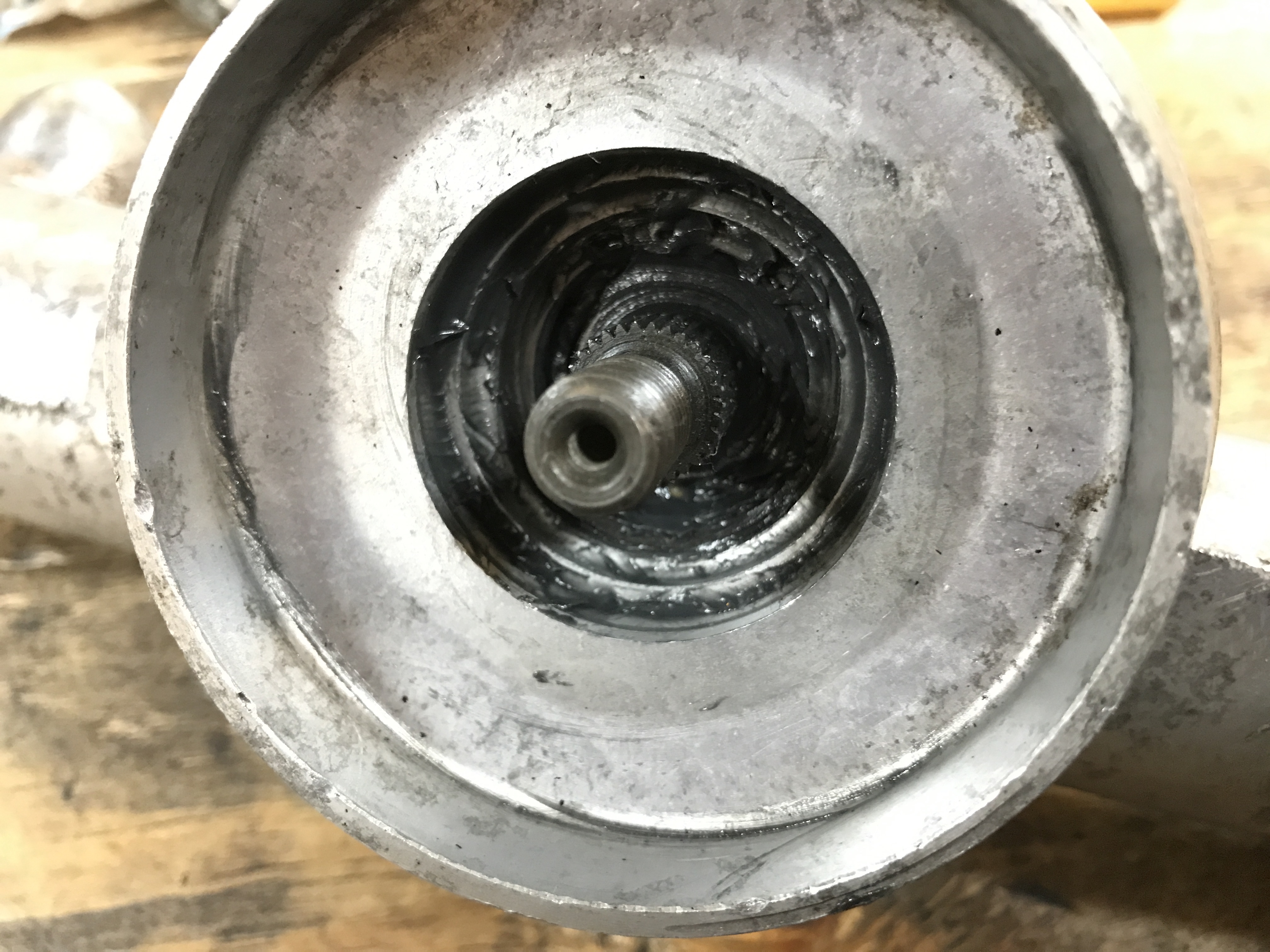

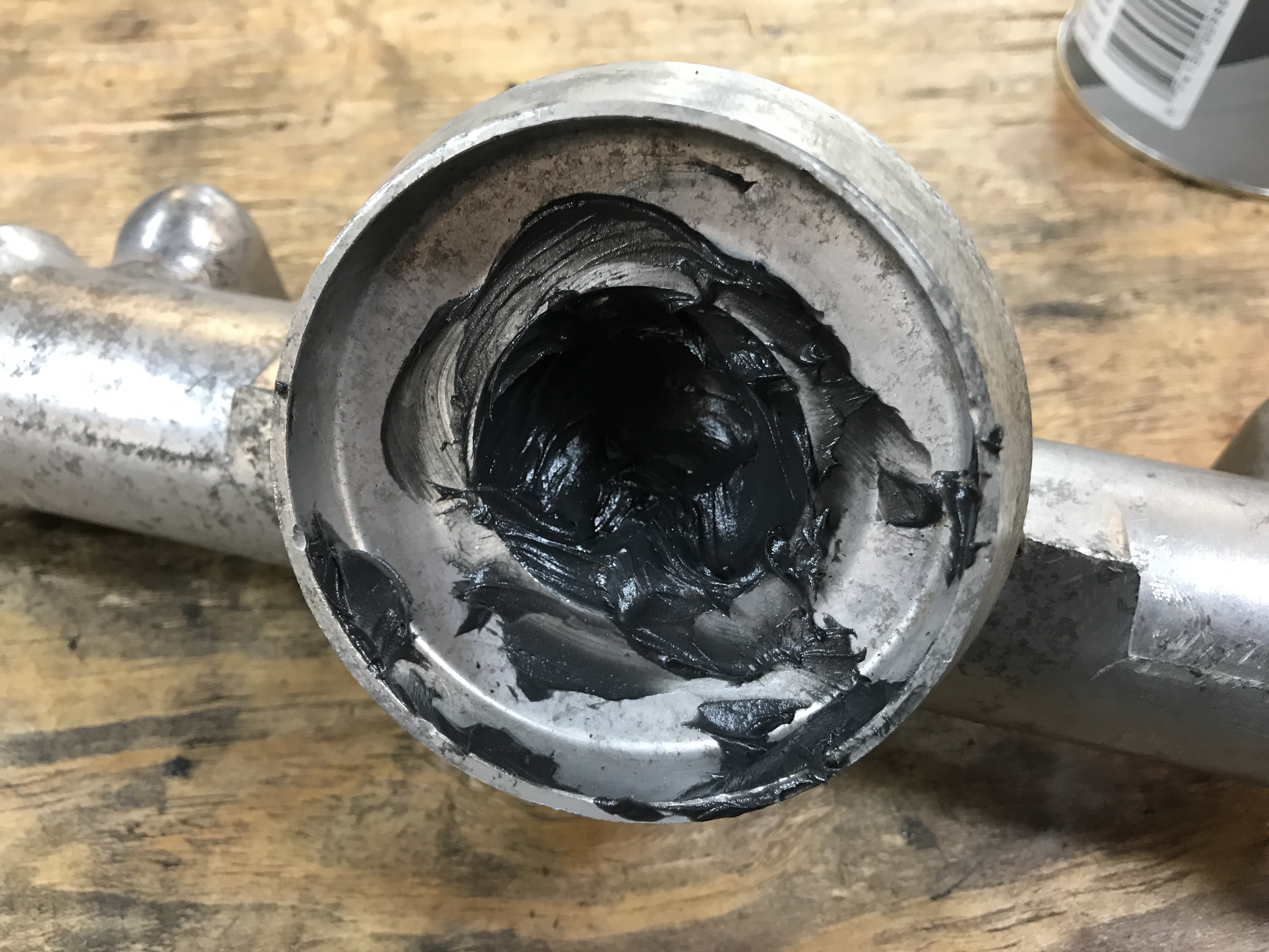

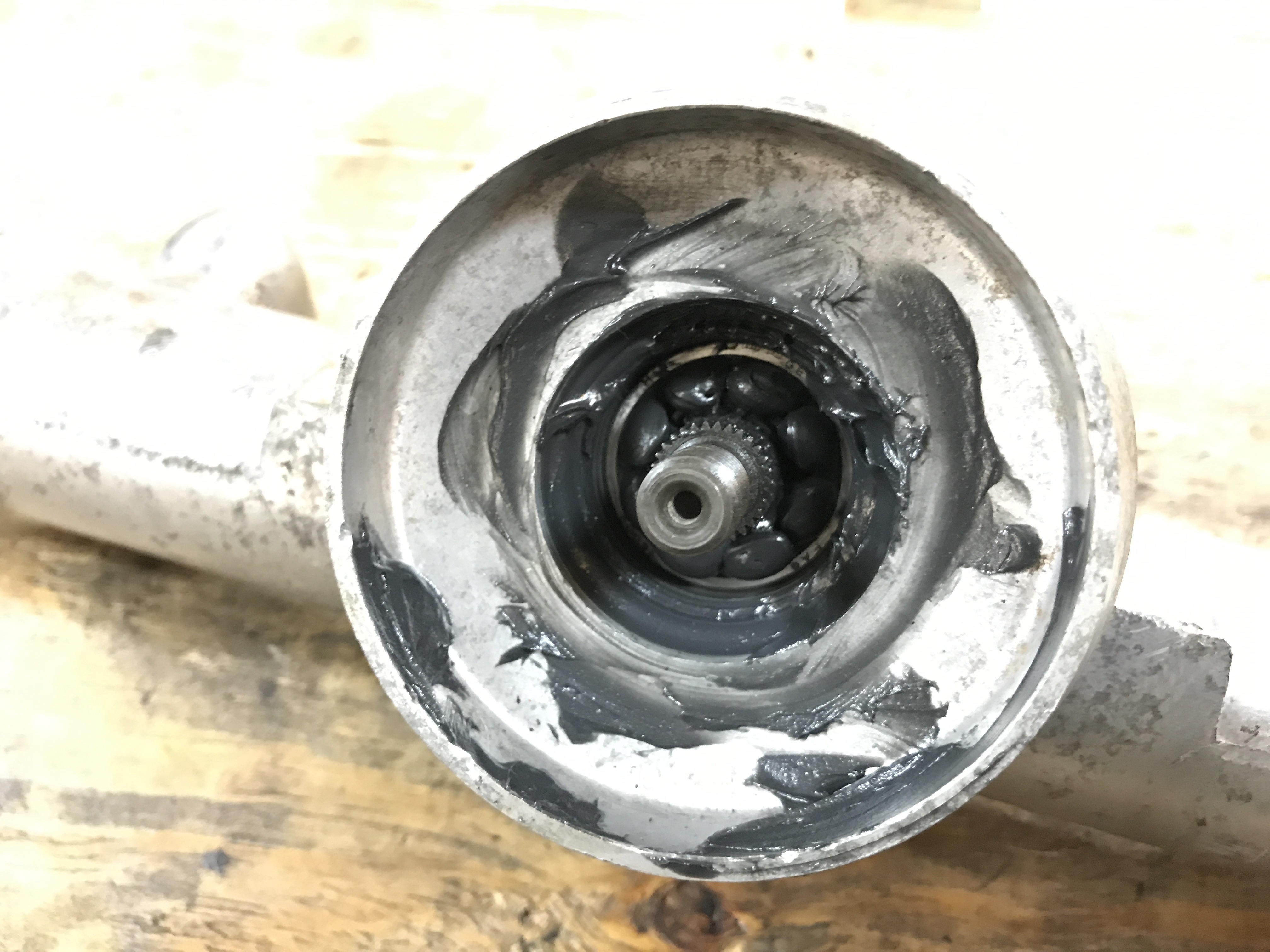

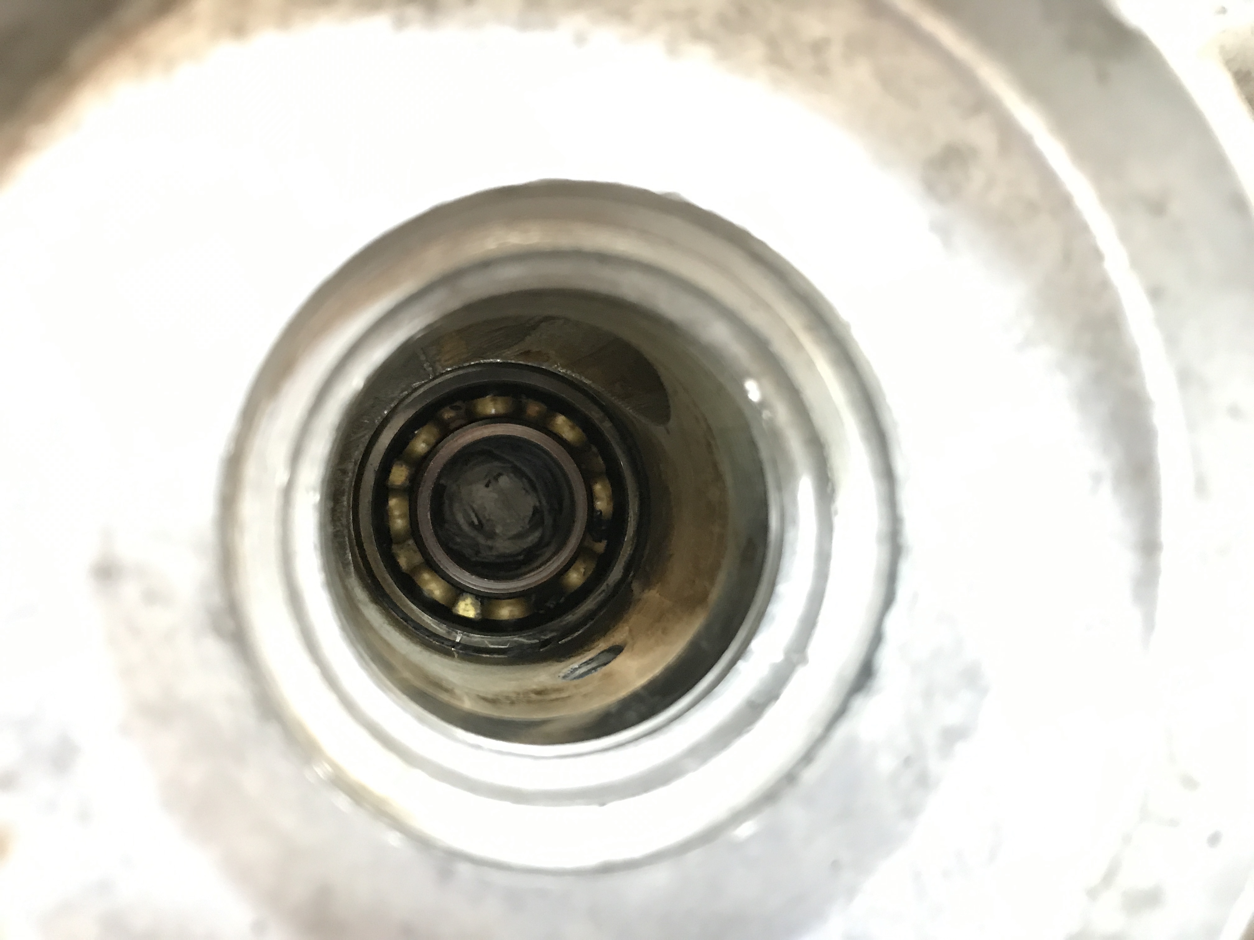

I never removed the inner pivot bearing, just cleaned out as much old grease as possible.
post Sep 15 2020, 07:46 PM
Post #1328
Posts: 8,343

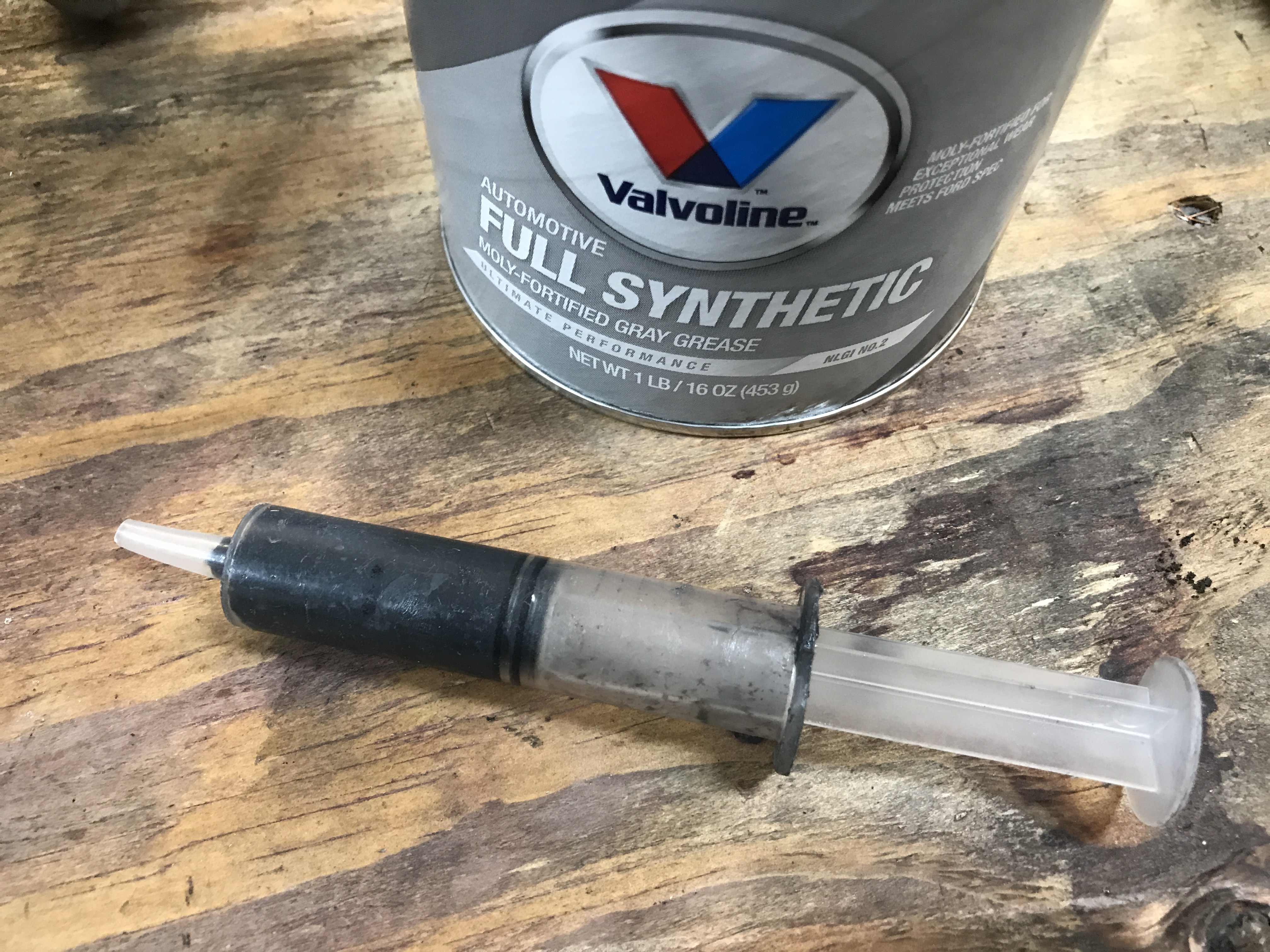

I made my own grease injector, to fill below the lower bearing.
post Sep 15 2020, 07:48 PM

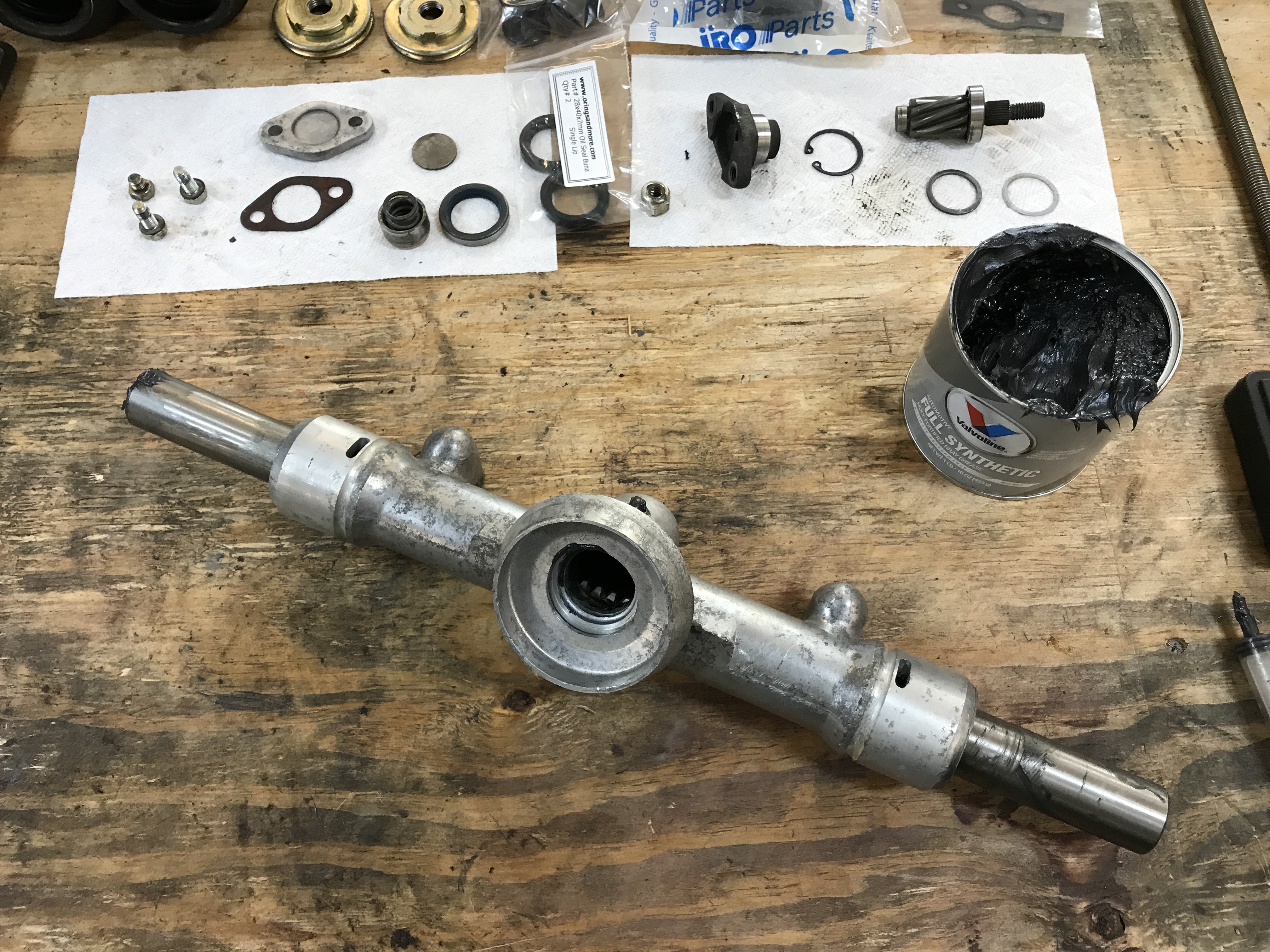

Then I greased up the rack, and slid that into place, maintaining the original left vs. right.

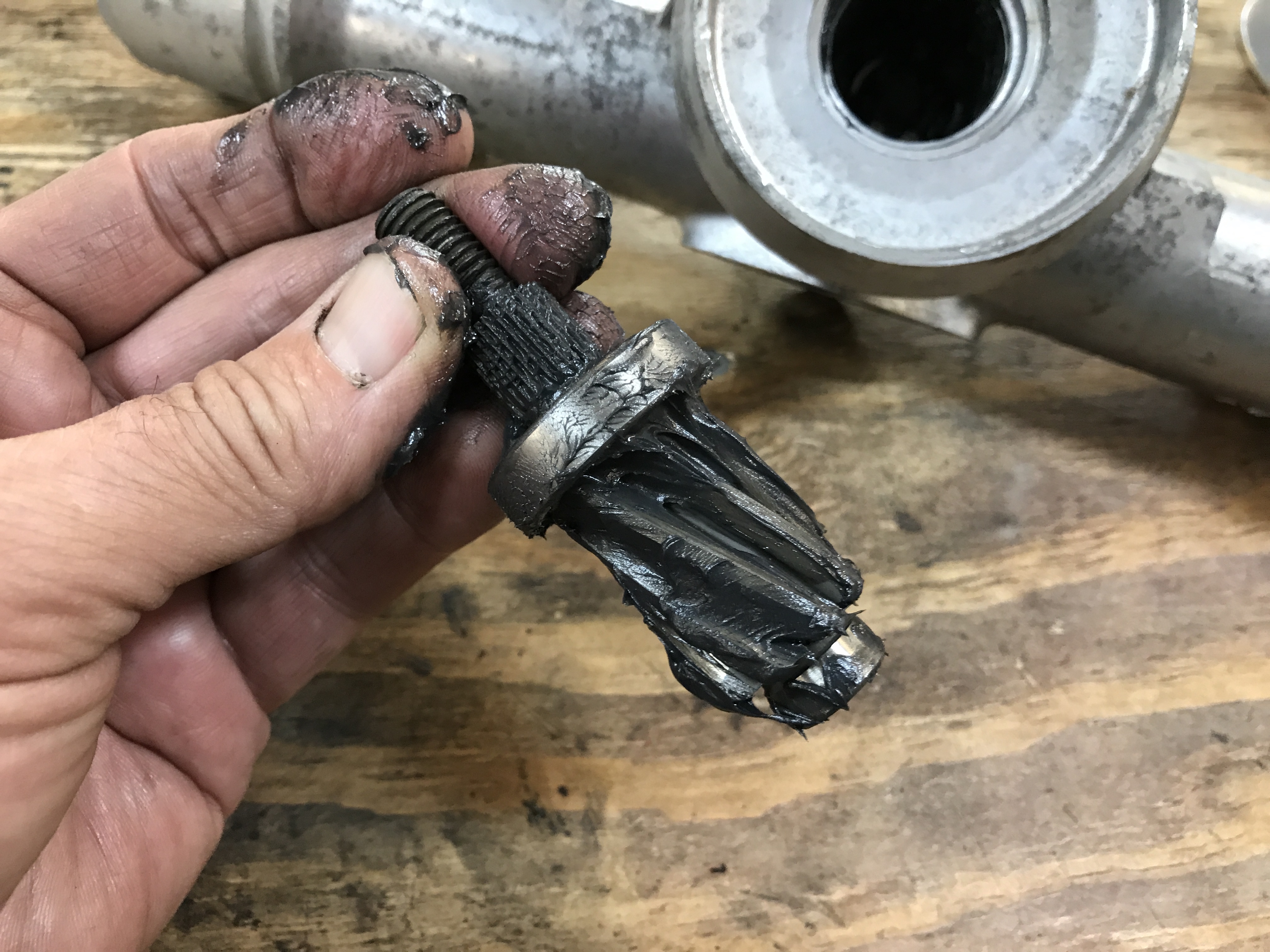

Posts: 8,343
Here's the pivot, with the upper bearing in place, all greased.

Then packed the interior with more grease.

With the rack centered, I installed the pivot. This took some patient twisting of the rack and pivot to get everything aligned.

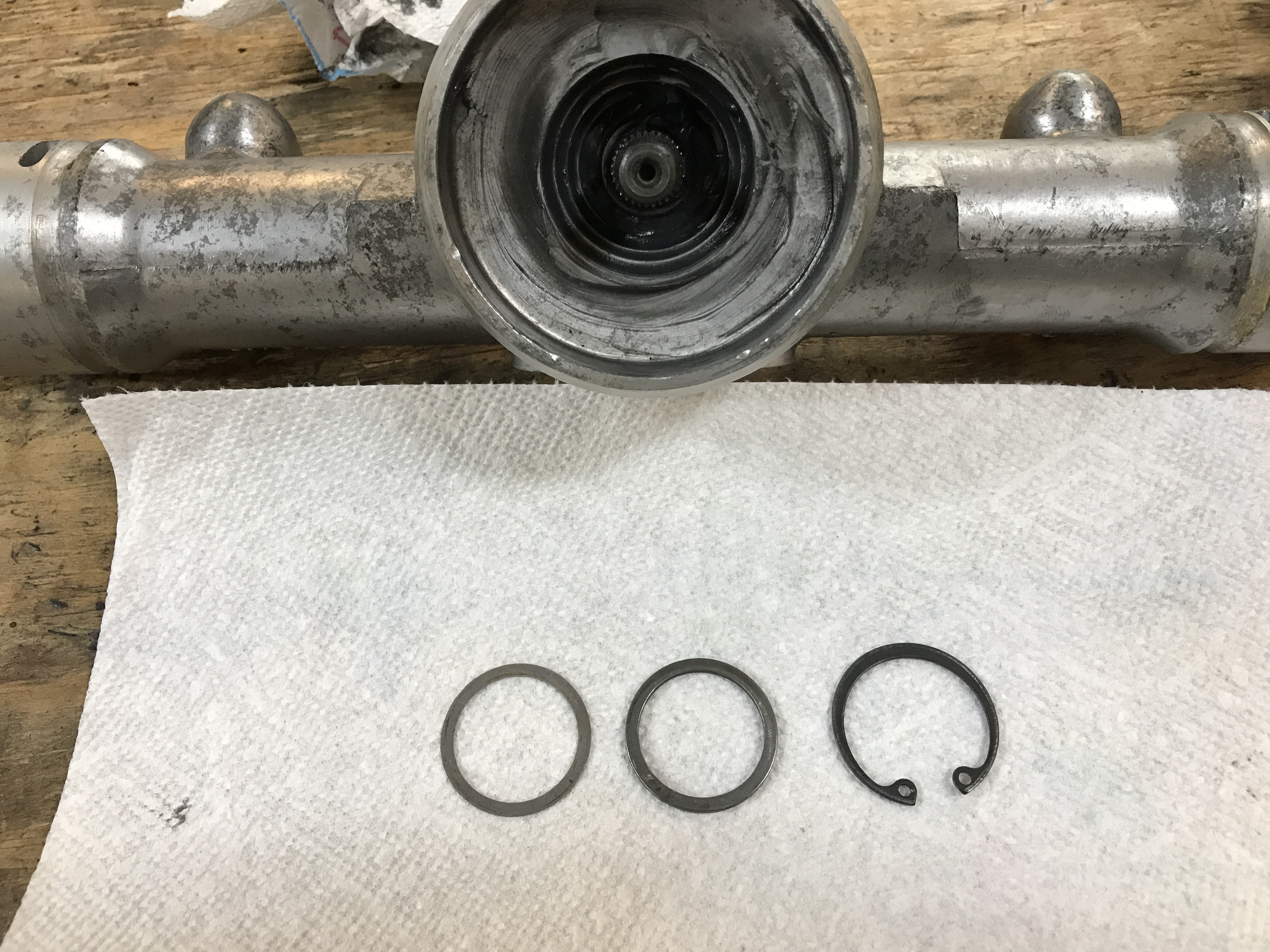

Next, the shims I removed and the lock ring.

With everything installed, I checked for end play: zero.

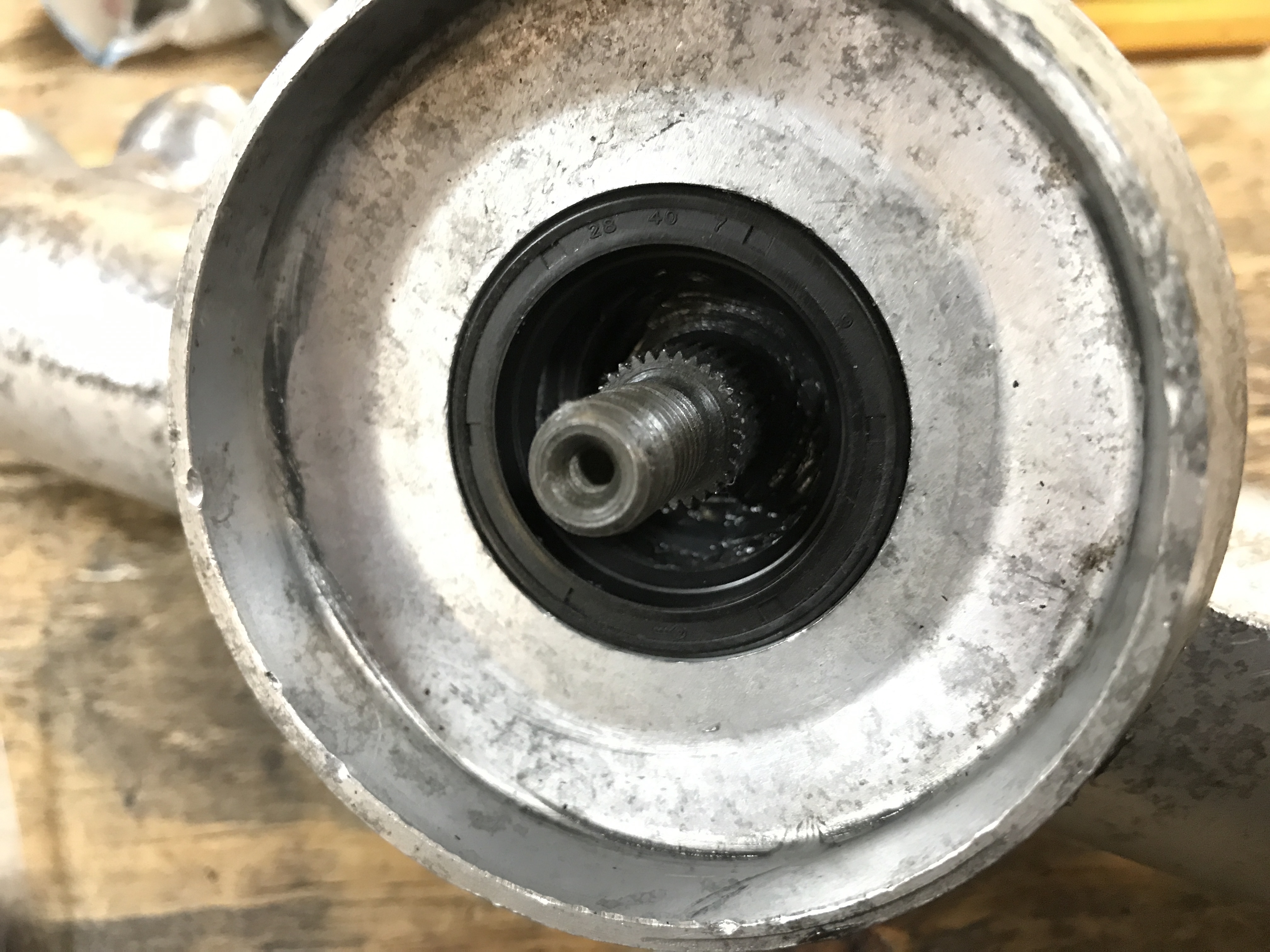

Posts: 8,343

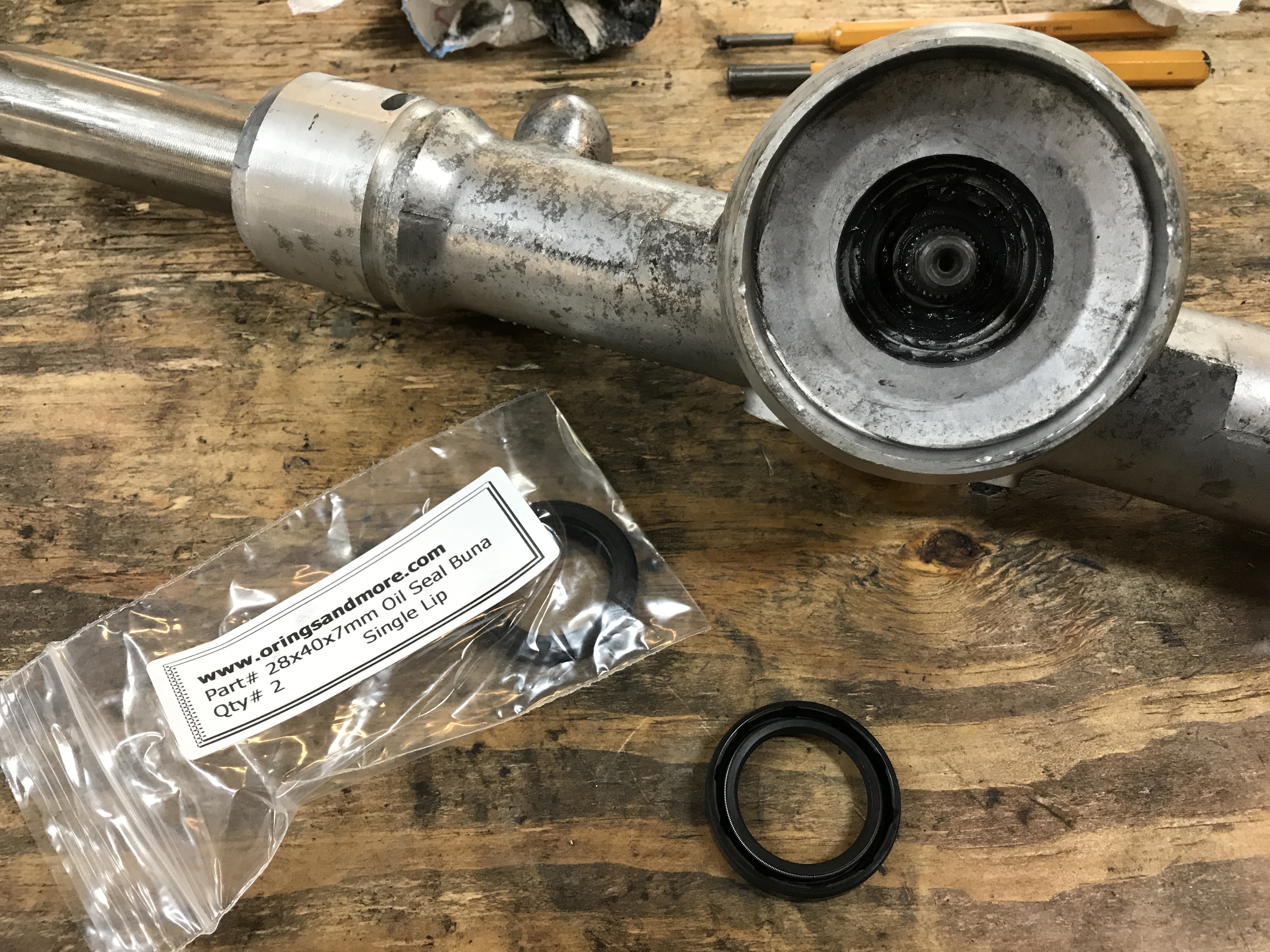

Then the pivot shaft seal, which I found based on dimension.
post Sep 15 2020, 07:57 PM
Post #1336
Posts: 8,343
Seal in place.
