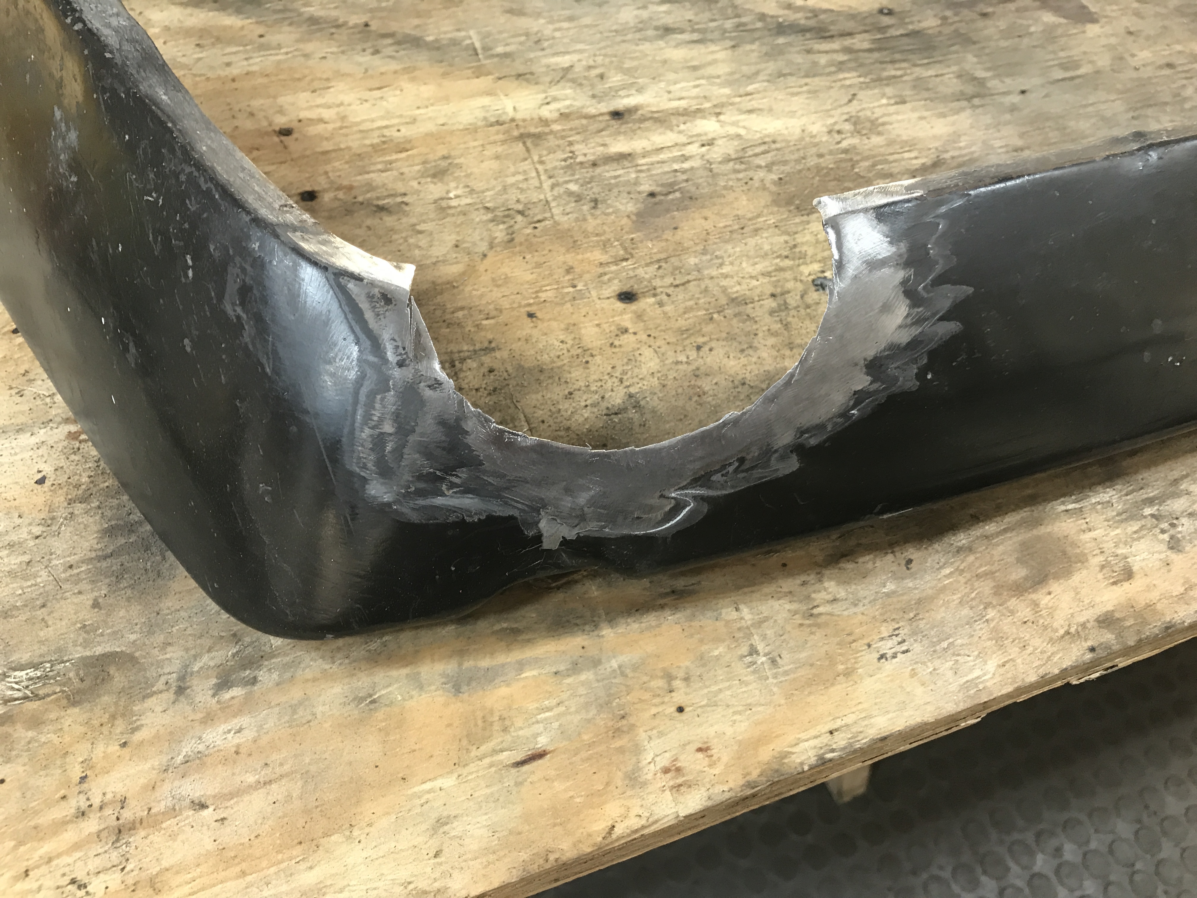

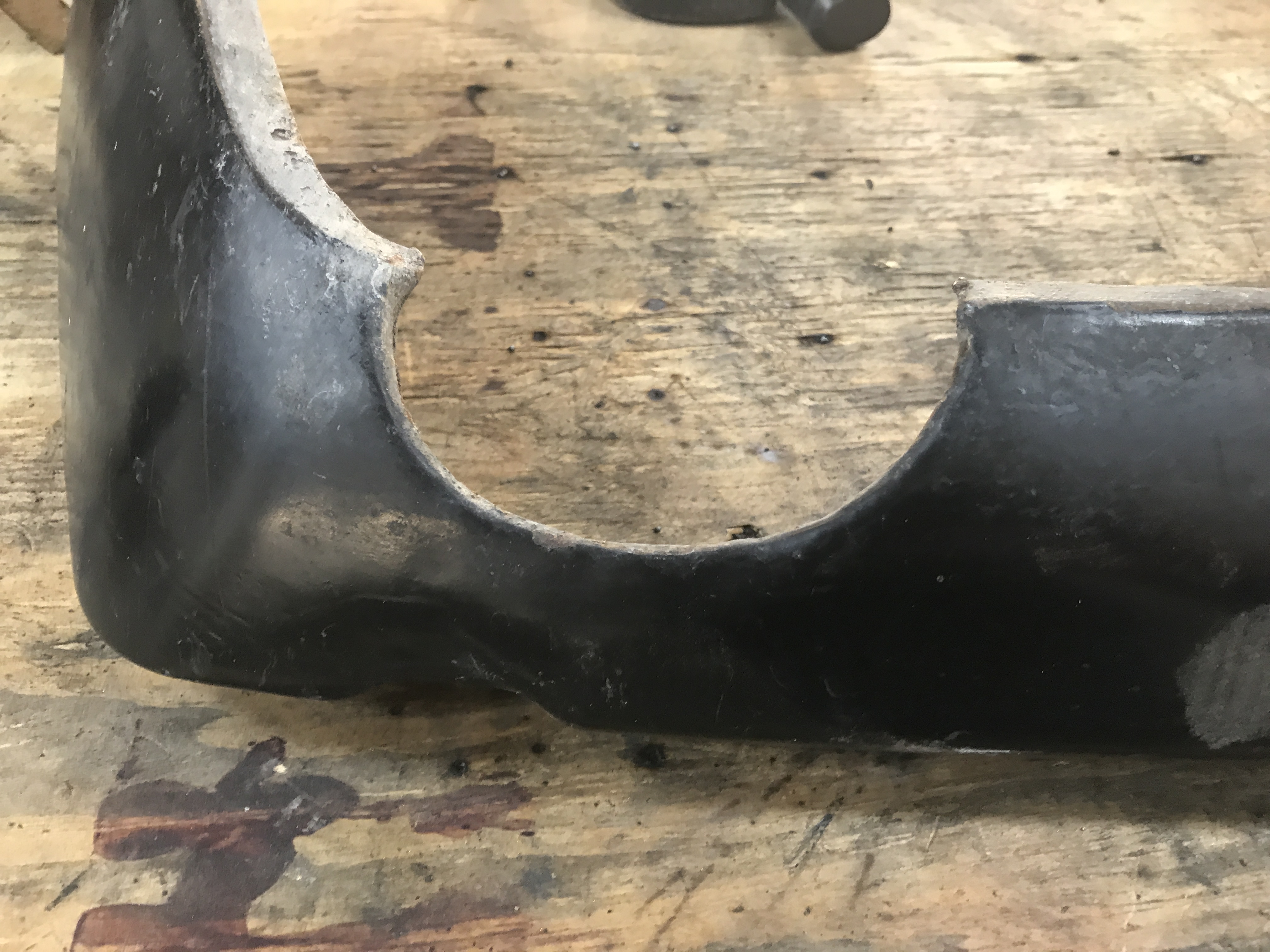

Here's the original tail pipe cut.
bkrantz
post Sep 21 2020, 07:36 PM
Post #1422
Posts: 8,343
Joined: 3-August 19
From: SW Colorado
Member No.: 23,343

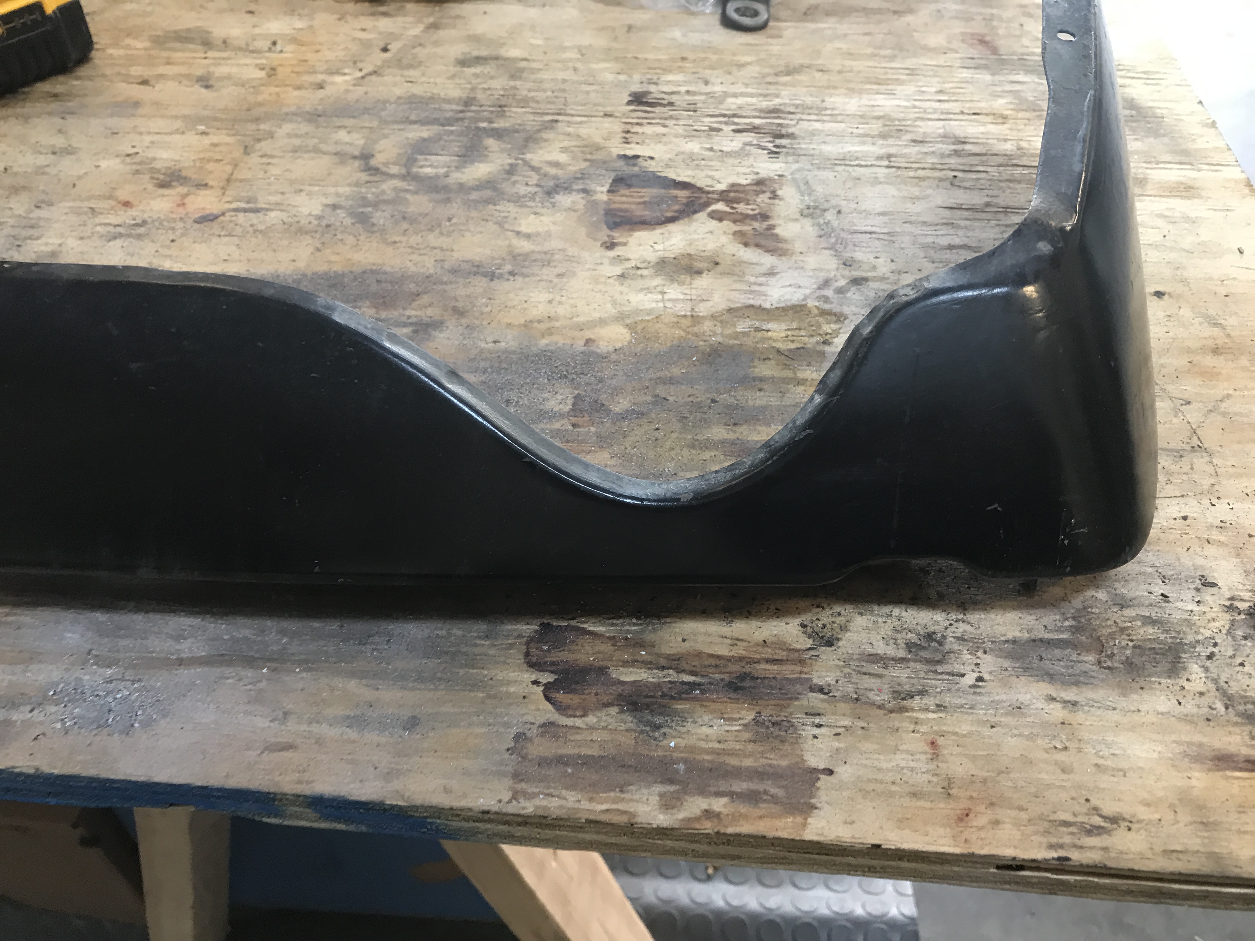

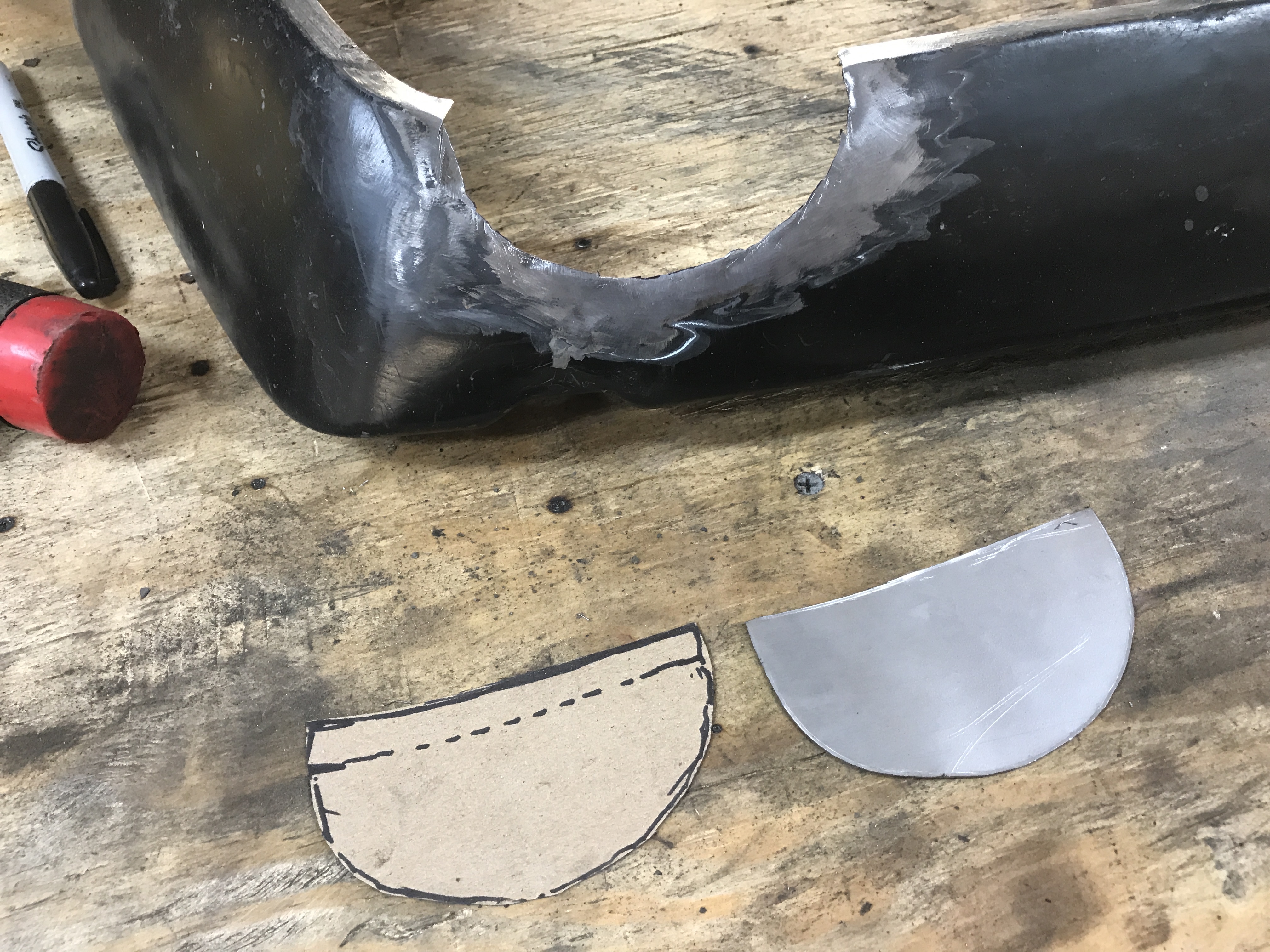

PO had a "custom" exhaust with dual pipes. And made a kinda-symmetrical cut in the valence. But not really. I want a stock muffler and single tail pipe, so this cut has to go.
bkrantz
post Sep 21 2020, 07:37 PM
Post #1423
Posts: 8,343
Joined: 3-August 19
From: SW Colorado
Member No.: 23,343
First I cut away the custom flange.

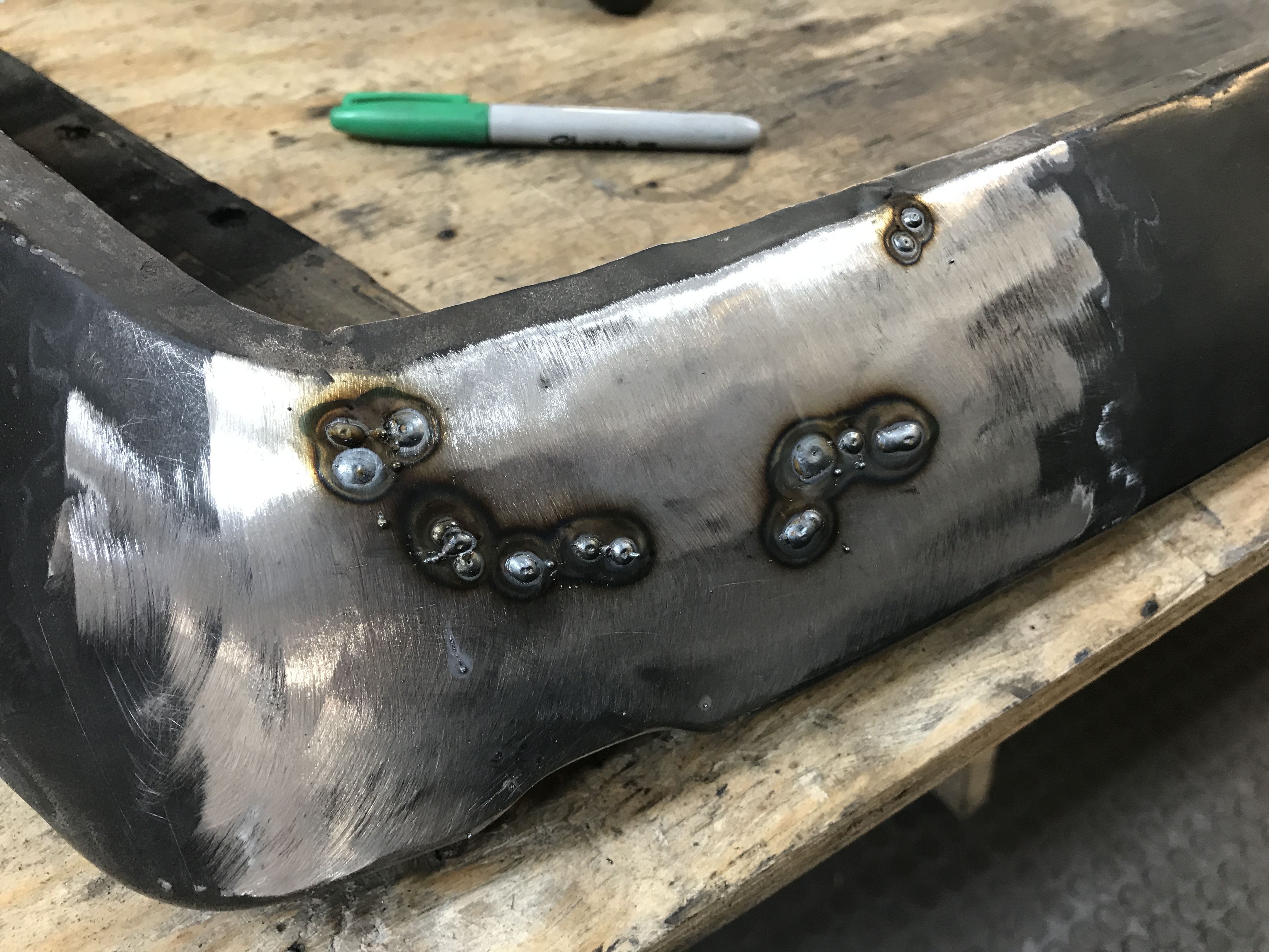

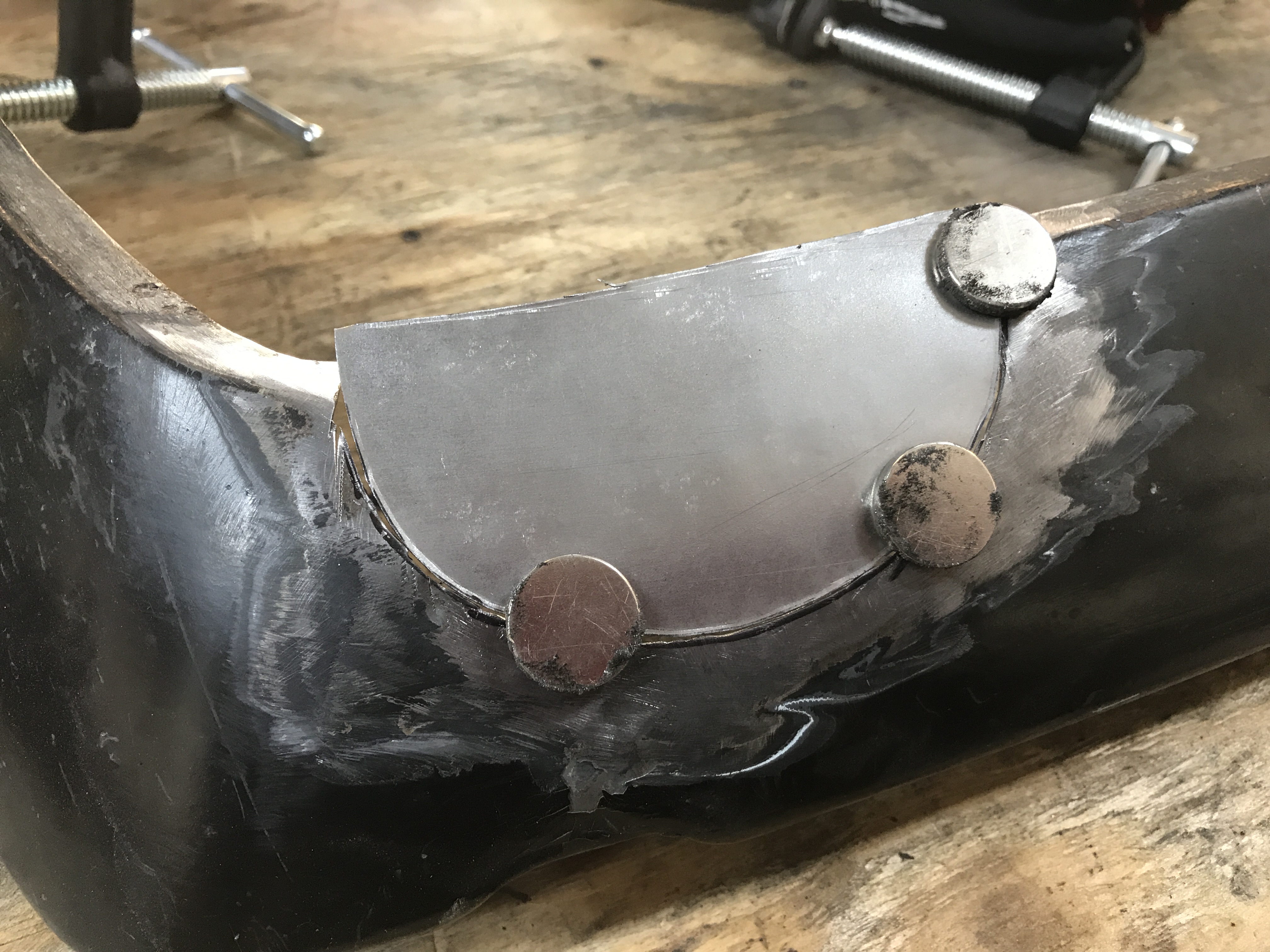

A quick cardboard template and then a patch piece.
bkrantz
post Sep 21 2020, 07:39 PM
Post #1425
Posts: 8,343
Joined: 3-August 19
From: SW Colorado
Member No.: 23,343

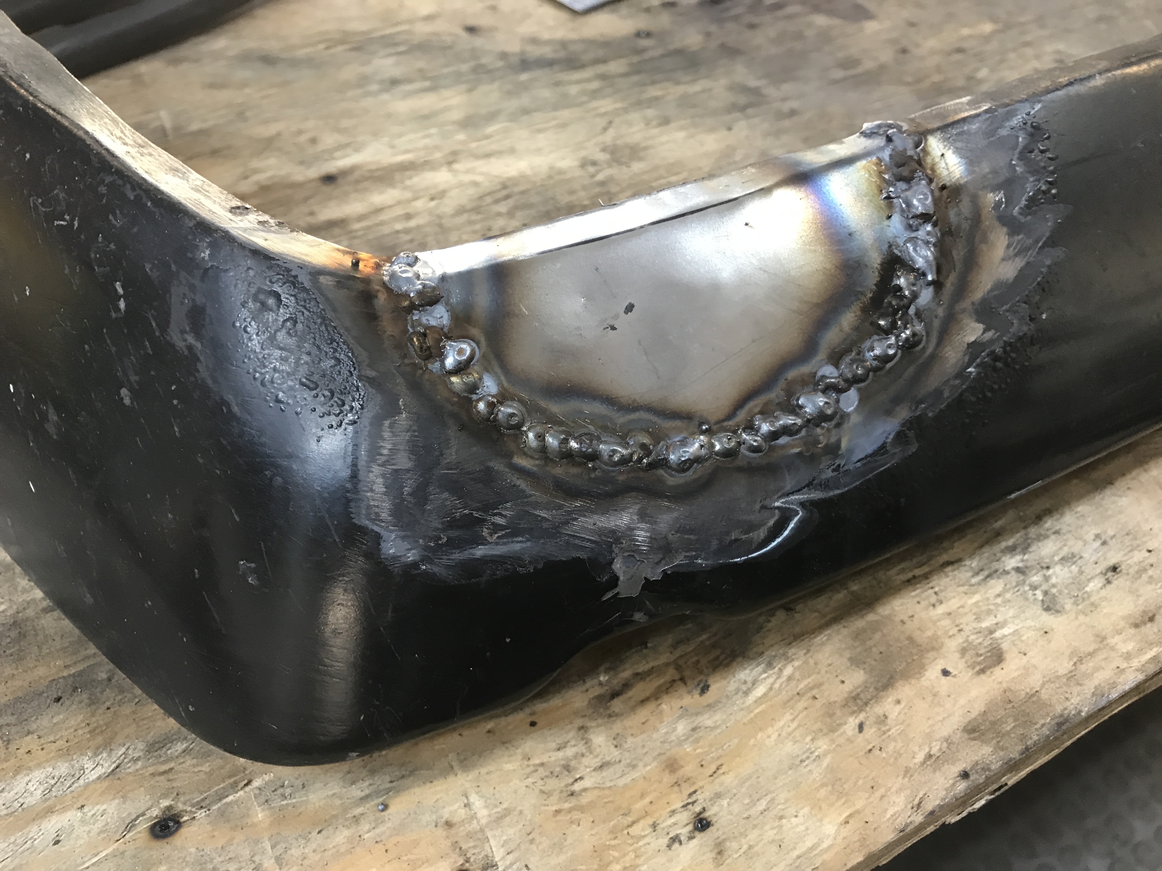

After some initial shaping, the patch in place.
bkrantz
post Sep 21 2020, 07:40 PM
Post #1426
Posts: 8,343
Joined: 3-August 19
From: SW Colorado
Member No.: 23,343

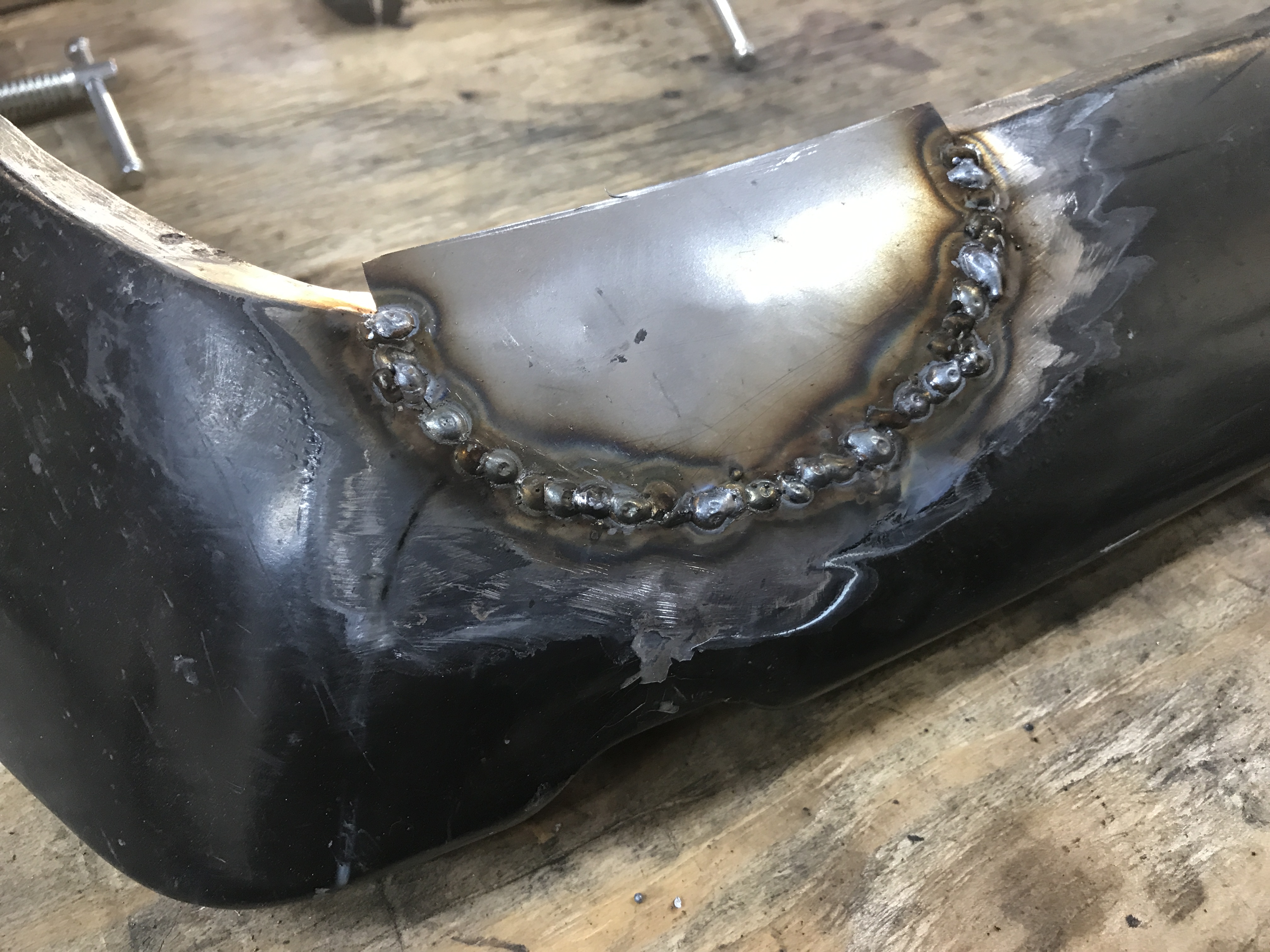

Welded along the main surface.
bkrantz
post Sep 21 2020, 07:41 PM
Post #1427
Posts: 8,343
Joined: 3-August 19
From: SW Colorado
Member No.: 23,343
Flange folded and the rest of the welding.

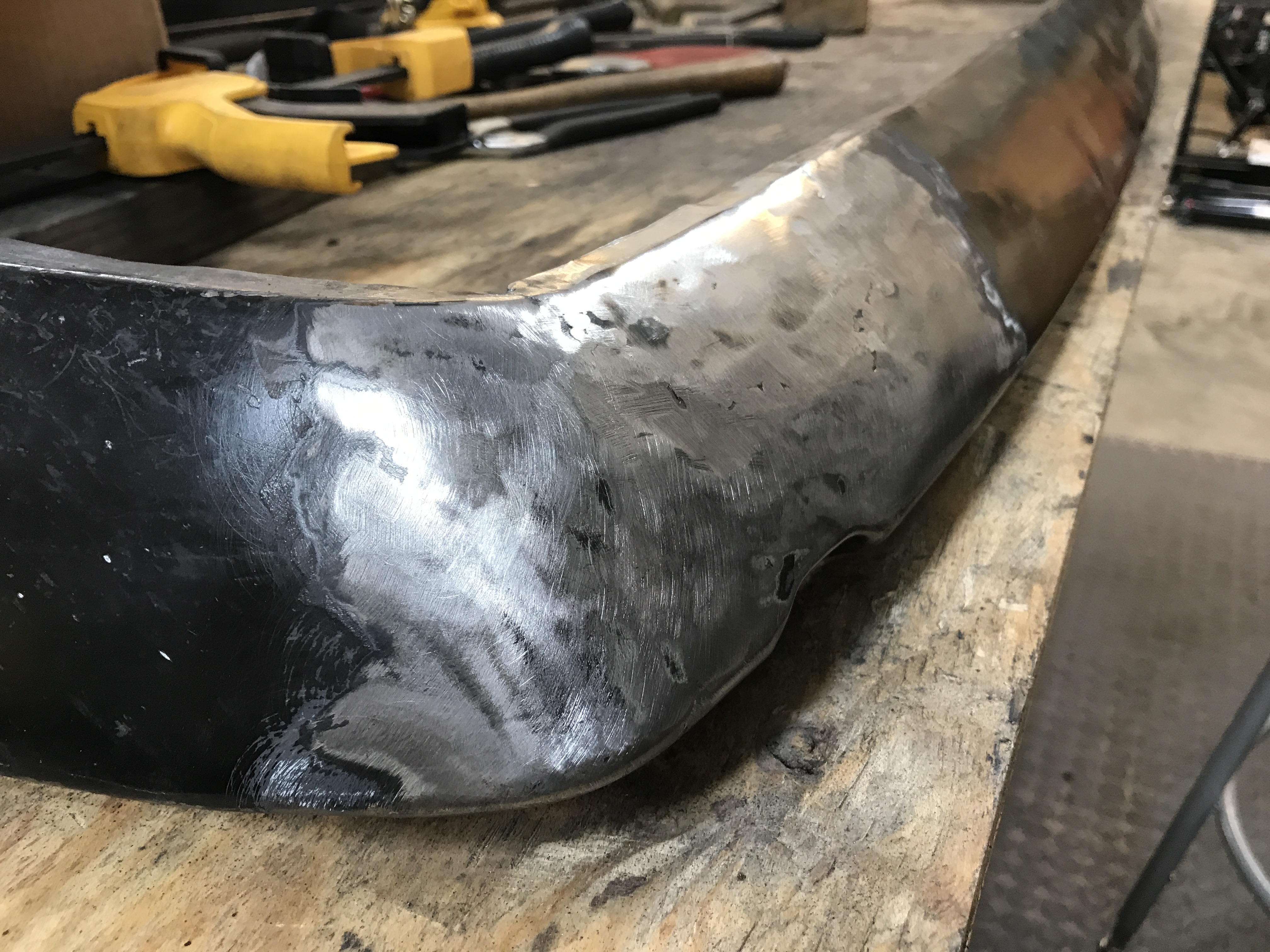

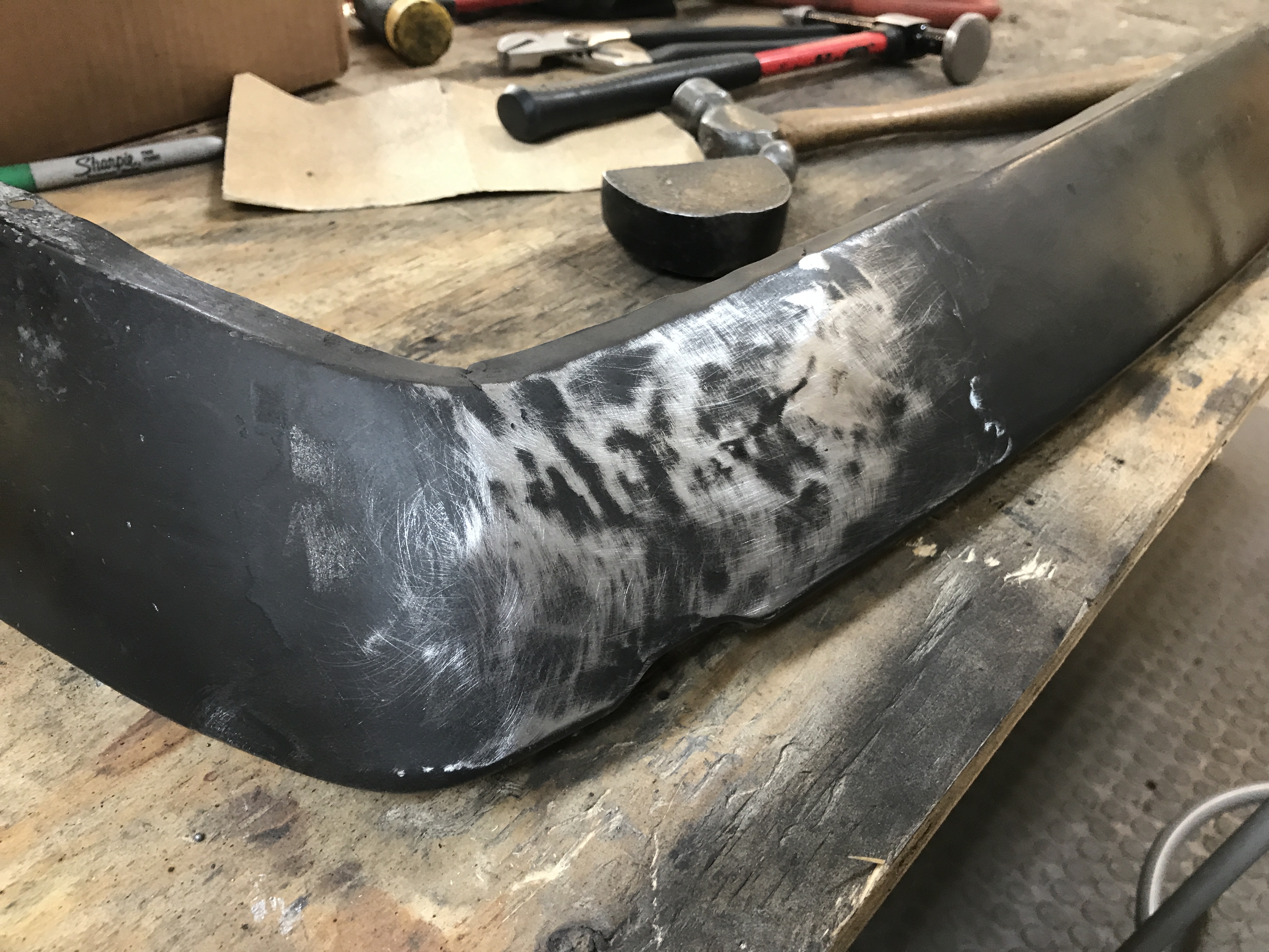

First pass grinding and a bit more shaping.
bkrantz
post Sep 22 2020, 07:46 PM
Post #1429
Posts: 8,343
Joined: 3-August 19
From: SW Colorado
Member No.: 23,343
Some flat black for a guide coat.
bkrantz
post Sep 22 2020, 07:48 PM
Post #1430
Posts: 8,343
Joined: 3-August 19
From: SW Colorado
Member No.: 23,343

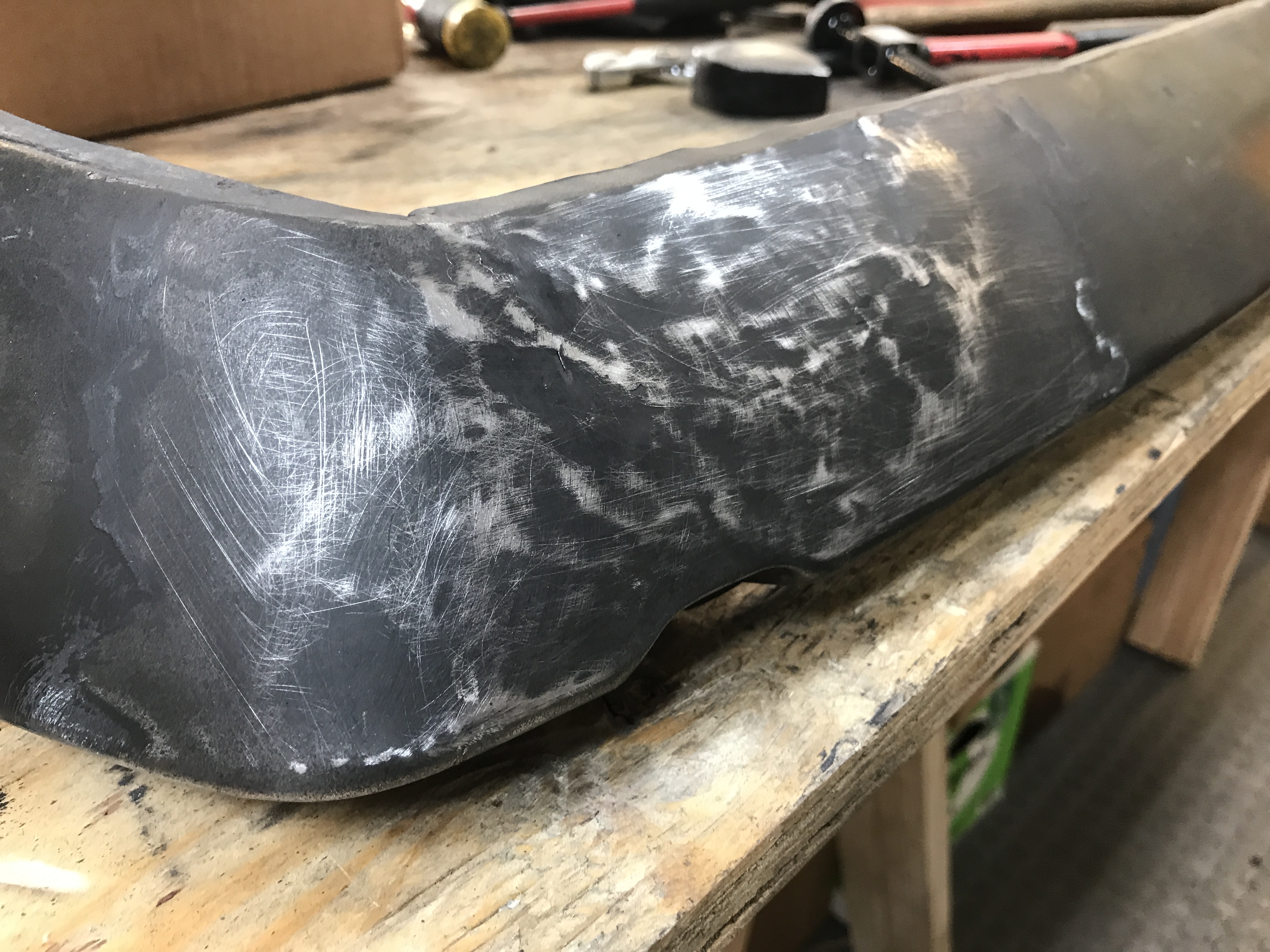

After a quick scuff with a sanding block. A bit lumpy.
bkrantz
post Sep 22 2020, 07:49 PM
Post #1431
Posts: 8,343
Joined: 3-August 19
From: SW Colorado
Member No.: 23,343
Touch up welding.
bkrantz
post Sep 22 2020, 07:51 PM
Post #1432
Posts: 8,343
Joined: 3-August 19
From: SW Colorado
Member No.: 23,343

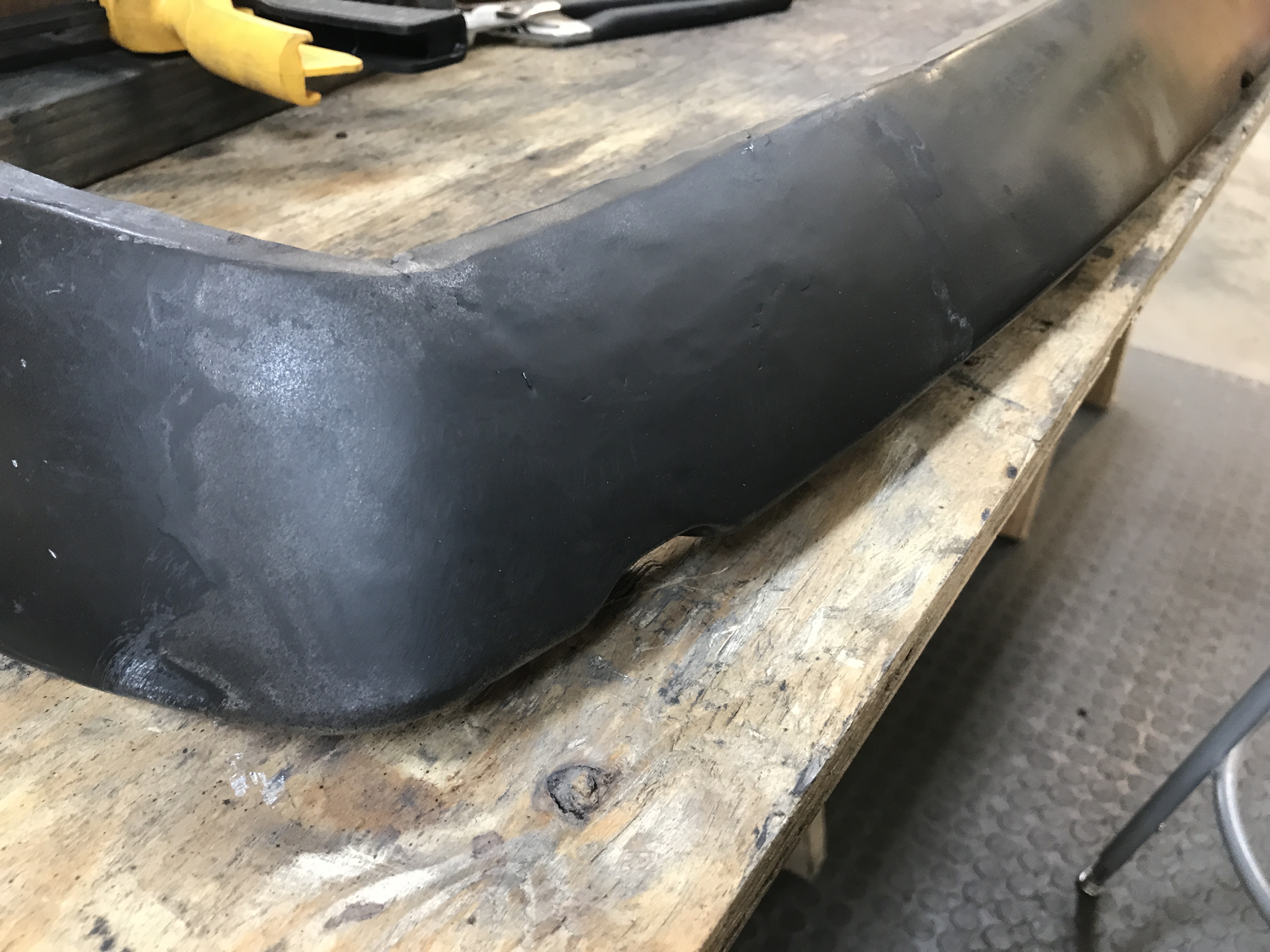

More grinding and shaping.
bkrantz
post Sep 22 2020, 08:15 PM
Post #1433
Posts: 8,343
Joined: 3-August 19
From: SW Colorado
Member No.: 23,343
After another round of shaping and guide coat. Good enough for this piece.

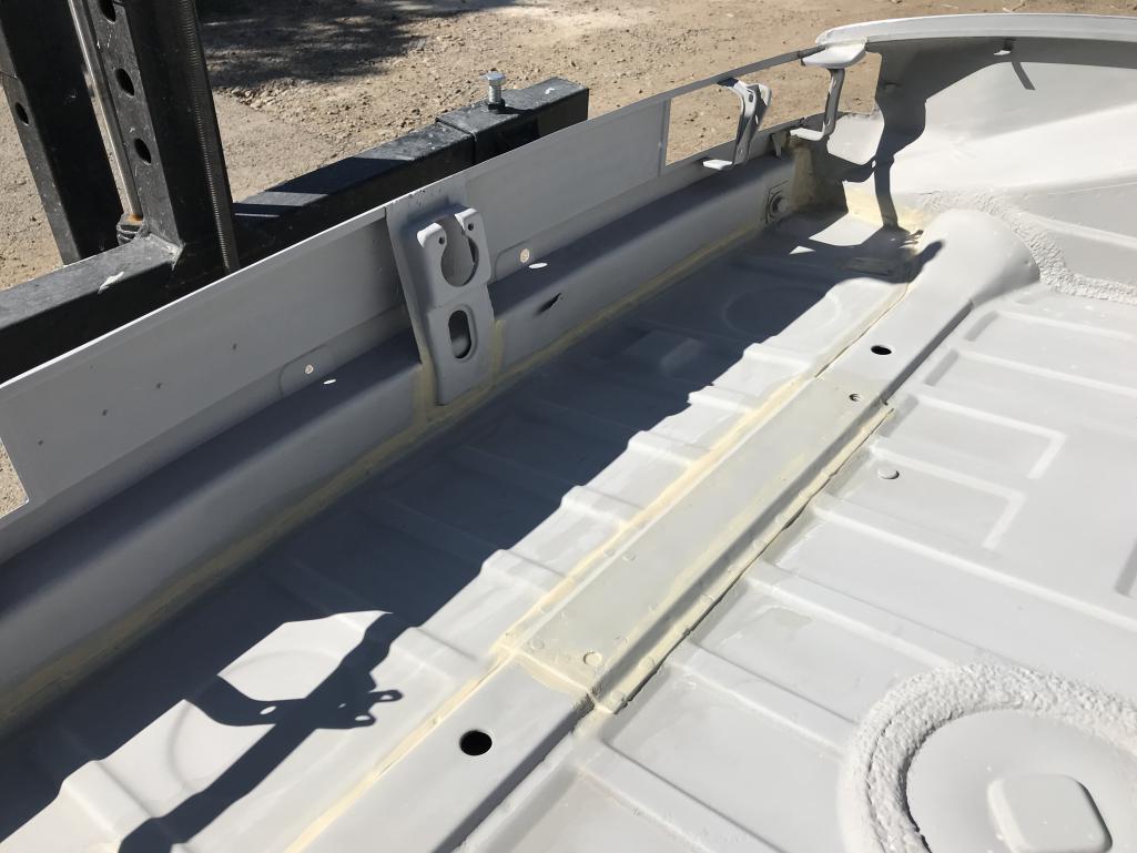

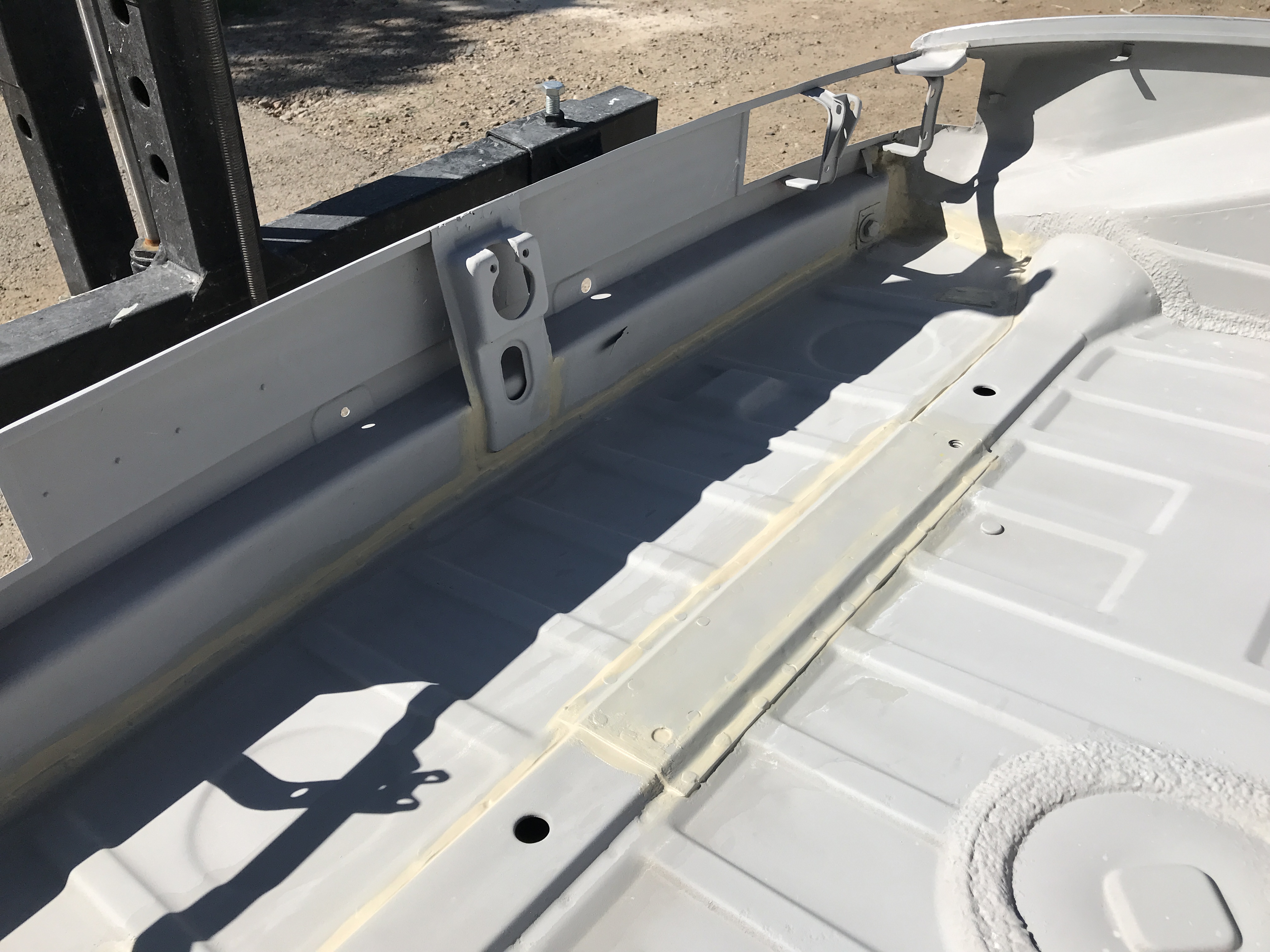

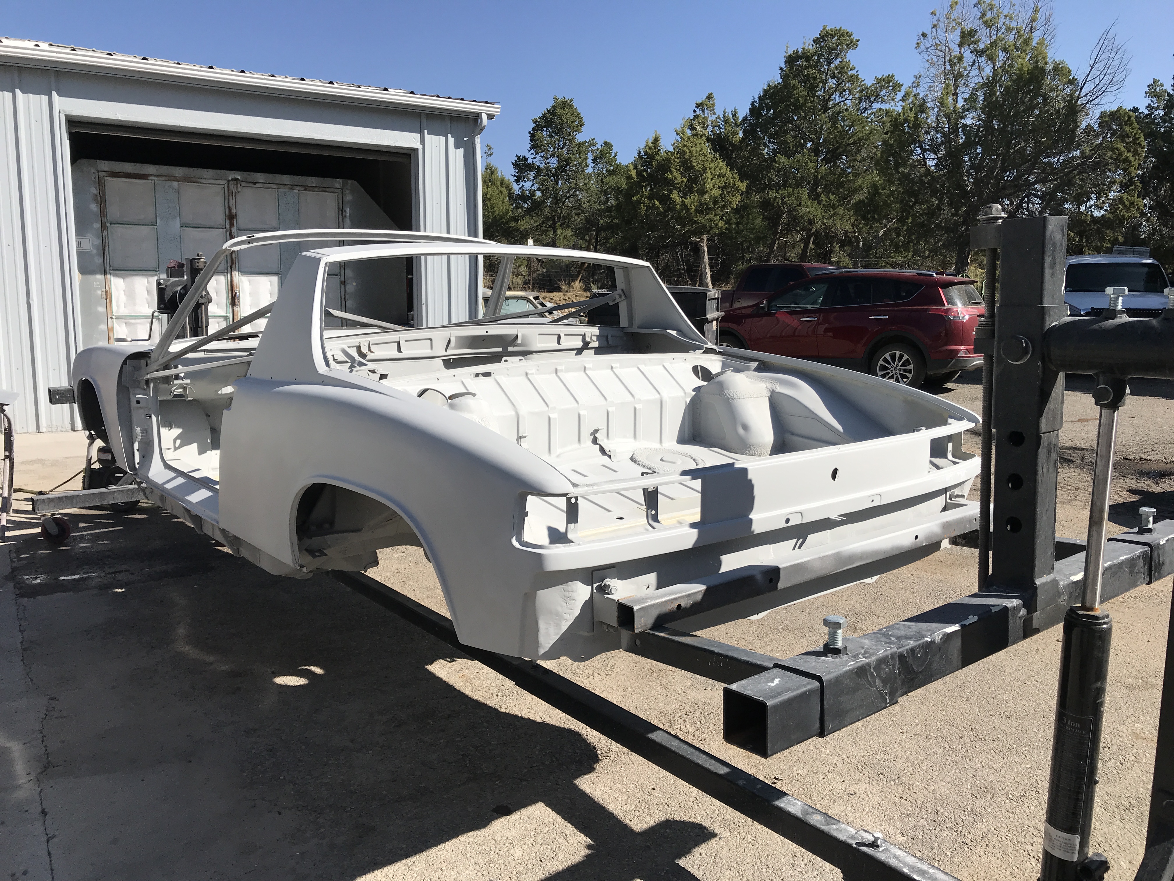

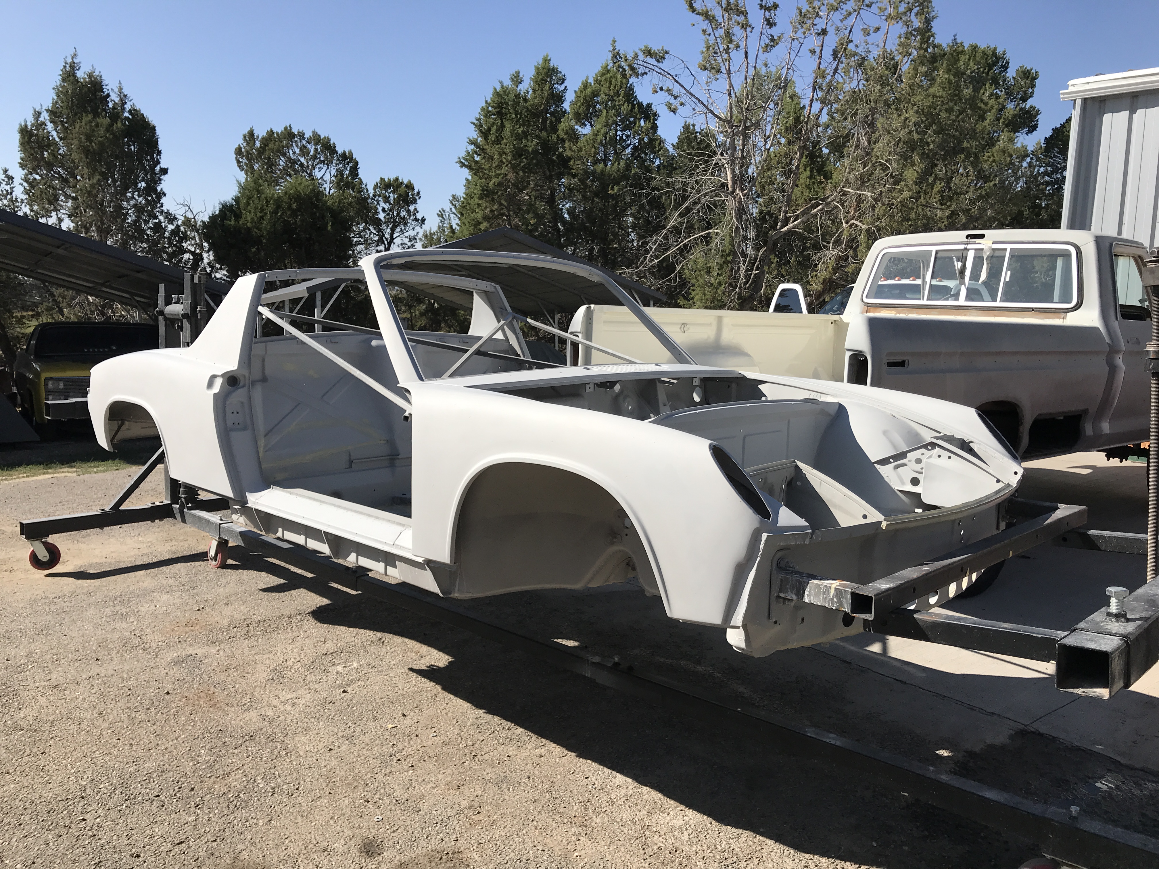

Progress at the body shop. This week they got onto my car. They finished the hand sanding on the body and doors, and were starting on the trunk lids.
bkrantz
post Sep 23 2020, 07:21 PM
Post #1435
Posts: 8,343
Joined: 3-August 19
From: SW Colorado
Member No.: 23,343
The plan is to paint the underside today, while still on the rotisserie, and then put the car on the dolly, remove the interior brace, and paint the interior and topside tomorrow and Friday. BTW, I did get to see the new color on the headlight covers--but will keep the suspense a few more days.

They also did most of the seam sealing, but need to hit a few more spots.

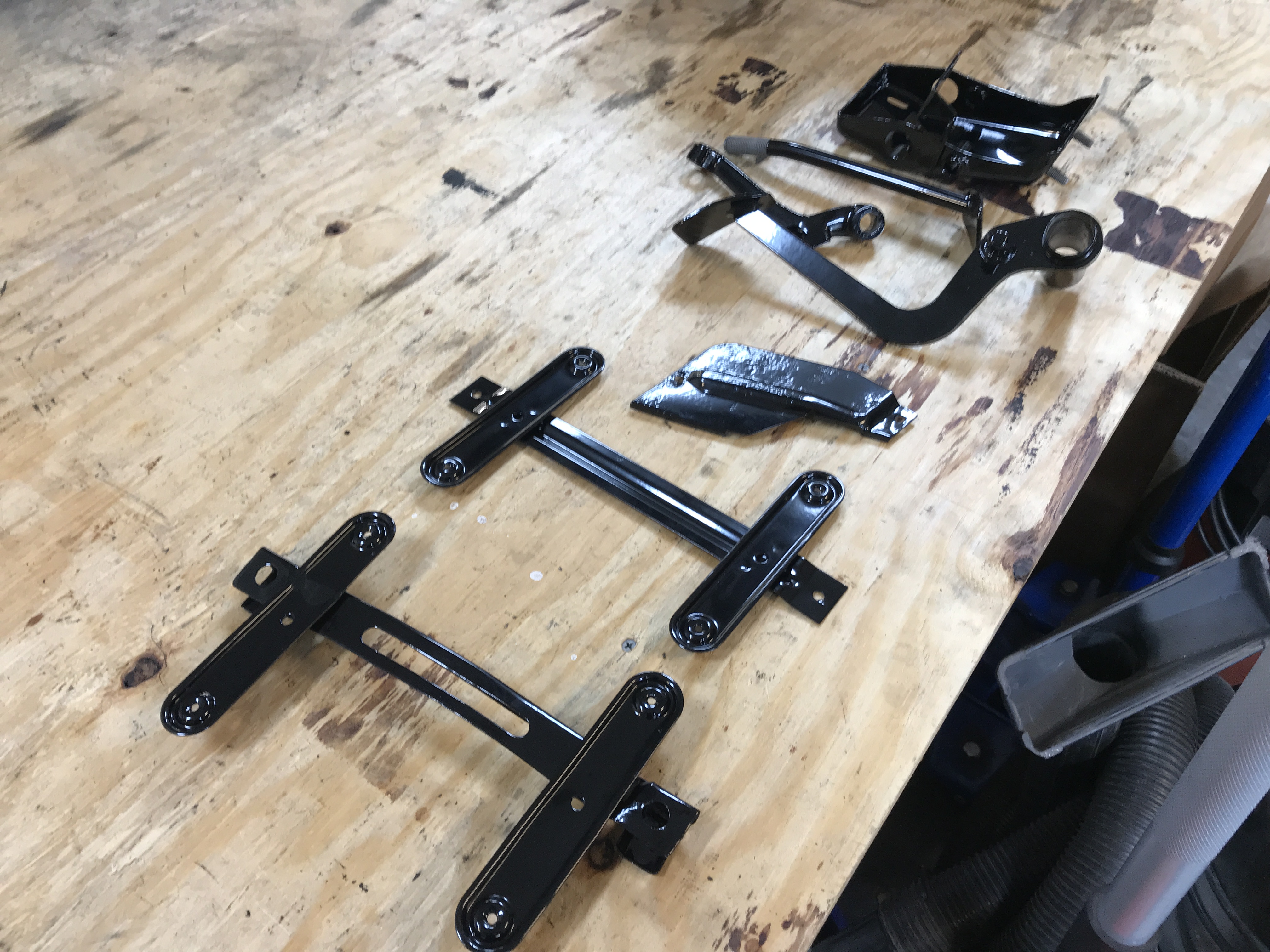

I also picked up another batch of parts from the powder coat shop. More shiny.

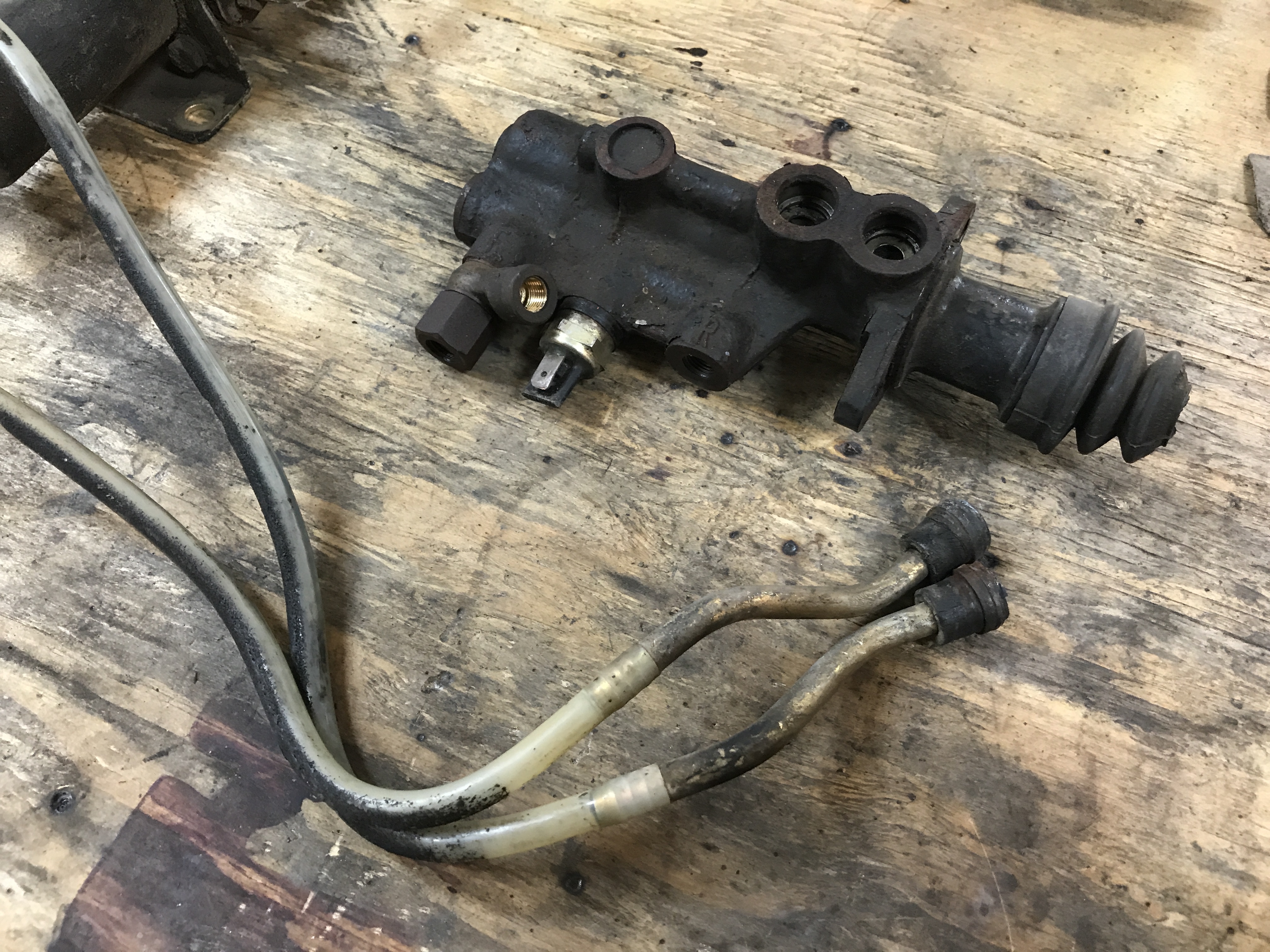

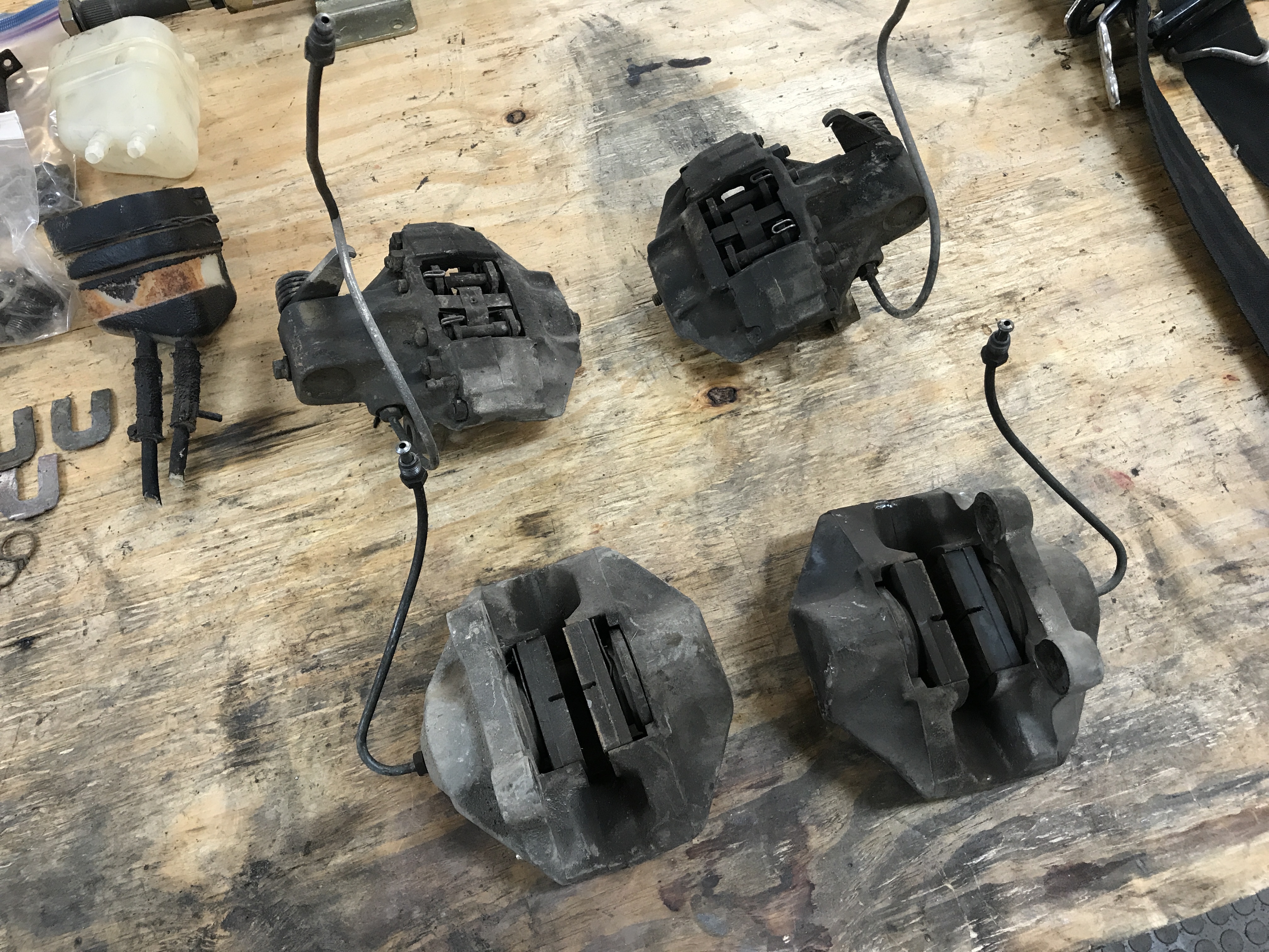

Next up, brakes. I have not seen these since last year. It looks like all parts are present, including on the rear calipers. I think the logical thing is to send these off to PMB, along with the proportioning valve.

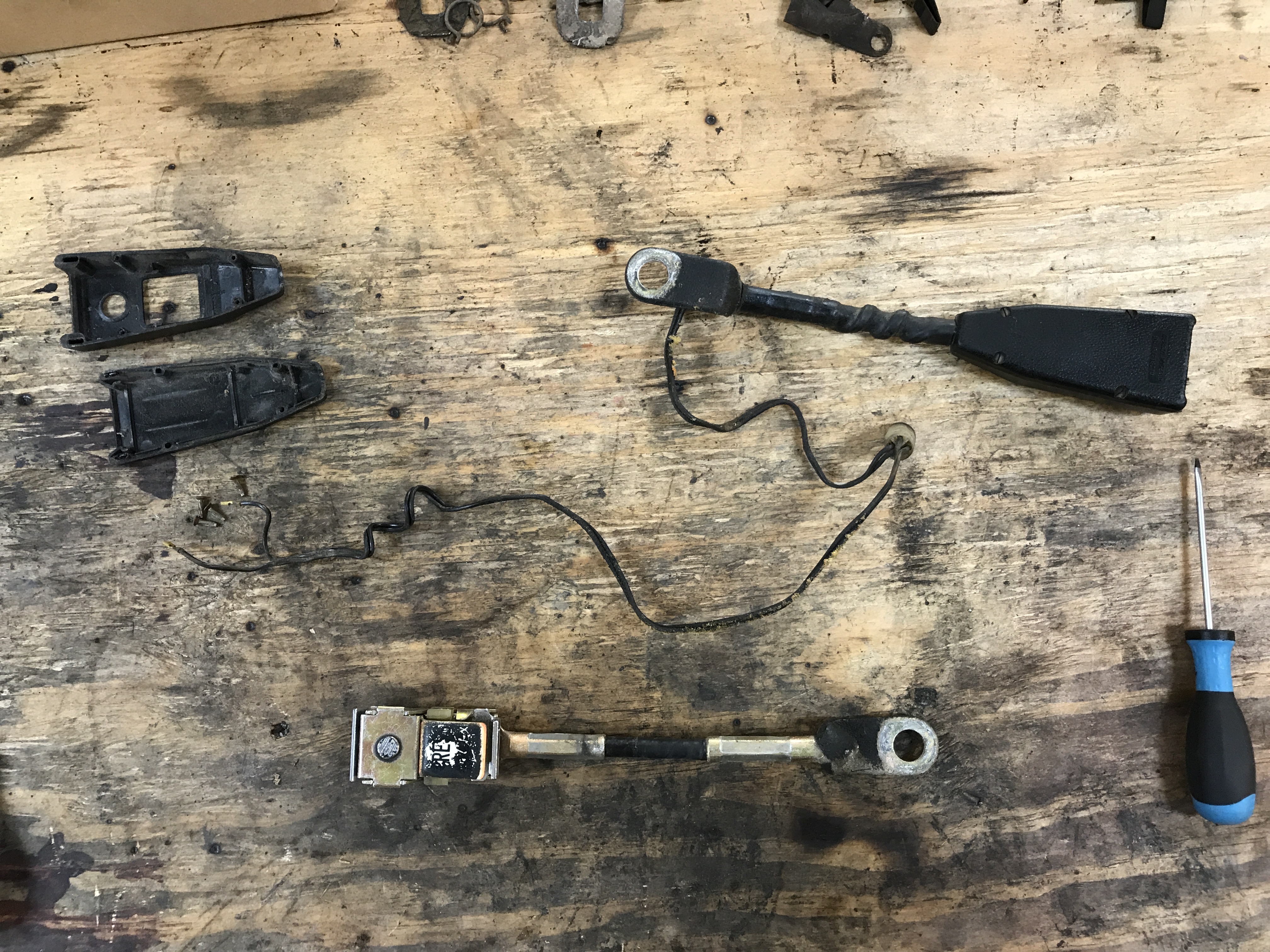

The other thing I want to send out is the seat belts, for re-webbing. The hardware needs some attention, too.
For the receivers, I removed the wiring for the warning lights.
