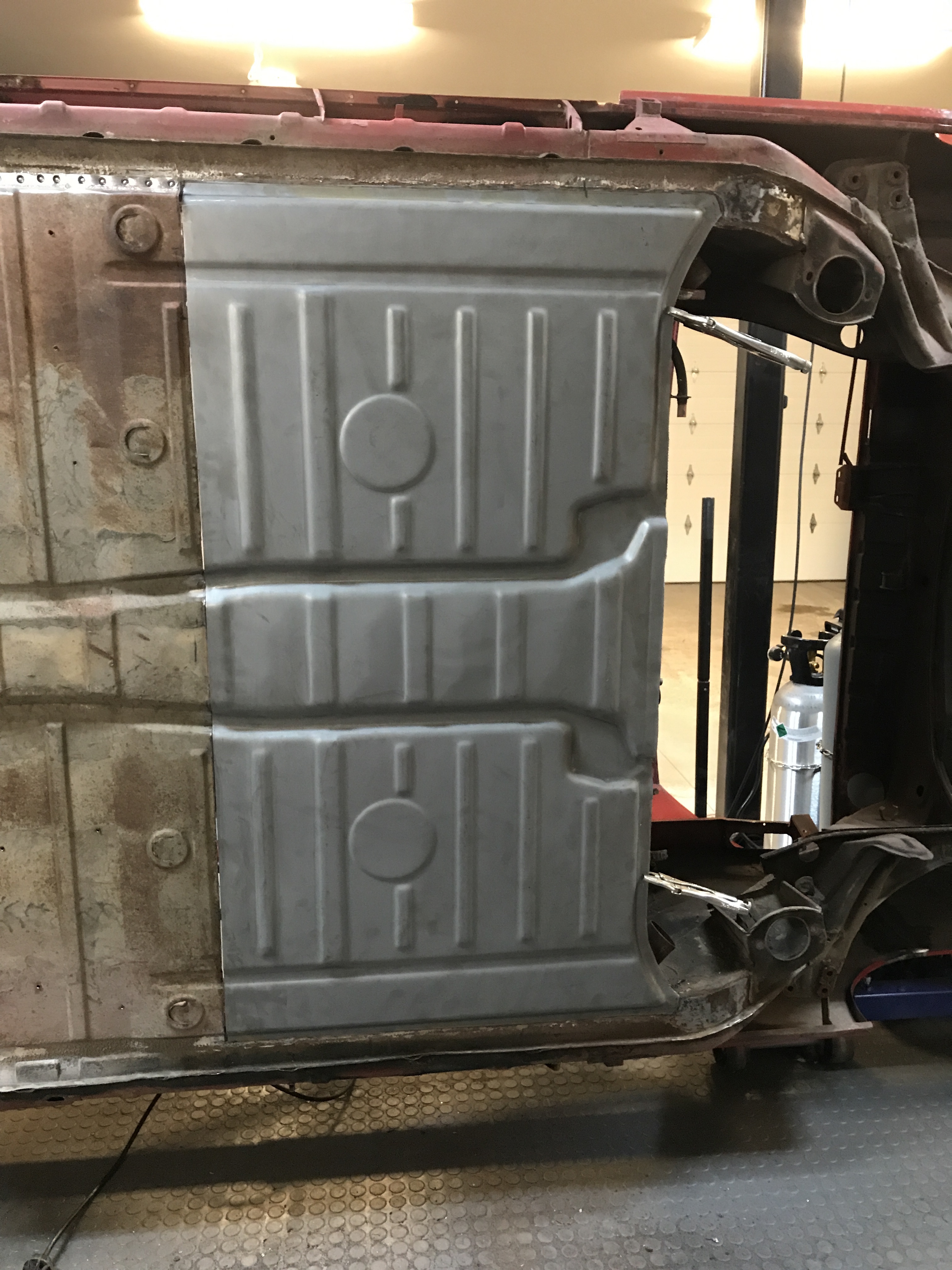

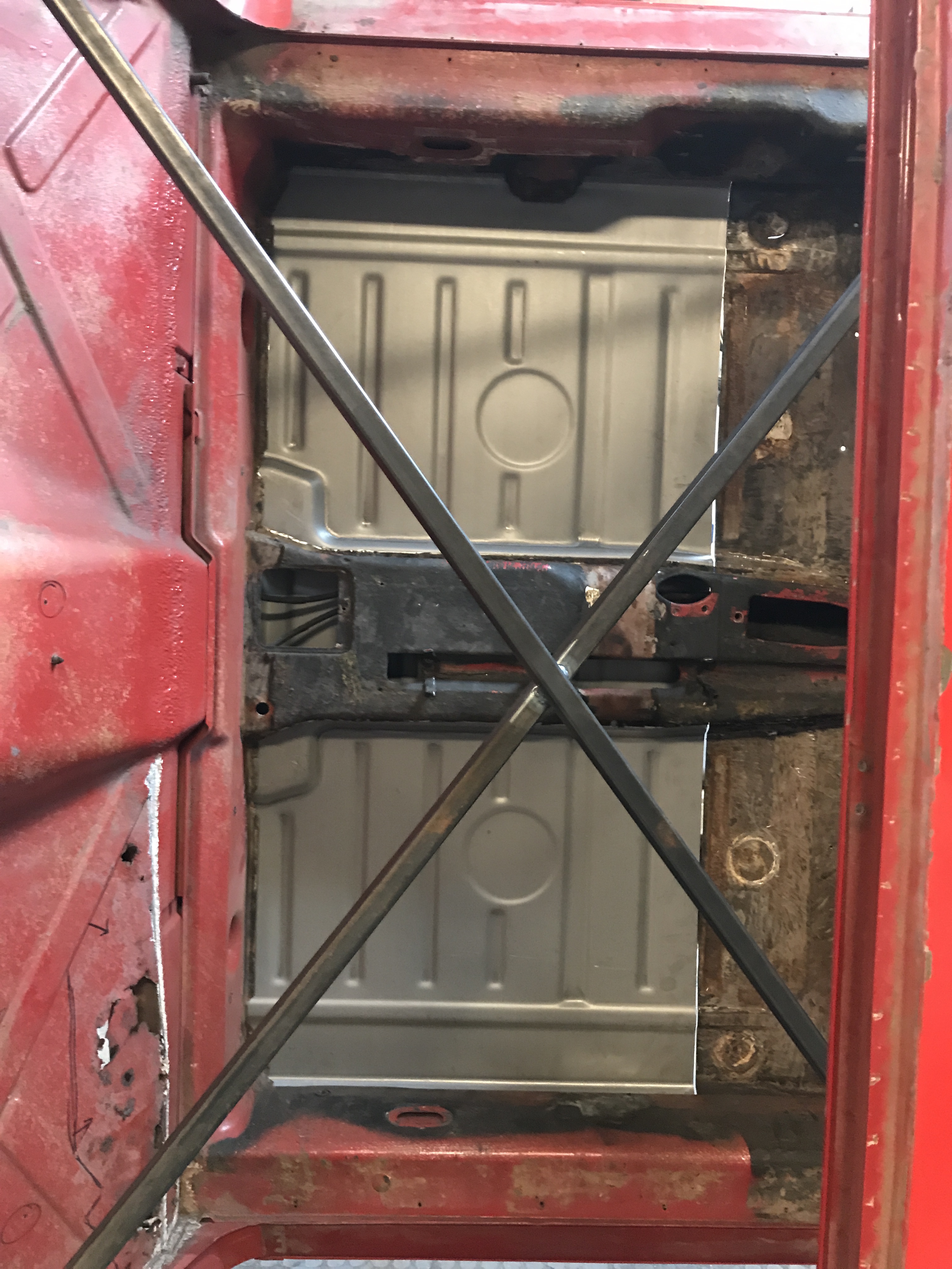

Then fitting the new floor section. First trim the excess around the edges, and then cut the remaining floor piece to fit. Decided to keep as much of the RD panel as possible since some of the rust extended forward of the cross brace.

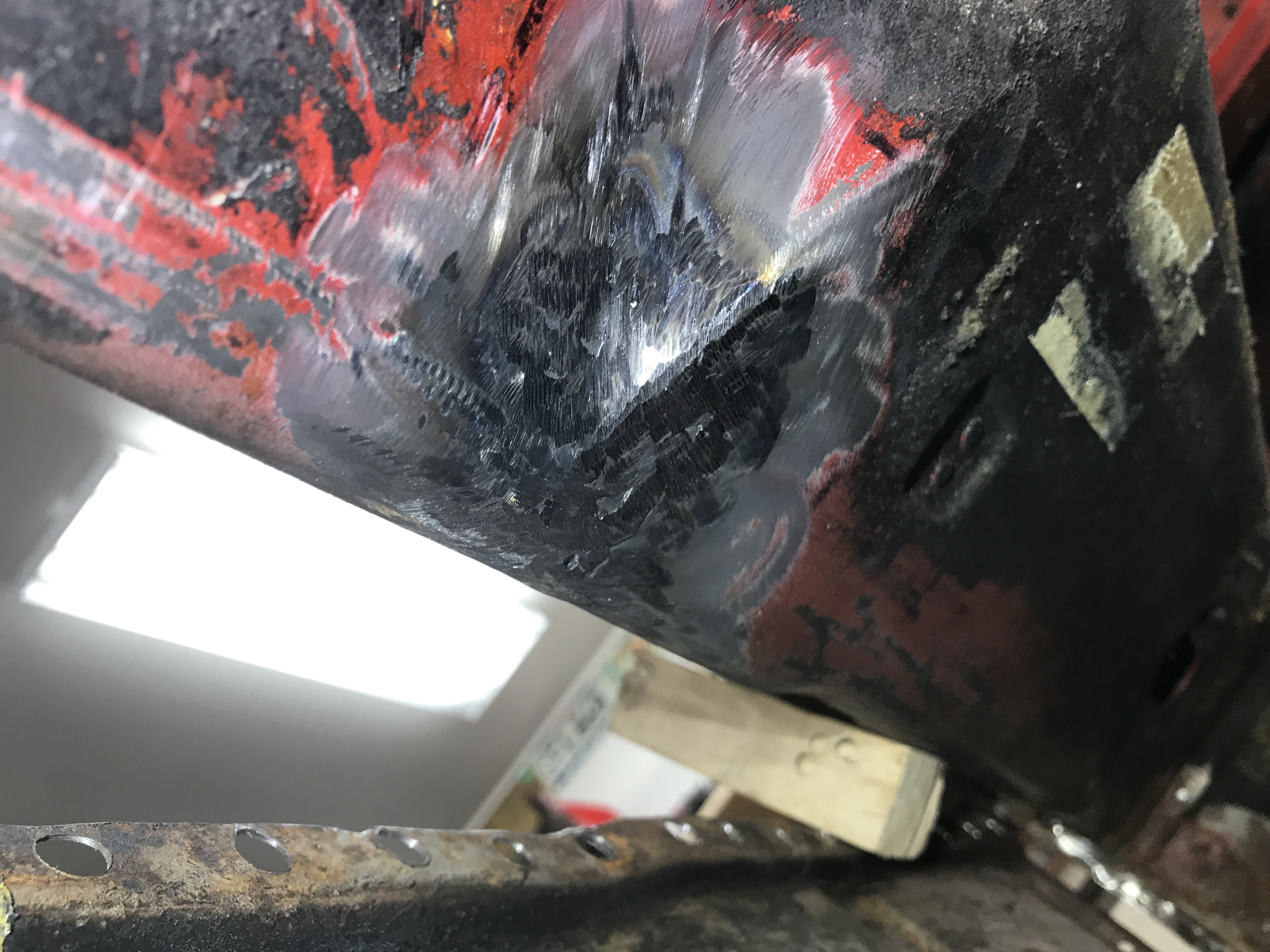

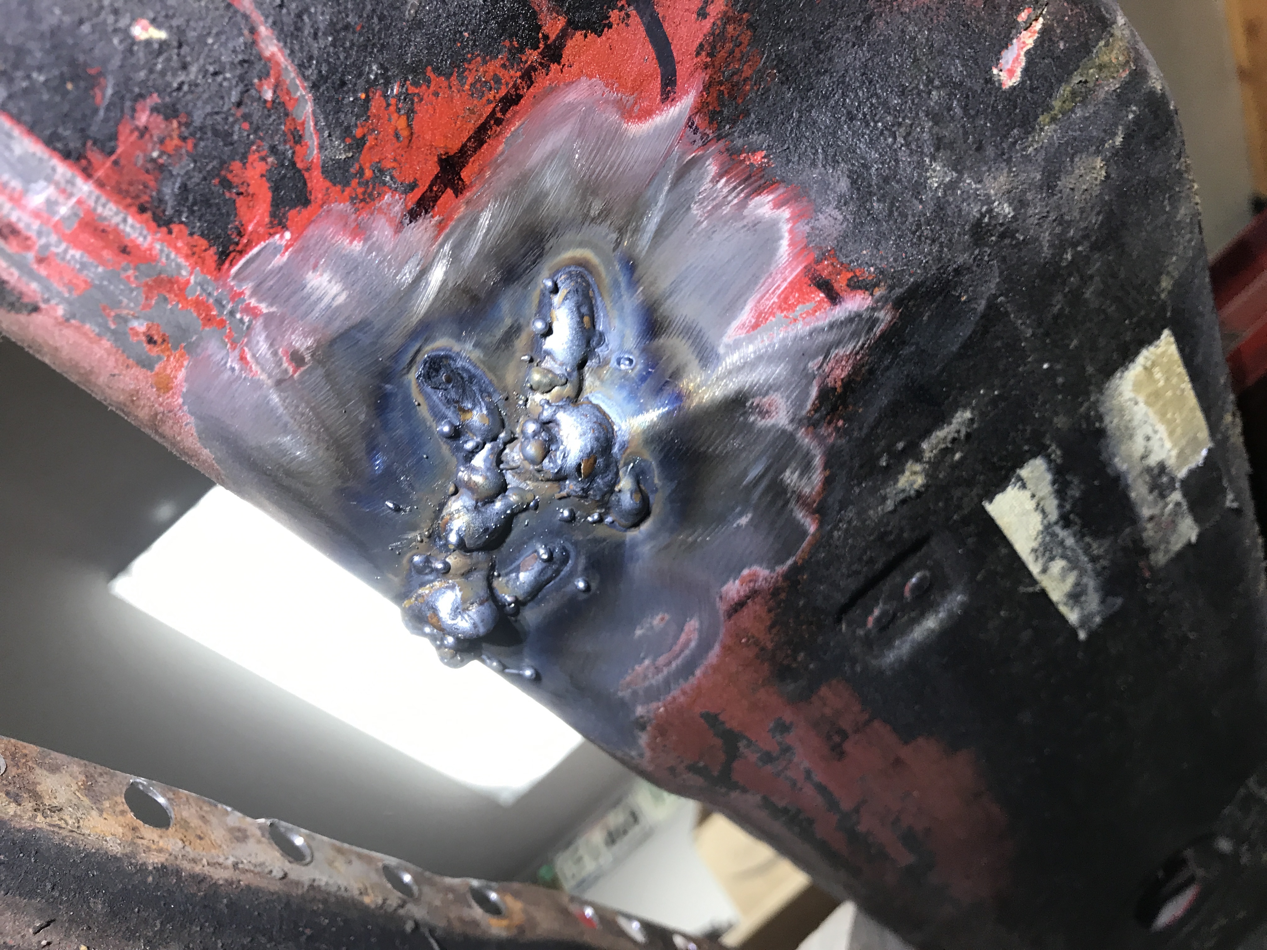

A few things to do before I can start welding in the floor. Item #1: welding the web of cracks in the left inner long, at the parking brake handle recess. A little sloppy (my excuse: upside down, which I could have corrected by rotating the rotisserie, but...).

And then grinding (and then some more welding and grinding).

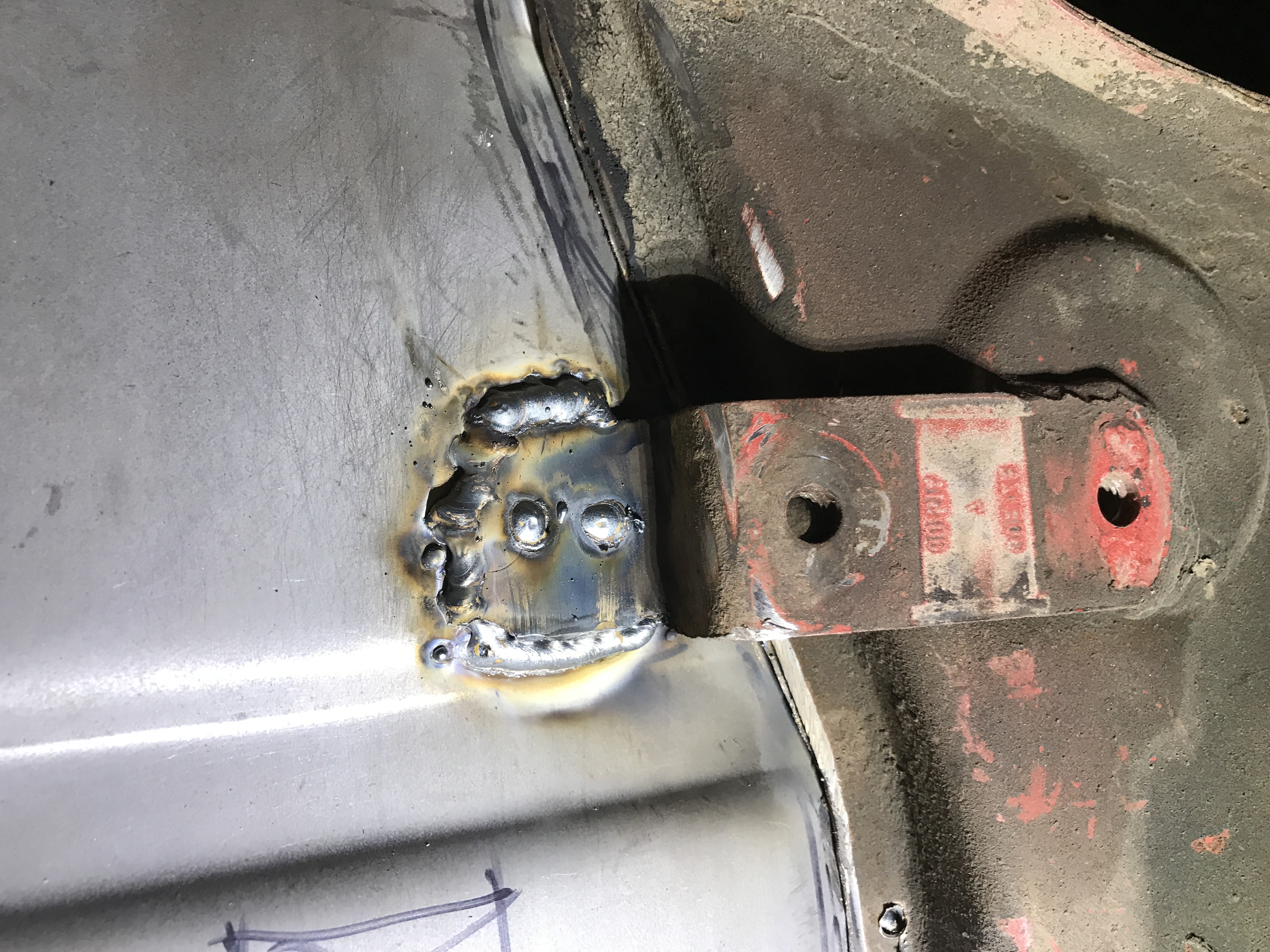

And before I forget, I welded the rear sway bar mounts to the new trunk floor.

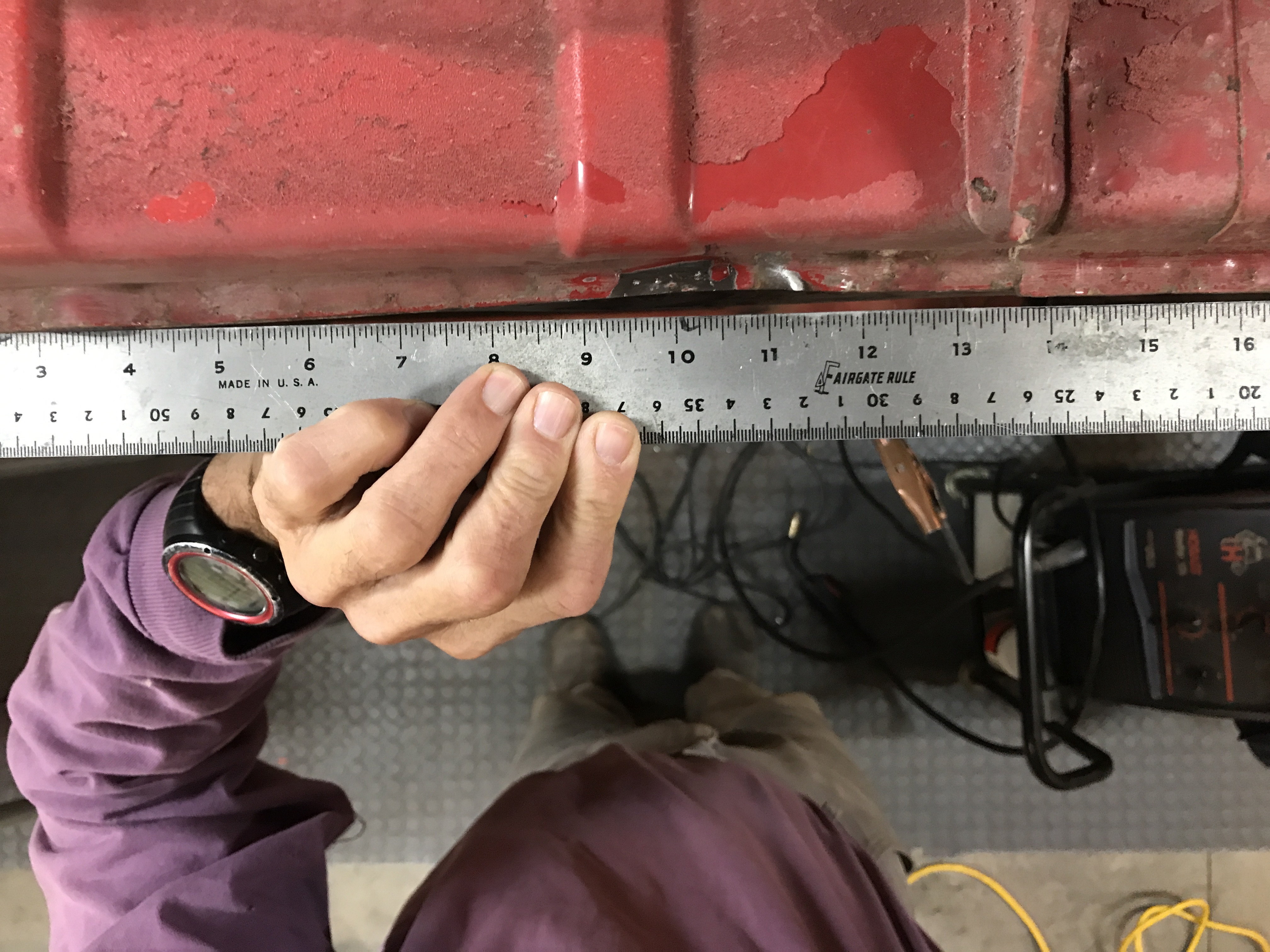

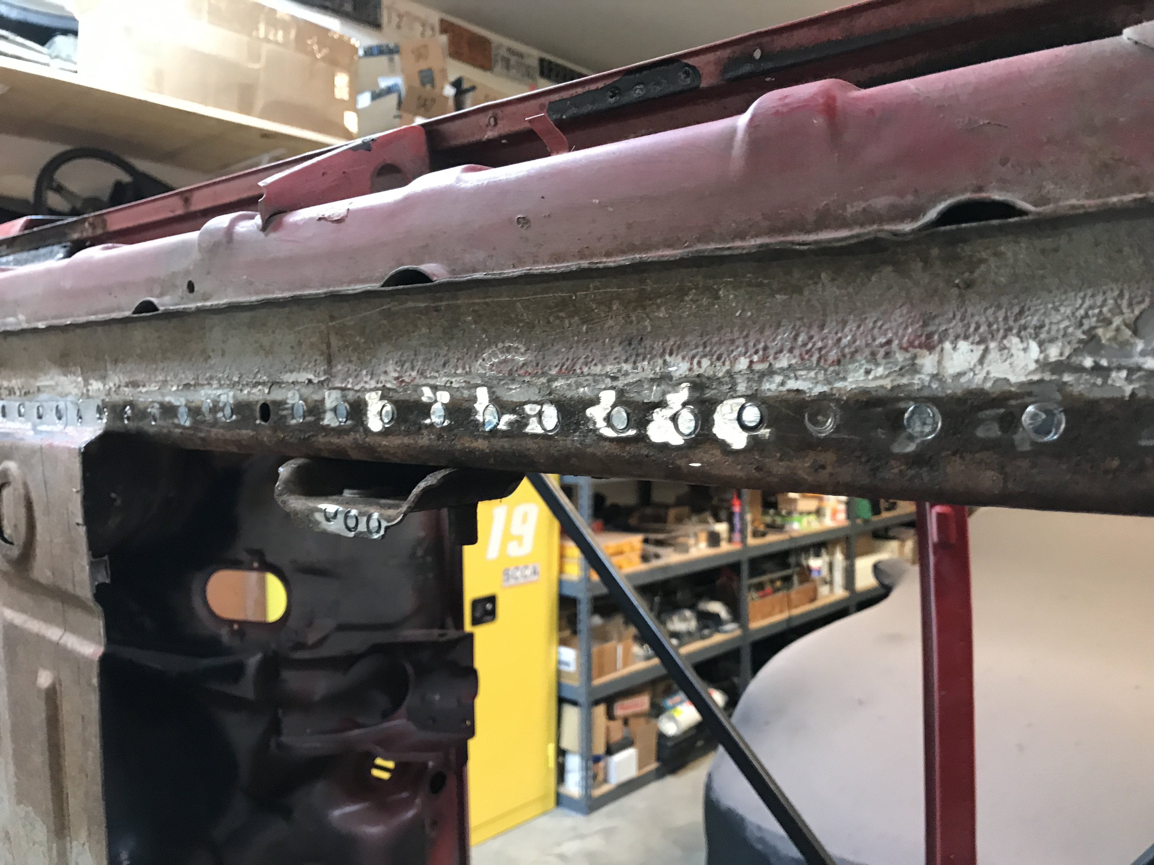

Item #2: Straightening the bottoms of both sills, with dents probably from jacking incidents. Here is the right sill.

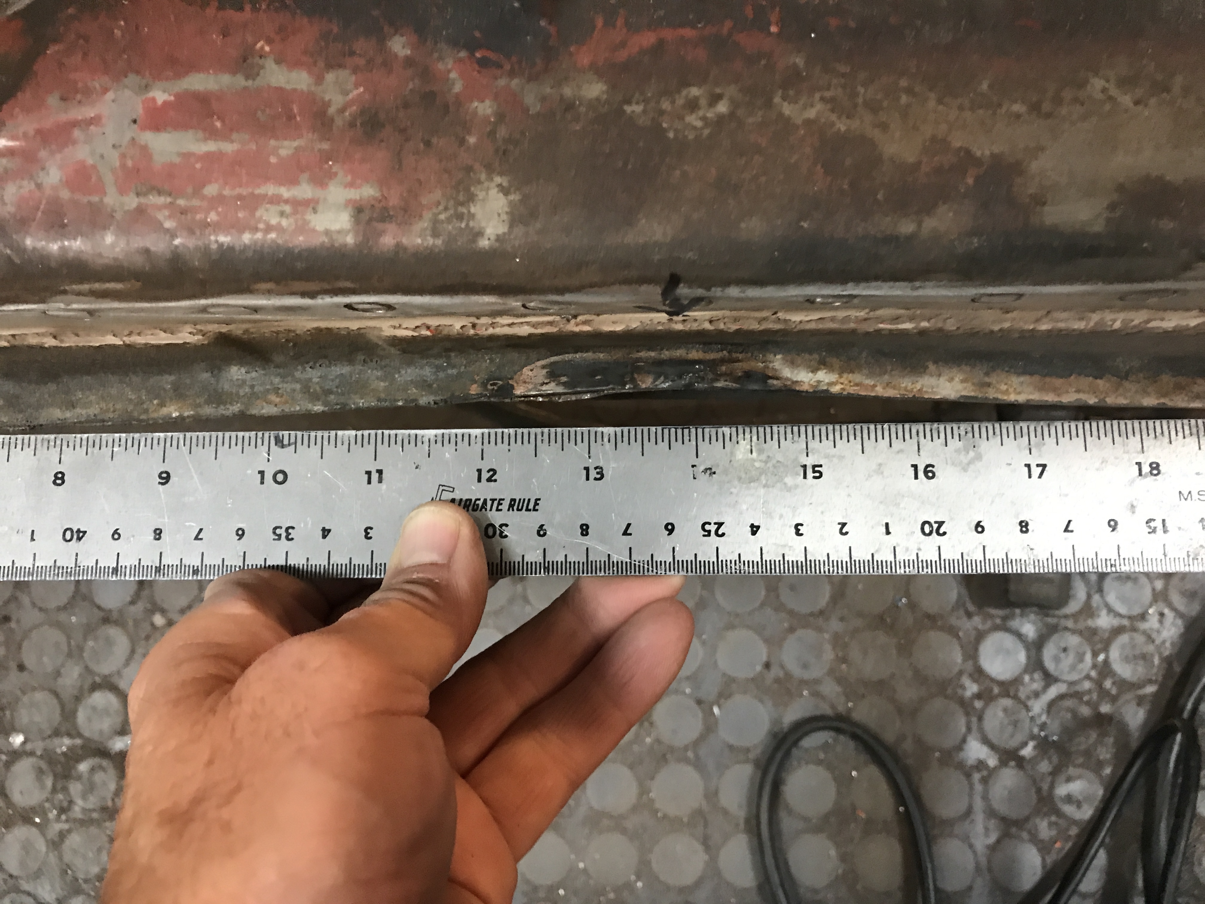

And the left sill.

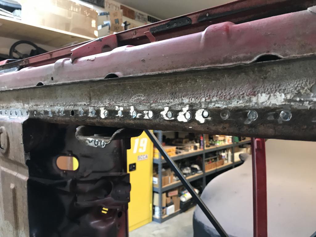

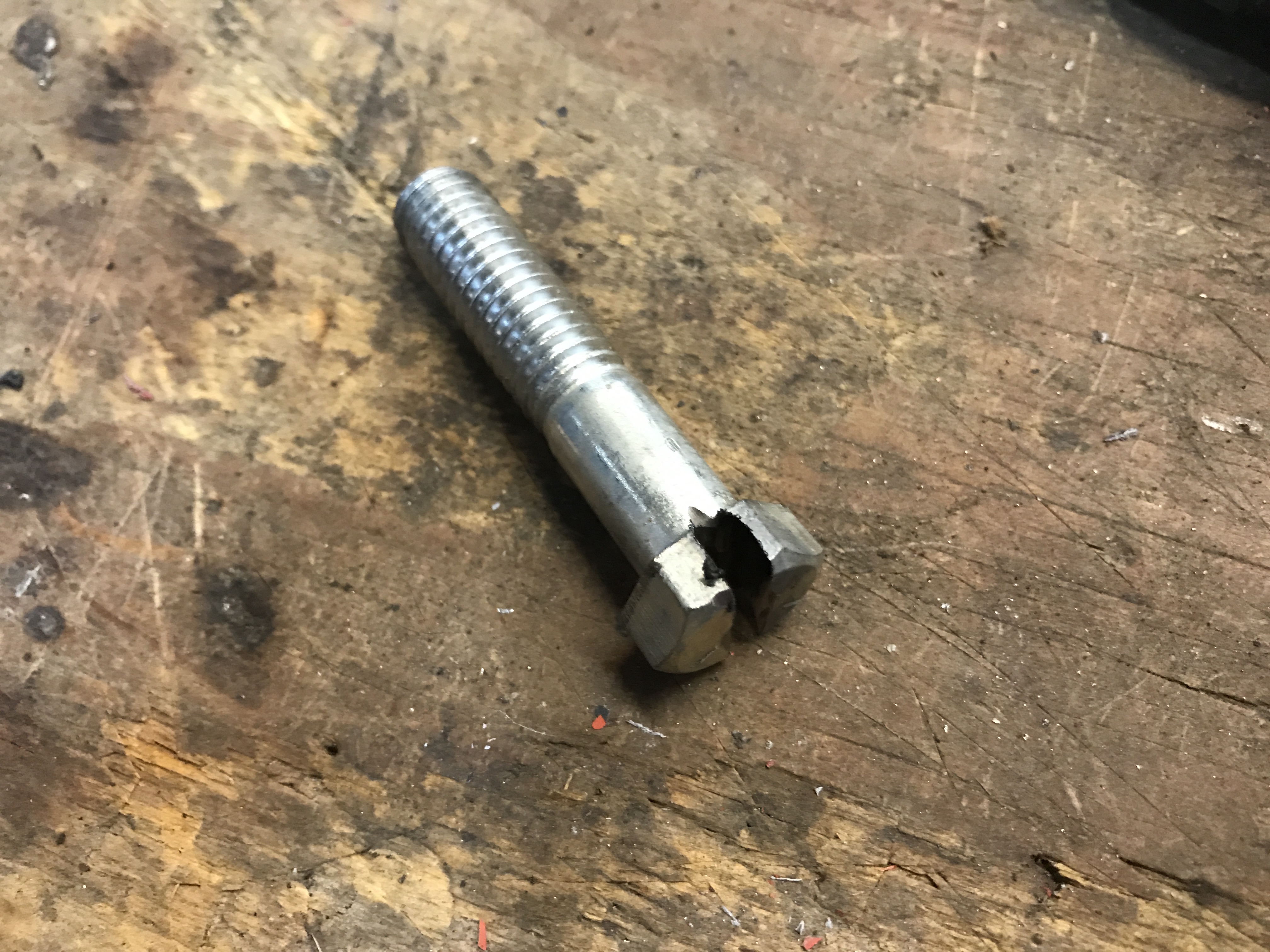

I made some studs that can be welded onto the sill seam, and screw into an adapter for my slide hammer.
