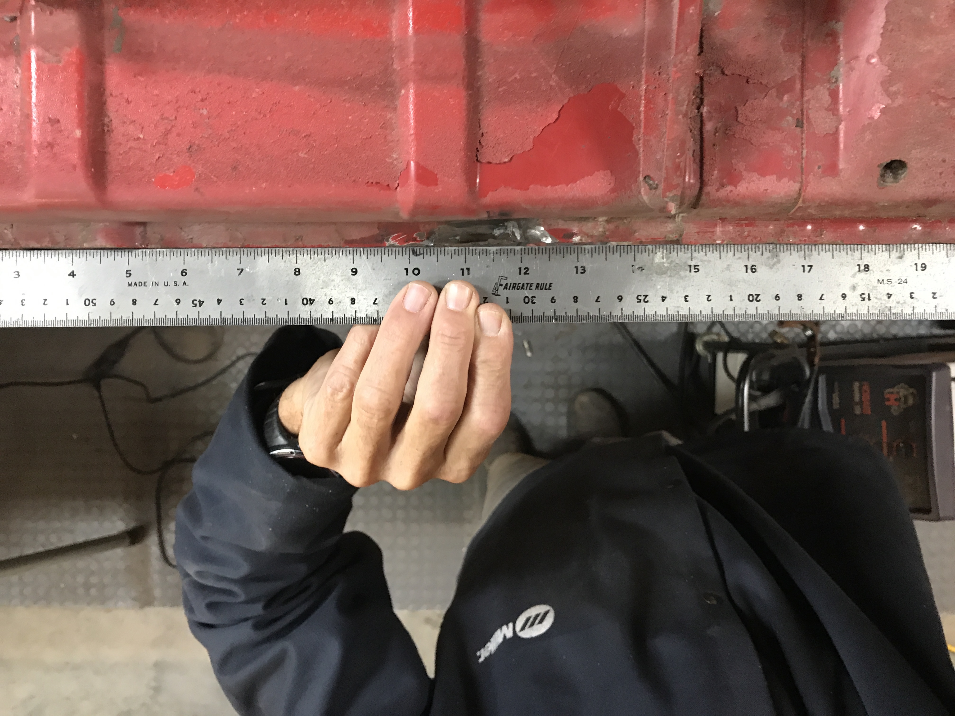

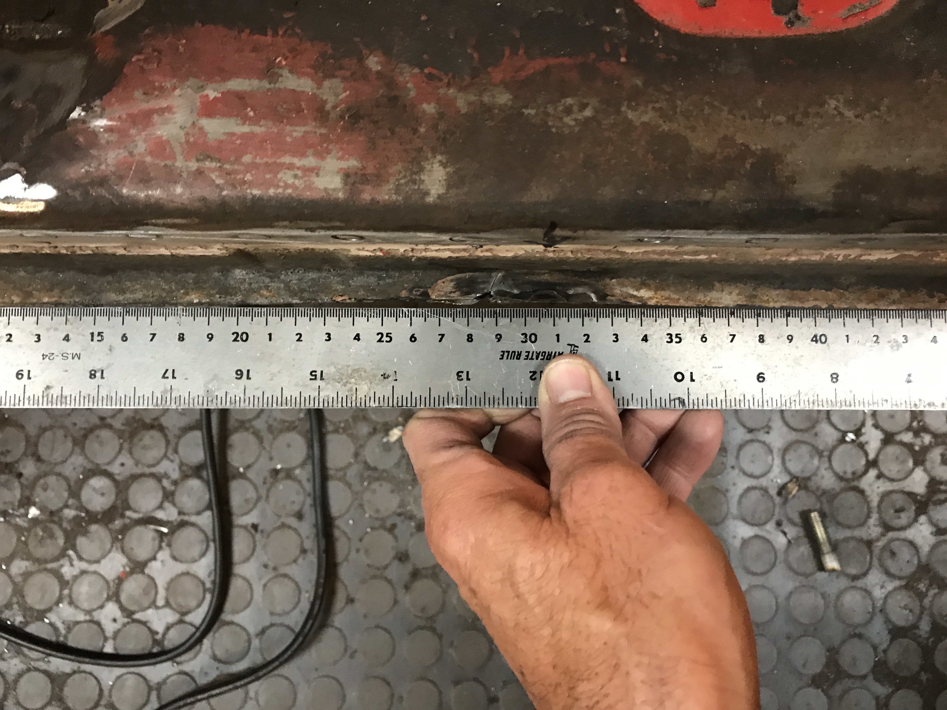

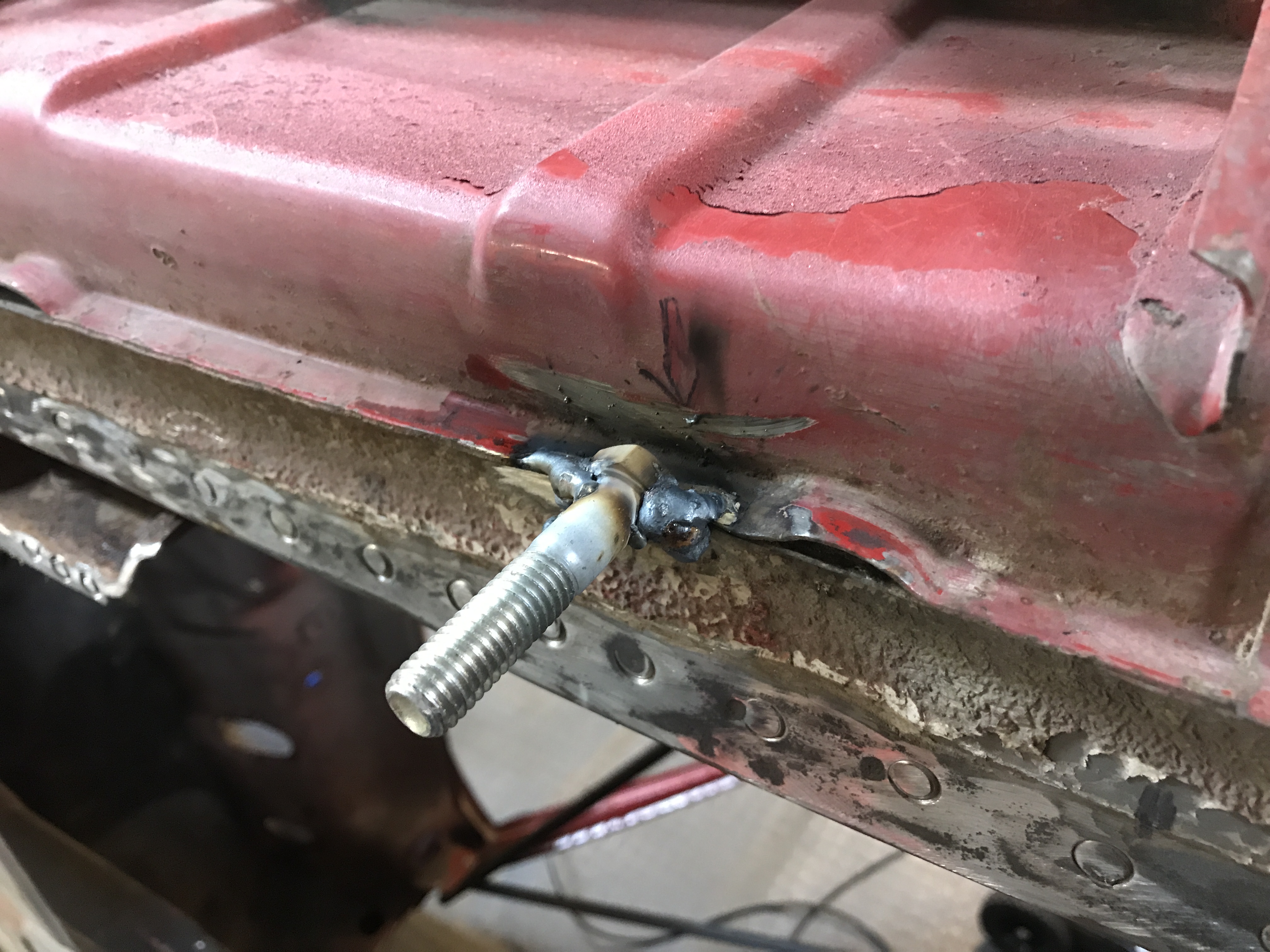

One on each sill, welded onto the seam at the center of each dent.
bkrantz
post Jan 26 2020, 09:33 PM
Post #182
Posts: 8,341
Joined: 3-August 19
From: SW Colorado
Member No.: 23,343

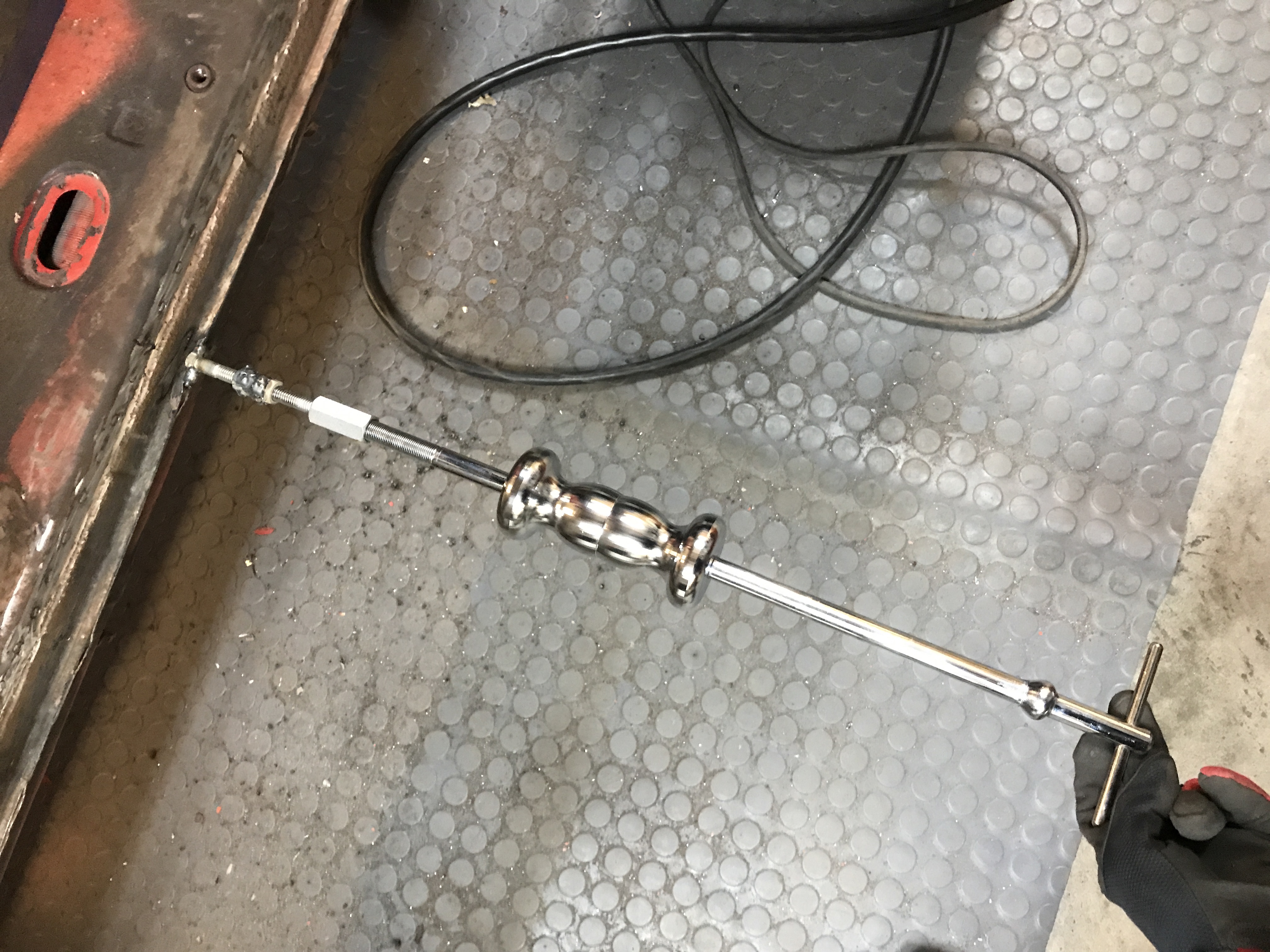

Slide hammer in action. Each side took a good number of hard hits to get close to straight.

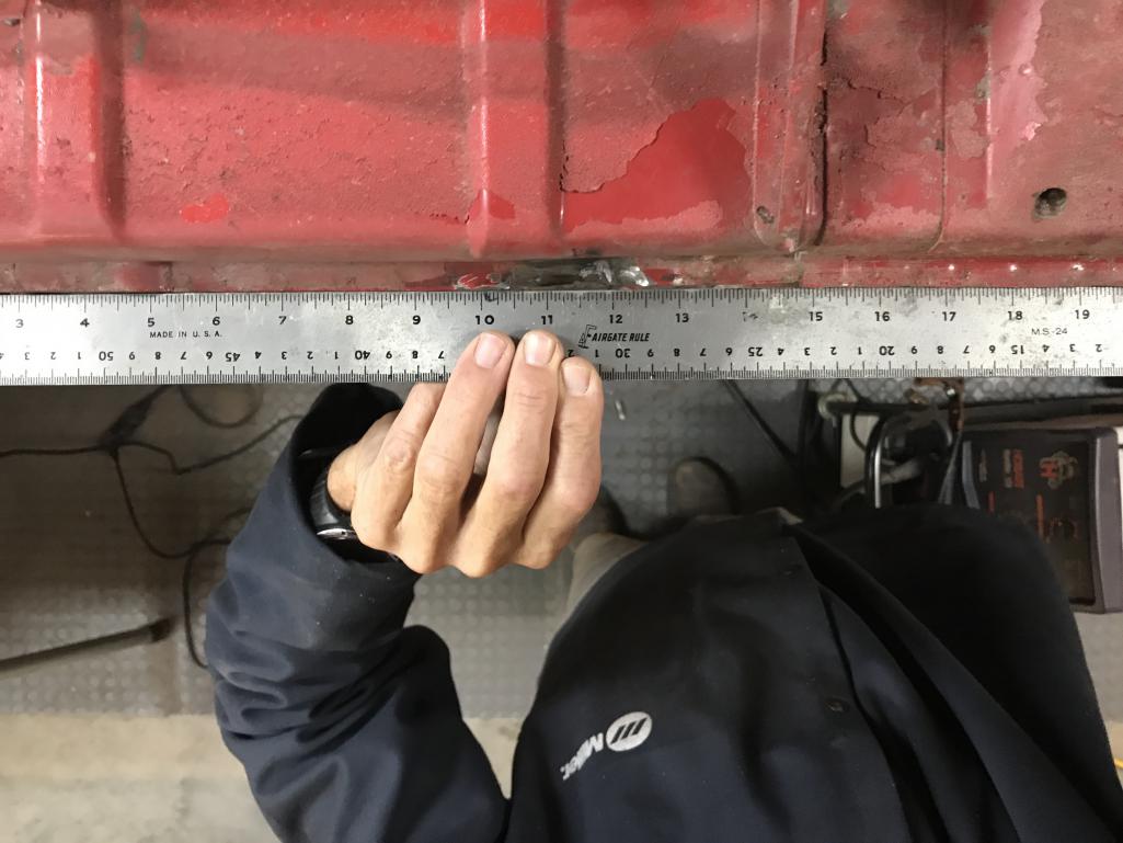

Left side, after cutting off the stud and grinding away the weld.
bkrantz
post Jan 26 2020, 09:35 PM
Post #184
Posts: 8,341
Joined: 3-August 19
From: SW Colorado
Member No.: 23,343
And the right side.

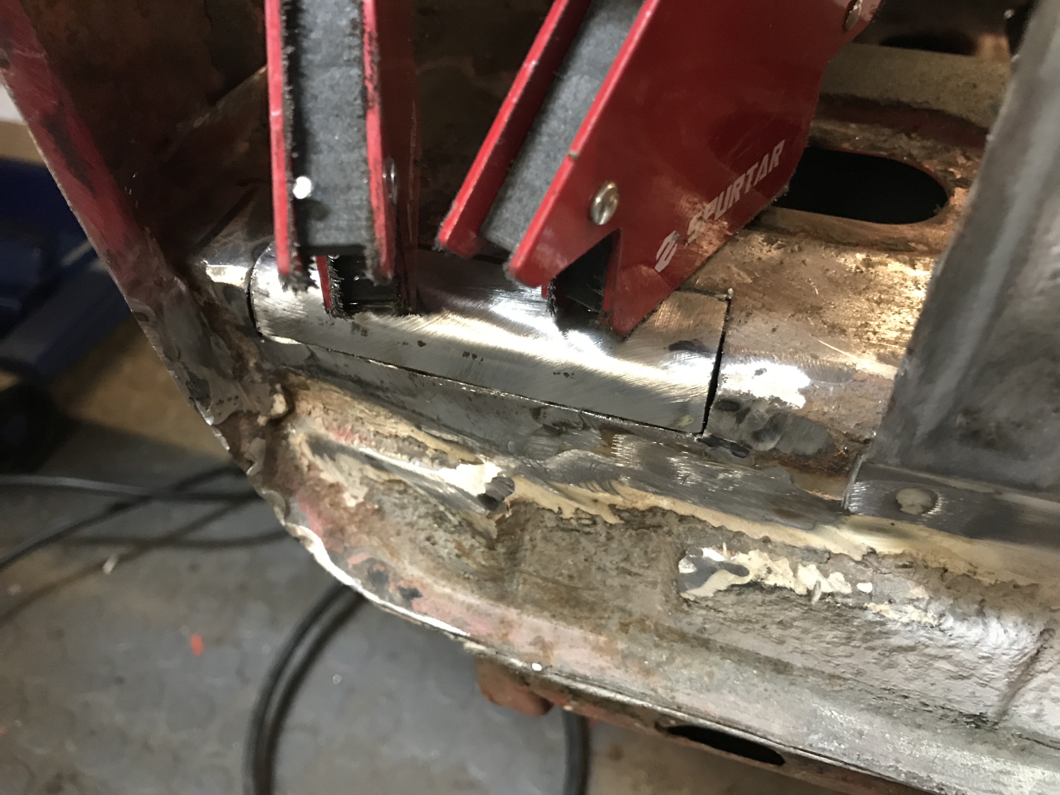

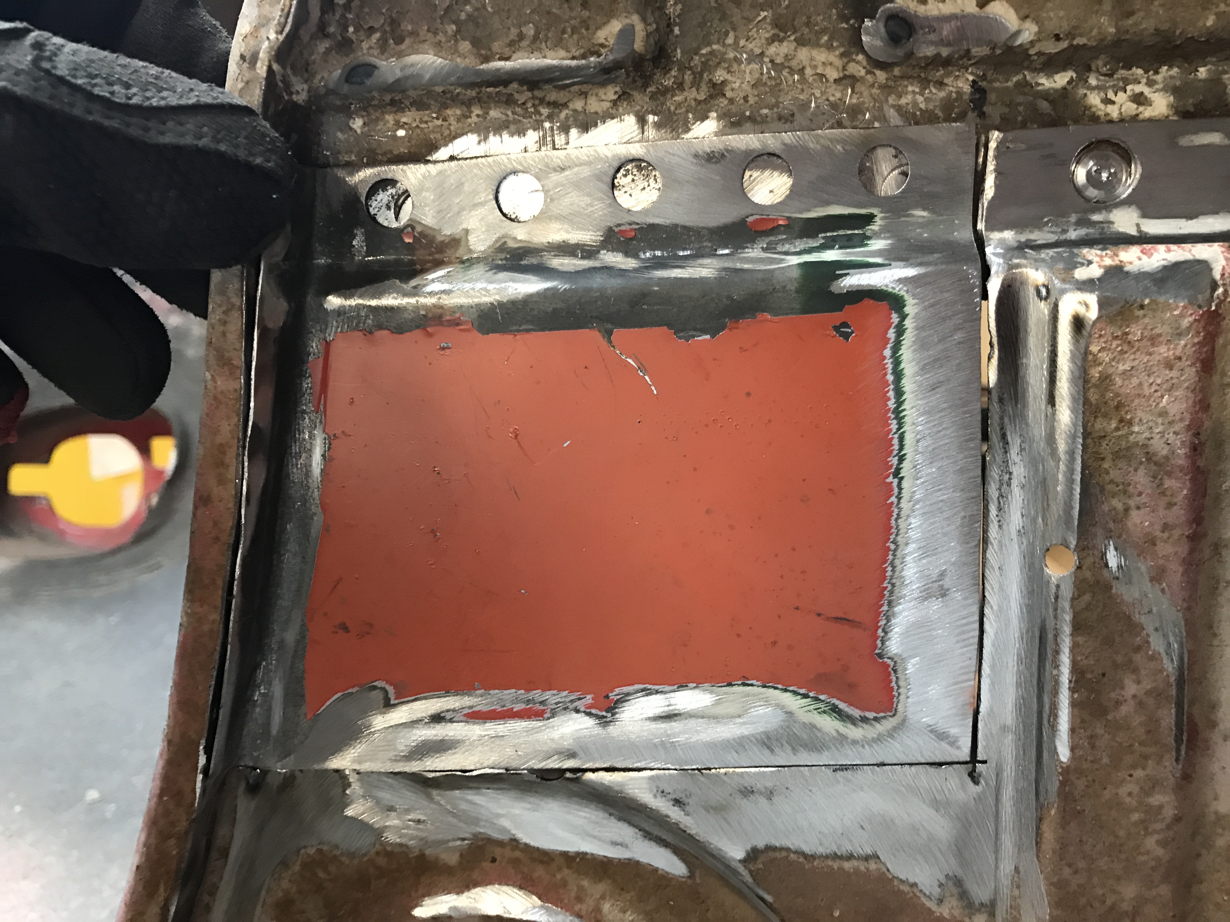

Item #3: patching the hole in the front inner right sill, where rust ate through (fortunately from outside in). Here's the hole after cutting.

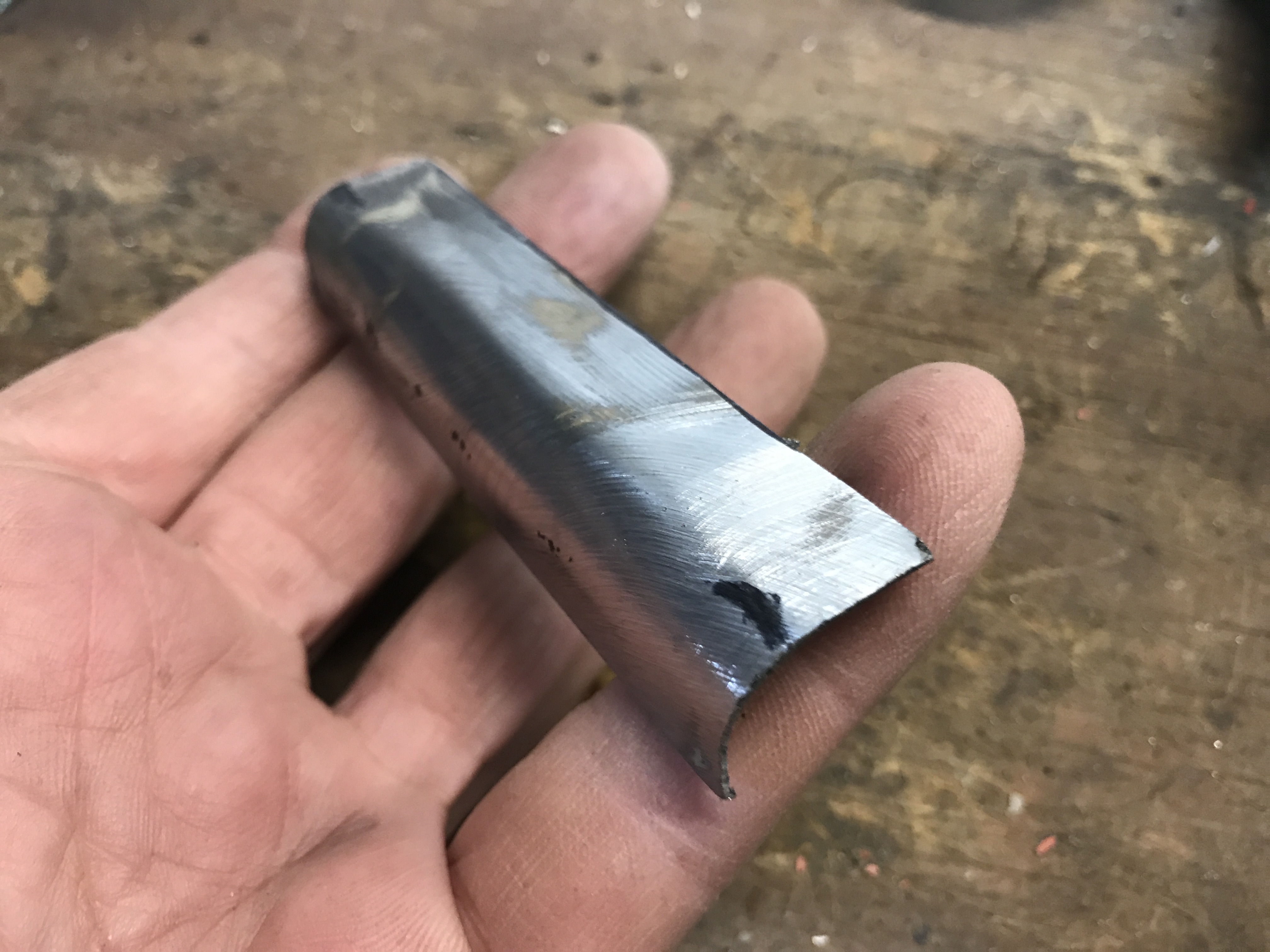

I made a patch from a section of 914 front fender.
bkrantz
post Jan 26 2020, 09:40 PM
Post #187
Posts: 8,341
Joined: 3-August 19
From: SW Colorado
Member No.: 23,343
Patch in place. Magnets are helpful.
bkrantz
post Jan 26 2020, 09:41 PM
Post #188
Posts: 8,341
Joined: 3-August 19
From: SW Colorado
Member No.: 23,343

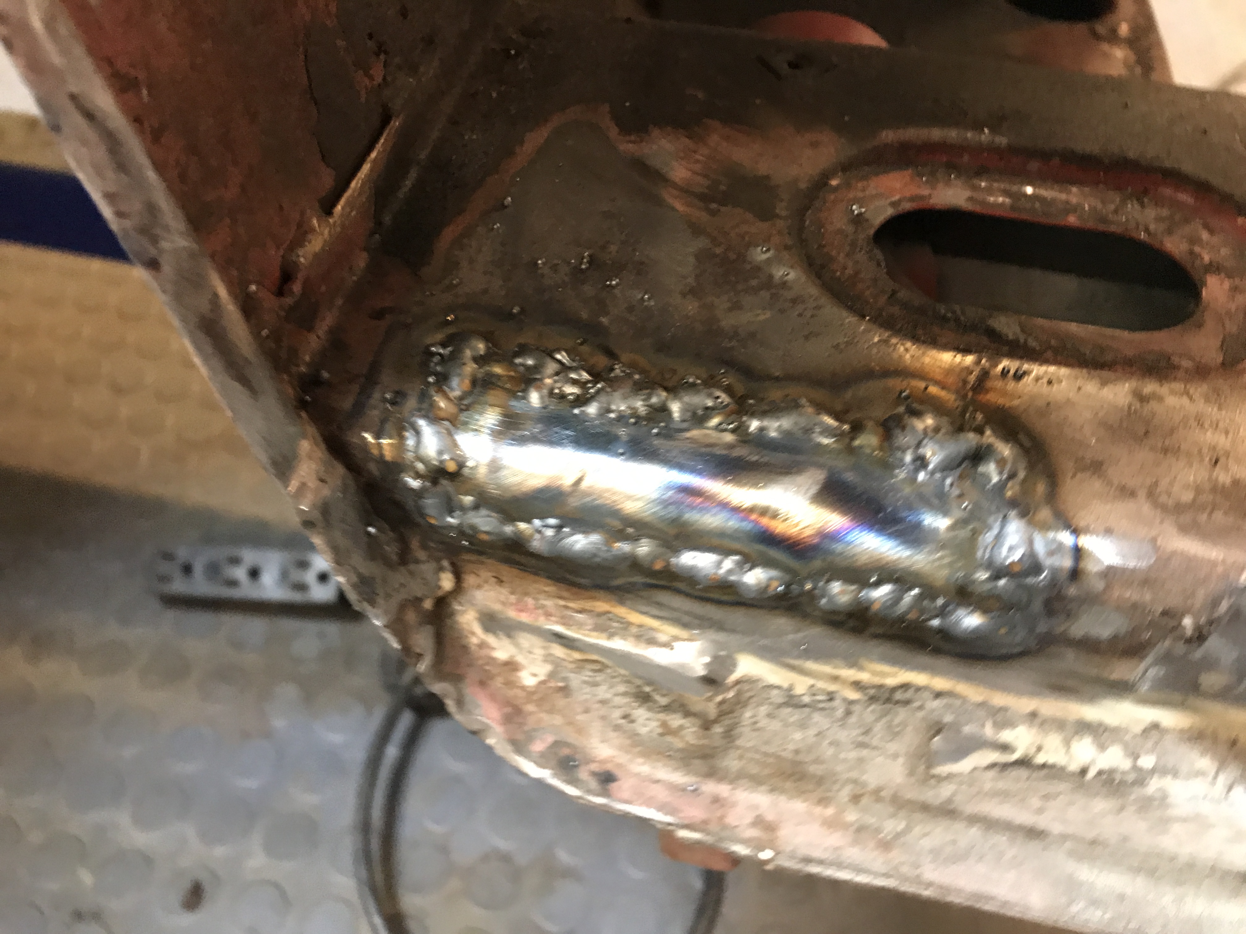

Welded in place.

And after grinding. I was less aggressive, and left some of the weld since the sheet metal here is relatively thin.

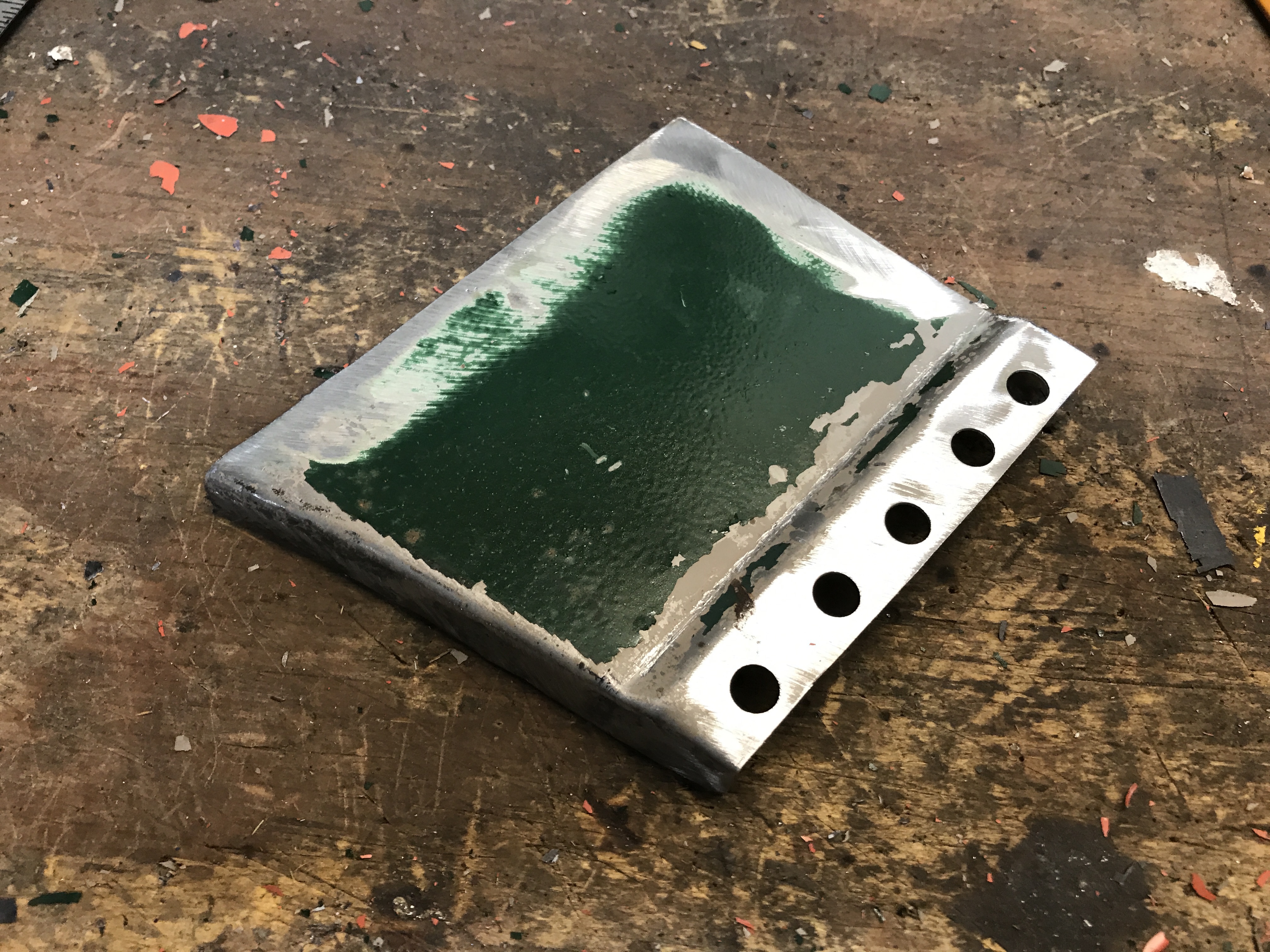

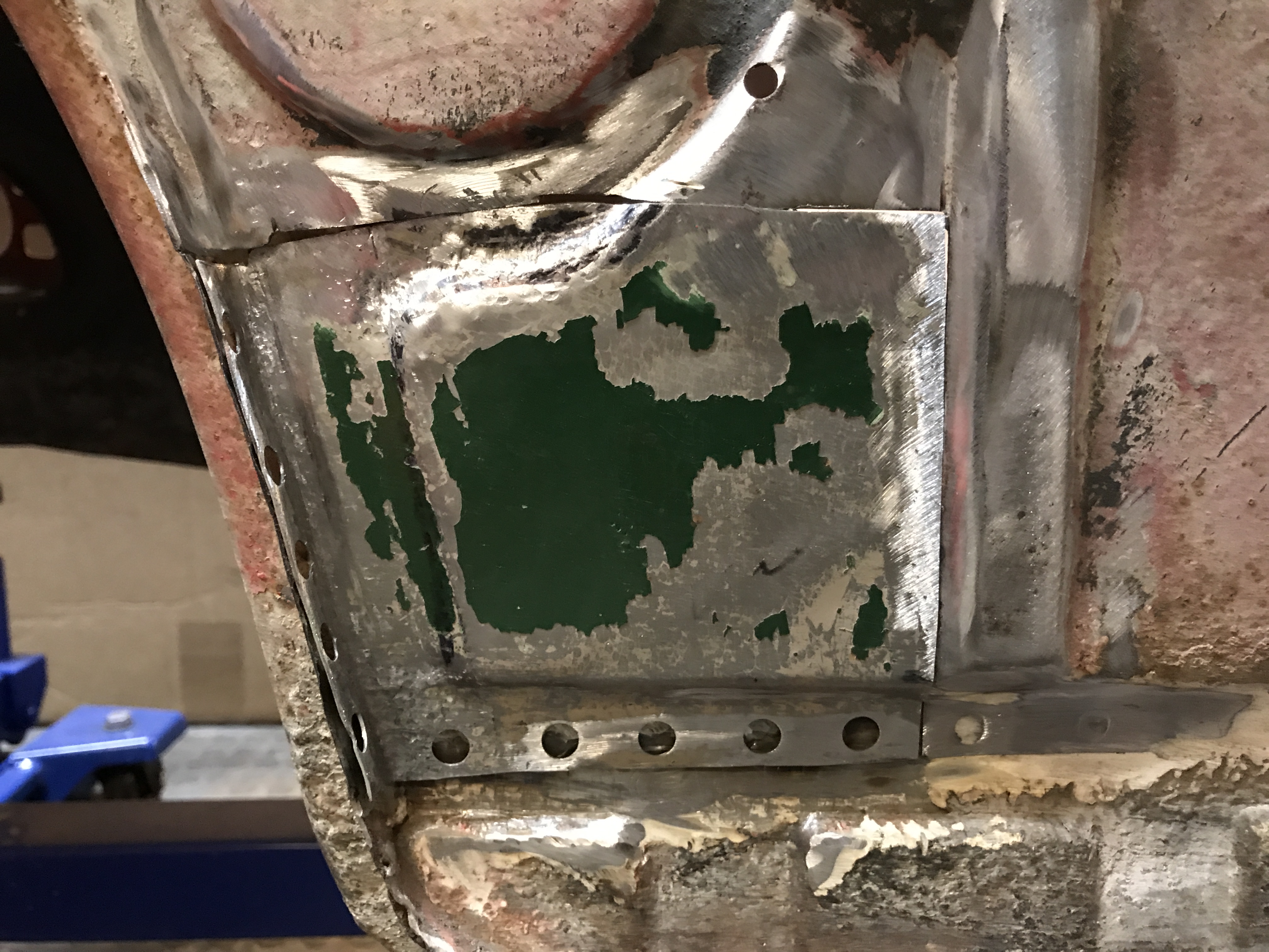

Item #4: the. front floor corners. Here's the patch for the left side, again made from genuine 914 sheet metal.

Test fit.

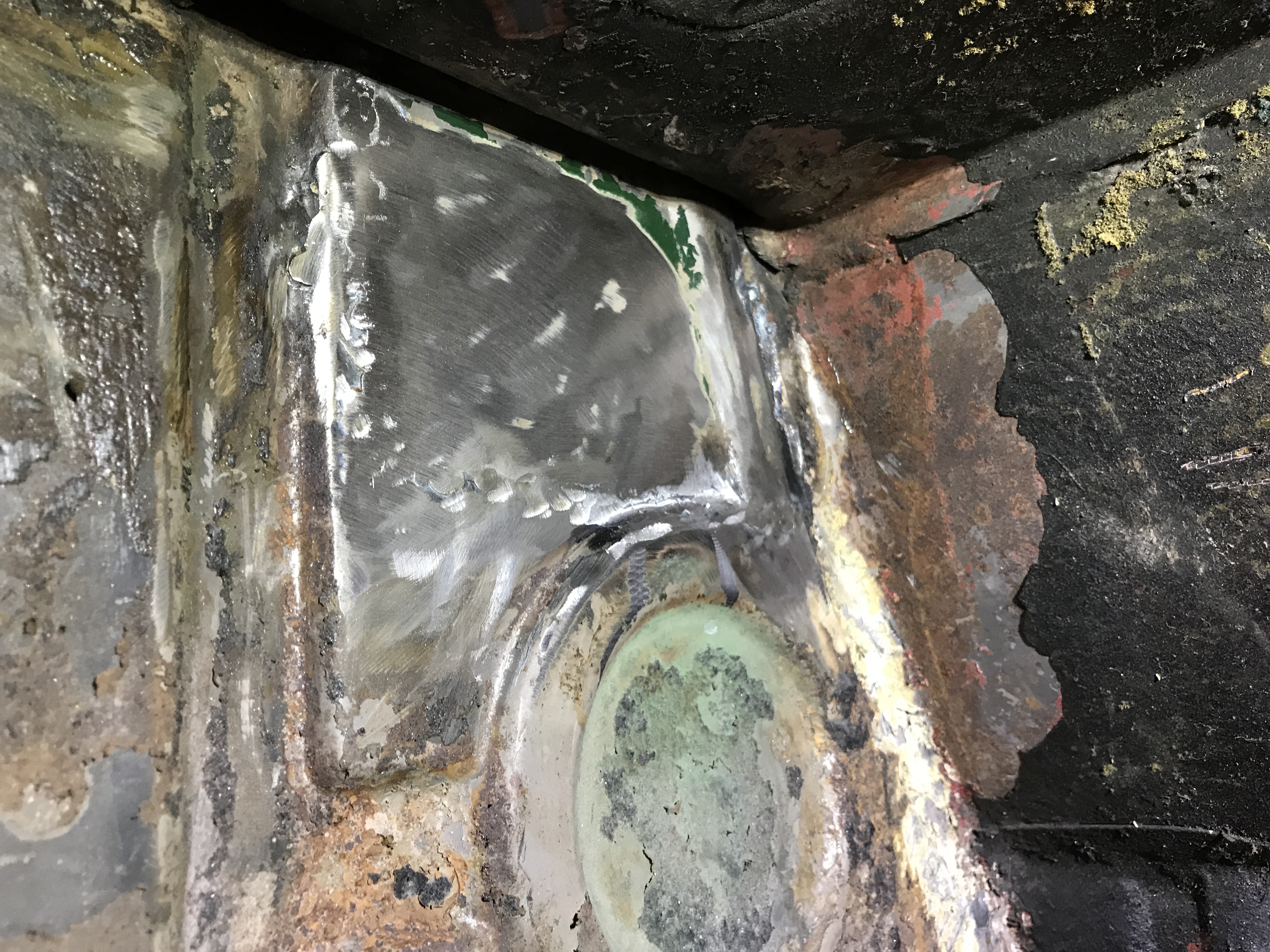

Jumping ahead to #5: treating and painting the rust inside the lower firewall.

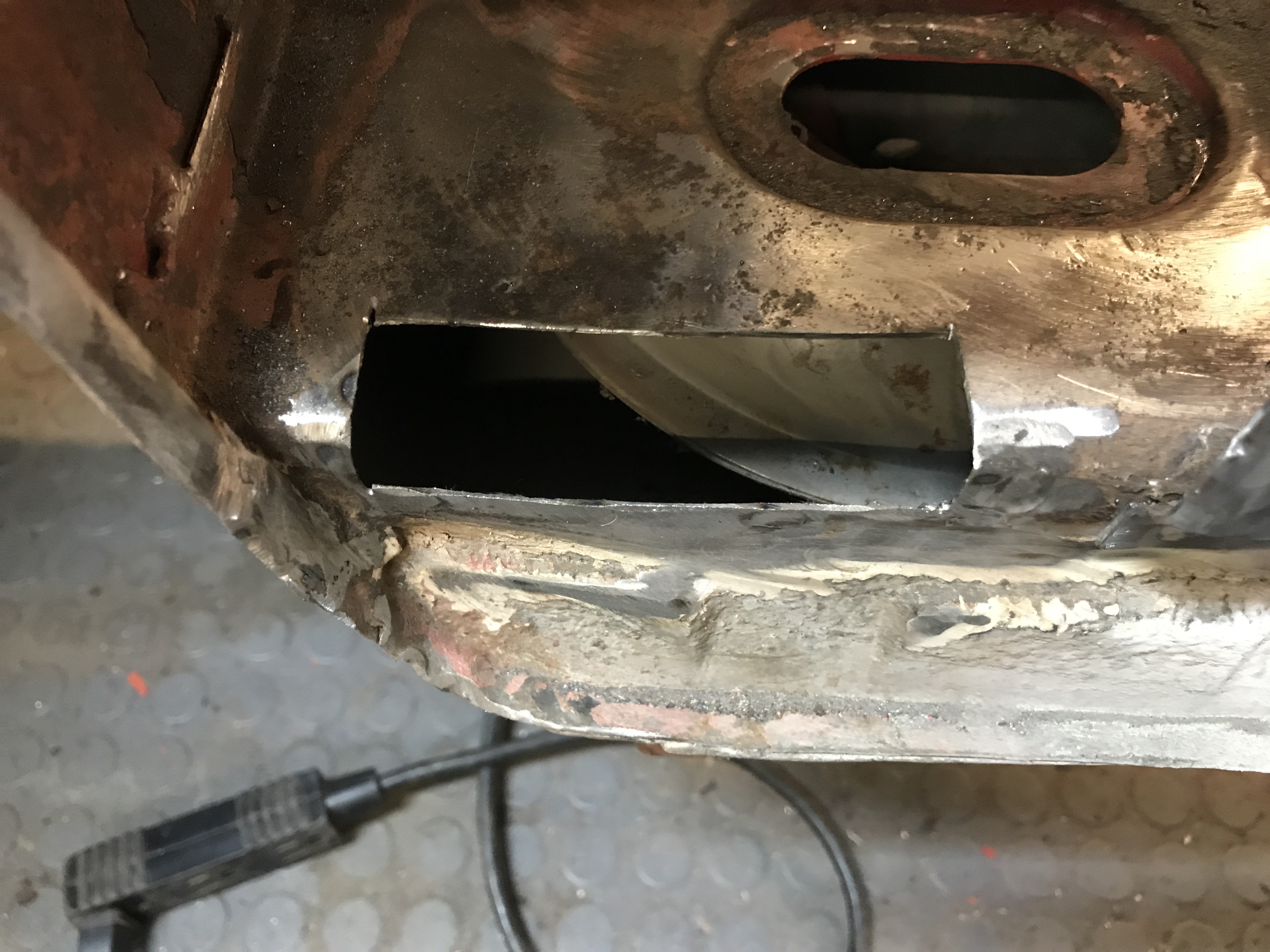

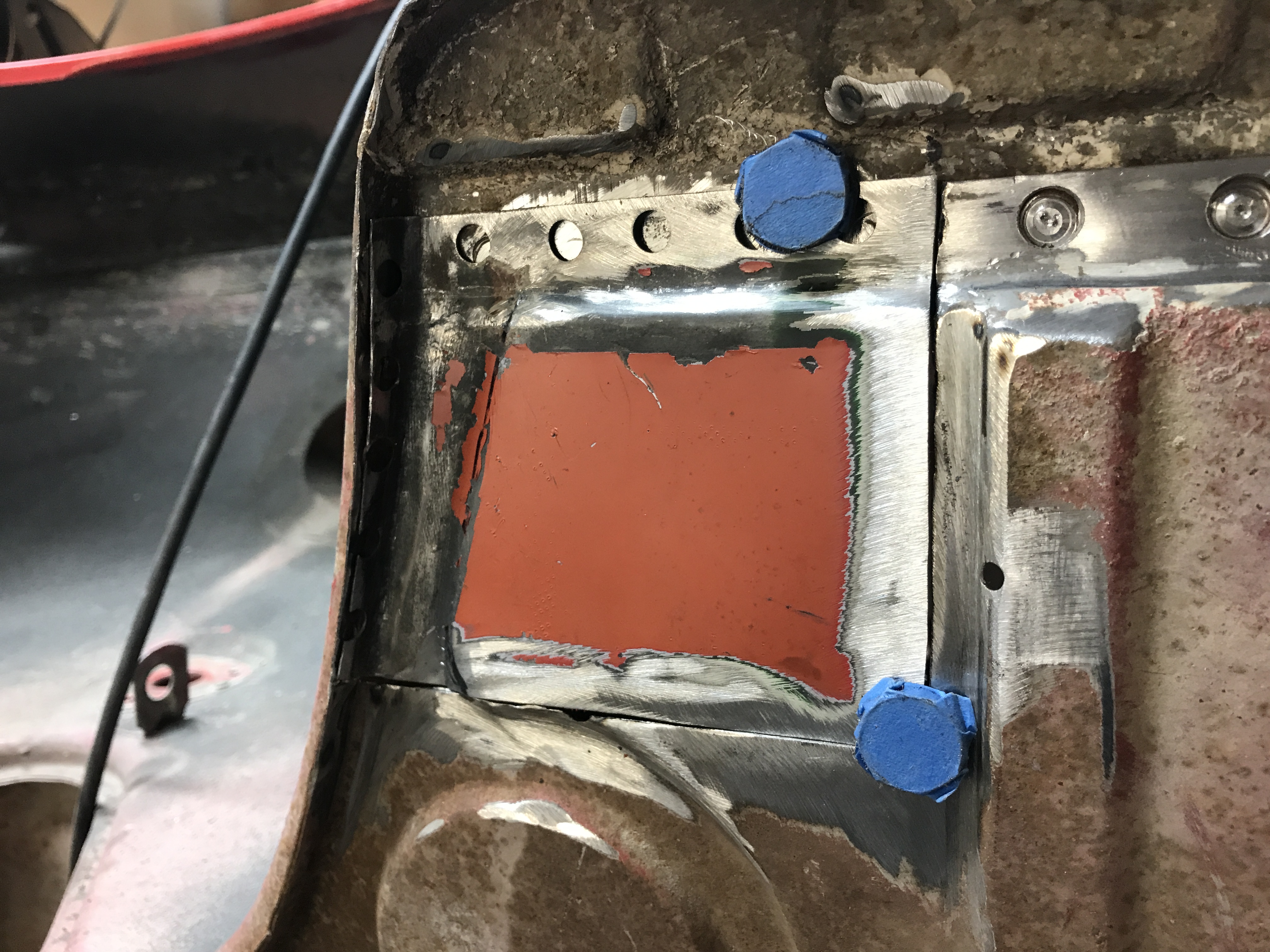

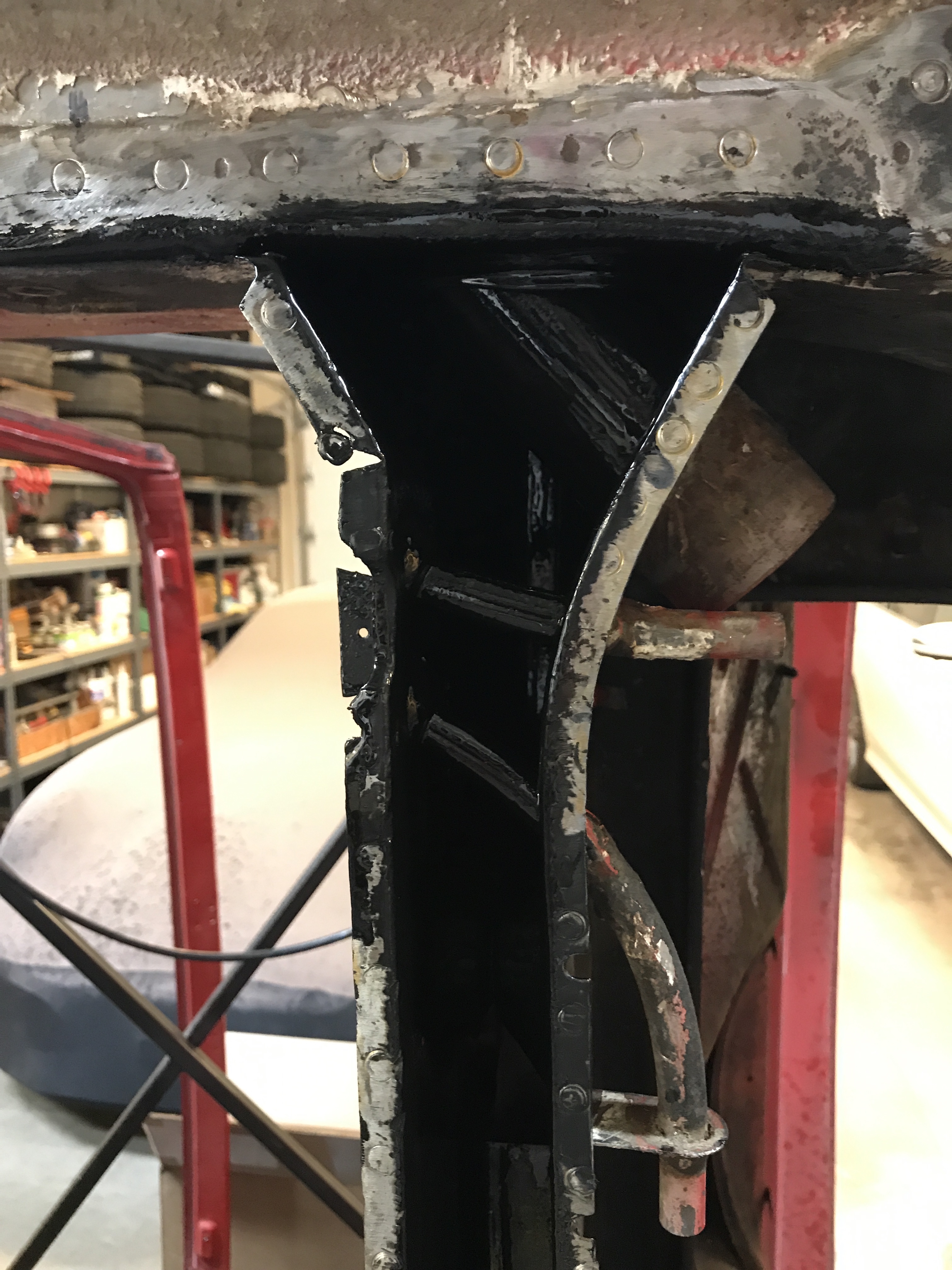

Back to Item#4: the floor front corners. I decided to reshape my patches to better duplicate the original floor channels.
Here's the left side, ready to weld.
bkrantz
post Jan 30 2020, 09:32 PM
Post #196
Posts: 8,341
Joined: 3-August 19
From: SW Colorado
Member No.: 23,343
And the right side, still needs a few tweaks.
bkrantz
post Jan 31 2020, 09:27 PM
Post #197
Posts: 8,341
Joined: 3-August 19
From: SW Colorado
Member No.: 23,343

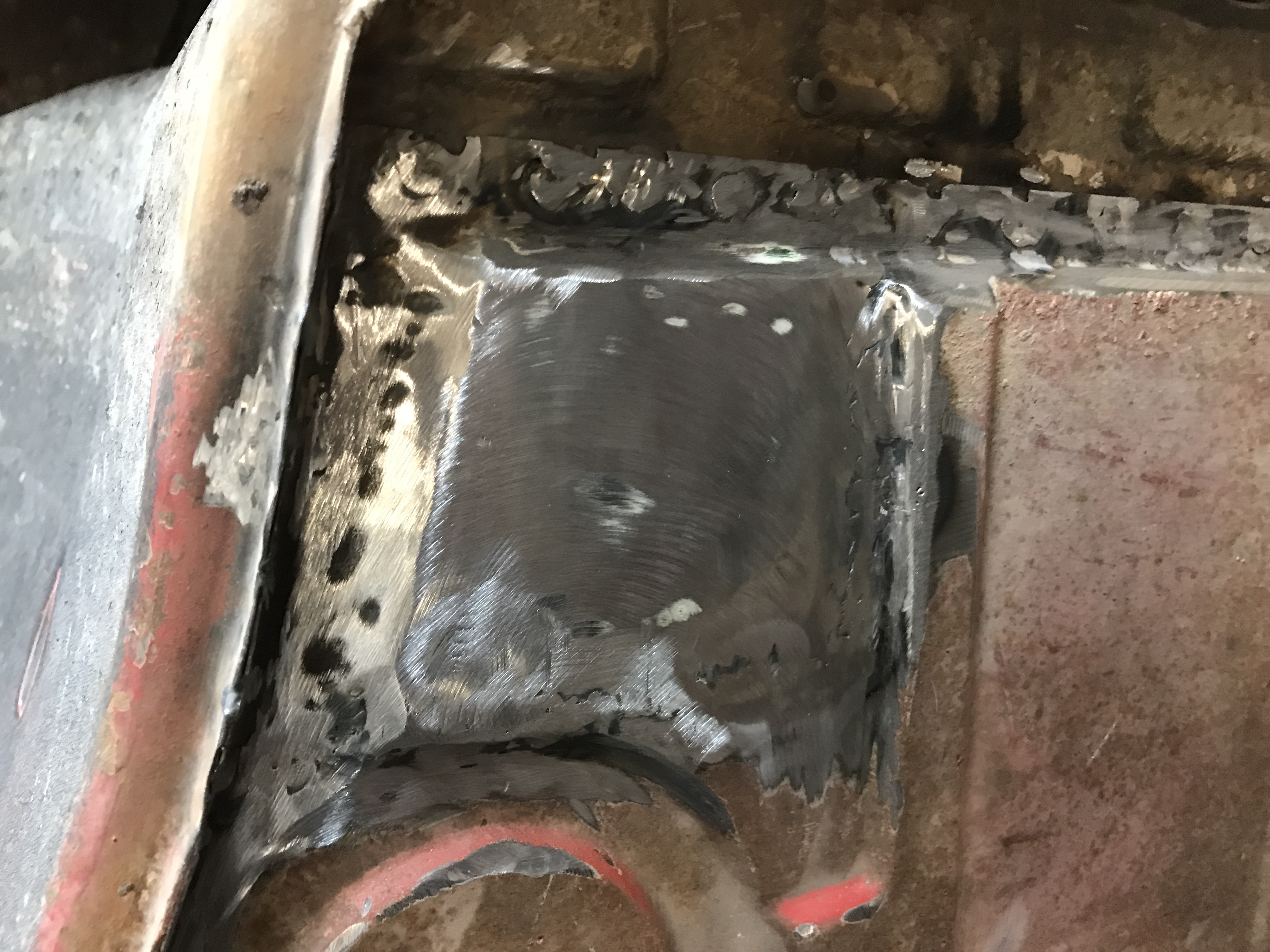

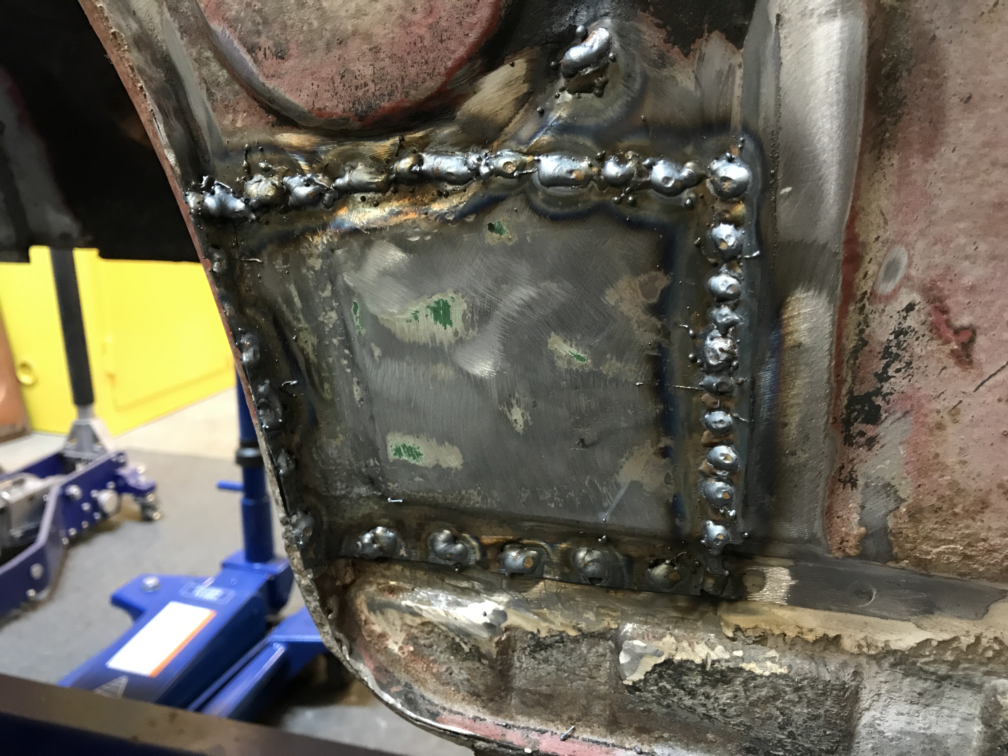

Left side welded in, and a quick grinding. A few spots to re-weld and then grind it pretty.
bkrantz

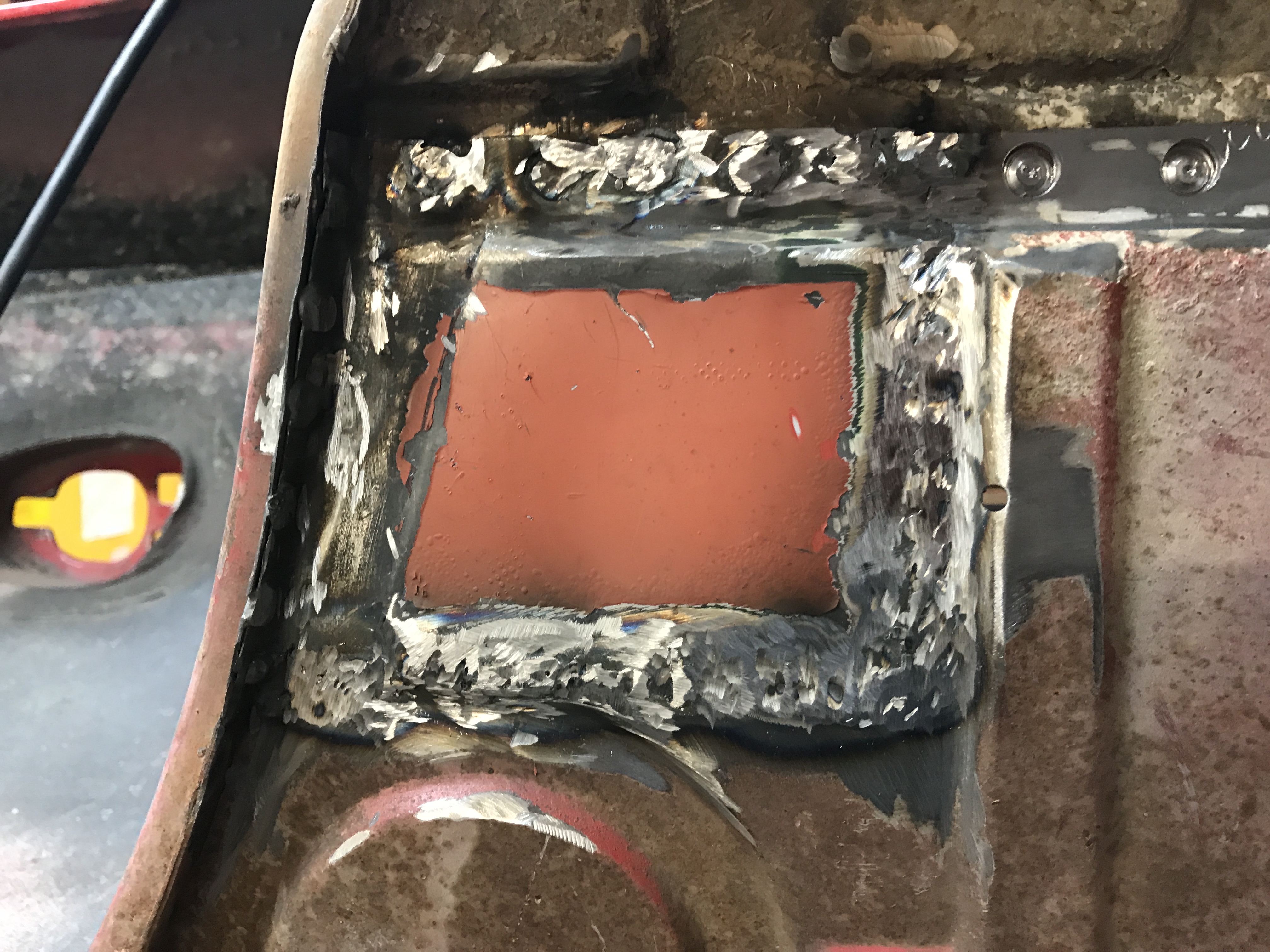

post Feb 1 2020, 10:42 PM
Post #198
Posts: 8,341
Joined: 3-August 19
From: SW Colorado
Member No.: 23,343

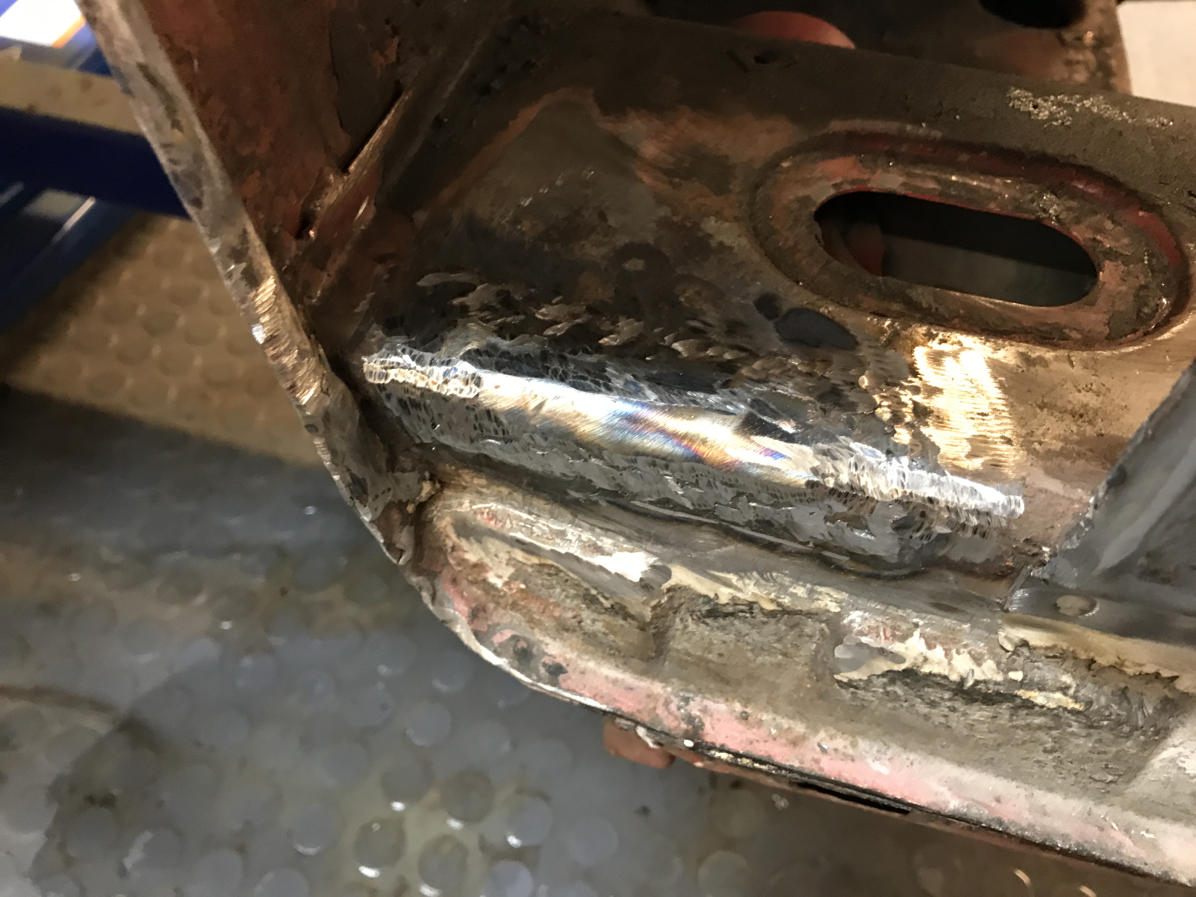

Finishing up #4. Here's the left side done.
bkrantz
post Feb 1 2020, 10:43 PM
Post #199
Posts: 8,341
Joined: 3-August 19
From: SW Colorado
Member No.: 23,343
And from the inside.
bkrantz
post Feb 1 2020, 10:45 PM
Post #200
Posts: 8,341
Joined: 3-August 19
From: SW Colorado
Member No.: 23,343
Right side welded in.
