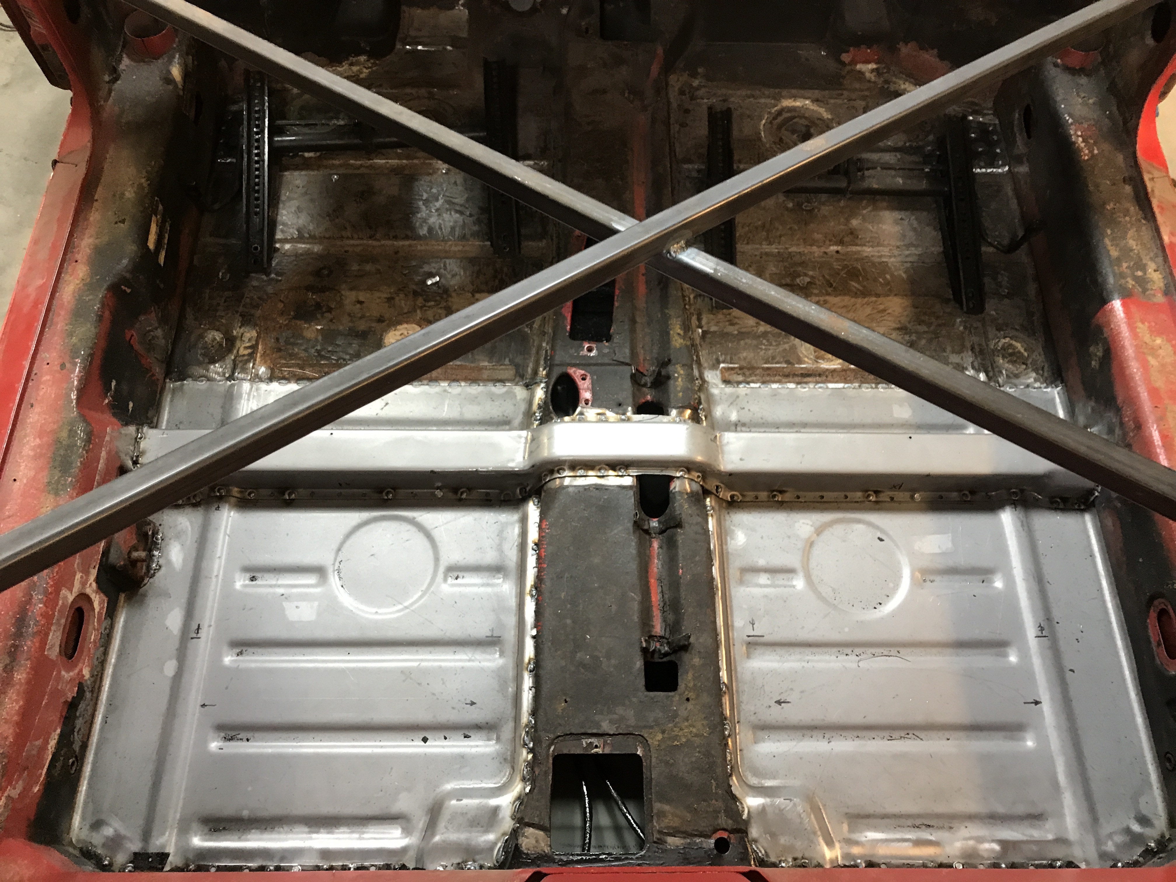

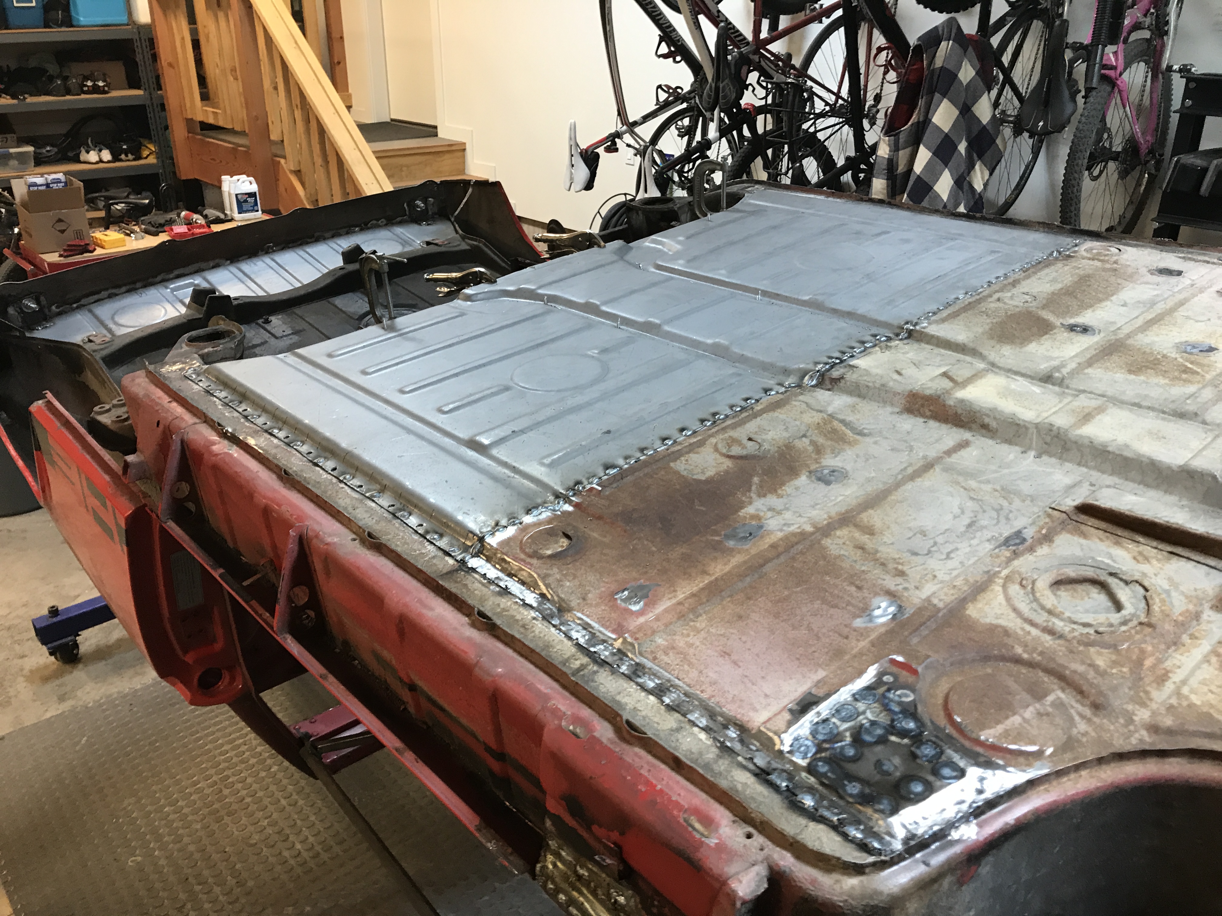

Finally on to attaching the new floor section. Here it is after tack-welding the butt seam (with metal work during welding to improve alignment), about 1/3 of the plug welds along the sills, and a few tack welds along the rear seam.

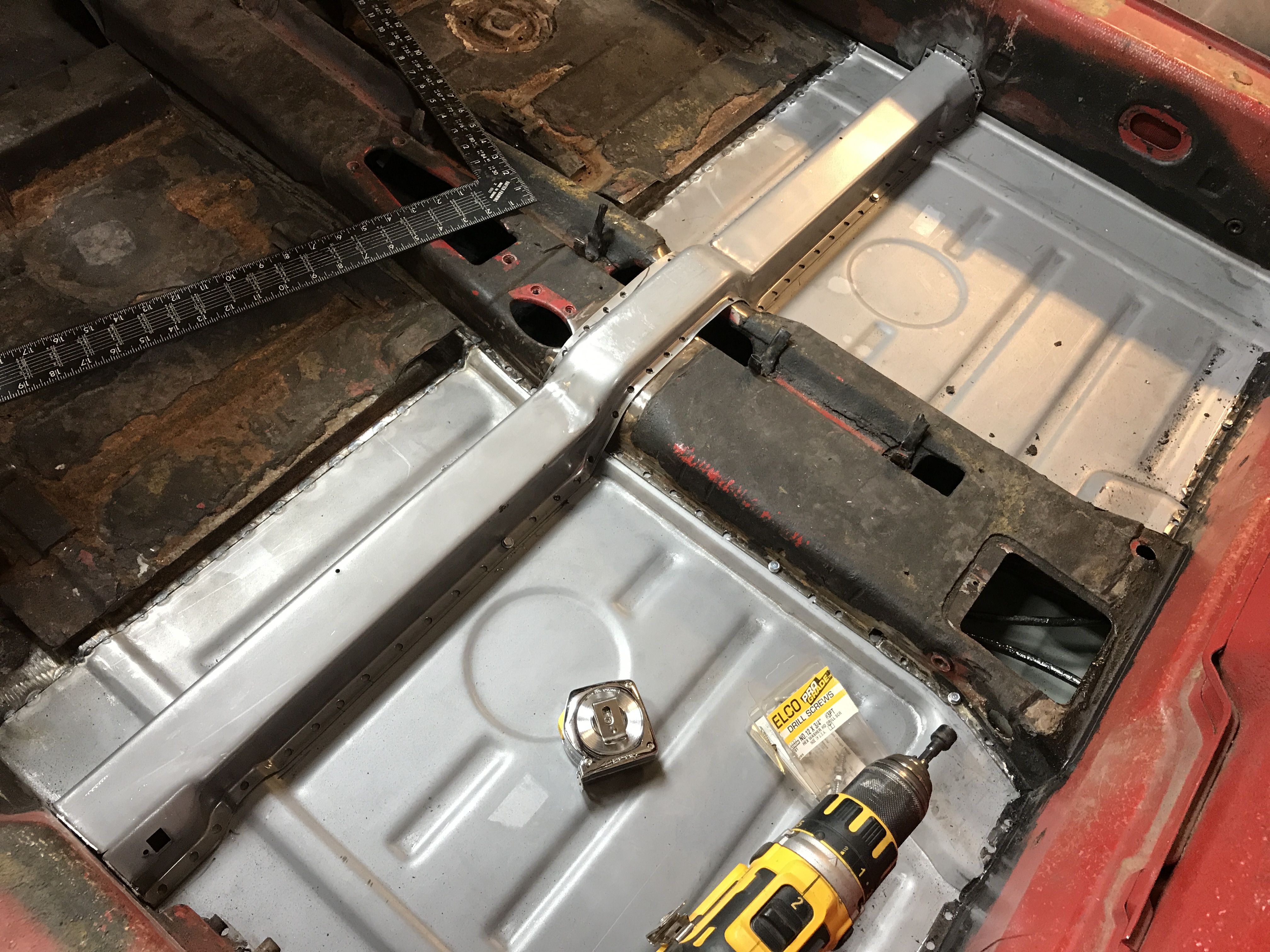

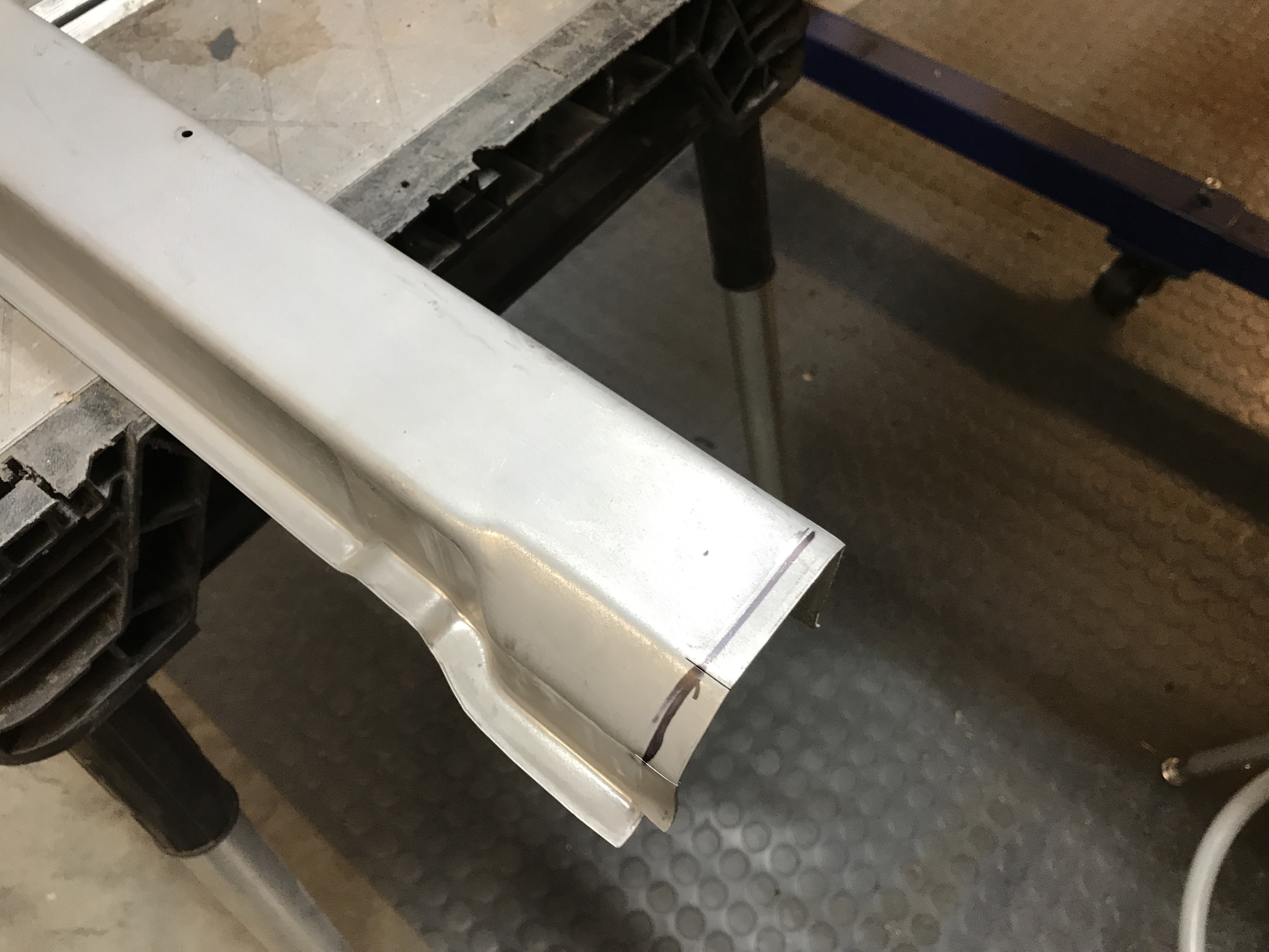

Allright! I flipped the car to right side up, and started work on the new floor cross member. Here is the piece as it cam from RD, with the ends notched for flange tabs but not bent.
bkrantz
post Feb 7 2020, 09:38 PM
Post #224
Posts: 8,341
Joined: 3-August 19
From: SW Colorado
Member No.: 23,343

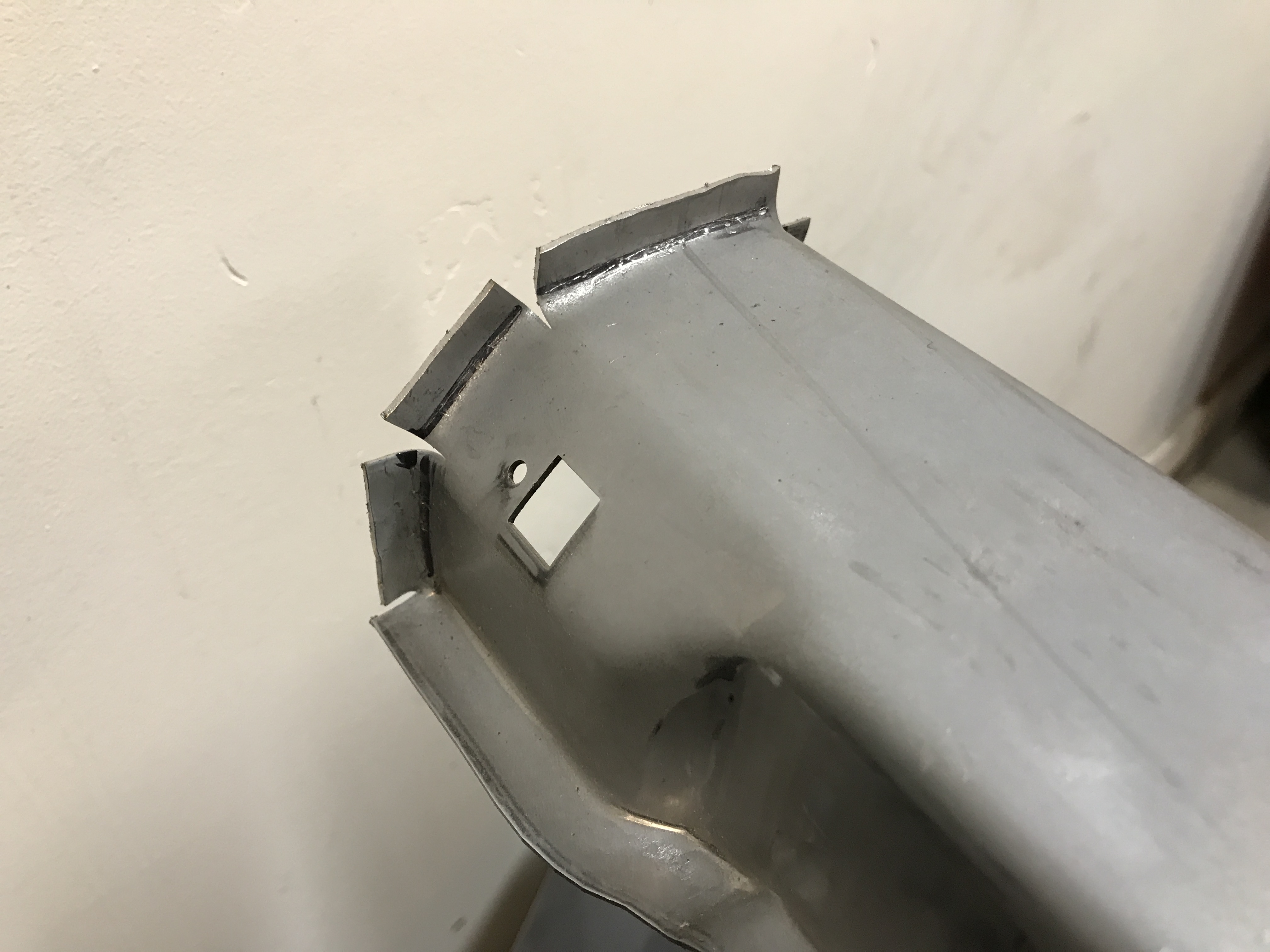

After measuring and bending, here is one end after bending some.
bkrantz
post Feb 7 2020, 09:39 PM
Post #225
Posts: 8,341
Joined: 3-August 19
From: SW Colorado
Member No.: 23,343
After more fitting and bending, here is the cross member installed ready for welding.
Trophy
post Feb 8 2020, 12:13 PM
Post #226
Posts: 2
Joined: 30-October 03
From: Calgary, Alberta
Member No.: 1,296
Nice work you are doing, what sort of tools are you using for the job, Welder's, spot weld cutters etc?
bkrantz
post Feb 8 2020, 08:58 PM
Post #227
Posts: 8,341
Joined: 3-August 19
From: SW Colorado
Member No.: 23,343
Thanks. I have mostly electrical tools: 4.5 inch grinders (new Hein and old Bosch) with cutting, grinding, and flap-sanding discs, Makita die grinder with 2 inch cut-off discs and carbide grinding bits, Rigid reciprocating saw, plus cordless drills, drill press, etc. For welding, I have a Hobart MIG and Easton TIG. 95% of the welding on car sheet metal is MIG. For metal forming I just have some hammers, including body work hammers, dollys, and miscellaneous bits of metal bars or angles. I have been cutting spot welds with the Blair 3/8 inch cutter (and lots of bits to stay sharp) as well as standard drill bits.

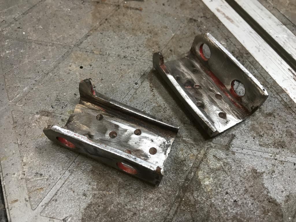

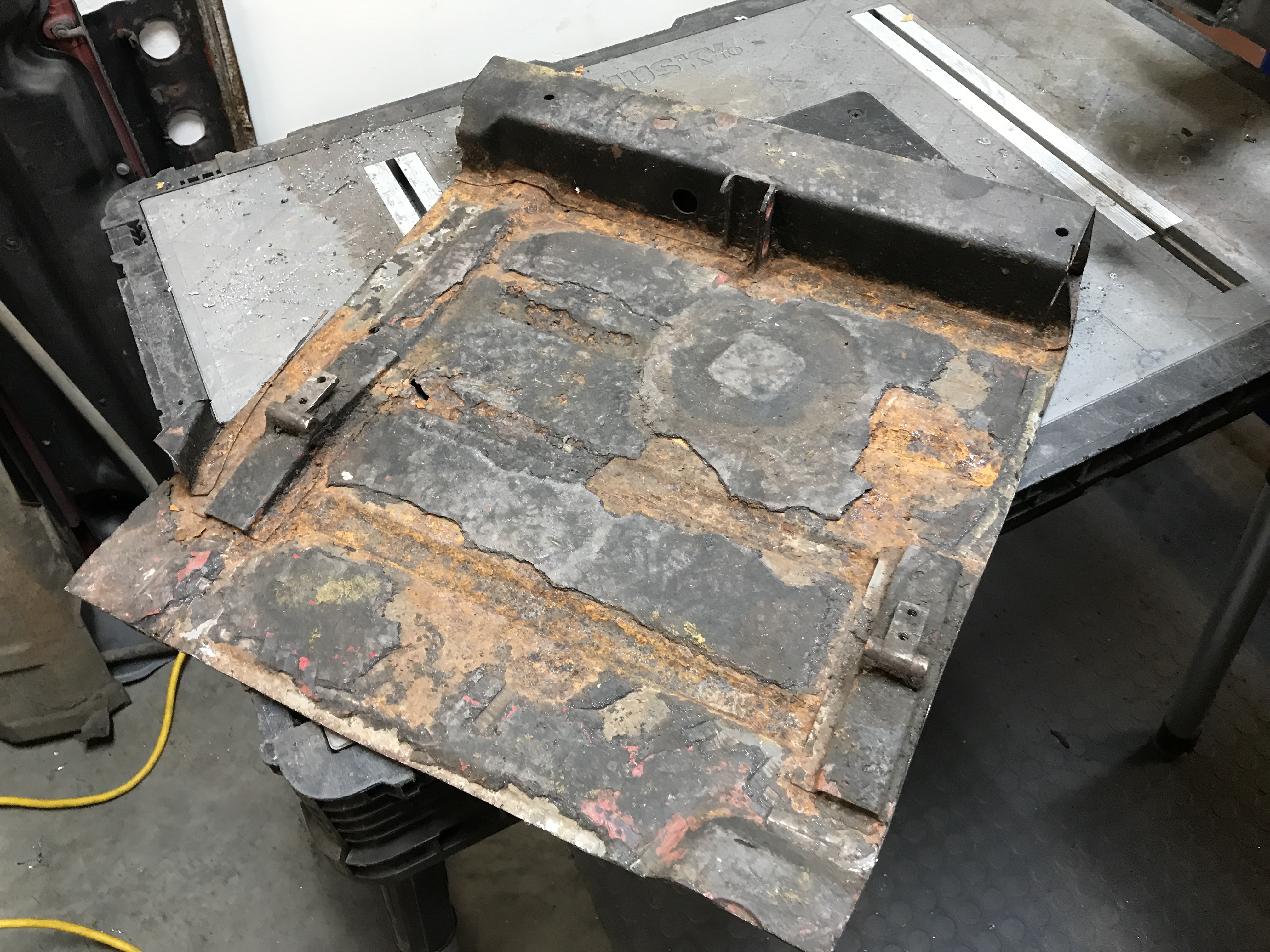

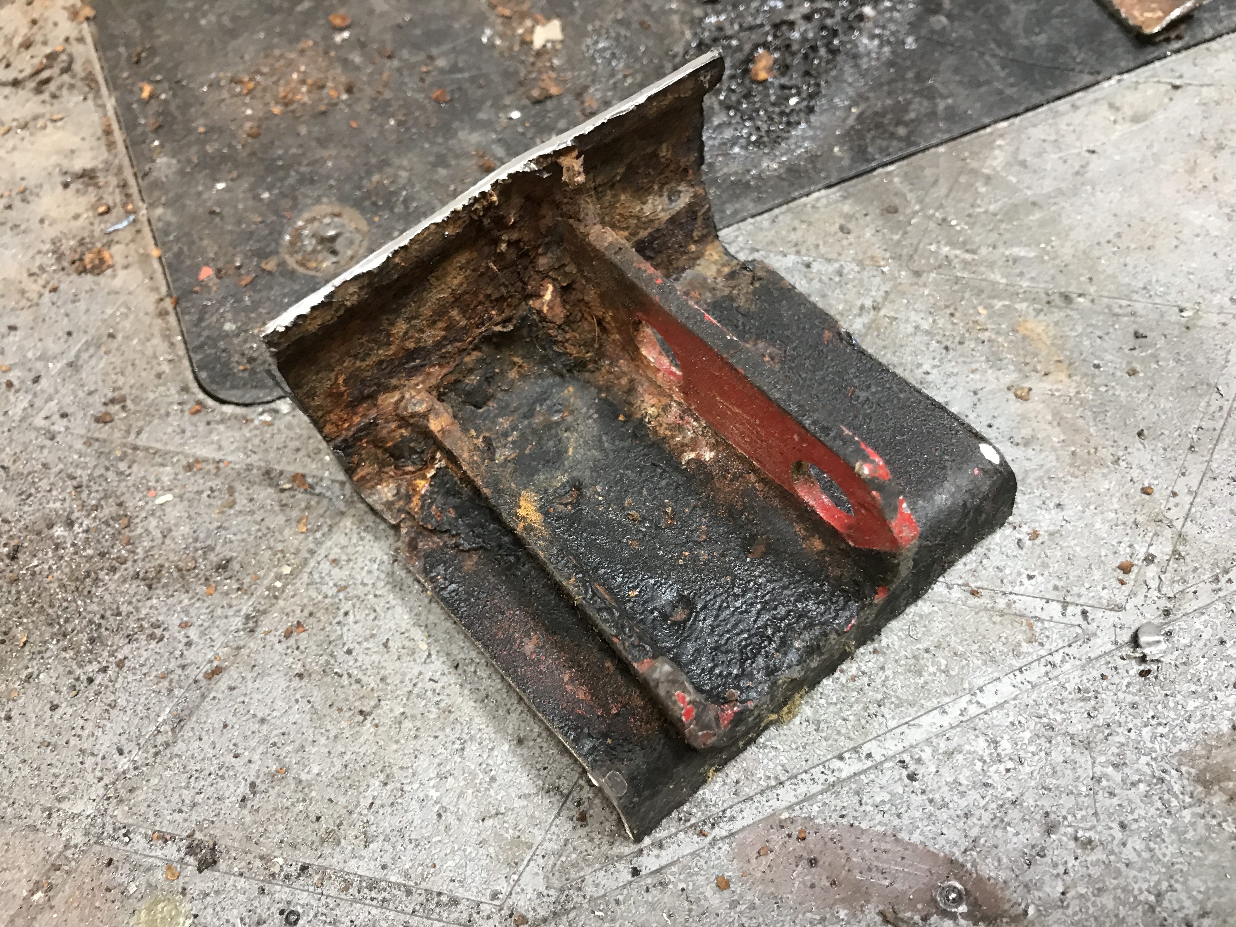

Just some incremental work today, mostly rescuing the brackets on the floor cross brace that hold the teeth for the seat tilt mechanism. Here is the left side, still attached to the section I cut out of the rusty floor.
bkrantz
post Feb 8 2020, 09:06 PM
Post #229
Posts: 8,341
Joined: 3-August 19
From: SW Colorado
Member No.: 23,343
Here's the bracket and surrounding sheet metal cut out.
bkrantz
post Feb 8 2020, 09:08 PM
Post #230
Posts: 8,341
Joined: 3-August 19
From: SW Colorado
Member No.: 23,343
And finally both brackets, after removal of old sheet metal and welds, and initial cleanup.

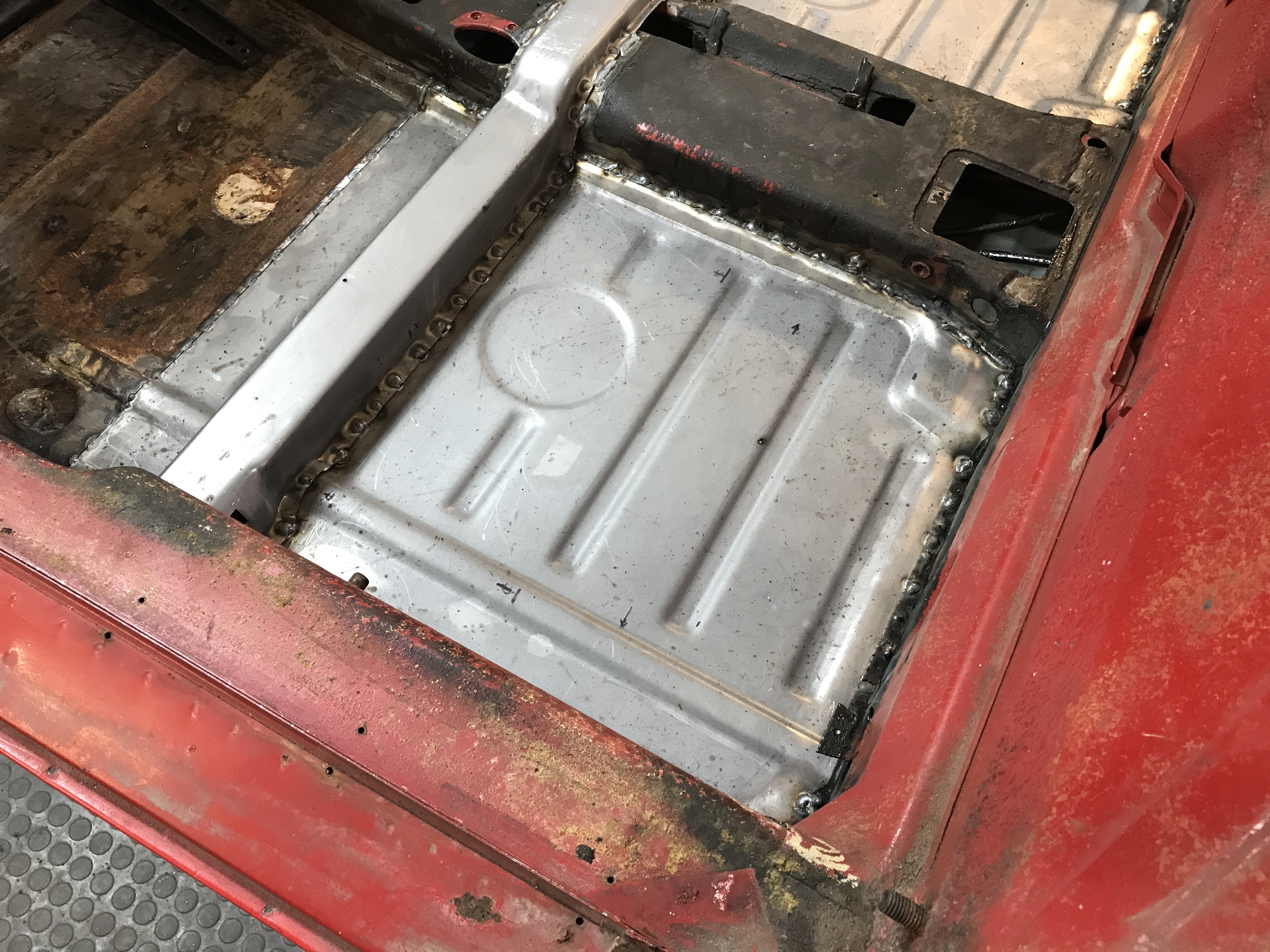

bkrantz
post Feb 9 2020, 10:11 PM
Post #231
Posts: 8,341
Joined: 3-August 19
From: SW Colorado
Member No.: 23,343
Some progress on welding inside the floor panel, including the cross member. Until I ran out of MIG wire (next time, buy 2 spools).

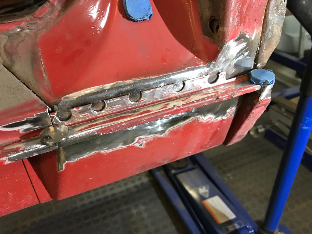

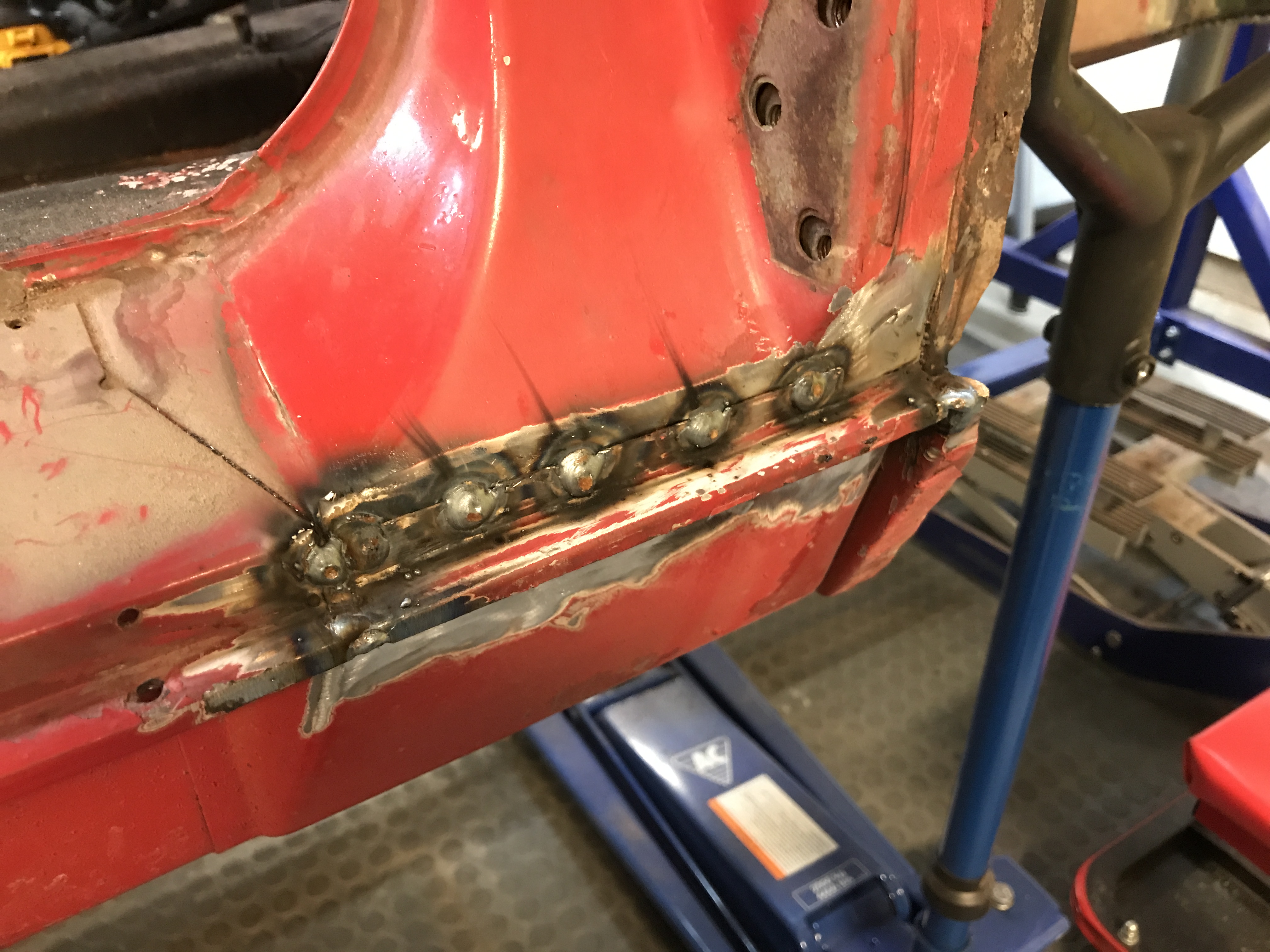

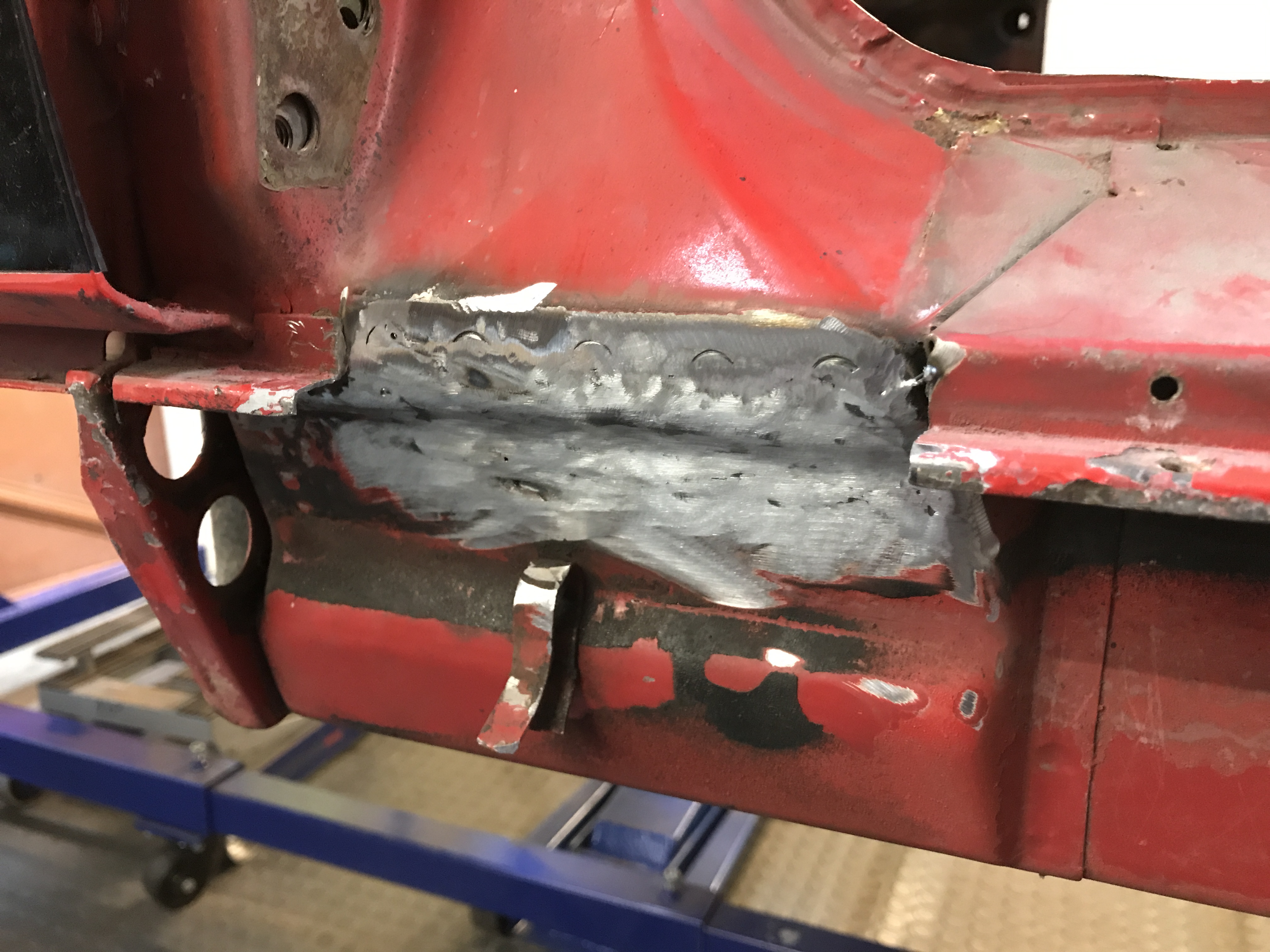

Also progress on the A-pillar bases. Ground down the welds on the left side.
bkrantz
post Feb 9 2020, 10:15 PM
Post #233
Posts: 8,341
Joined: 3-August 19
From: SW Colorado
Member No.: 23,343

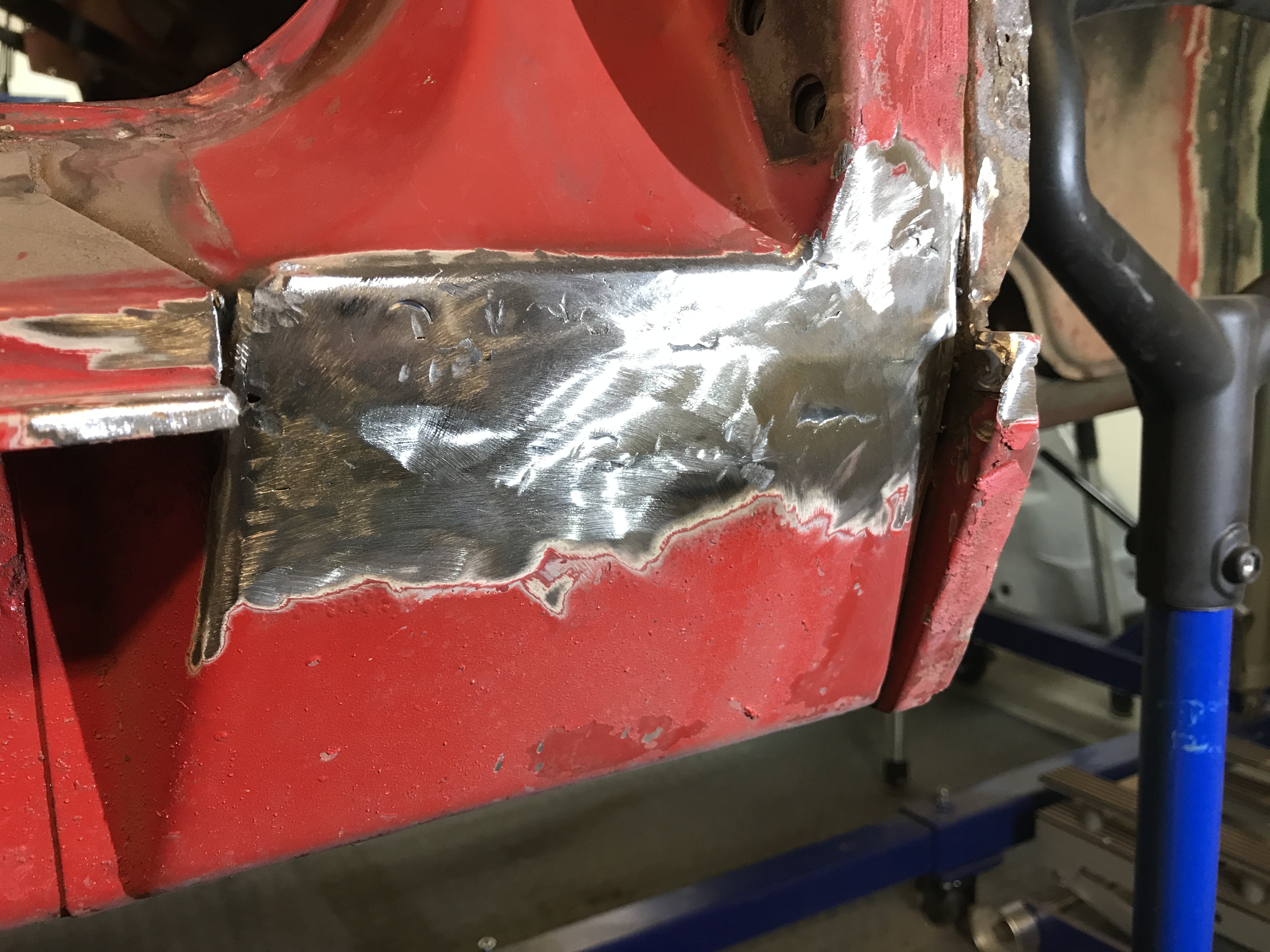

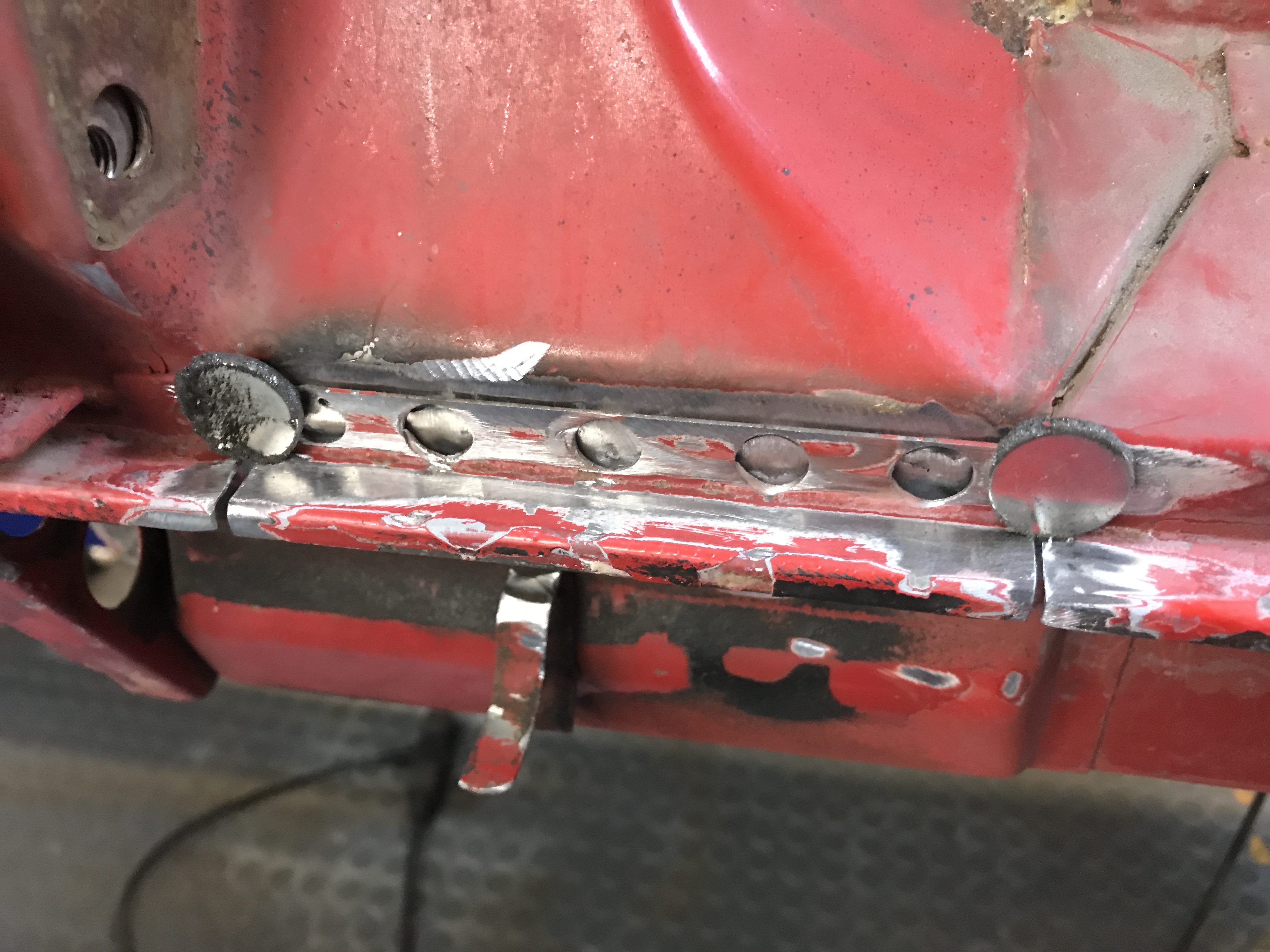

And the missing piece of the sill ledge, in place for welding.

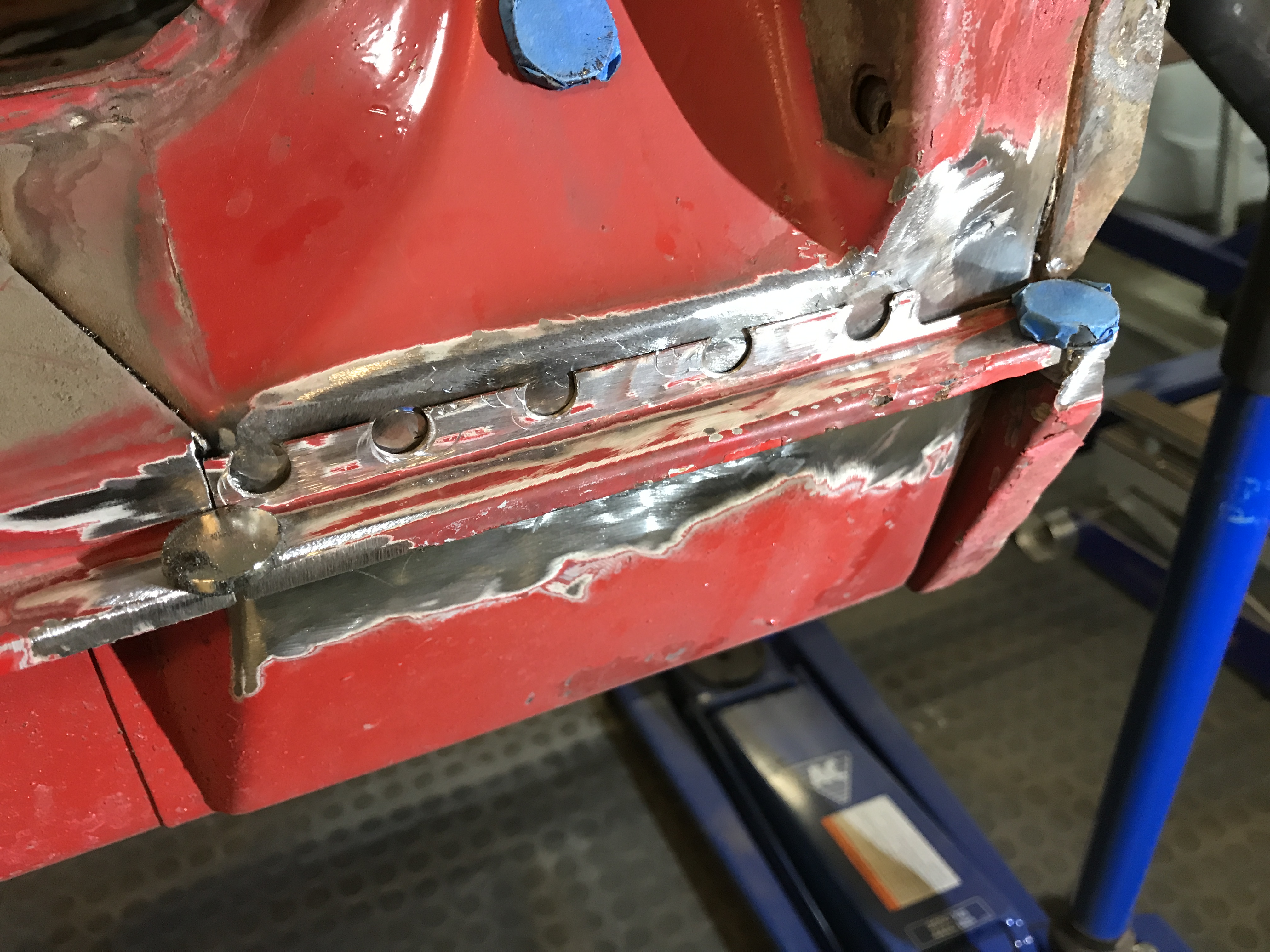

bkrantz
post Feb 9 2020, 10:16 PM
Post #234
Posts: 8,341
Joined: 3-August 19
From: SW Colorado
Member No.: 23,343
Right side ground down.
bkrantz
post Feb 9 2020, 10:17 PM
Post #235
Posts: 8,341
Joined: 3-August 19
From: SW Colorado
Member No.: 23,343
And right sill edge piece.

bkrantz
post Feb 10 2020, 10:11 PM
Post #237
Posts: 8,341
Joined: 3-August 19
From: SW Colorado
Member No.: 23,343
QUOTE(horizontally-opposed @ Feb 9 2020, 09:22 PM) *
QUOTE(bkrantz @ Feb 9 2020, 08:17 PM) *
^ Nice work—in an inspiring thread...wow!
Thanks. Nothing fancy or as quality as some really talented people can do. I just figure I can learn by doing and get something functionally better.
bkrantz
post Feb 10 2020, 10:12 PM
Post #238
Posts: 8,341
Joined: 3-August 19
From: SW Colorado
Member No.: 23,343
Right sill edge welded.
bkrantz
post Feb 10 2020, 10:14 PM
Post #239
Posts: 8,341
Joined: 3-August 19
From: SW Colorado
Member No.: 23,343

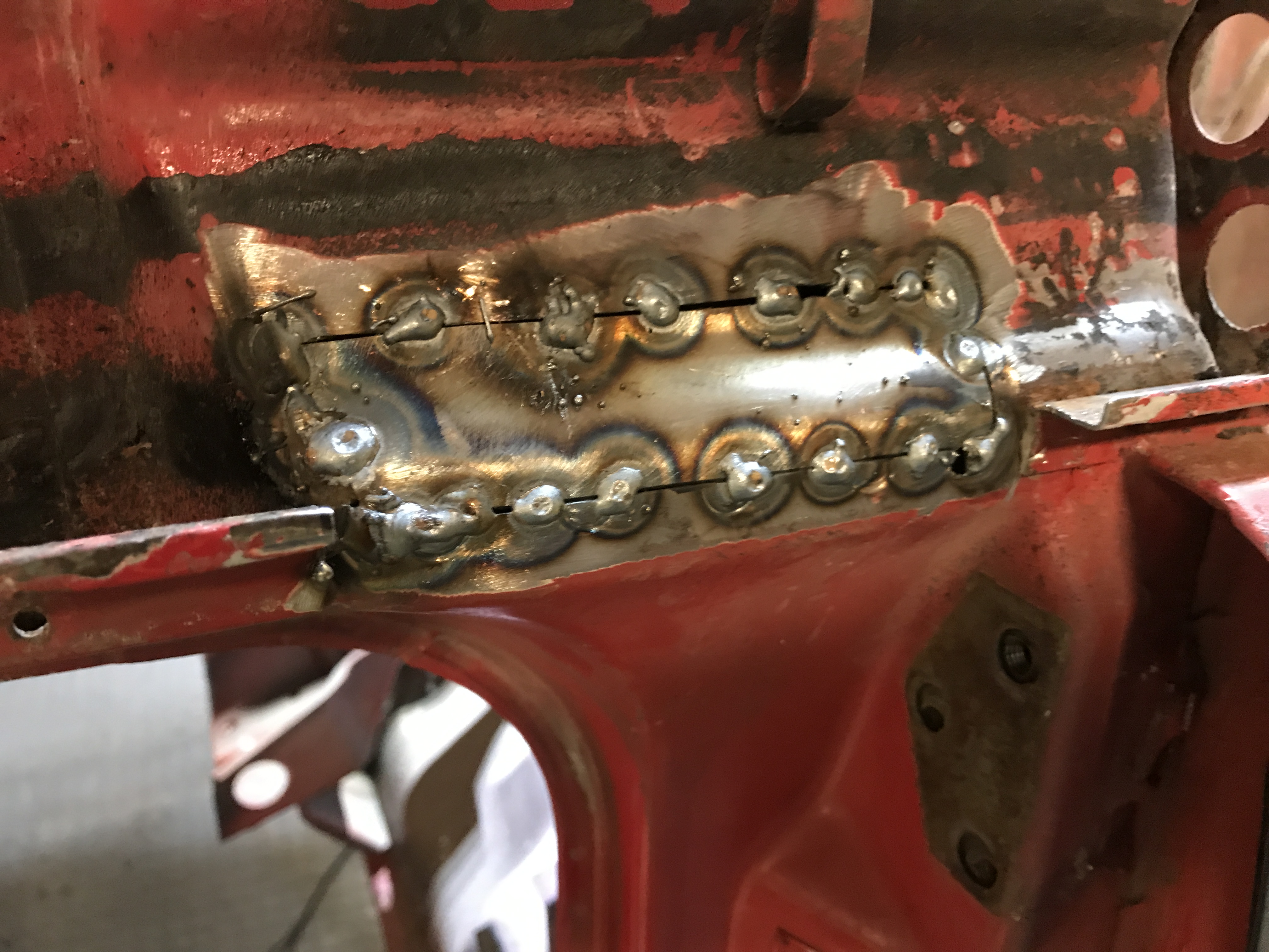

Right side floor interior welding done. Still a challenge to get the plug welds functional and pretty. I go for functional first.

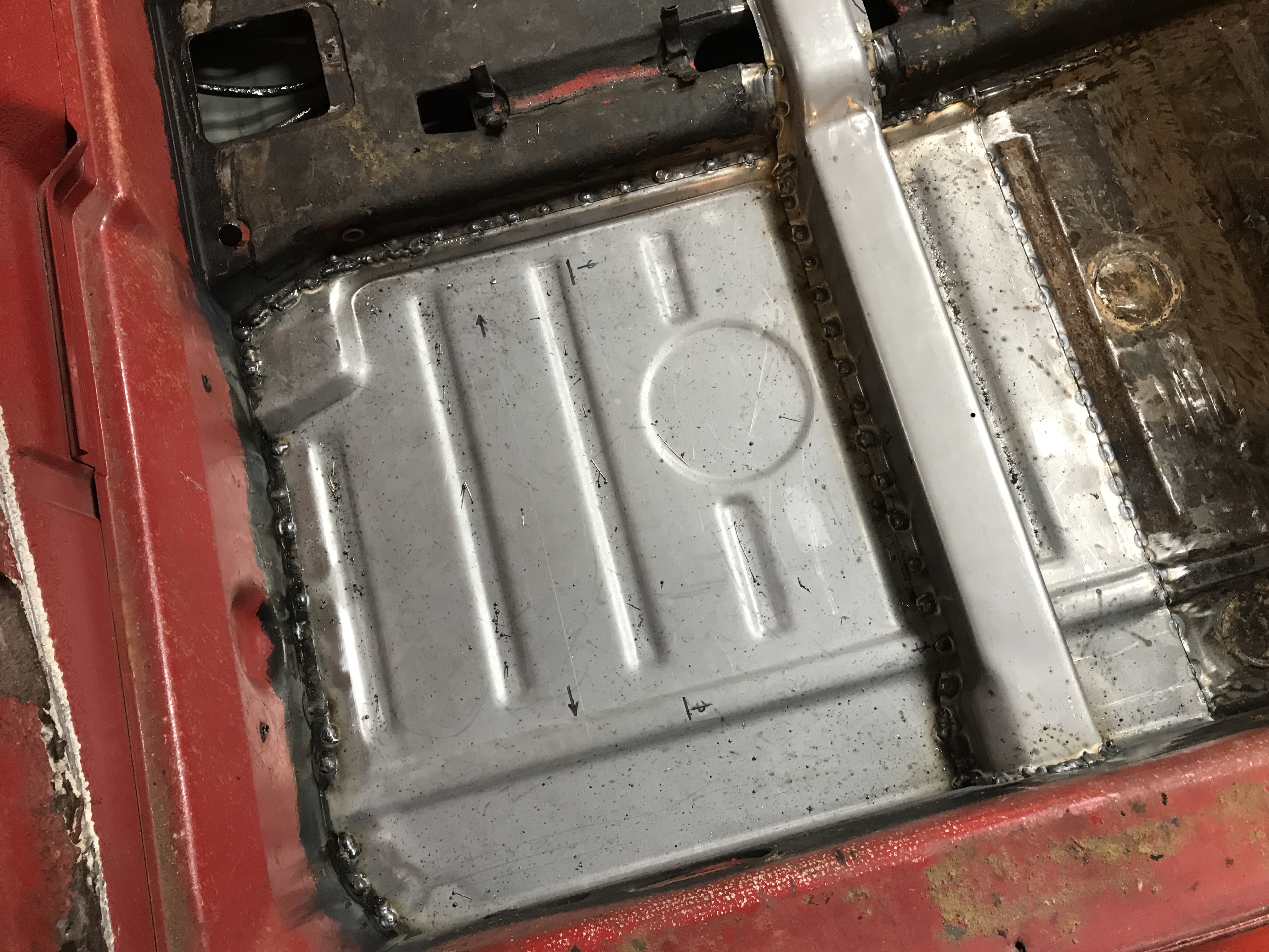

bkrantz
post Feb 12 2020, 10:54 PM
Post #240
Posts: 8,341
Joined: 3-August 19
From: SW Colorado
Member No.: 23,343
And the left side done. Getting a little better at plug welding.
