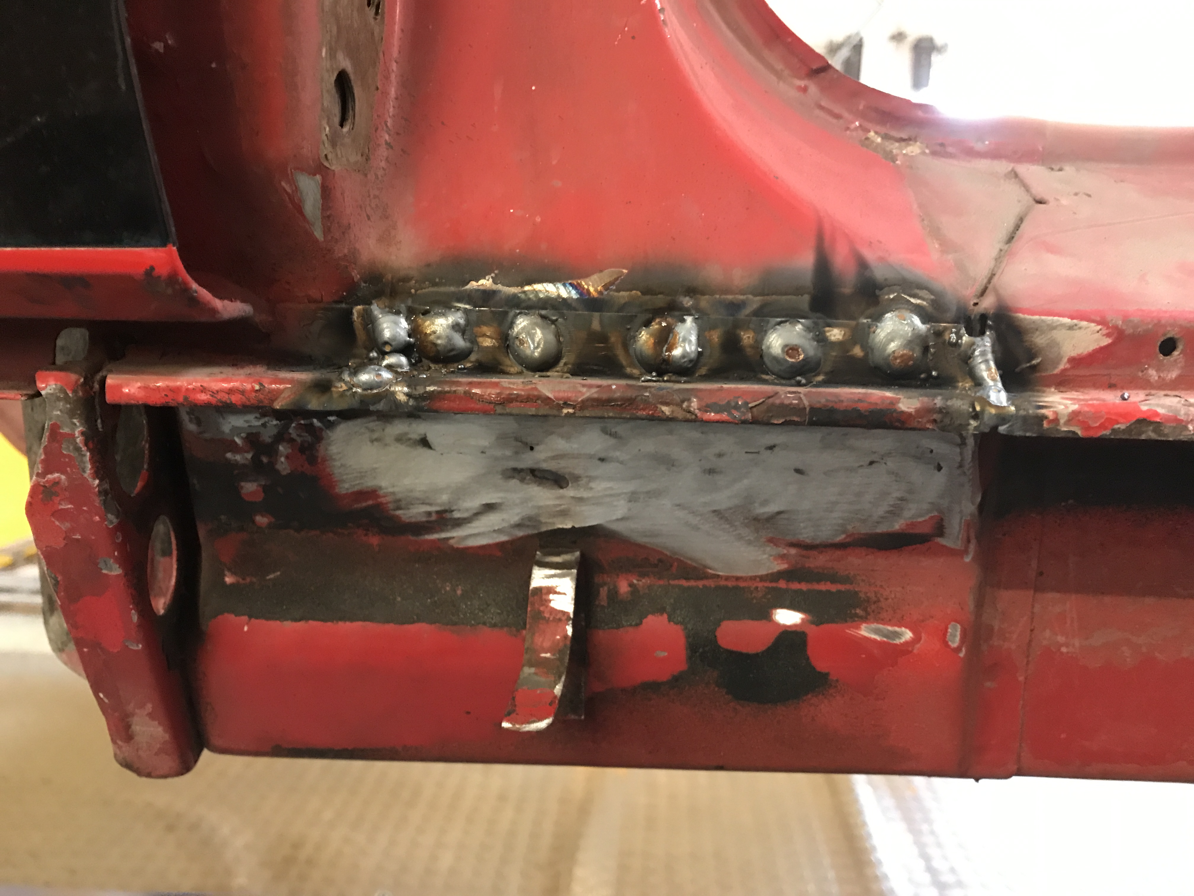

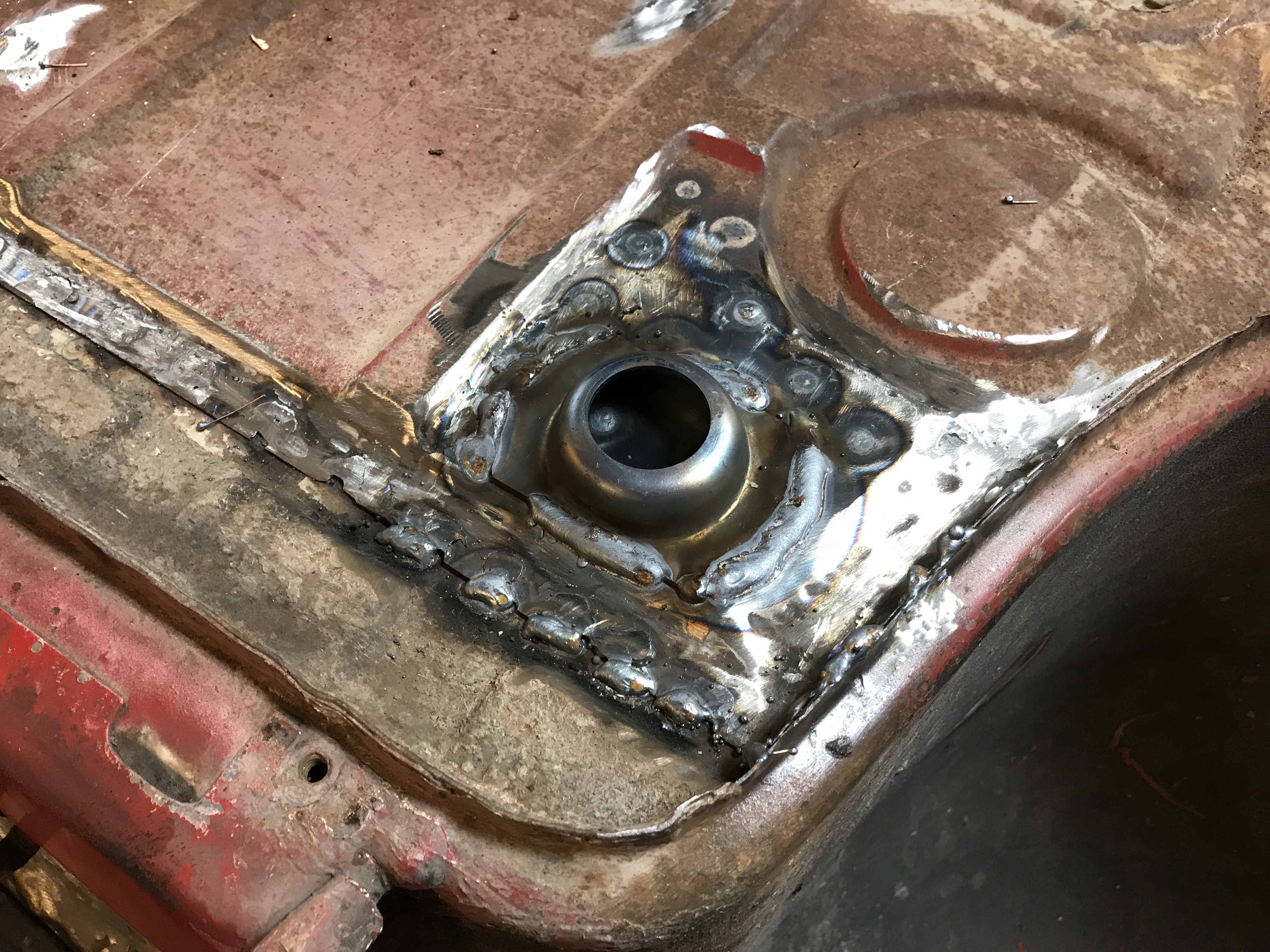

Left side sill ledge piece. Had a couple of burn-throughs so these beads are a bit fat.

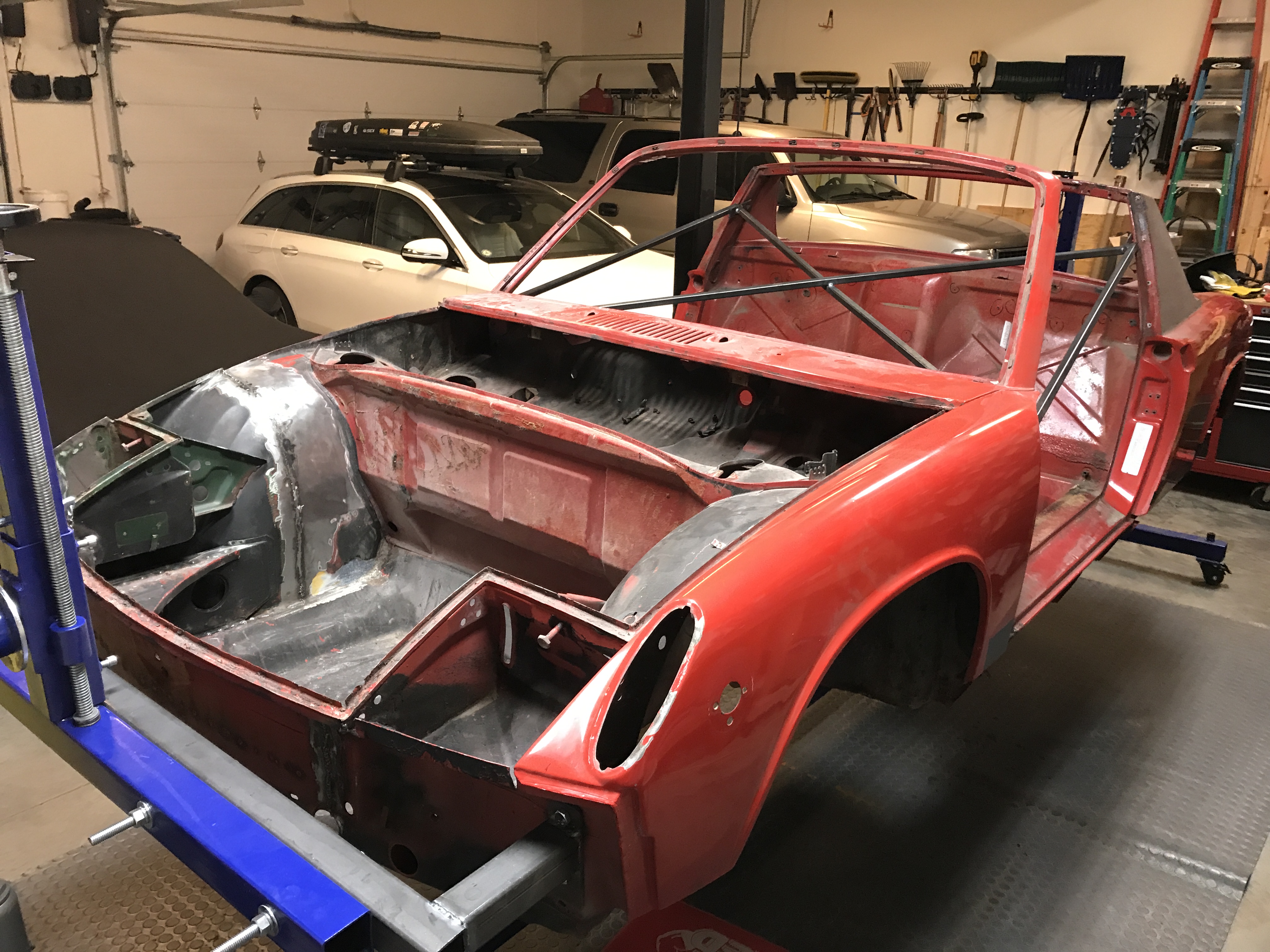

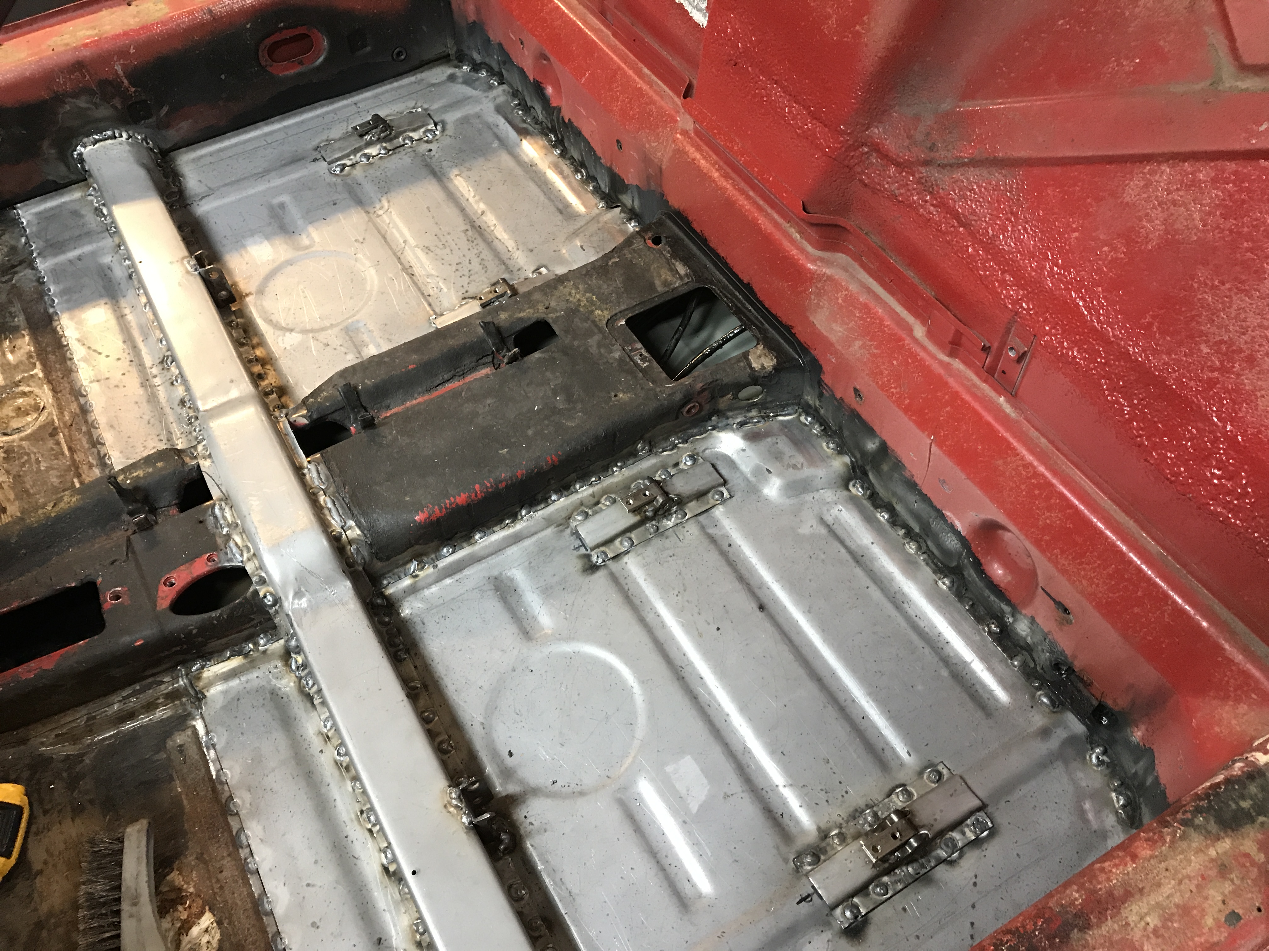

An overall shot of the car--feeling like I have made some progress, and maybe over the hump. (At least this hump)

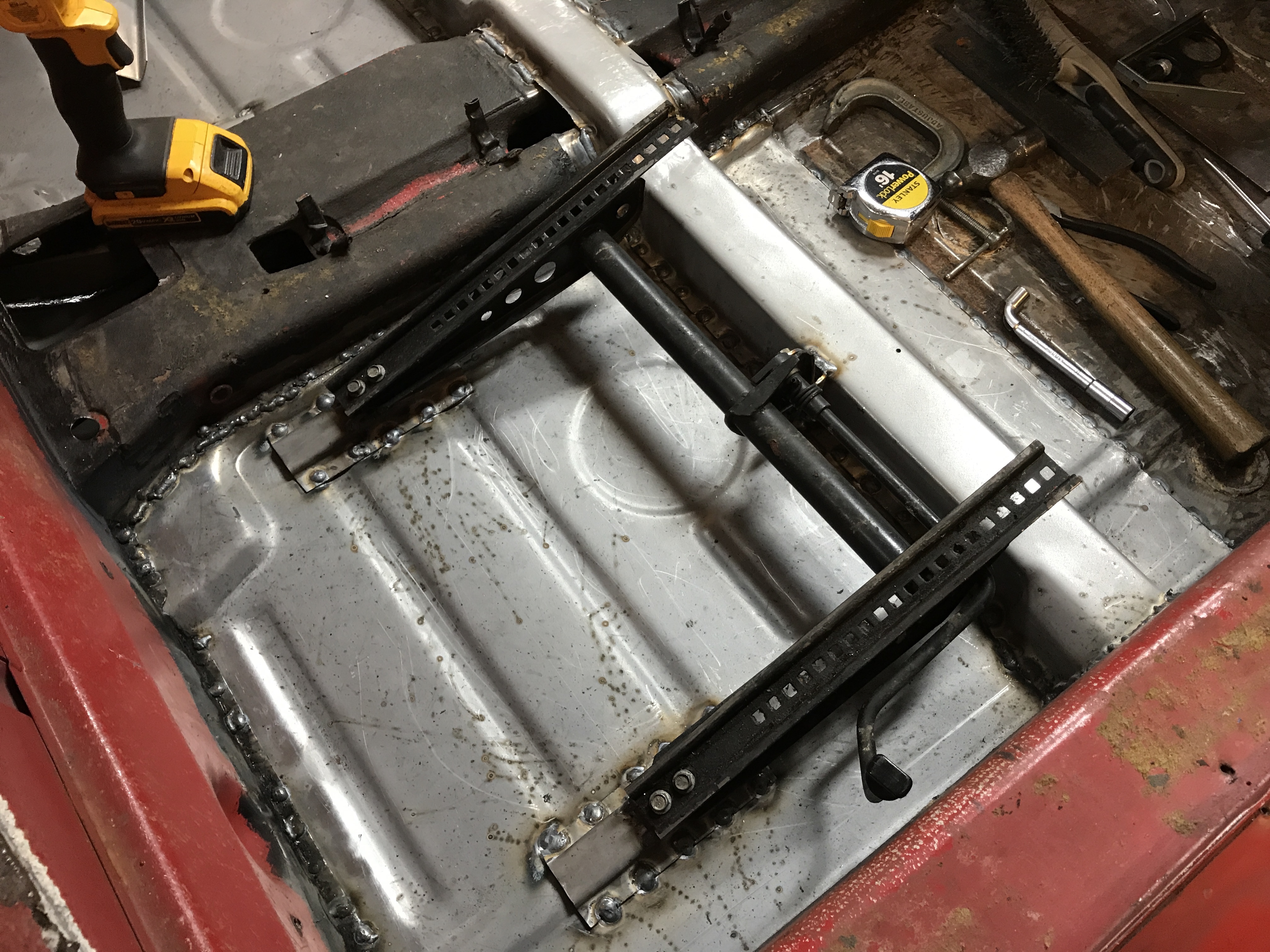

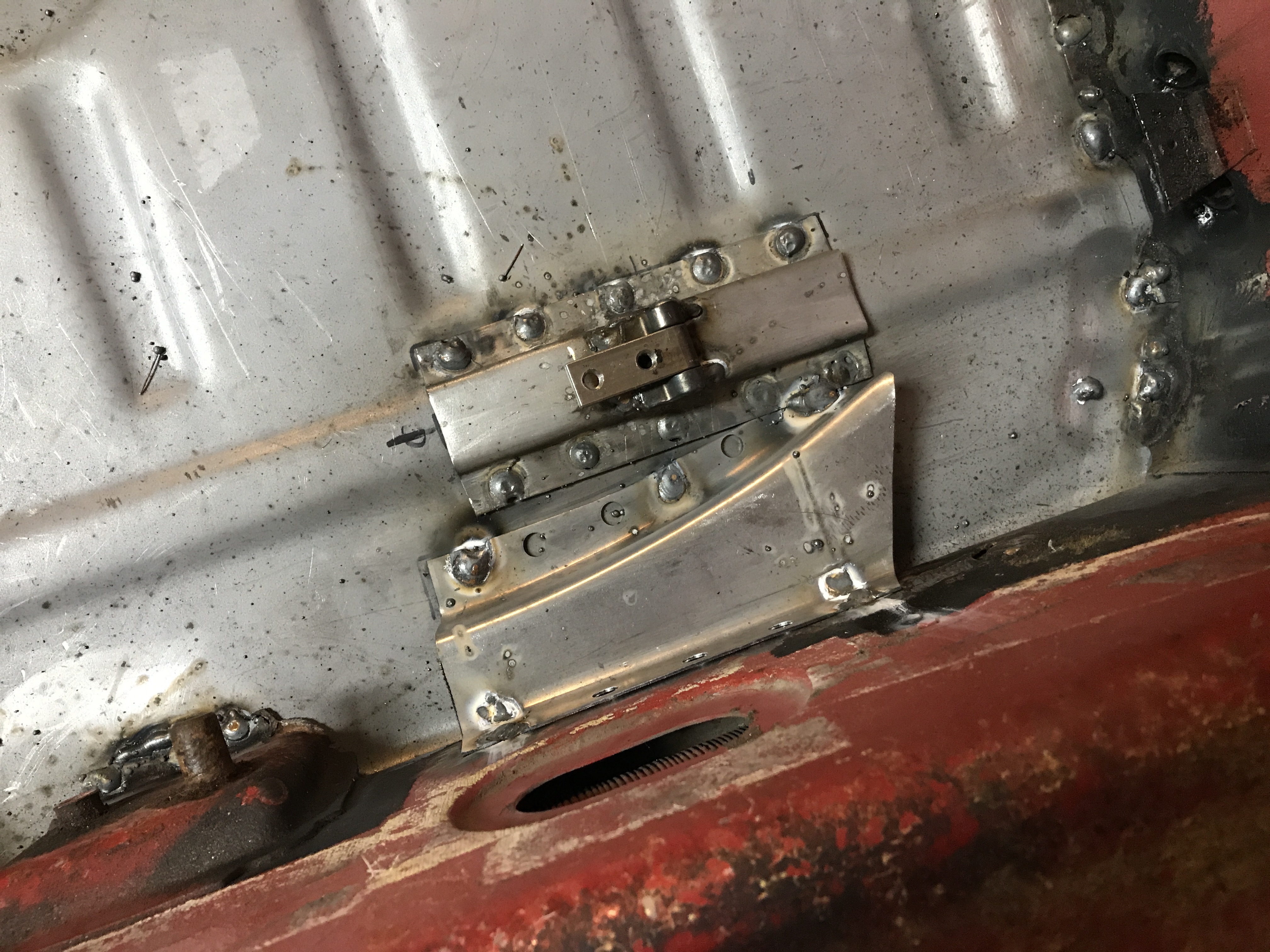

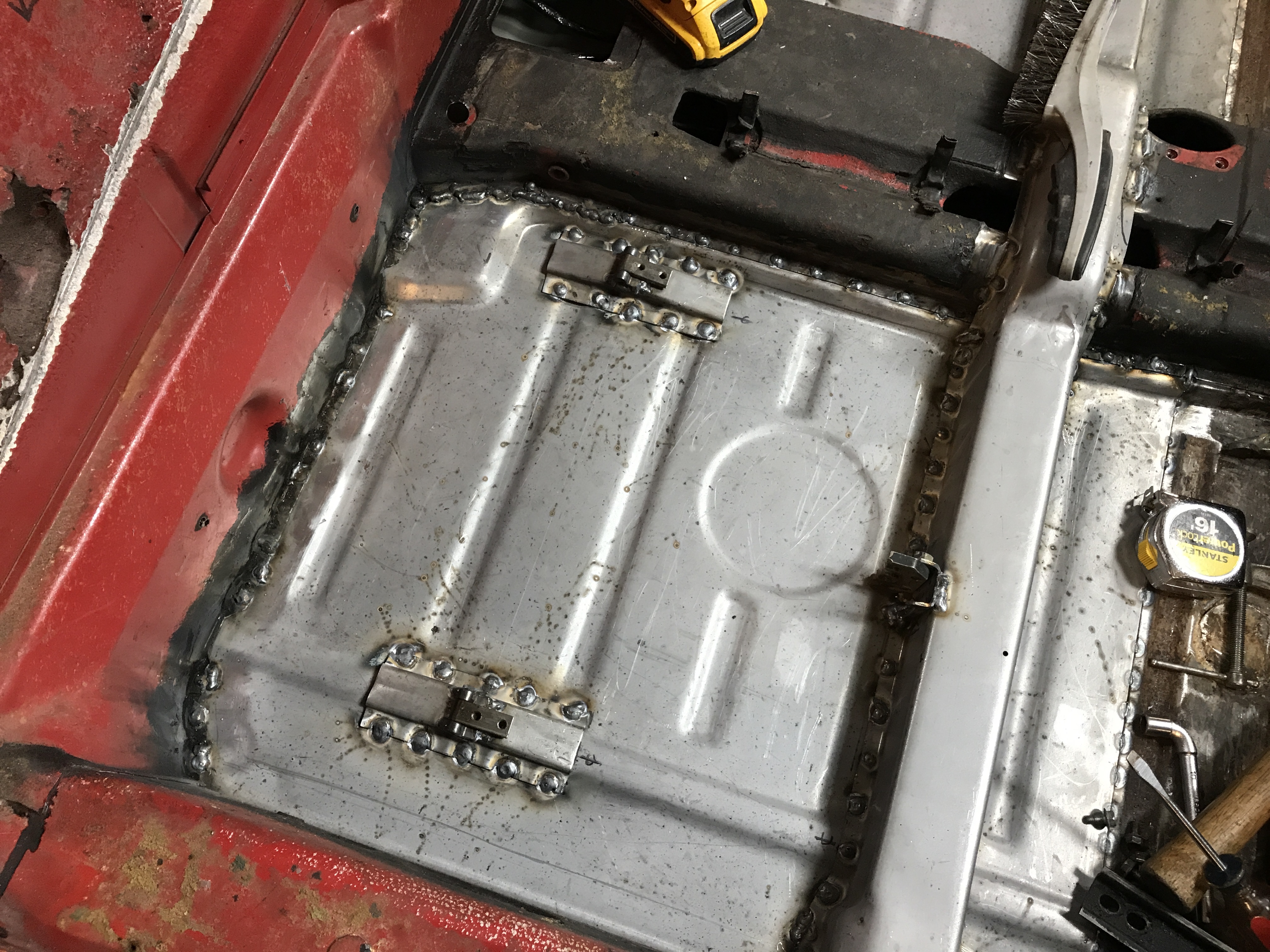

So after 3 days of measuring and fitting and aligning, I was confident enough to weld in the seat bracket mounts. I did the hinges and floor mounts first, then lined up the front bracket that holds the tilt adjustment teeth.
Here's the left side:
bkrantz
post Feb 14 2020, 09:35 PM
Post #244
Posts: 8,341
Joined: 3-August 19
From: SW Colorado
Member No.: 23,343

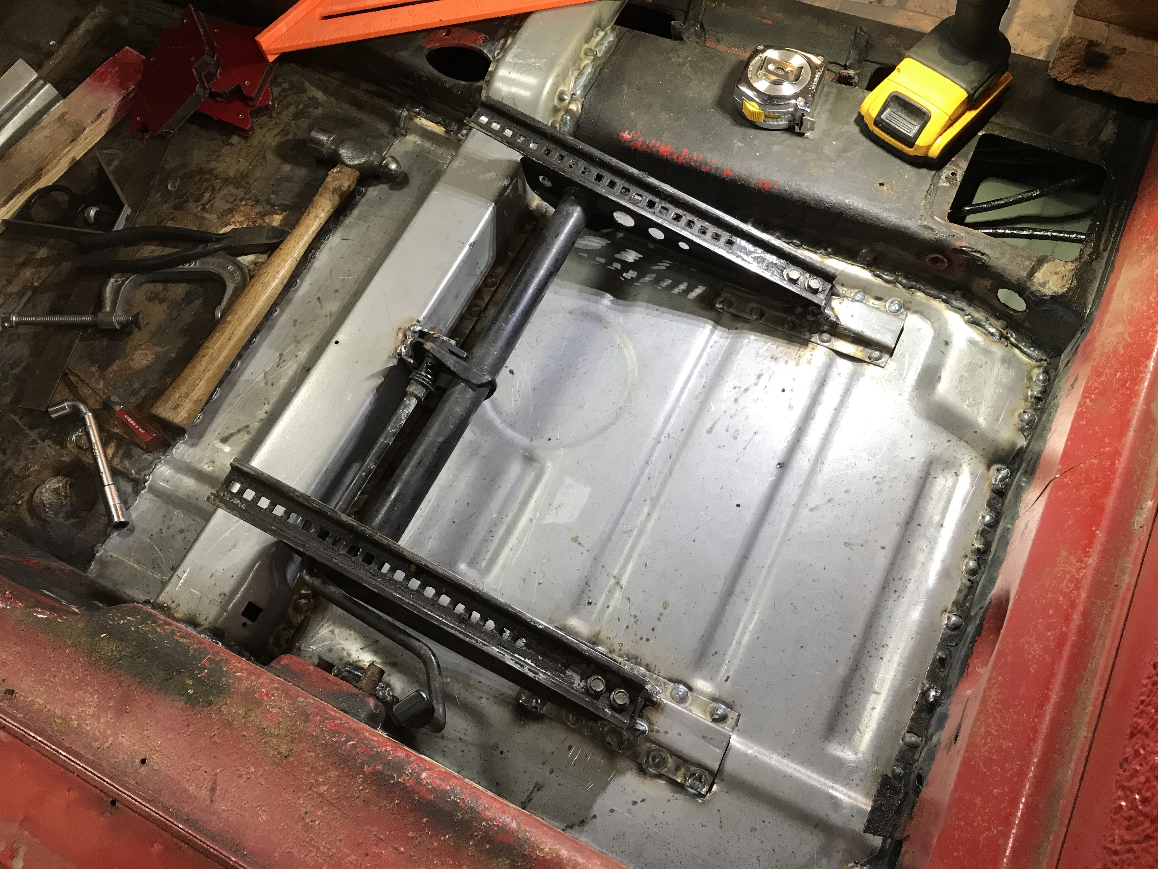

And with the seat mount in place. It tilts!

And the right side:

This side tilts, too!

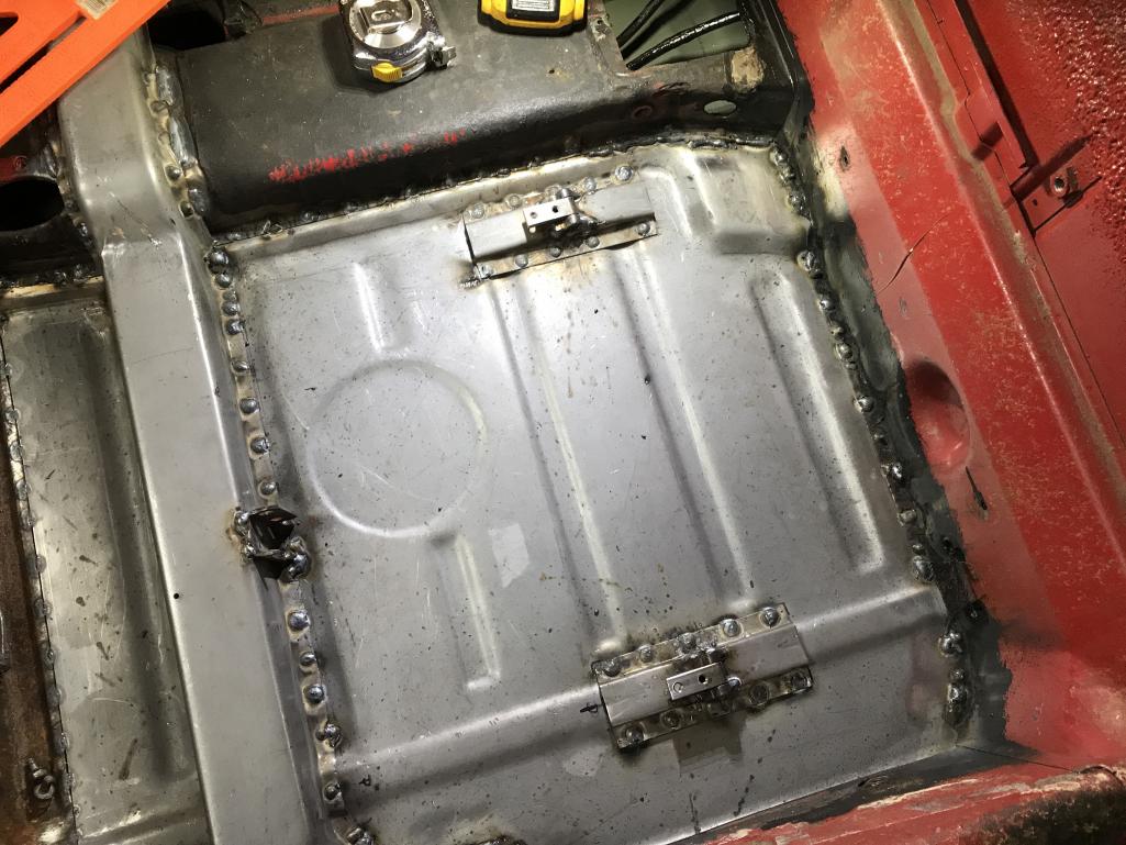

Only one more thing to weld on the floor interior. Any guesses?

QUOTE(bkrantz @ Feb 14 2020, 08:38 PM) *
Carpet buttons.
E-brake mount?

QUOTE(Kansas 914 @ Feb 15 2020, 06:37 AM) *
E-brake mount?
Here it is.

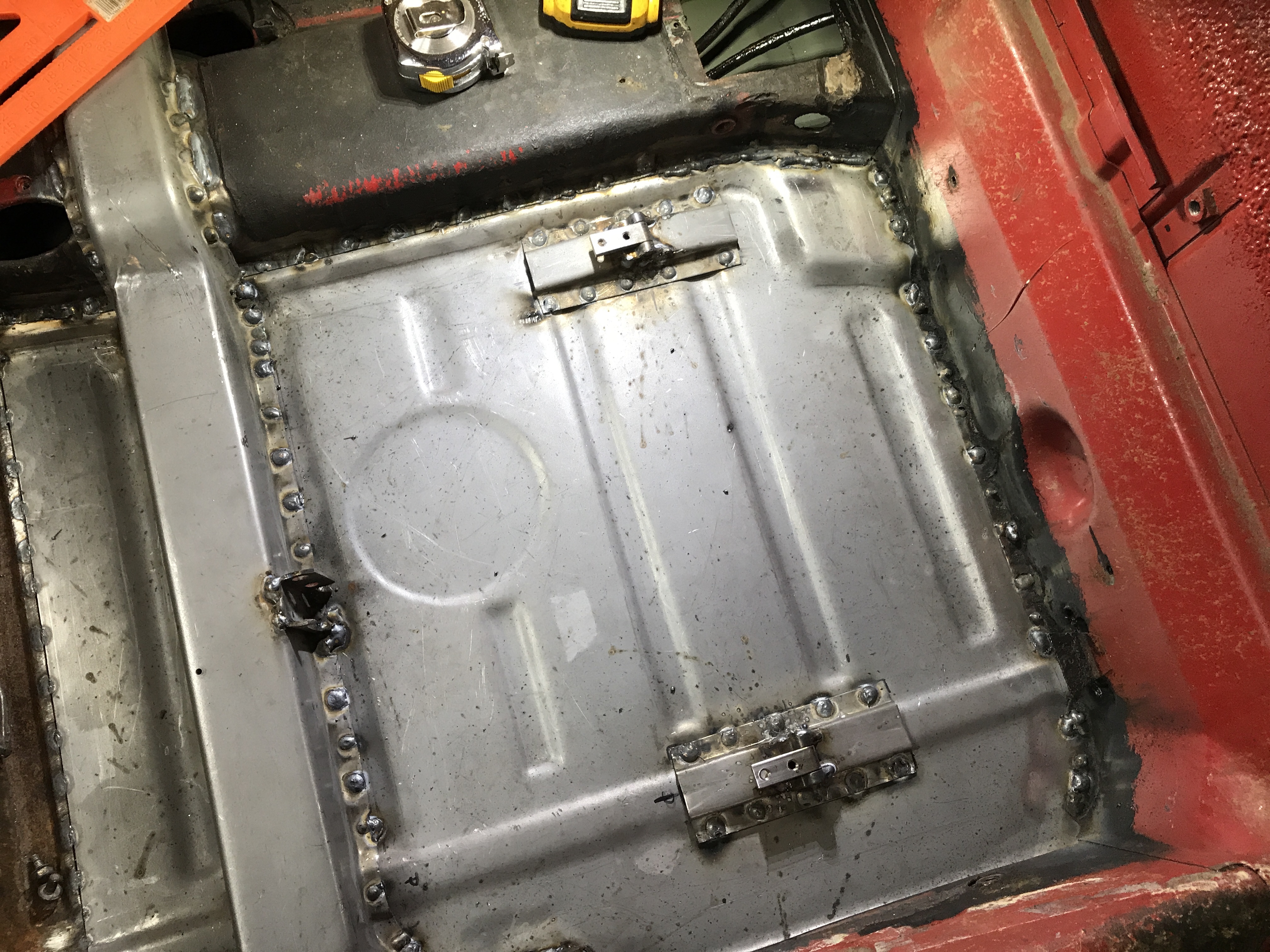

While the car is upright, I started welding in the rear cross member brace that goes on top of the trunk floor.

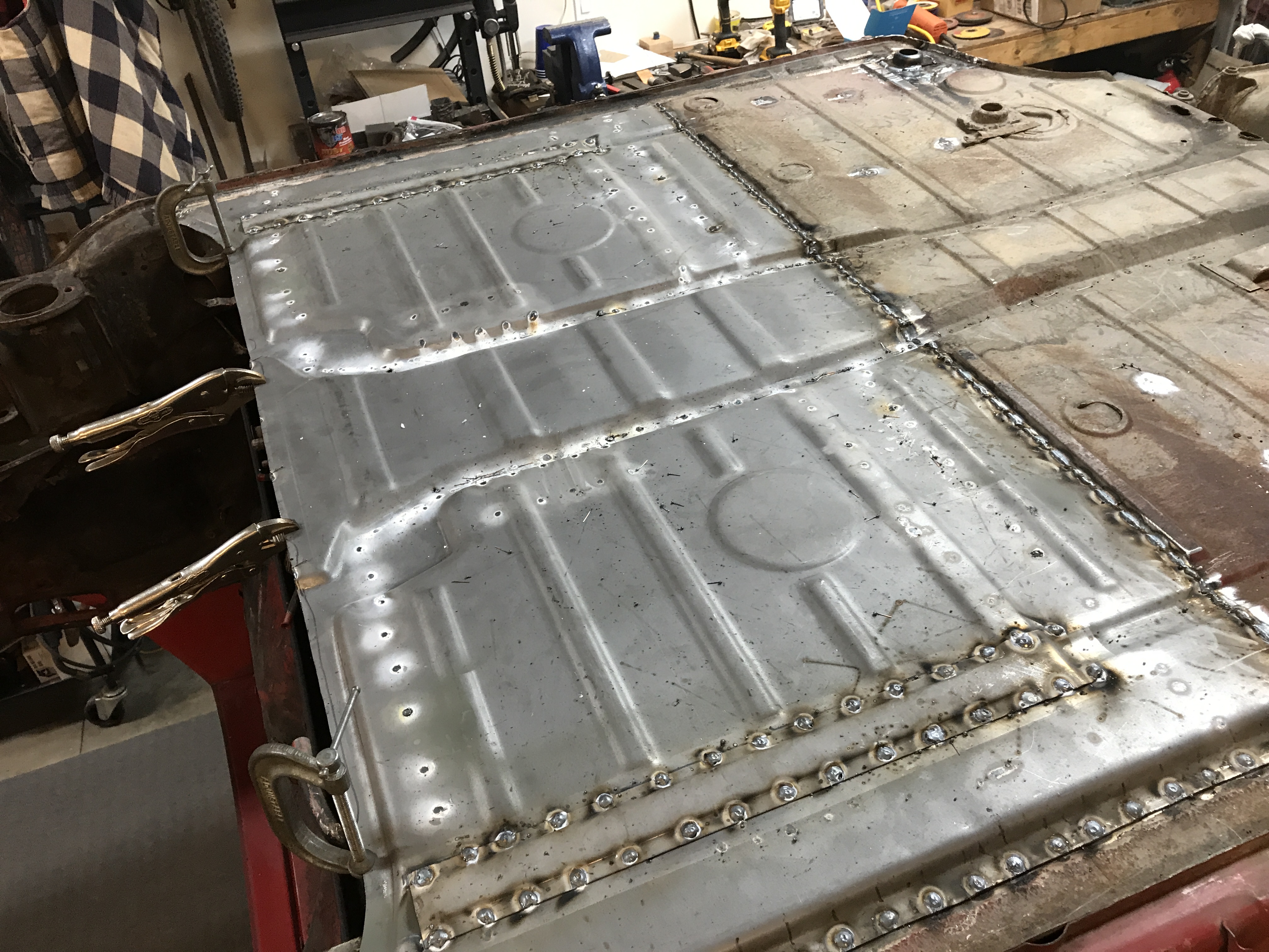

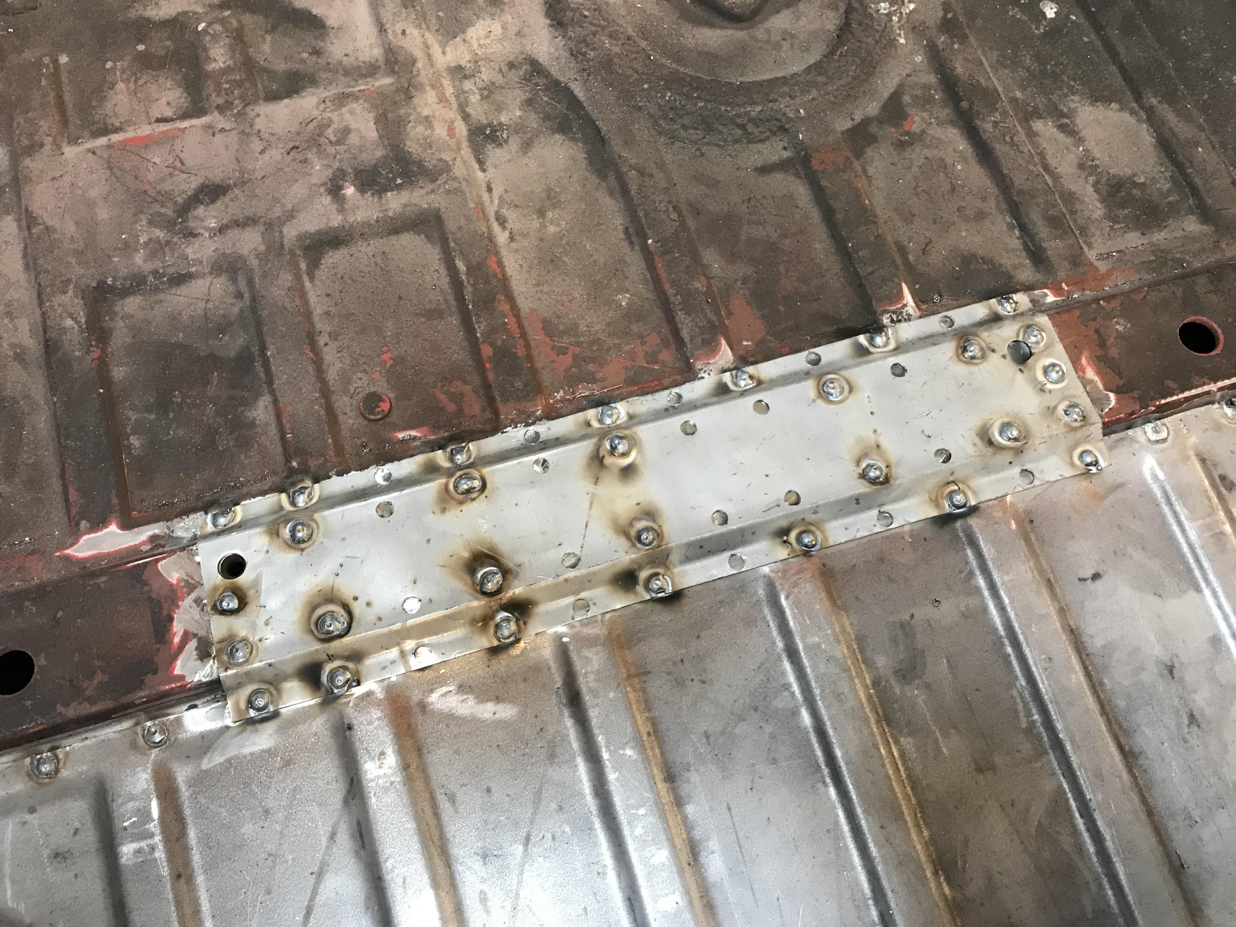

Bottom of the floor is nearly done! I flipped the car upside down to weld on the seat reinforcing strips and finish the welding along the butt seam between the front and rear sections.

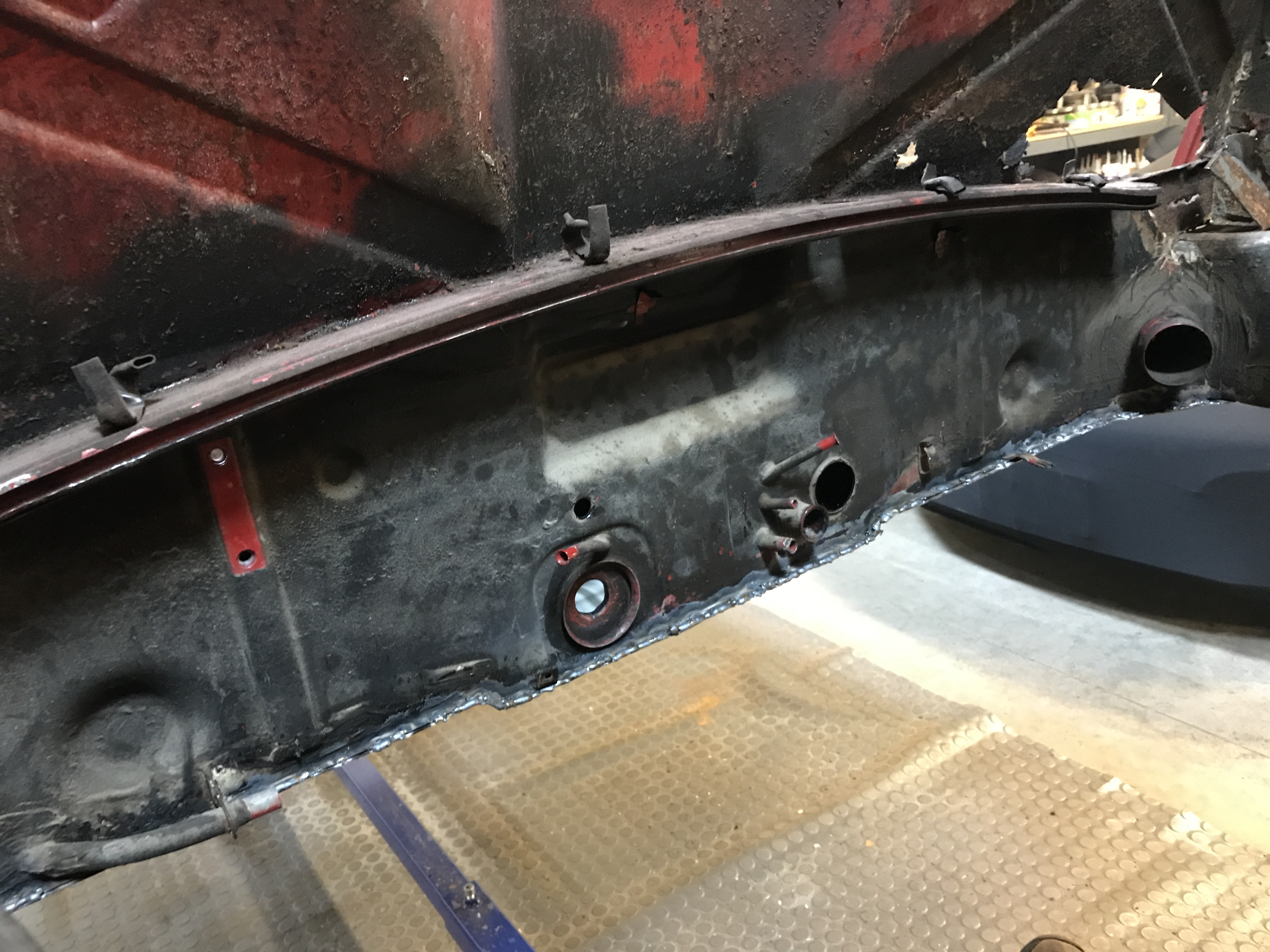

Got to the rear seam, at the base of the firewall in the engine compartment. Plug welded all the way across plus seam welding the edge of the center tunnel, just like original.

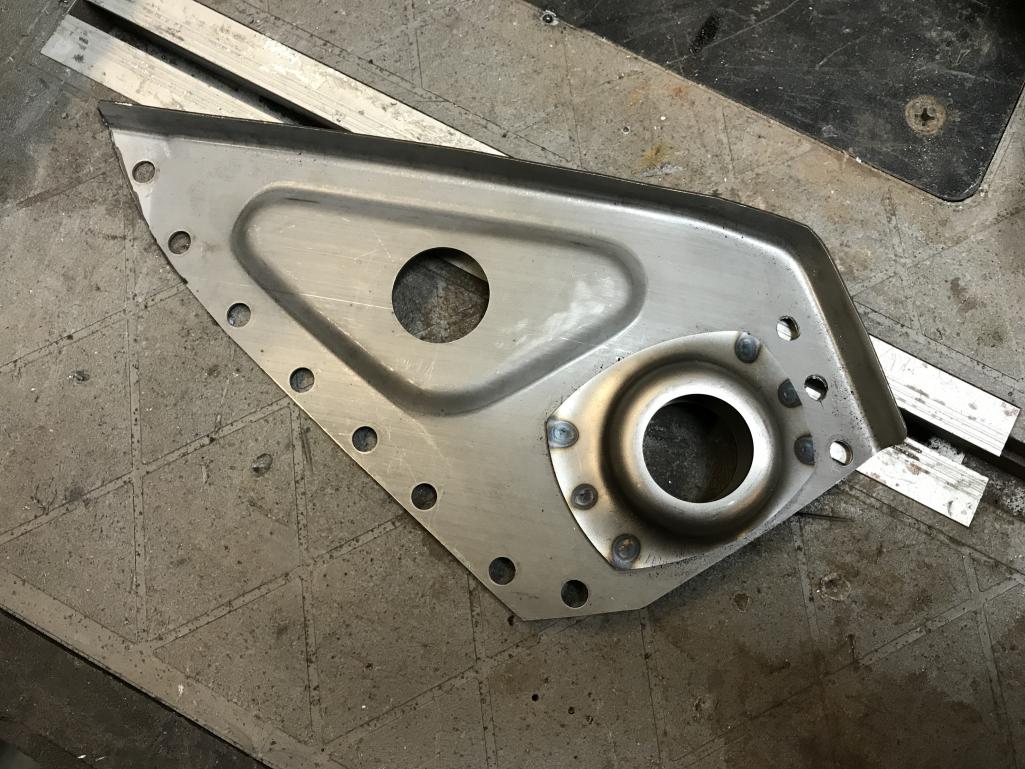

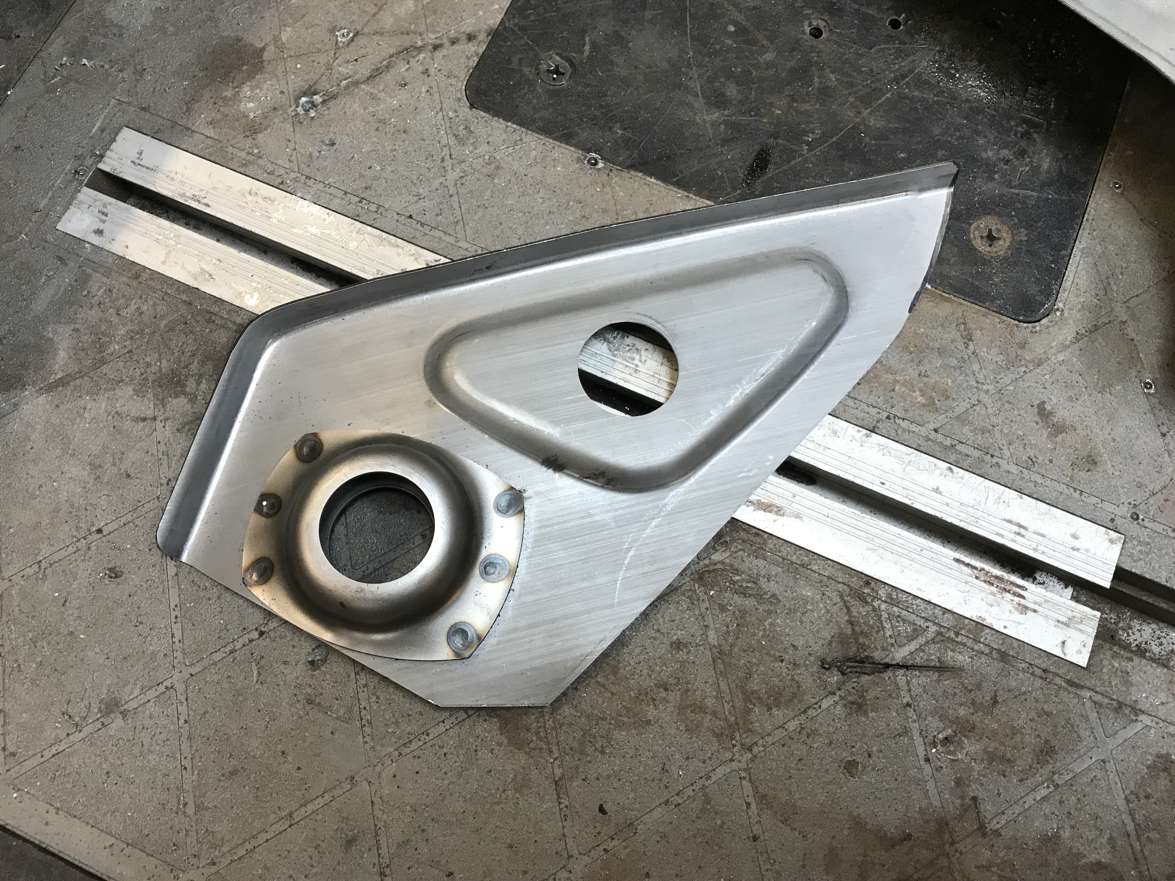

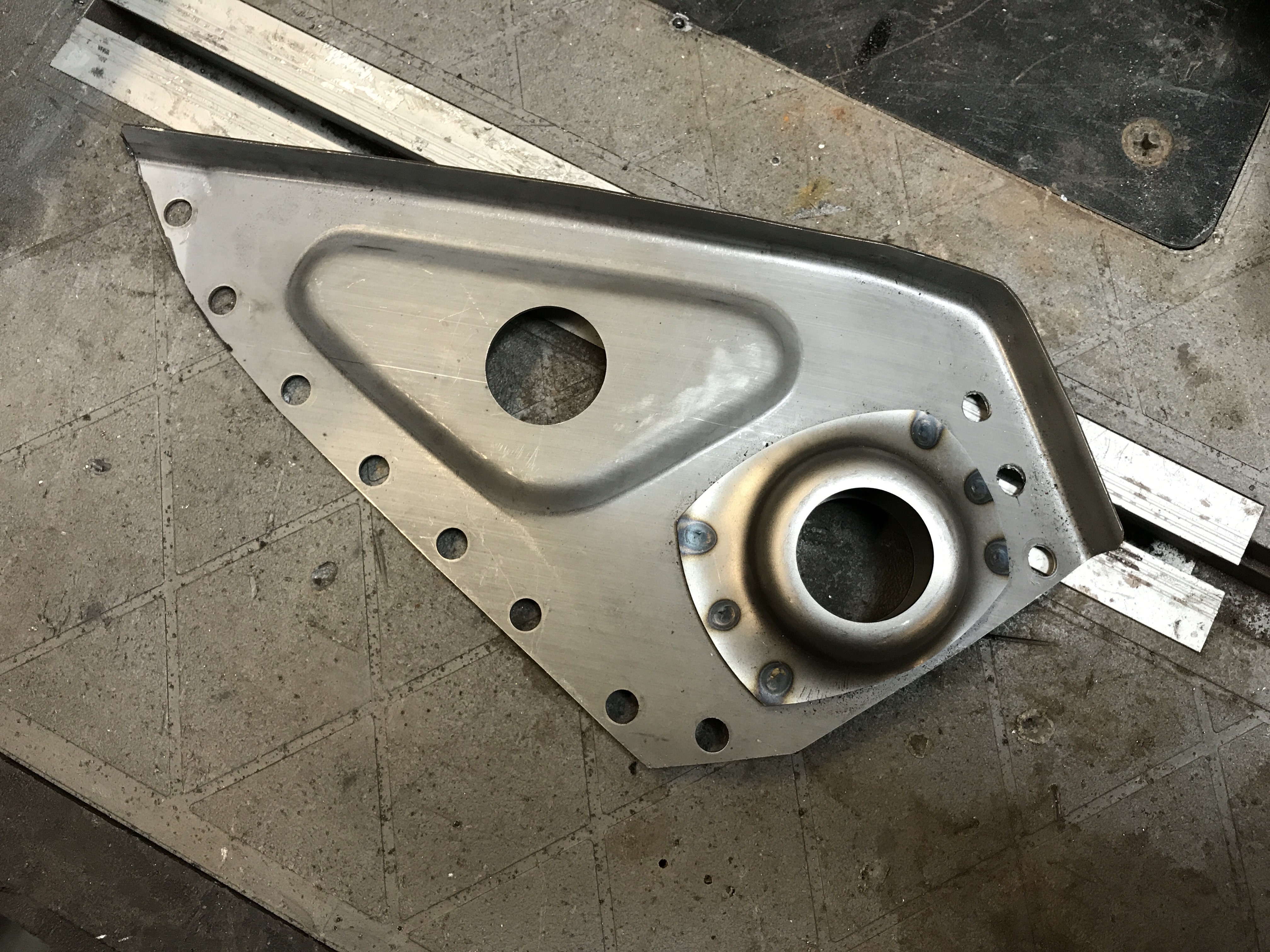

Last job on the floor: the rear corner gussets and jacking donuts. Here is on as it came from RD.
bkrantz
post Feb 17 2020, 09:30 PM
Post #260
Posts: 8,341
Joined: 3-August 19
From: SW Colorado
Member No.: 23,343
And after trimming to fit and punching holes.
