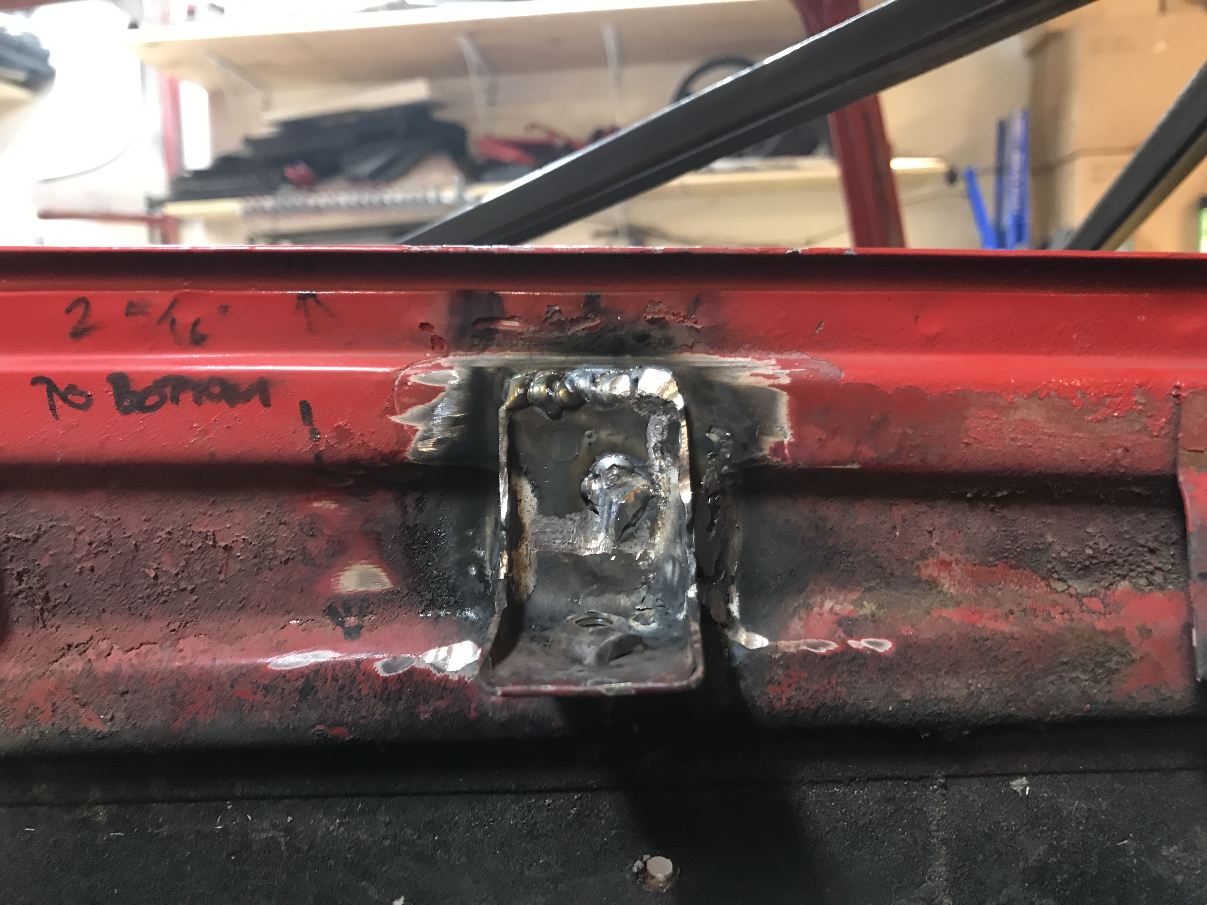

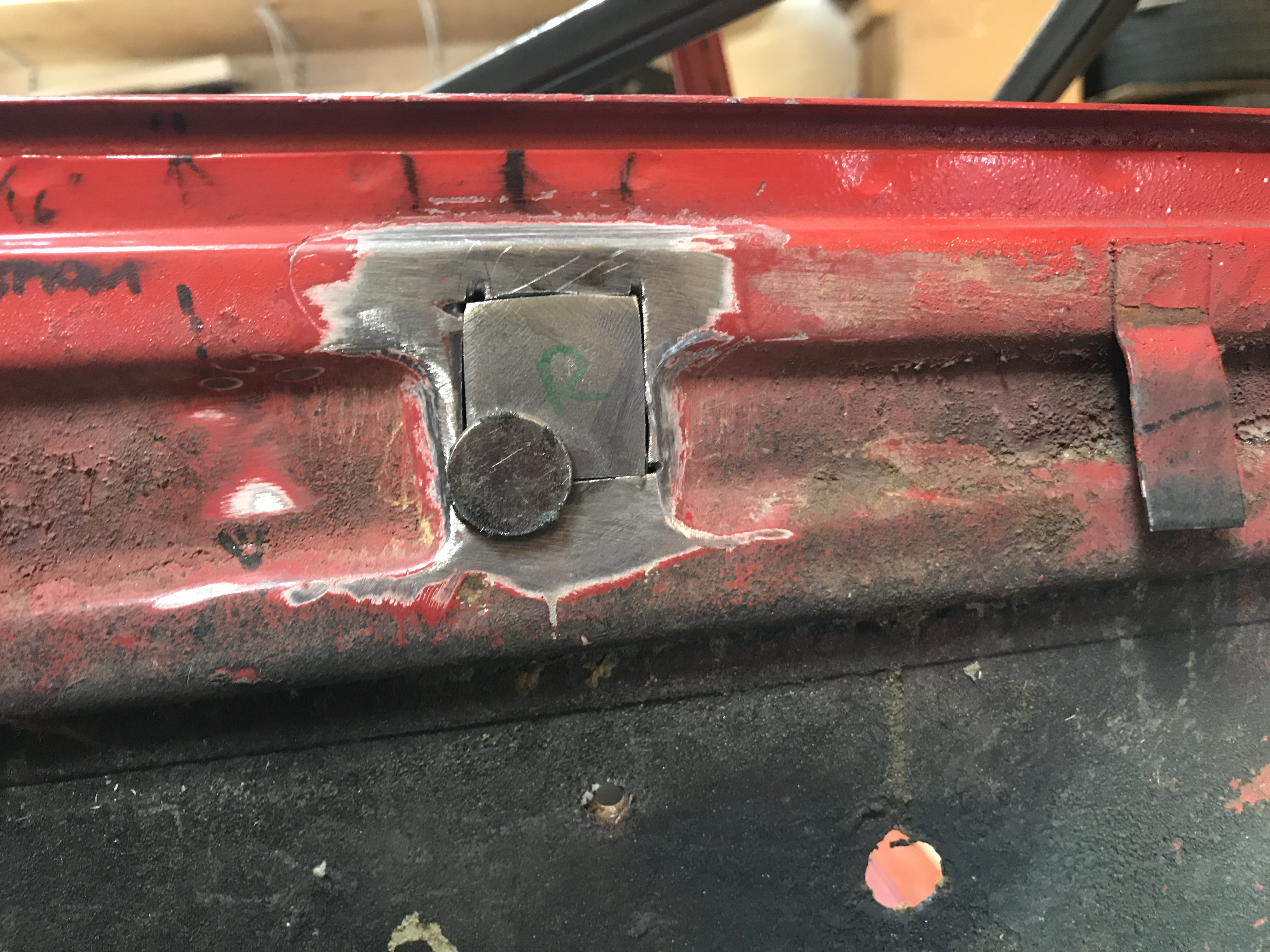

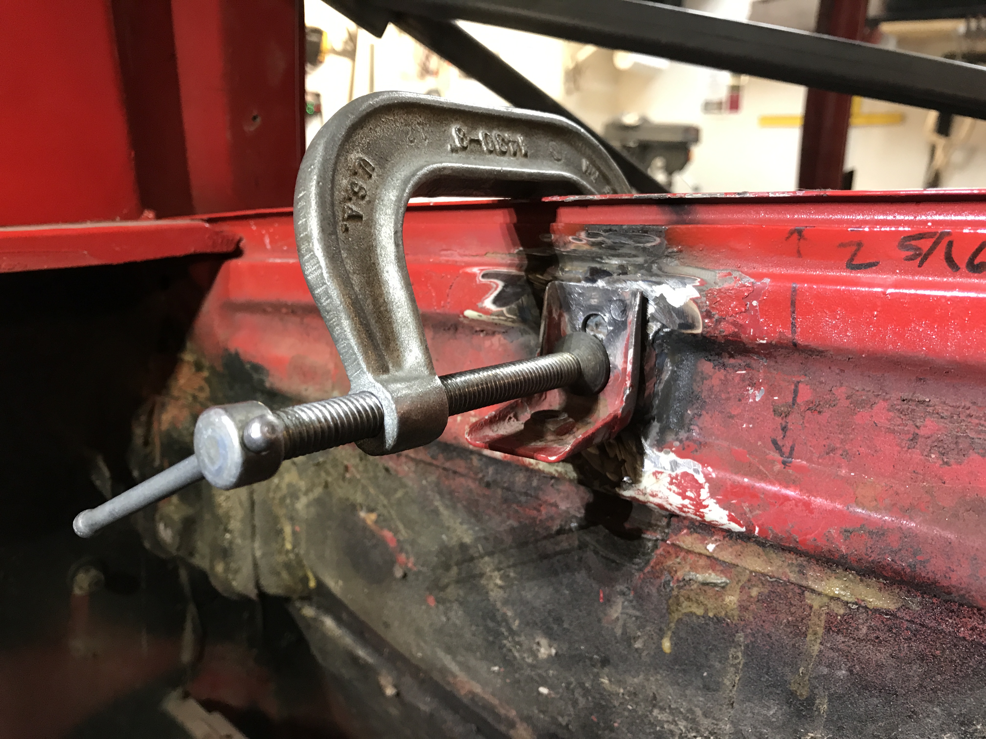

Left side bracket in position.
bkrantz
post Mar 14 2020, 08:12 PM
Post #343
Posts: 8,341
Joined: 3-August 19
From: SW Colorado
Member No.: 23,343

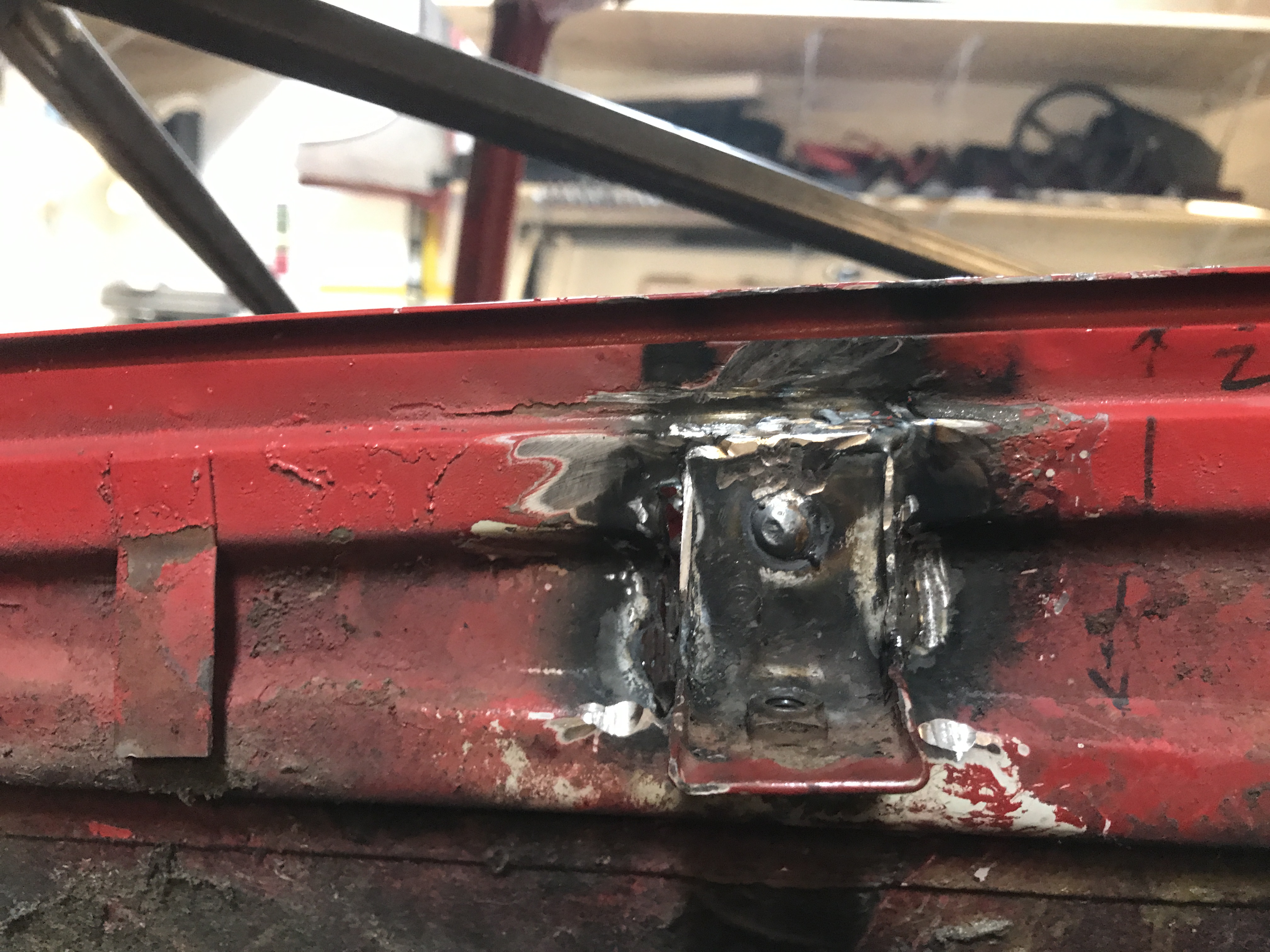

And welded.

And right side.

Yeah, those engine lid brackets need to be in the correct position. If too low, your engine lid will be too low and have a big gap on the leading edge. If too hight you could use some washers to space the lid down to the correct height.
Moral...better to be too high than too low.

I will find out before too much longer. Before any final body and paint work I plan to mount all the lids and doors to check alignment.

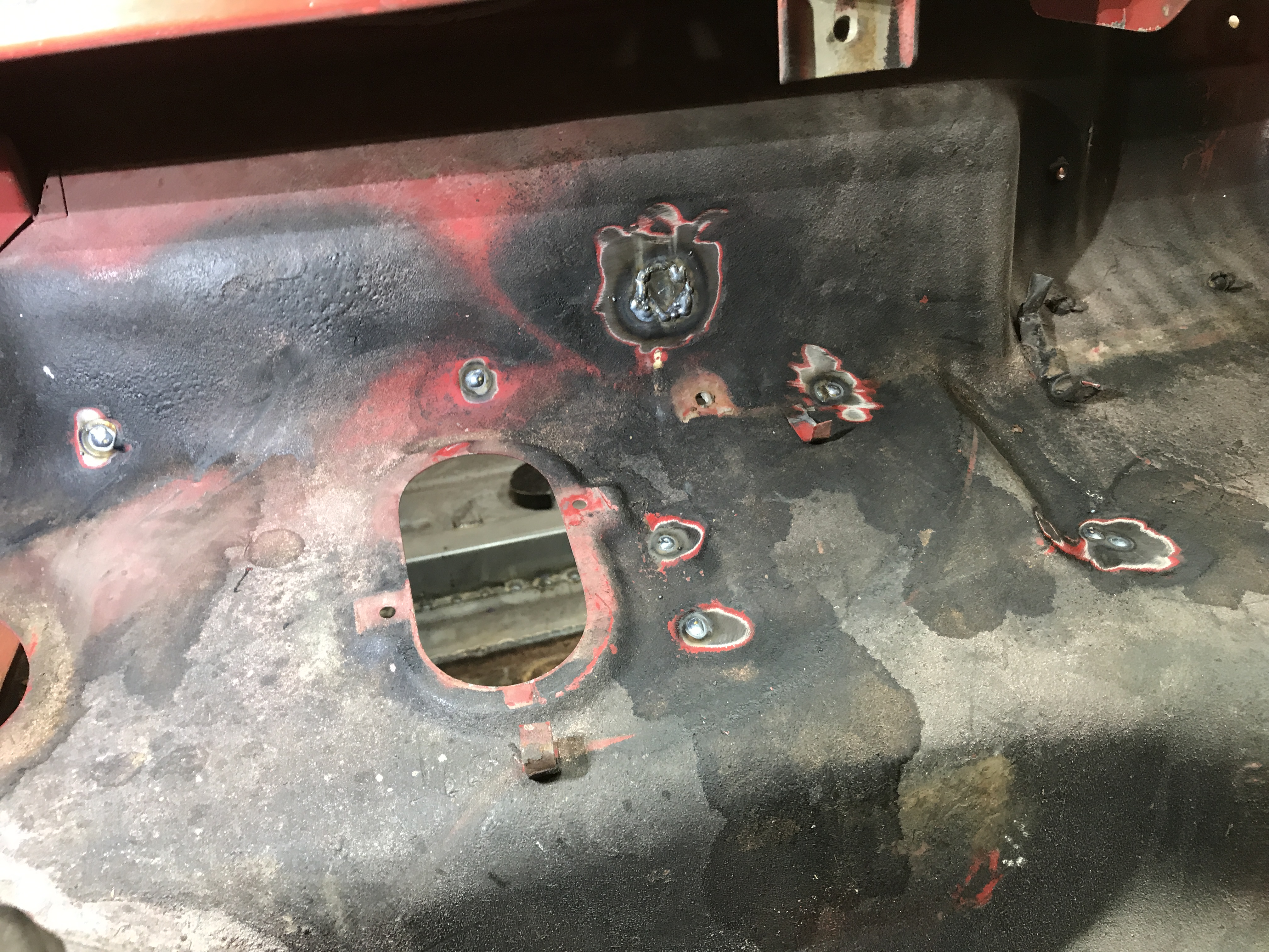

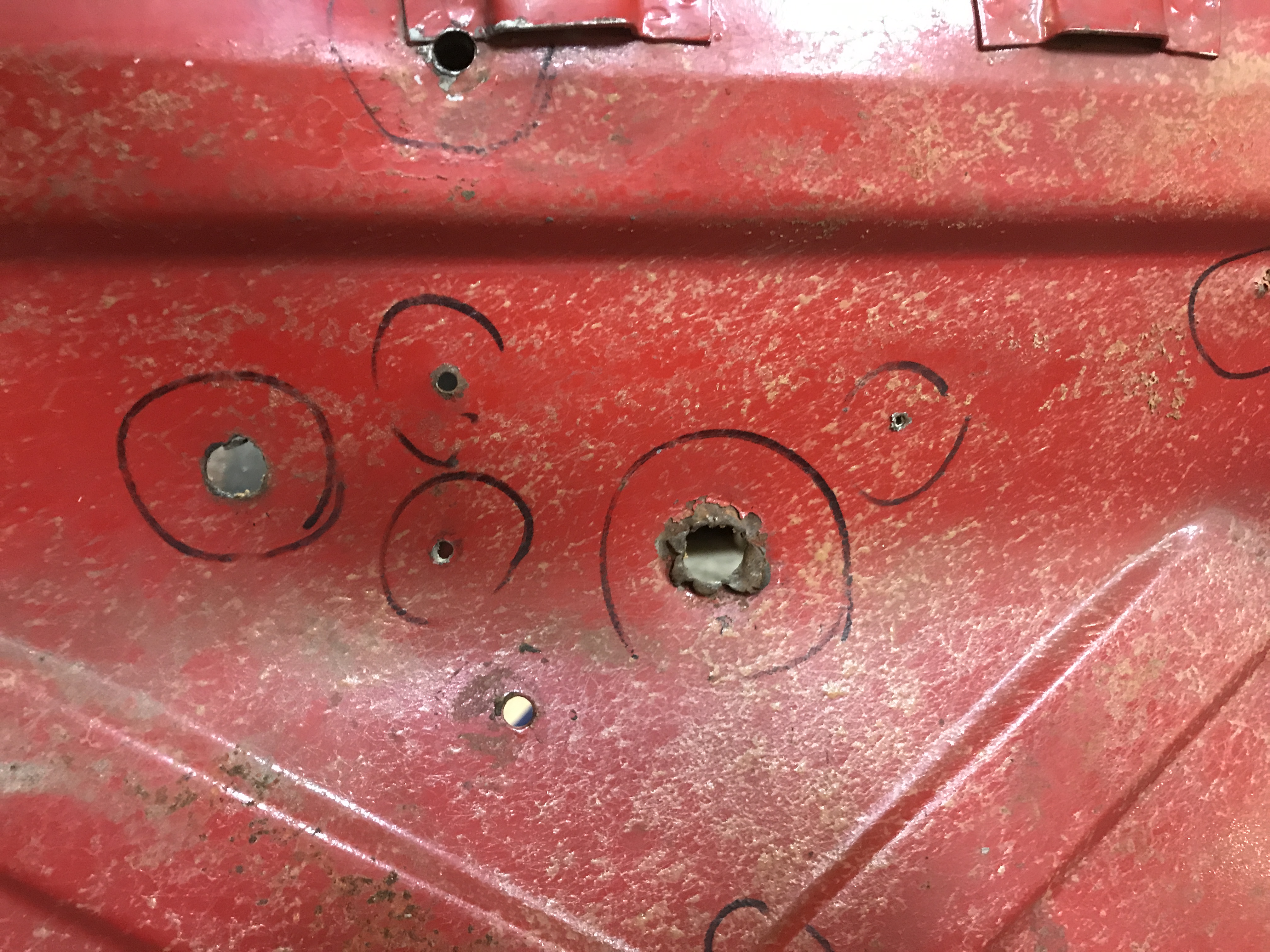

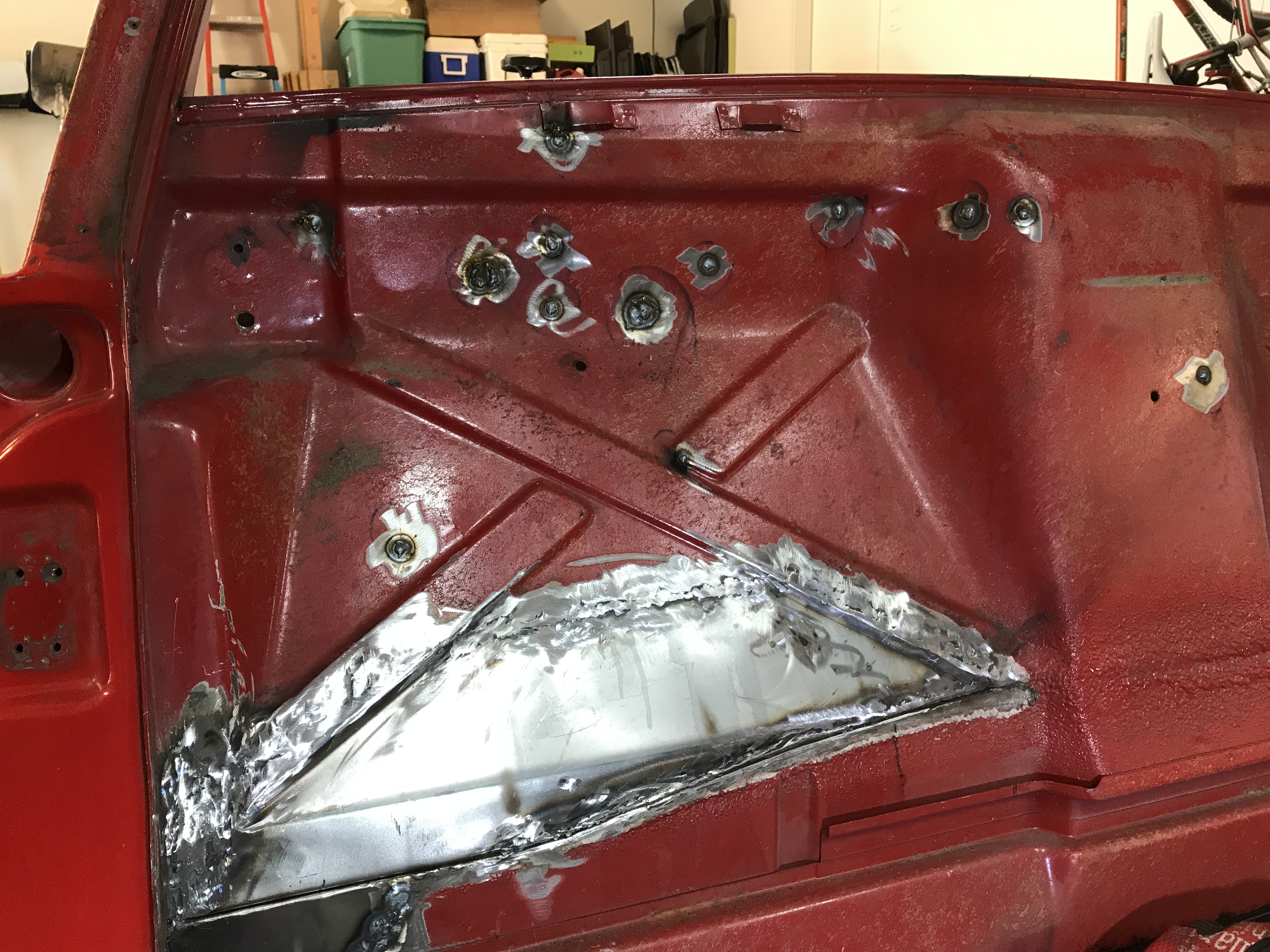

Last task in the engine compartment area is dealing with the festival of holes in the firewall, left by POs.

Here's my favorite. How and why did somebody do this?

After straightening the sheet metal at some holes, I got the grinder with the paint stripping disk busy.

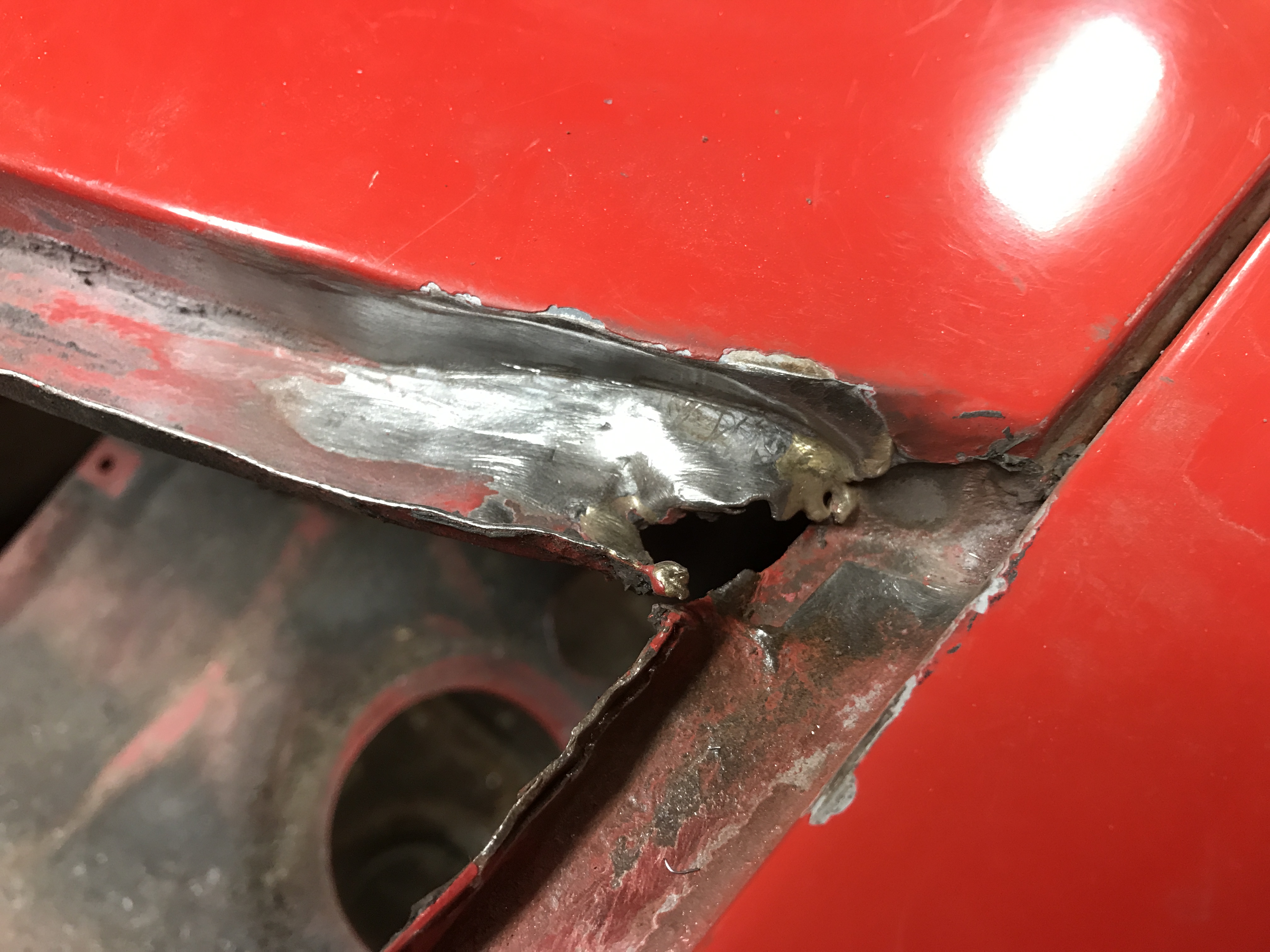

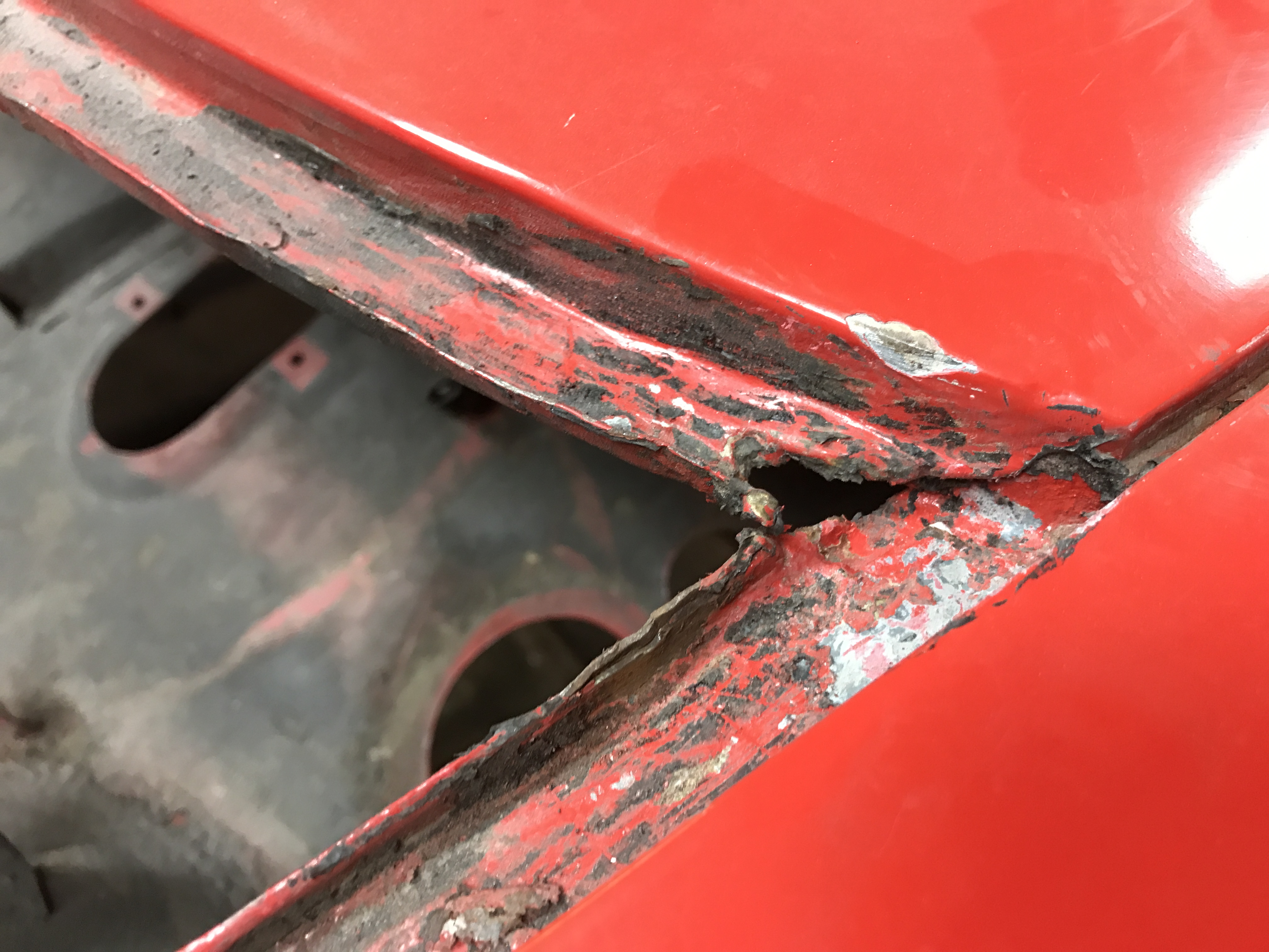

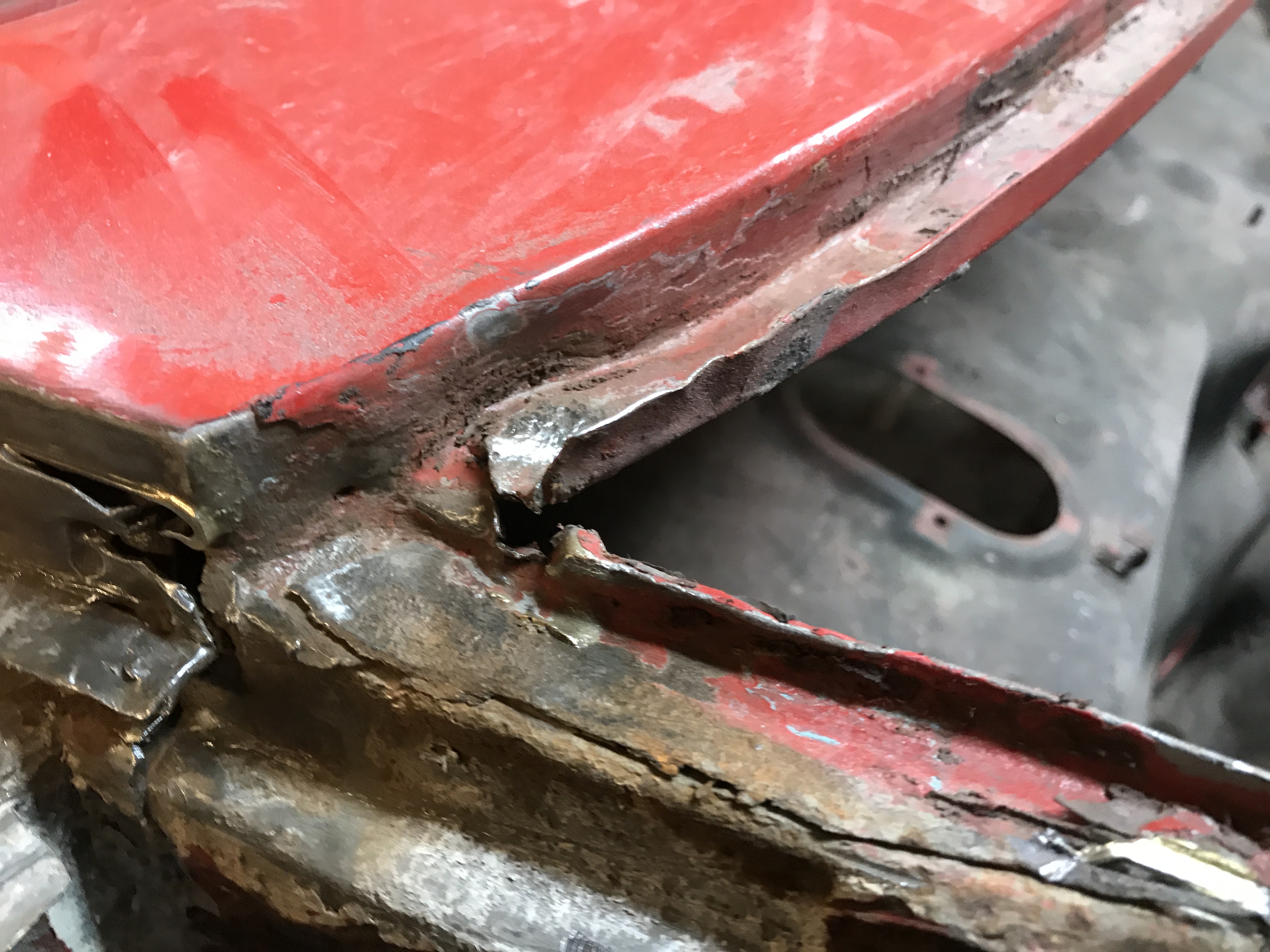

Looking ahead to the next job: repairing the sides of the cowl panel where it meets the tops of the front fenders. The front trunk lid opened too far, probably many times, and made contact with the cowl weatherstrip channel. This deformed the channel and tore the corner joint.
Here is the right side, where I have previously removed the fender.

And the left side.

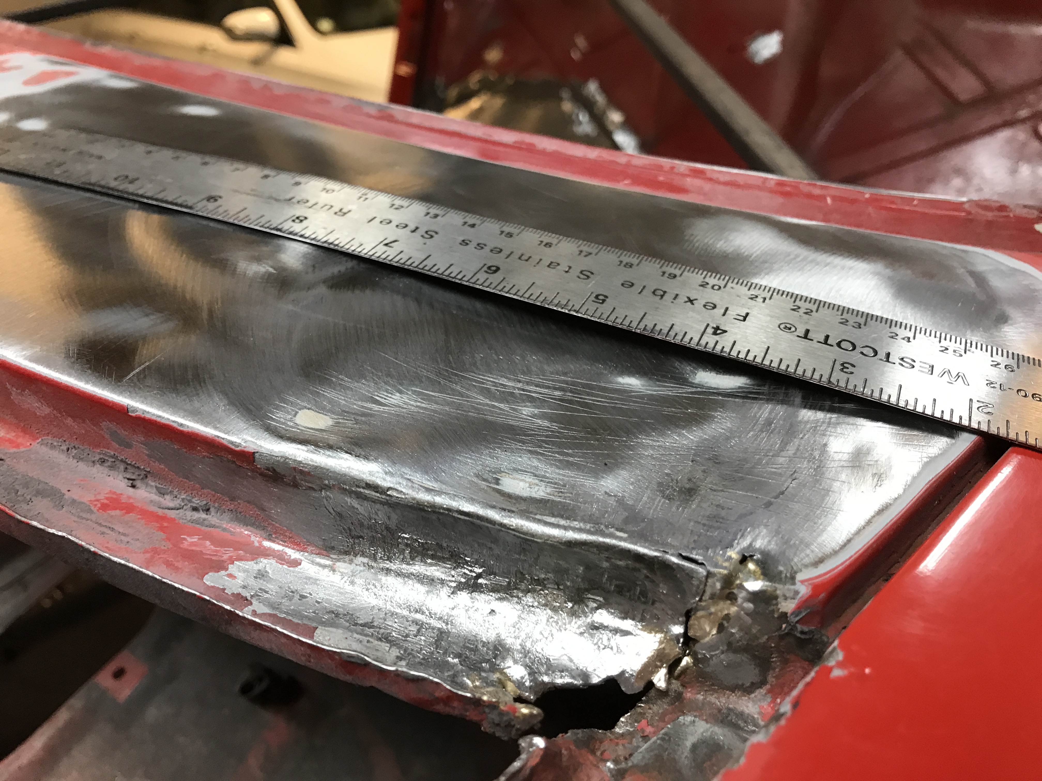

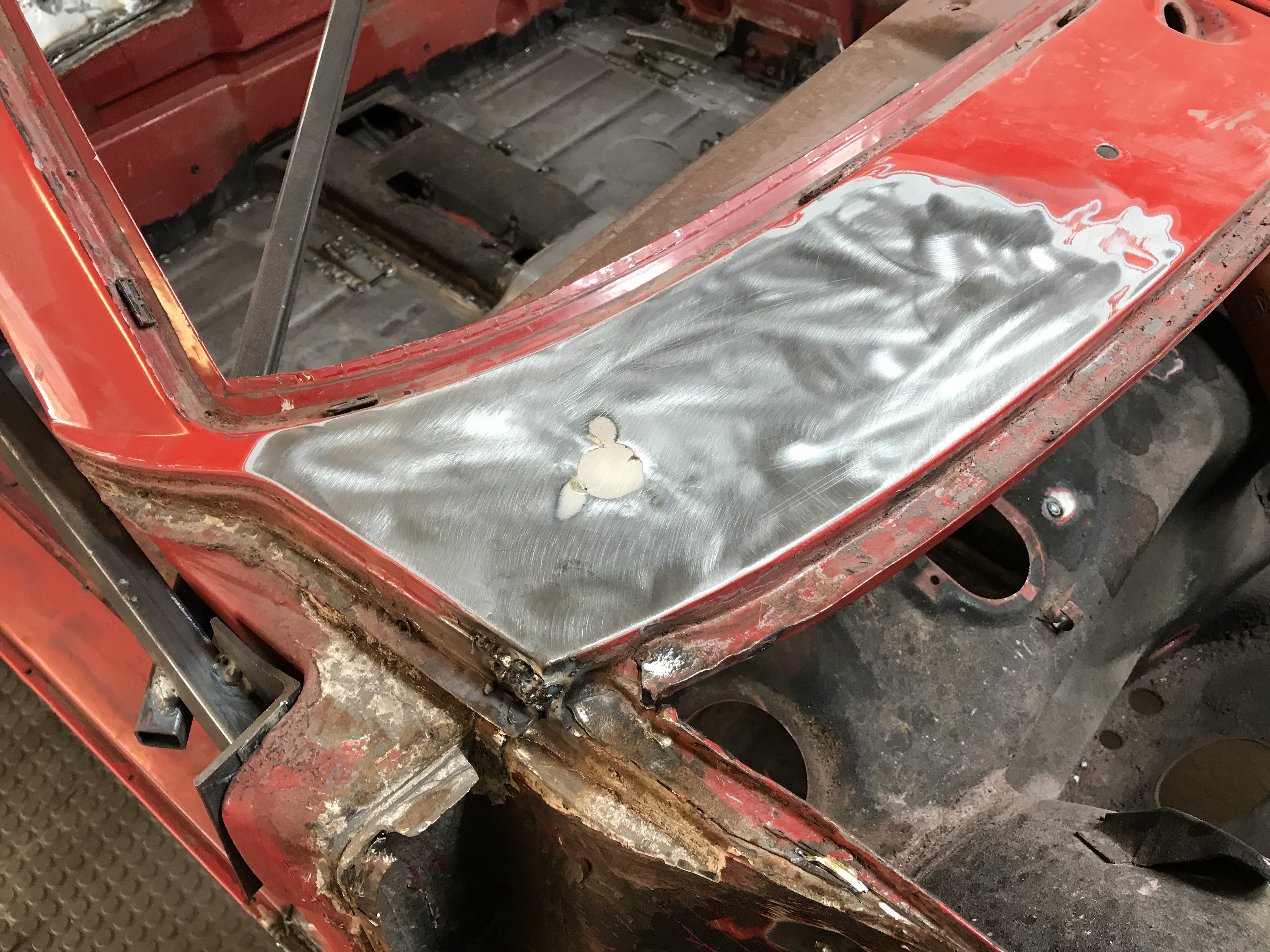

But the left side had a surprise! First, some bondo in the channel, hiding distortion of the channel side.
bkrantz
post Mar 15 2020, 08:32 PM
Post #353
Posts: 8,341
Joined: 3-August 19
From: SW Colorado
Member No.: 23,343
And then LOTS of bondo on the cowl top surface, hiding a big divot in the sheet metal. I can imagine the trunk lid flying up and whacking the cowl hard enough to bend it. But I can't imagine why somebody did not straighten it better, before slathering on 1/4 of bondo.

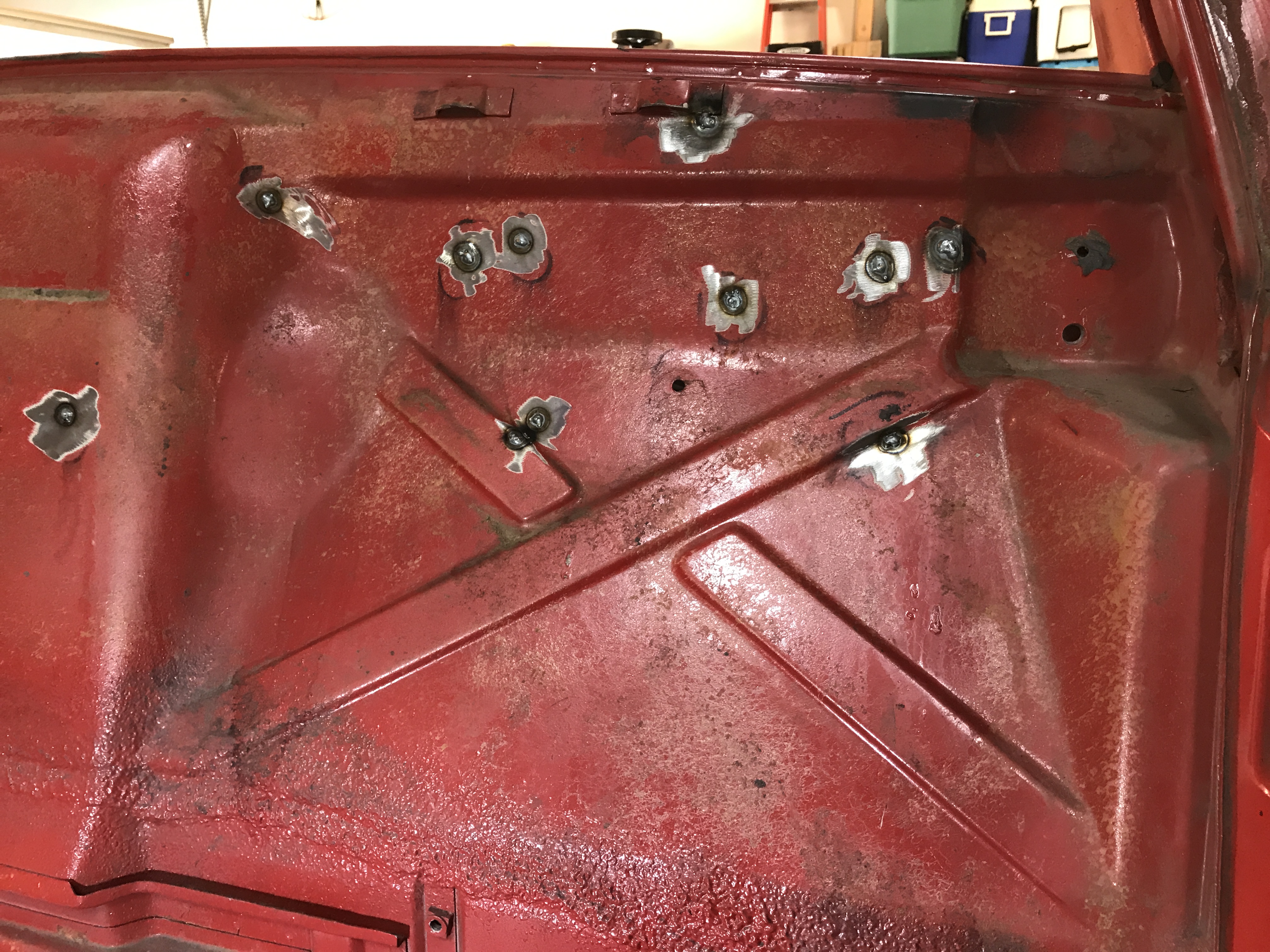

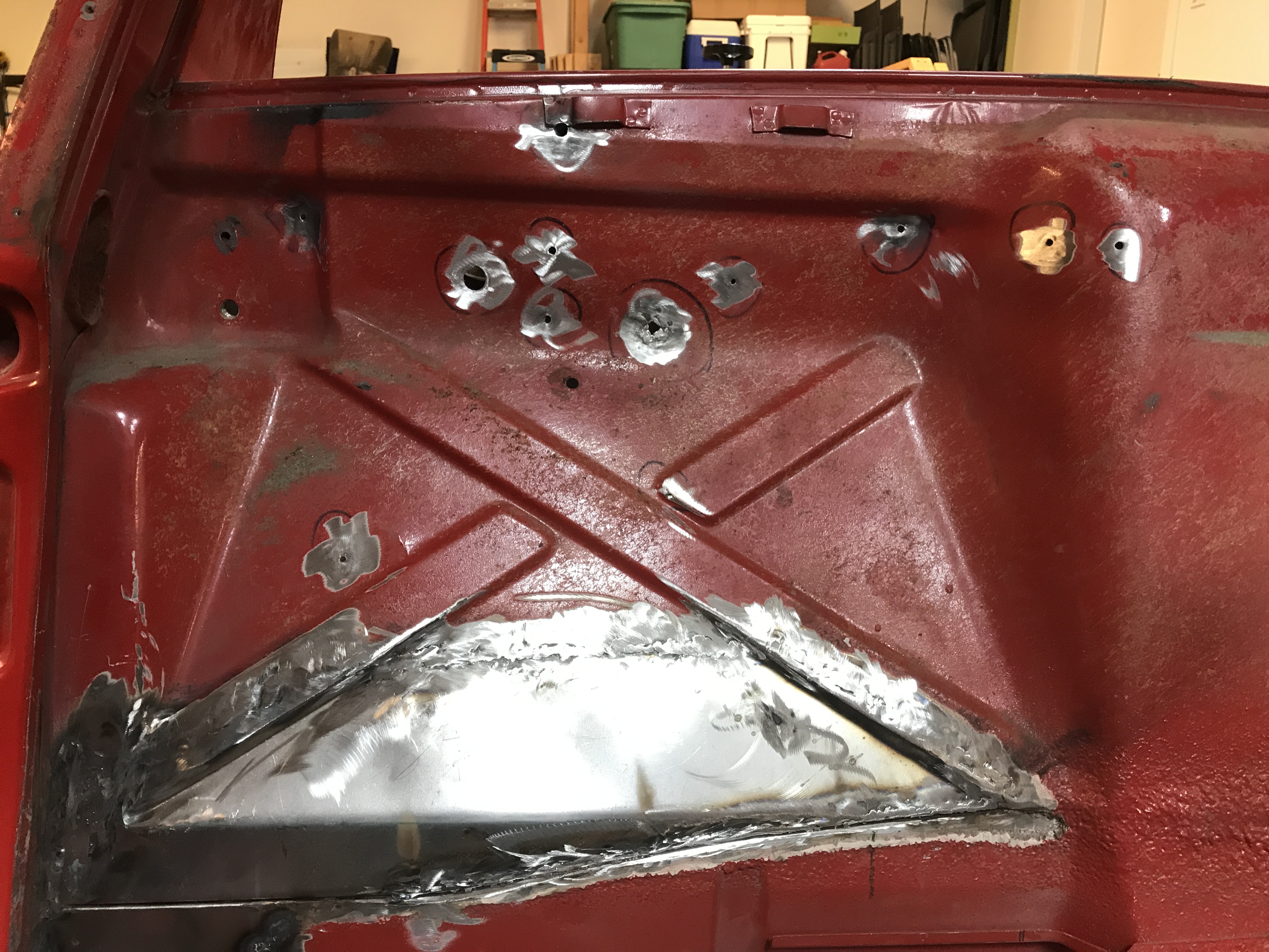

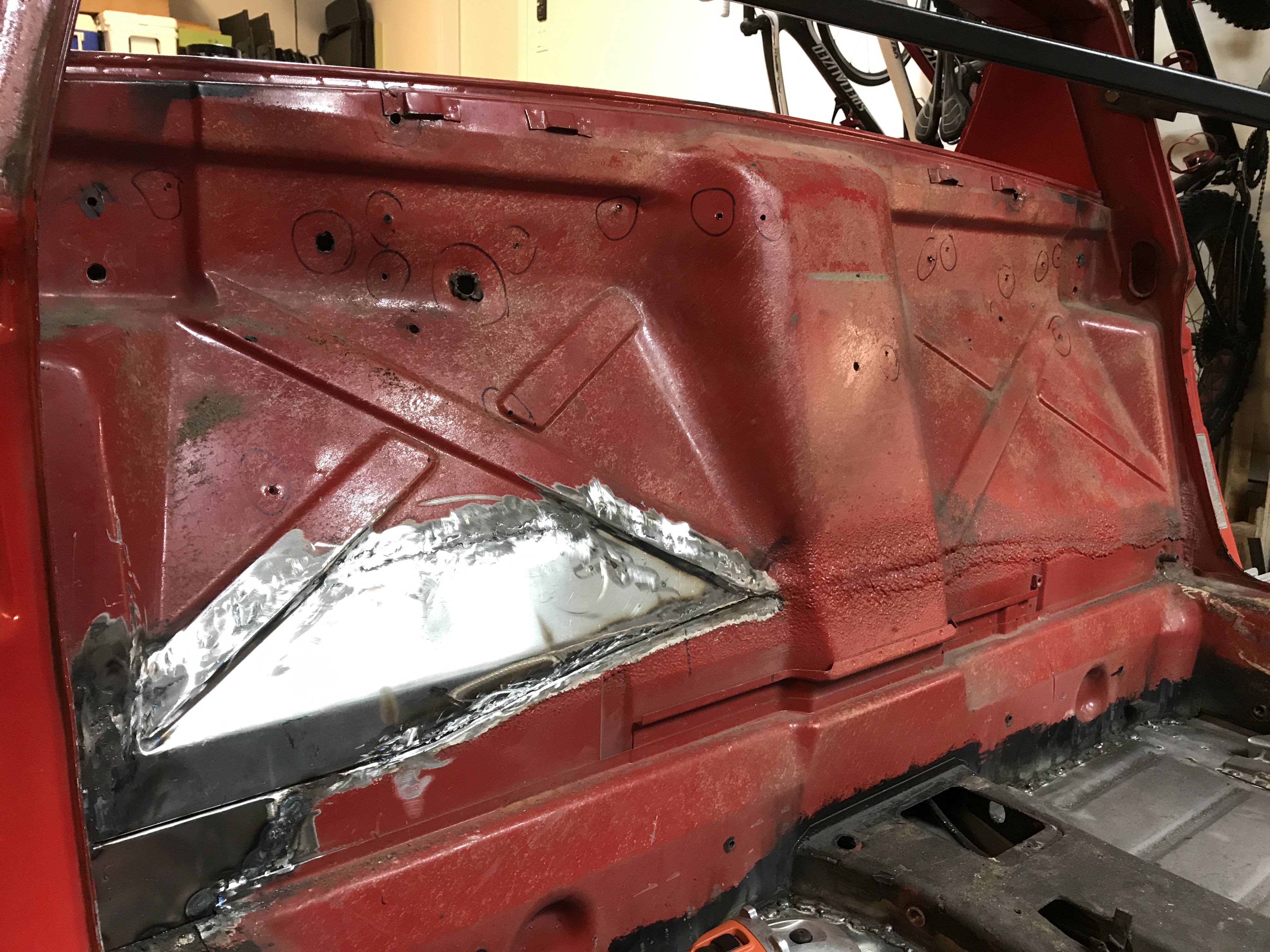

Festival of holes, part 2, is done. I patched and welded all the holes in the passenger side firewall...
bkrantz
post Mar 16 2020, 09:04 PM
Post #355
Posts: 8,341
Joined: 3-August 19
From: SW Colorado
Member No.: 23,343
...driver side firewall...
bkrantz
post Mar 16 2020, 09:05 PM
Post #356
Posts: 8,341
Joined: 3-August 19
From: SW Colorado
Member No.: 23,343
...and dash under-panel. Plus the front right inner fender wall.

Speaking of grinding, at least bondo grinding, I decided to check out the right side of the cowl. Sure enough, about 1/8 inch of bondo. And then another surprise (but not completely).
