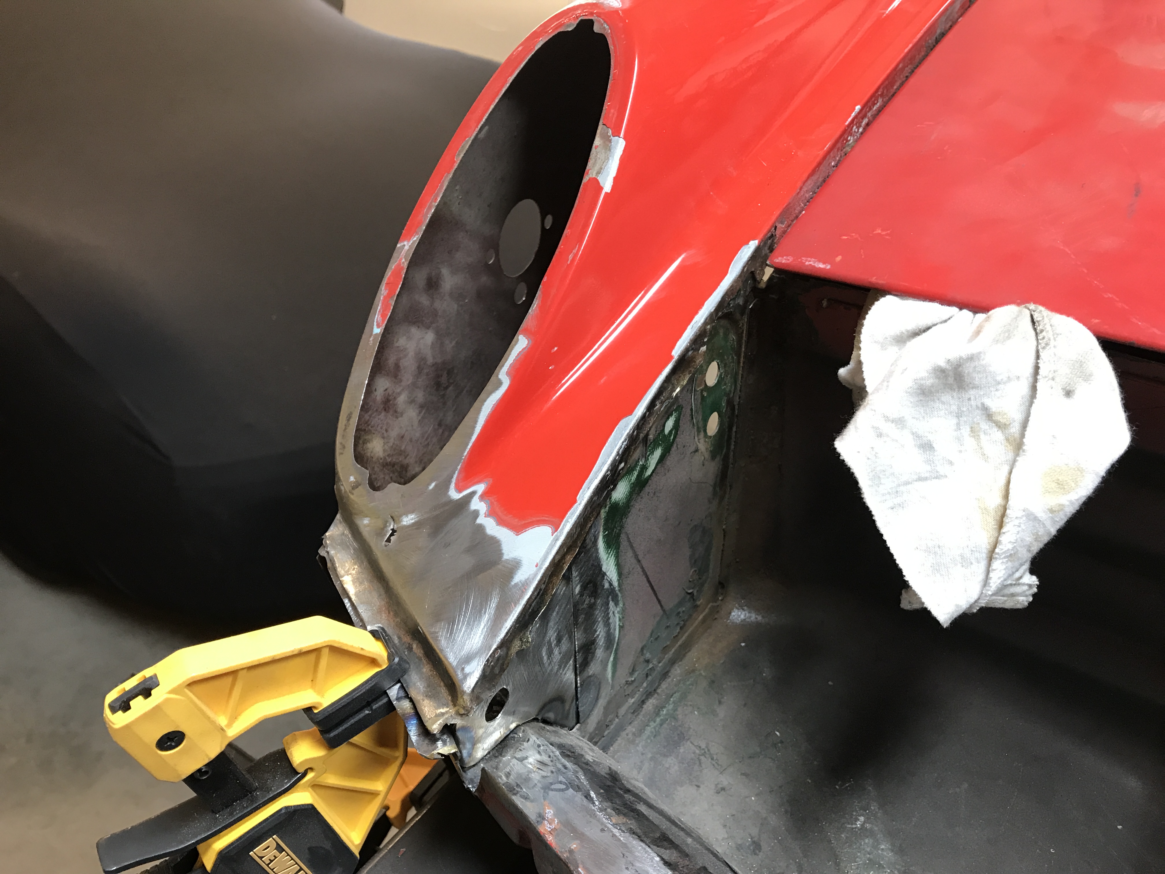

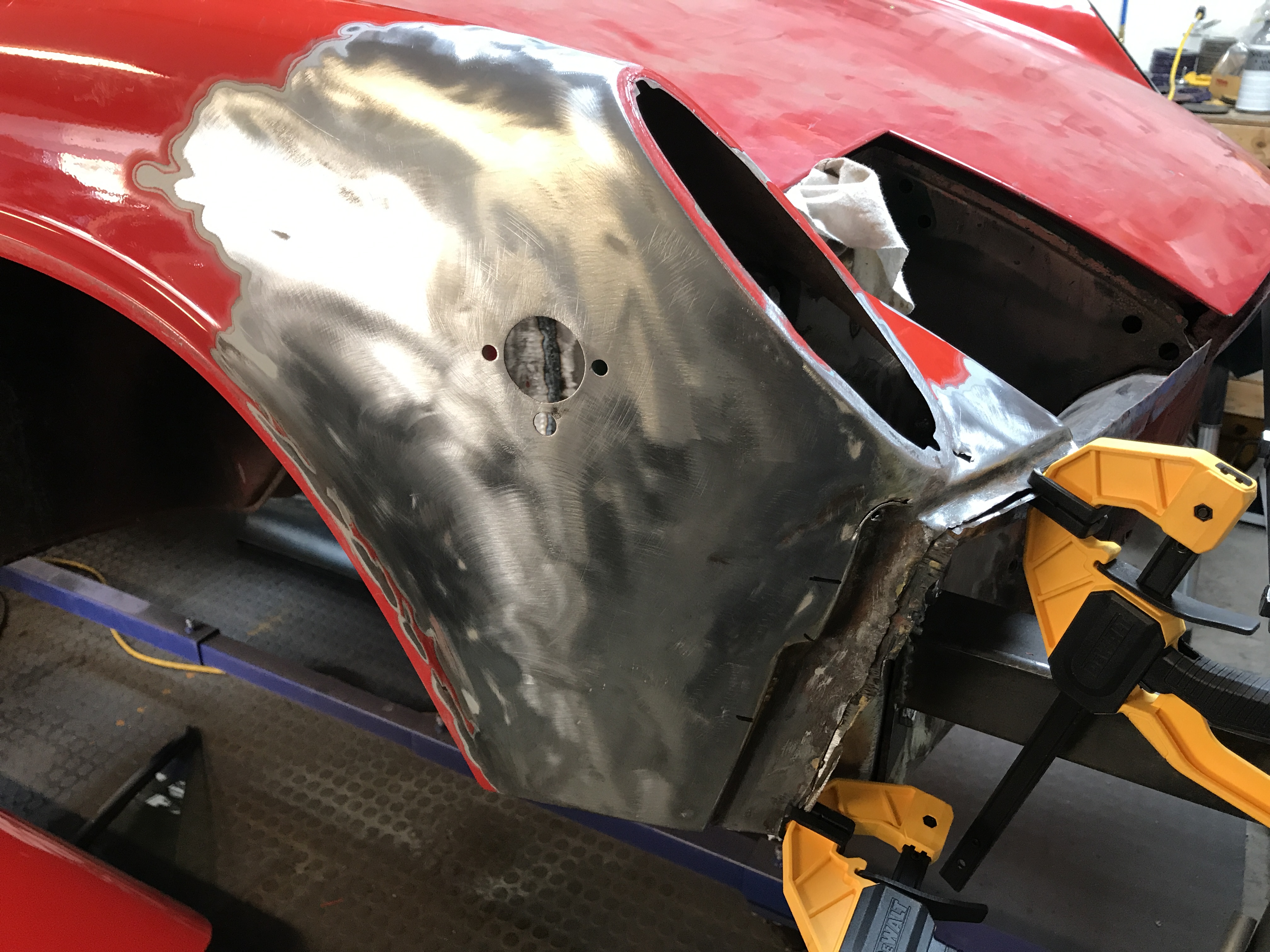

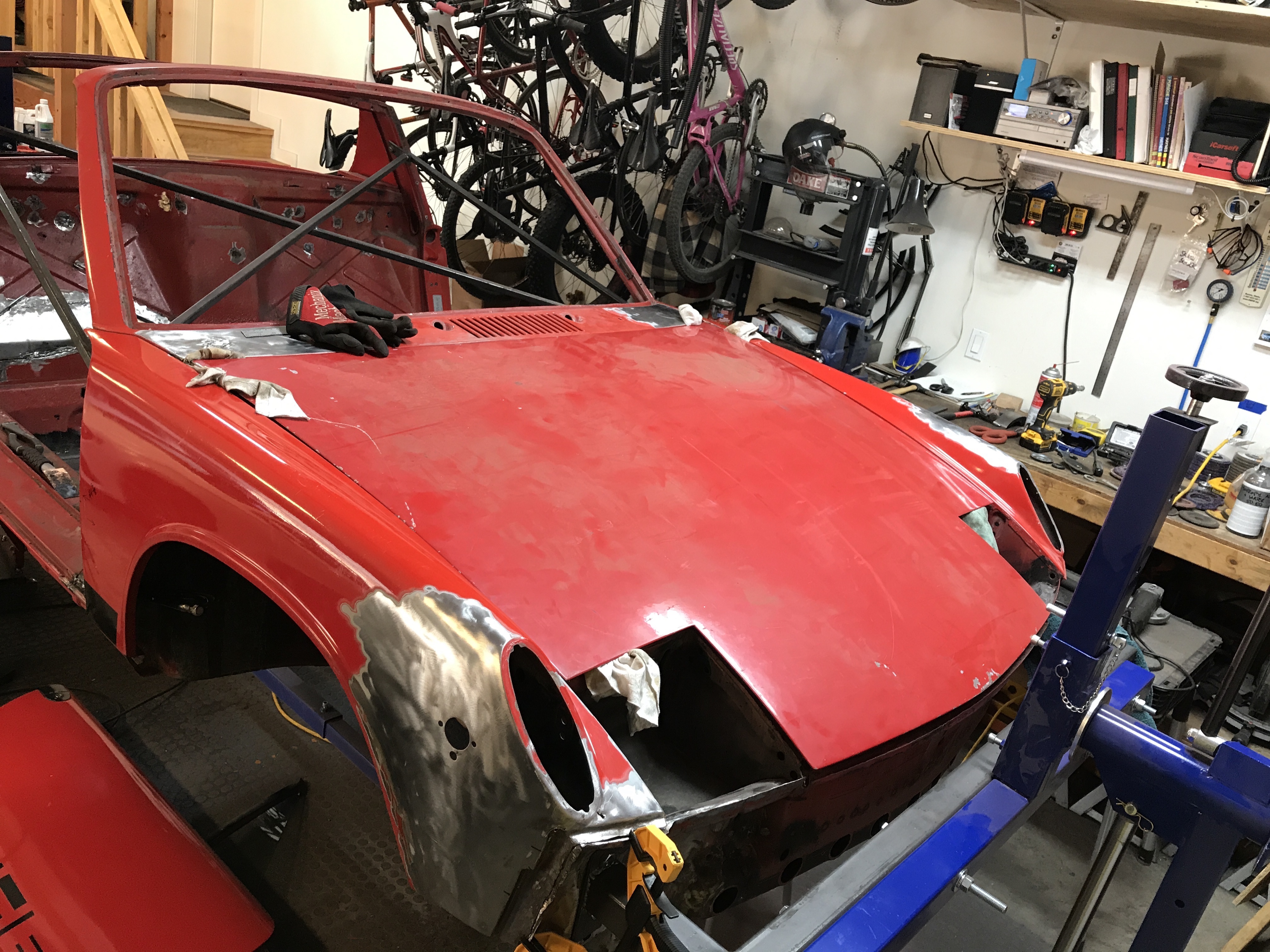

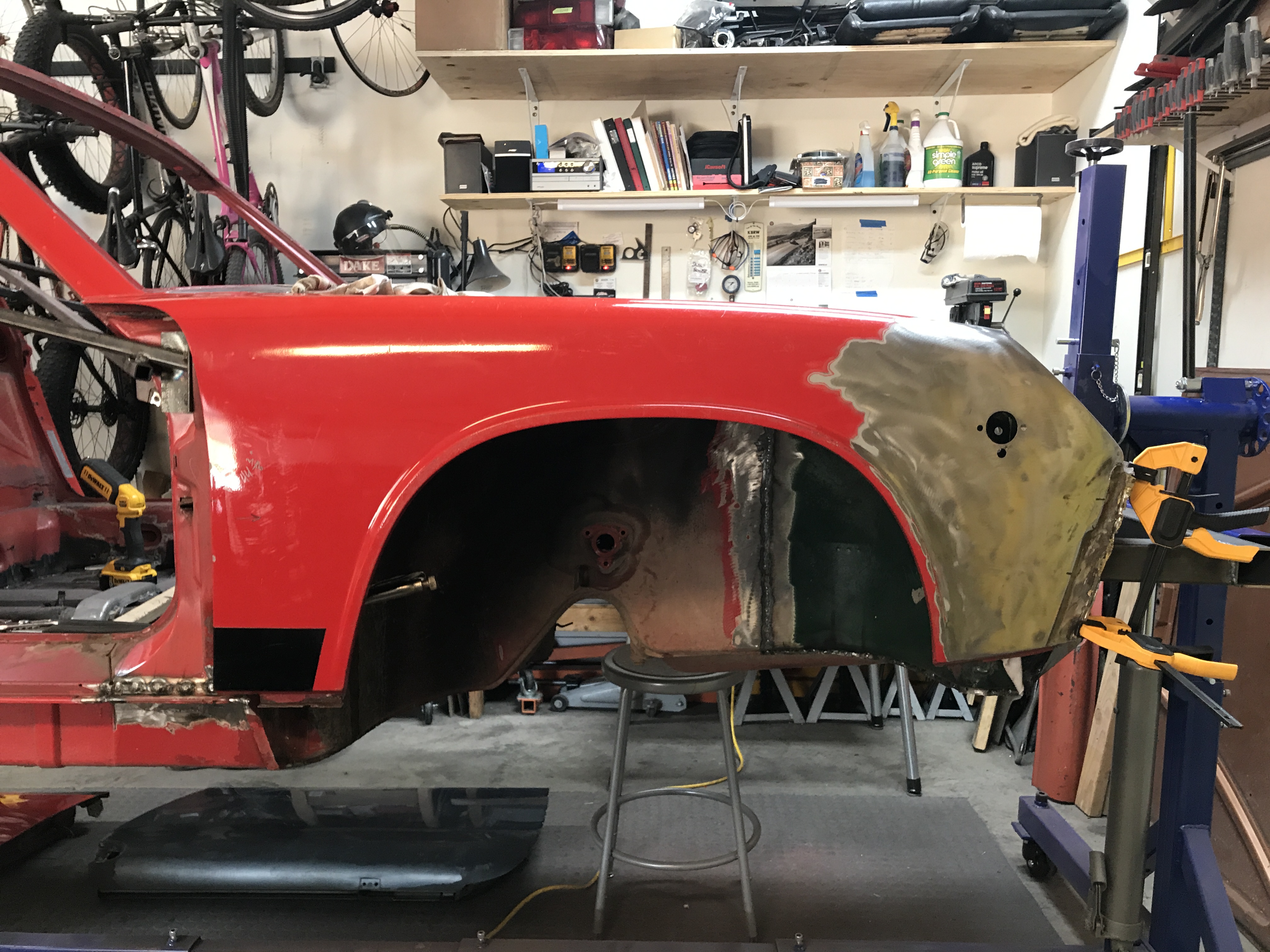

After more tweaks and bends, and cutting the top seam to fit, I clamped the fender in place. I then started measuring and comparing from right side to left side.
bkrantz
post Mar 26 2020, 07:35 PM
Post #405
Posts: 8,341
Joined: 3-August 19
From: SW Colorado
Member No.: 23,343
I also propped the frunk lid in place, a good reference since this piece (not from this car) is almost certainly straight.
bkrantz
post Mar 26 2020, 07:37 PM
Post #406
Posts: 8,341
Joined: 3-August 19
From: SW Colorado
Member No.: 23,343

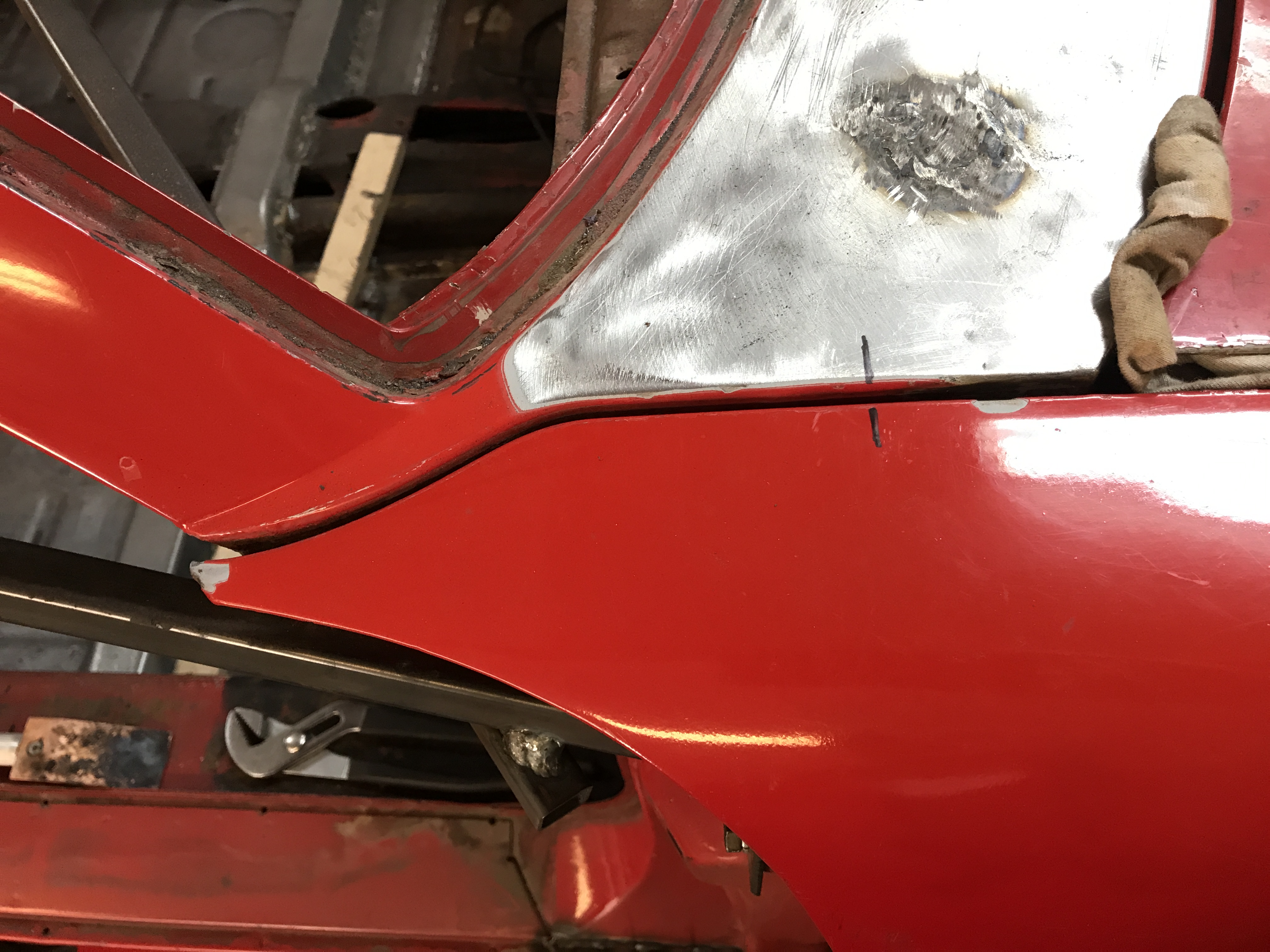

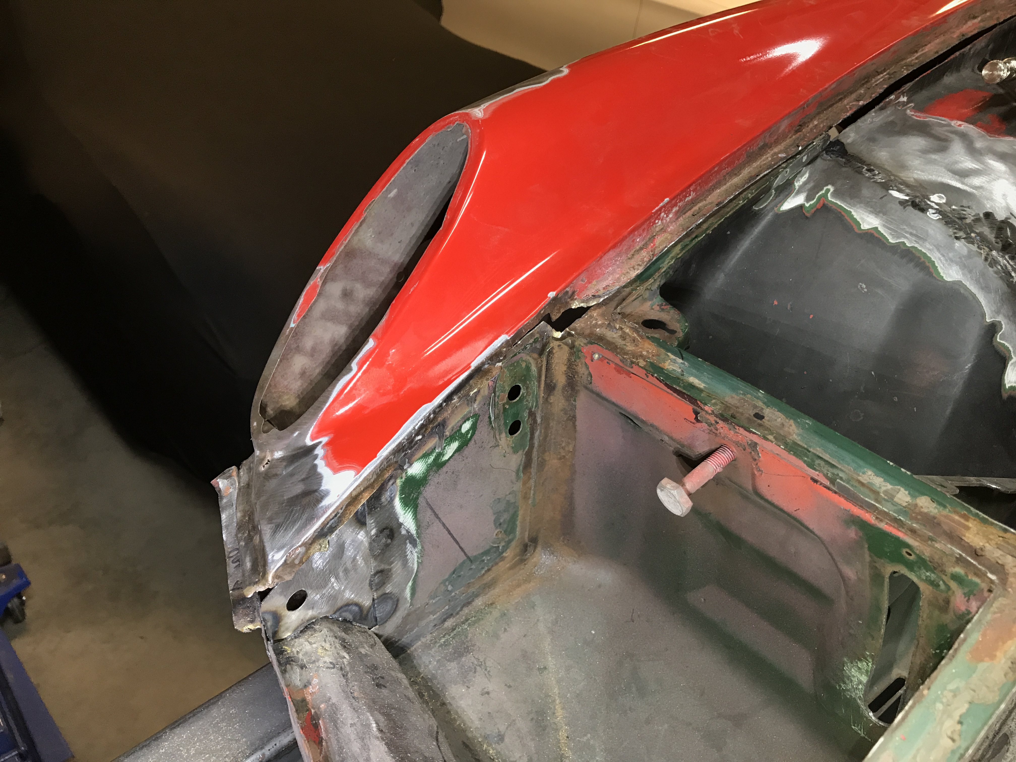

Fit by the cowl (the fender is just a bit low and too far out).
bkrantz
post Mar 26 2020, 07:39 PM
Post #407
Posts: 8,341
Joined: 3-August 19
From: SW Colorado
Member No.: 23,343

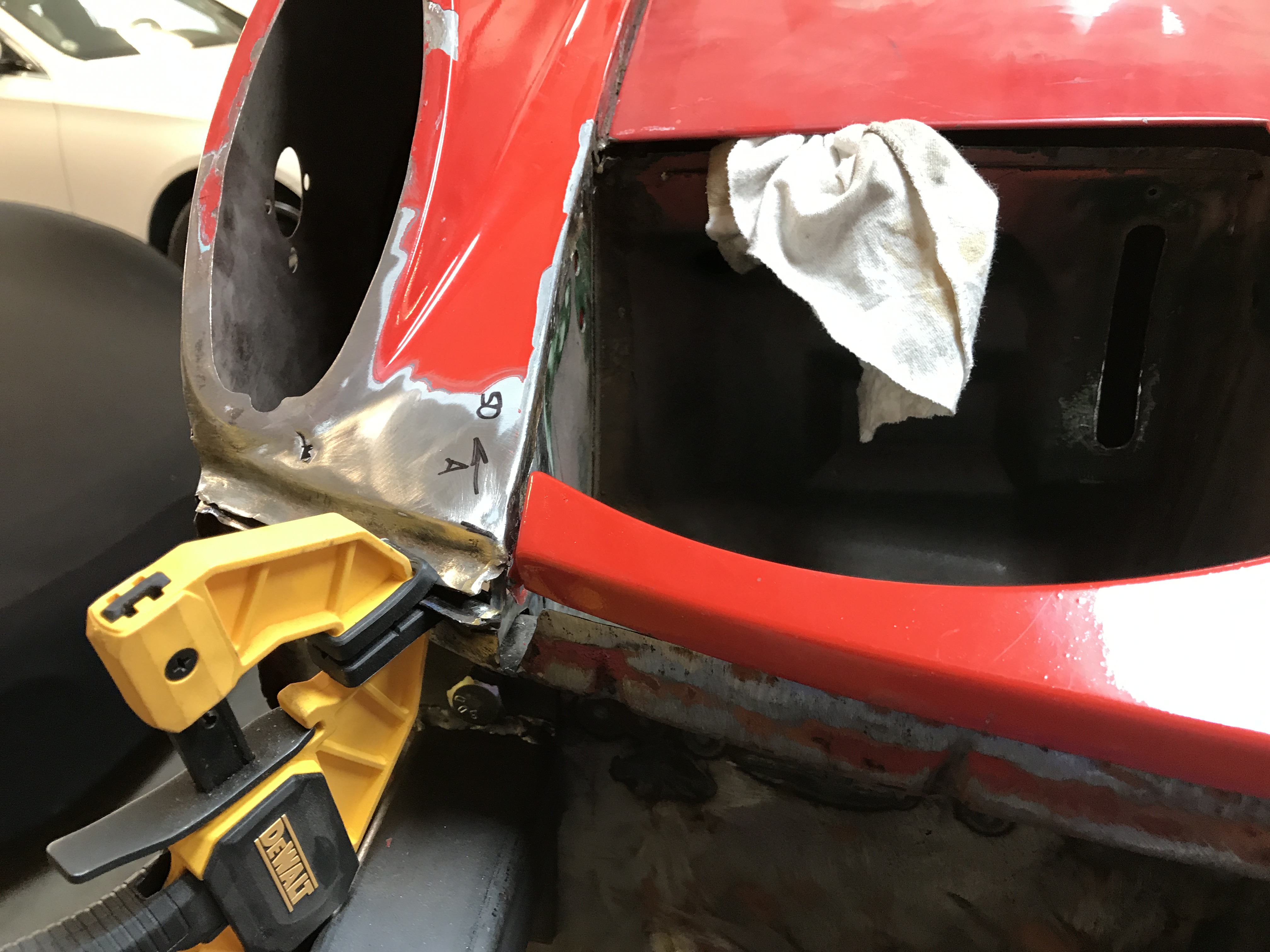

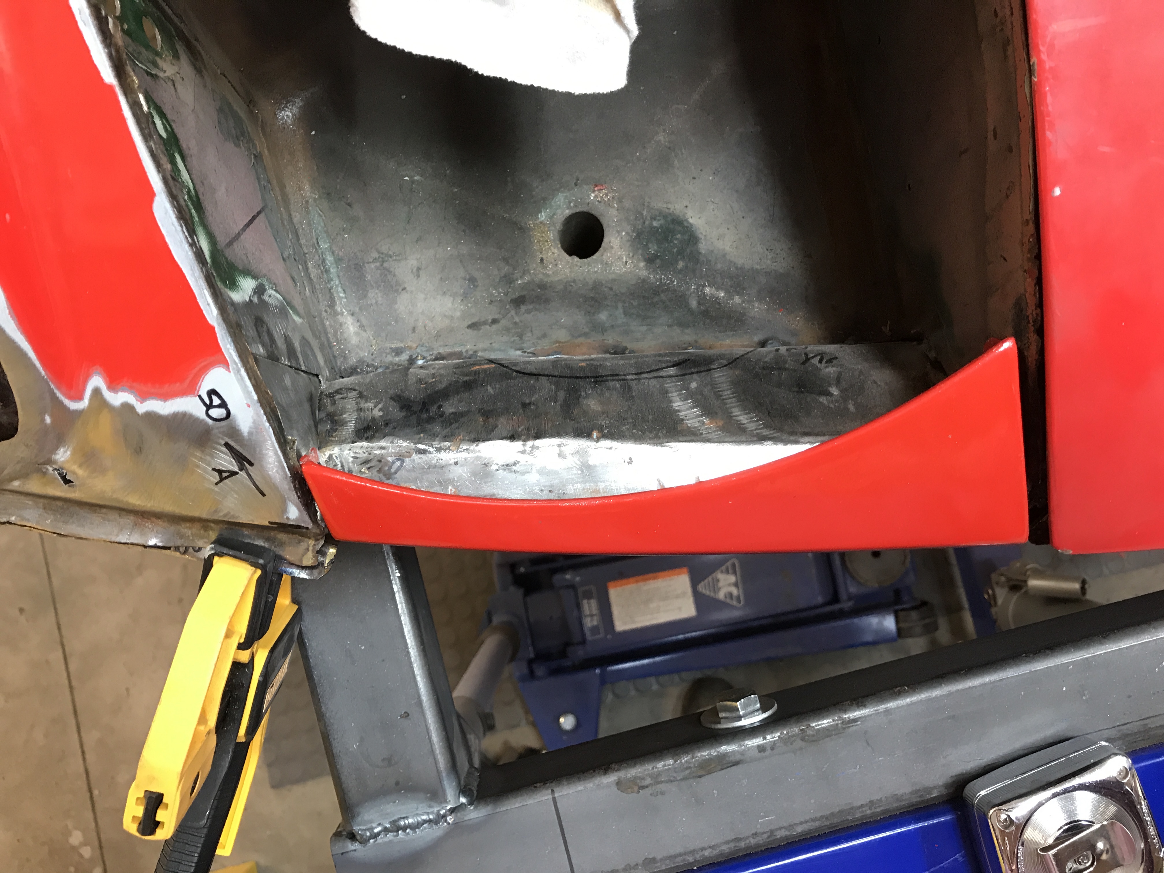

The front corner. The front panel still needs to shift inward, confirmed by measured lengths and angles.
bkrantz
post Mar 26 2020, 07:41 PM
Post #408
Posts: 8,341
Joined: 3-August 19
From: SW Colorado
Member No.: 23,343

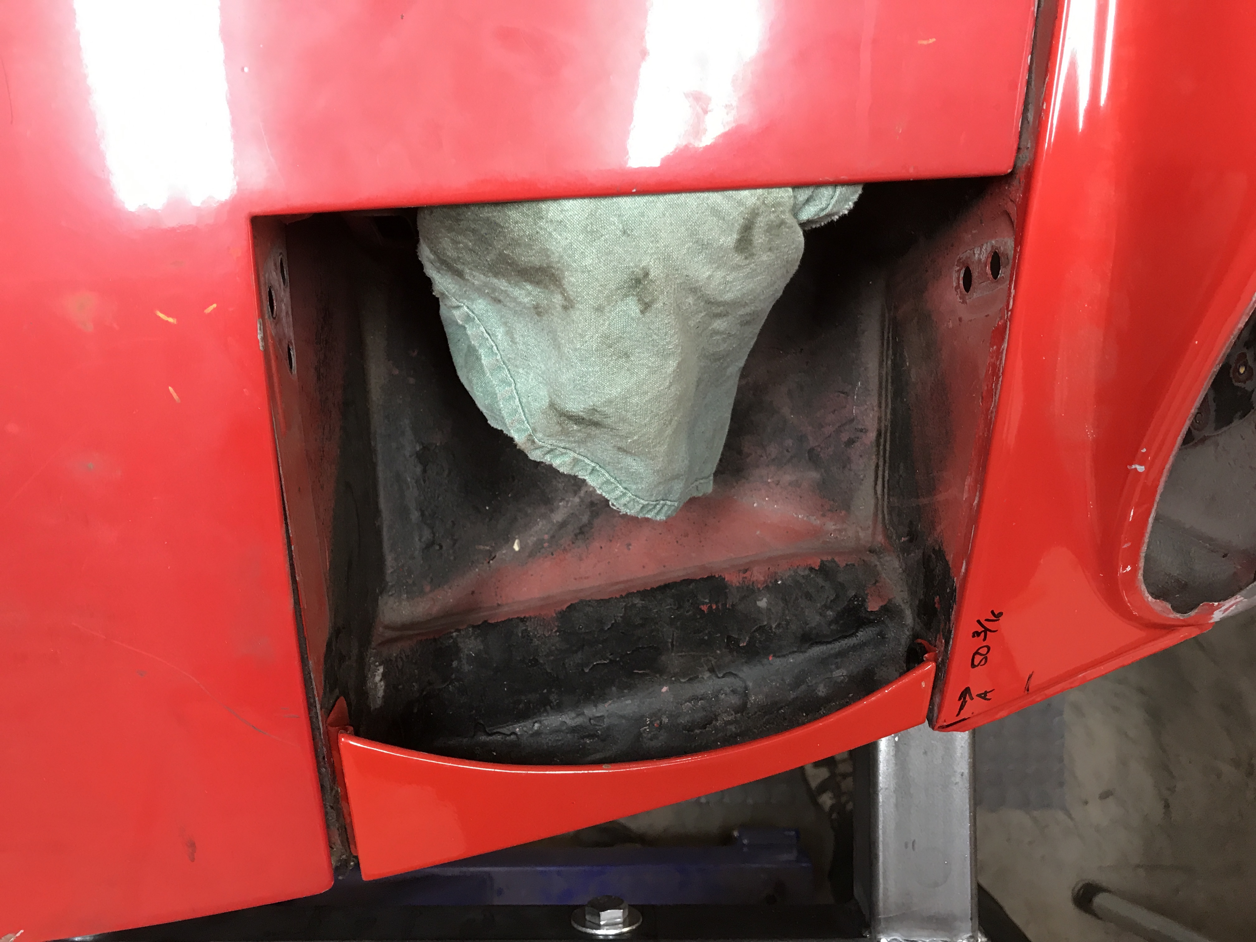

Along the headlight box, nearly there.

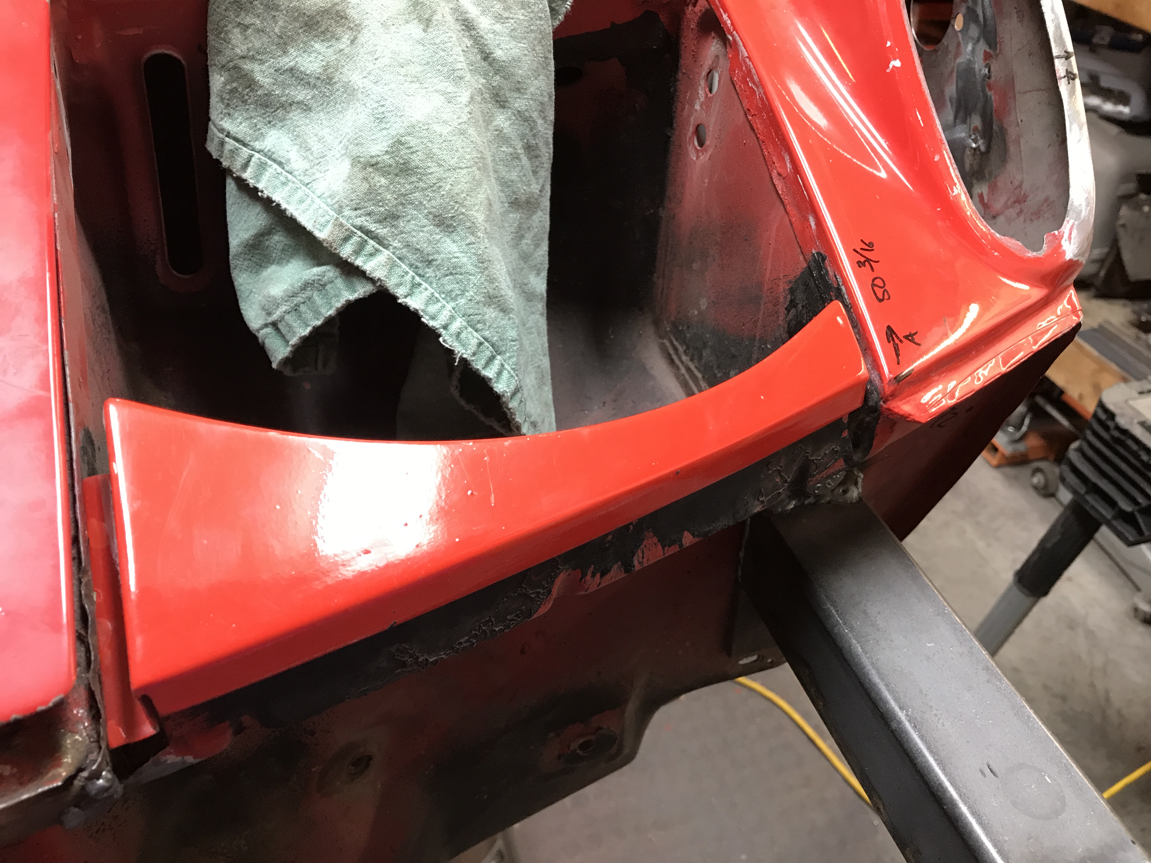

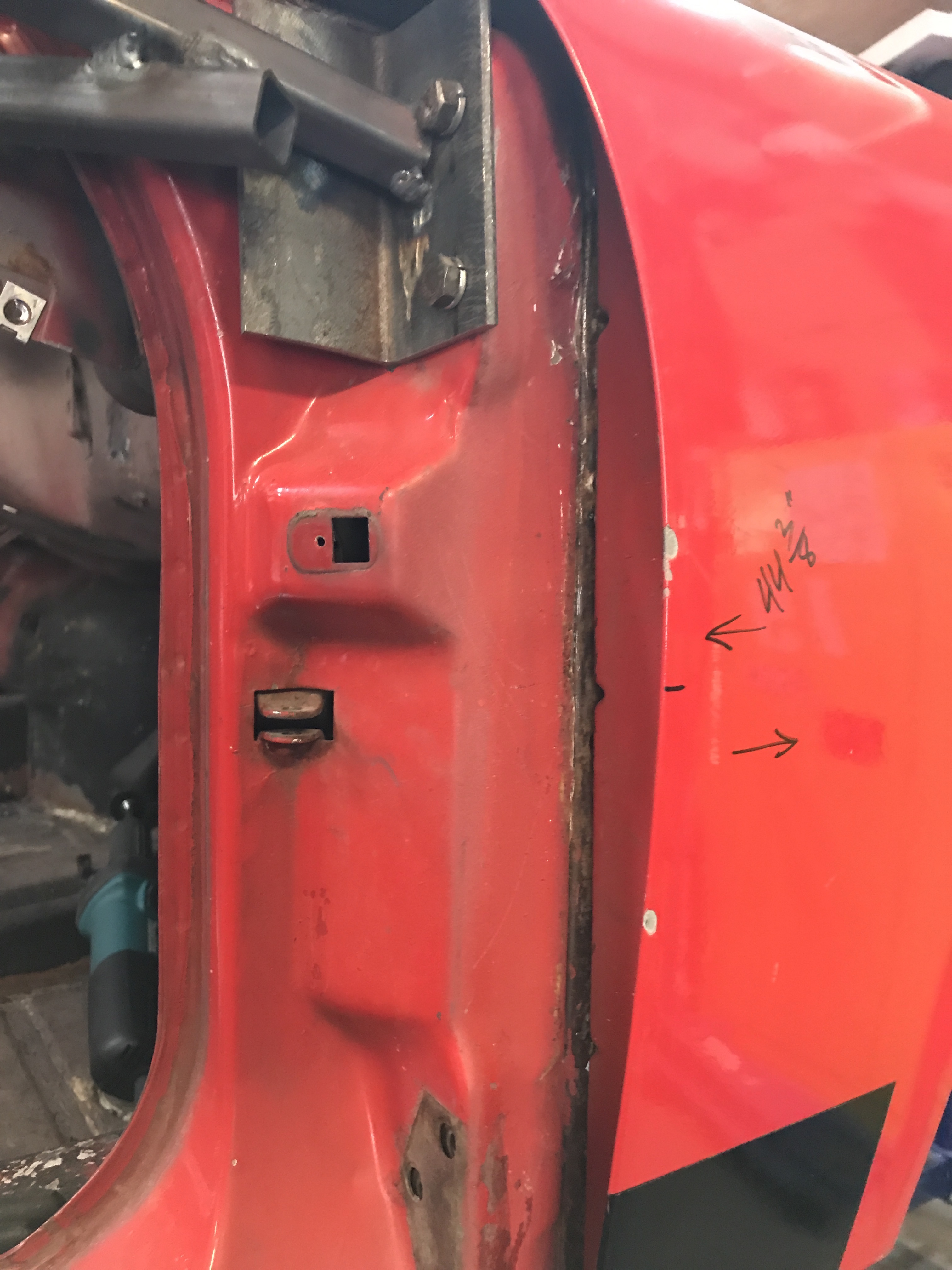

A-pillar inside.
bkrantz
post Mar 26 2020, 07:46 PM
Post #410
Posts: 8,341
Joined: 3-August 19
From: SW Colorado
Member No.: 23,343
A-pillar outside.

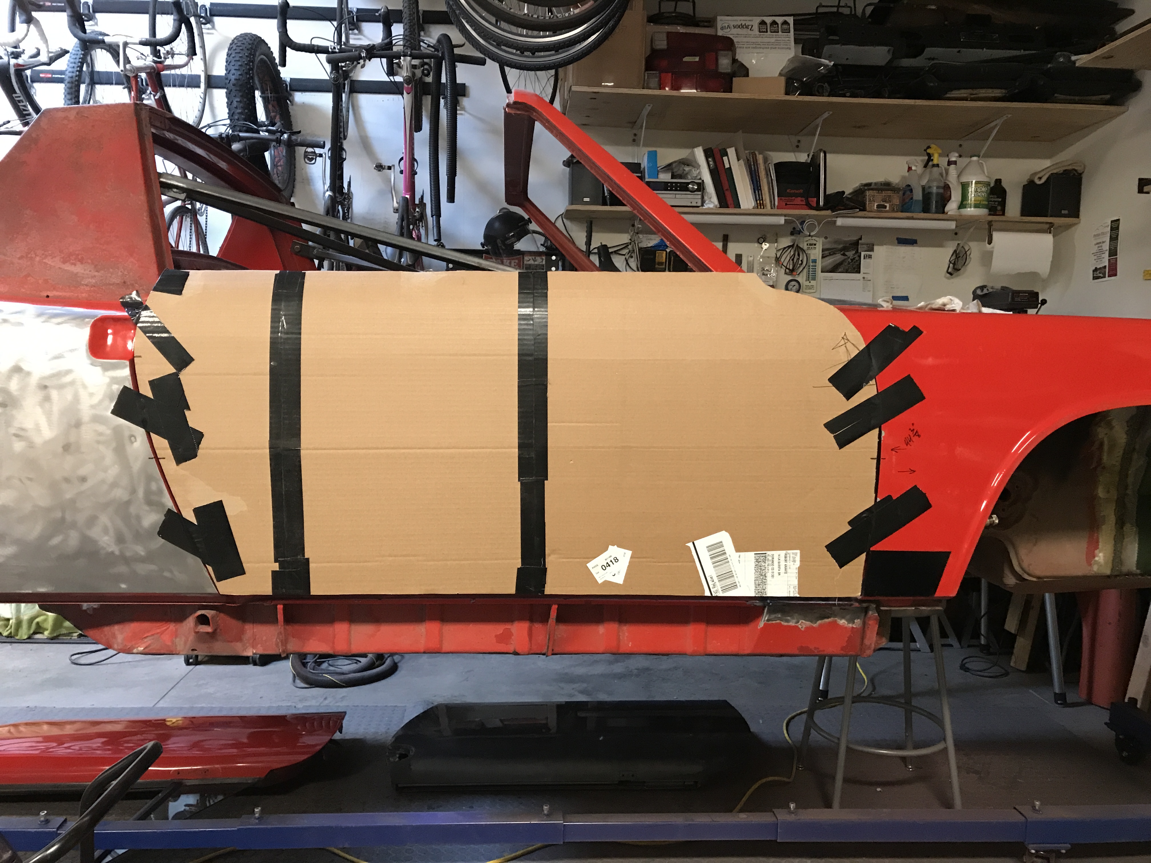

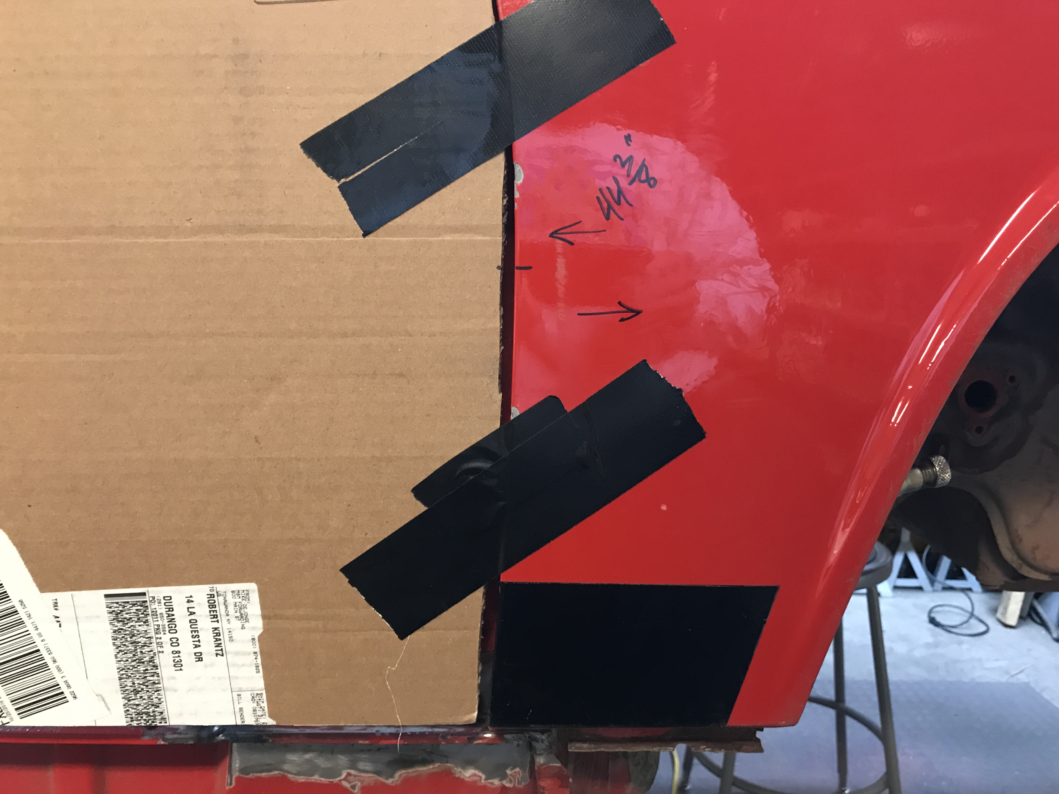

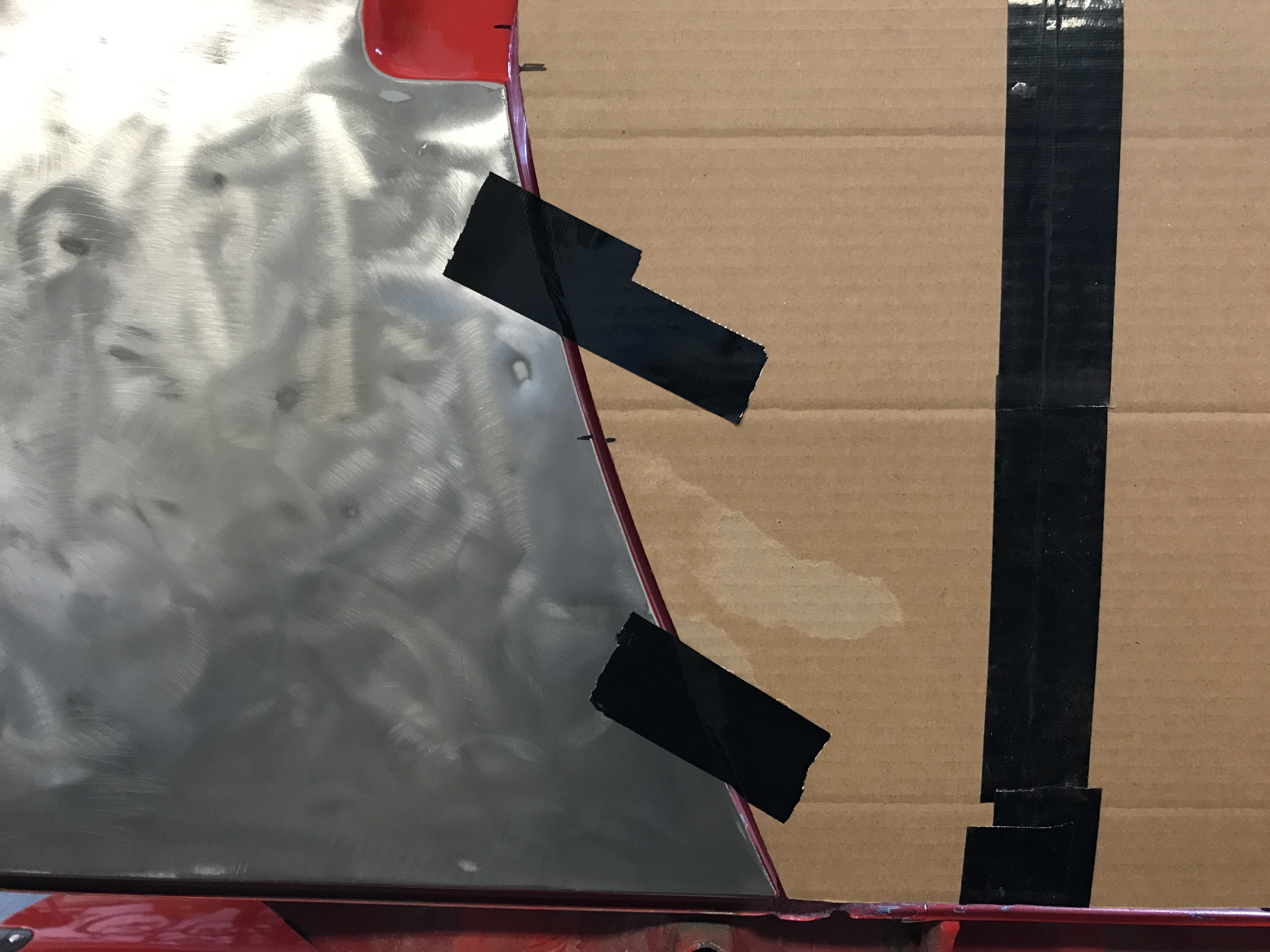

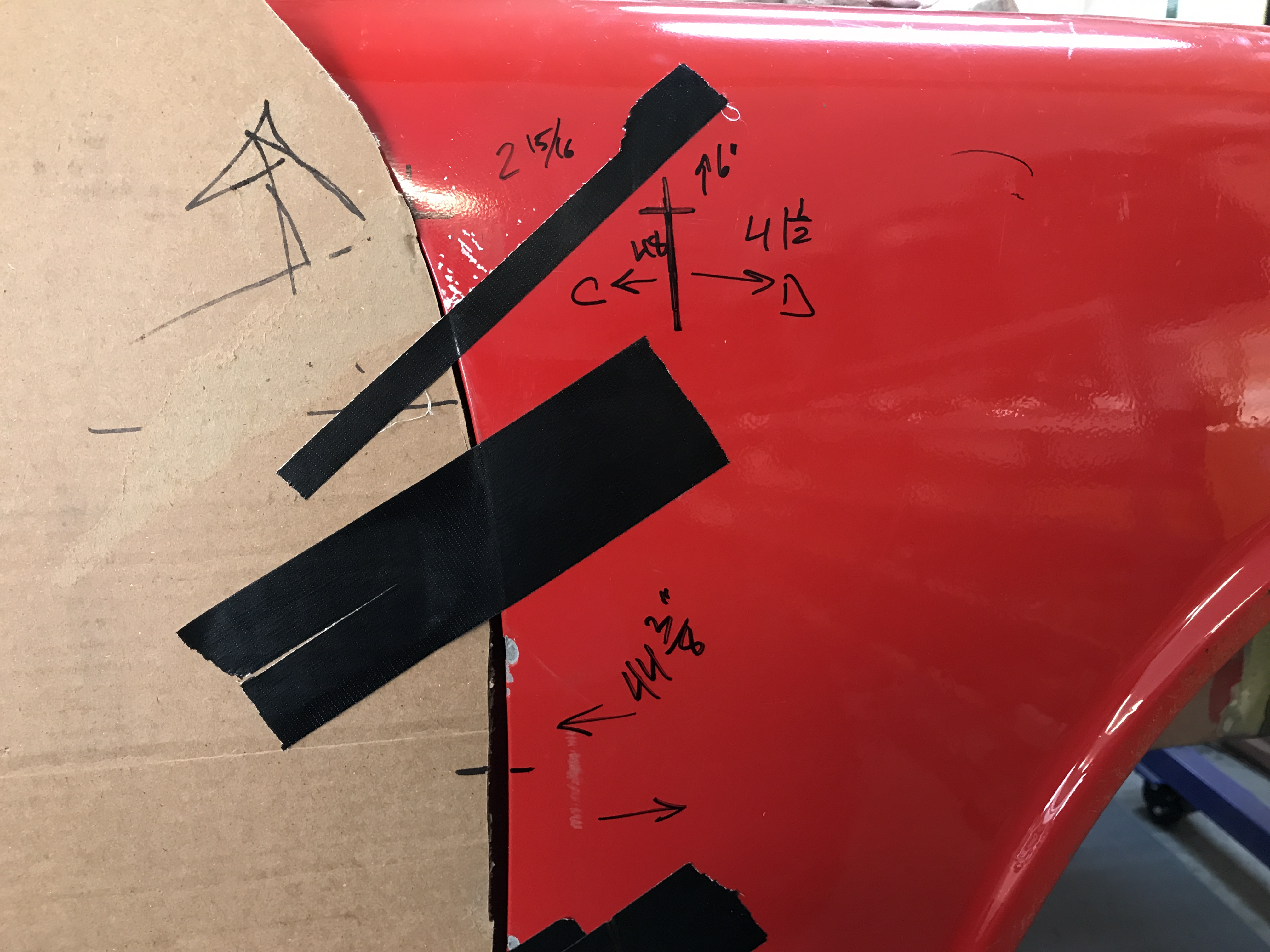

Still trying to assess and adjust the fender fit. I would like to bolt on the door, but really can't without setting the body down from the rotisserie, and removing the braces (which would require cutting). So I made a cardboard template directly from the door, and got it as close as I could accounting for the curvature. I think it is accurate except for the upper part of the leading edge.
bkrantz
post Mar 27 2020, 08:34 PM
Post #412
Posts: 8,341
Joined: 3-August 19
From: SW Colorado
Member No.: 23,343
Gaps are about 3/16 inch front...
bkrantz
Post #413
Posts: 8,341
Joined: 3-August 19
From: SW Colorado
Member No.: 23,343
And rear. I don't think the fender should shift any more rearward (and probably not forward).

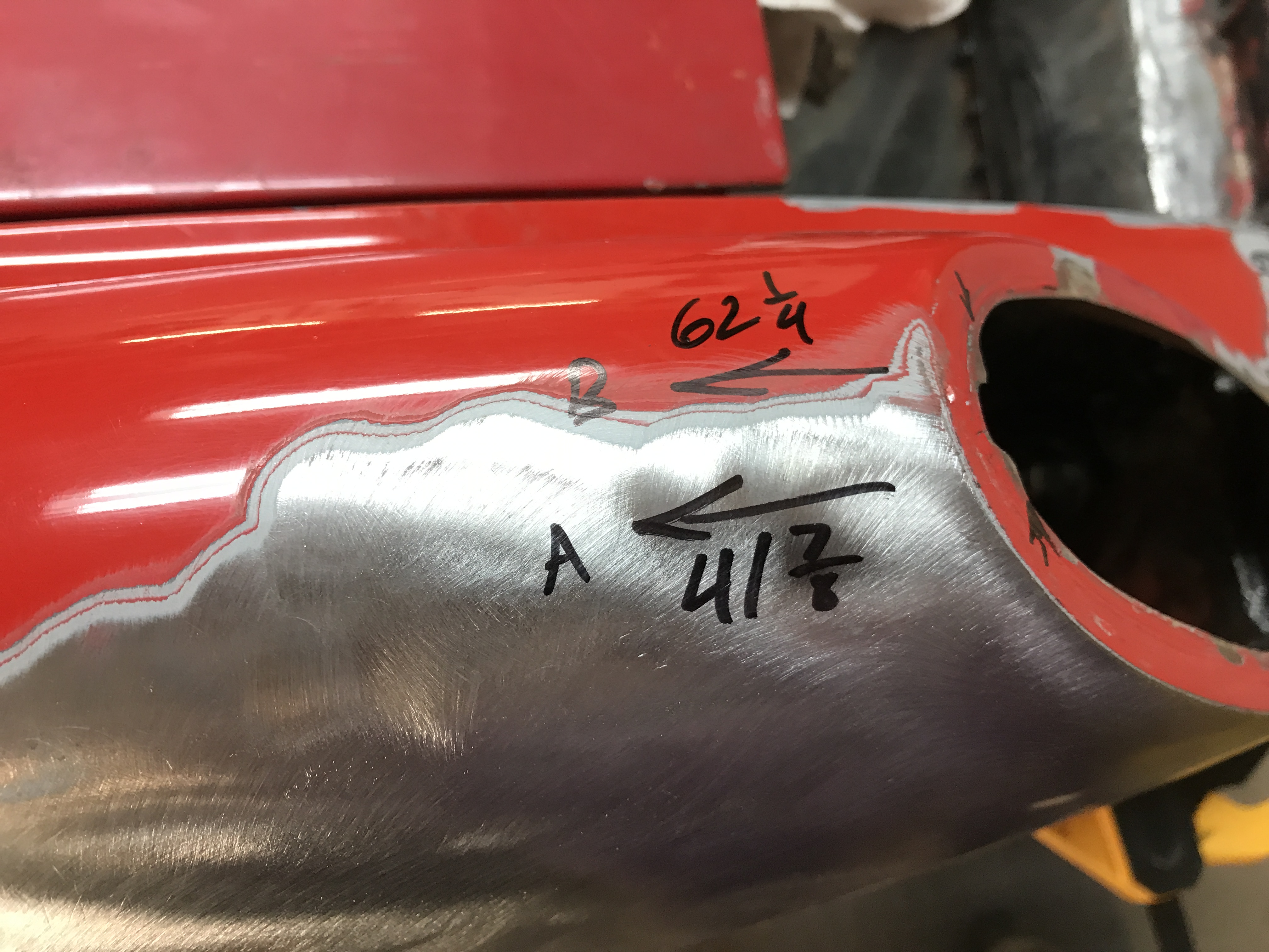

No 914 work today. I did some office work in the morning, and then started on a big outdoor project: removing and thinning the scrub oak that are too close to the house. This should help reduce danger from brush fires.
