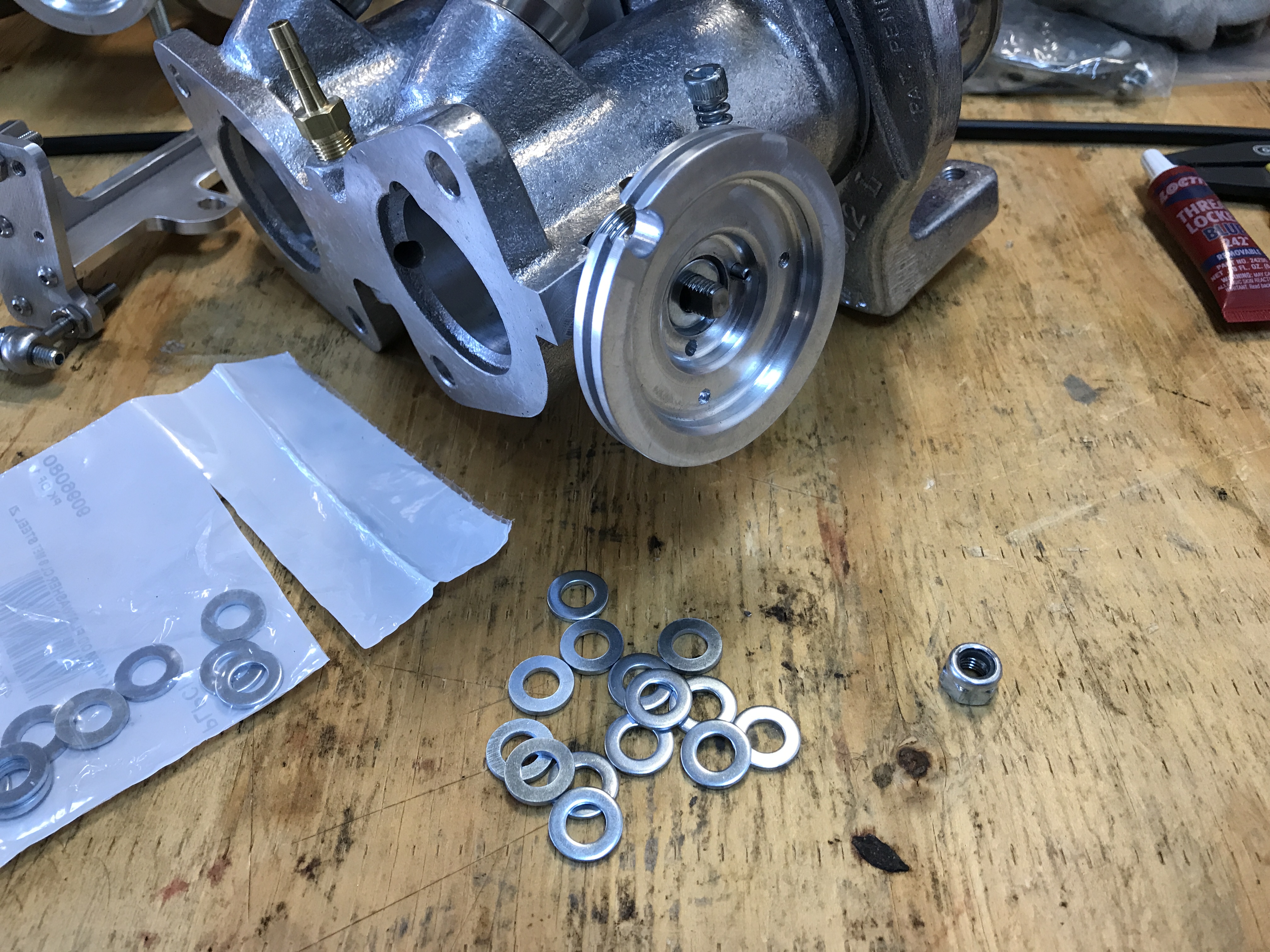

Pulley in place, but I need a couple of washers (M7) since the unthreaded segment of the shaft extends beyond the pulley center. Stay tuned.

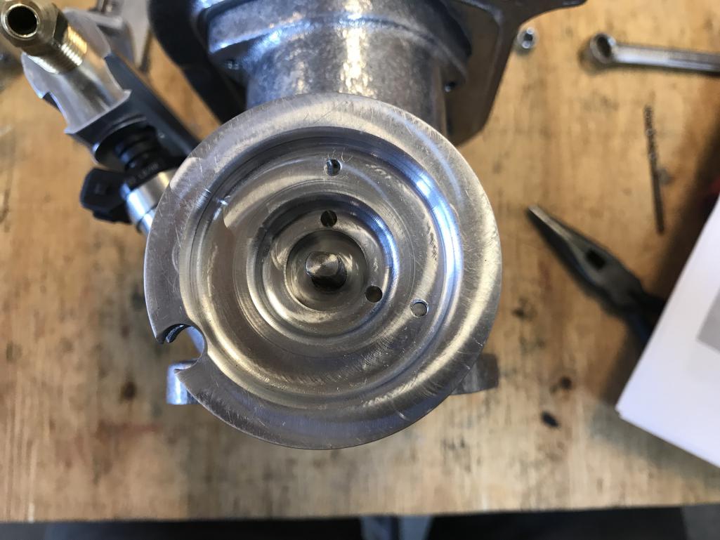

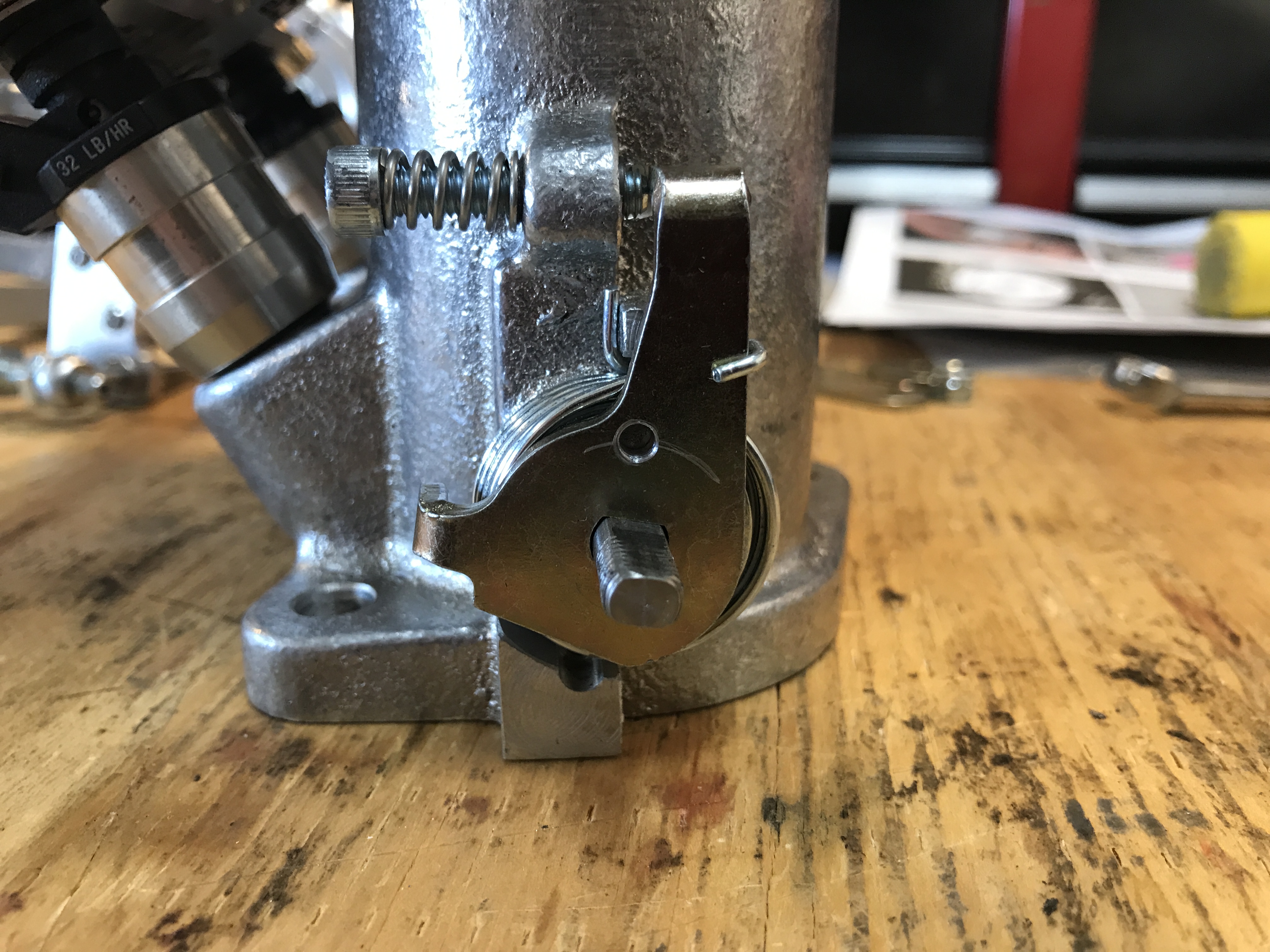

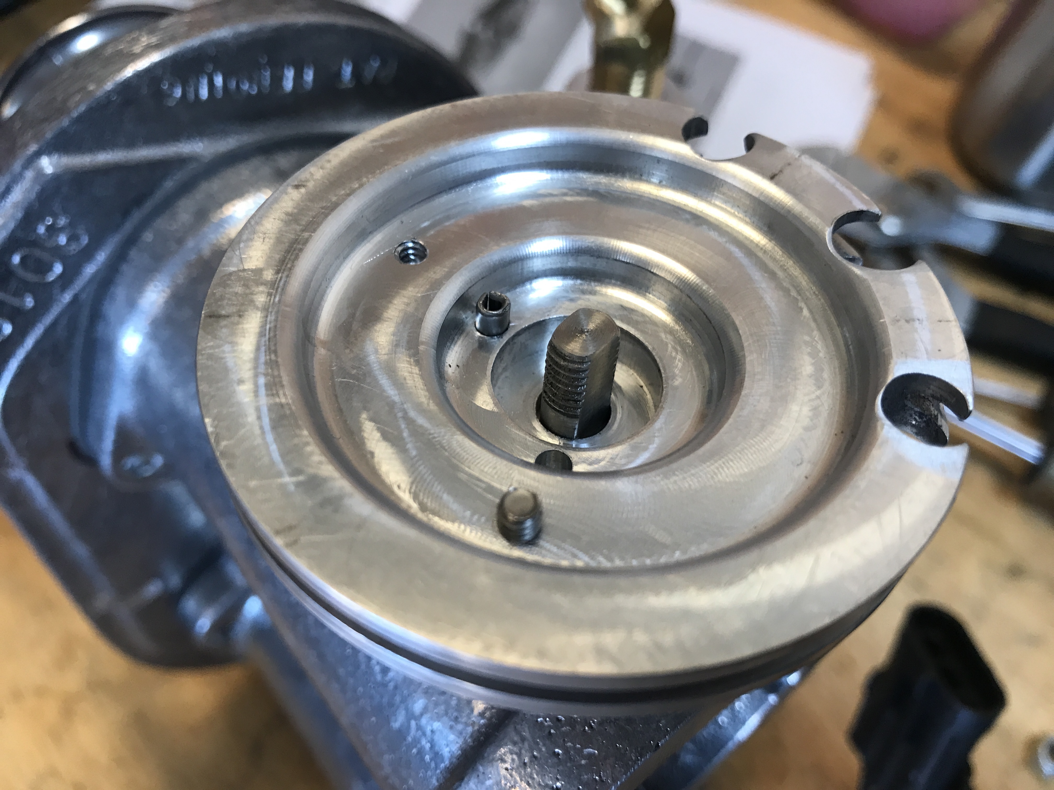

Still waiting on washers, so I started on my left (slave) throttle body. I stripped off the stock lever, and got the slave pulley in position.
bkrantz
post Nov 15 2021, 08:45 PM
Post #4143
Posts: 8,347
Joined: 3-August 19
From: SW Colorado
Member No.: 23,343

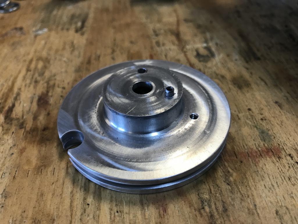

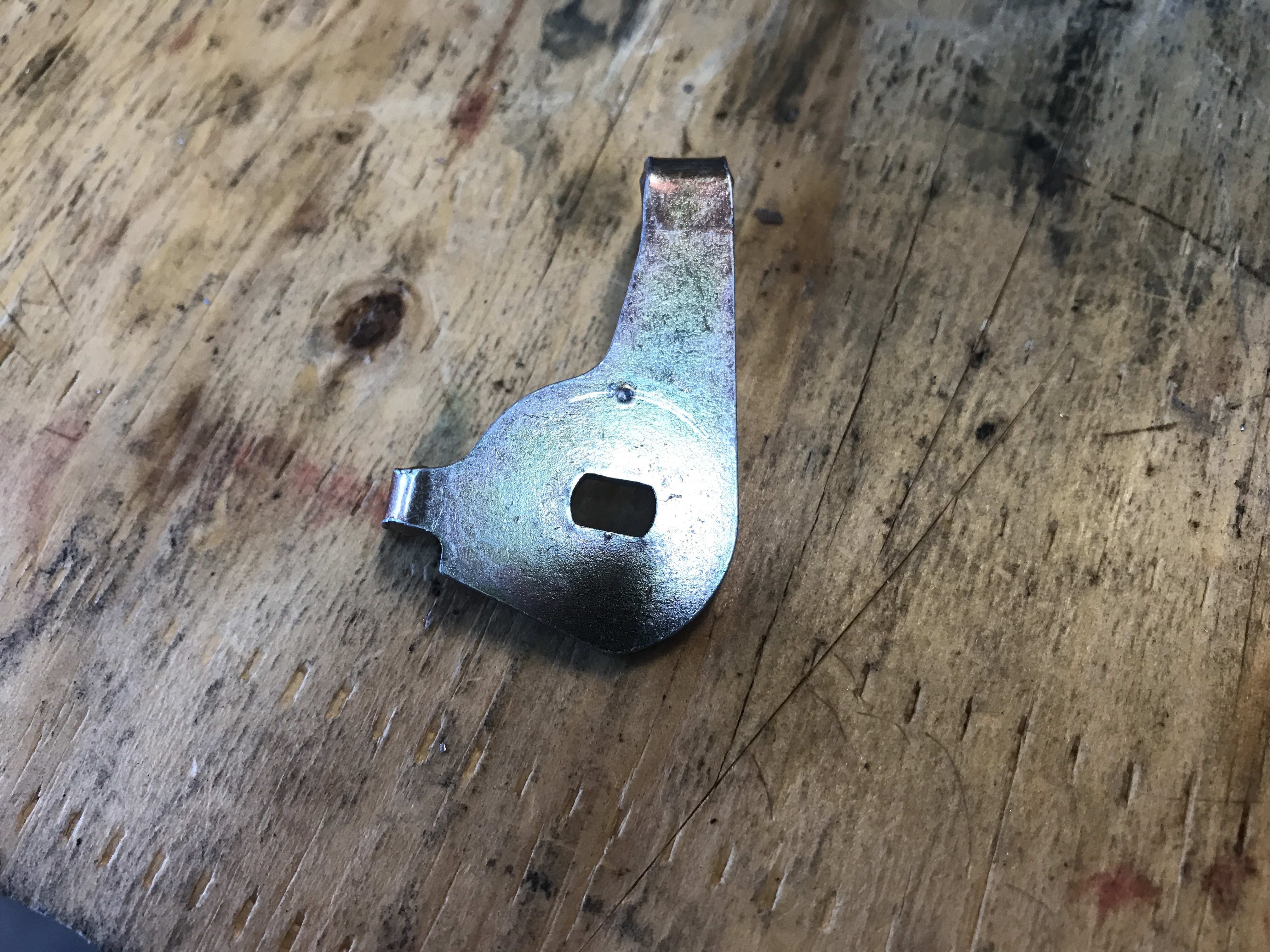

Throttle stop marked for pin.
bkrantz
post Nov 15 2021, 08:46 PM
Post #4144
Posts: 8,347
Joined: 3-August 19
From: SW Colorado
Member No.: 23,343

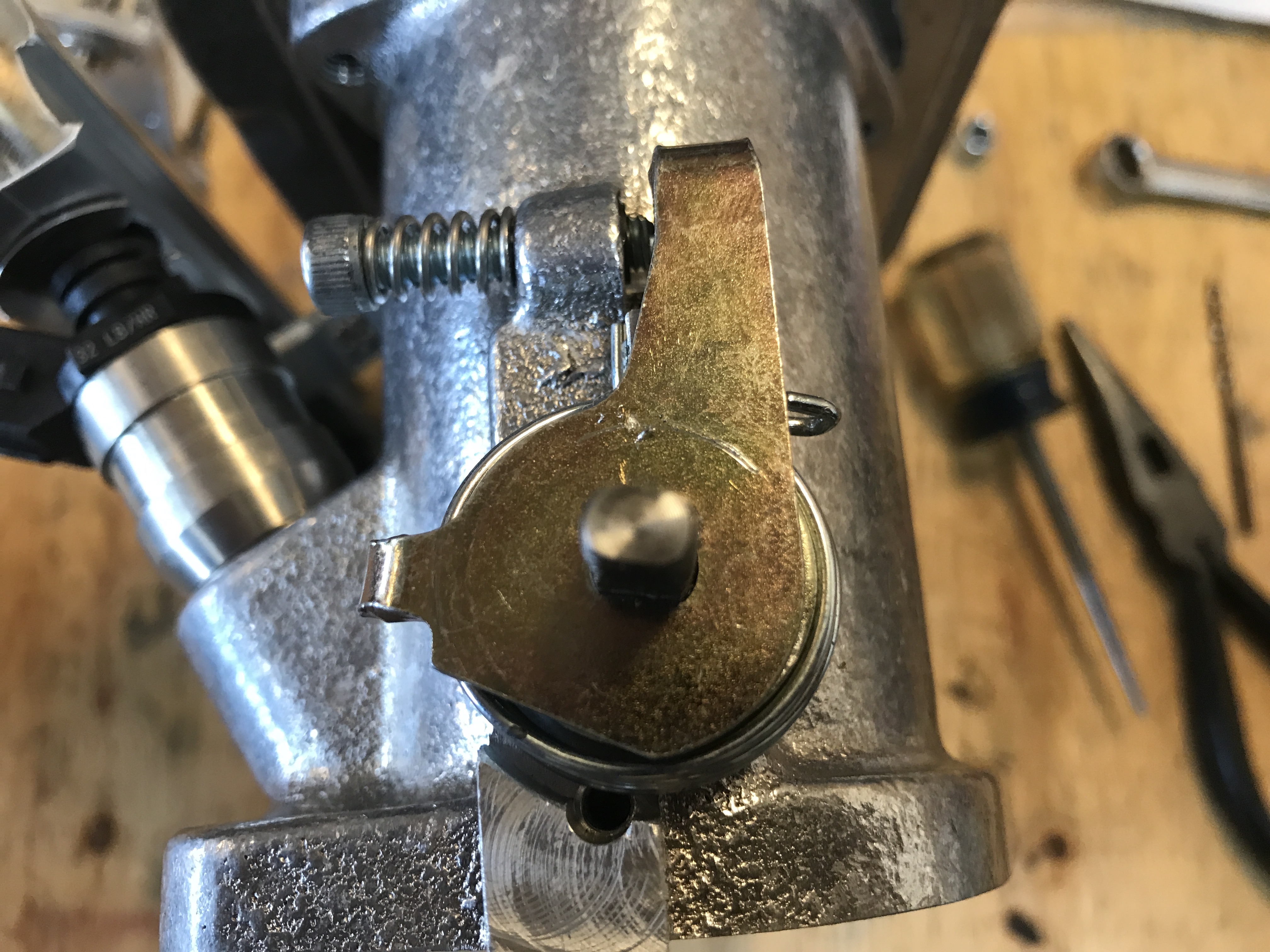

Again, the pin position was too close to the edge, so I moved it just enough.
bkrantz
post Nov 15 2021, 08:47 PM
Post #4145
Posts: 8,347
Joined: 3-August 19
From: SW Colorado
Member No.: 23,343
Hole drilled and chamfered.
bkrantz
post Nov 15 2021, 08:49 PM
Post #4146
Posts: 8,347
Joined: 3-August 19
From: SW Colorado
Member No.: 23,343
Split pin pressed into slave pulley, again just enough to engage the thickness of the throttle stop and not drag on the washer behind it.

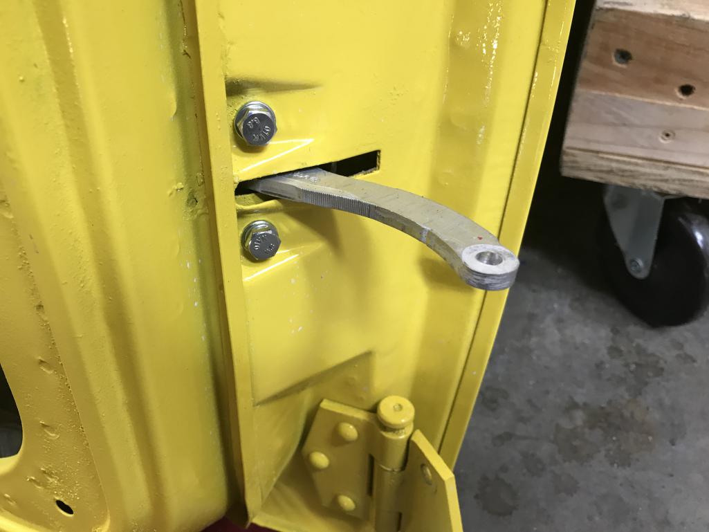

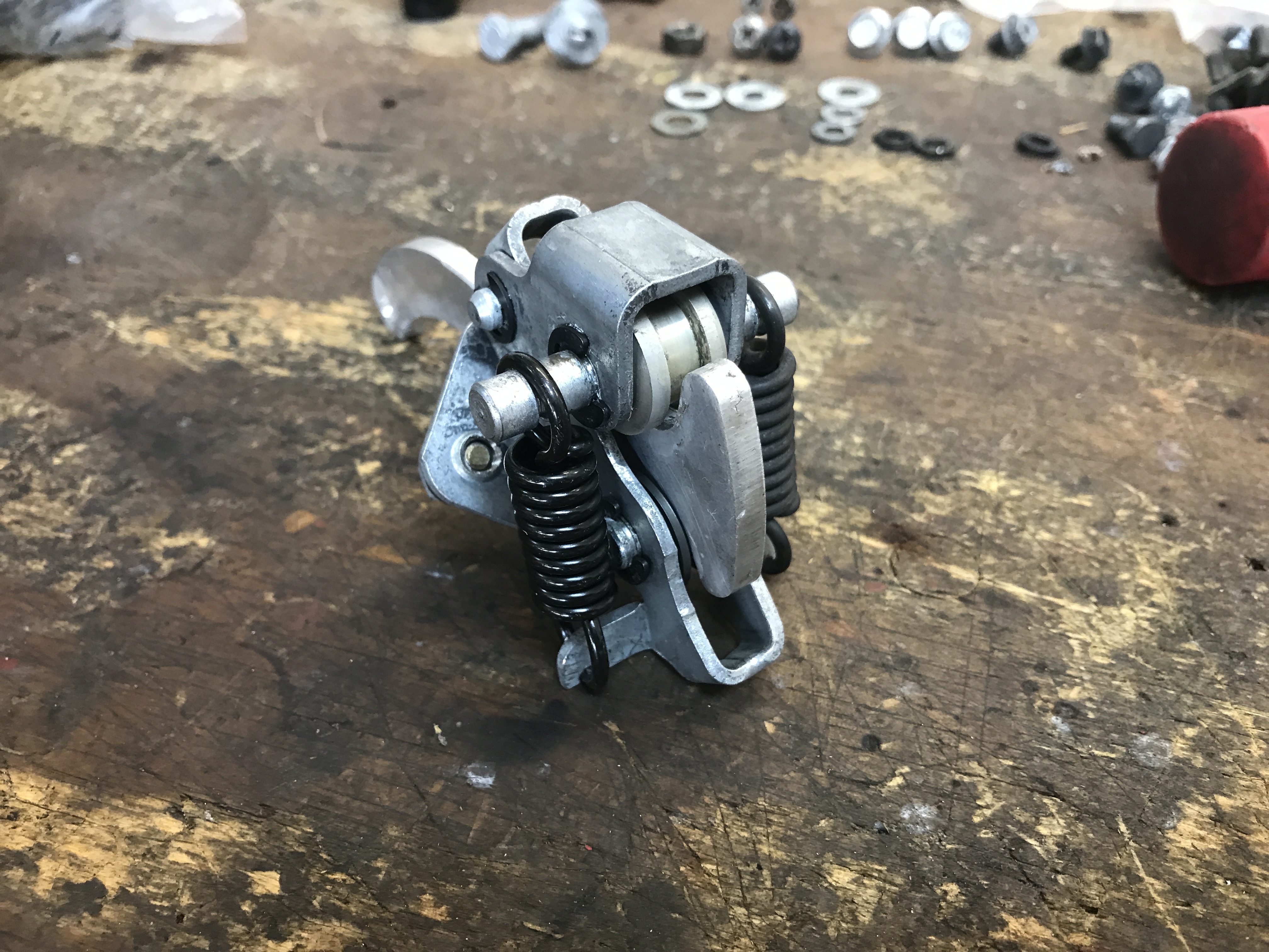

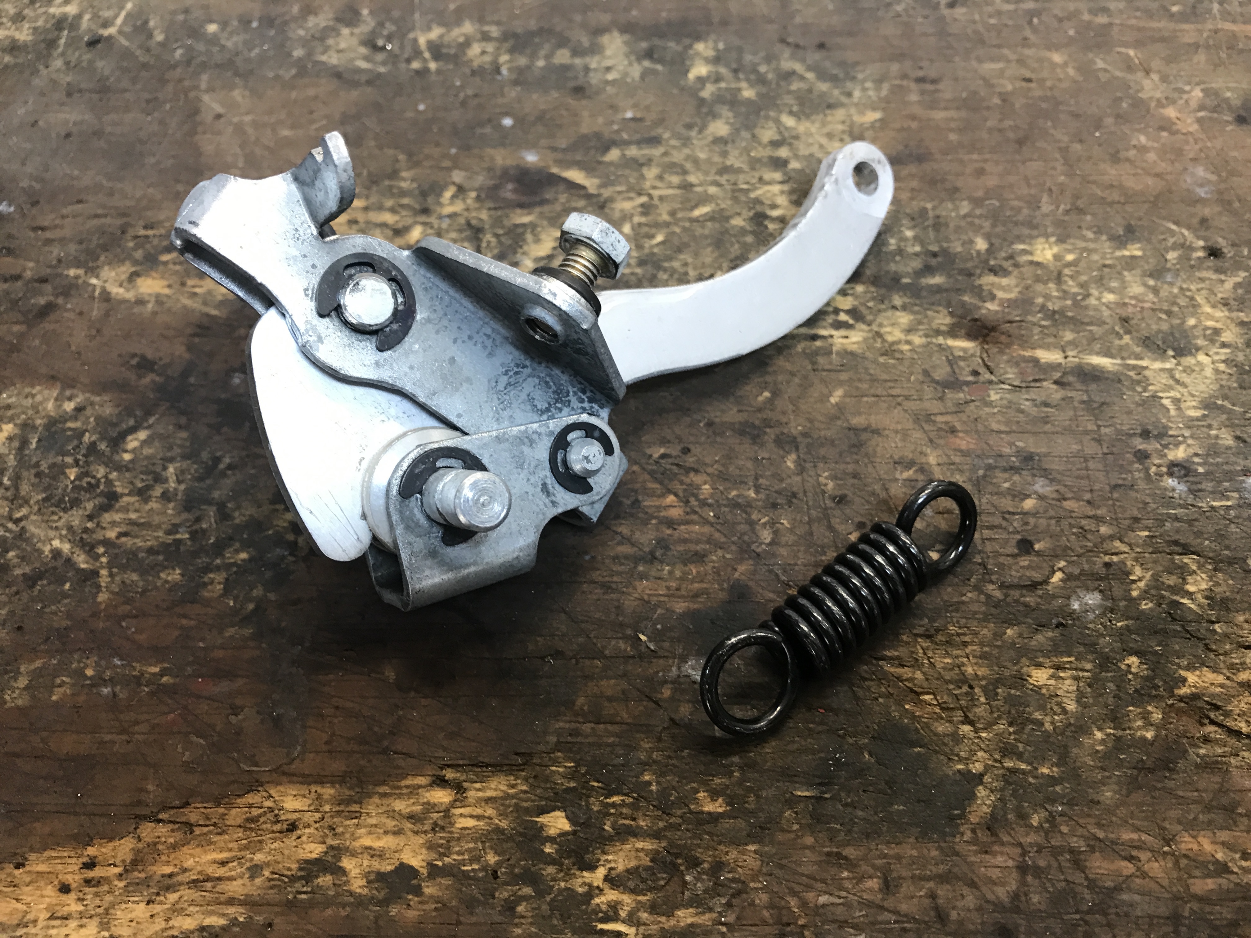

One thing I did get is a replacement door stay spring. (Thanks, Mark)
bkrantz
post Nov 15 2021, 08:52 PM
Post #4149
Posts: 8,347
Joined: 3-August 19
From: SW Colorado
Member No.: 23,343
Door stay ready.
bkrantz
post Nov 15 2021, 08:53 PM
Post #4150
Posts: 8,347
Joined: 3-August 19
From: SW Colorado
Member No.: 23,343
Some light lube, and then installed.

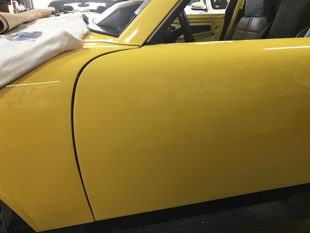

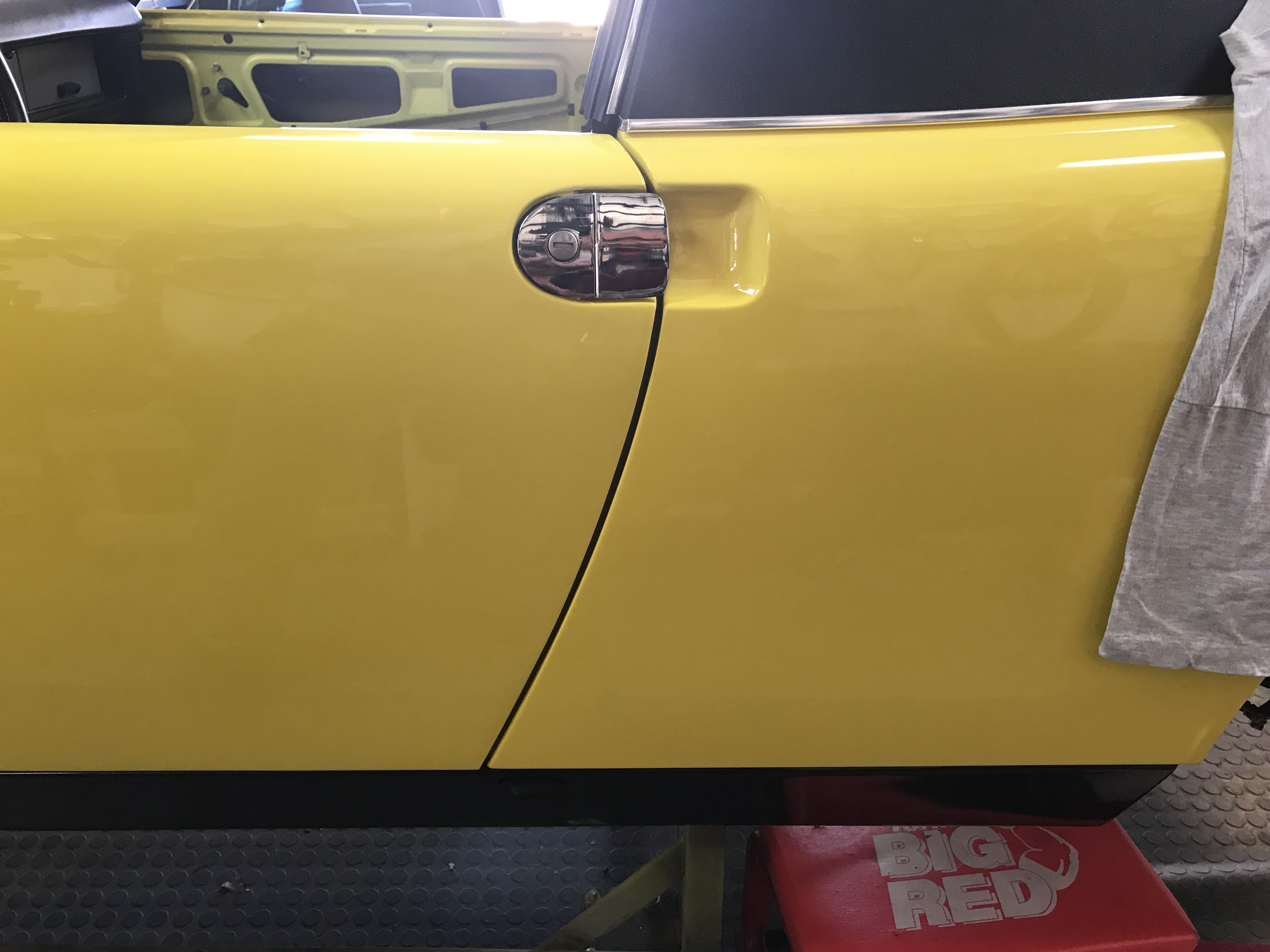

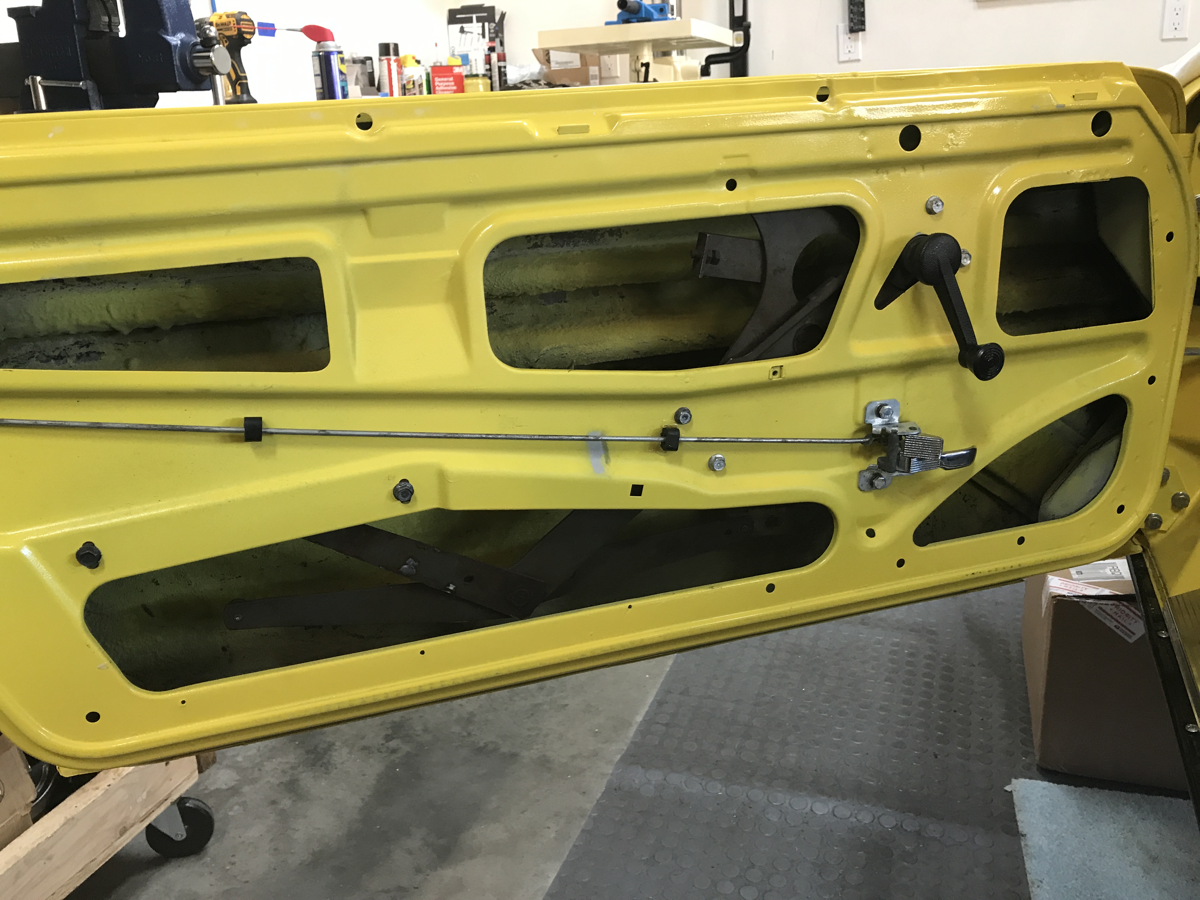

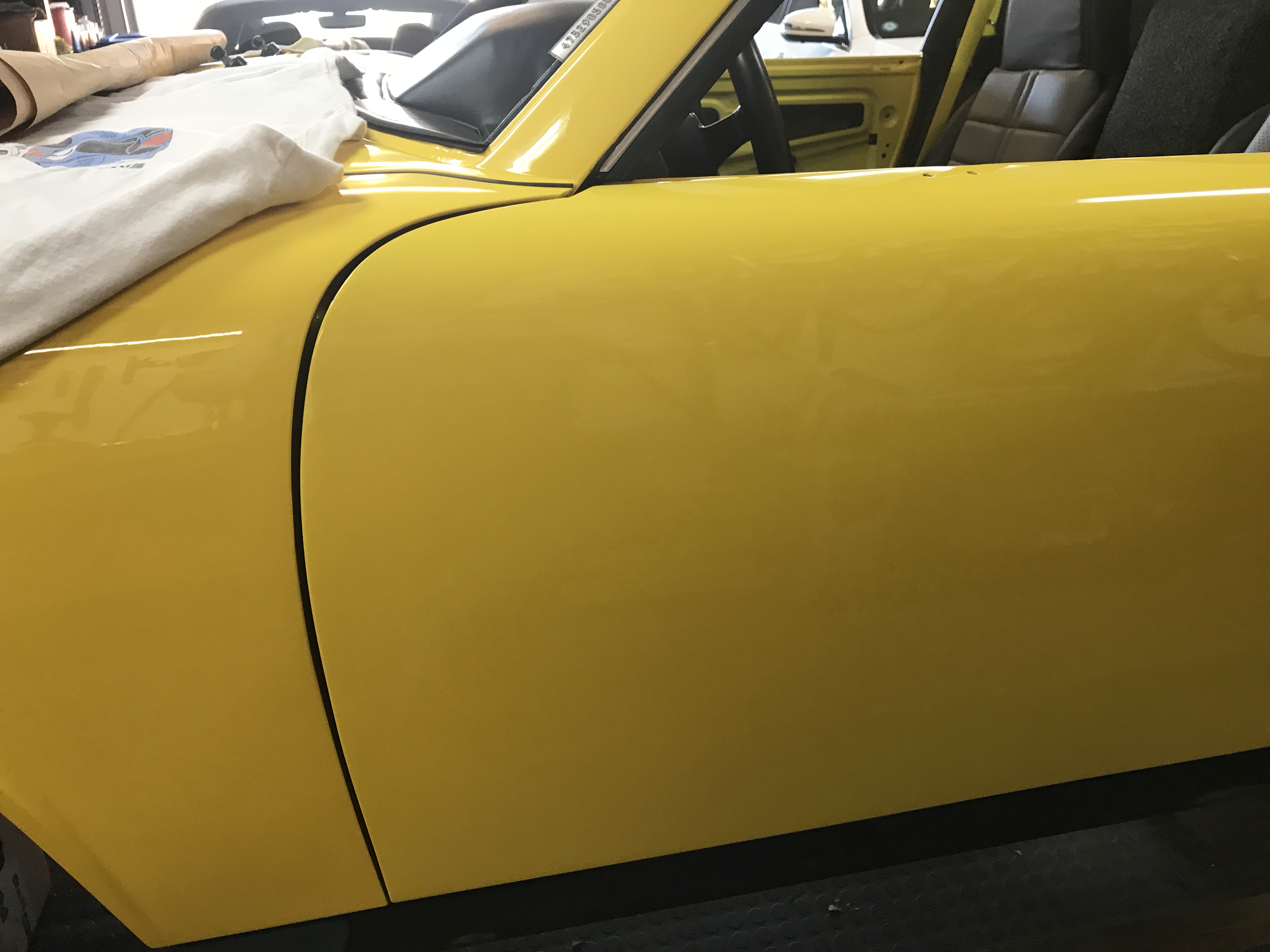

I then hung the door, and made a first alignment of the hinge positions. Front gap OK.
bkrantz
post Nov 15 2021, 08:55 PM
Post #4152
Posts: 8,347
Joined: 3-August 19
From: SW Colorado
Member No.: 23,343
Rear gap better. I will work on this more later on.
bkrantz
post Nov 15 2021, 08:56 PM
Post #4153
Posts: 8,347
Joined: 3-August 19
From: SW Colorado
Member No.: 23,343
With the door mounted, I installed the window winder. Once I get my OEM vent window gaskets I can get on with the guides and glass.

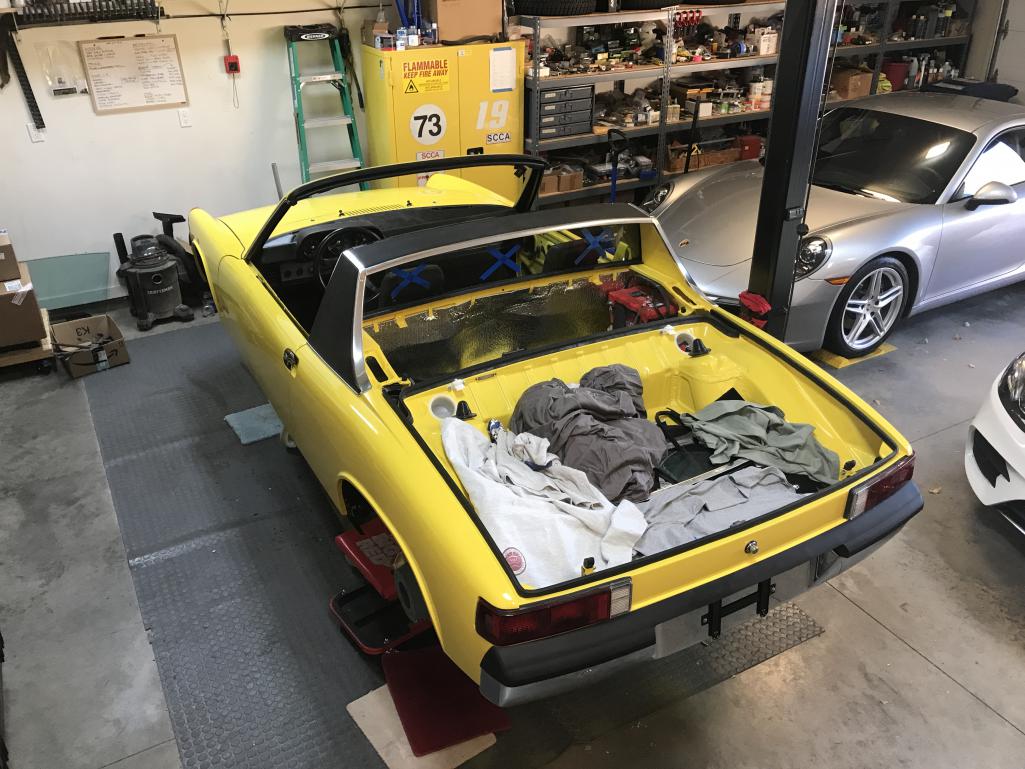

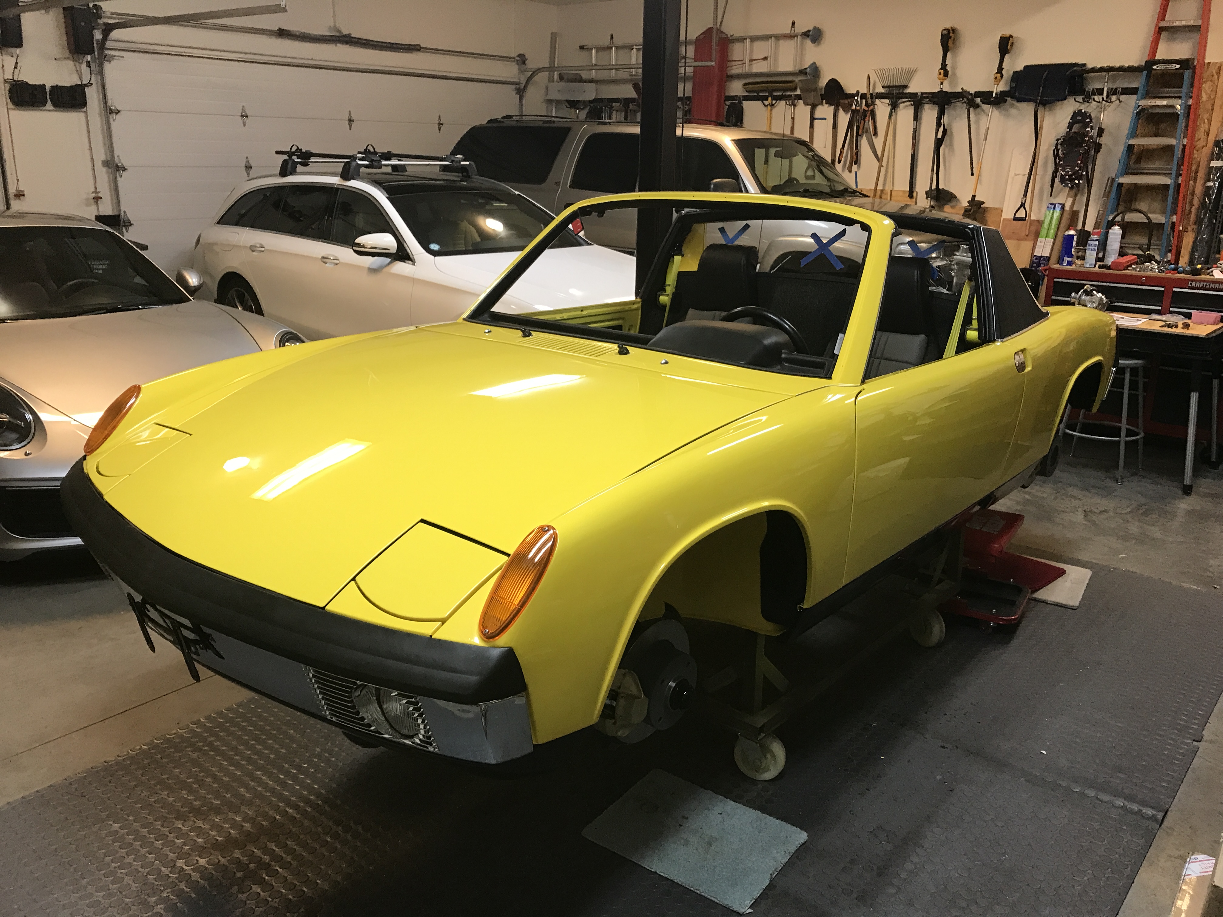

With both doors on, I could not resist some glamour shots.
bkrantz
post Nov 15 2021, 08:58 PM
Post #4155
Posts: 8,347
Joined: 3-August 19
From: SW Colorado
Member No.: 23,343
One more.

Perhaps plexiglass hoods? Then you'd know what's inside without lifting the boot. (IMG:style_emoticons/default/ohmy.gif)
Puebloswatcop
post Nov 16 2021, 07:40 AM
Post #4157
Posts: 1,444
Joined: 27-December 14
From: Mineola, Texas
Member No.: 18,258
Looking awesome Bob, (IMG:style_emoticons/default/driving.gif)
bkrantz
post Nov 16 2021, 08:12 PM
Post #4158
Posts: 8,347
Joined: 3-August 19
From: SW Colorado
Member No.: 23,343
QUOTE(raynekat @ Nov 15 2021, 09:25 PM) *
Nah, you can see how much junk in the trunk I have already.

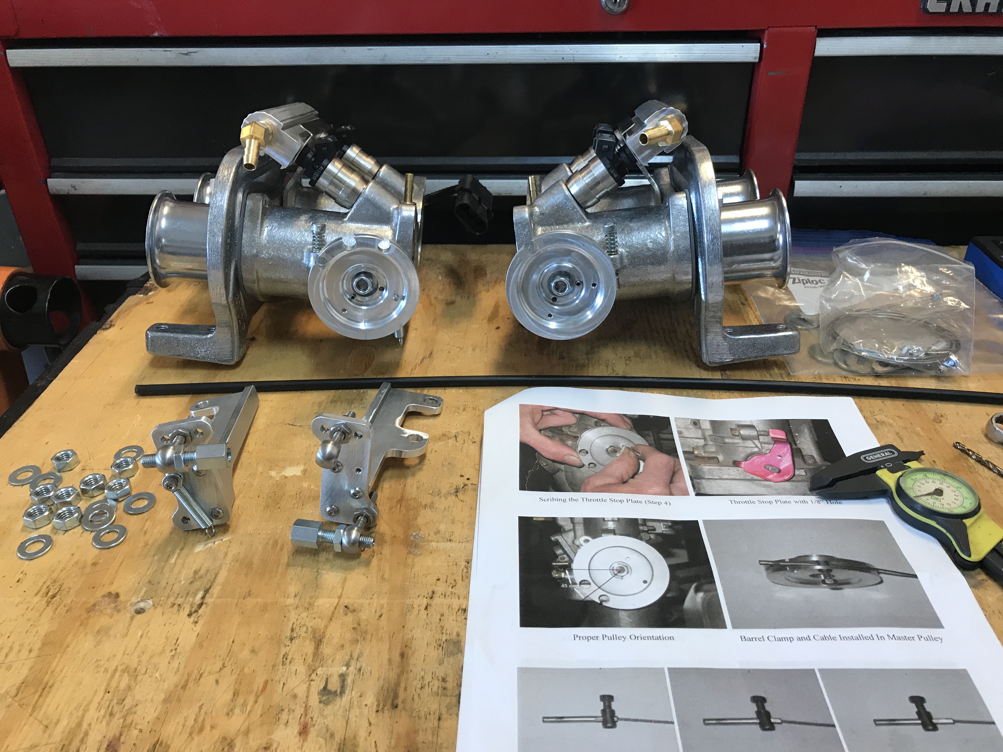

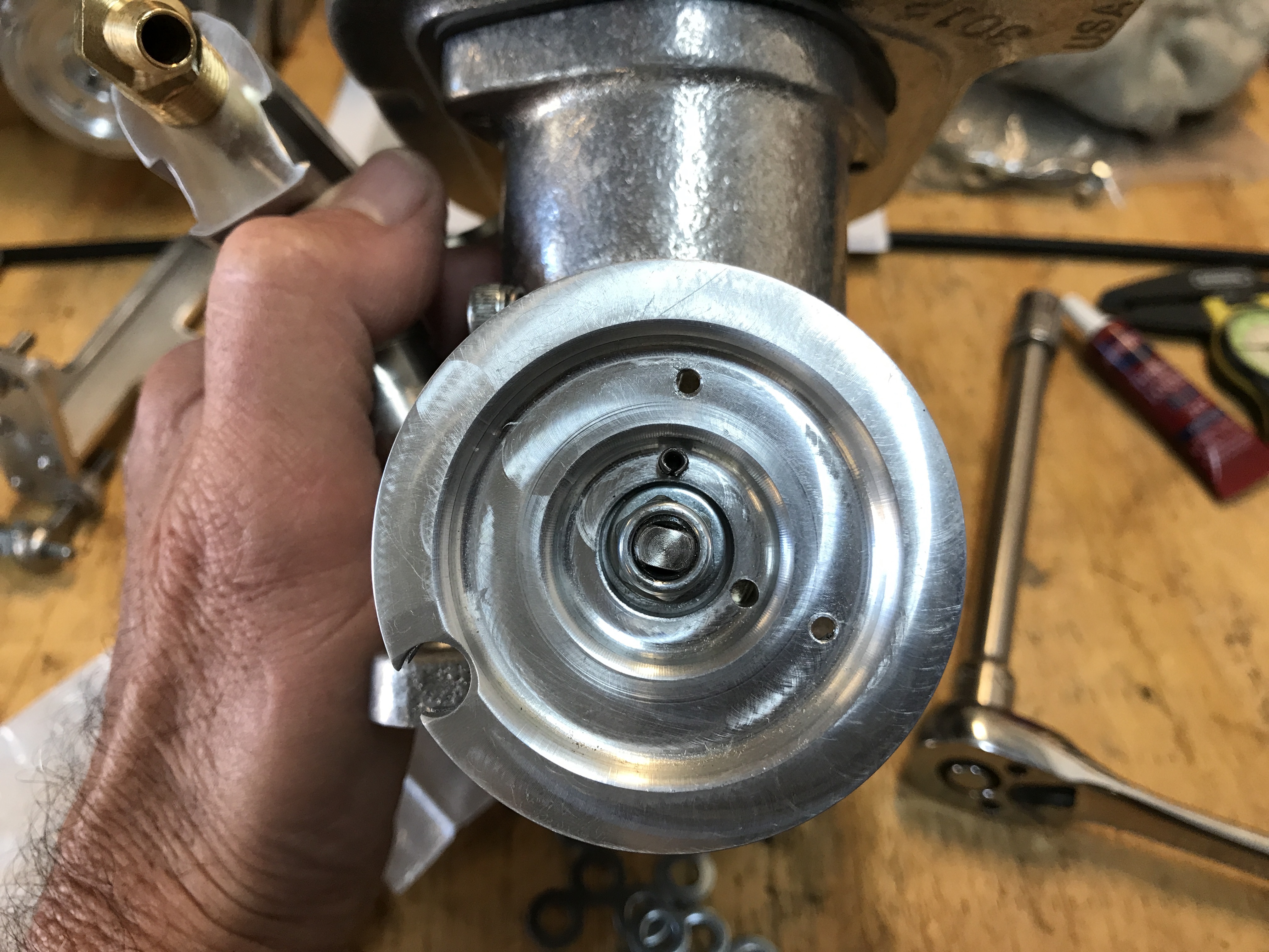

Got my M7 washers, just the size for the throttle body shafts.
bkrantz
post Nov 17 2021, 07:59 PM
Post #4160
Posts: 8,347
Joined: 3-August 19
From: SW Colorado
Member No.: 23,343
Slave pulley mount test. Two washes do the job.
