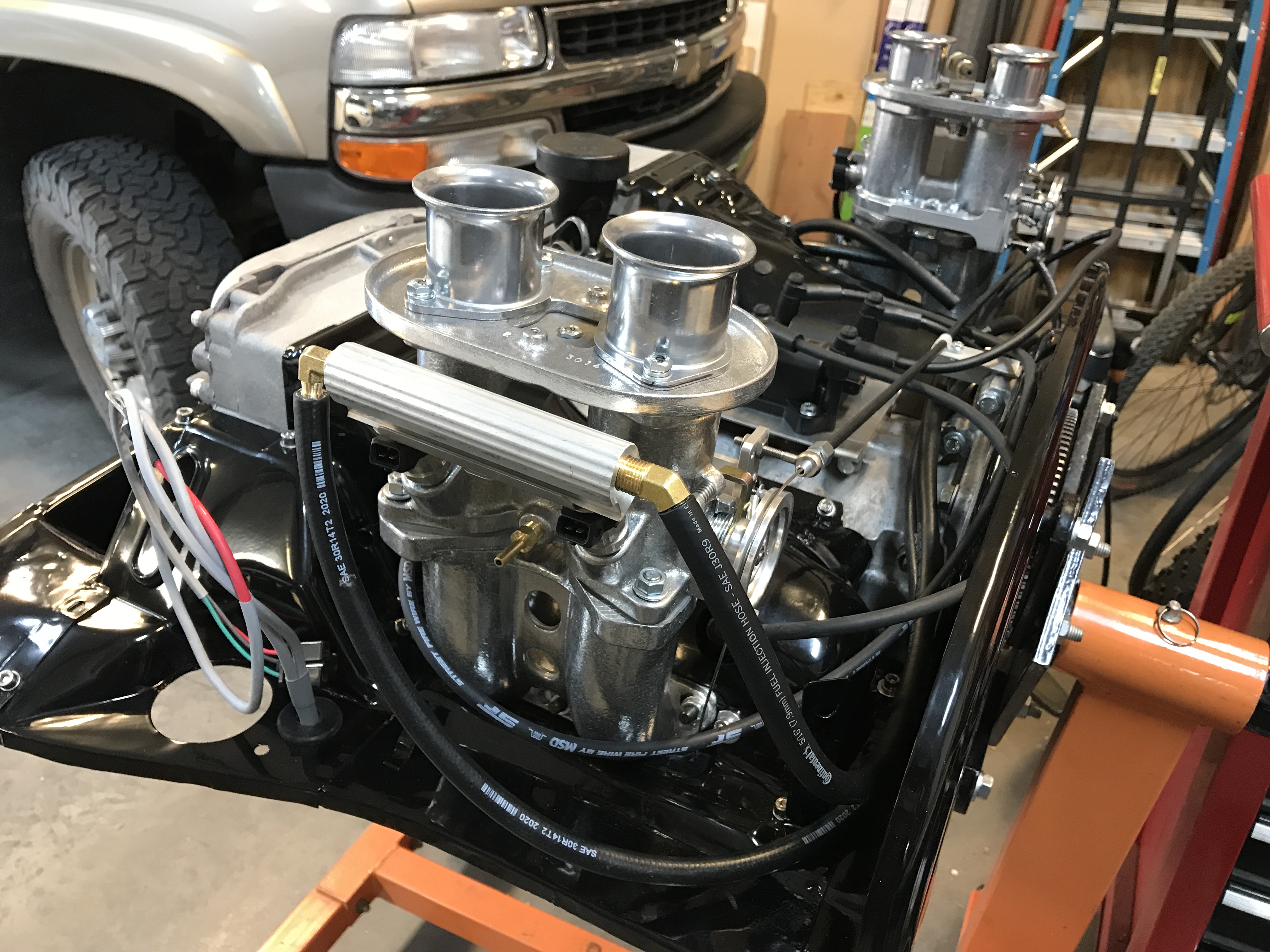

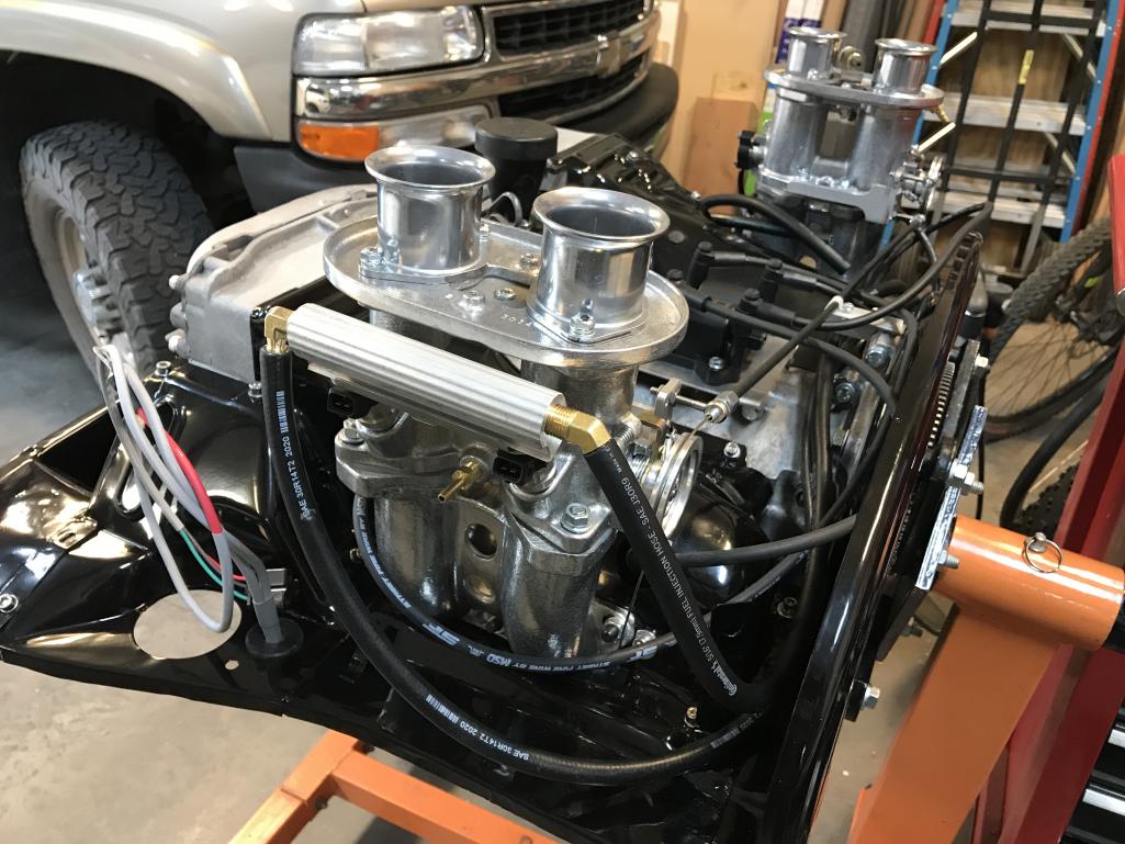

I also started to mock up the lines on the engine, connecting supply to left injector rail, left rail to right rail, and right rail to pressure regulator.

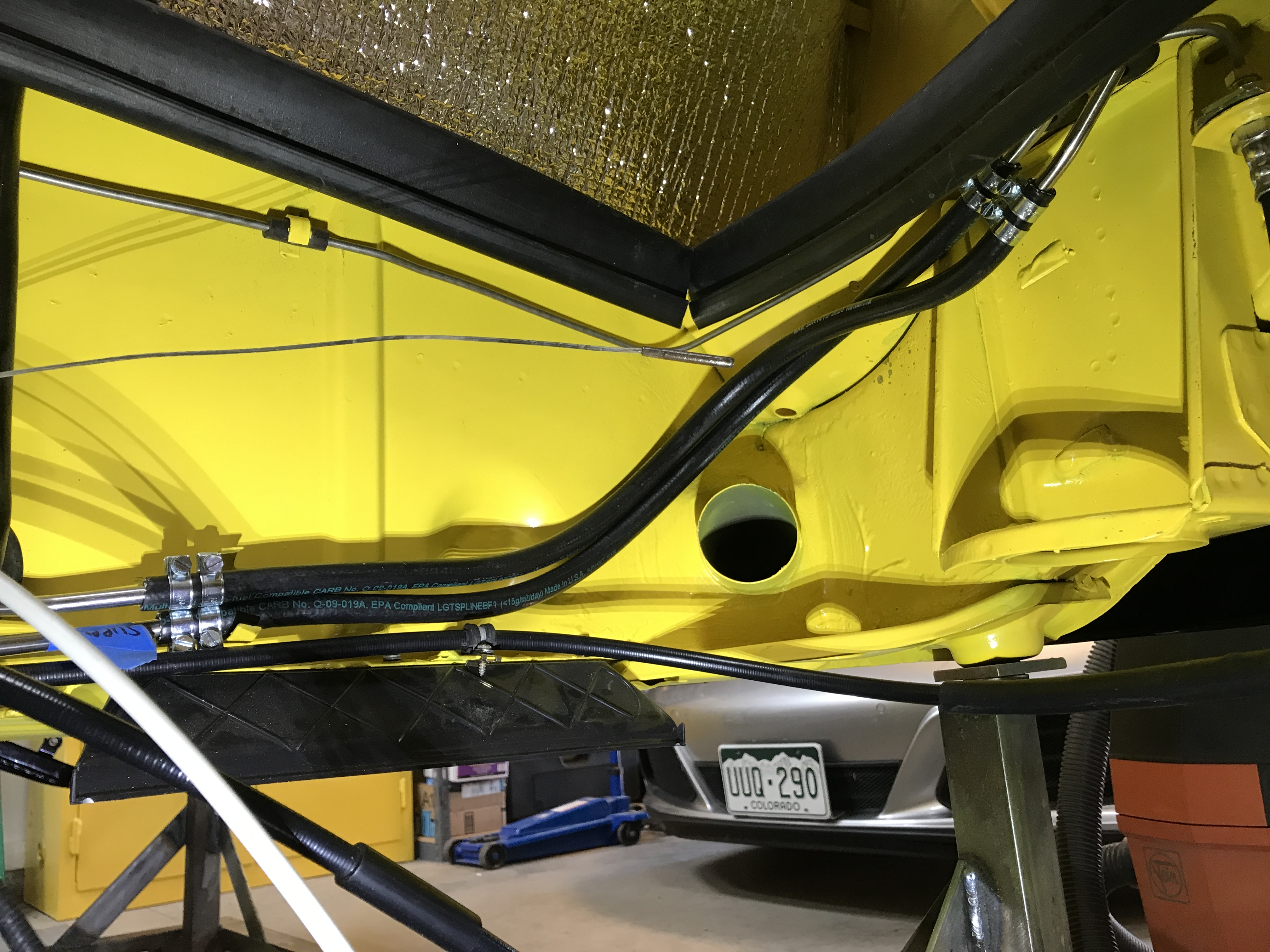

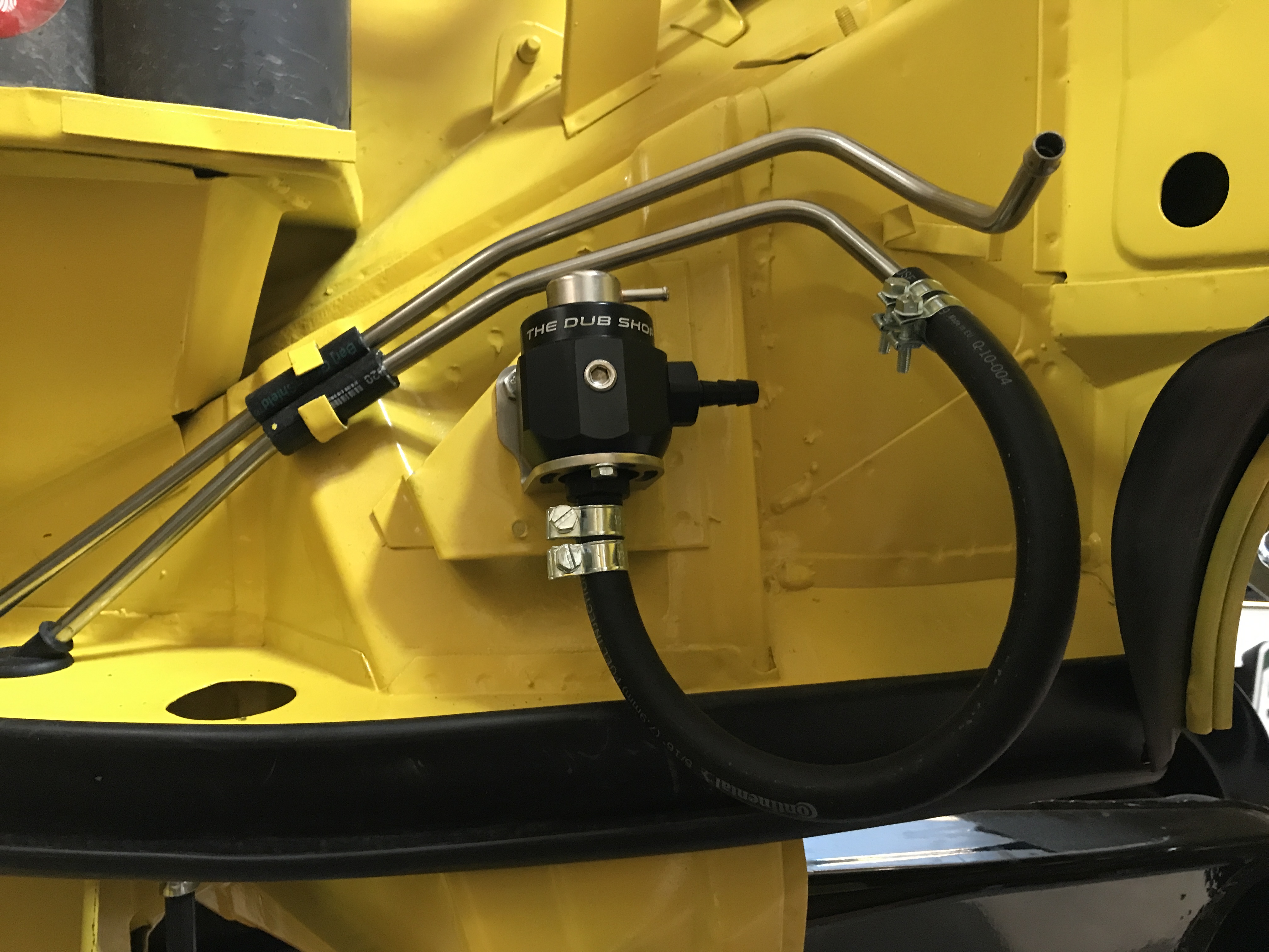

Running fuel lines in the engine compartment, to connect the hard lines in the tunnel with those through the shelf.

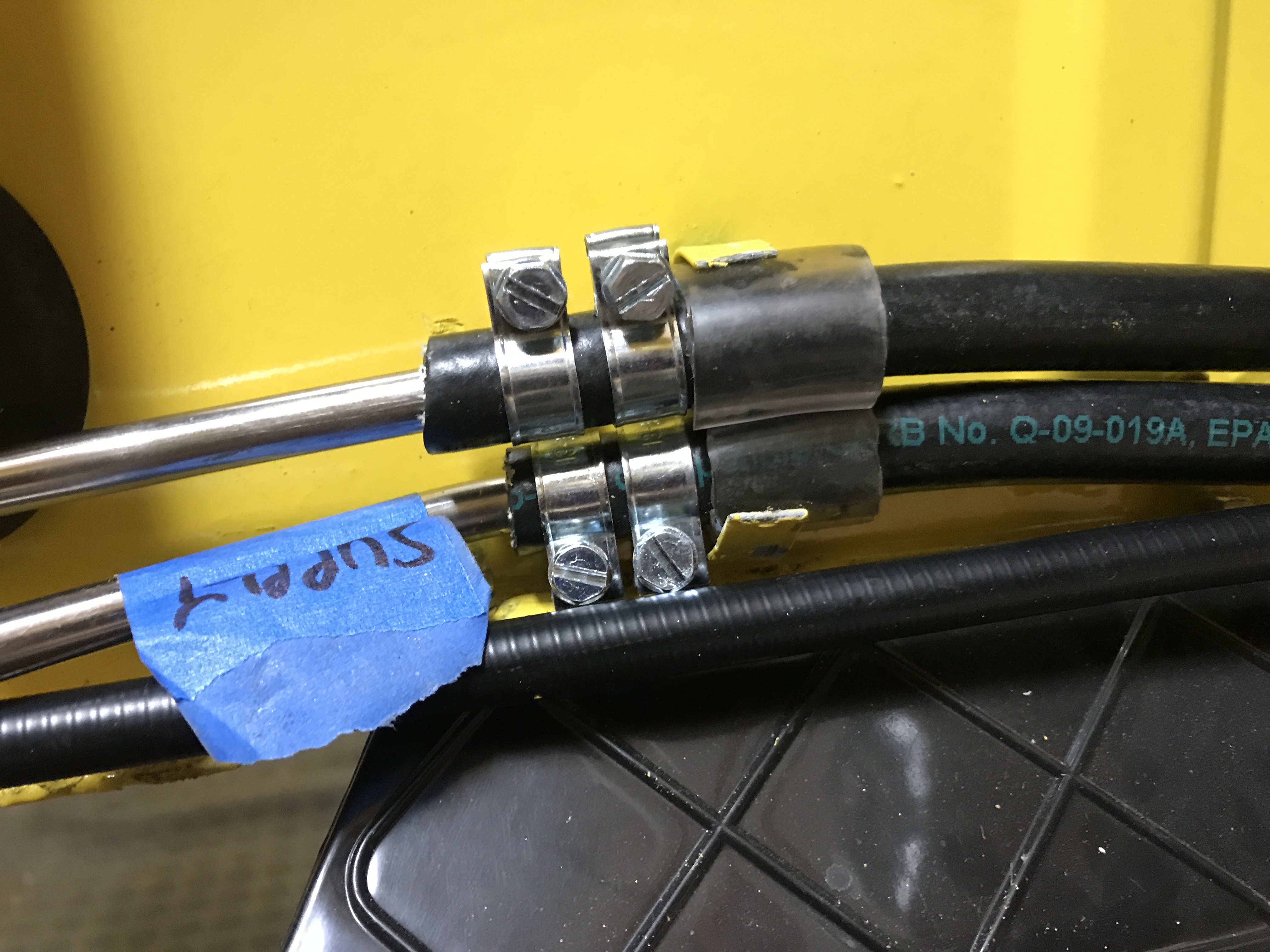

I decided to double-clamp all the connections--probably overkill, but who wants fuel loose in the engine compartment?
I also used some plastic tubing to protect the lines from the retaining clamp edges.

At the top side, connecting the pressure regulator with the return line.

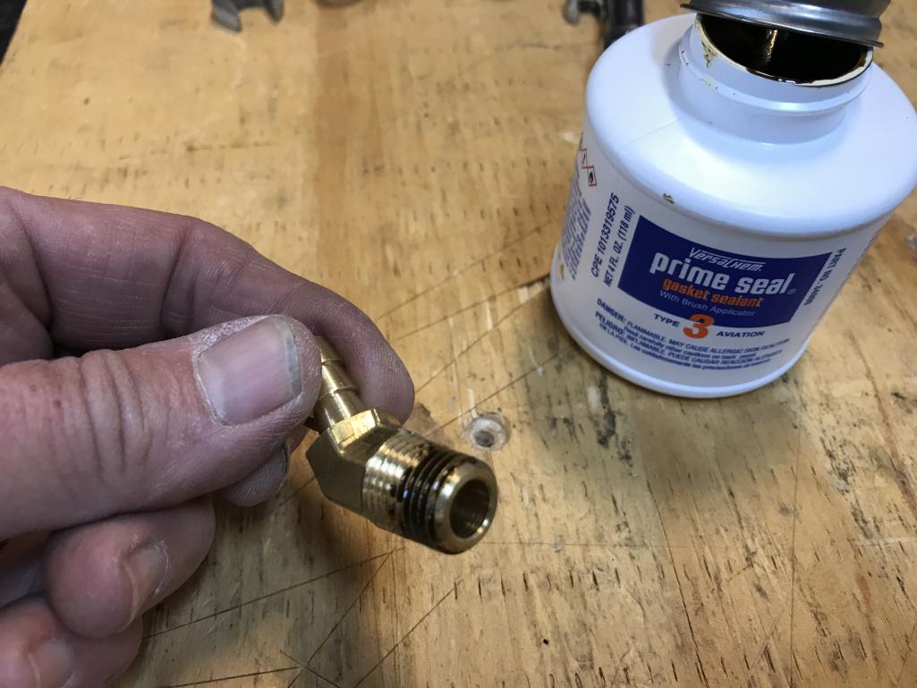

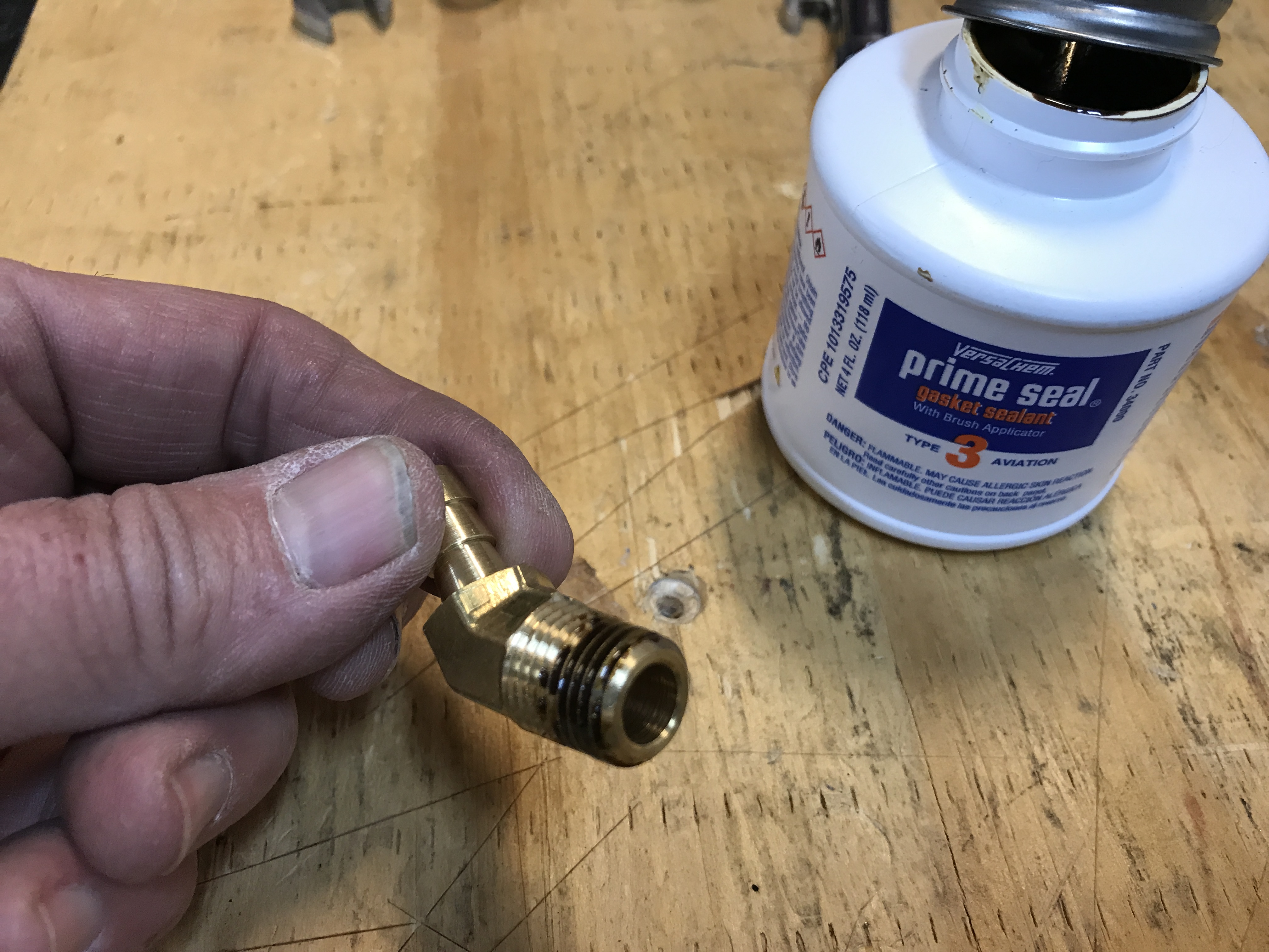

Last bit today: sealing the fittings in the injector rails with some #3, careful not to get any on the internal ends.

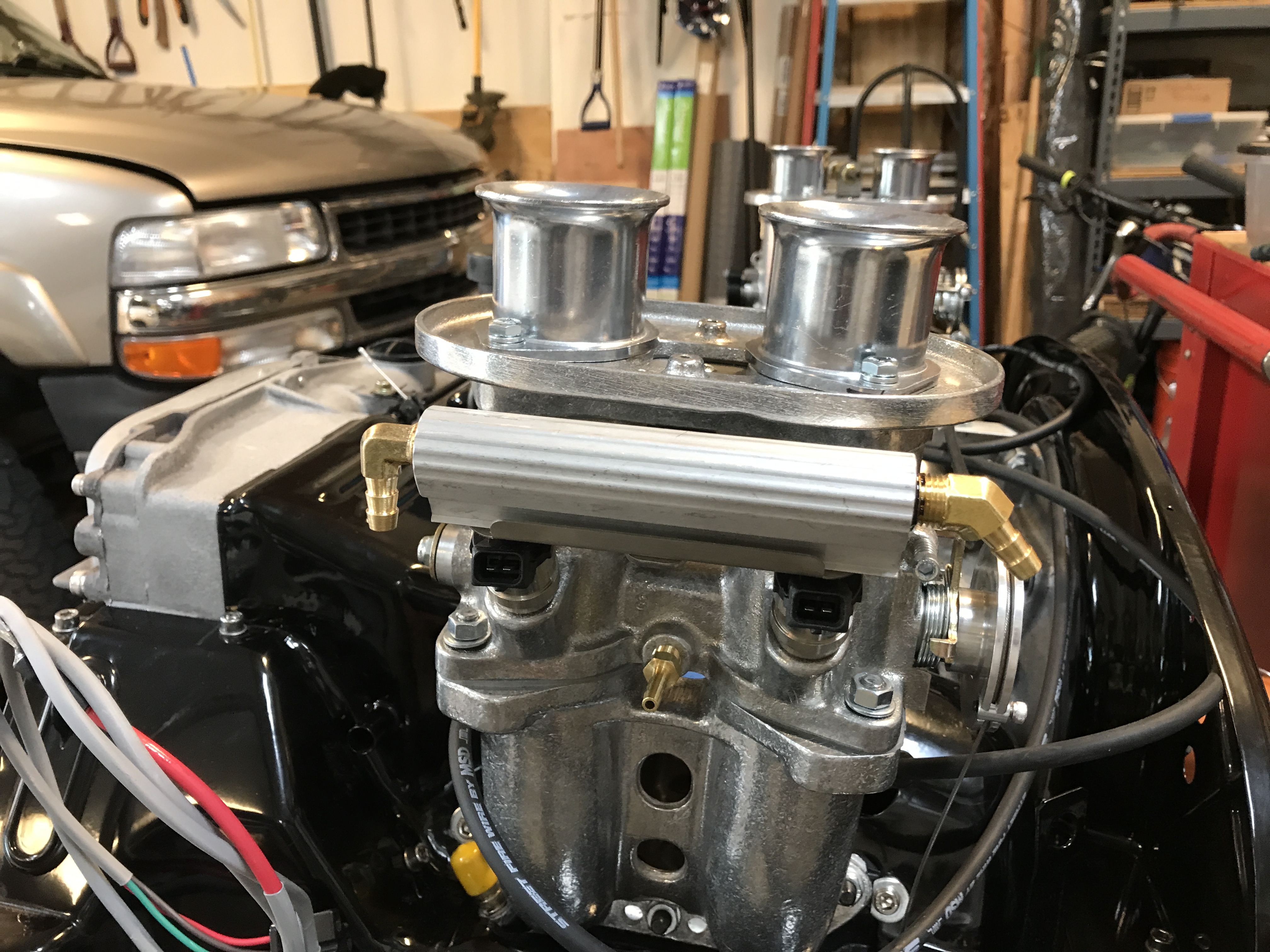

Fittings in place, both sides.

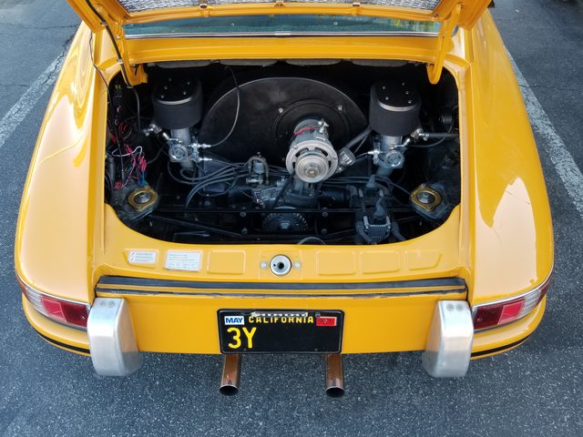

I have Dub Shop injection and spark kit on my 912 (modified original 616 motor) and it's top notch. Mario is a great guy, too.
(IMG:http://www.914world.com/bbs2/uploads_offsite/i.imgur.com-26060-1637728351.1.jpg)
(taken before I tidied-up the harness on the left)
(IMG:http://www.914world.com/bbs2/uploads_offsite/i.imgur.com-26060-1637728351.2.jpg)
Loving your work. Great thread!

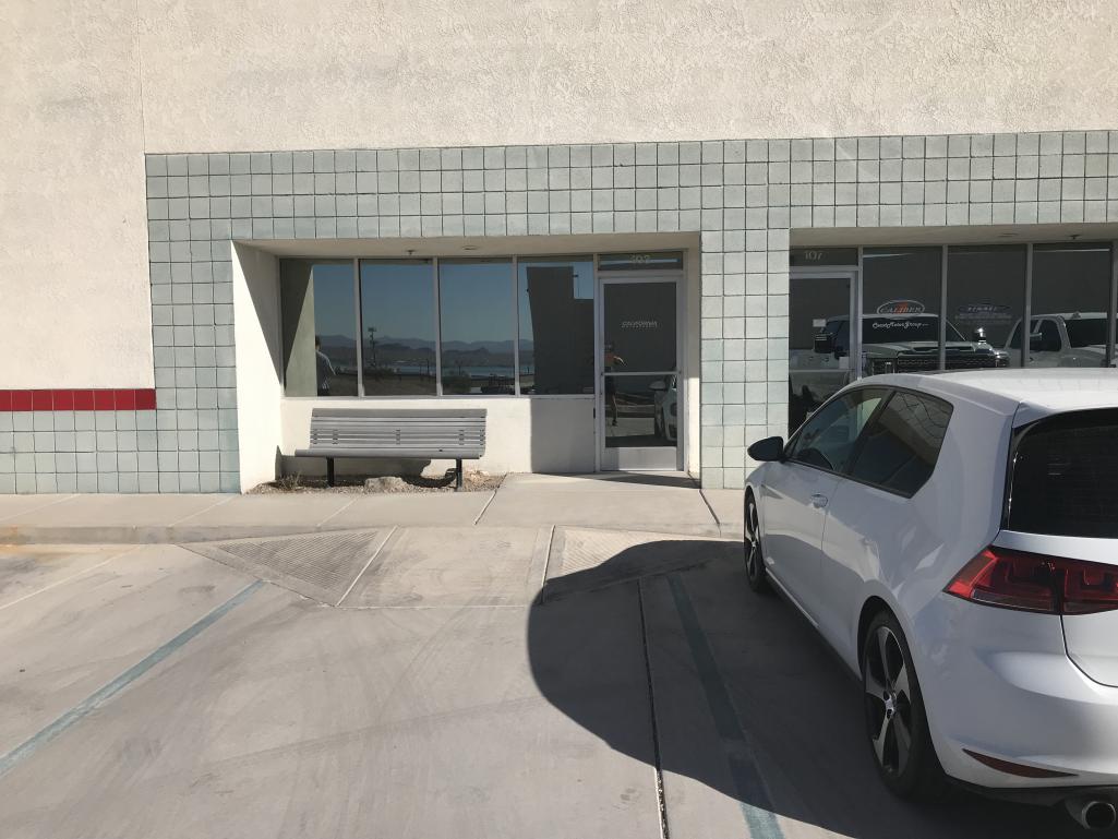

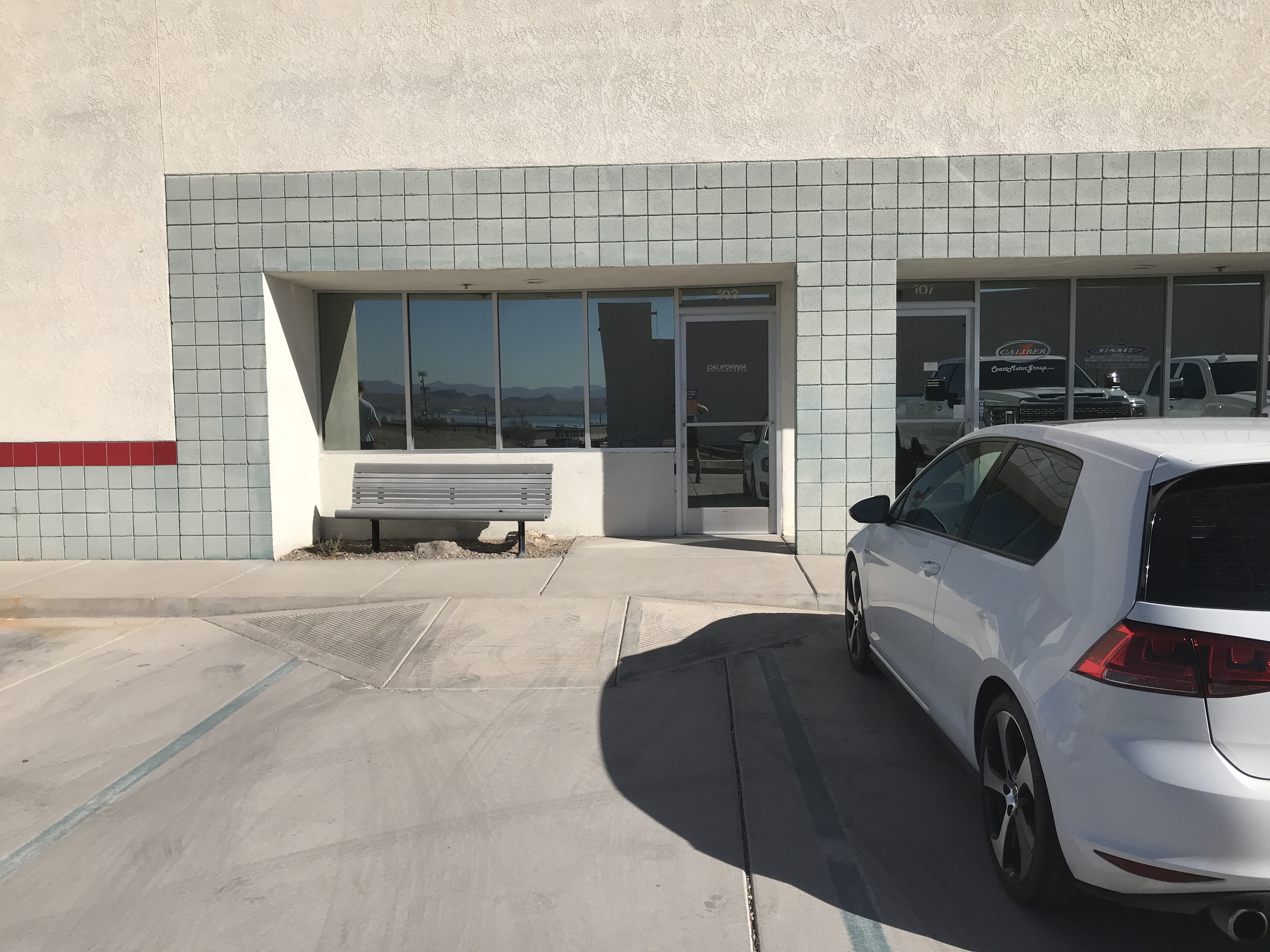

Any guess what this place is? Hint: not far from London bridge.

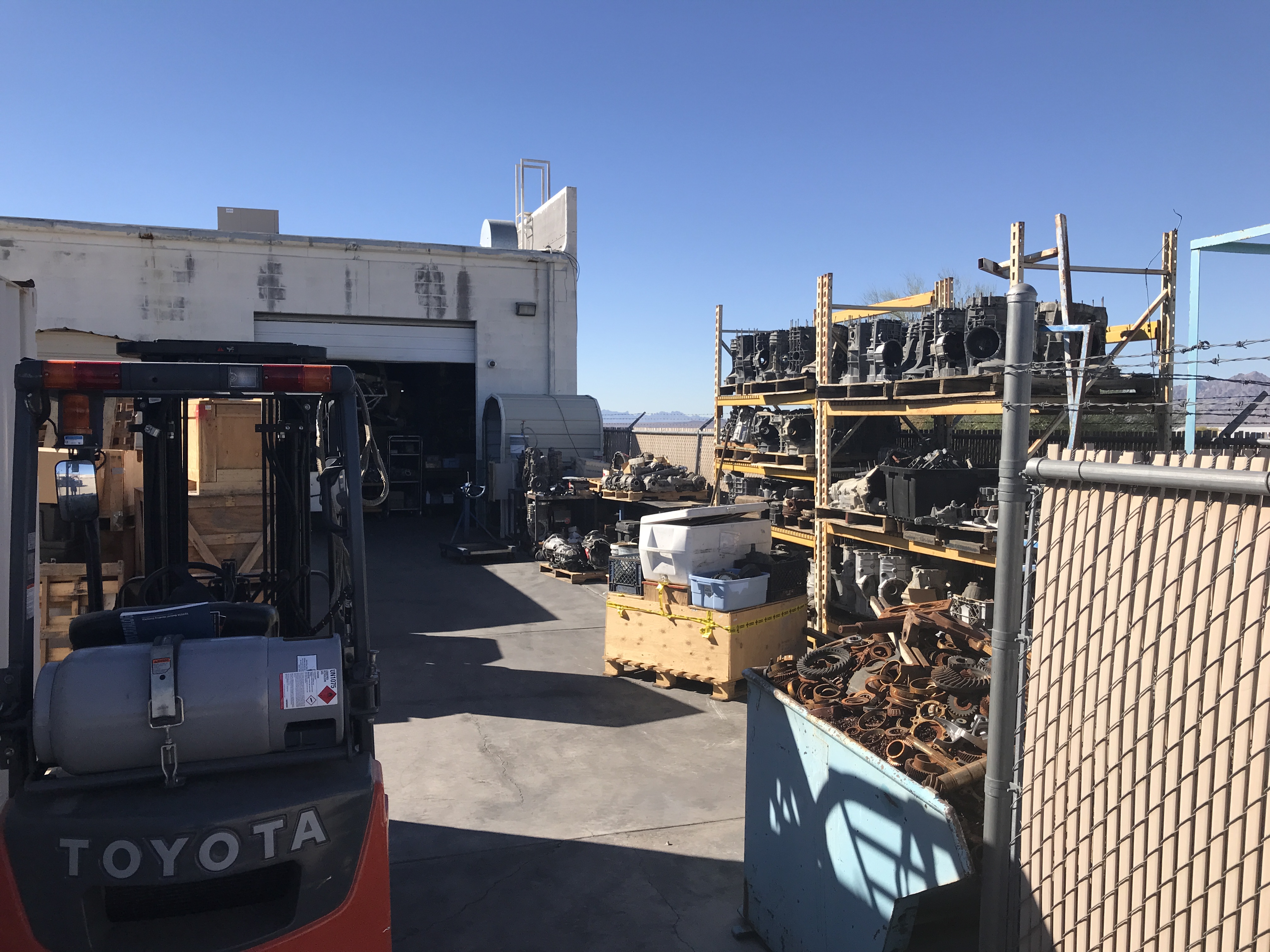

Here it is from the back.
Answer: California Motor Sports, in Lake Havasu City, Arizona. Home of the Porsche transaxle rebuild. Mine needed a bunch of replacement parts, including a new intermediate plate. They CNC machine these onsite.

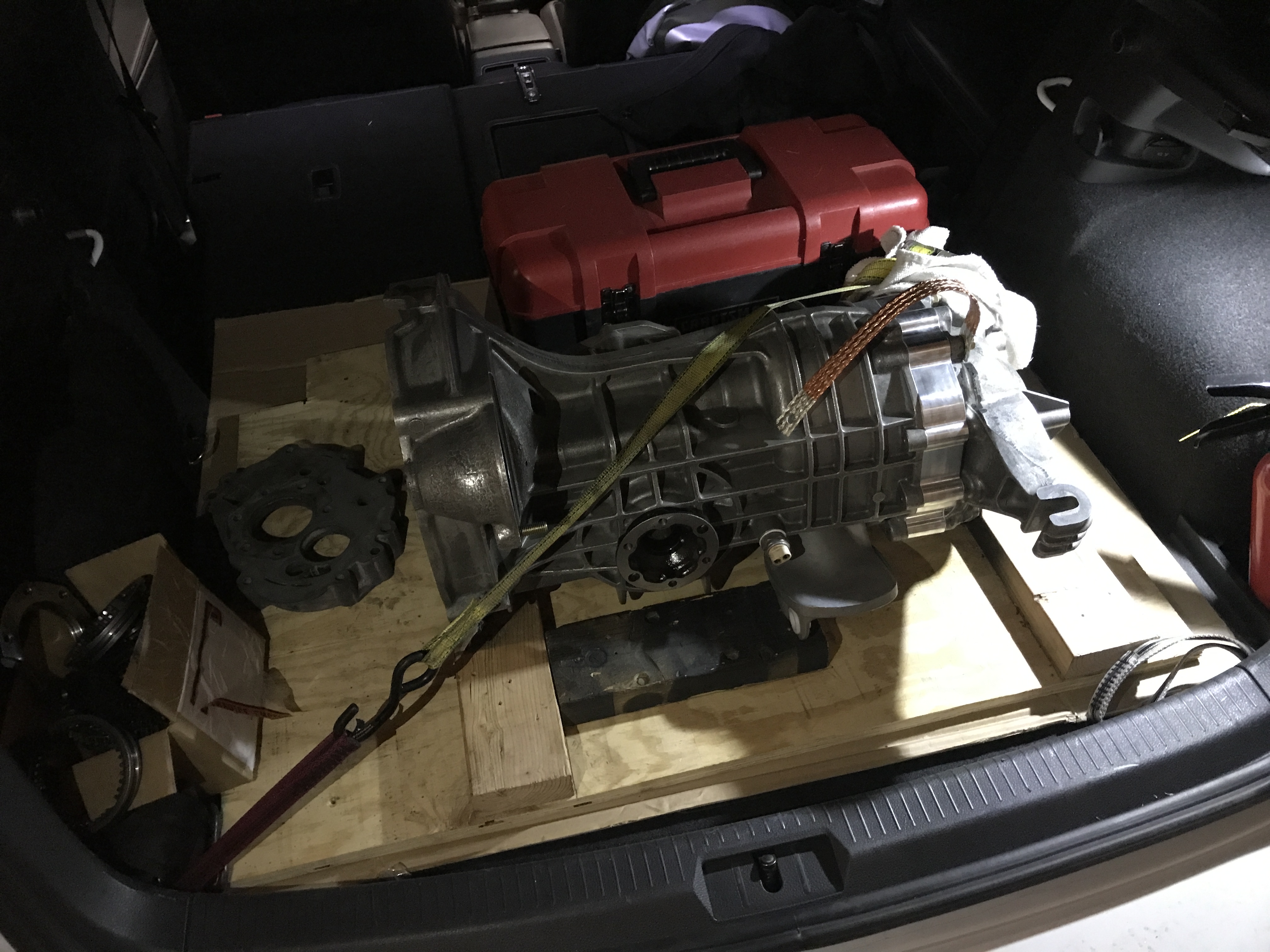

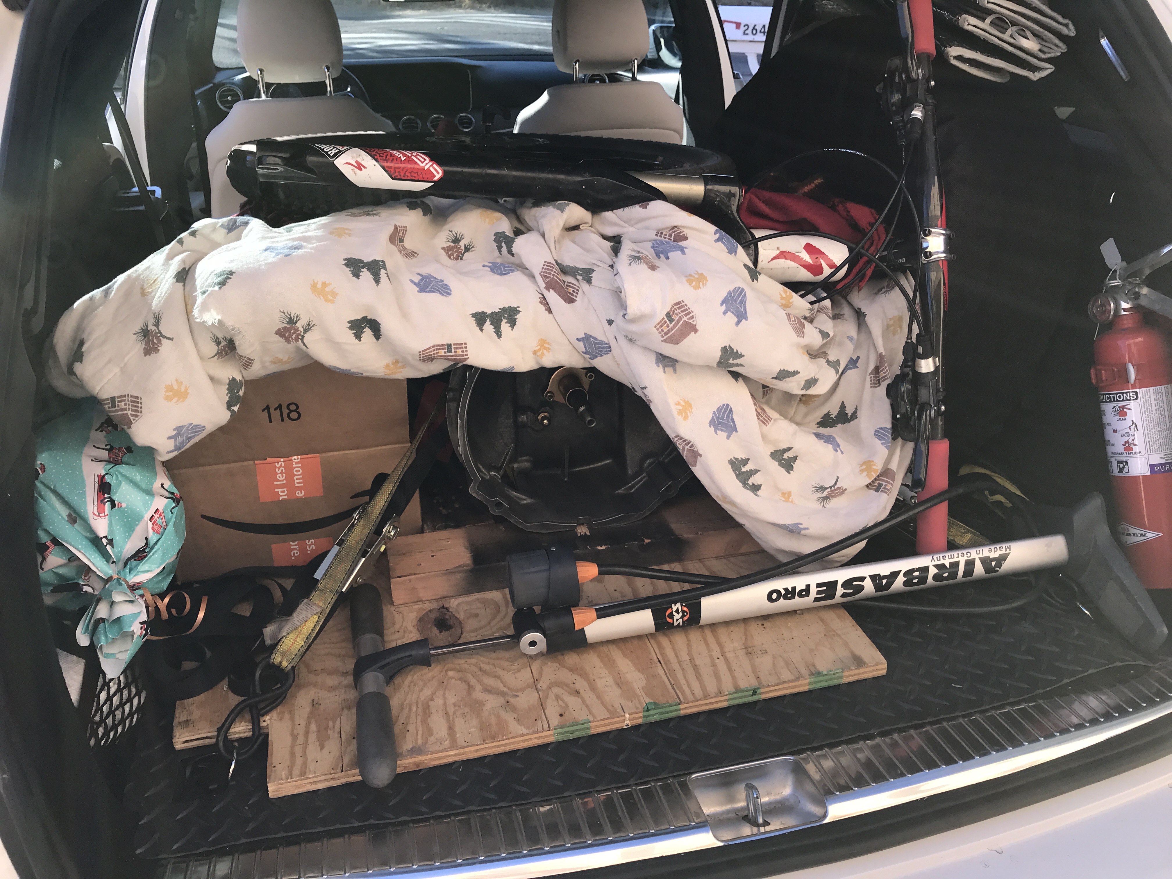

Here's my like-new box, strapped into my son's GTI for the trip to Tucson. Next week I will get it home, and get on with installation.

Forgot to include a picture of the bridge.
