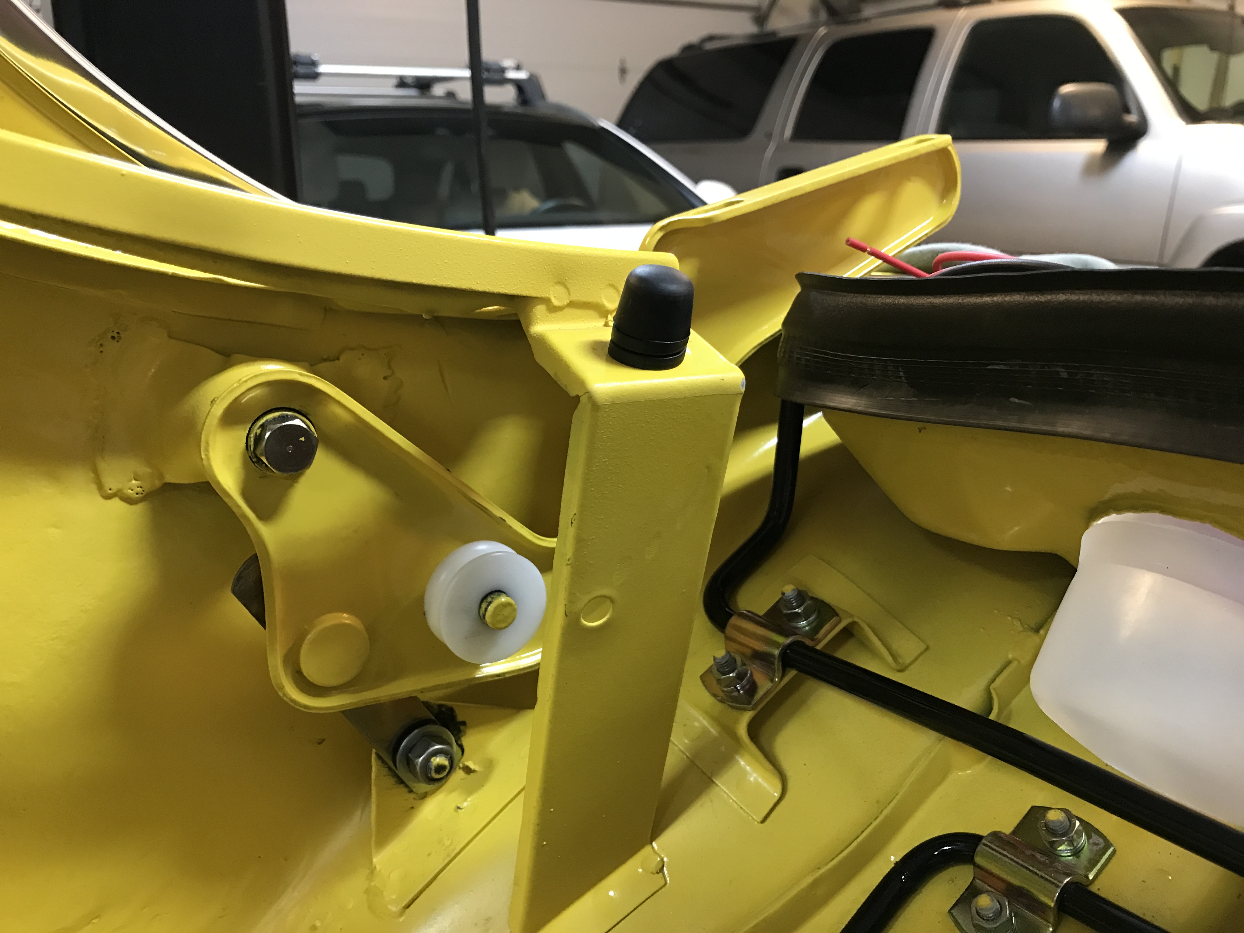

Hinges installed, with new hinge pins and rollers.

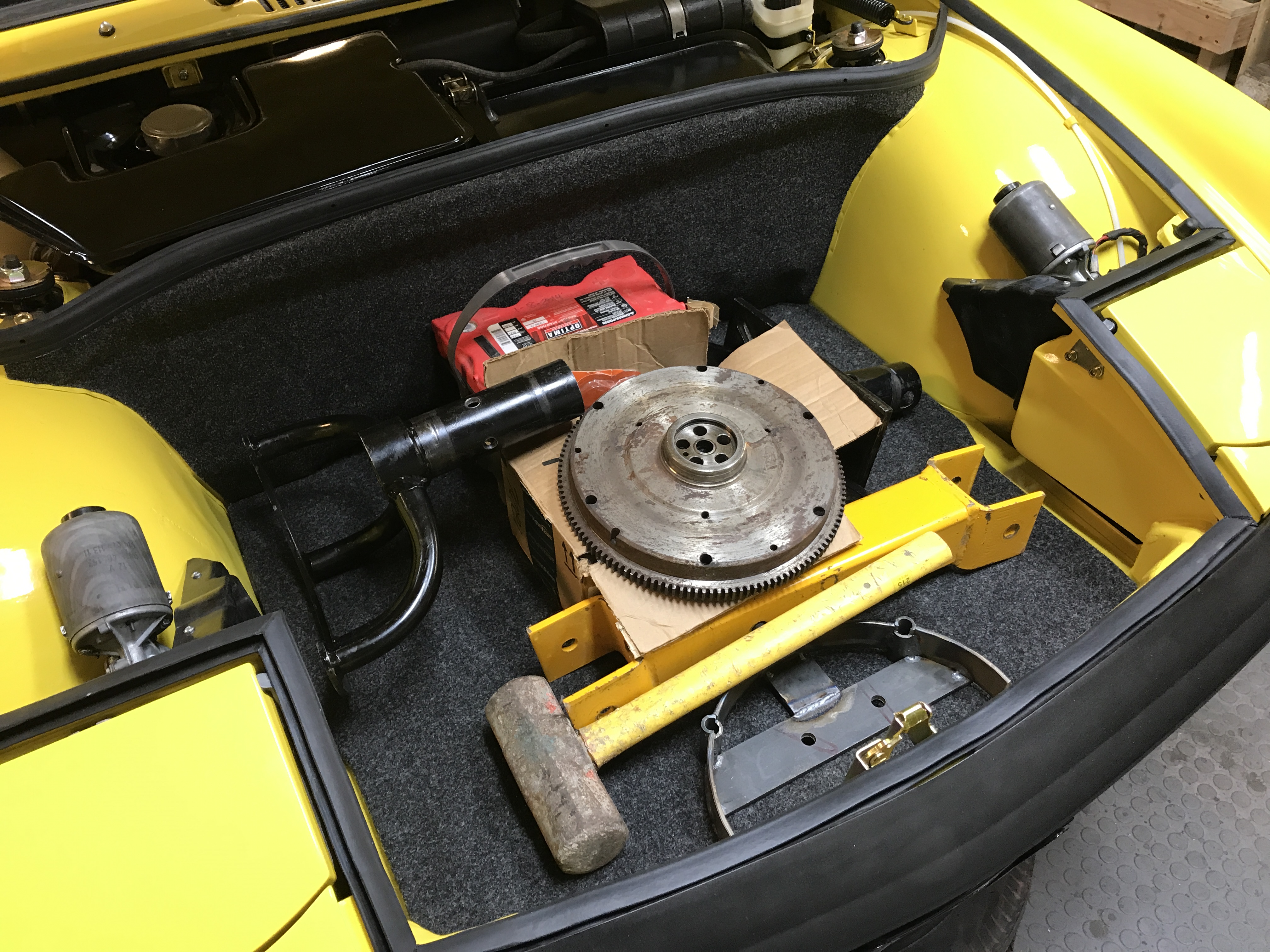

As recommended, I added some weight to the frunk to balance the weight of the engine and trans.

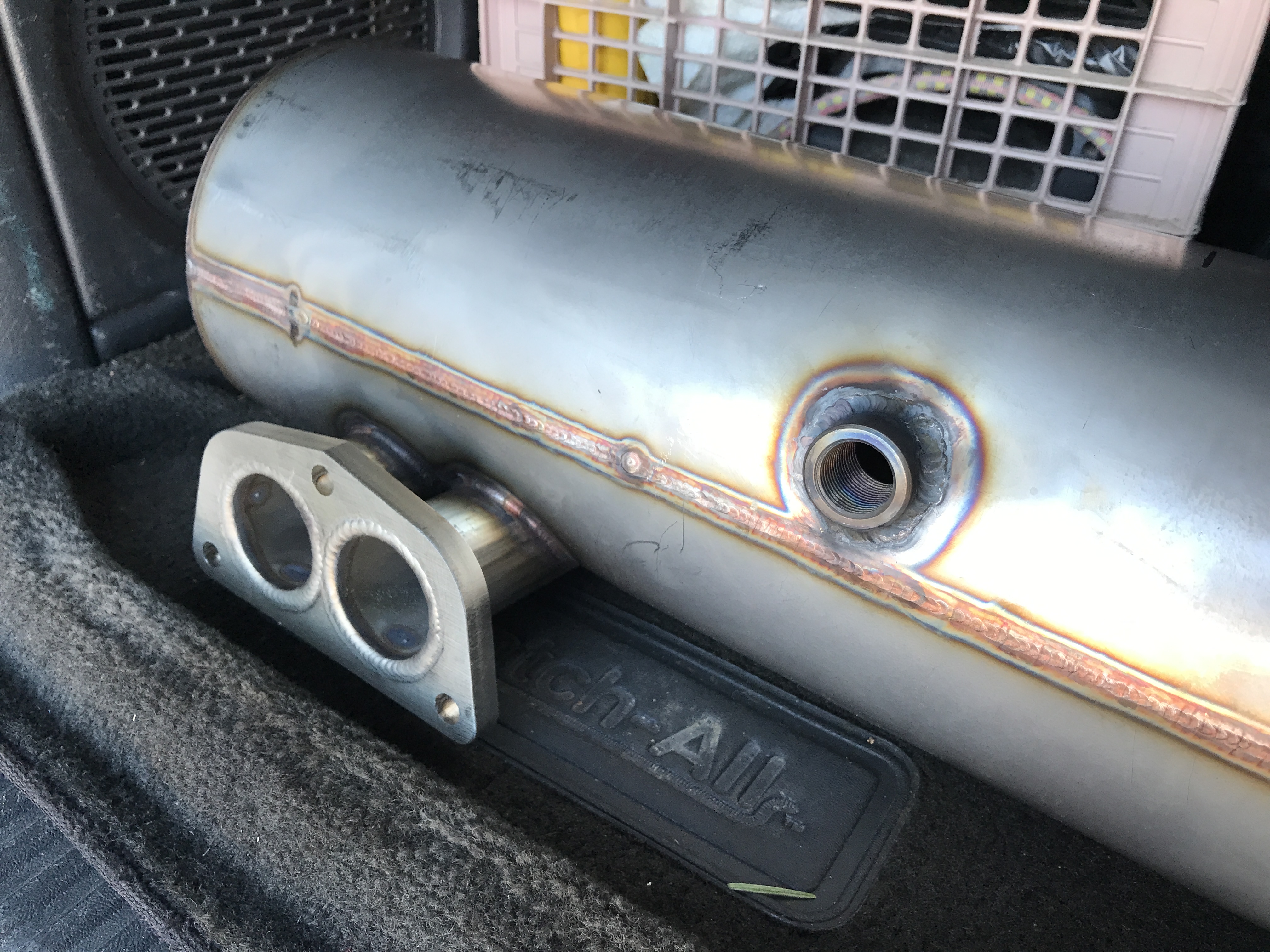

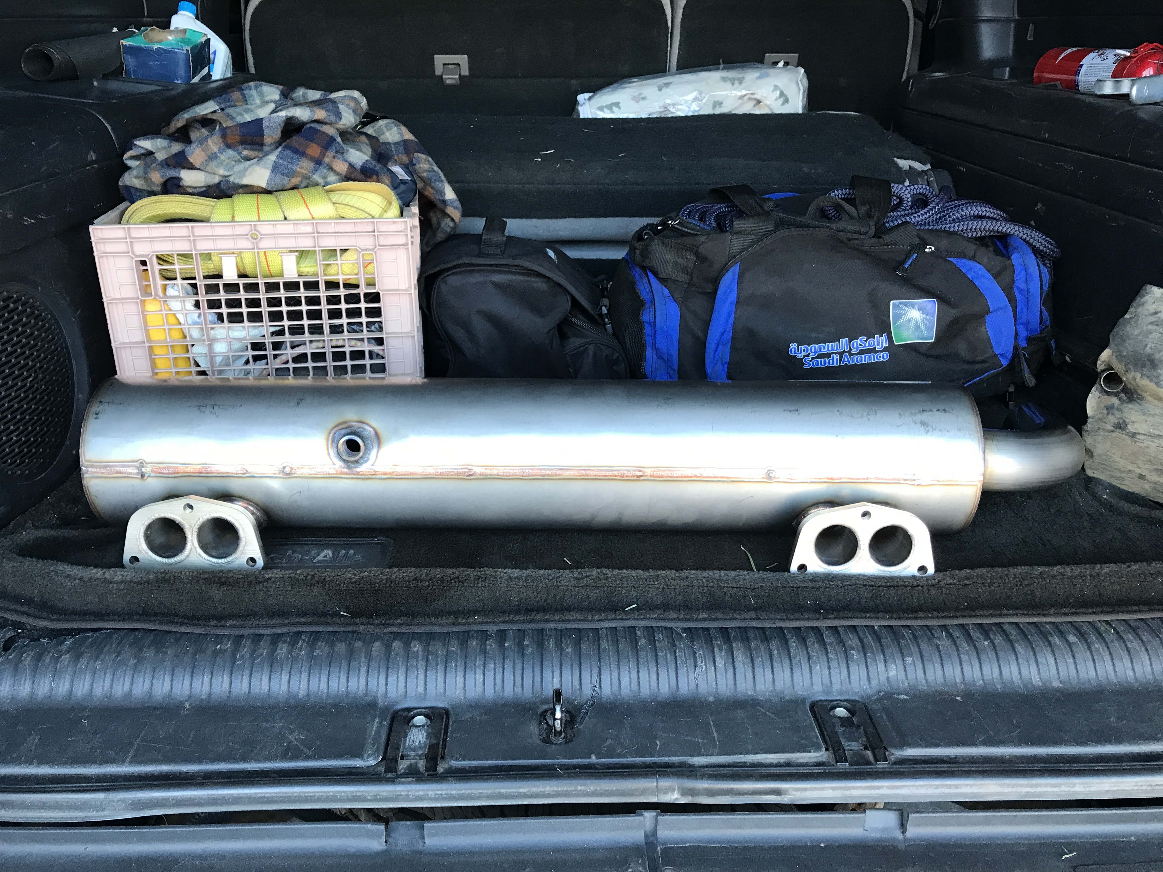

I also picked up my muffler at the weld shop.

It now has a stainless bung for the O2 sensor.

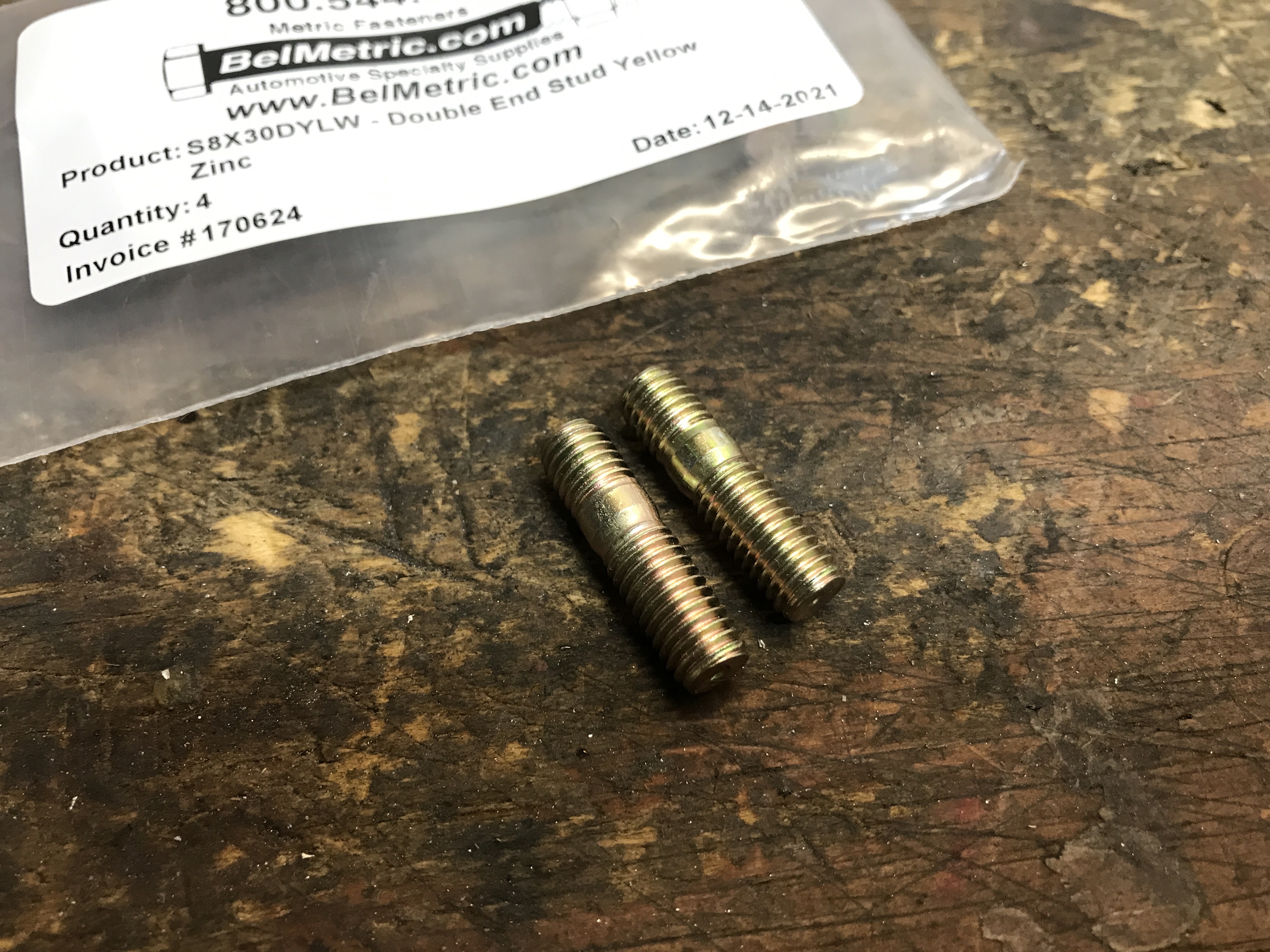

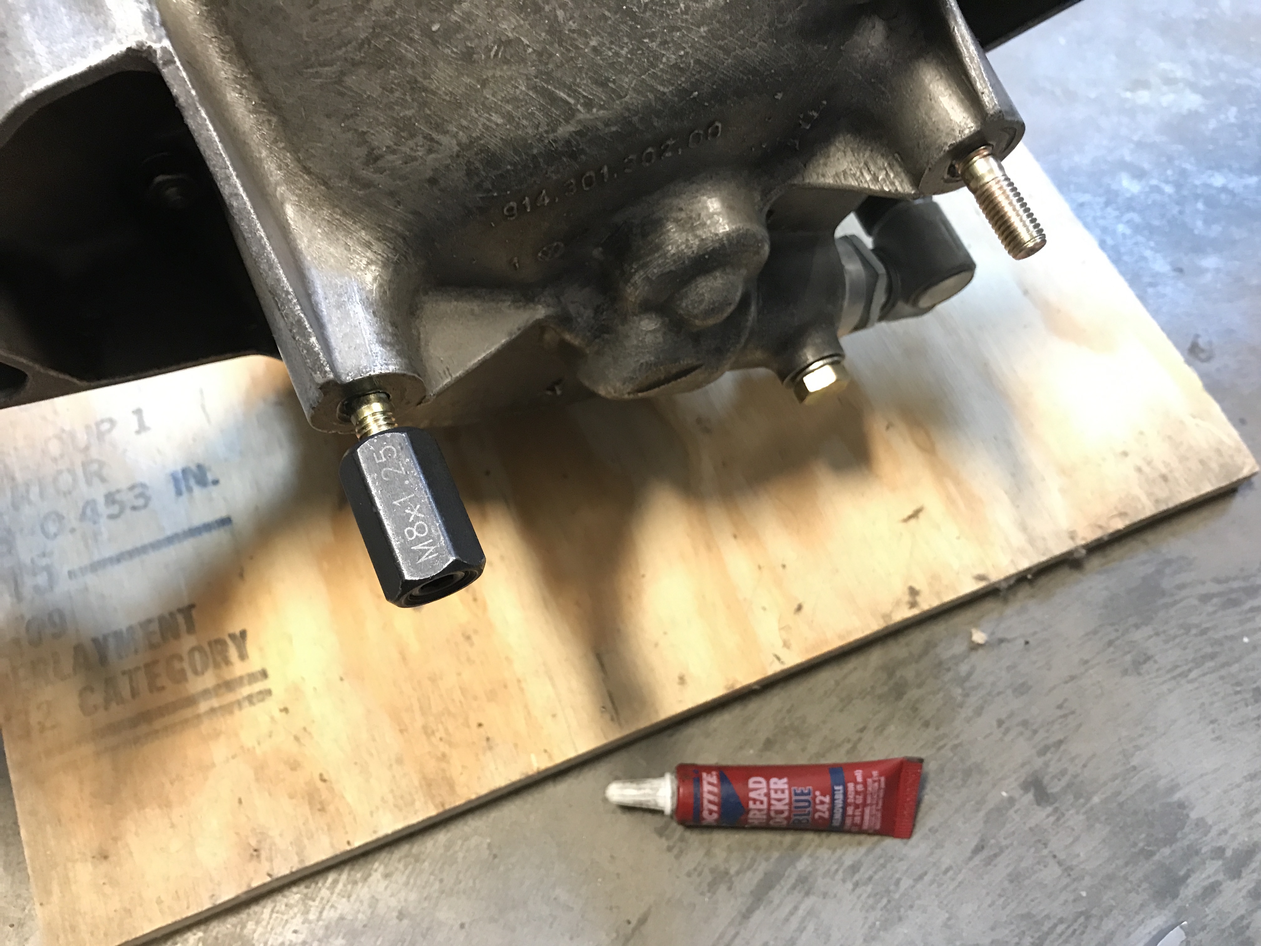

More part deliveries. Here are M8 studs for the back of the transaxle.
bkrantz
post Dec 18 2021, 08:42 PM
Post #4366
Posts: 8,347
Joined: 3-August 19
From: SW Colorado
Member No.: 23,343
Got out my stud install kit again, and installed each stud with a dab of Loctite.

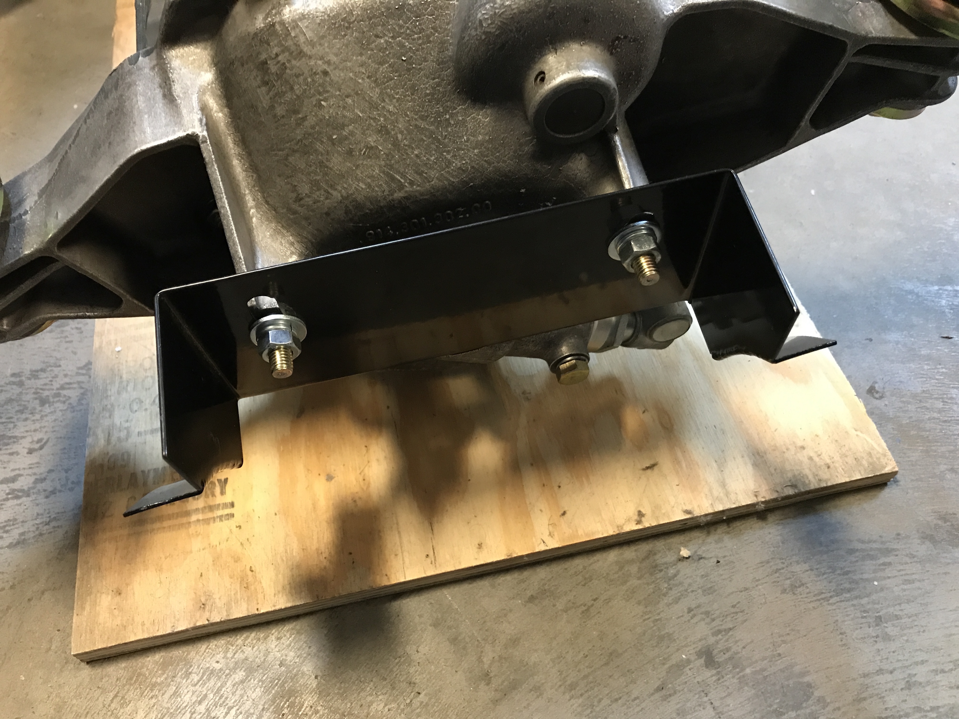

Member No.: 23,343
I then installed the custom bracket that came with my Mcfarland muffler.

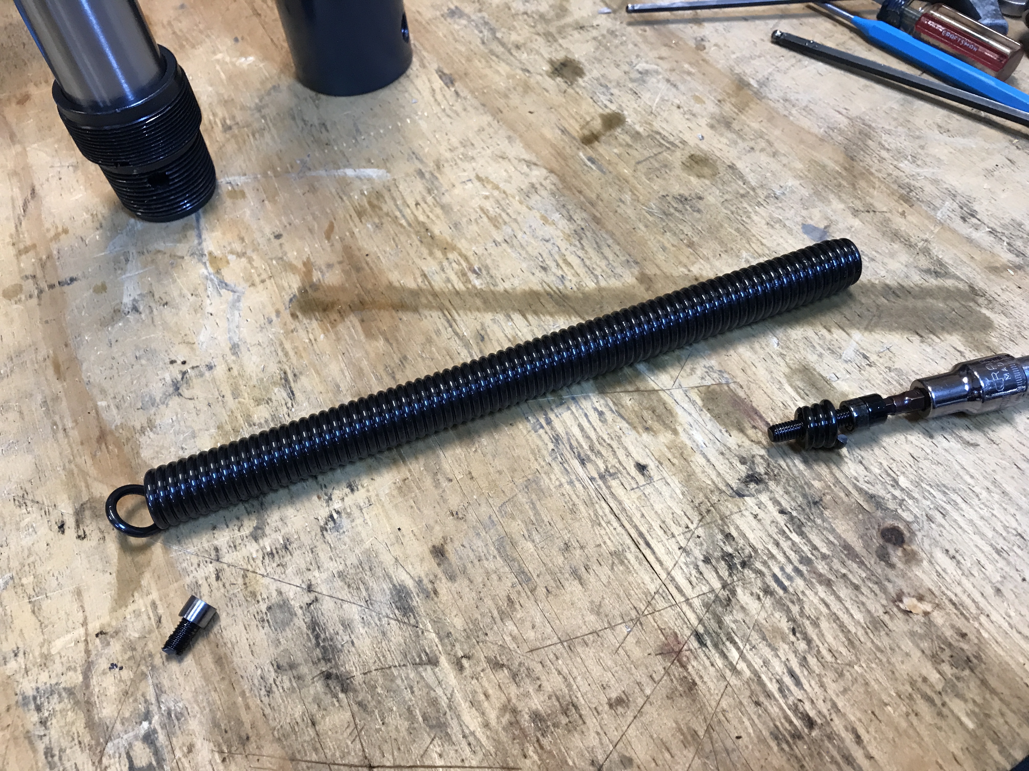

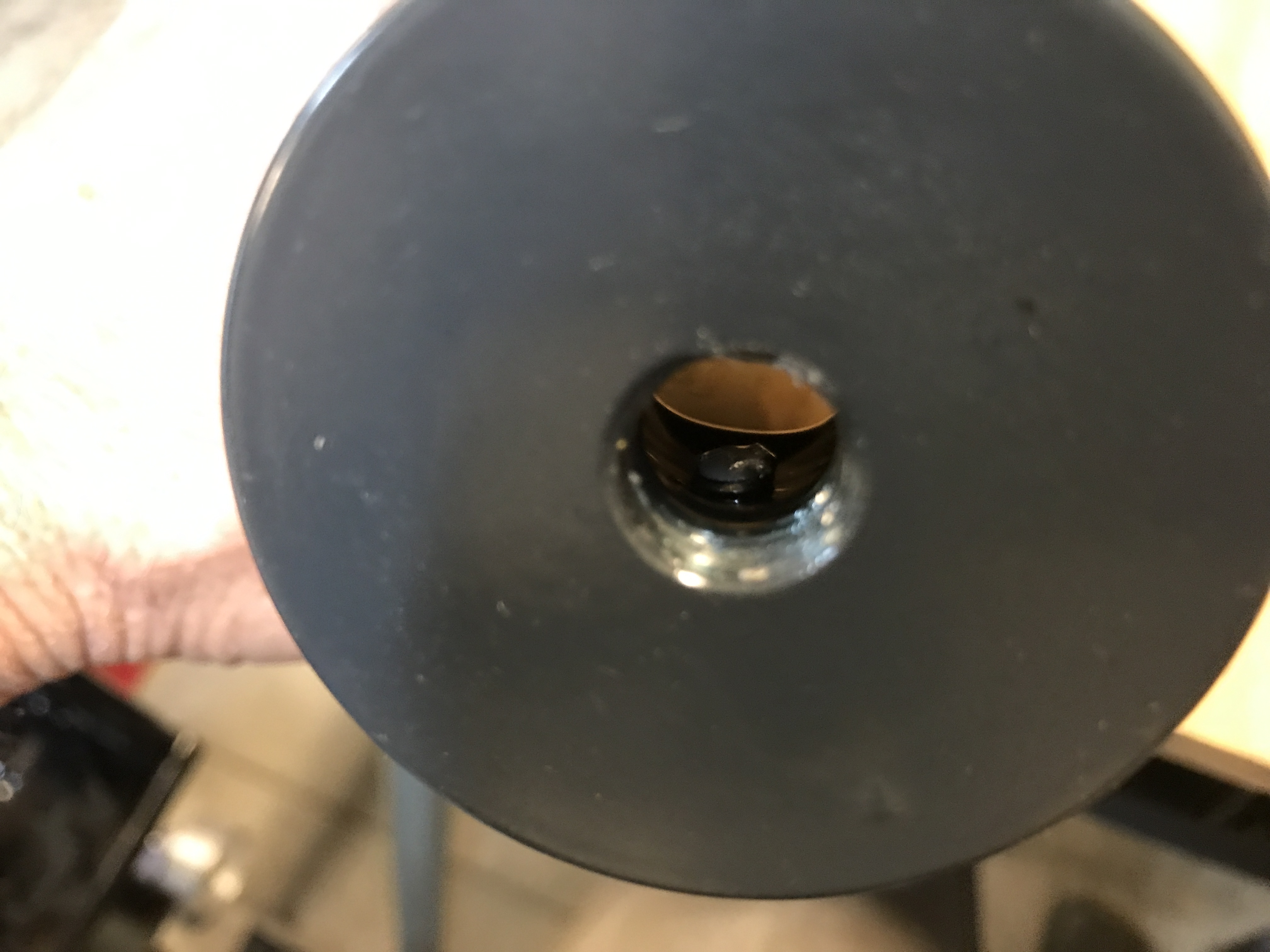

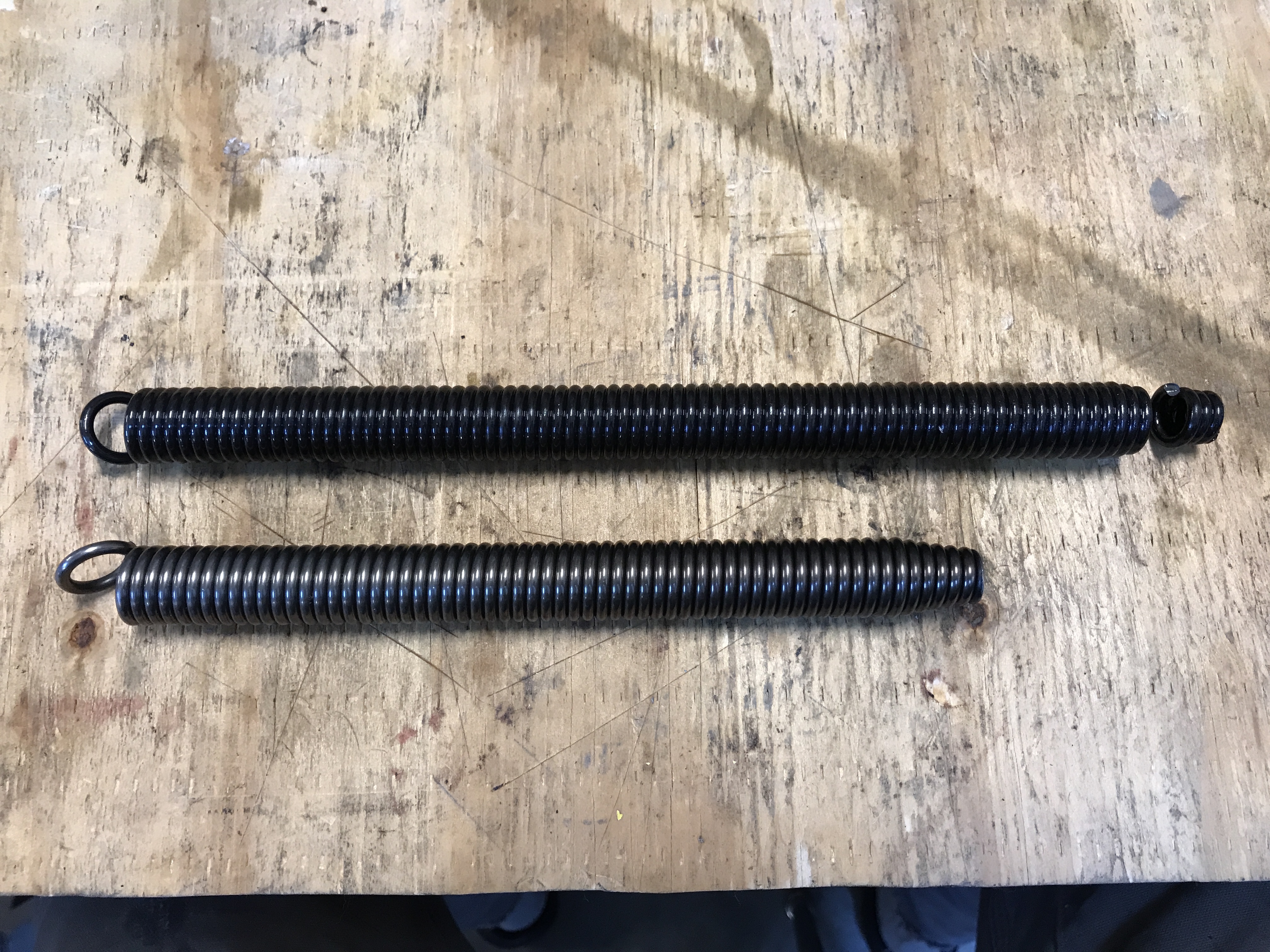

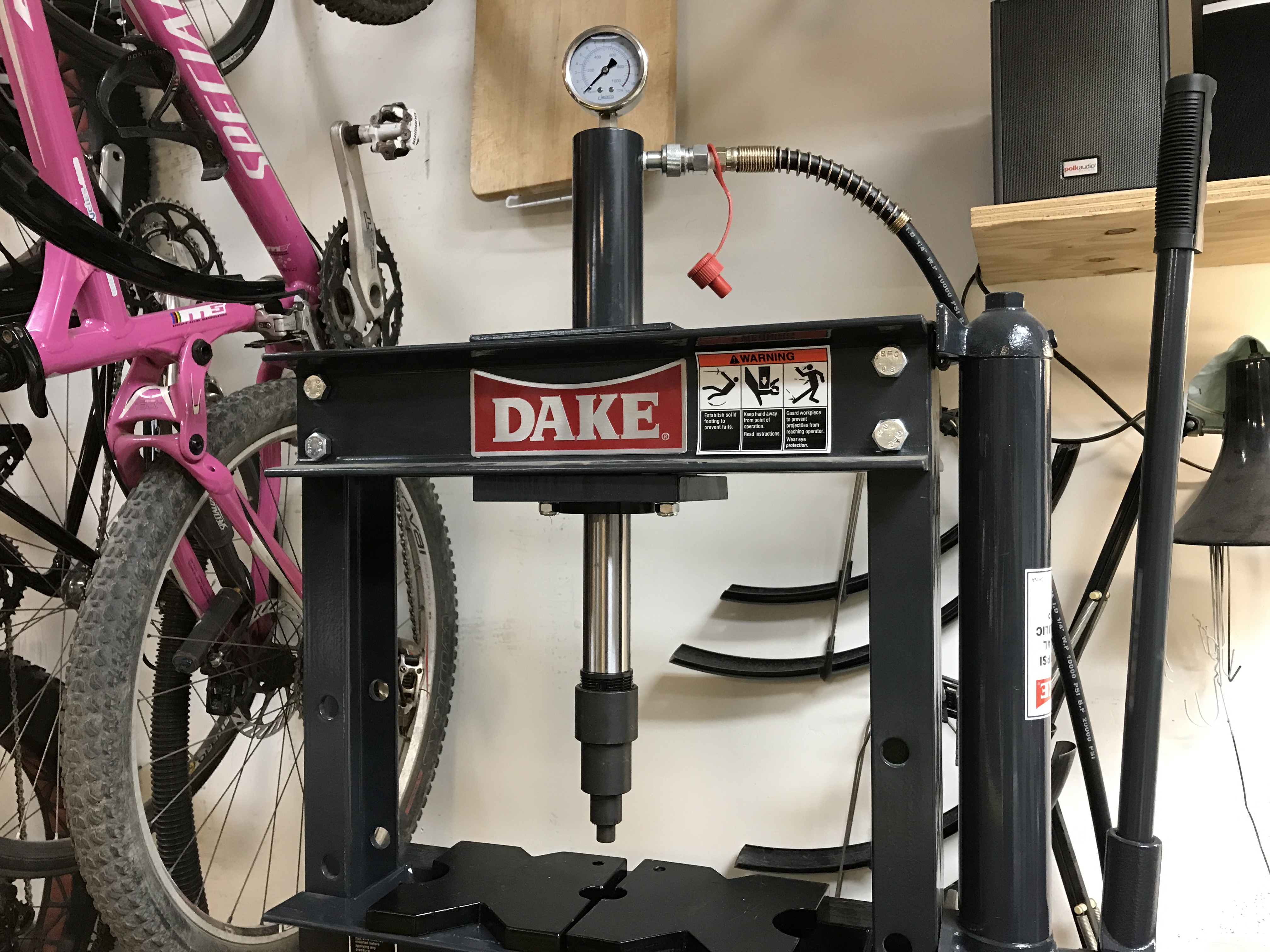

I then got sidetracked. My hydraulic press piston stopped returning when I released the pressure valve. The most likely culprit was a broken return spring, so I ordered a replacement from Dake.
bkrantz
post Dec 18 2021, 08:49 PM
Post #4369
Posts: 8,347
Joined: 3-August 19
From: SW Colorado
Member No.: 23,343
Sure enough, the bottom of the spring was broken off. But the upper retaining bolt was also broken in half.

I then spent 30 minutes removing the rest of the broken bolt, mostly by tapping the side with a punch to make it spin lefty-loosey.

OK, all set to rebuild the piston with the new spring, but...the replacement is 2 inches shorter than the original. And I was planning to use the press for the next task today. Gotta improvise to stay on schedule.

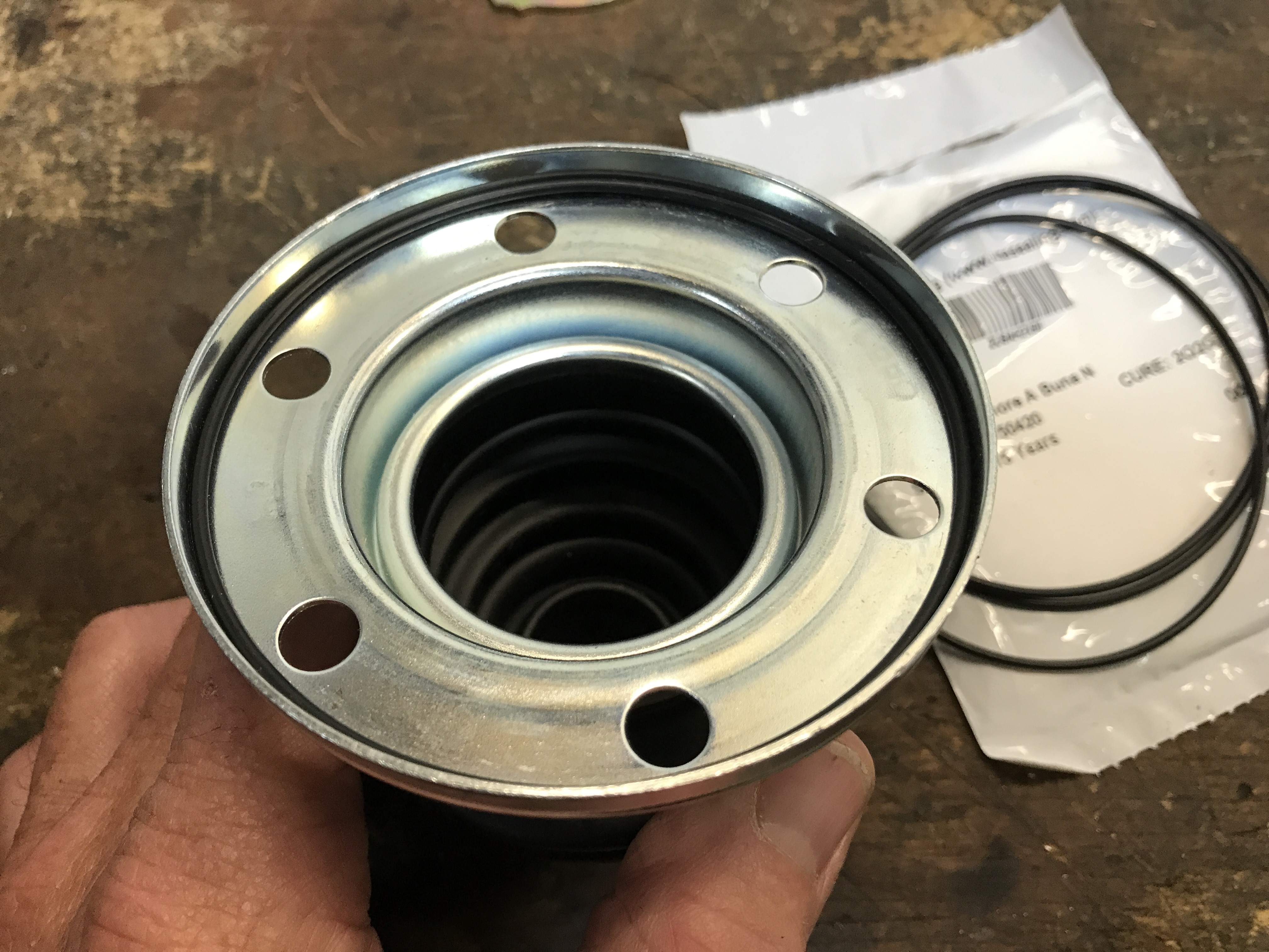

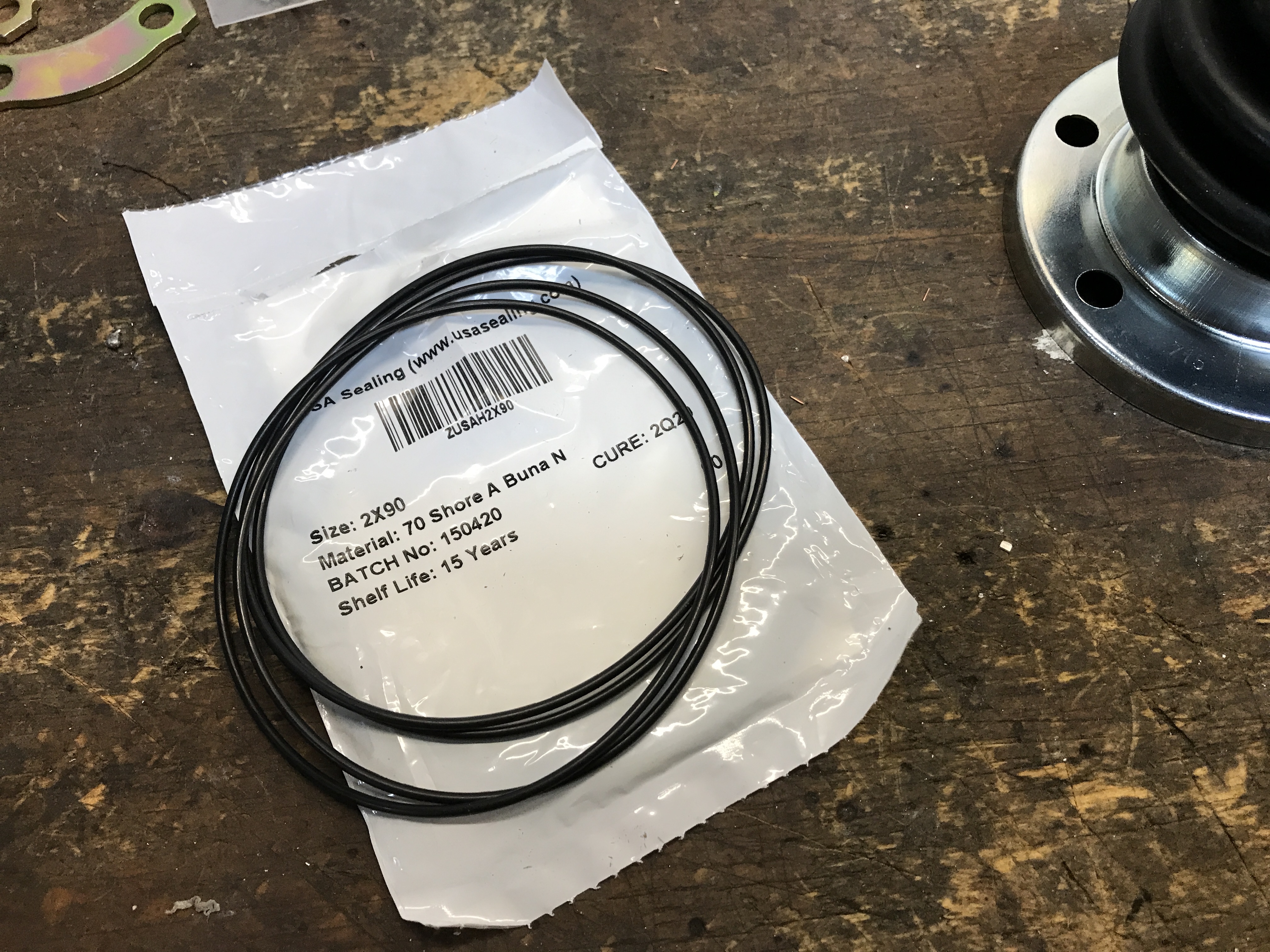

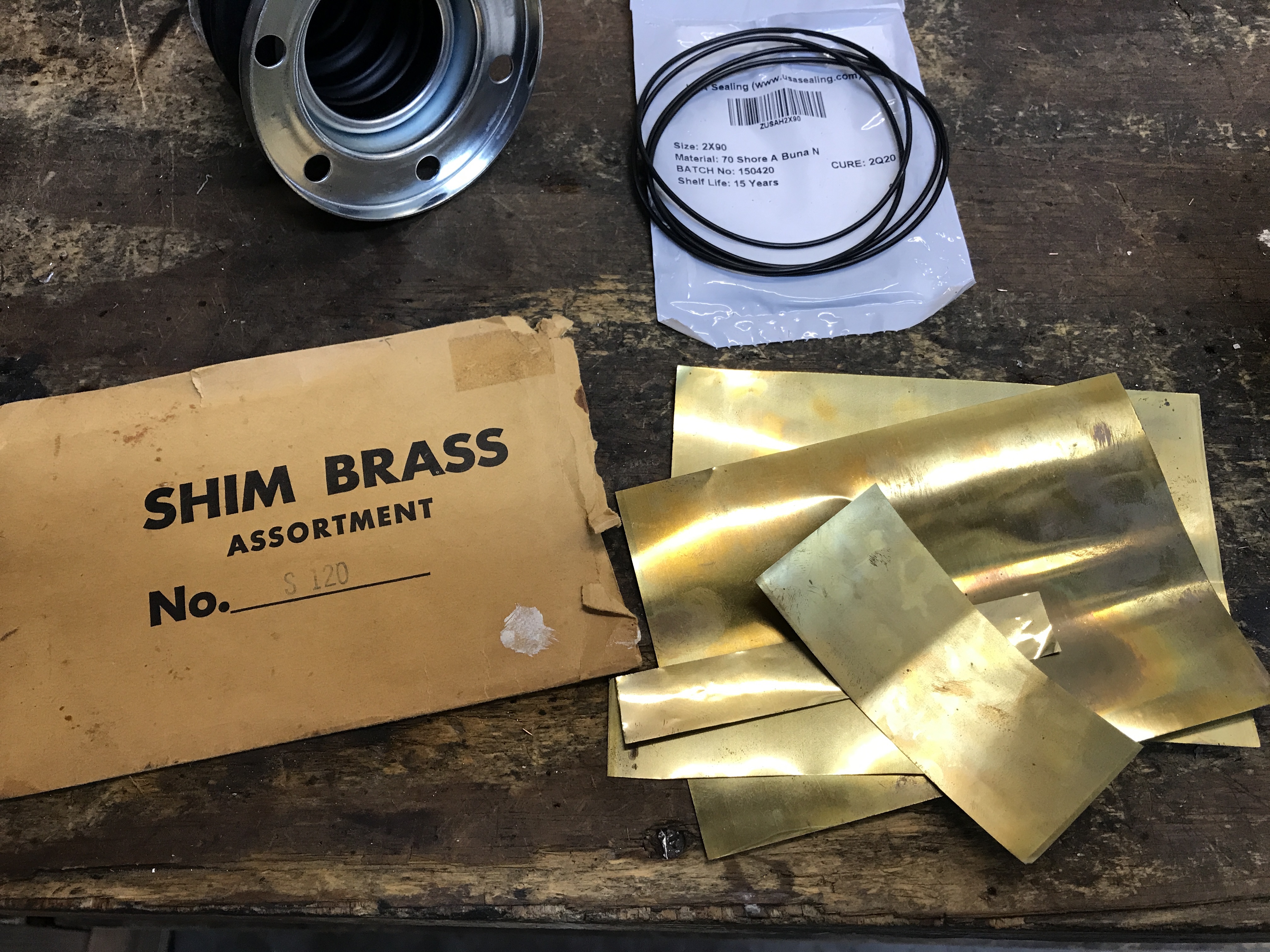

I also got bi O-rings to seal the CV joint boot flanges. These are 90 mm ID and 2 mm thick, from McMaster-Carr.
bkrantz
post Dec 18 2021, 08:58 PM
Post #4373
Posts: 8,347
Joined: 3-August 19
From: SW Colorado
Member No.: 23,343
They fit just right!

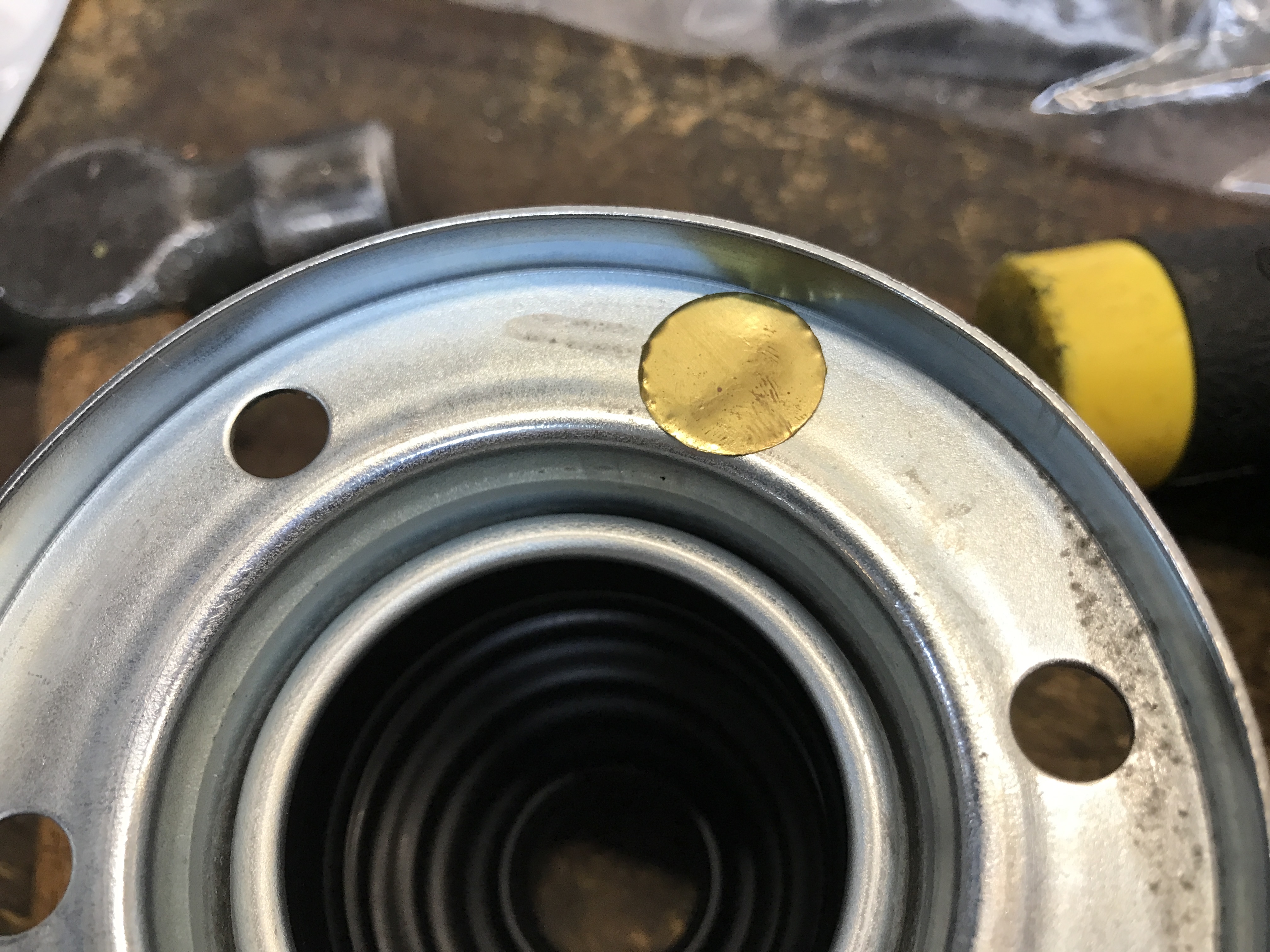

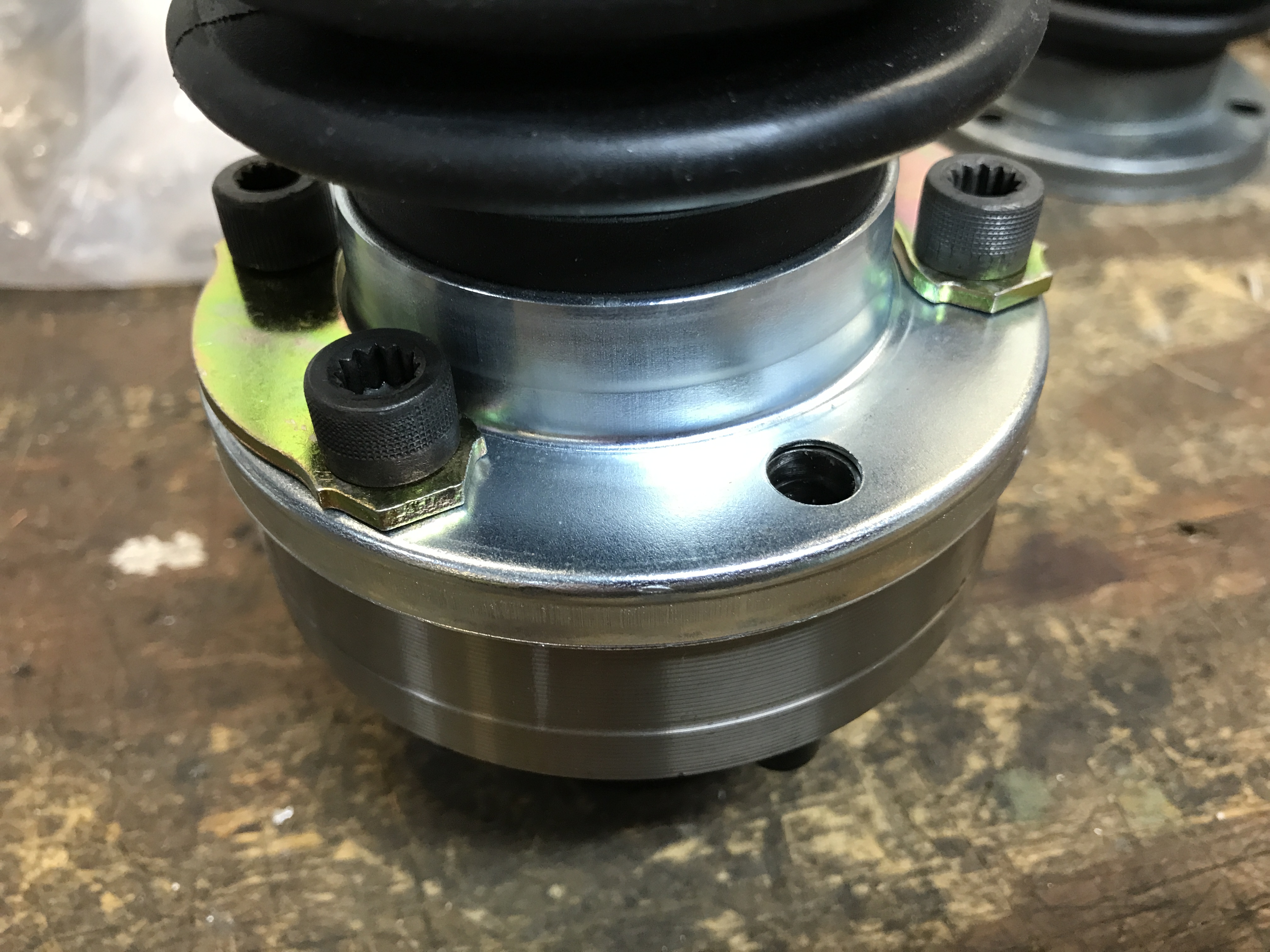

Maybe its me (definitely) but the extra holes in the Type 1 CV boot flanges bother me. In the 914 application, these holes correspond to locating pins, not bolts.
bkrantz
post Dec 18 2021, 09:01 PM
Post #4375
Posts: 8,347
Joined: 3-August 19
From: SW Colorado

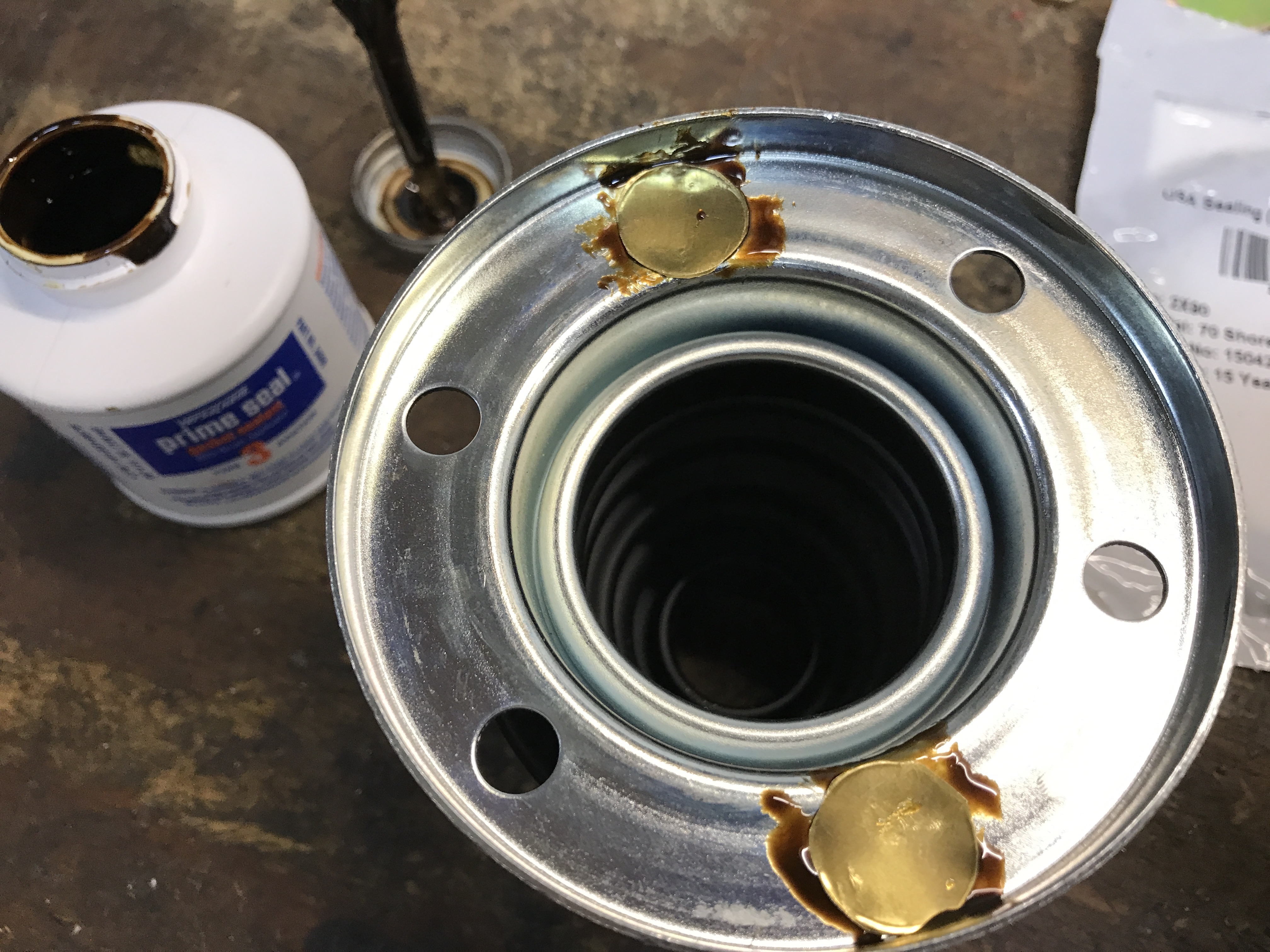

Member No.: 23,343
So I got out some brass shim material.
bkrantz
post Dec 18 2021, 09:02 PM
Post #4376
Posts: 8,347
Joined: 3-August 19
From: SW Colorado
Member No.: 23,343
And made interior covers for the extra holes.
bkrantz
Post #4377
Posts: 8,347
Joined: 3-August 19
From: SW Colorado
Member No.: 23,343
And then glued them in place with aviation sealant.

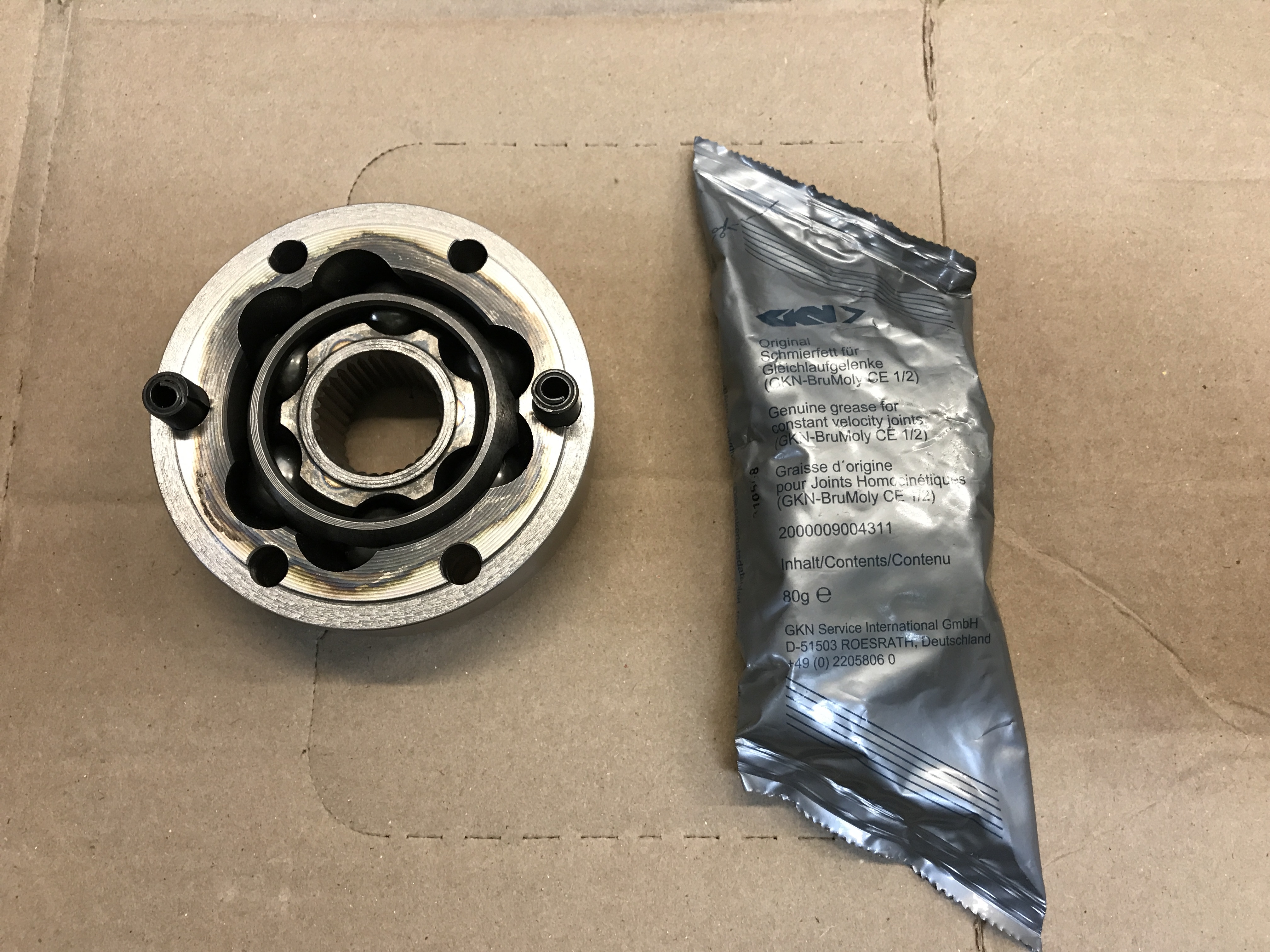

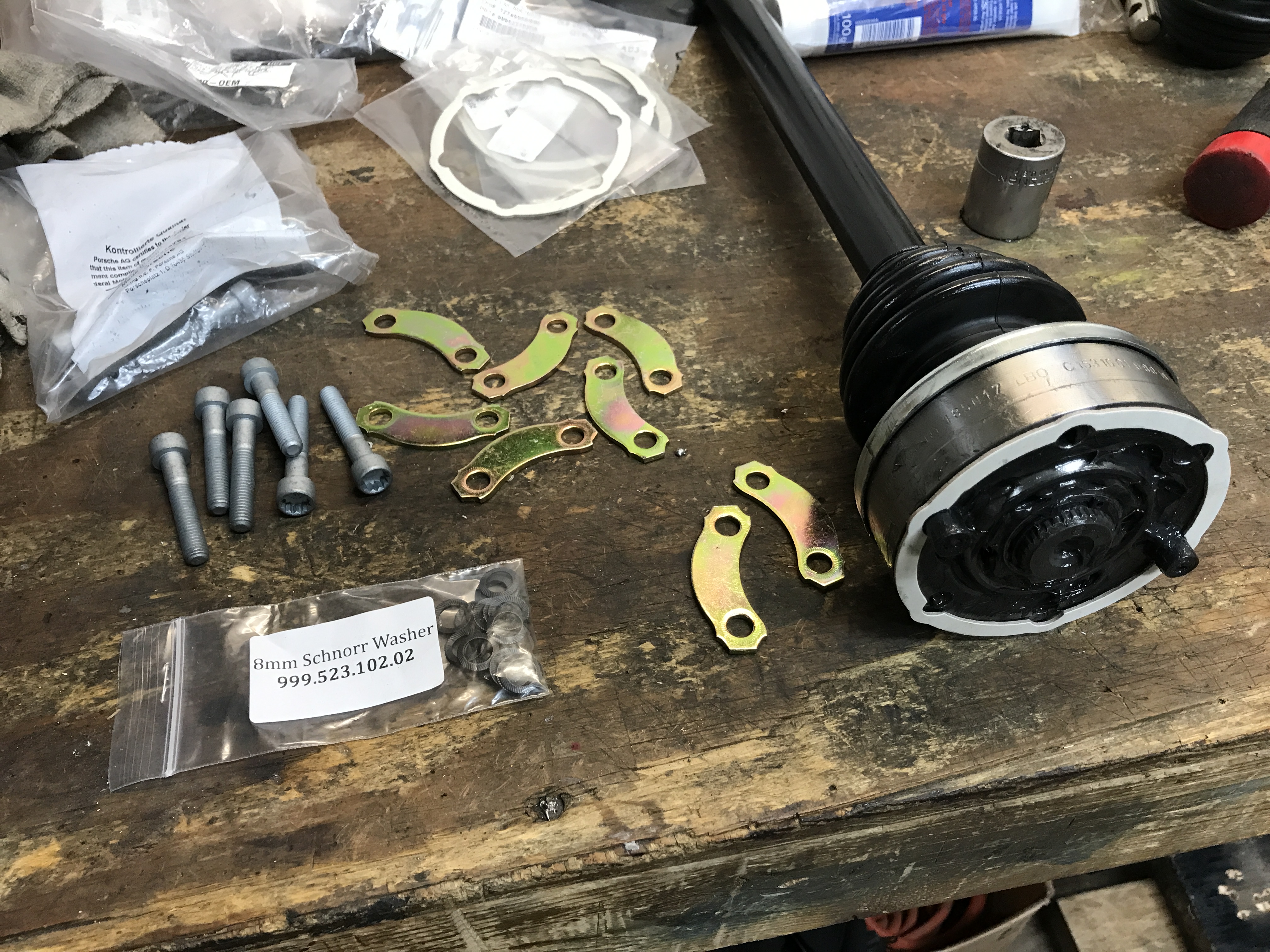

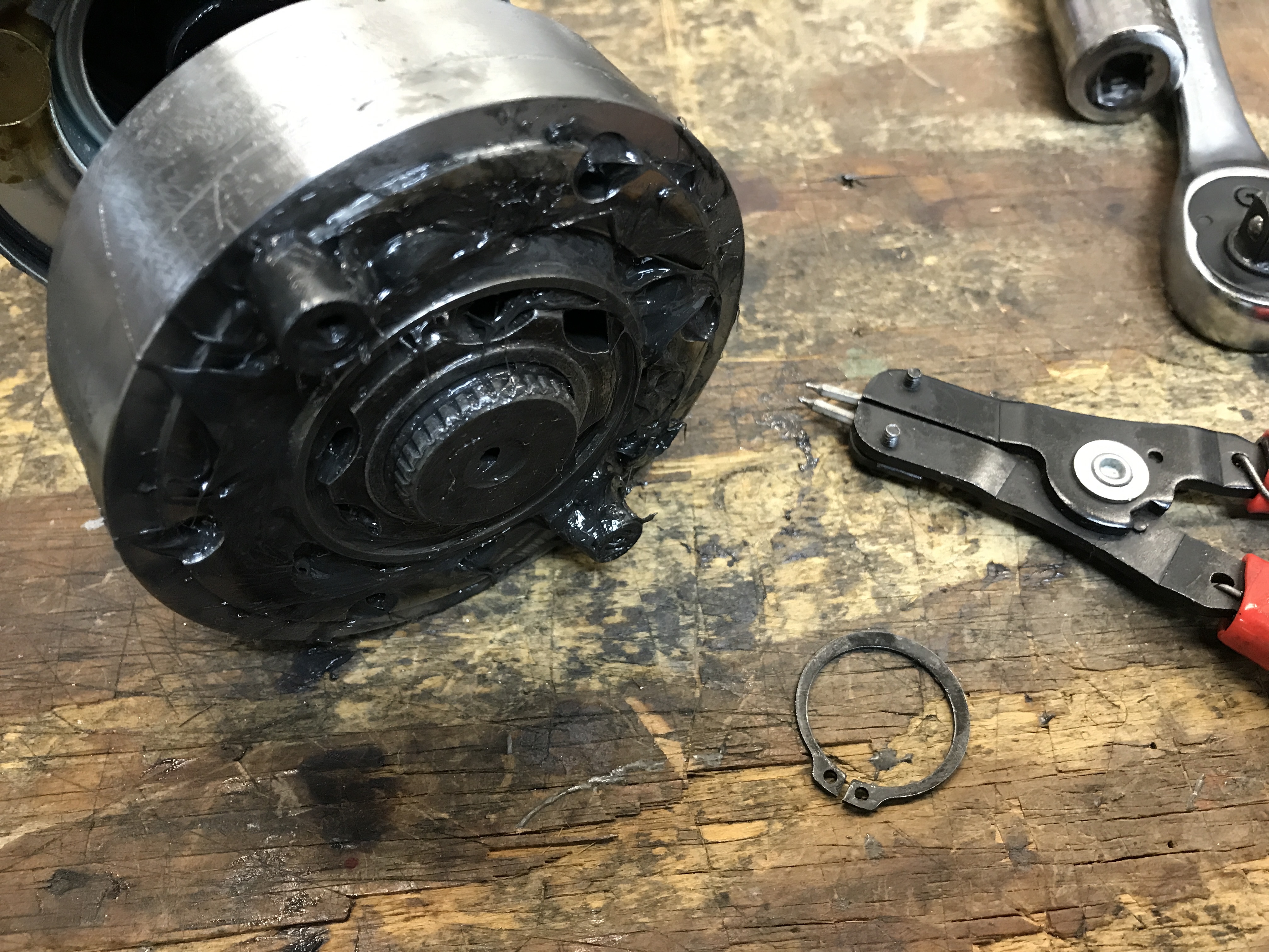

OK, on with assembly. First, to lube all the CV joints with the grease that came in the GKN kits. A slightly messy job.
bkrantz
post Dec 18 2021, 09:10 PM
Post #4379
Posts: 8,347
Joined: 3-August 19
From: SW Colorado
Member No.: 23,343
So, with a new O-ring in the boot flange, and a flattened conical washer I tapped the CV joint onto the axle.
bkrantz
post Dec 18 2021, 09:12 PM
Post #4380
Posts: 8,347
Joined: 3-August 19
From: SW Colorado
Member No.: 23,343
I ended up using the split ring retainer, which fit exactly.
