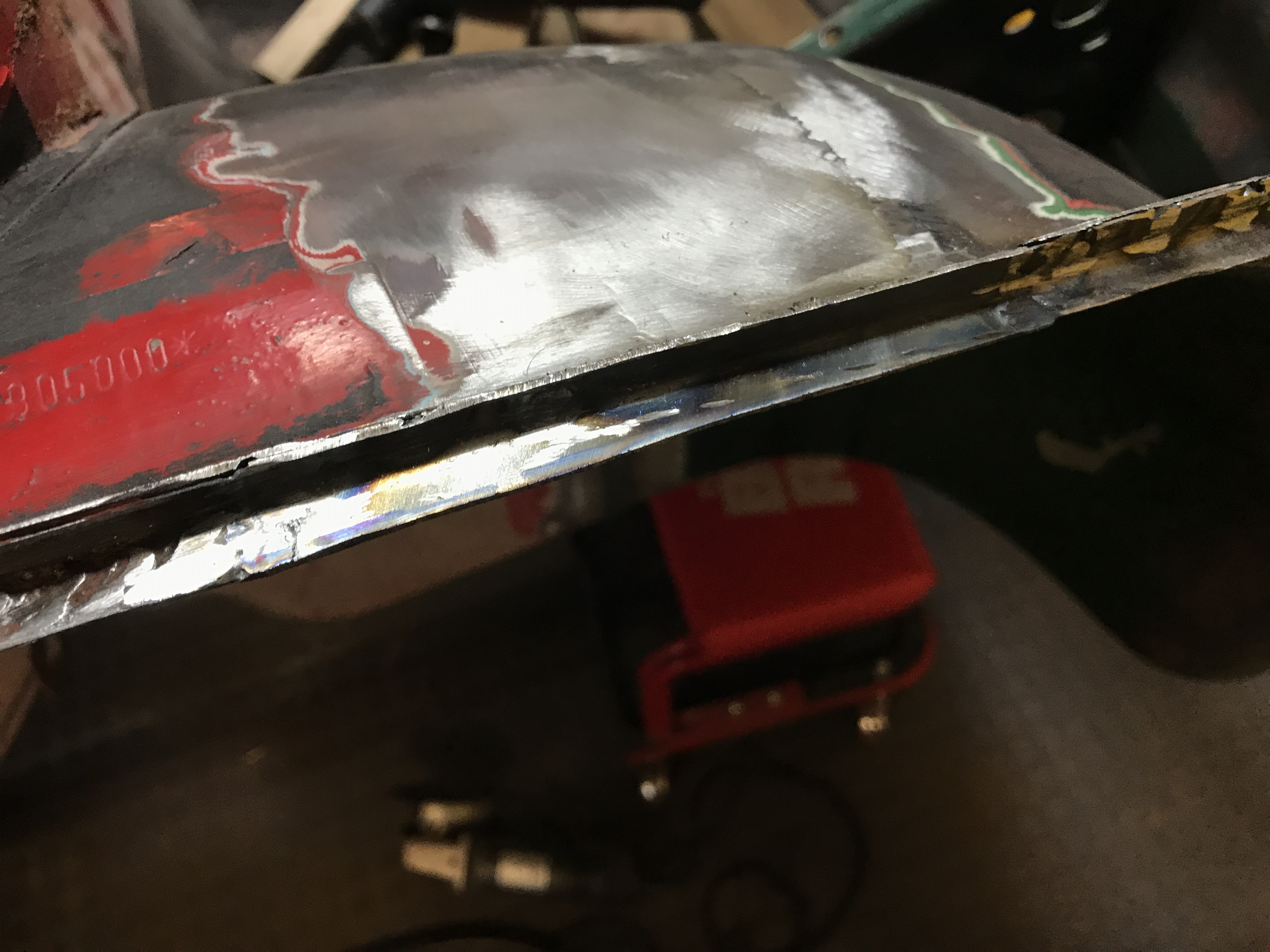

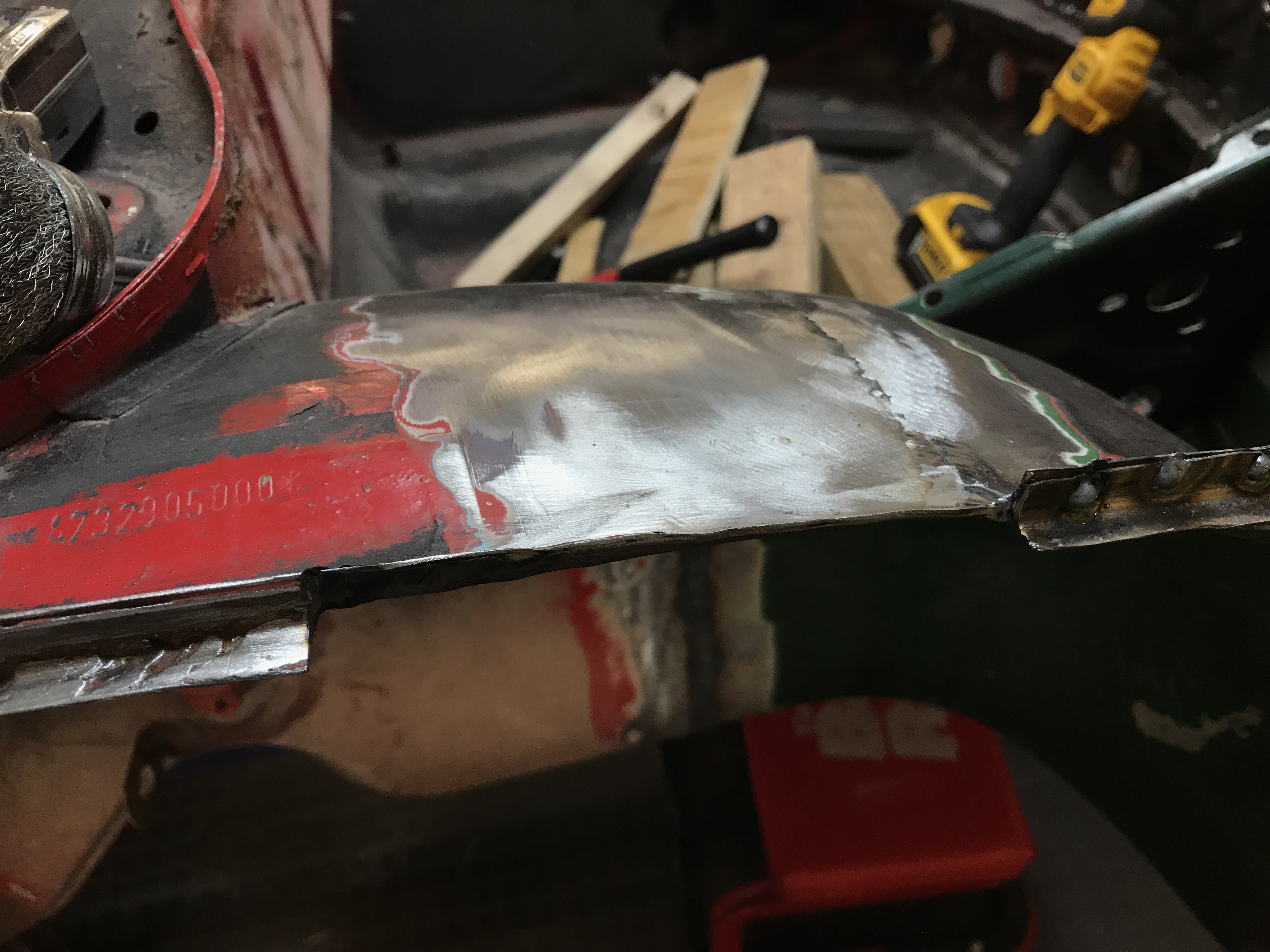

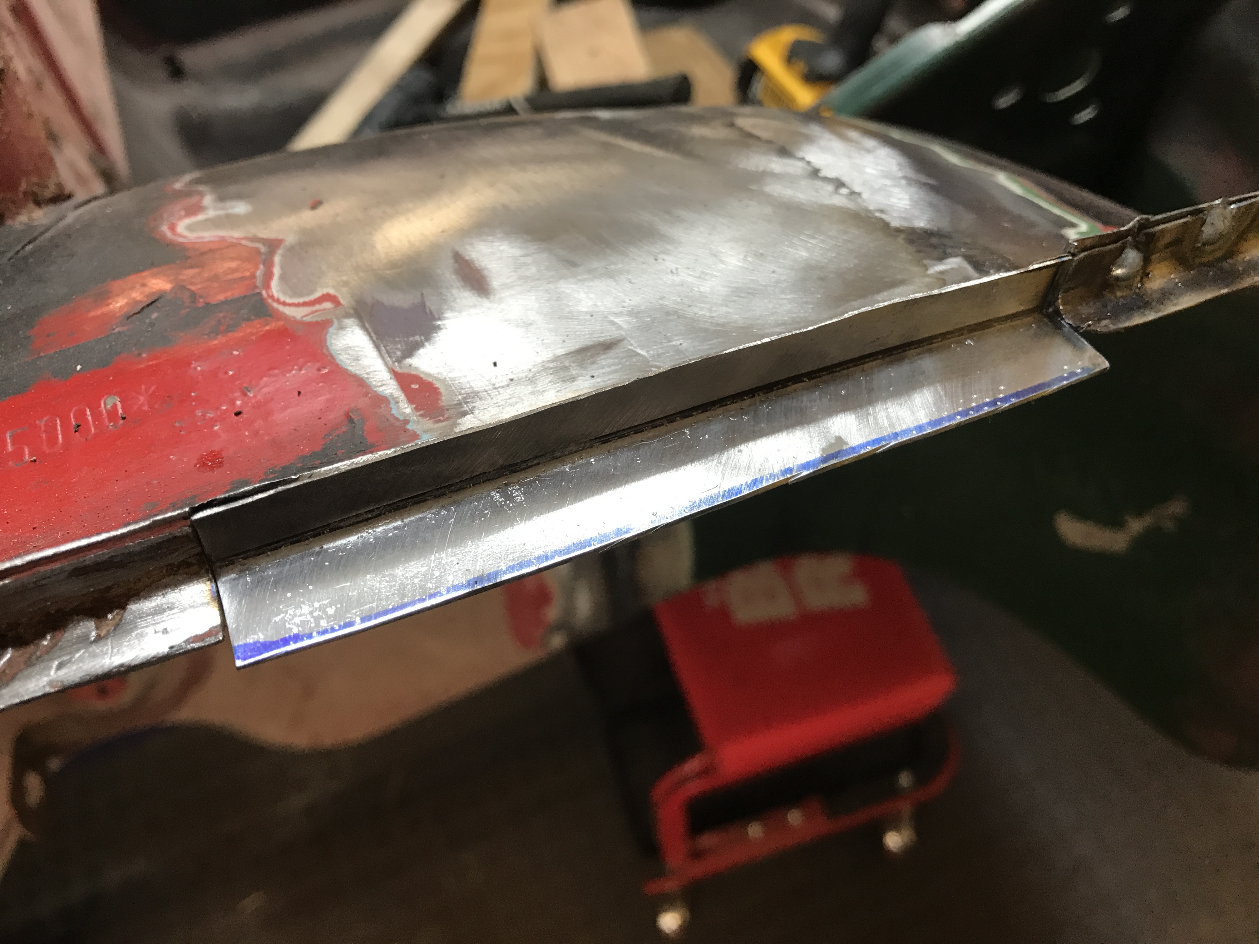

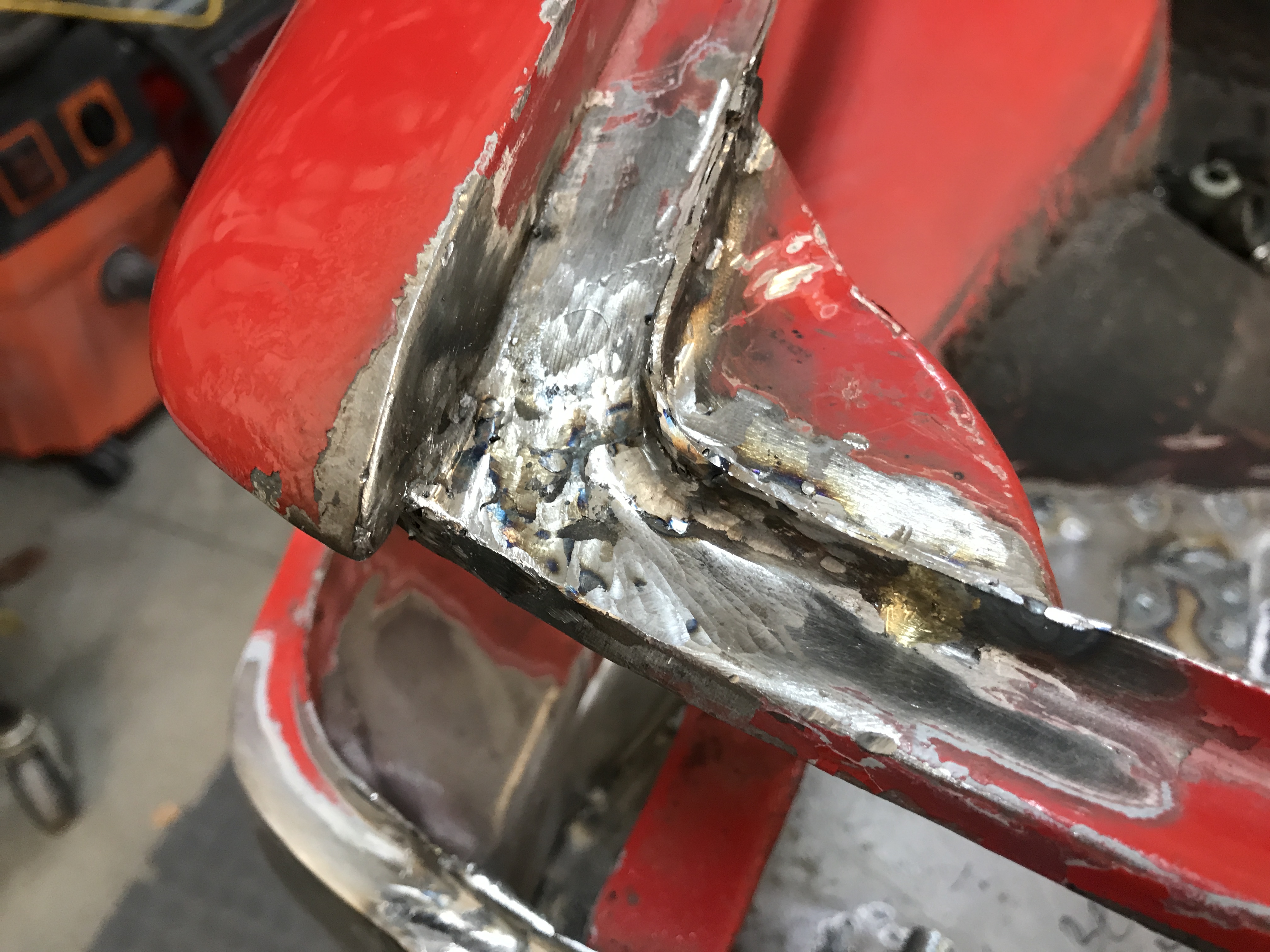

Last prep job is filling the gap in the weatherstrip channel. When I cut the fender for removal last year, I sliced down the middle of the channel.
bkrantz
post Apr 4 2020, 08:49 PM
Post #443
Posts: 8,342
Joined: 3-August 19
From: SW Colorado
Member No.: 23,343
Here's the patch, made from more recycled 914 sheet metal. I even got some curvature to match the overall arc.

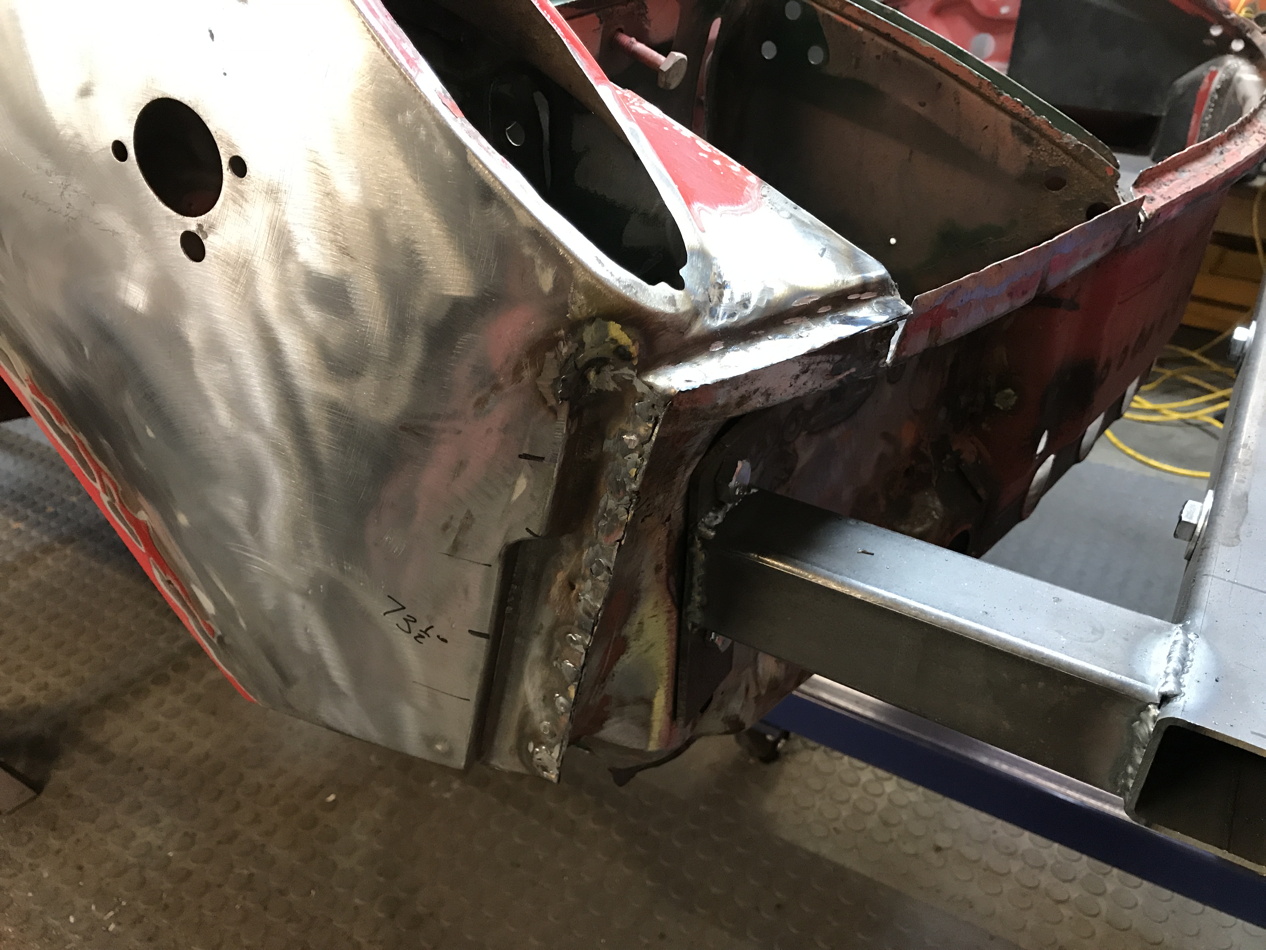

Welded in place, ground down, and trimmed to fit.

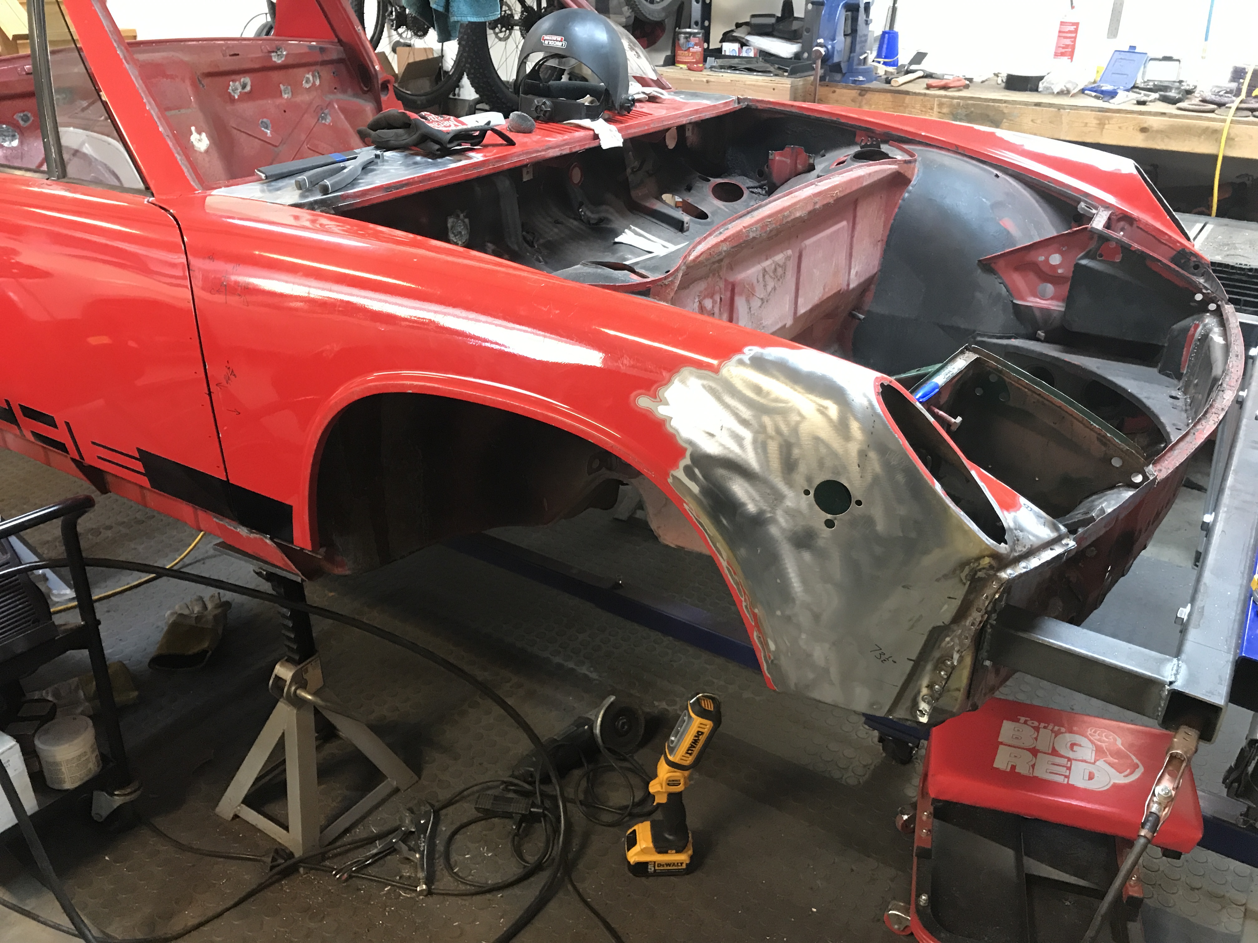

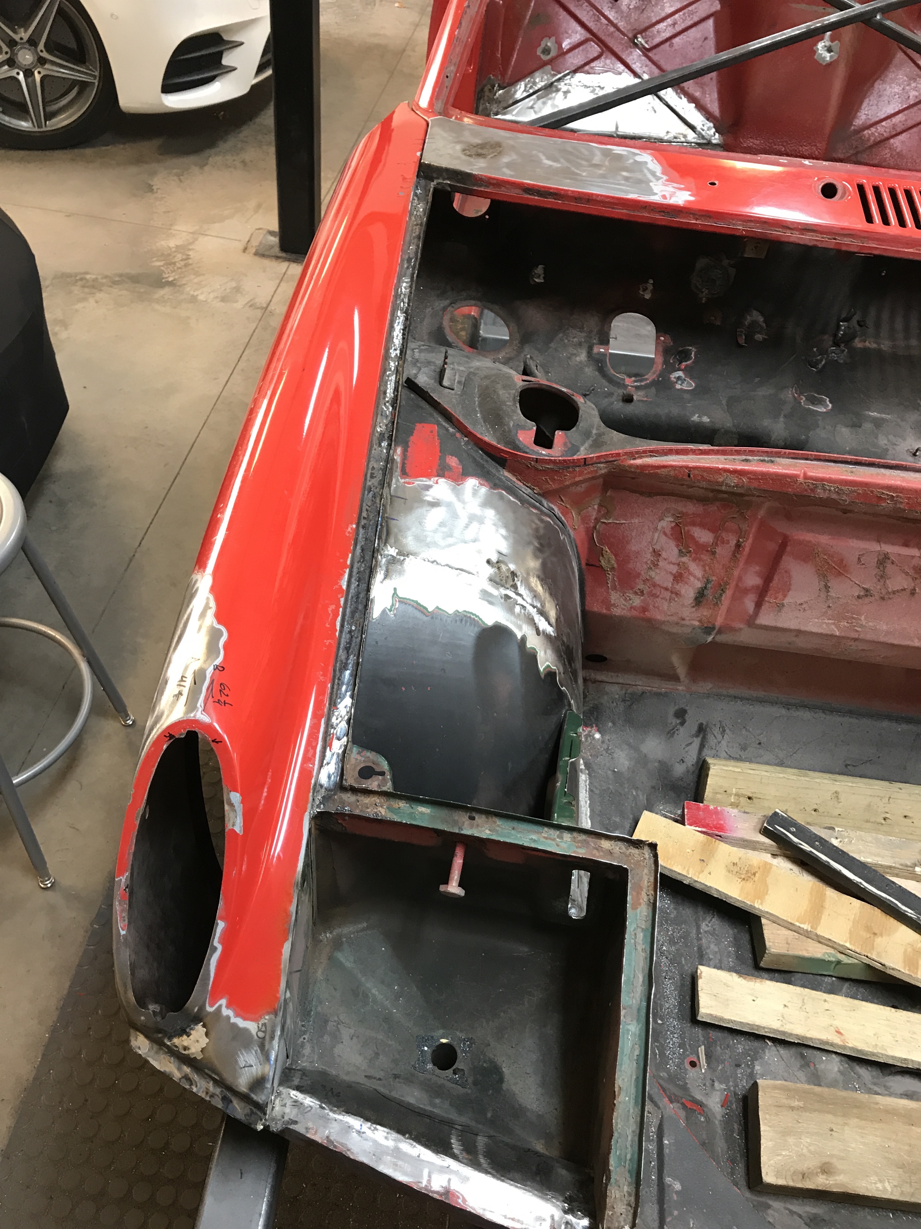

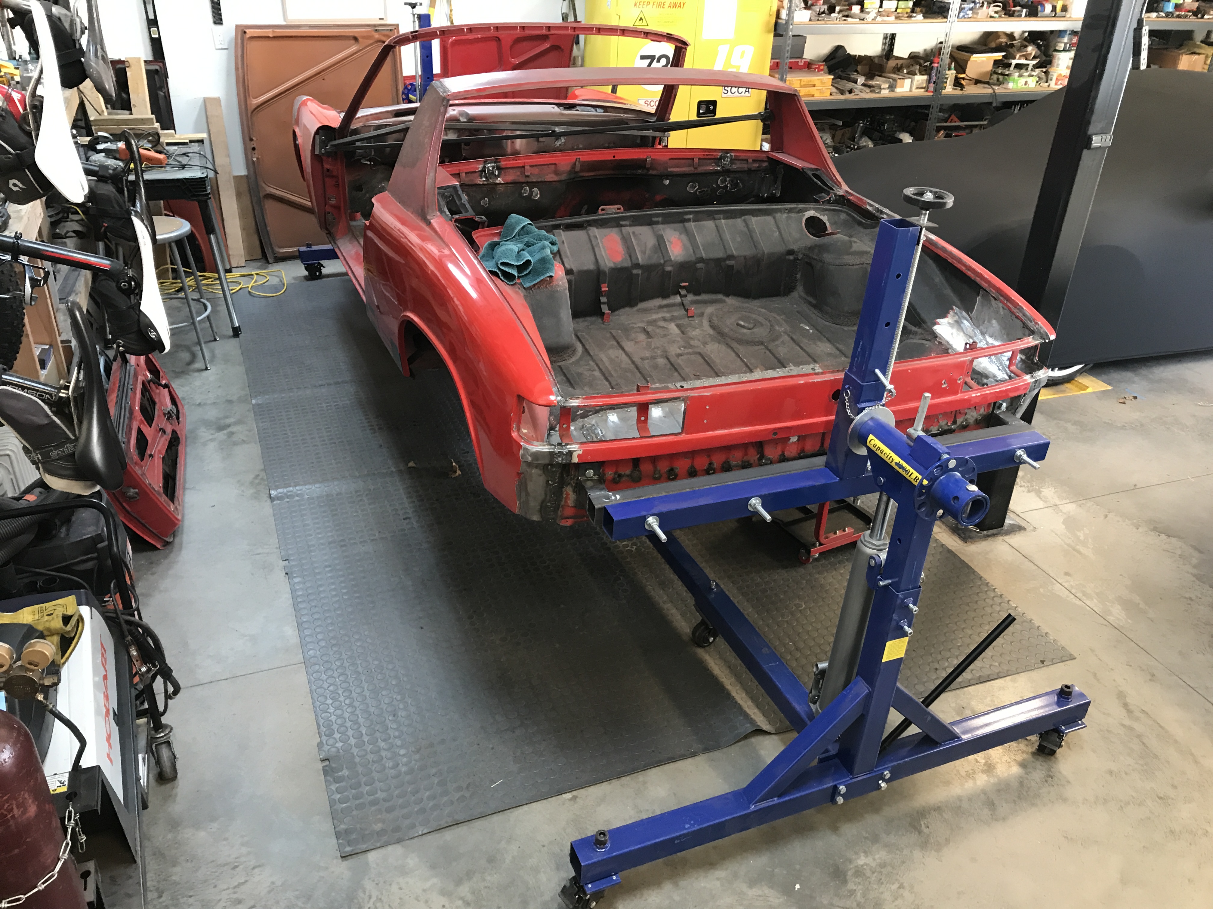

And finally, after fooling with it for almost 2 weeks, here is the fender welded in place. The alignment looks good--I hope I can say that after final assembly with the frunk lid and bumper in place.

Today, I finished the rest of the plug welds inside and along the front seams, and did some quick grinding.

And completed welding the seam in the top channel. The fender should be pretty well stuck on.

I removed the door, re-installed the interior brace, and lifted the car off the jack stands. Next is the first of the "minor" list jobs, tidying up the rear panel.

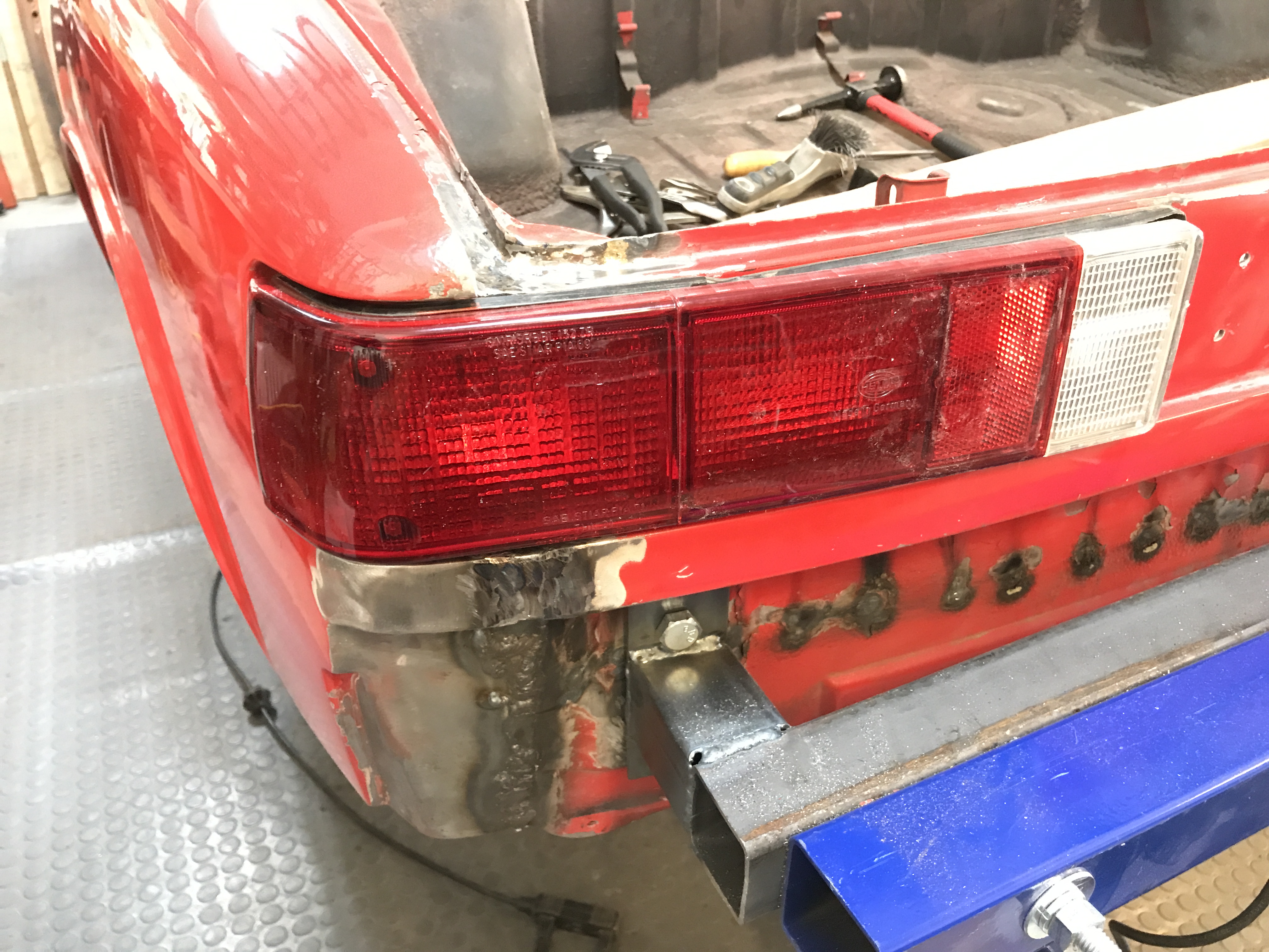

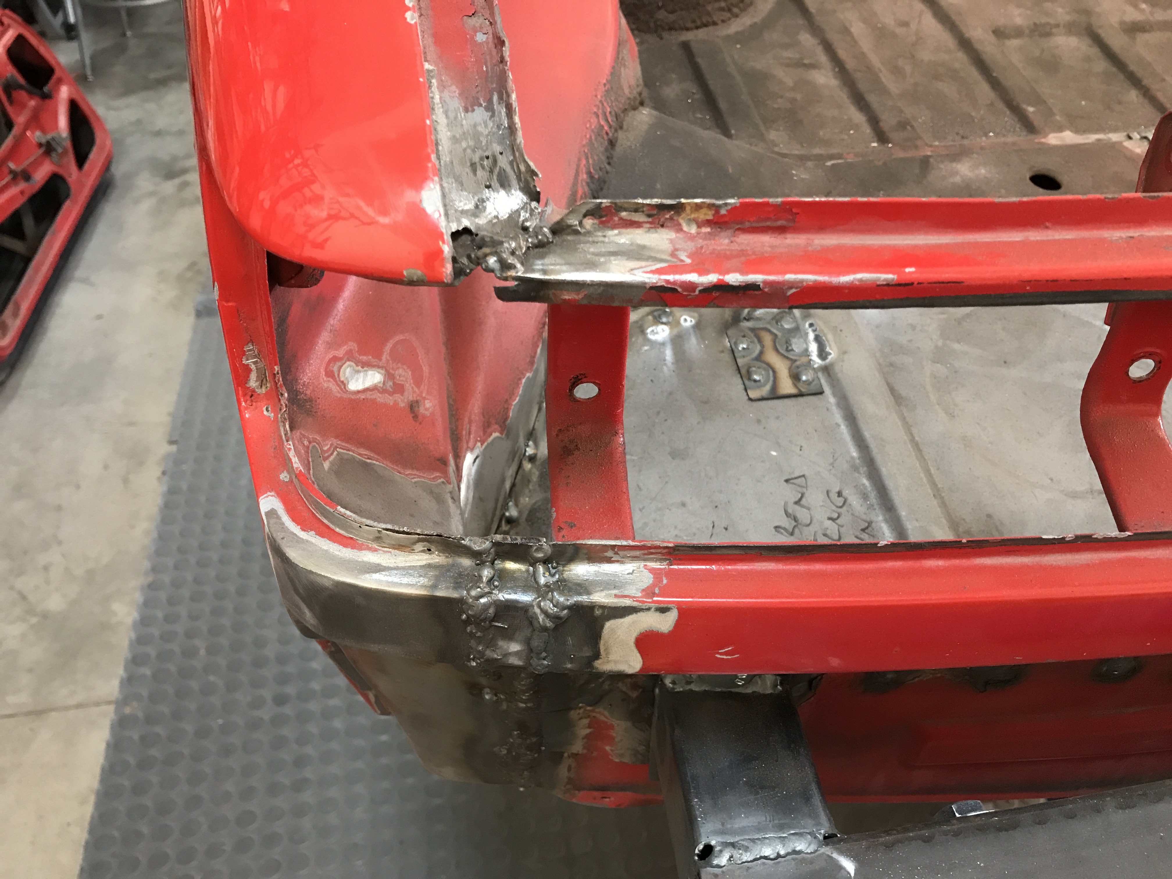

Got a start today, on the left side. When I last touched this area in December, I left some crude weld spots.
bkrantz
post Apr 6 2020, 08:34 PM
Post #450
Posts: 8,342
Joined: 3-August 19
From: SW Colorado
Member No.: 23,343
After some grinding, a quick check of tail light fit.

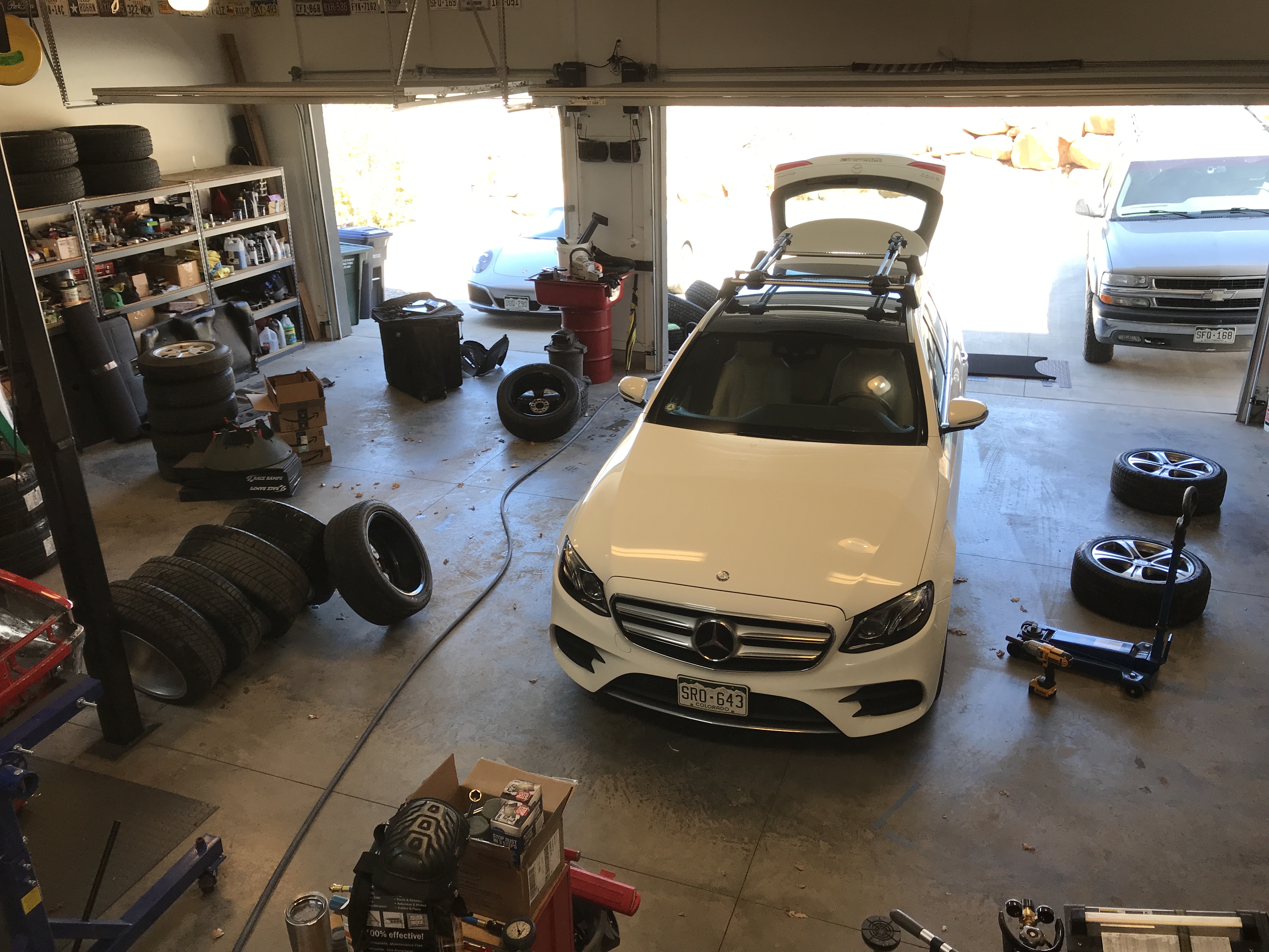

Another day without 914 progress. My excuse is that I played tire shop today, and swapped out snow tires for summer or off road rubber on my 991, Benz wagon, and Suburban.

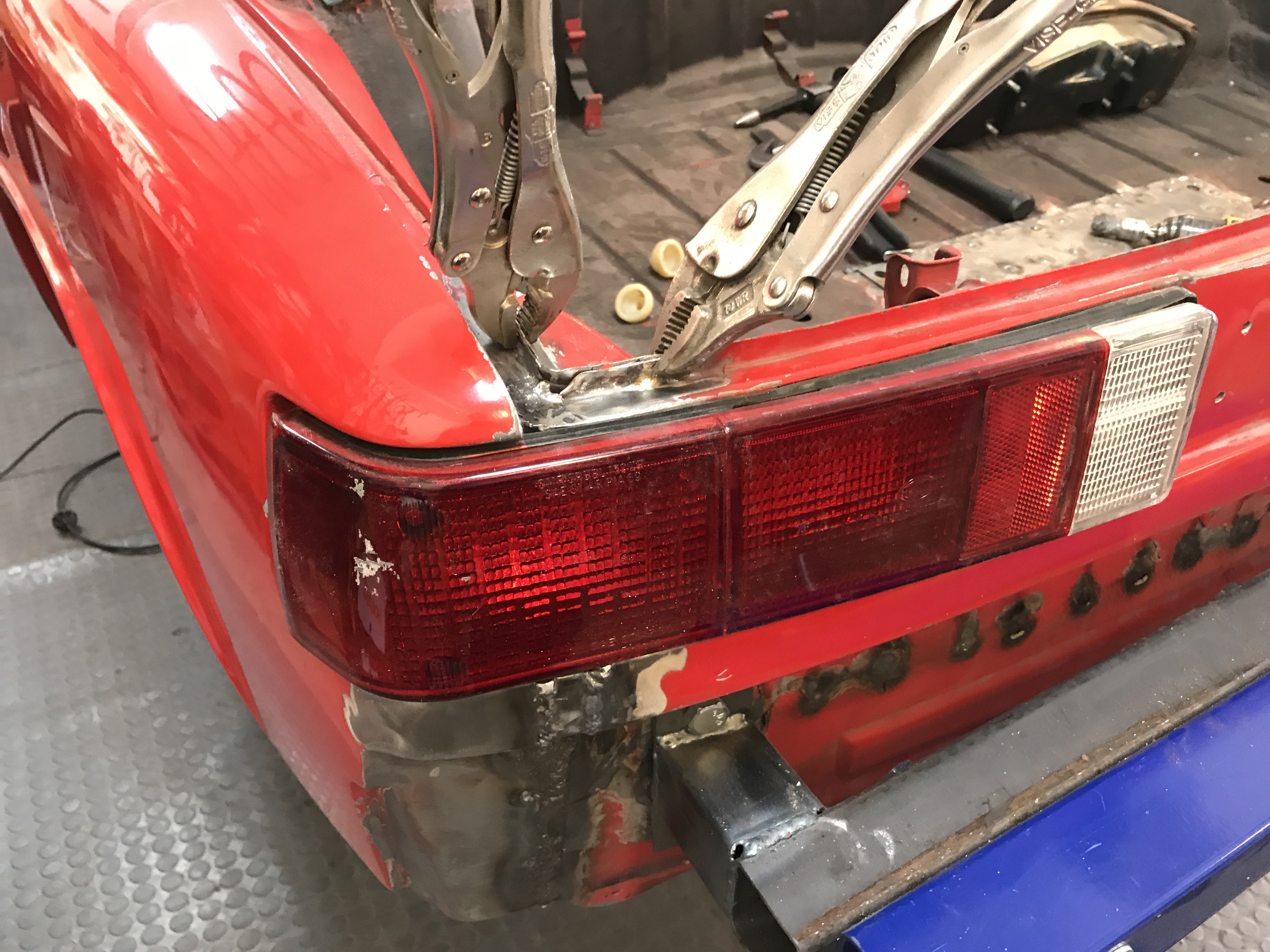

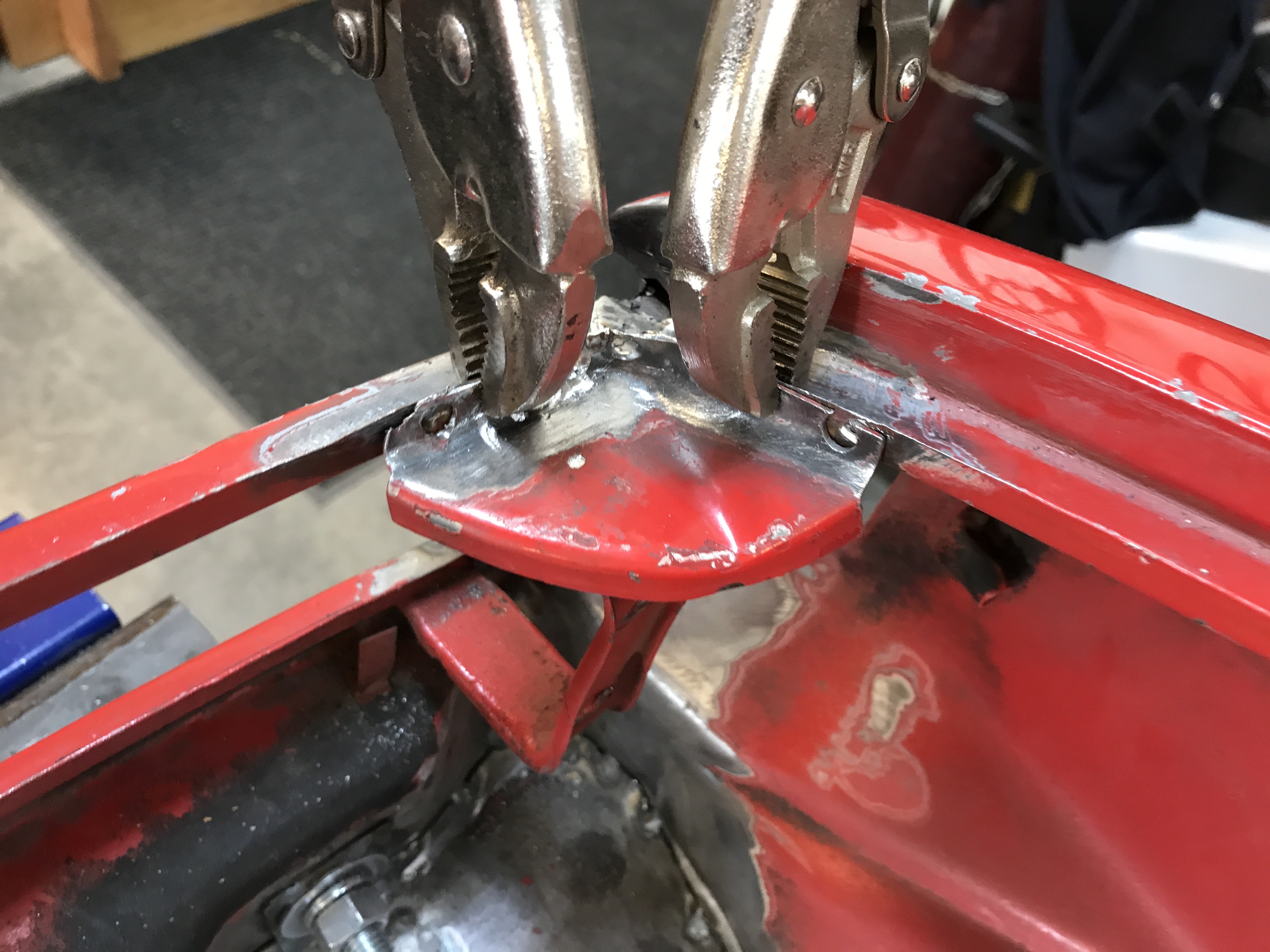

I had a couple of hours today for 914 work. That was enough to finish up the left trunk corner.
Here is the gusset/trunk lid bumper stop in place.

After welding and grinding. I have to fill some gaps and build up missing metal.
bkrantz
post Apr 9 2020, 08:05 PM
Post #455
Posts: 8,342
Joined: 3-August 19
From: SW Colorado
Member No.: 23,343
And a quick check with the tail light in place.
