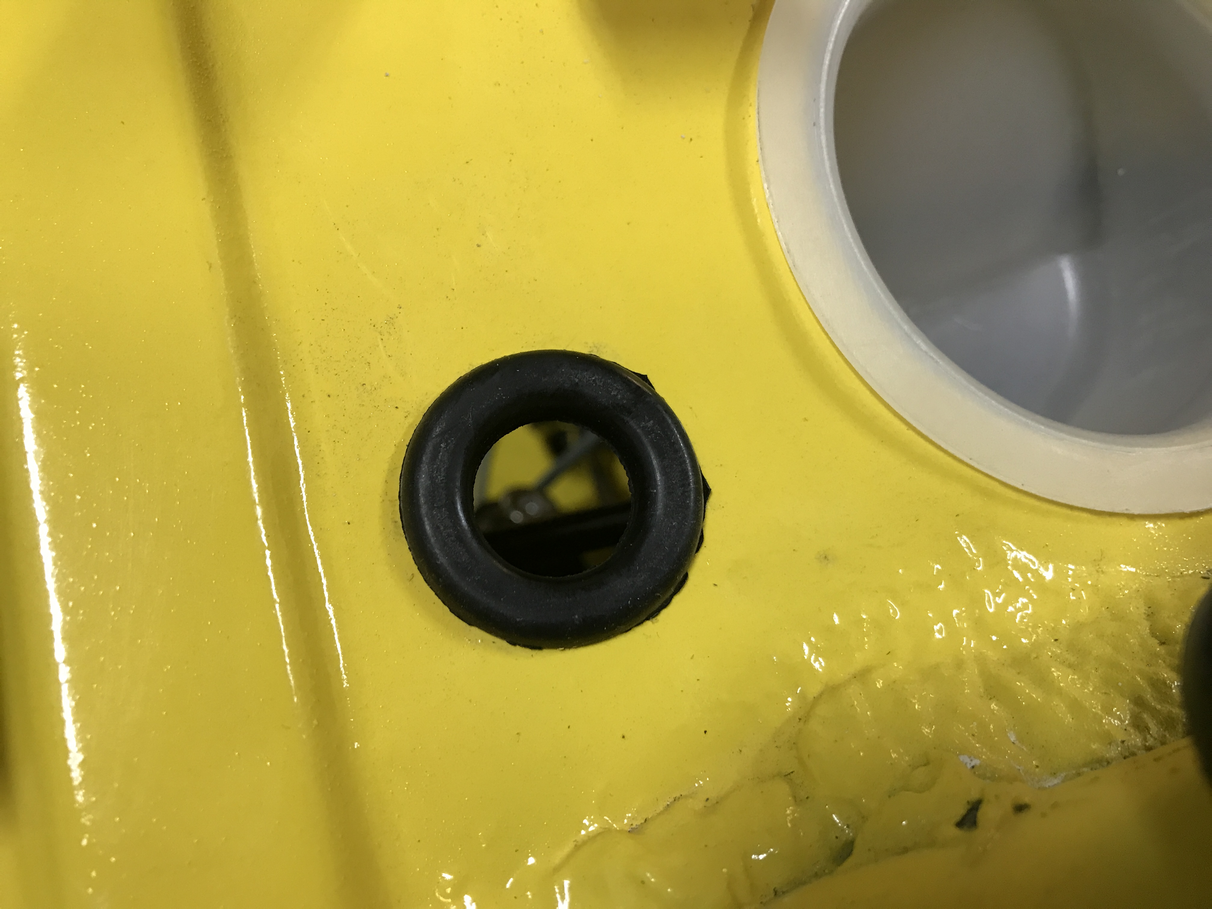

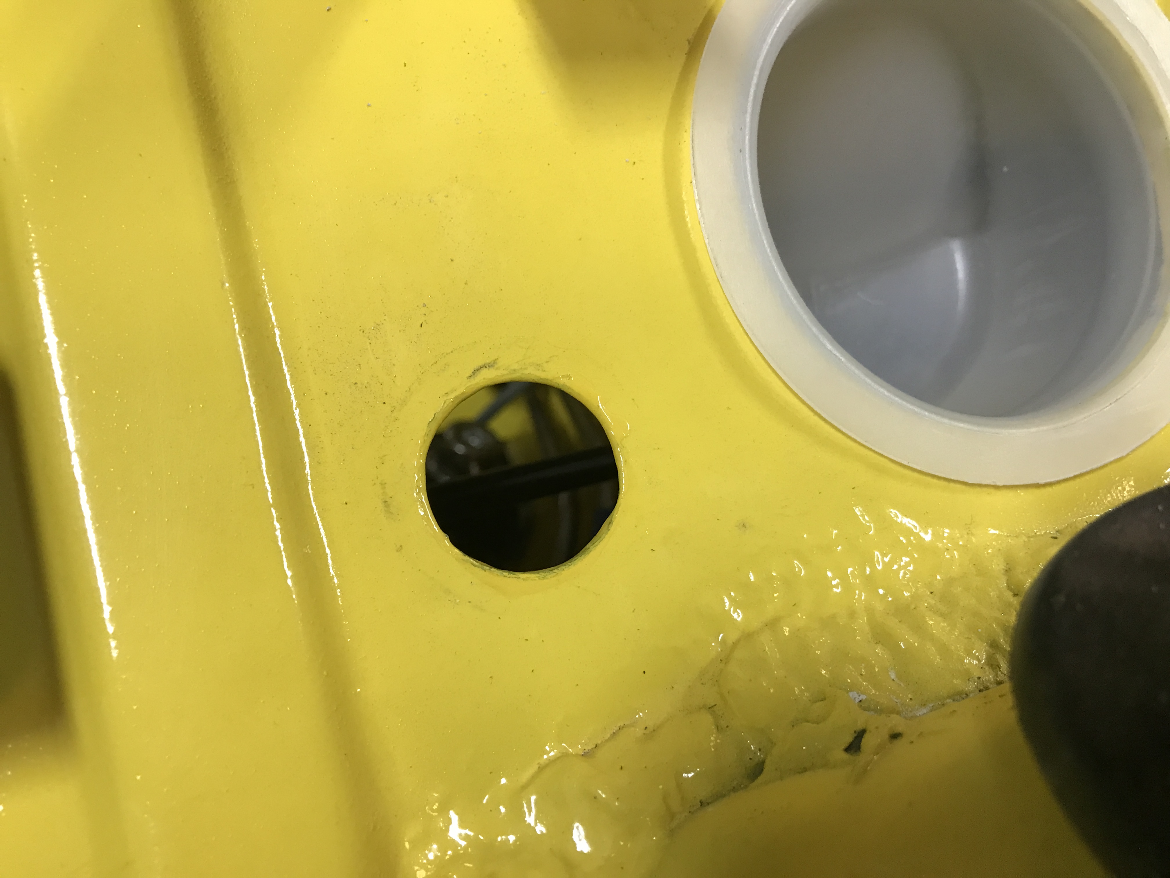

I primed and painted the raw edge.
bkrantz
post Dec 19 2021, 08:27 PM
Post #4402
Posts: 8,347
Joined: 3-August 19
From: SW Colorado
Member No.: 23,343
And popped in a 1 inch grommet. I will find out later if this is big enough.

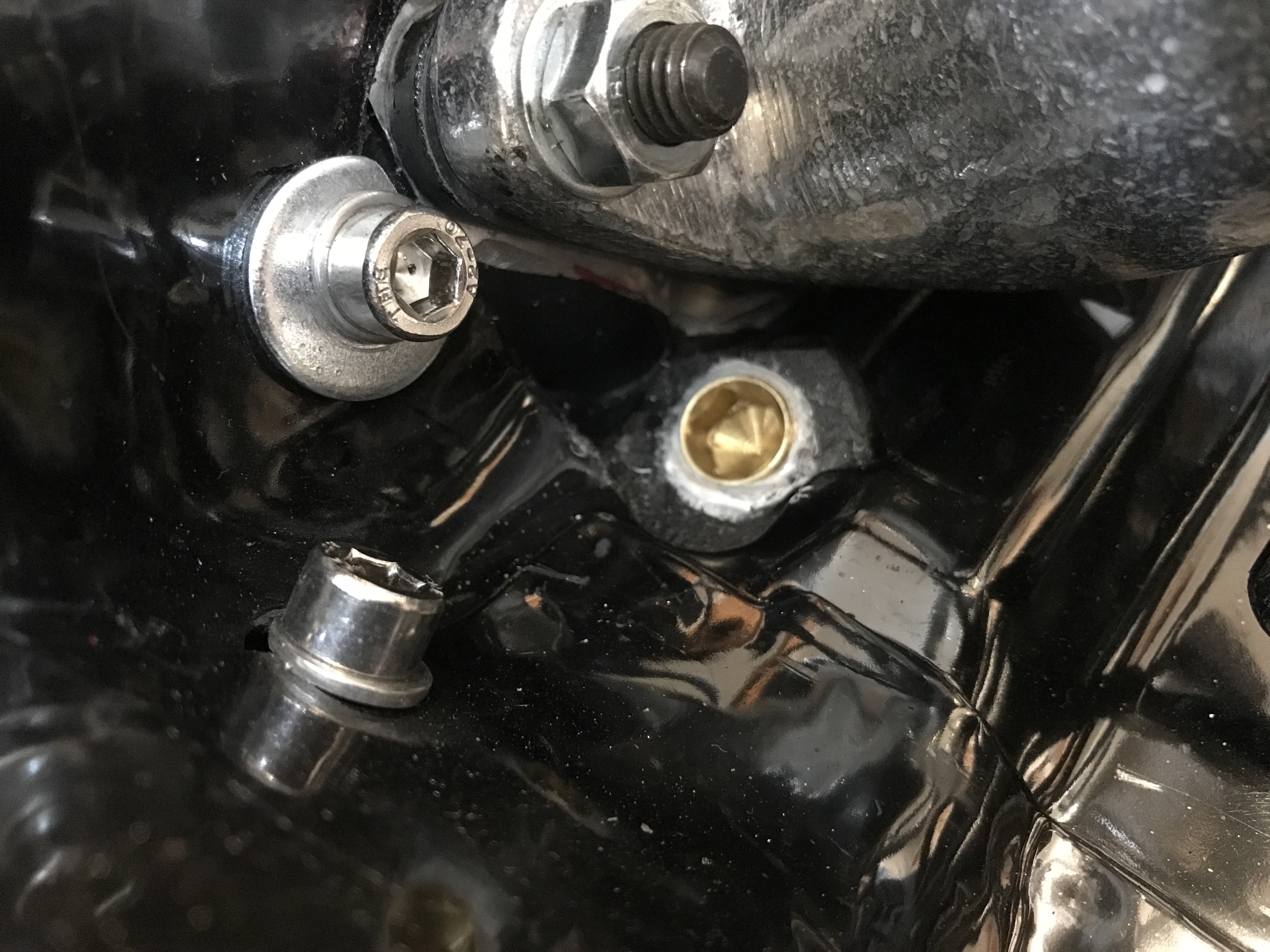

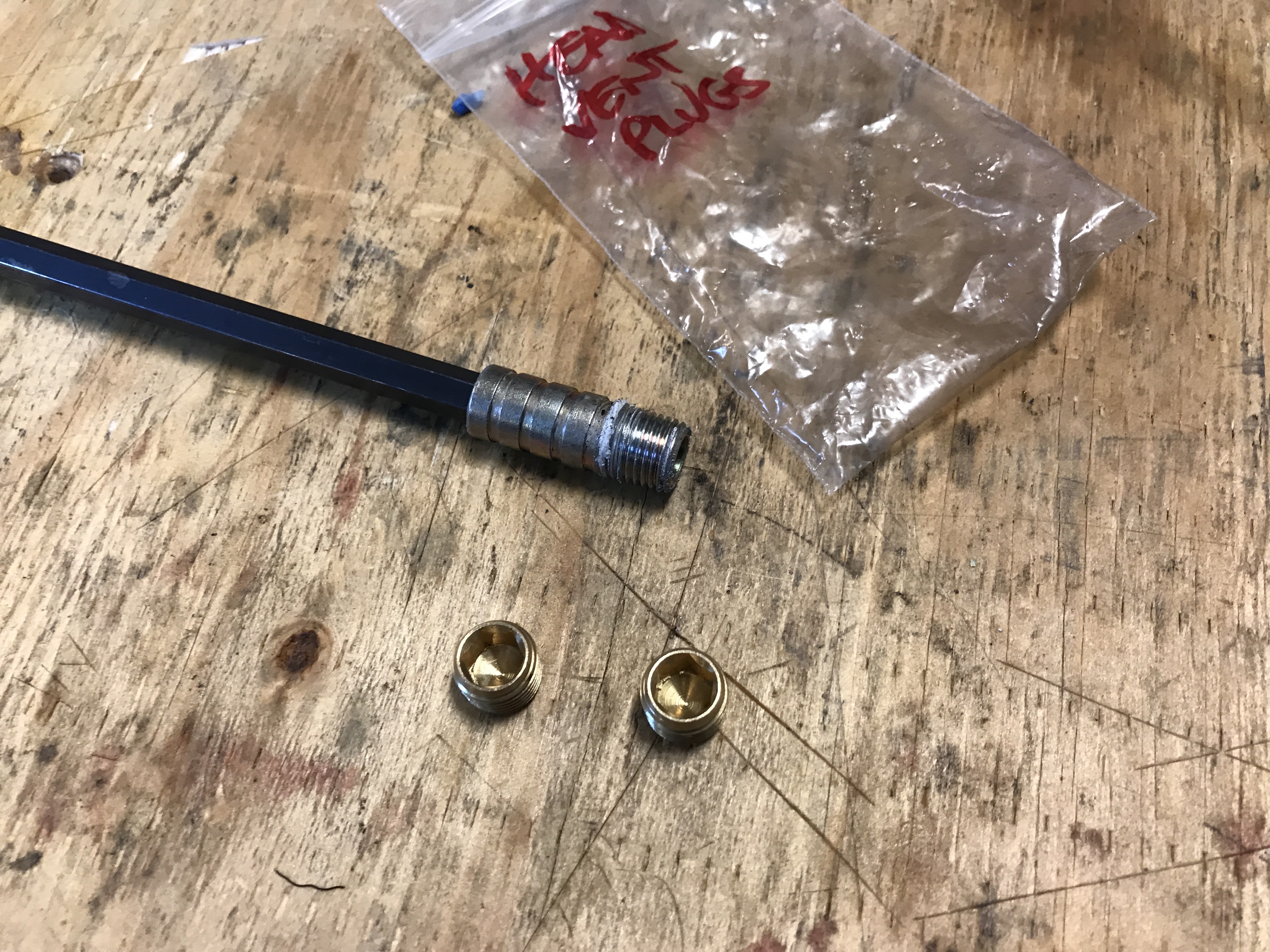

After reading Len Hoffman's analysis of engine case breathing, I decided to change from the "stock" set-up, with each head vented, to Len's recommended venting from the oil breather stack. These are the head vent plugs (and one of the vent hose fittings, already removed).
bkrantz
post Dec 19 2021, 08:31 PM
Post #4404
Posts: 8,347
Joined: 3-August 19
From: SW Colorado
Member No.: 23,343
Even with the sheet metal and intake manifolds, I was able to install the vent plugs.

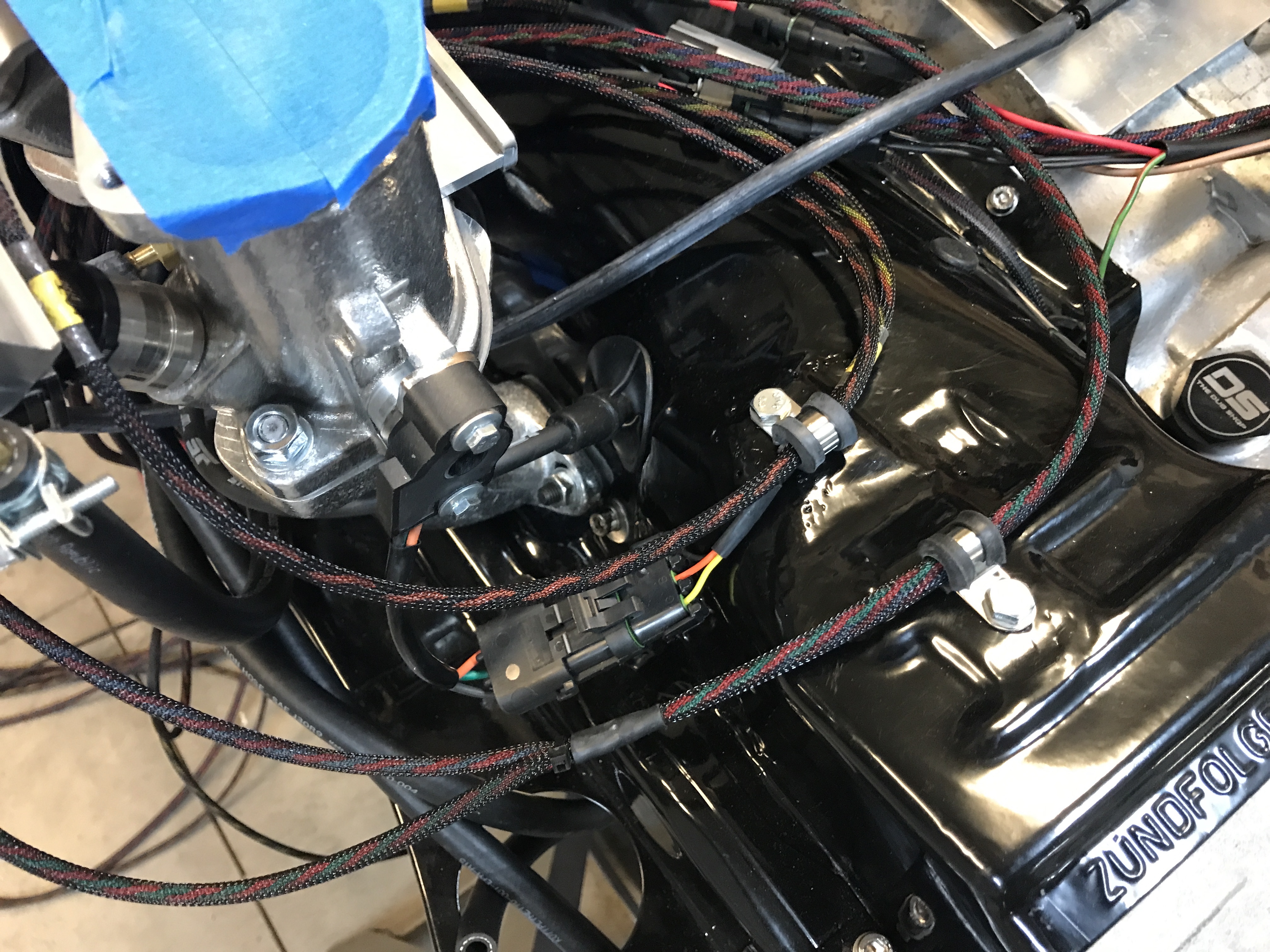

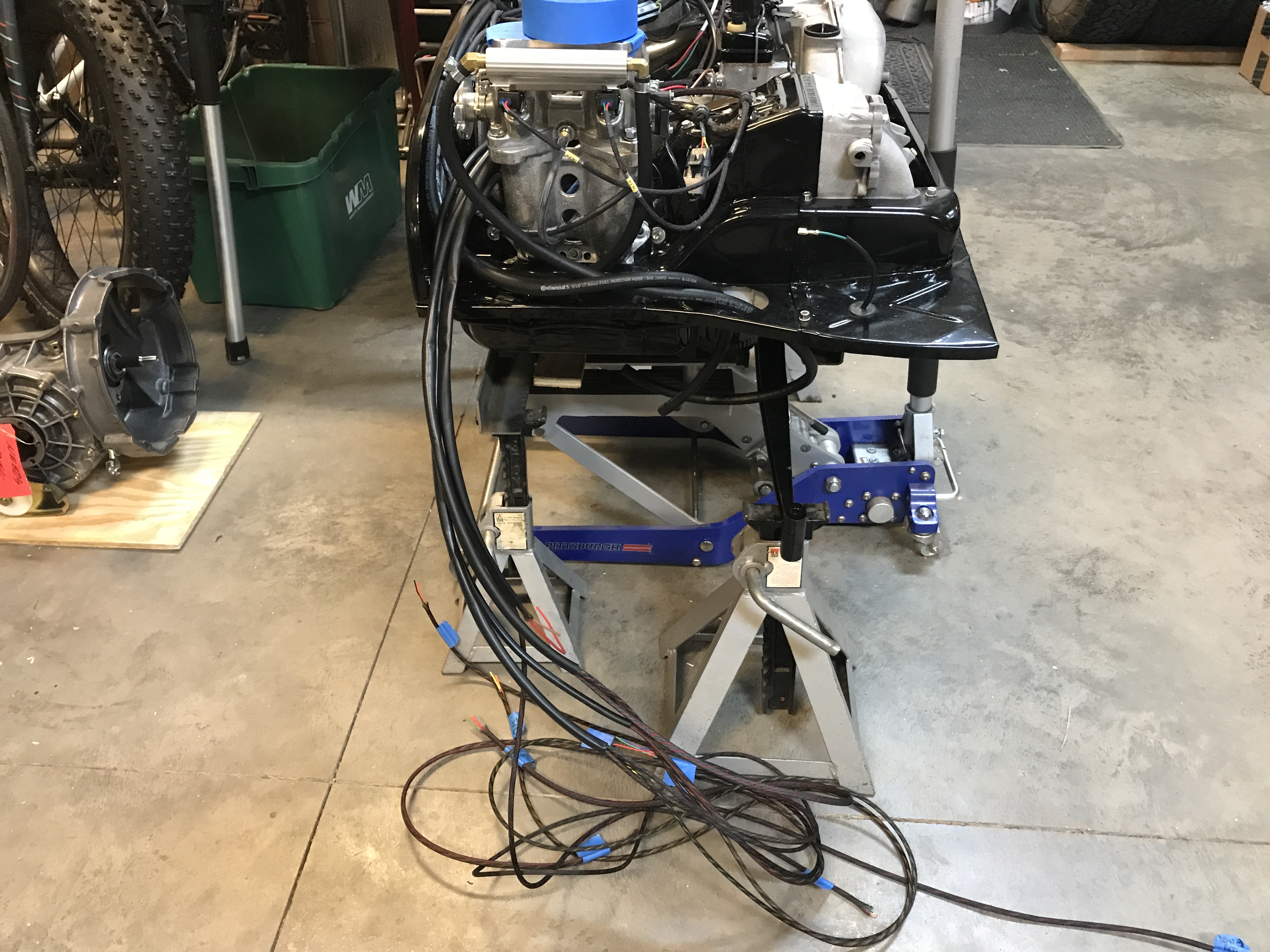

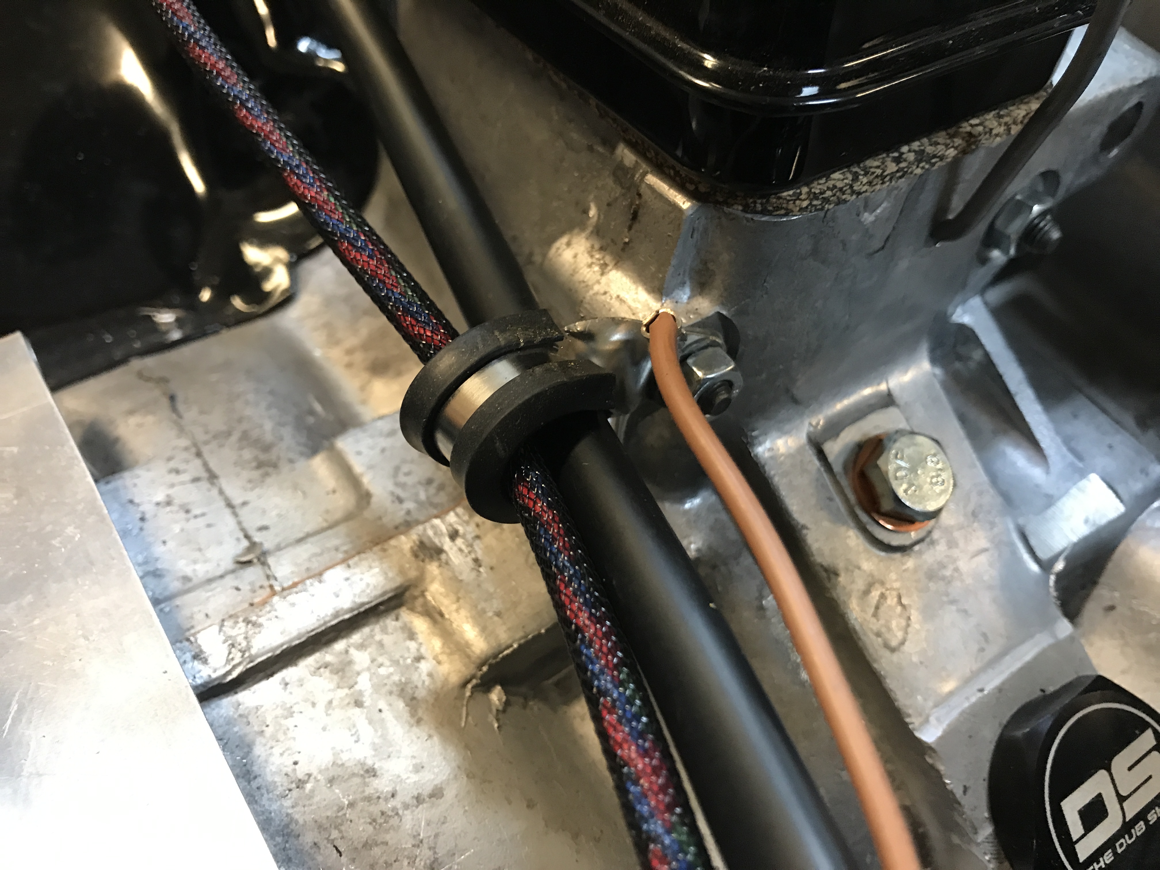

I took the near-final opportunity to tame the new EFI cables. In a new places, I can use bolt-on clamps.

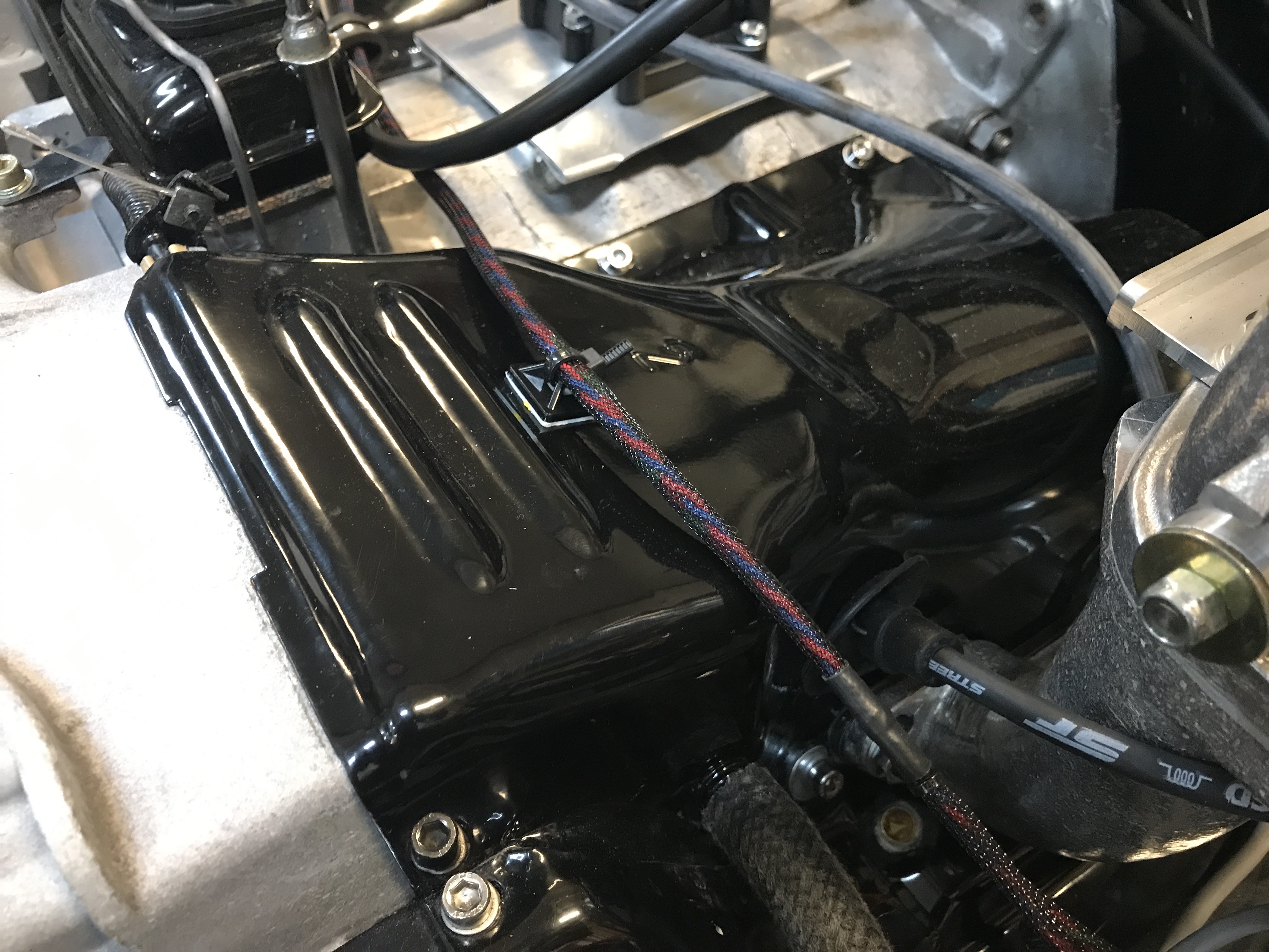

And here.

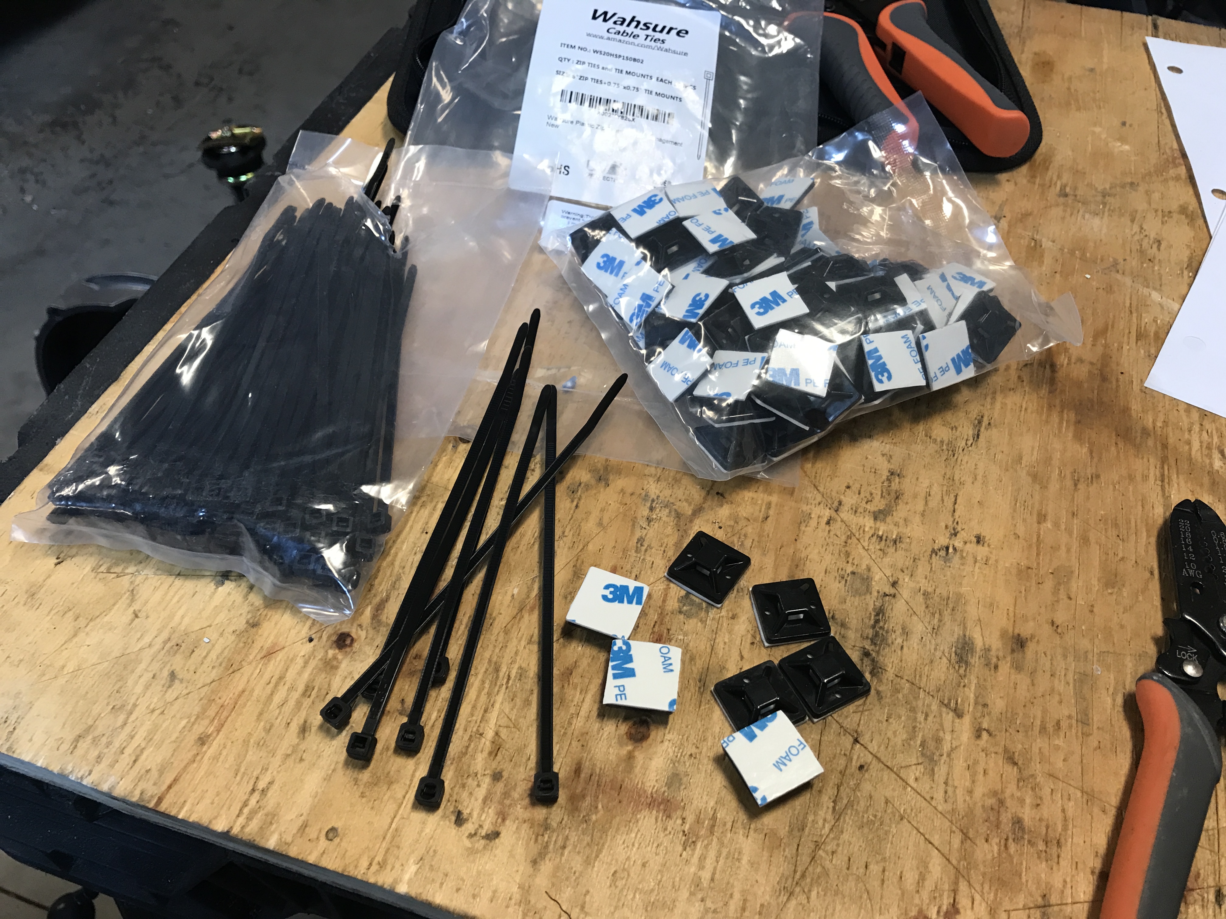

I also got stick-on anchors. Not sure how these will hold up to heat.
bkrantz
post Dec 20 2021, 08:25 PM
Post #4408
Posts: 8,347
Joined: 3-August 19
From: SW Colorado
Member No.: 23,343
These make it easy--if they stay on.

I also grouped some of the cables into plastic sheaths. Not such a mess now.

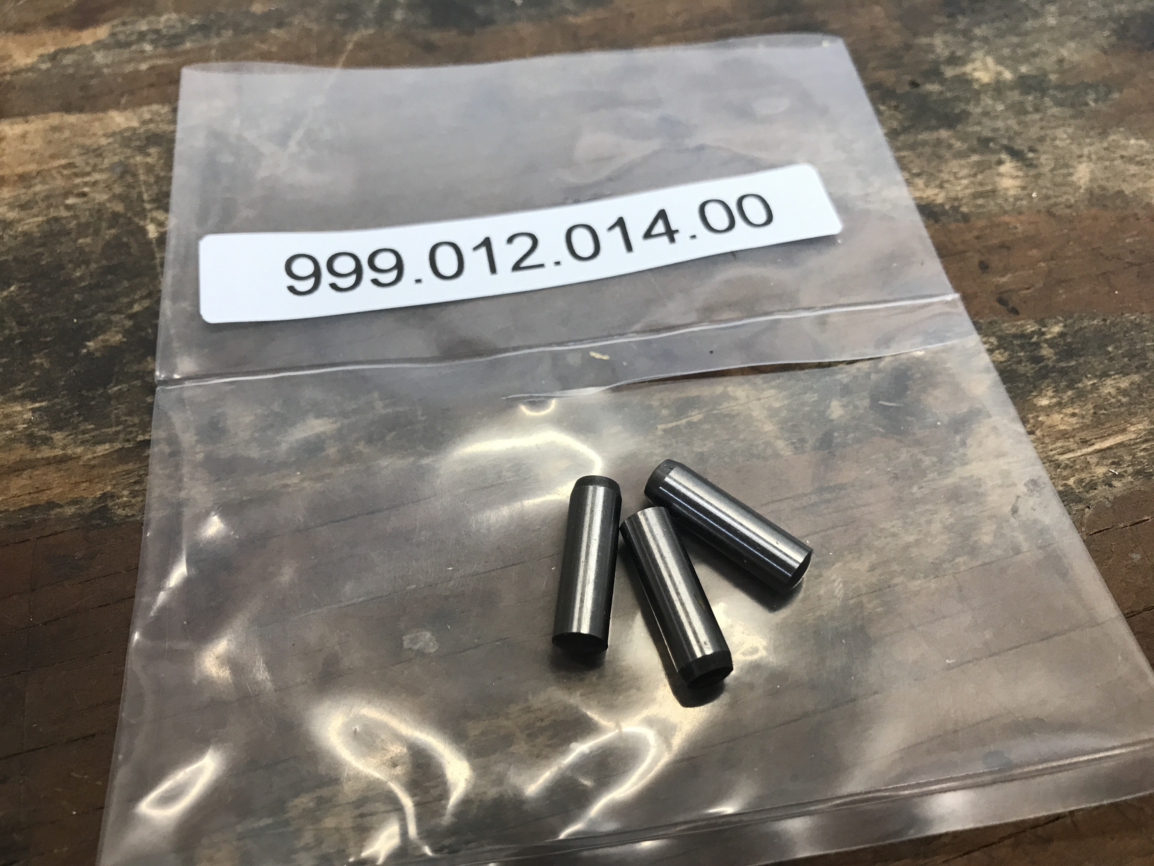

OK, time for engine and transaxle assembly. Here are the flywheel location pins I was missing.

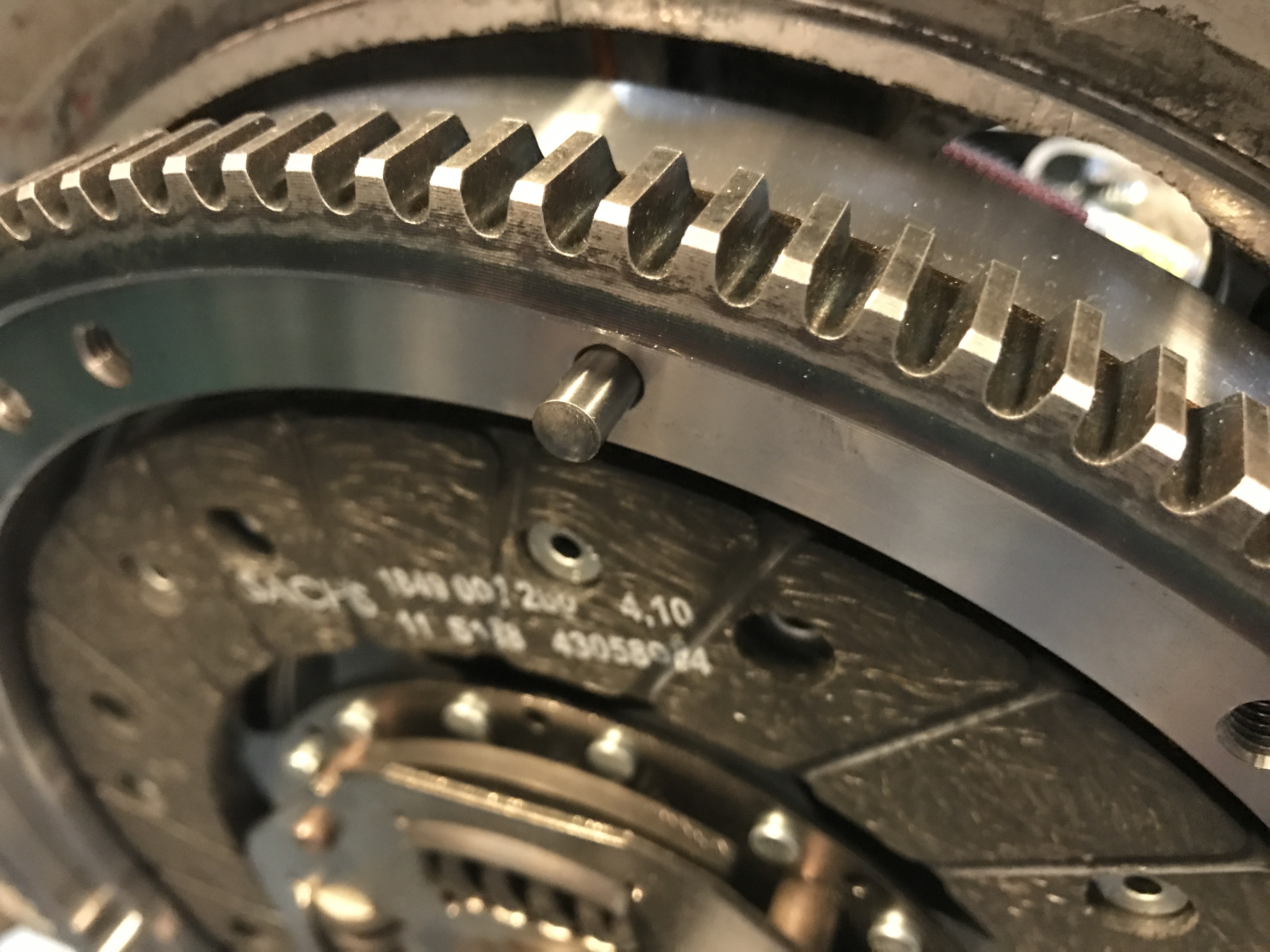

I used a plastic-face hammer to tap (pound) these in.

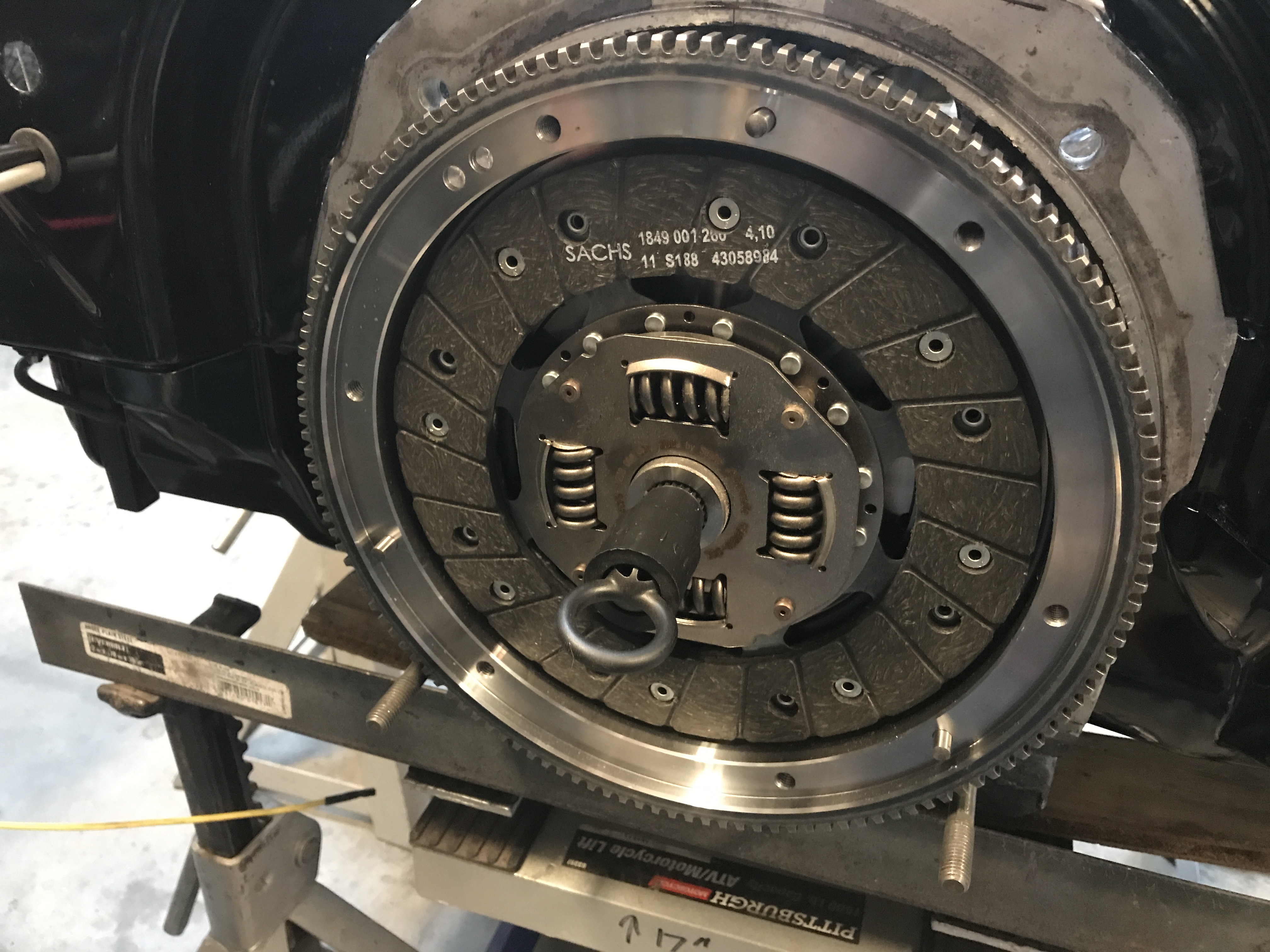

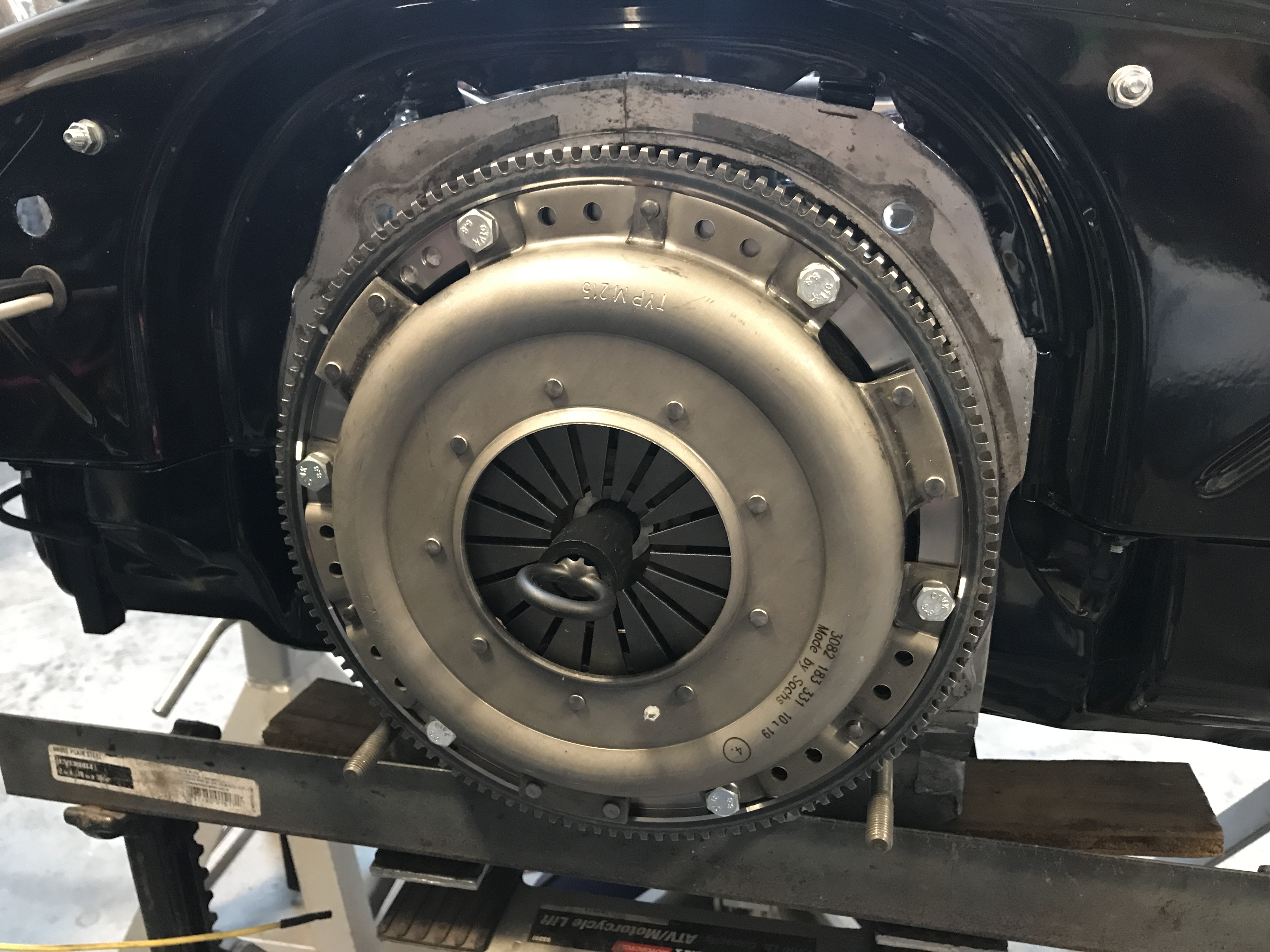

Finally, the flywheel is ready. Clutch disk in place with centering tool.
bkrantz
post Dec 20 2021, 08:31 PM
Post #4413
Posts: 8,347
Joined: 3-August 19
From: SW Colorado
Member No.: 23,343
And clutch cover bolted on.

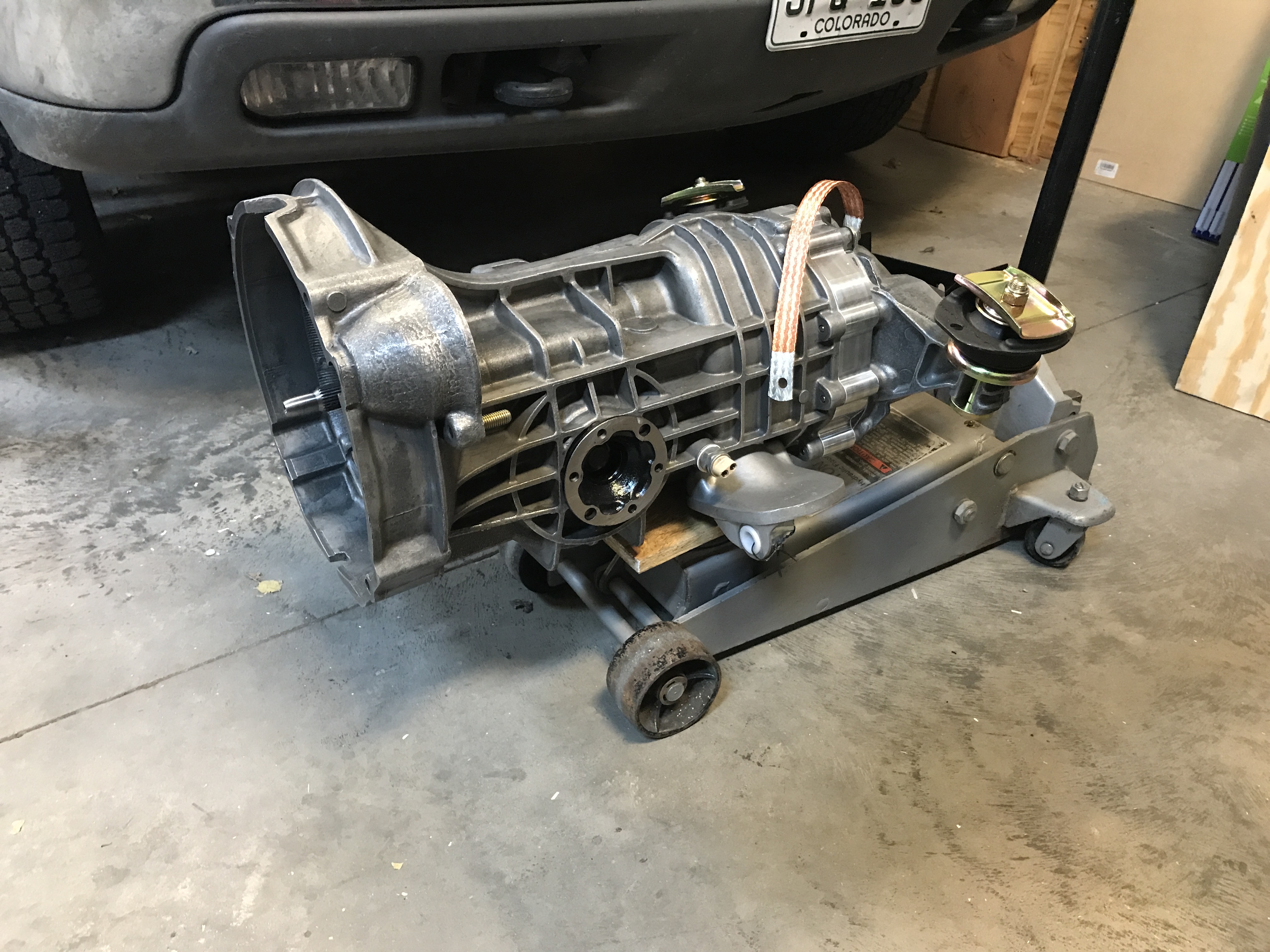

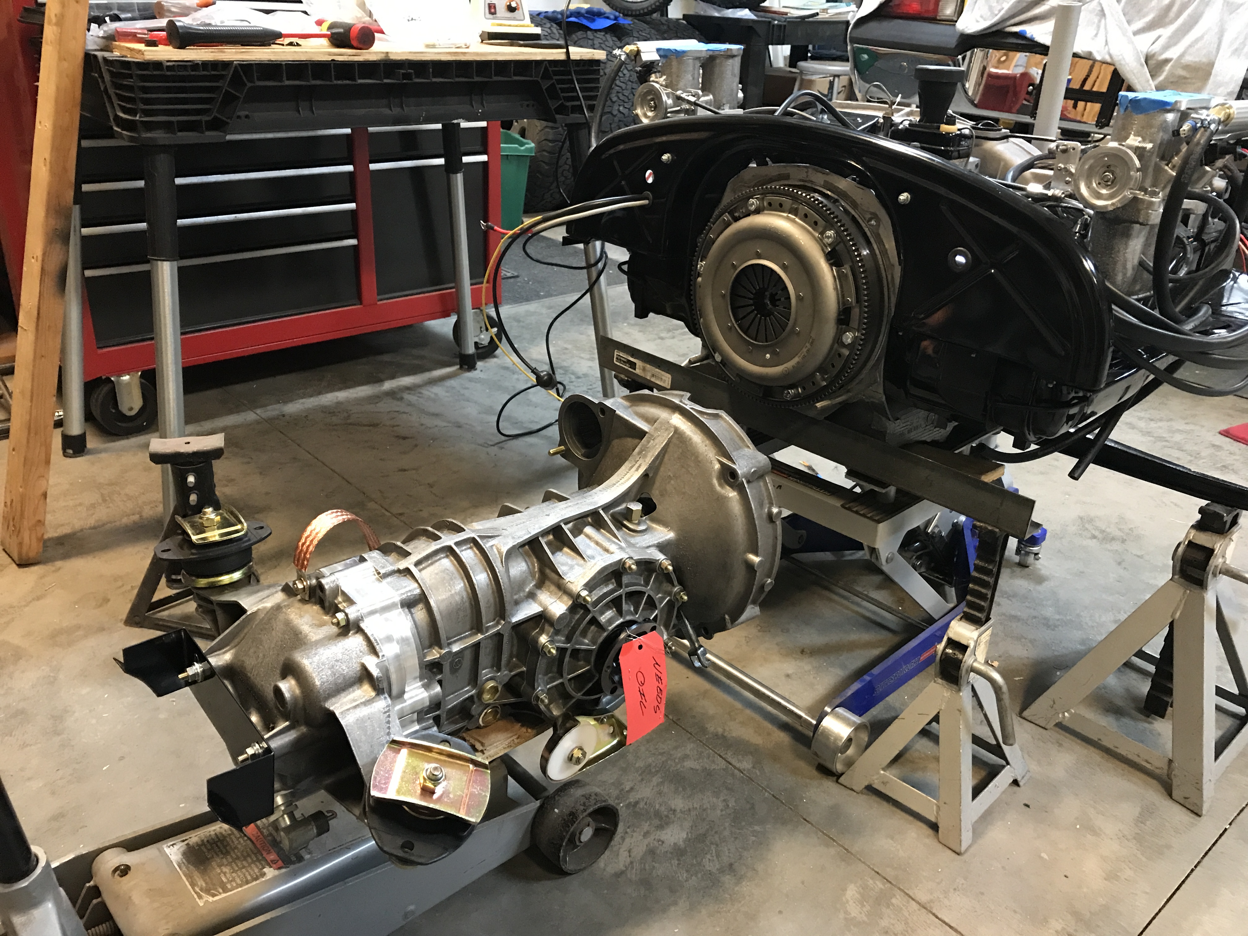

I got the trans balanced on a floor jack.

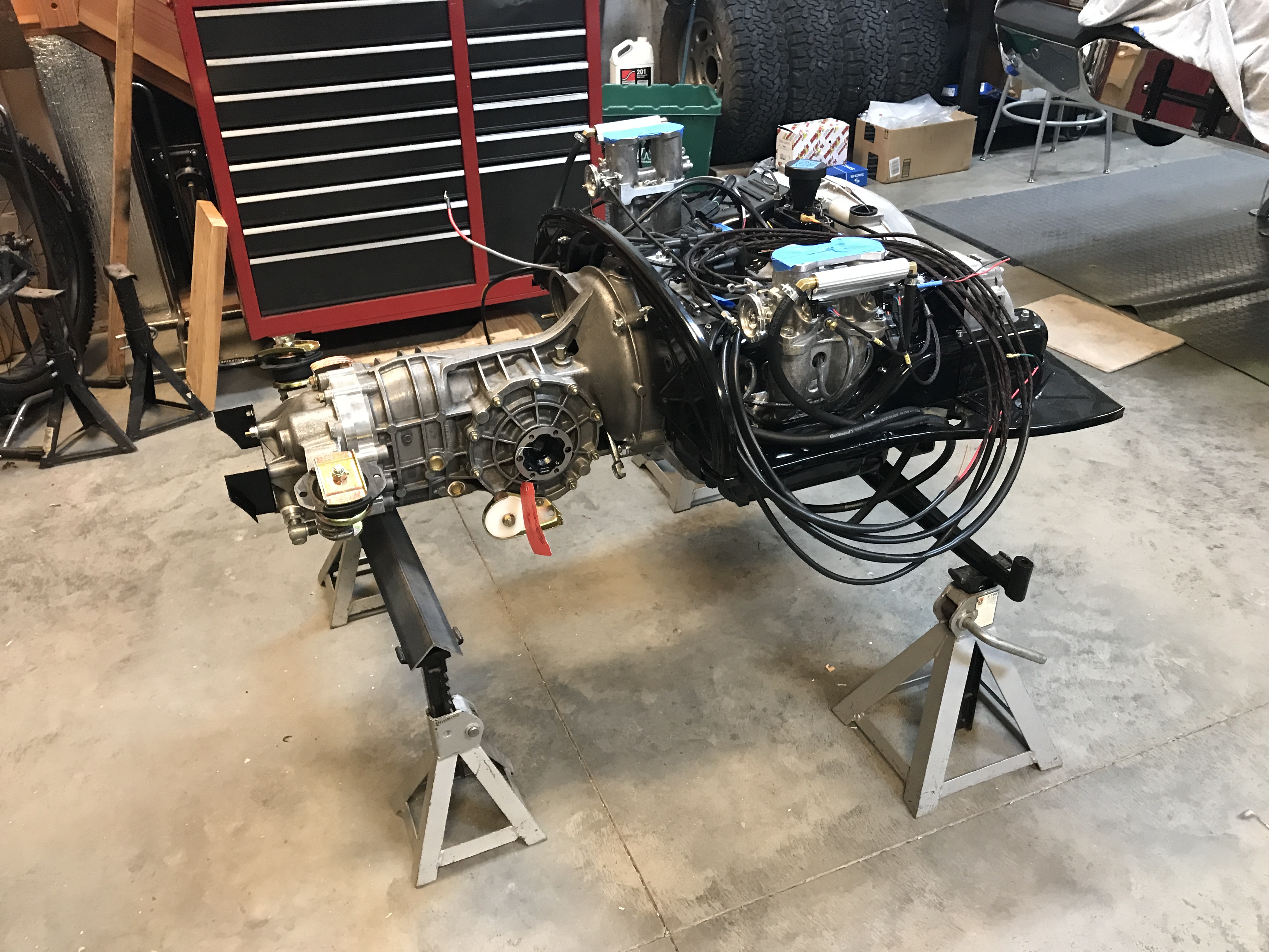

Here we go. I have not done this in at least 10 years.
bkrantz
post Dec 20 2021, 08:40 PM
Post #4416
Posts: 8,347
Joined: 3-August 19
From: SW Colorado
Member No.: 23,343
So, this photo is about 2 hours later. It took about 5 attempts. After 3 tries to align the disk, and insert the trans shaft (with lots of changing angles of trans and engine), I resorted to another method. I loosened the clutch cover bolts enough so the disk could shift sideways. On the fourth attempt, I got the shaft in, then pulled the trans back and tightened the cover bolts. The fifth attempt then got it all together.
A few more things to do, and then I can get this beast into the car.

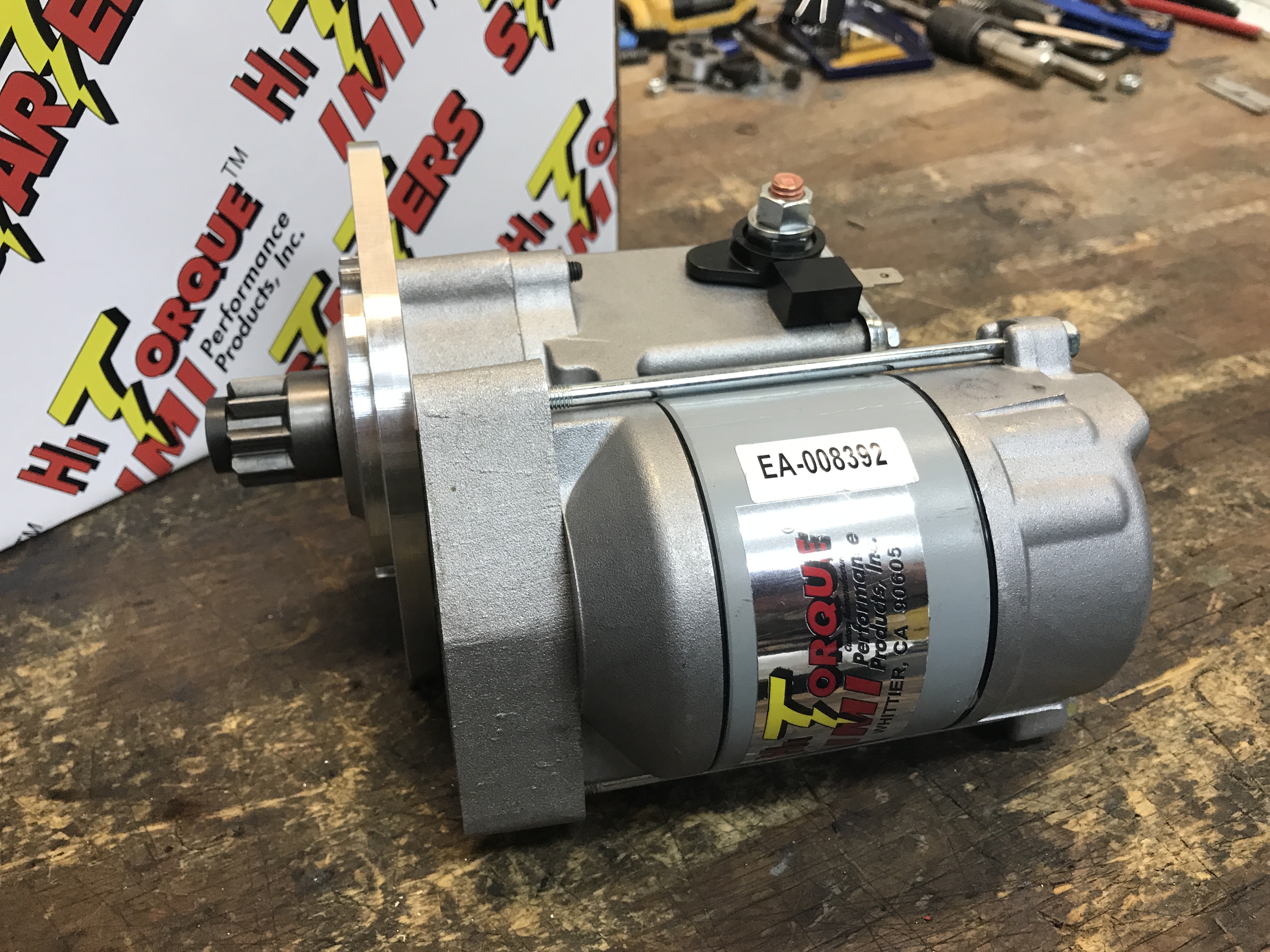

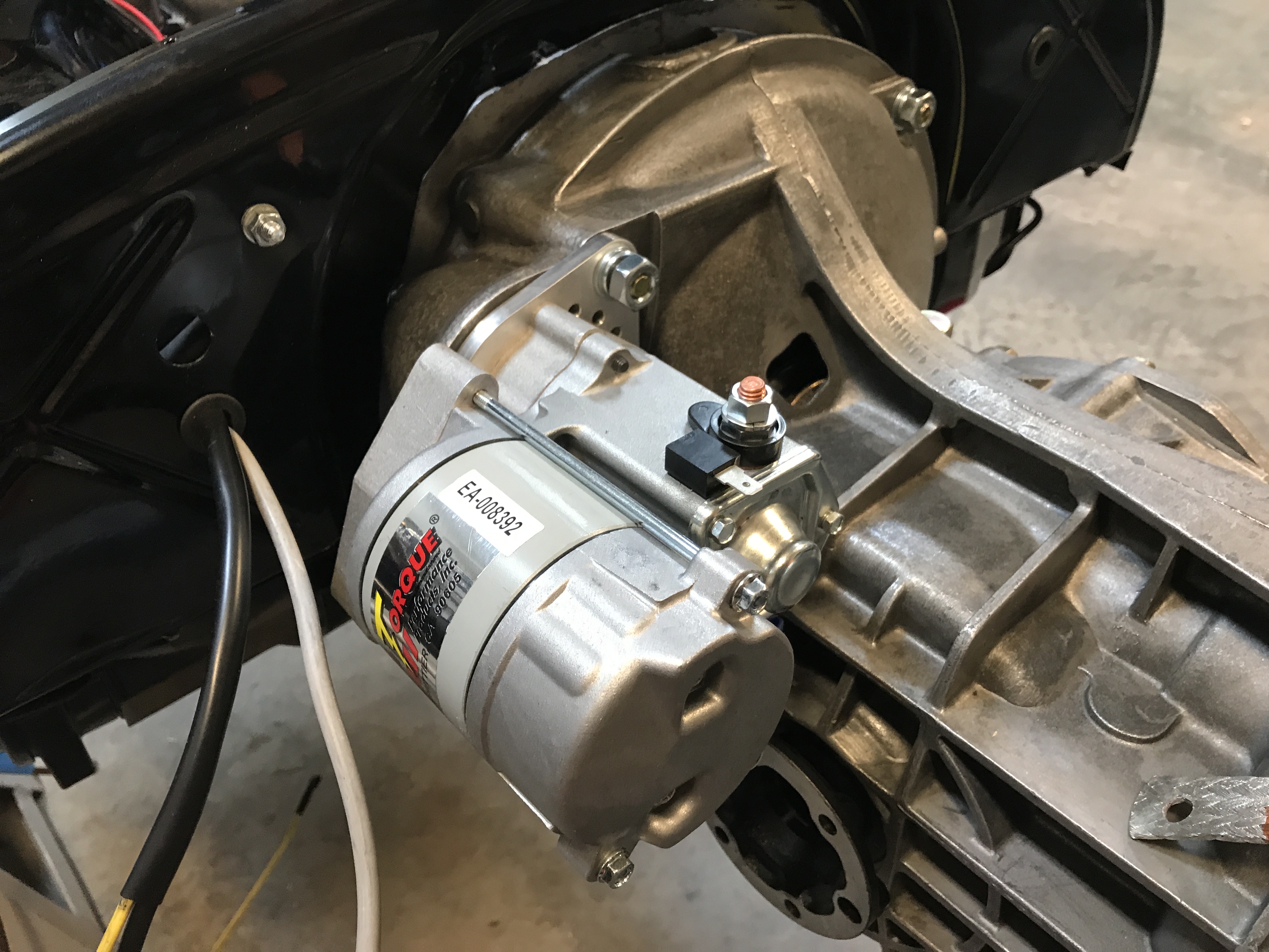

More engine-trans prep. How about a Hi-Torque starter? Less weight, more power.

Bolted on. (And then I torqued all the engine-trans bolts and nuts.)
