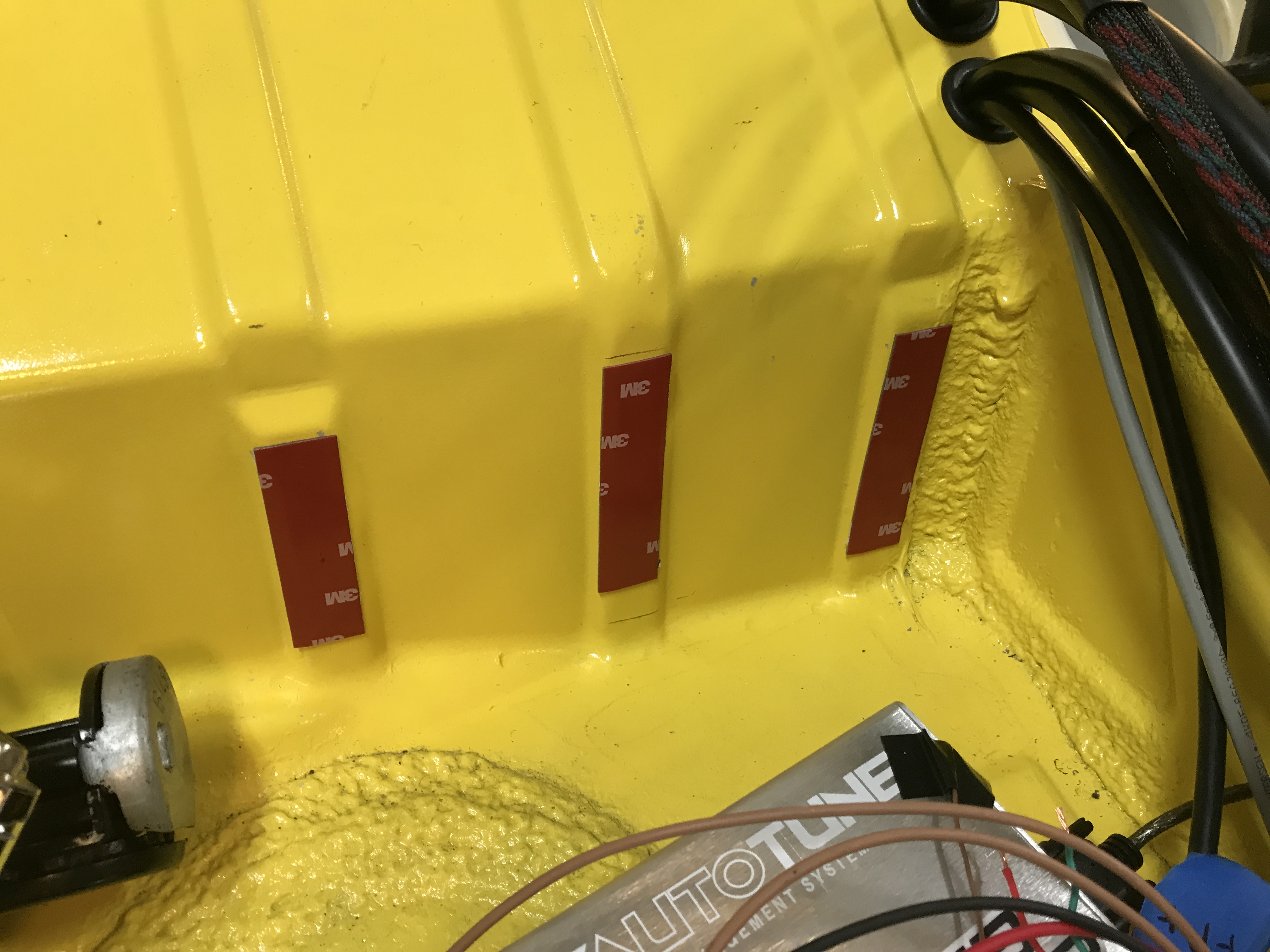

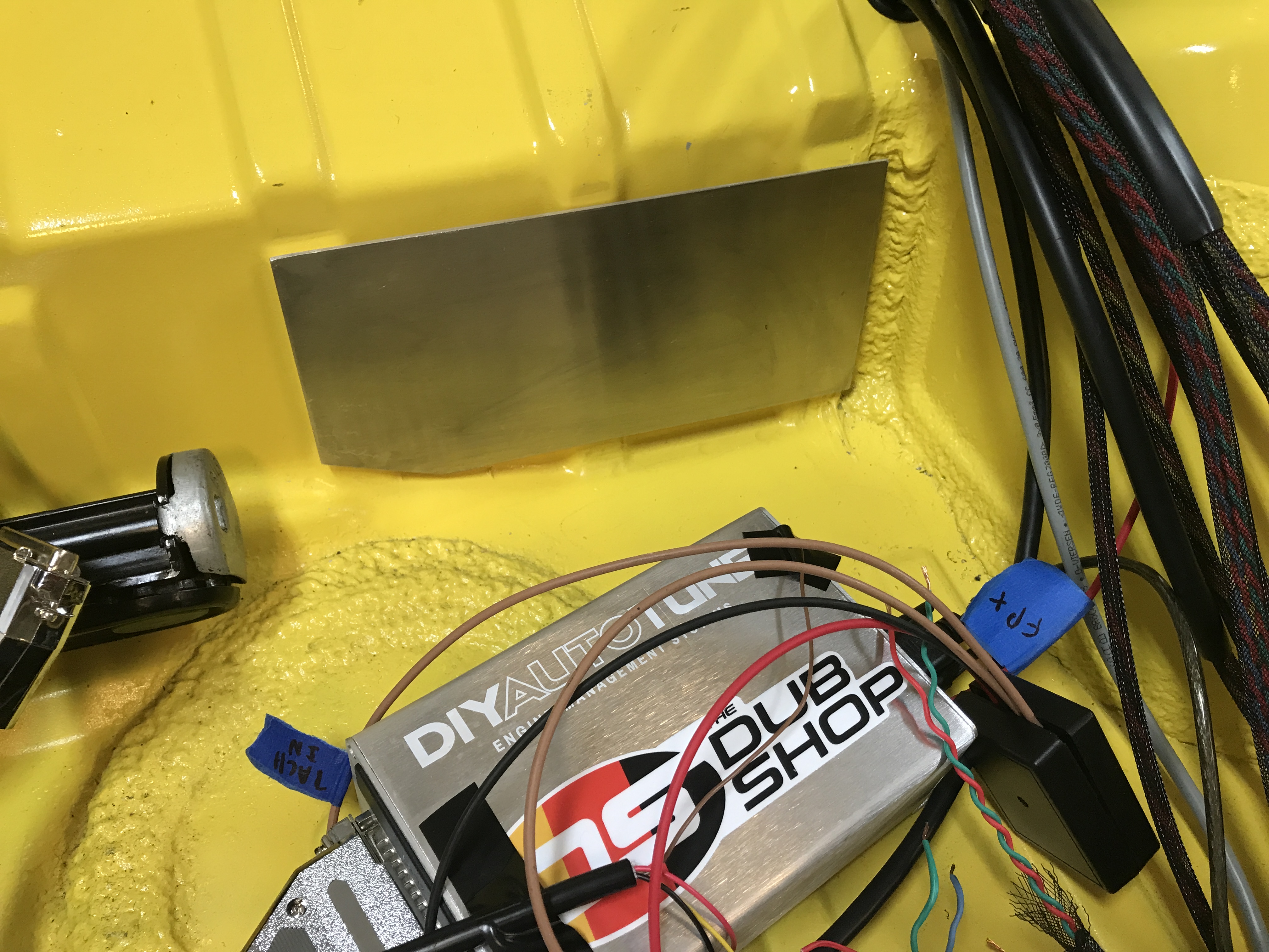

Extra-strong 3M adhesive tape.
bkrantz
post Dec 27 2021, 09:39 PM
Post #4502
Posts: 8,346
Joined: 3-August 19
From: SW Colorado
Member No.: 23,343
Mounting plate in place.

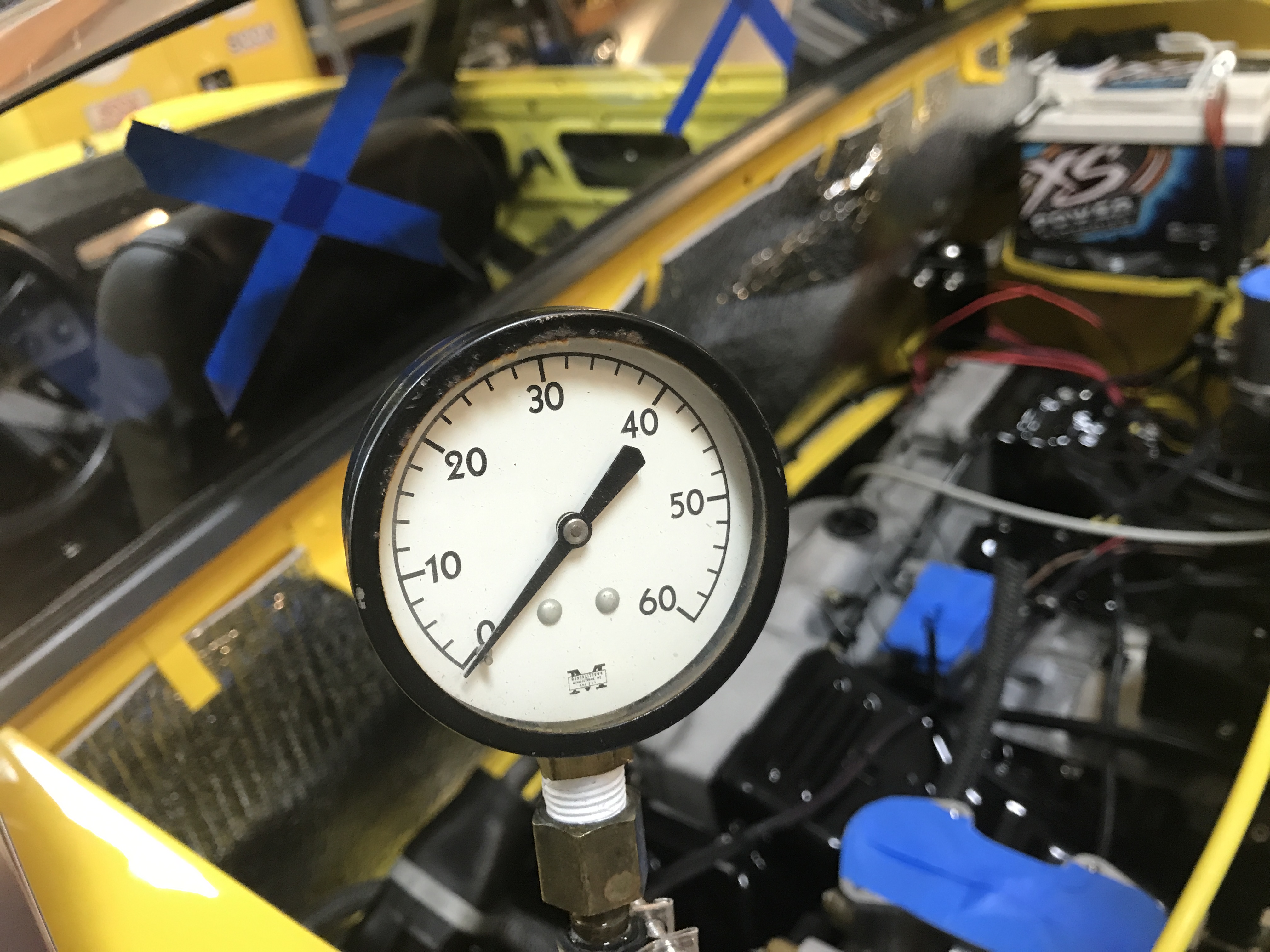

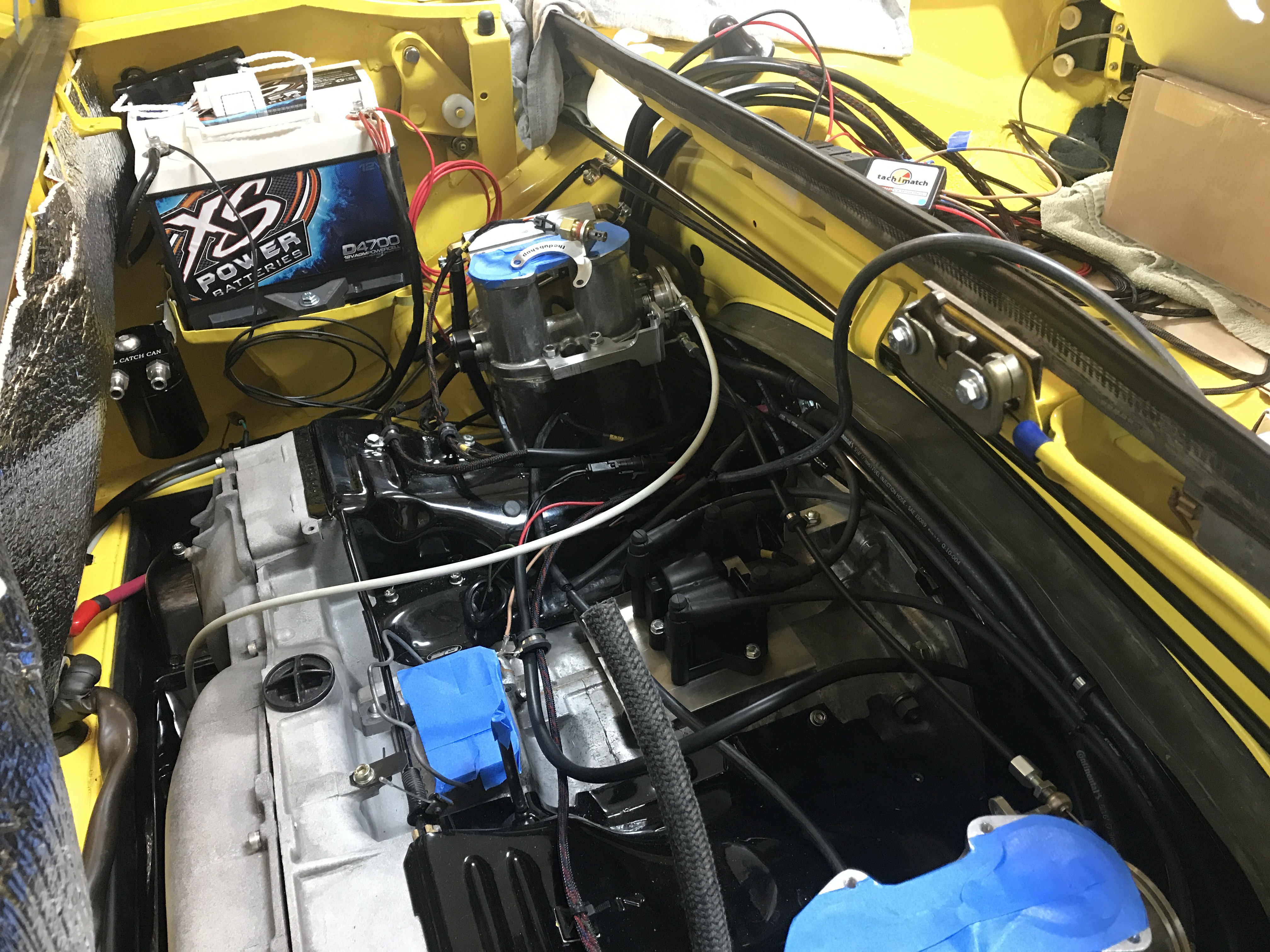

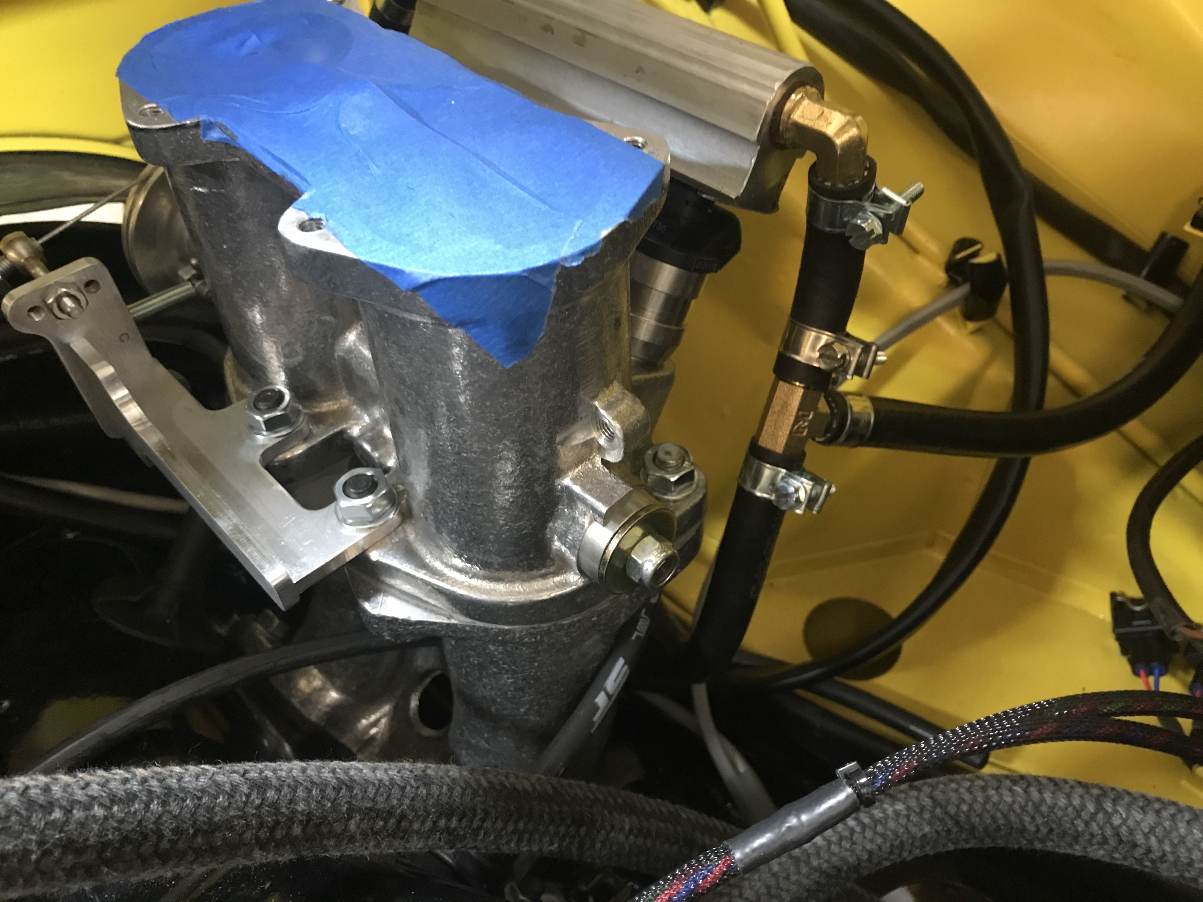

Getting ready for fuel system leak test #2. I added a T-fitting (temporary).
bkrantz
post Dec 28 2021, 08:34 PM
Post #4507
Posts: 8,346
Joined: 3-August 19
From: SW Colorado
Member No.: 23,343
The T allows me to connect a pressure gauge.
bkrantz
post Dec 28 2021, 08:37 PM
Post #4508
Posts: 8,346
Joined: 3-August 19
From: SW Colorado
Member No.: 23,343

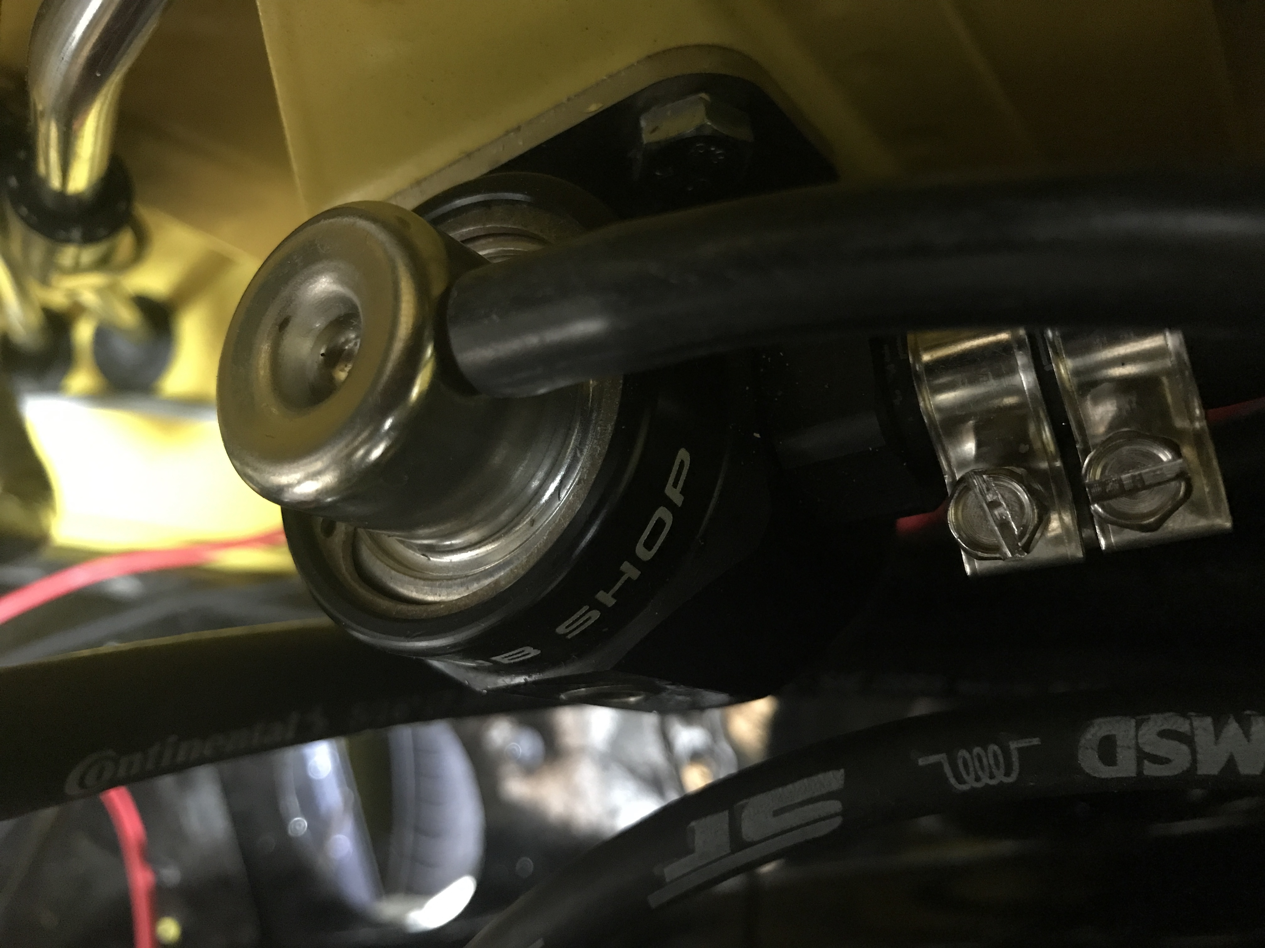

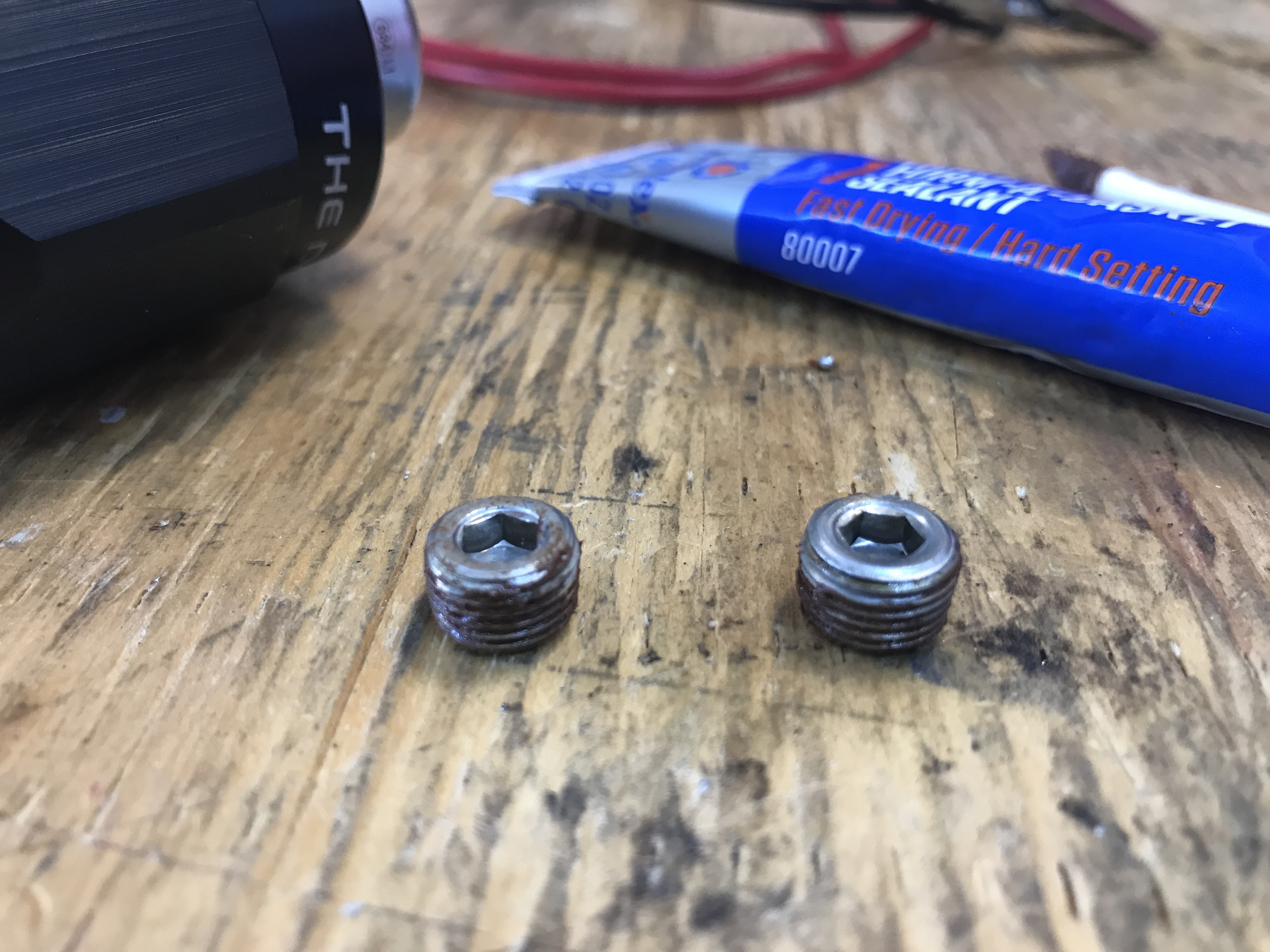

I also confirmed that the lead from the new relay box can power the fuel pump, and I cycled the pump 2 or 3 times.
Good news: the fittings I re-sealed on the injector rails did not leak.
Bad news: I found a leak on the new pressure regulator.
bkrantz
post Dec 28 2021, 08:38 PM
Post #4509
Posts: 8,346
Joined: 3-August 19
From: SW Colorado
Member No.: 23,343

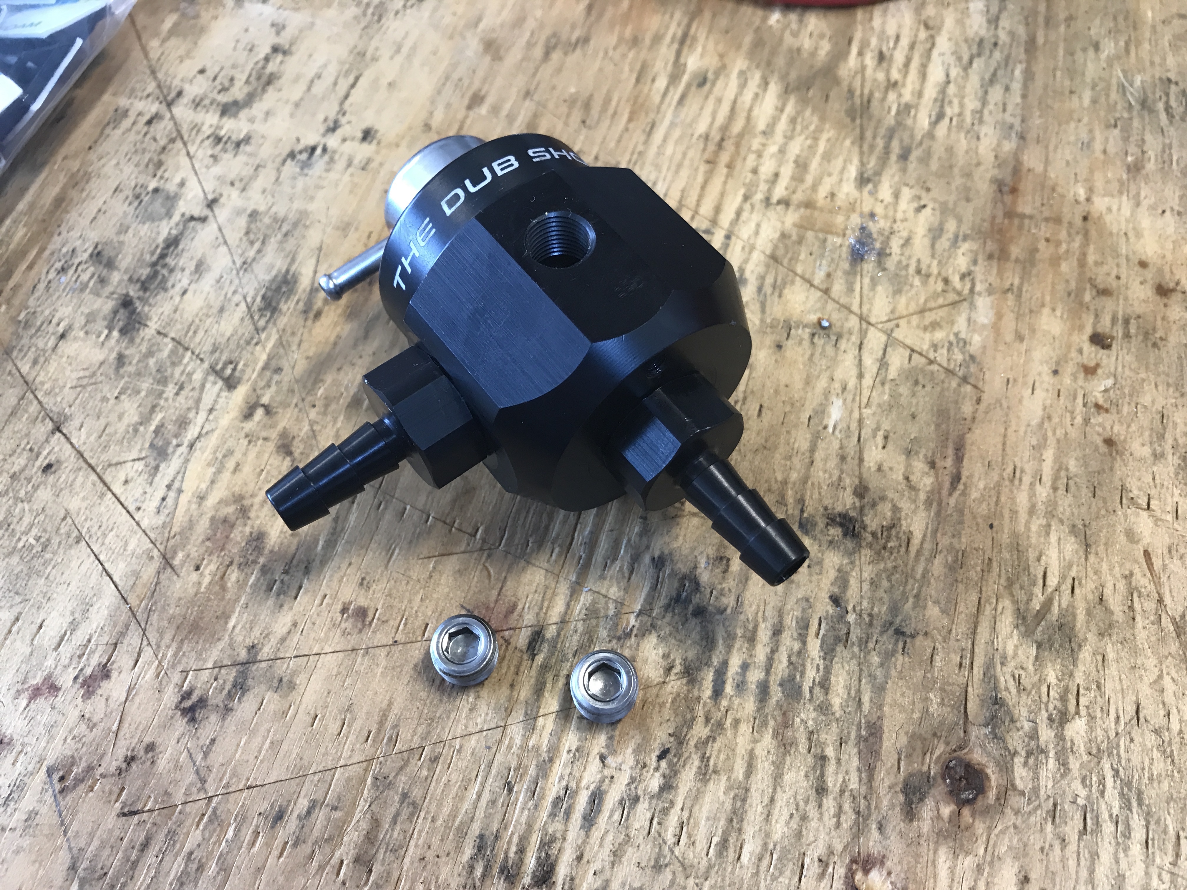

My bad. When I first installed the regulator, I did not seal the small plugs for auxiliary ports.
bkrantz
post Dec 28 2021, 08:40 PM
Post #4510
Posts: 8,346
Joined: 3-August 19
From: SW Colorado
Member No.: 23,343
So I used the same hard-setting sealant, re-installed the regulator, and put the fuel system back together.

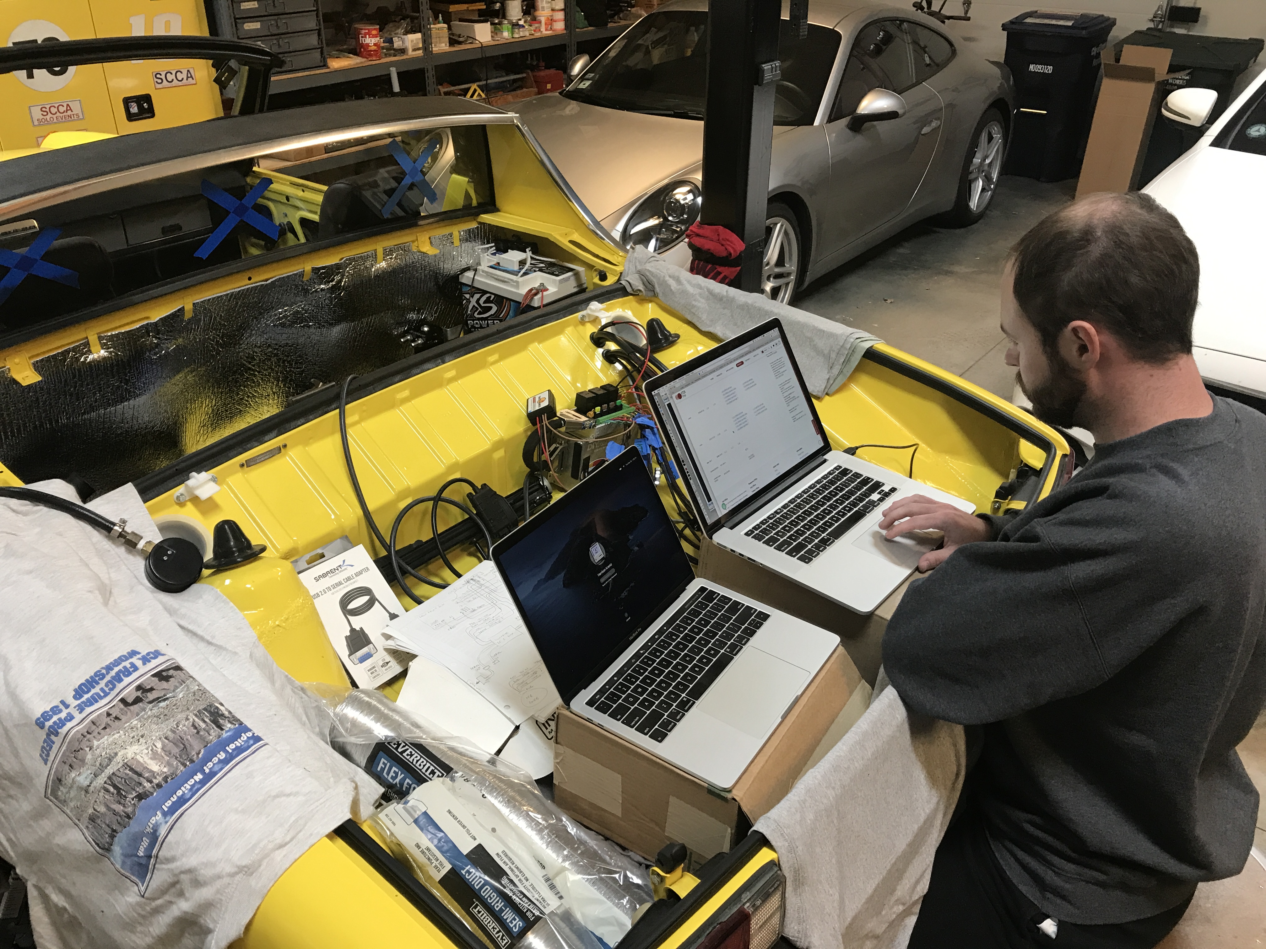

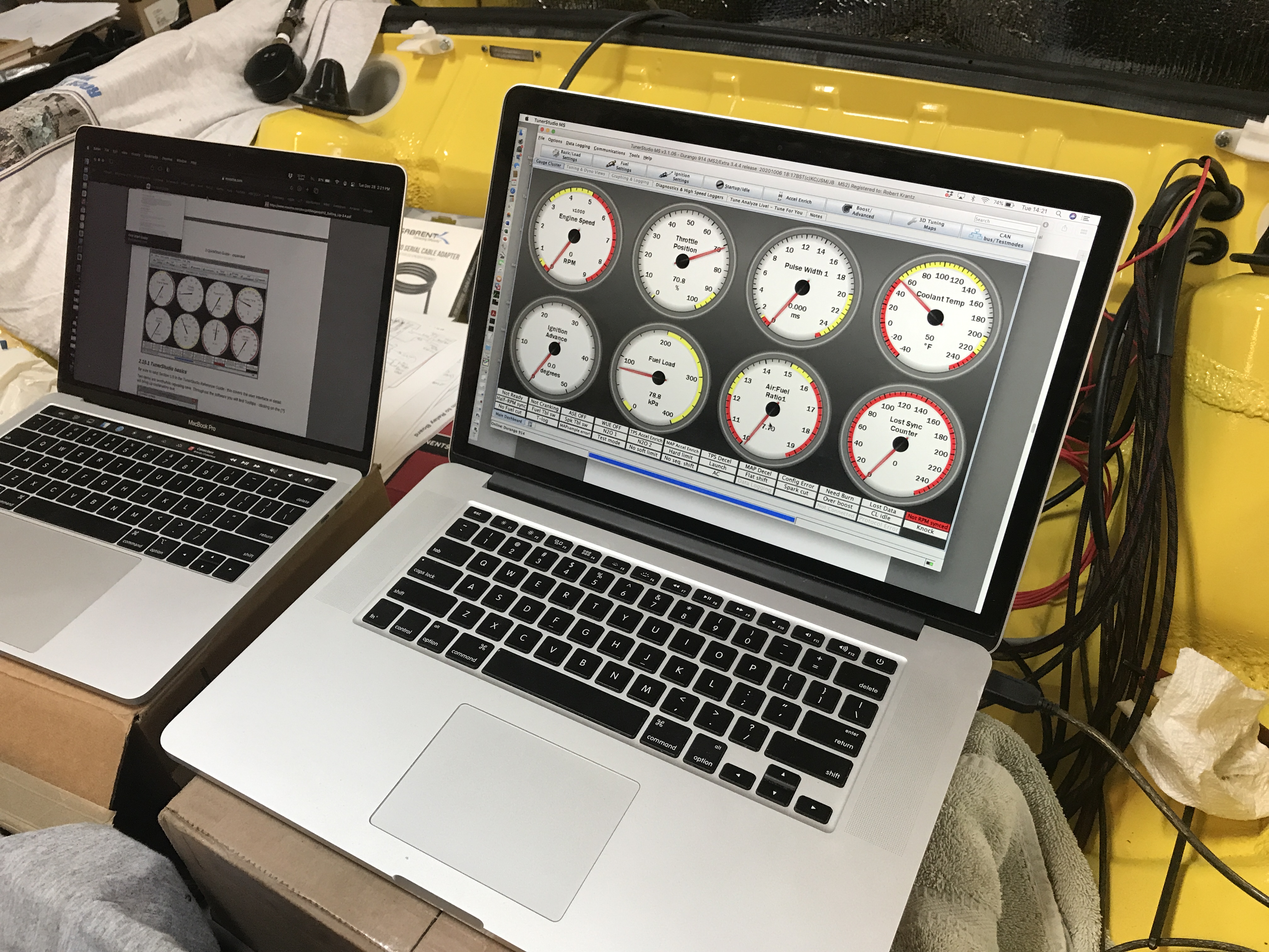

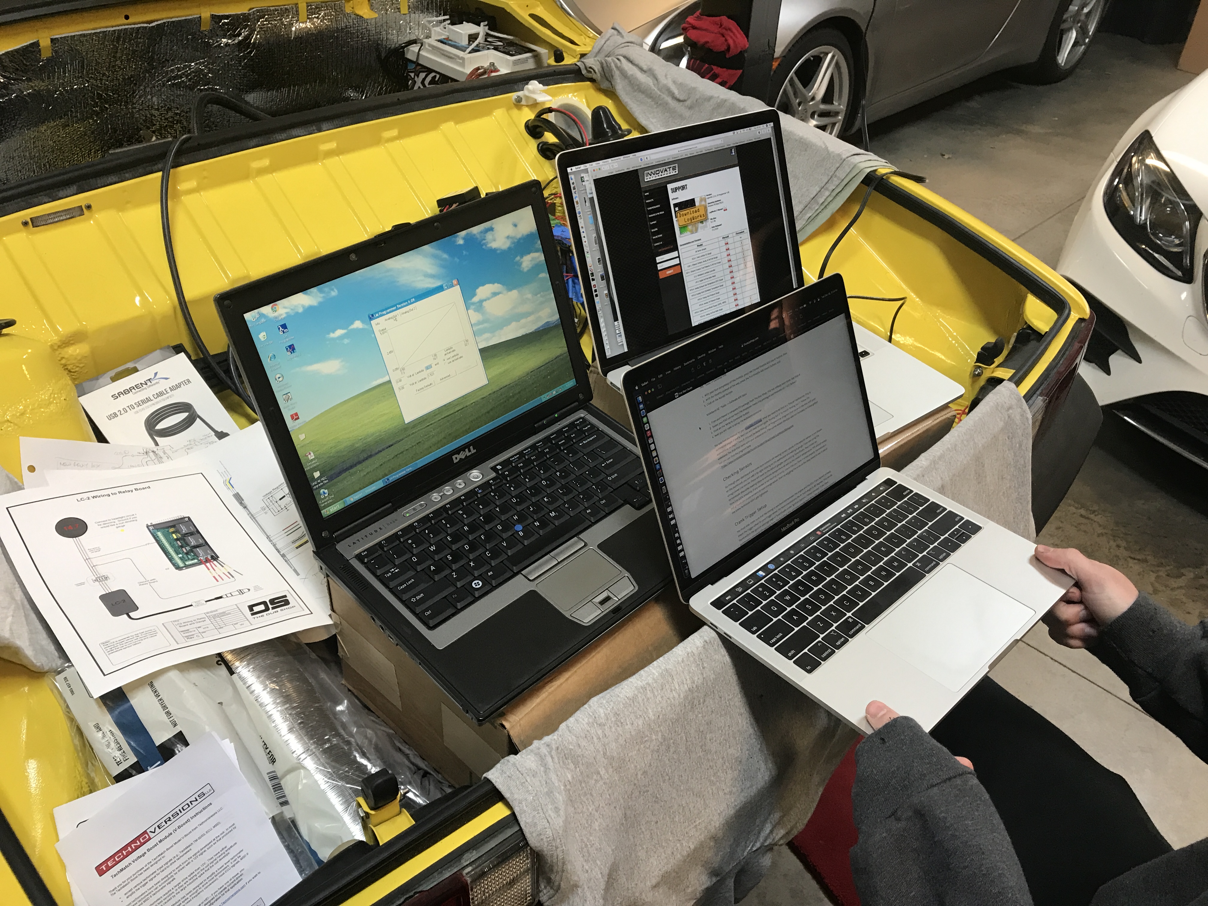

We got my Mac laptop connected, after a few minor bugs. The other laptop belongs to my IT wizard son. We started going through the initial set up and calibrations.
bkrantz
post Dec 28 2021, 08:47 PM
Post #4513
Posts: 8,346
Joined: 3-August 19
From: SW Colorado
Member No.: 23,343
Here we are, running MegaLog Viewer, and checking sensors and settings.

To set up the O2 system we needed a program that seems to be available only on Windows, so I got out my old Dell.

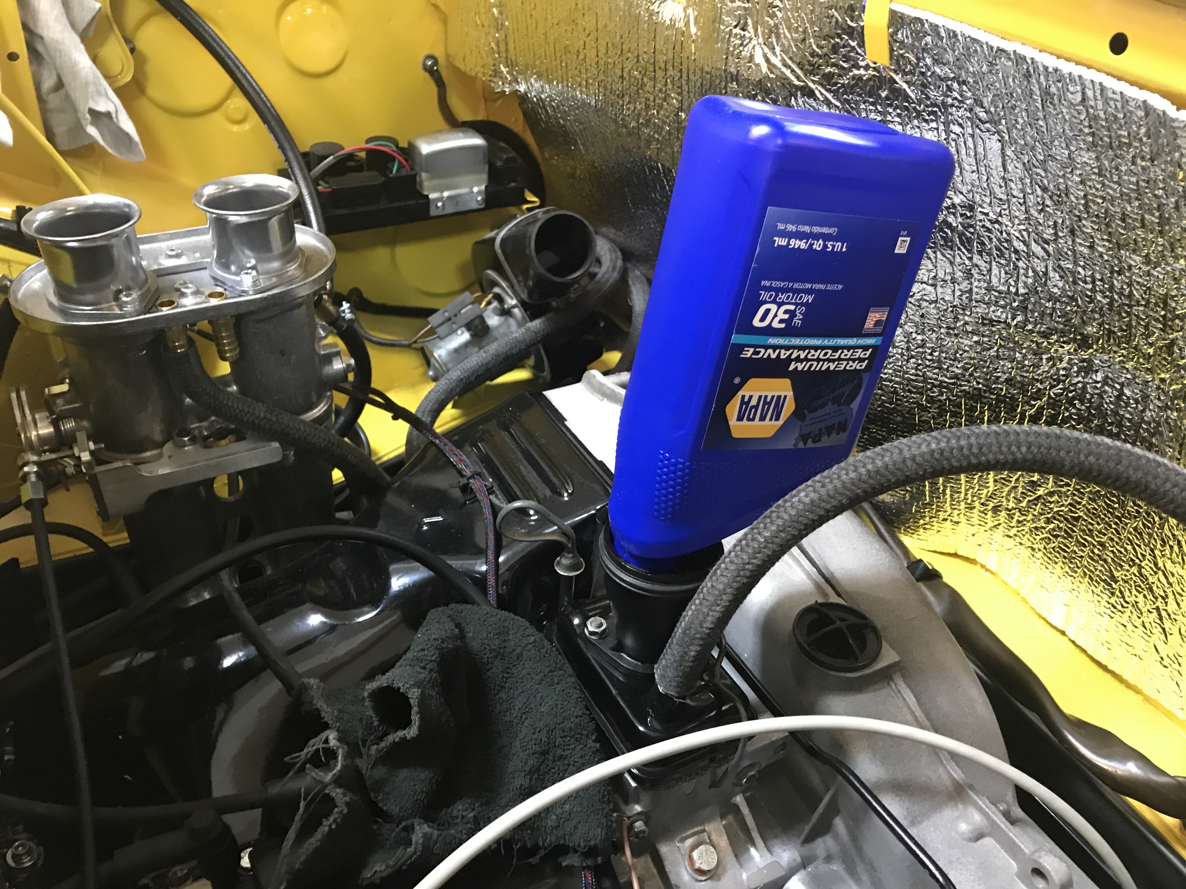

Next, the first oil fill, with straight 30 weight, plus a bottle of Lucas break-in additive, mostly for the boost in zinc.

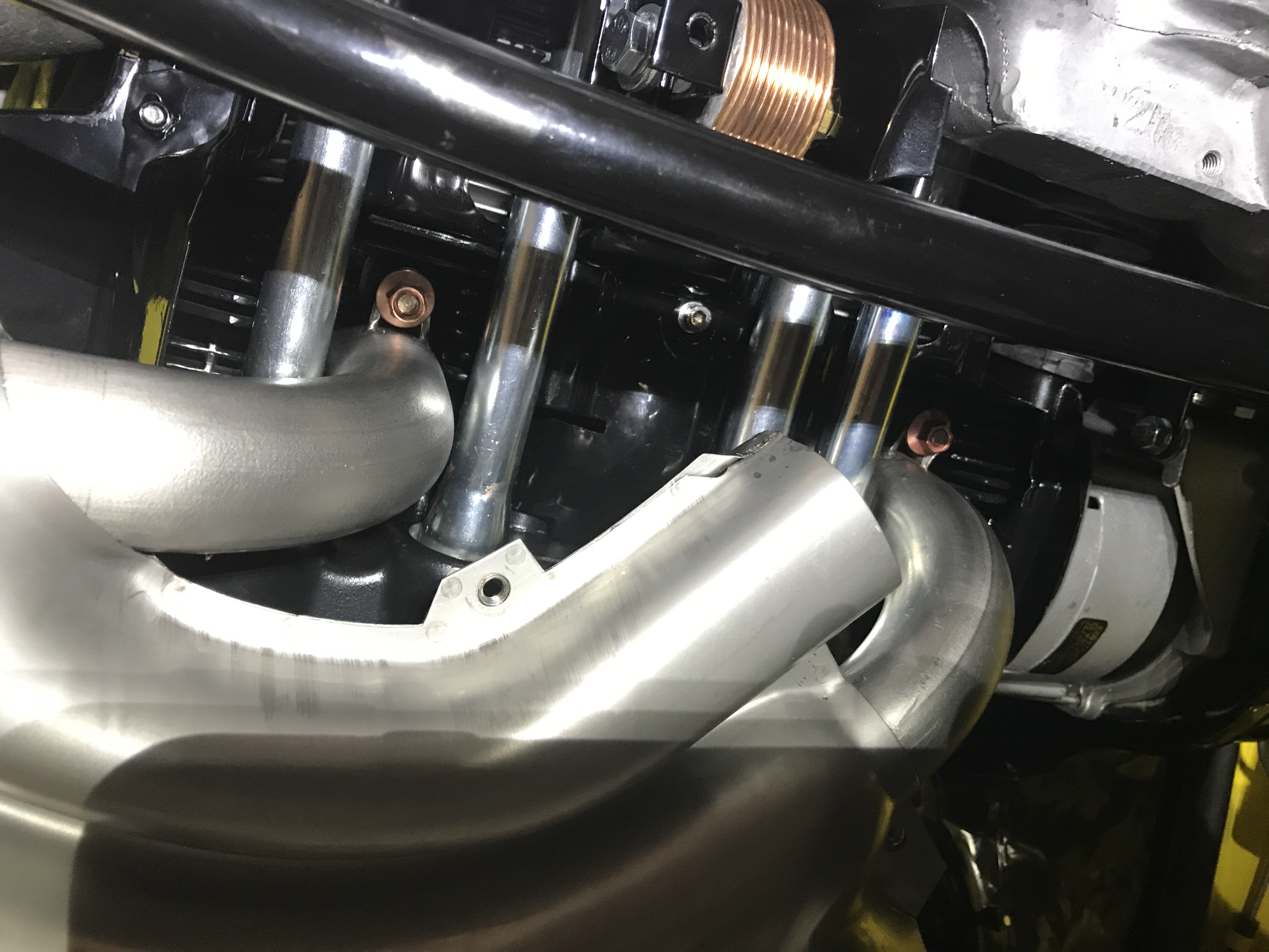

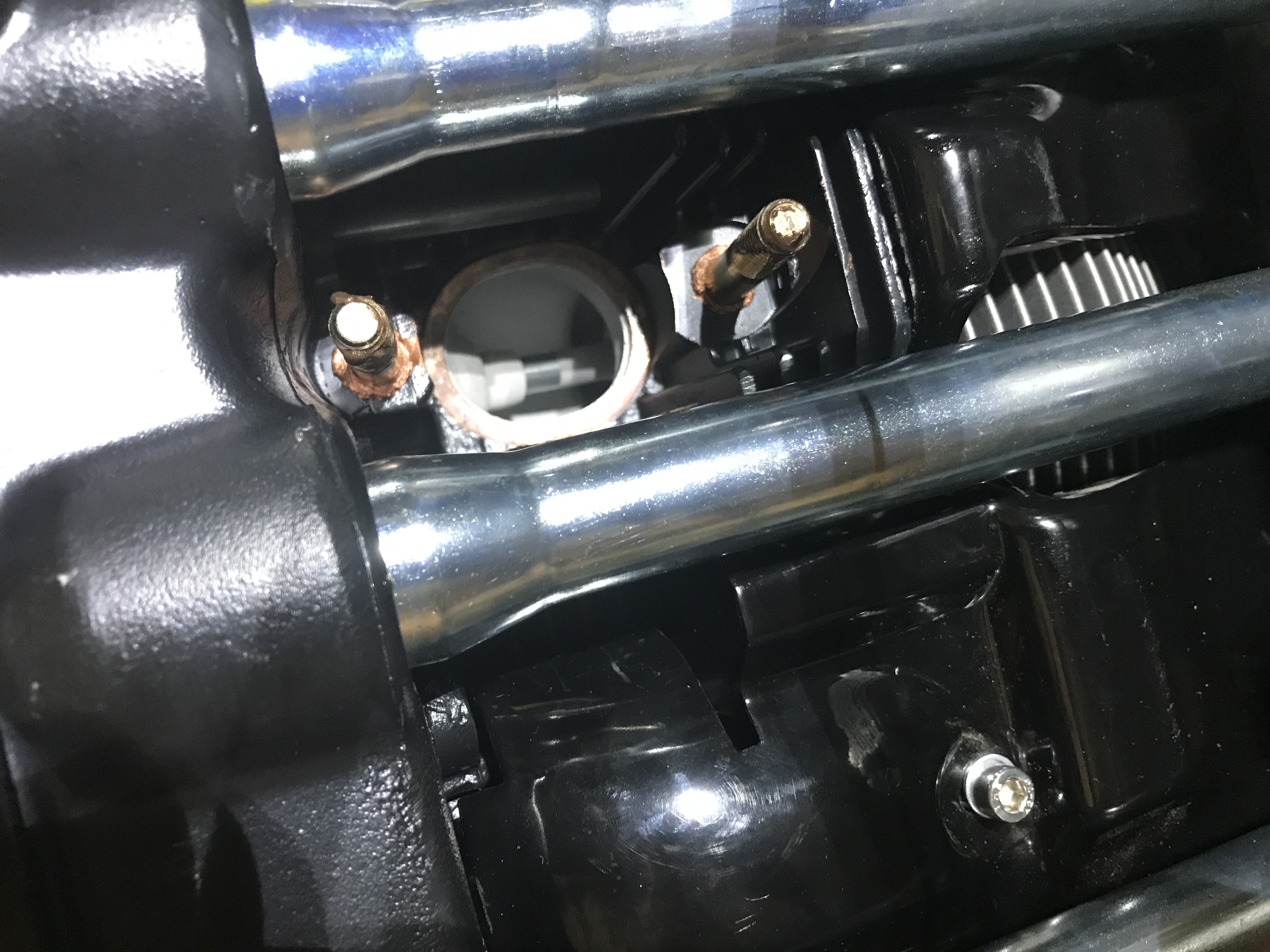

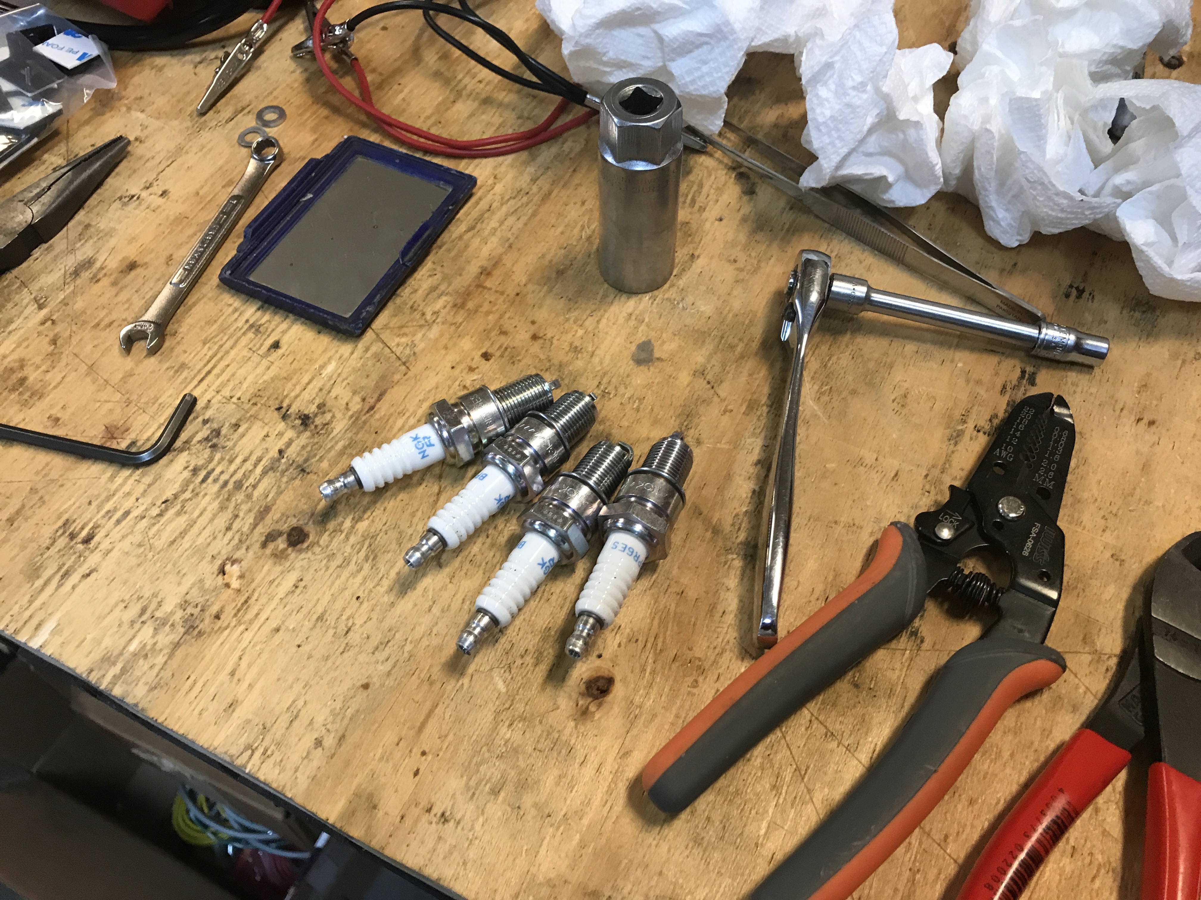

I pulled the plugs I had installed while the engine was out. My first reminder of some of the fun things about wrenching on a 914 engine.

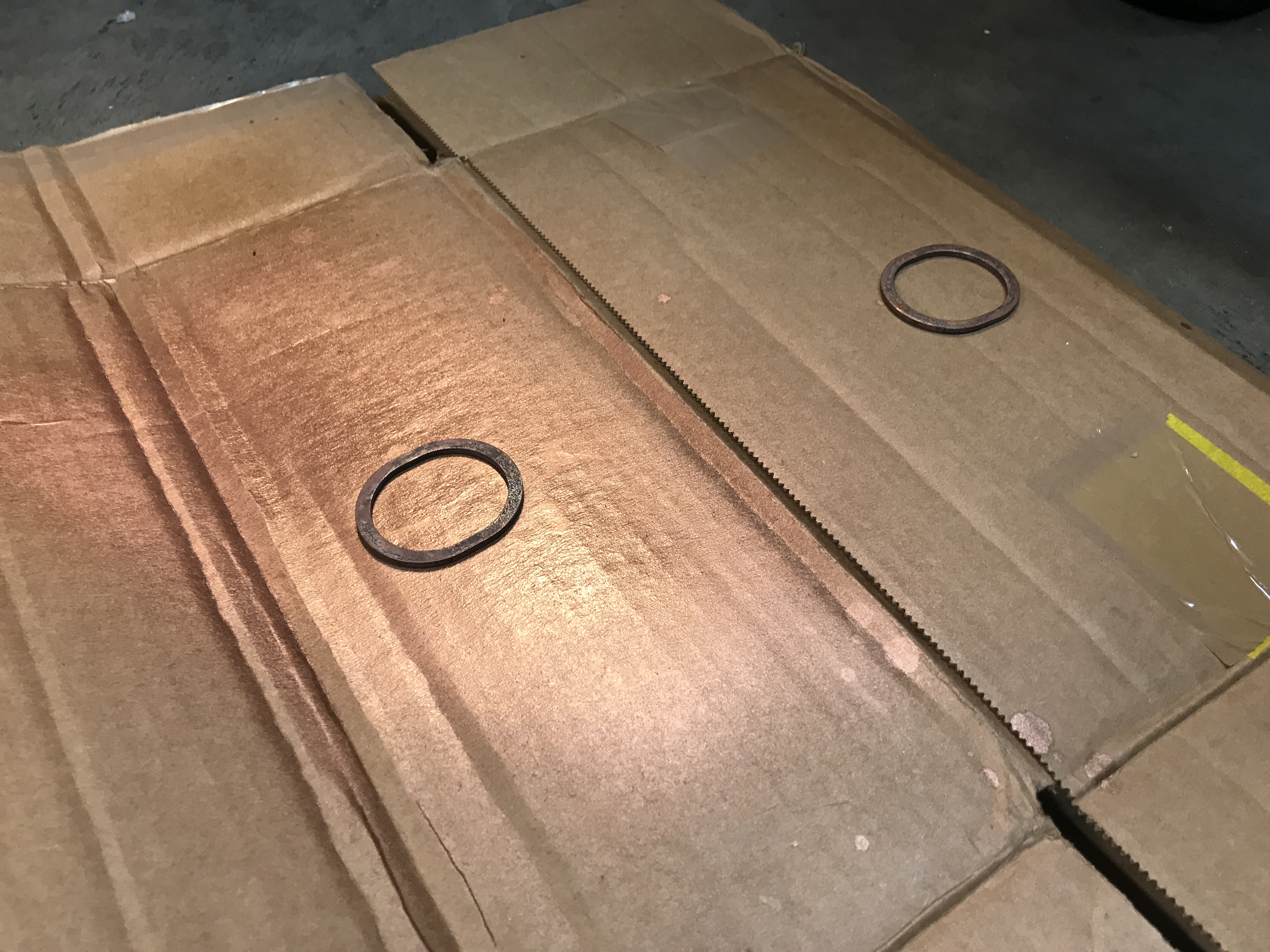

A few more things before start-up. I got out my annealed exhaust gaskets, and sprayed them with copper gasket stuff.
bkrantz
post Dec 28 2021, 08:57 PM
Post #4519
Posts: 8,346
Joined: 3-August 19
From: SW Colorado
Member No.: 23,343
This is sticky enough to hold the gasket rings in the exhaust ports.

I also got new copper-coated, locking flange nuts.
