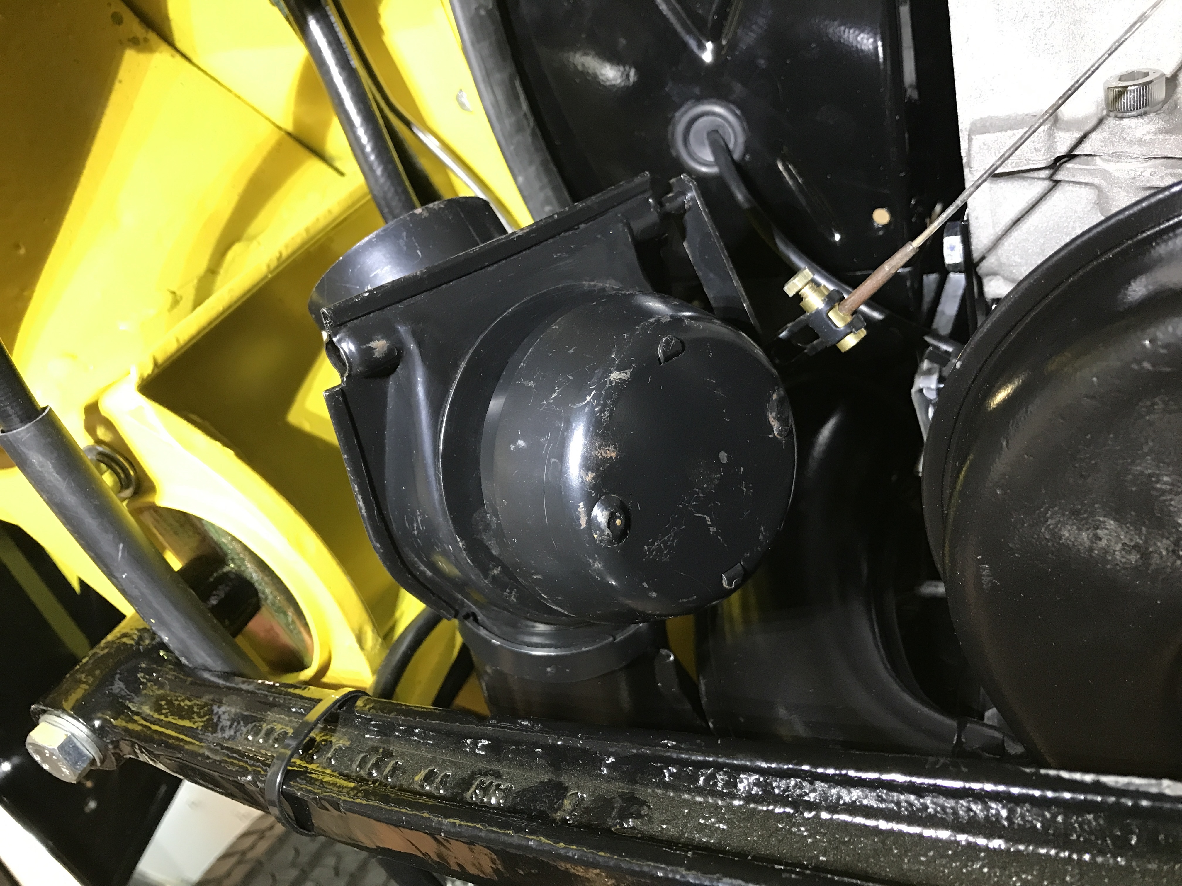

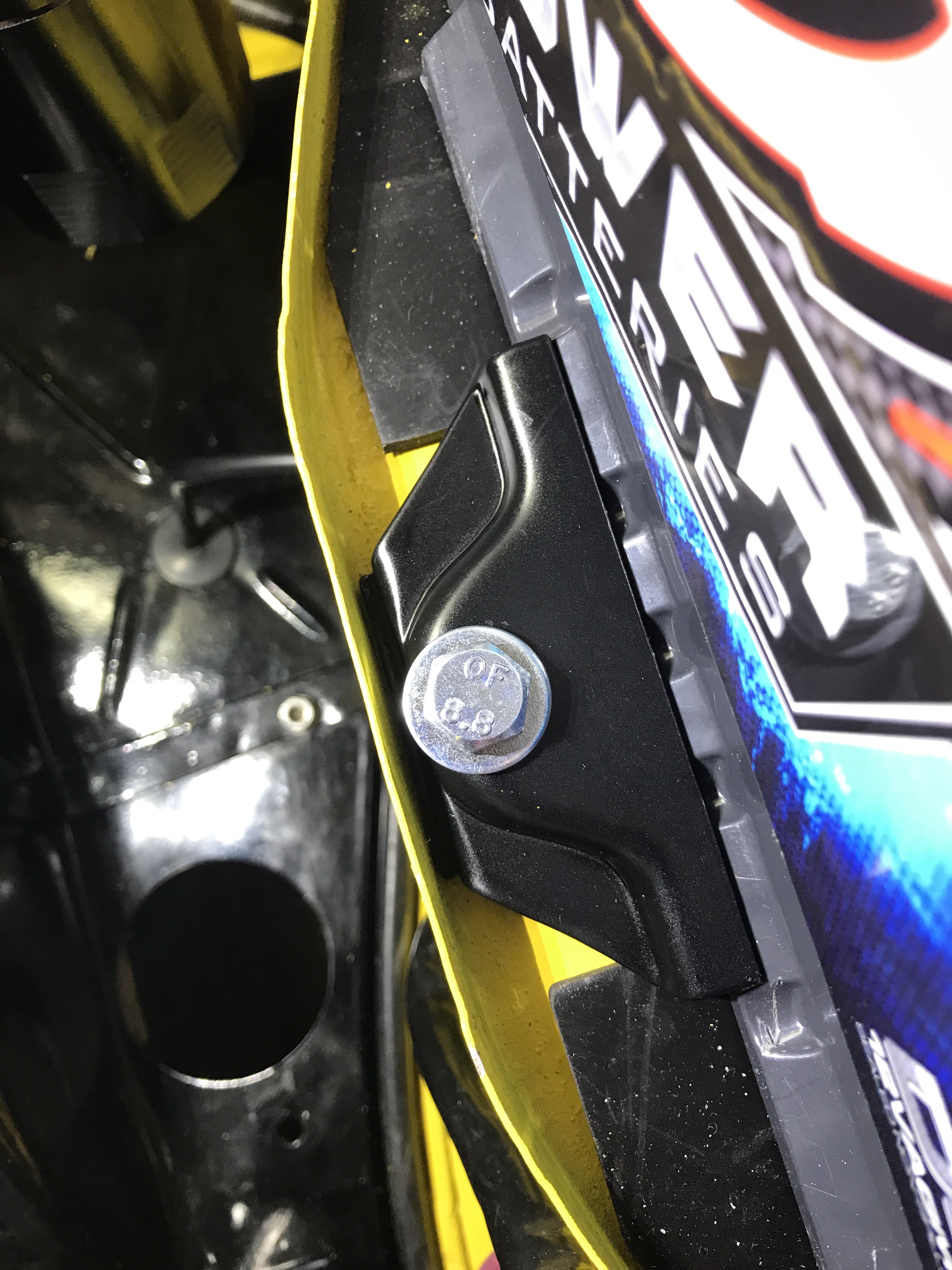

That extra thickness pushes the clamp closer to the battery, and makes for a better grip.

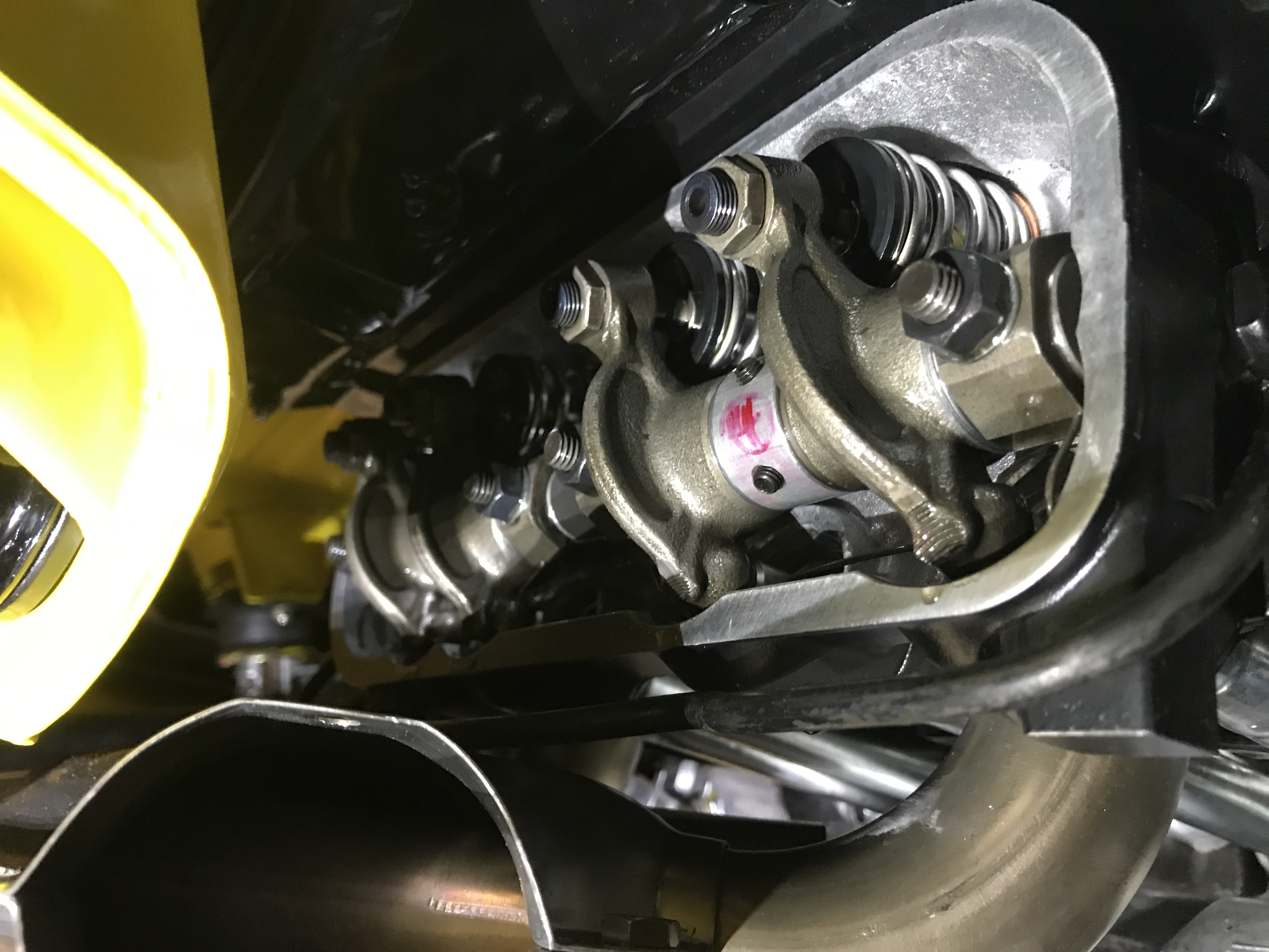

Now I am waiting for a replacement EFI part before I can continuing trouble-shooting.
Meanwhile, I did my first 914 valve adjustment (with the engine in the car) in almost 30 years. Fond(?) memories.

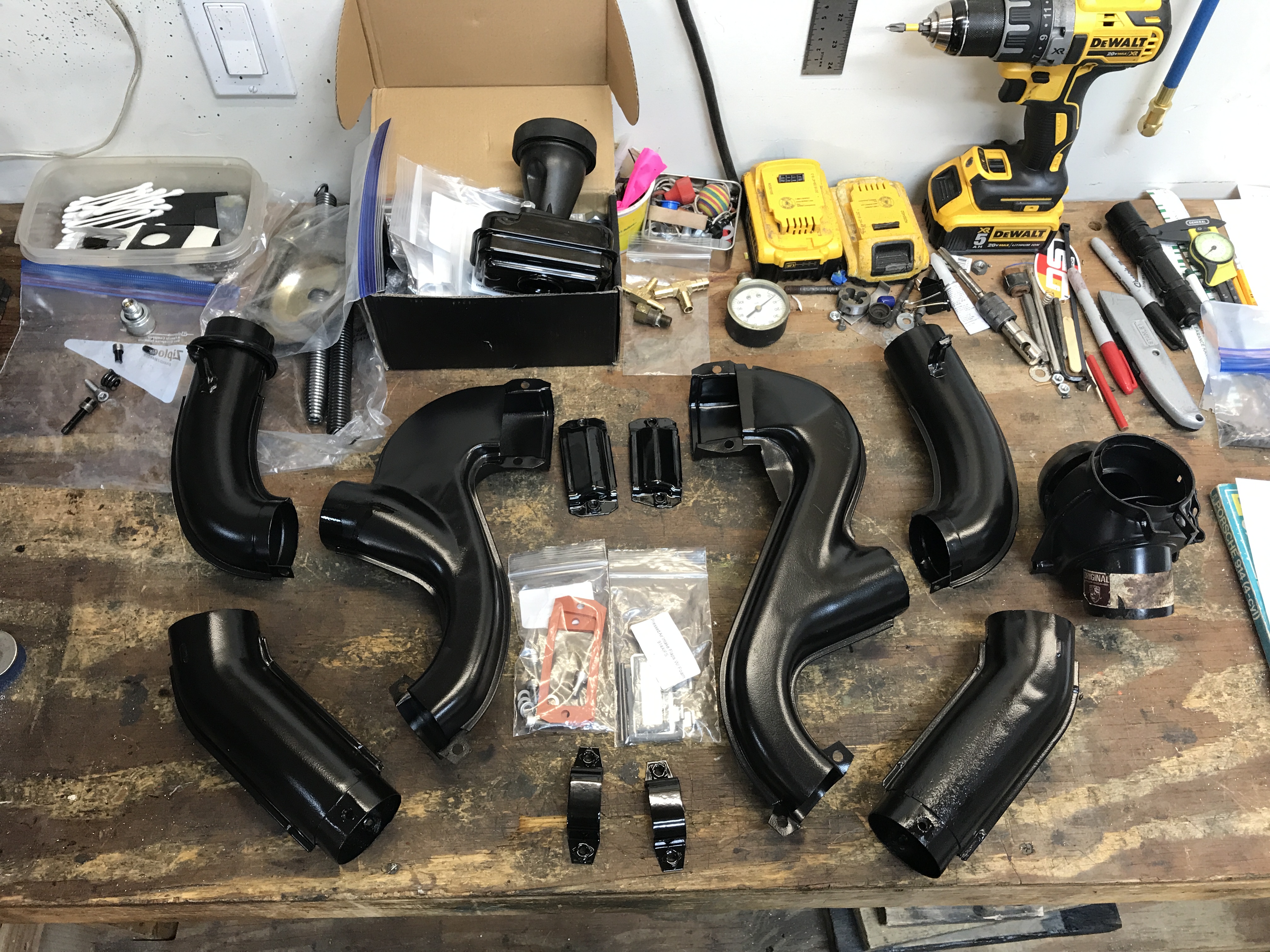

I have most of the parts to hook up the heating system. The duct sections I took off the car are all powder-coated. And I have one NOS heat control valve, with another on the way.

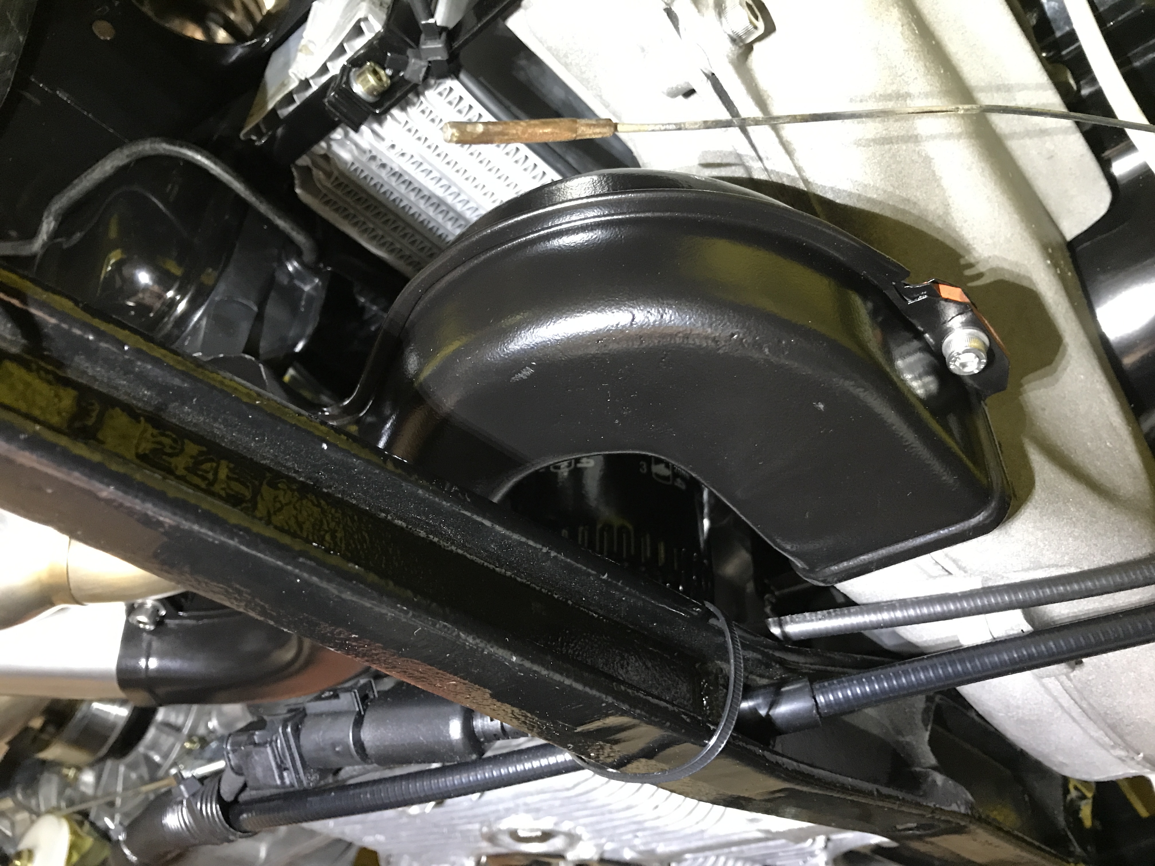

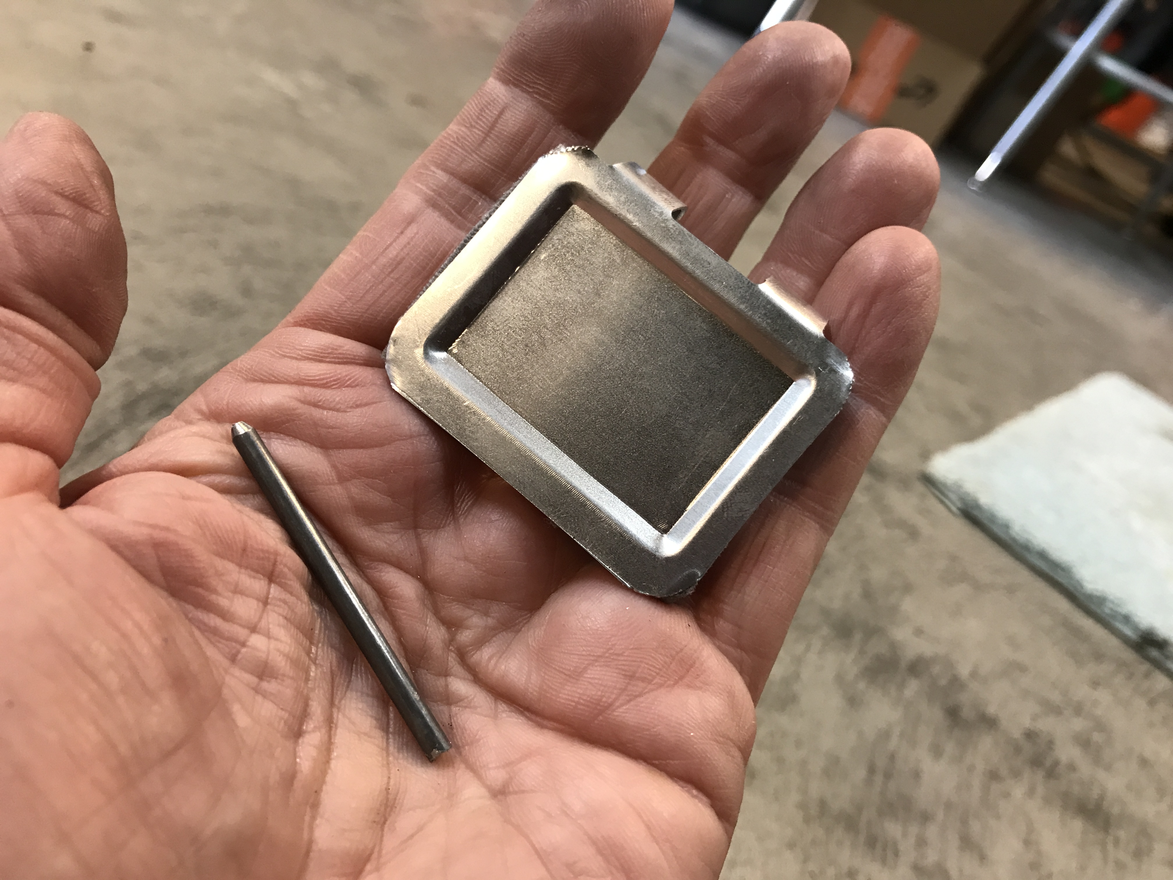

I also have some new bits from 914Rubber, including the baffle valves. These need a bit of trimming at corners, and the pivot pins need to be shortened.
bkrantz
post Jan 14 2022, 08:45 PM
Post #4670
Posts: 8,345
Joined: 3-August 19
From: SW Colorado
Member No.: 23,343

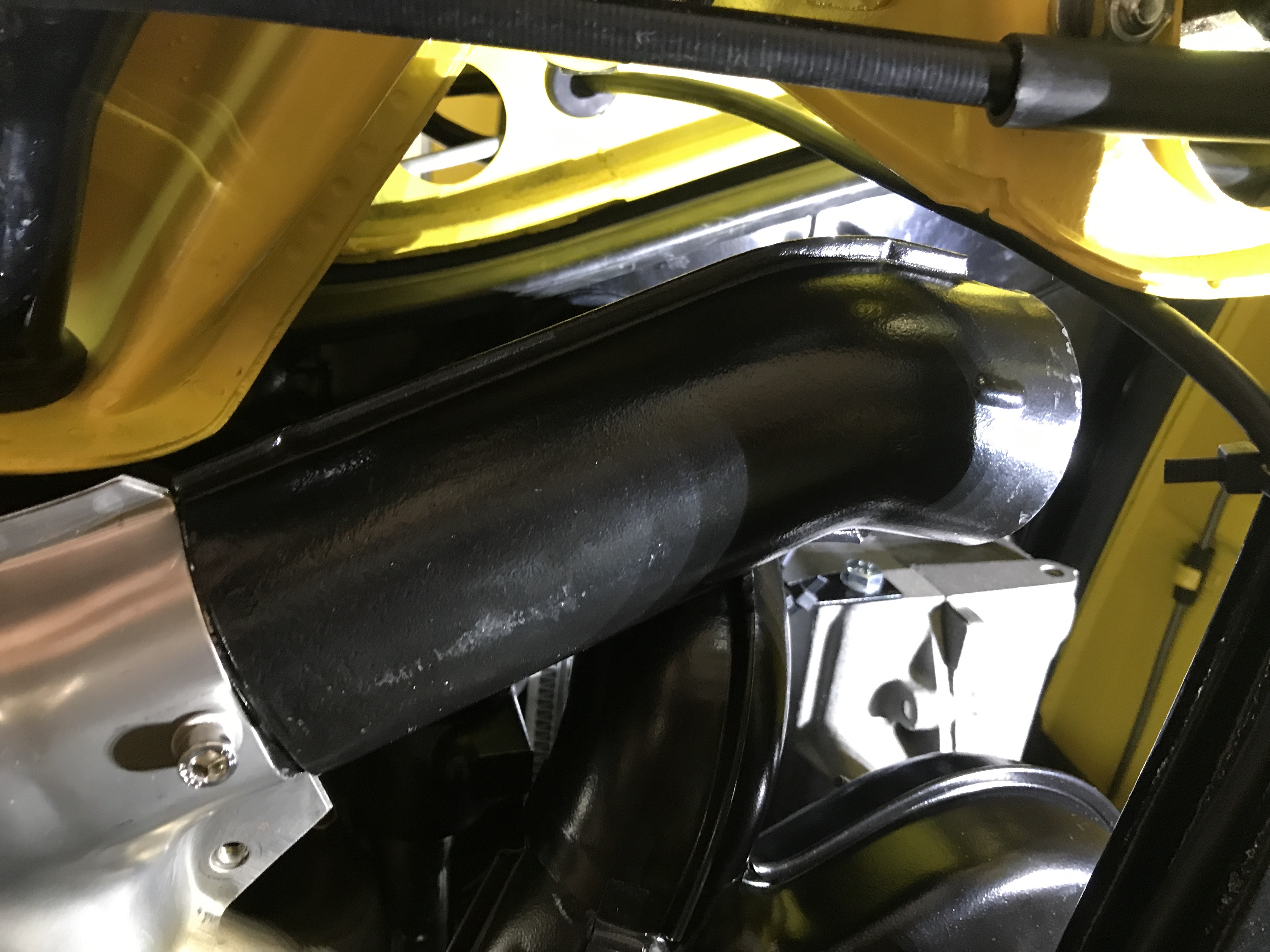

First section of duct (passenger side).

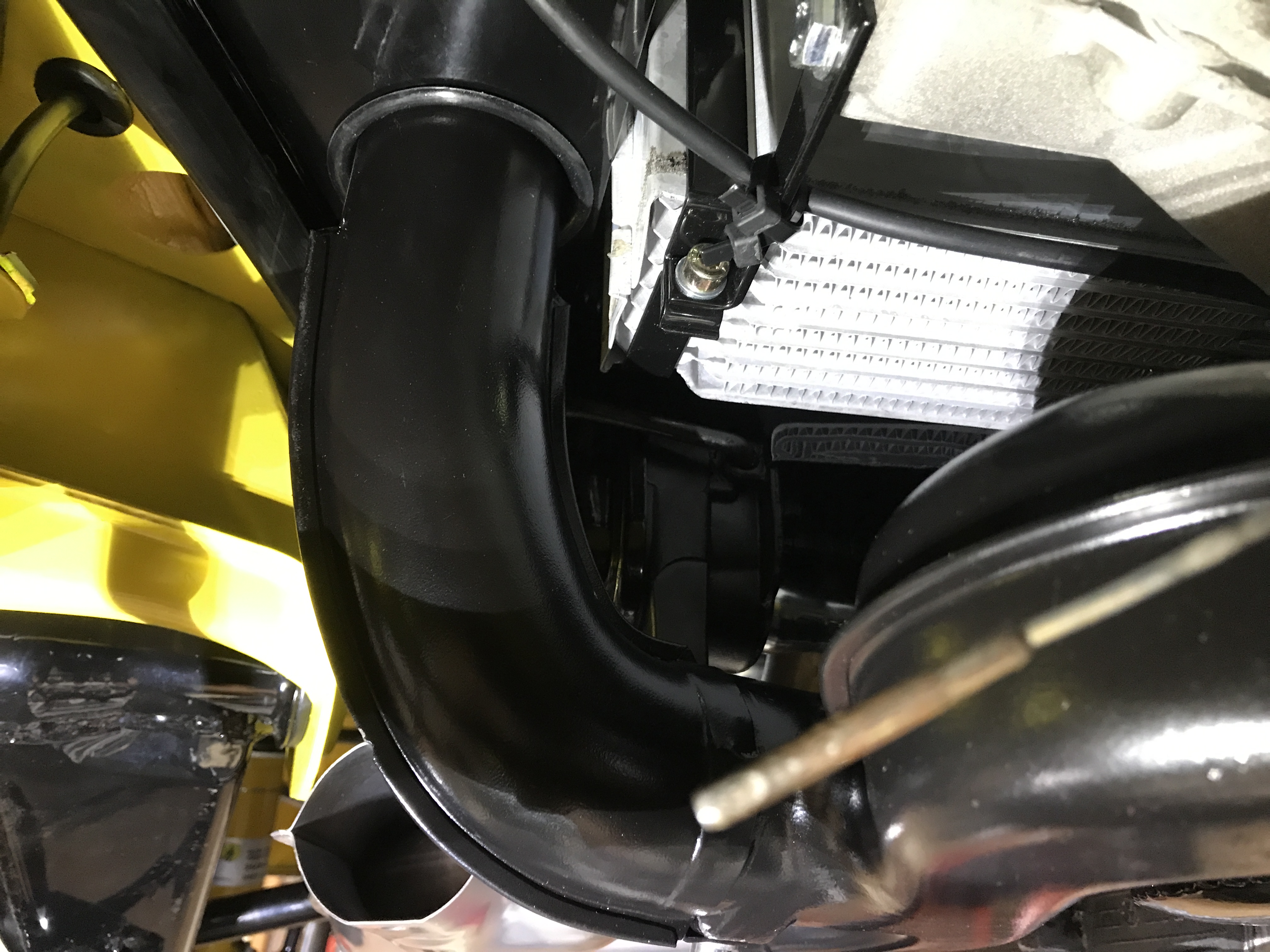

And the section section, up through the sheet metal, with a new ring gasket. Pretty easy so far.

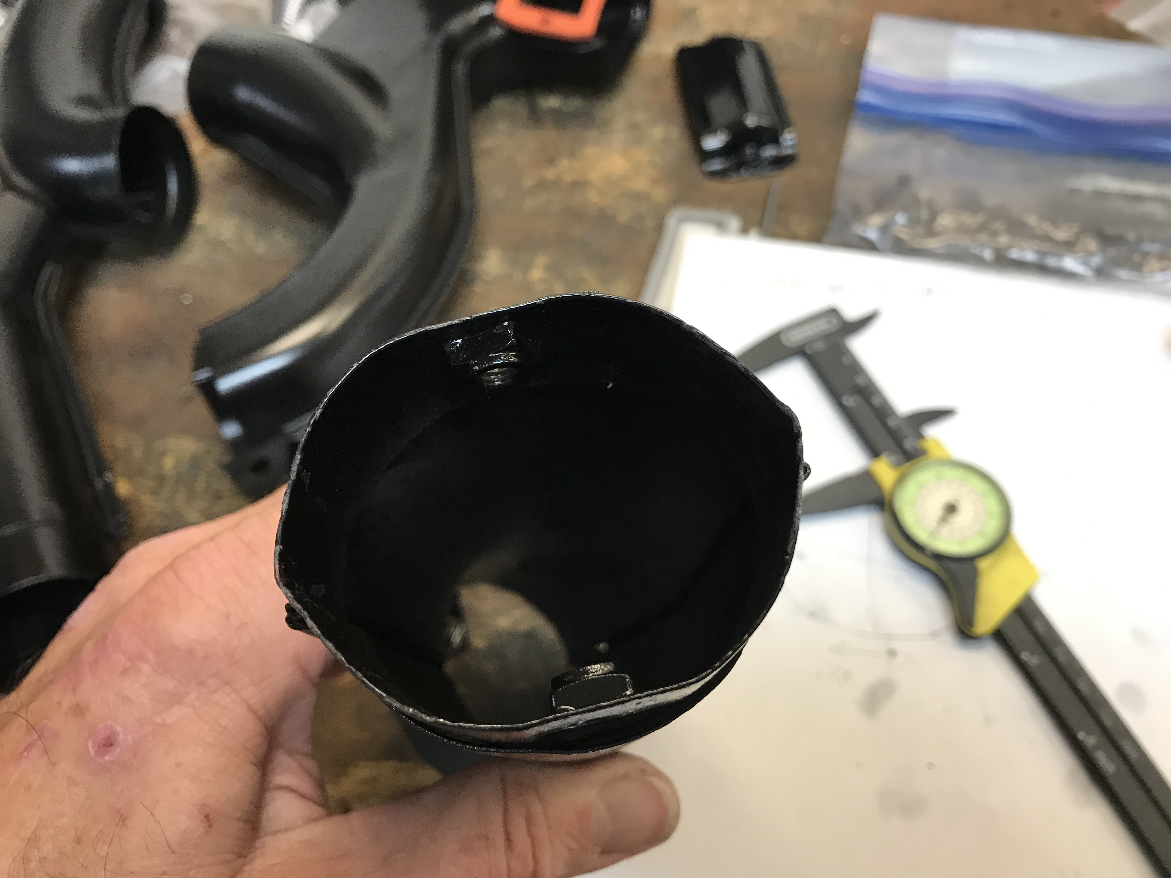

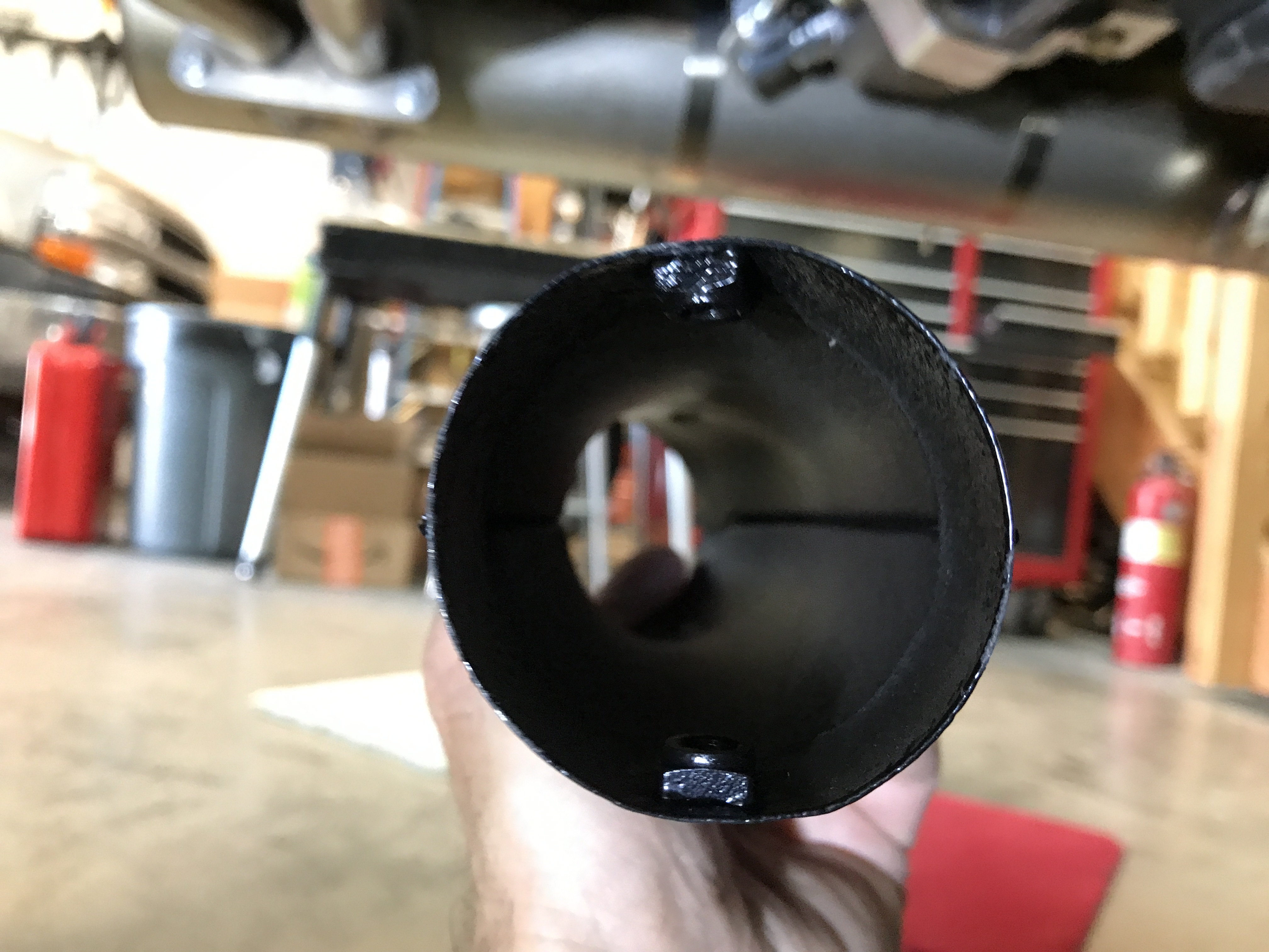

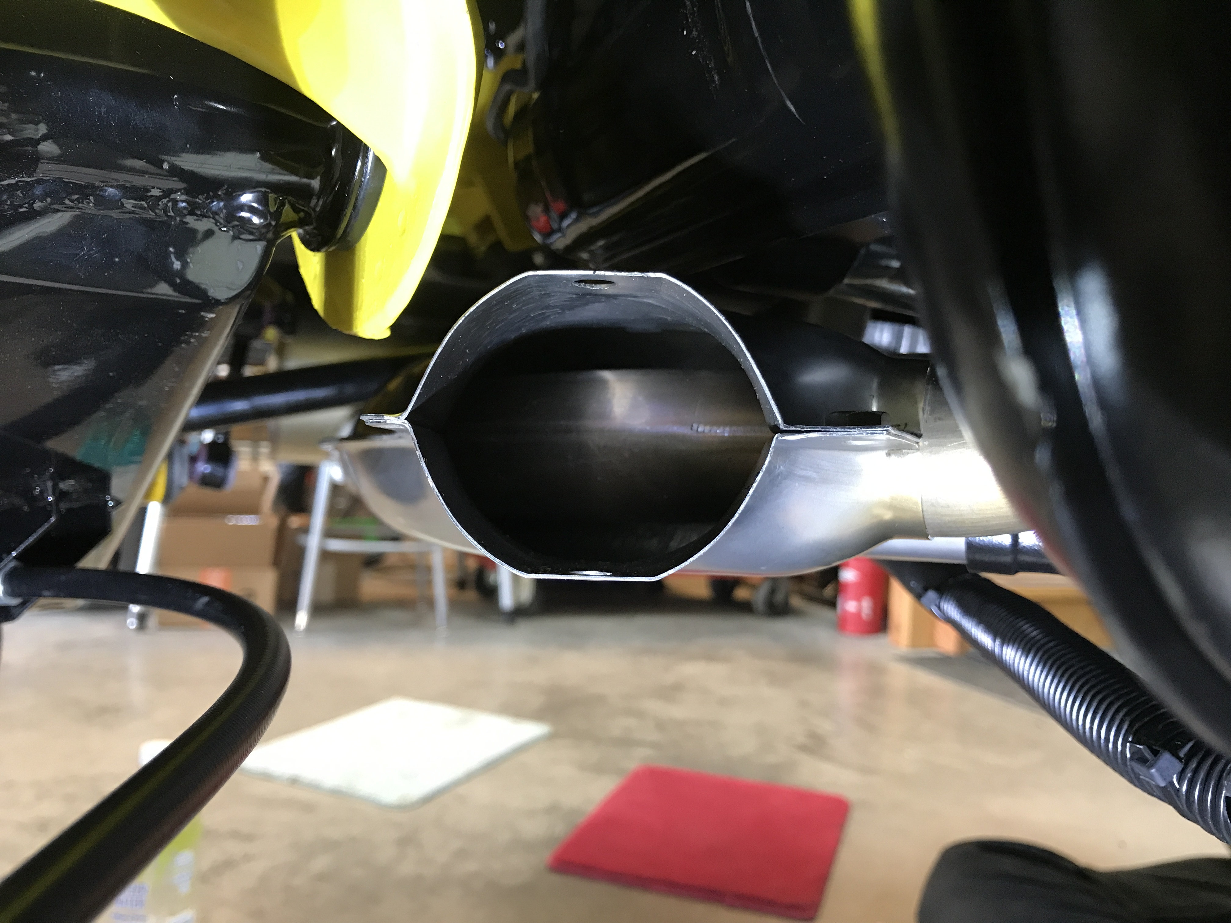

The the fun started, with the short section that connect the heat exchanger outlet with the control box. These did not want to mate at all, and look like different sizes.
bkrantz
post Jan 14 2022, 08:54 PM
Post #4673
Posts: 8,345
Joined: 3-August 19
From: SW Colorado
Member No.: 23,343
The duct section is round.
bkrantz
post Jan 14 2022, 08:55 PM
Post #4674
Posts: 8,345
Joined: 3-August 19
From: SW Colorado
Member No.: 23,343

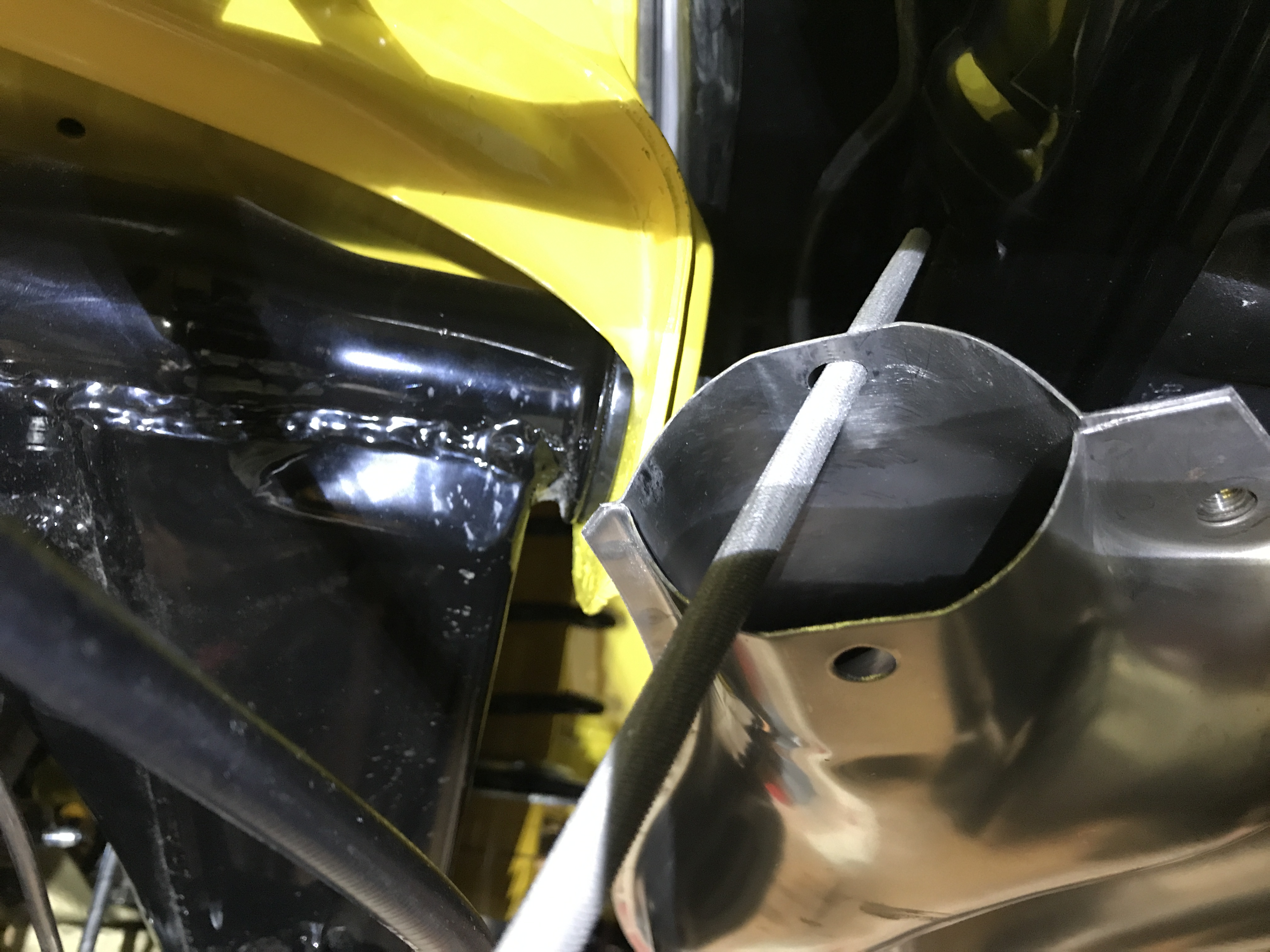

But the outlet on the SS heat exchangers is not!
bkrantz
post Jan 14 2022, 08:56 PM
Post #4675
Posts: 8,345
Joined: 3-August 19
From: SW Colorado
Member No.: 23,343

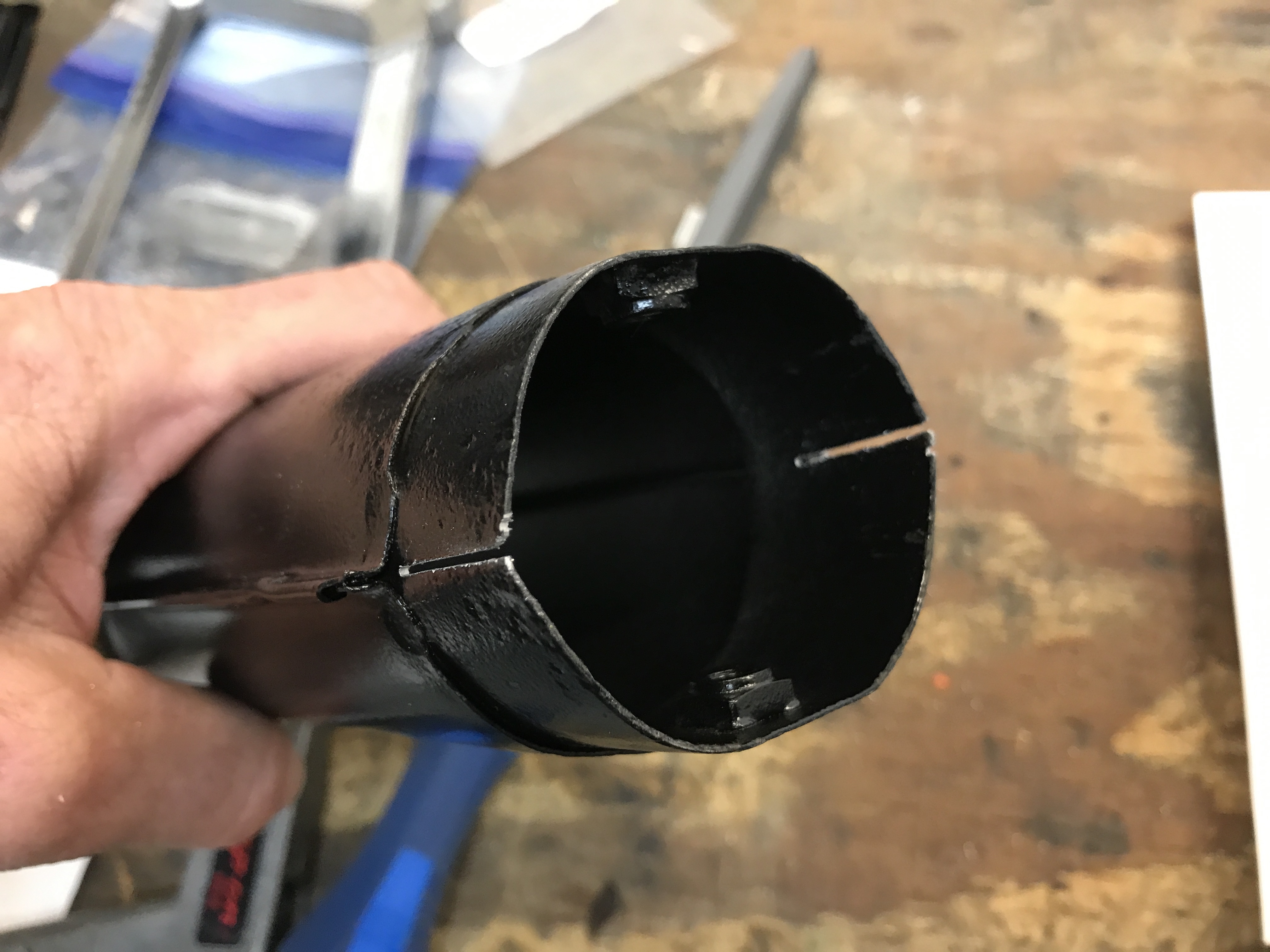

Since the ducts are loose, I tried reforming the shape to match the outlet. The was closer, but still too big.
bkrantz
post Jan 14 2022, 08:57 PM
Post #4676
Posts: 8,345
Joined: 3-August 19
From: SW Colorado
Member No.: 23,343

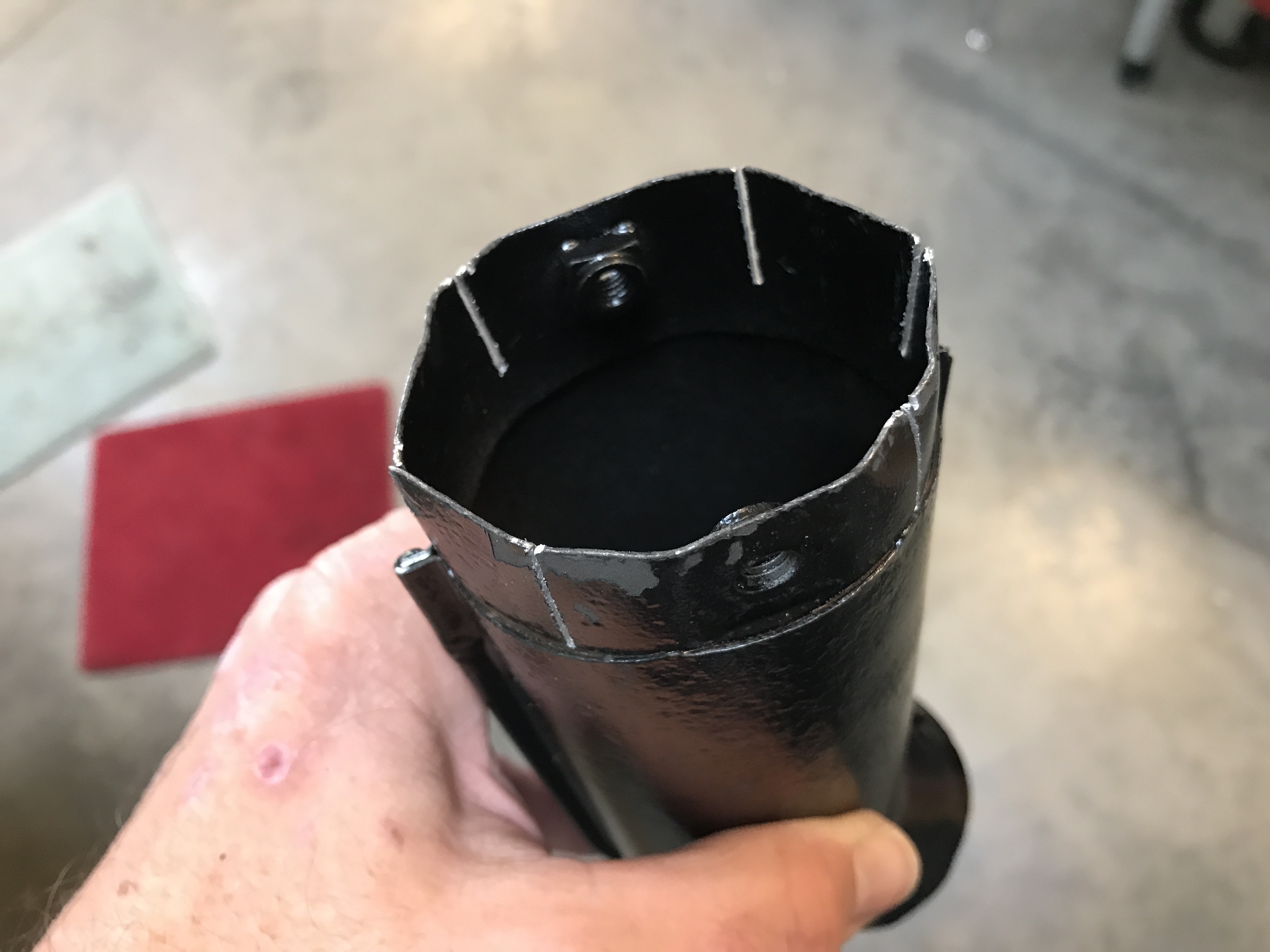

Next, I had a pair of cuts to help shrink the end of the duct. Still not enough.
bkrantz
post Jan 14 2022, 08:58 PM
Post #4677
Posts: 8,345
Joined: 3-August 19
From: SW Colorado
Member No.: 23,343
Two more pairs of cuts finally did the trick, and I was able to insert the duct into the outlet.
bkrantz
post Jan 14 2022, 08:59 PM
Post #4678
Posts: 8,345
Joined: 3-August 19
From: SW Colorado
Member No.: 23,343

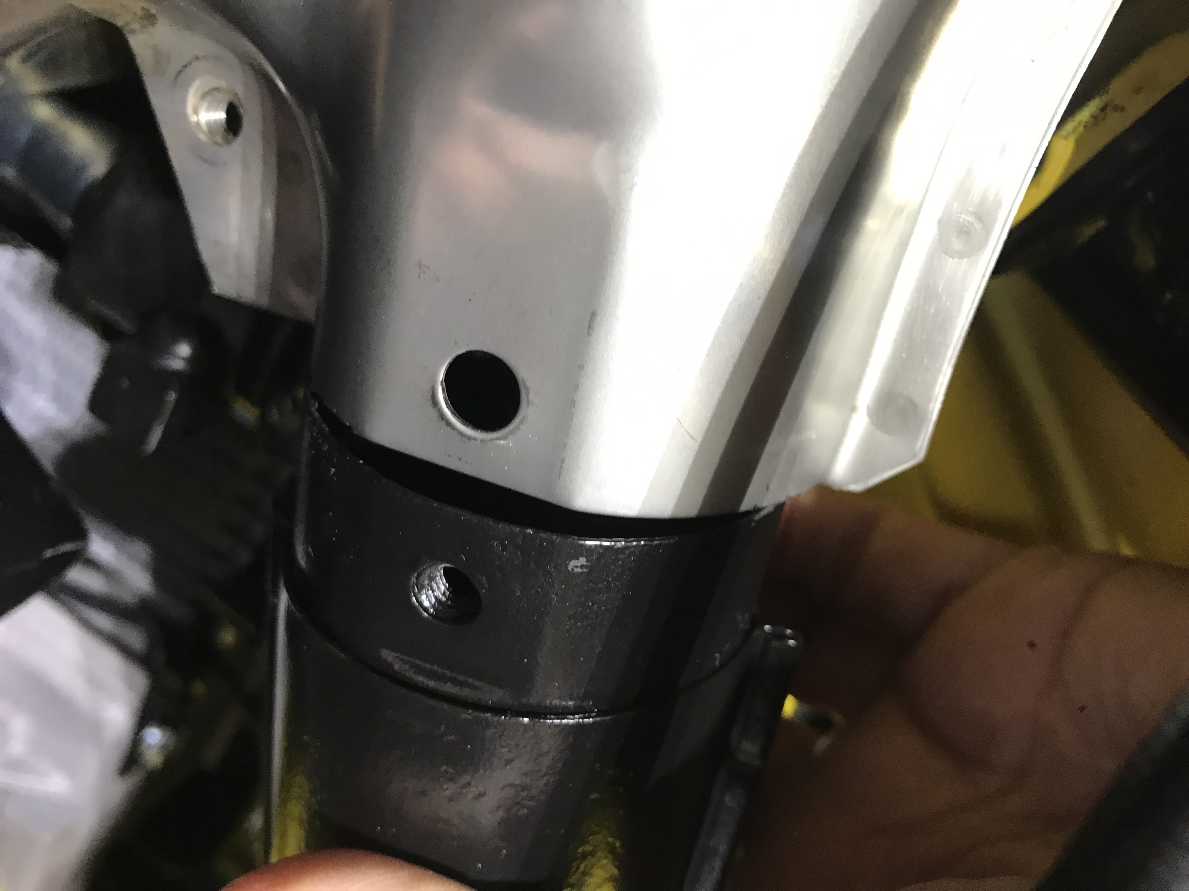

The upper hole on the outlet also needed some adjustment.
bkrantz
post Jan 14 2022, 09:00 PM
Post #4679
Posts: 8,345
Joined: 3-August 19
From: SW Colorado
Member No.: 23,343
Finally! Duct in place, with bolts top and bottom.
