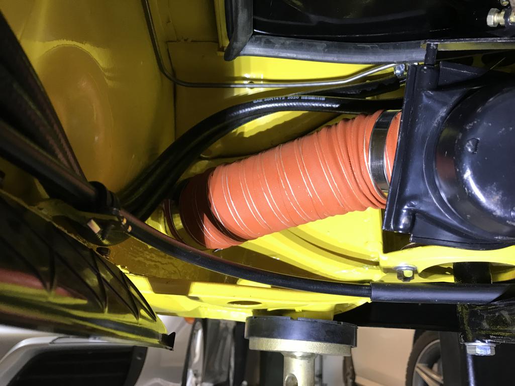

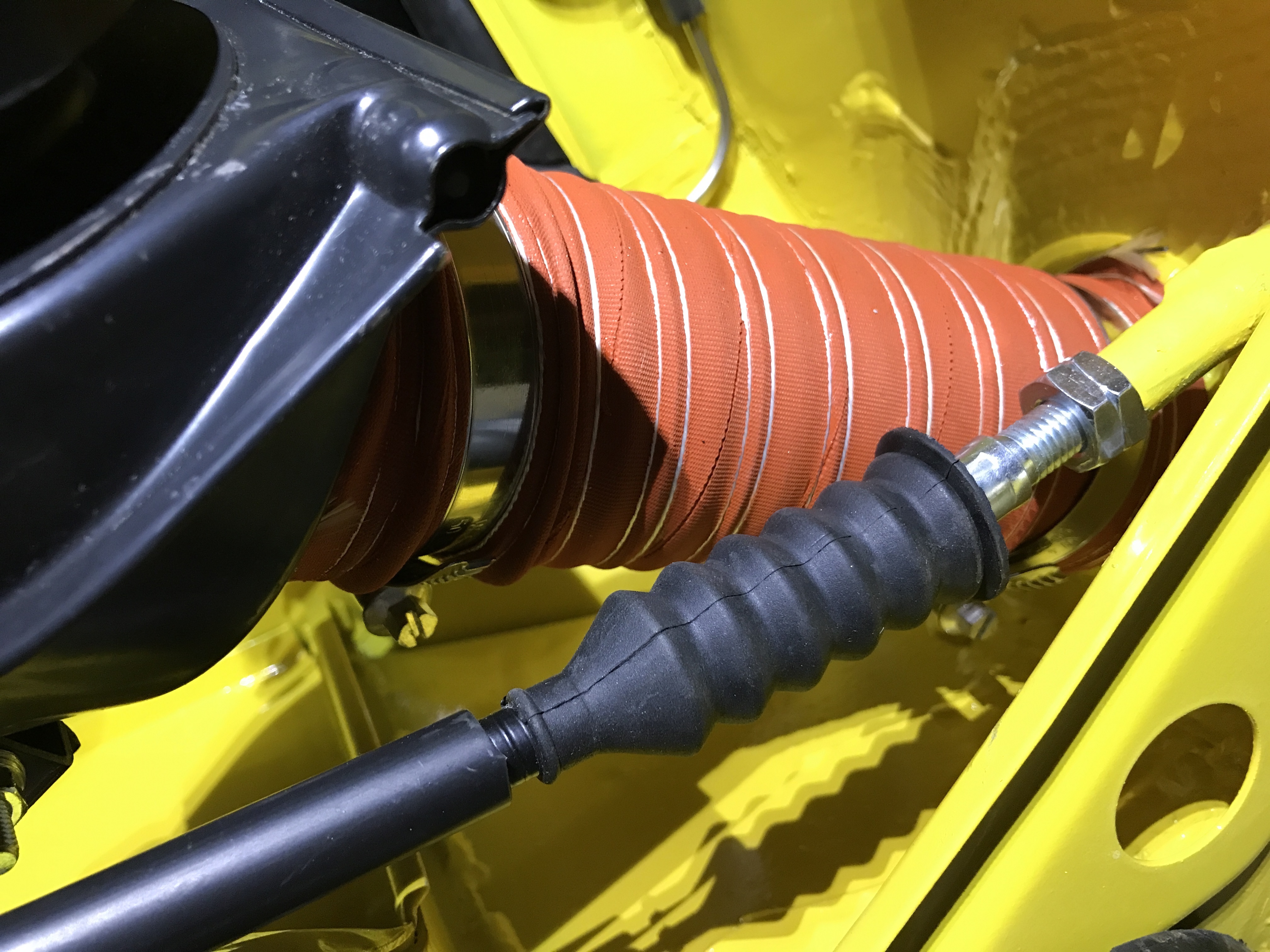

That connects the control box and feed to the long duct on the left.
bkrantz
post Jan 29 2022, 08:53 PM
Post #4722
Posts: 8,345
Joined: 3-August 19
From: SW Colorado
Member No.: 23,343
And another on the right. That completes all the heat system ducting, at least under the car.

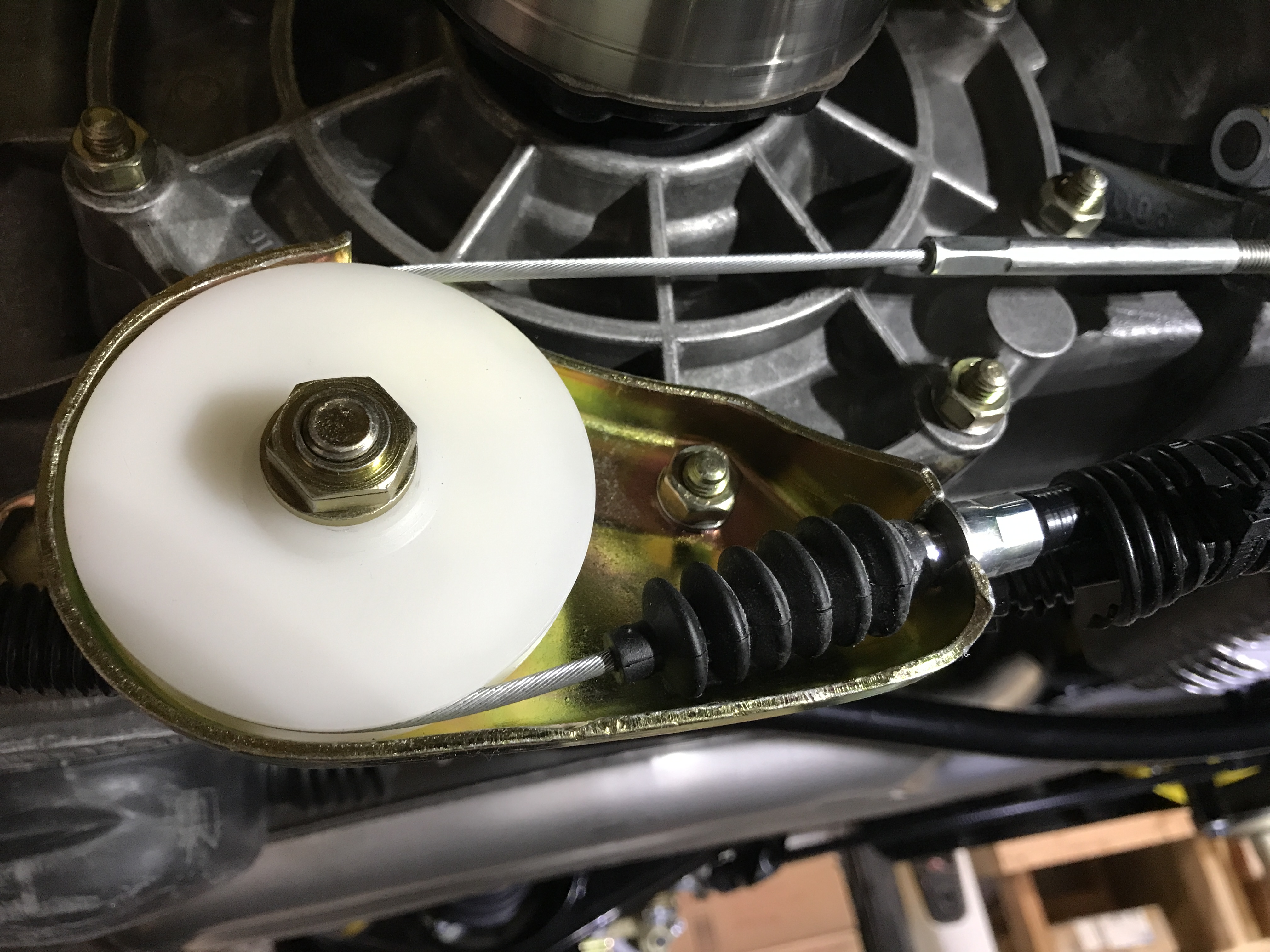

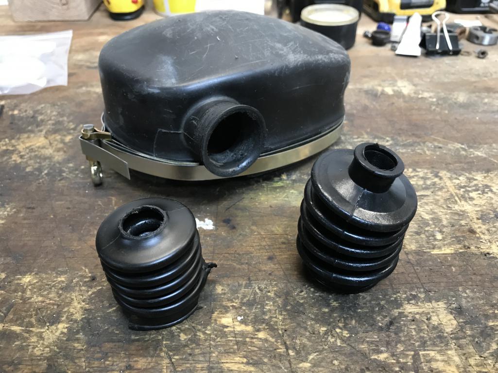

Another detail: sealing boot for the clutch cable.
bkrantz
post Jan 29 2022, 08:59 PM
Post #4725
Posts: 8,345
Joined: 3-August 19
From: SW Colorado
Member No.: 23,343
Boot installed.

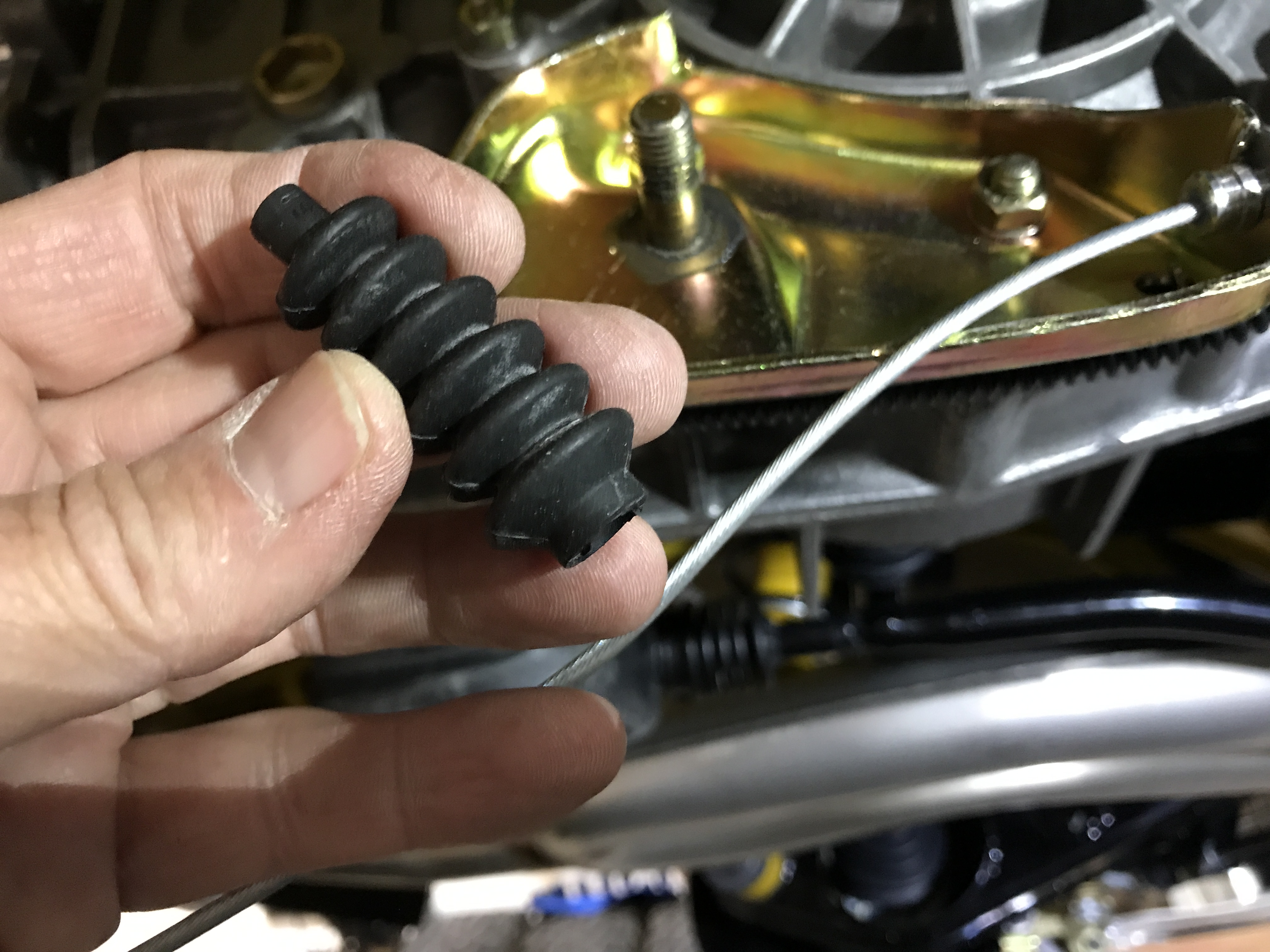

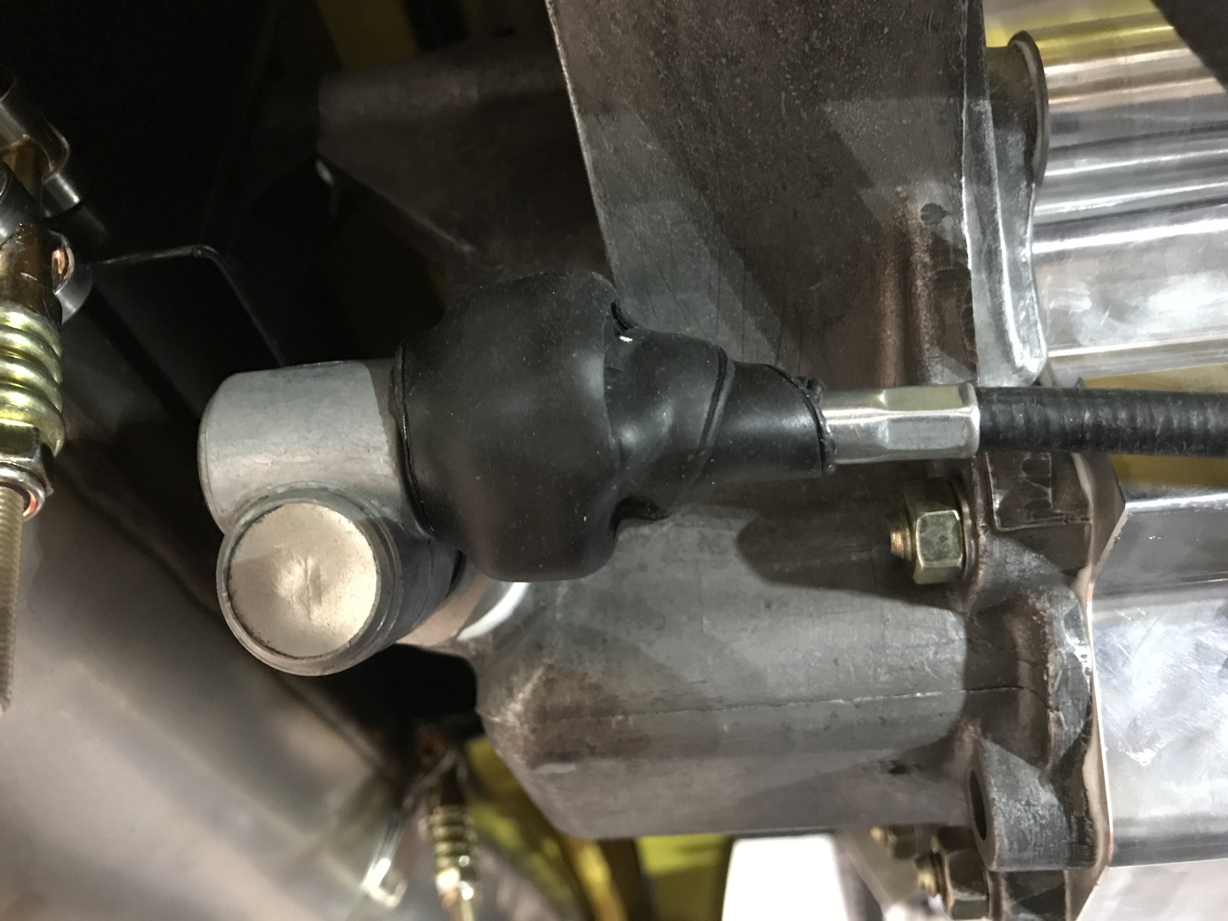

While under the car, I was reminded that the speedo cable did not have a boot, so I got out some 3M rubber sealing tape.
bkrantz
post Jan 29 2022, 09:01 PM
Post #4727
Posts: 8,345
Joined: 3-August 19
From: SW Colorado
Member No.: 23,343
Instant boot.

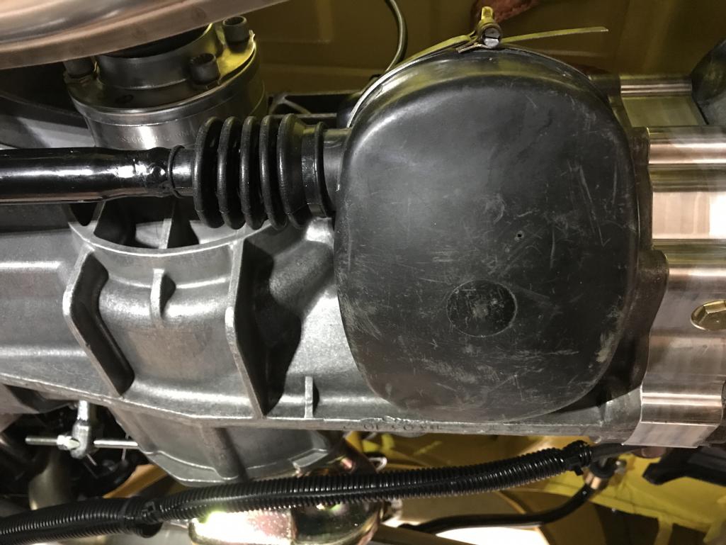

Another new boot: for the shift rod. The old one was essentially rigid.
bkrantz
post Jan 29 2022, 09:07 PM
Post #4729
Posts: 8,345
Joined: 3-August 19
From: SW Colorado
Member No.: 23,343
To get that installed, I had to detach the rear shift rod at both ends. Hope this is worth it!

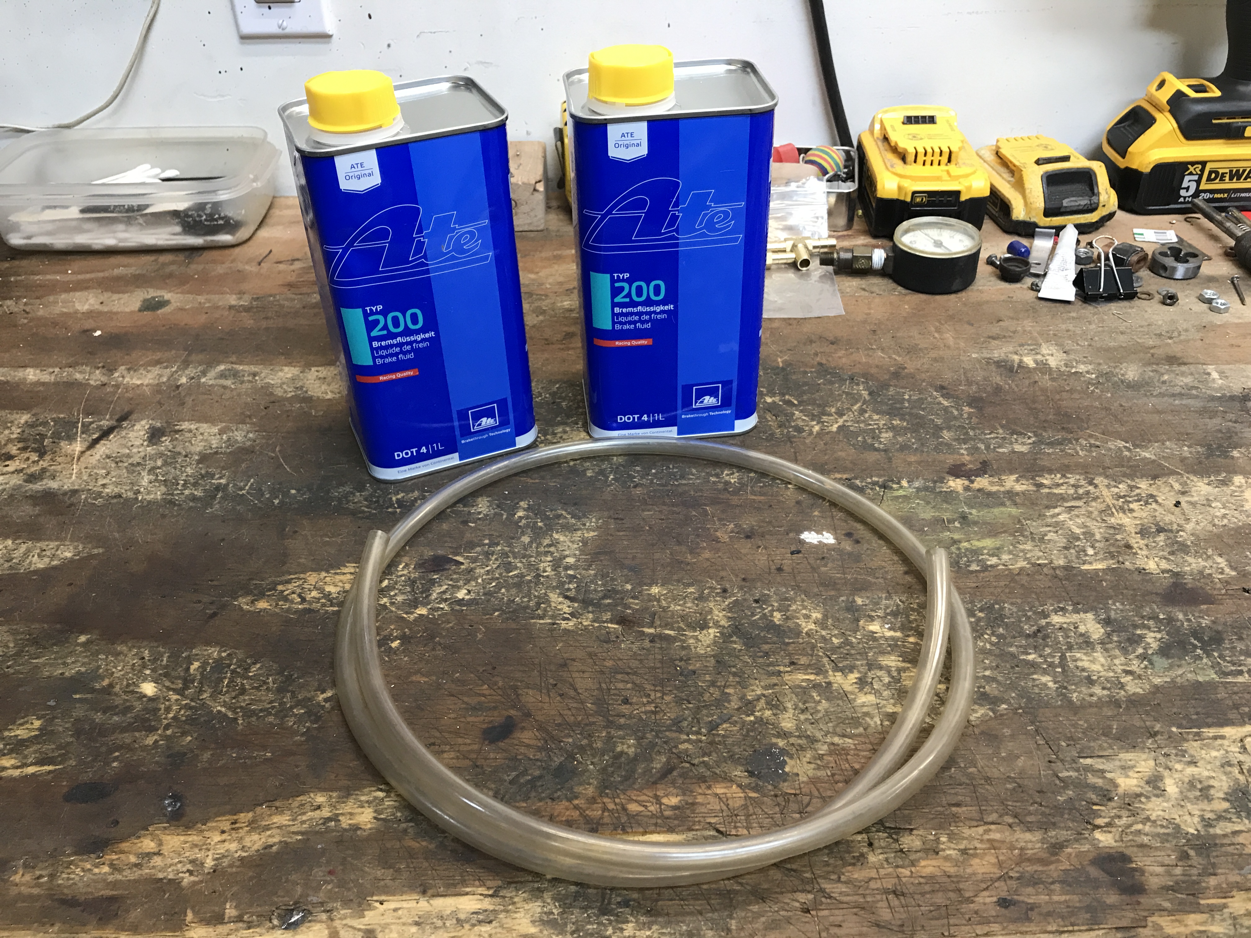

Time to start another task: filling and bleeding the brake system. I bought almost all components, including new stainless steel lines and rebuilt calipers from PMB. The system has been on the car complete for a year, but not filled.
I started with a simple plan, and tried gravity bleeding.

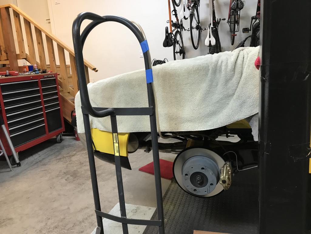

Here's the gravity bleed hose set up on the right rear caliper, with the free end of the hose higher than the reservoir.

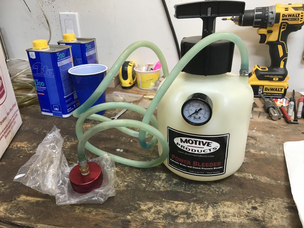

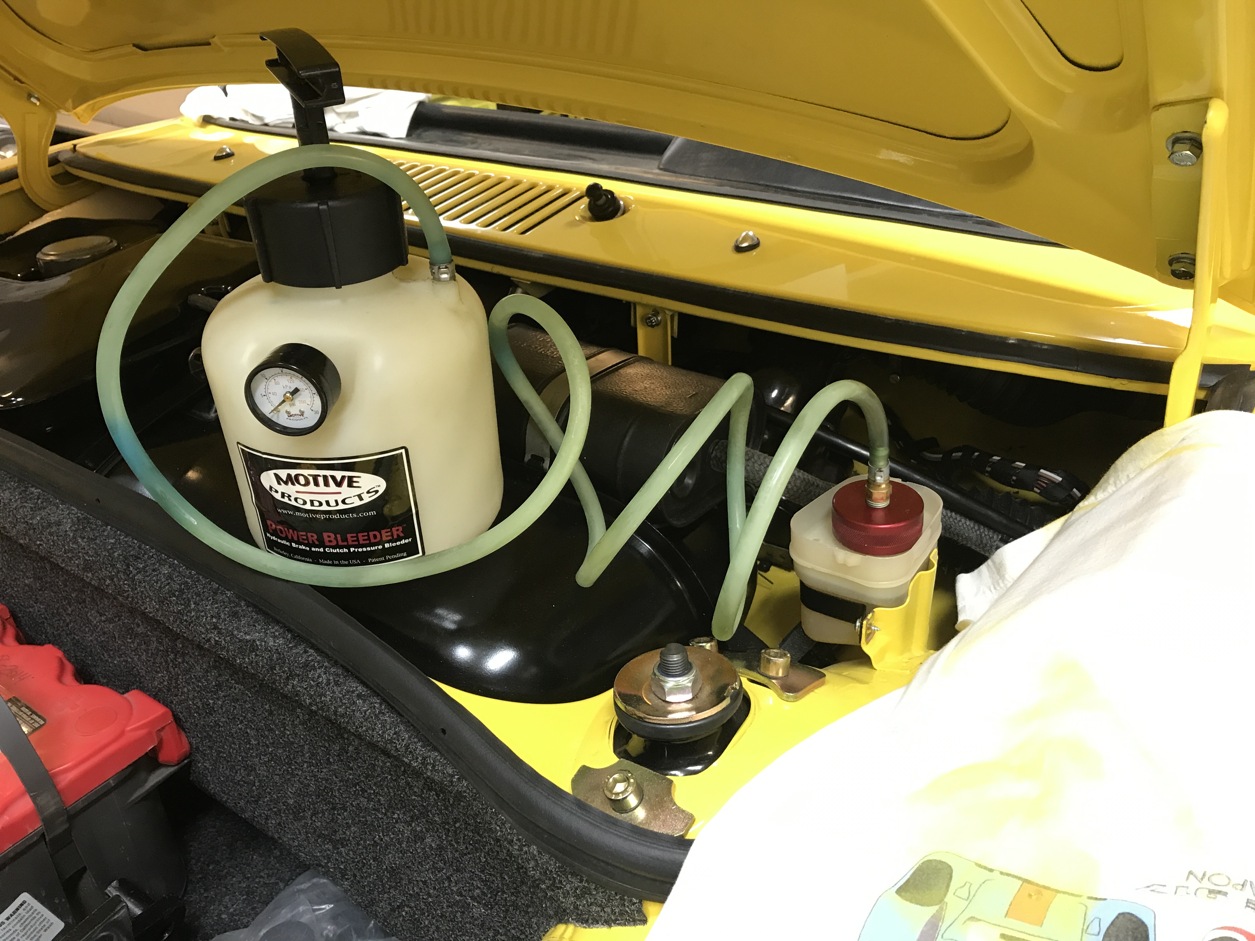

So, I next got out the power bleeder, that has been part of my garage kit for about 30 years, with the Porsche reservoir adapter.
bkrantz
post Jan 30 2022, 08:47 PM
Post #4734
Posts: 8,345
Joined: 3-August 19
From: SW Colorado
Member No.: 23,343

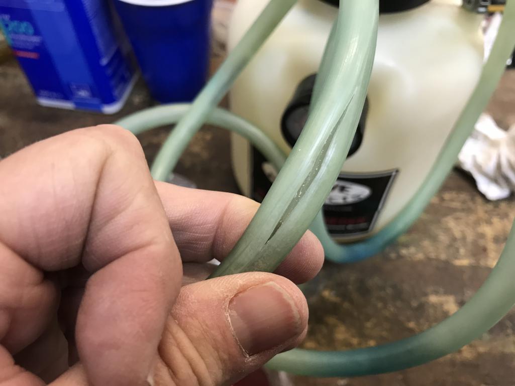

But the hose is showing its age. For today, I cut off the end with the split and re-attached the cap.
bkrantz
post Jan 30 2022, 08:48 PM
Post #4735
Posts: 8,345
Joined: 3-August 19
From: SW Colorado
Member No.: 23,343
Then I could pump (just air) and pressurize the reservoir to about 25 psi.

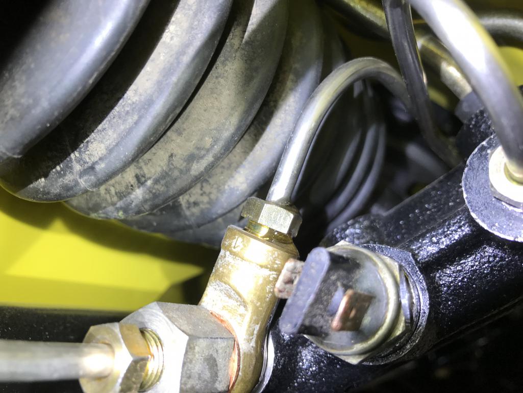

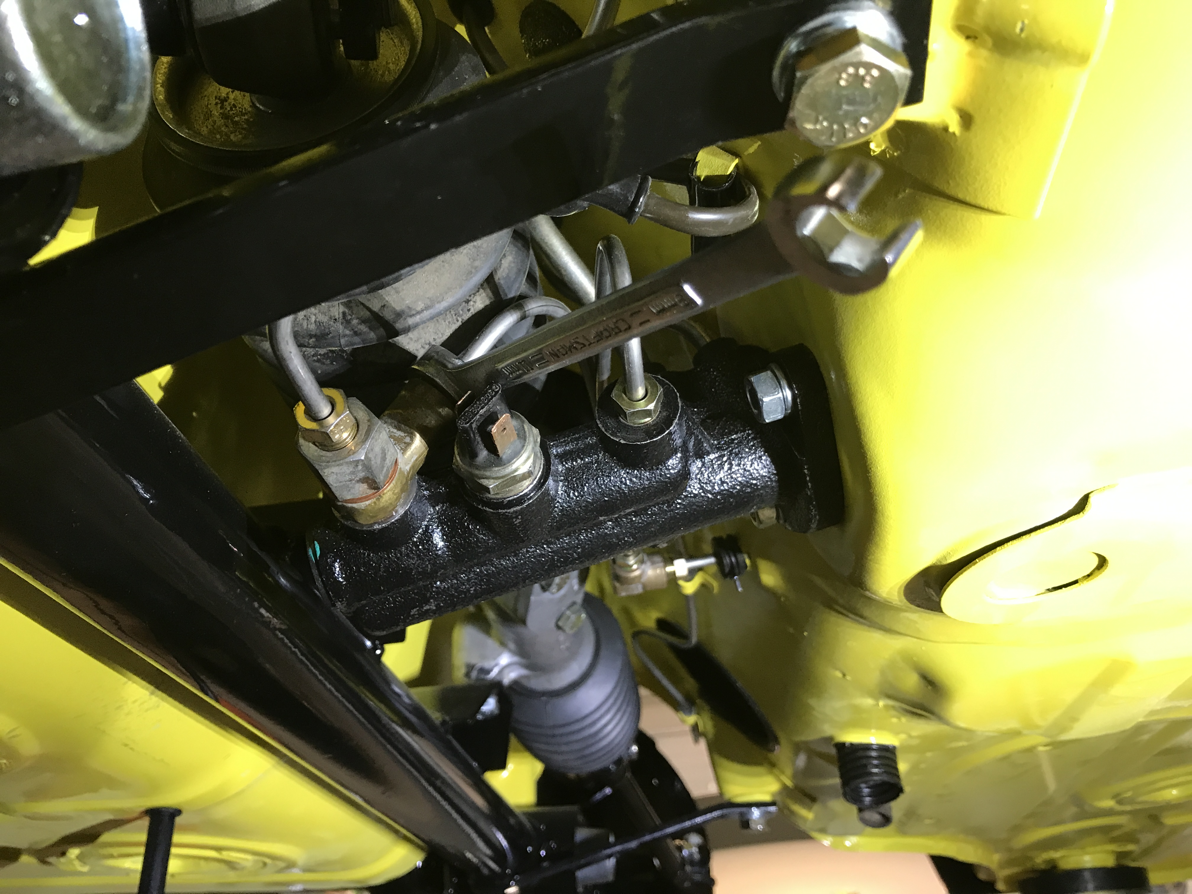

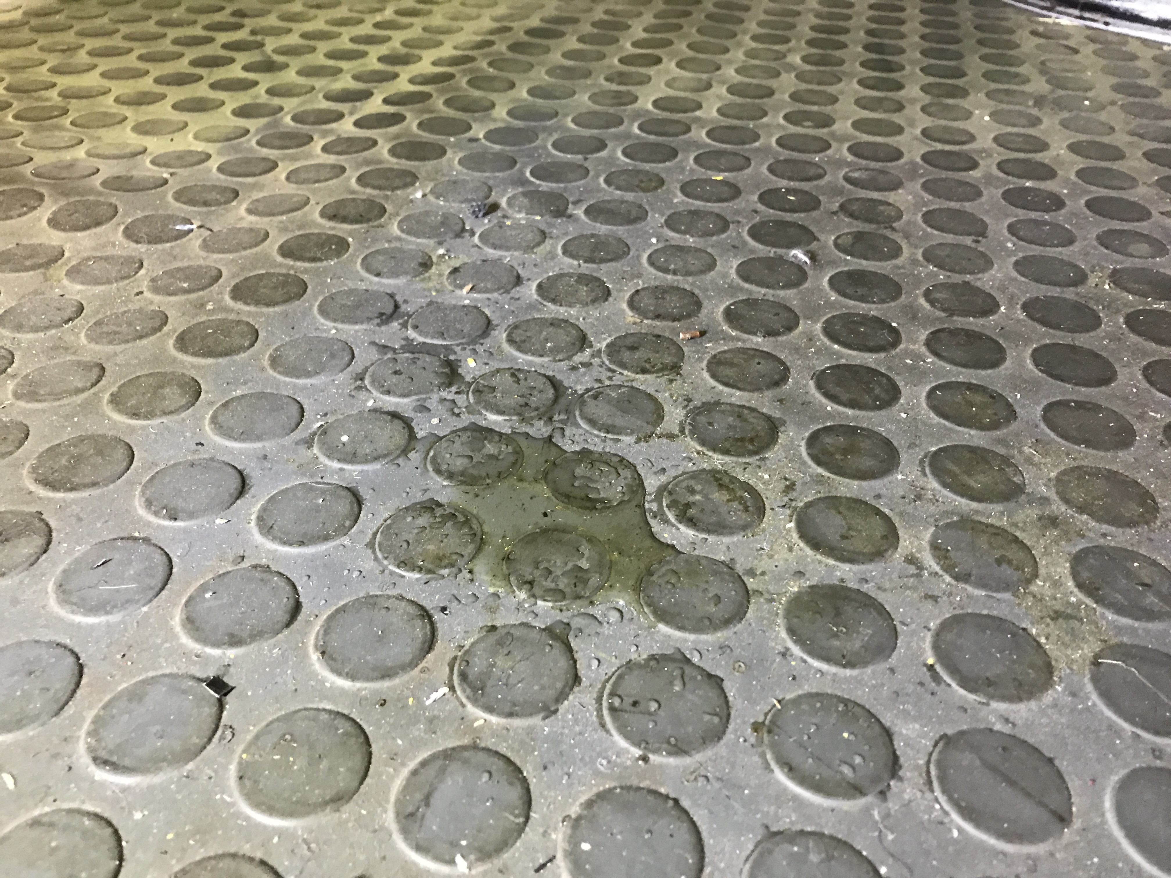

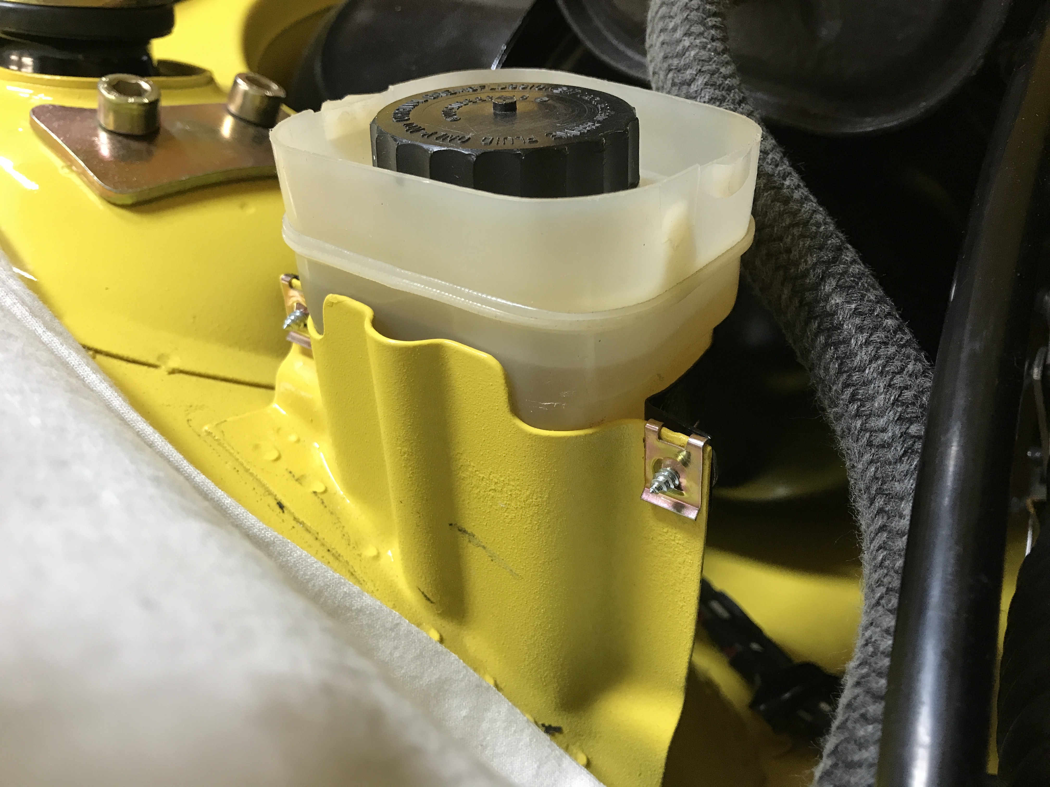

Next problem: a puddle on the floor under the master cylinder.
bkrantz
post Jan 30 2022, 08:53 PM
Post #4737
Posts: 8,345
Joined: 3-August 19
From: SW Colorado
Member No.: 23,343
At first I expected to see the supply lines from the reservoir leaking, but they were dry. The (main) leak was from the fitting where the front right line attaches to the banjo fitting. This was actually just finger tight--my bad.
bkrantz
post Jan 30 2022, 08:59 PM
Post #4738
Posts: 8,345
Joined: 3-August 19
From: SW Colorado
Member No.: 23,343
So I tightened that loose fitting, pumped up some pressure, and found more leaks.
Now I was worried. I started tracing all the lines and connections, starting at the MC. None were "loose", but I was able to tighten all of them a bit more. When I installed all the lines I tightened them the way I would for "normal" steel brake lines. I think the SS lines need more pressure to seat fully.
bkrantz
post Jan 30 2022, 09:00 PM
Post #4739
Posts: 8,345
Joined: 3-August 19
From: SW Colorado
Member No.: 23,343

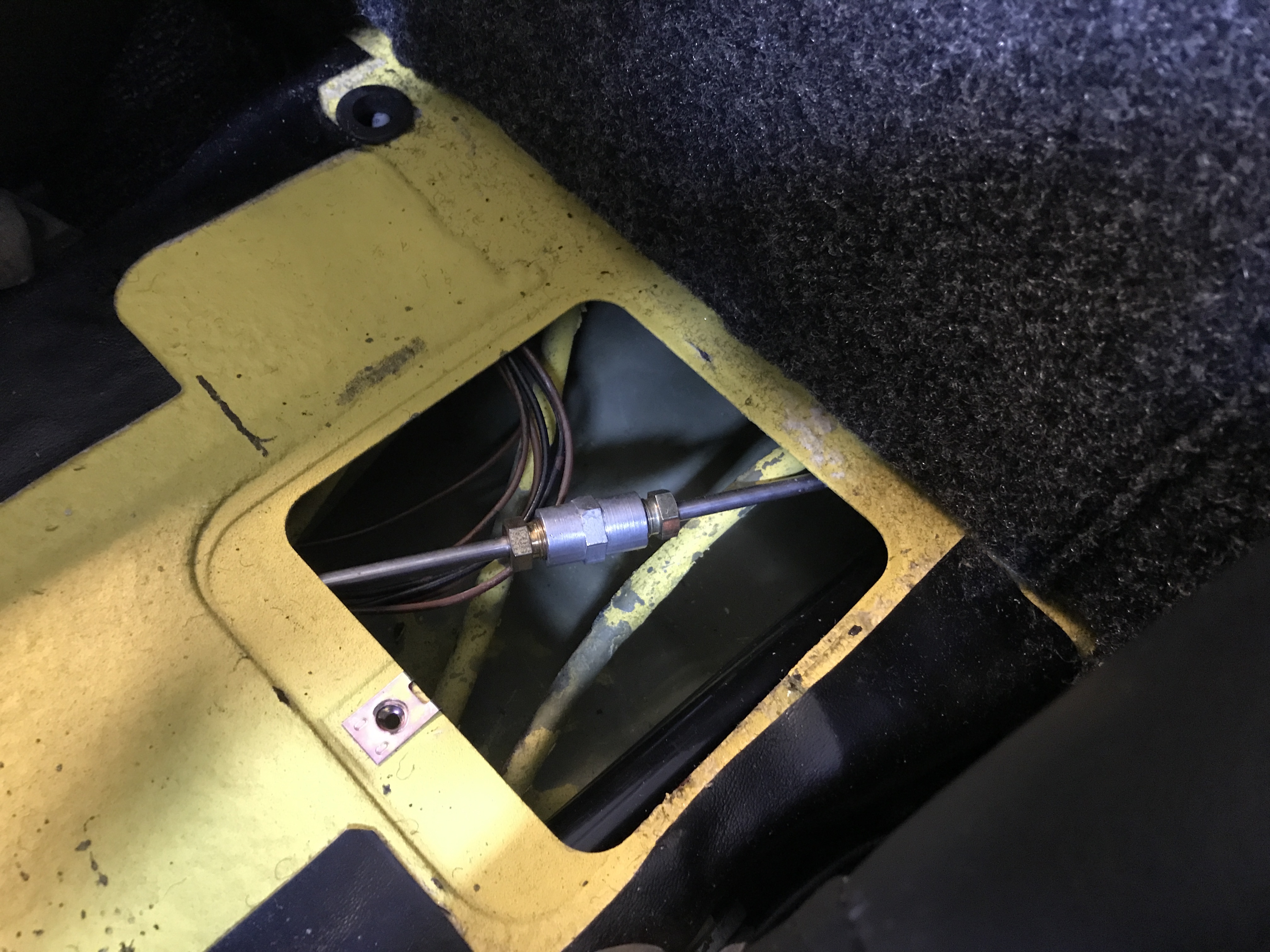

That included the junction fitting inside the tunnel.
bkrantz
post Jan 30 2022, 09:03 PM
Post #4740
Posts: 8,345
Joined: 3-August 19
From: SW Colorado
Member No.: 23,343

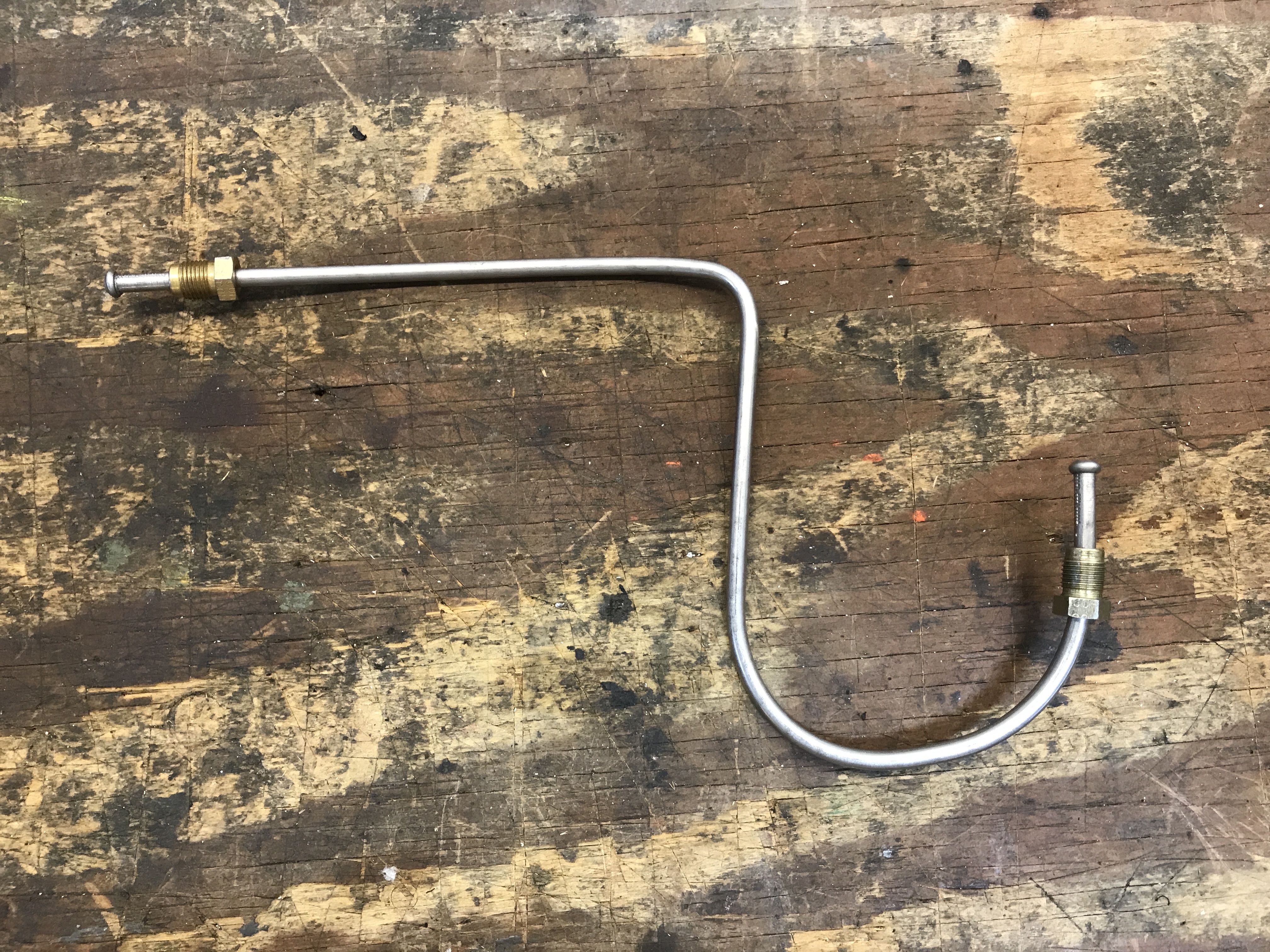

I was able to stop all obvious leaks except for where the line feeds into the right rear caliper. Even after what felt like too much torque it still weeped. So I removed the line.
