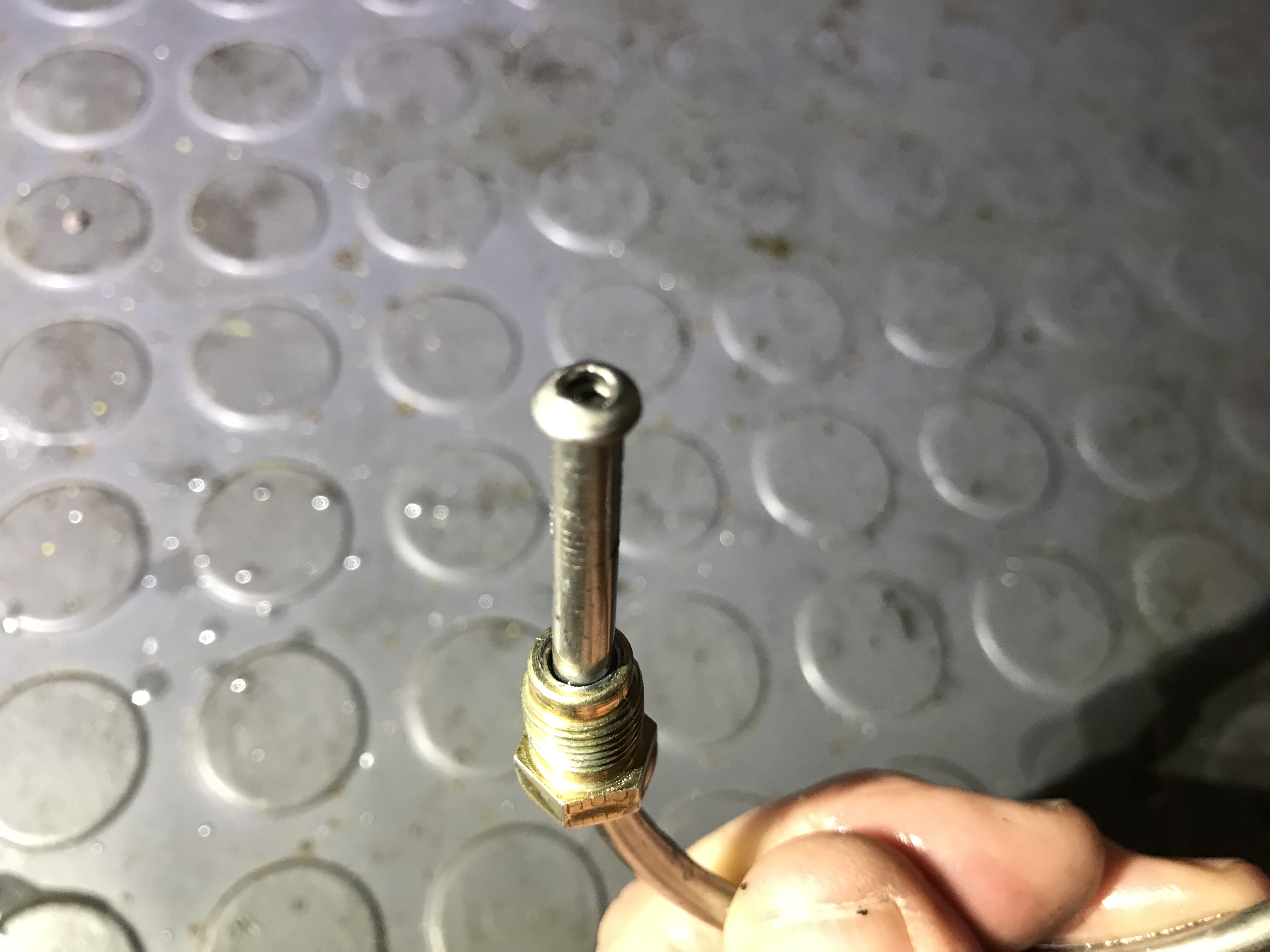

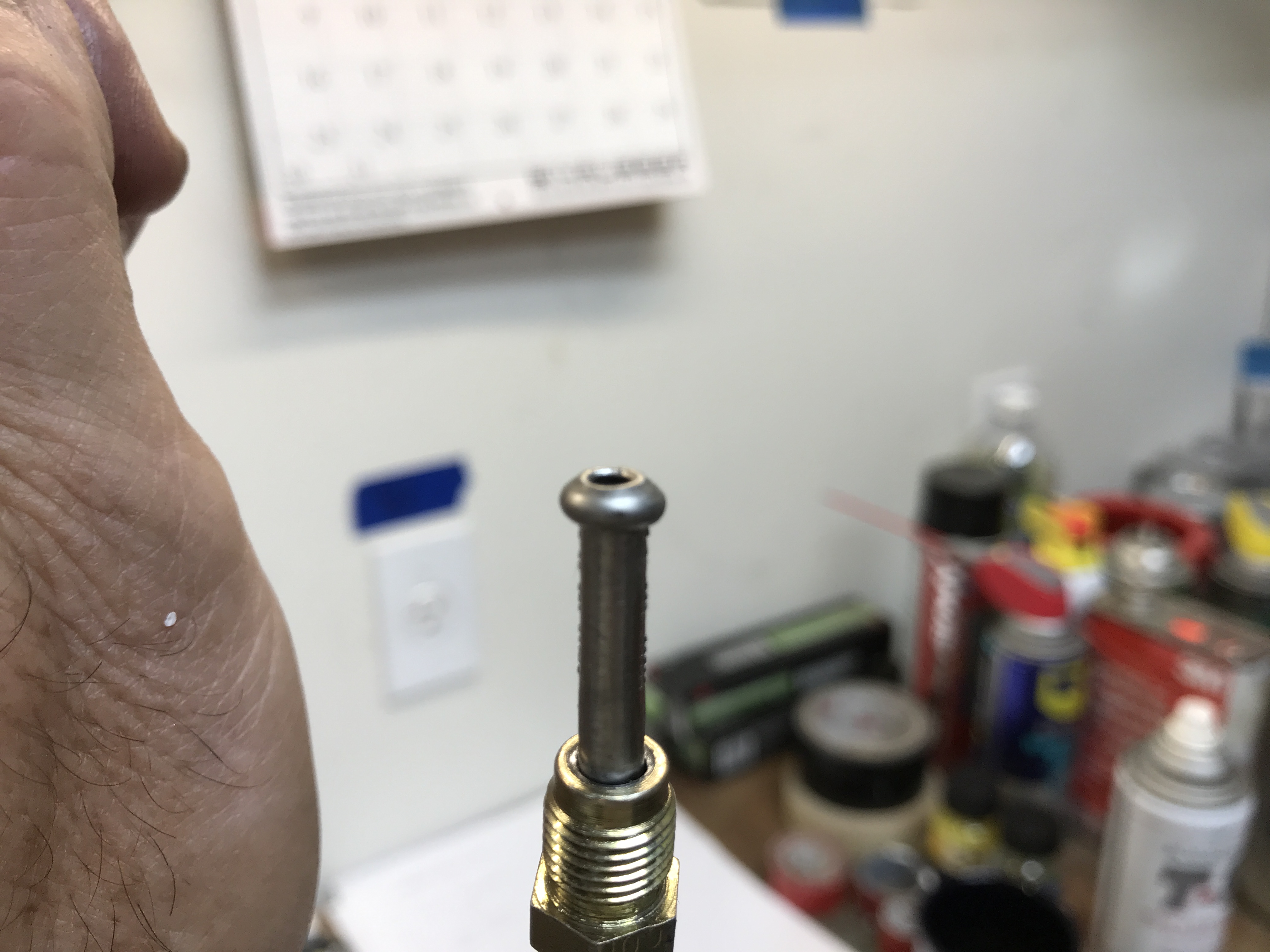

A possible problem: the flare on the caliper end is a bit off-center and uneven (it looks worse than the photo shows). Time to step back.

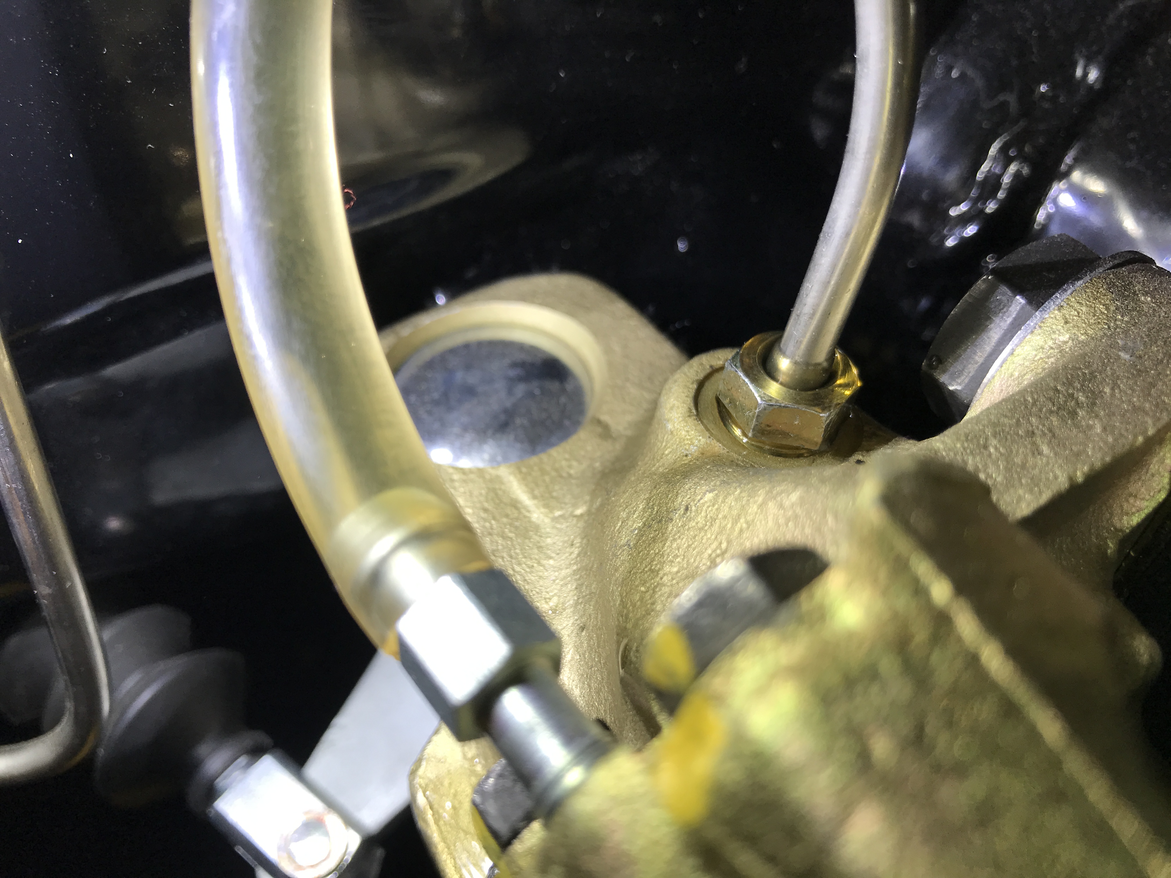

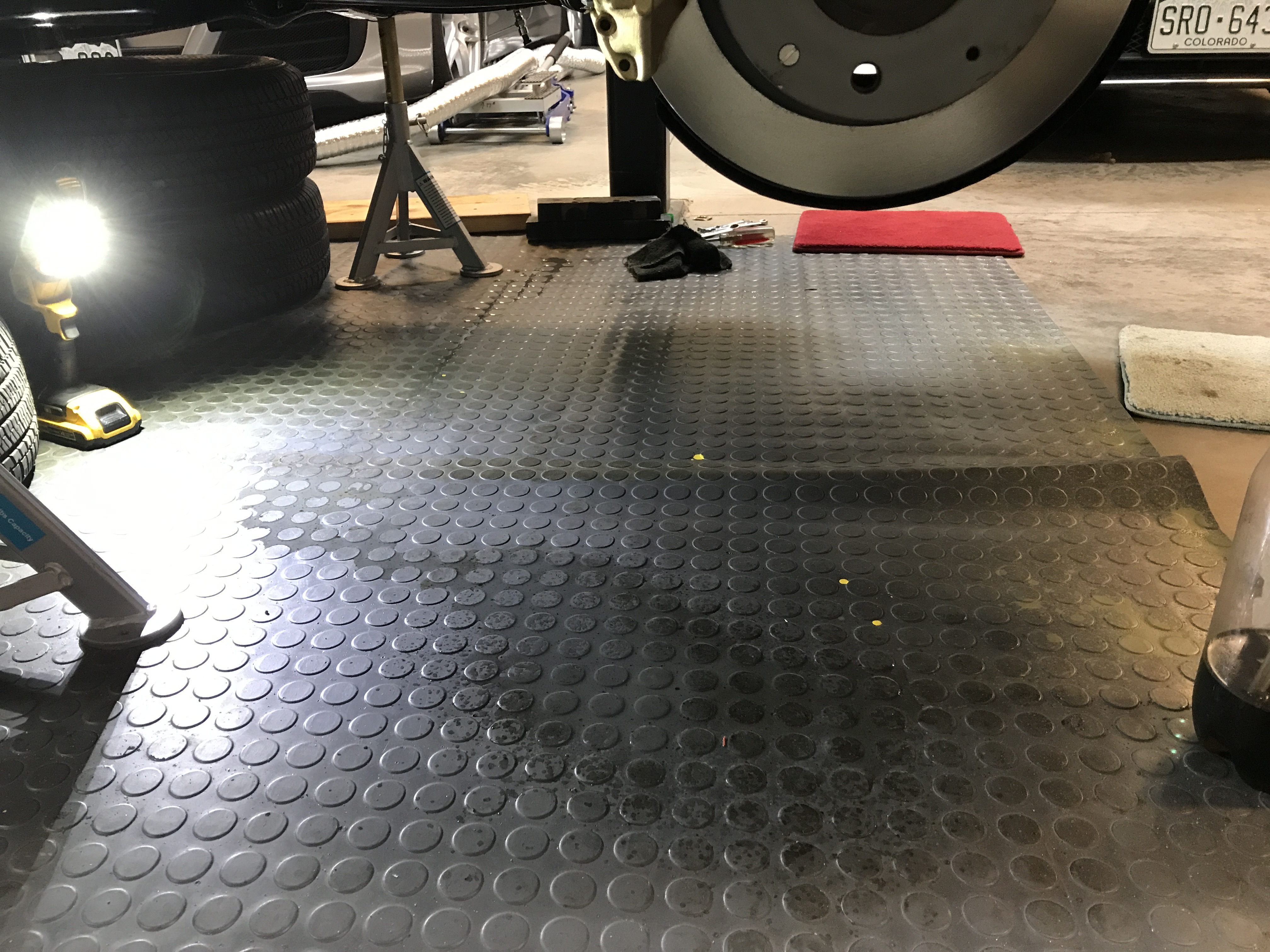

Well, sitting overnight revealed a similar leak from the left rear caliper.
bkrantz
post Jan 31 2022, 08:58 PM
Post #4743
Posts: 8,345
Joined: 3-August 19
From: SW Colorado
Member No.: 23,343
Just like the right side, the line going in to the caliper is leaking, despite a fair amount of tightening on the fitting.

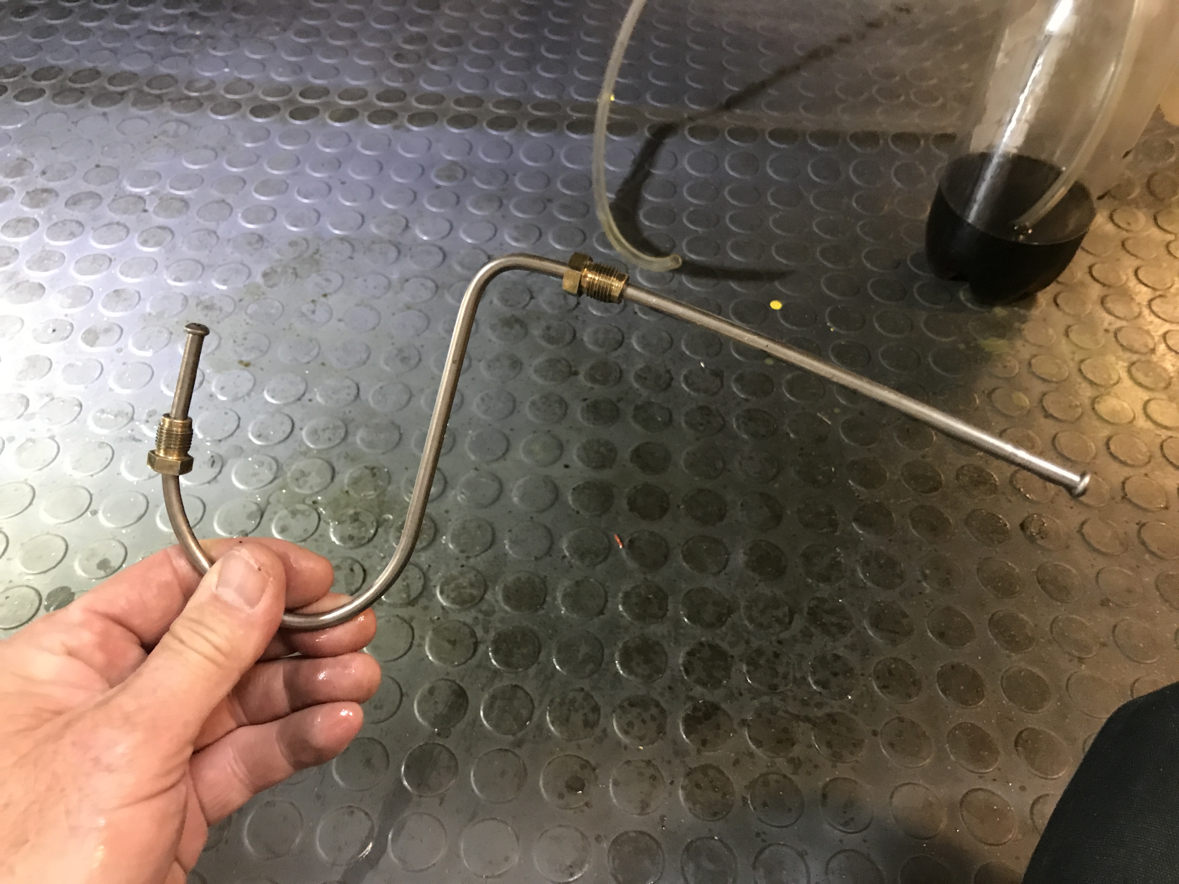

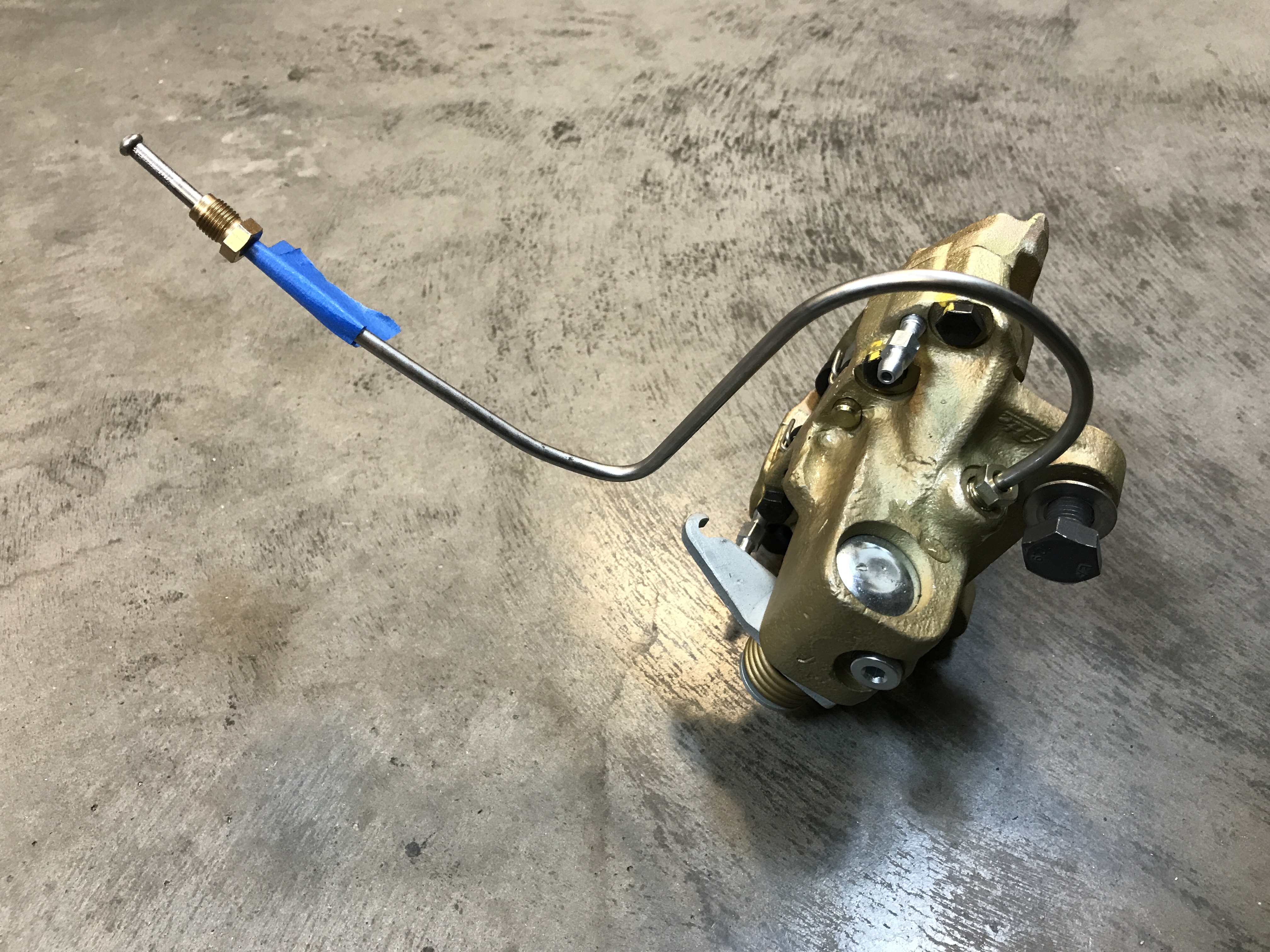

I pulled the hard line off.
bkrantz
post Jan 31 2022, 08:59 PM
Post #4745
Posts: 8,345
Joined: 3-August 19
From: SW Colorado
Member No.: 23,343
And just like on the right side, the flare seems off-center. (Sorry for the fuzzy photo)

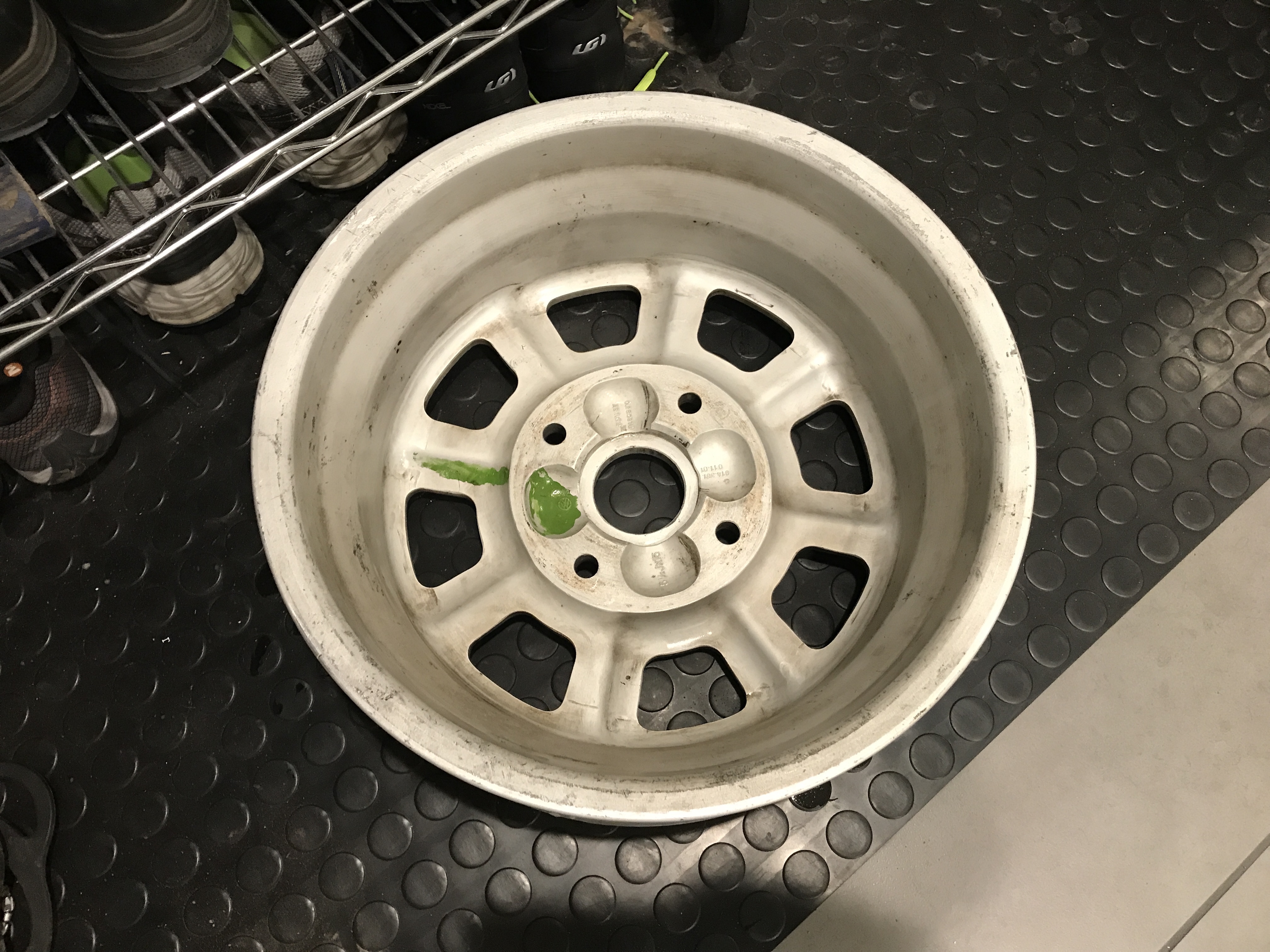

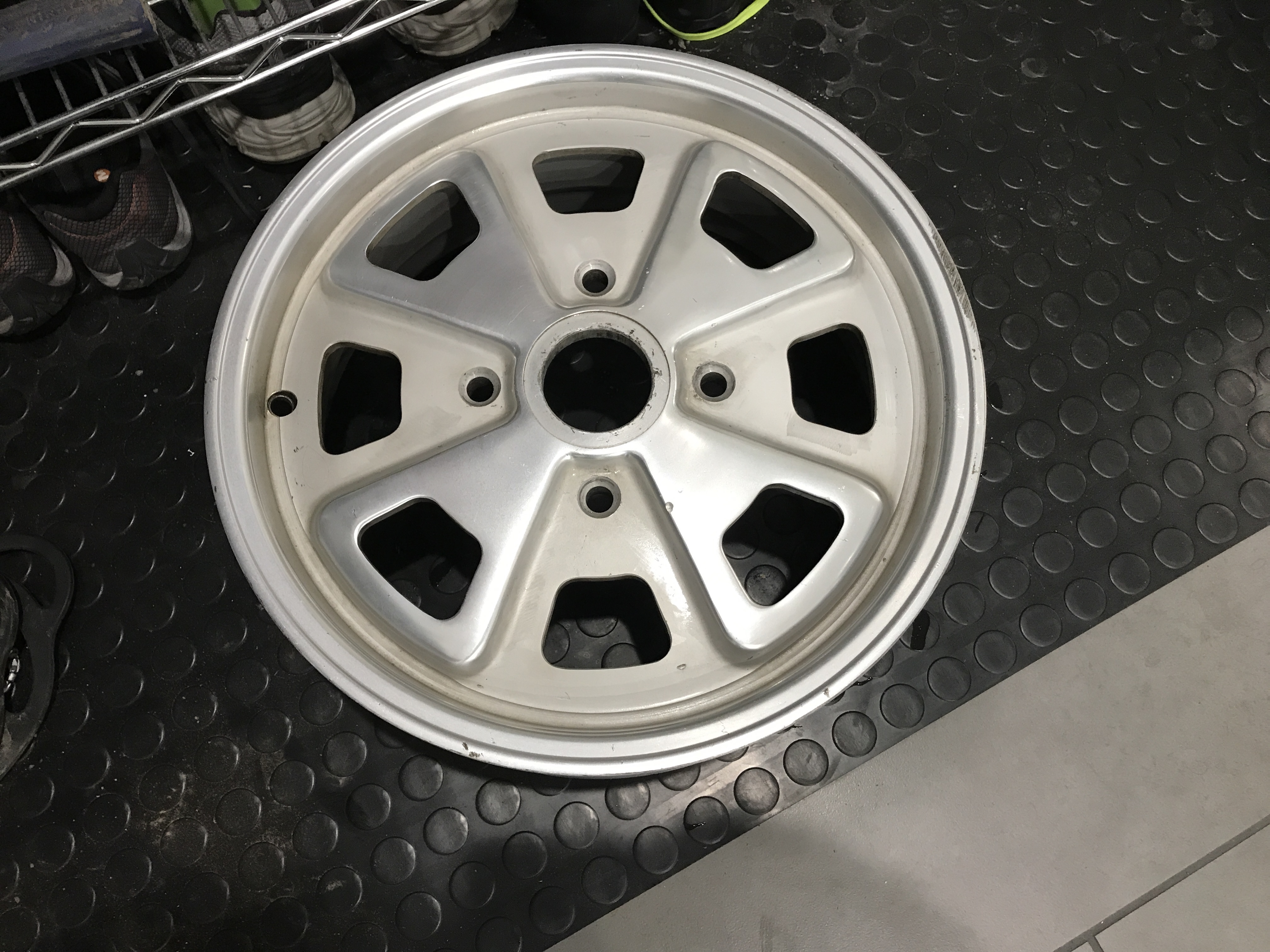

Meanwhile, I was experimenting with cleaning the original Fuchs wheels. I got most of the ancient wheel weight adhesive off from the inside. And then I got out my new citrus cleaner from Chemical Guys.
bkrantz
post Jan 31 2022, 09:04 PM
Post #4747
Posts: 8,345
Joined: 3-August 19
From: SW Colorado
Member No.: 23,343
About 30 minutes with the cleaner and a scotch-bite pad, and the inside is looking good--good enough at least for this wheel, which will be my spare.
bkrantz
post Jan 31 2022, 09:05 PM
Post #4748
Posts: 8,345
Joined: 3-August 19
From: SW Colorado
Member No.: 23,343
The outside also cleaned up a bit, but still has the nasty bit of curb rash.

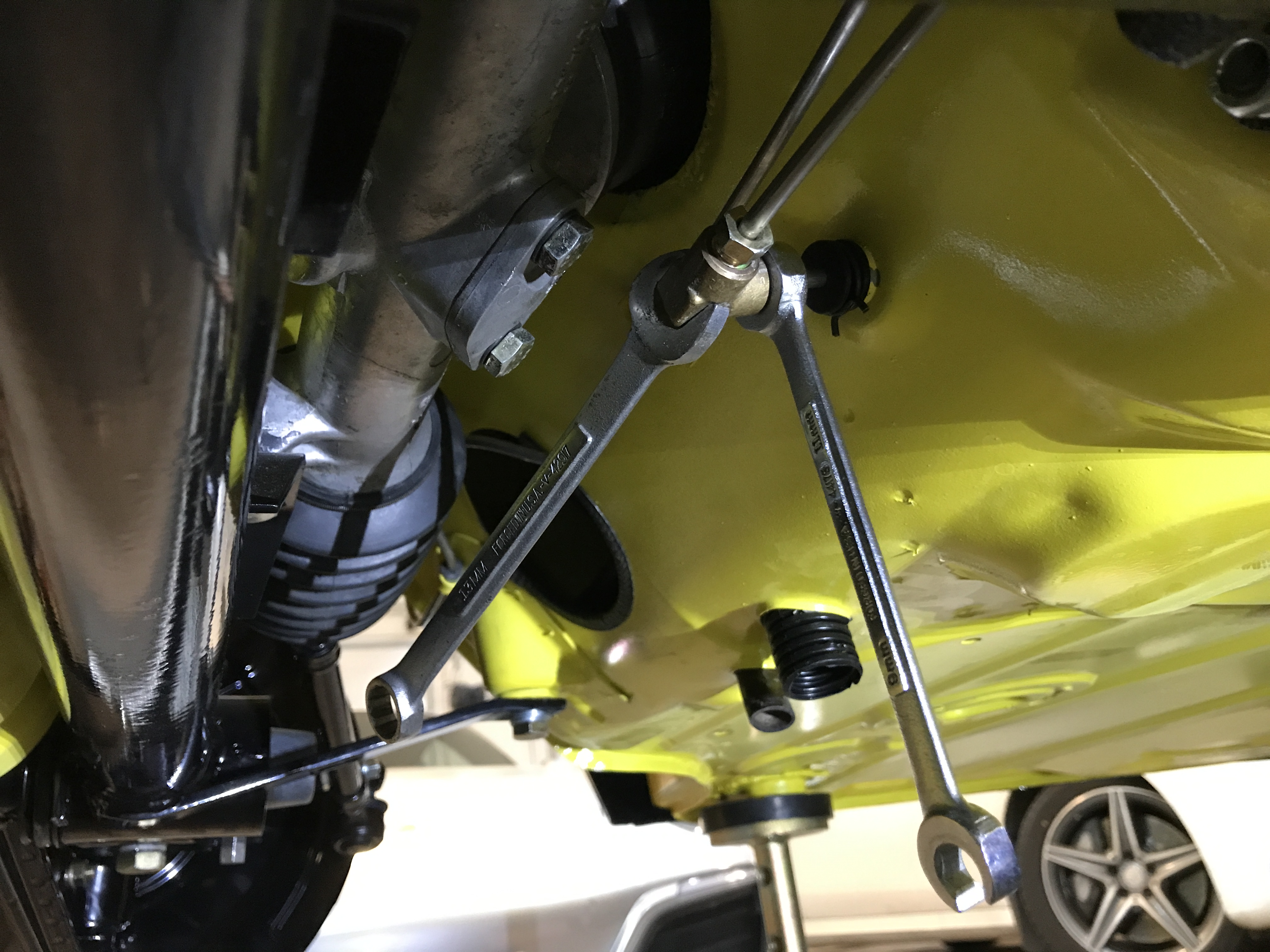

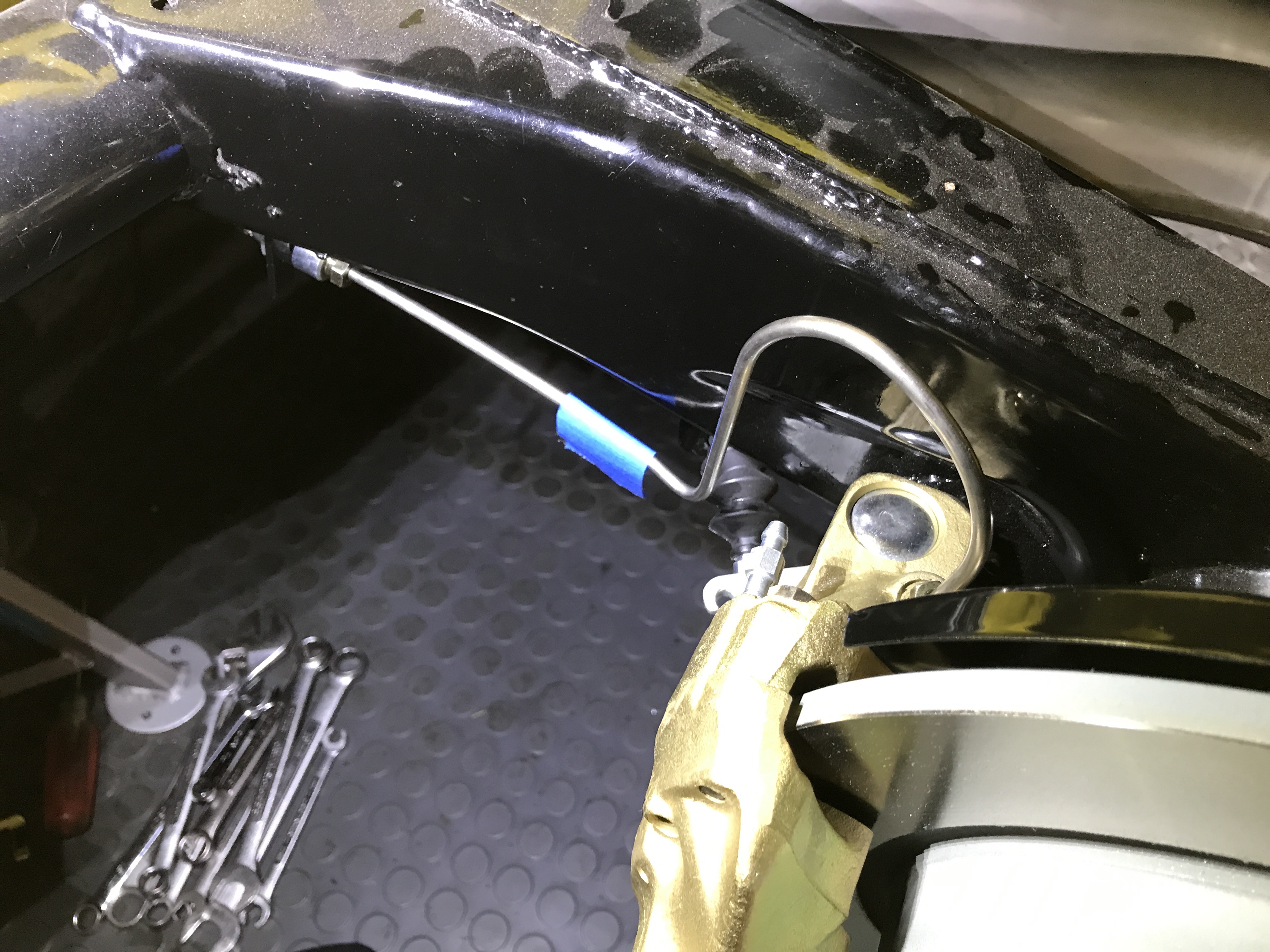

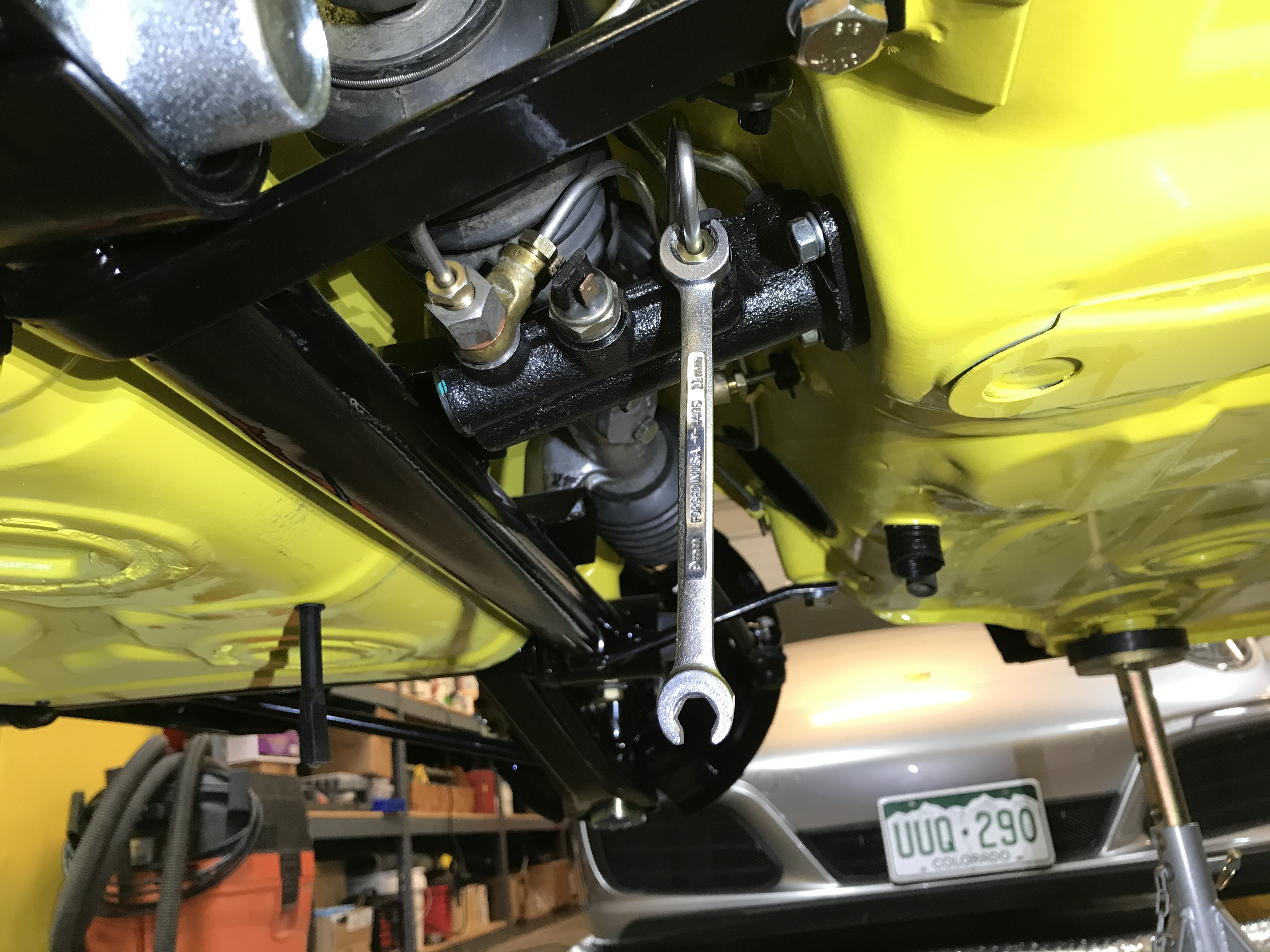

Back on the brake lines. According to some reliable sources, stainless steel lines are a bit harder, and might take more effort to get the flares to seat properly. They recommend a process of tightening and loosening a fitting, and repeating 5 or 6 times, before a final tightening.
So, starting at the master cylinder, I applied this technique at every junction.
bkrantz
post Feb 2 2022, 08:33 PM
Post #4750
Posts: 8,345
Joined: 3-August 19
From: SW Colorado
Member No.: 23,343
Junction with the tunnel line.
bkrantz
post Feb 2 2022, 08:34 PM
Post #4751
Posts: 8,345
Joined: 3-August 19
From: SW Colorado
Member No.: 23,343
Front flex lines and calipers.

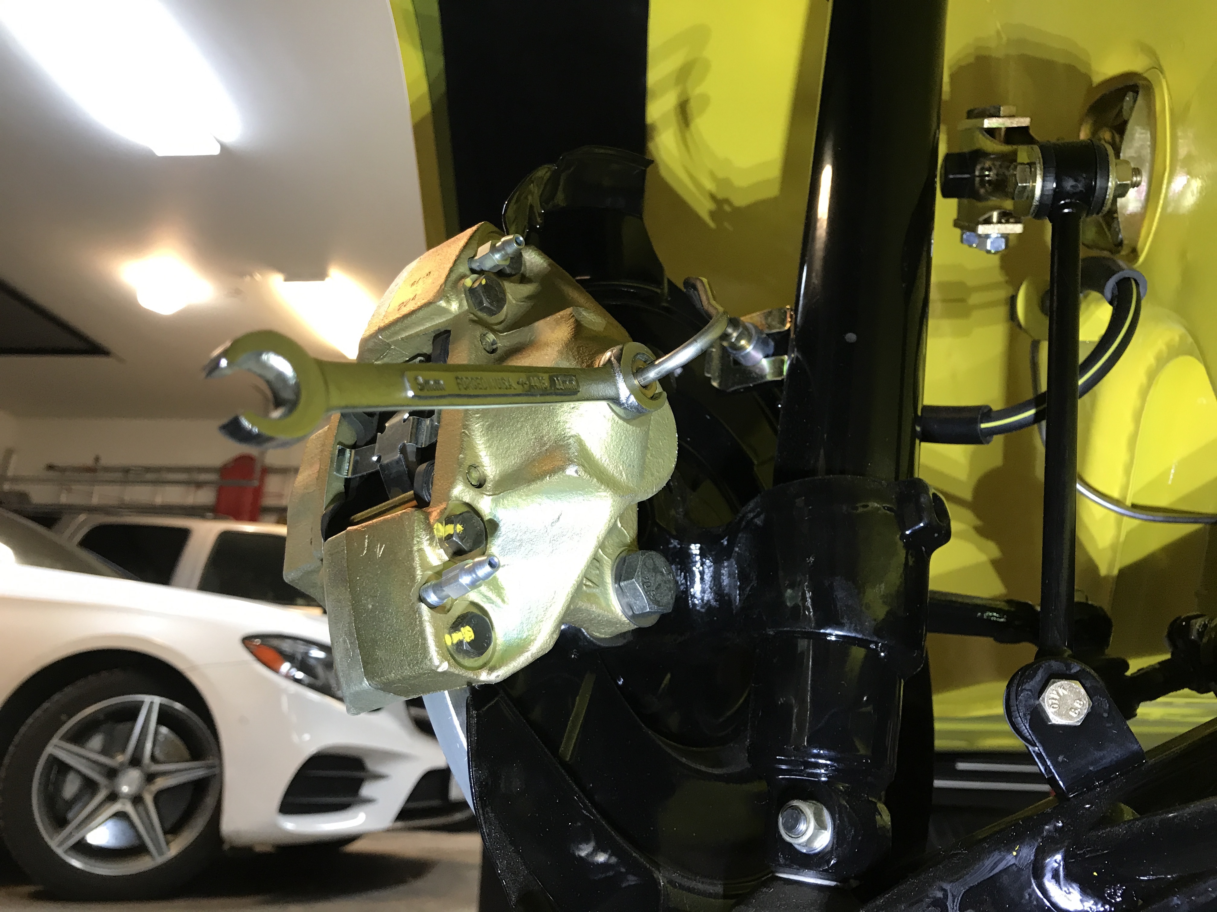

For good access to the fittings on top, I removed the rear calipers. These were the most leaky junctions.
bkrantz
post Feb 2 2022, 08:42 PM
Post #4753
Posts: 8,345
Joined: 3-August 19
From: SW Colorado
Member No.: 23,343
And then re-installed the calipers and connected the flex lines. I still need to get to the fittings on the pressure regulator. But dinner time.

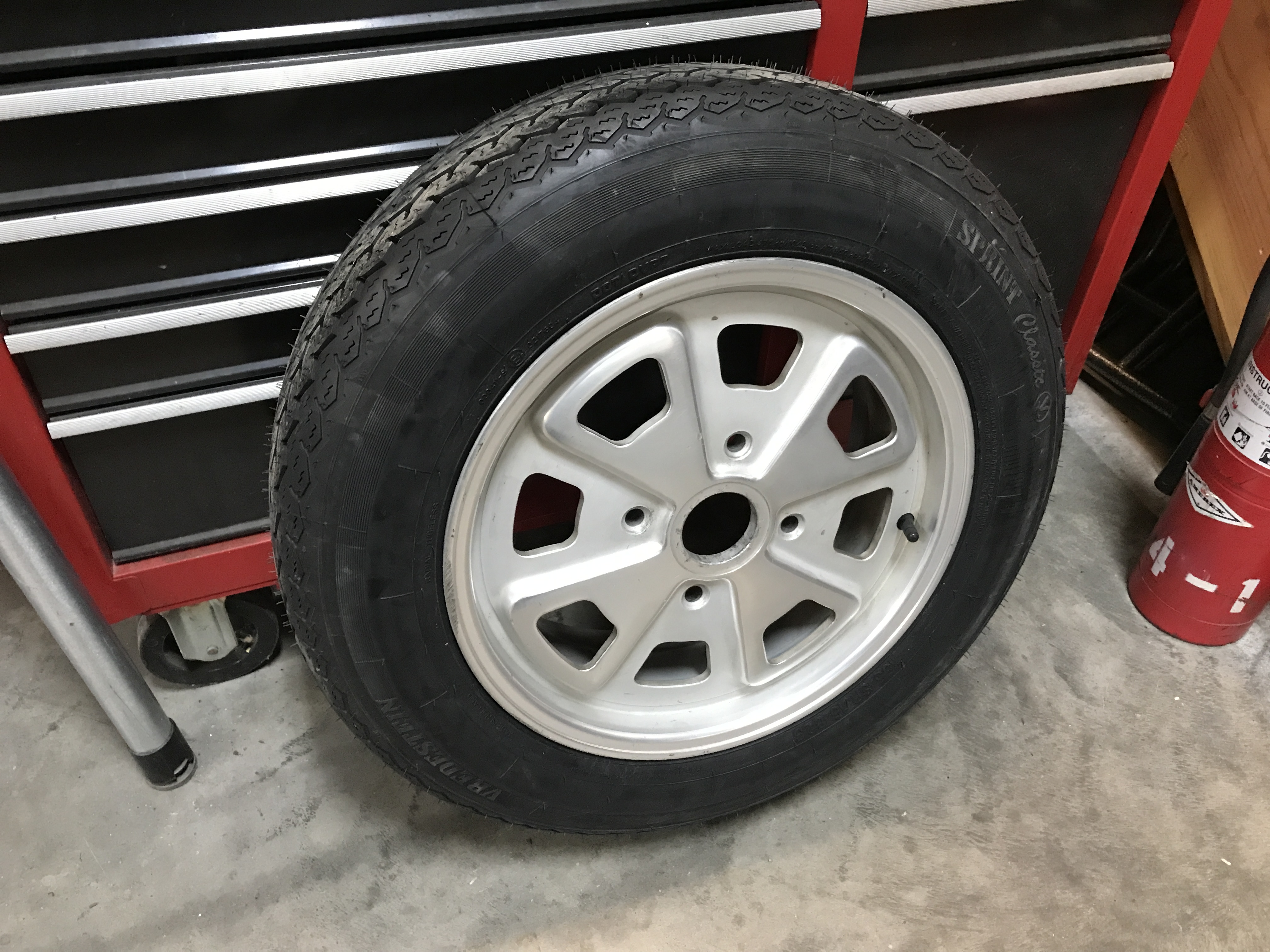

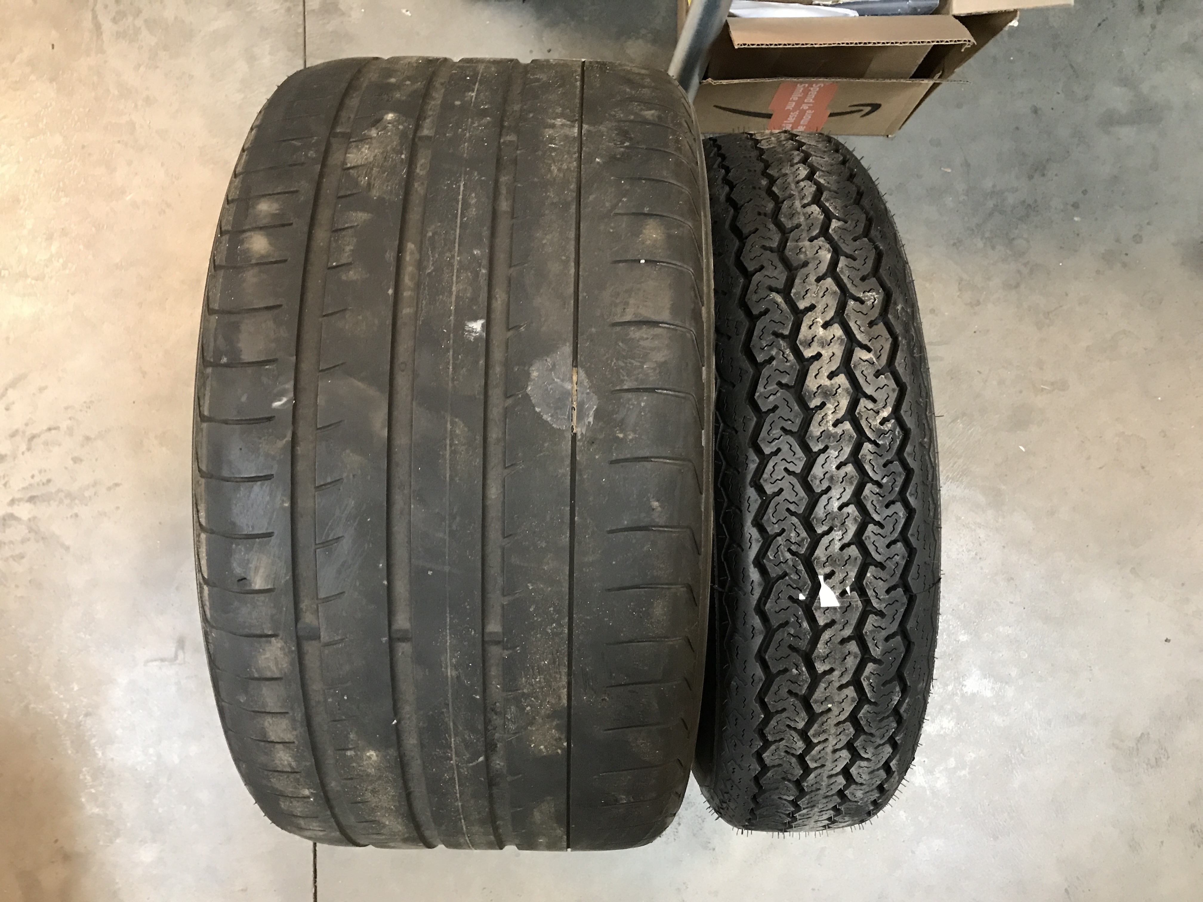

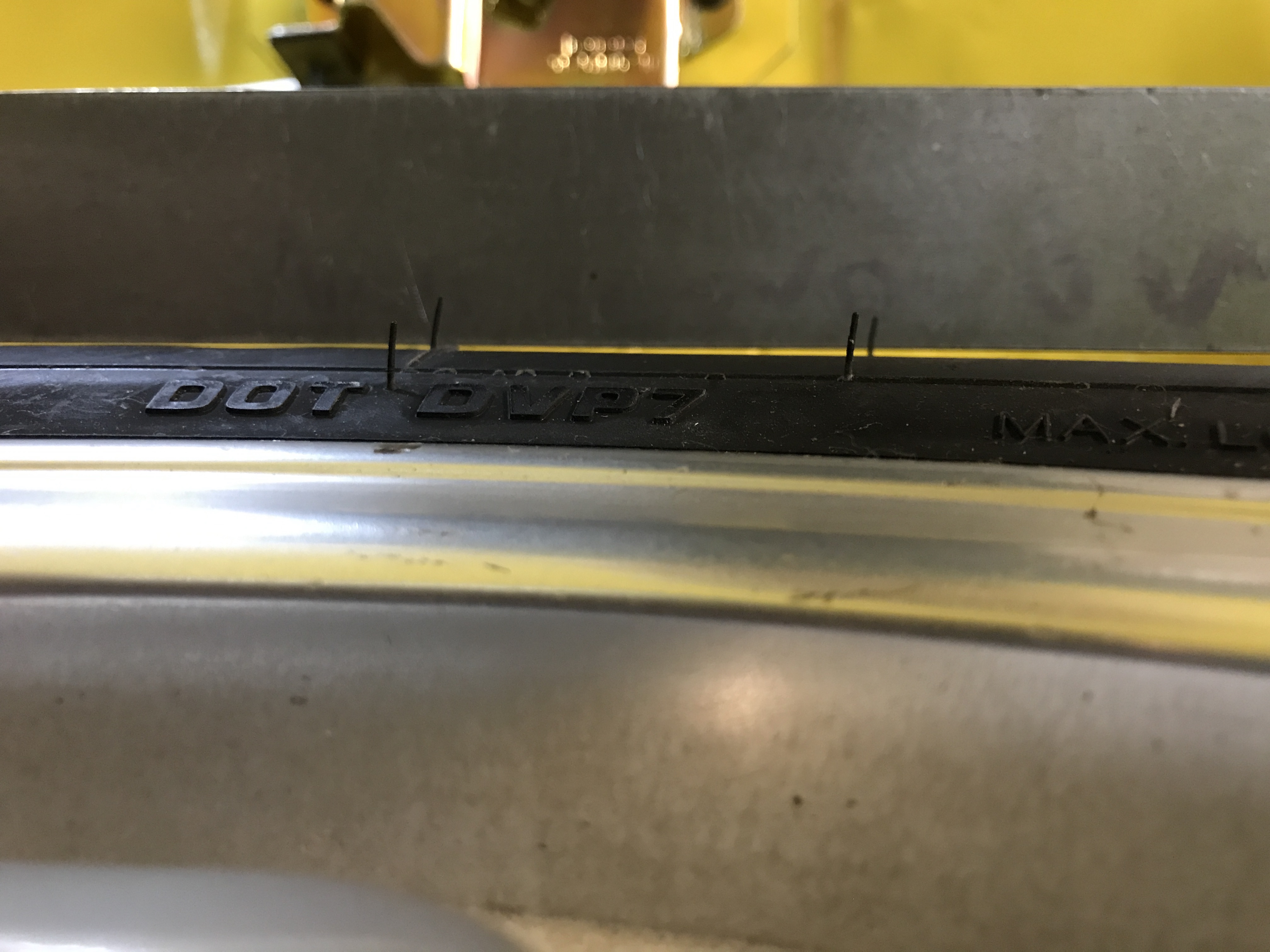

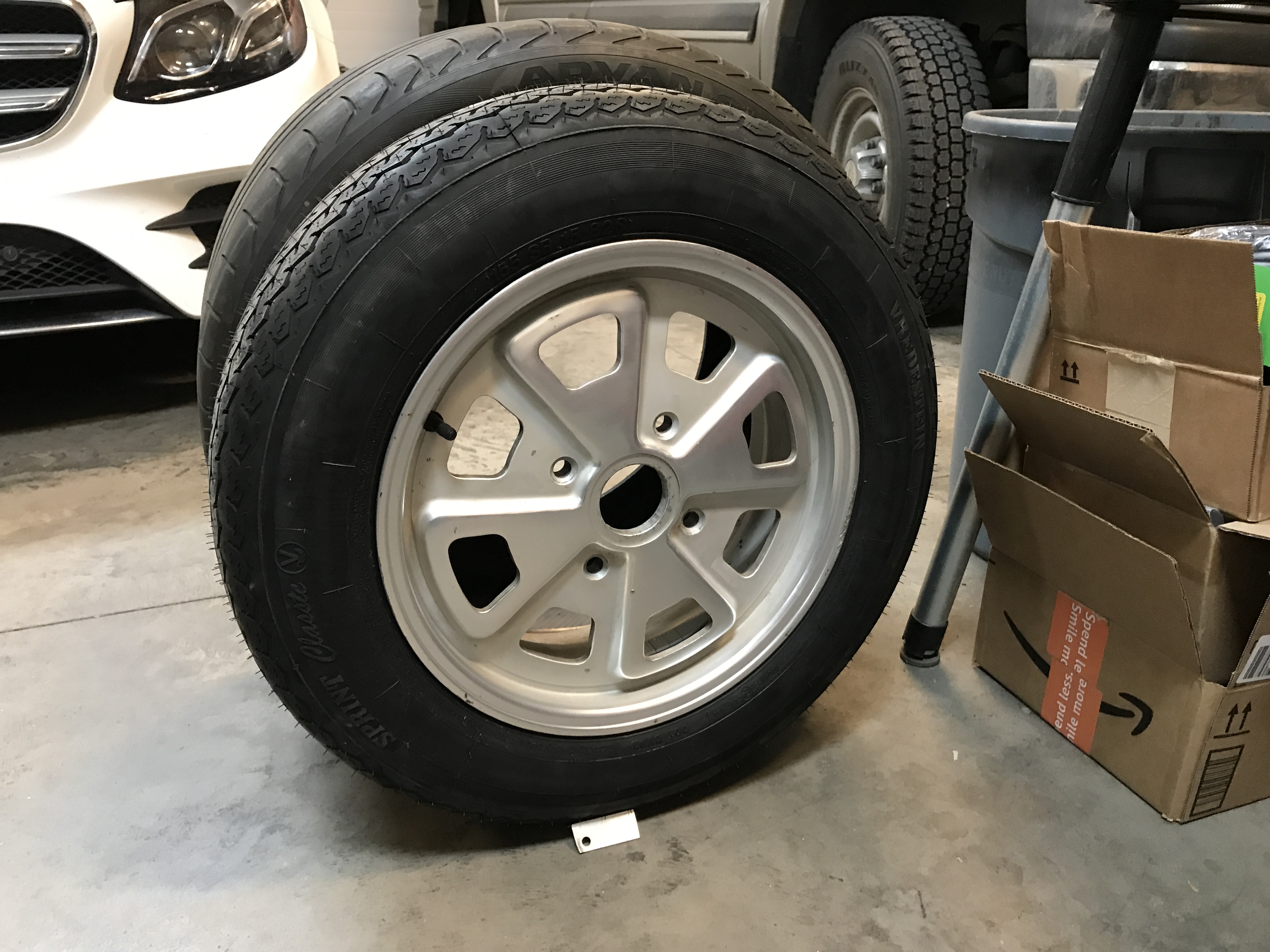

I got my spare mounted, a Vredestein Sprint Classic, 155SR-15, on a stock Fuchs wheel.
bkrantz
post Feb 3 2022, 08:47 PM
Post #4757
Posts: 8,345
Joined: 3-August 19
From: SW Colorado
Member No.: 23,343

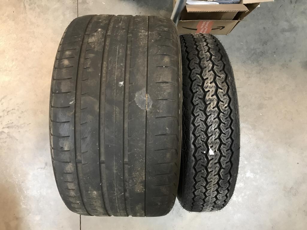

This tire is almost as tall as the ones on my 2017 991.
bkrantz
post Feb 3 2022, 08:49 PM
Post #4758
Posts: 8,345
Joined: 3-August 19
From: SW Colorado
Member No.: 23,343
But the 991 rear is just a bit wider.

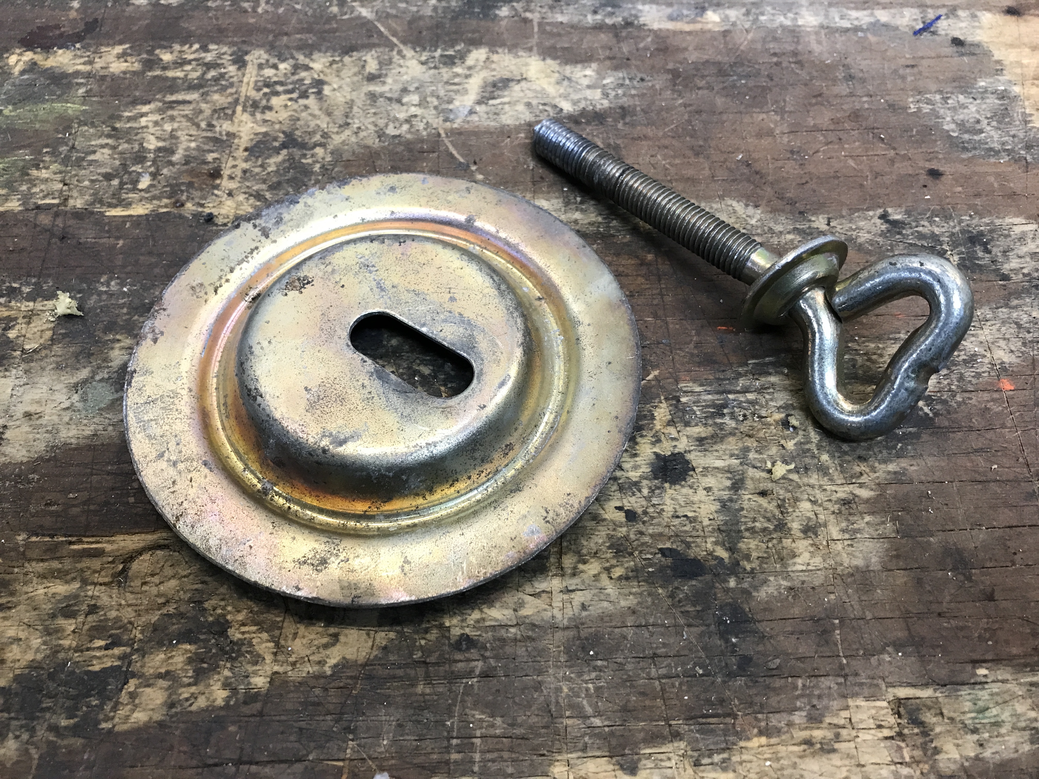

I dug out the spare retaining hardware.
