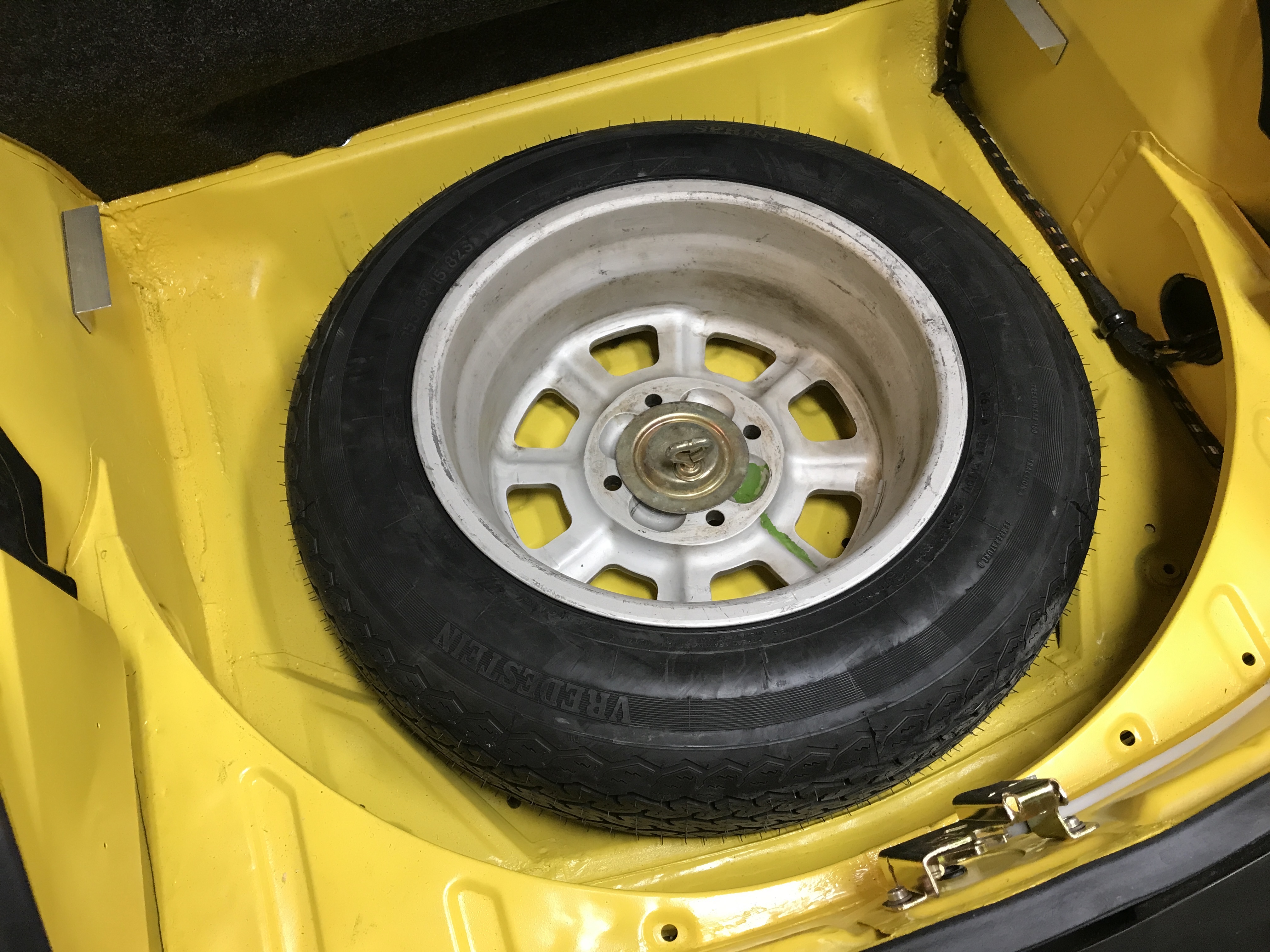

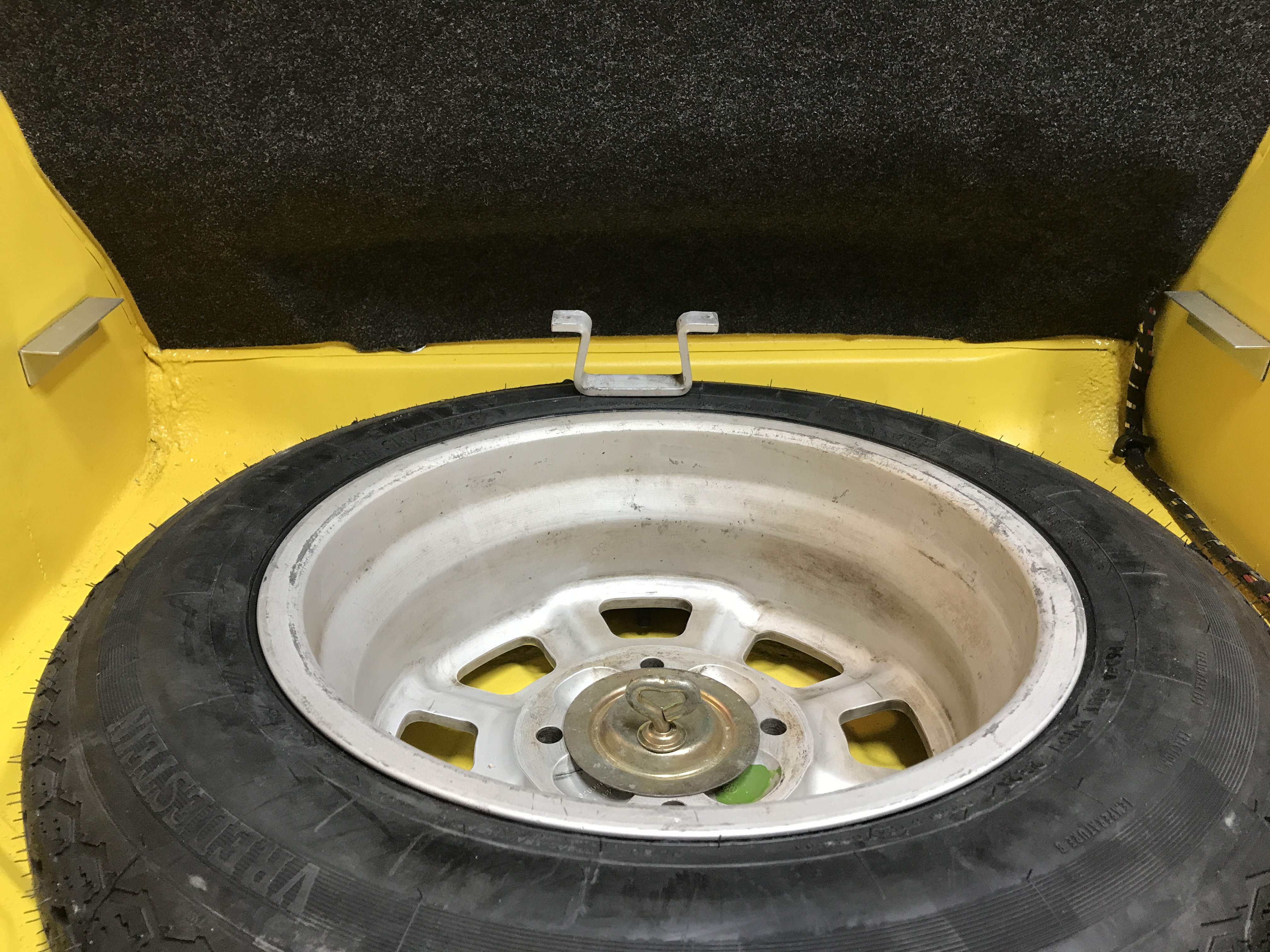

Here's the spare in place and tied down. But the gap towards the rear is about 2 inches, and leaves the floor unsupported.

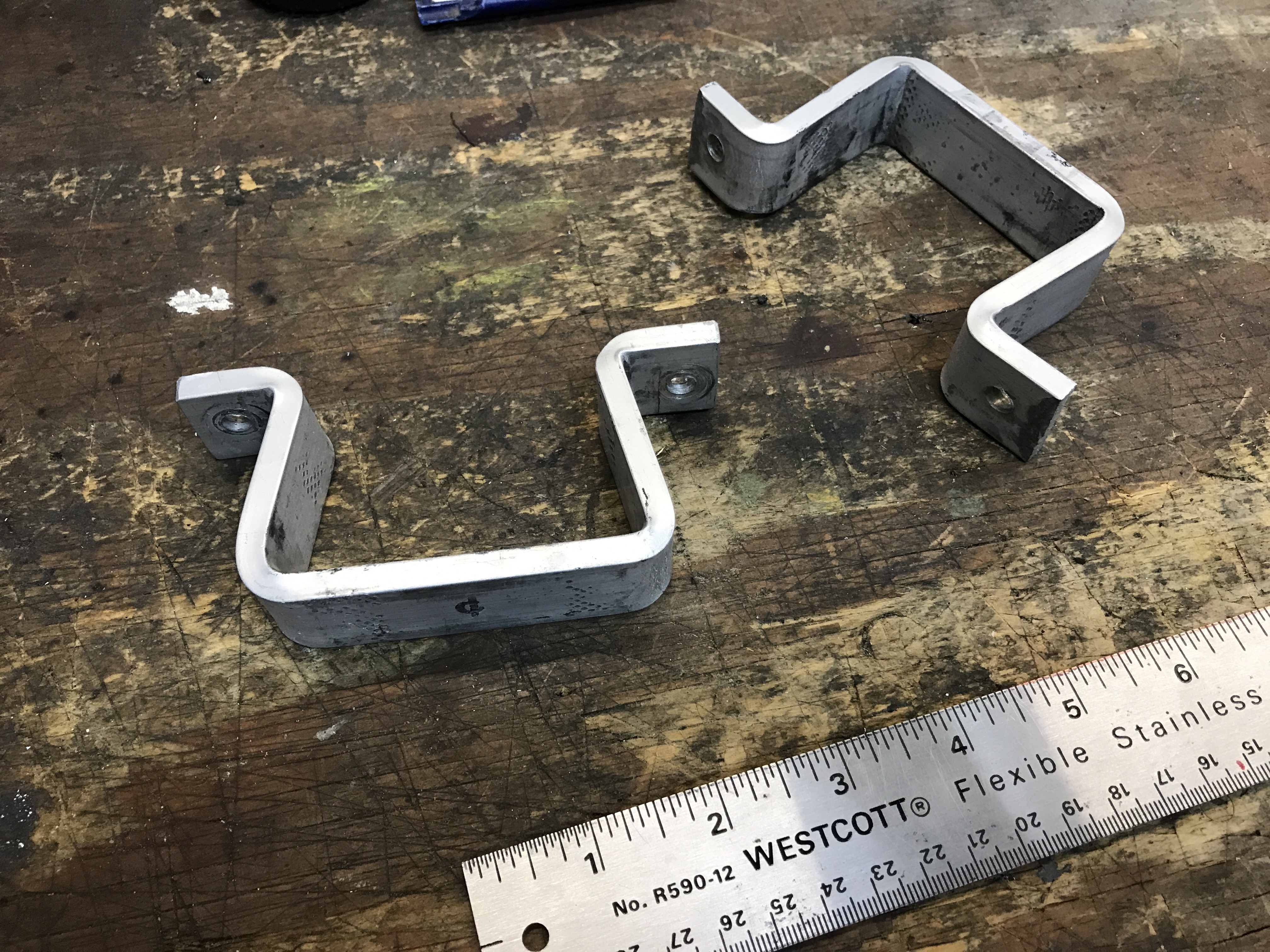

Looking around in my junk pile, I found a pair of brackets I made for something years ago.

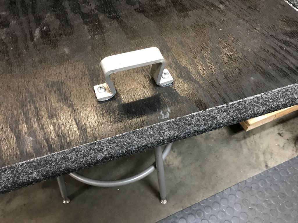

The bracket is just the right height.

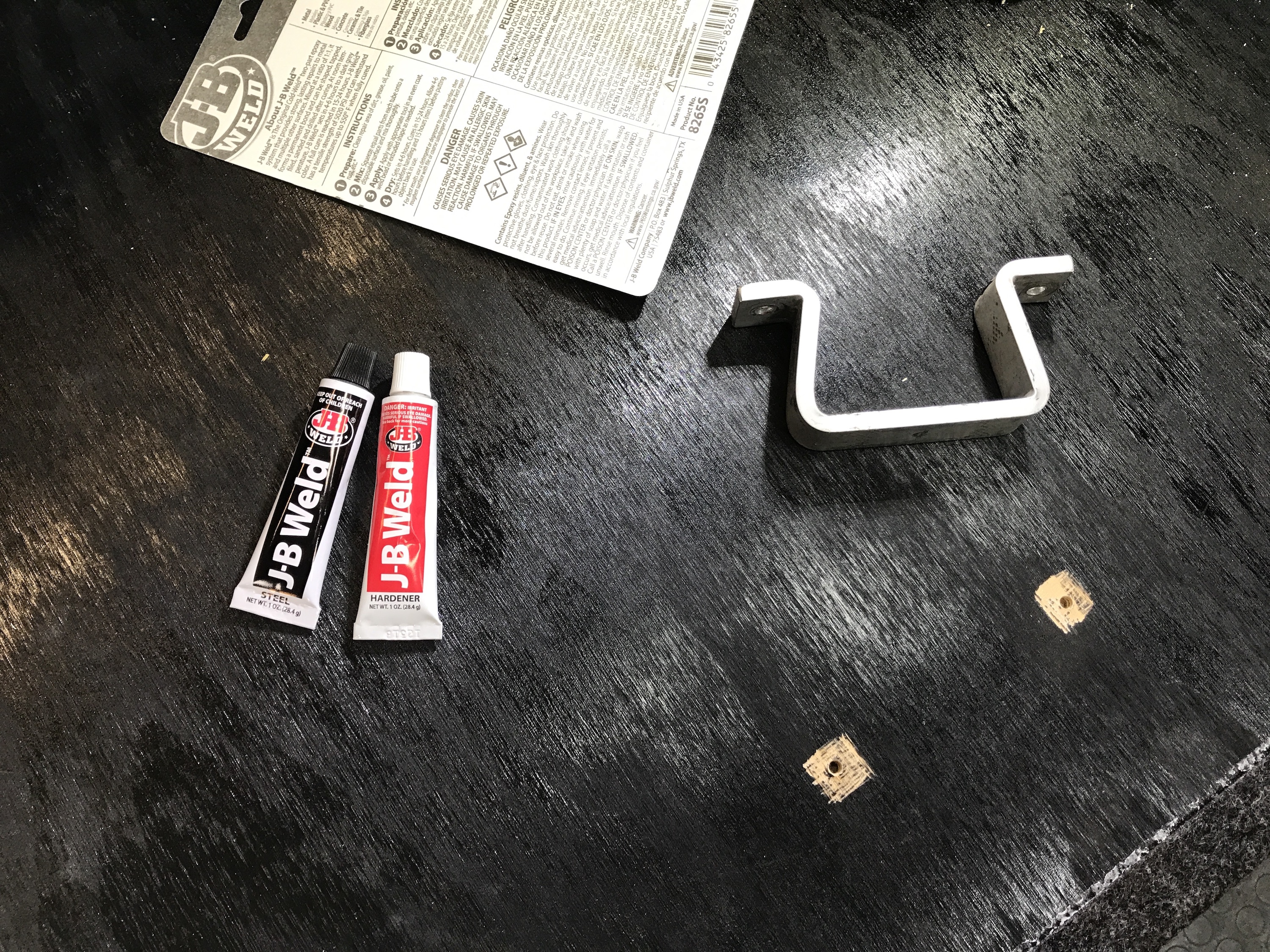

I got out some screws and JB Weld.

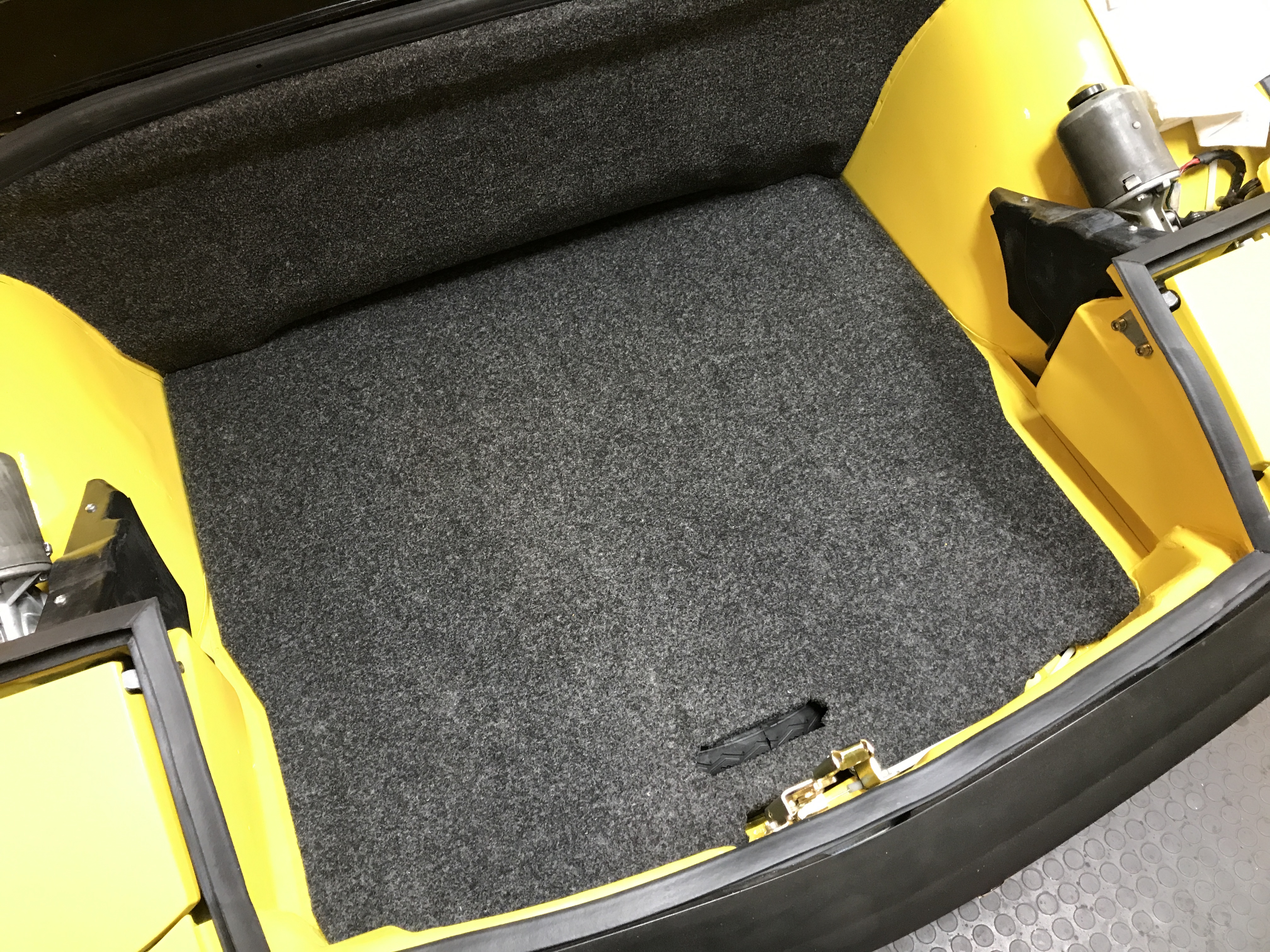

Now the custom floor I made sits level, and supported near the back edge.

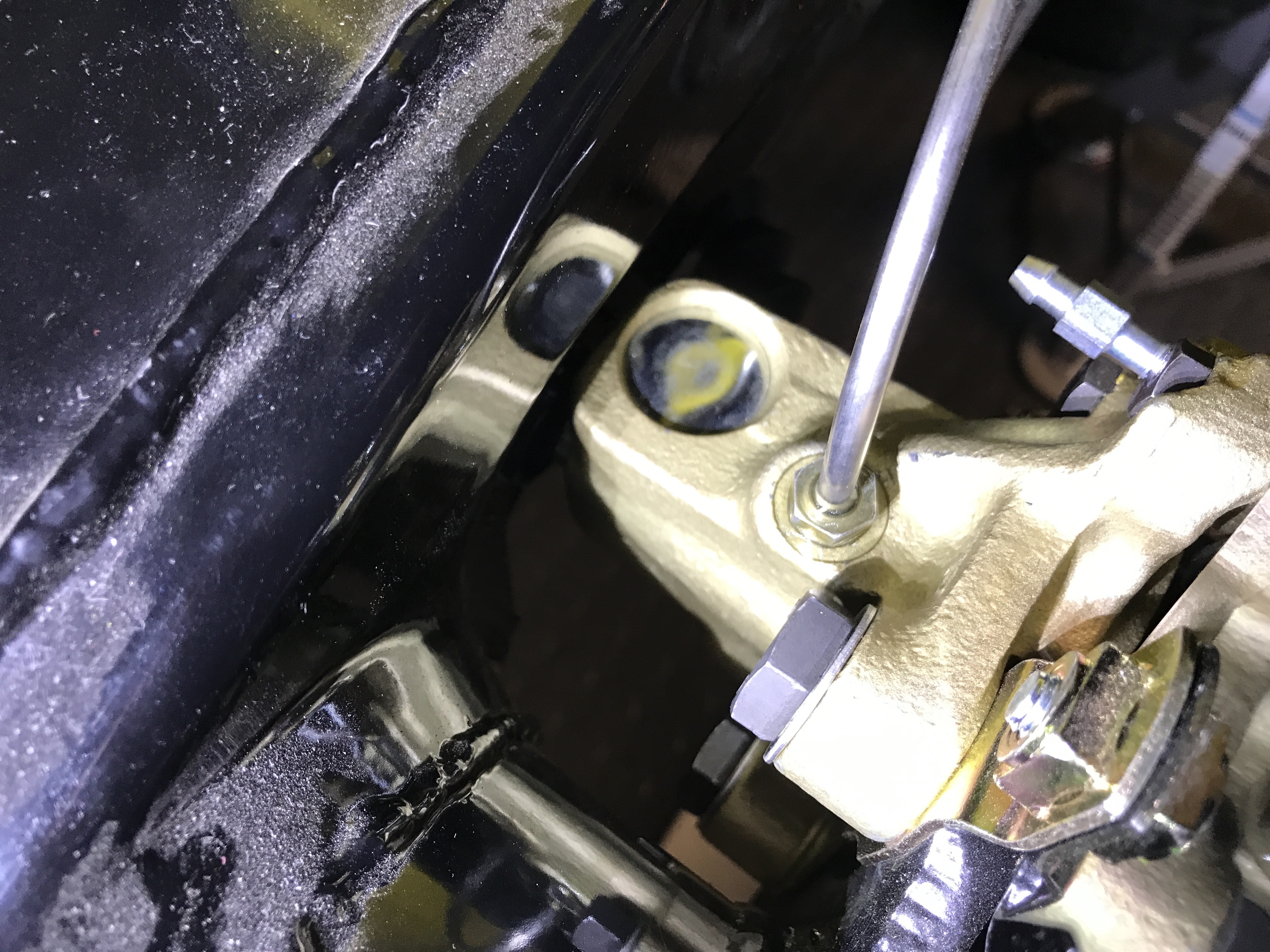

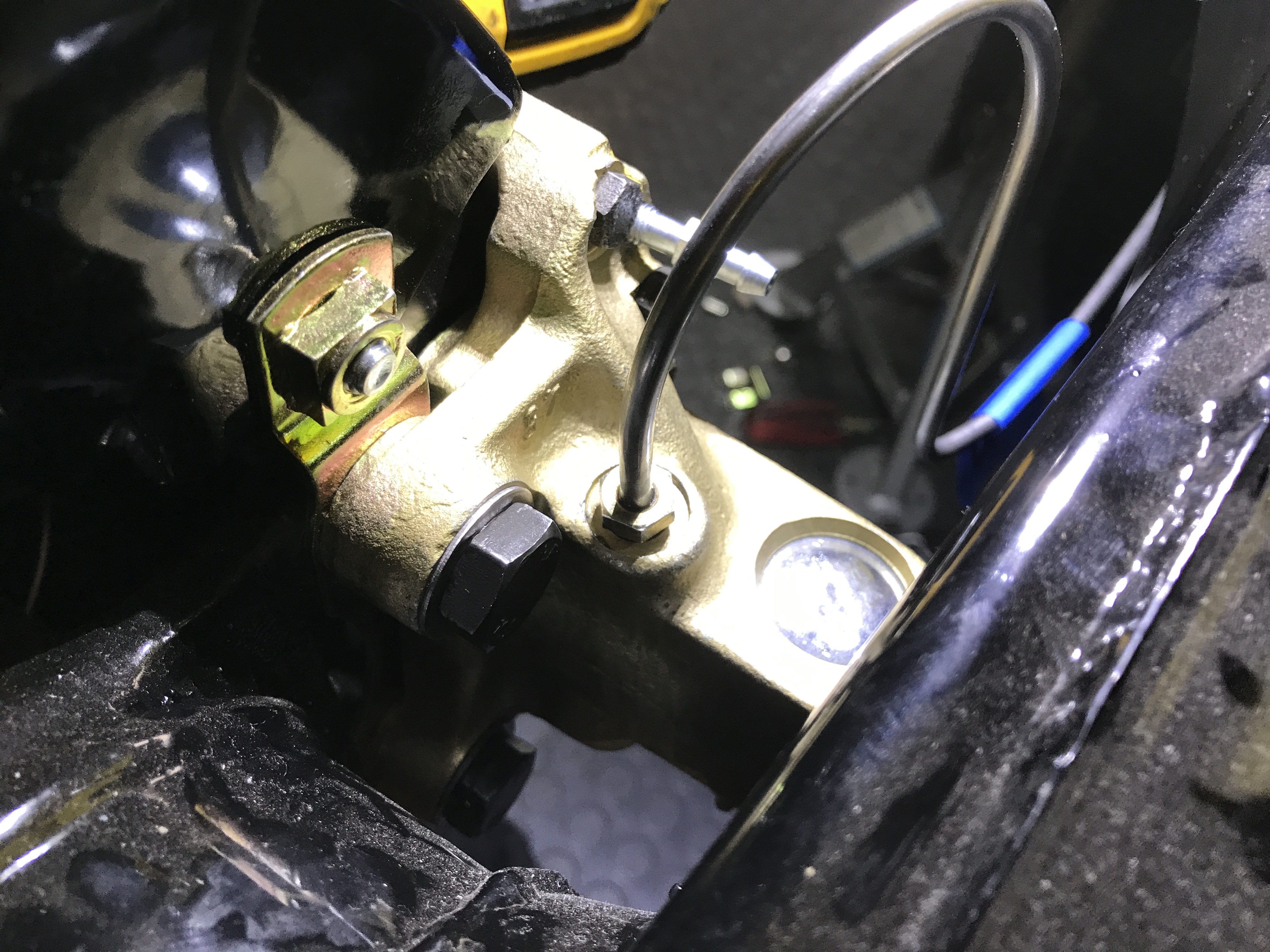

Last thing today: I checked the brake line attachments at the rear calipers for leaks. The left caliper looks dry.
bkrantz
post Feb 3 2022, 09:05 PM
Post #4768
Posts: 8,345
Joined: 3-August 19
From: SW Colorado
Member No.: 23,343
But the right side is still leaking. I will need to work on this side again.

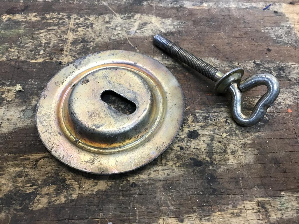

QUOTE(bkrantz @ Feb 3 2022, 06:53 PM) *
I dug out the spare retaining hardware.
Whoa, whoa, whoa.....
Dude. Are you actually putting a part looking like this back in that car of yours?
OMGGGGGGGGGGGG
I'm mean the plating, the cleanliness, etc, etc.
I might not be able to sleep tonight without notifying the concour polizei.
(IMG:style_emoticons/default/barf.gif)
(IMG:style_emoticons/default/bootyshake.gif)
hahaha
Looking good as always Bob.
Fun to watch all the progress.

QUOTE(bkrantz @ Feb 3 2022, 10:05 PM) *
Is the tubing "bubble" flared?
My local NAPA informed me of the bubble, I had no prior idea. Single flare, double flare but never heard of a bubble

QUOTE(raynekat @ Feb 3 2022, 09:07 PM) *
OMGGGGGGGGGGGG
hahaha
Doug, I feel your pain. (IMG:style_emoticons/default/biggrin.gif)
I forgot a few things when I sent out my hardware for re-plating. I figure that I should have a few "original" parts on the car, right?

QUOTE(930cabman @ Feb 4 2022, 06:22 AM) *
Yes, they have bubble flares--and I trust the source (PMB) to provide the correct flares.

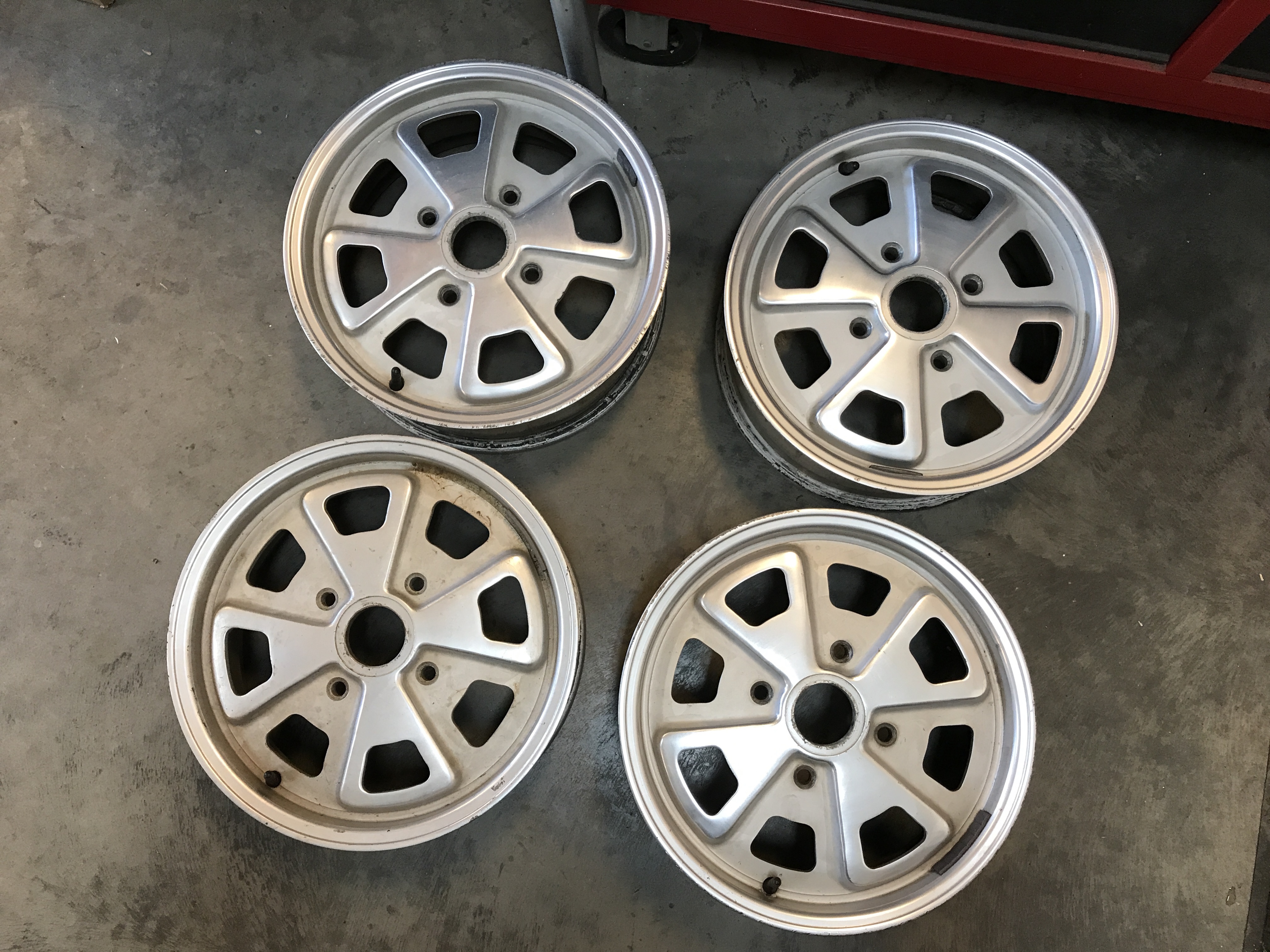

I got the rest of the old tires removed today, and just in time. These all have some scratches, and even a bit of curb rash, but seem to be straight and true. Just dirty.

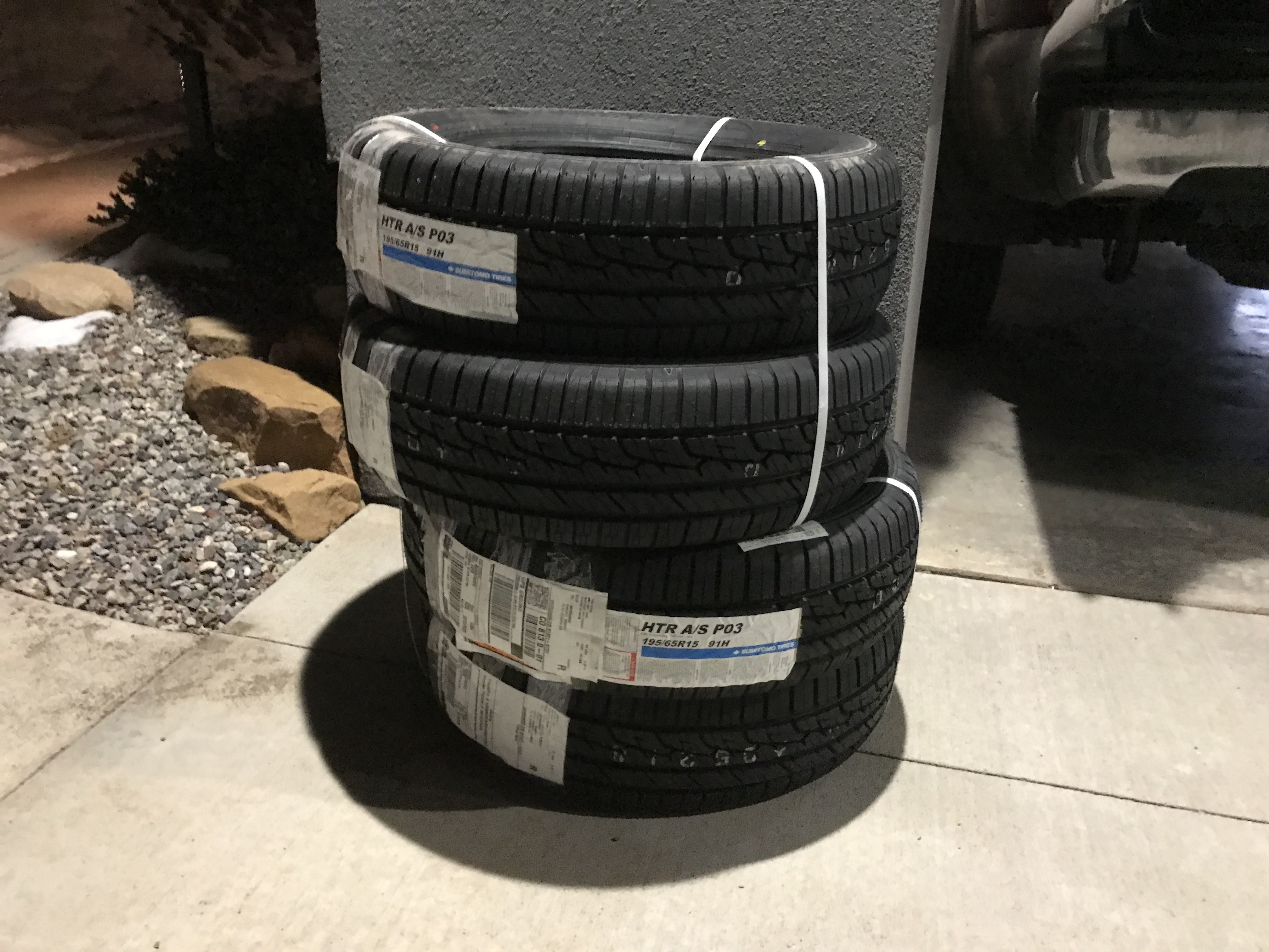

Member No.: 23,343
I ordered Sumitomo HTR A/S in 195/65-15 from Tire Rack yesterday afternoon, and they showed up at 6pm today. No supply chain issues!

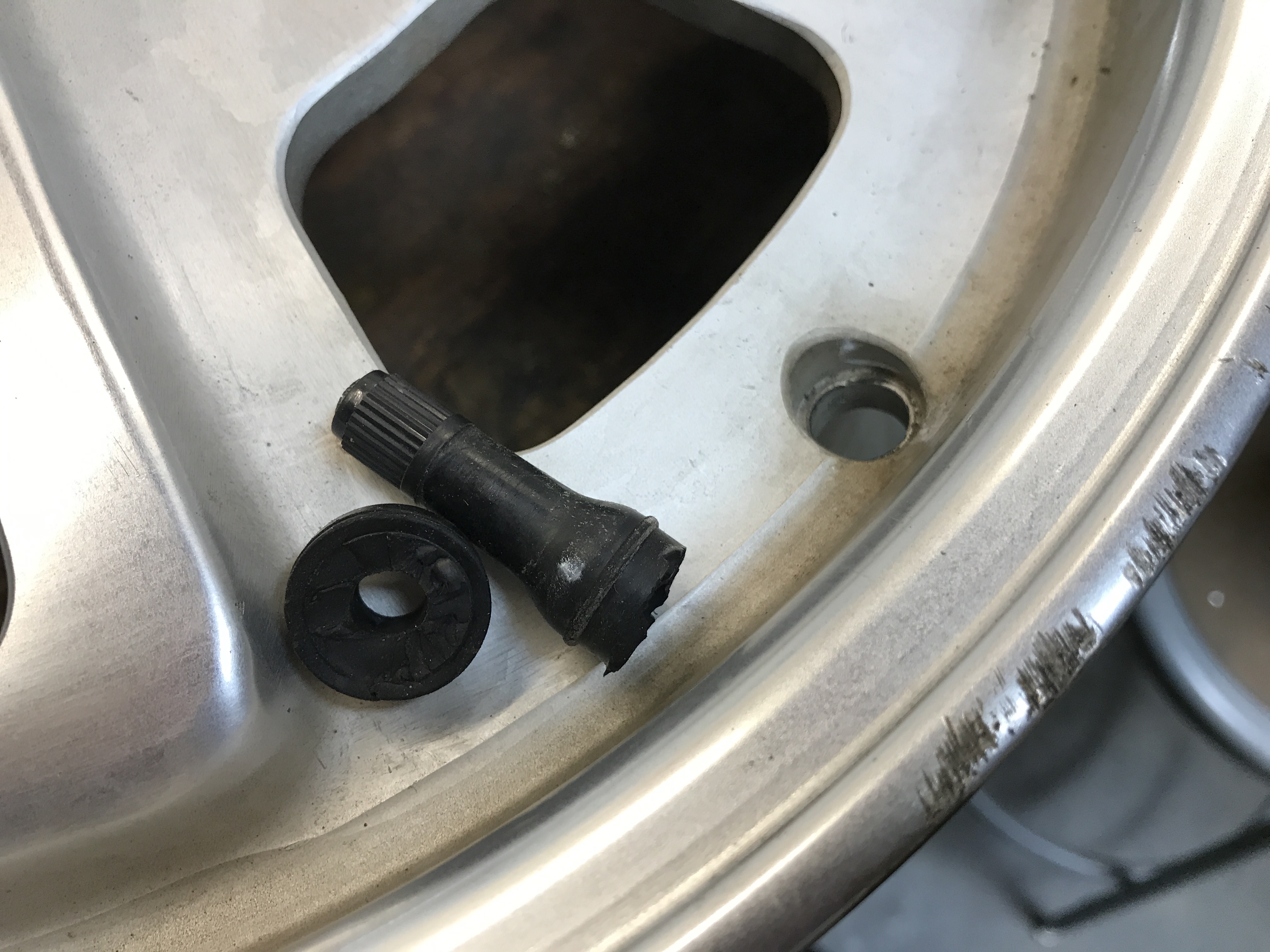

I started processing the remaining Fuchs wheels so I can get the new tires mounted.
Step 1: remove the valve stem.
bkrantz
post Feb 5 2022, 09:33 PM
Post #4776
Posts: 8,345
Joined: 3-August 19
From: SW Colorado
Member No.: 23,343

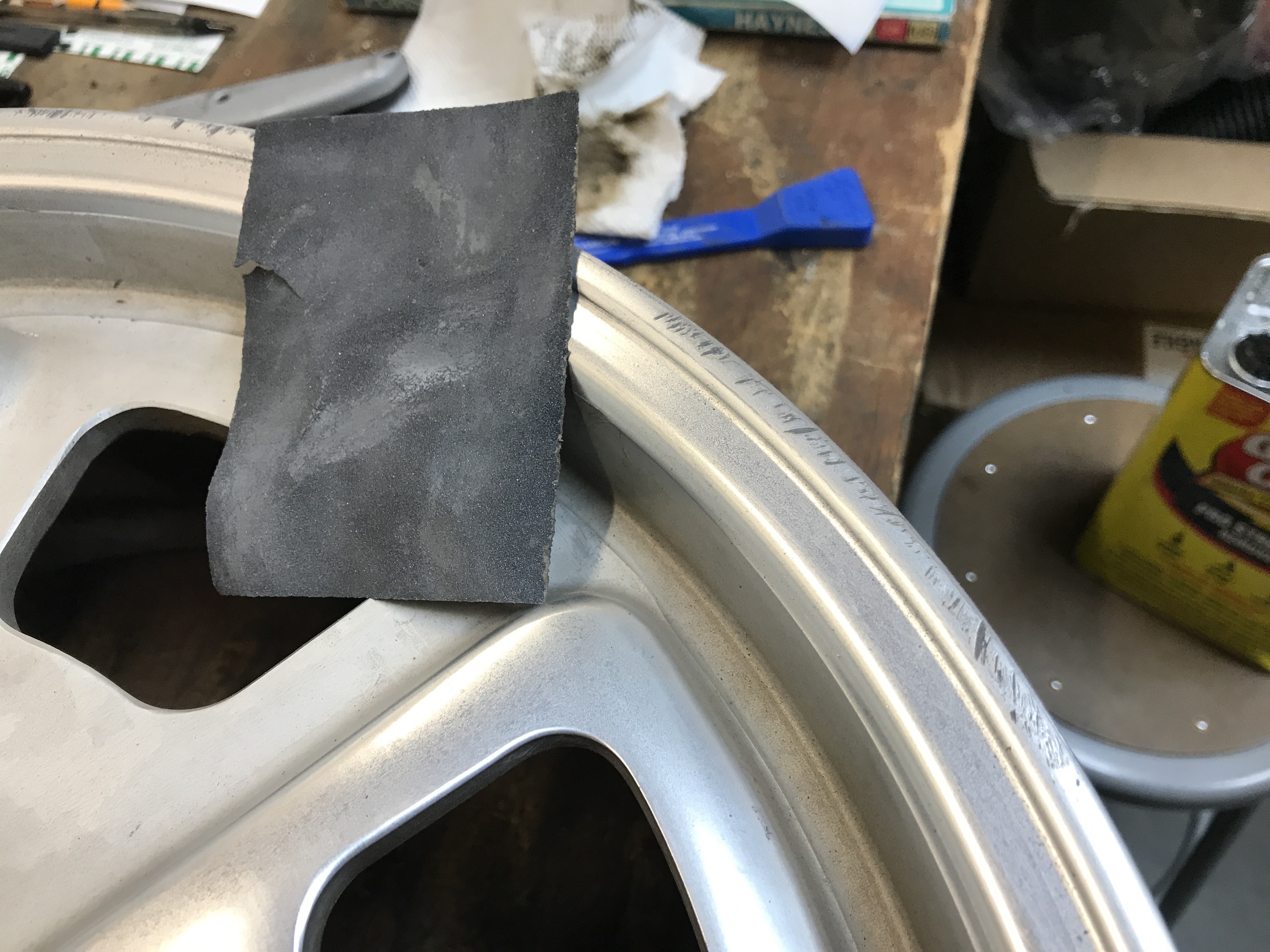

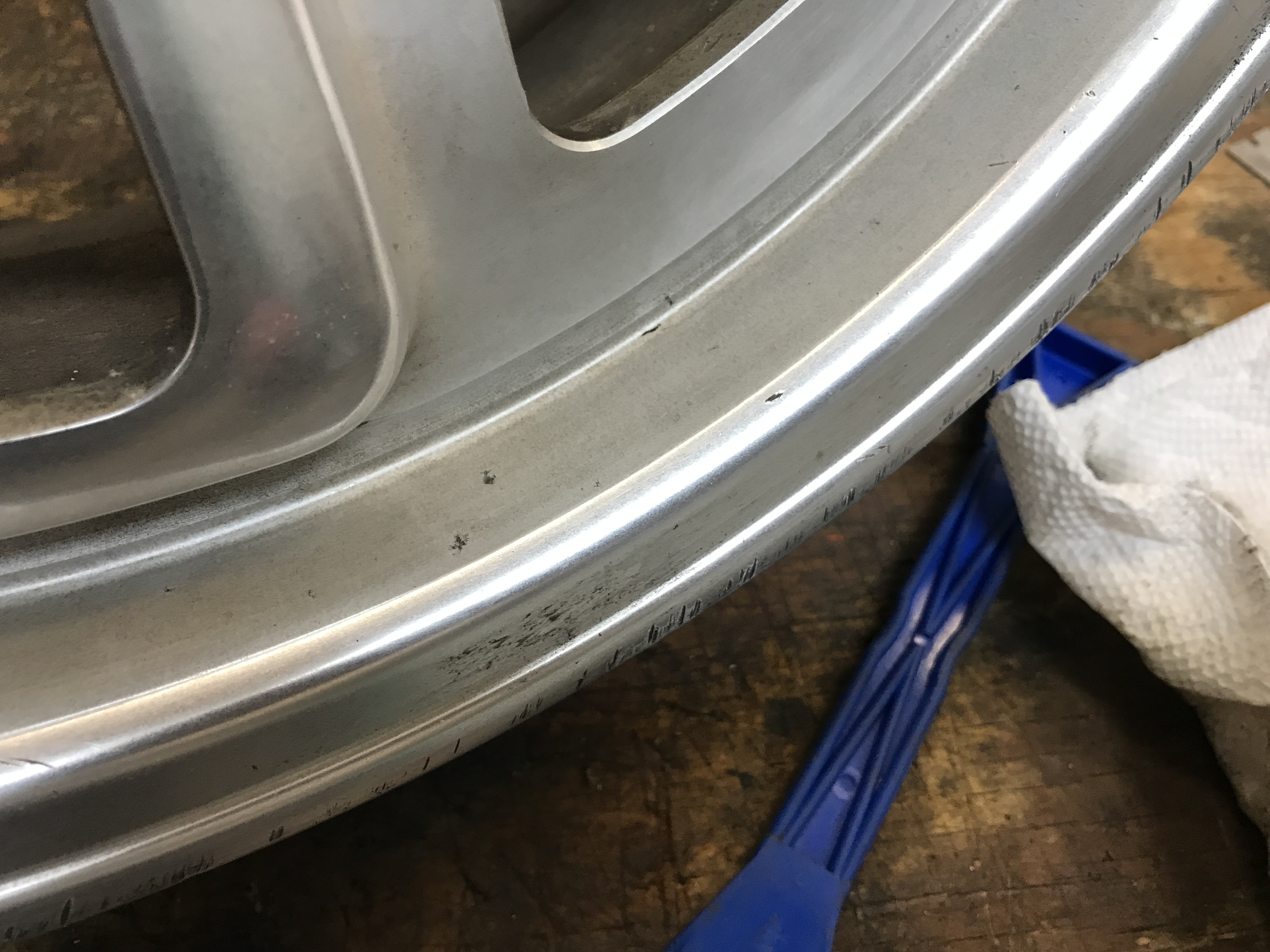

Step 2: A bit of sanding on the curb rash--at least enough to take down any edges and reduce the visibility. I know this removes the anodizing, but I think the trade-off is worthwhile.
bkrantz
post Feb 5 2022, 09:34 PM
Post #4777
Posts: 8,345
Joined: 3-August 19
From: SW Colorado
Member No.: 23,343

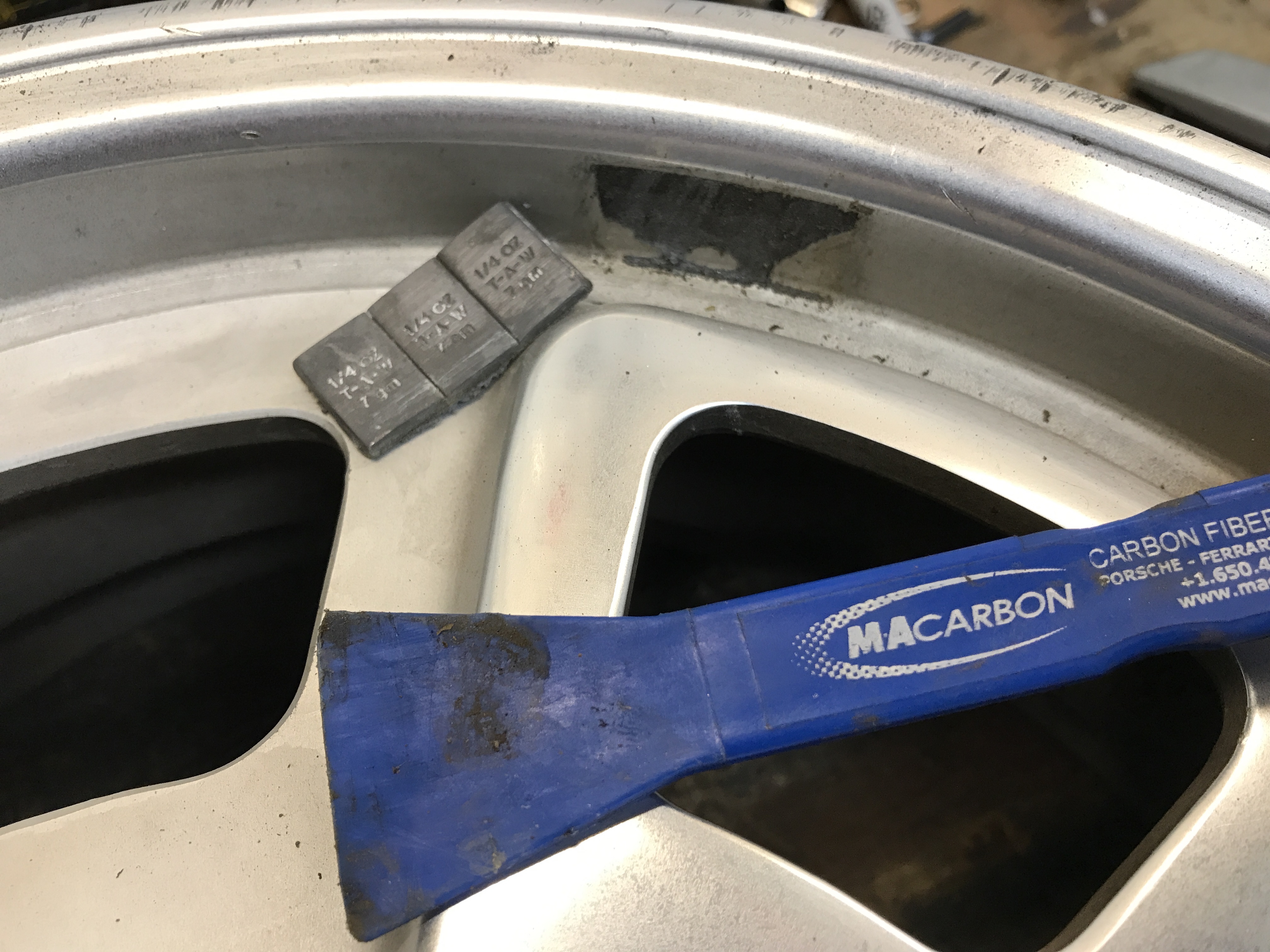

Step 3: remove any existing stick-on weights, outside and in.
bkrantz
post Feb 5 2022, 09:36 PM
Post #4778
Posts: 8,345
Joined: 3-August 19
From: SW Colorado
Member No.: 23,343

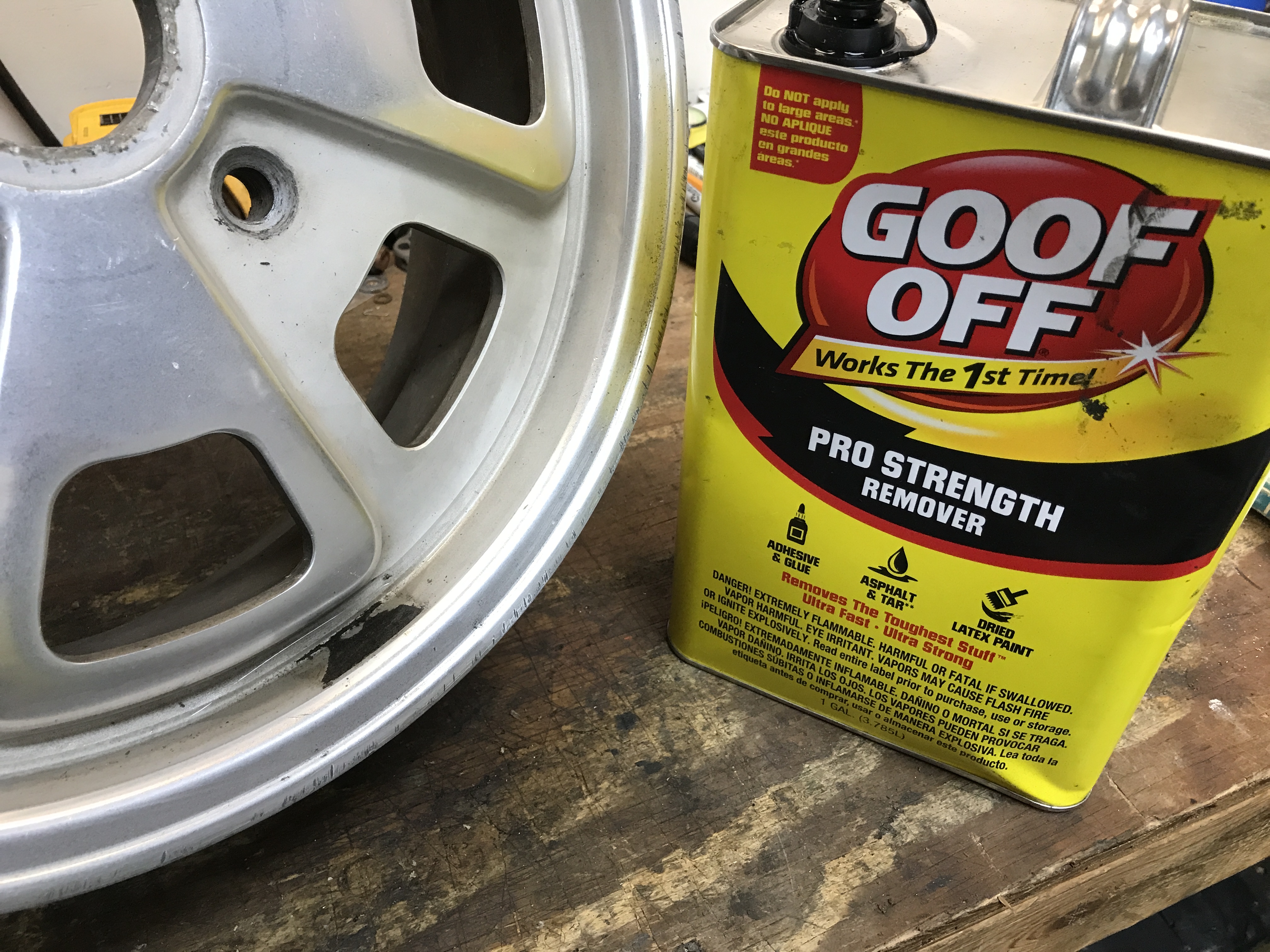

Step 4: use Goof Off to remove the "recent" adhesive residue.
bkrantz
Post #4779
Posts: 8,345
Joined: 3-August 19
From: SW Colorado
Member No.: 23,343
That works well, and easy.

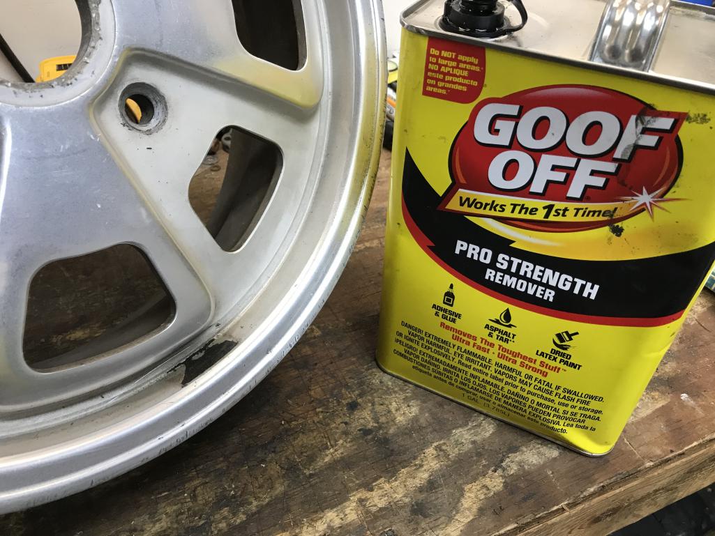

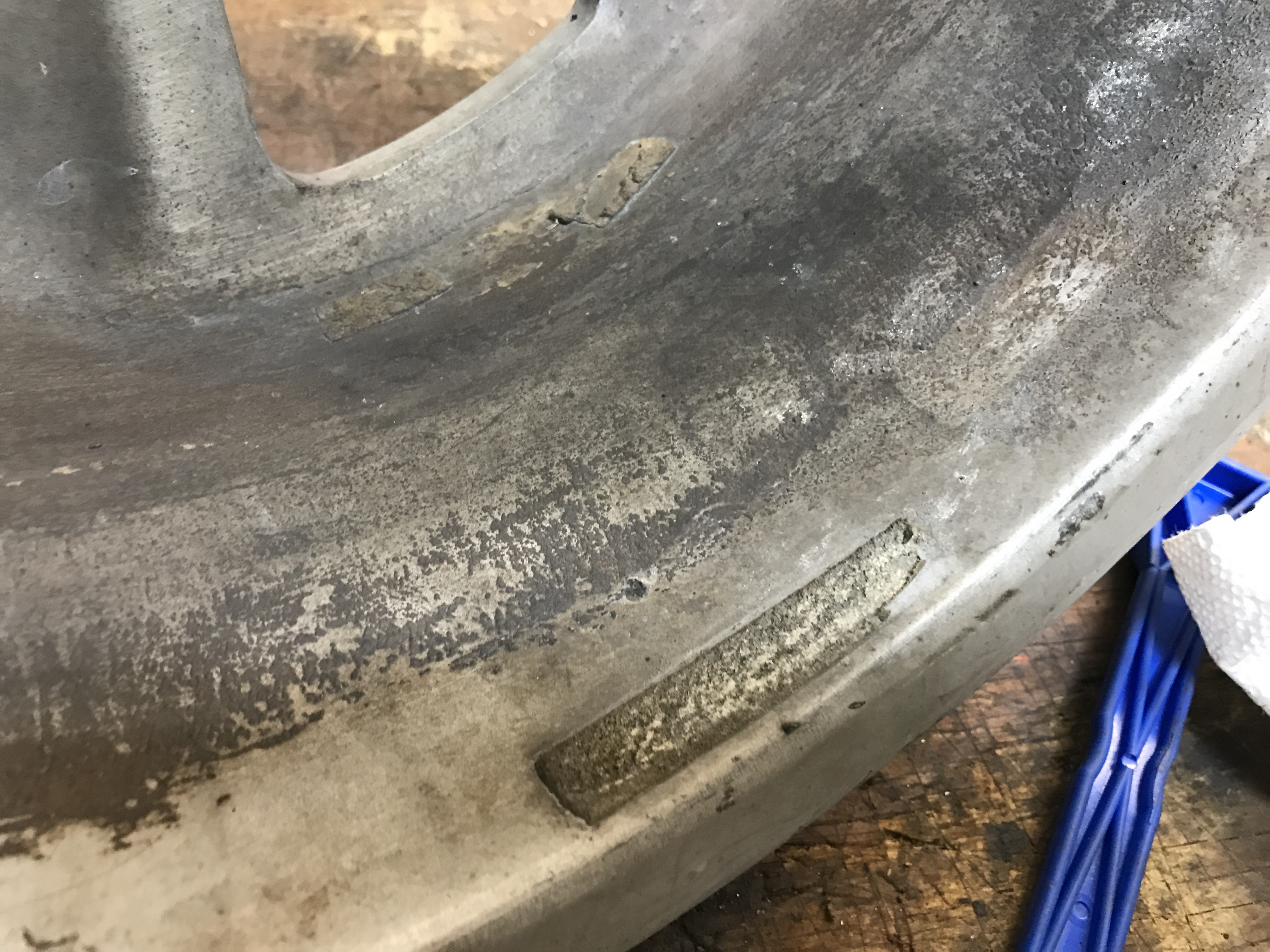

Step 5: attack any ancient adhesive residue.
