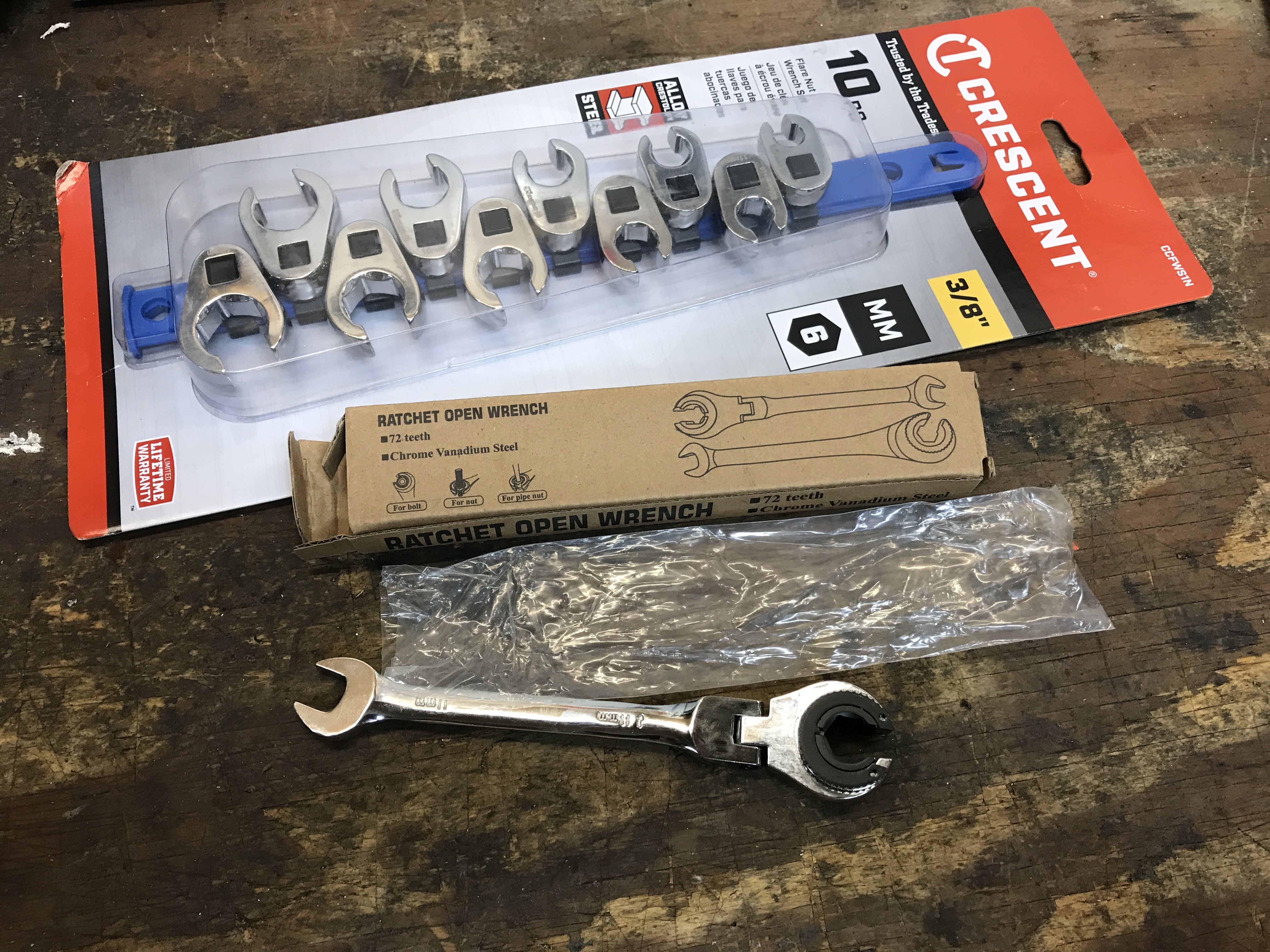

Got some more tools (More Tools!), to help reach all the brake system fittings without pulling the engine.

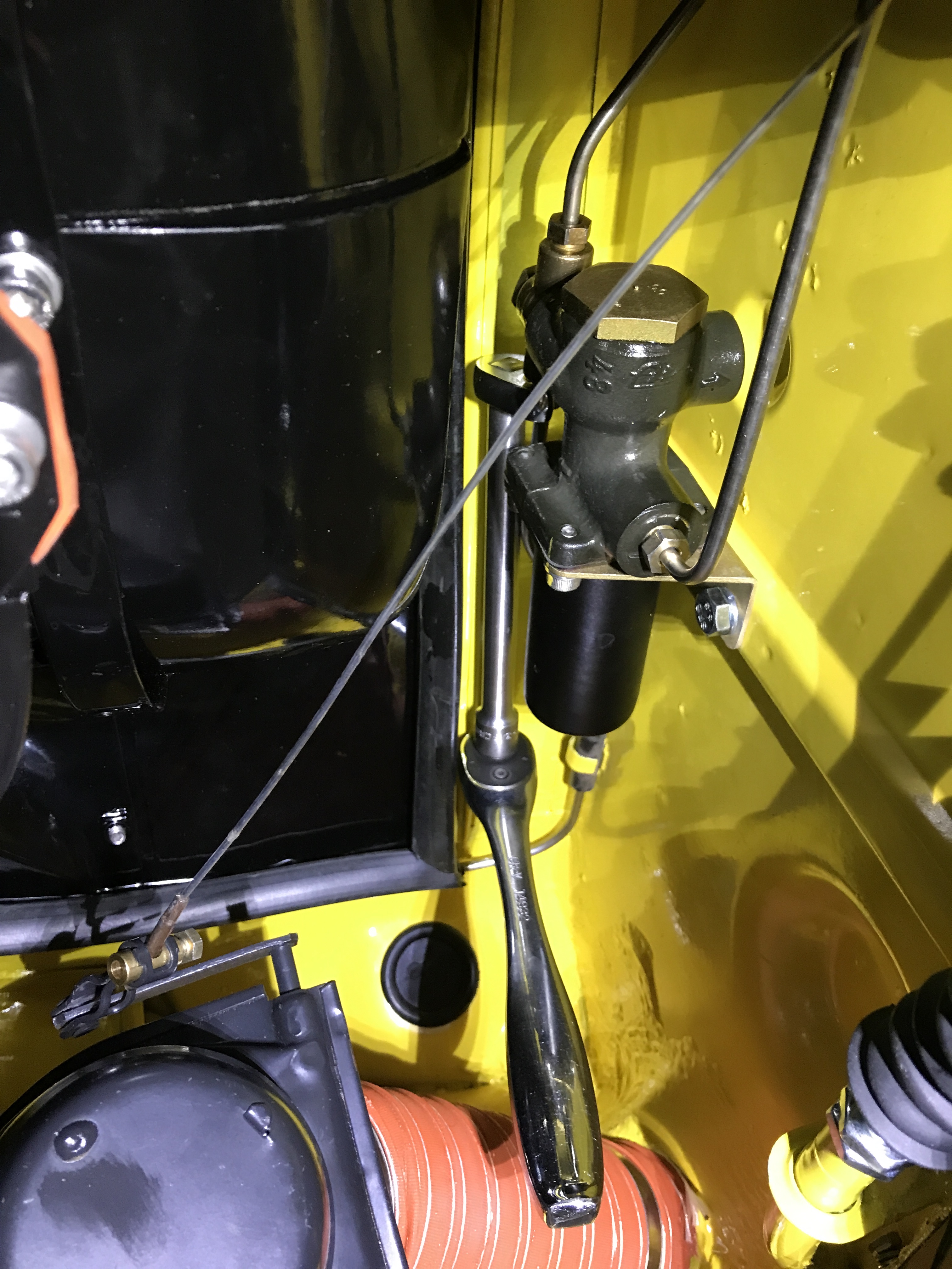

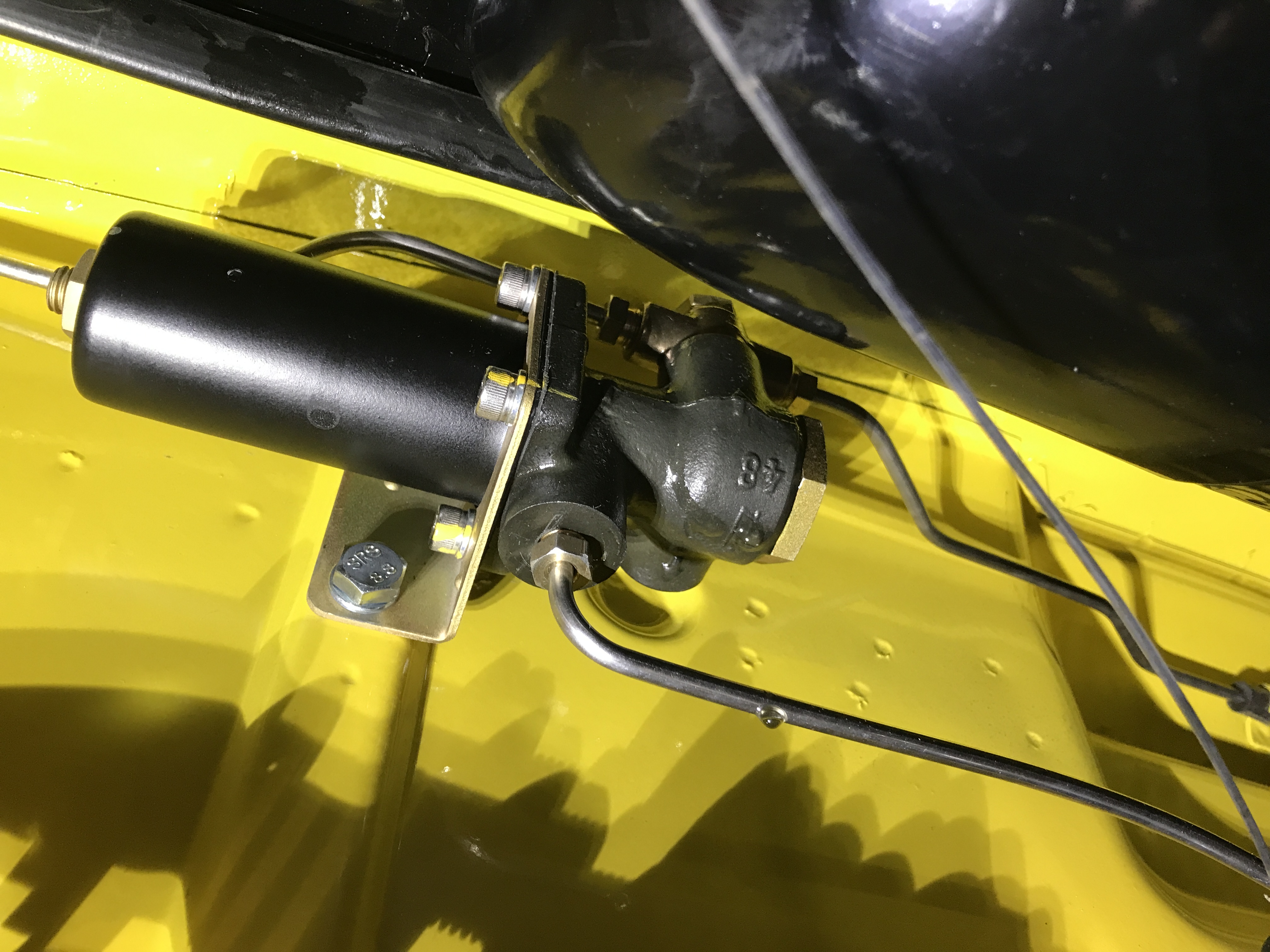

Good thing, since at least some of the fittings on the pressure regulator valve are still weeping.

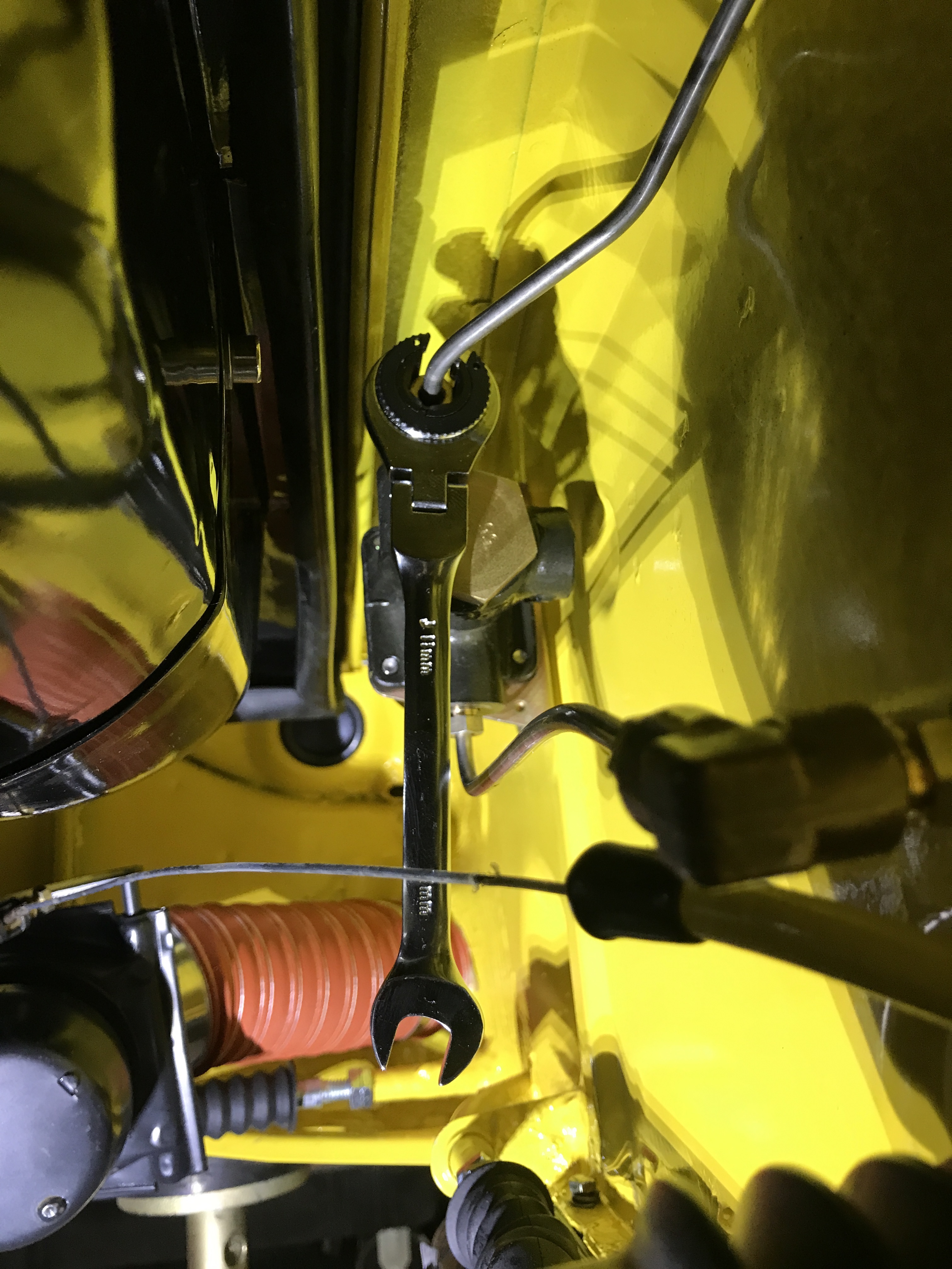

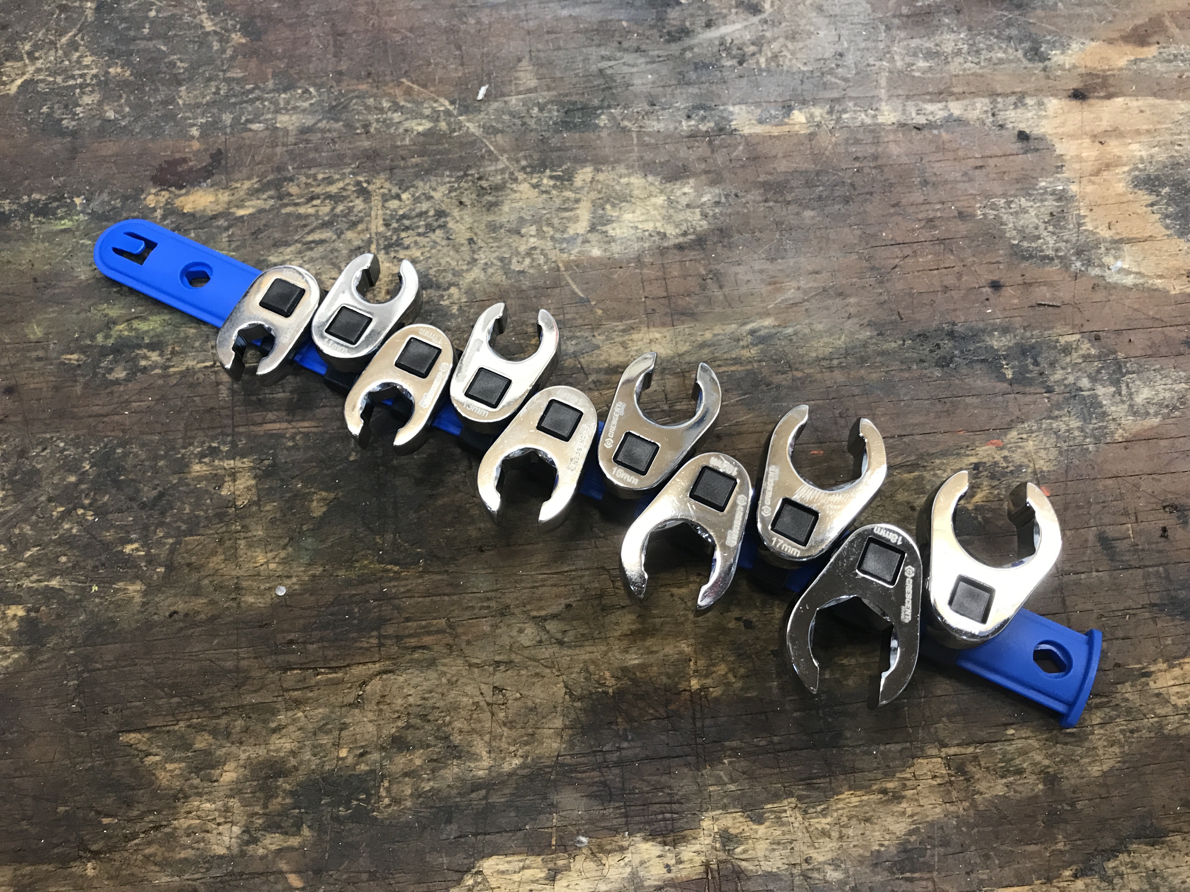

Start with the flare nut crows foot wrenches.
bkrantz
post Feb 9 2022, 08:14 PM
Post #4806
Posts: 8,345
Joined: 3-August 19
From: SW Colorado
Member No.: 23,343

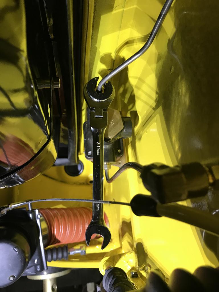

The 11 mm on a 6 inch extension is perfect for one of the fittings on top. I was able to tighten this one quite a bit.
bkrantz
post Feb 9 2022, 08:16 PM
Post #4807
Posts: 8,345
Joined: 3-August 19
From: SW Colorado
Member No.: 23,343
Then I used the 11 mm ratcheting wrench, which also has a flare nut style engagement on the other side. Also quite a bit of tightening.

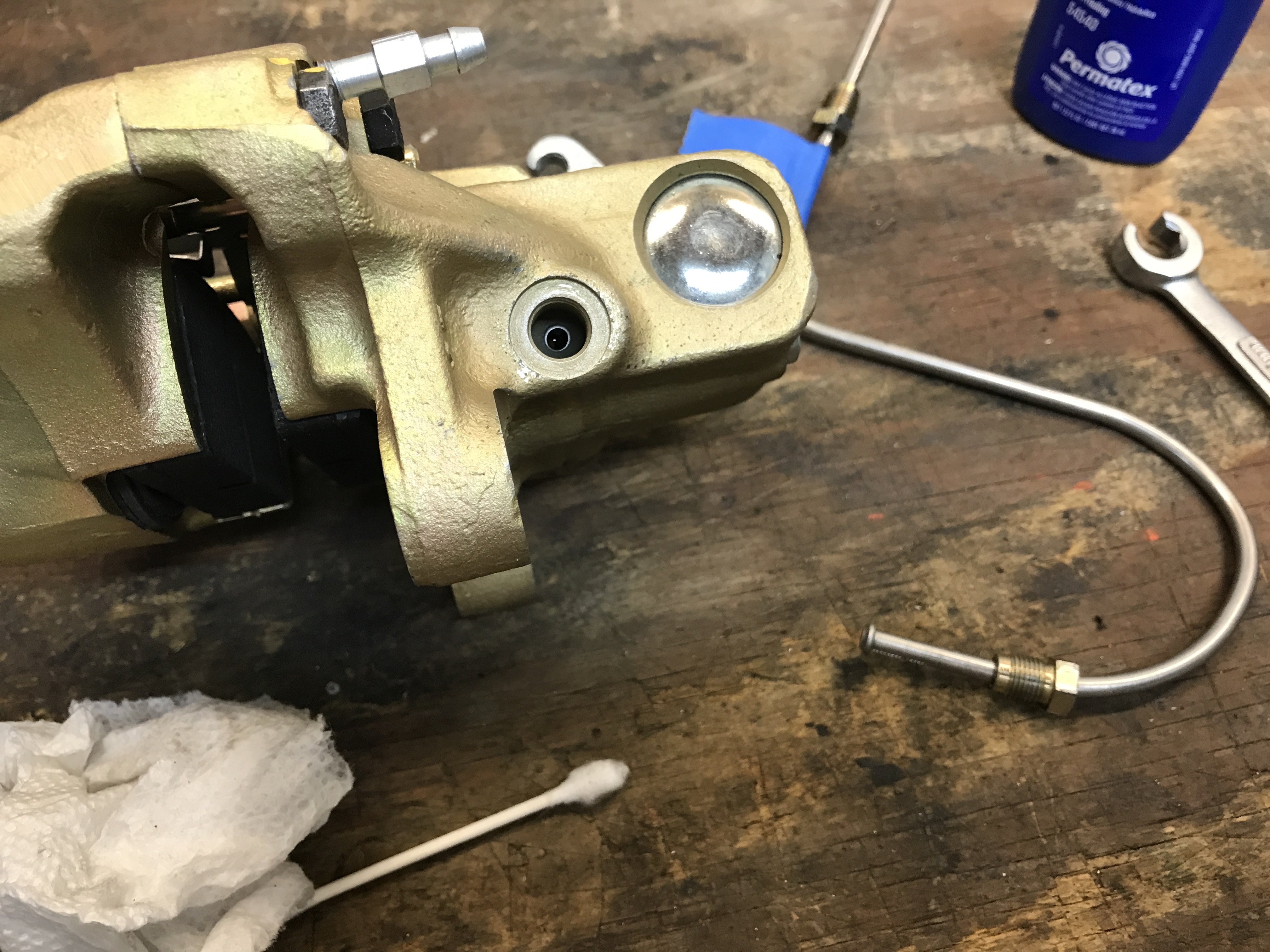

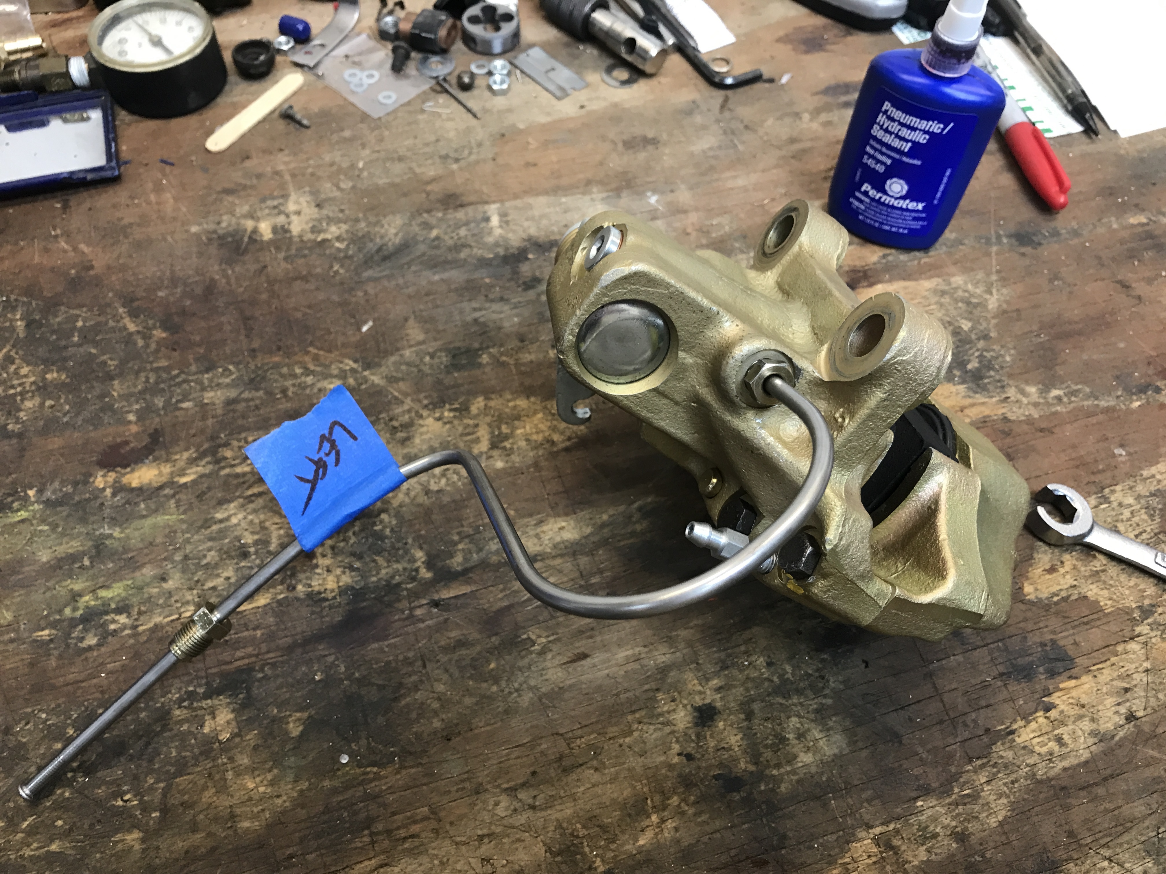

I also got some hydraulic fitting sealant, as recommended by PMB. This is for the problematic fittings on the rear calipers.
bkrantz
post Feb 9 2022, 08:22 PM
Post #4809
Posts: 8,345
Joined: 3-August 19
From: SW Colorado
Member No.: 23,343
Once again I took the calipers out so I can fully access the fittings on top. I removed and cleaned the hard lines, and the seat inside the caliper body.
bkrantz
post Feb 9 2022, 08:25 PM
Post #4810
Posts: 8,345
Joined: 3-August 19
From: SW Colorado
Member No.: 23,343

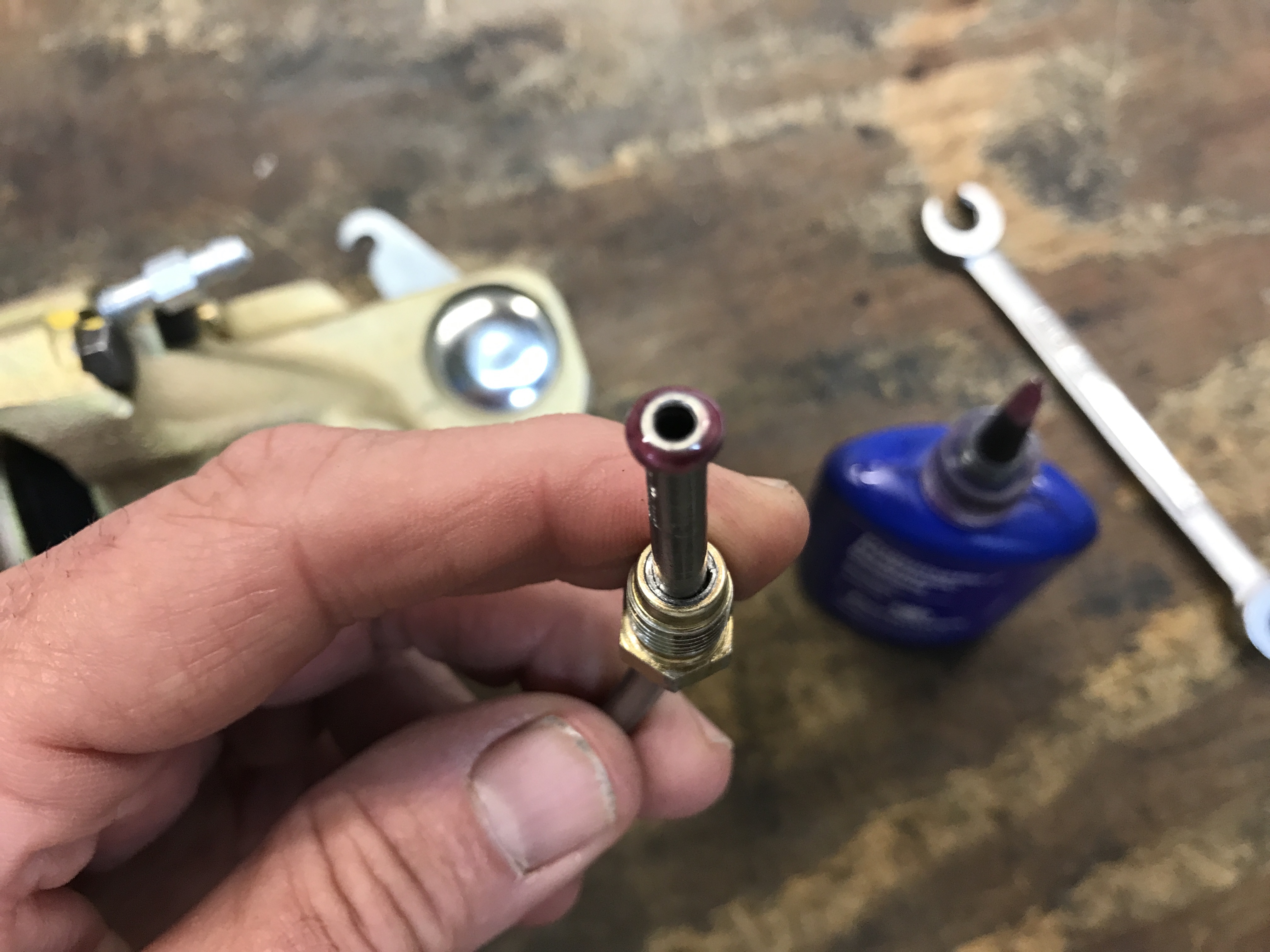

Then a thin ring of sealant on the flare.
bkrantz
post Feb 9 2022, 08:28 PM
Post #4811
Posts: 8,345
Joined: 3-August 19
From: SW Colorado
Member No.: 23,343
And then I REALLY tightened the hard line fitting.

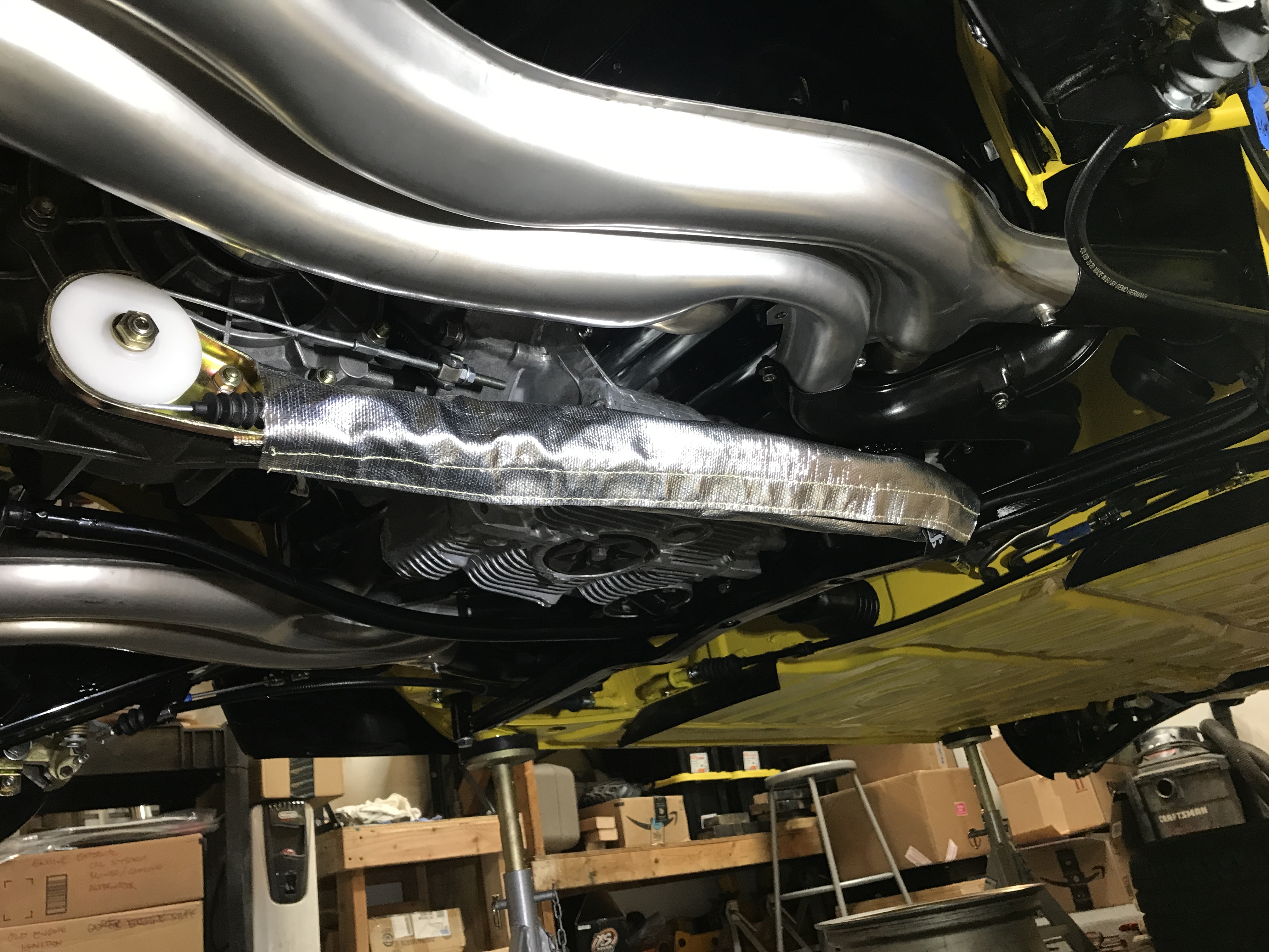

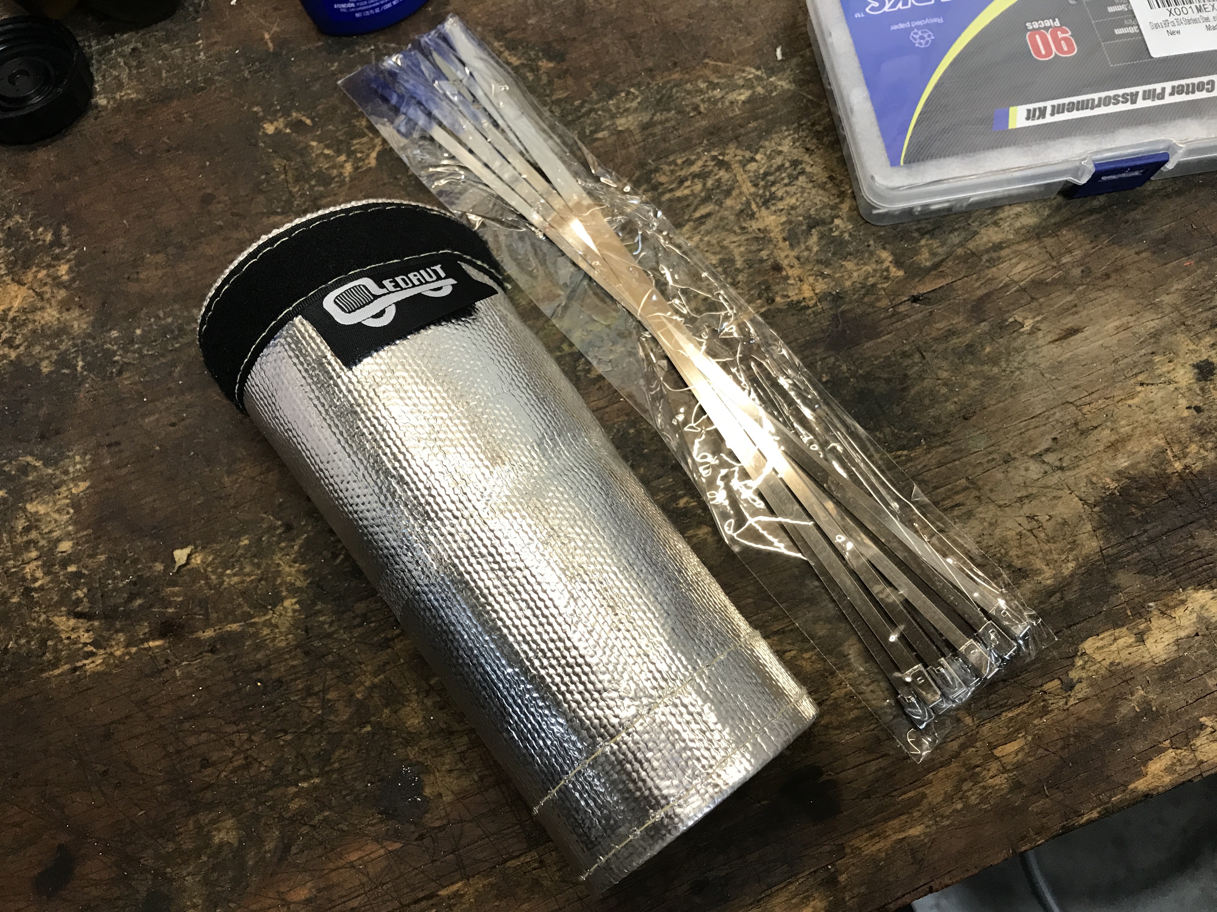

One more thing delivered: some more hi-temp wrap, nominally for 2 inch ID.
bkrantz
post Feb 9 2022, 08:32 PM
Post #4813
Posts: 8,345
Joined: 3-August 19
From: SW Colorado
Member No.: 23,343
I used a length for the bundle of cables under the engine, including clutch cable, speedo cable, and O2 sensor cable. Mostly I am worried about the O2 cable plastic plug that sits under the right cylinders. Probably being paranoid, but at least its shiny.

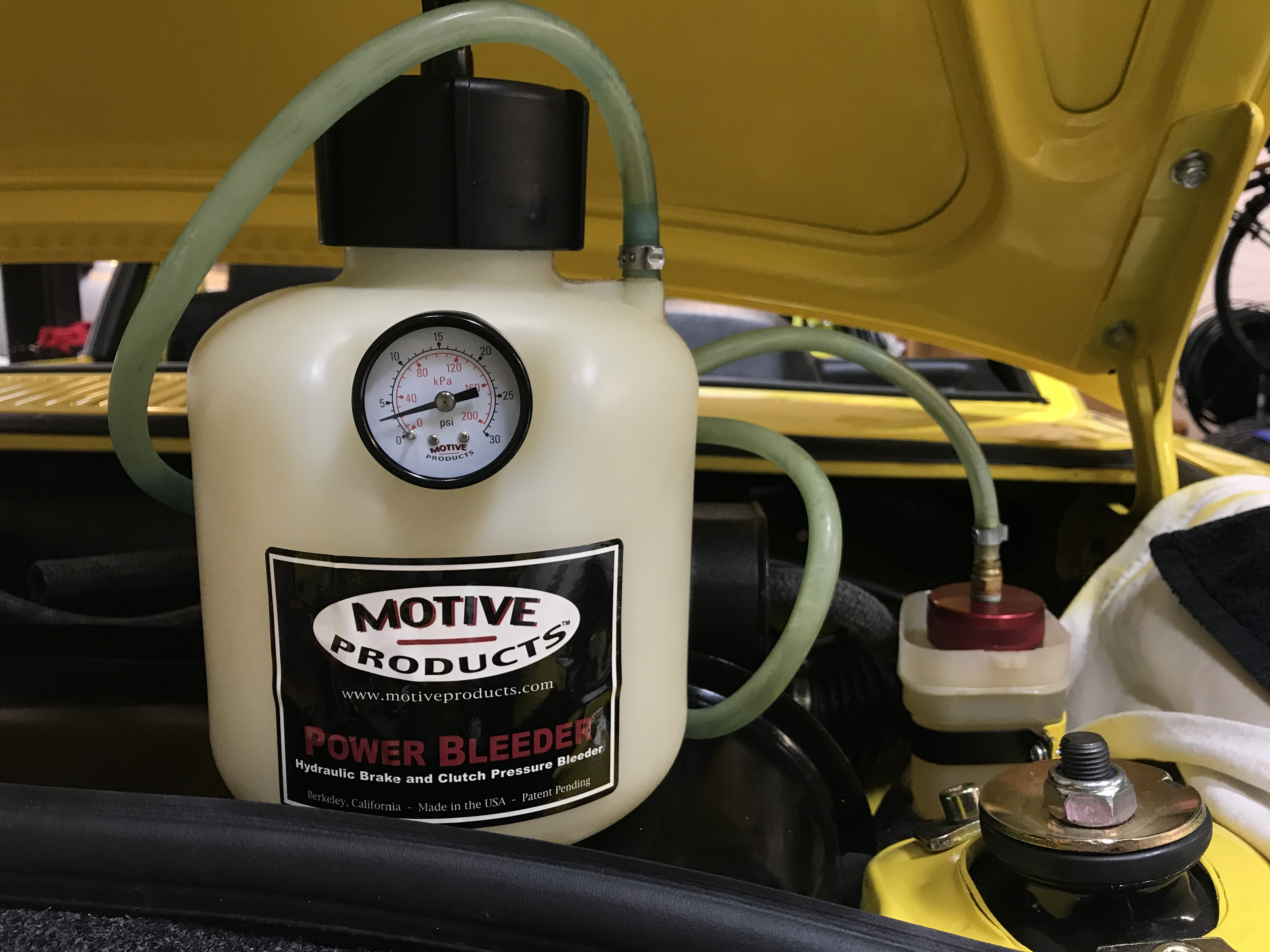

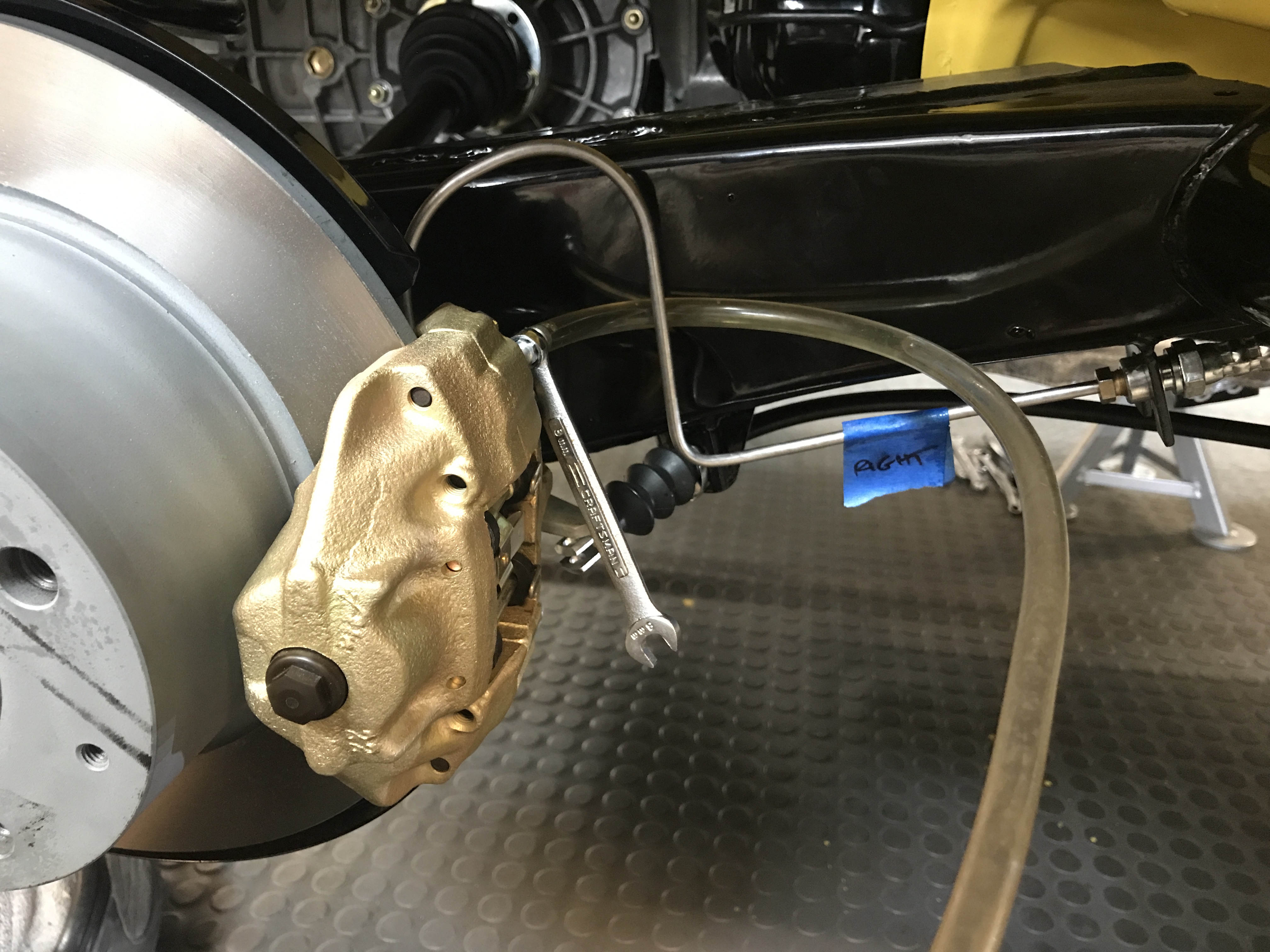

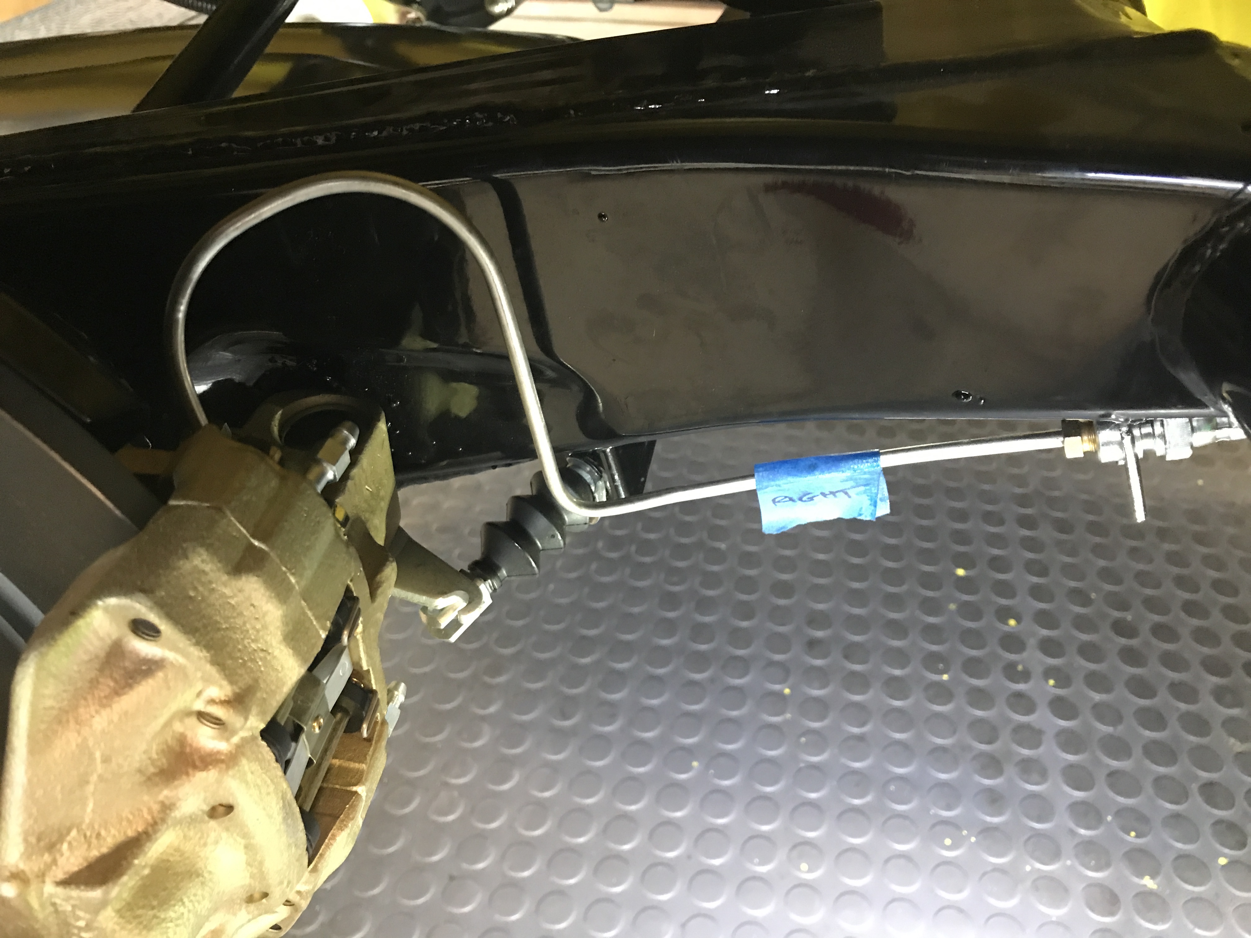

I connected the rear caliper lines, and then tightened all the other connections I did not get to yesterday.
bkrantz
post Feb 10 2022, 09:10 PM
Post #4815
Posts: 8,345
Joined: 3-August 19
From: SW Colorado
Member No.: 23,343
I then did a quick bleed, to make sure I have fluid throughout the system. No leaks yet.
bkrantz
post Feb 10 2022, 09:11 PM
Post #4816
Posts: 8,345
Joined: 3-August 19
From: SW Colorado
Member No.: 23,343
I then left the system pressurized to about 20 psi. It will sit overnight.

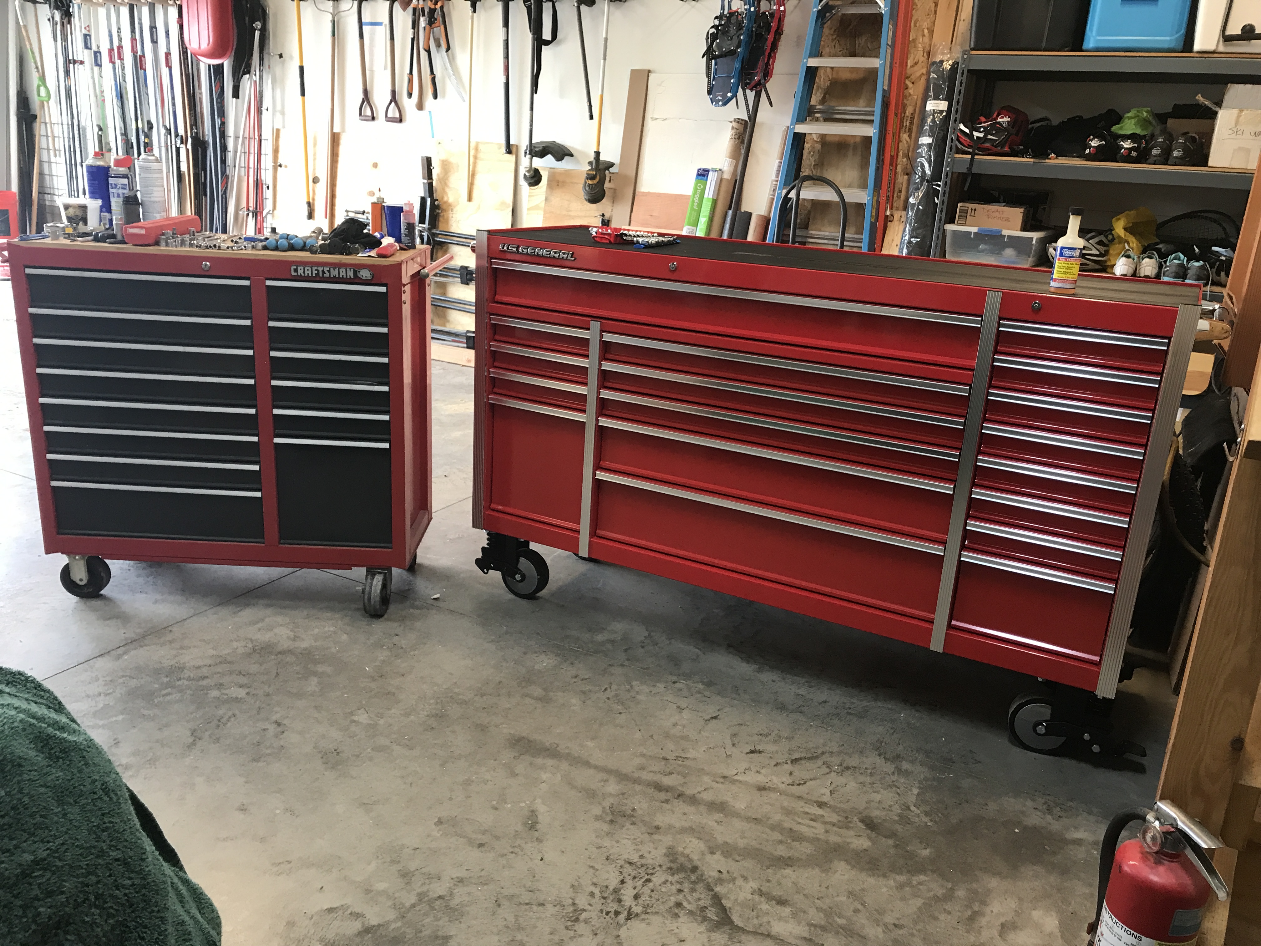

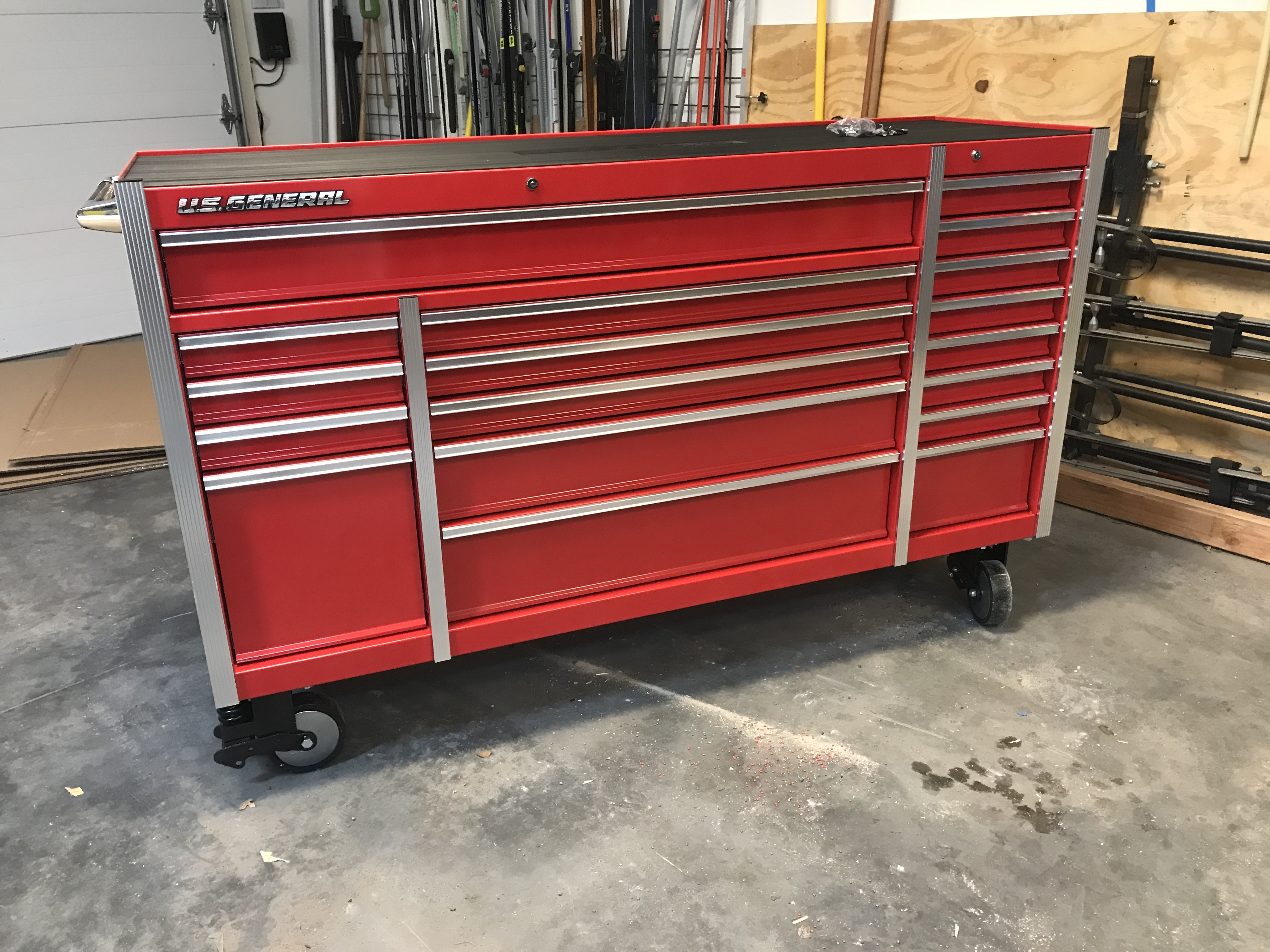

From: SW Colorado
Member No.: 23,343
I splurged on a new tool cart, from Harbor Freight. I looked at quite a few, online and in person, and this seems to be the best value.
bkrantz
post Feb 10 2022, 09:17 PM
Post #4819
Posts: 8,345
Joined: 3-August 19
From: SW Colorado
Member No.: 23,343
The new cart is 72" long and 22" deep. I have twice as much space as in my old cart, plus drawers that are more than long enough for big tools.

QUOTE(bkrantz @ Feb 10 2022, 07:12 PM) *
A rather big thing got delivered today (the box, no the bike).
Nice Schwinn.
Oh...the tool box. Yeah, nice.
