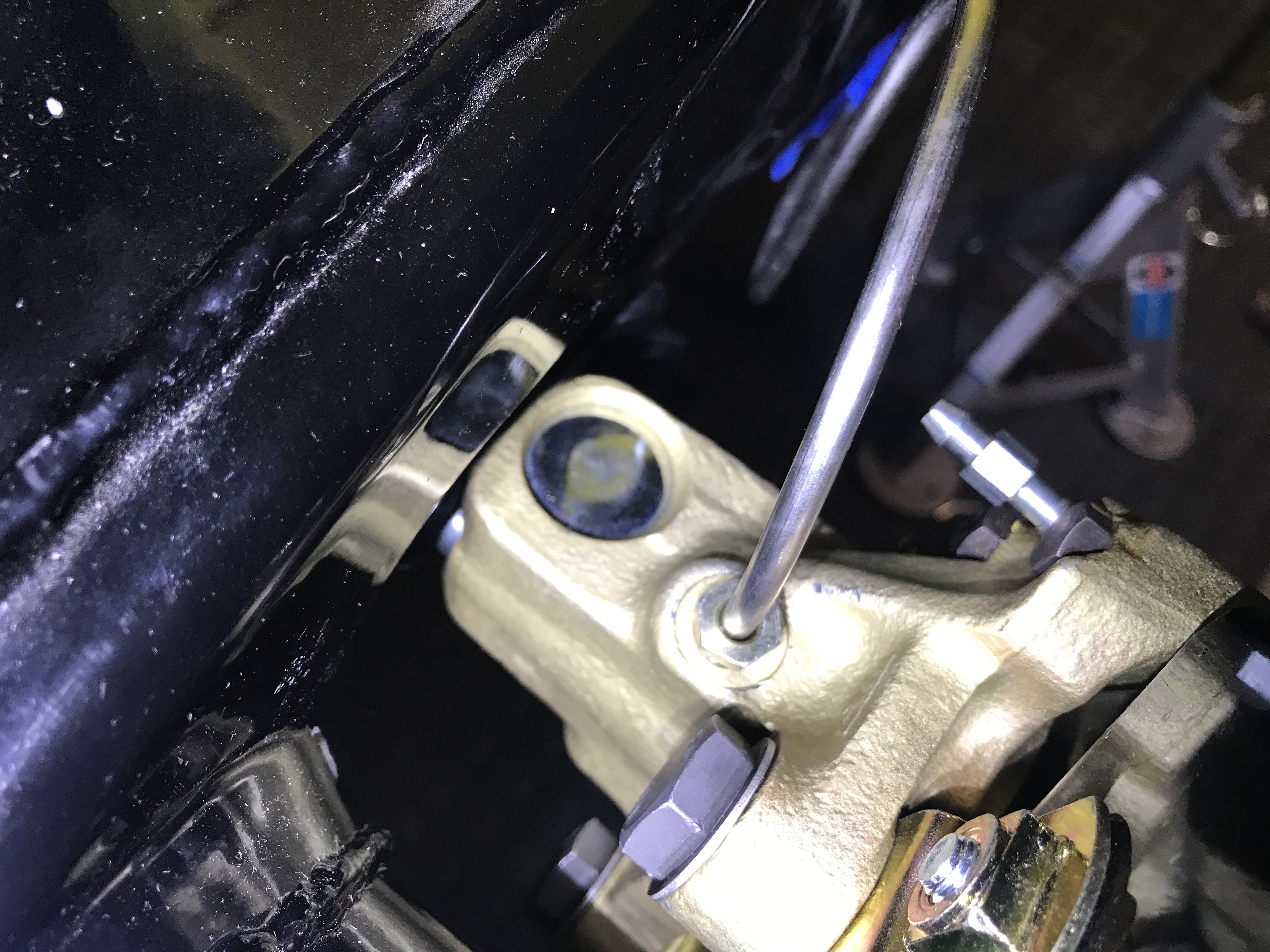

Brake check! The pressure held overnight, a good sign.

Even better, no leaks, even at the troublesome right rear caliper.

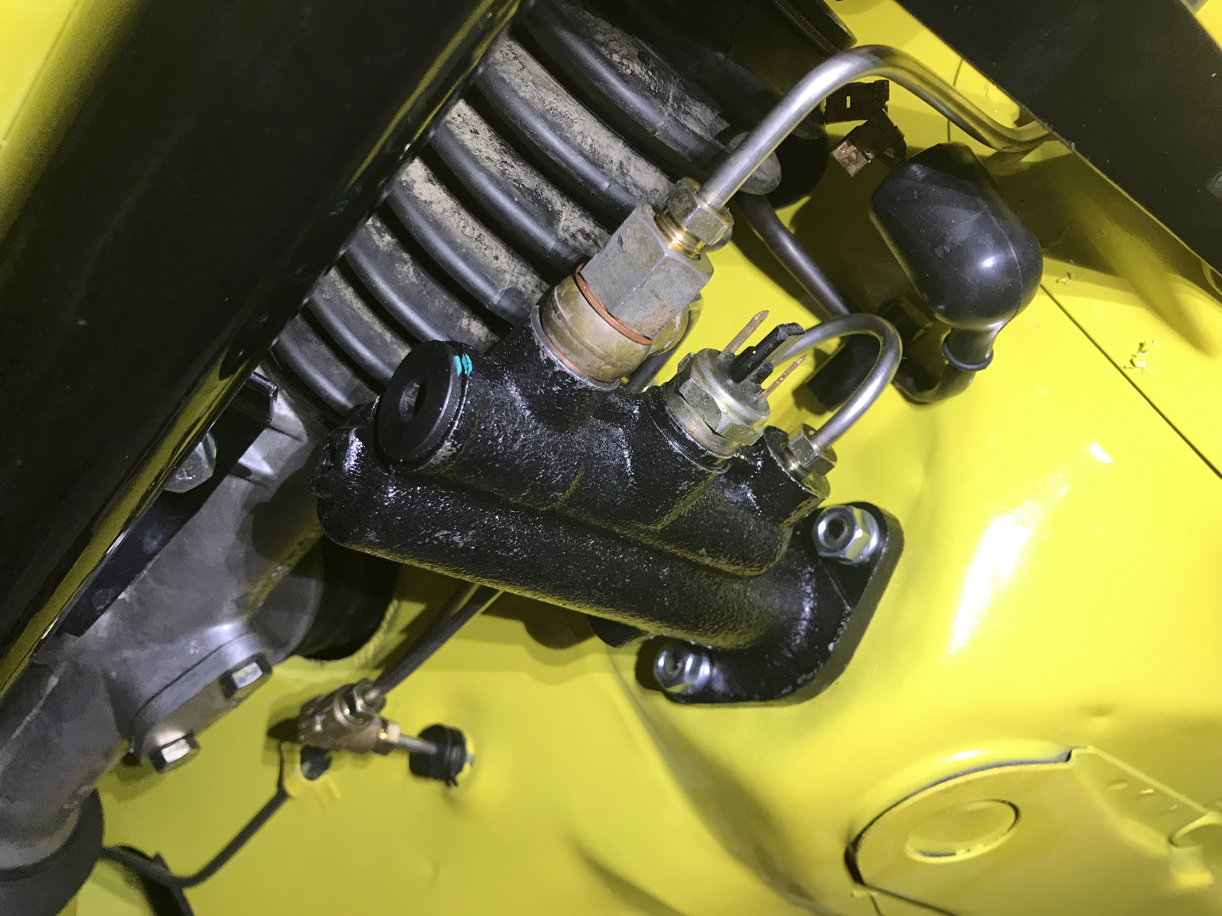

Master cylinder fittings also dry. Yeah!!! (IMG:style_emoticons/default/cheer.gif)
I feel like I have been high-centered trying to get the brake system sealed up.

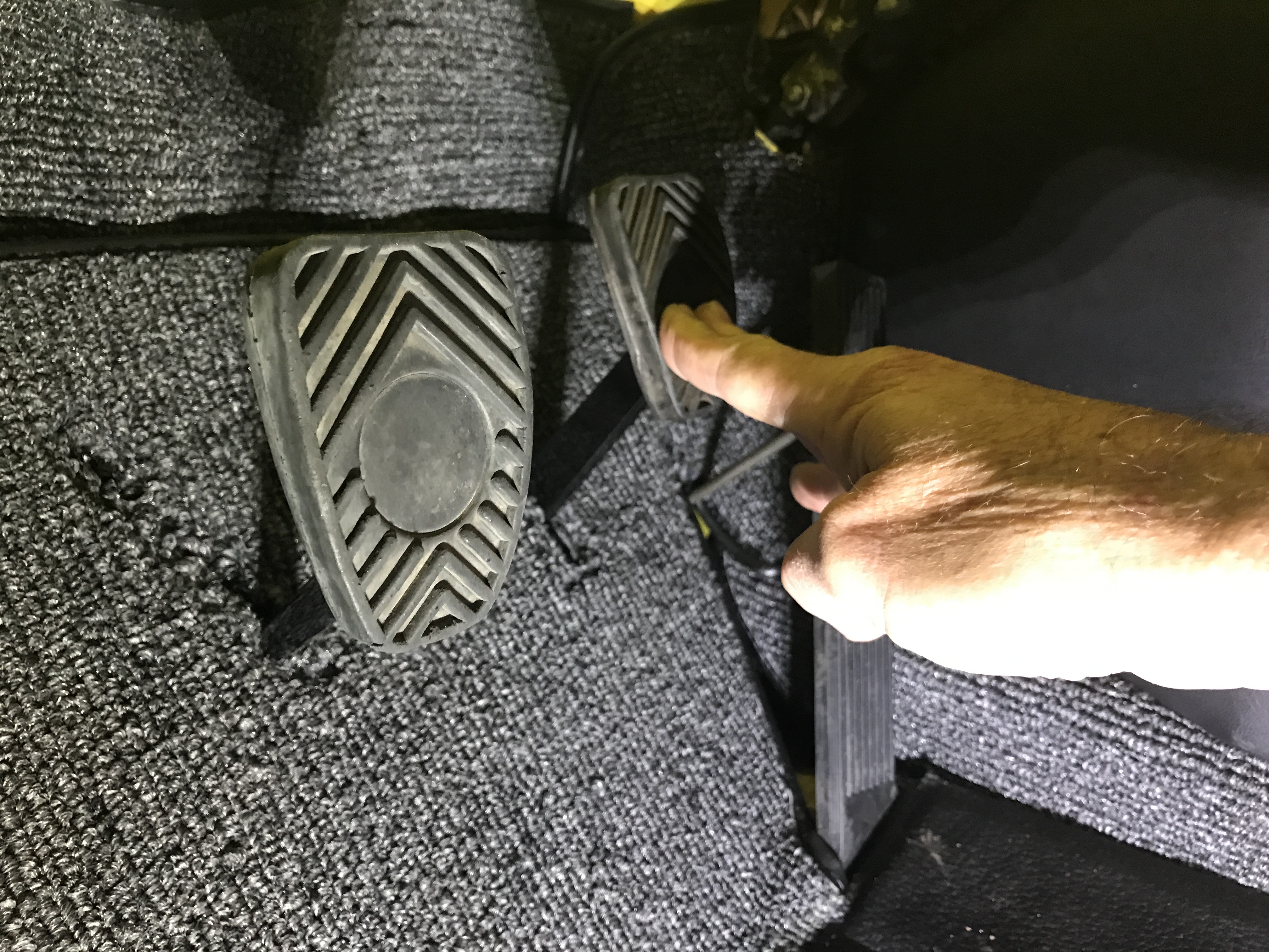

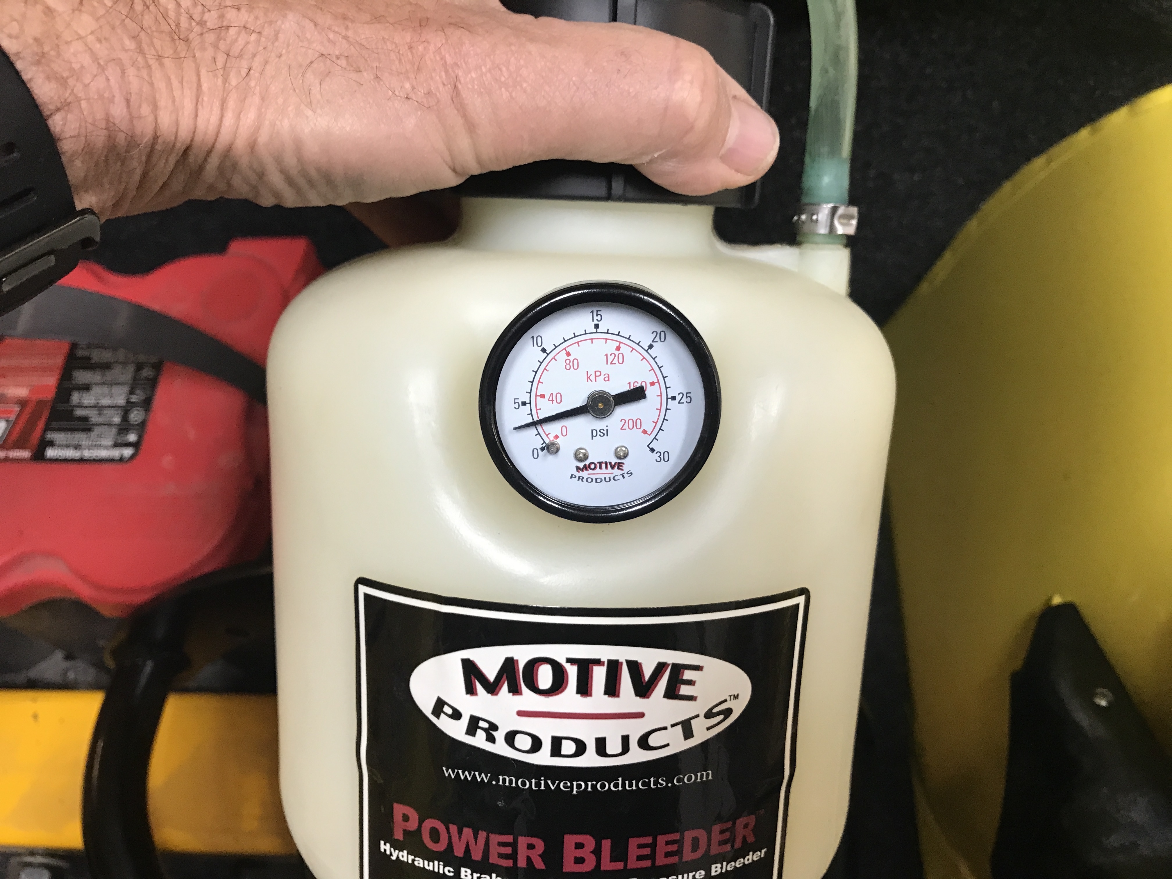

Then I finally got back to starting to bleed the system. I used the pressure bottle to bleed all four corners twice, with lots of tapping of components and a few pumps of the brake pedal. I could hear some action in rear.
After this first effort, the initial pedal is still low (but not "zero").
bkrantz
post Feb 11 2022, 08:44 PM
Post #4829
Posts: 8,345
Joined: 3-August 19
From: SW Colorado
Member No.: 23,343
And the pedal pumps up to normal with about 3 or 4 strokes. I think this is a good start.

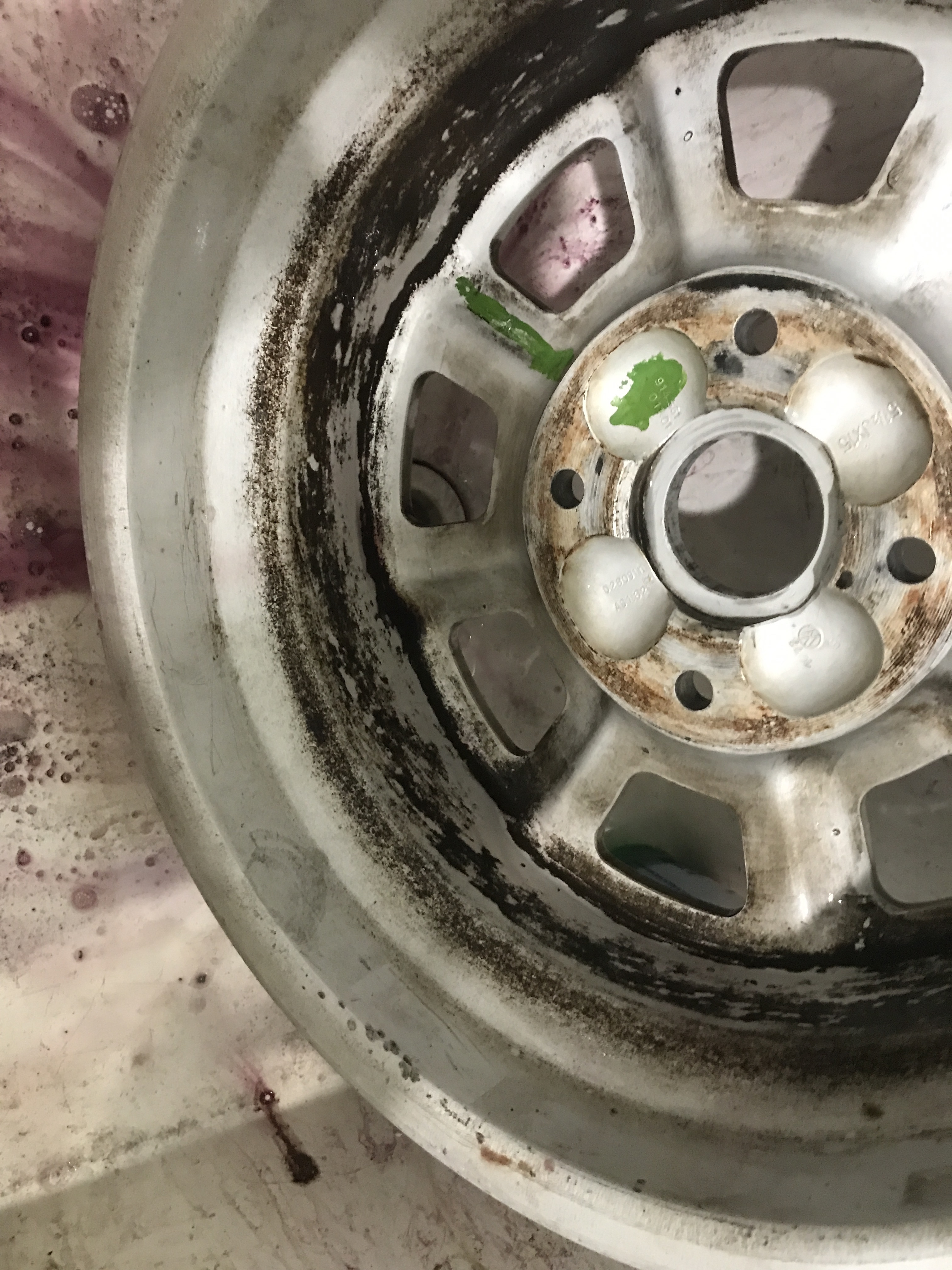

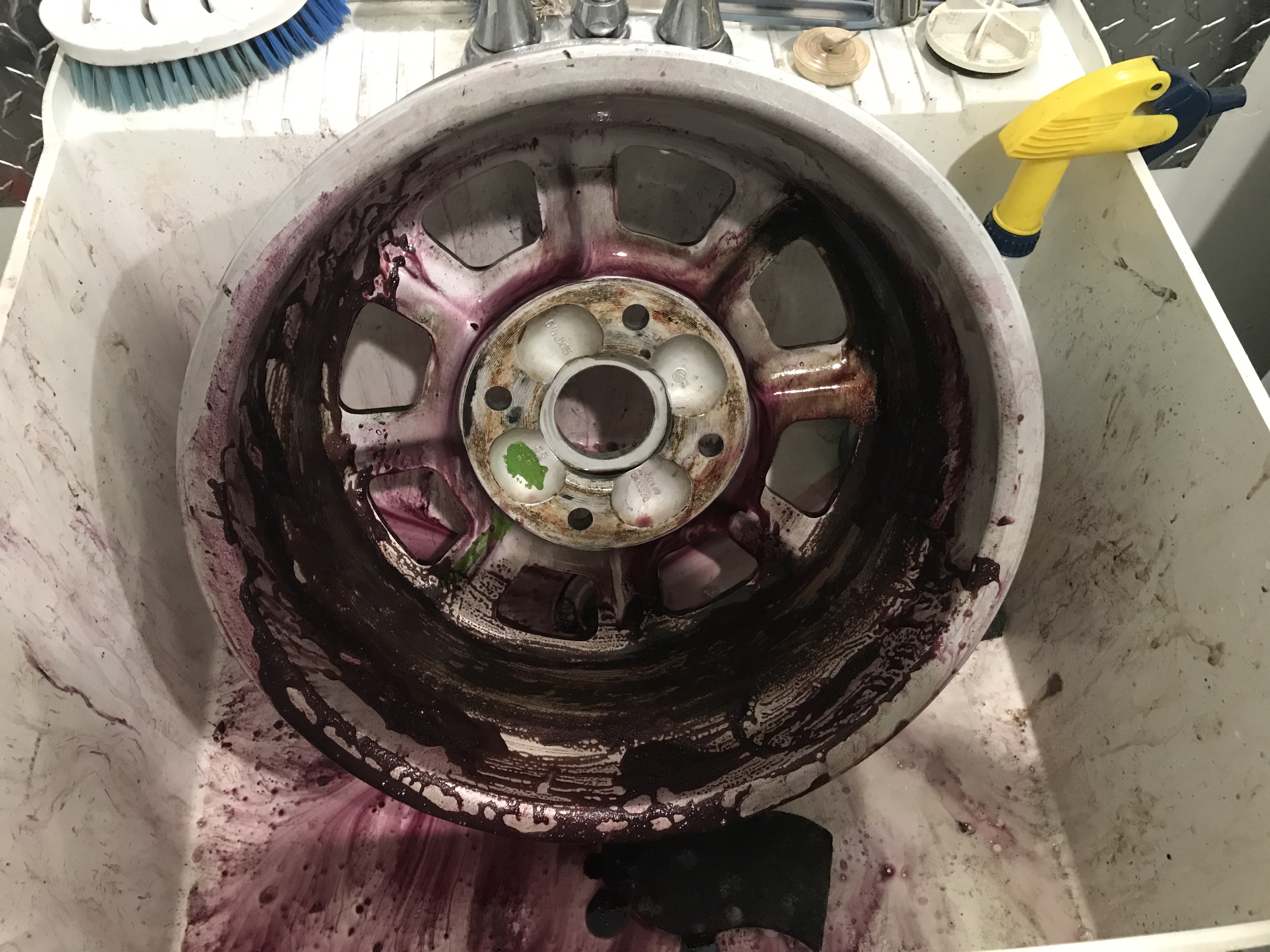

I went back to the wheel that I started with the bit of Iron-X I had on my shelf. Lots of purple means lots of iron crud getting dissolved.

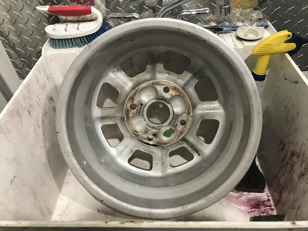

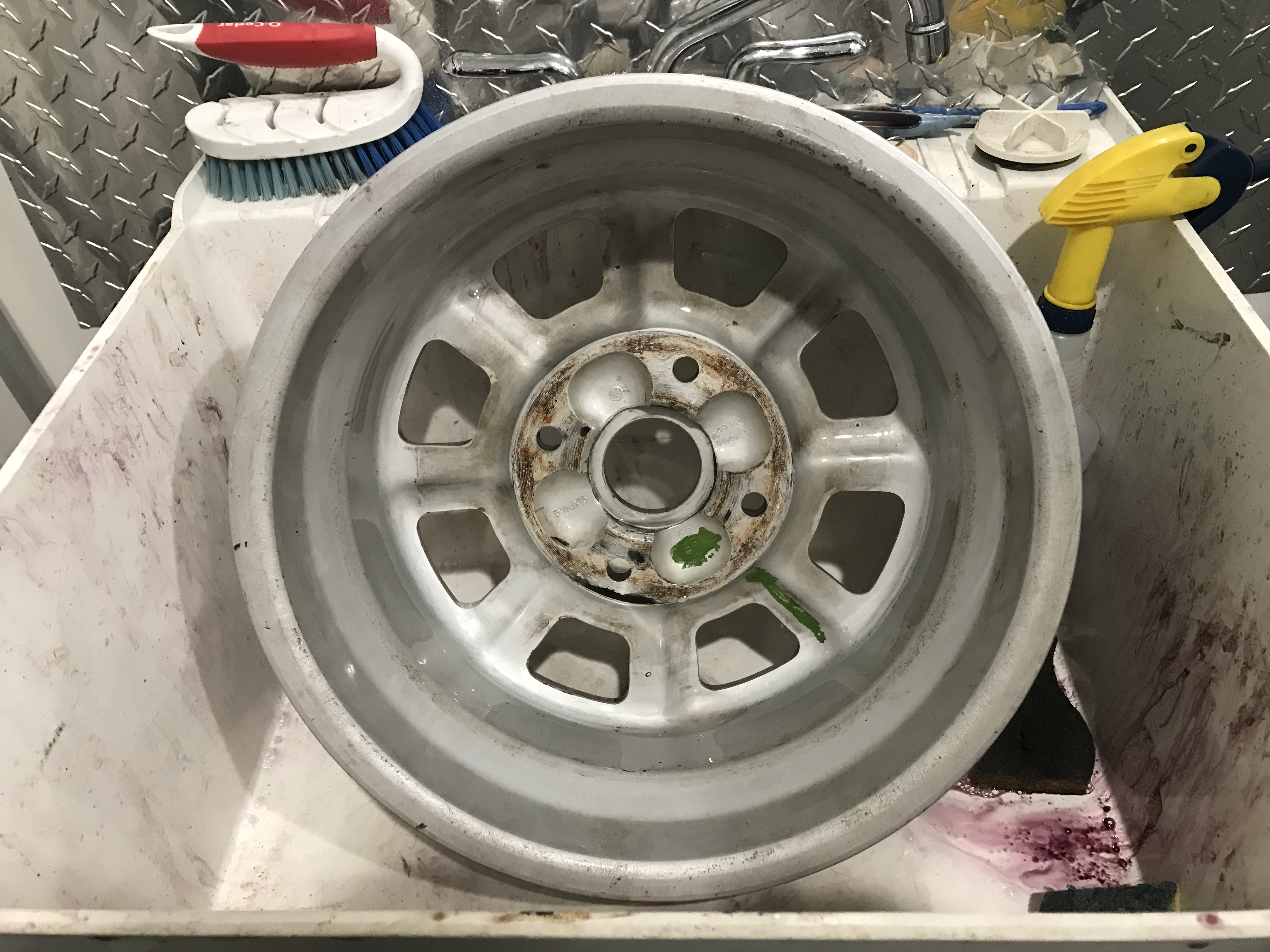

Halfway there. This new batch is still smelly, and works perhaps a bit better.

After about an hour of treating, soaking, scrubbing, and rinsing--done! Just one more wheel to go.

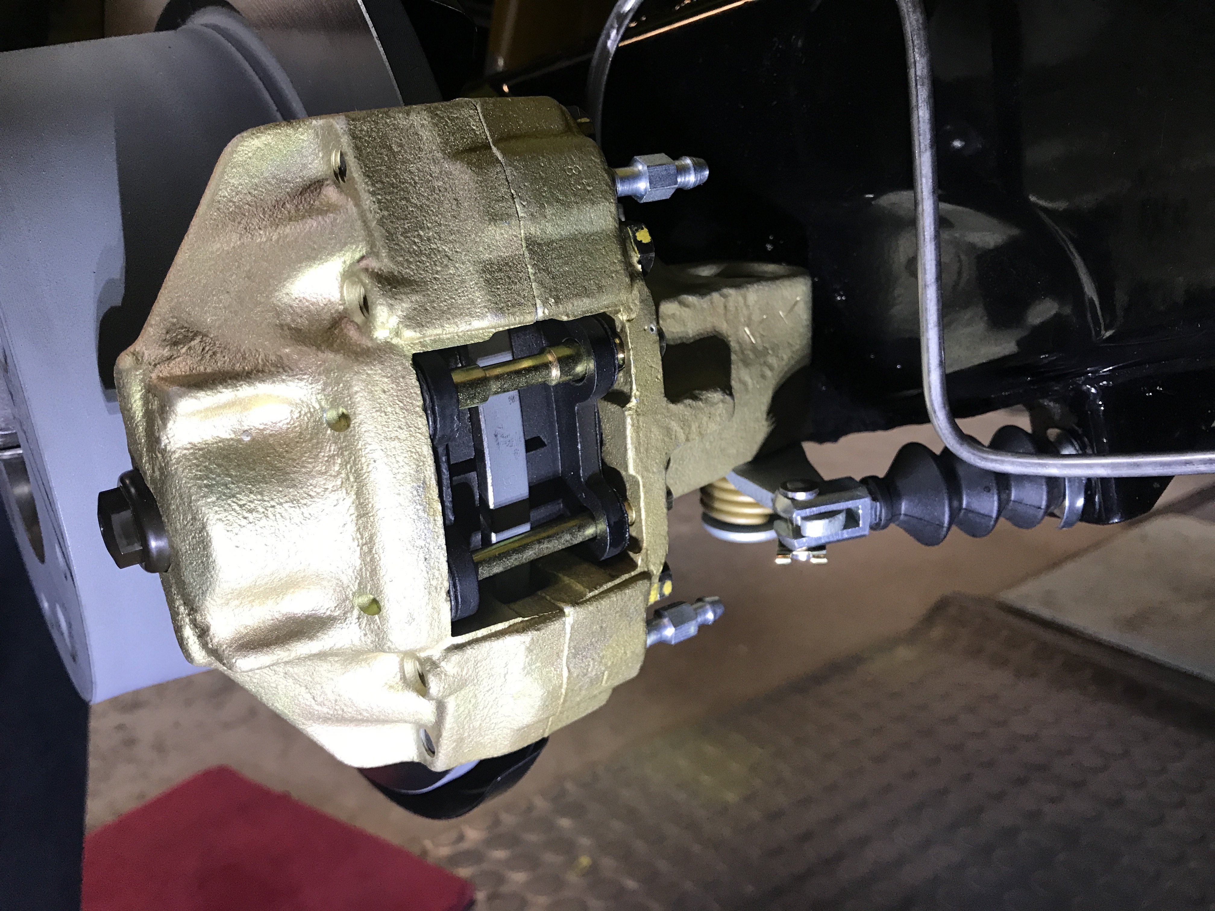

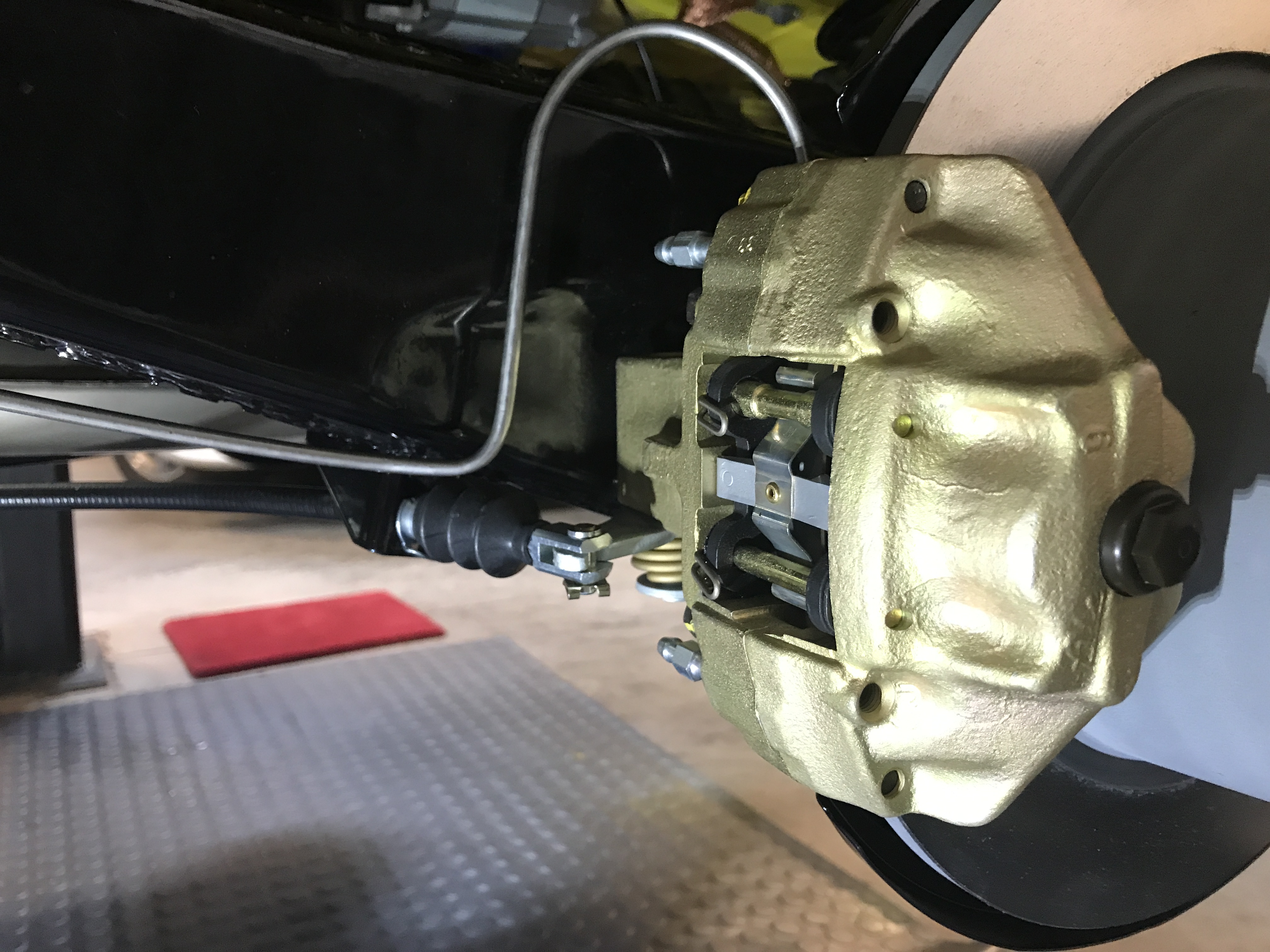

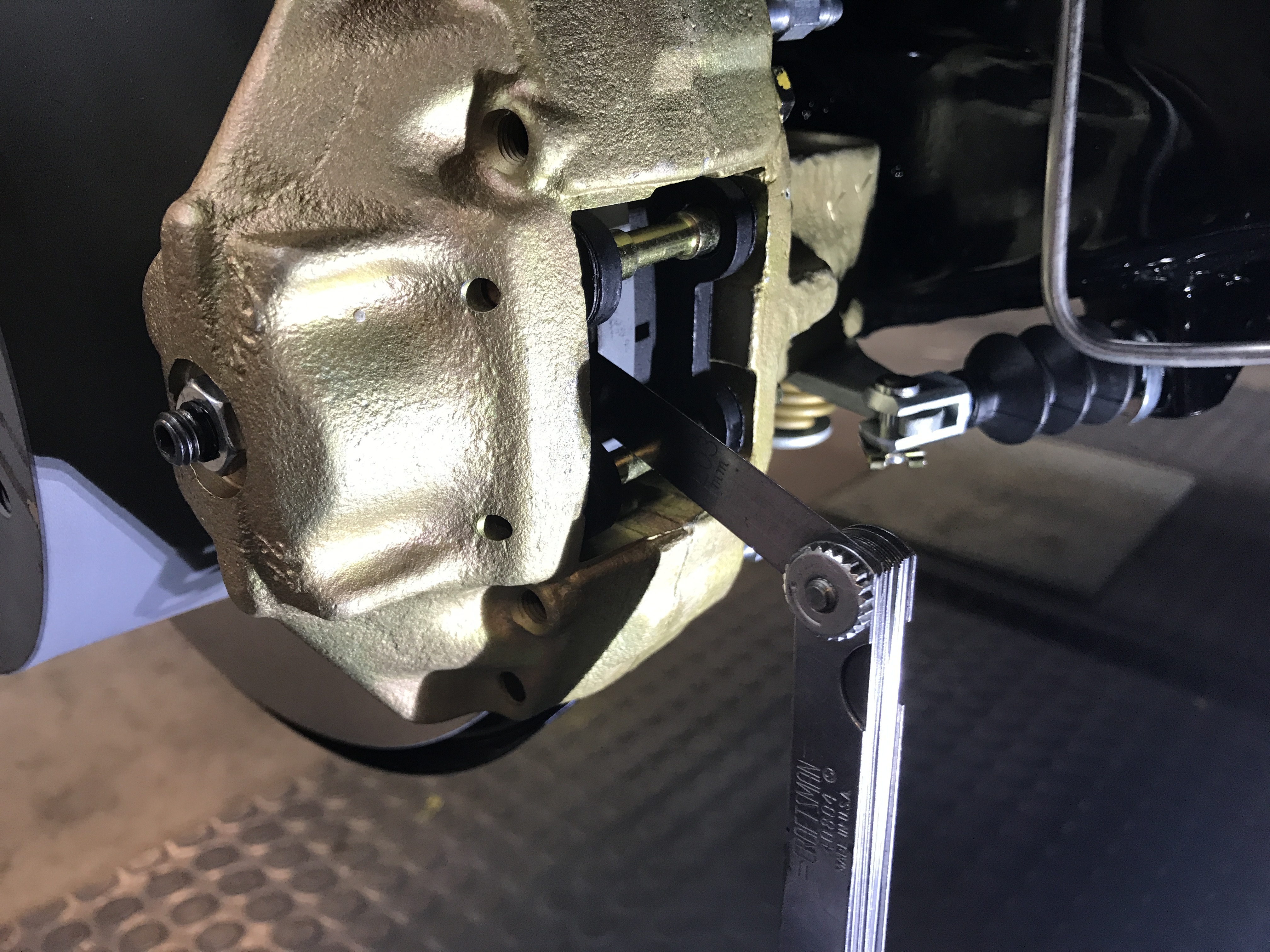

I did another round of brake system bleeding, and have a firmer pedal. I also adjusted the rear caliper pad clearance.
First, I removed the pad spreader spring.

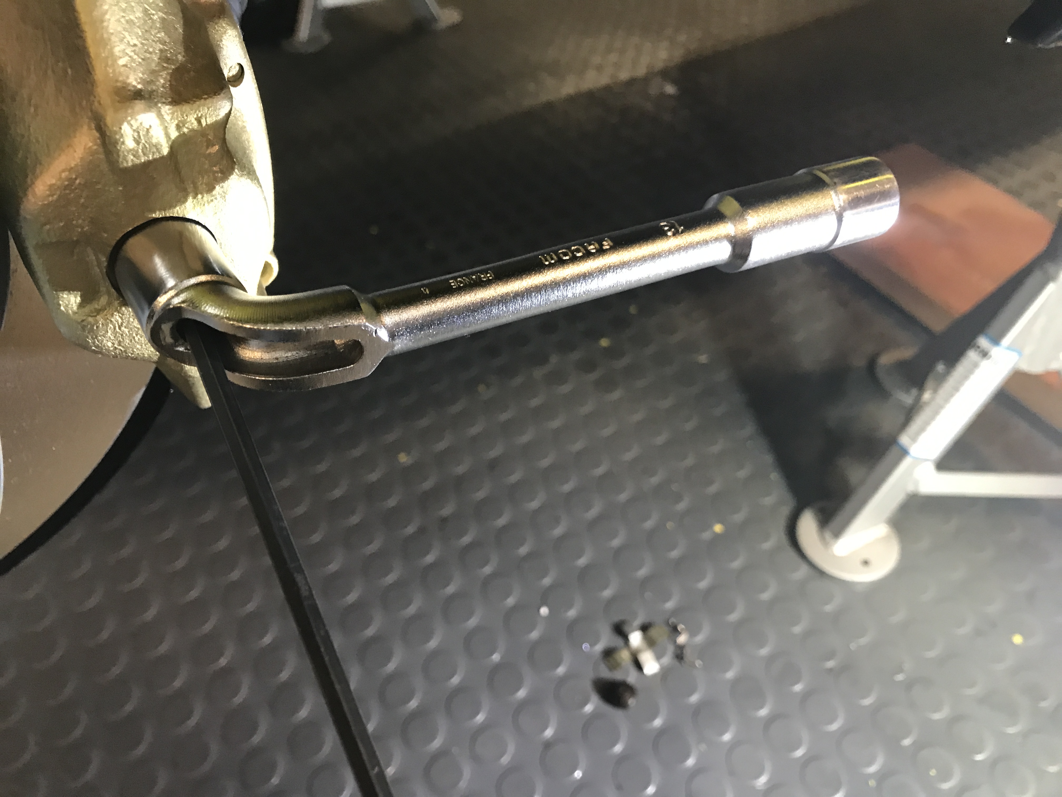

For the outer adjuster, I have the perfect wrench: a Facom socket wrench. This has an open end to allow the Allen wrench through.

Clearance set. I used .008" for the initial running. Once everything is settled, I will try for .004"
bkrantz

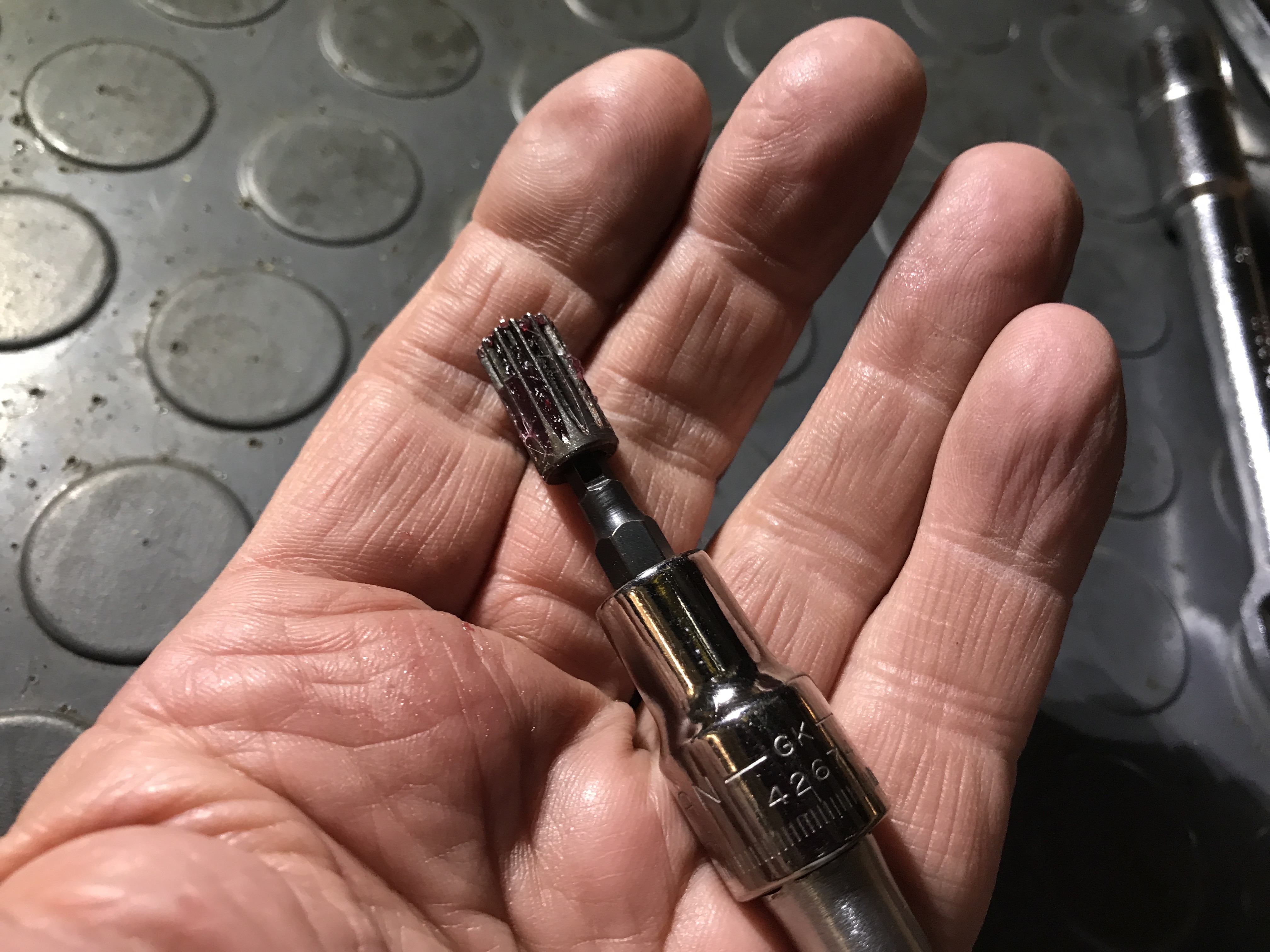

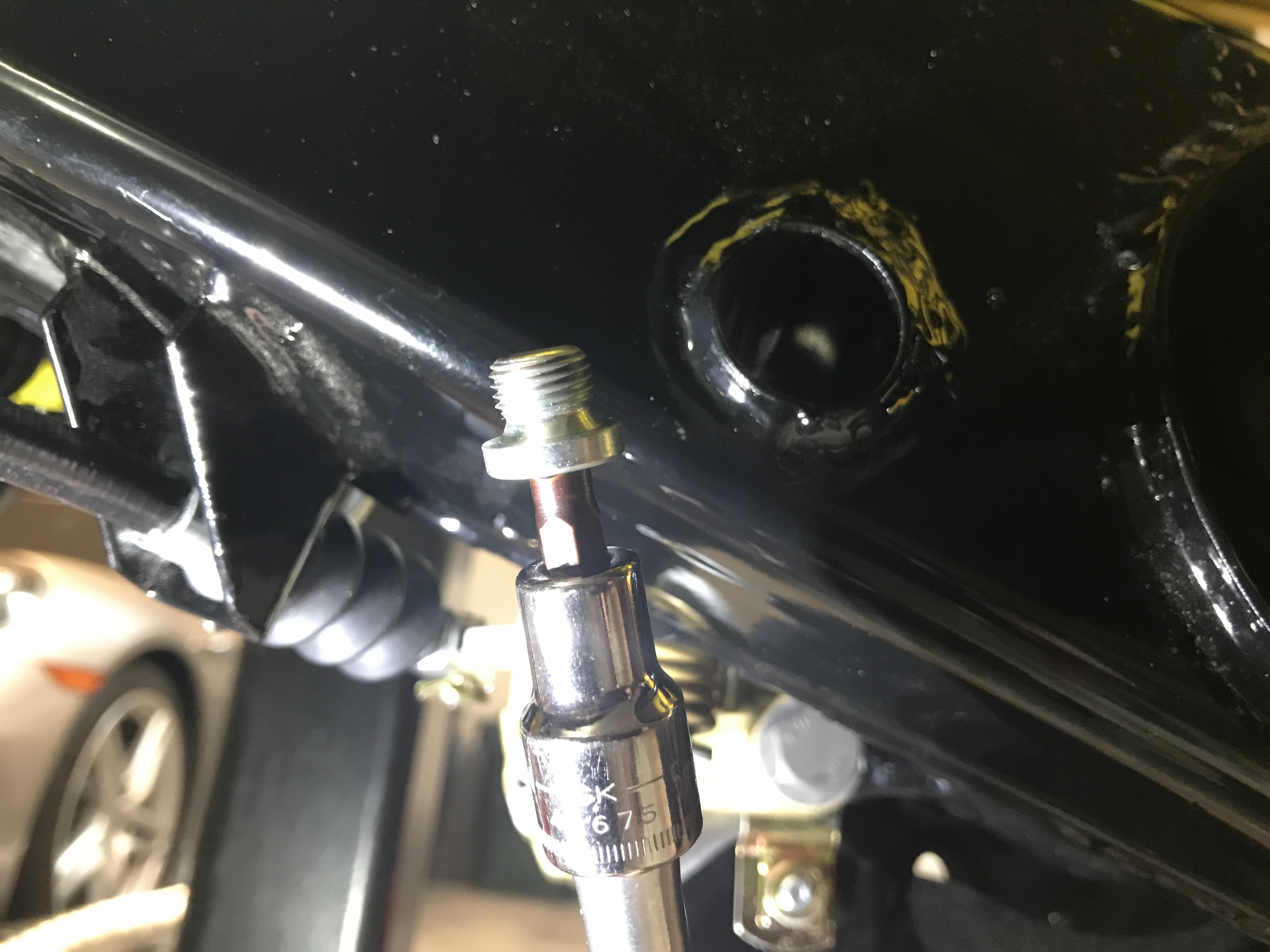

On the inside, I unscrewed the new PMB caps (with 5 mm hex indents).
bkrantz

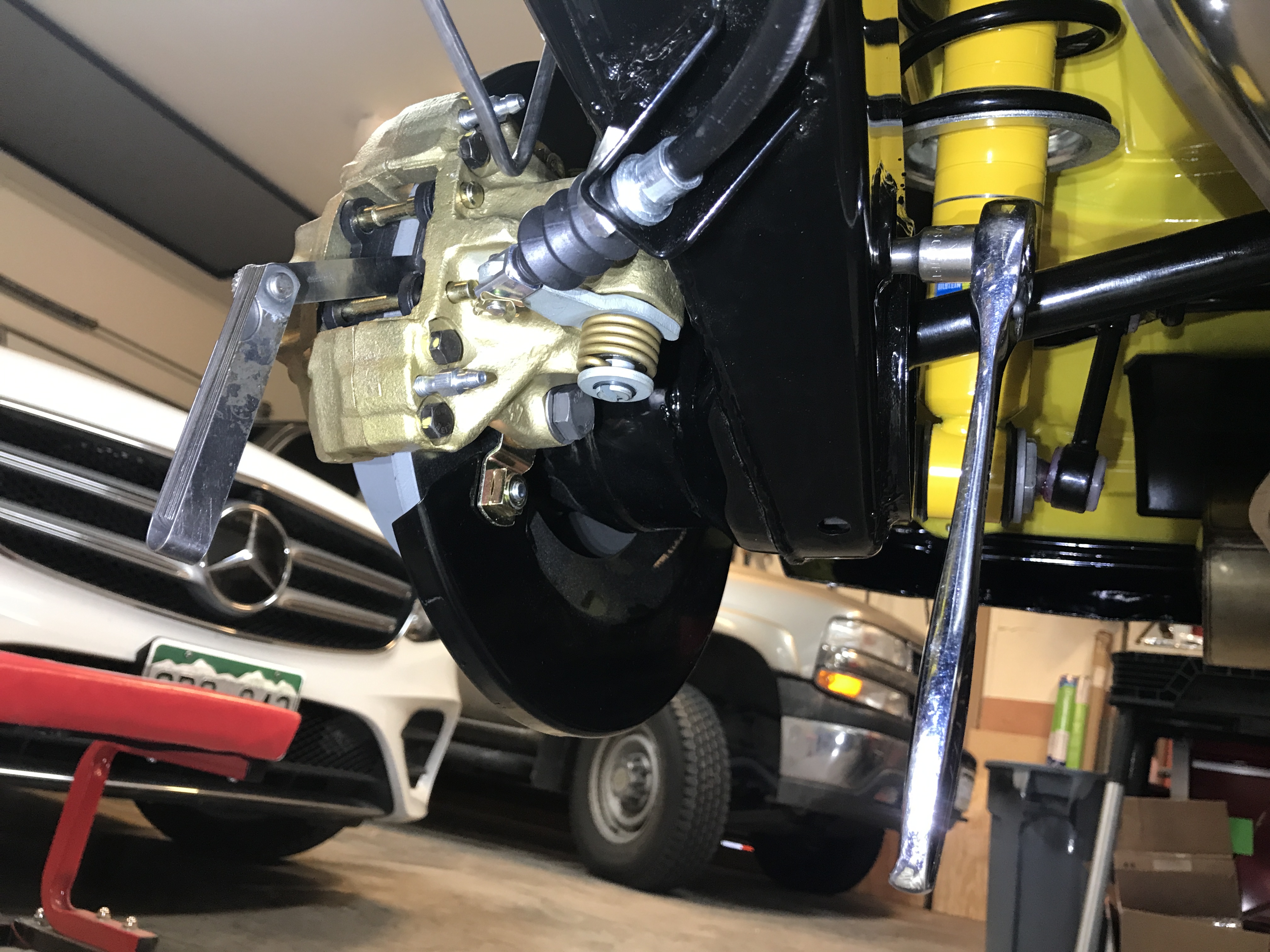

The adjuster on the inside takes a 4 mm Allen wrench.
bkrantz

I adjusted the inside pad also to .008".

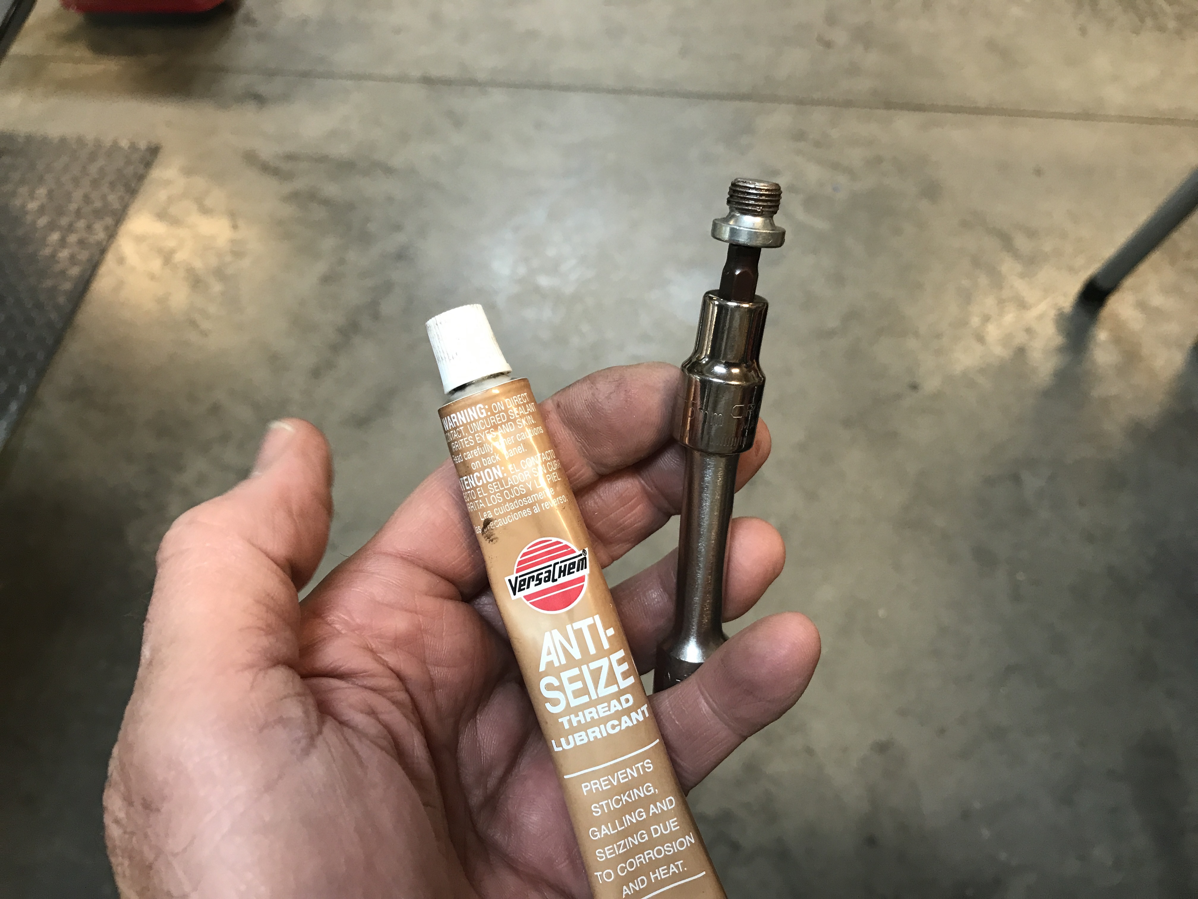

I put a dab of anti-seize on the cap before installing.
