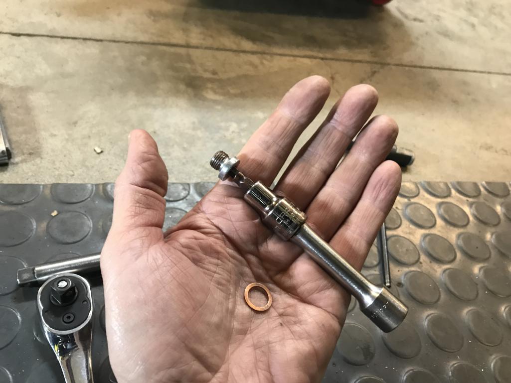

Don't forget the copper ring gasket.

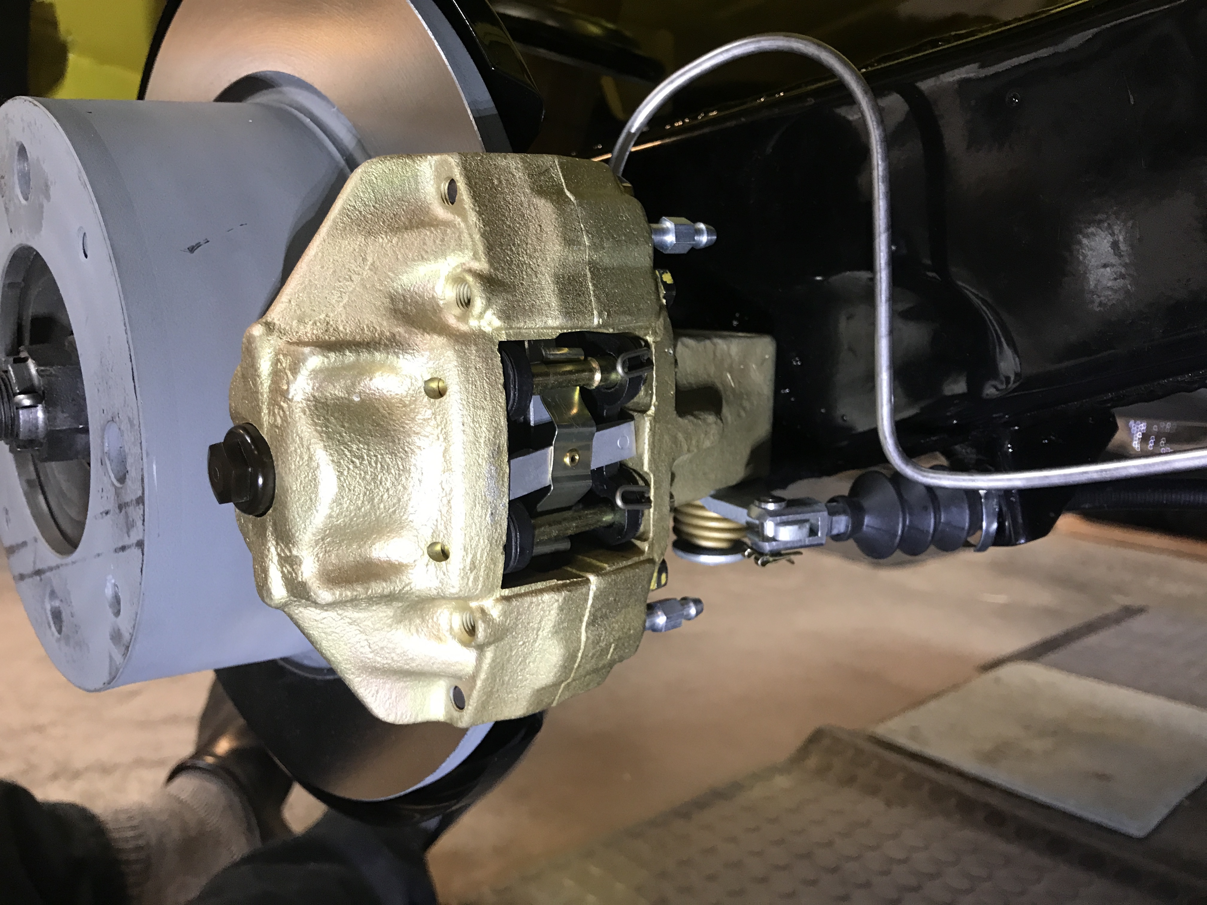

I put all the spring hardware back in.
Oops! Its not straight!!! (IMG:style_emoticons/default/headbang.gif)

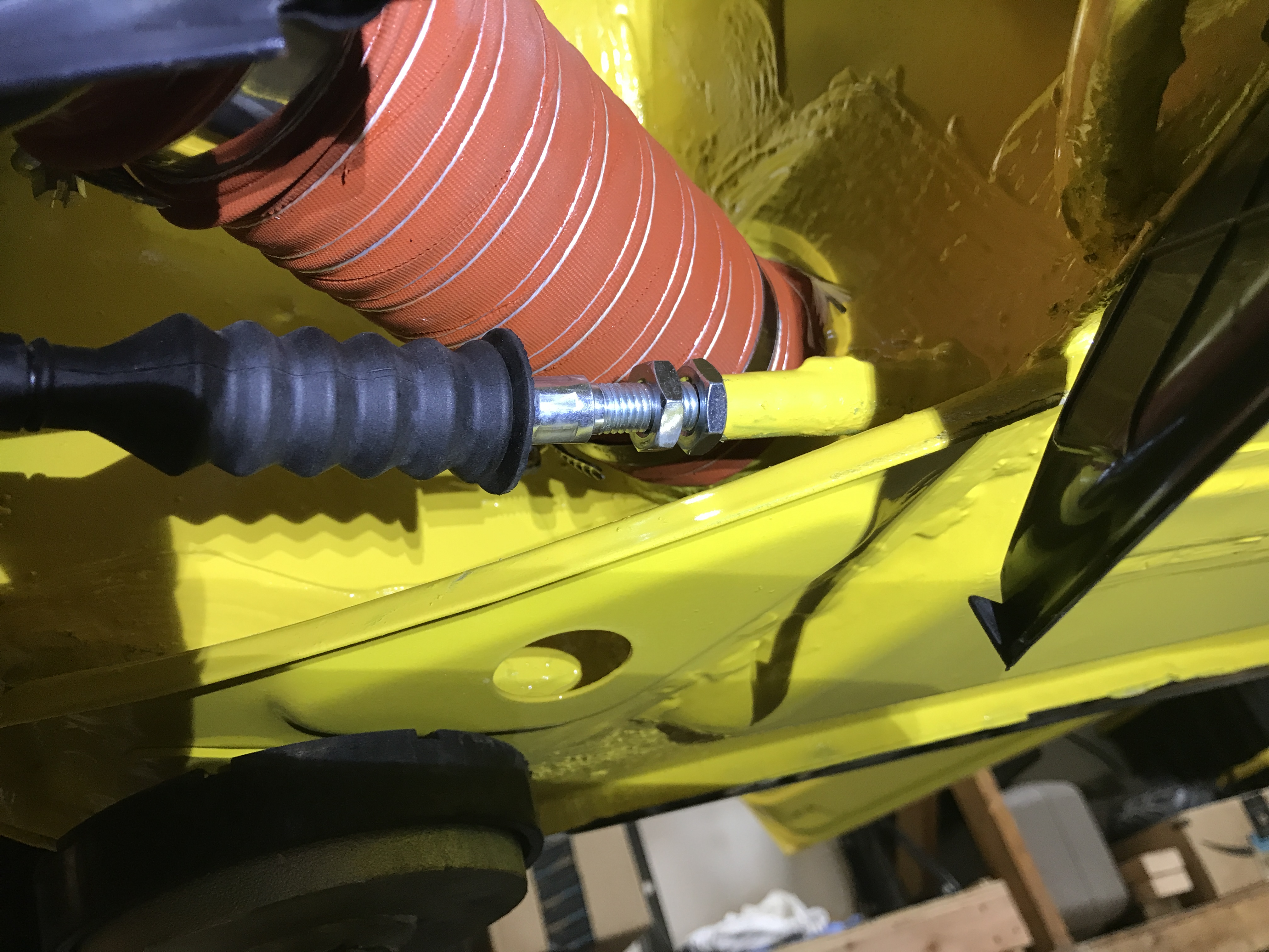

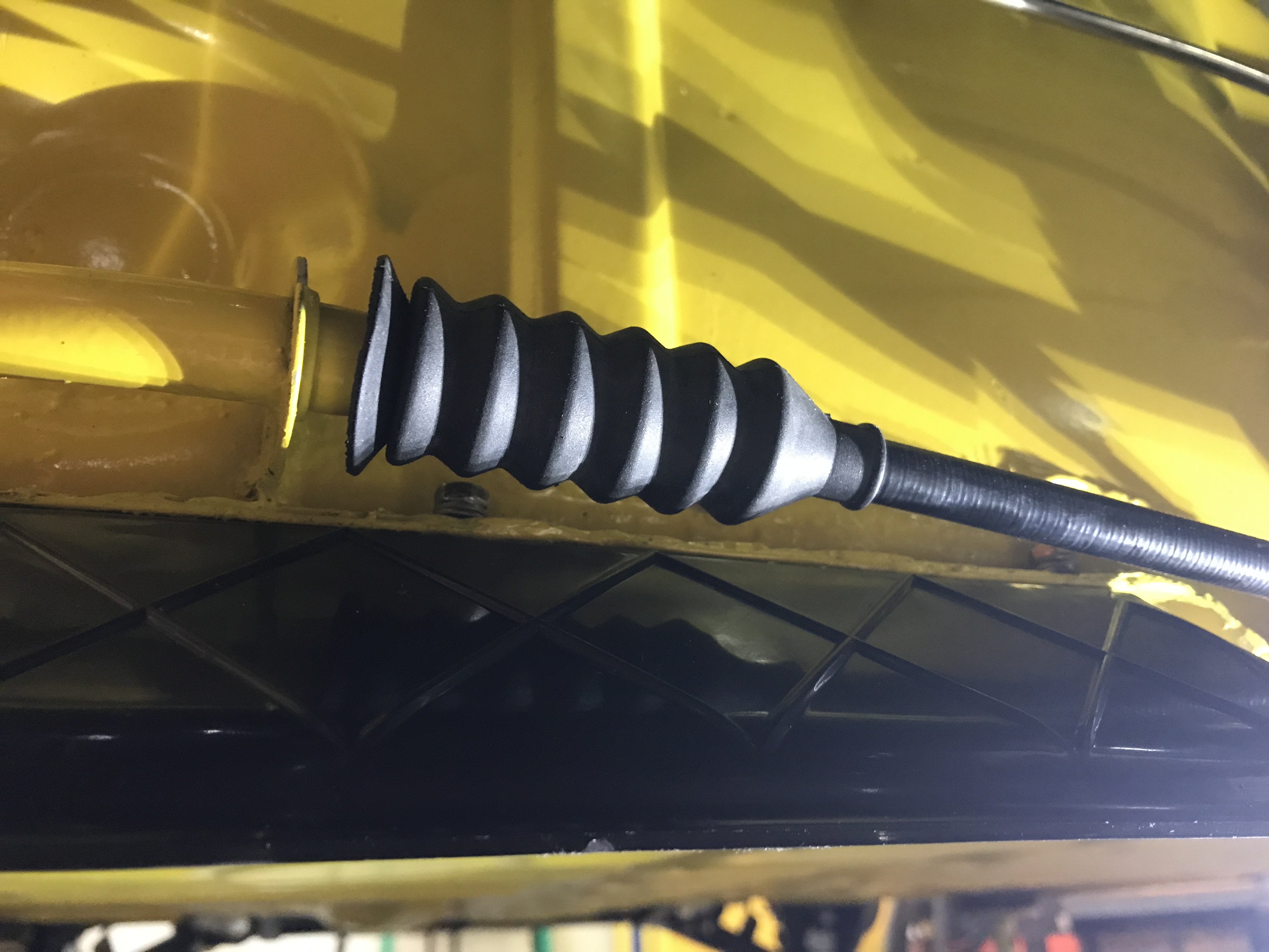

While I was under the car, I also adjusted the parking brake cables.
bkrantz
post Feb 12 2022, 09:08 PM
Post #4844
Posts: 8,345
Joined: 3-August 19
From: SW Colorado
Member No.: 23,343
And then pulled the rubber boots over the nuts.

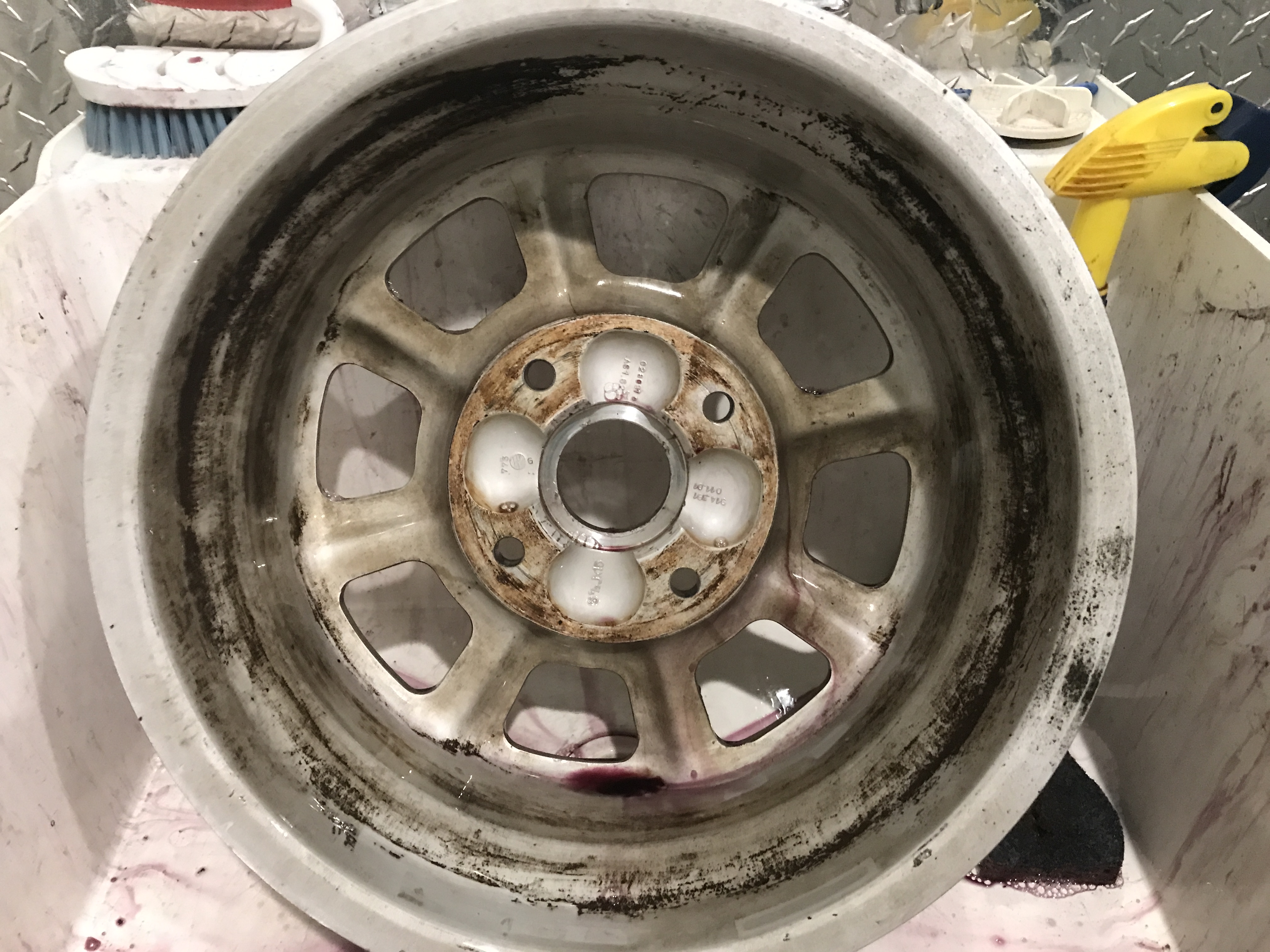

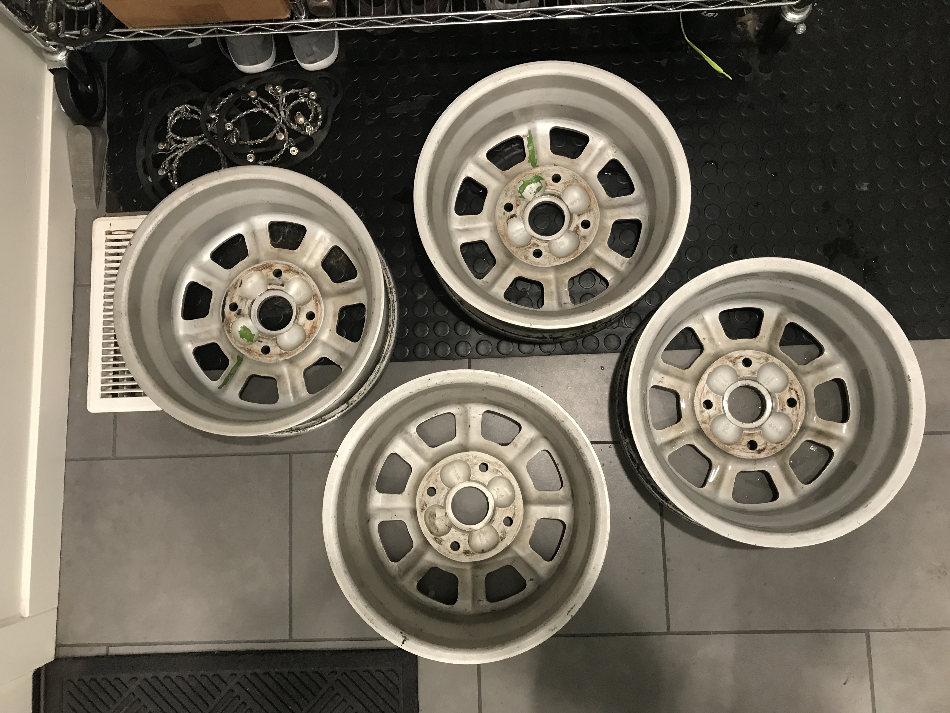

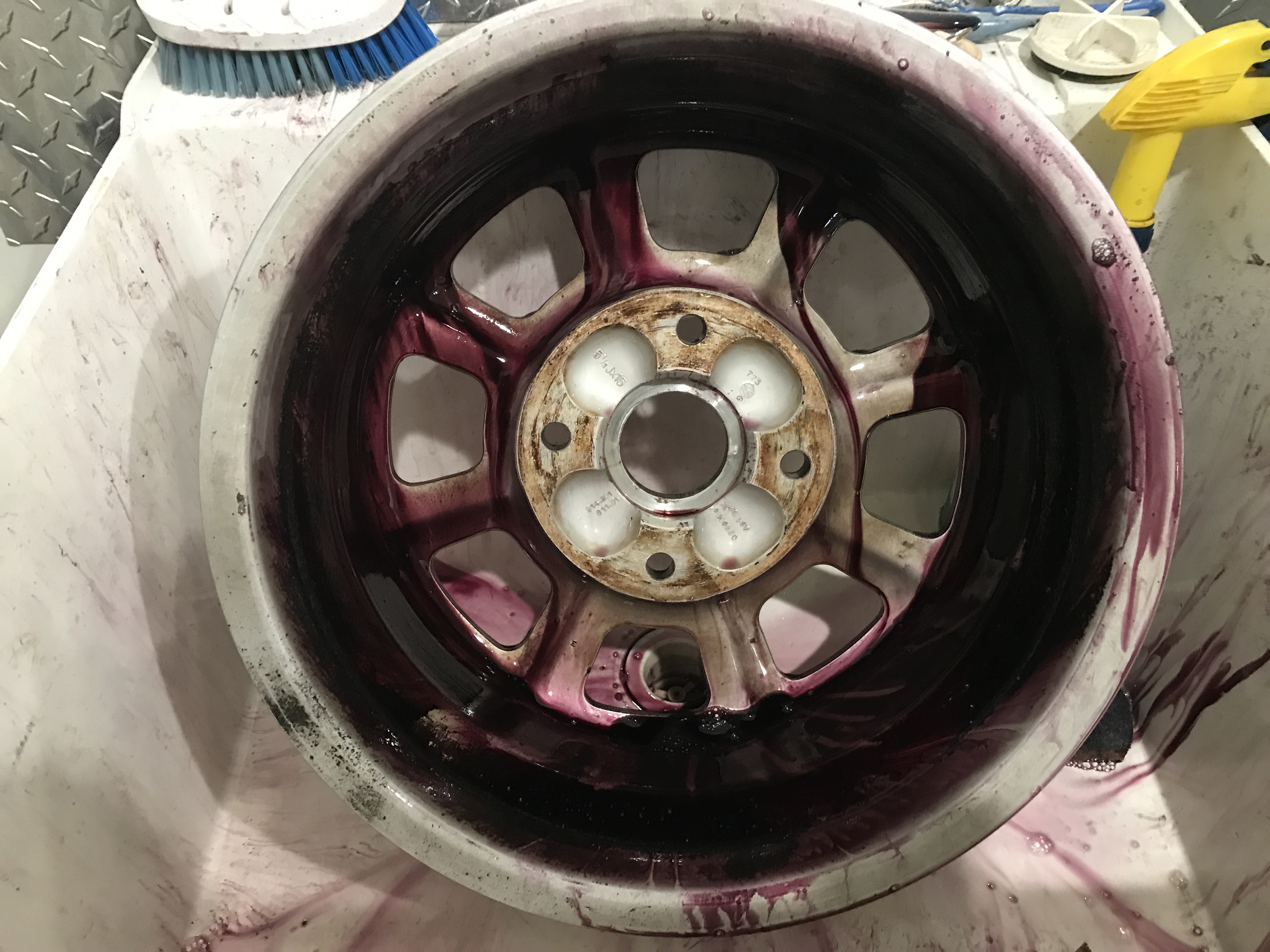

Then onto the last wheel. Like the last one, this had a pretty solid coating of brake crud.
The first application of Iron-X made a big purple mess.

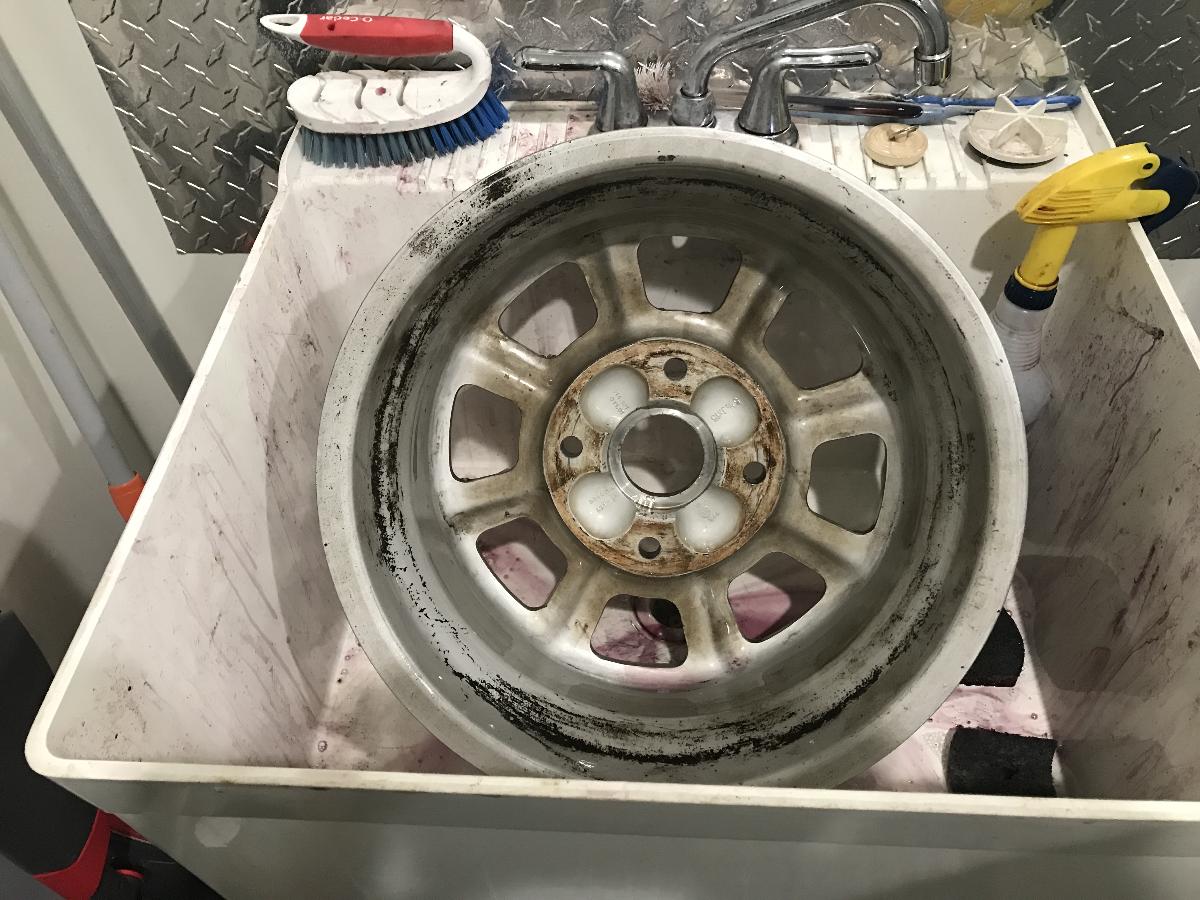

bkrantz
post Feb 12 2022, 09:13 PM
Post #4846
Posts: 8,345
Joined: 3-August 19
From: SW Colorado
Member No.: 23,343

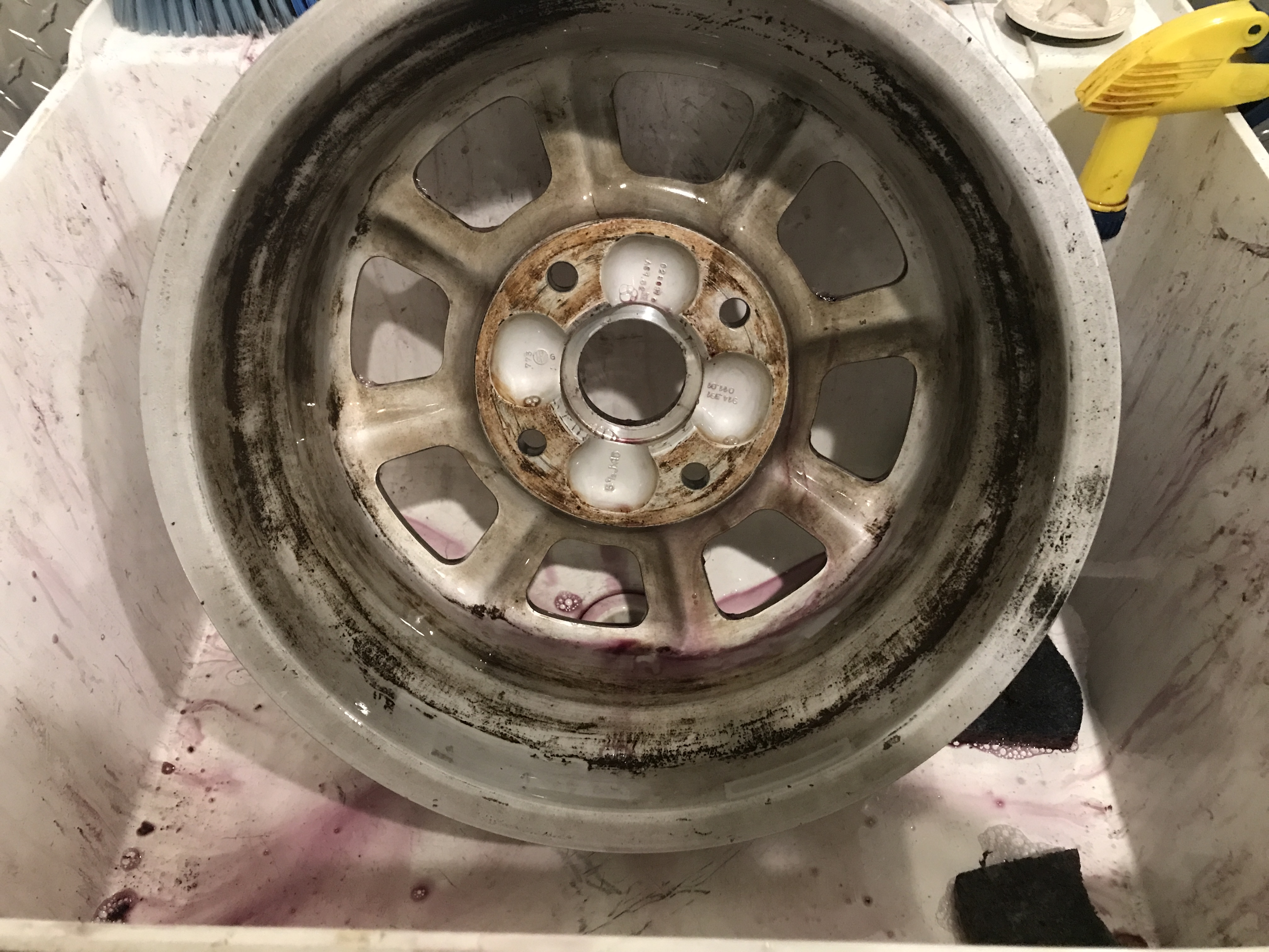

After 30 minutes of apply, soak, scrub, and rinse (multiple times).
bkrantz
post Feb 12 2022, 09:15 PM
Post #4847
Posts: 8,345
Joined: 3-August 19
From: SW Colorado
Member No.: 23,343
After about an hour.

And after 2 hours, done. All four wheels are cleaned on the inside.

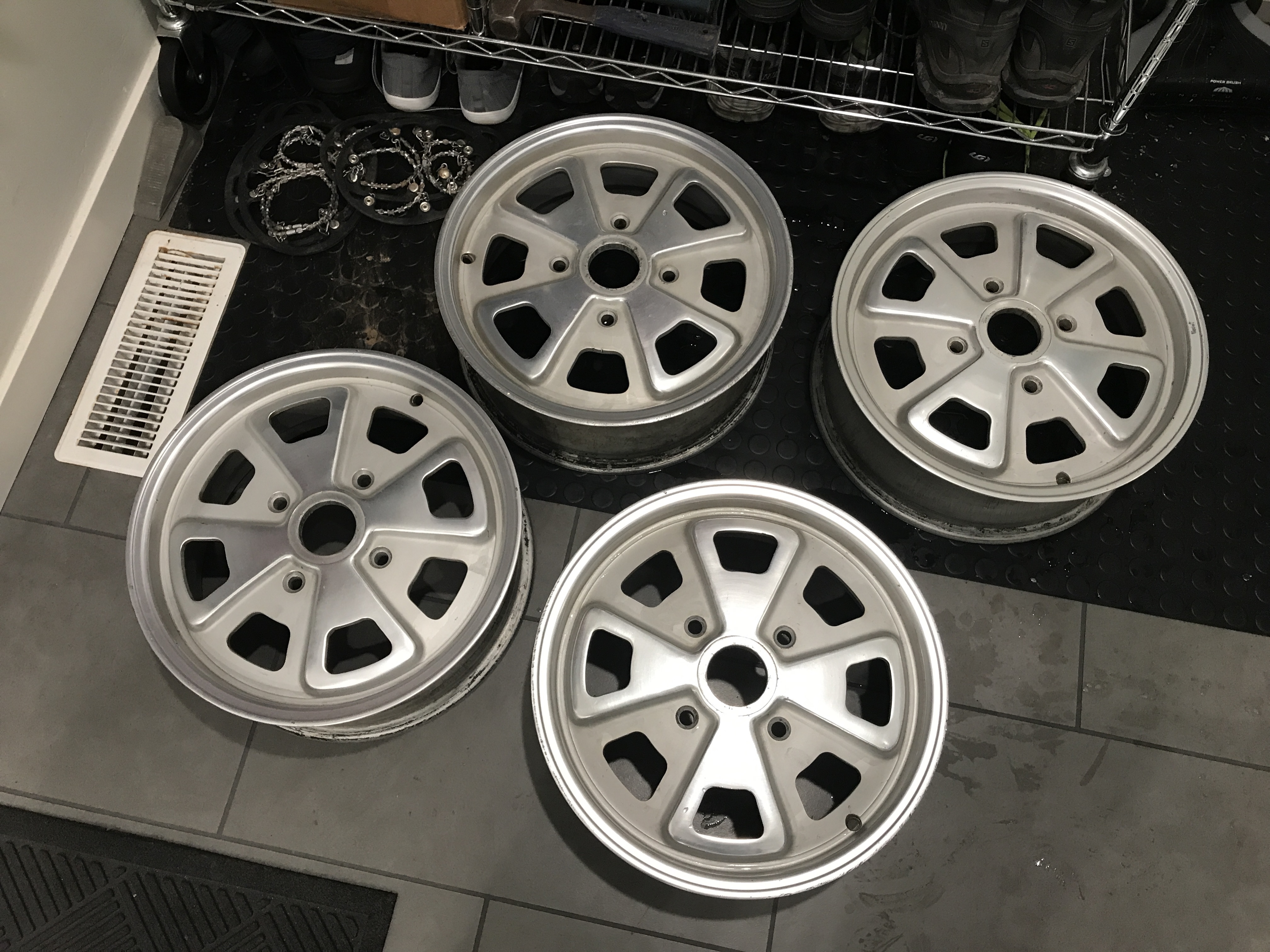

And the outside, too. These are certainly not concours, but will do. At least now I get head back to the tire shop.

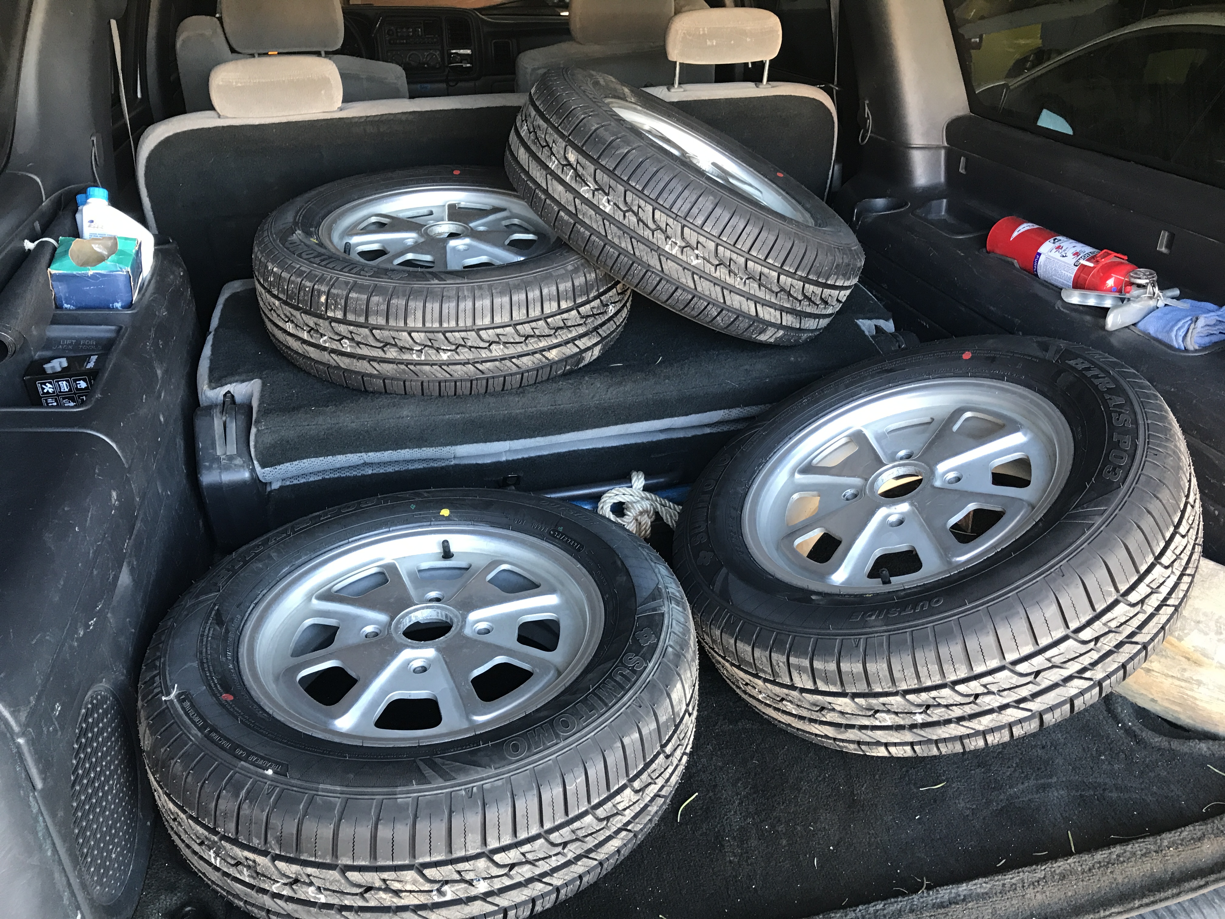

Home from the tire shop.

QUOTE(bkrantz @ Feb 12 2022, 06:55 PM) *
For the outer adjuster, I have the perfect wrench: a Facom socket wrench. This has an open end to allow the Allen wrench through.
I need one of those Facom wrench's because.........well just because. (IMG:style_emoticons/default/drooley.gif)

QUOTE(76-914 @ Feb 14 2022, 08:14 PM) *
Here's one source:
https://www.grainger.com/category/tools/soc...et-end-wrenches
I bought 8mm, 10mm, and 13mm when I lived in France in the 80s. That covers 99% of Porsche hardware, but now I want to fill in the rest--like you said just because.

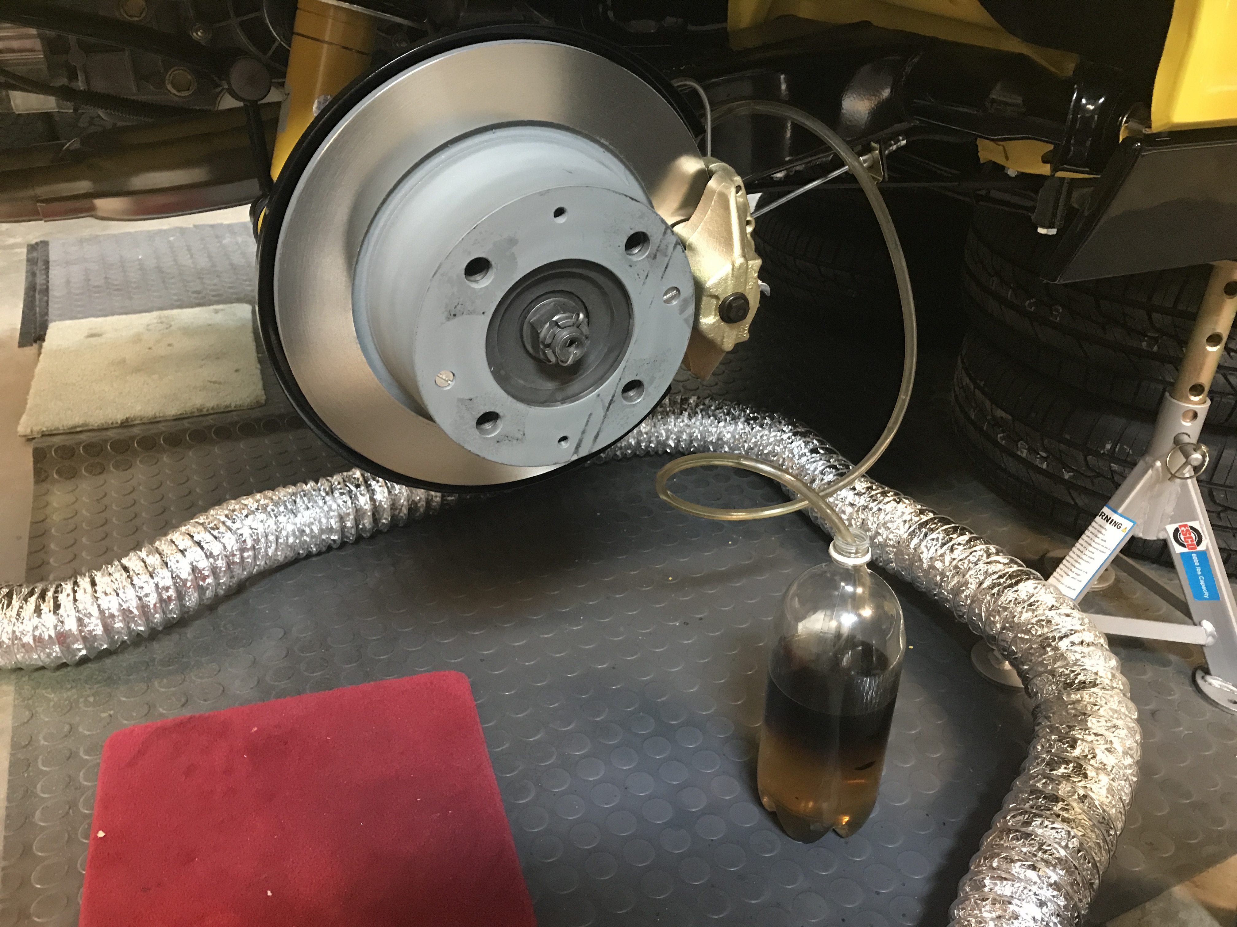

I did one more round of brake bleeding, and saw at least one good sized air bubble come out. I think I am done with bleeding until I can road test.

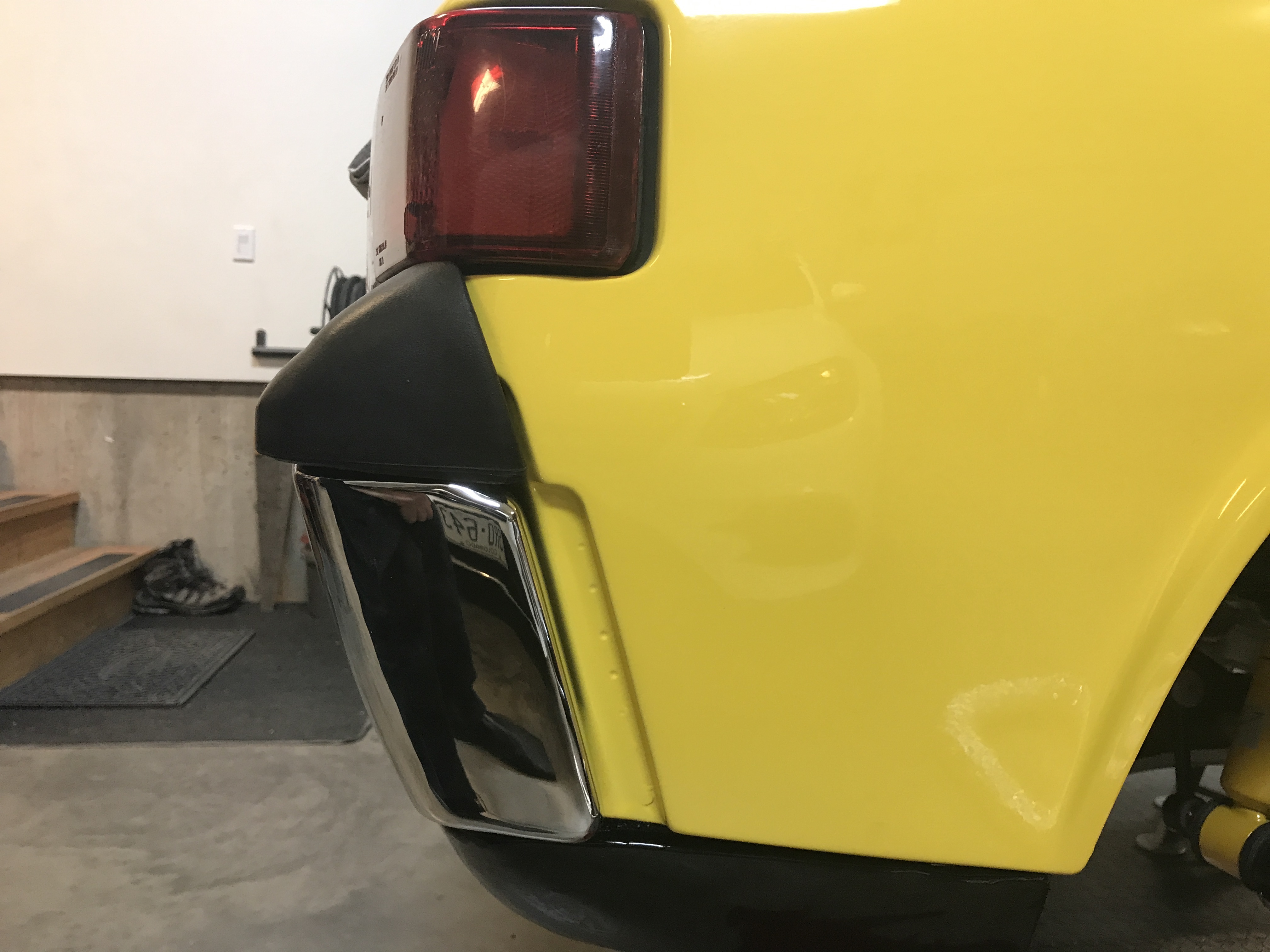

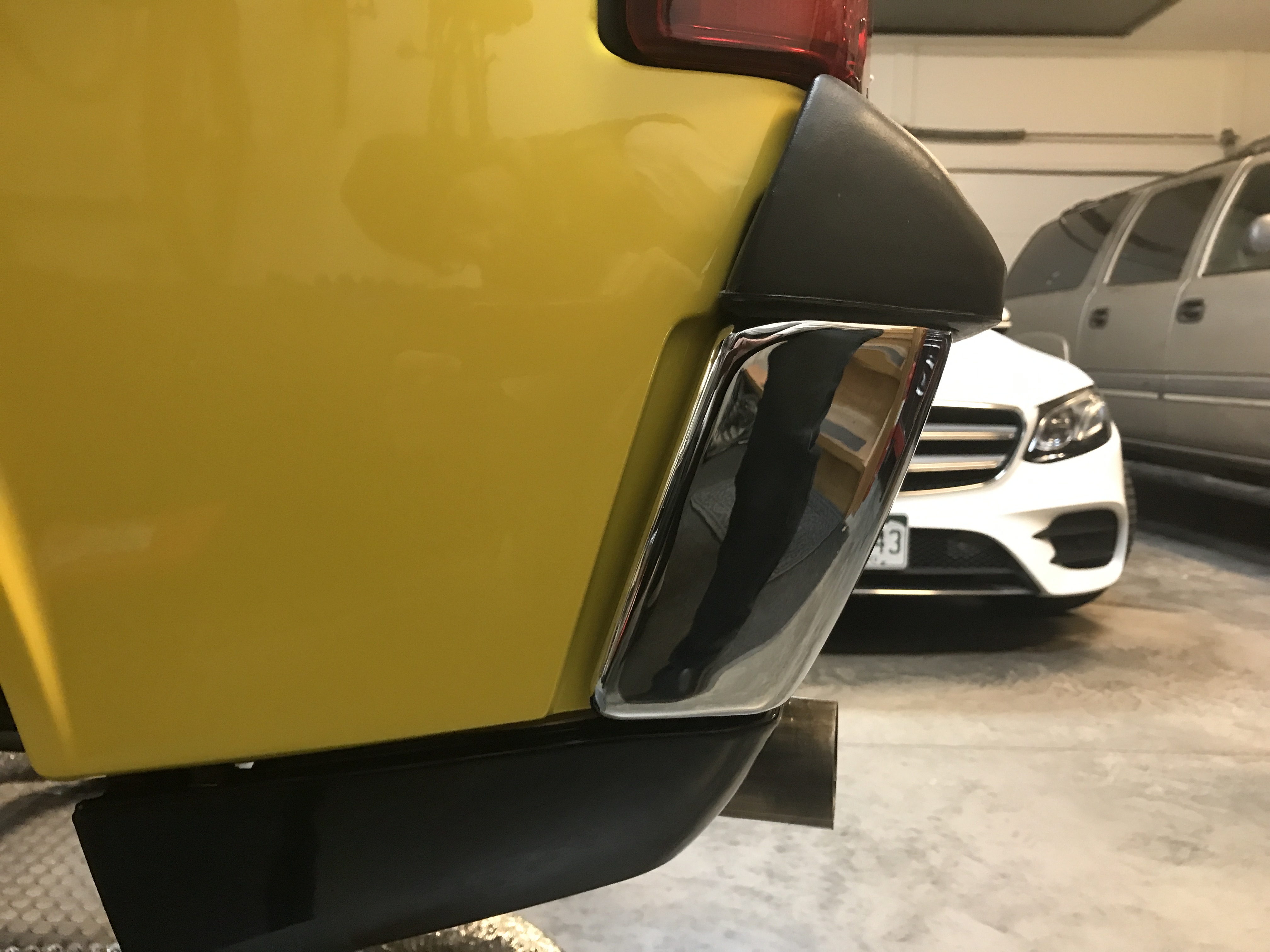

Then I decided to fix something that has been bothering me. On the rear bumper, the fit is not equal from side to side. Here is the left that looks good, with the rubber tight against the body and the chrome showing about 5/8 inch gap.
bkrantz
post Feb 16 2022, 08:51 PM
Post #4859
Posts: 8,345
Joined: 3-August 19
From: SW Colorado
Member No.: 23,343
But on the right side, the rubber is off the body work, and the gap along the chrome is about an inch--enough to see behind the bumper.

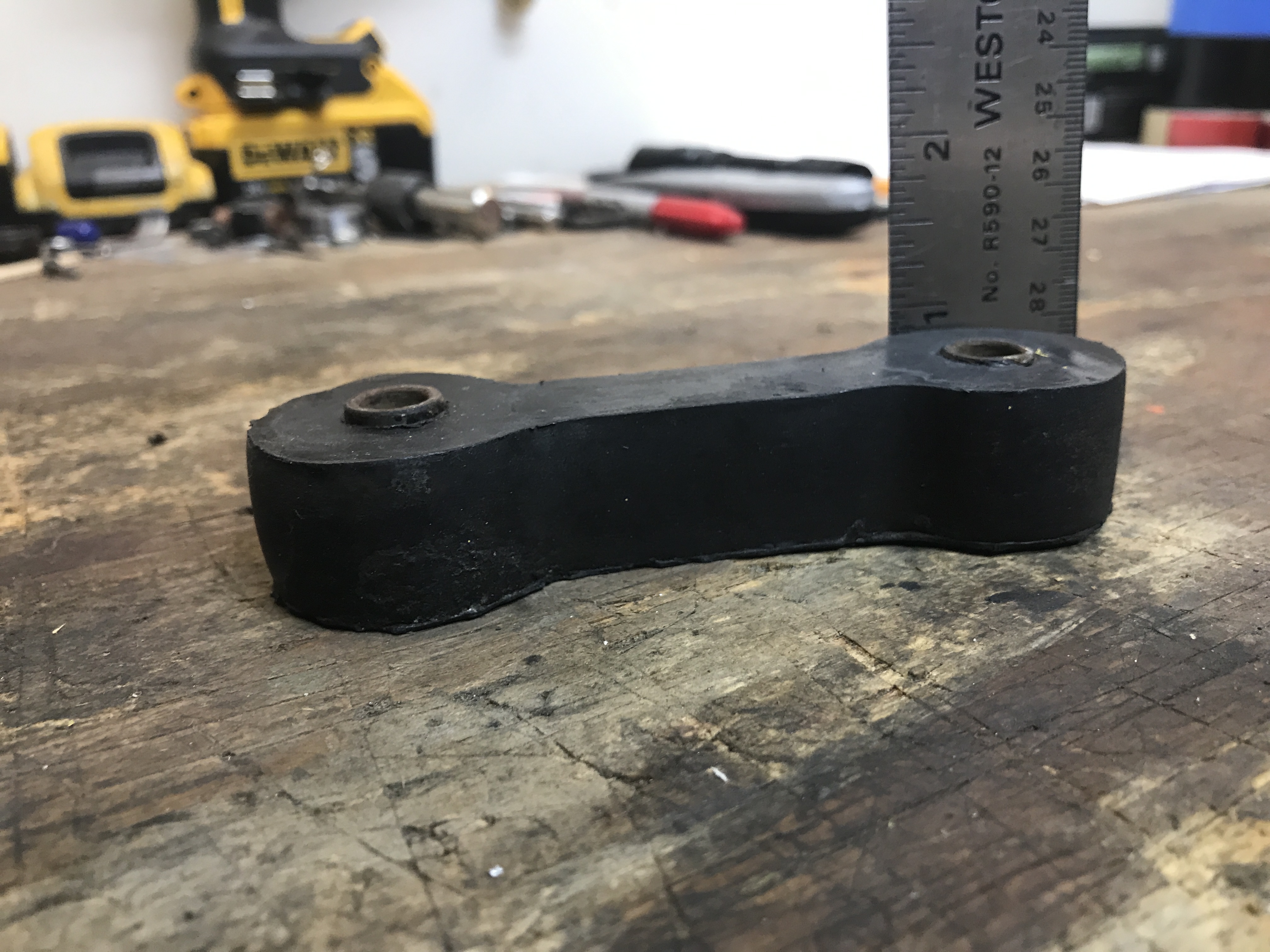

bkrantz
post Feb 16 2022, 08:52 PM
Post #4860
Posts: 8,345
Joined: 3-August 19
From: SW Colorado
Member No.: 23,343
I took the bumper off, and removed the dog bone. It is about 7/8 inch thick.
