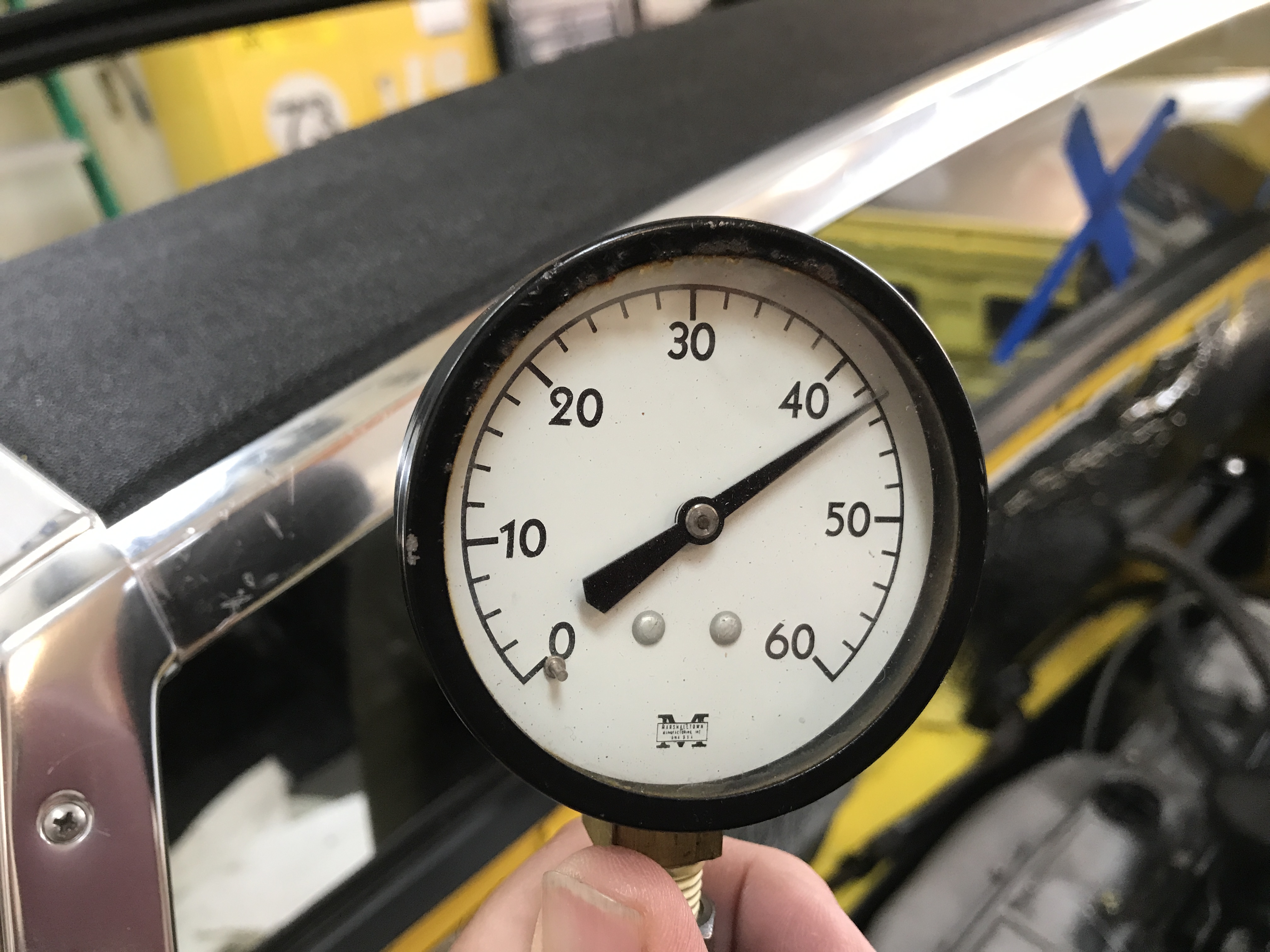

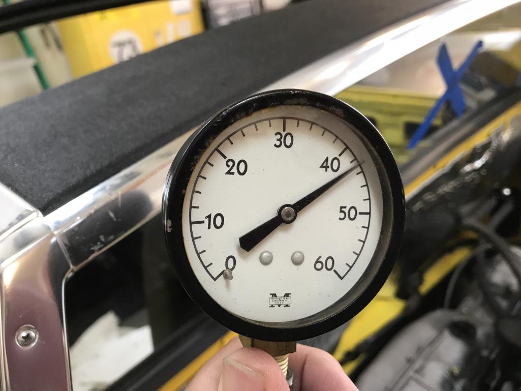

Still performing basic checks. The fuel pressure should be 43.5 psi--looks good on the gauge.

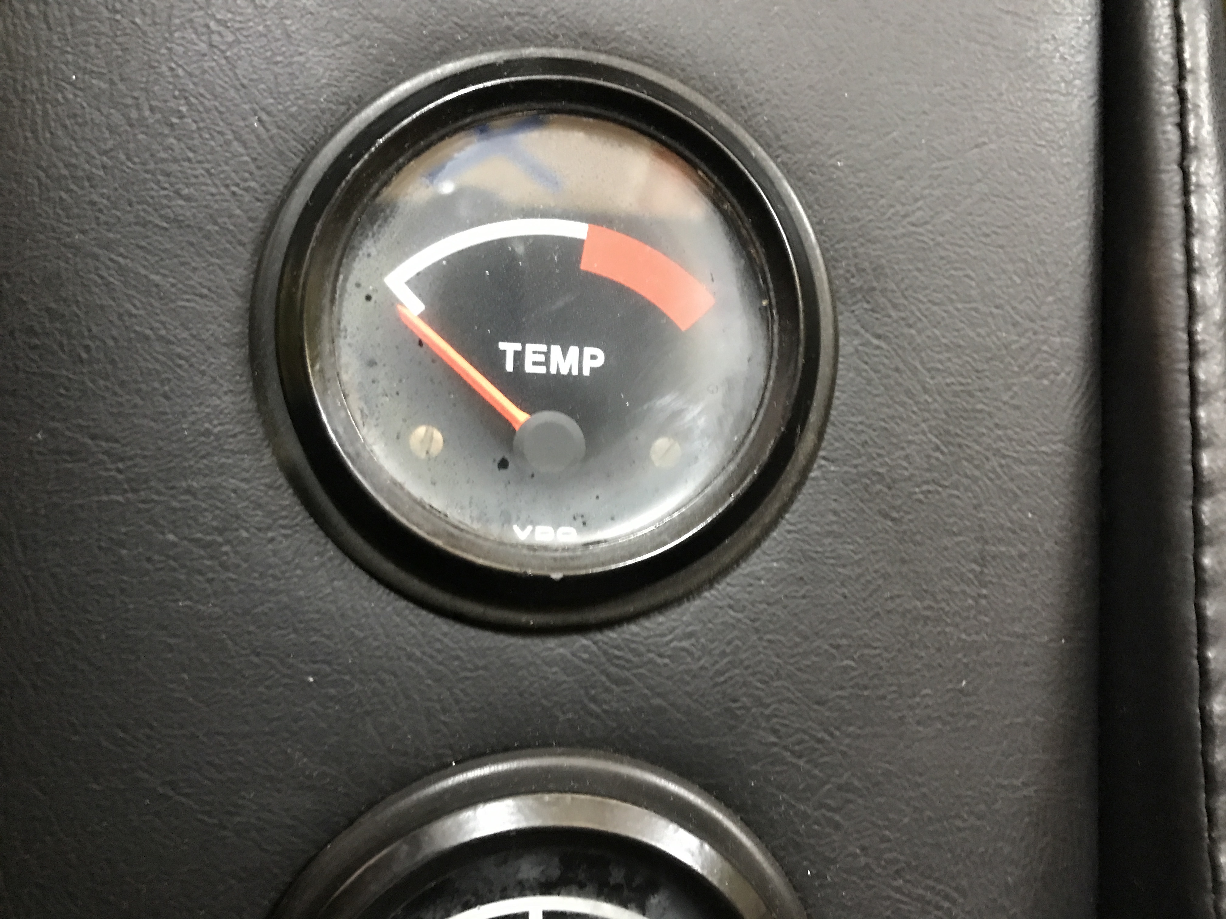

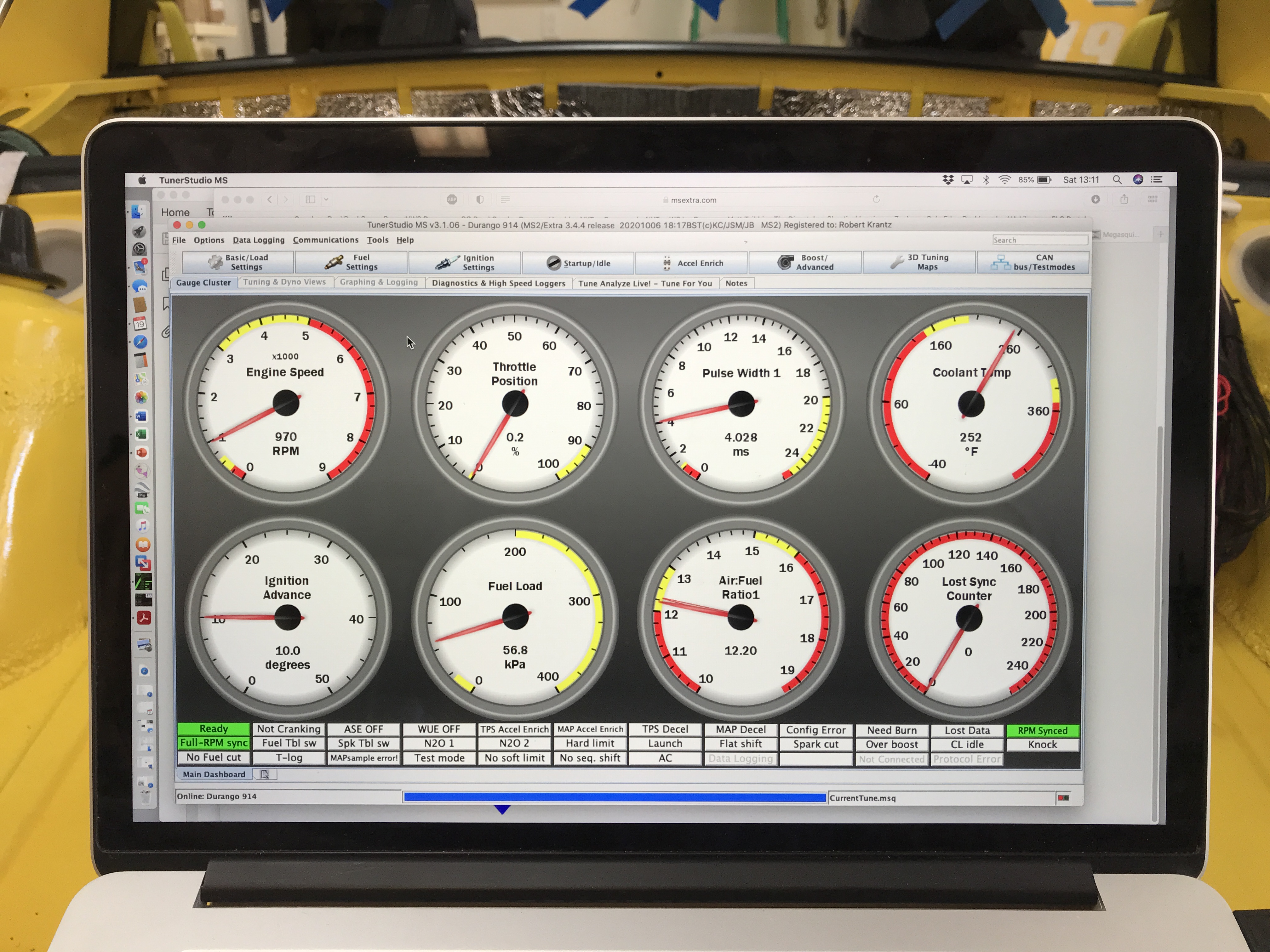

The temp gauge now is set for air-cooled head temps. I let it warm up a bit, running for about 15 minutes, and the head got to about 250°.

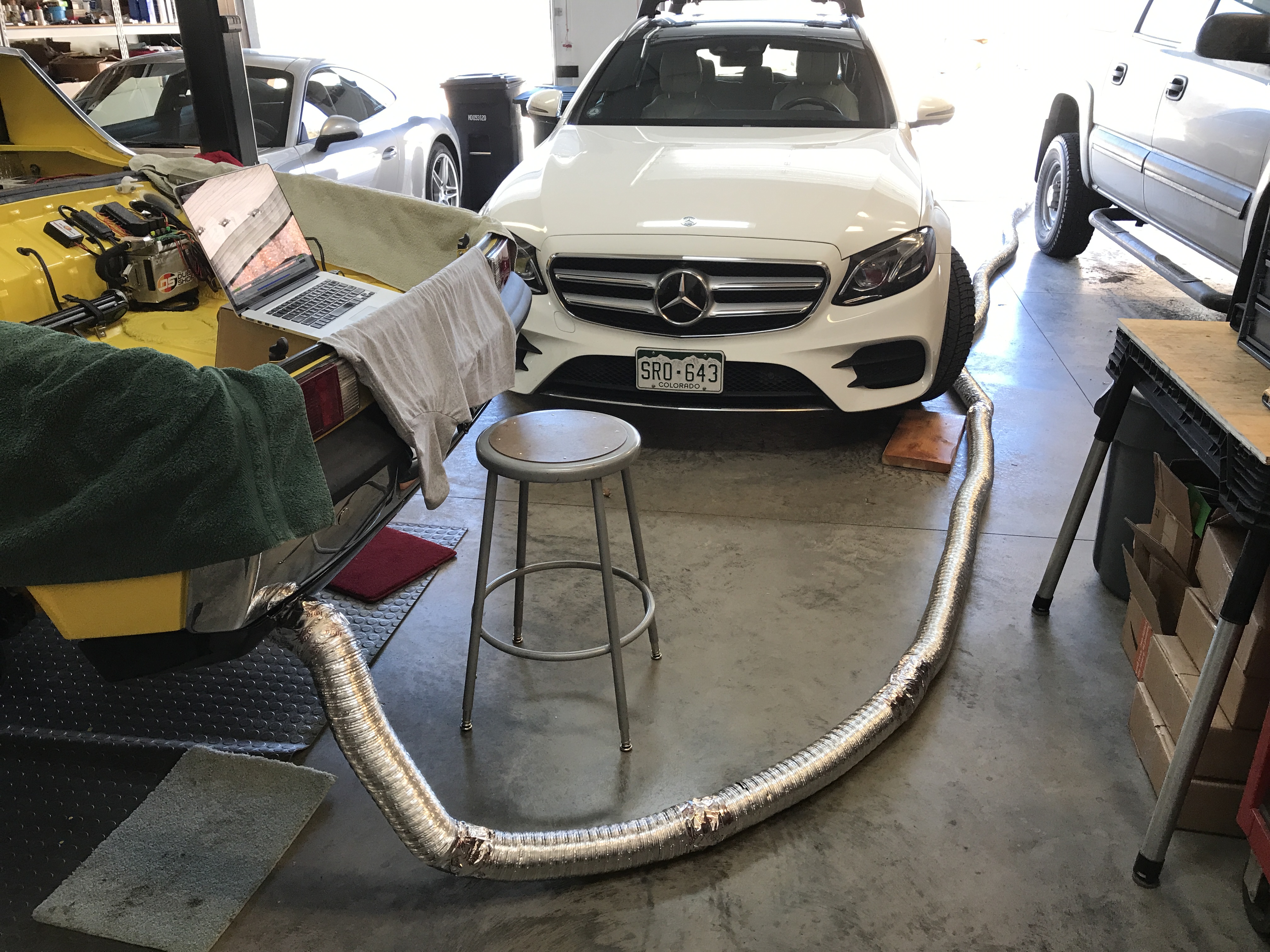

I need to work on my exhaust ducting. Its a long way to the outside.
bkrantz
post Feb 19 2022, 08:44 PM
Post #4888
Posts: 8,345
Joined: 3-August 19
From: SW Colorado
Member No.: 23,343

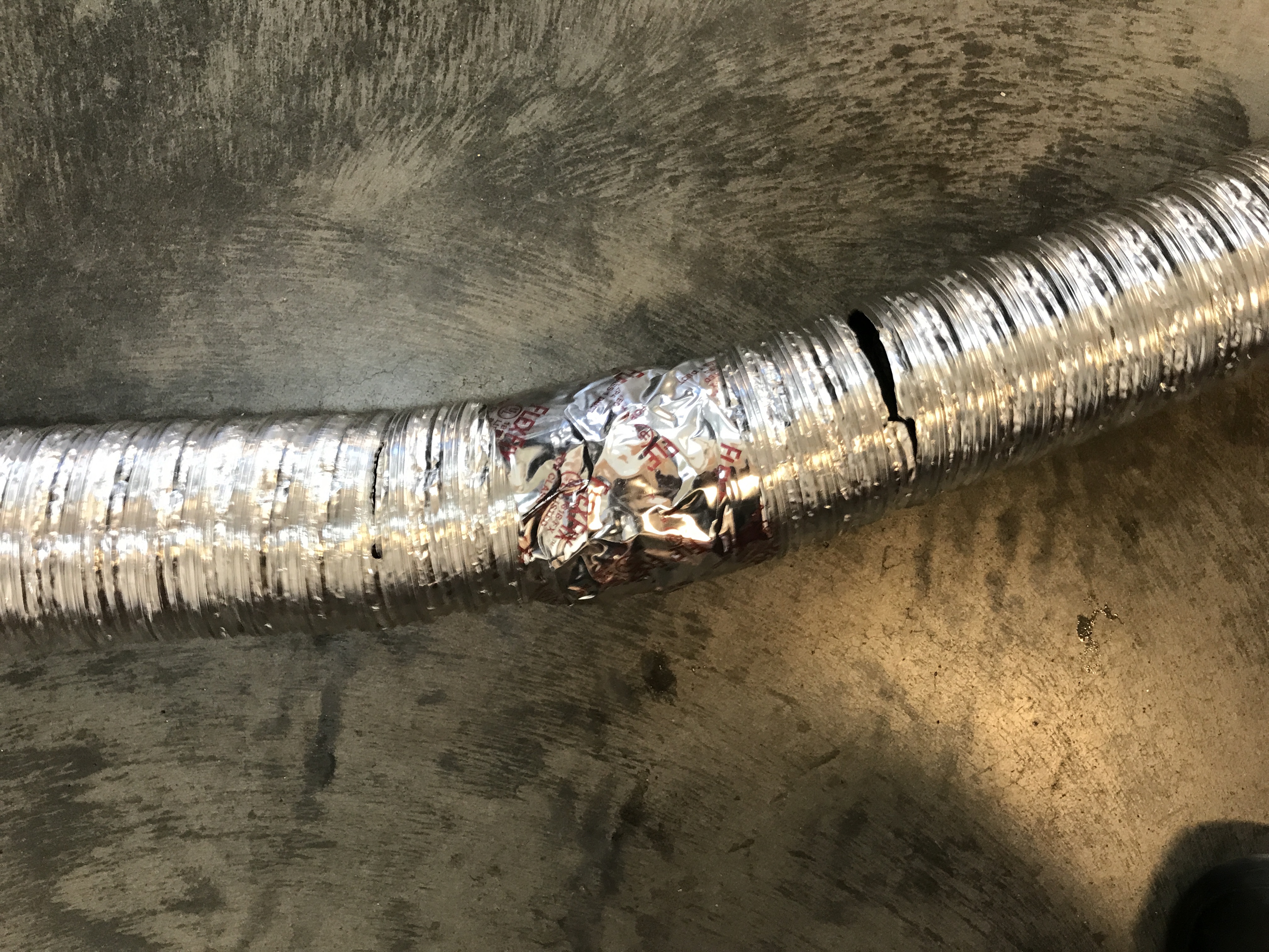

And my aluminum dryer ducting is pretty fragile--and leaky.
bkrantz
post Feb 19 2022, 08:45 PM
Post #4889
Posts: 8,345
Joined: 3-August 19
From: SW Colorado
Member No.: 23,343
And it gets chilly with the garage doors open, even on a warmer day like today.

Still no real response on the stock temp gauge.

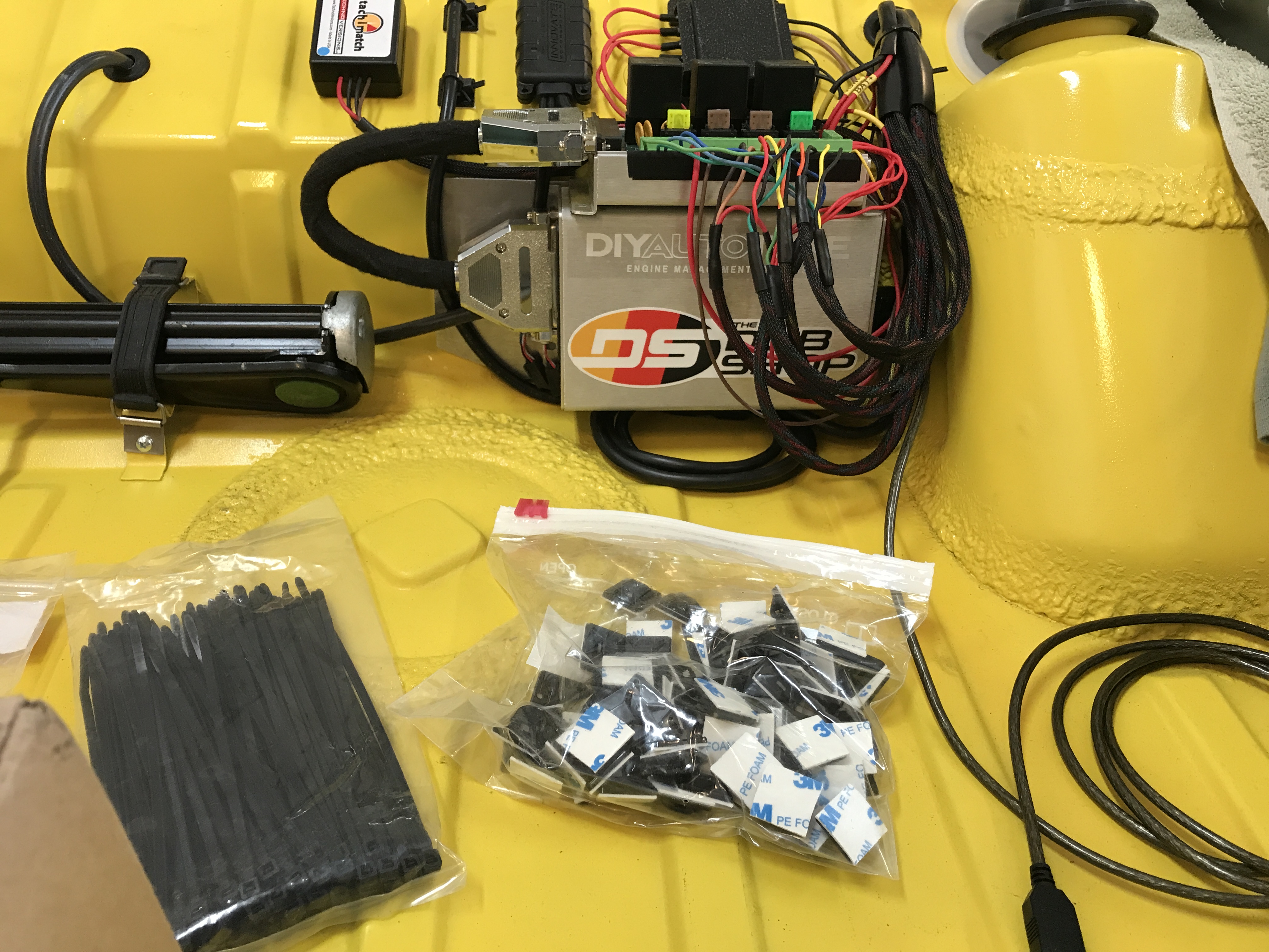

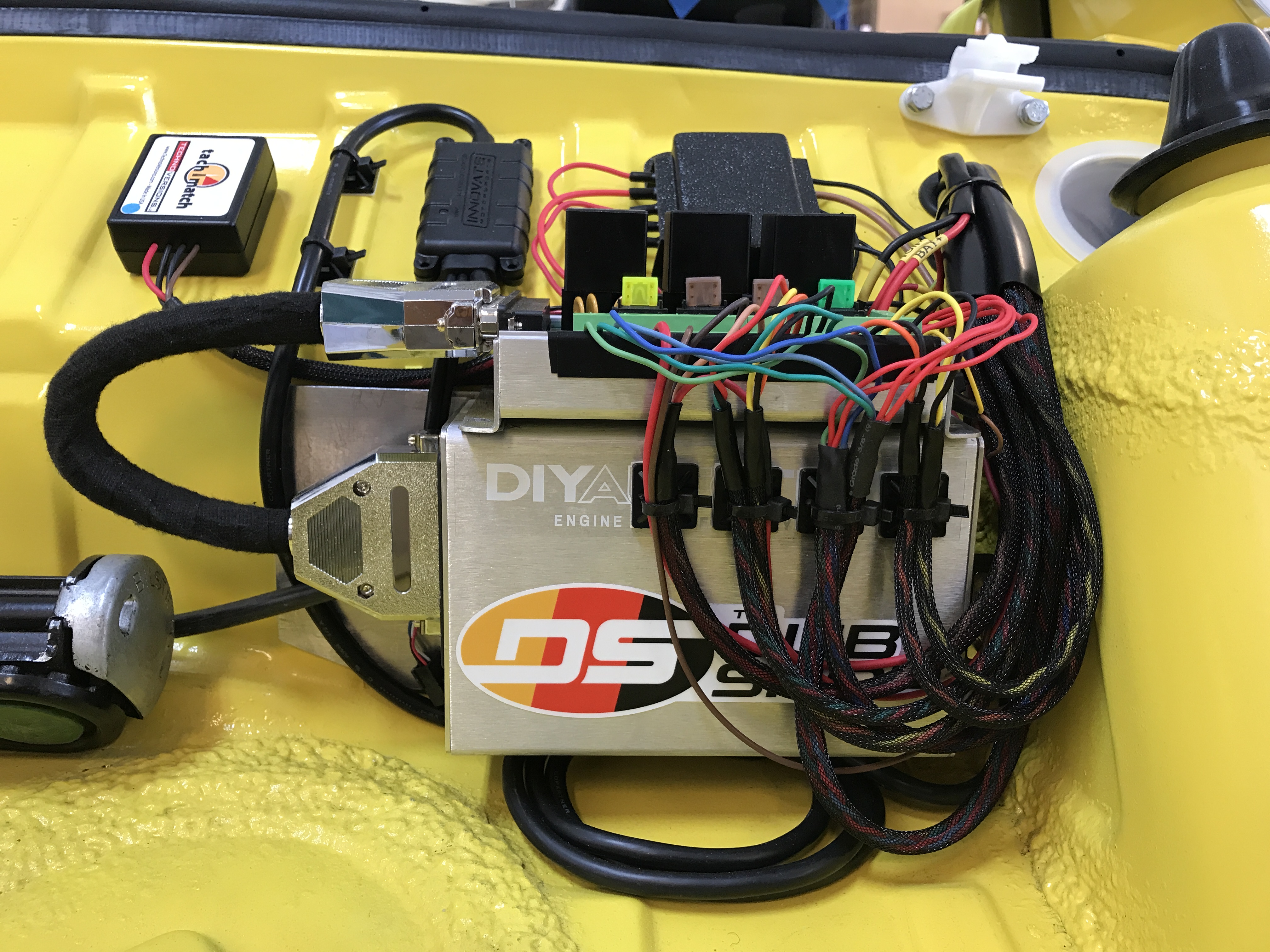

Since everything in the EFI seems to be working, I worked on making the wires neater and tied down.
bkrantz
post Feb 19 2022, 08:56 PM
Post #4892
Posts: 8,345
Joined: 3-August 19
From: SW Colorado
Member No.: 23,343
Not as surgical as @tygaboy , but better.

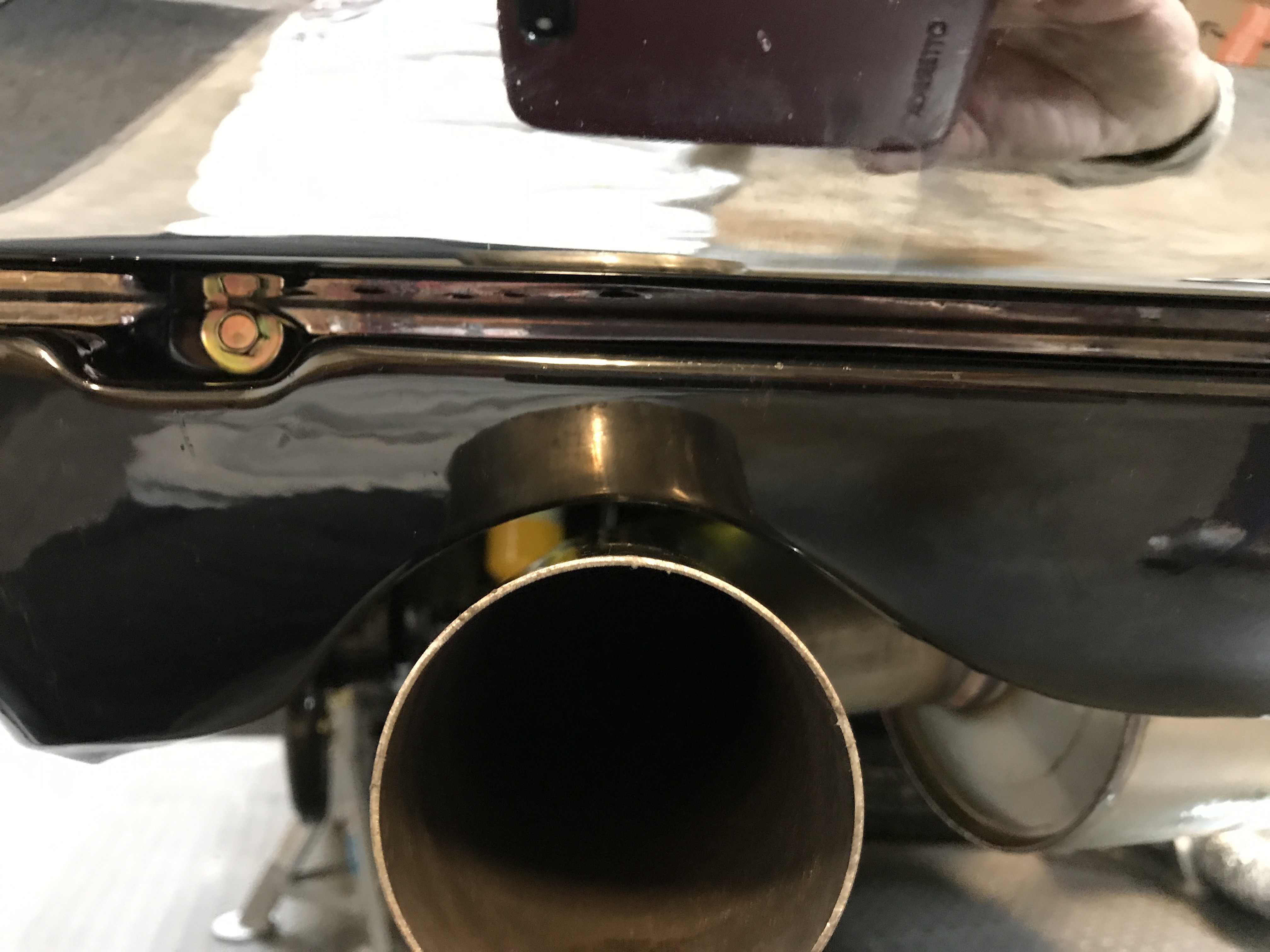

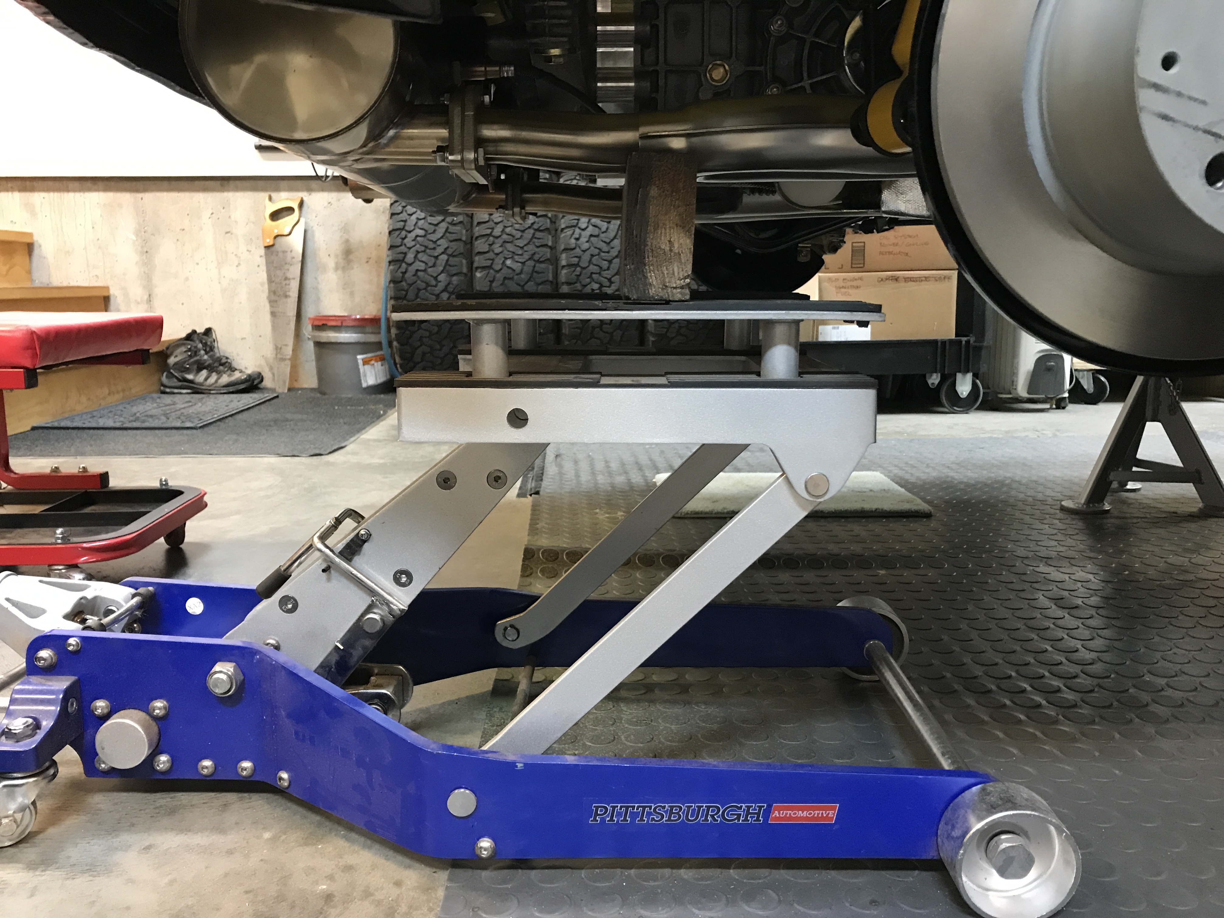

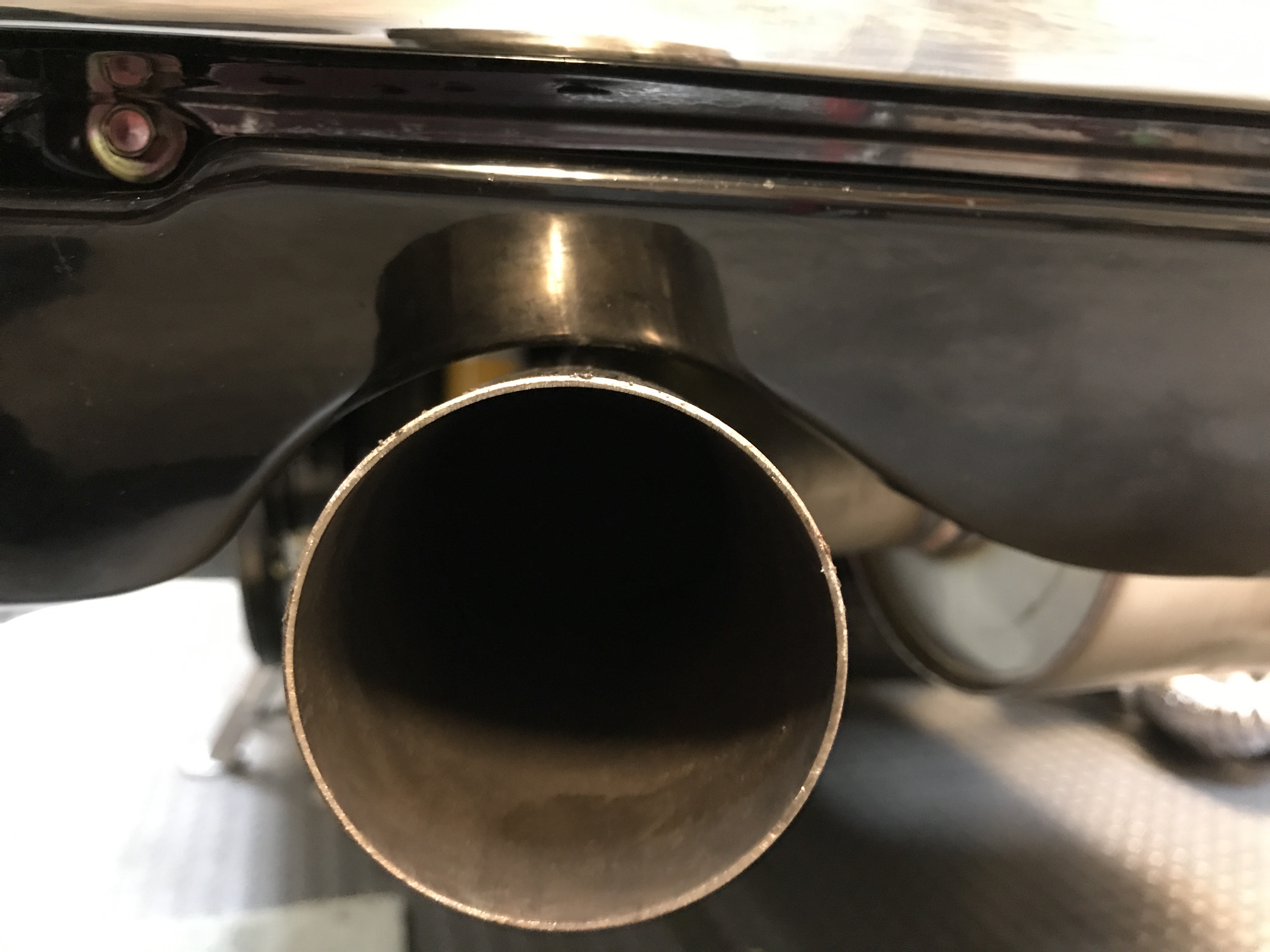

When I checked the tail pipe clearance after yesterday's hot-cold cycle, it was back where it was, and too close.
bkrantz
post Feb 20 2022, 07:54 PM
Post #4894
Posts: 8,345
Joined: 3-August 19
From: SW Colorado
Member No.: 23,343
I used a jack to brace the rear of the heat exchangers, and then "leaned" on the tail pipe to induce a little bending.
bkrantz
post Feb 20 2022, 07:56 PM
Post #4895
Posts: 8,345
Joined: 3-August 19
From: SW Colorado
Member No.: 23,343
I then adjusted the muffler bracket again. Better clearance (at least for now).

QUOTE(bkrantz @ Feb 19 2022, 06:47 PM) *
Have you done the old grounding trick or does that not work on these gauges?
