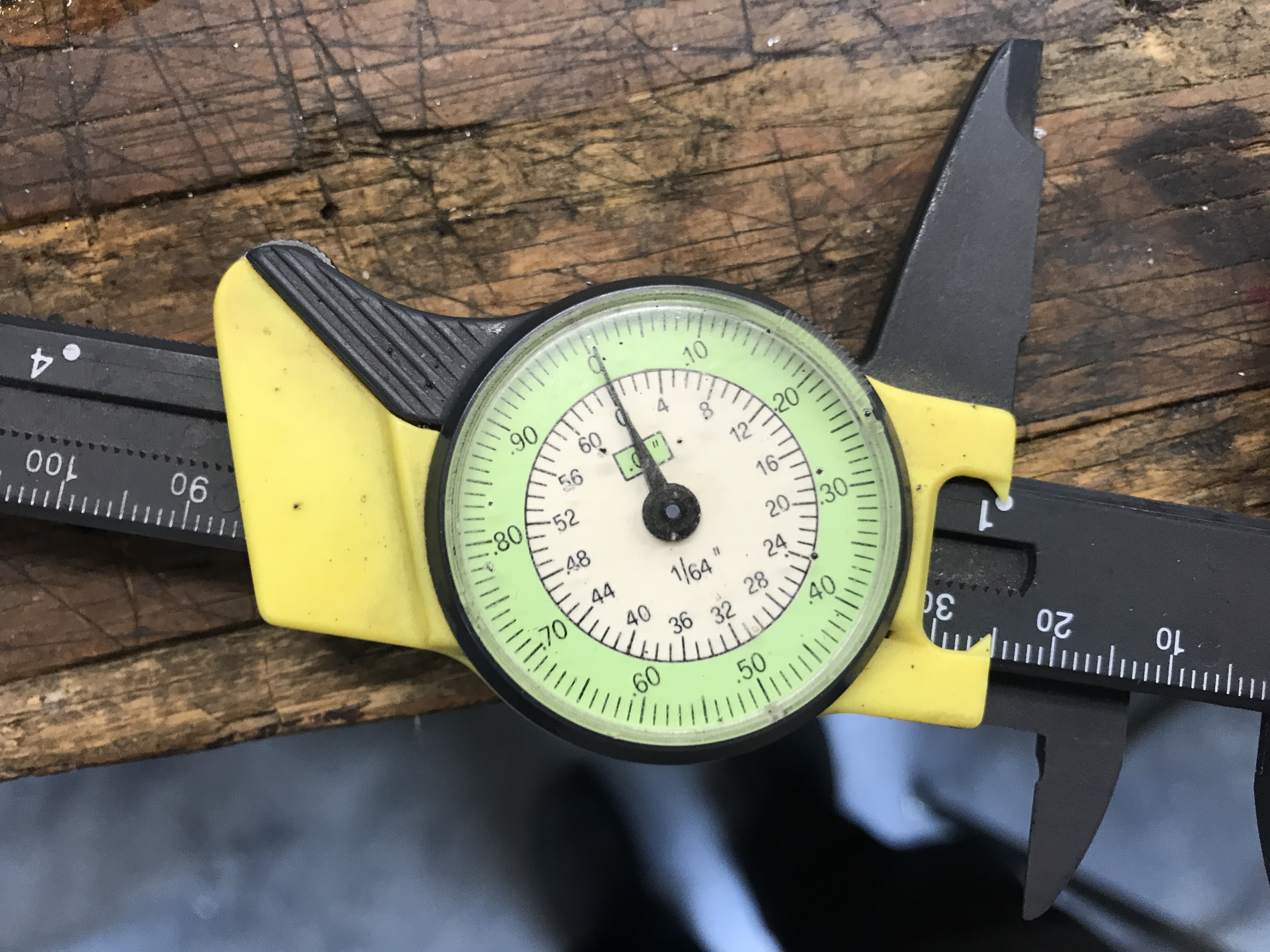

On the new one, it measures about 1.00"
This means the clearance for the switch plunger is about .04" less, so the plunger is depressed a bit and the switch closed, even with the piston in "neutral". Not good part 2.
Lesson, be wary of after-market, no brand MC. Time for a better one.

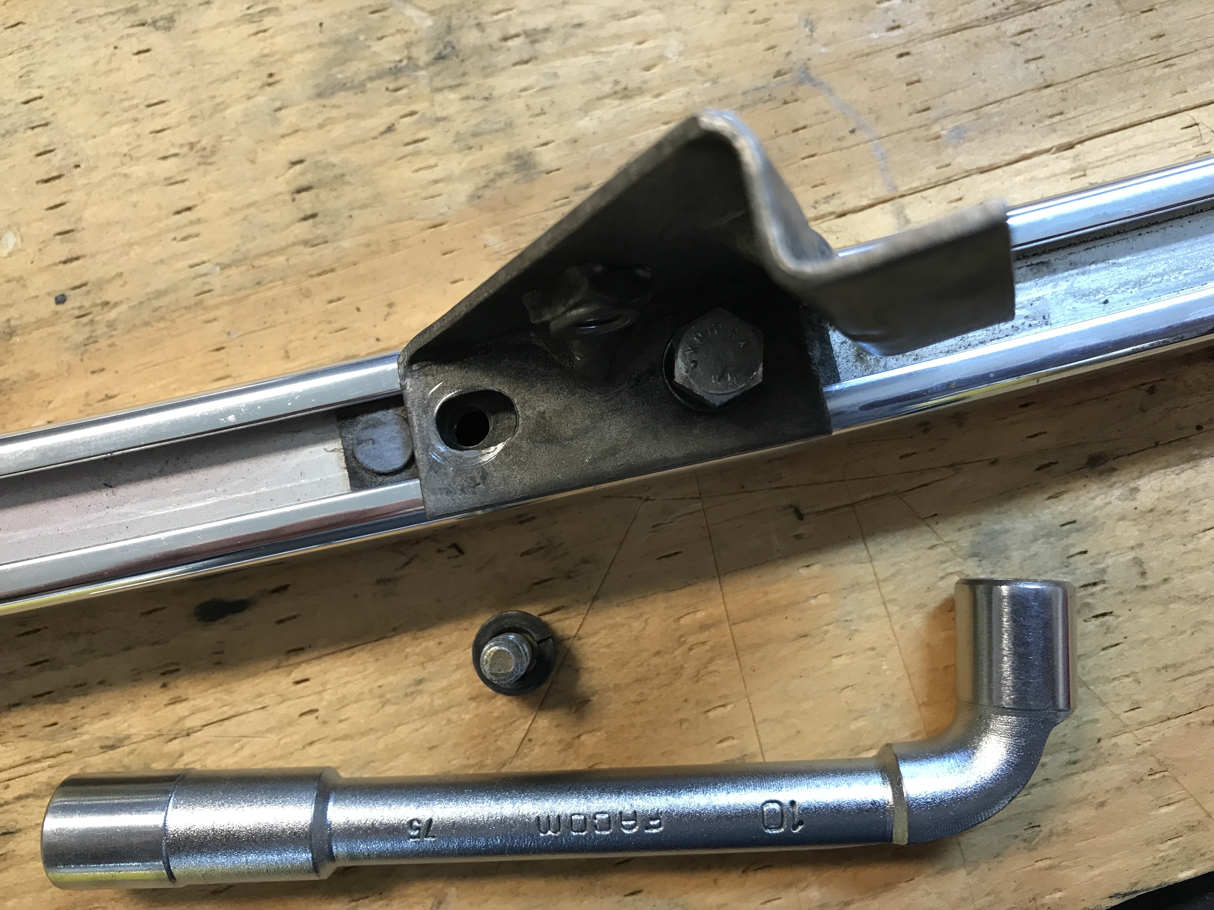

Member No.: 23,343

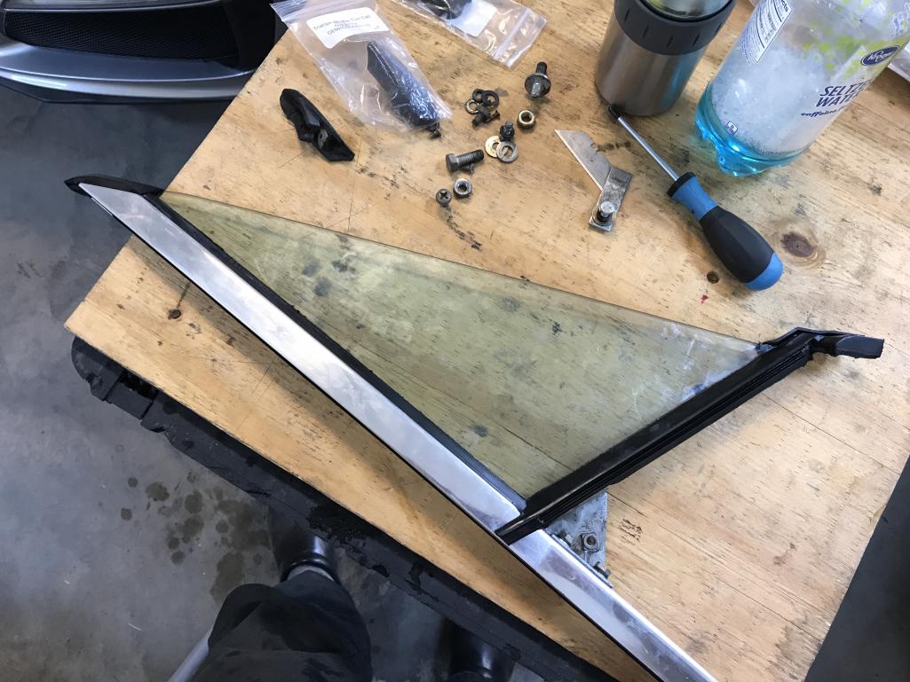

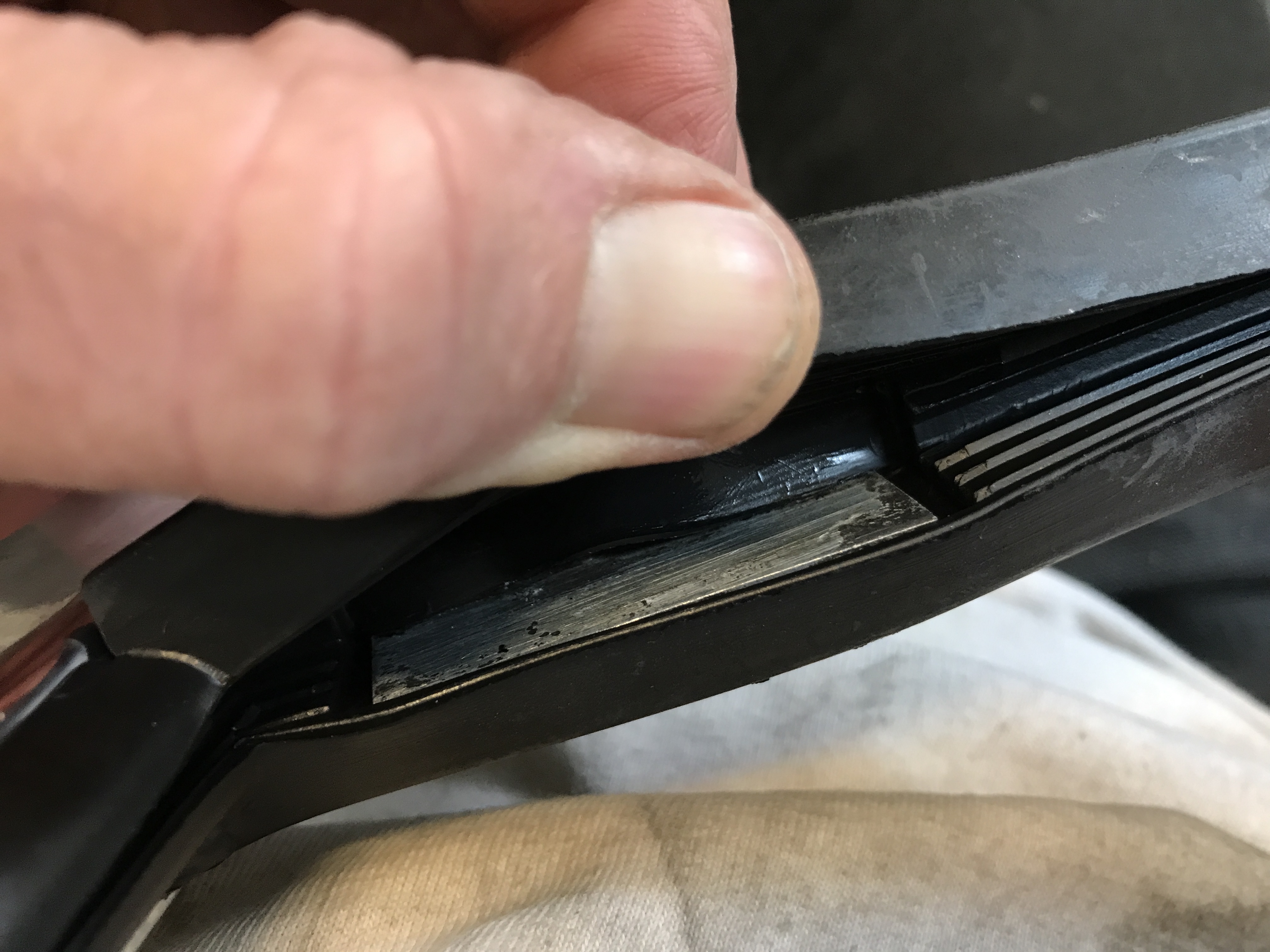

Here's the triangular piece from below, inserted into the horizontal section of the vent window rubber. I had to cut a slit in the very thin rubber there.
bkrantz

Member No.: 23,343

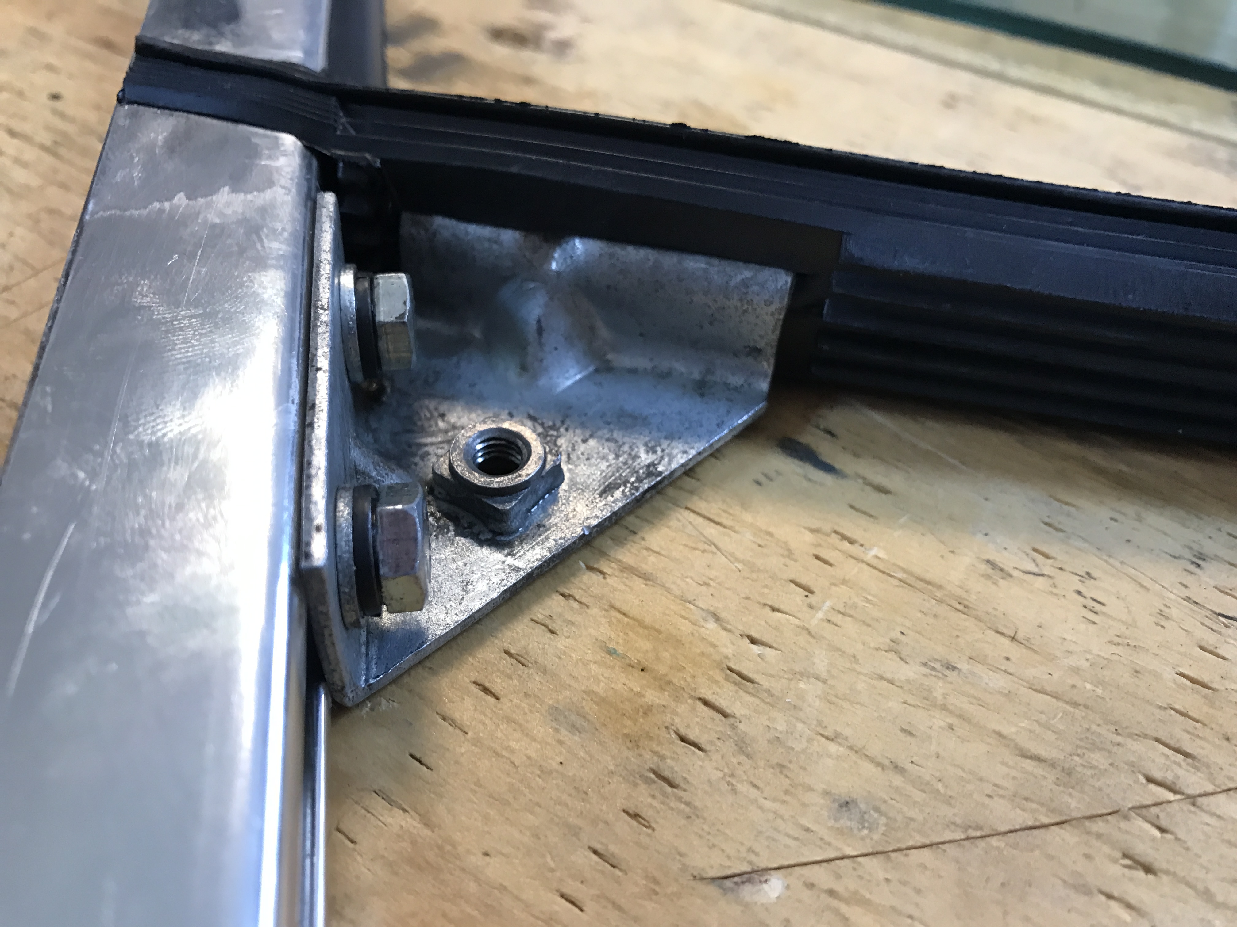

And from above. The metal tab fits nicely into a recess in the rubber.

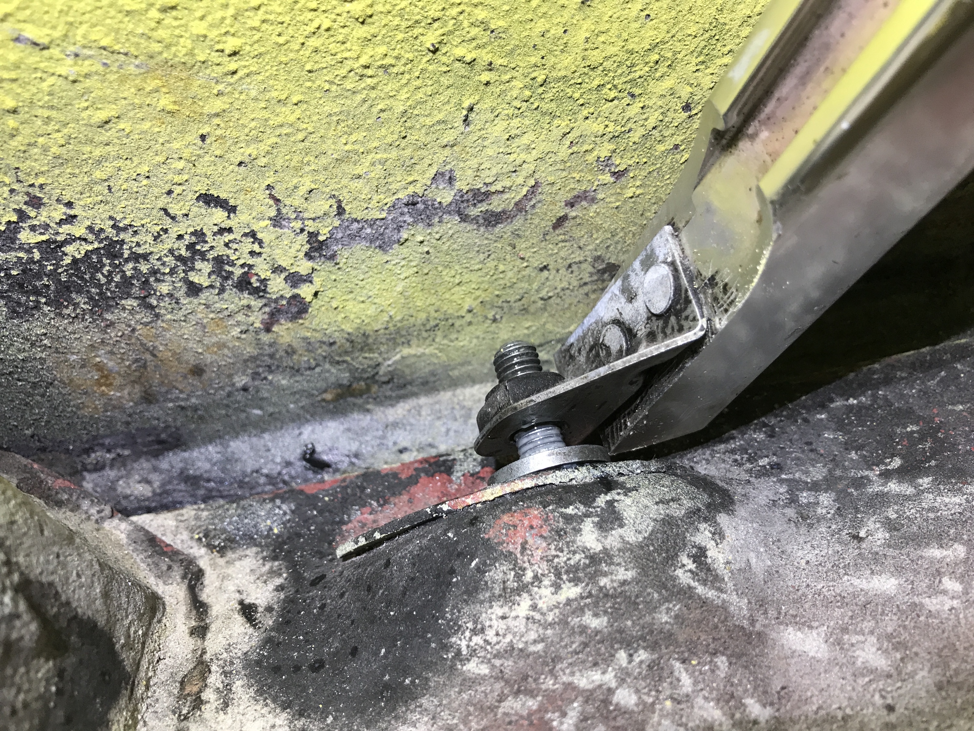

Vertical channel inserted into the door, with the adjuster bolt at the bottom. I put a touch of grease on the threads.

Member No.: 23,343

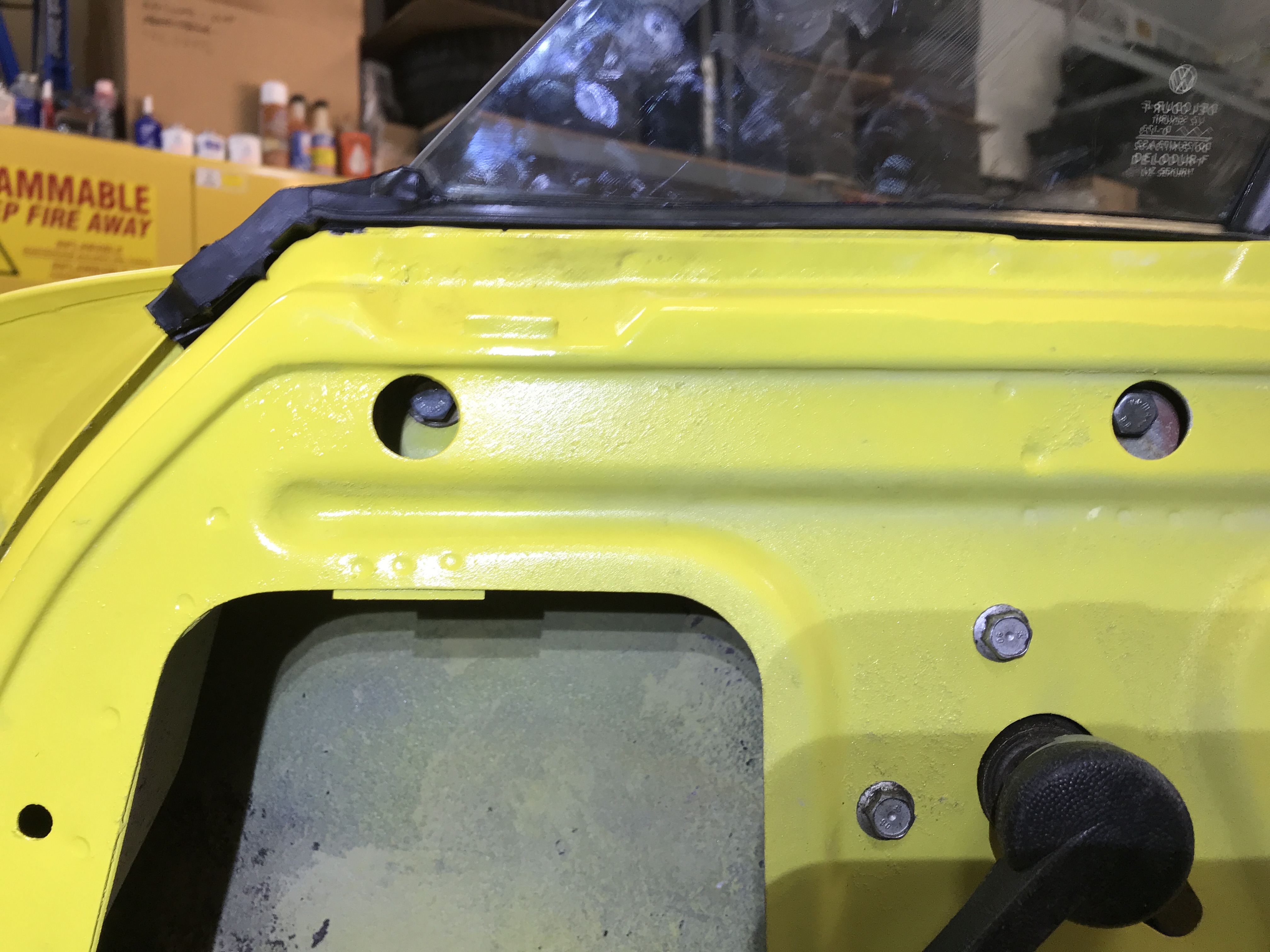

Then two M6 bolts at the top. The rear one (right) attaches the triangular brace, and thus the vertical channel, to the door. The front one attaches a second narrow metal tab to the door.

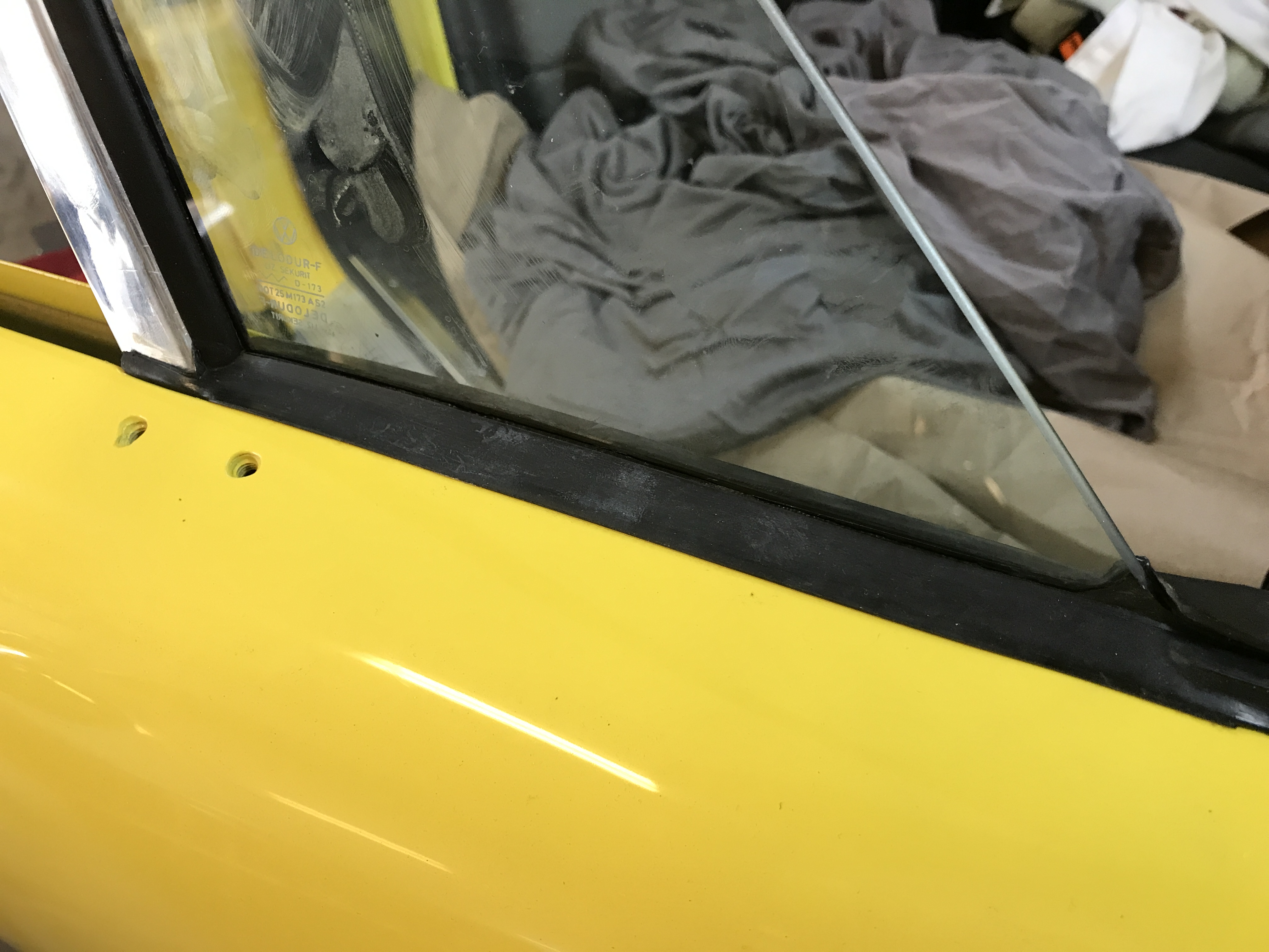

Member No.: 23,343
With the window and rubber seated fully into the door, the rubber edge sits evenly. This is what I could not achieve with the after-market rubber.

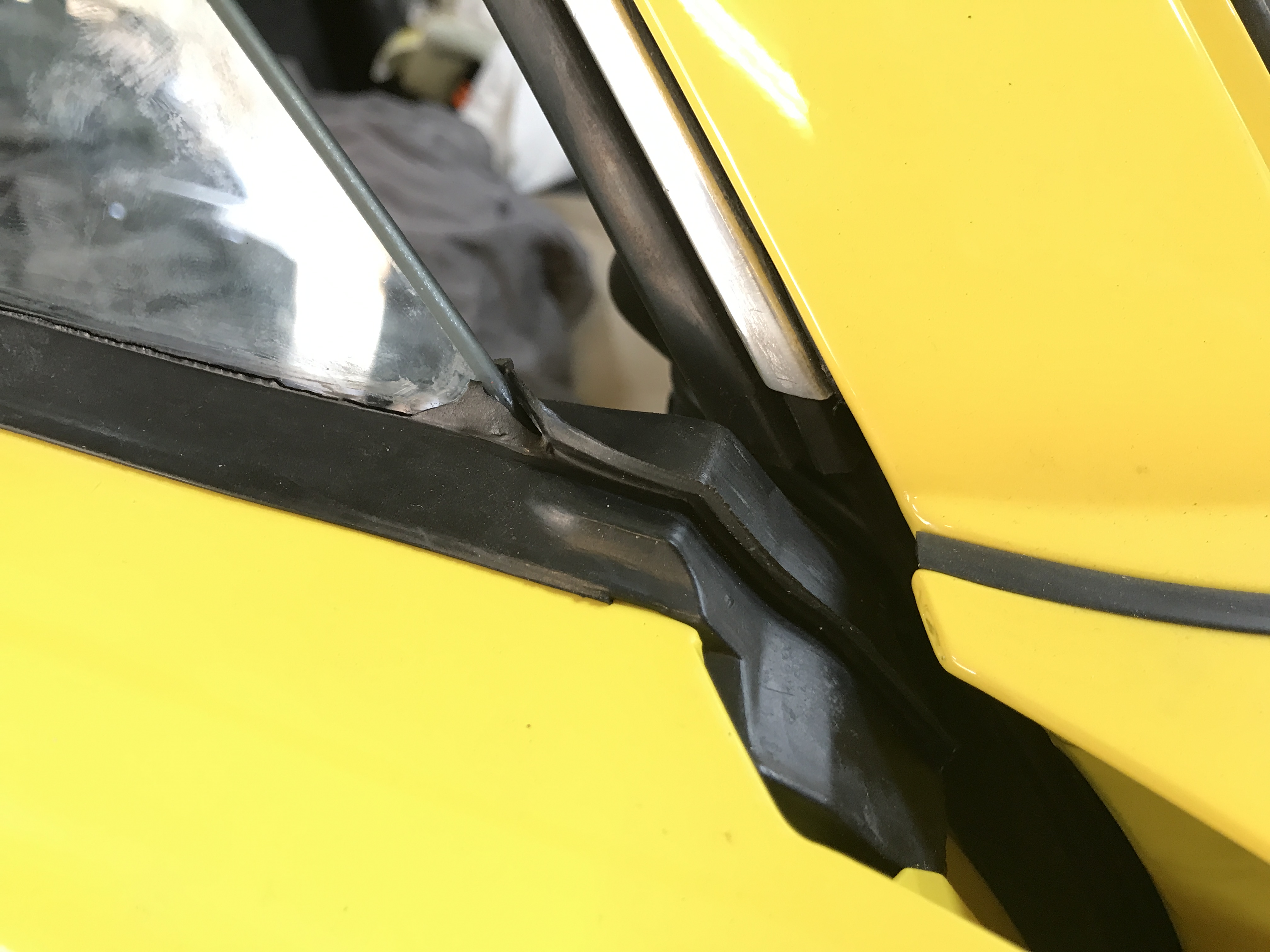

Member No.: 23,343

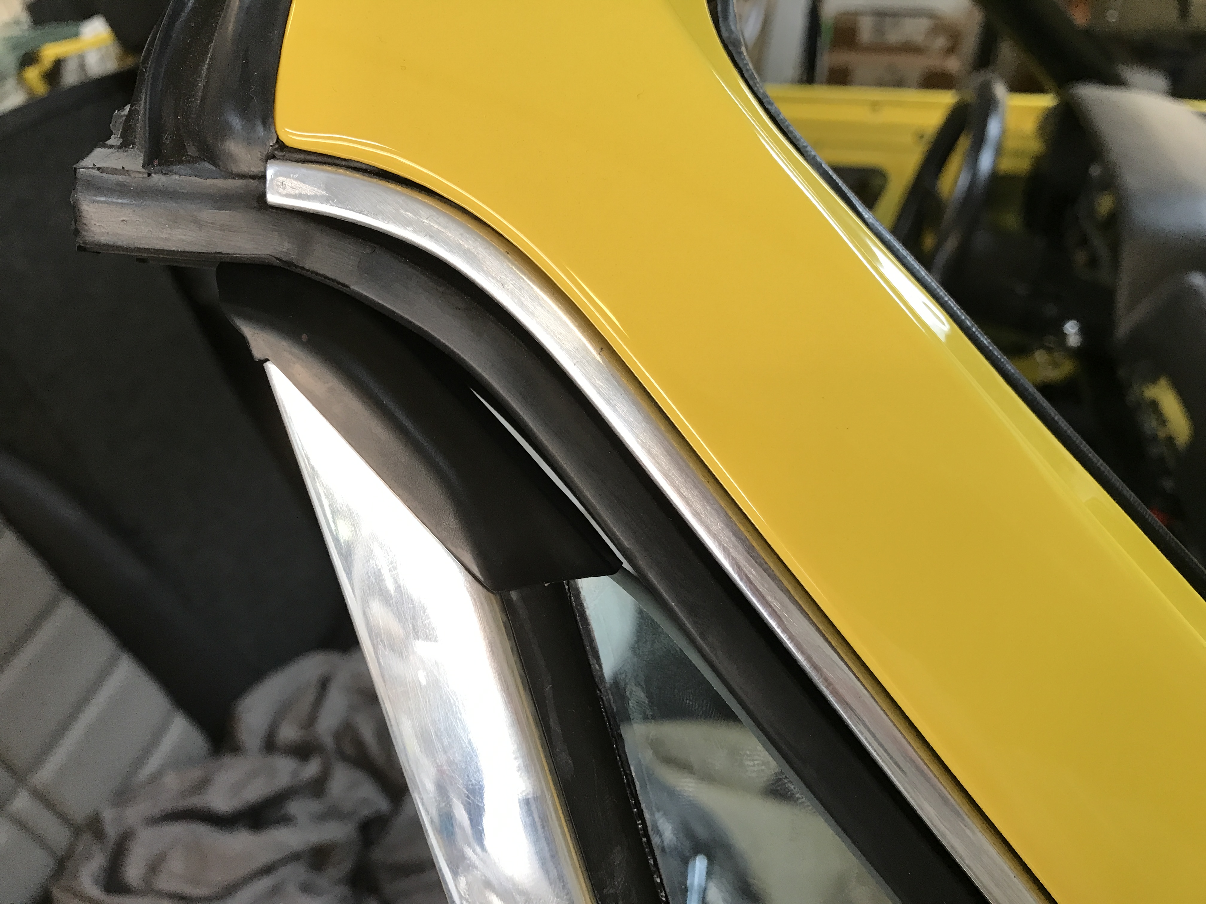

But now, I have interference between the vent window rubber, and the A-pillar weatherstrip that I had rough-cut last year. A bit more precise trimming took care of that.

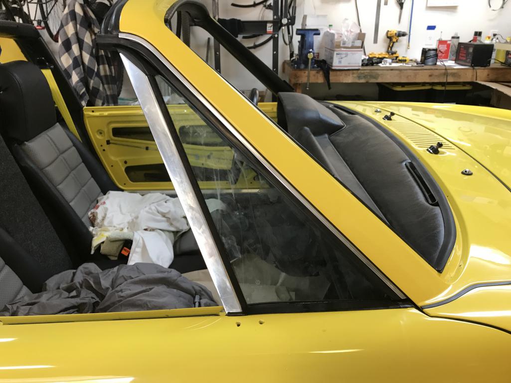

Member No.: 23,343

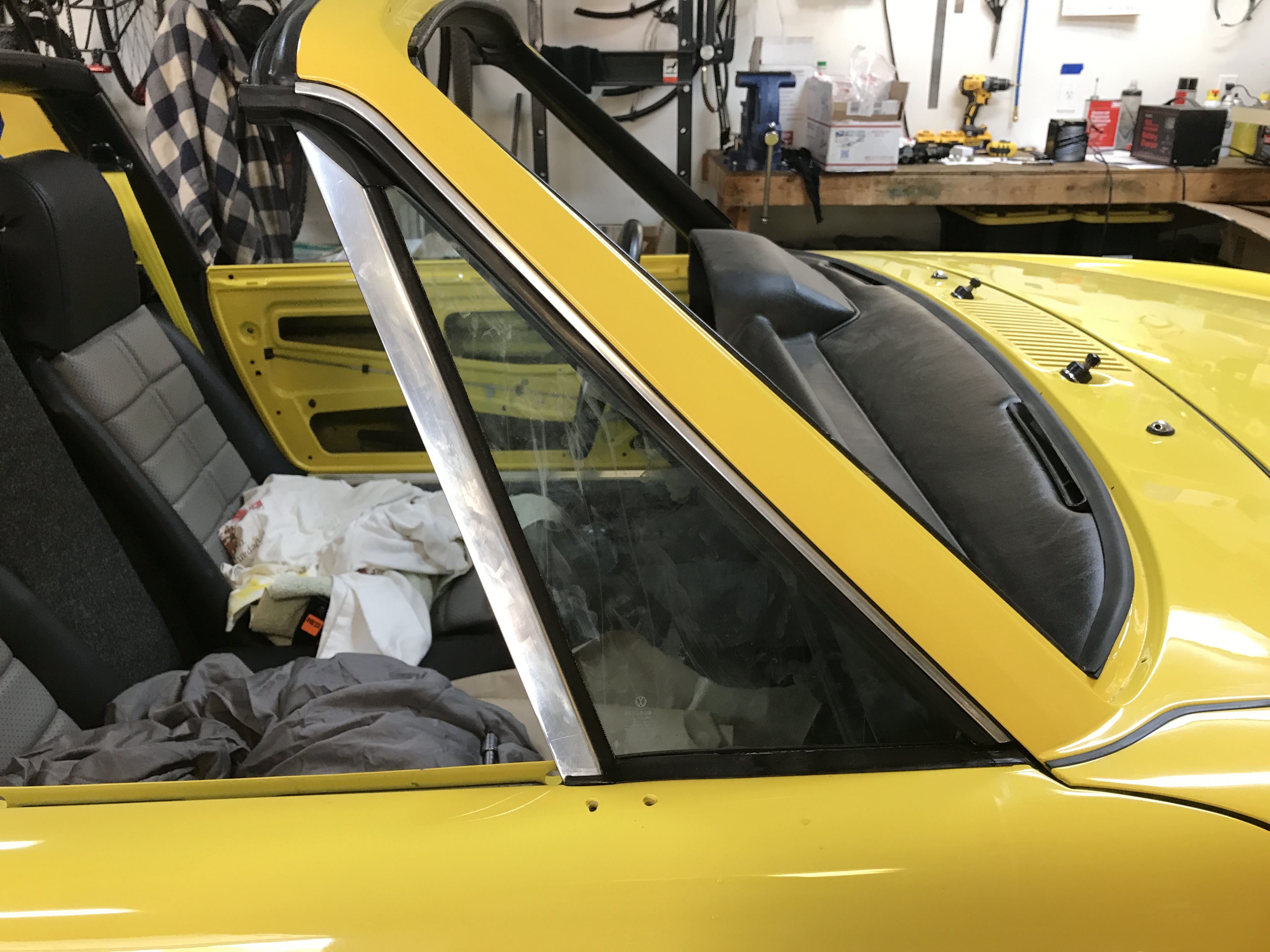

I did a quick adjustment of the alignment, and it looks like a 914 vent window.
Yeah, I know there is no windshield (yet). Working on getting one.

Member No.: 23,343
But there is an annoying gap between the vent window rubber and the A-pillar rubber. More adjustment fun ahead. (IMG:style_emoticons/default/blink.gif)

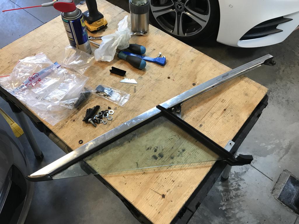

Member No.: 23,343
I got started on the left door, so I can compare the fit to the right side.
When I attached the vent support triangle bracket, I discover that the mounting holes are slotted, so the vent window can be shifted up or down on the main window track. I may need this adjustment on the right side.

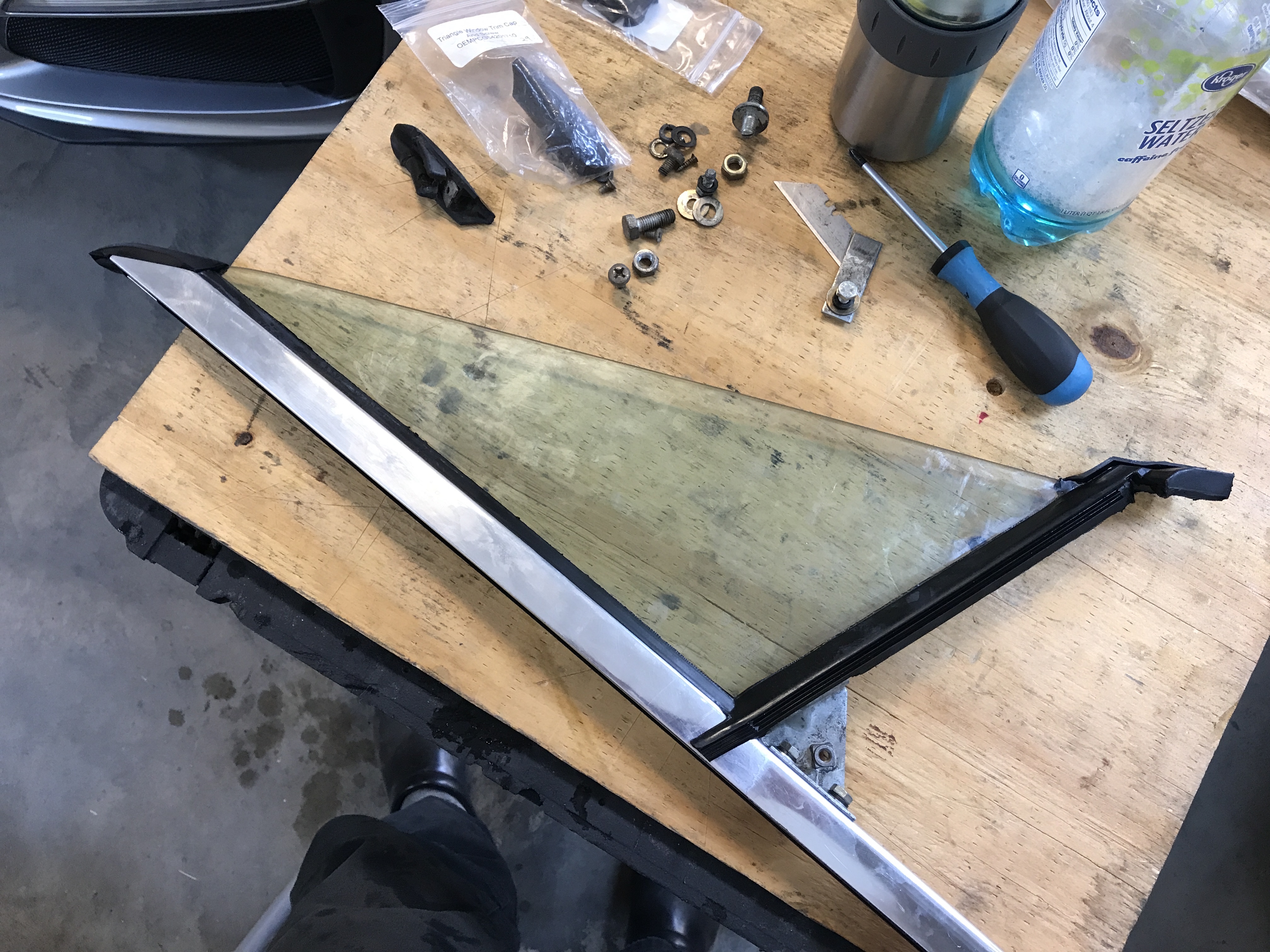

Member No.: 23,343
Left vent window and track ready.

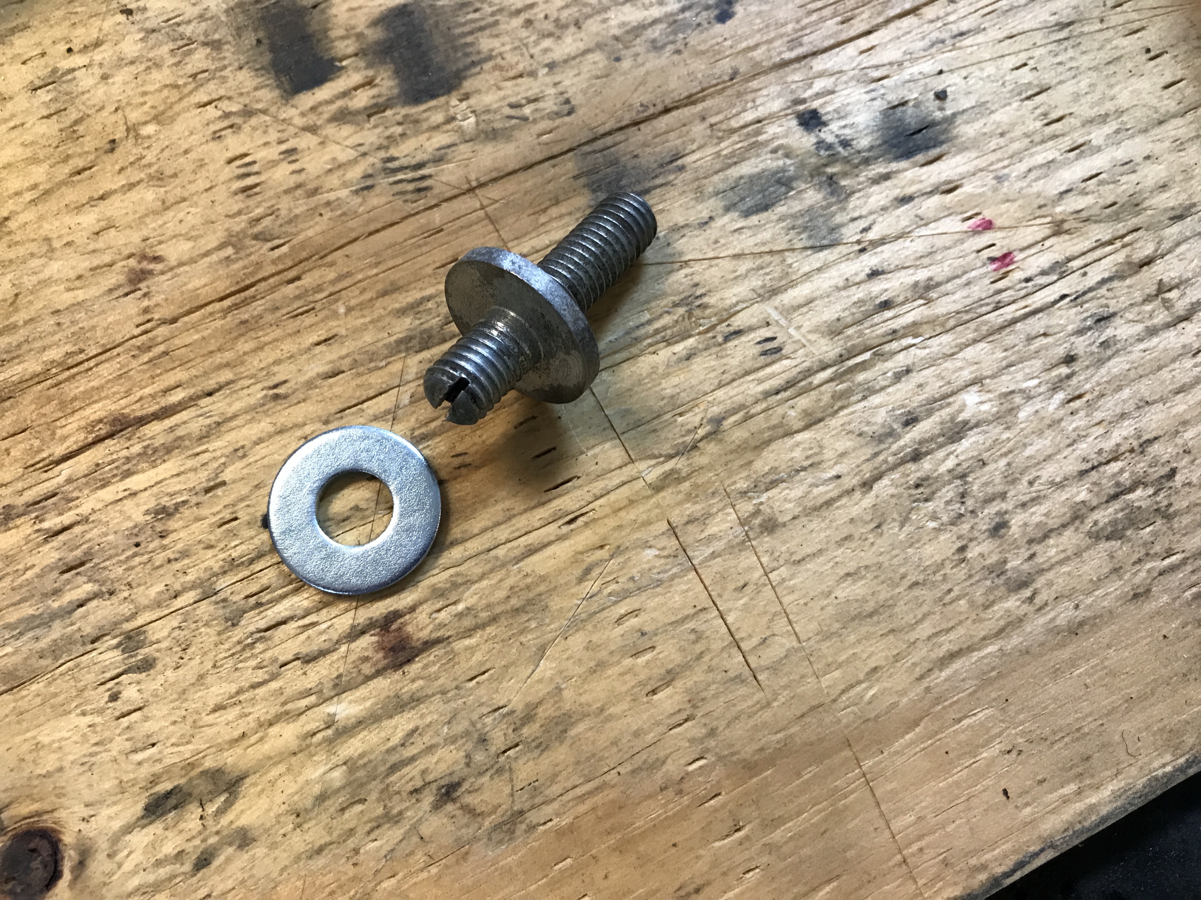

Given how the right side fit, I decided to include a washer between the bottom adjuster and the door.
