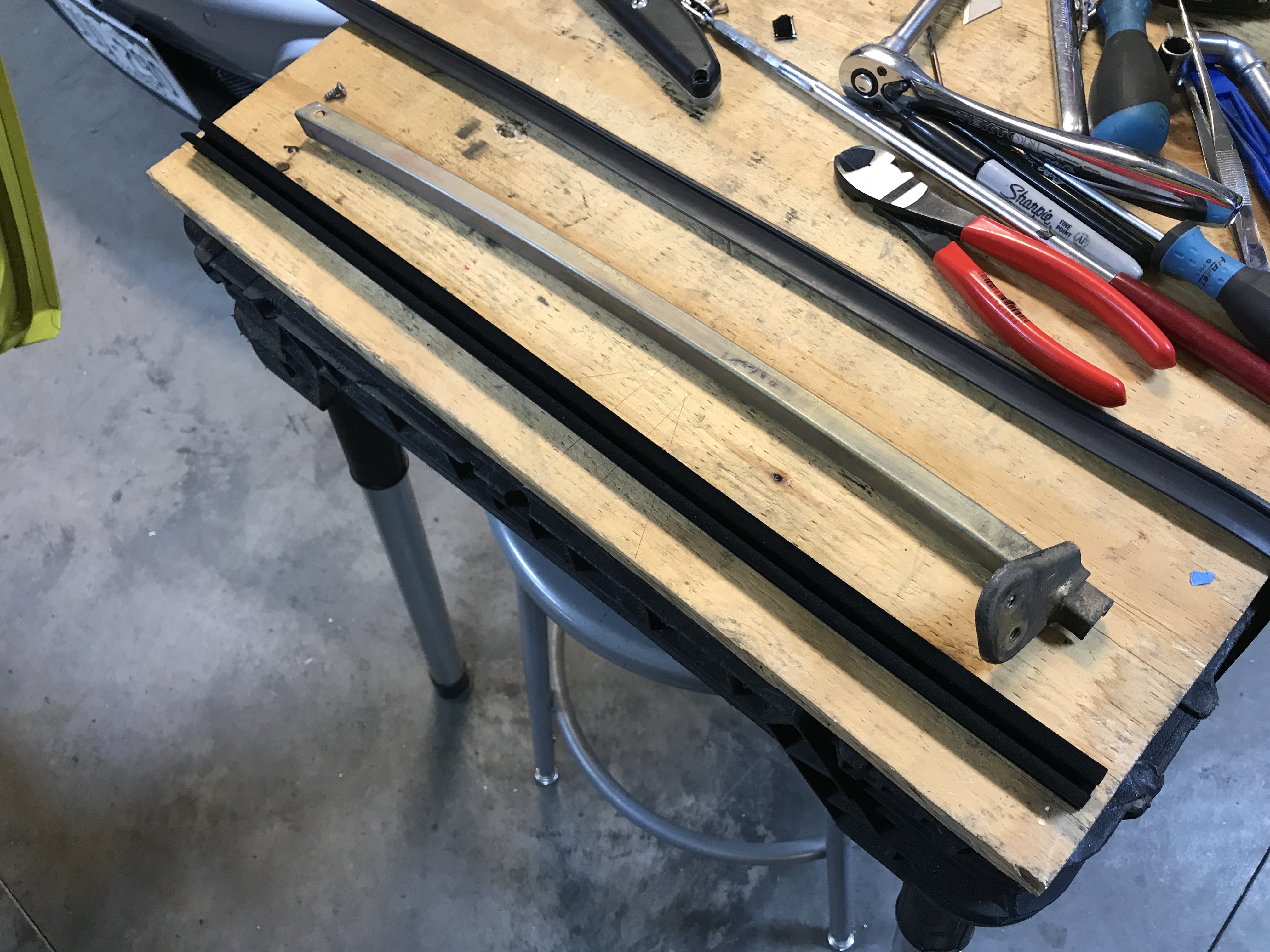

I got the track in the door, but the dinner bell rang before I could bolt it up.

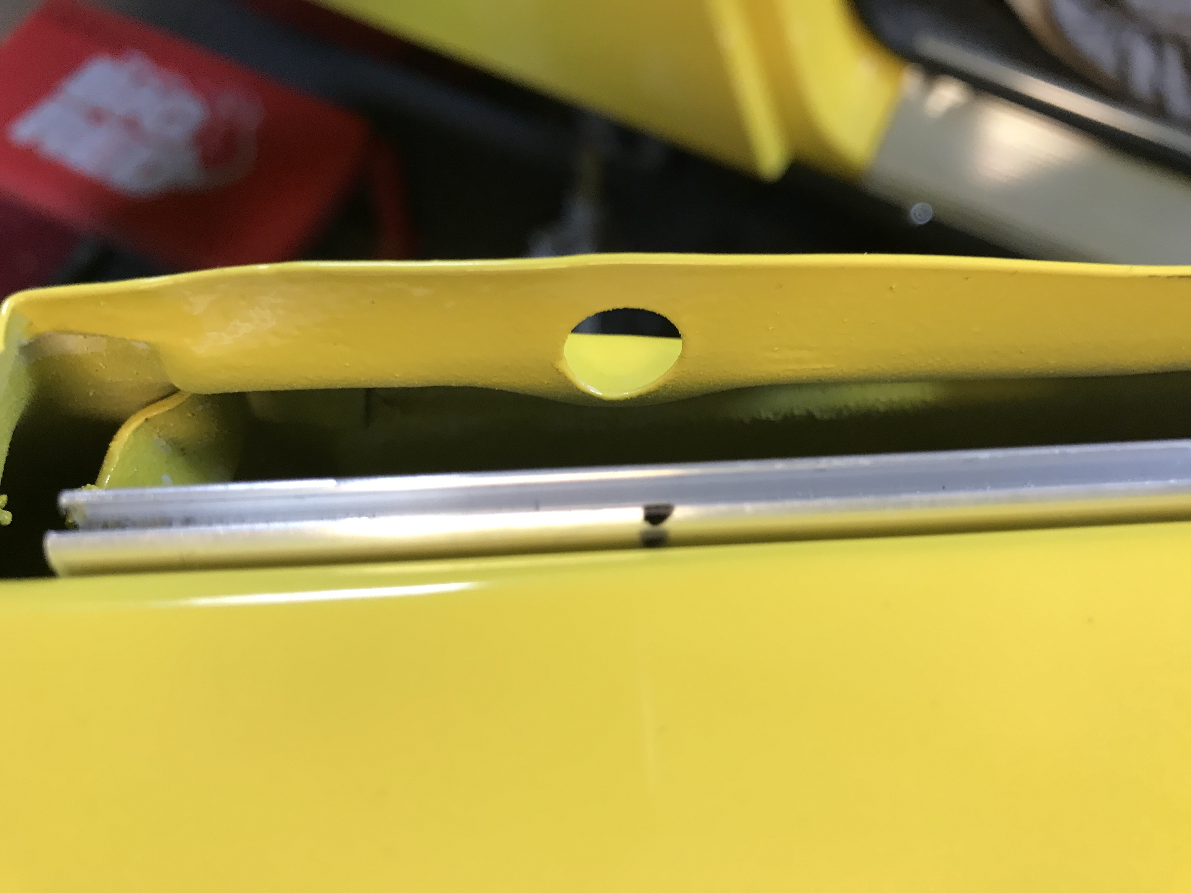

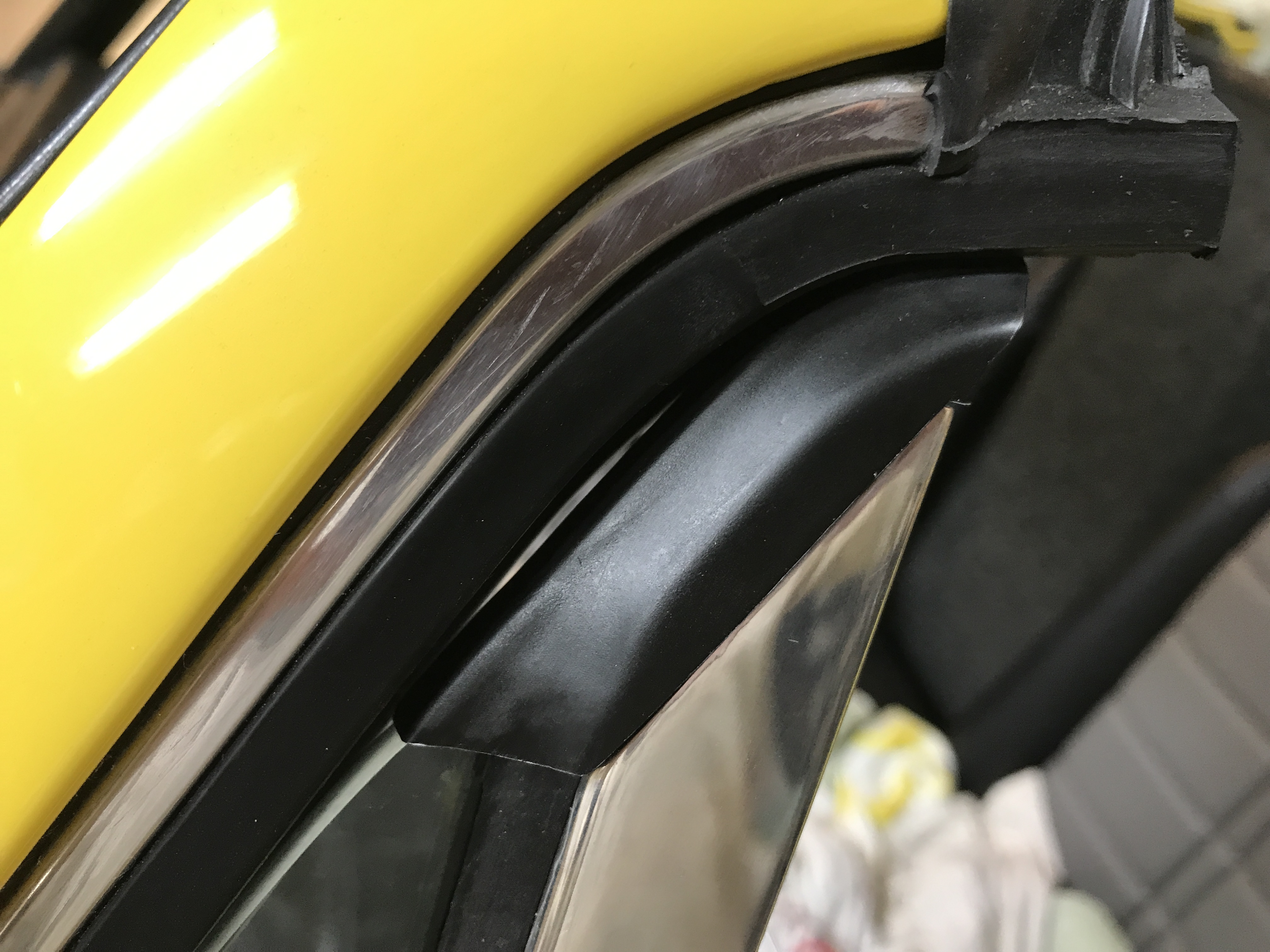

Just a few (more patient) minutes today, and I got the left side front channel bolted in.
bkrantz
post Apr 6 2022, 07:16 PM
Post #4964
Posts: 8,345
Joined: 3-August 19
From: SW Colorado
Member No.: 23,343
Hmm, about the same gap I have on the right side.

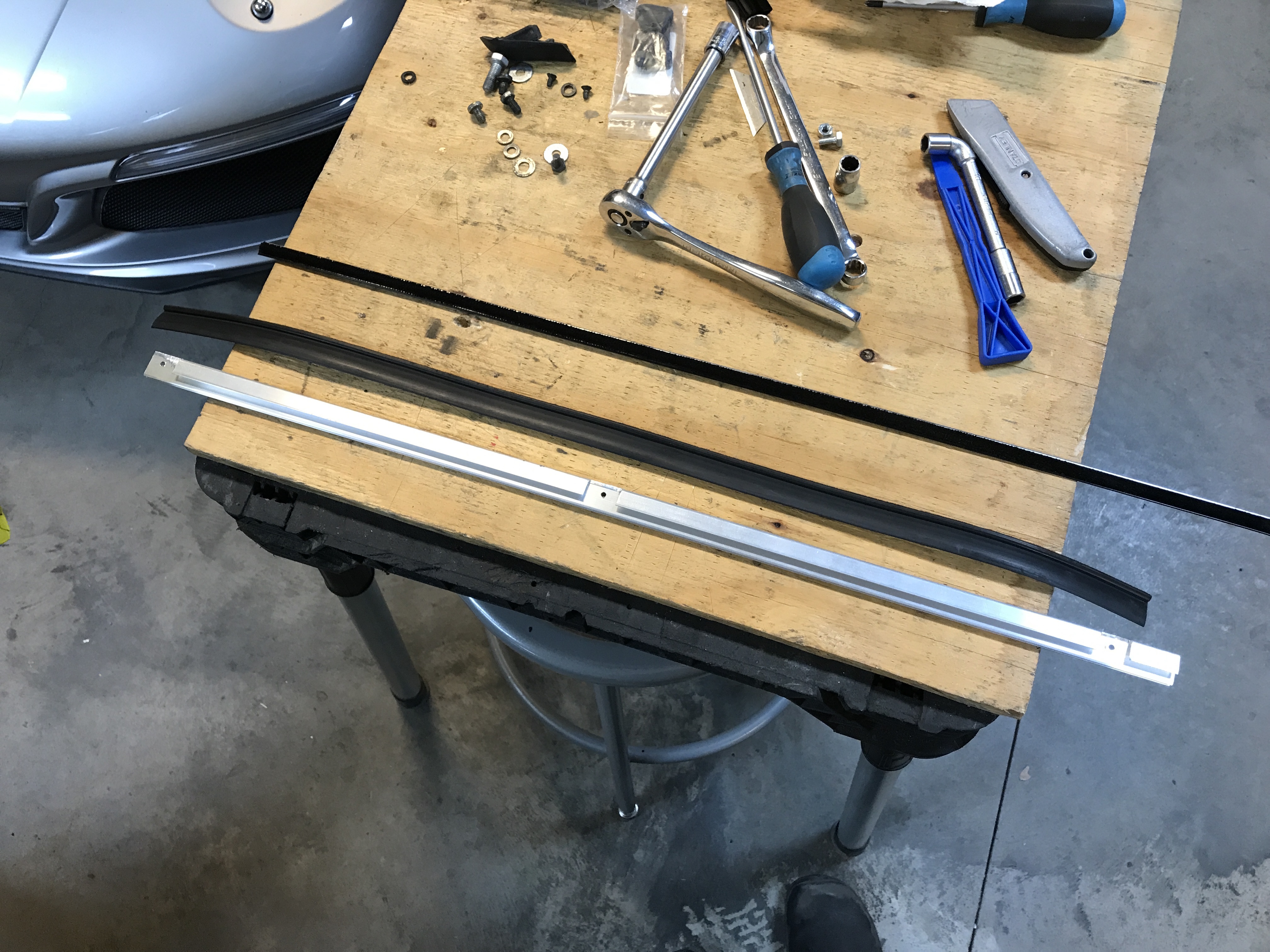

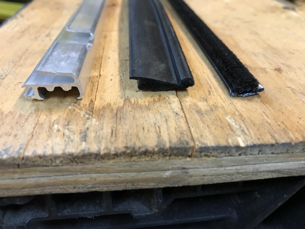

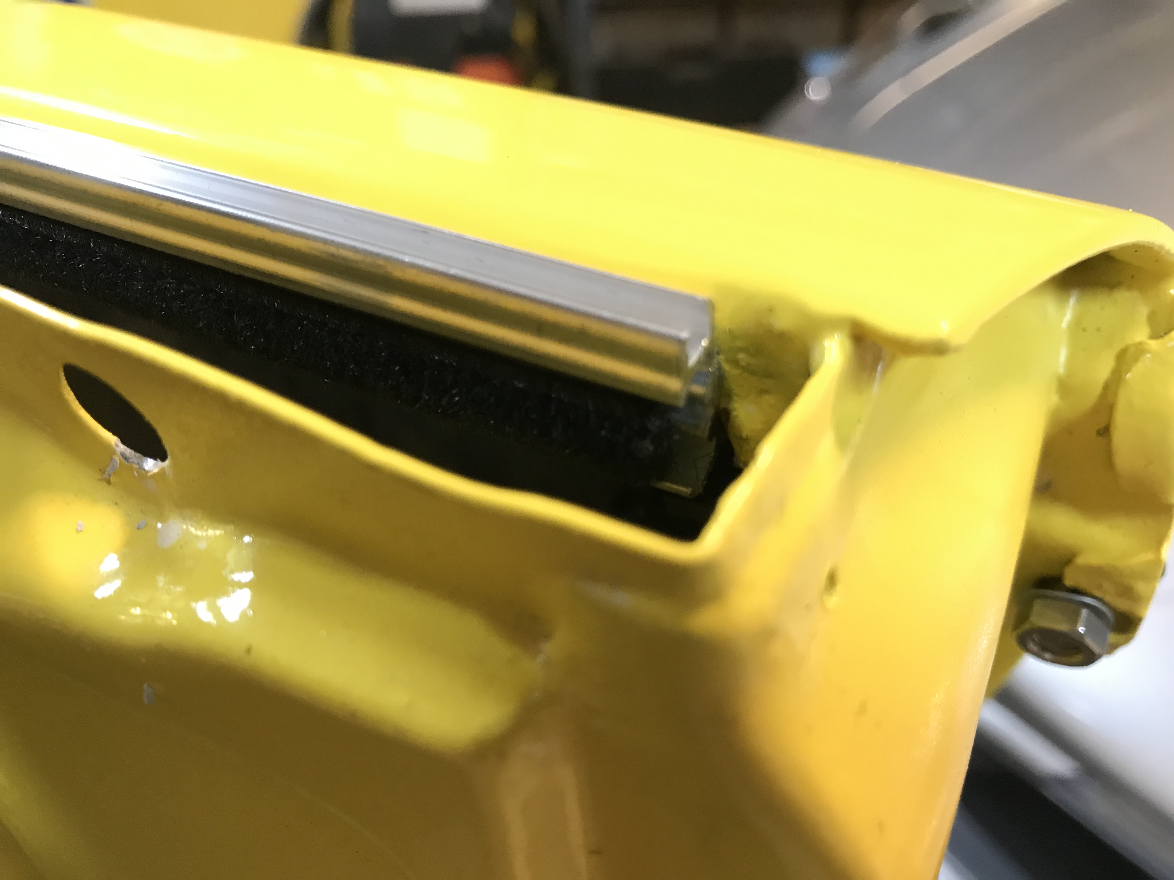

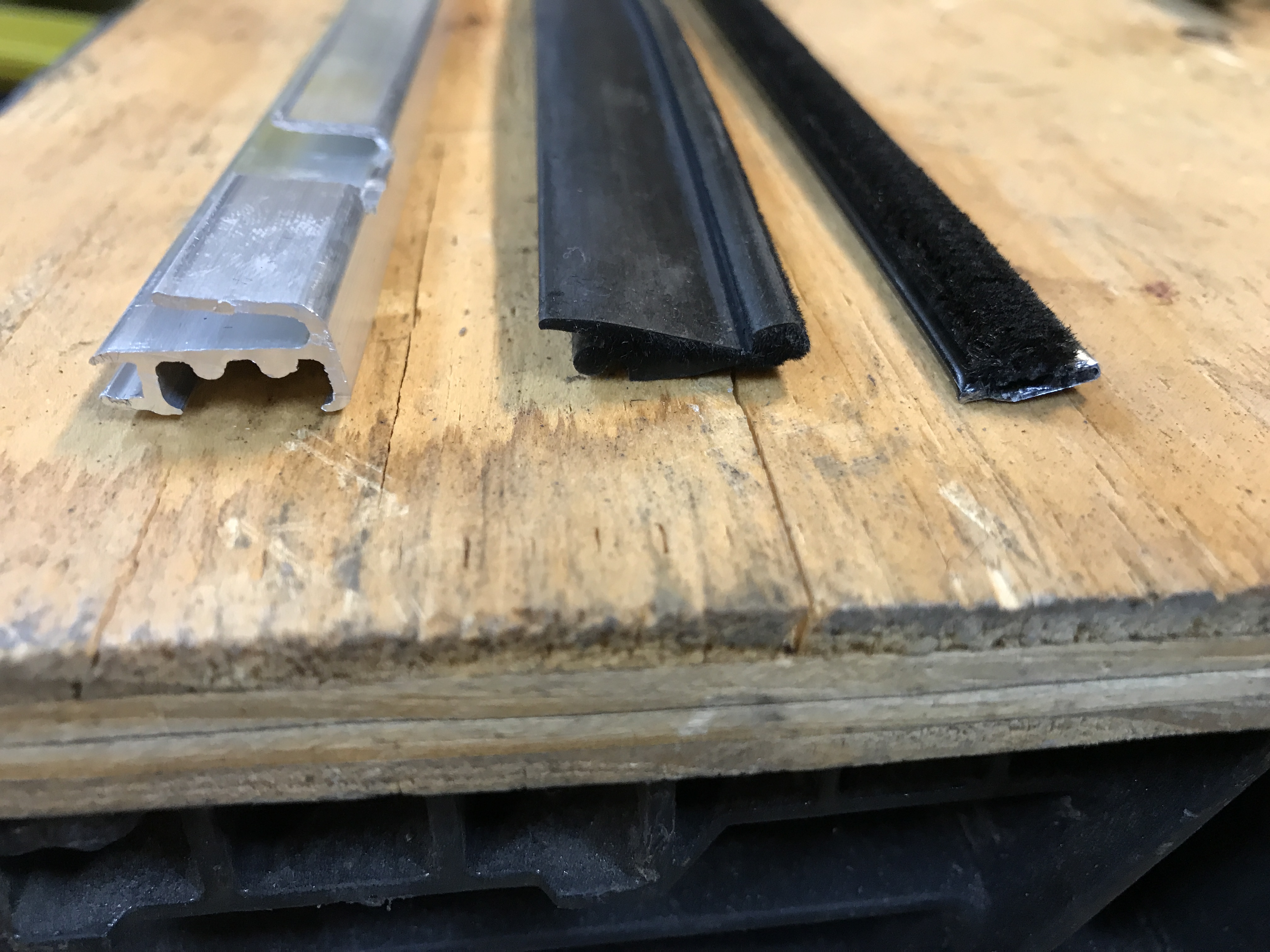

Back to the right side, and prep before the main window. Here are the new aluminum window sill strip, outer fuzzy, and outer scraper.
bkrantz
post Apr 6 2022, 07:22 PM
Post #4966
Posts: 8,345
Joined: 3-August 19
From: SW Colorado
Member No.: 23,343
Another view of the new pieces.
bkrantz
post Apr 6 2022, 07:24 PM
Post #4967
Posts: 8,345
Joined: 3-August 19
From: SW Colorado
Member No.: 23,343

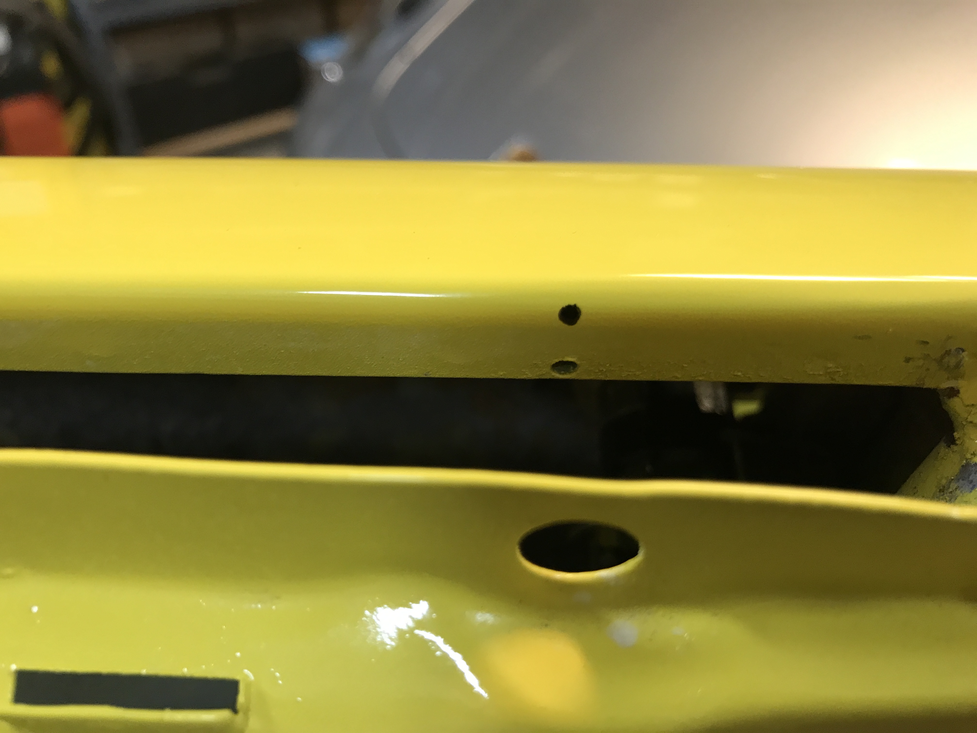

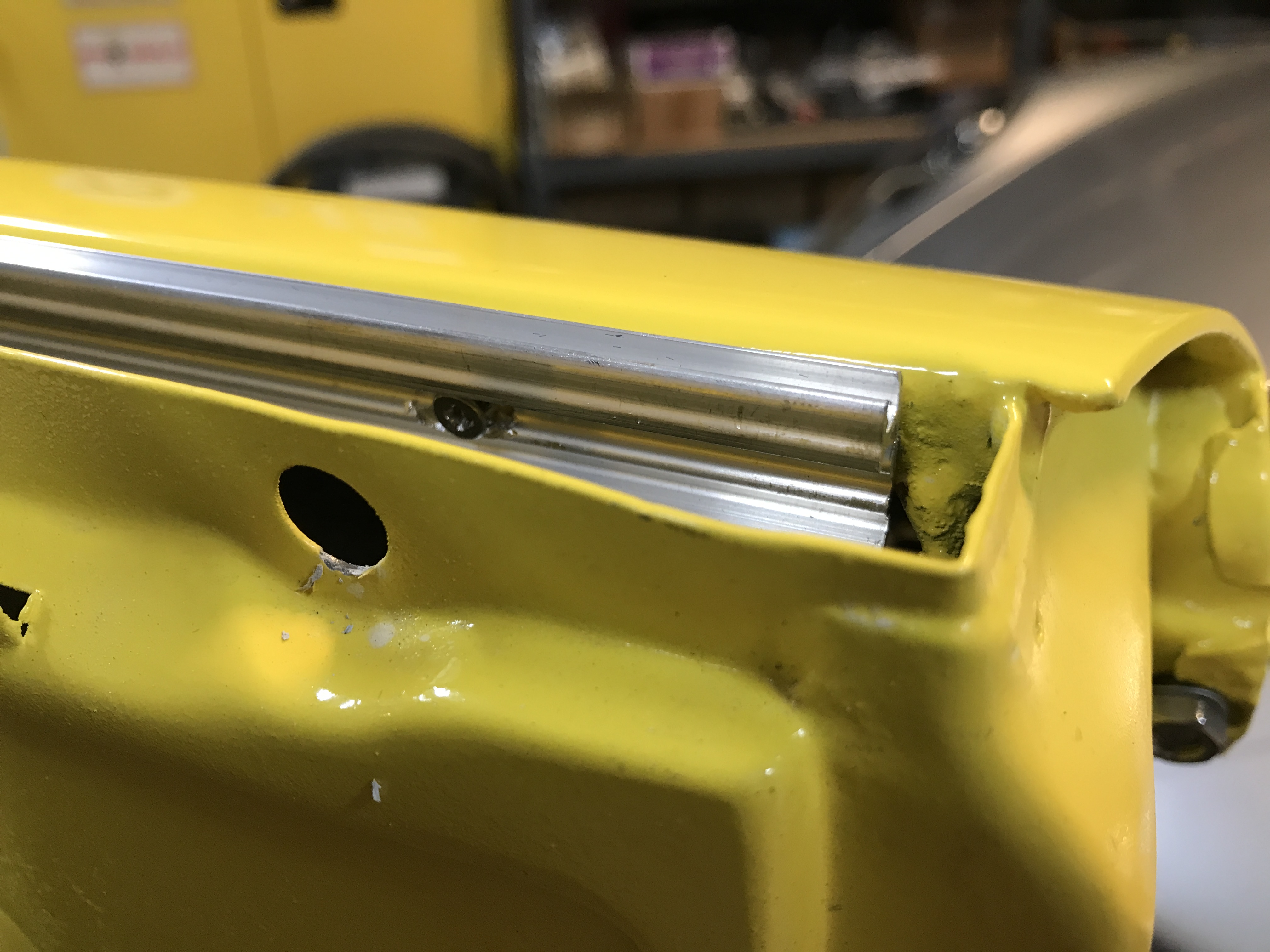

Of course, the pre-drilled holes in the sill do not line up with the existing holes in the door, so I need to locate new holes in the sill. Step 1, mark the locations of the holes in the door (and yes, that is erasable marker--I hope).
bkrantz
post Apr 6 2022, 07:25 PM
Post #4968
Posts: 8,345
Joined: 3-August 19
From: SW Colorado
Member No.: 23,343

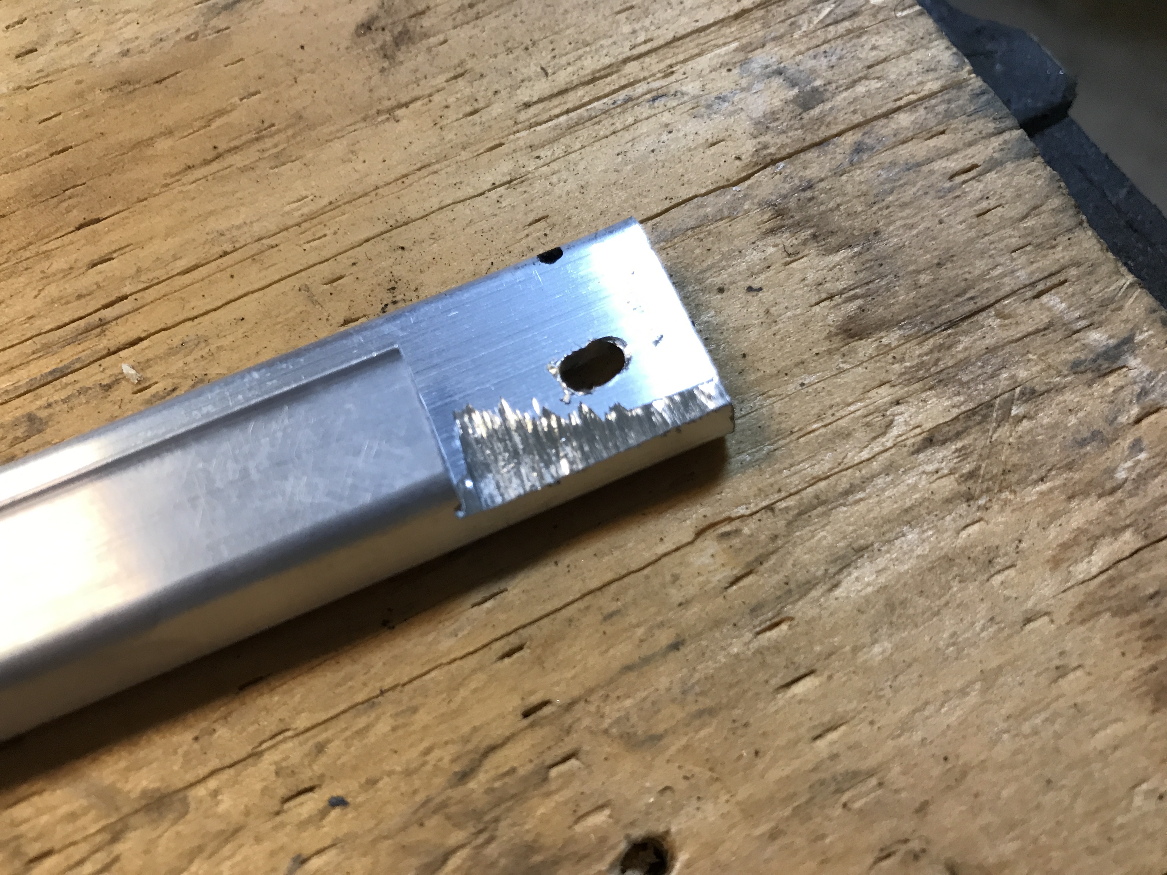

Step 2: transfer the hole locations to the new sill strip.
bkrantz
Post #4969
Posts: 8,345
Joined: 3-August 19
From: SW Colorado
Member No.: 23,343
Step 3: mark the new holes.
bkrantz
post Apr 6 2022, 07:26 PM
Post #4970
Posts: 8,345
Joined: 3-August 19
From: SW Colorado
Member No.: 23,343

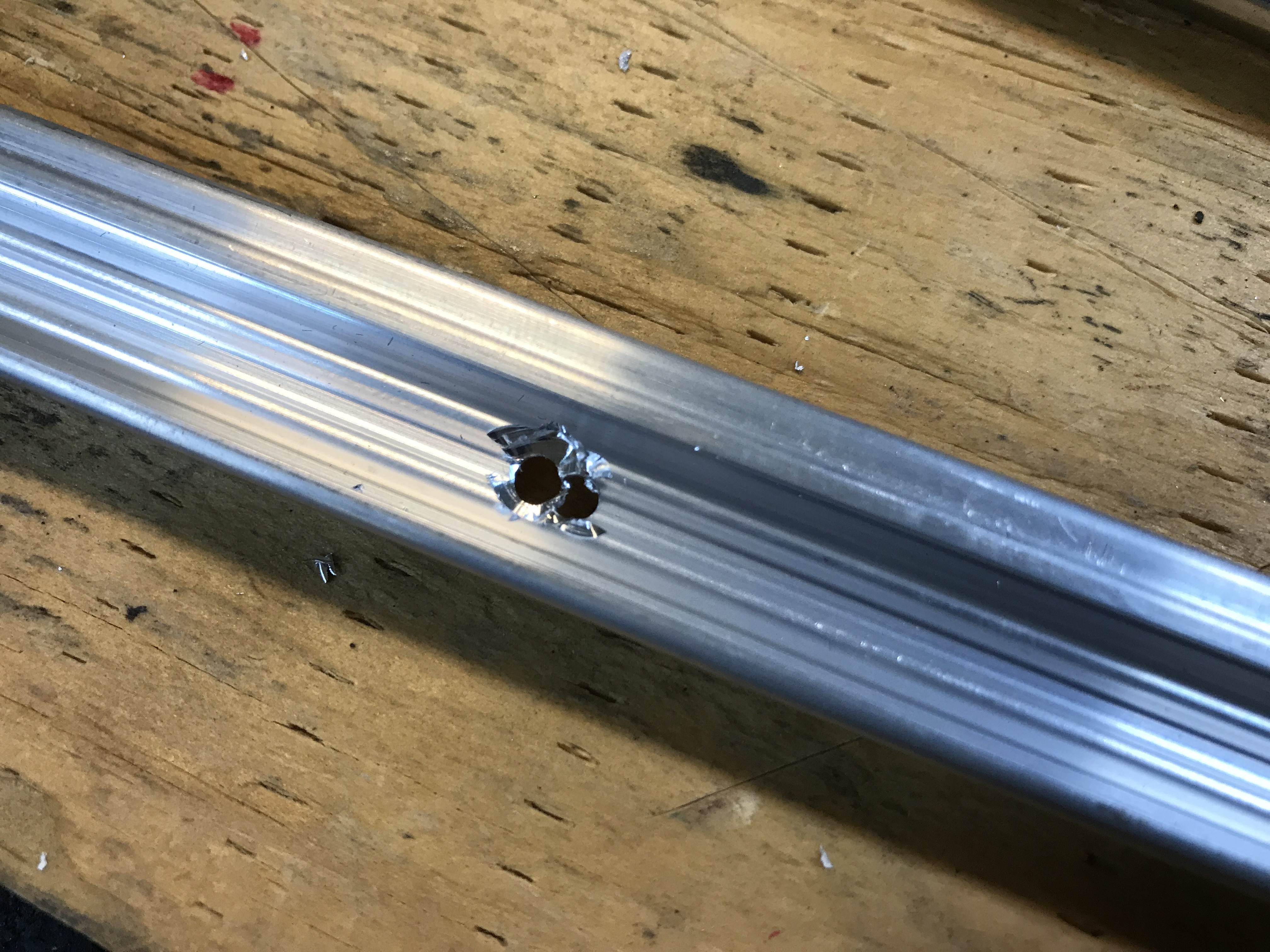

Step 4: drill new holes.
bkrantz
post Apr 6 2022, 07:27 PM
Post #4971
Posts: 8,345
Joined: 3-August 19
From: SW Colorado
Member No.: 23,343
Step 5: counter-sink the holes, so the screw heads will sit below the outer fuzzy when installed.
bkrantz
post Apr 6 2022, 07:28 PM
Post #4972
Posts: 8,345
Joined: 3-August 19
From: SW Colorado
Member No.: 23,343

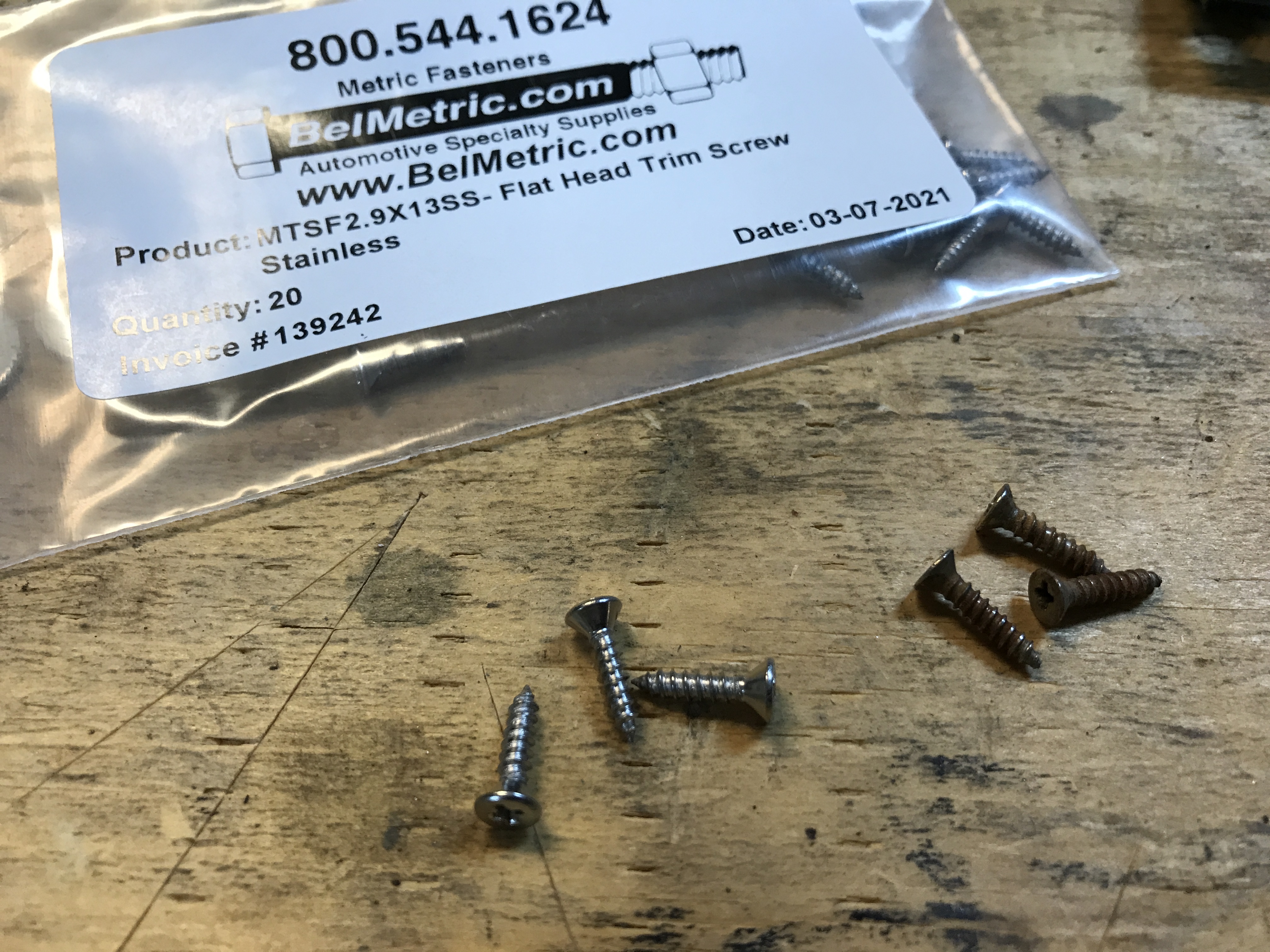

New stainless screws.
bkrantz
post Apr 6 2022, 07:29 PM
Post #4973
Posts: 8,345
Joined: 3-August 19
From: SW Colorado
Member No.: 23,343
Step 6: install the strip with new screws.
bkrantz
post Apr 6 2022, 07:30 PM
Post #4974
Posts: 8,345
Joined: 3-August 19
From: SW Colorado
Member No.: 23,343
Step 7: insert the outer fuzzy (it pops into the groove in the sill strip).
bkrantz
post Apr 6 2022, 07:31 PM
Post #4975
Posts: 8,345
Joined: 3-August 19
From: SW Colorado
Member No.: 23,343

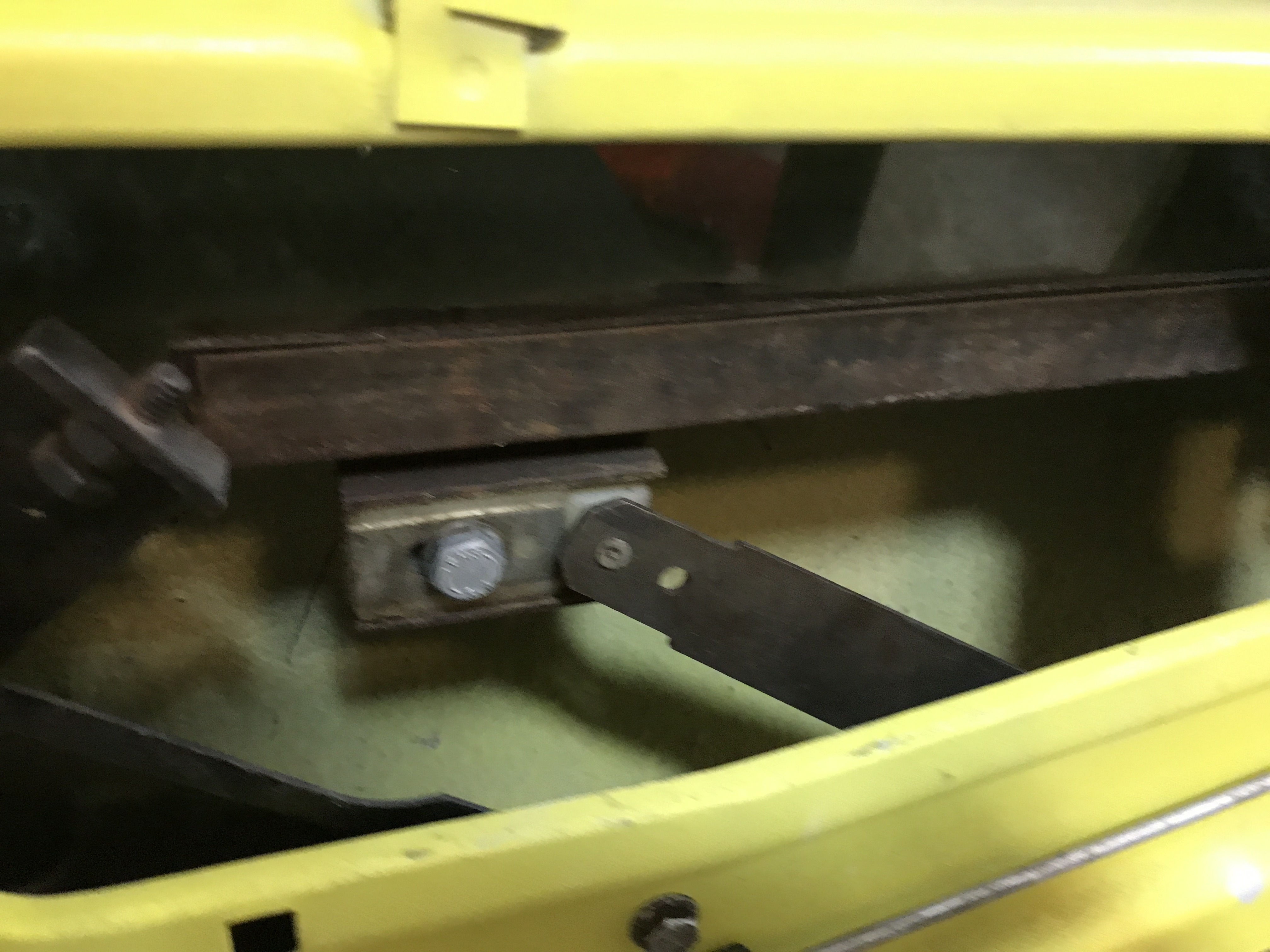

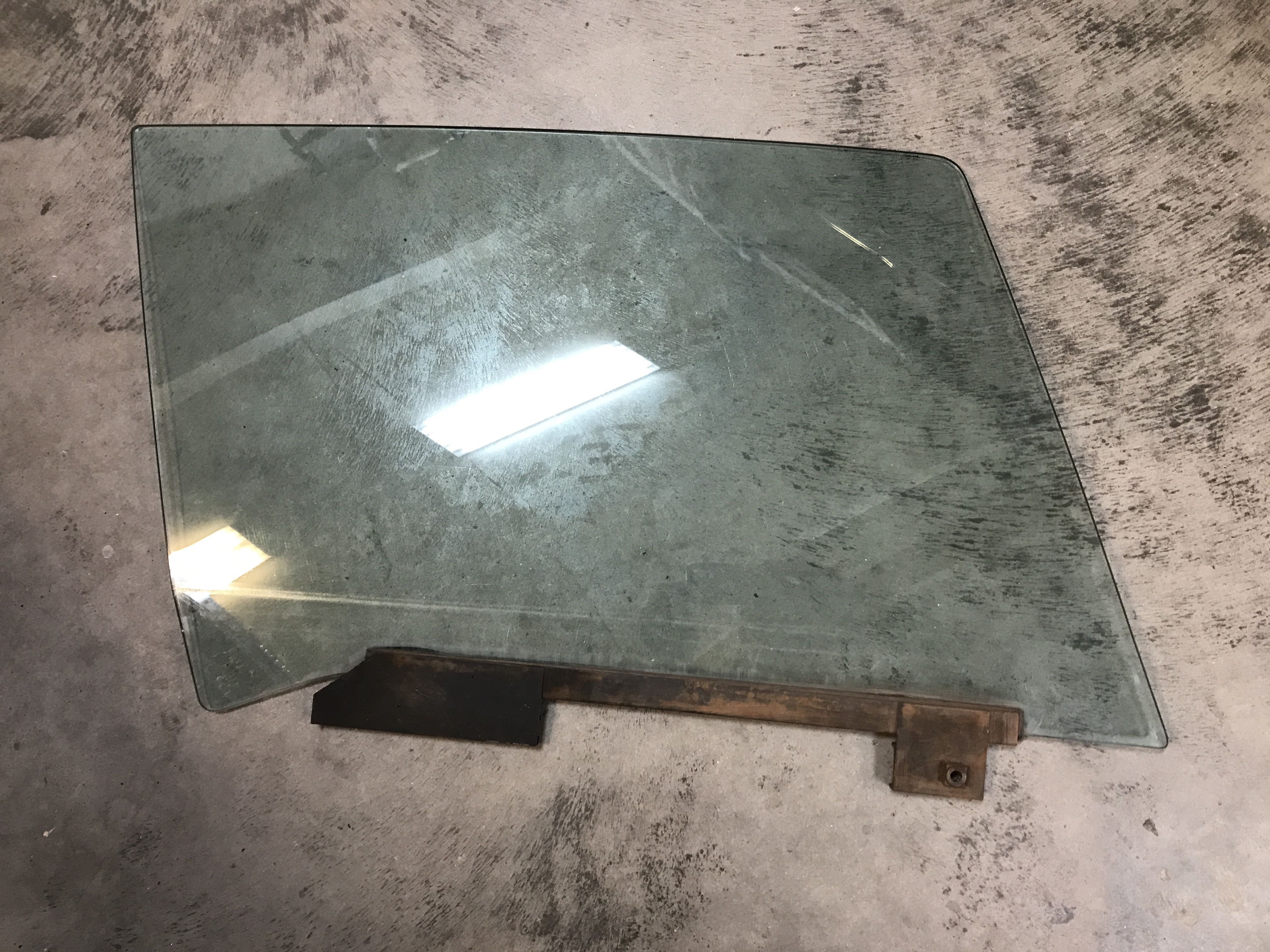

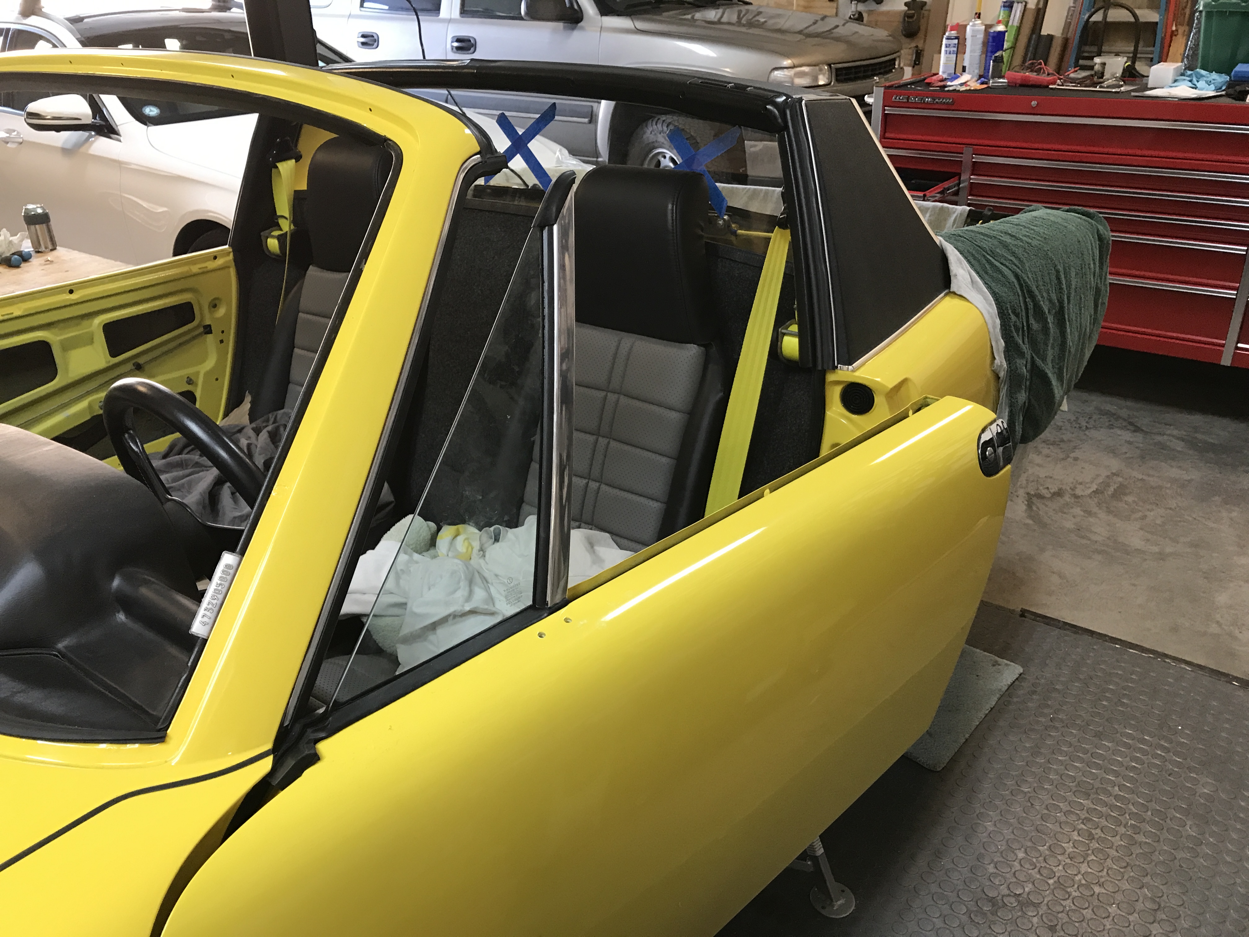

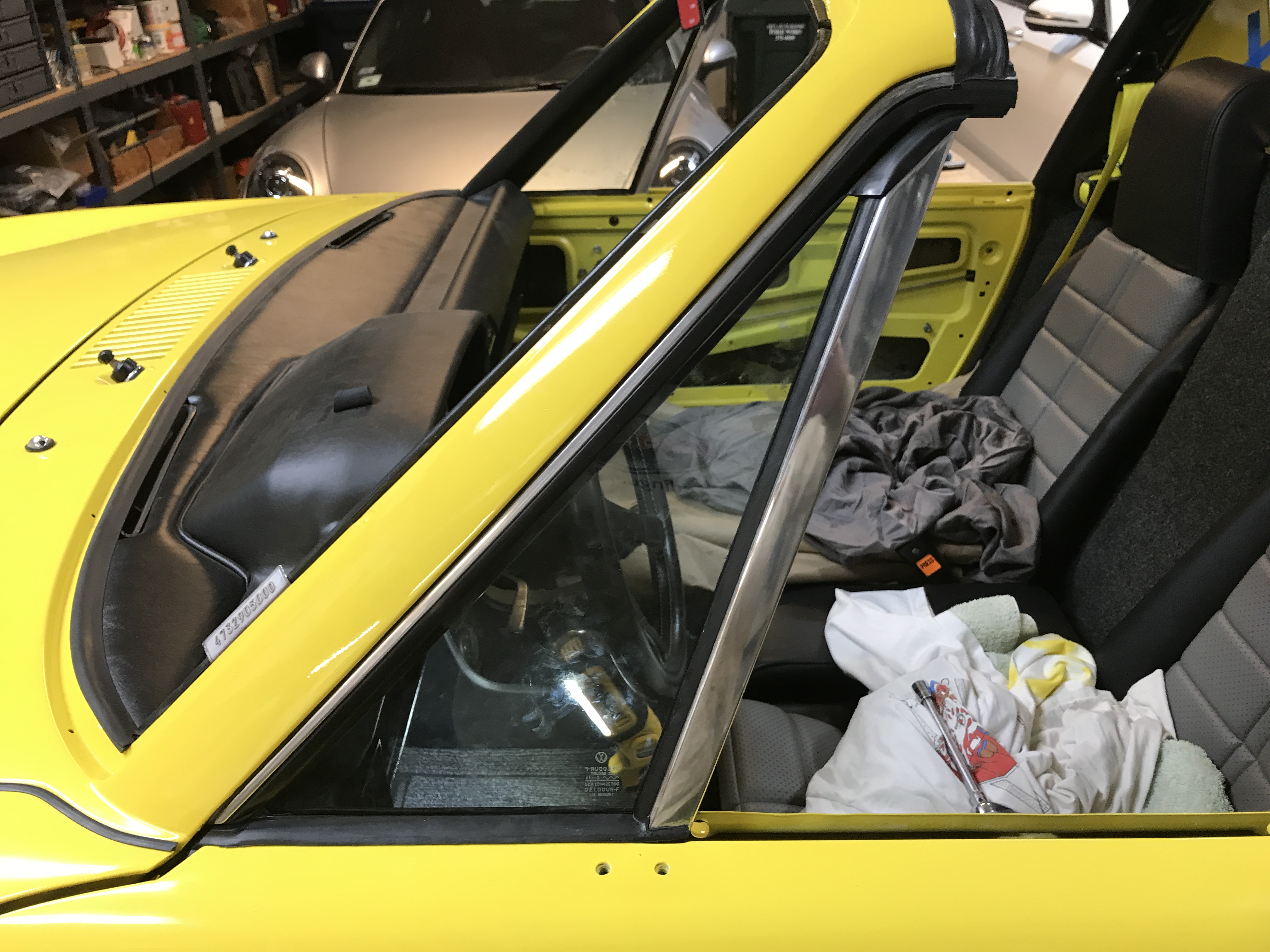

Time for the main window. Definitely tinted glass (one of the original options listed on the COA).
bkrantz
post Apr 6 2022, 07:34 PM
Post #4976
Posts: 8,345
Joined: 3-August 19
From: SW Colorado
Member No.: 23,343

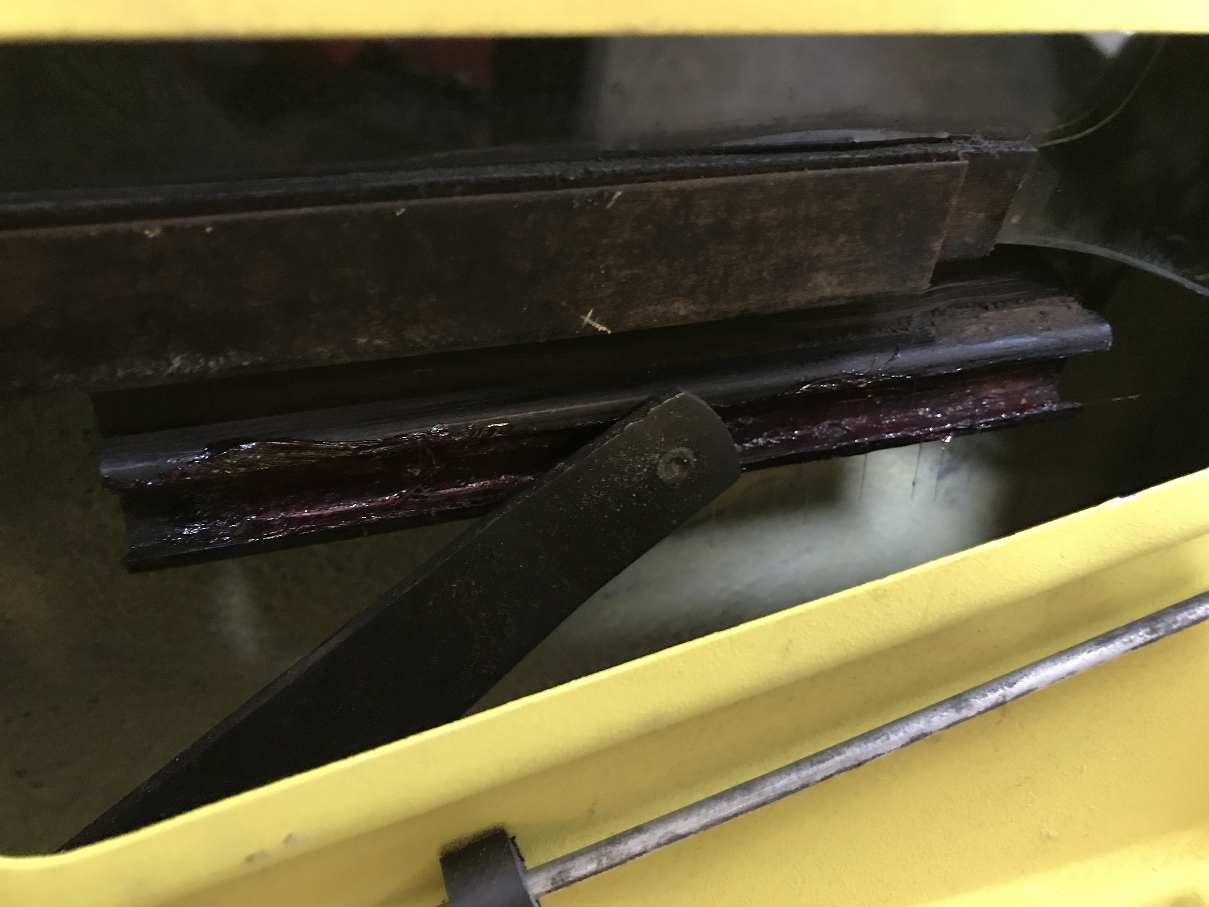

As many know, it takes a bit of wiggling, twisting, and swearing to get the glass in place and locate the sliding pivot in the track (with new grease).
bkrantz
post Apr 6 2022, 07:35 PM
Post #4977
Posts: 8,345
Joined: 3-August 19
From: SW Colorado
Member No.: 23,343

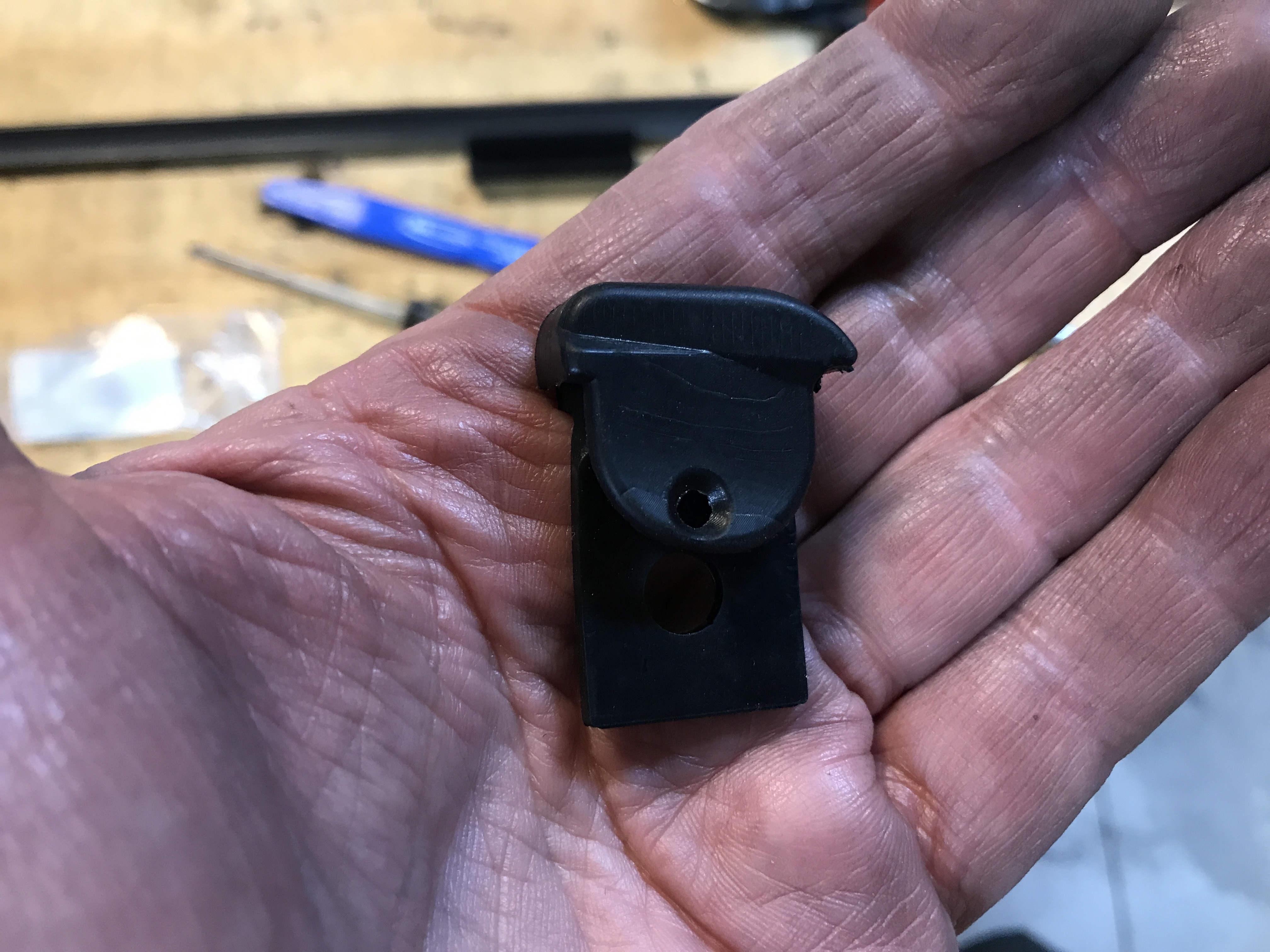

Then bolt the front pivot block into its seat on the window metal.
bkrantz
post Apr 6 2022, 07:38 PM
Post #4978
Posts: 8,345
Joined: 3-August 19
From: SW Colorado
Member No.: 23,343

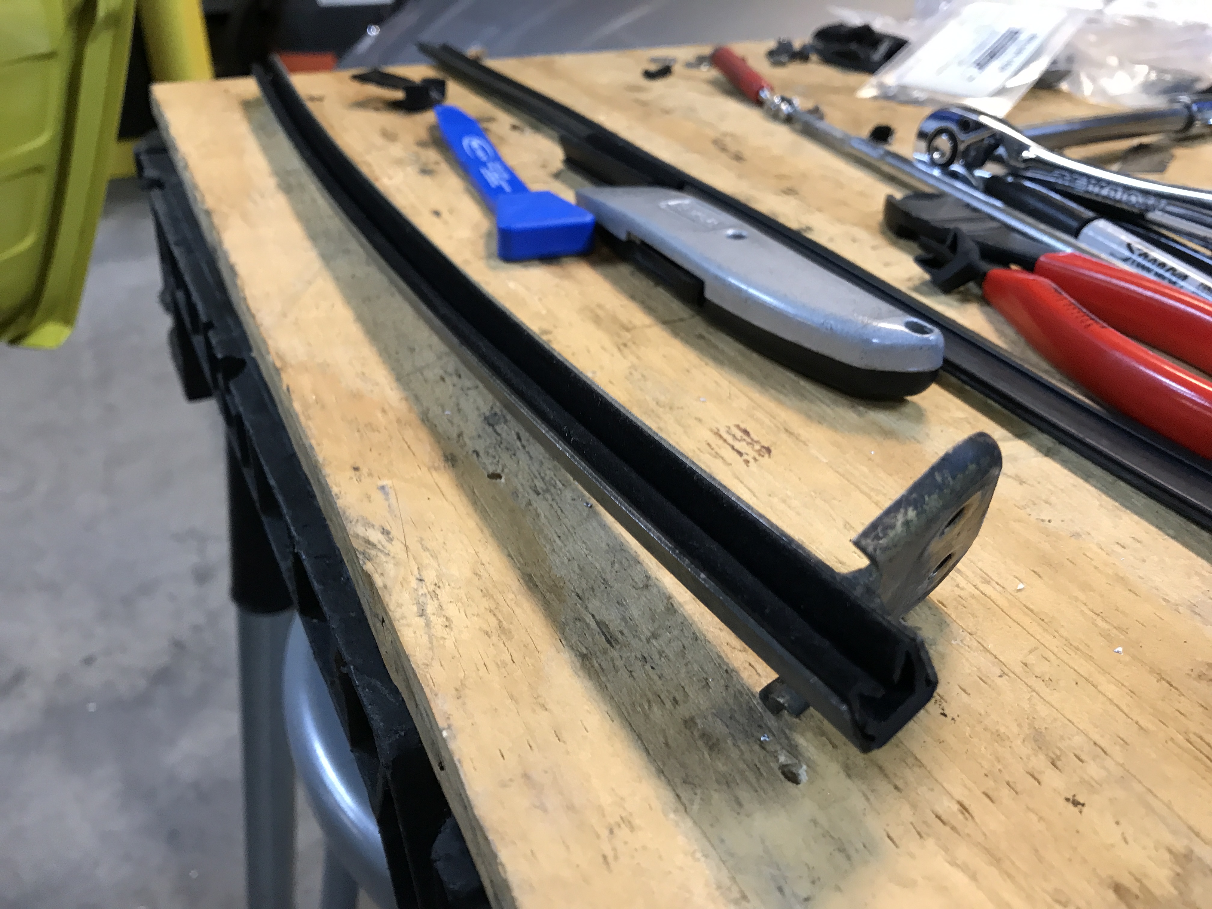

Next, the rear window channel, and new channel fuzzy.
bkrantz
Post #4979
Posts: 8,345
Joined: 3-August 19
From: SW Colorado
Member No.: 23,343
Fuzzy installed in channel, and trimmed to length.

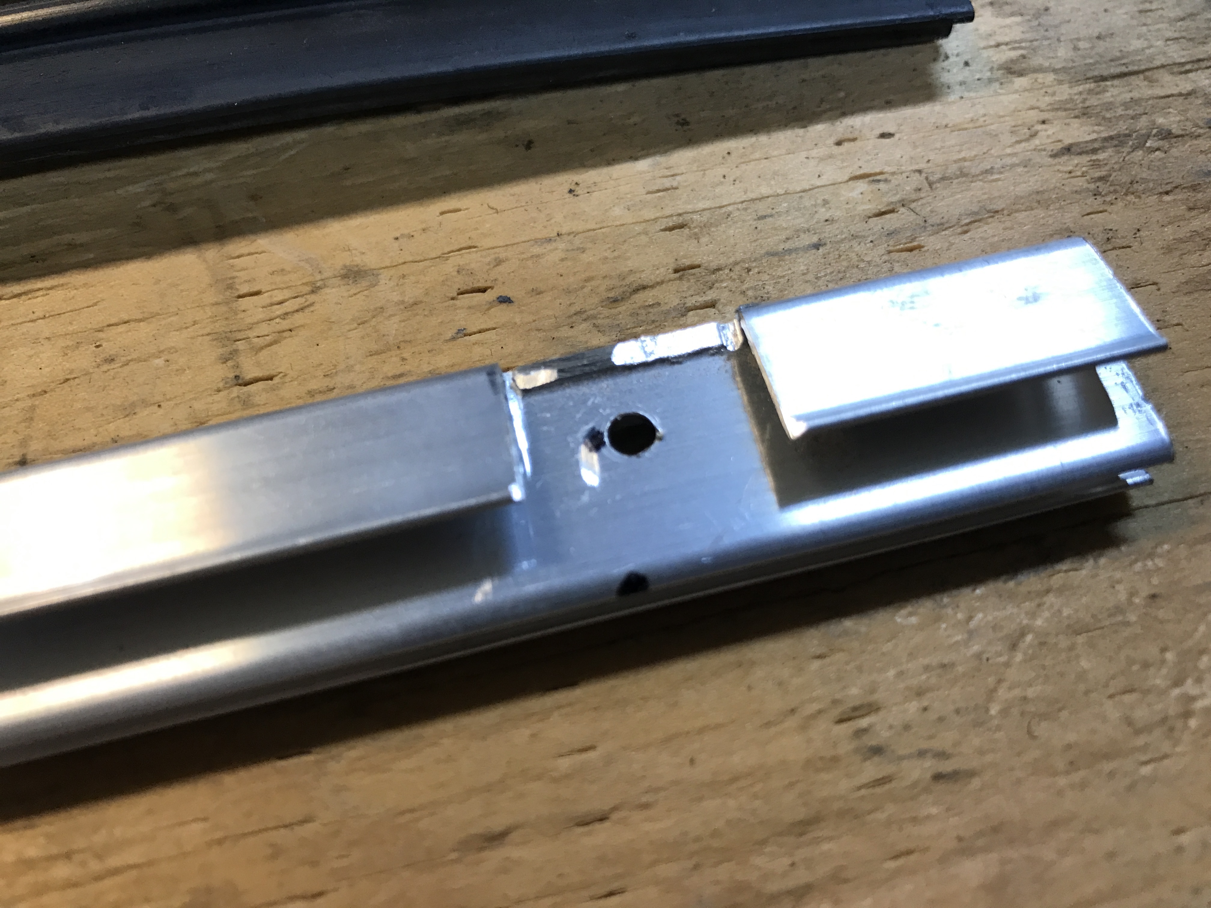

New rear channel cap.
