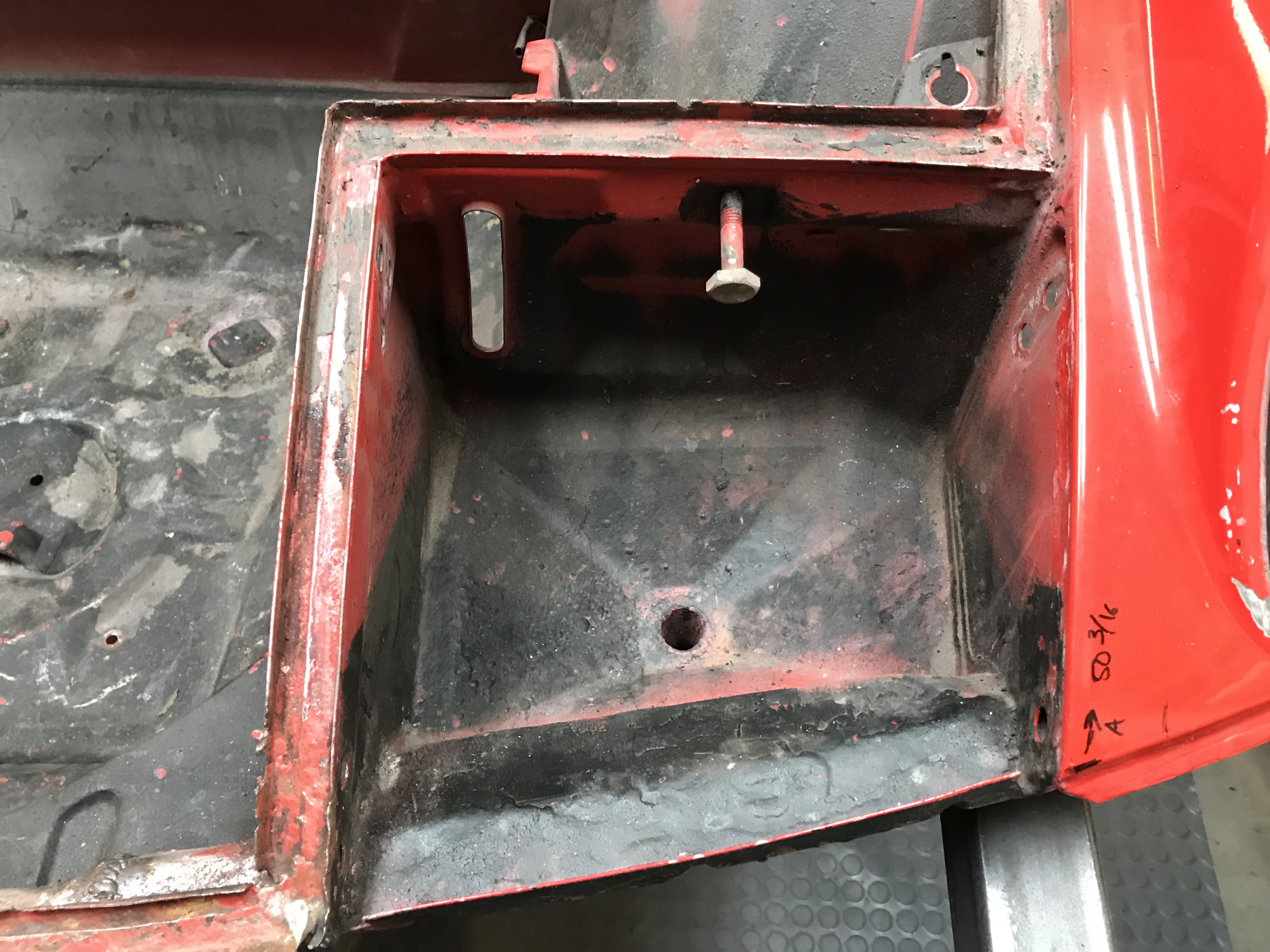

post Apr 18 2020, 08:50 PM
Post #502
Posts: 8,342
Detail:

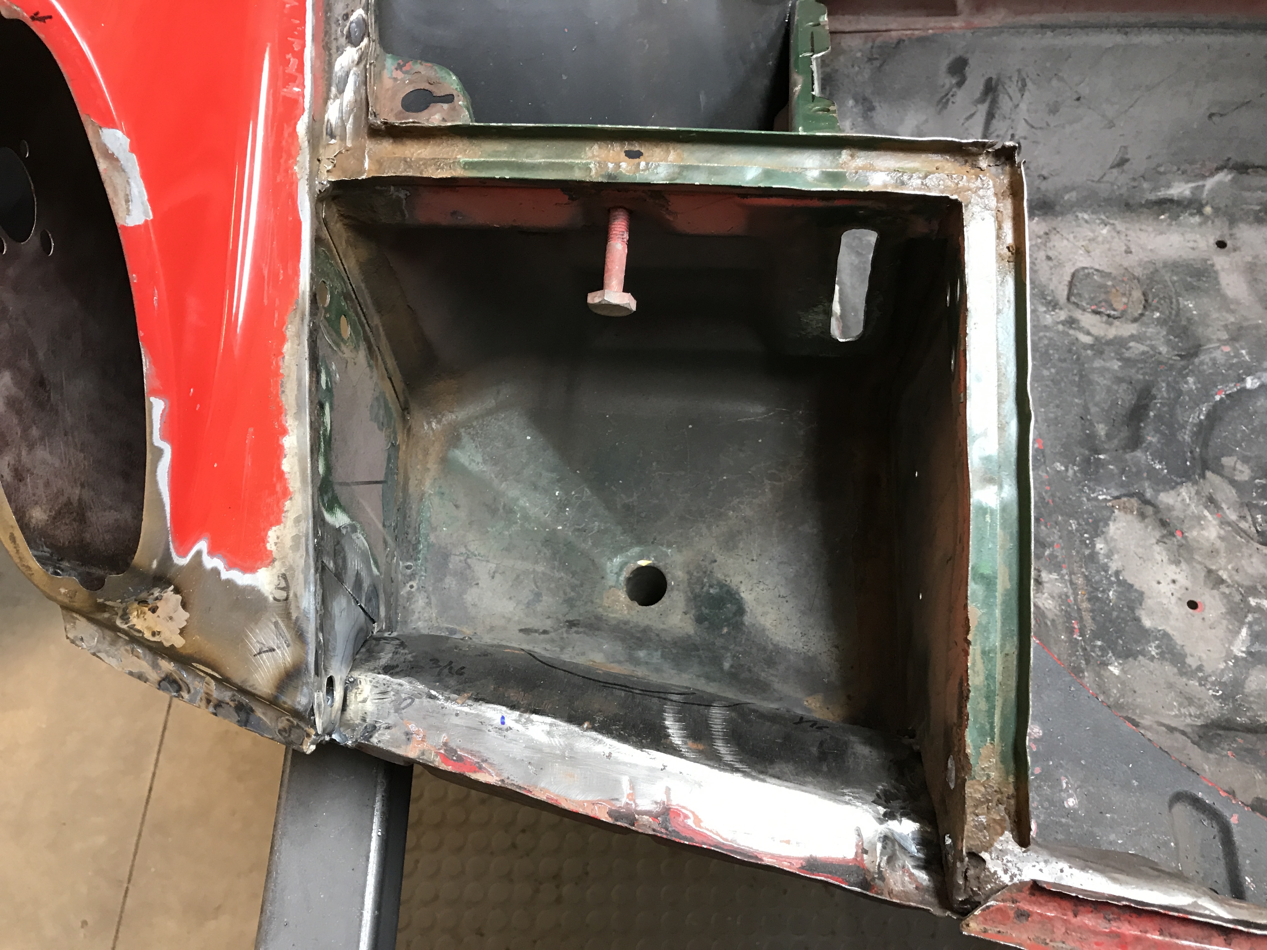

post Apr 18 2020, 08:51 PM
Post #503
Posts: 8,342
Right headlight box:

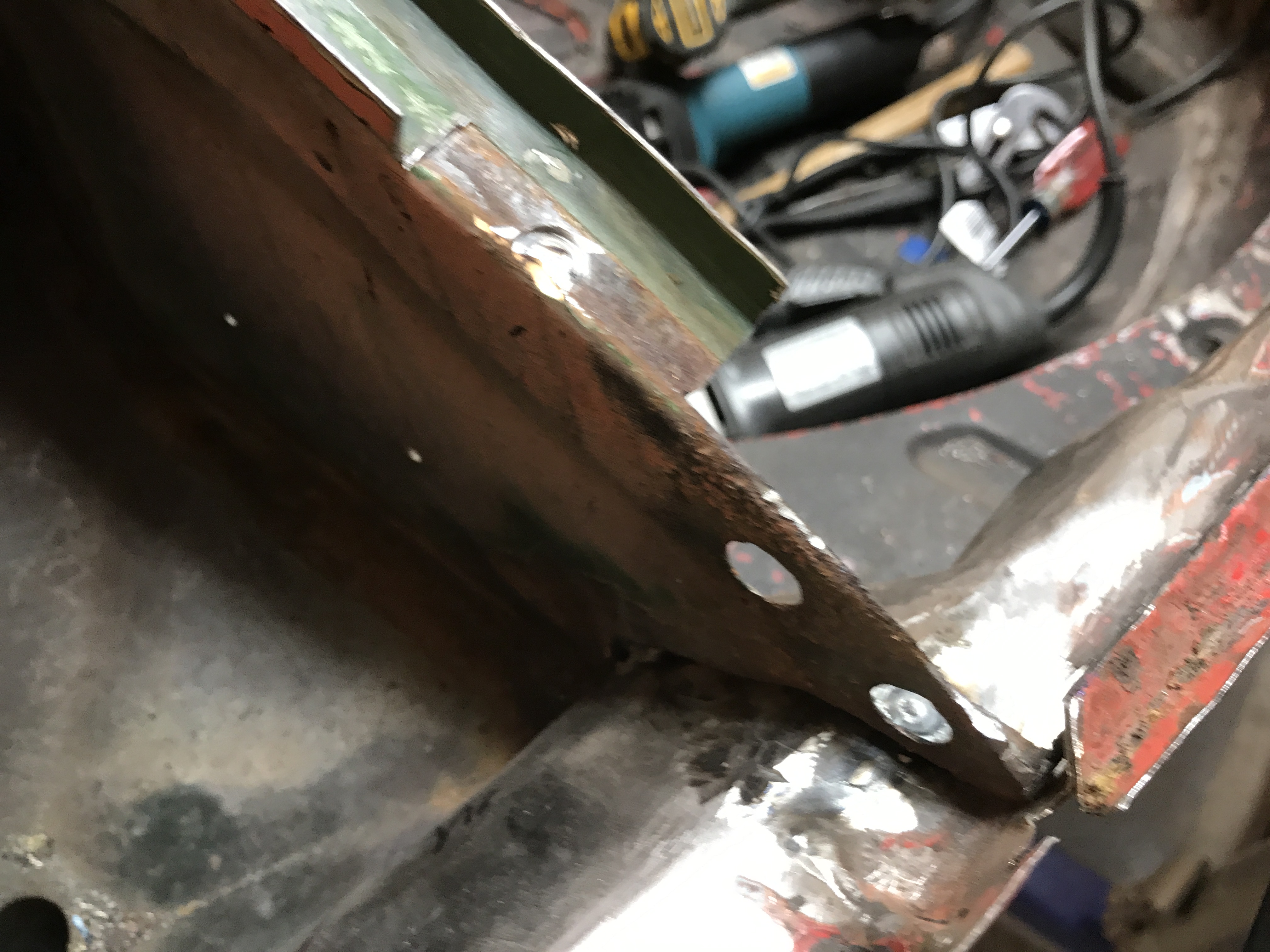

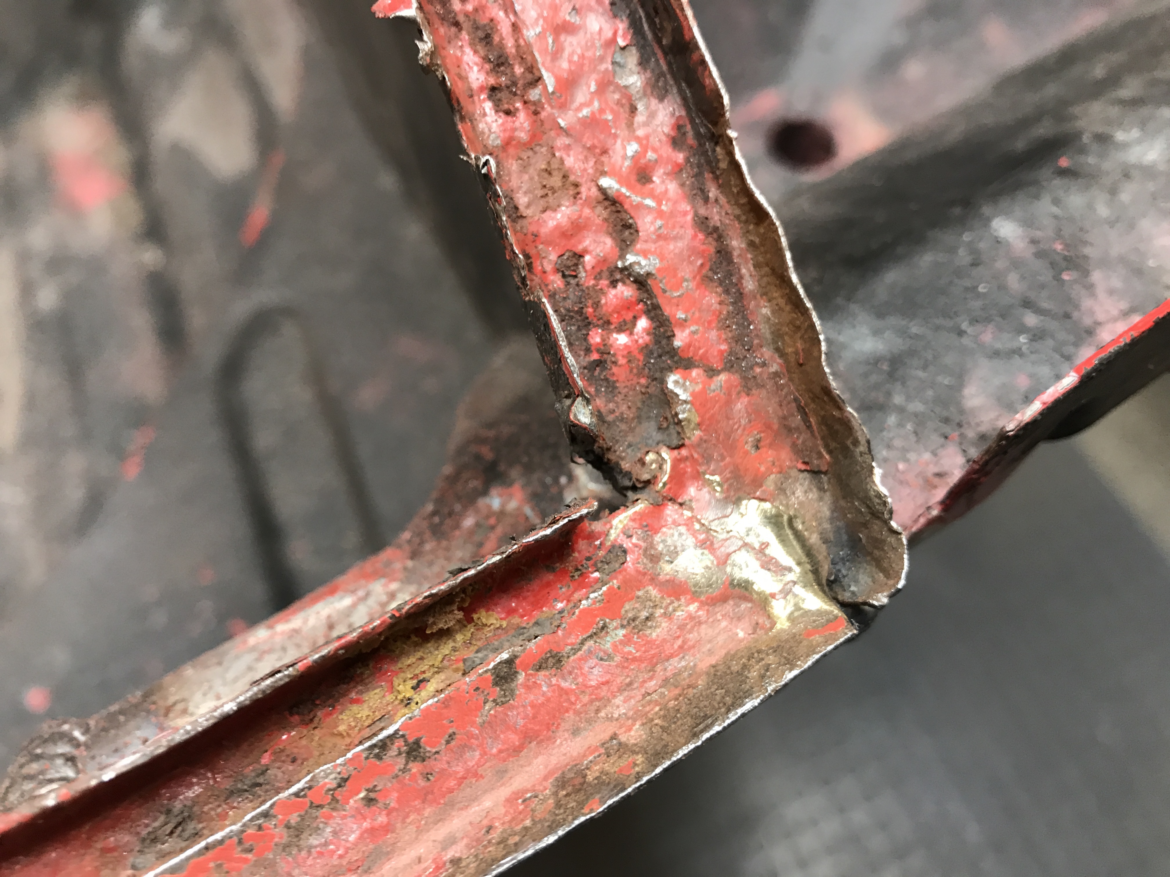

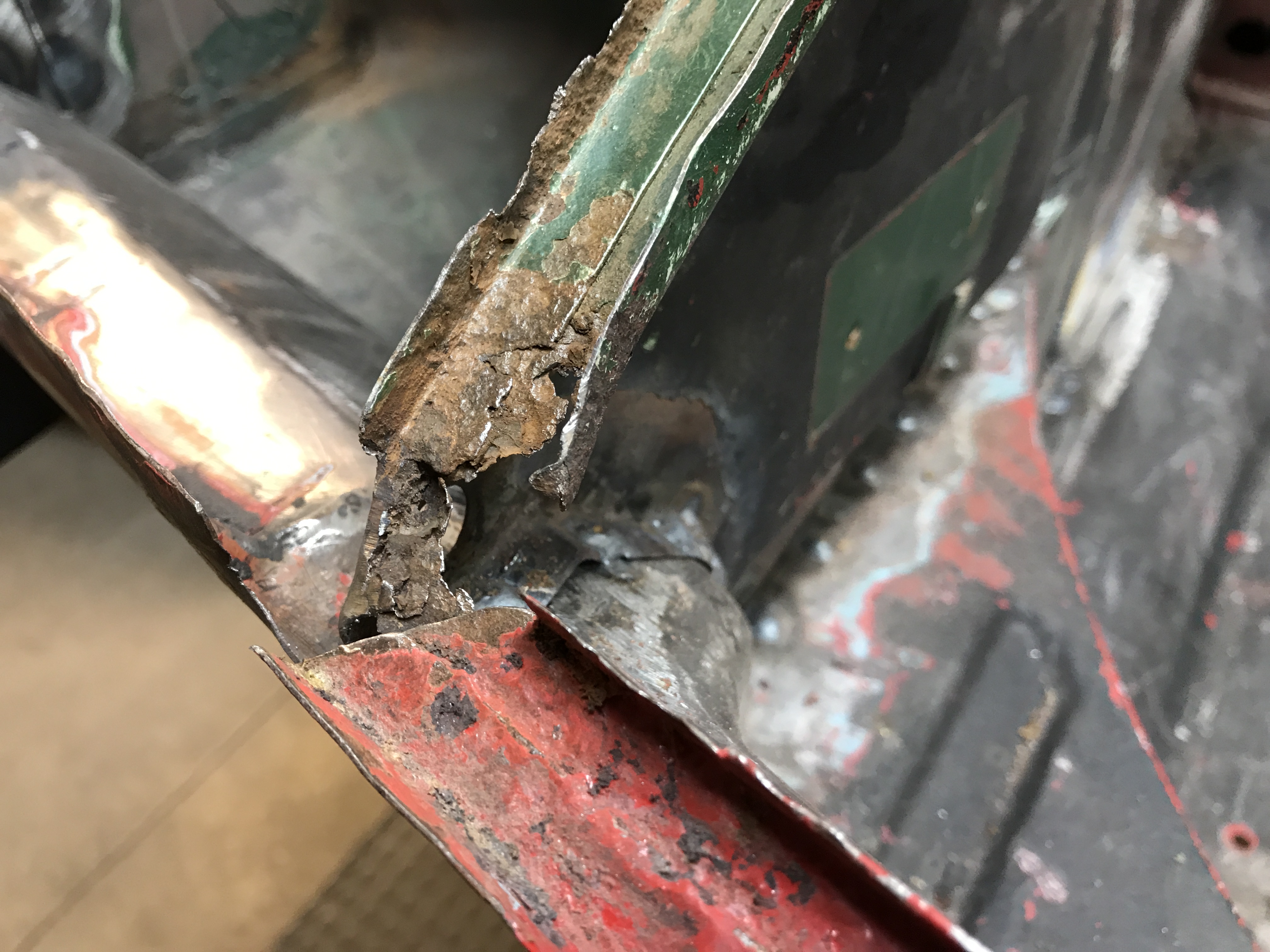

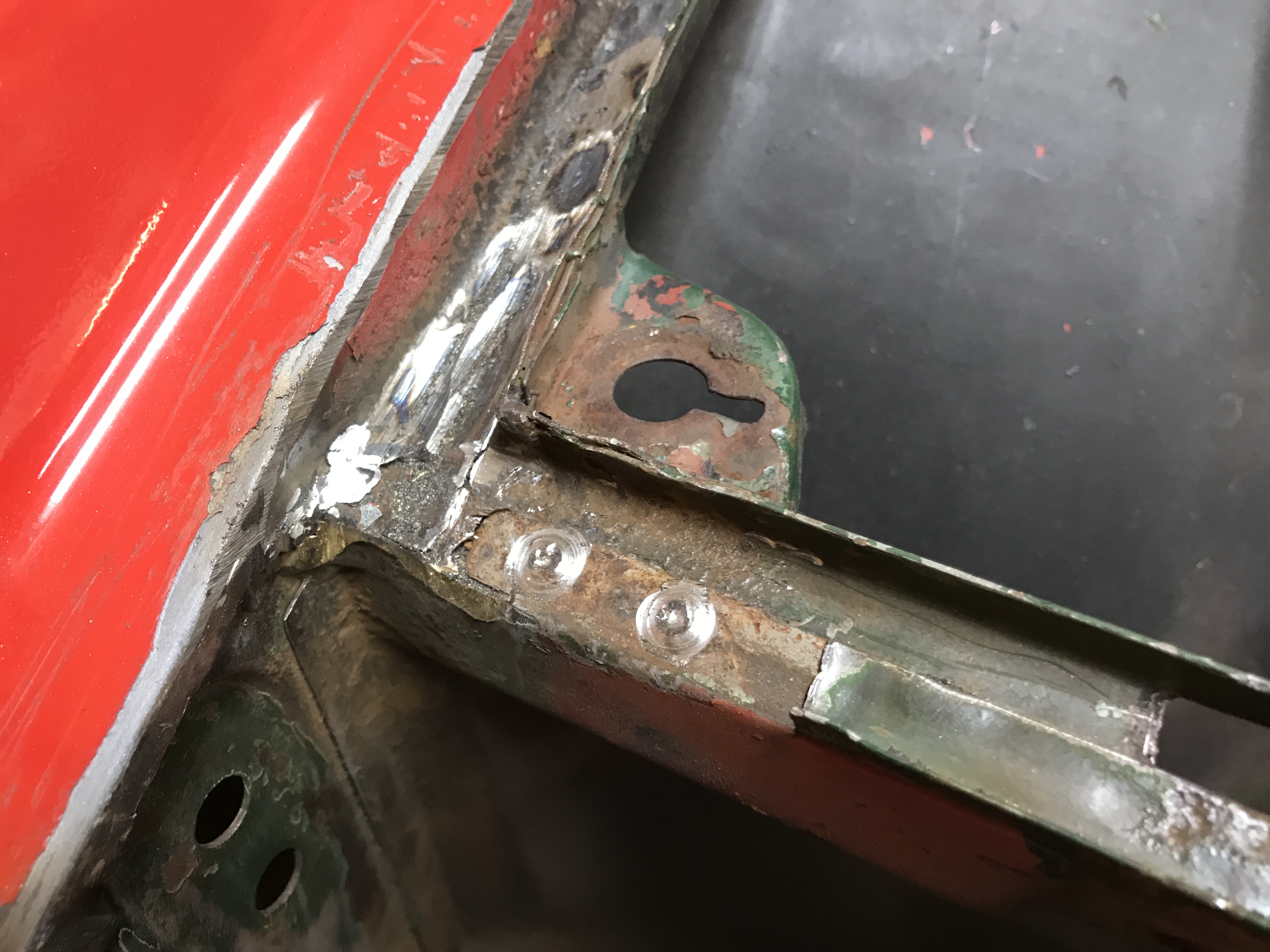

post Apr 18 2020, 08:54 PM
Post #505
Posts: 8,342
Time for surgical removal. I am trying to minimize replacement.

post Apr 18 2020, 08:56 PM
Post #507
Posts: 8,342
And more:
post Apr 18 2020, 08:58 PM
Post #508

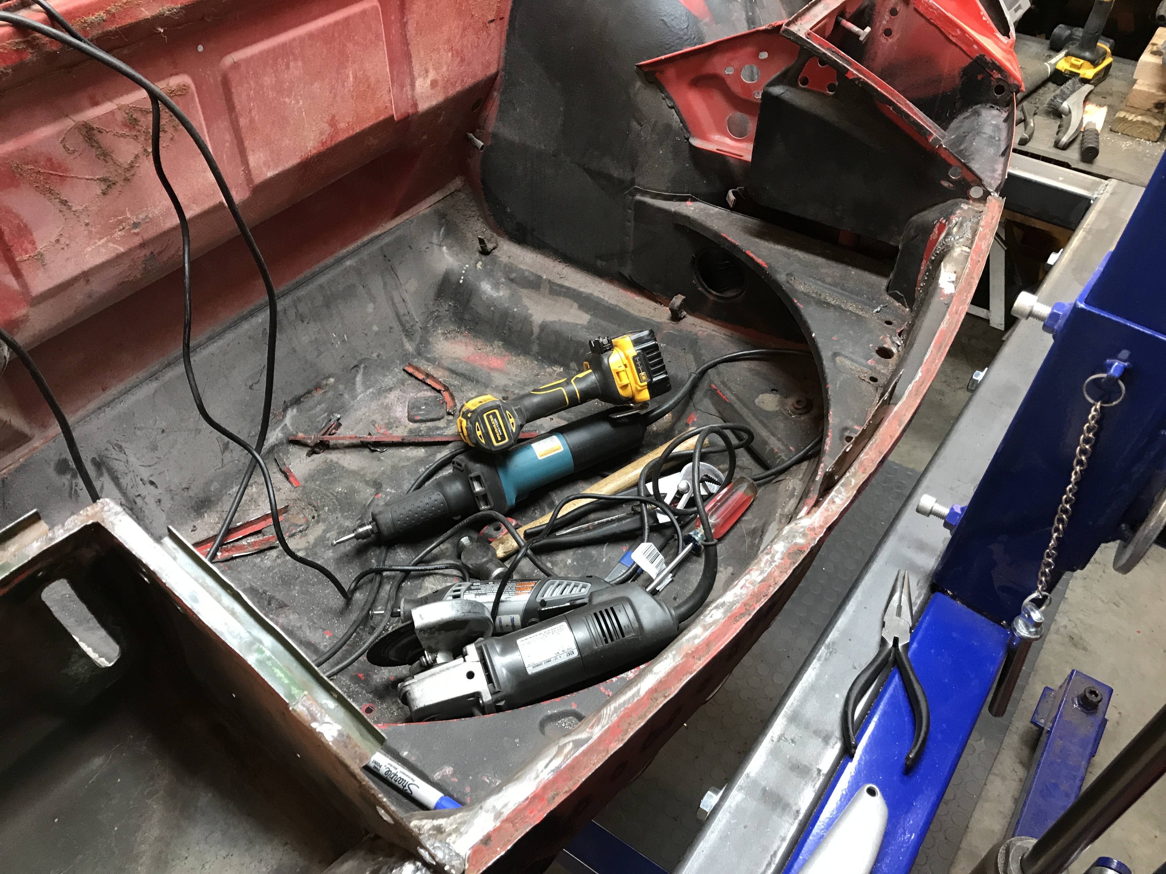

Posts: 8,342
The biggest section I removed was the inner side of the front edge. As always, the tools pile up during a job.

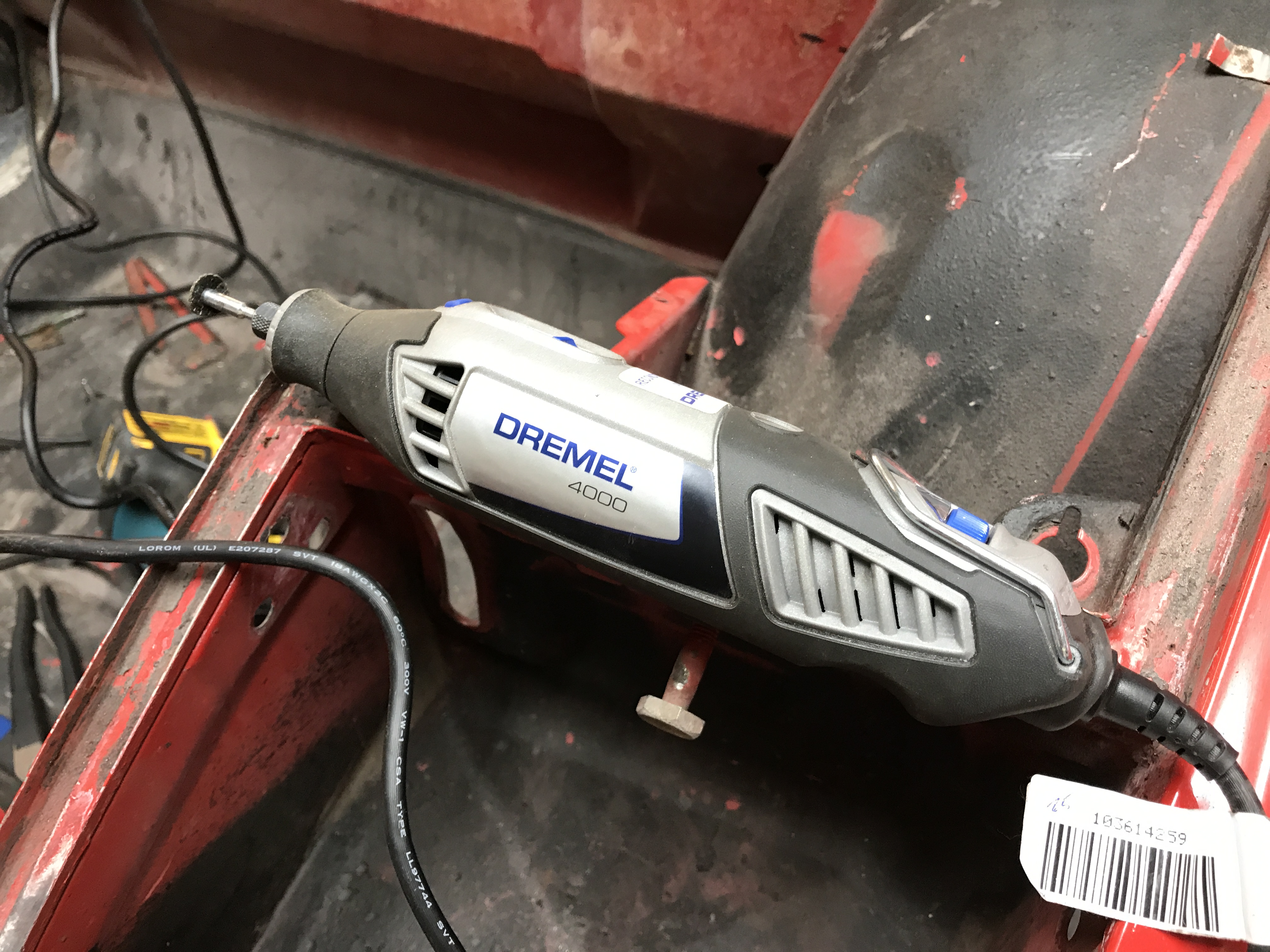

Posts: 8,342
Today, the hero tool was the Dremel. We will see how long this one lasts.

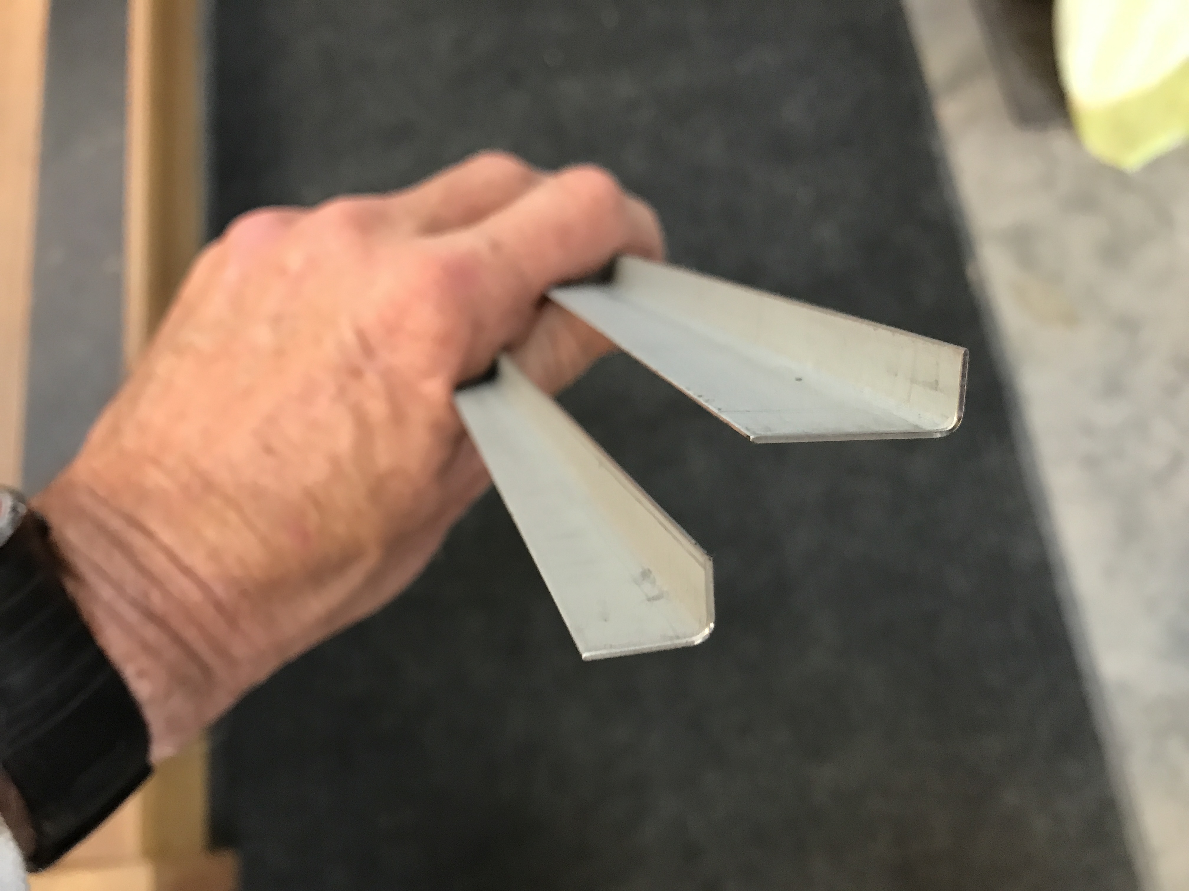

post Apr 19 2020, 08:30 PM
Post #510
Posts: 8,342
I started piecing the channel back together today, with the new stock from 914 Rubber. Thanks, Mark.

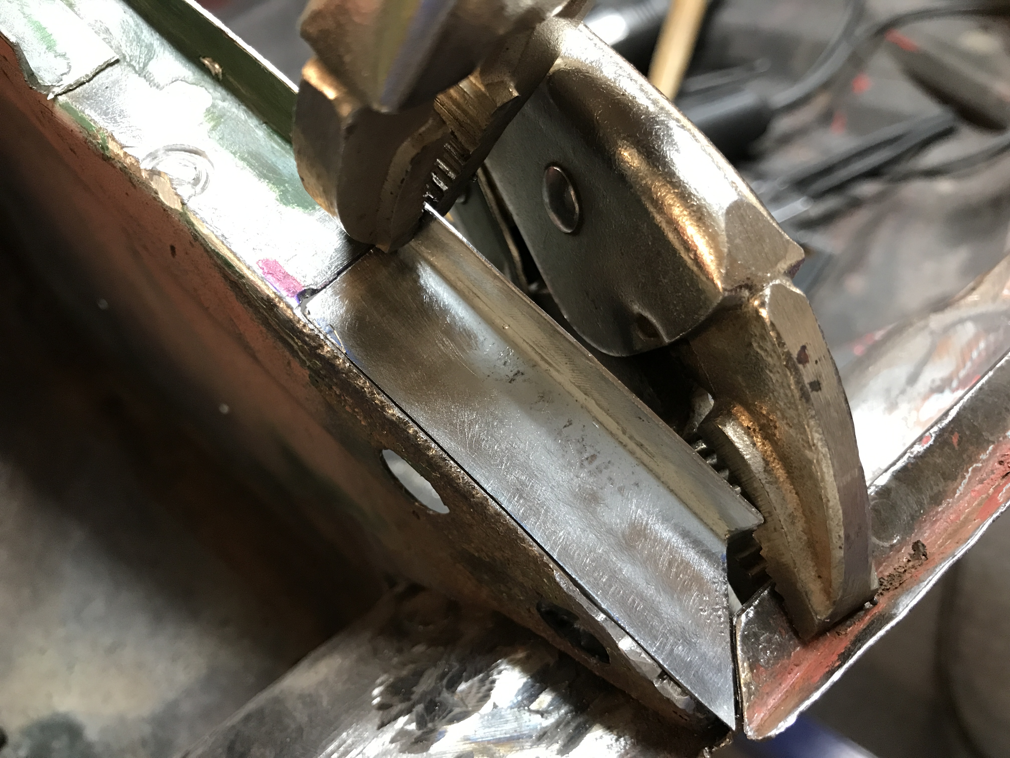

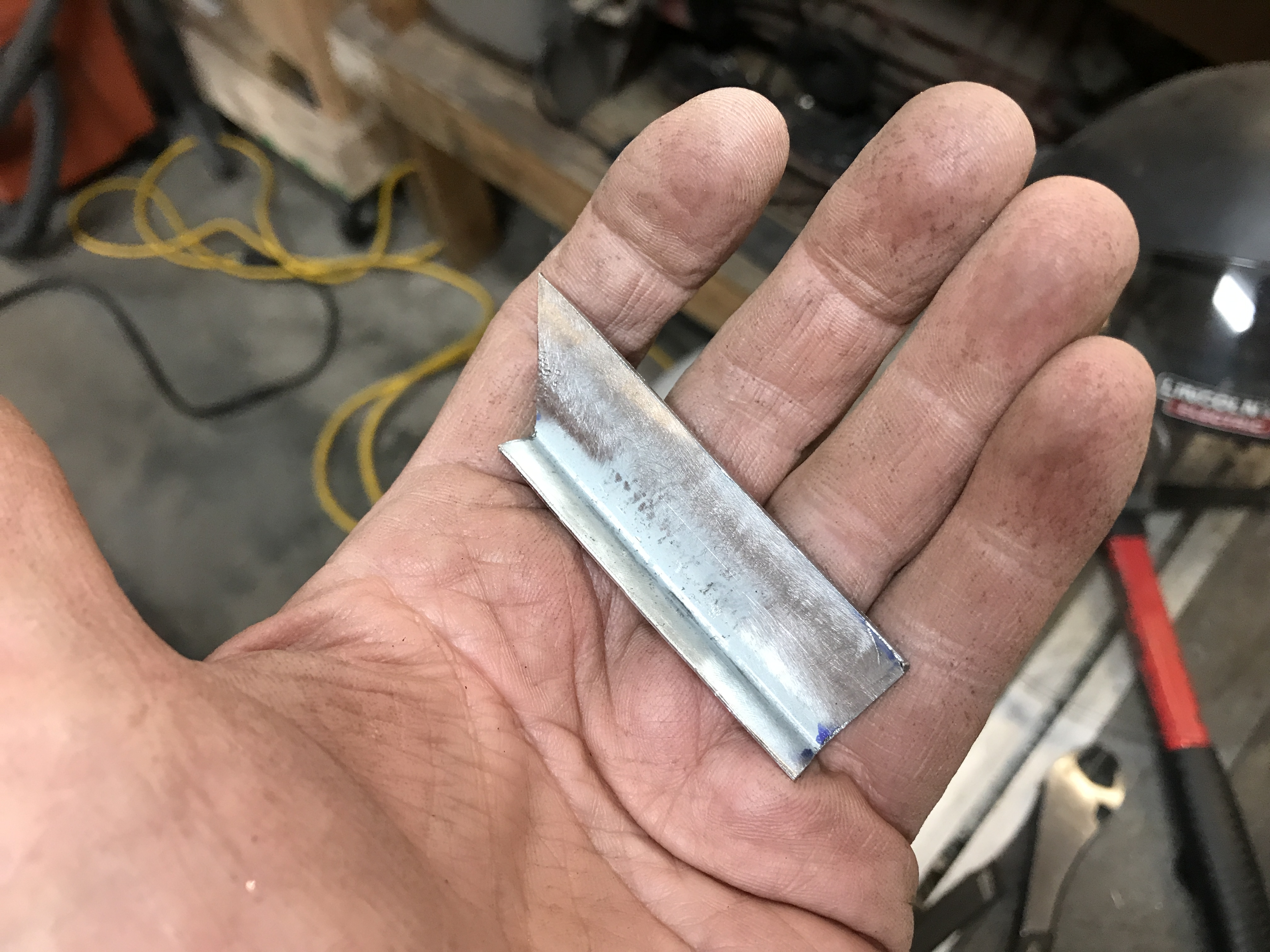

post Apr 19 2020, 08:32 PM
Post #511

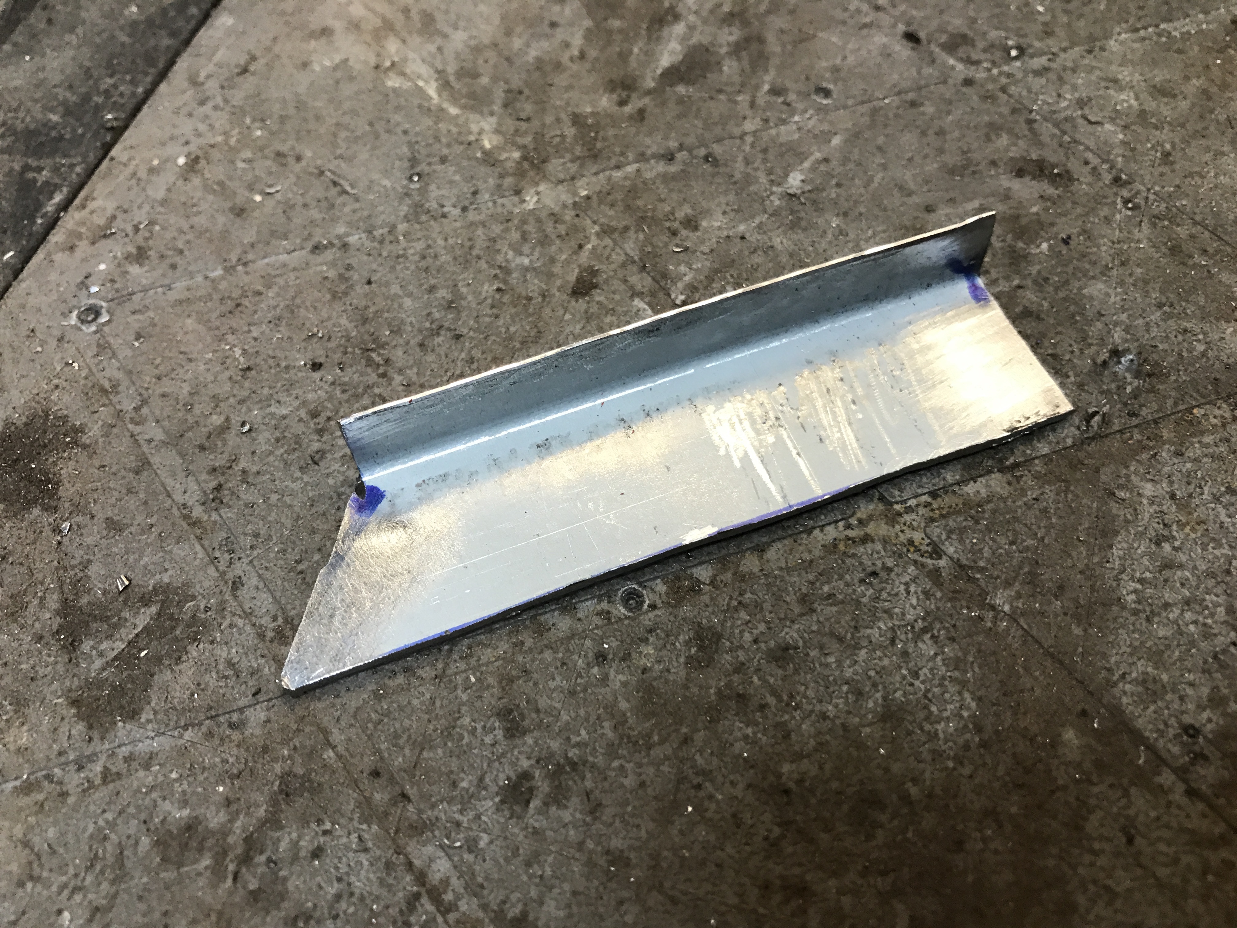

Posts: 8,342
The piece cut for the front left corner.
post Apr 19 2020, 08:33 PM
Post #512

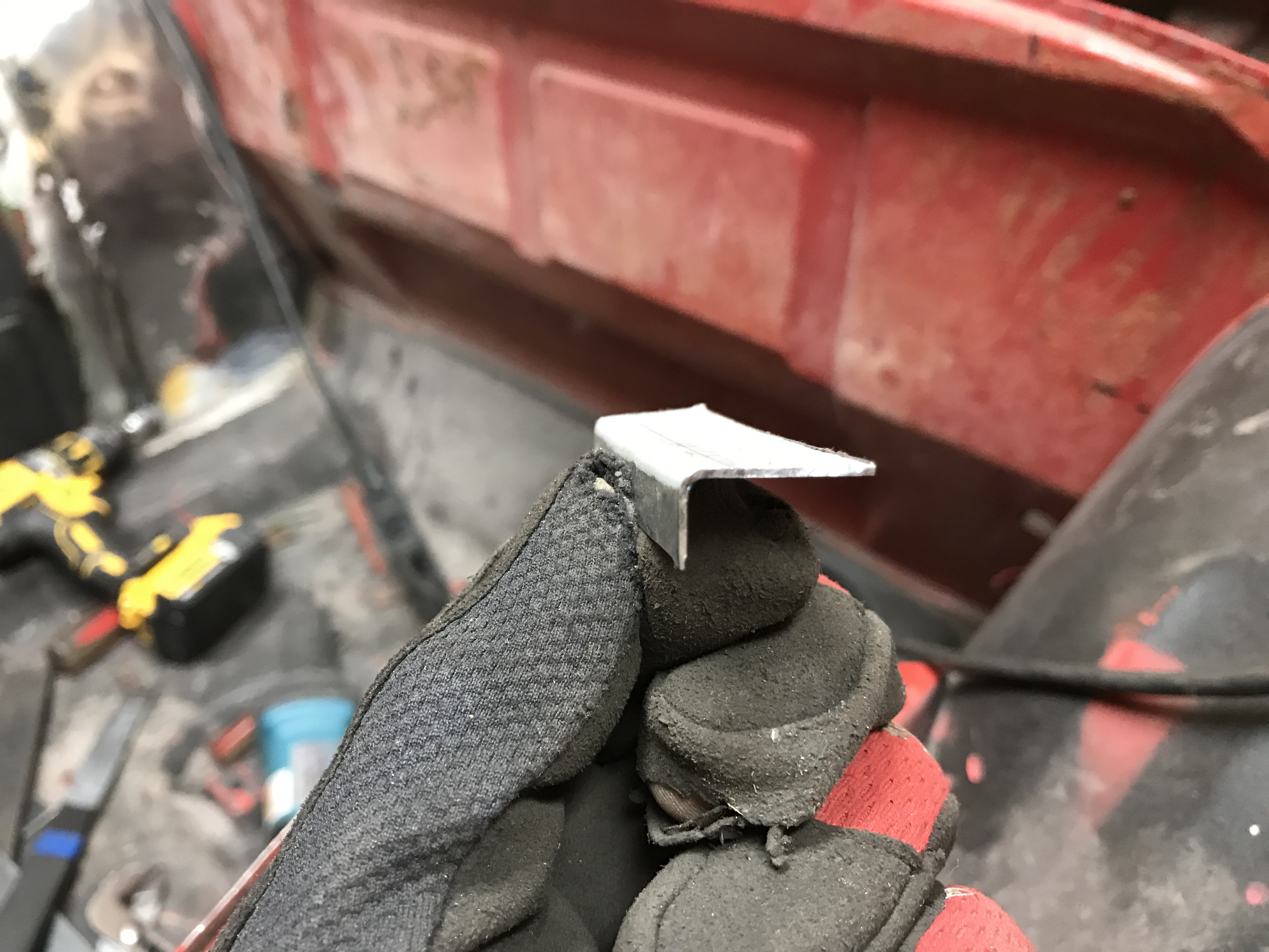

Posts: 8,342
I managed to get a bit of curvature, to match the original arc.
post Apr 19 2020, 08:34 PM
Post #513

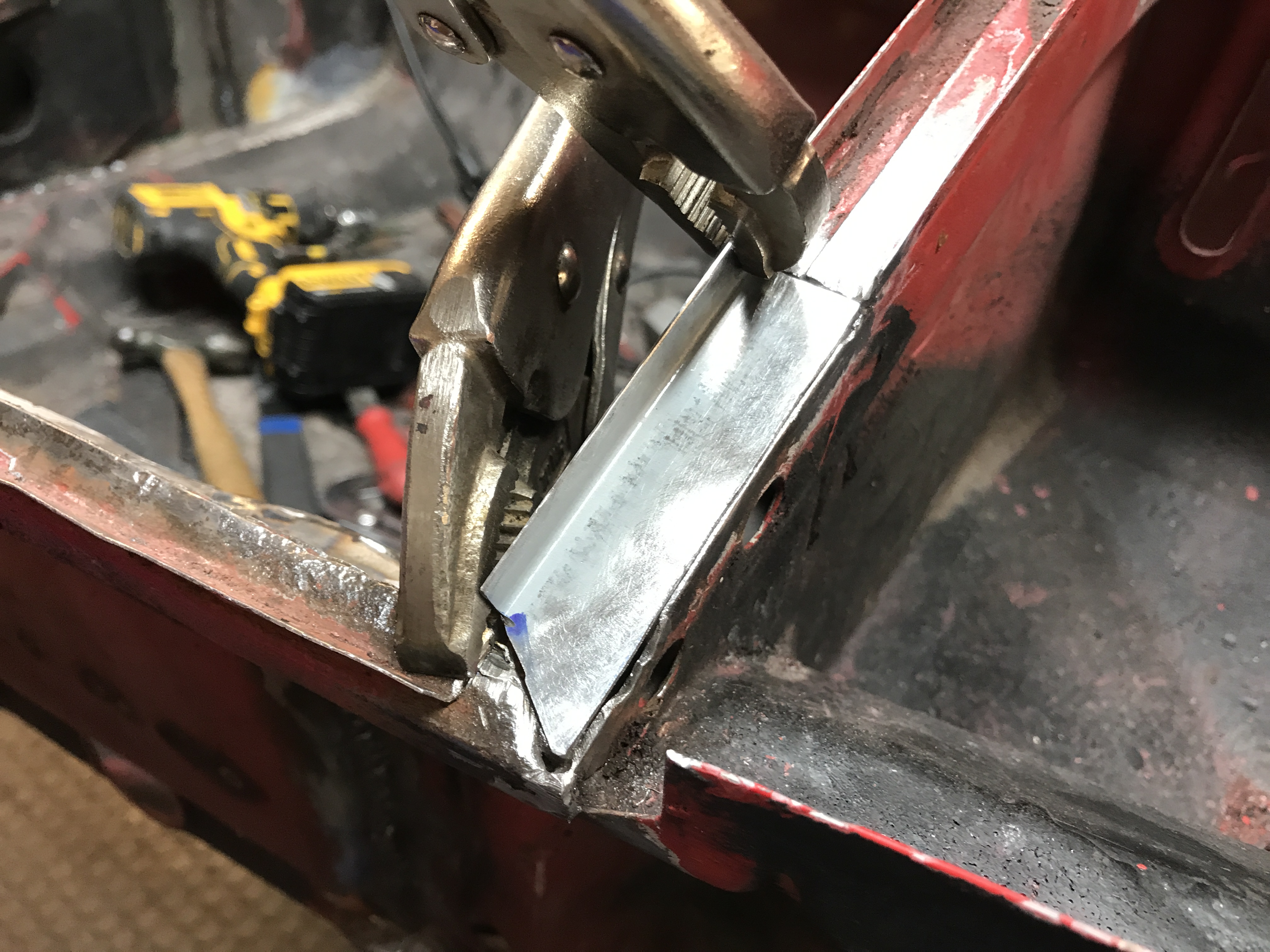

Posts: 8,342
Fit in place.

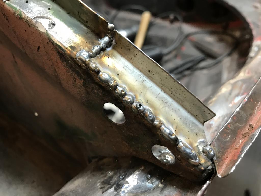

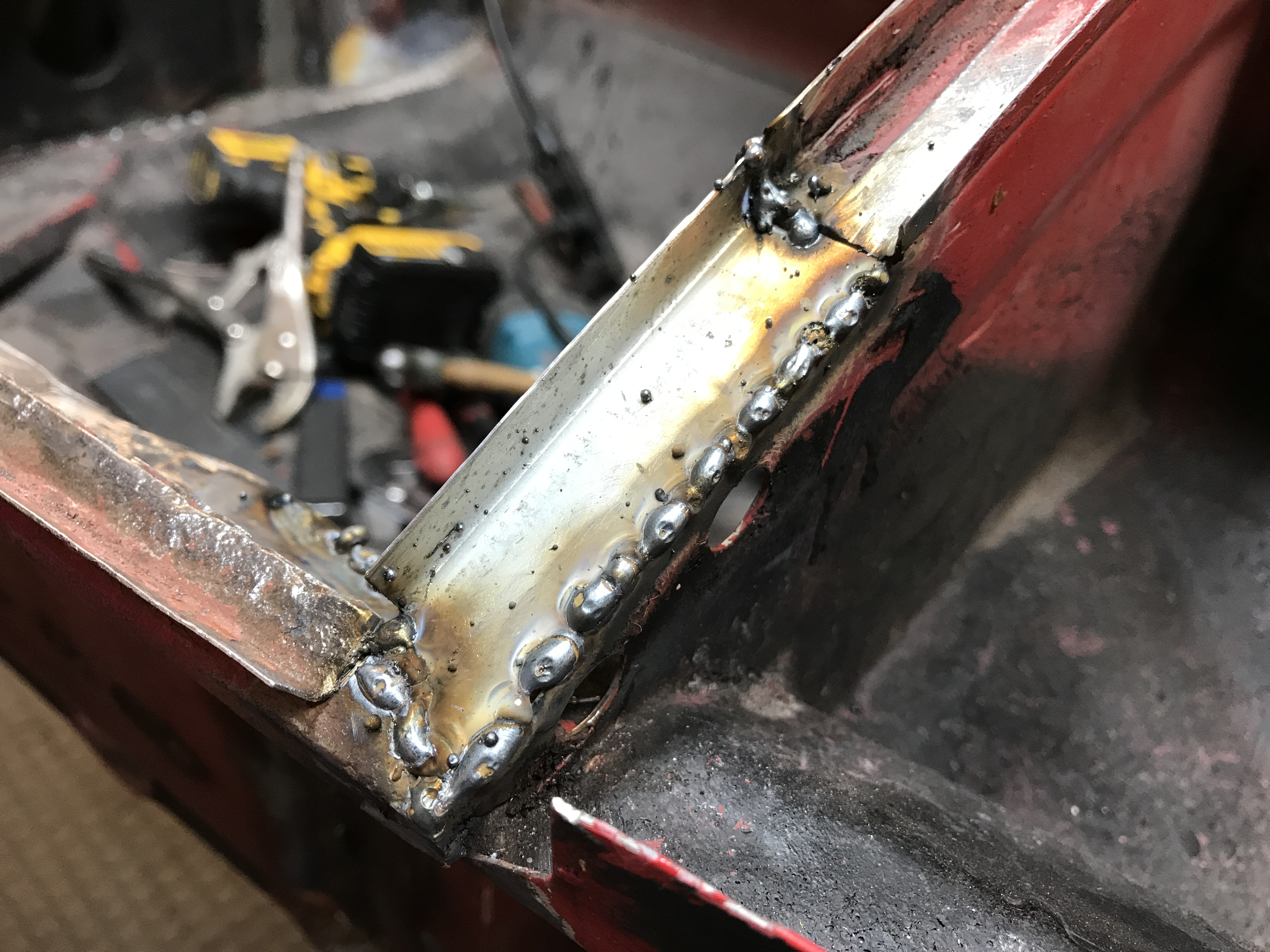

post Apr 19 2020, 08:36 PM
Post #514
Posts: 8,342
And welded in. I had pretty good luck with the thin gauge metal edges, even a bit of corrosion.

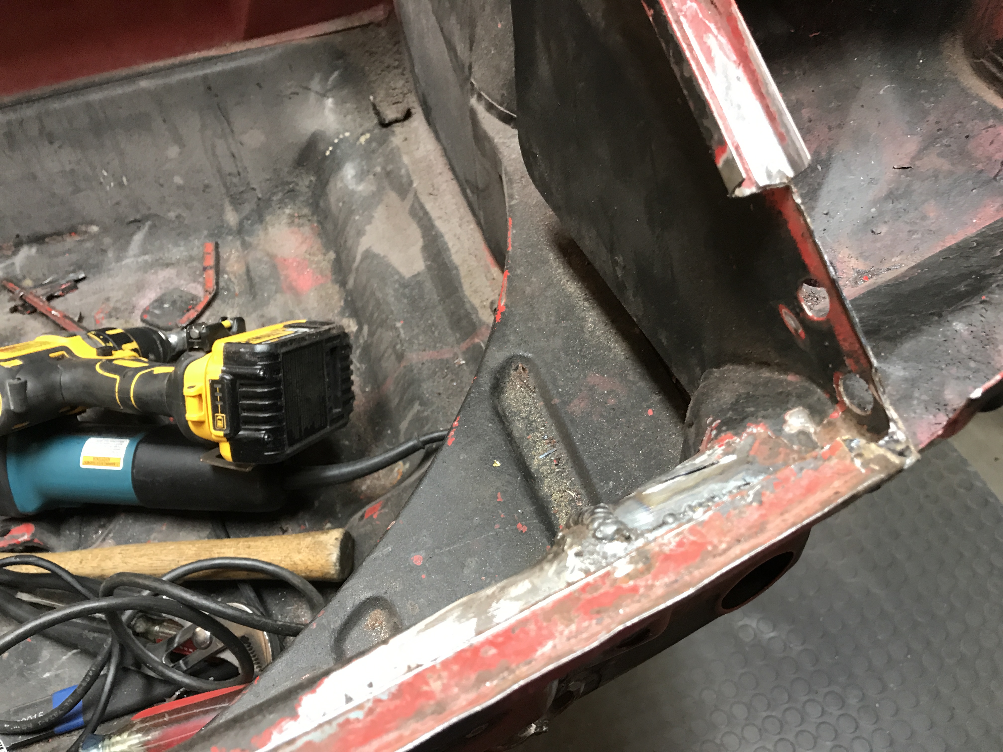

post Apr 19 2020, 08:37 PM
Post #515
Posts: 8,342
Right front corner piece.
Post #516
Posts: 8,342
In place.

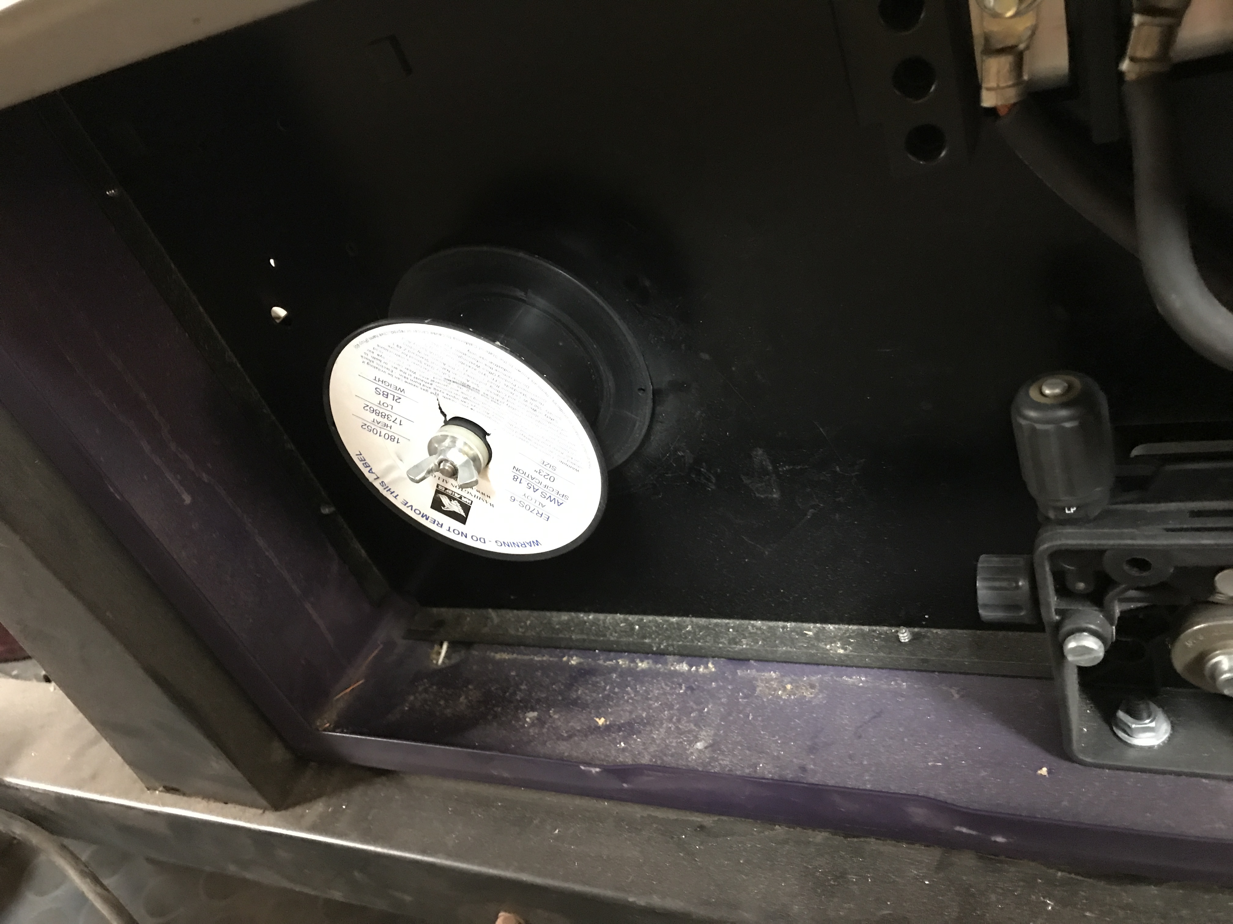

post Apr 19 2020, 08:39 PM
Post #517
Posts: 8,342
I started to tack weld this, and...the wire ran out. Always at an inconvenient moment, right? I had one more spool in my stock.
post Apr 19 2020, 08:40 PM
Post #518
Posts: 8,342
Back to welding. I can grind these first corner pieces tomorrow, and get on with the next bits.
