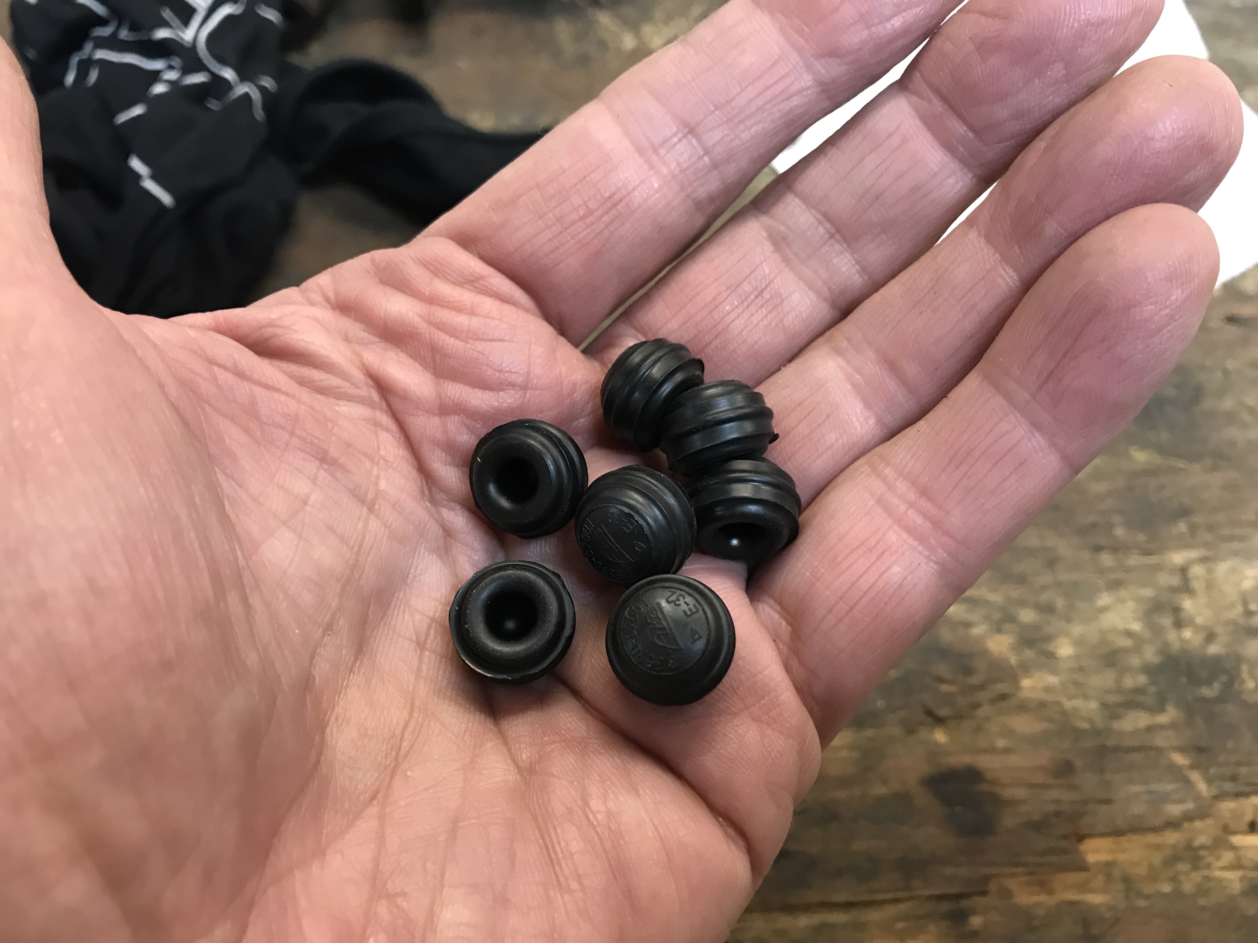

And got out the new bleed nipple caps.

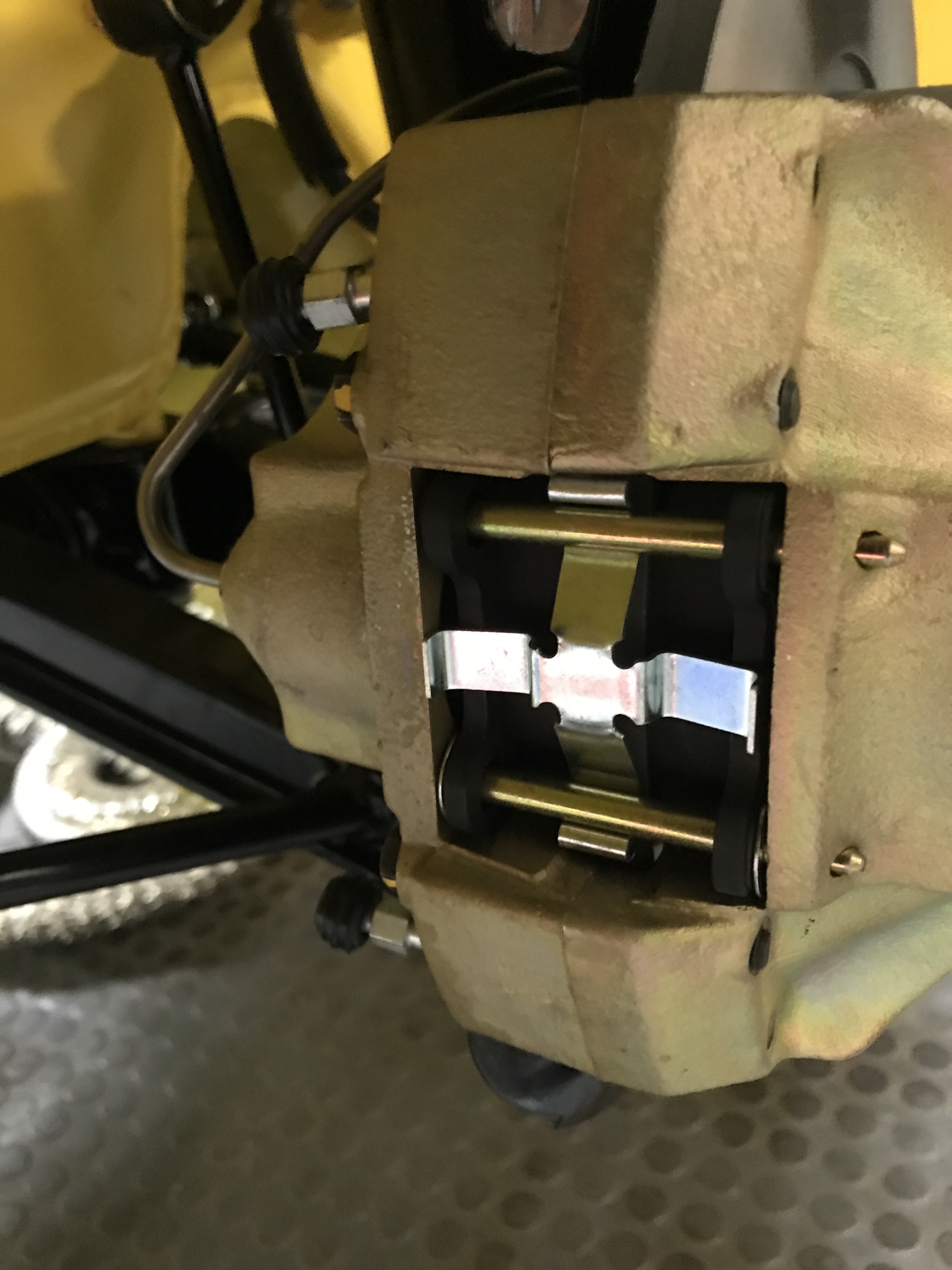

Fingers crossed--the brake work is done, at least until after the initial break-in.

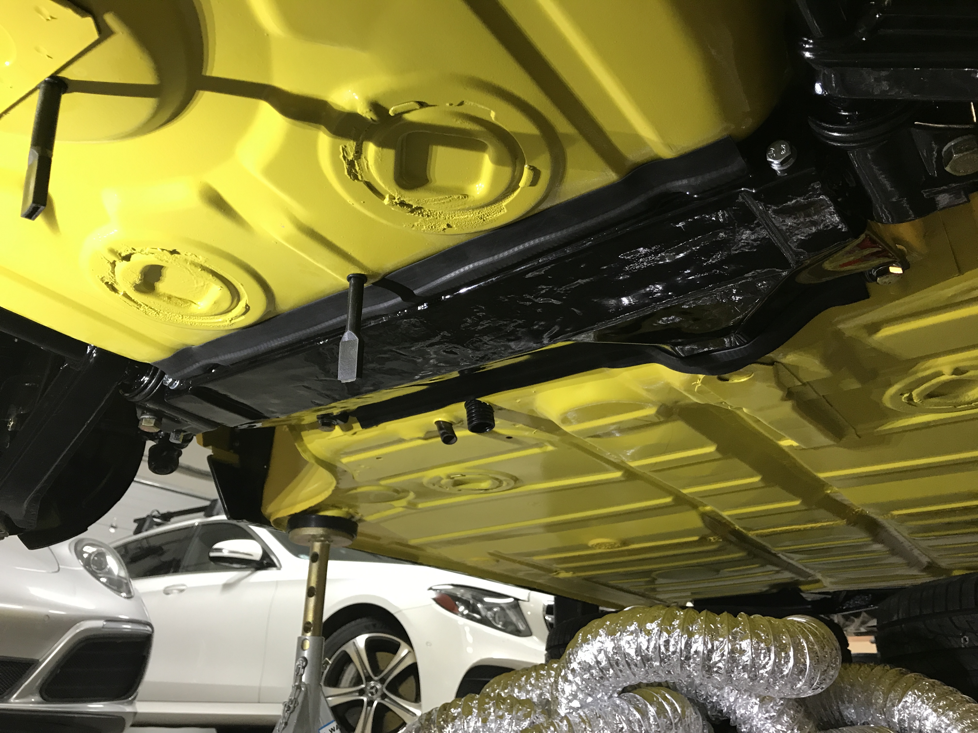

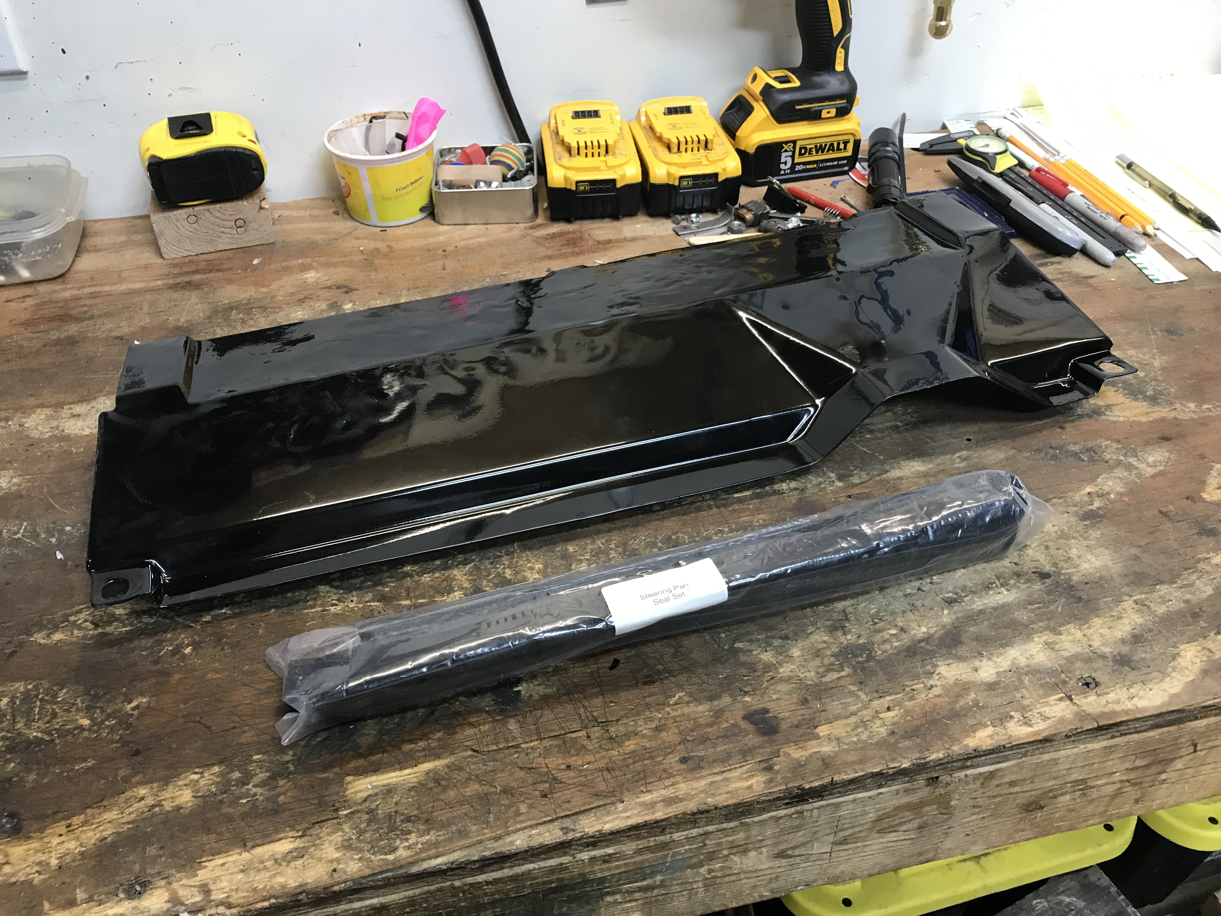

With my confidence high, I got out the front suspension under tray. Kinda lumpy, but nicely powder-coated. And new edge rubber.

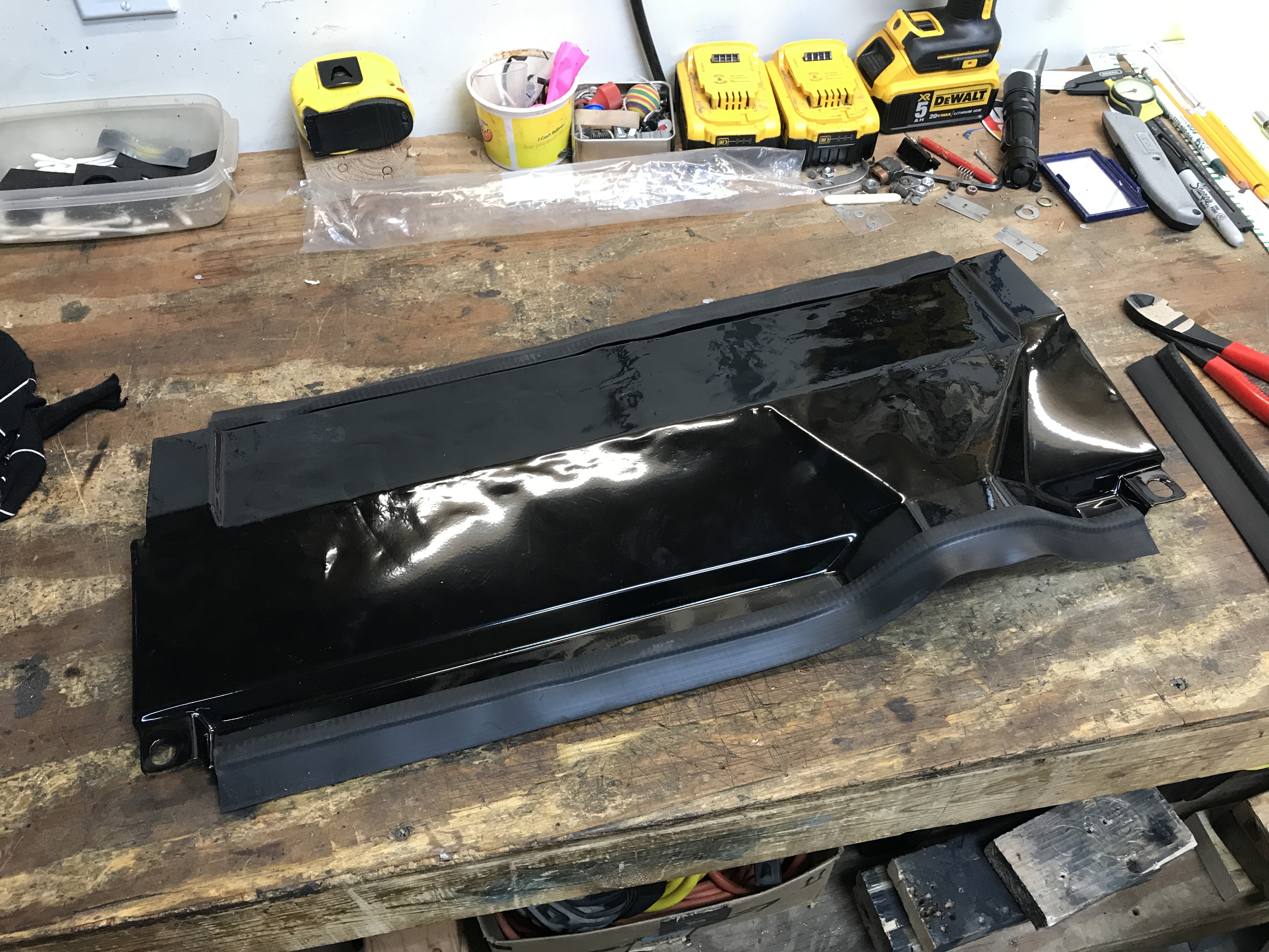

Rubber installed.

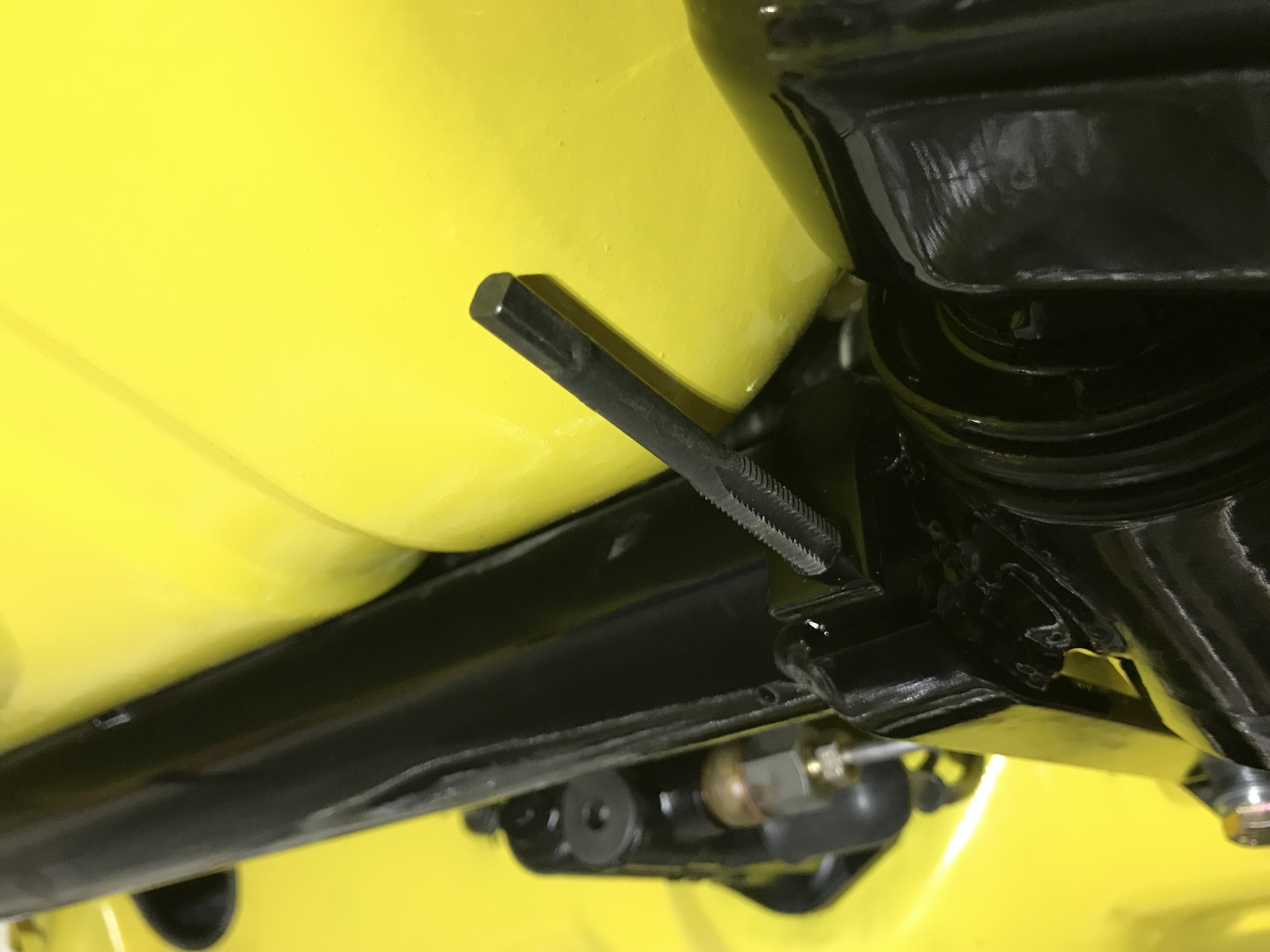

I had to chase the threads in the mounting tabs on the cross member. My powder coat shop was generally very good about protecting threads, but these got coated. Not much room to spin the tap.
bkrantz
post Apr 14 2022, 07:35 PM
Post #5046
Posts: 8,345
Joined: 3-August 19
From: SW Colorado
Member No.: 23,343
Under tray installed. Reflections from my dryer vent tubing make it look lumpier than it is.

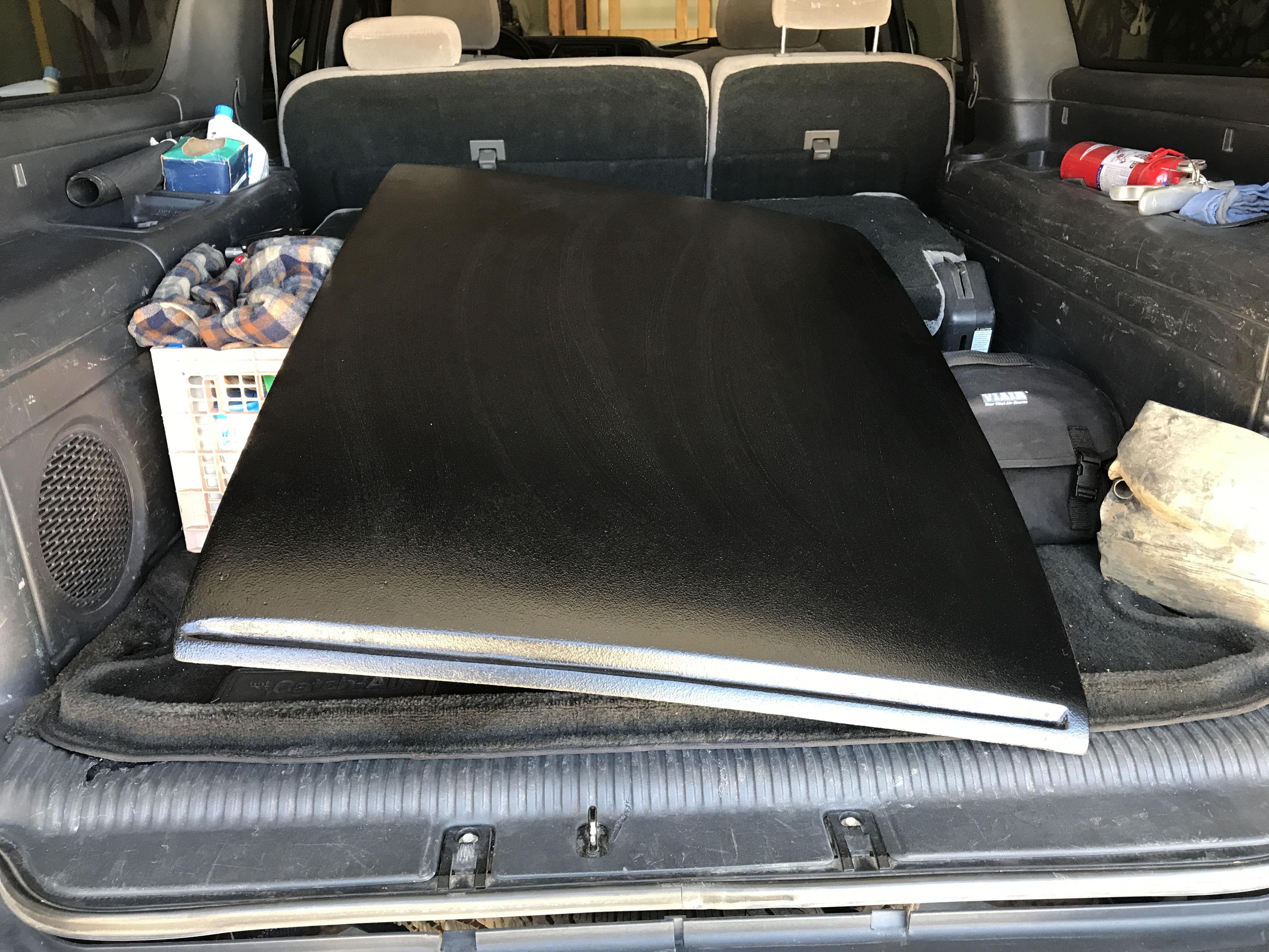

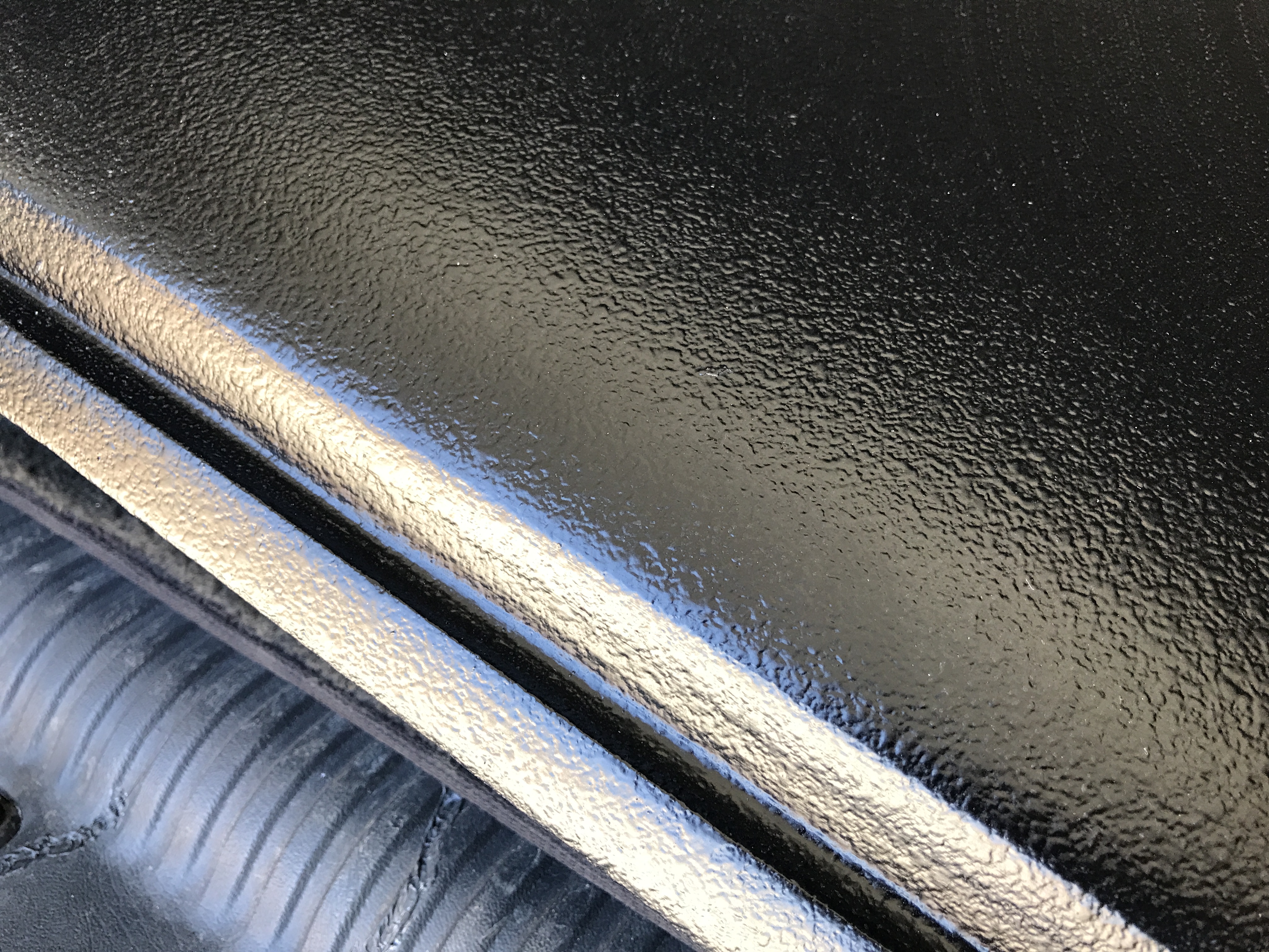

I picked up my targa top at the paint shop today. Not quite stock (and not as glossy as it looks in the photo). I like it.
bkrantz
post Apr 15 2022, 08:04 PM
Post #5050
Posts: 8,345
Joined: 3-August 19
From: SW Colorado
Member No.: 23,343
Close up of texture.

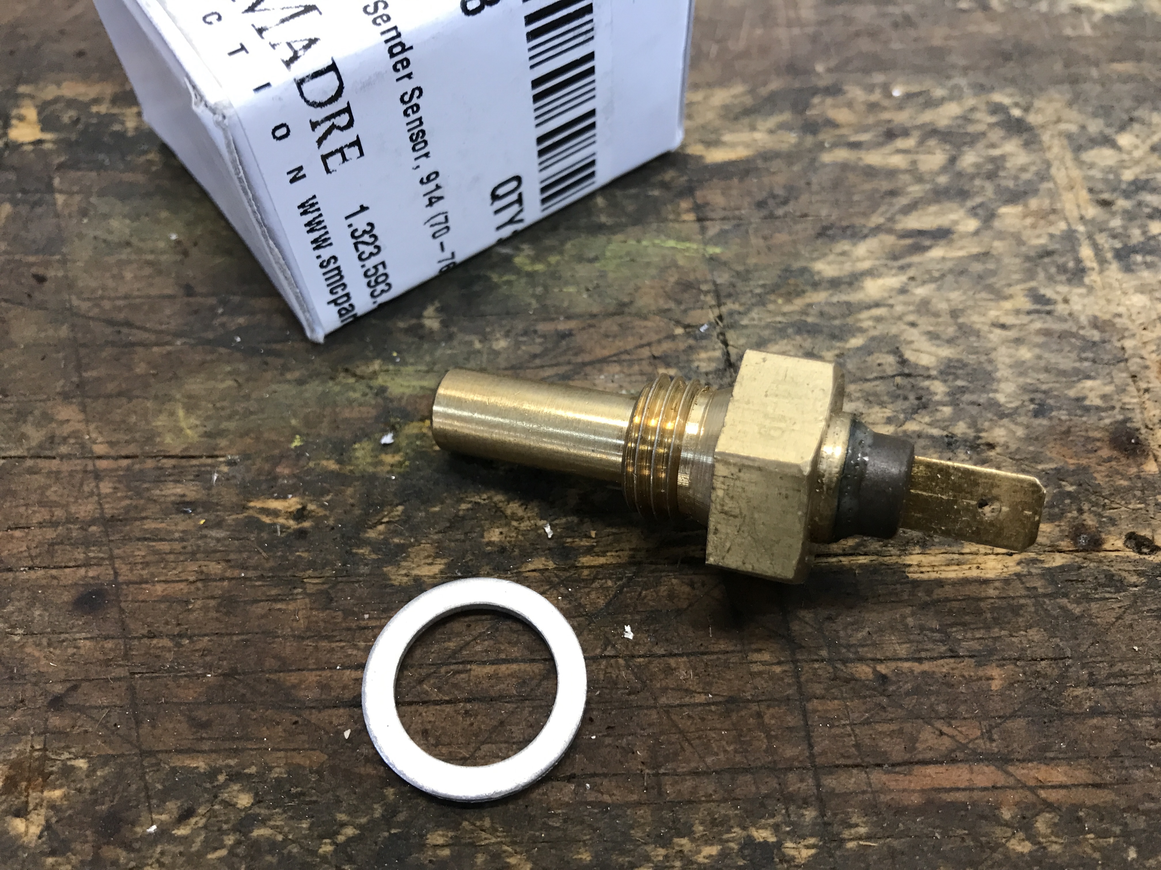

I got my repro oil temp sender from Pelican (in a box tagged Sierra Madre). Now time for more detective work.

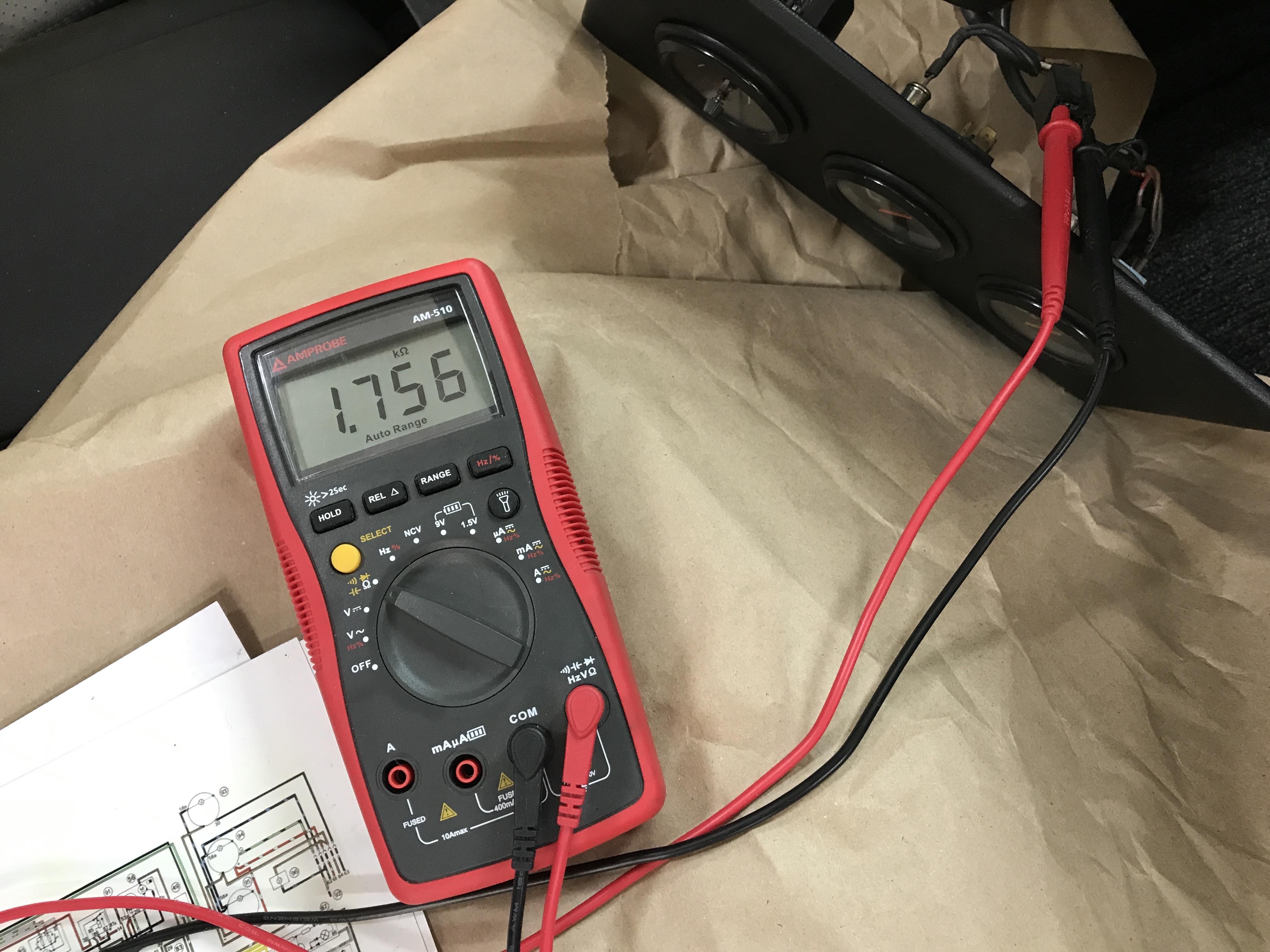

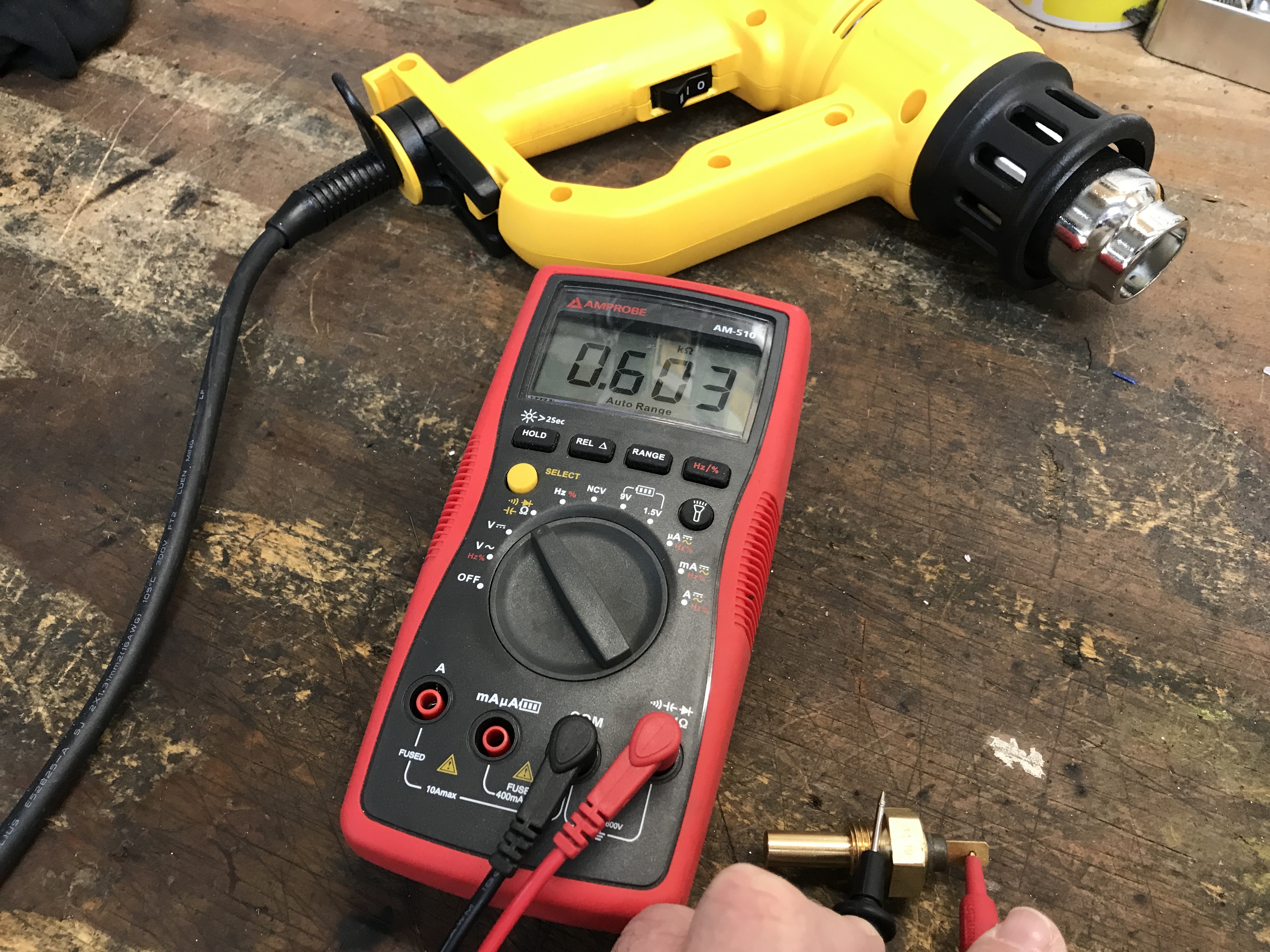

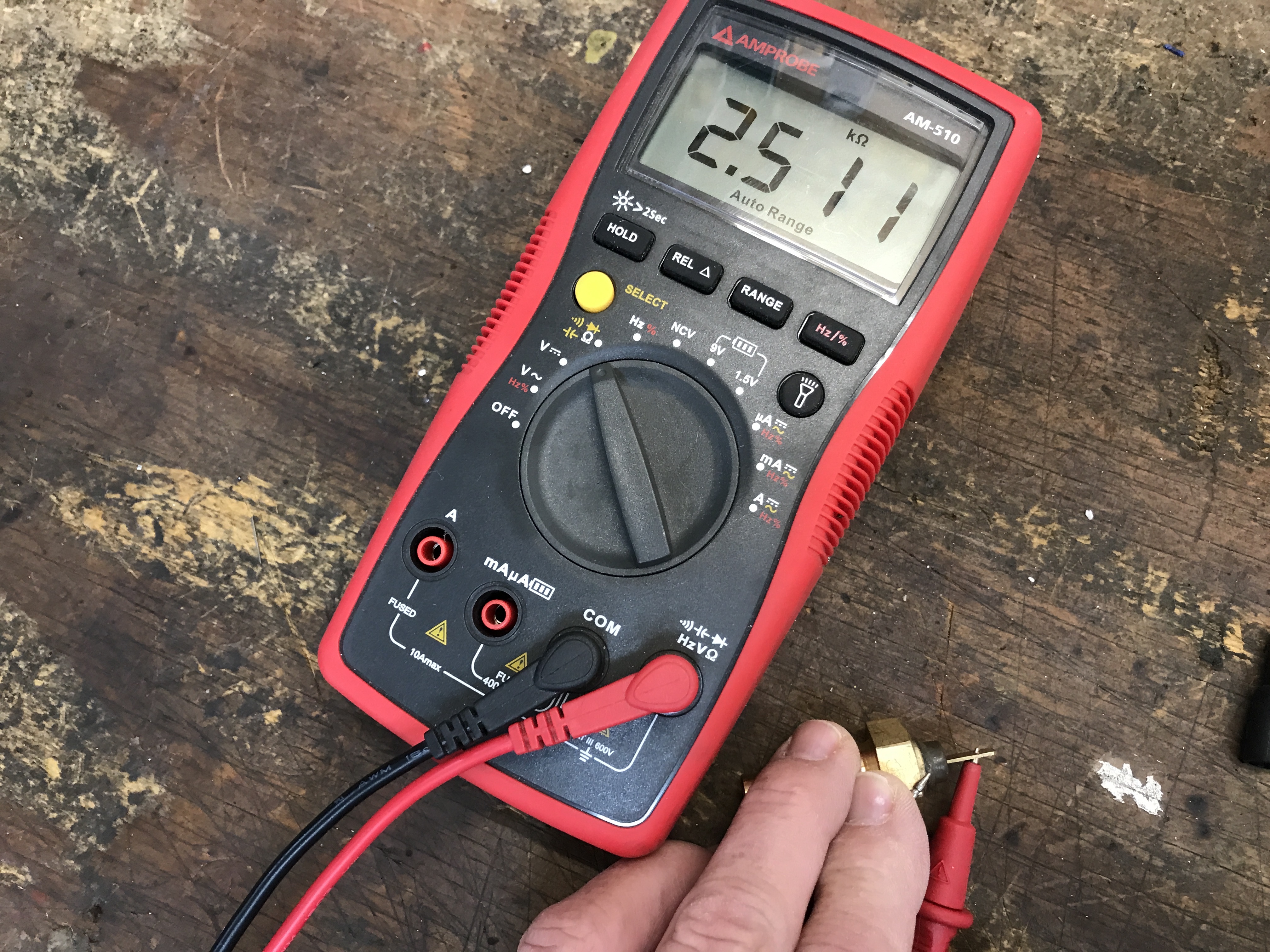

Resistance check, with the sender at room temperature.
bkrantz
post Apr 16 2022, 08:30 PM
Post #5055
Posts: 8,345
Joined: 3-August 19
From: SW Colorado
Member No.: 23,343
And warmed up with my heat gun. Resistance has dropped as expected.

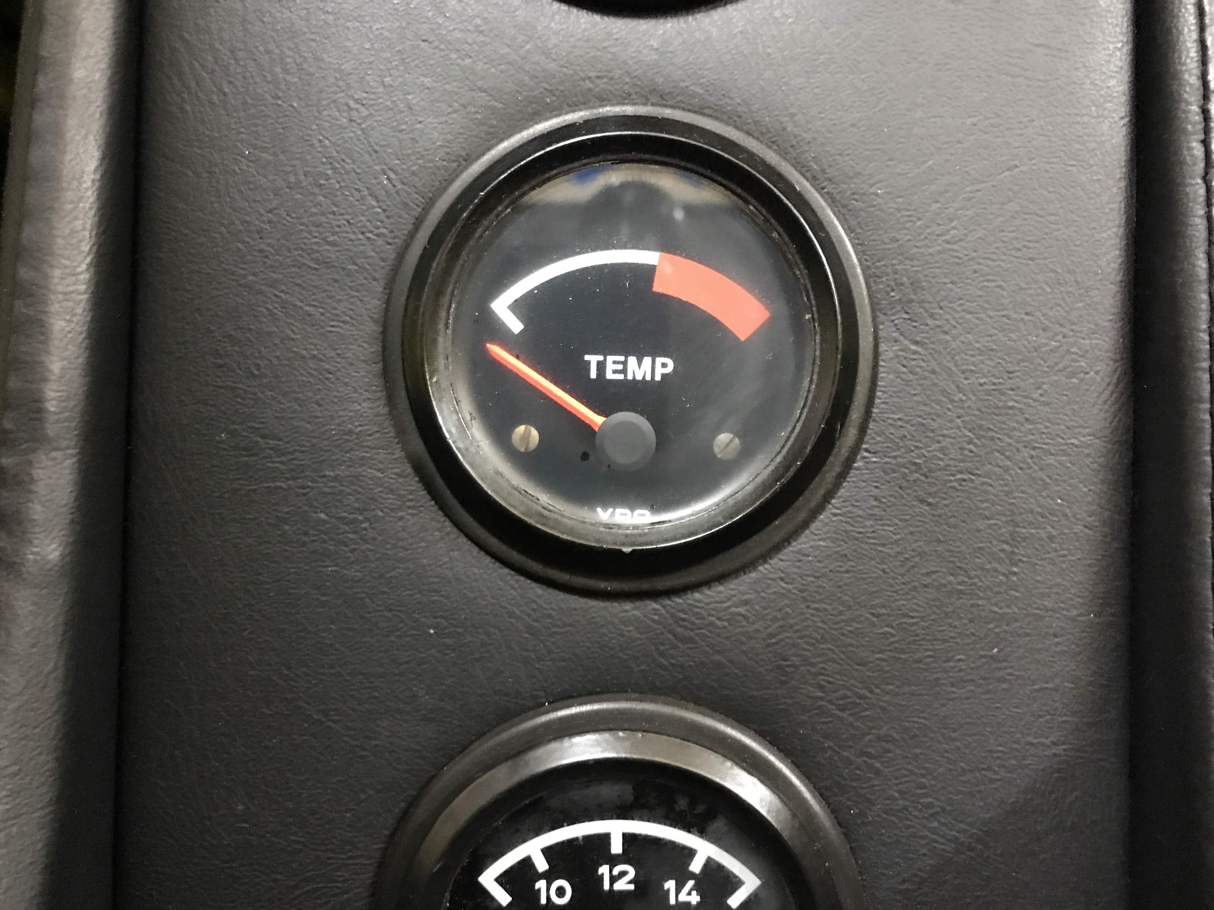

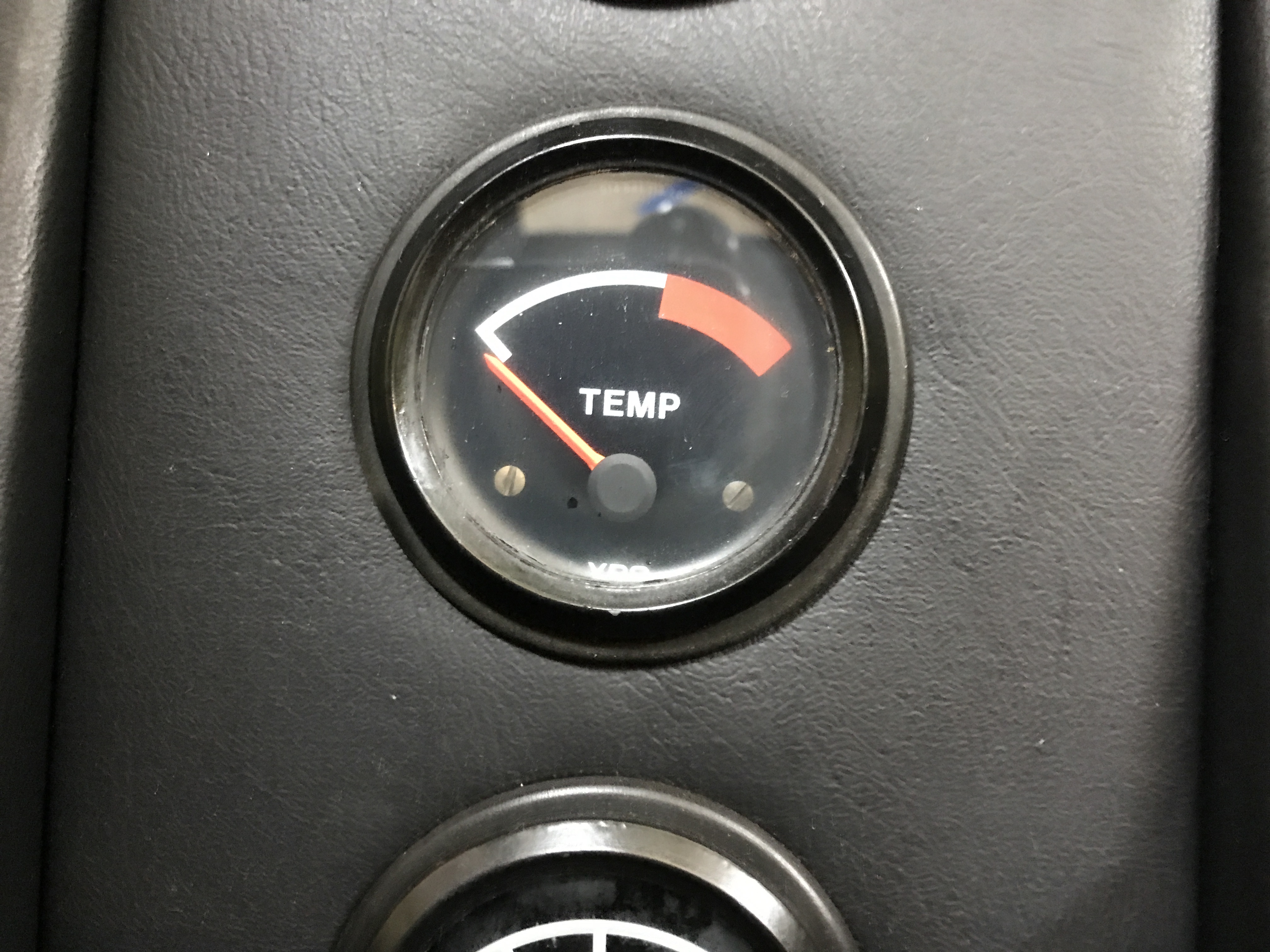

Meanwhile, here is the gauge with the key off.
bkrantz
post Apr 16 2022, 08:32 PM
Post #5057
Posts: 8,345
Joined: 3-August 19
From: SW Colorado
Member No.: 23,343

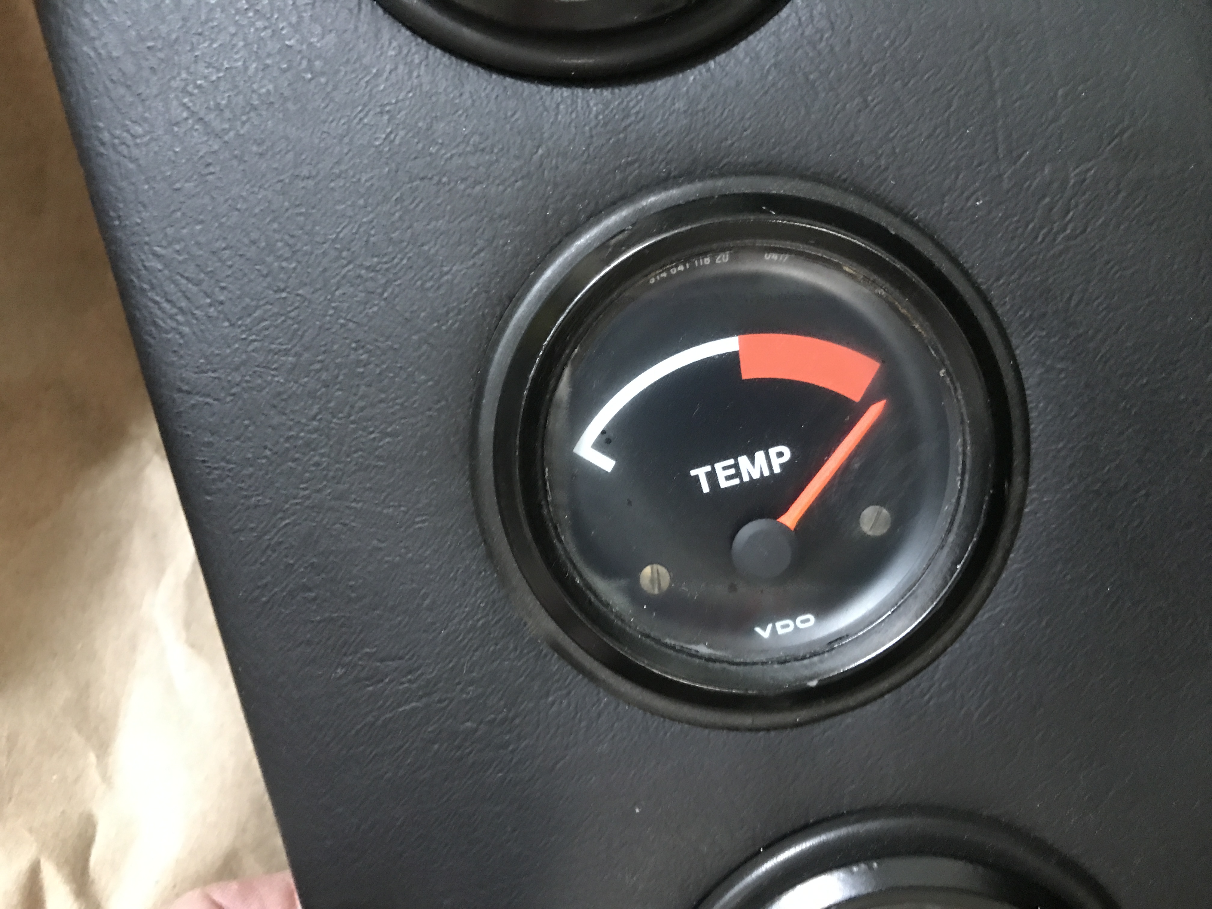

And the key on (and the lead attached to the old sender, installed in the taco plate).
bkrantz
post Apr 16 2022, 08:34 PM
Post #5058
Posts: 8,345
Joined: 3-August 19
From: SW Colorado
Member No.: 23,343
And the gauge with the sender lead grounded.
bkrantz
post Apr 16 2022, 08:35 PM
Post #5059
Posts: 8,345
Joined: 3-August 19
From: SW Colorado
Member No.: 23,343

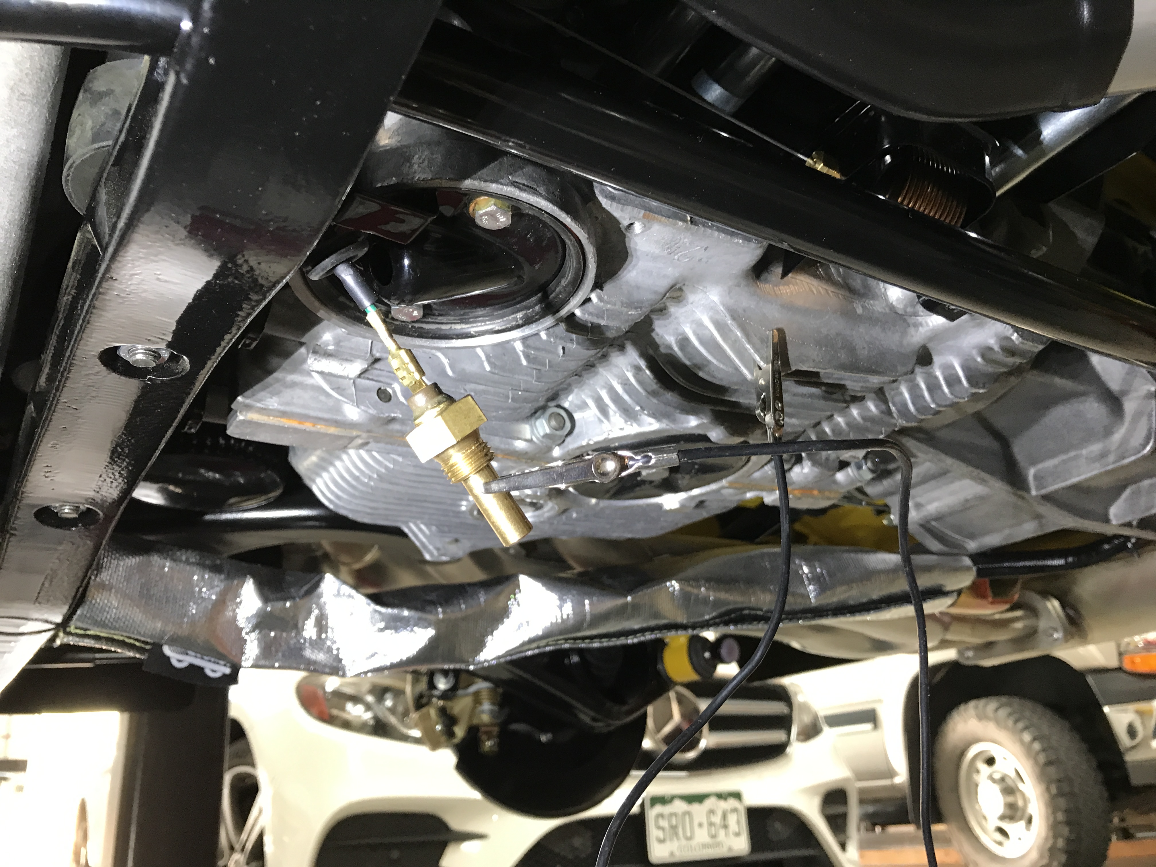

I rigged up the new sender, attached to the lead and grounded to the engine case.
bkrantz
post Apr 16 2022, 08:37 PM
Post #5060
Posts: 8,345
Joined: 3-August 19
From: SW Colorado
Member No.: 23,343
Resistance at the gauge, with the sender warmed up in my hand.
