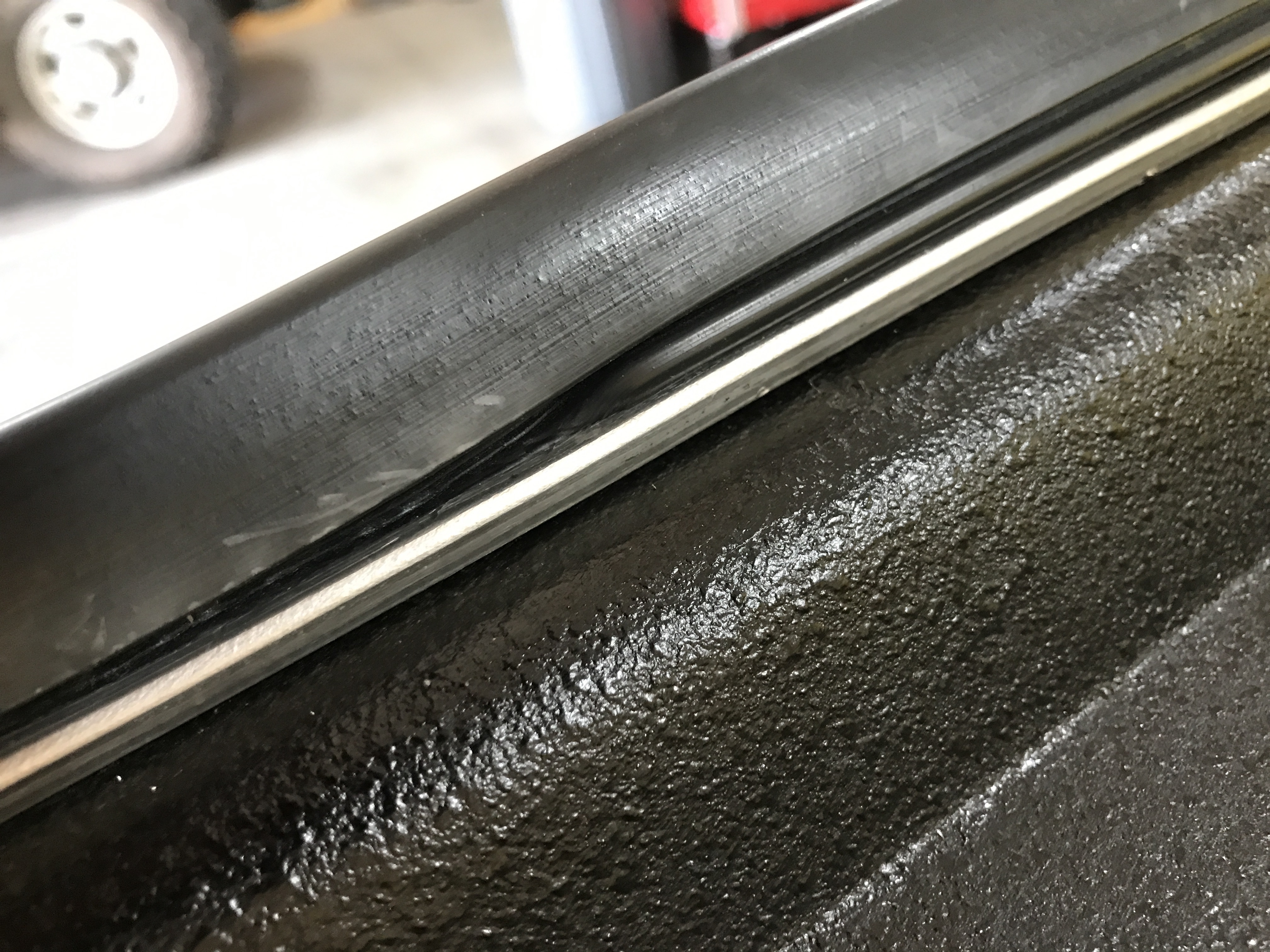

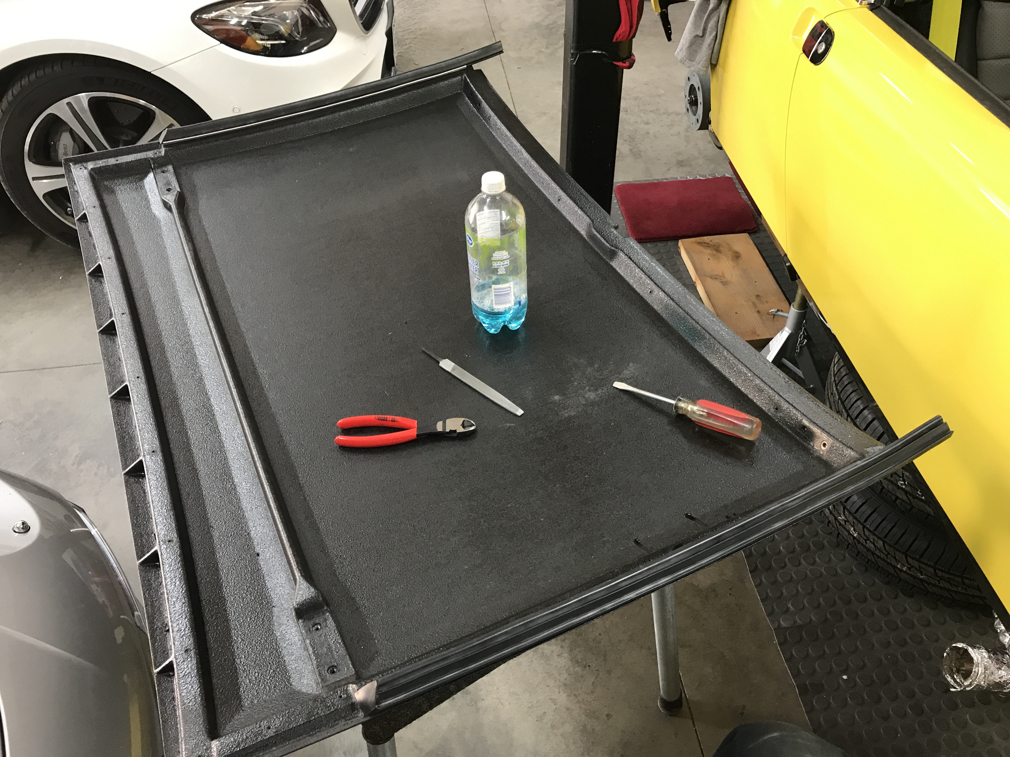

And then--slowly--seated the inner lip. Did I say these are thick?
bkrantz
post Apr 25 2022, 08:12 PM
Post #5102
Posts: 8,345
Joined: 3-August 19
From: SW Colorado
Member No.: 23,343
Right side done.
bkrantz
post Apr 25 2022, 08:13 PM
Post #5103
Posts: 8,345
Joined: 3-August 19
From: SW Colorado
Member No.: 23,343
And then the left. I trimmed off the excess (first rough cut) after this photo.

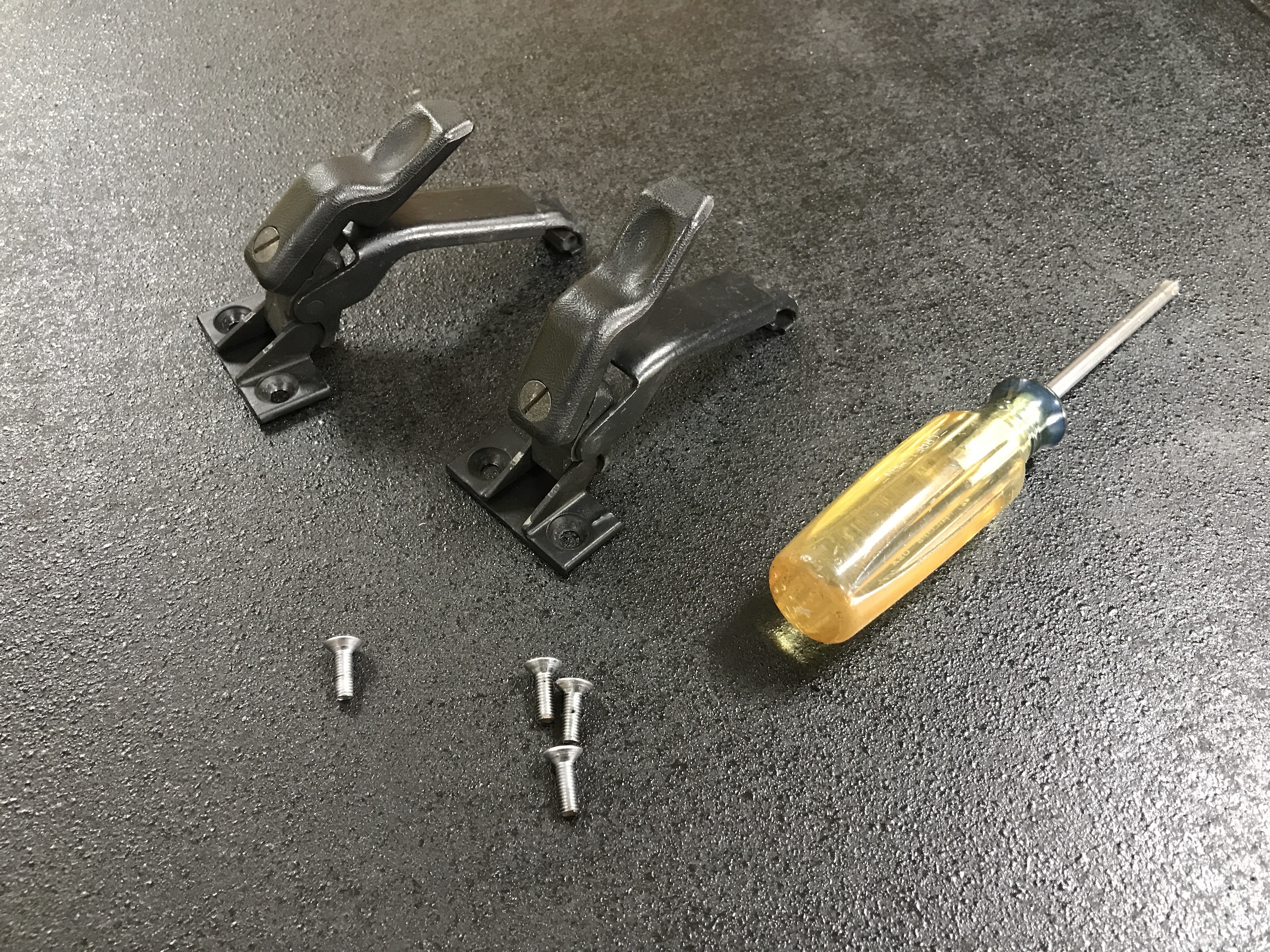

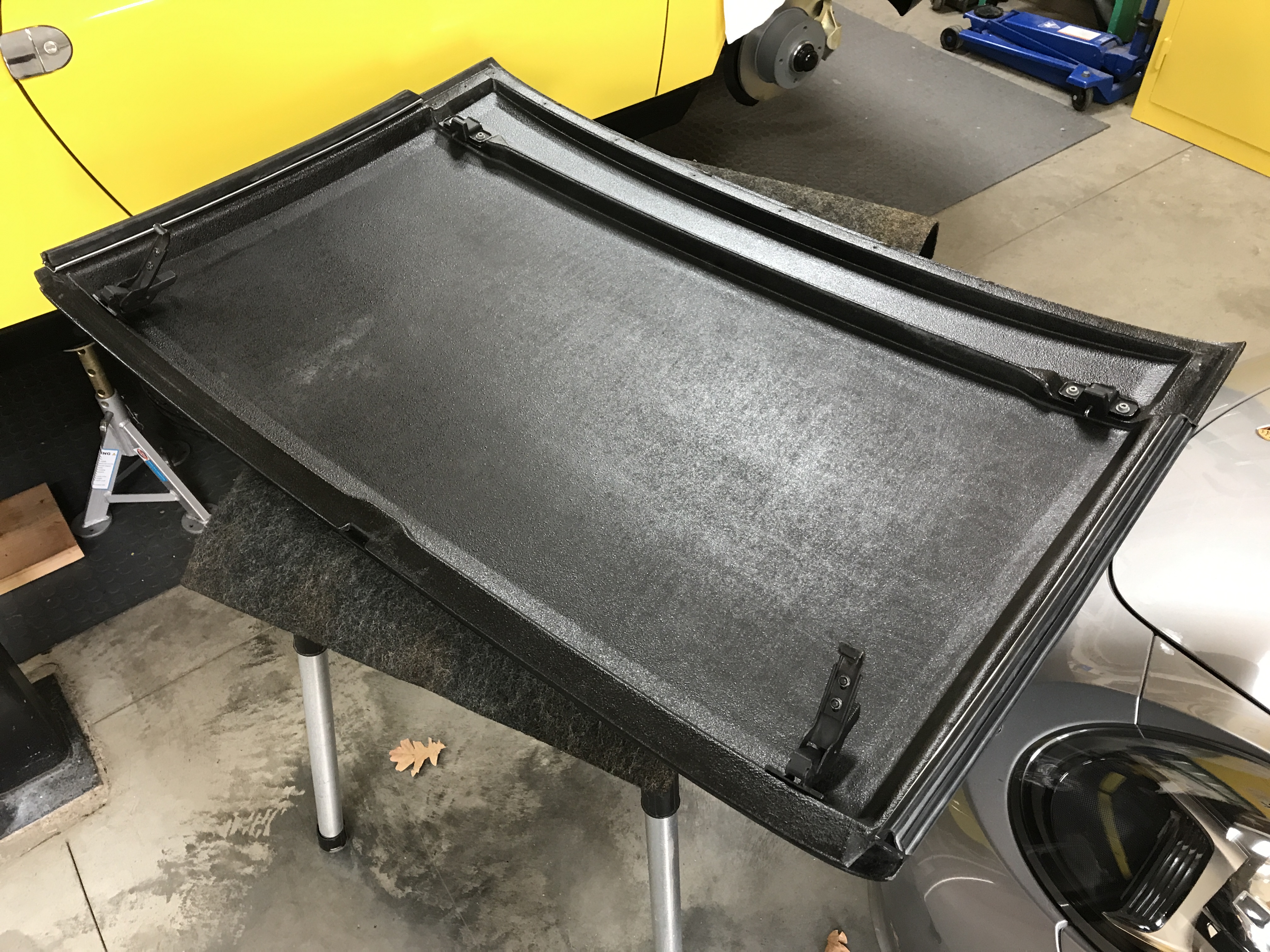

I figured the roof needs hardware to fit correctly, starting with the front latches.
bkrantz
post Apr 25 2022, 08:18 PM
Post #5107
Posts: 8,345
Joined: 3-August 19
From: SW Colorado
Member No.: 23,343

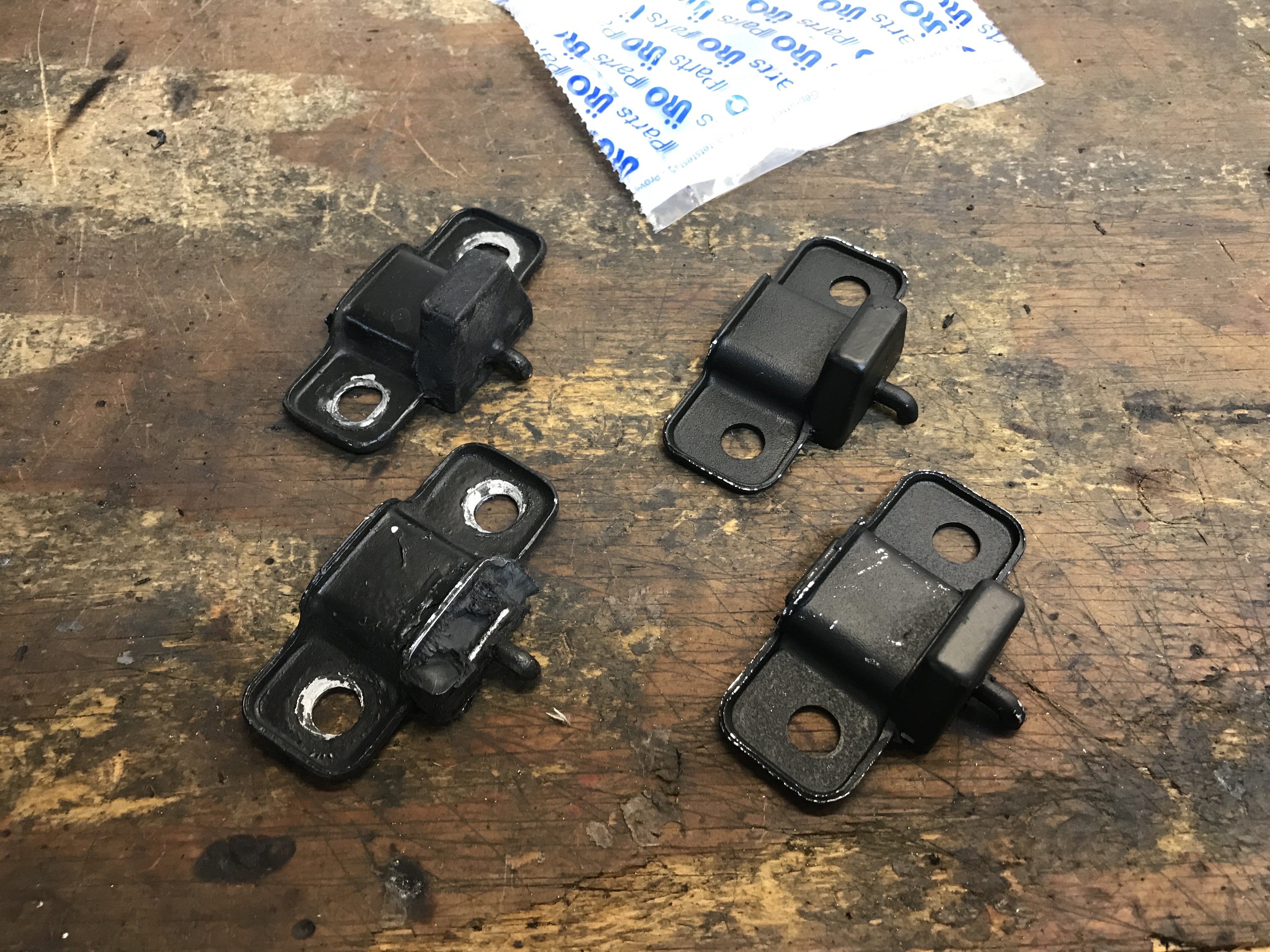

And new rubber latch blocks for the rear.
bkrantz
post Apr 25 2022, 08:19 PM
Post #5108
Posts: 8,345
Joined: 3-August 19
From: SW Colorado
Member No.: 23,343
Roof with hardware.

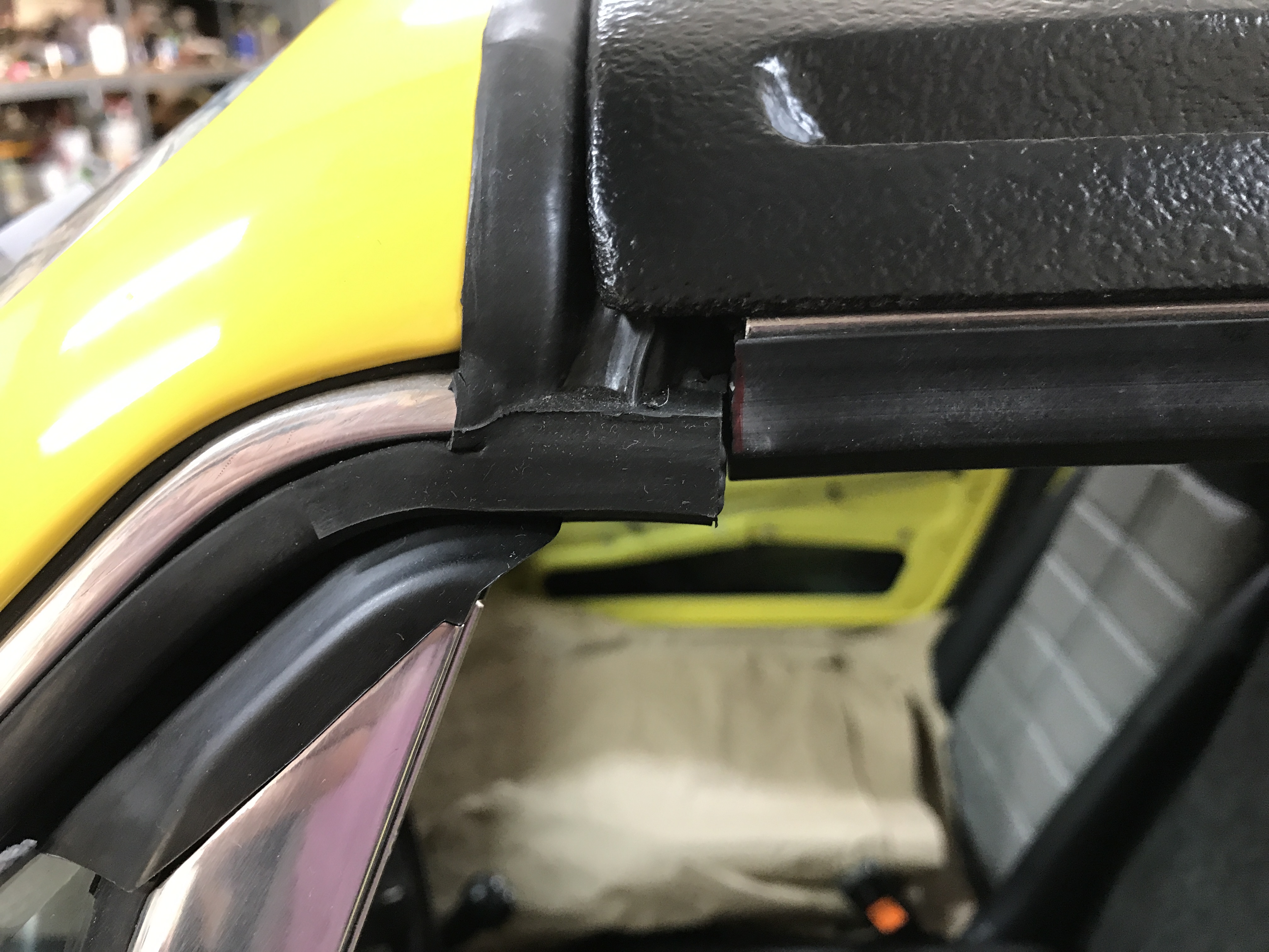

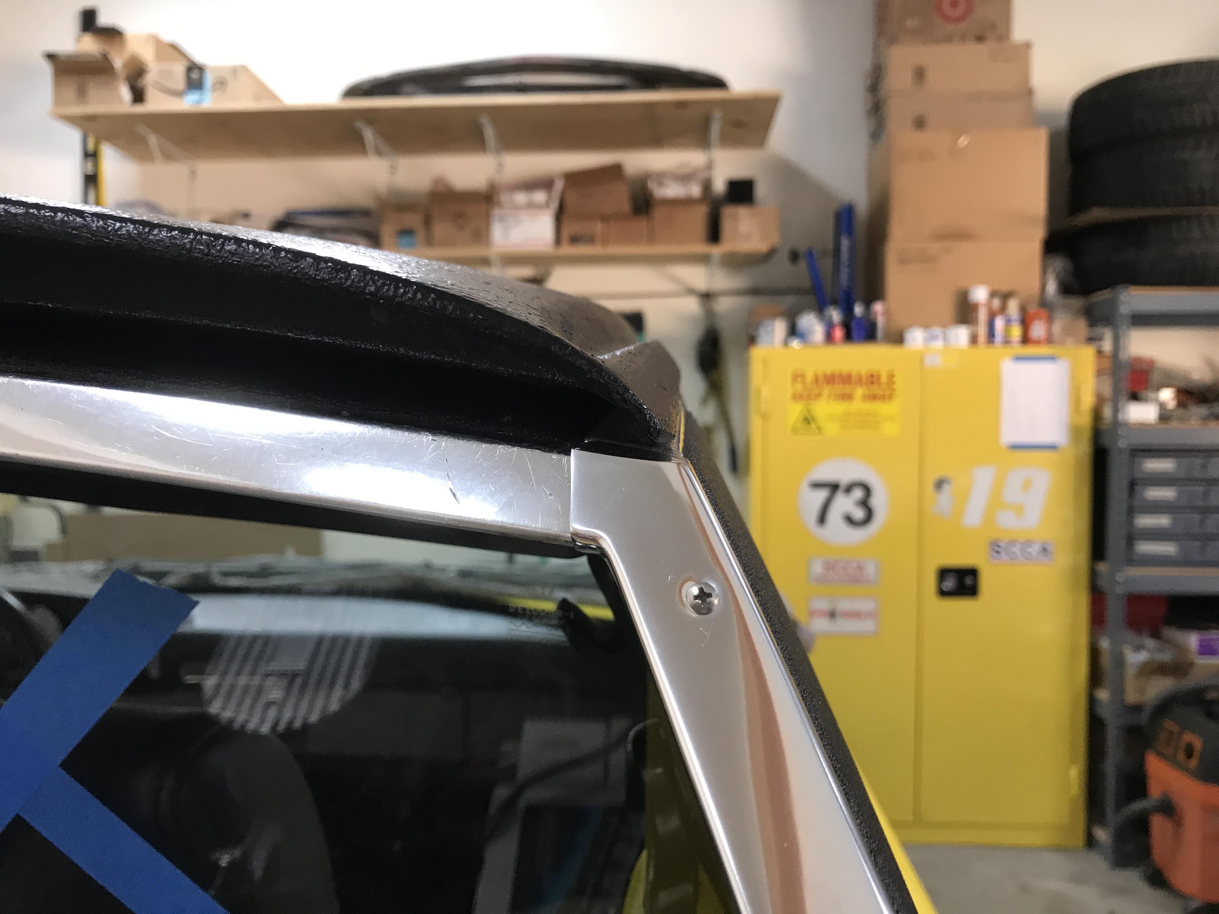

Rear alignment needs work. The right side edge sits just inboard of the targa hoop corner.
bkrantz
post Apr 25 2022, 08:24 PM
Post #5111
Posts: 8,345
Joined: 3-August 19
From: SW Colorado
Member No.: 23,343
While the left side edge sits outboard.

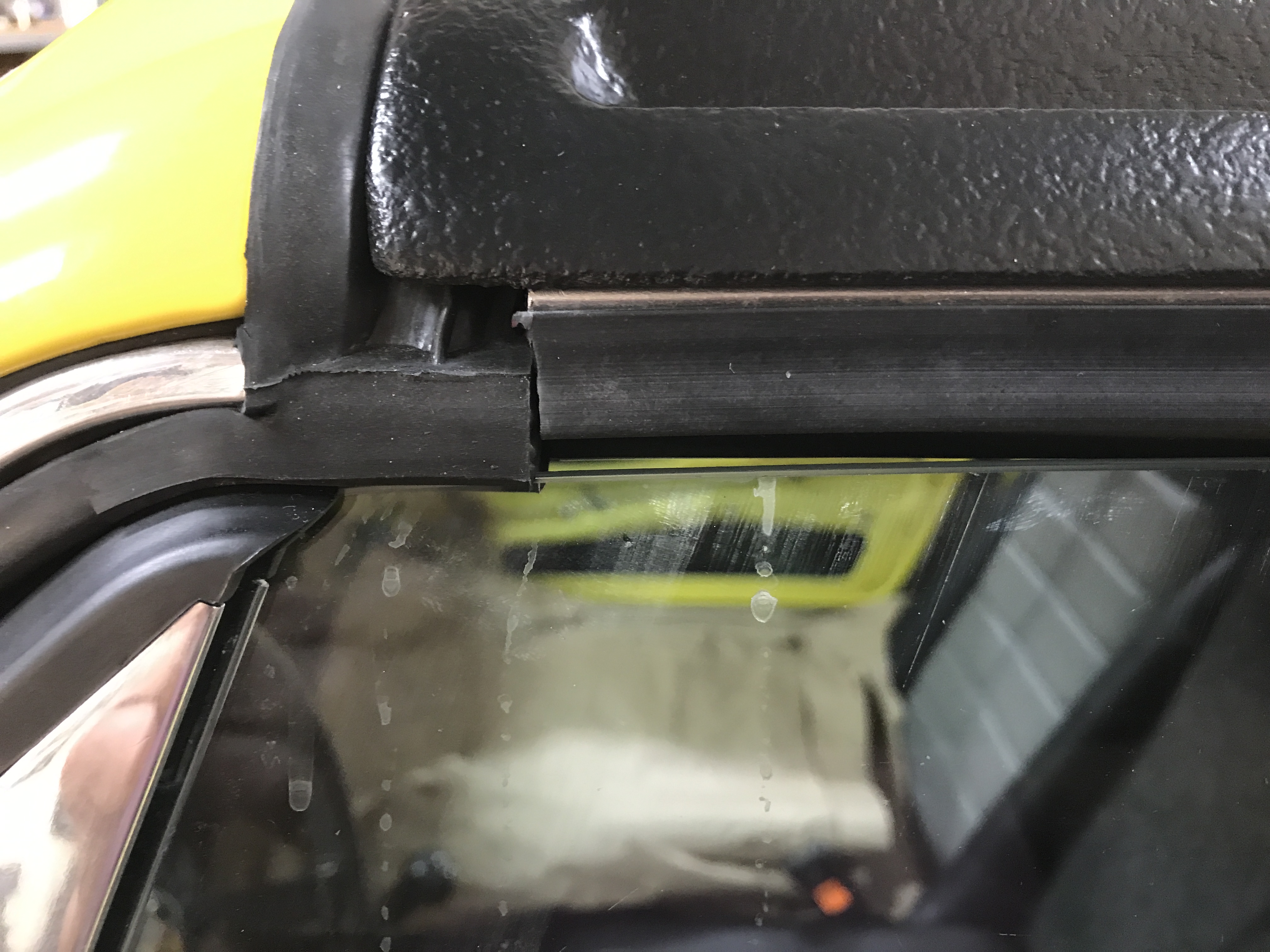

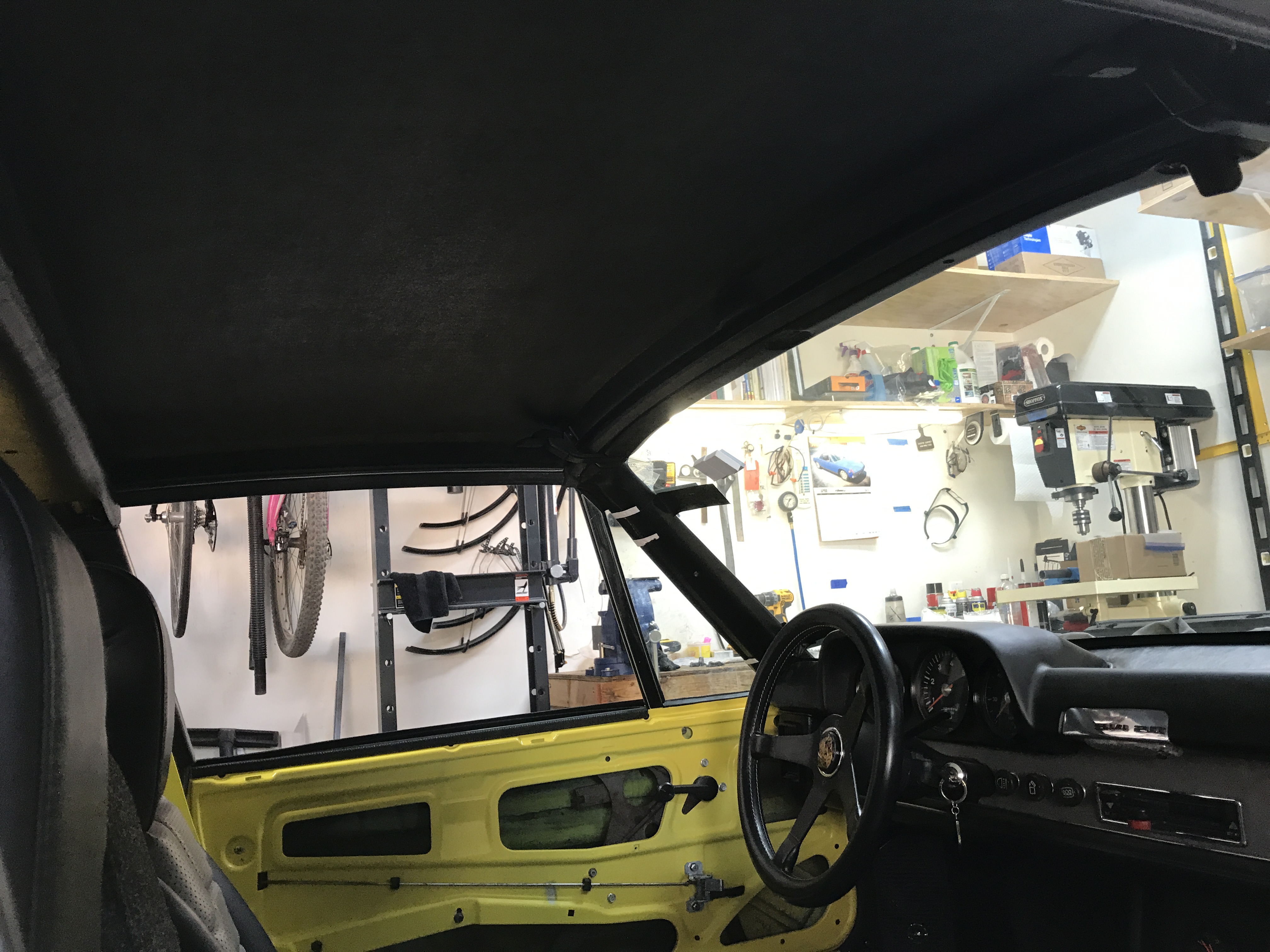

Just to get depressed, I rolled up the left window to see how bad things look. Ugh again. Did I mention that I don't like weatherstrips and seals?

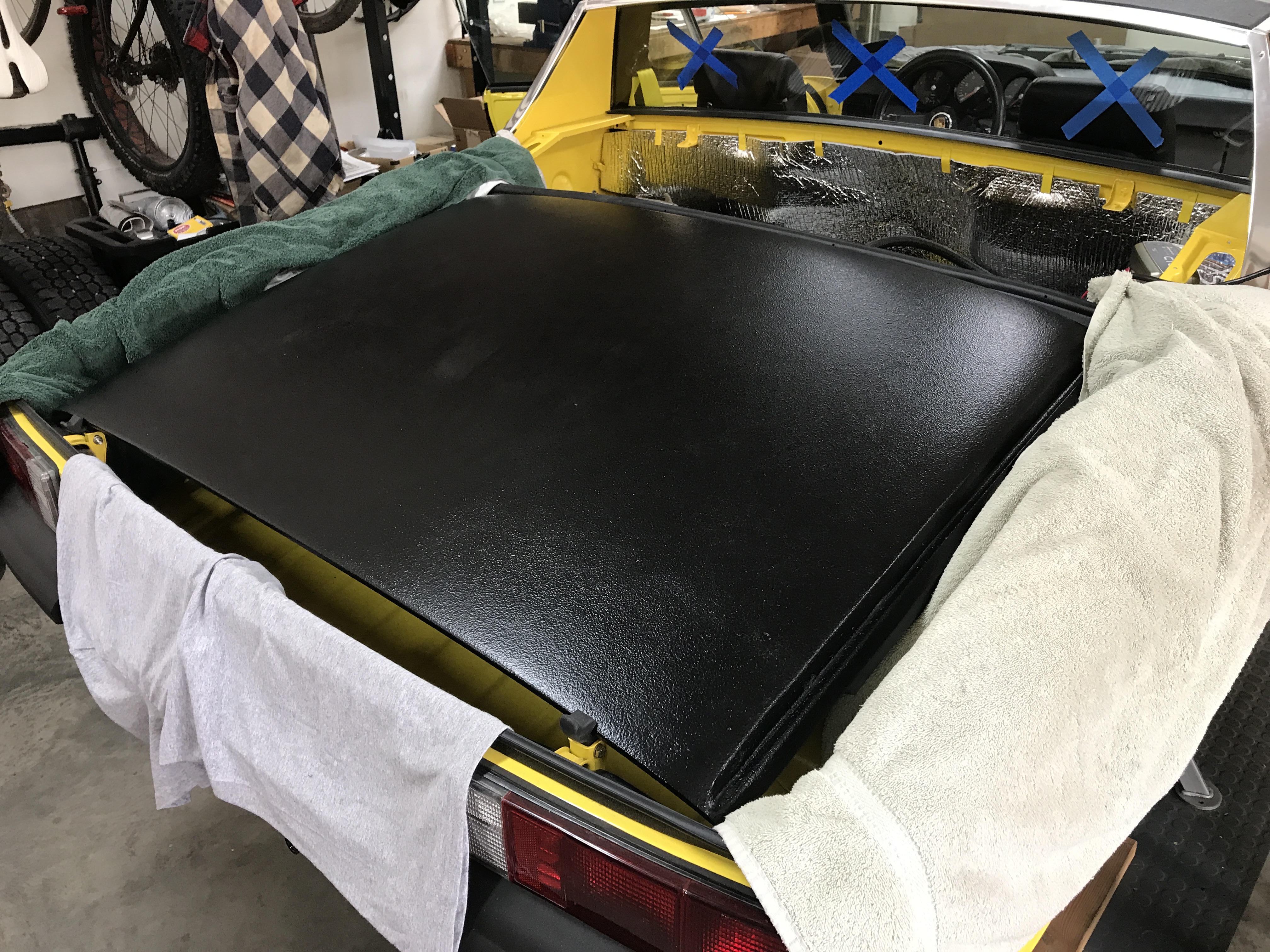

A little diversion: checking the fit of the targa top in the trunk.

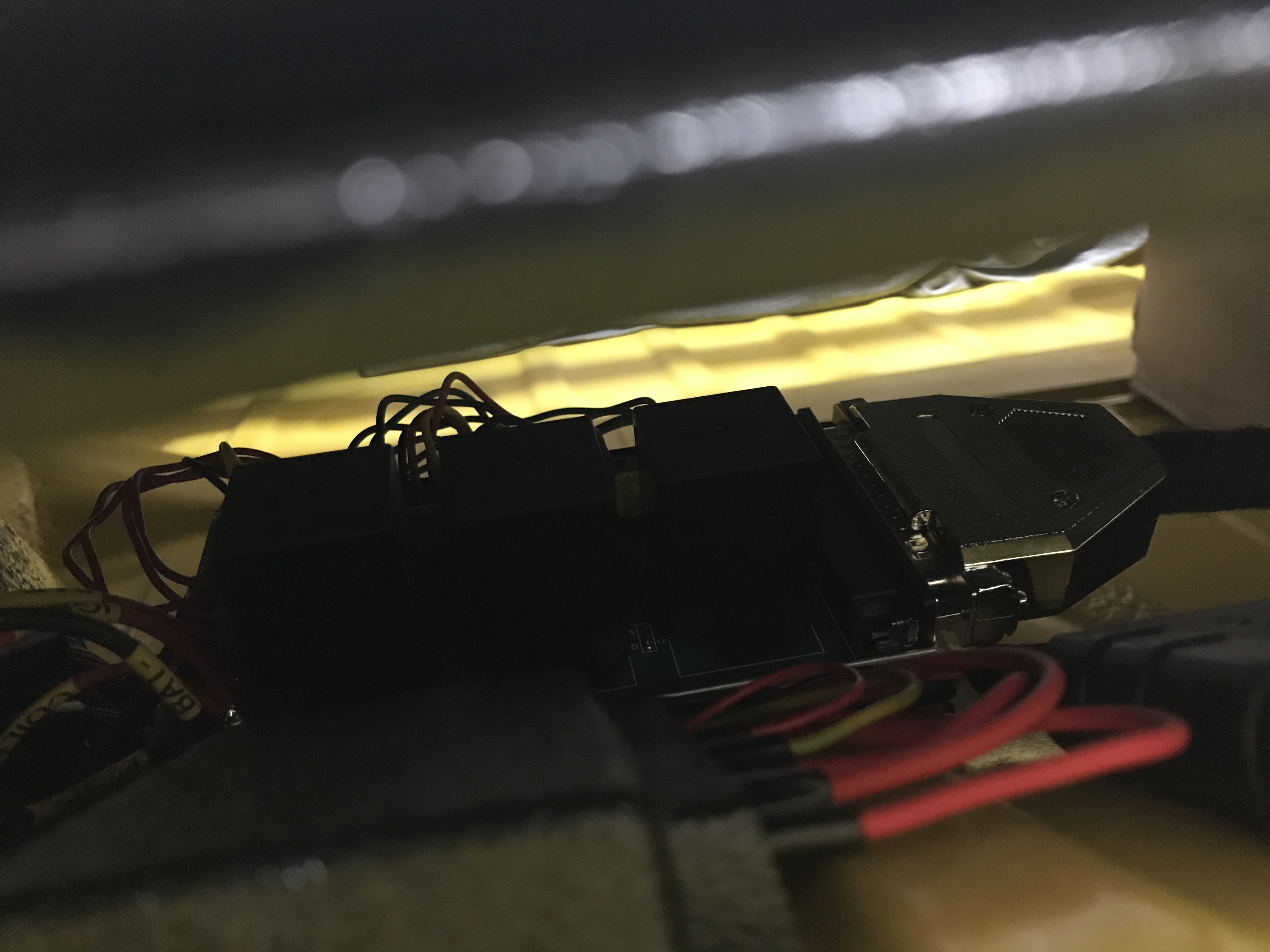

And then checking the clearance of my new EFI stuff under the forward edge of the top. Looks OK (and room for a cover over the EFI).

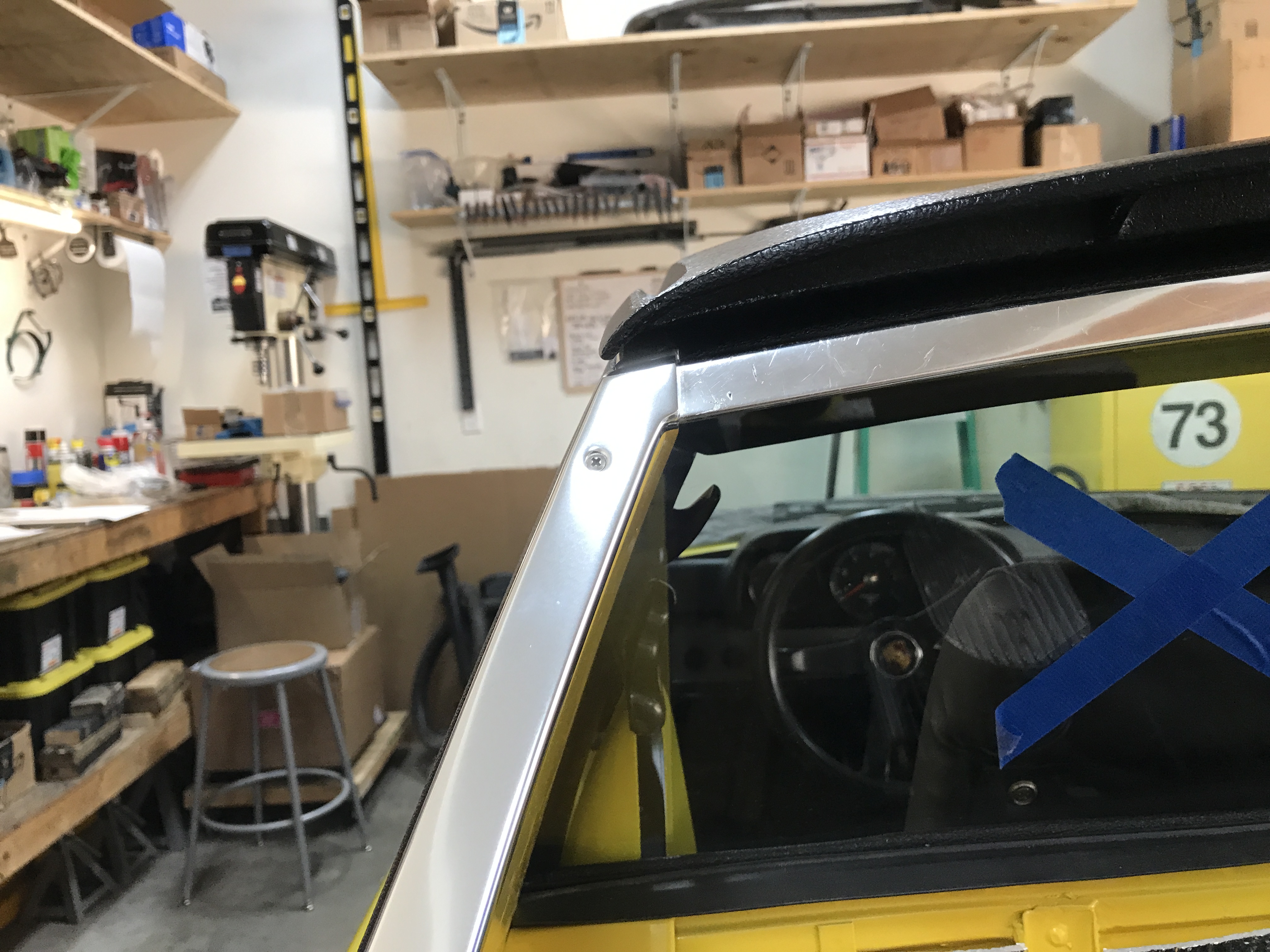

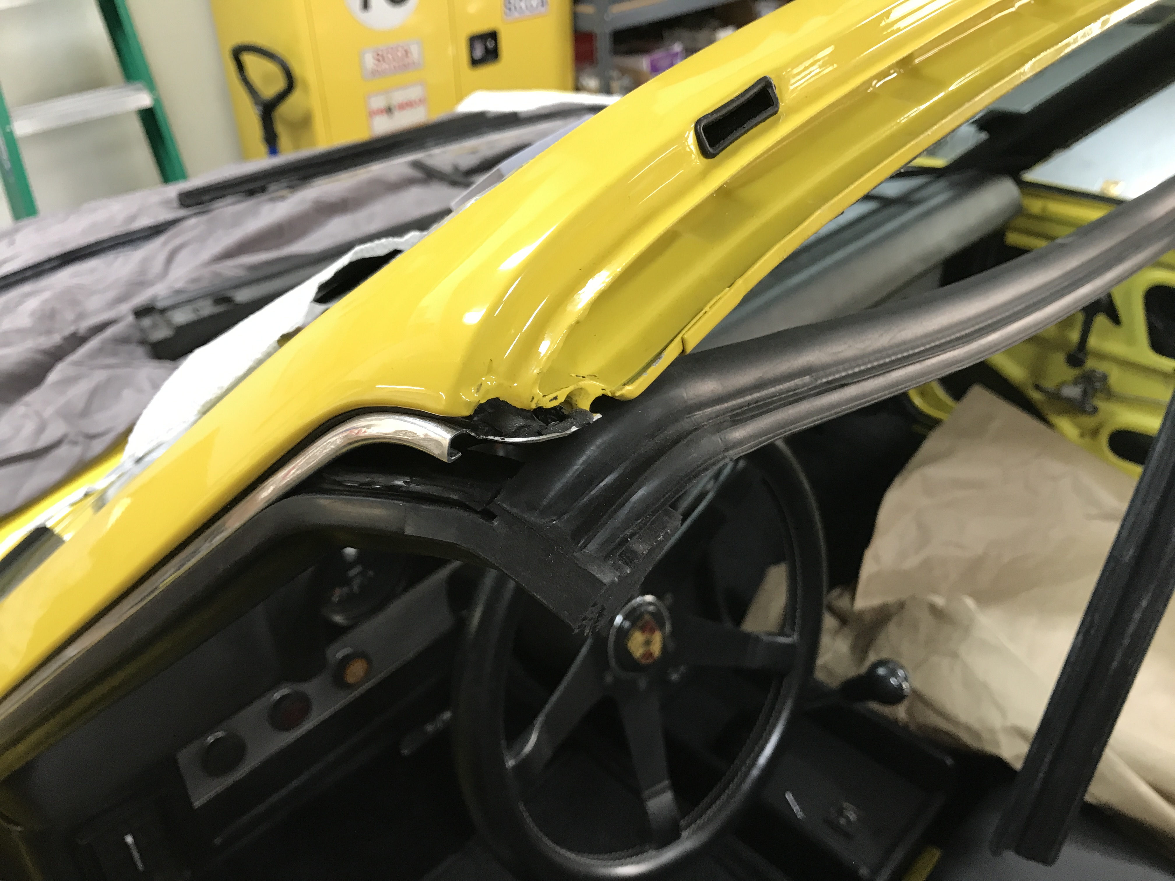

Back to working on rubber piece alignment. I pulled off the front seals and worked on fitting the A-pillar trim.
bkrantz
post Apr 28 2022, 07:32 PM
Post #5116
Posts: 8,345
Joined: 3-August 19
From: SW Colorado
Member No.: 23,343

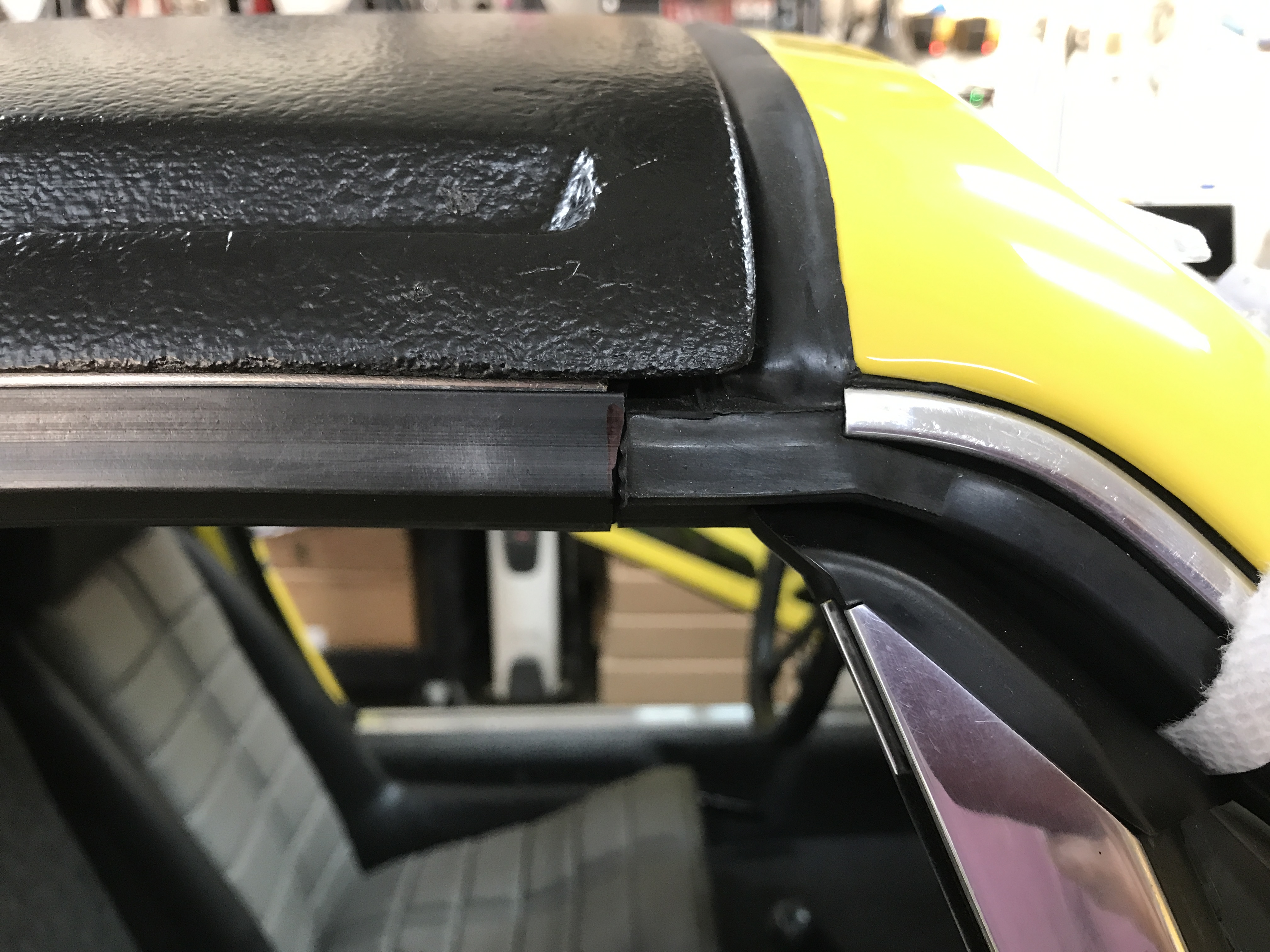

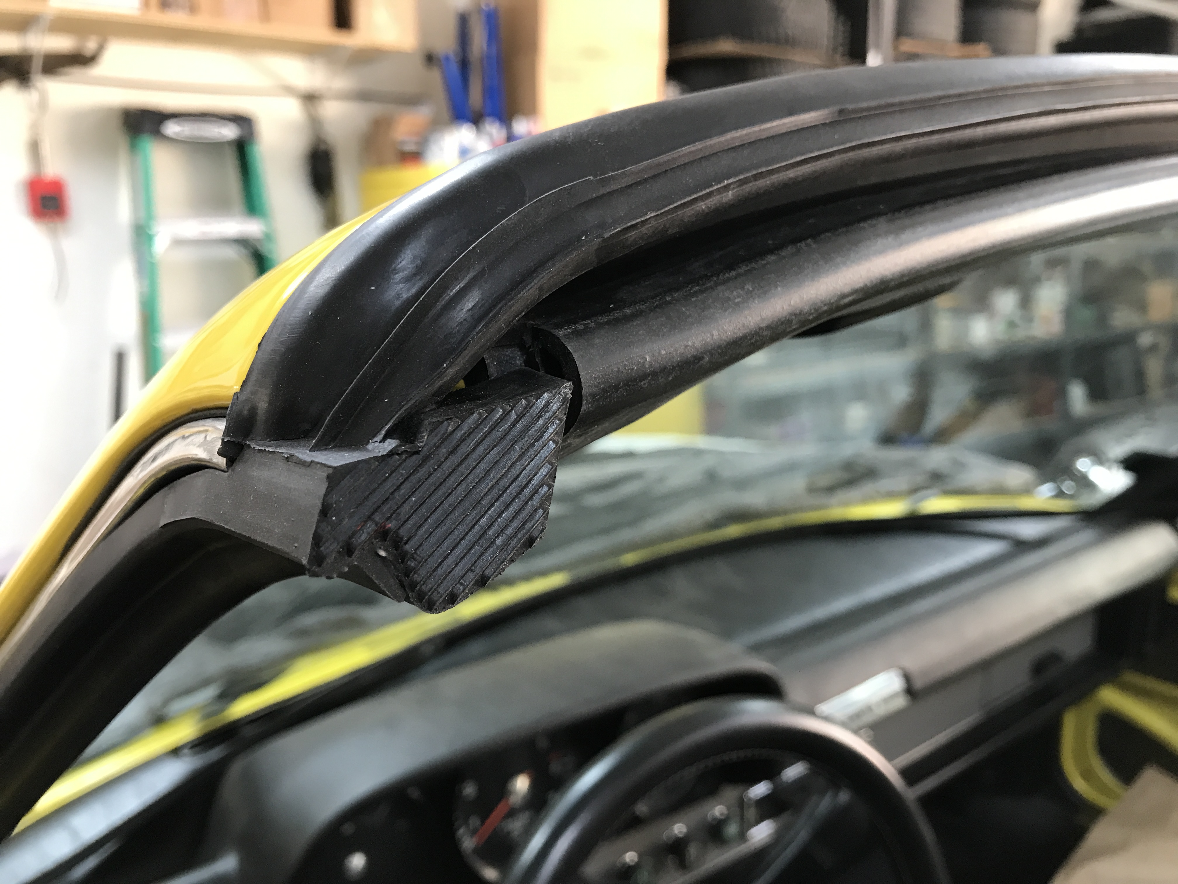

And I got the rubber seal remounted a bit higher.

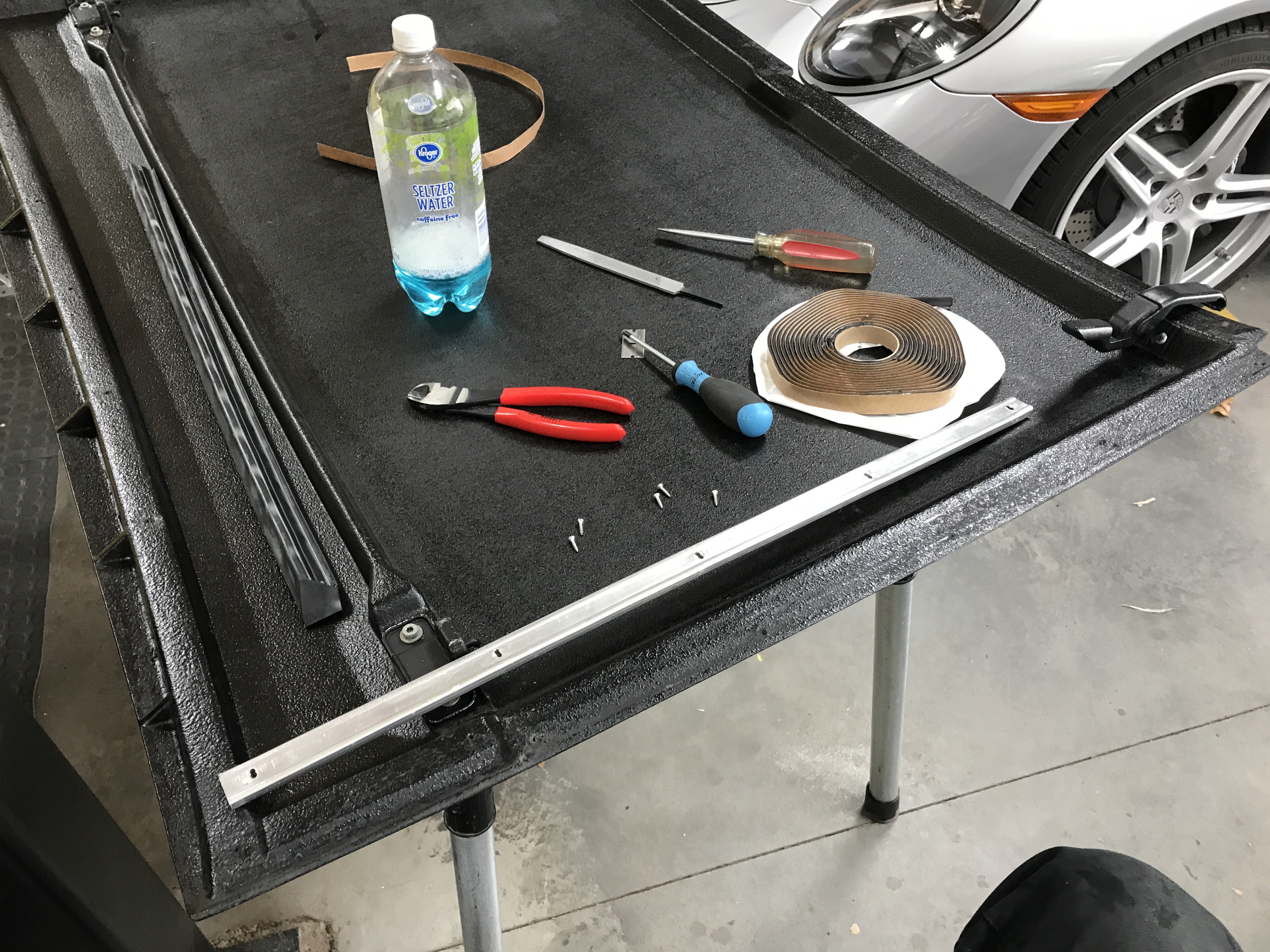

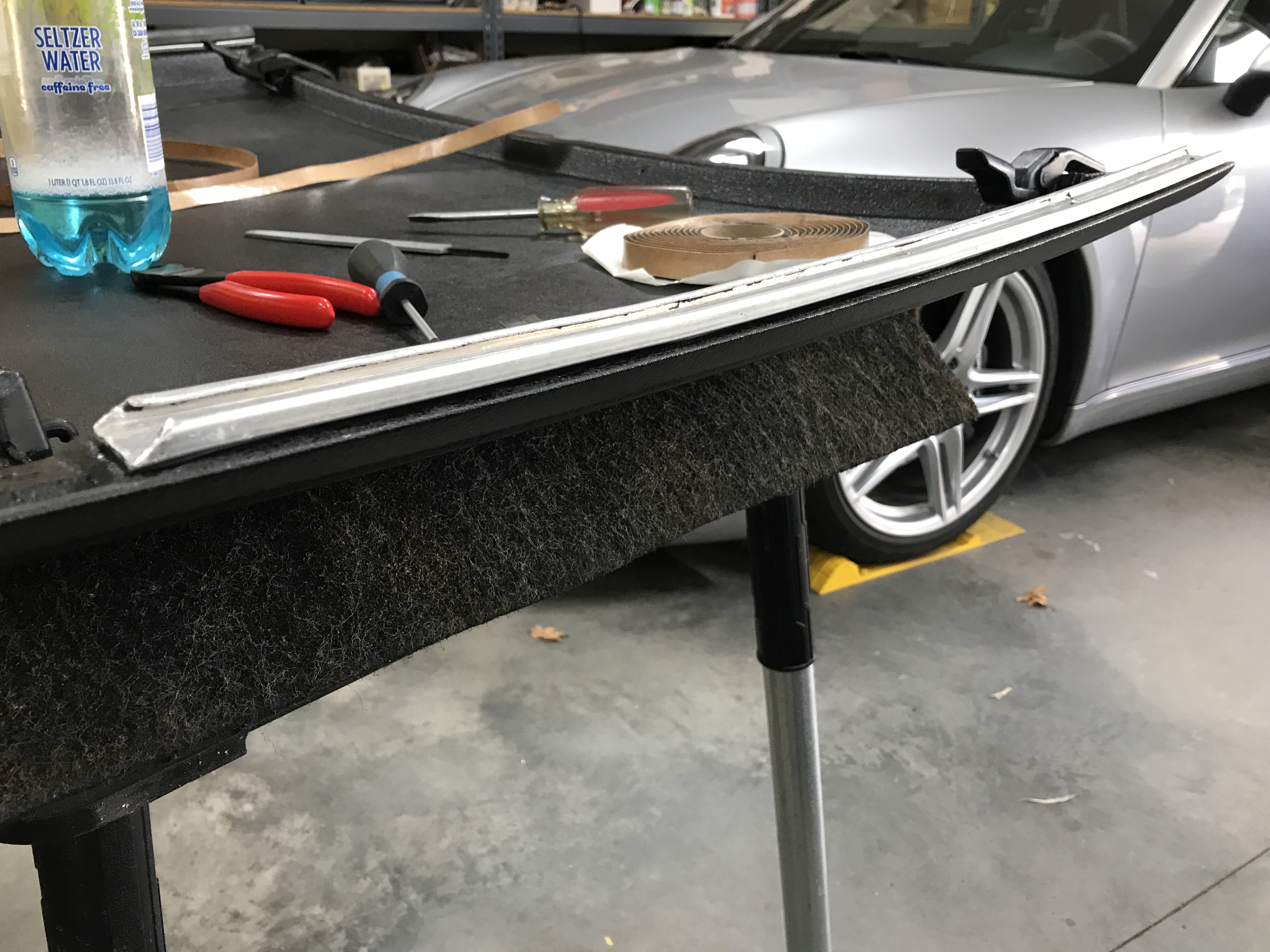

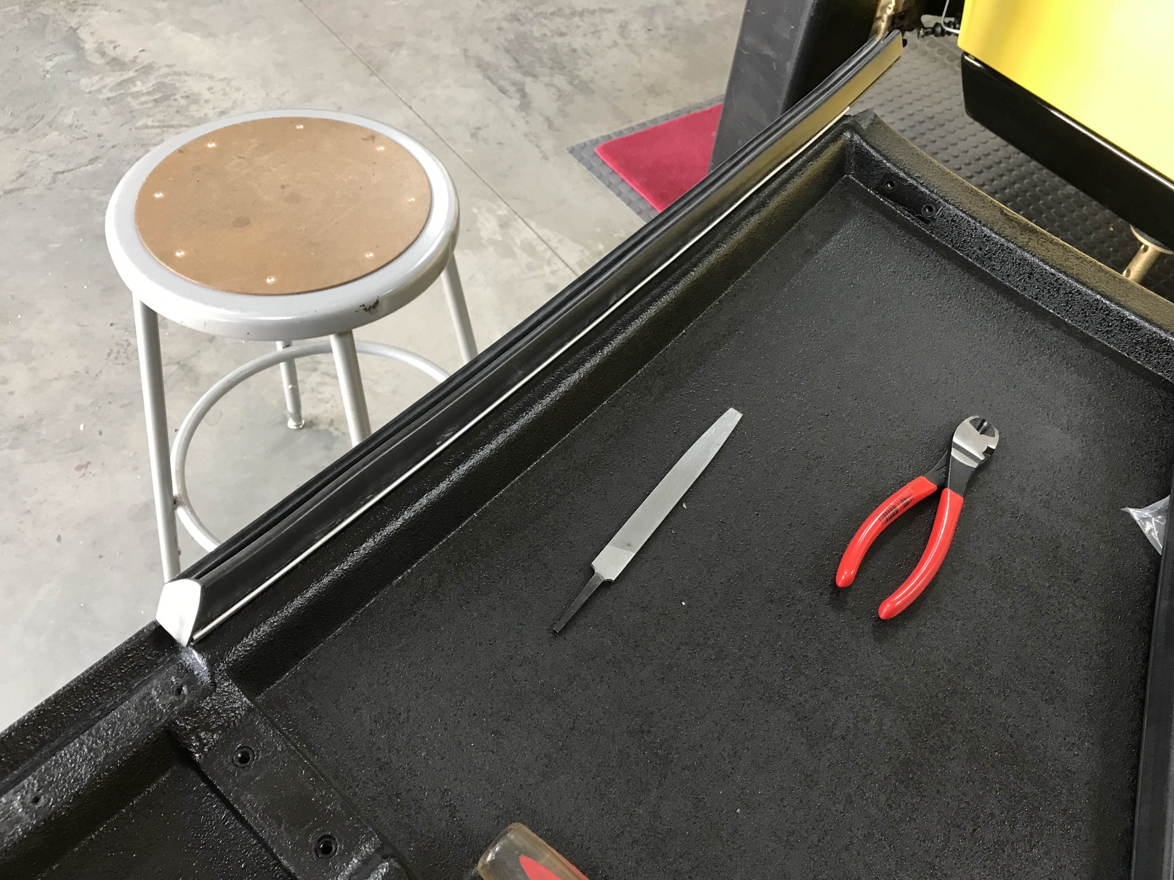

Then I remembered something (duh). When I mounted the side seal trim strips, I forgot to put butyl tape between the trim and the top. So I got out my roll of 1/2 x 1/8 butyl tape.
bkrantz
post Apr 28 2022, 07:35 PM
Post #5118
Posts: 8,345
Joined: 3-August 19
From: SW Colorado
Member No.: 23,343
Trim mounted with butyl. And then I went through the fun of installing the side seals (again).

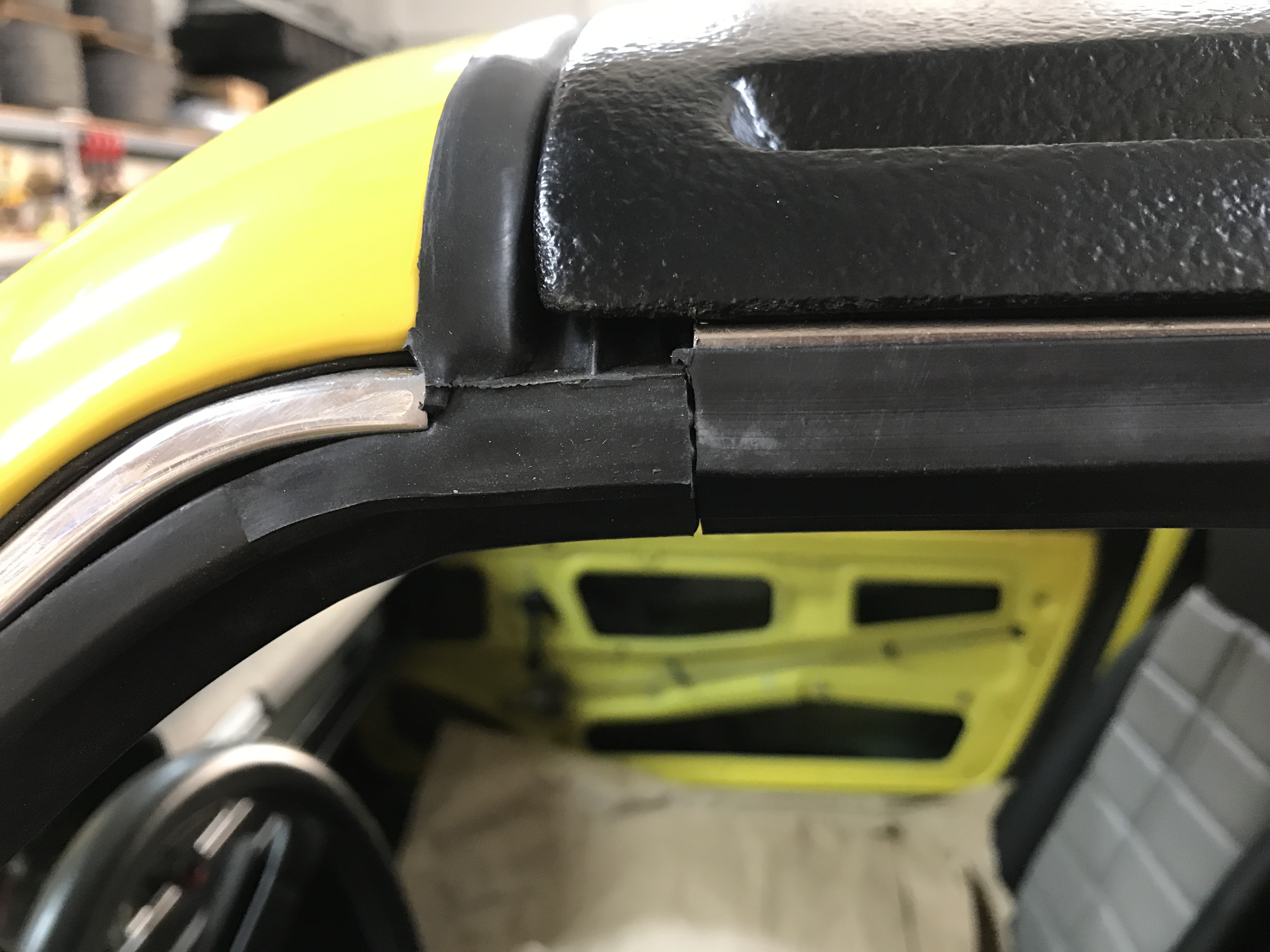

Yay! Left side alignment now looks good.

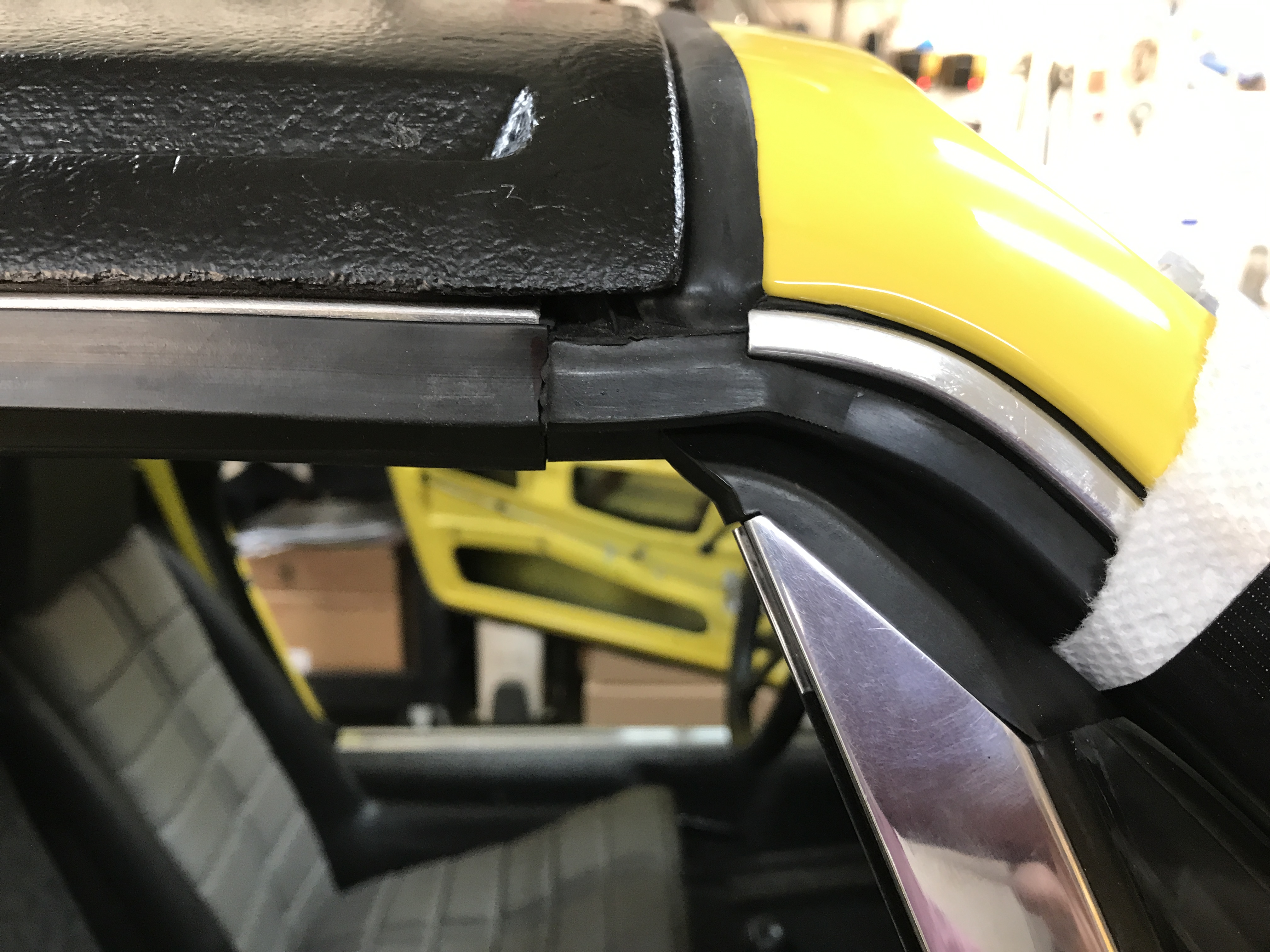

And the right side is good, too.
