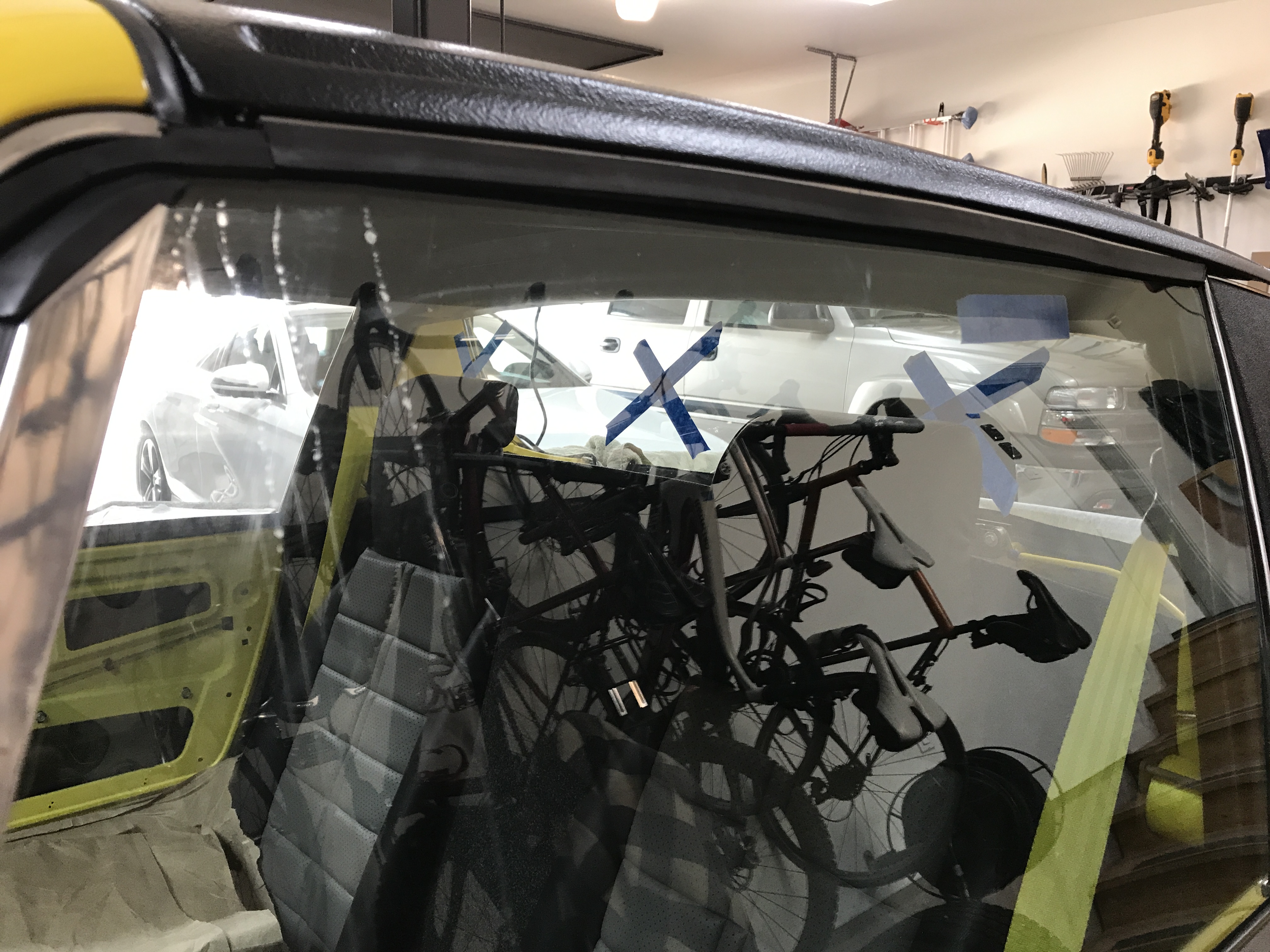

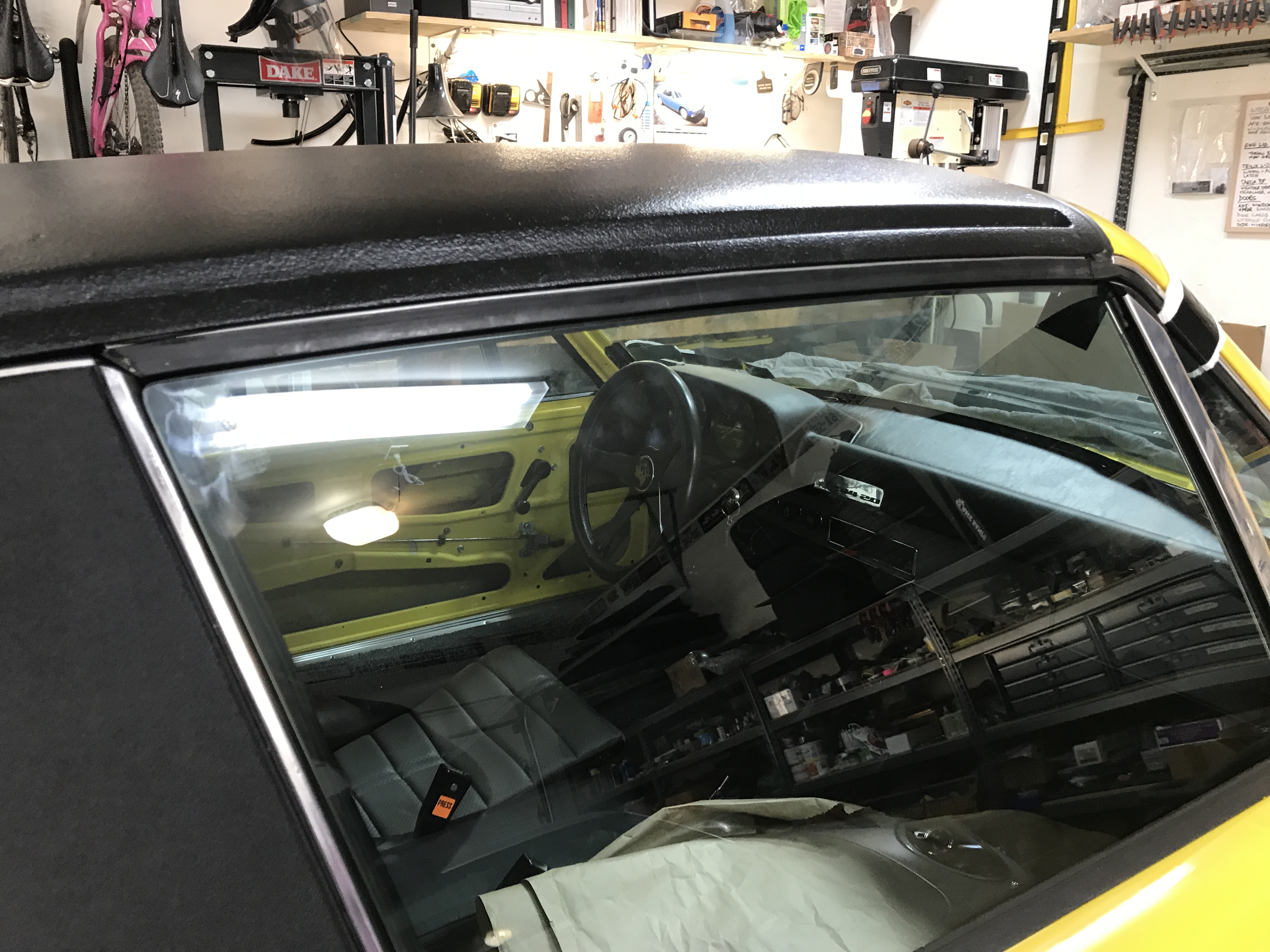

Left window also looks good.
bkrantz
post Apr 28 2022, 07:39 PM
Post #5122
Posts: 8,345
Joined: 3-August 19
From: SW Colorado
Member No.: 23,343
But the right window needs some work, since it closes a bit uneven along the top.

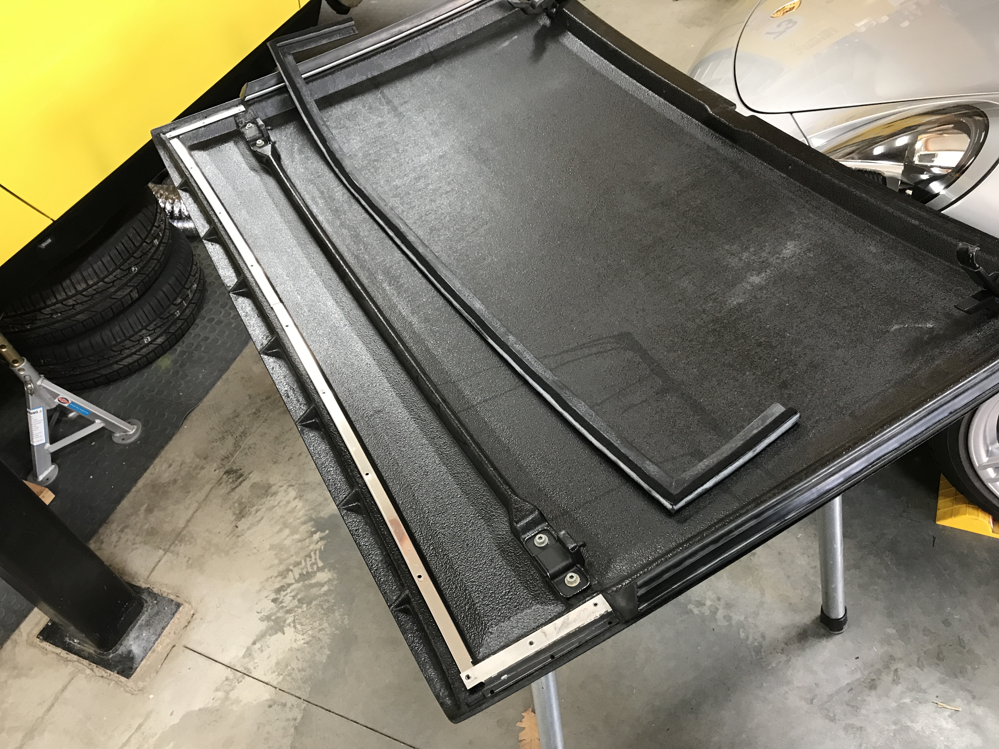

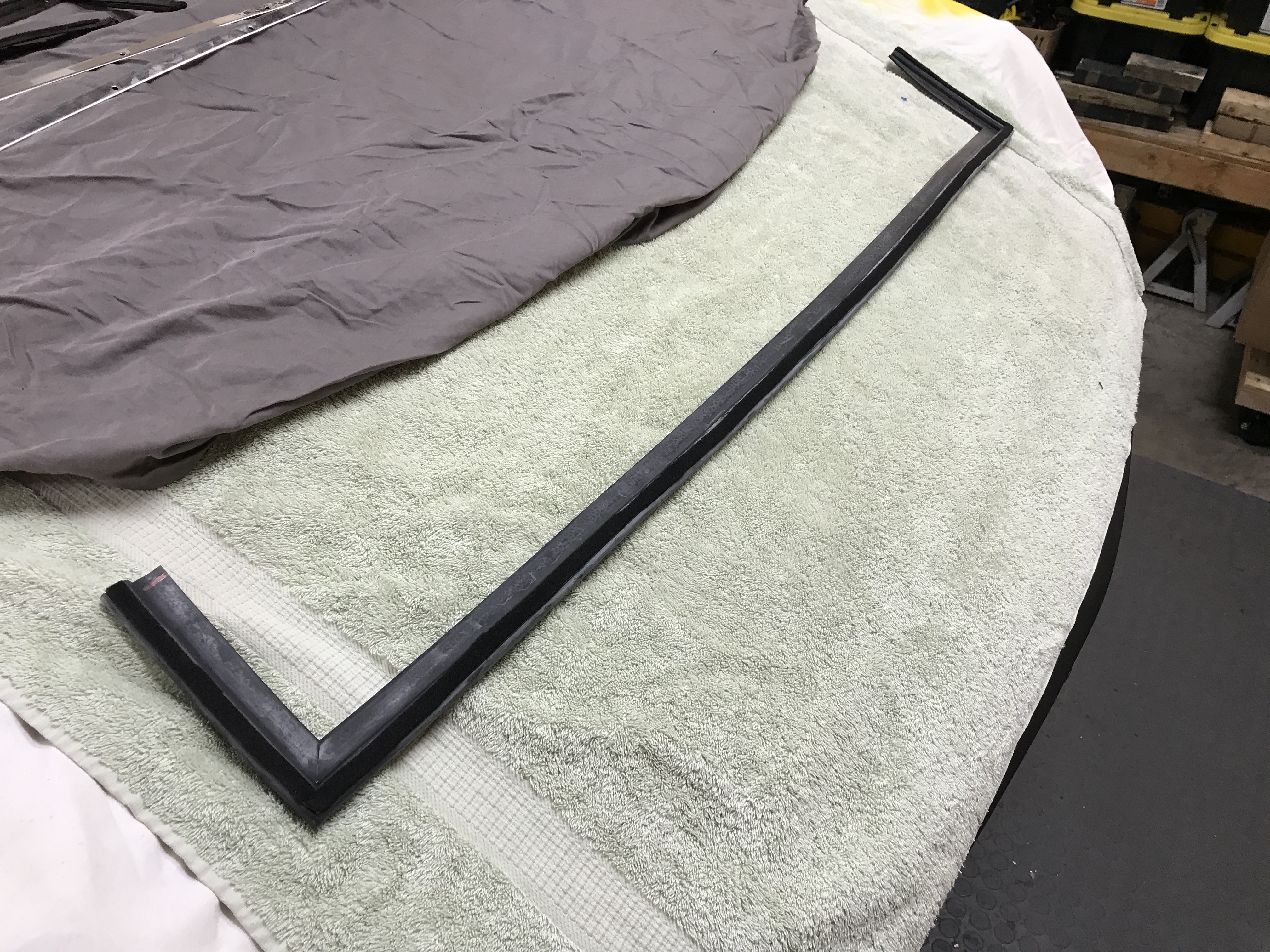

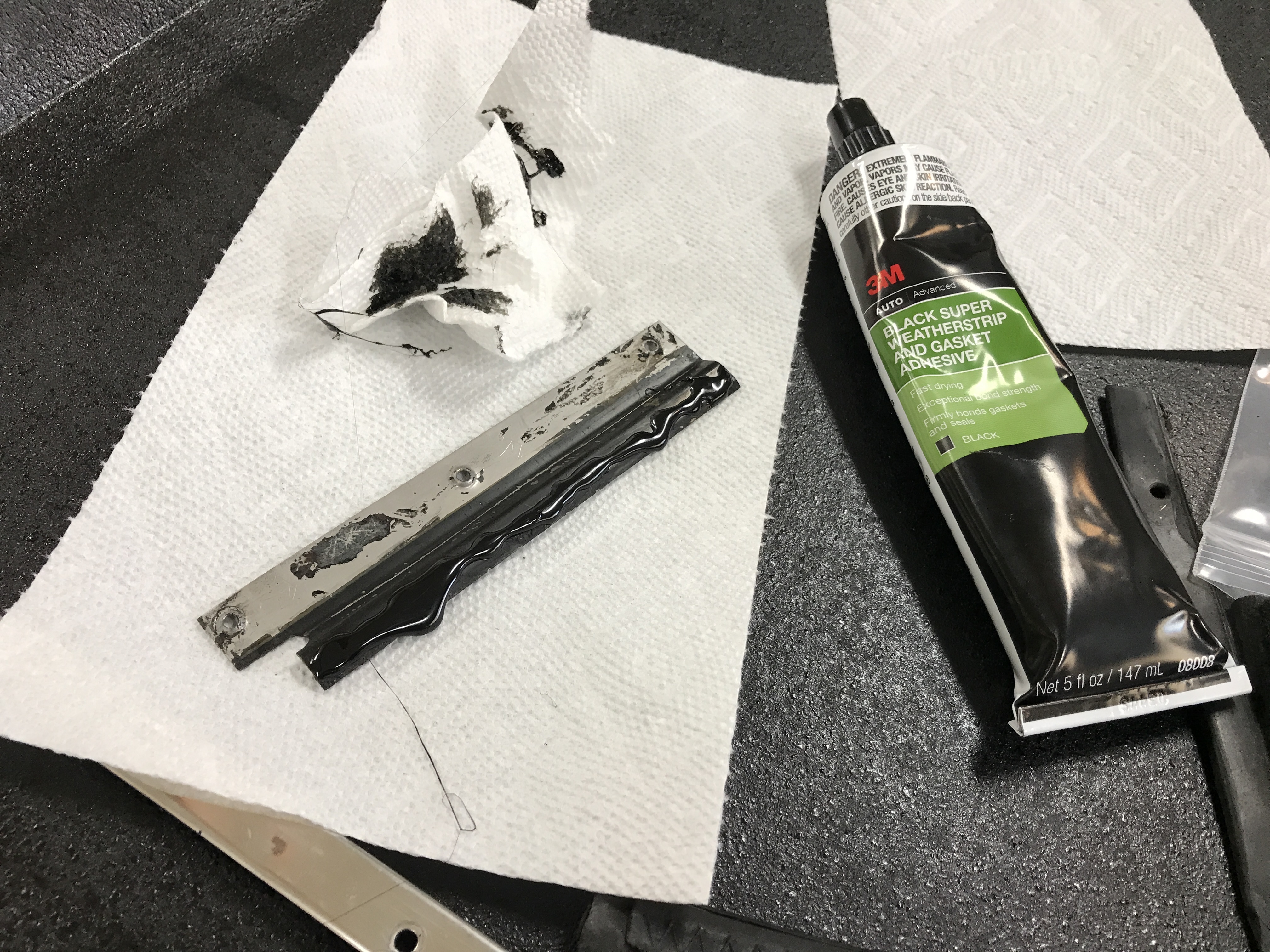

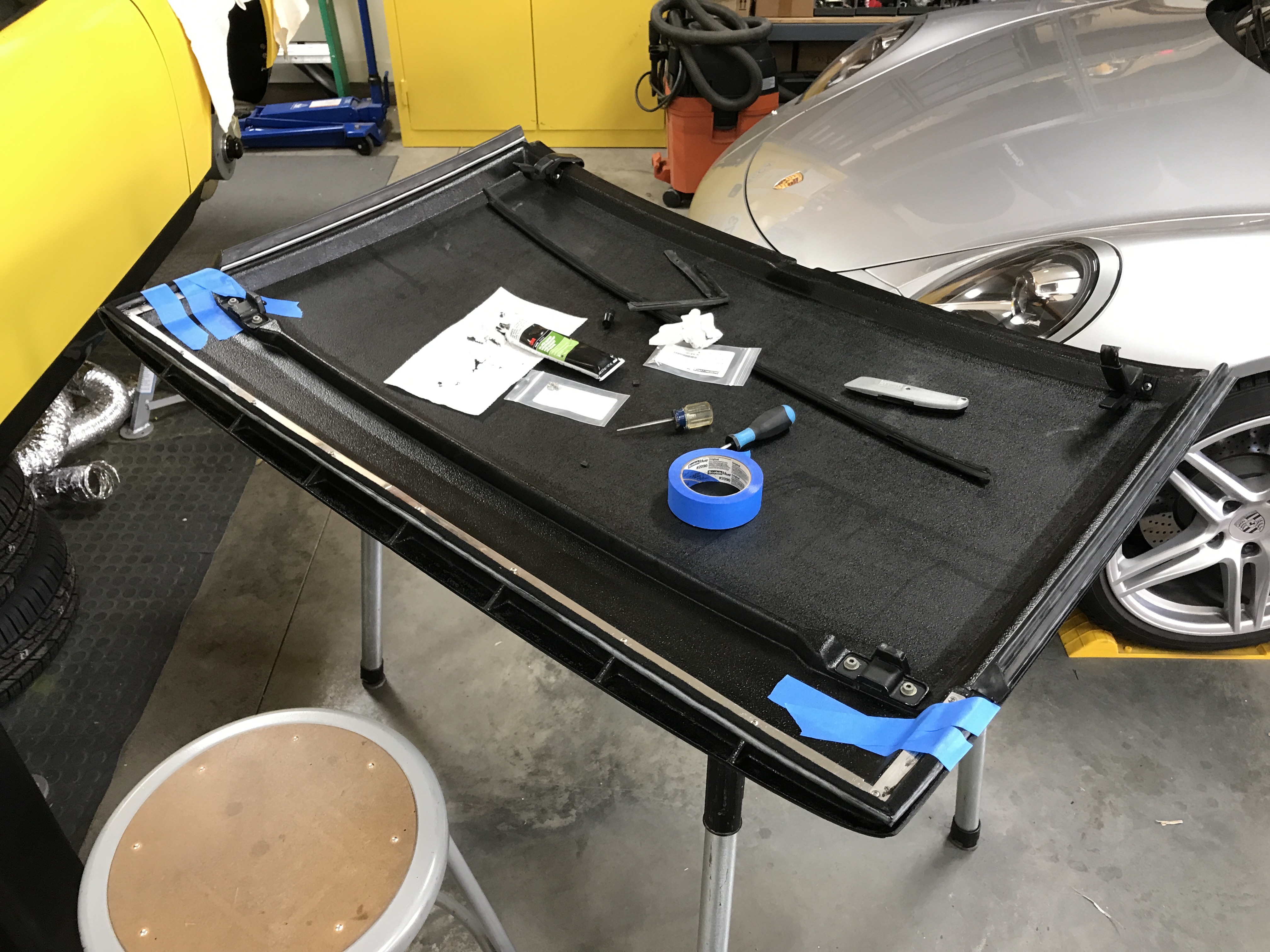

I needed a break from playing window adjuster, so I tackled the targa top rear seal. Here is the replacement I got from 914 Rubber. I know it can be installed as-is, but I want to duplicate the original.

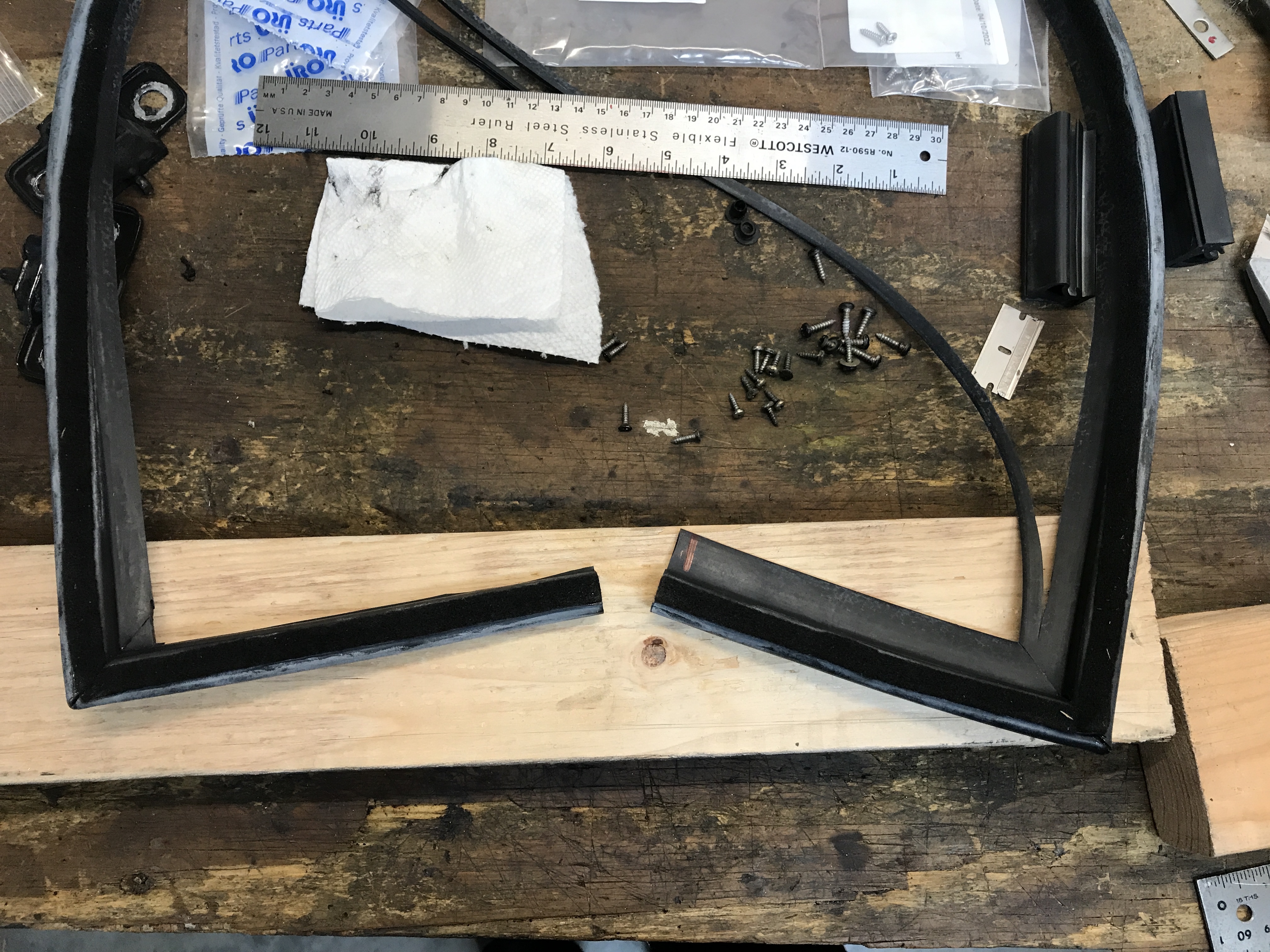

First, I test fitted the metal strips, including the side pieces that were molded into the original rubber seal.

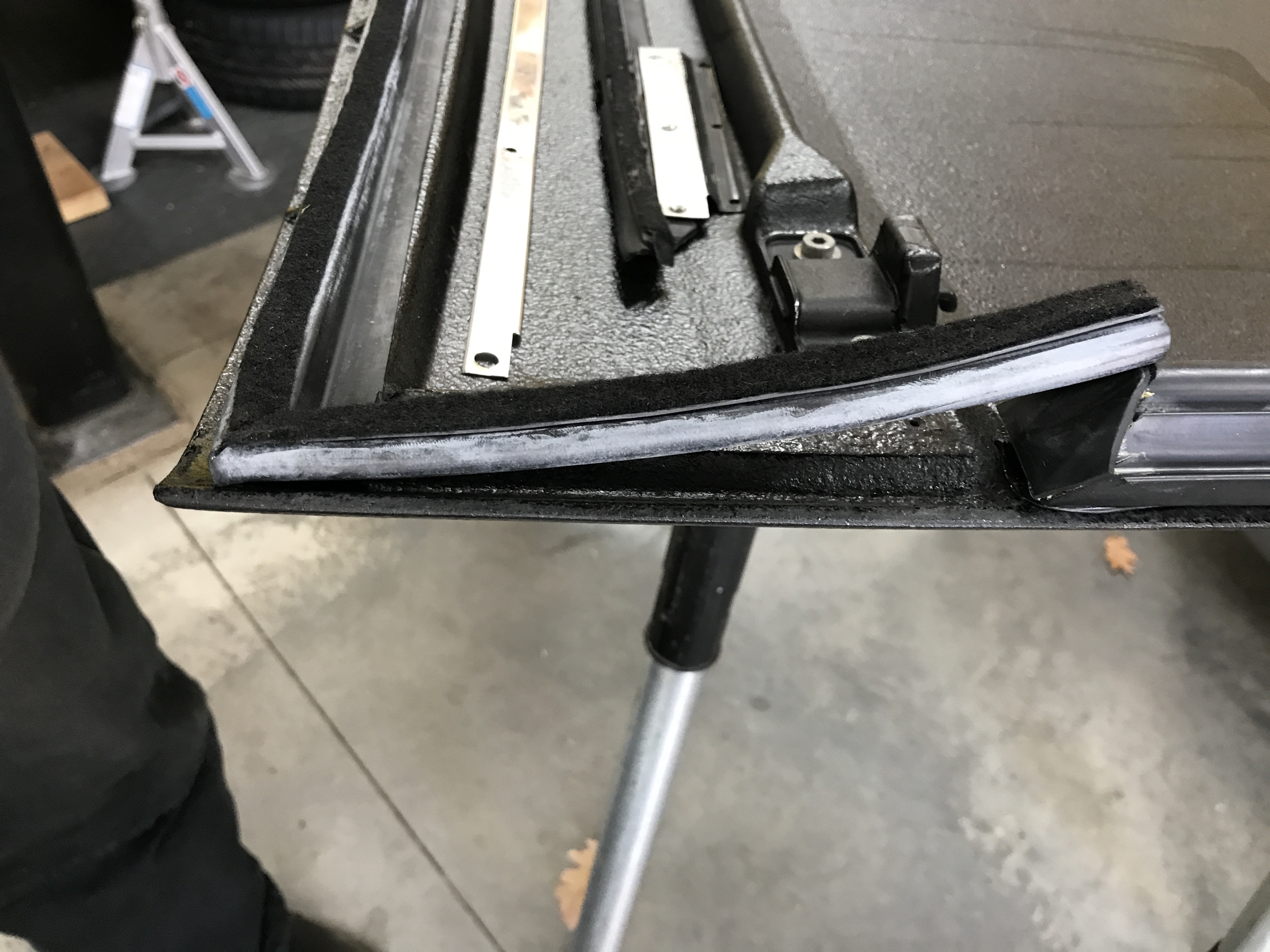

Starting to modify the rubber. I removed the flat flaps from the side sections, and trimmed about 3 mm from the flap along the transverse section.
bkrantz
post Apr 29 2022, 07:22 PM
Post #5130
Posts: 8,345
Joined: 3-August 19
From: SW Colorado
Member No.: 23,343
The side sections are a bit too long, so I trimmed them to fit.

That's better.

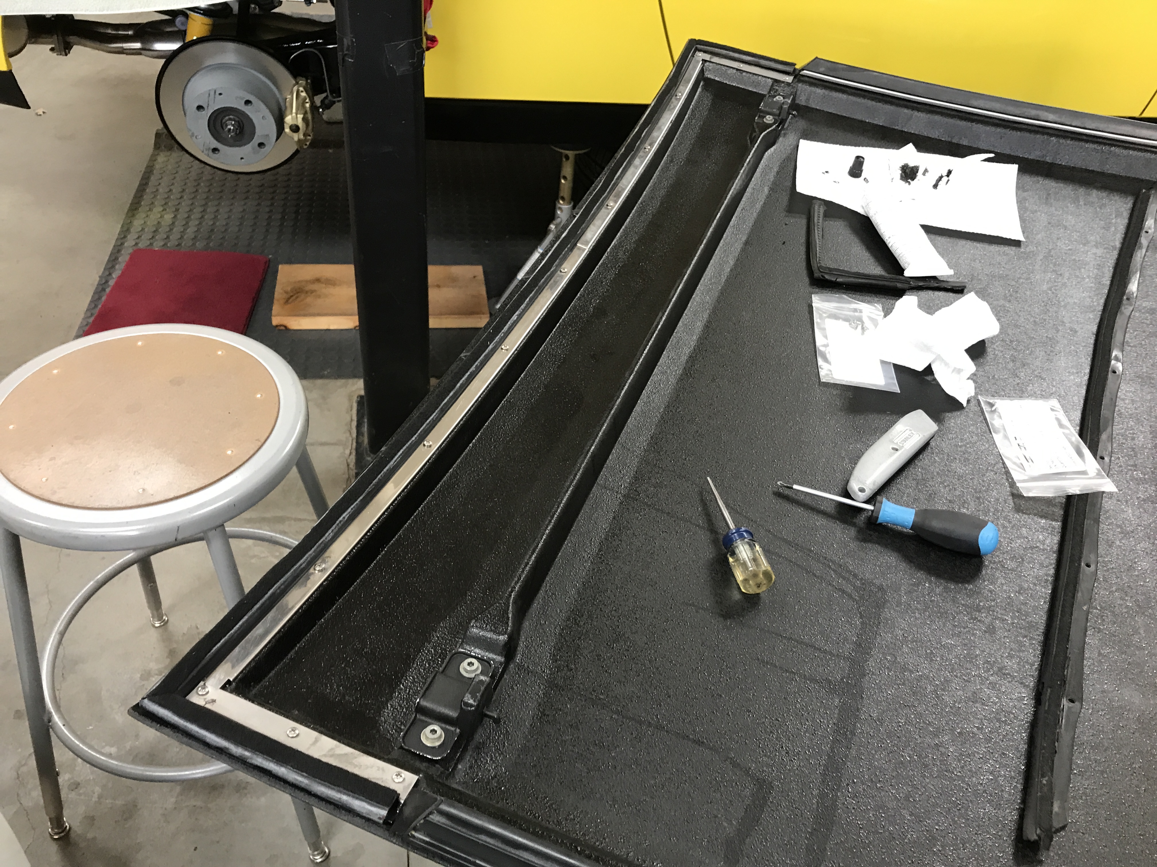

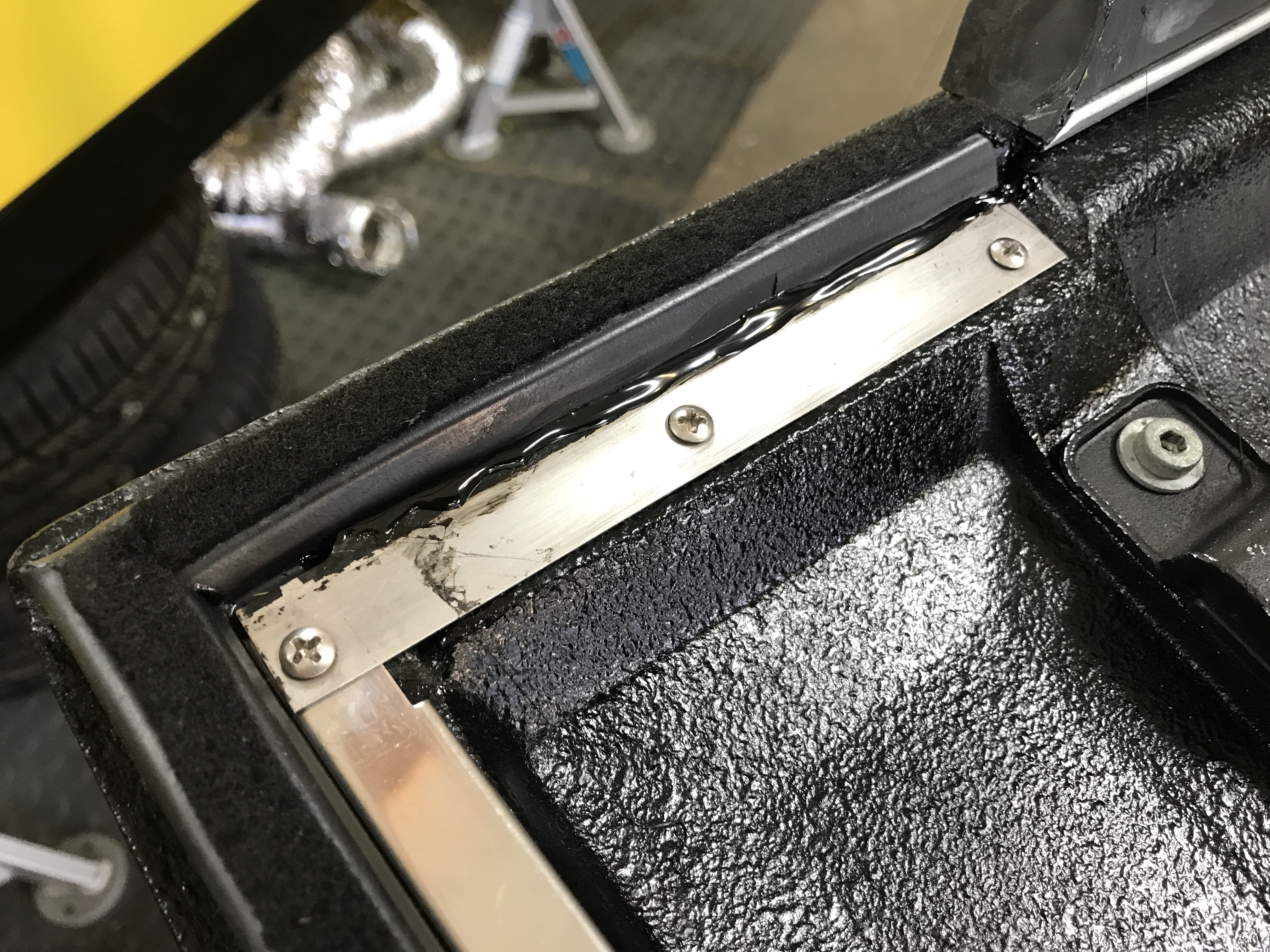

I used 3M weatherstrip adhesive to first glue the entire rubber piece to the top, and then some glue on the side metal sections.
bkrantz
post Apr 29 2022, 07:26 PM
Post #5133
Posts: 8,345
Joined: 3-August 19
From: SW Colorado
Member No.: 23,343

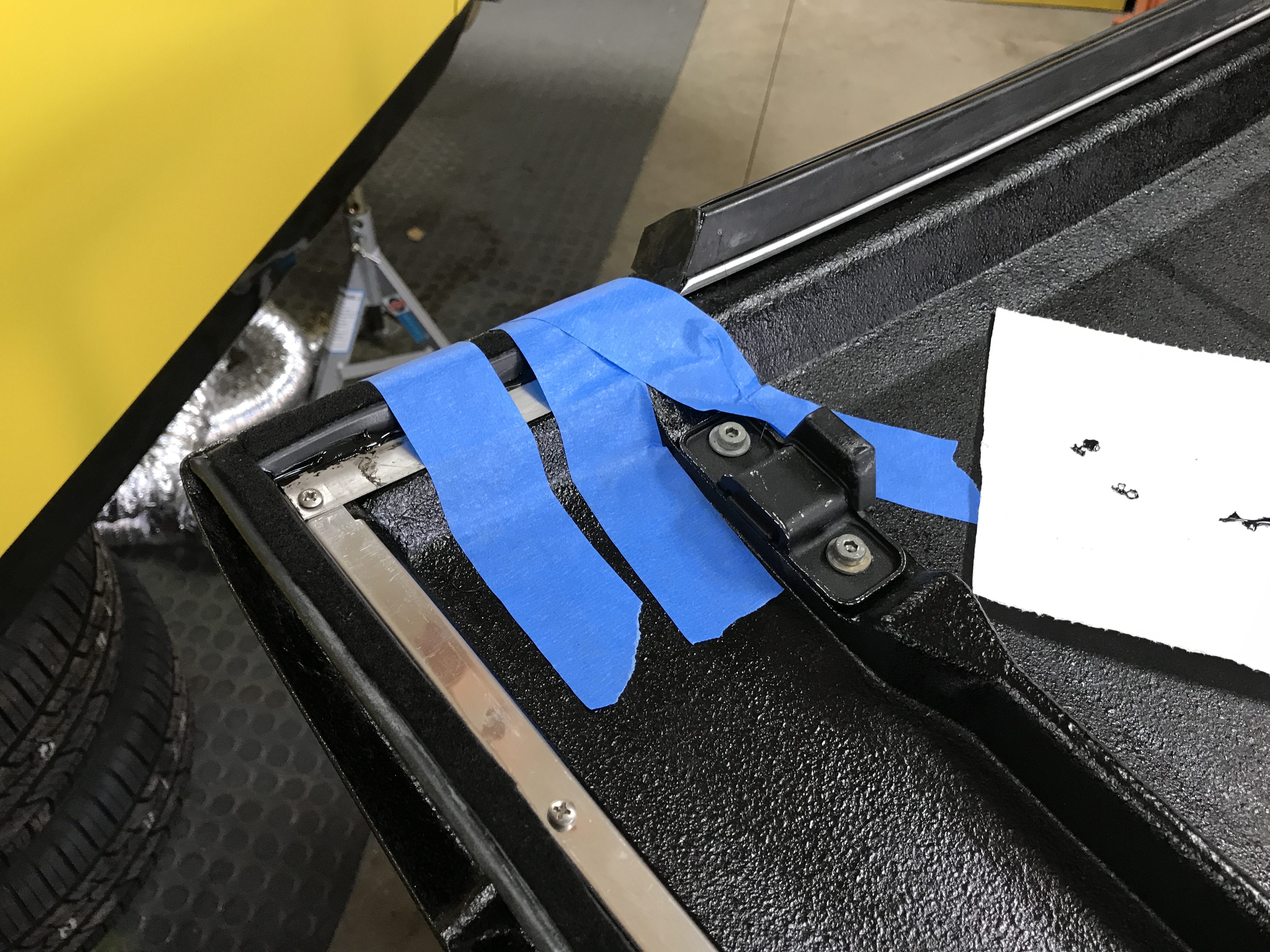

The side metal sections went into slits made in the rubber "cylinder", and then I screwed everything down with new SS hardware.
bkrantz
post Apr 29 2022, 07:27 PM
Post #5134
Posts: 8,345
Joined: 3-August 19
From: SW Colorado
Member No.: 23,343
Then to mimic the original molded-on rubber, I glued the slit rubber to the top (bottom) of the side metal pieces.
bkrantz
post Apr 29 2022, 07:28 PM
Post #5135
Posts: 8,345
Joined: 3-August 19
From: SW Colorado
Member No.: 23,343
Some ever popular blue tape to hold things in place.

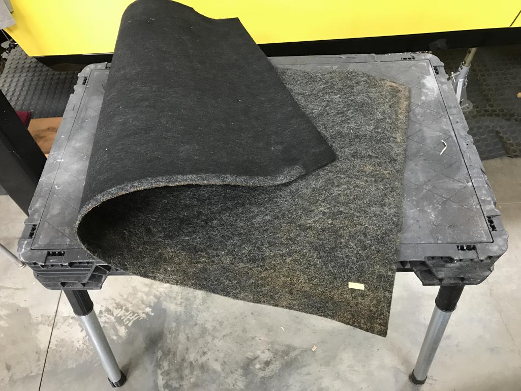

Next step: replacing the original headliner, which the PO painted, what for it, black.

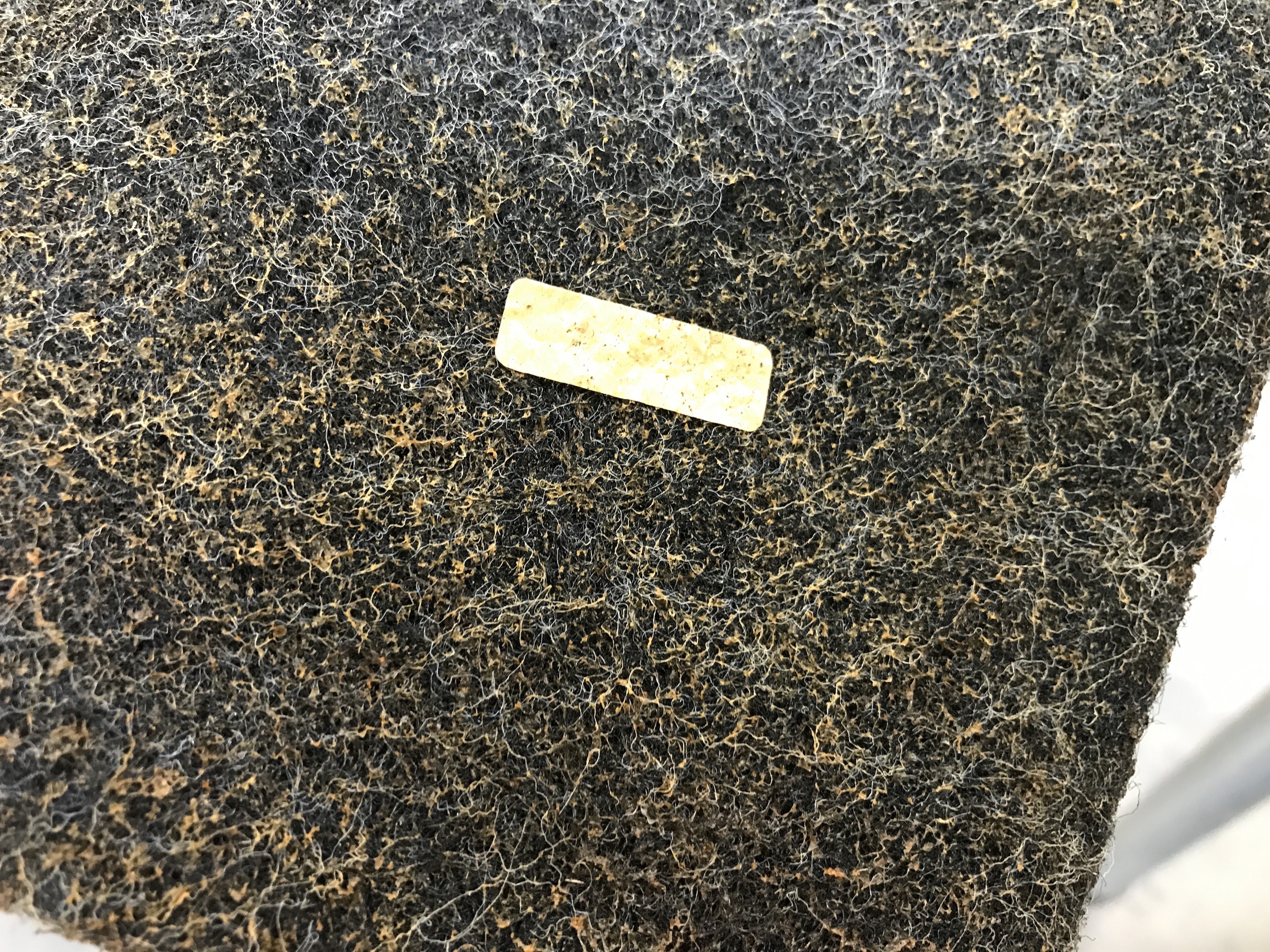

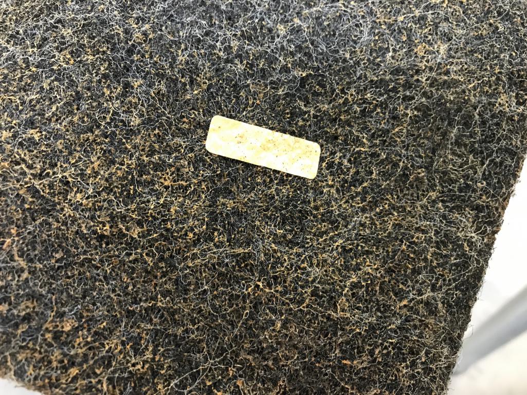

The small tag on the glue side makes me think this was a factory piece, and probably original to the top.

Member No.: 23,343

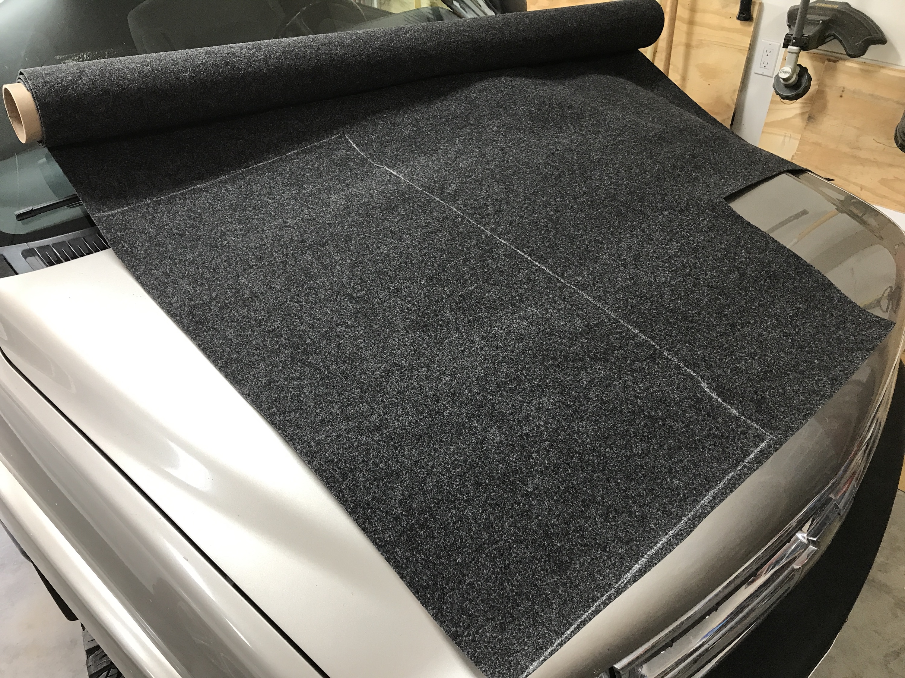

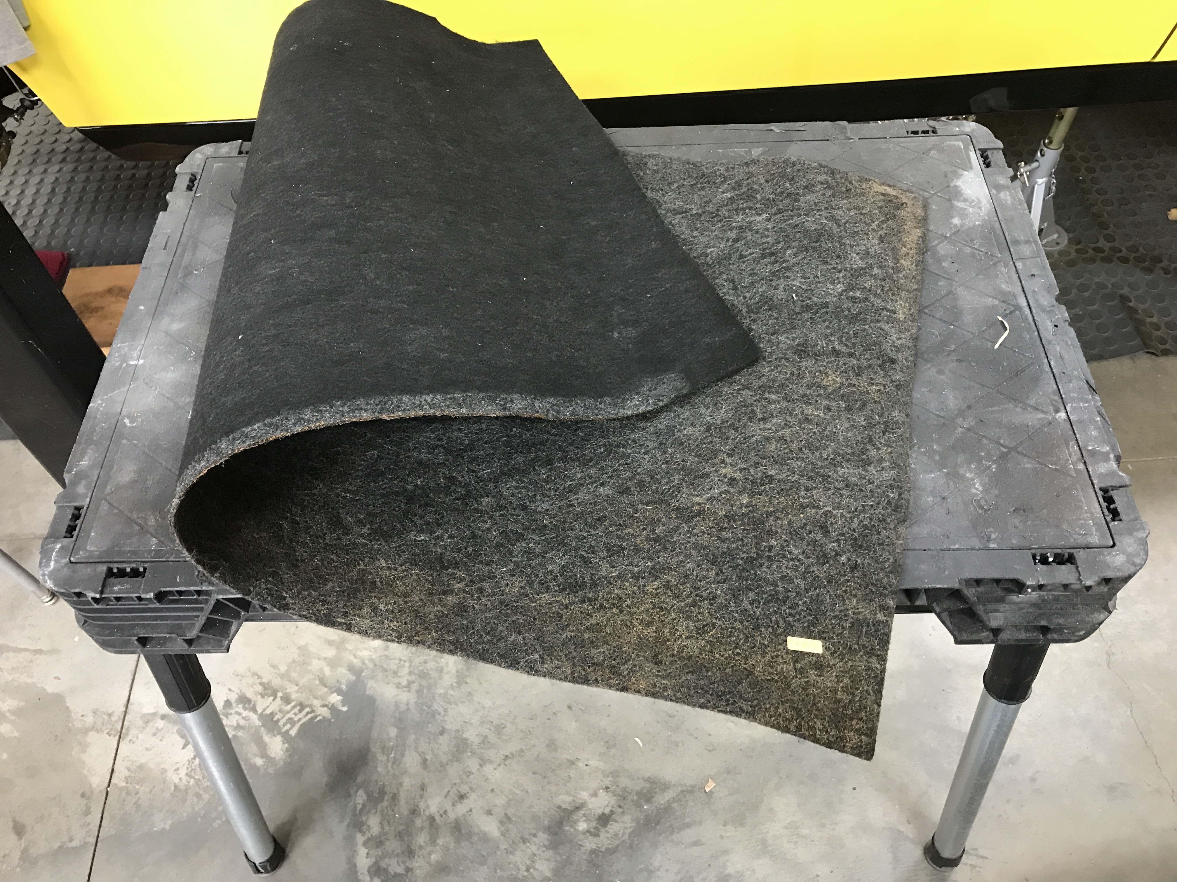

I traced the original onto replacement bulk perlon, dark charcoal.
