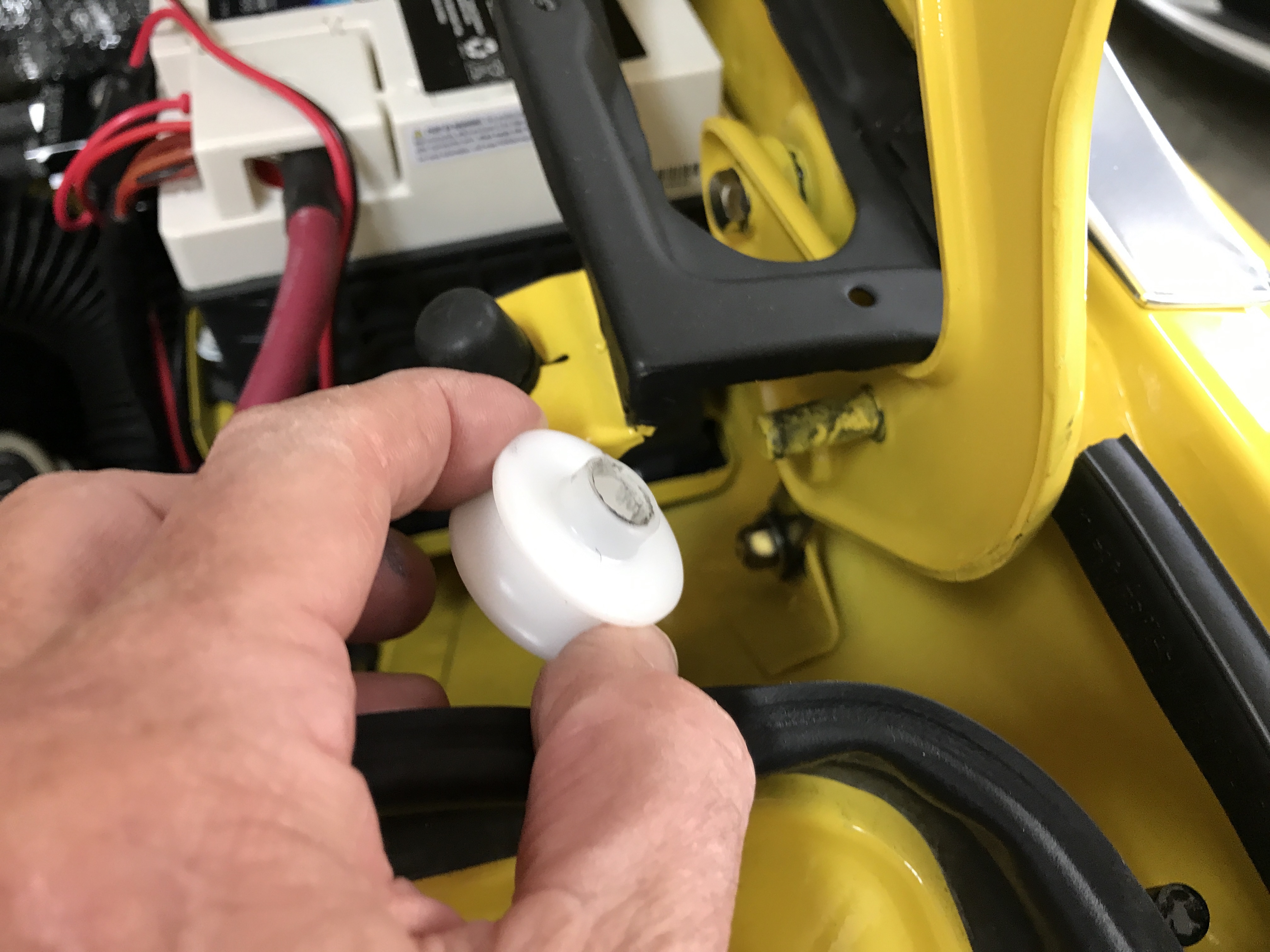

Step 2: take the pulley wheel off the hinge stud.

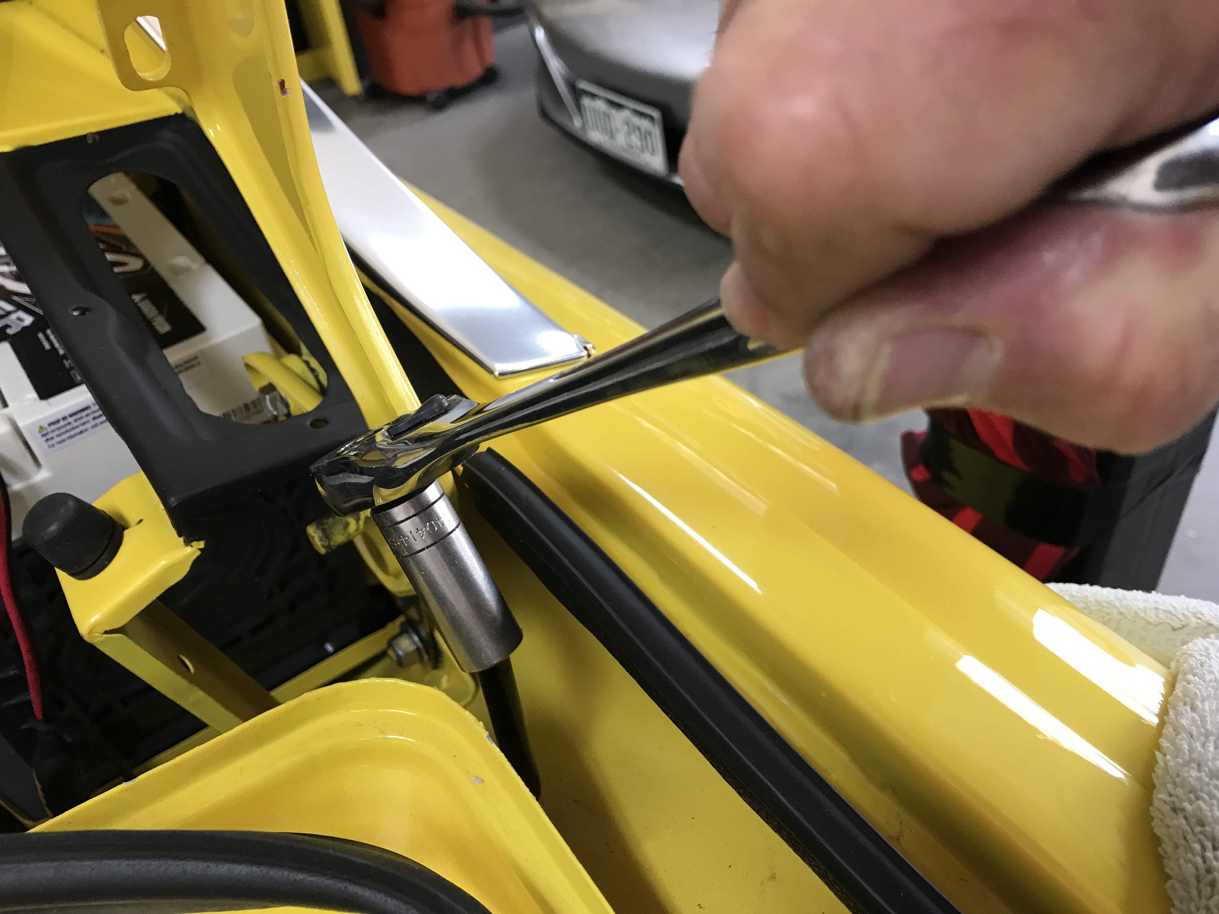

Step 5: use a 10 mm deep socket and ratchet to level the torsion bar end slightly forward...
