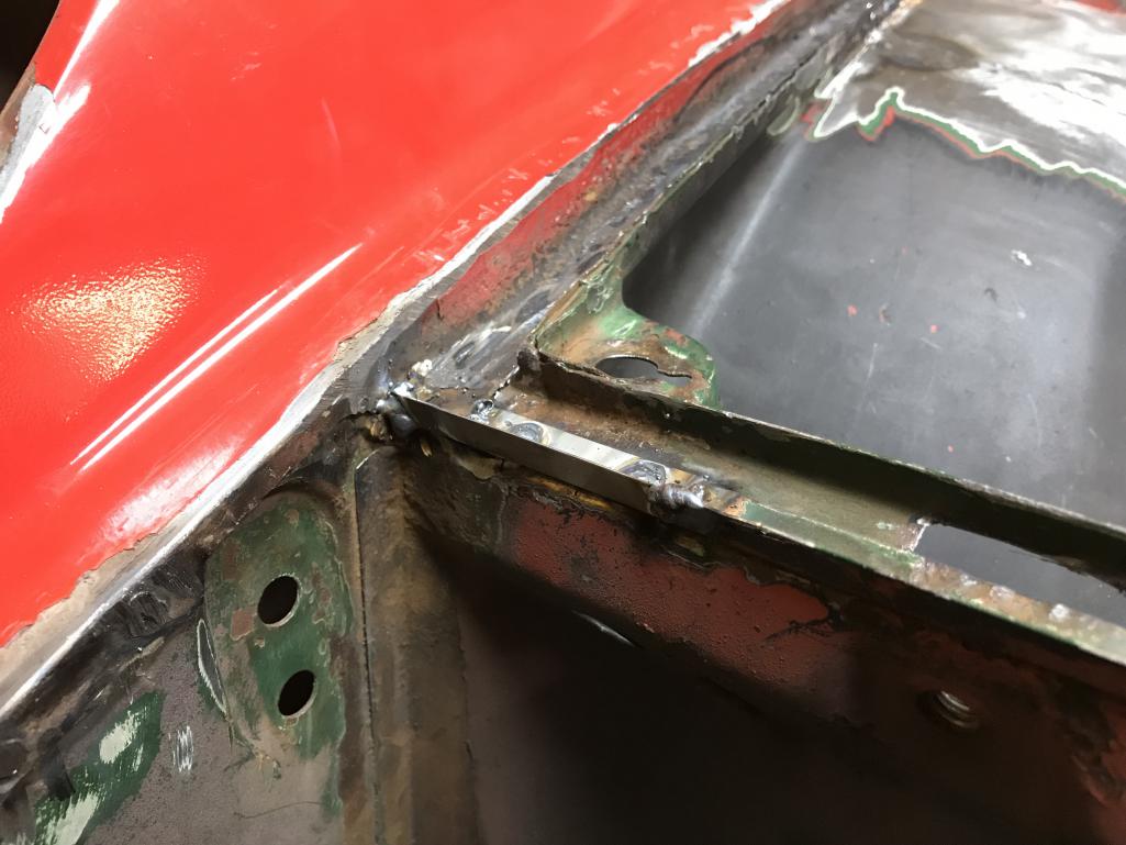

Back to work, just an hour yesterday and a couple today. For me, short stints seem to work better for small pieces.

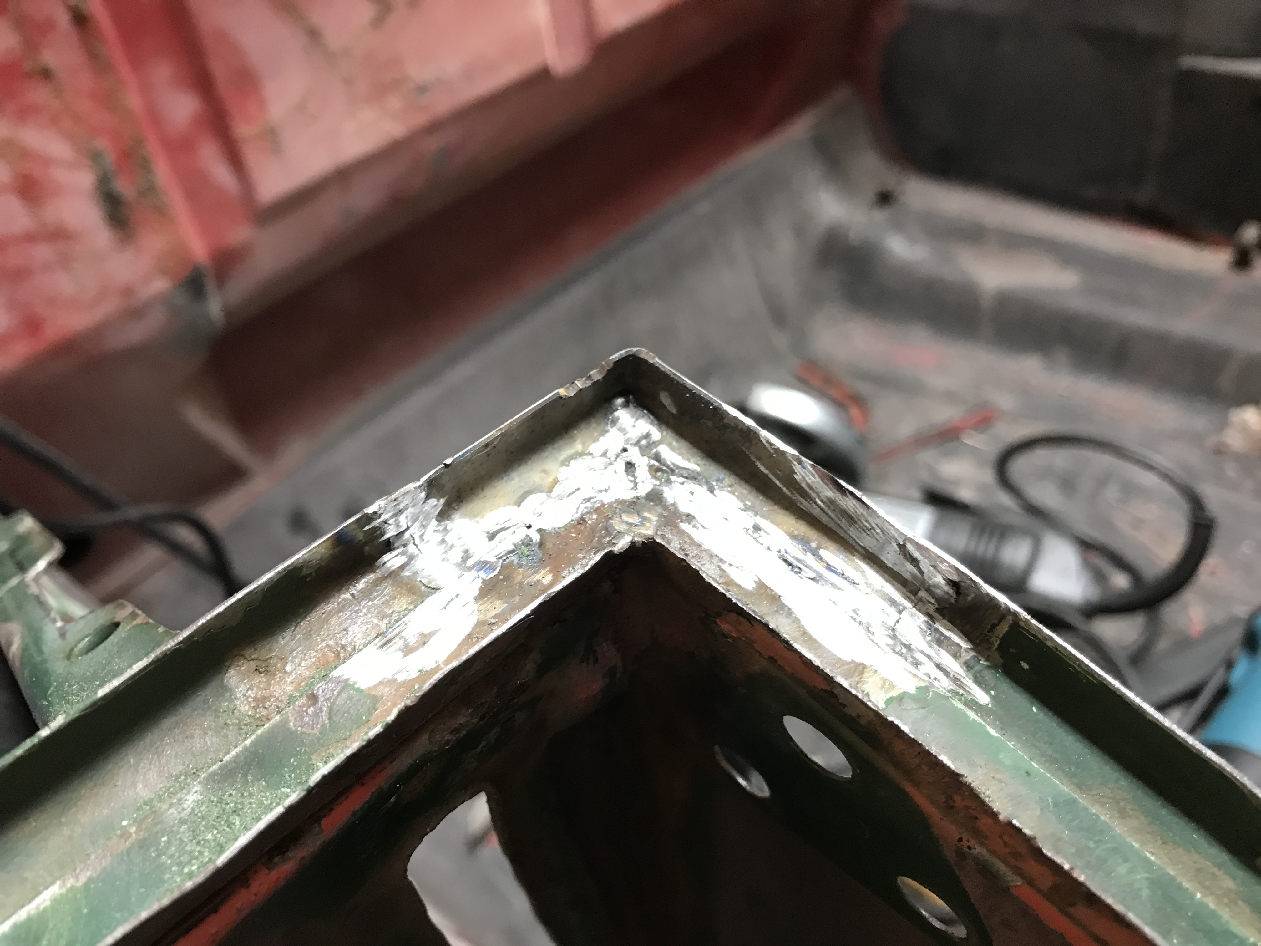

Grinding the first bits from Sunday. Left side:
bkrantz
post Apr 21 2020, 08:57 PM
Post #522
Posts: 8,342
Joined: 3-August 19
From: SW Colorado
Member No.: 23,343
Right side:

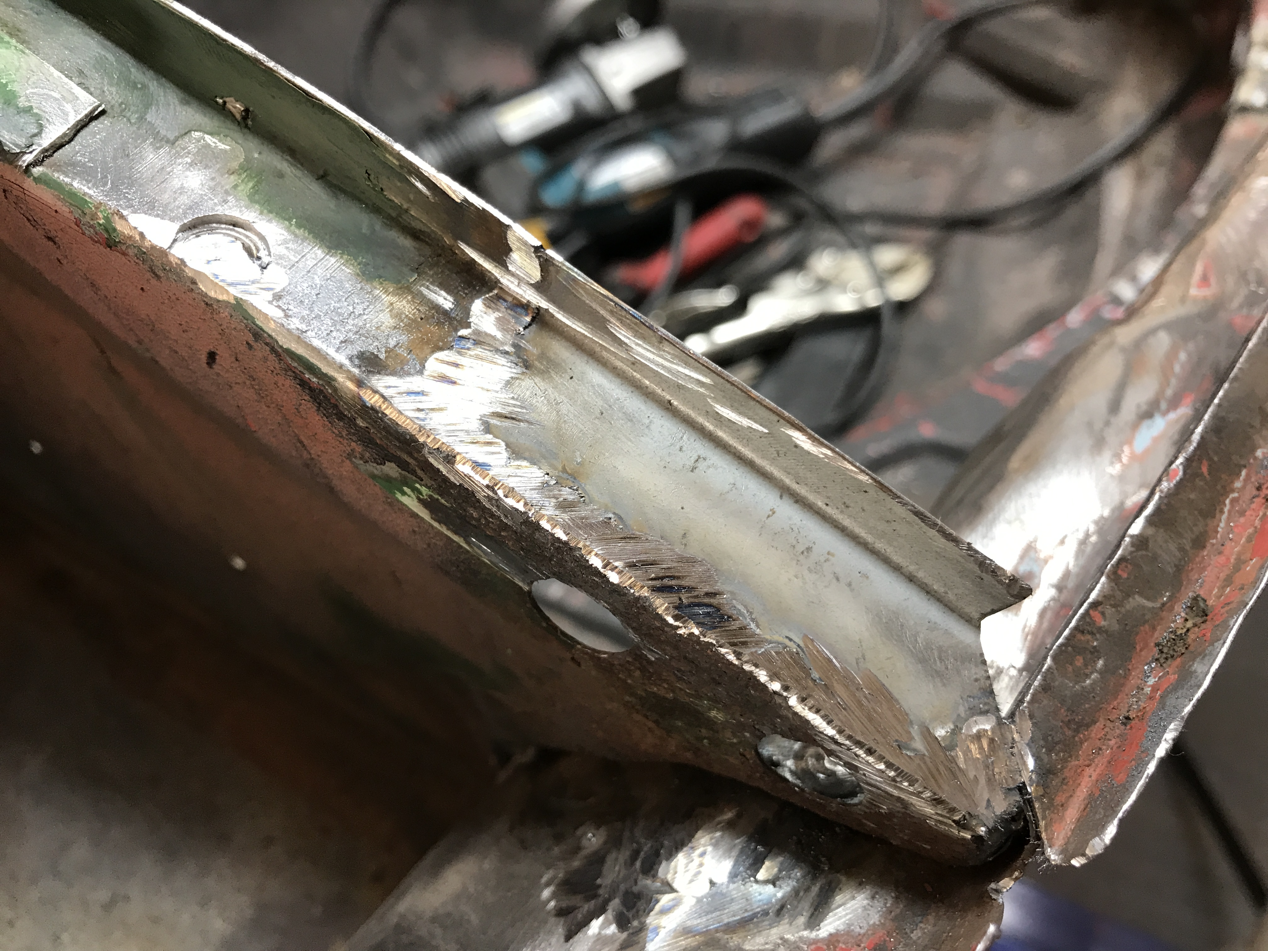

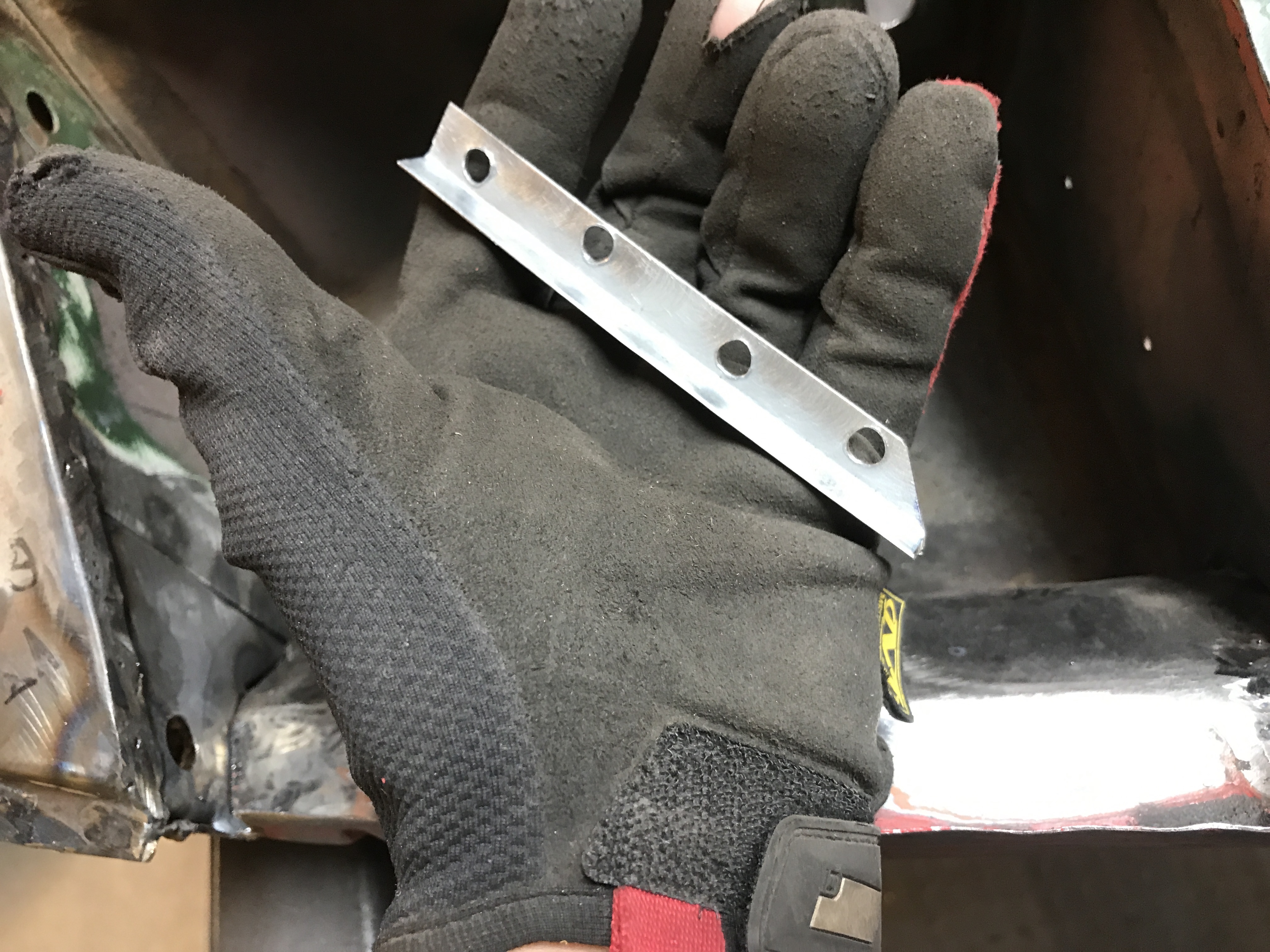

Next piece for the left side.
bkrantz
post Apr 21 2020, 08:59 PM
Post #524
Posts: 8,342
Joined: 3-August 19
From: SW Colorado
Member No.: 23,343
Welded in place.

Same piece for the right side.
bkrantz
post Apr 21 2020, 09:00 PM
Post #526
Posts: 8,342
Joined: 3-August 19
From: SW Colorado
Member No.: 23,343
Welded in place.

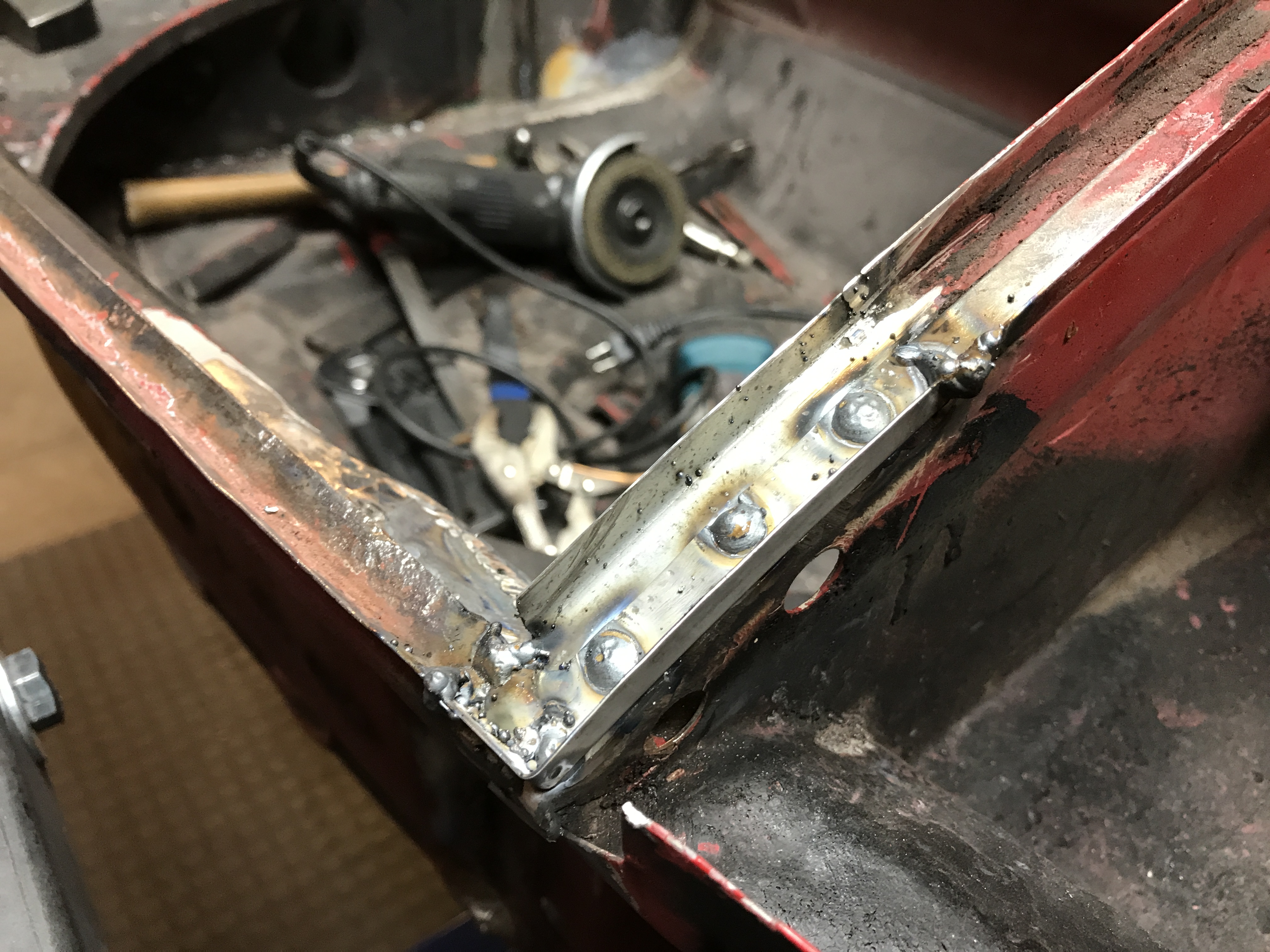

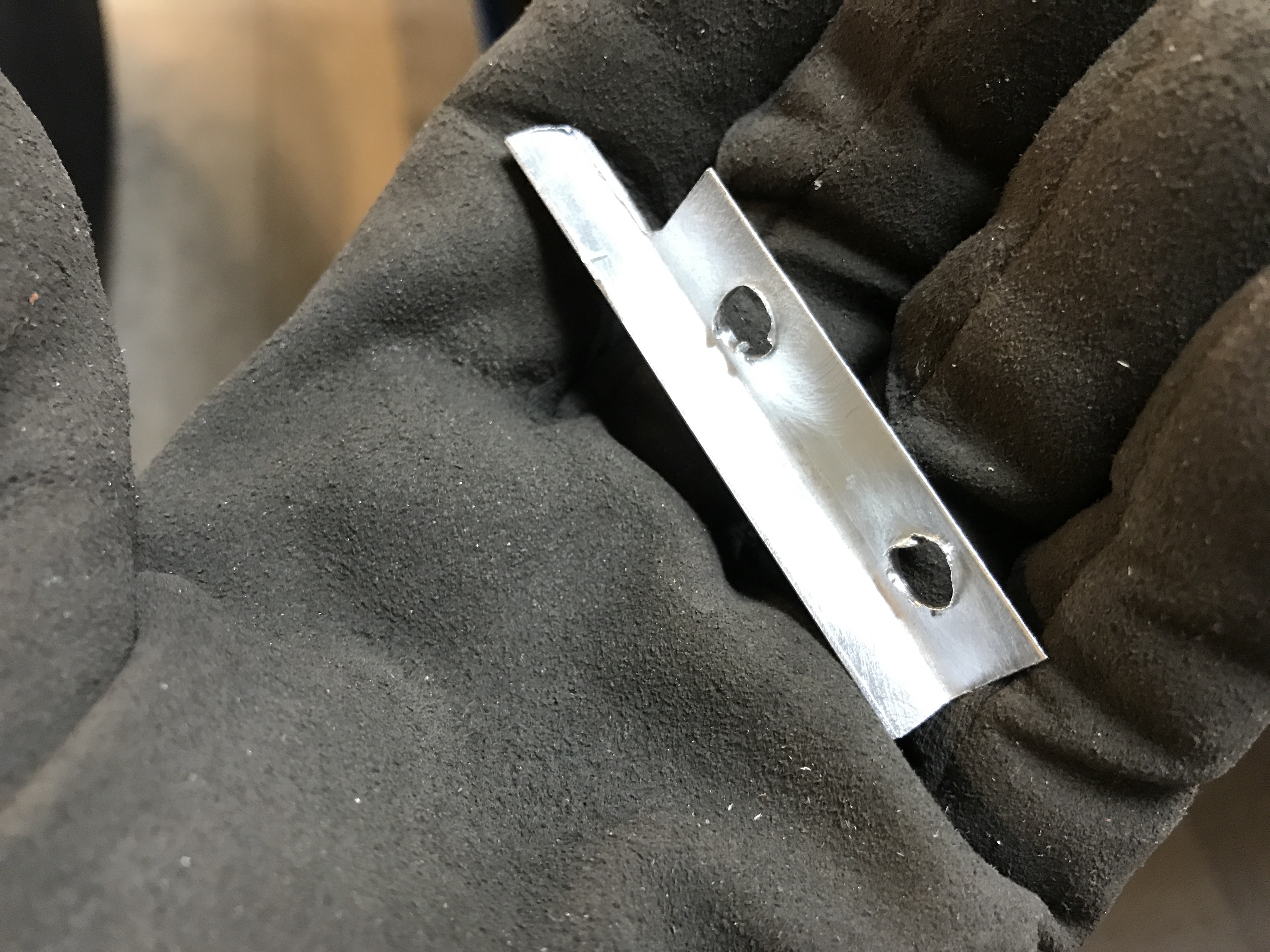

Inner corner piece for the right side.
bkrantz
post Apr 21 2020, 09:03 PM
Post #528
Posts: 8,342
Joined: 3-August 19
From: SW Colorado
Member No.: 23,343
Welded.

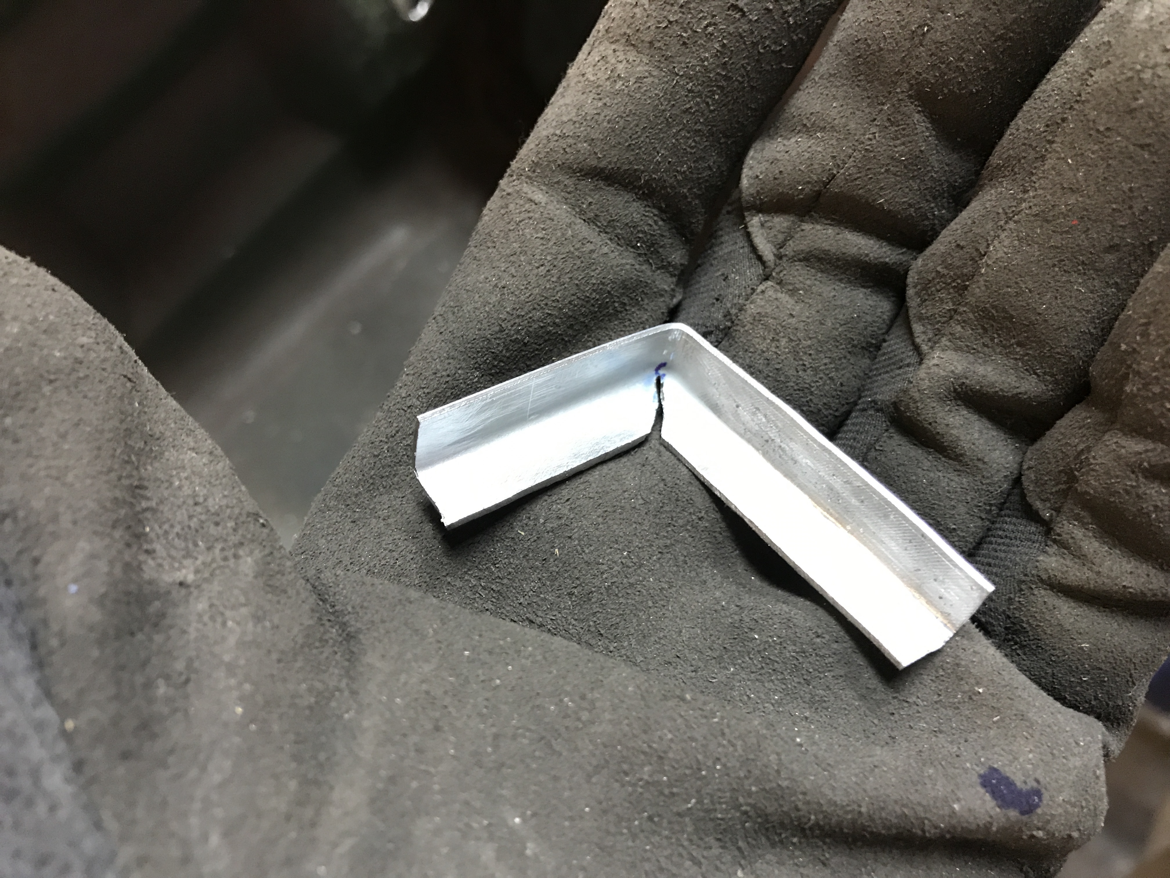

Last piece for the right side?
bkrantz
post Apr 21 2020, 09:05 PM
Post #530
Posts: 8,342
Joined: 3-August 19
From: SW Colorado
Member No.: 23,343
Welded.

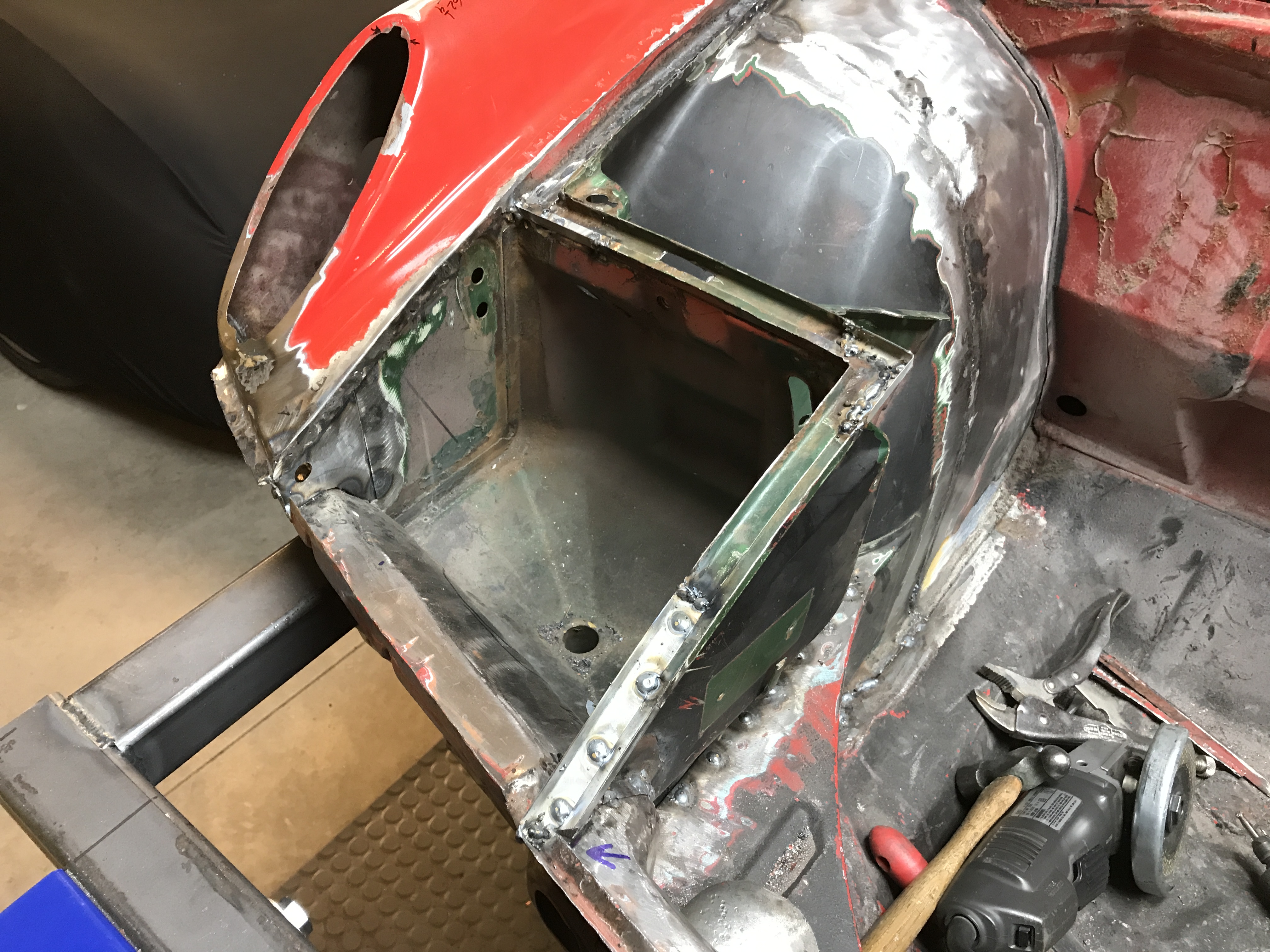

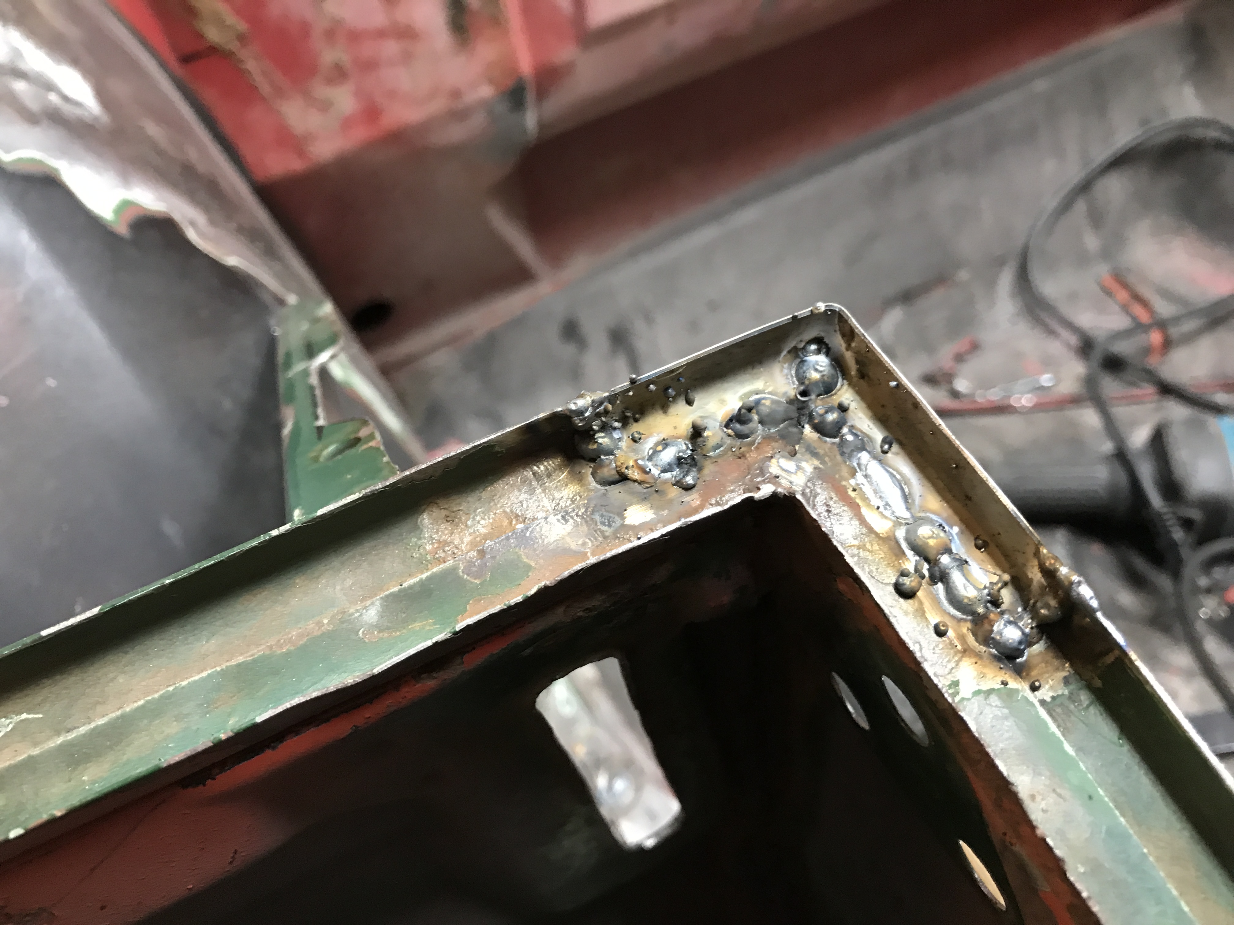

Here's the right side, almost done.

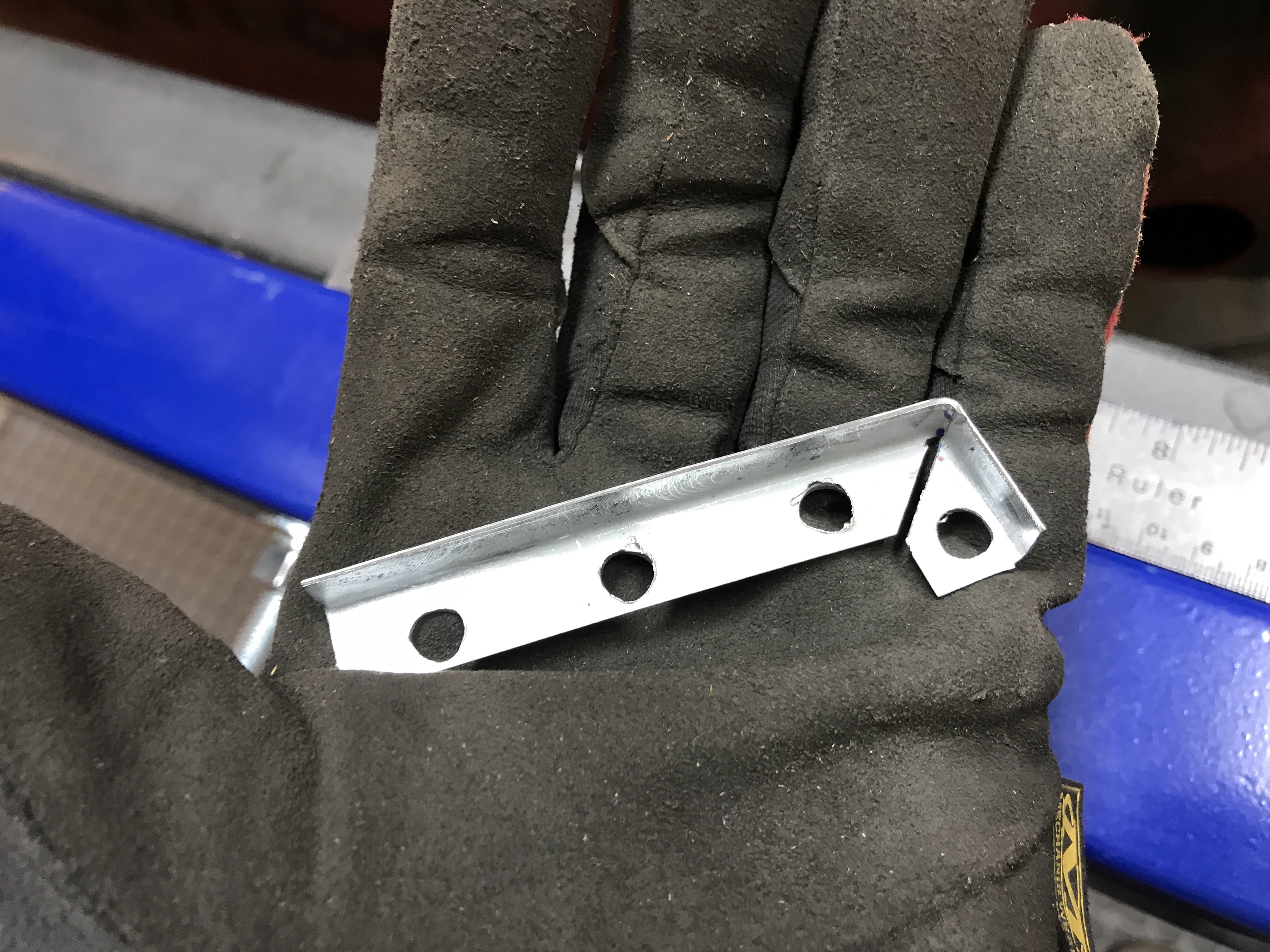

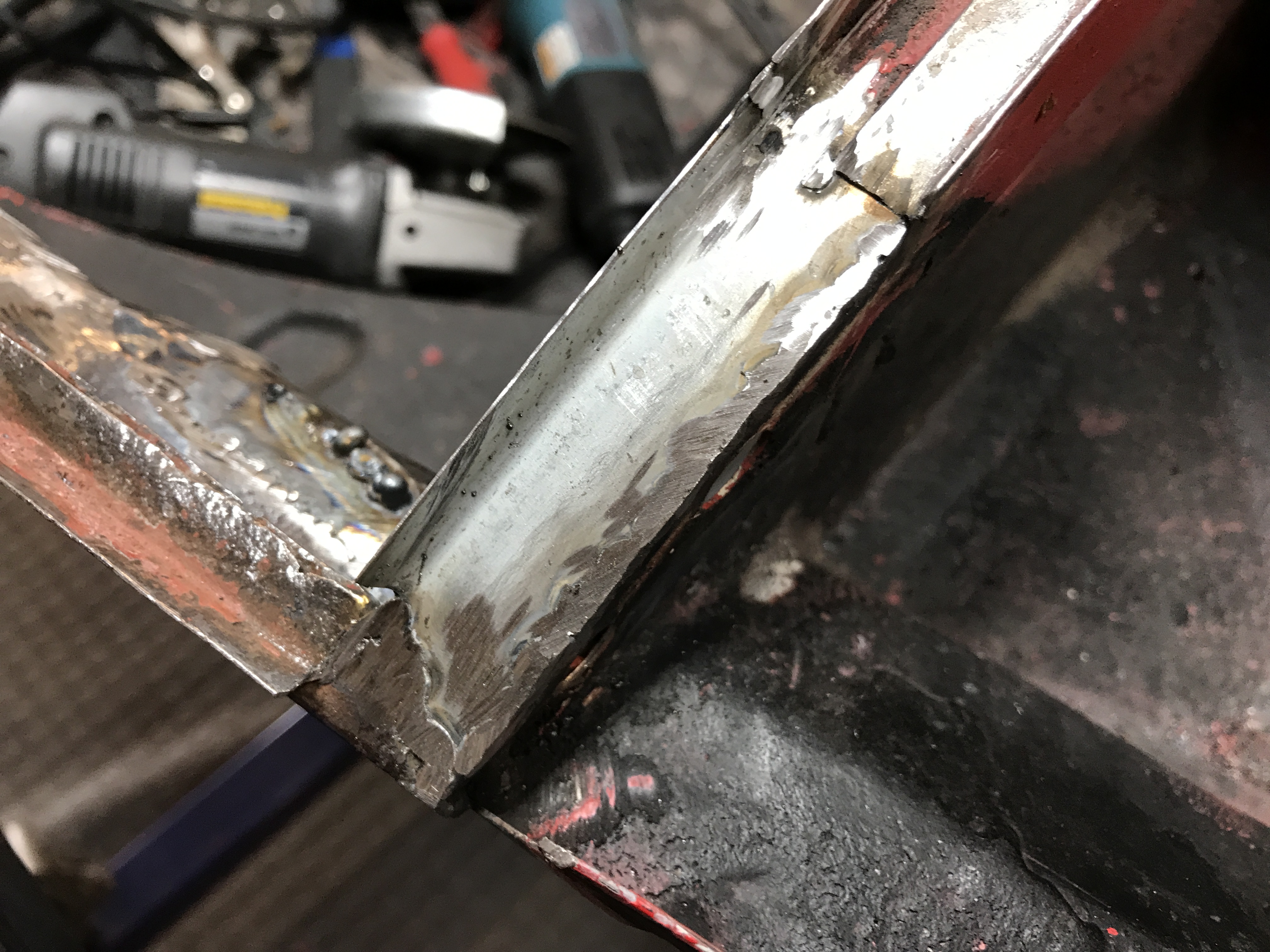

First, I caught up with grinding the pieces from yesterday.
bkrantz
post Apr 22 2020, 07:40 PM
Post #533
Posts: 8,342
Joined: 3-August 19
From: SW Colorado
Member No.: 23,343
More grinding.
bkrantz
post Apr 22 2020, 07:41 PM
Post #534
Posts: 8,342
Joined: 3-August 19
From: SW Colorado
Member No.: 23,343
And more grinding.

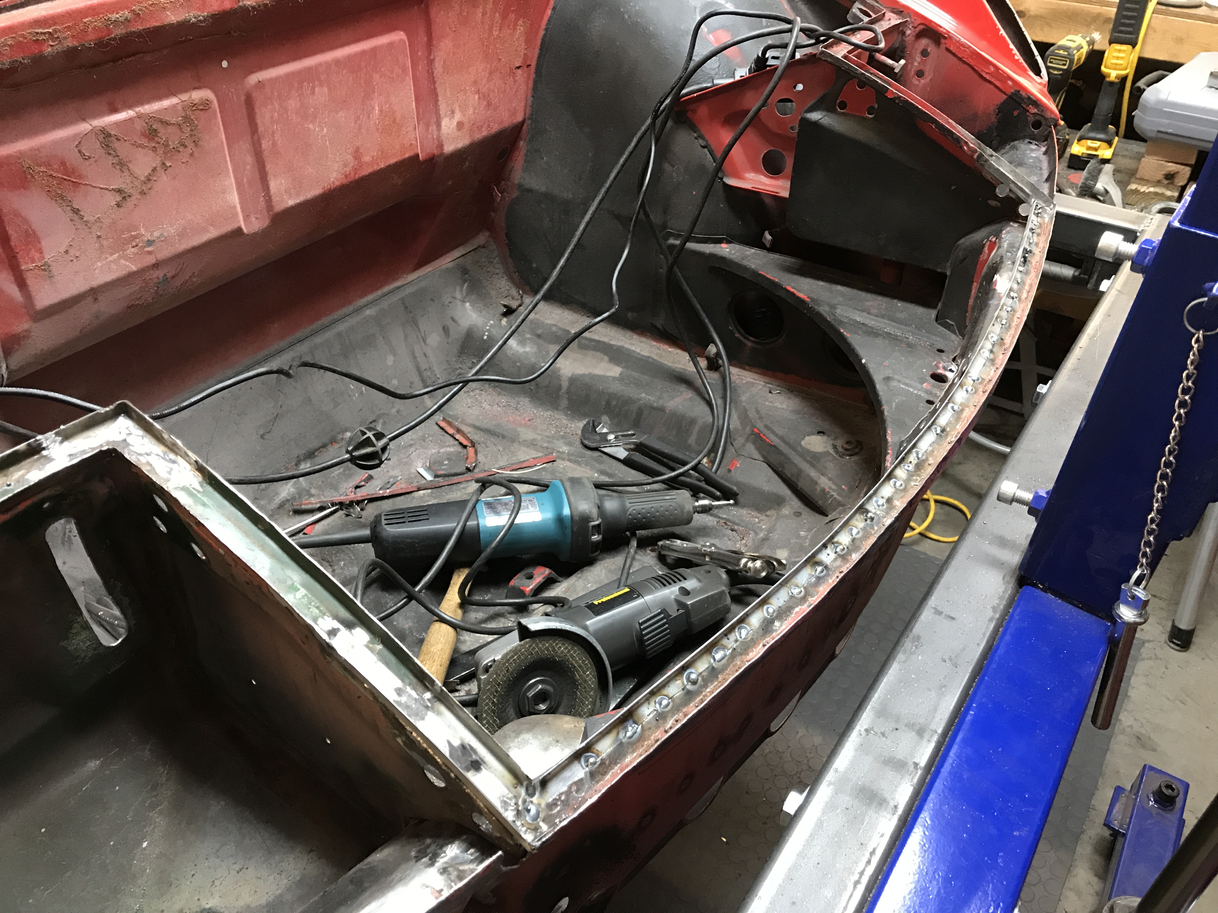

bkrantz
post Apr 22 2020, 07:44 PM
Post #535
Posts: 8,342
Joined: 3-August 19
From: SW Colorado
Member No.: 23,343

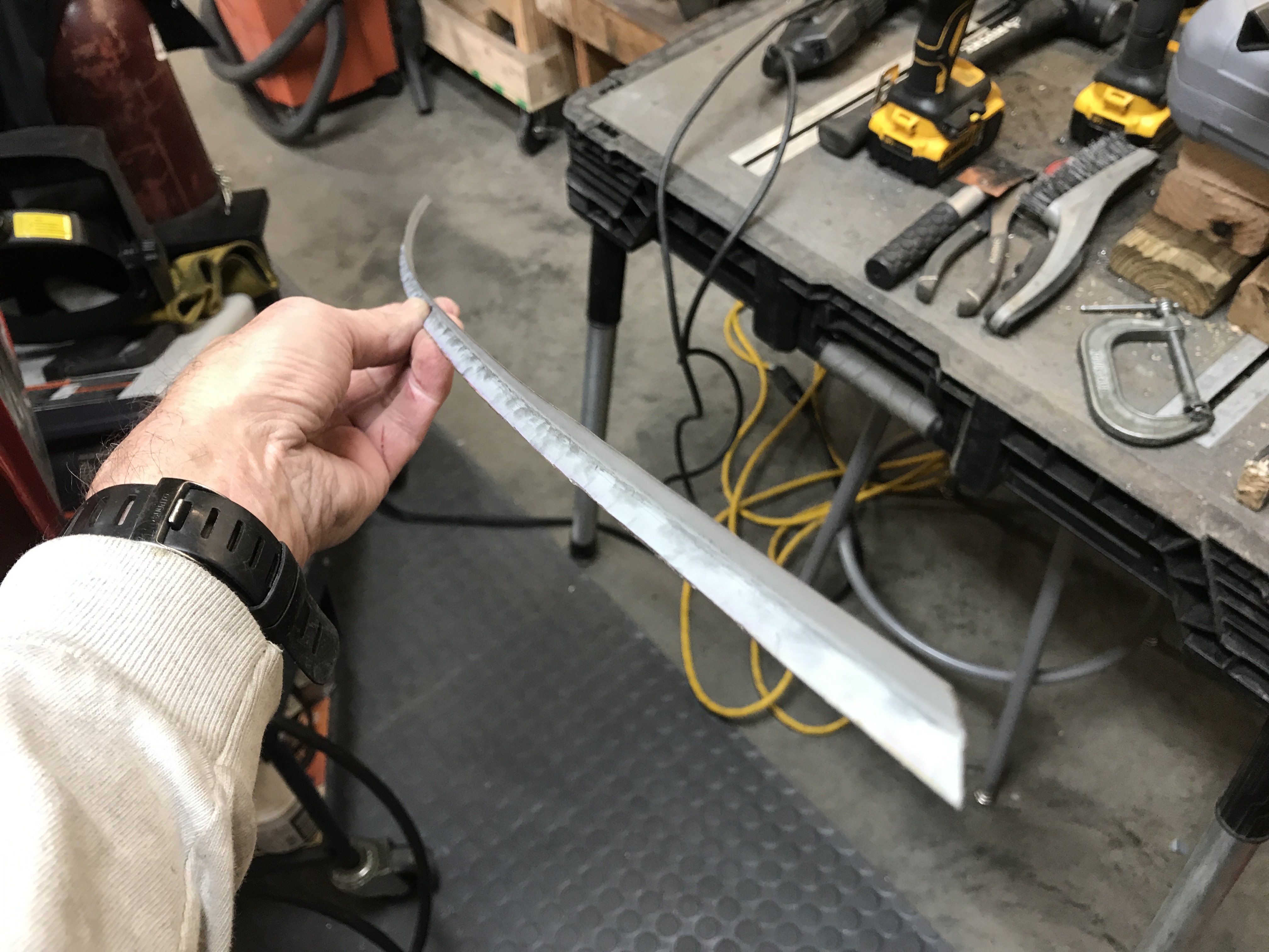

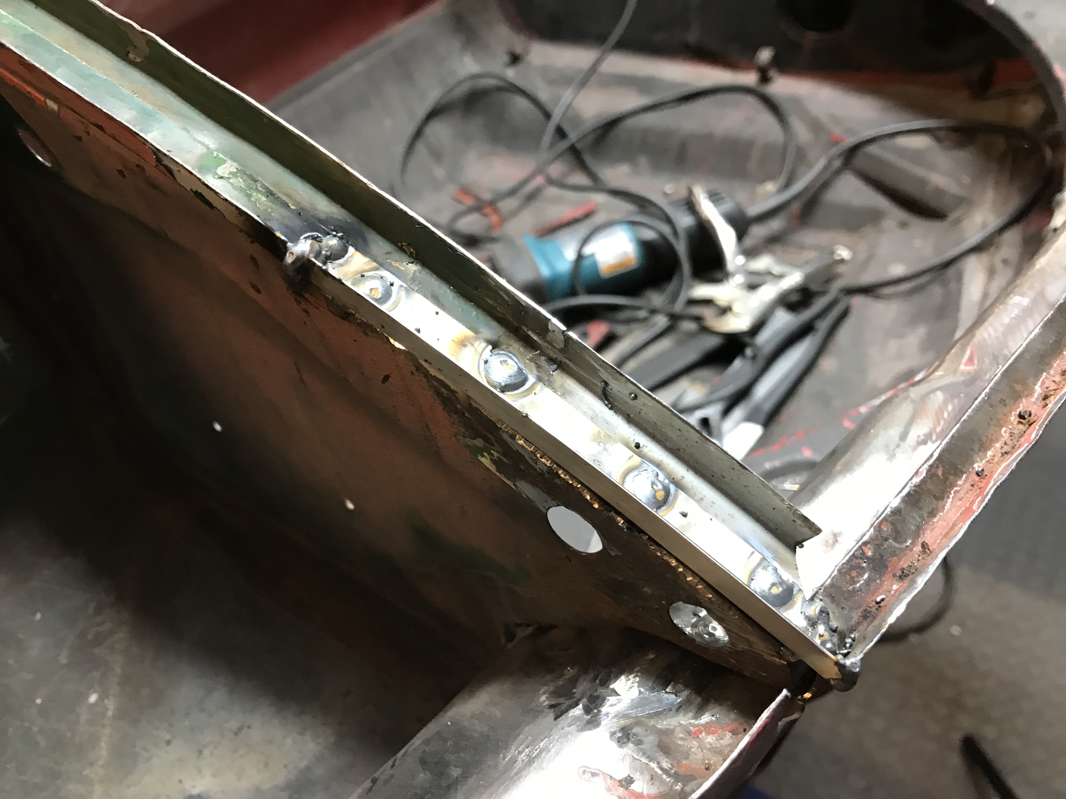

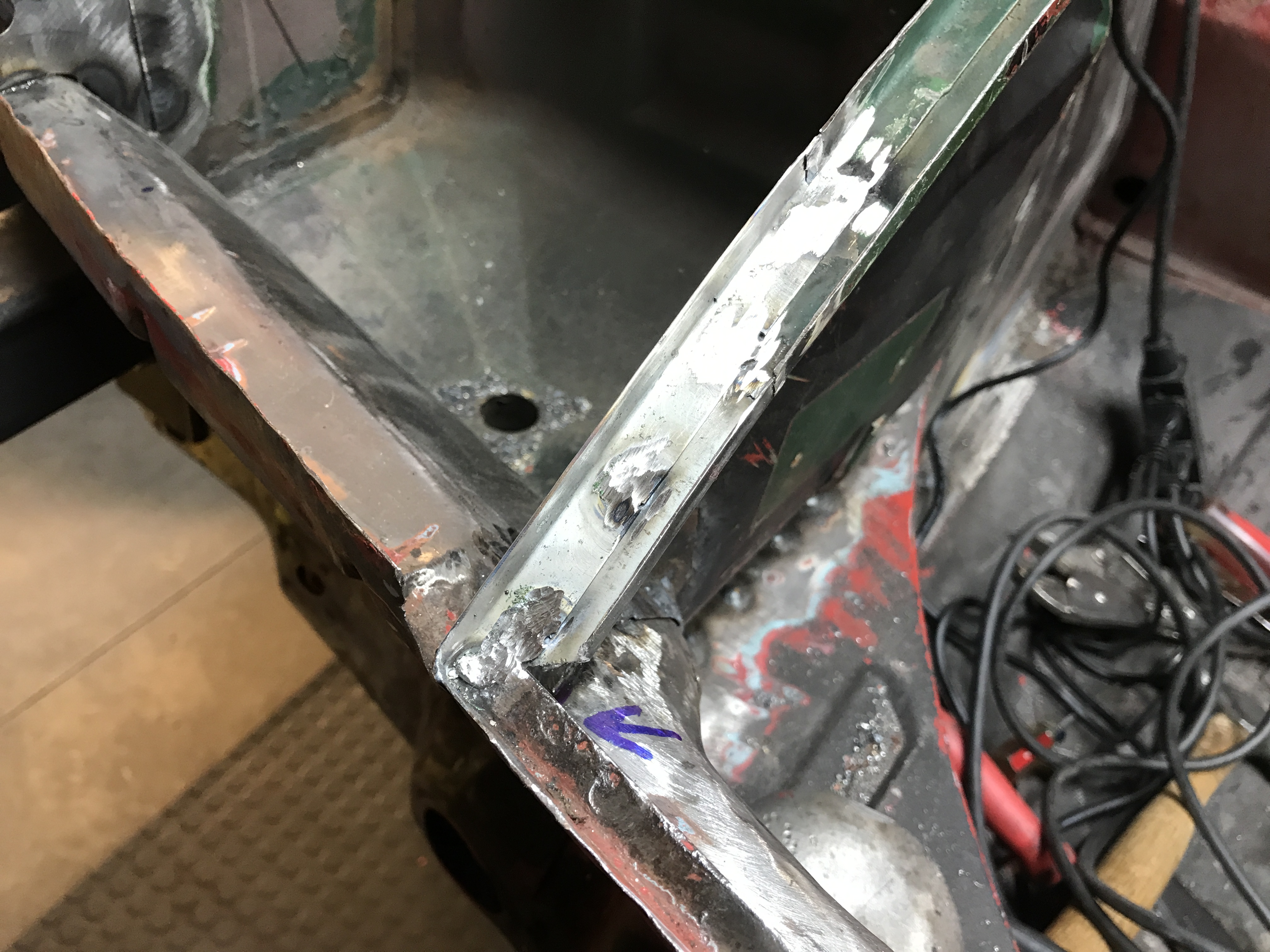

The last bit is the inner edge of the channel all along the front. I had to cut down the stock width of the L, and give it the same curvature as the front of the car.
bkrantz
post Apr 22 2020, 07:45 PM
Post #536
Posts: 8,342
Joined: 3-August 19
From: SW Colorado
Member No.: 23,343
Got it tacked in place before quitting time.

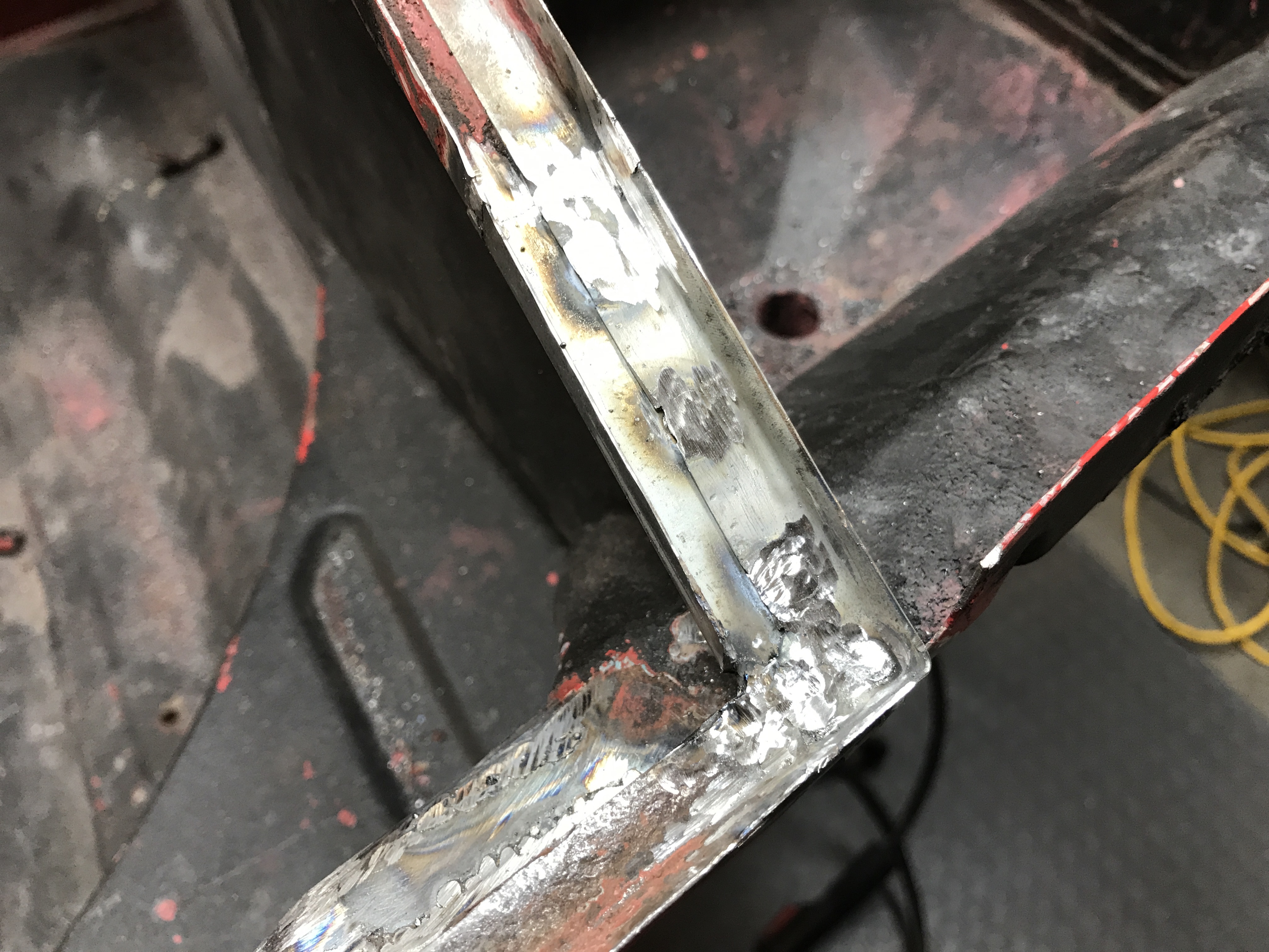

bkrantz
post Apr 23 2020, 08:11 PM
Post #537
Posts: 8,342
Joined: 3-August 19
From: SW Colorado
Member No.: 23,343

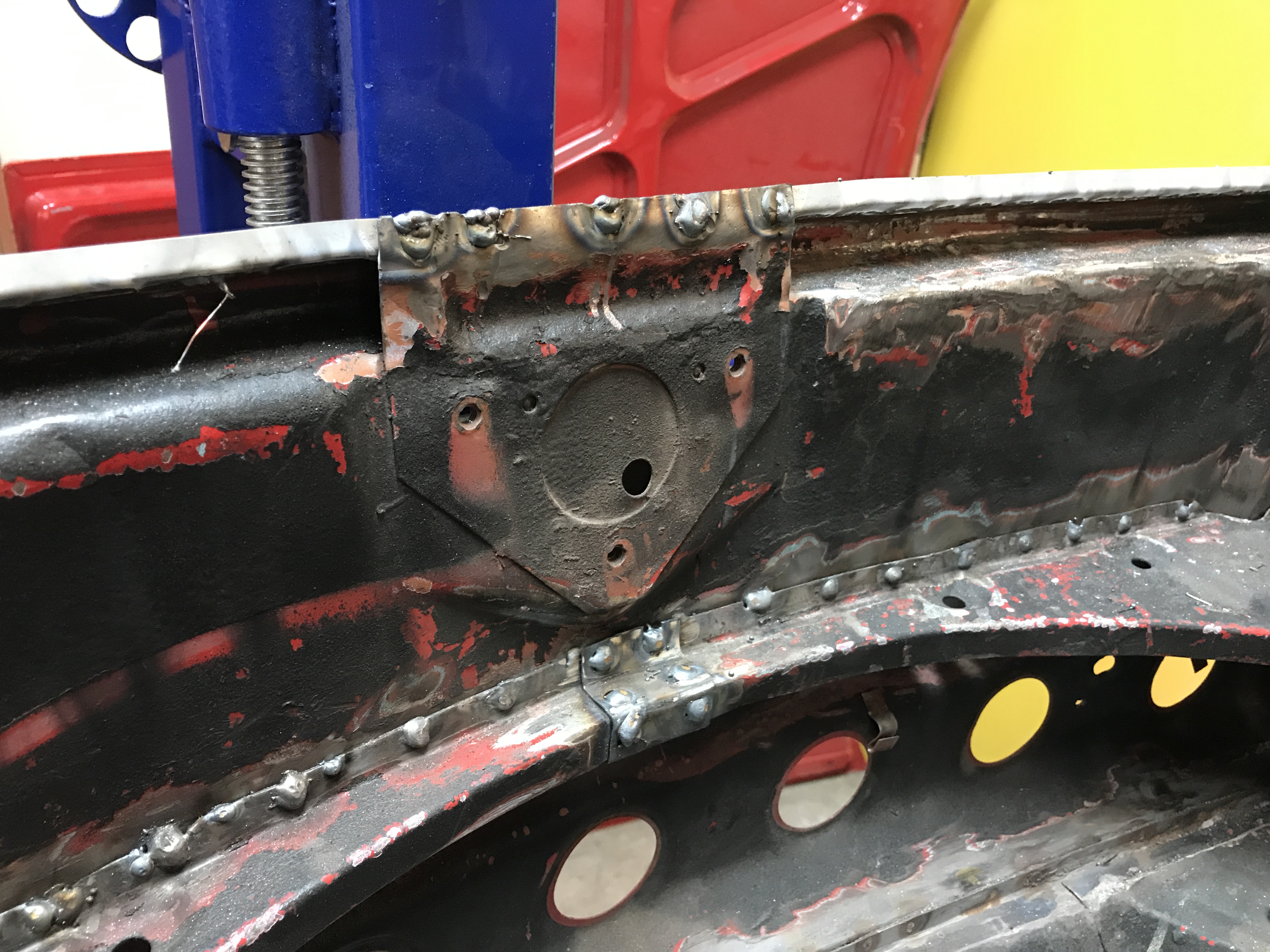

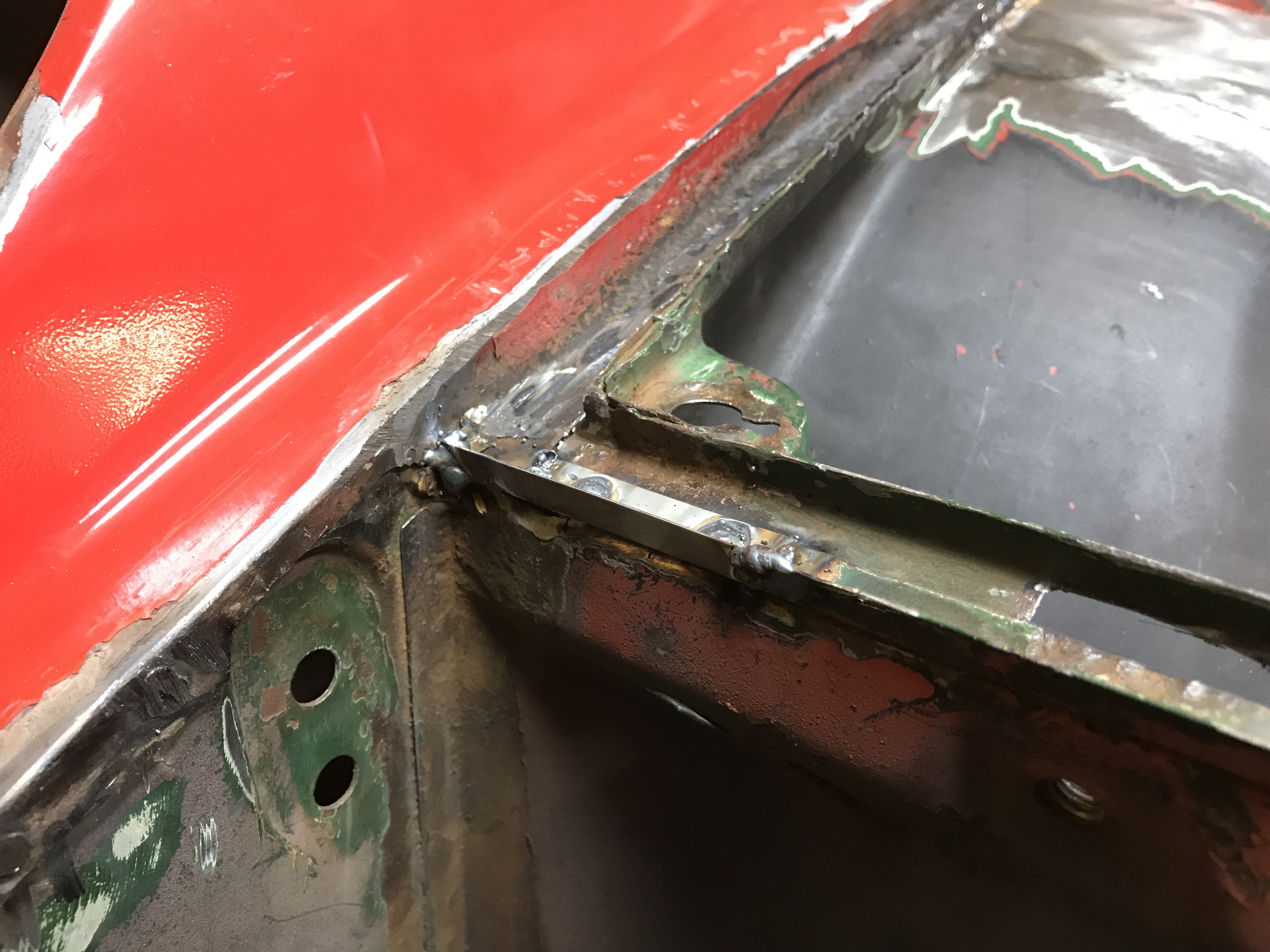

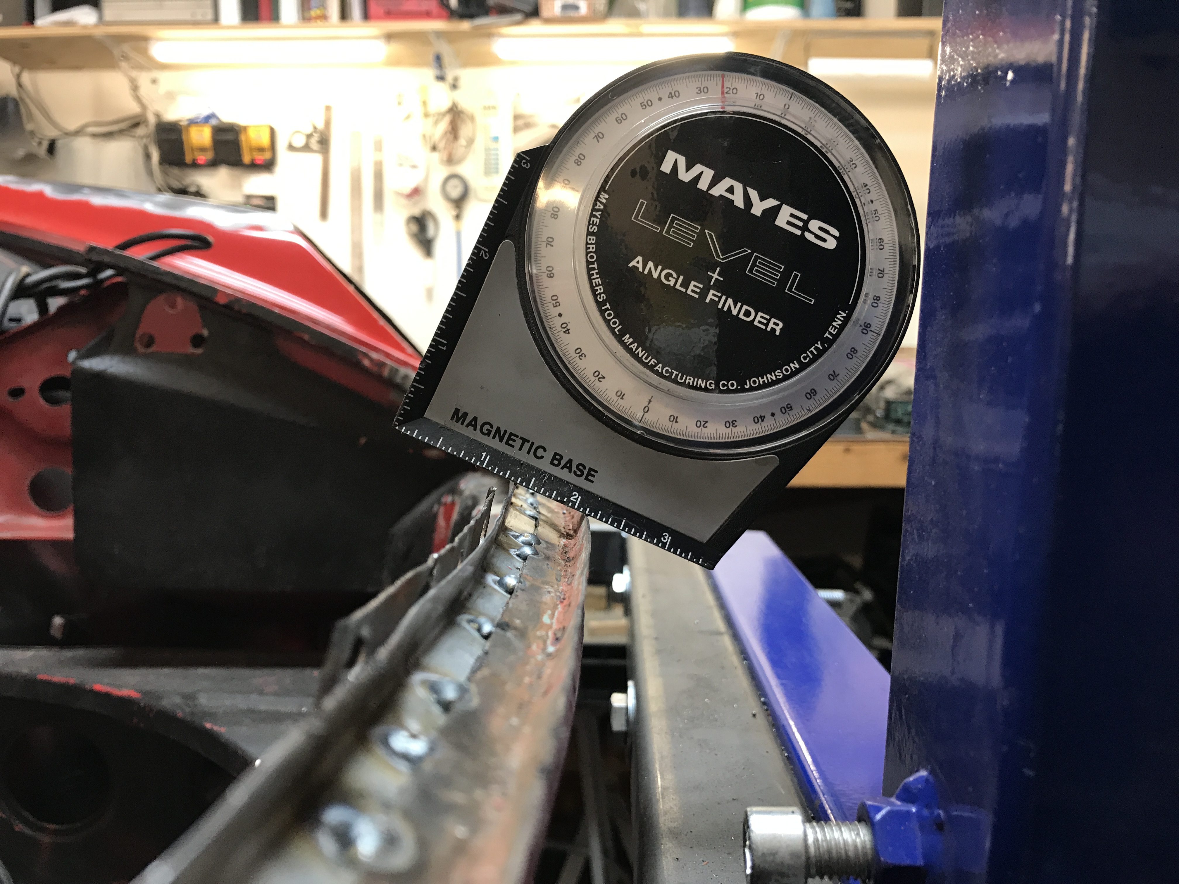

I finished up the frunk channel today. Before final welding along the front, including the latch mounting plate, I made sure I had the same angle across the channel from left to right.
bkrantz
post Apr 23 2020, 08:13 PM
Post #538
Posts: 8,342
Joined: 3-August 19
From: SW Colorado
Member No.: 23,343
Here's the latch welded on. Don't worry, I ground this into something pretty.

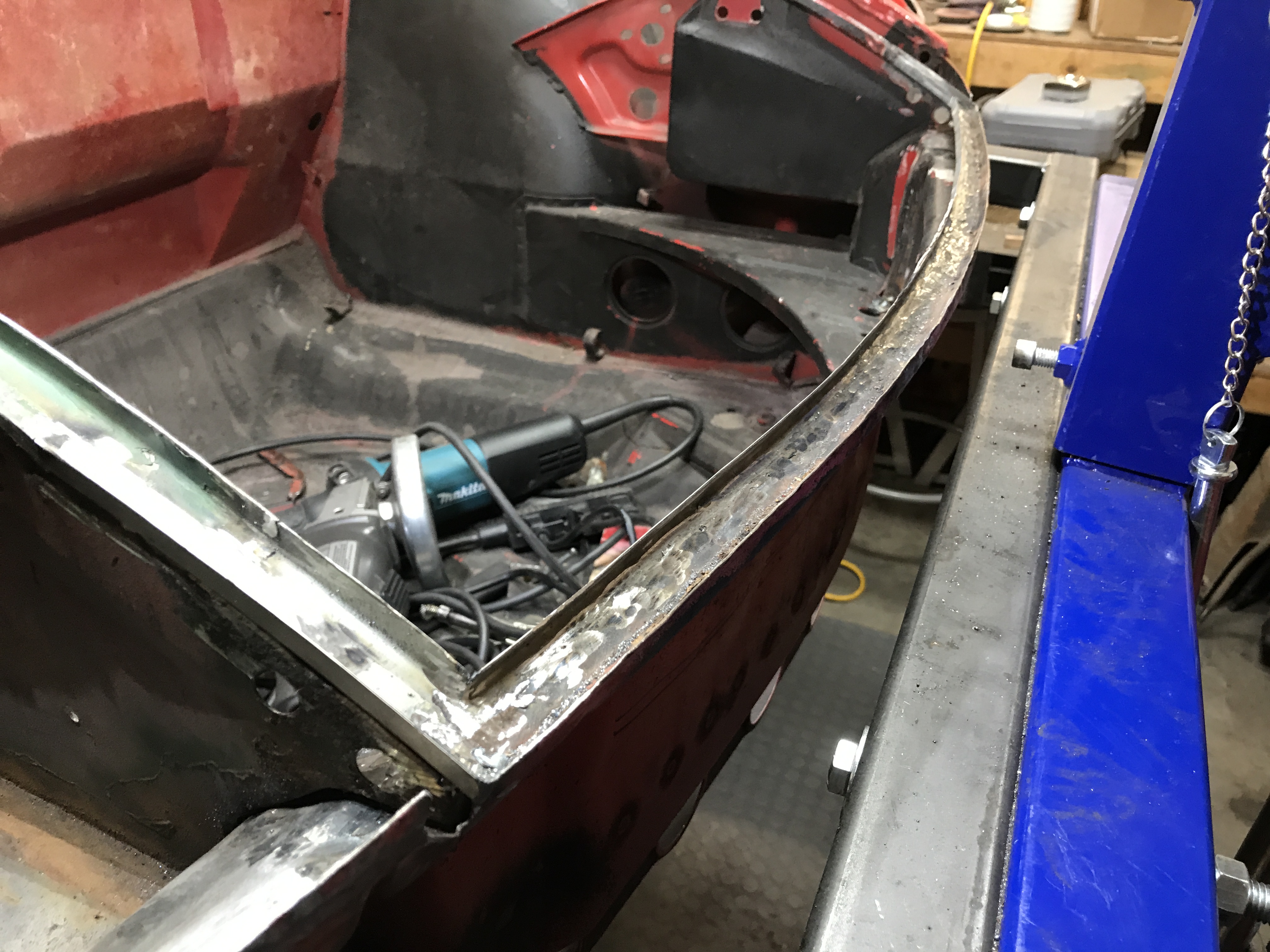

bkrantz
post Apr 23 2020, 08:16 PM
Post #539
Posts: 8,342
Joined: 3-August 19
From: SW Colorado
Member No.: 23,343
After welding the front channel "seam" and grinding that.
bkrantz
post Apr 23 2020, 08:17 PM
Post #540
Posts: 8,342
Joined: 3-August 19
From: SW Colorado
Member No.: 23,343
Frunk channel all done, and another item crossed off the list.
