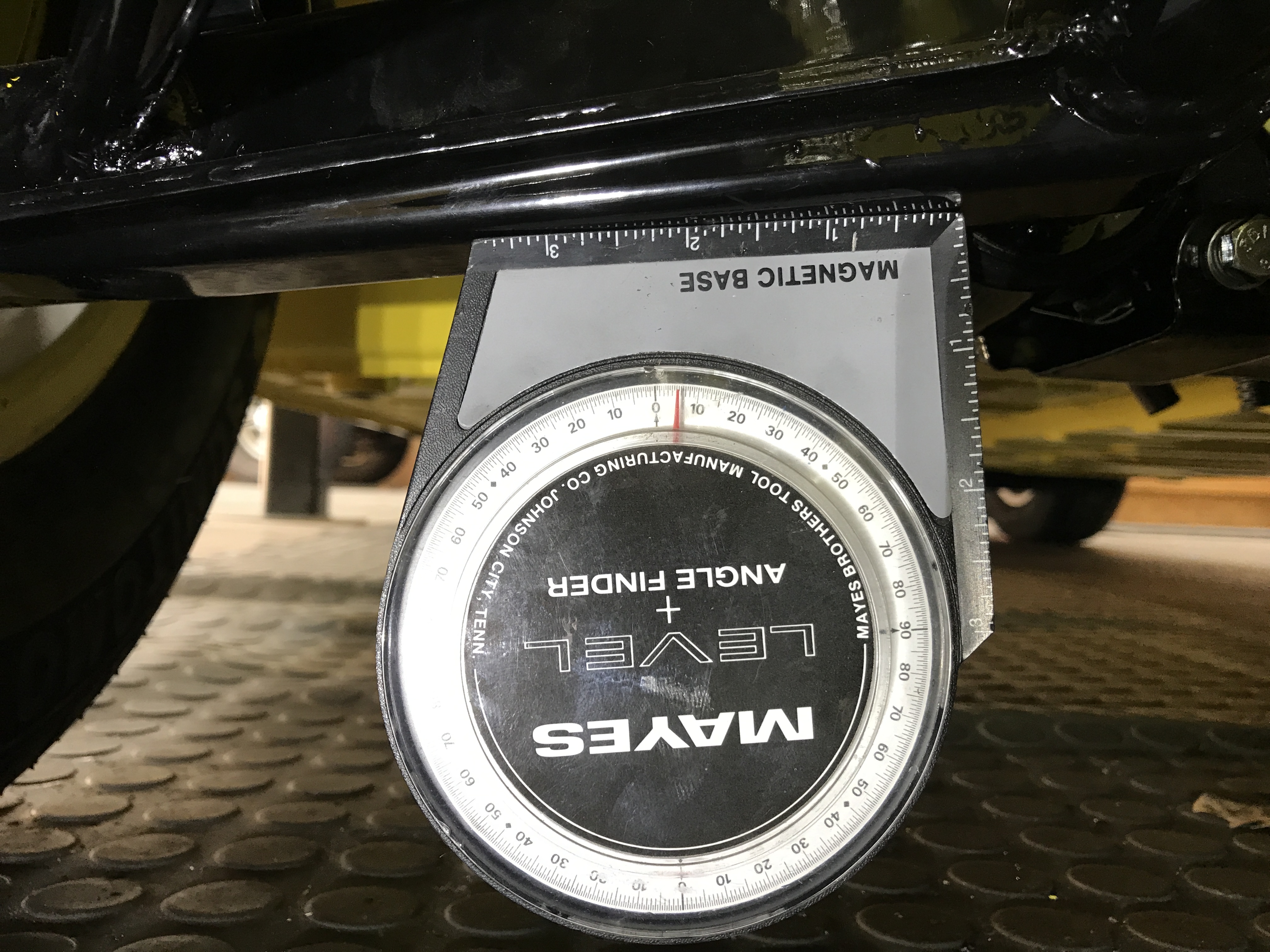

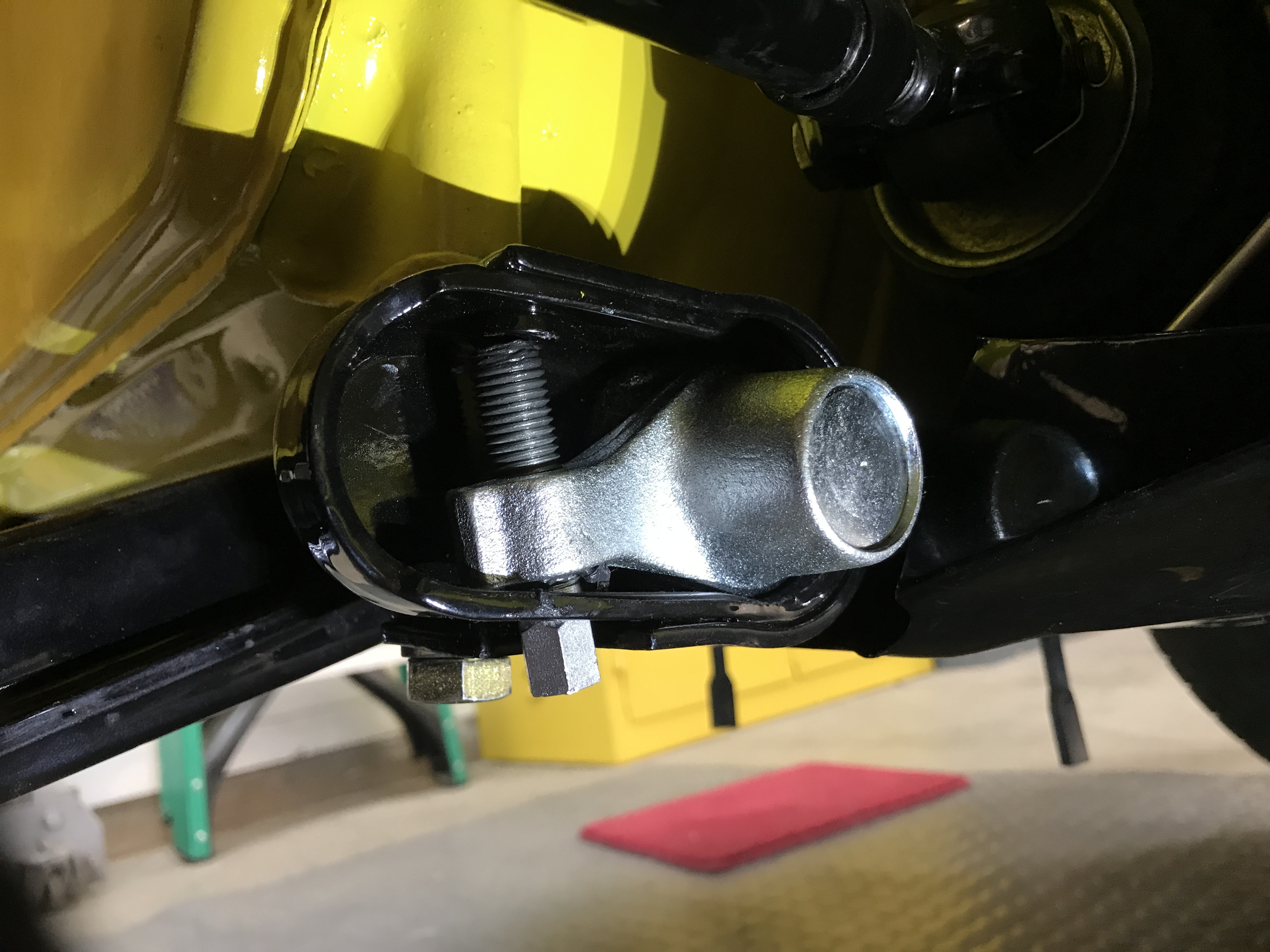

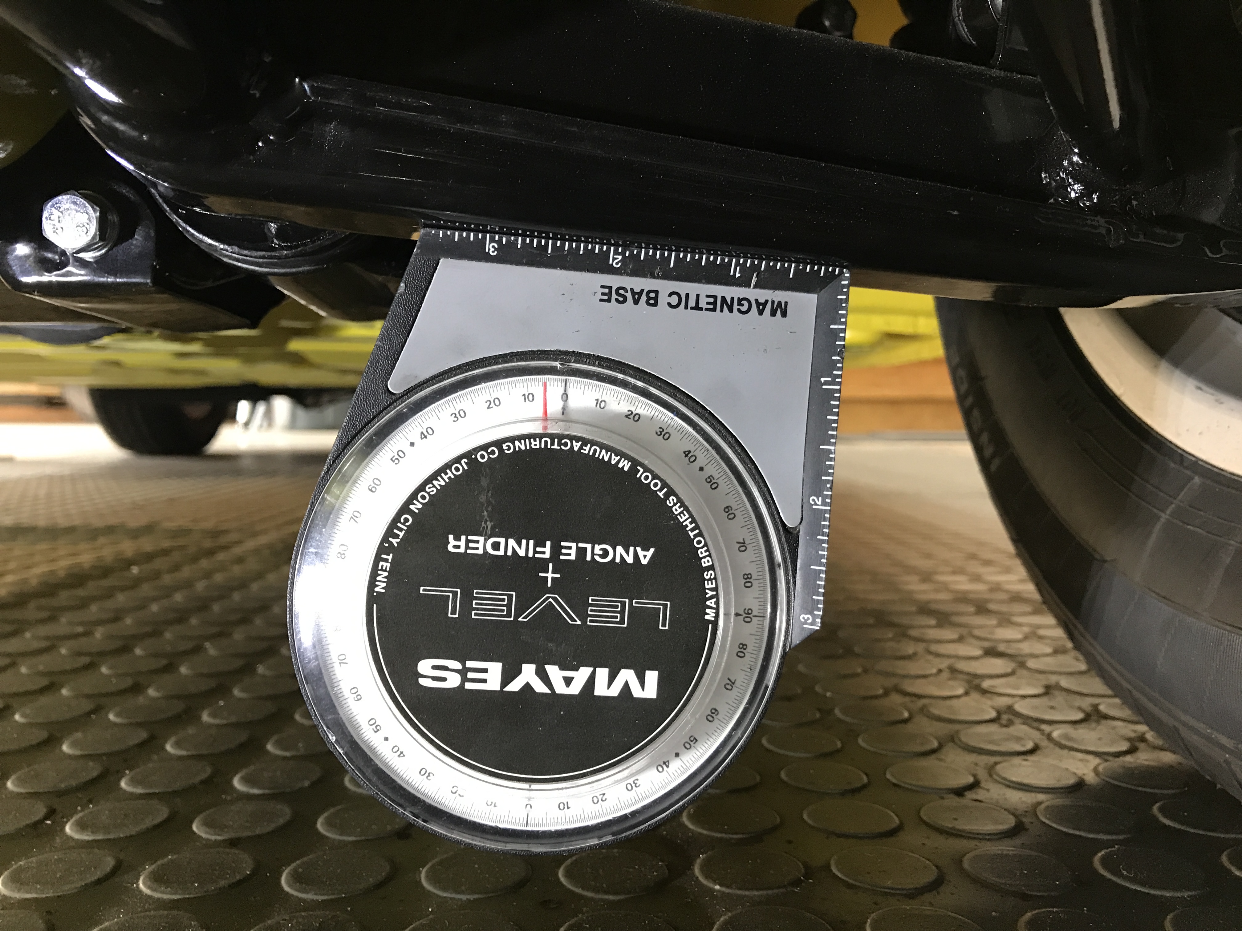

After another round of bouncing and rolling, I first checked the A-arm angles. 5° on the left.
bkrantz
post May 9 2022, 07:28 PM
Post #5243
Posts: 8,345
Joined: 3-August 19
From: SW Colorado
Member No.: 23,343
And 5° on the right. This might be as low as I want to go.

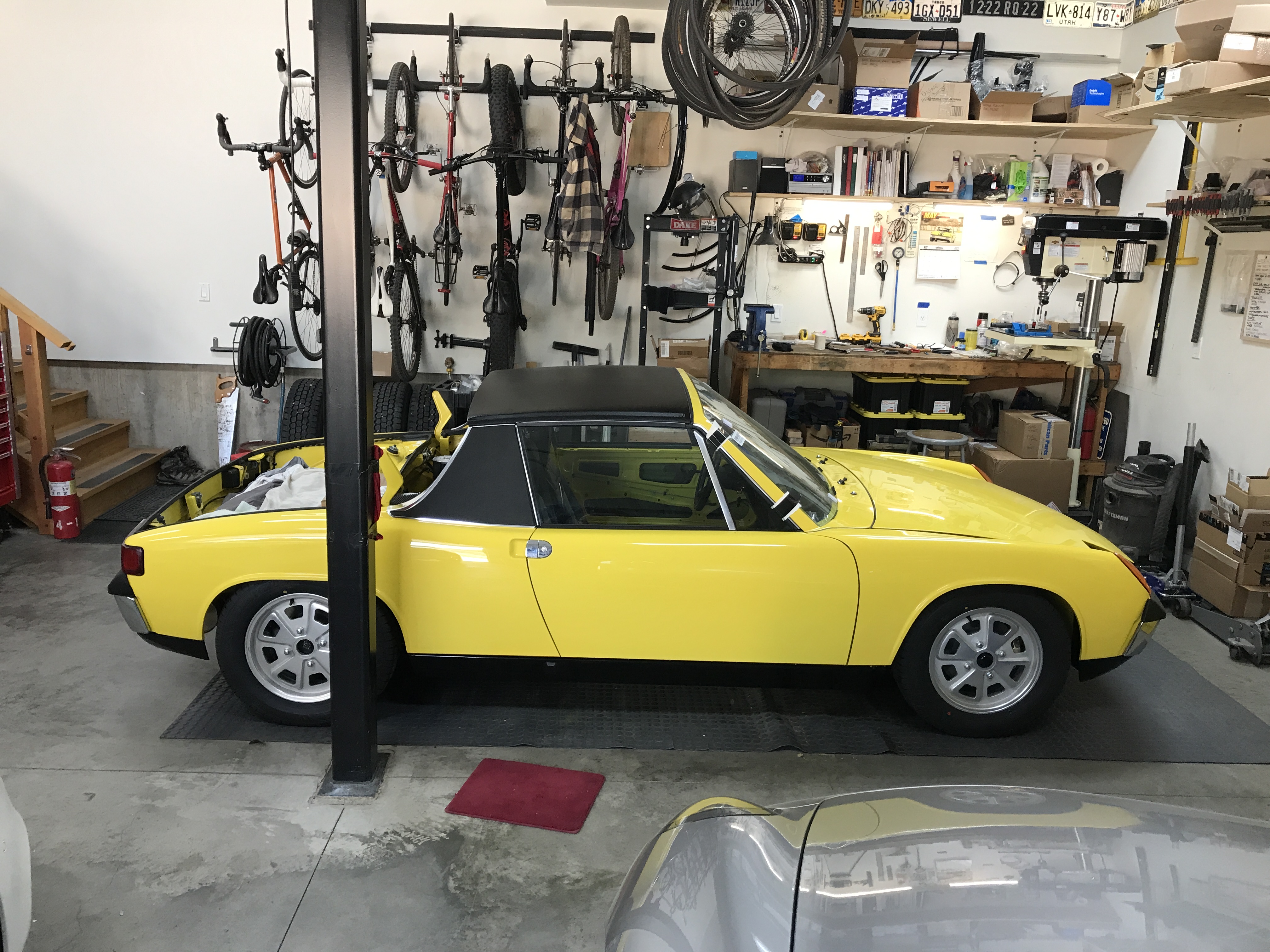

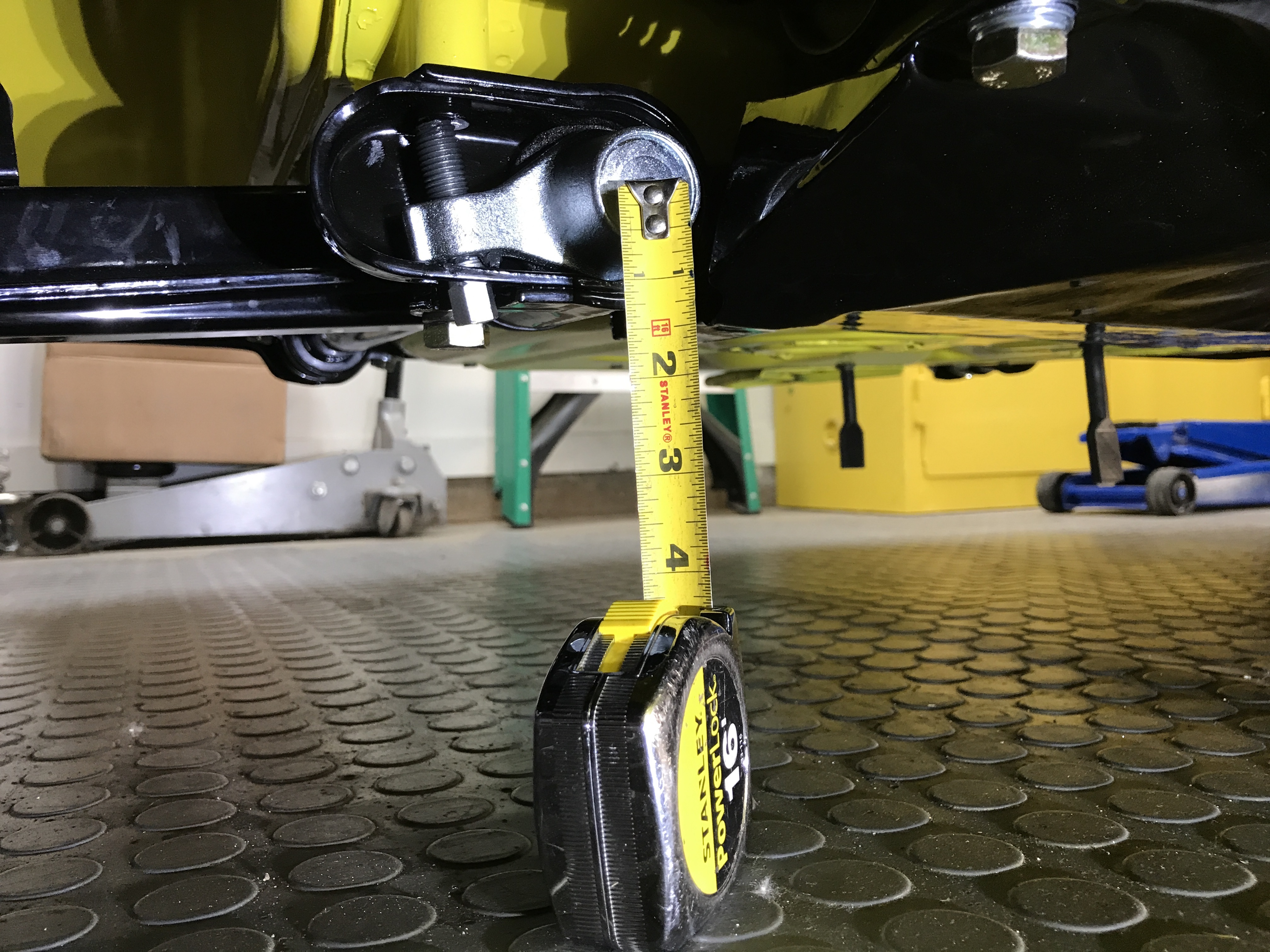

Torsion bar centers are now both at 6.8" above the floor, about 3/4" lower than yesterday. Front fender lips are now 24.4 (L) and 24.5 ®.

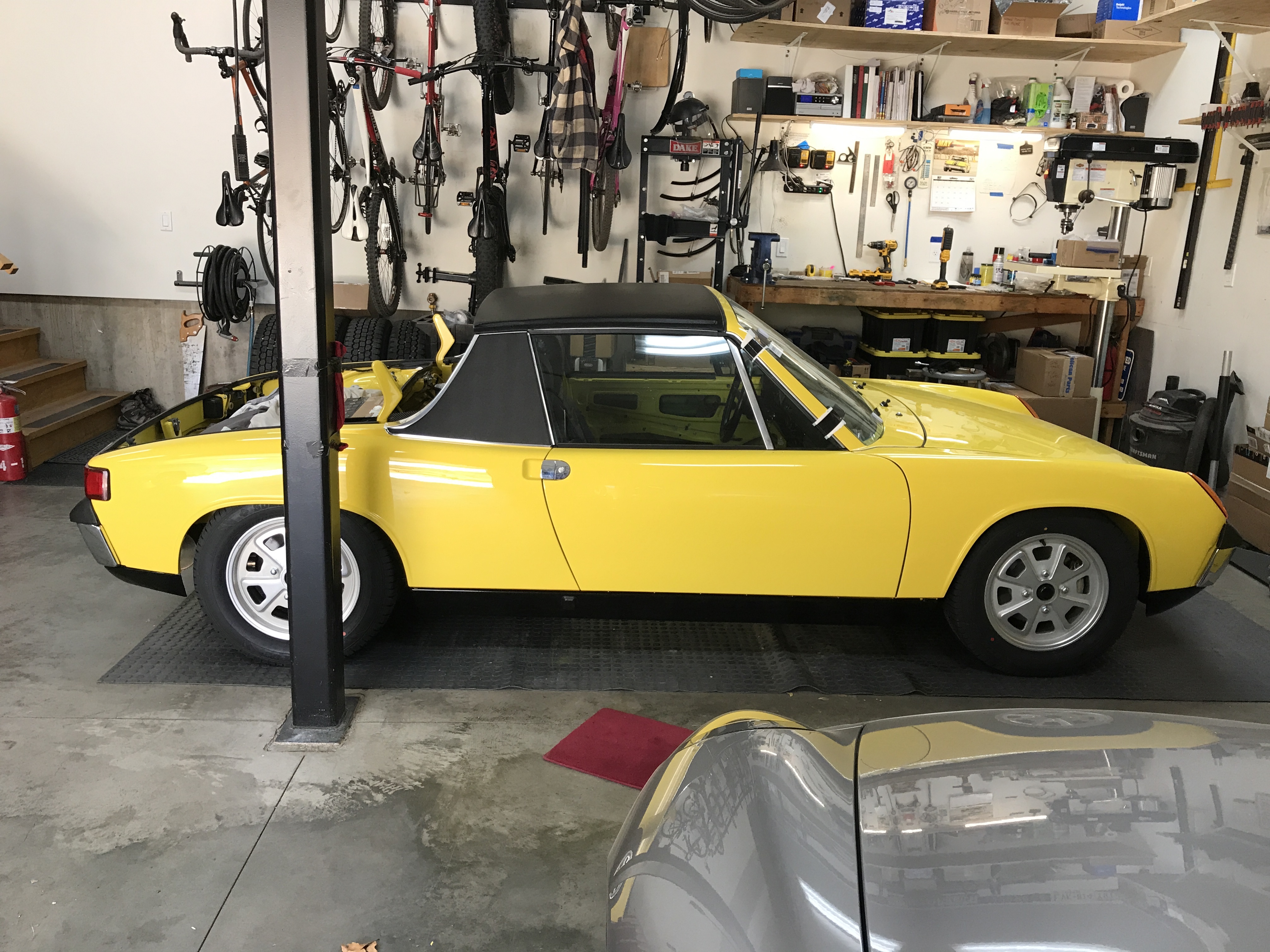

The car now sits about level, with the rocker seam about 6.3" above the floor F and R on both sides.

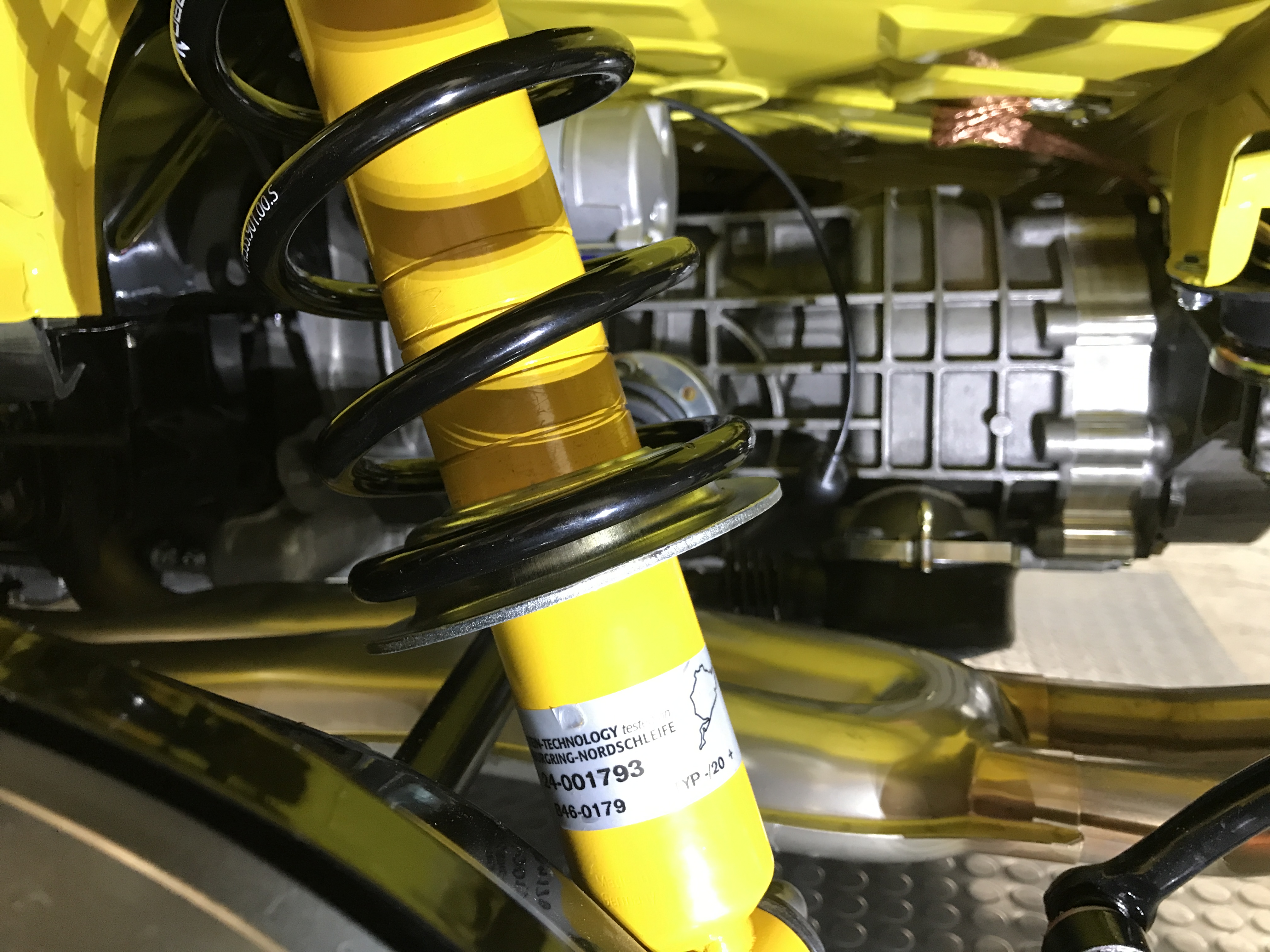

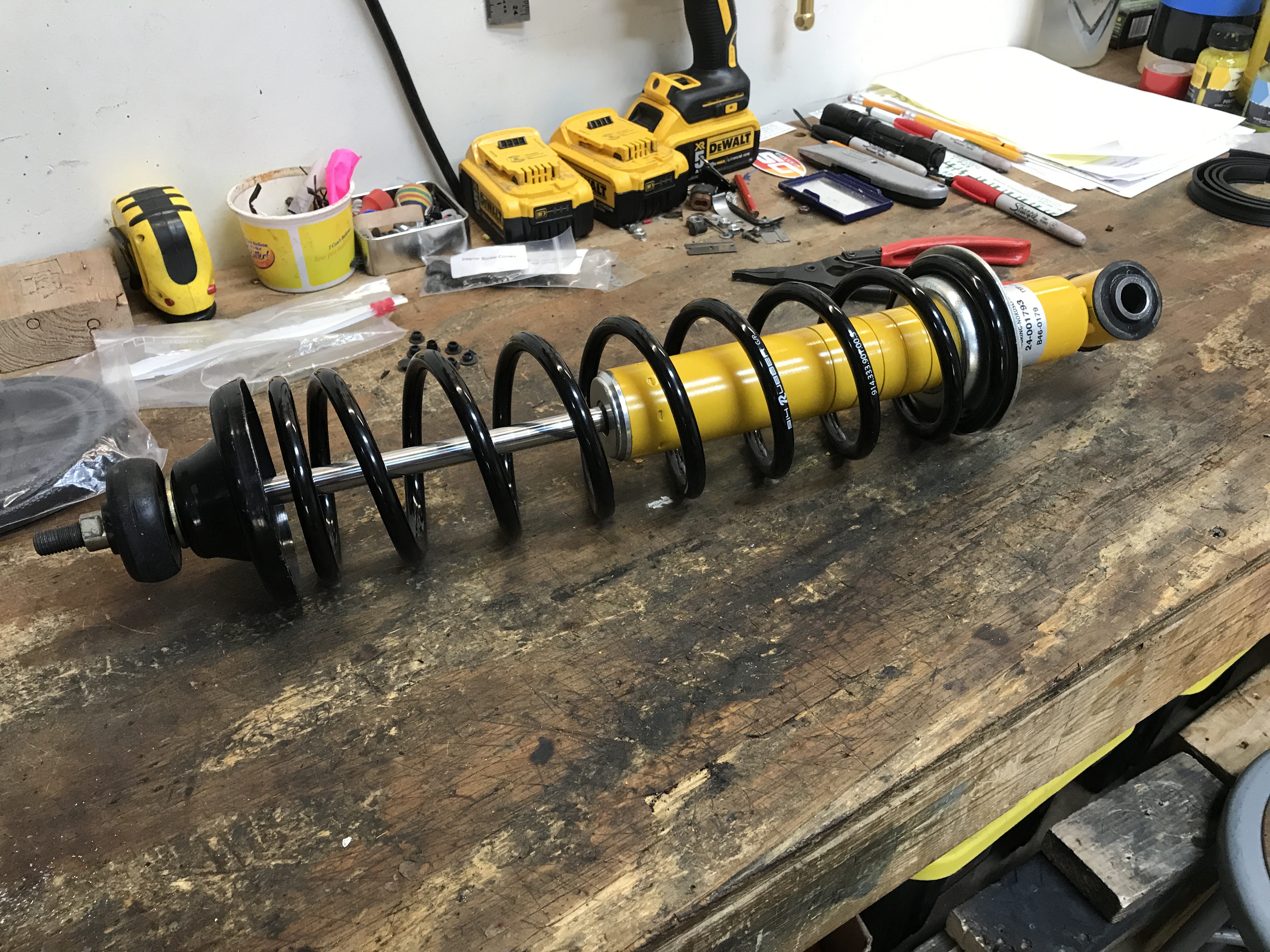

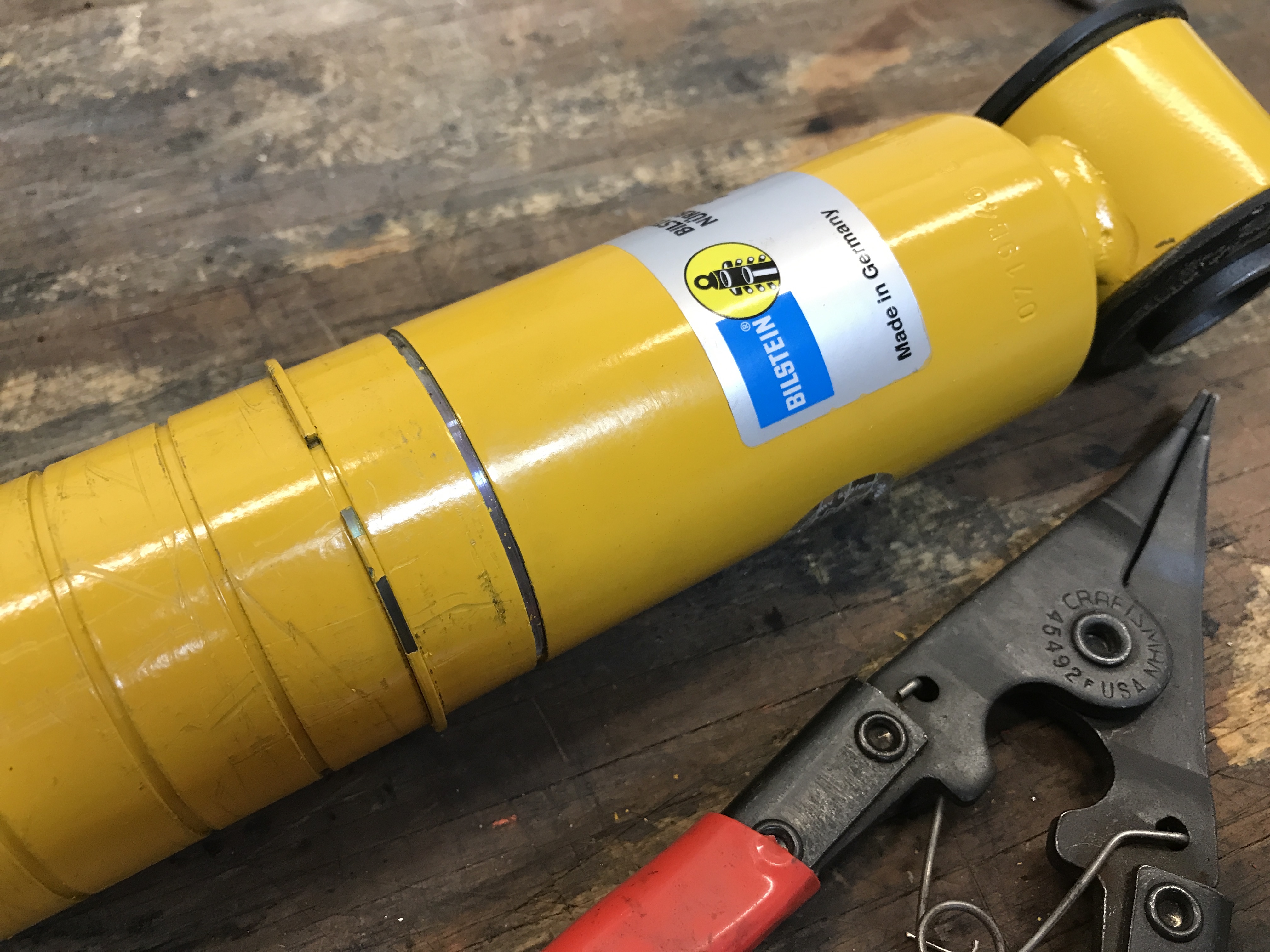

Since I had to pull the rear shocks again anyway, I decided to raise the rear just a bit.
bkrantz
post May 9 2022, 07:35 PM
Post #5247
Posts: 8,345
Joined: 3-August 19
From: SW Colorado
Member No.: 23,343
I moved the spring perch up 1 groove.

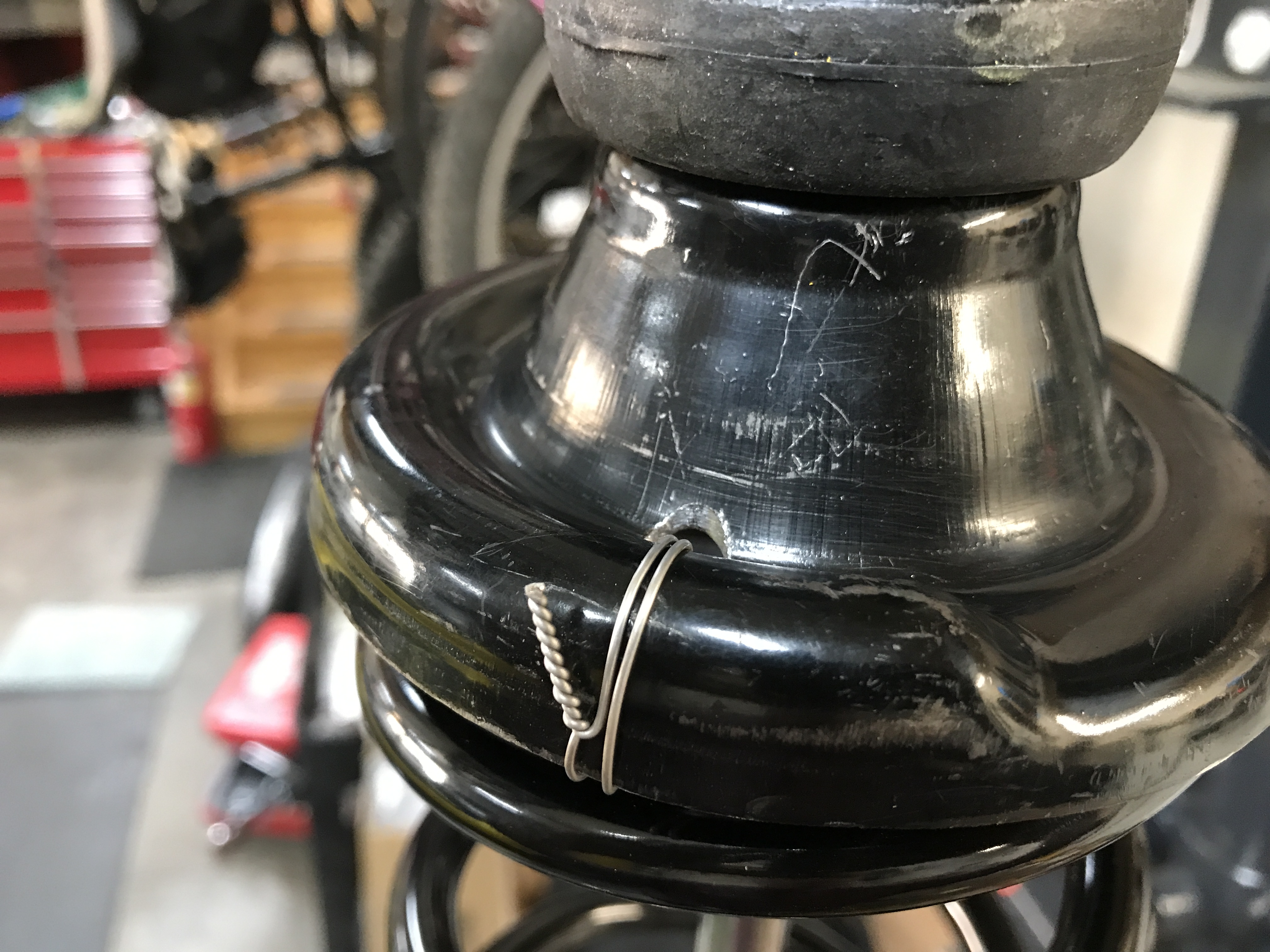

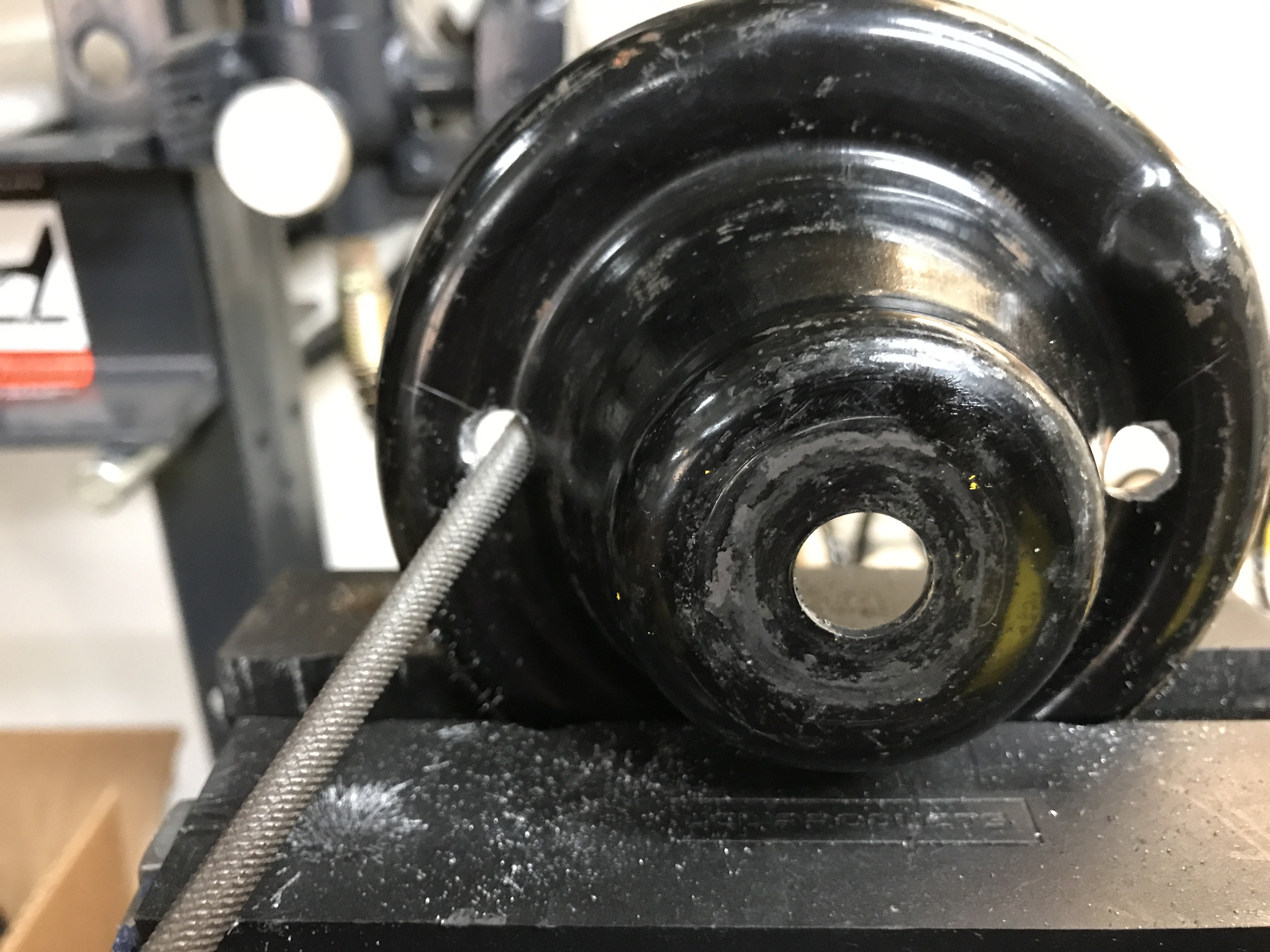

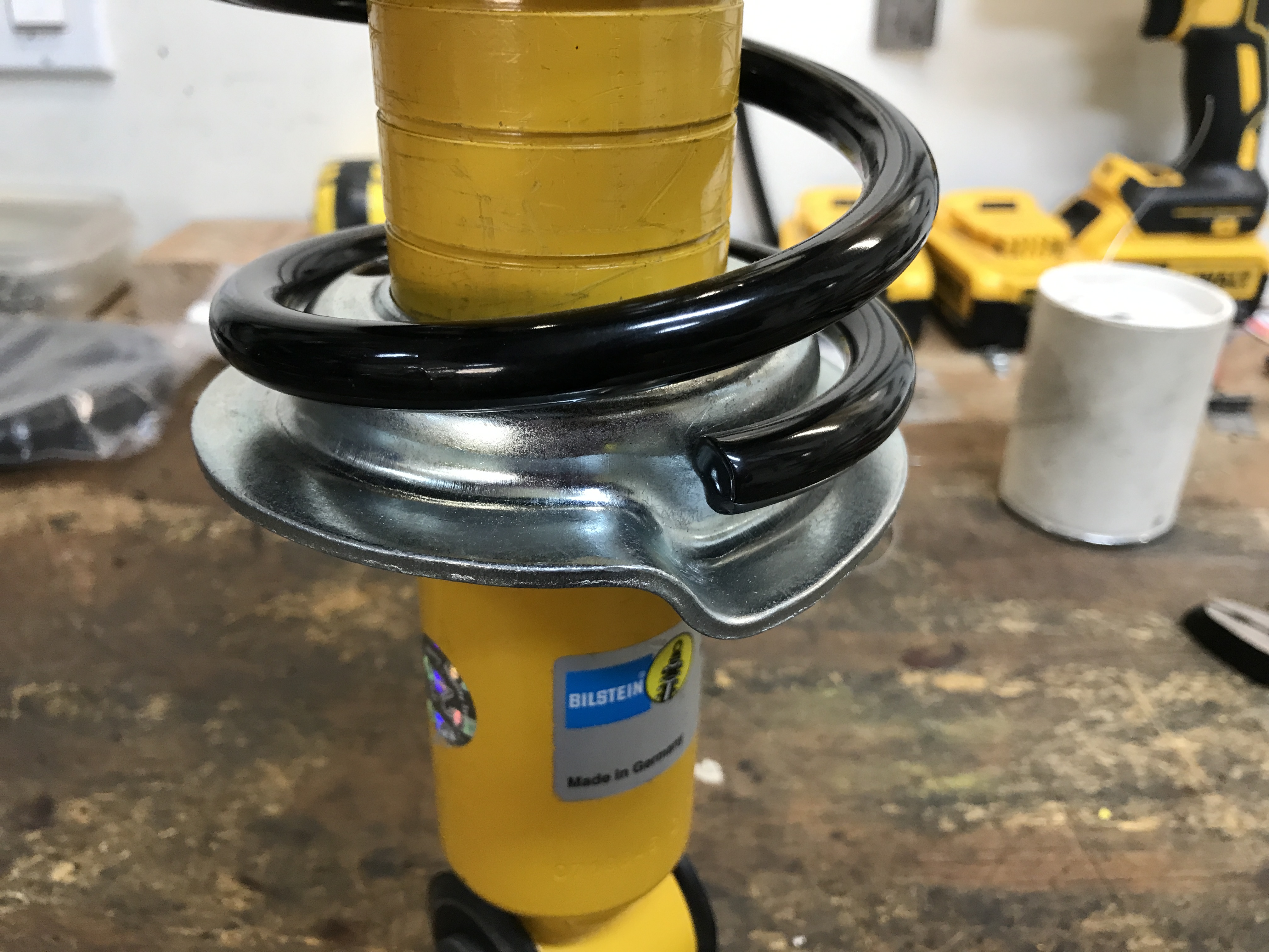

To tie the spring to the upper perch, I drilled a pair of holes, and then smoothed the edges.
bkrantz
post May 9 2022, 07:38 PM
Post #5249
Posts: 8,345
Joined: 3-August 19
From: SW Colorado
Member No.: 23,343

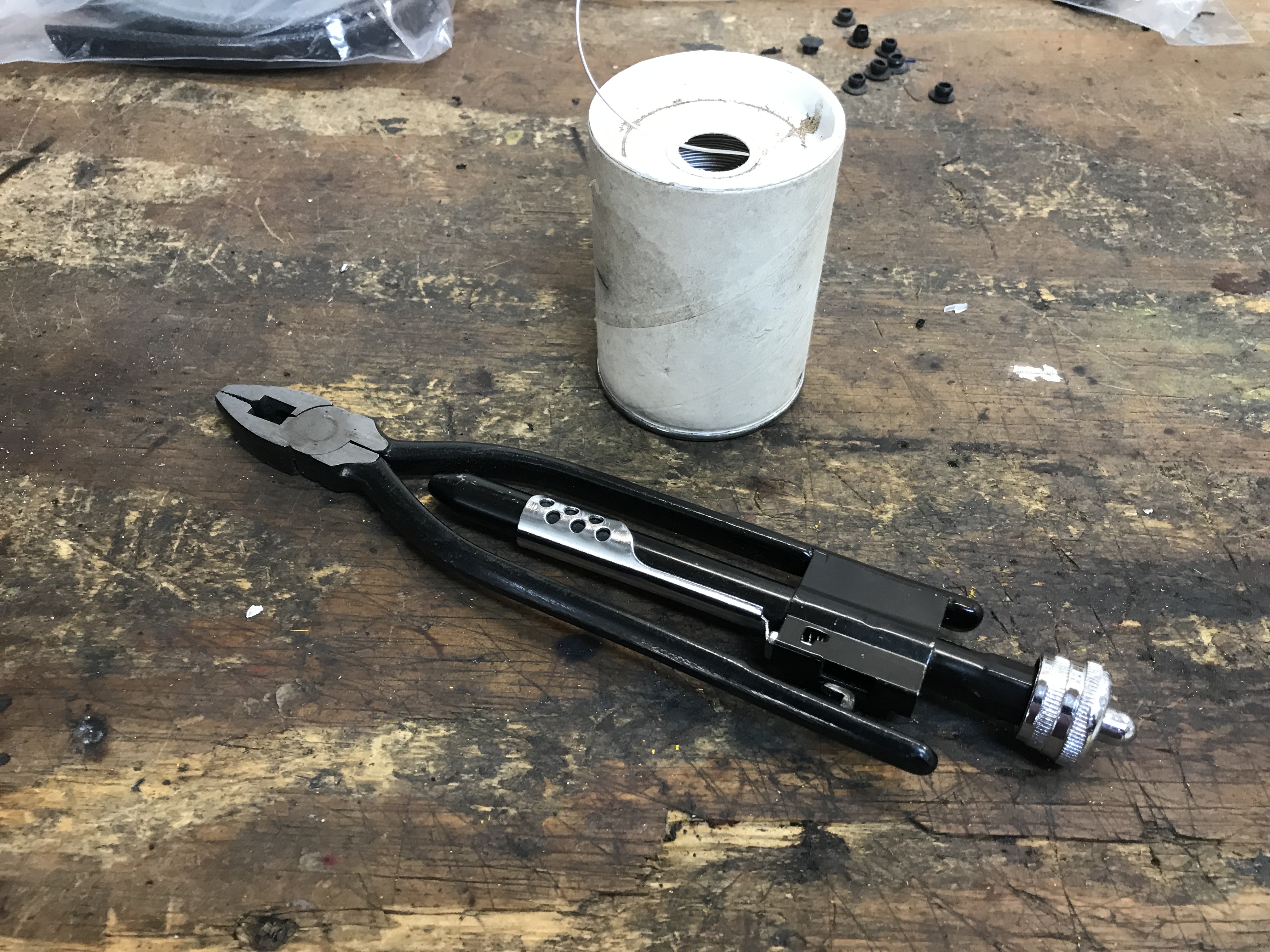

I got out my trusty safety wire and pliers. I used to wire up all kinds of stuff on race cars in the 90s and 2000s.
bkrantz
Post #5250
Posts: 8,345
Joined: 3-August 19
From: SW Colorado
Member No.: 23,343
Upper perch wired to the spring.
bkrantz
post May 9 2022, 07:40 PM
Post #5251
Posts: 8,345
Joined: 3-August 19
From: SW Colorado
Member No.: 23,343
Now there is about 1/2" of free play in the spring length. Looks like the rear perch still nicely locates the spring, so for now I will not wire that end.

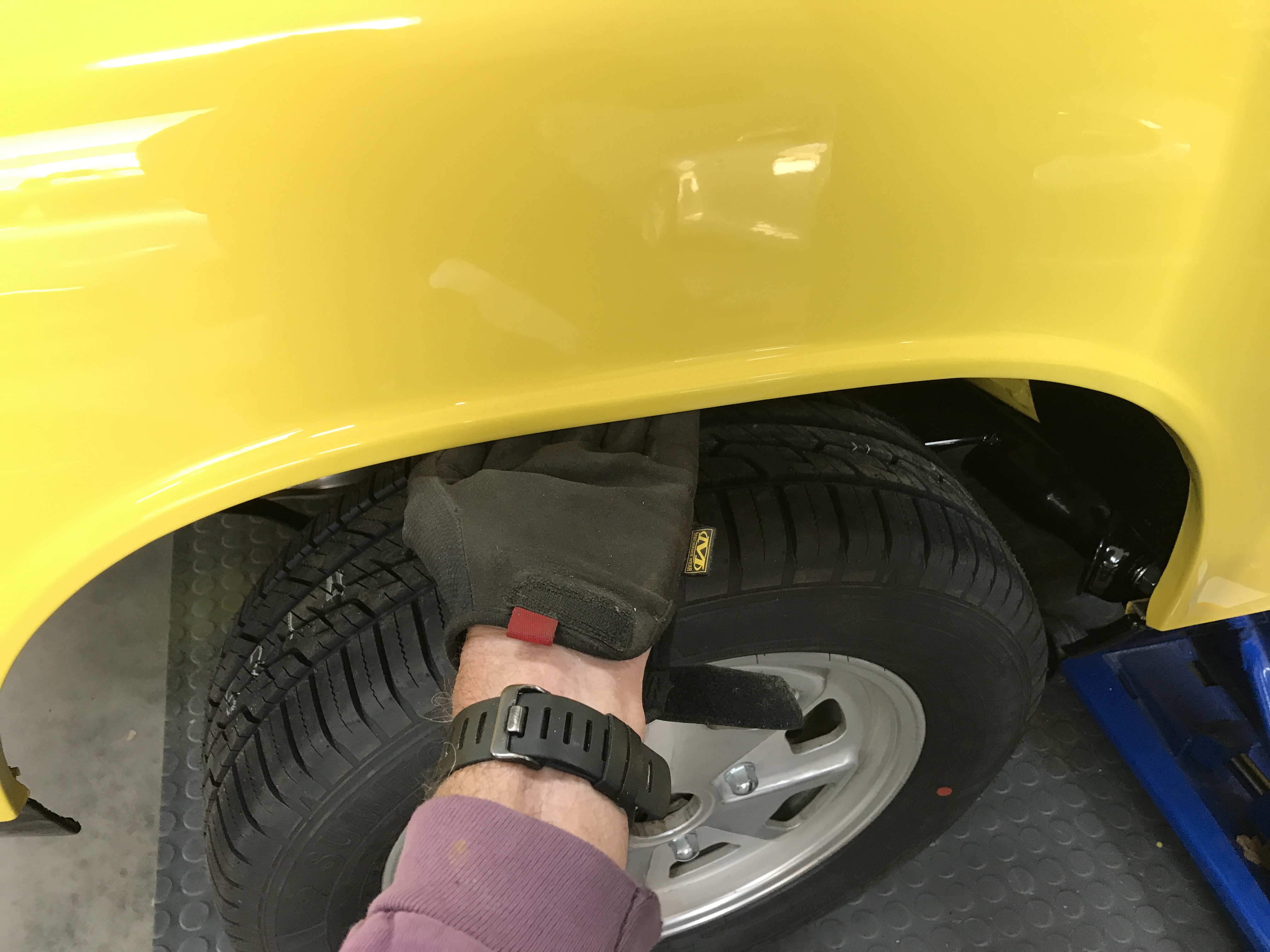

Before I lowered the car, I did a first attempt to create a bit more tire clearance inside the right fender. I think I moved it about 1/8".

After that, I lowered the car, did another bounce and roll session, and measured. The rear end of the rocker seam is now about 1/4" higher than the front. I think this is pretty good for now.
"Default" camber is also close enough, fronts -0.1 L and +0.5 R (and easily adjusted), rears -0.6 L and 0.0 R.
Next step is to roughly set the toe and then camber.

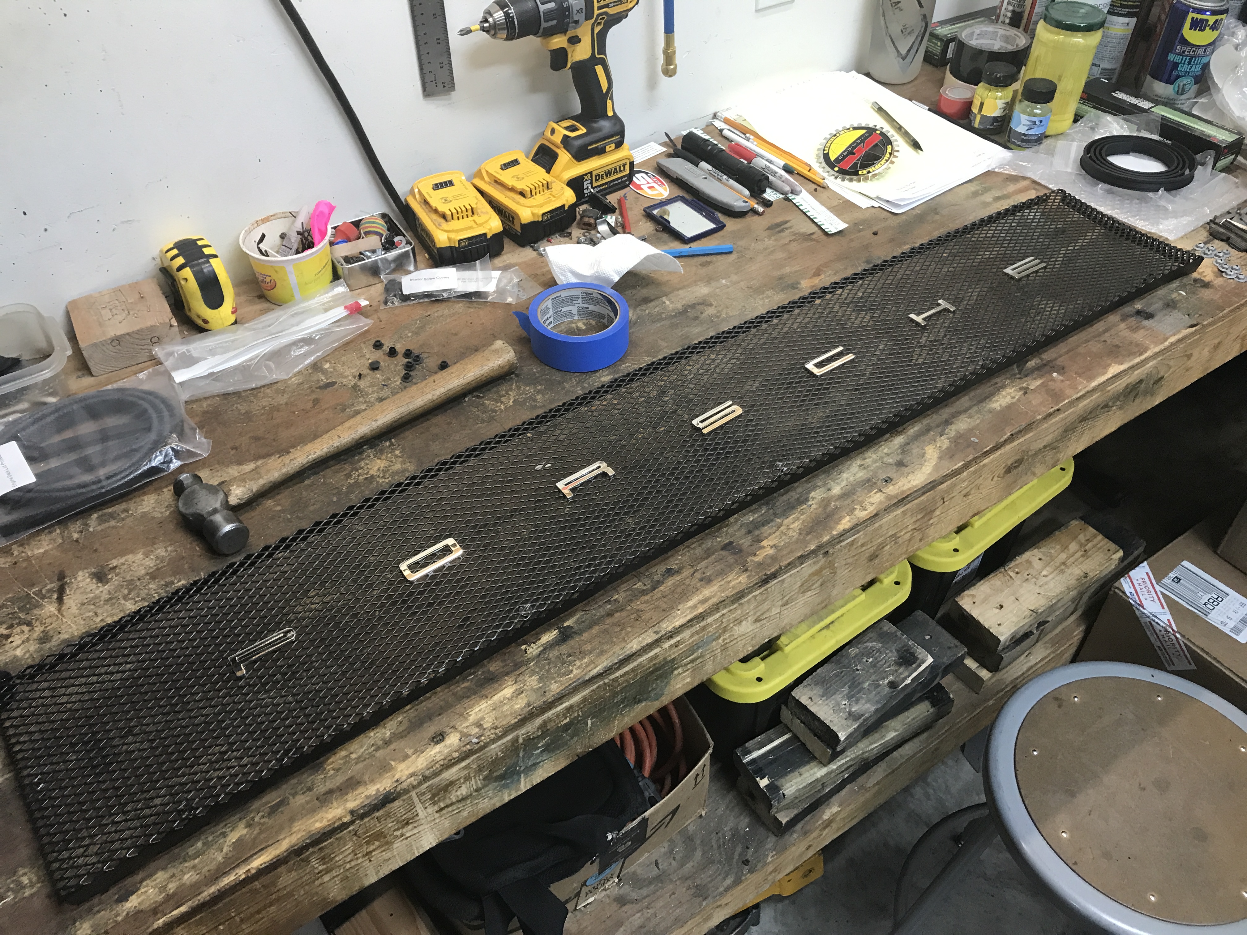

Time to put the engine lid together. Letters in the right order (I hope).
