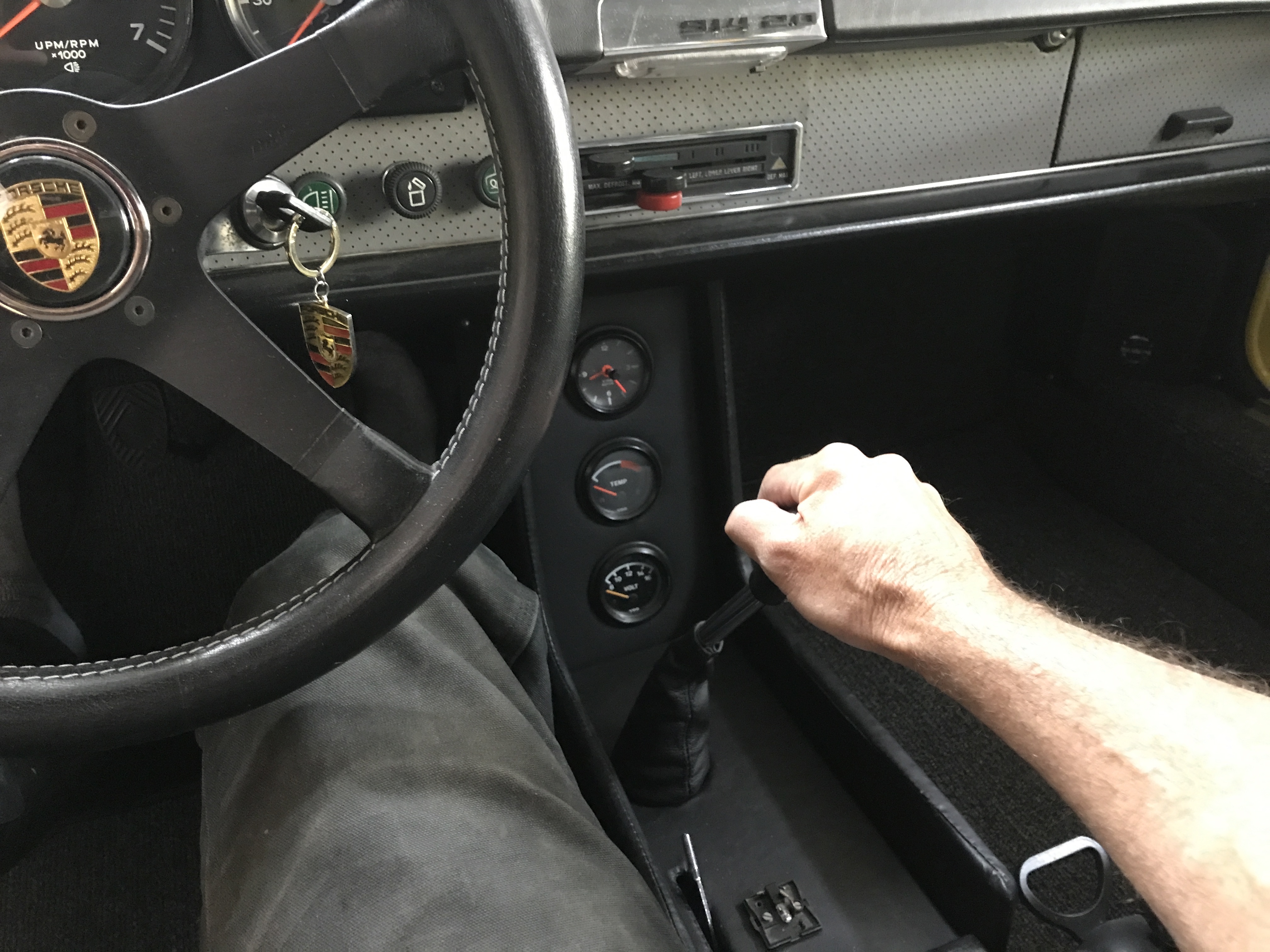

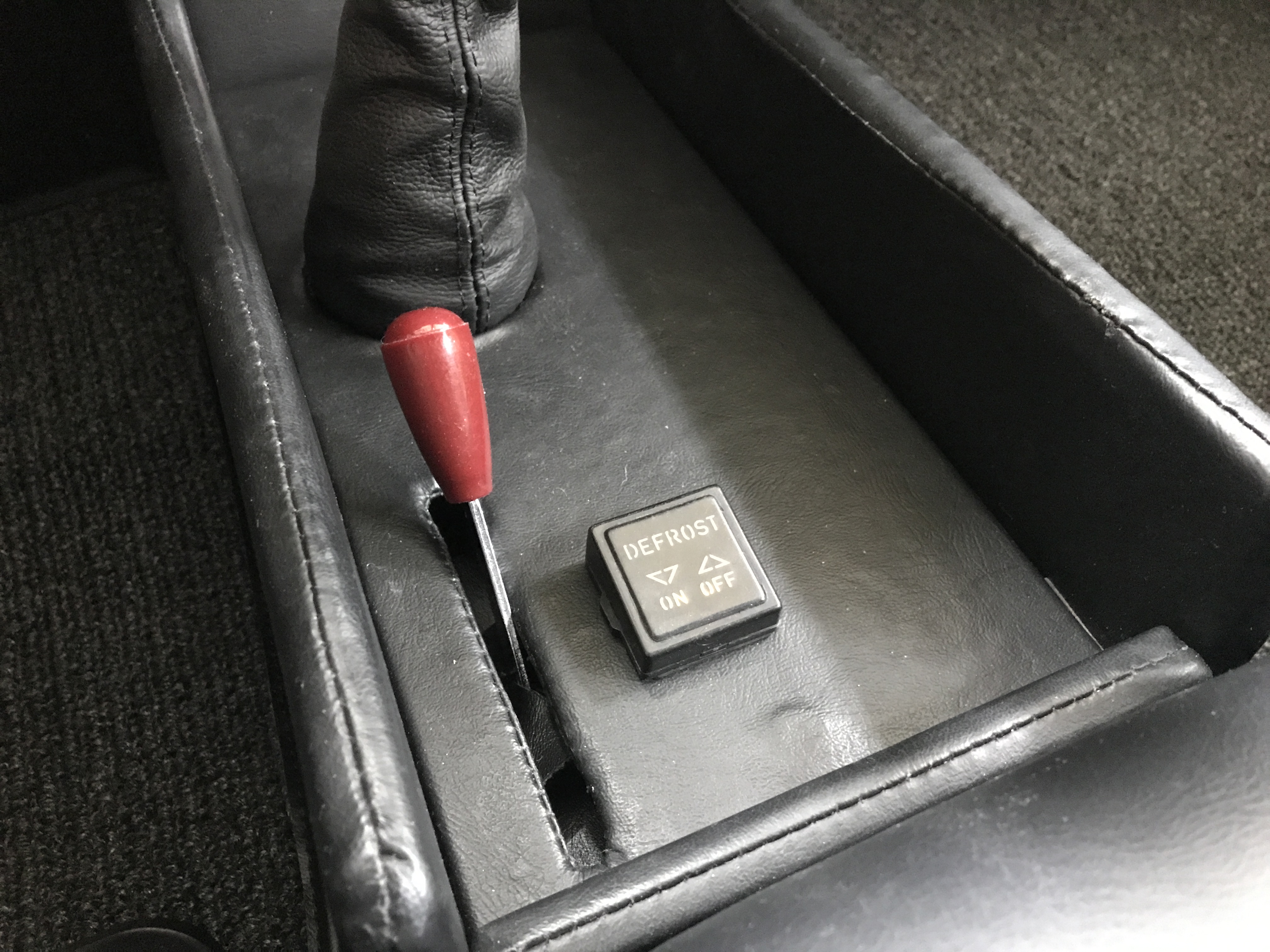

Let's try this again. A few days ago I got home from teaching in a remote area for a week, and got ready to spend some quality time in my garage. Then I woke up with COVID. Fortunately, so far I have been lucky with a mild case, and today feel much better.
I figured I was up to some small tasks, starting with confirming the shift rod adjustment. I can get all 6 gears, and the fore-aft position of the knob seems good.
bkrantz
post May 24 2022, 08:08 PM
Post #5283
Posts: 8,343
Joined: 3-August 19
From: SW Colorado
Member No.: 23,343
So I can put the console back together again, including a new dark red heat lever knob.

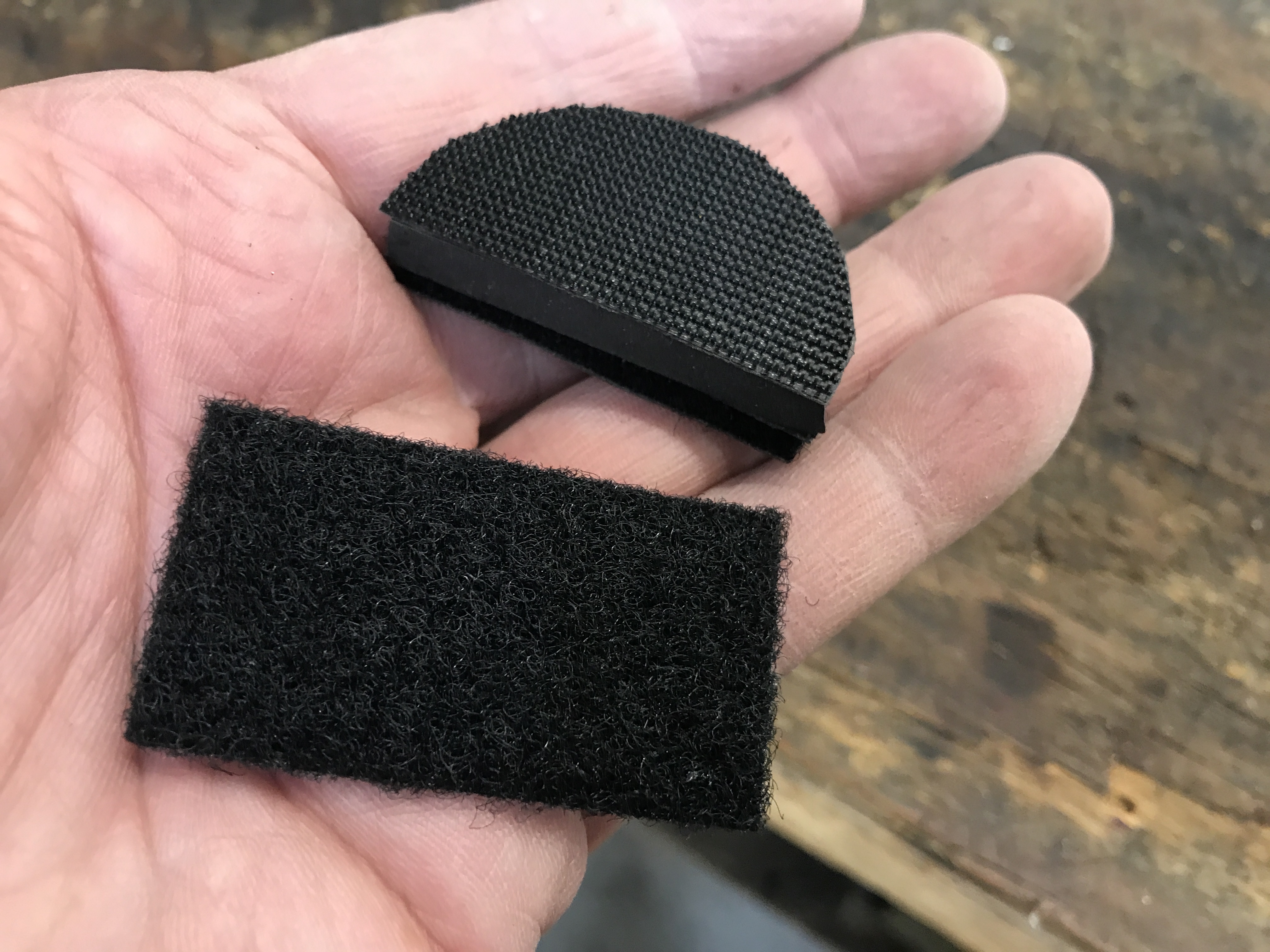

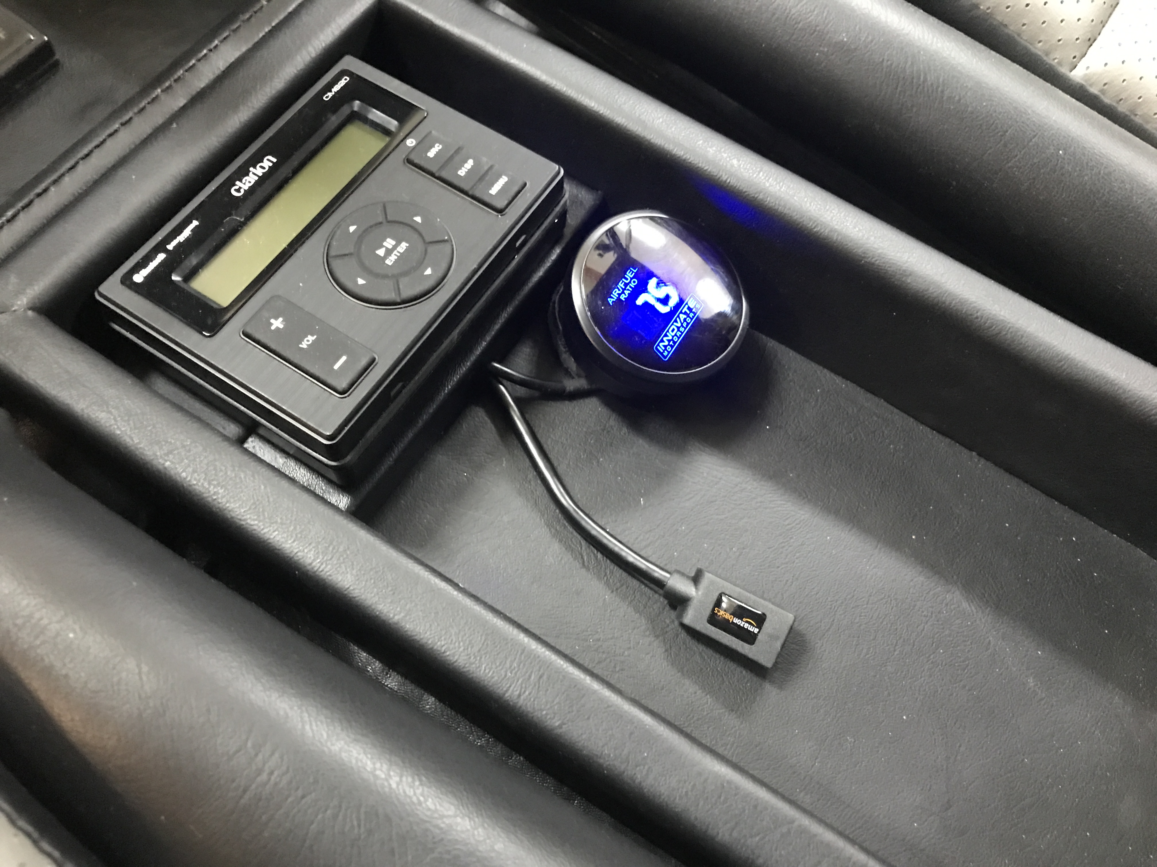

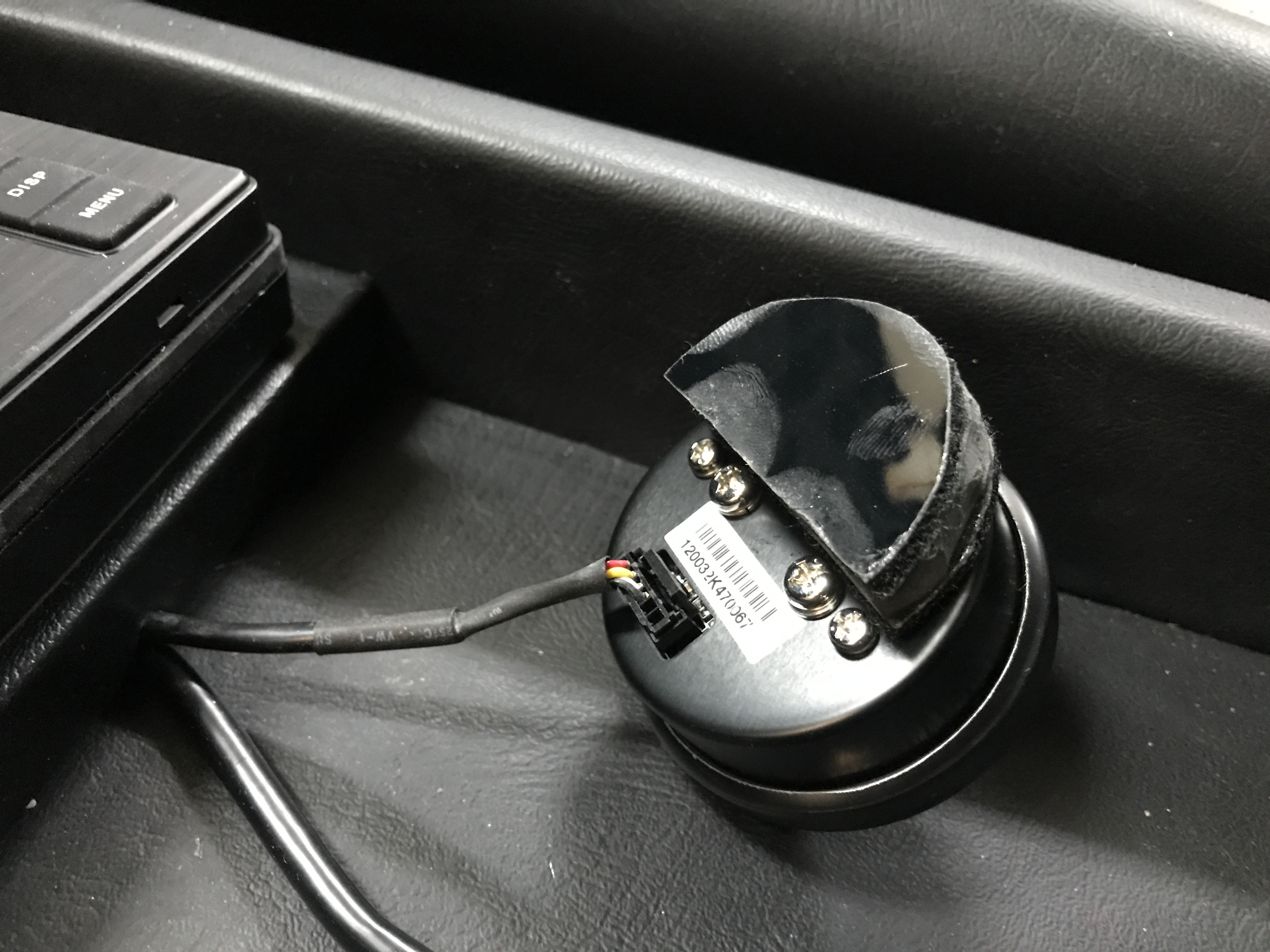

Then I made a temporary mount for my O2 sensor gauge, with a rubber wedge and adhesive velcro.
bkrantz
post May 24 2022, 08:11 PM
Post #5285
Posts: 8,343
Joined: 3-August 19
From: SW Colorado
Member No.: 23,343
Mount on the back of the gauge, with stand-off space for the cable plug.
bkrantz
post May 24 2022, 08:12 PM
Post #5286
Posts: 8,343
Joined: 3-August 19
From: SW Colorado
Member No.: 23,343
I mounted the gauge inside the center arm rest, along with the control box for my hidden audio system. No radio showing in the dashboard. the USB plug port is for the audio system.

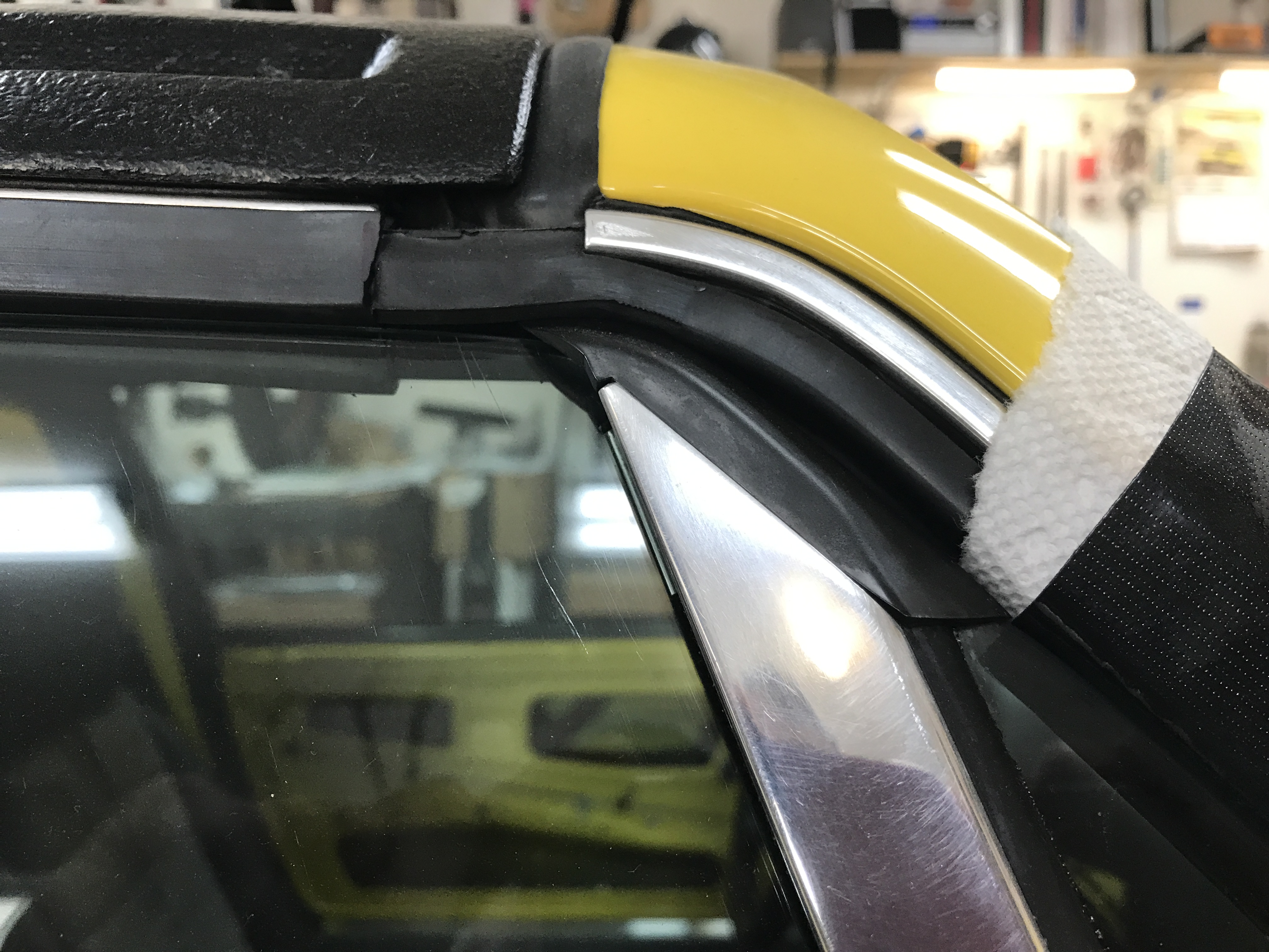

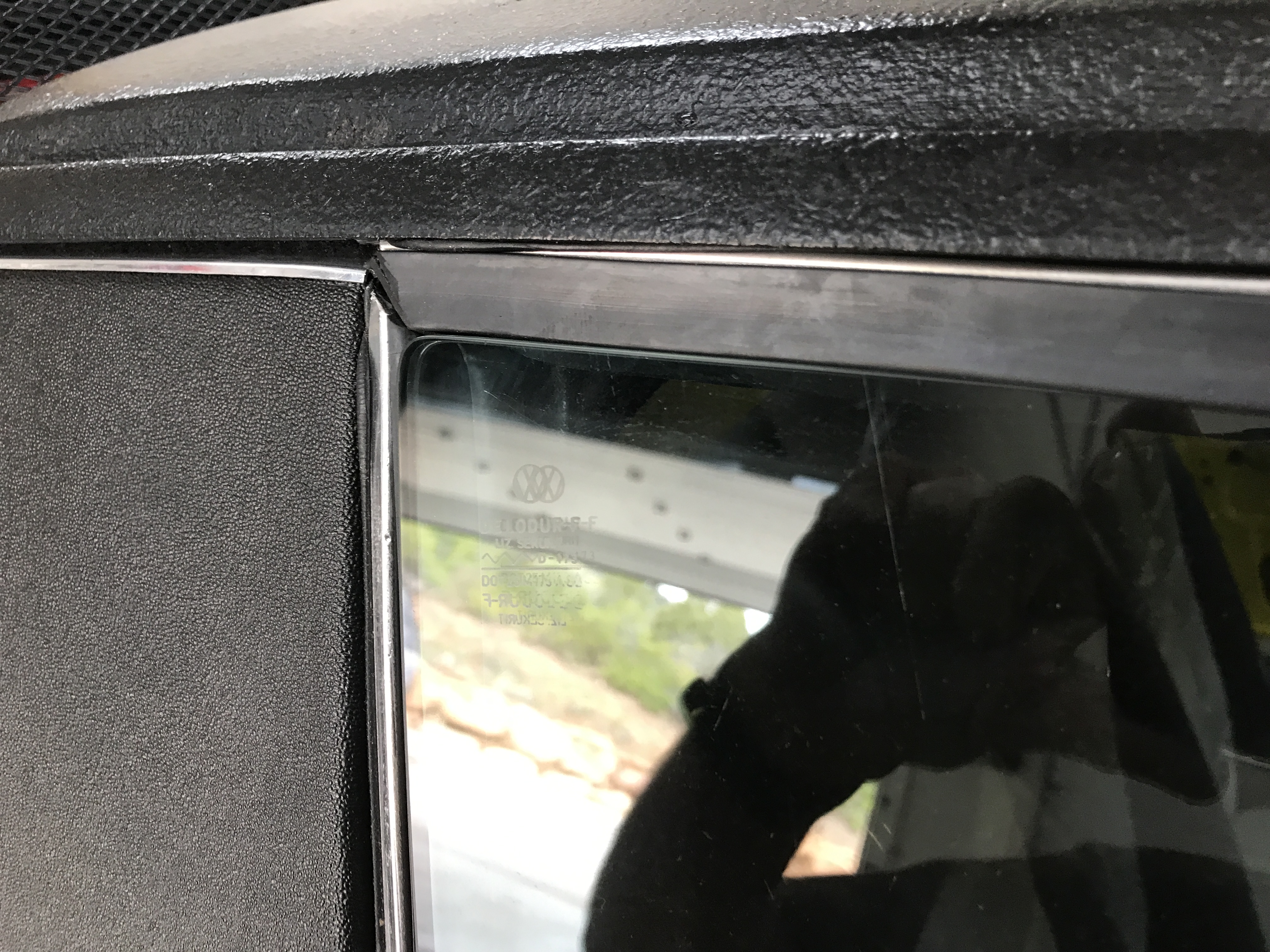

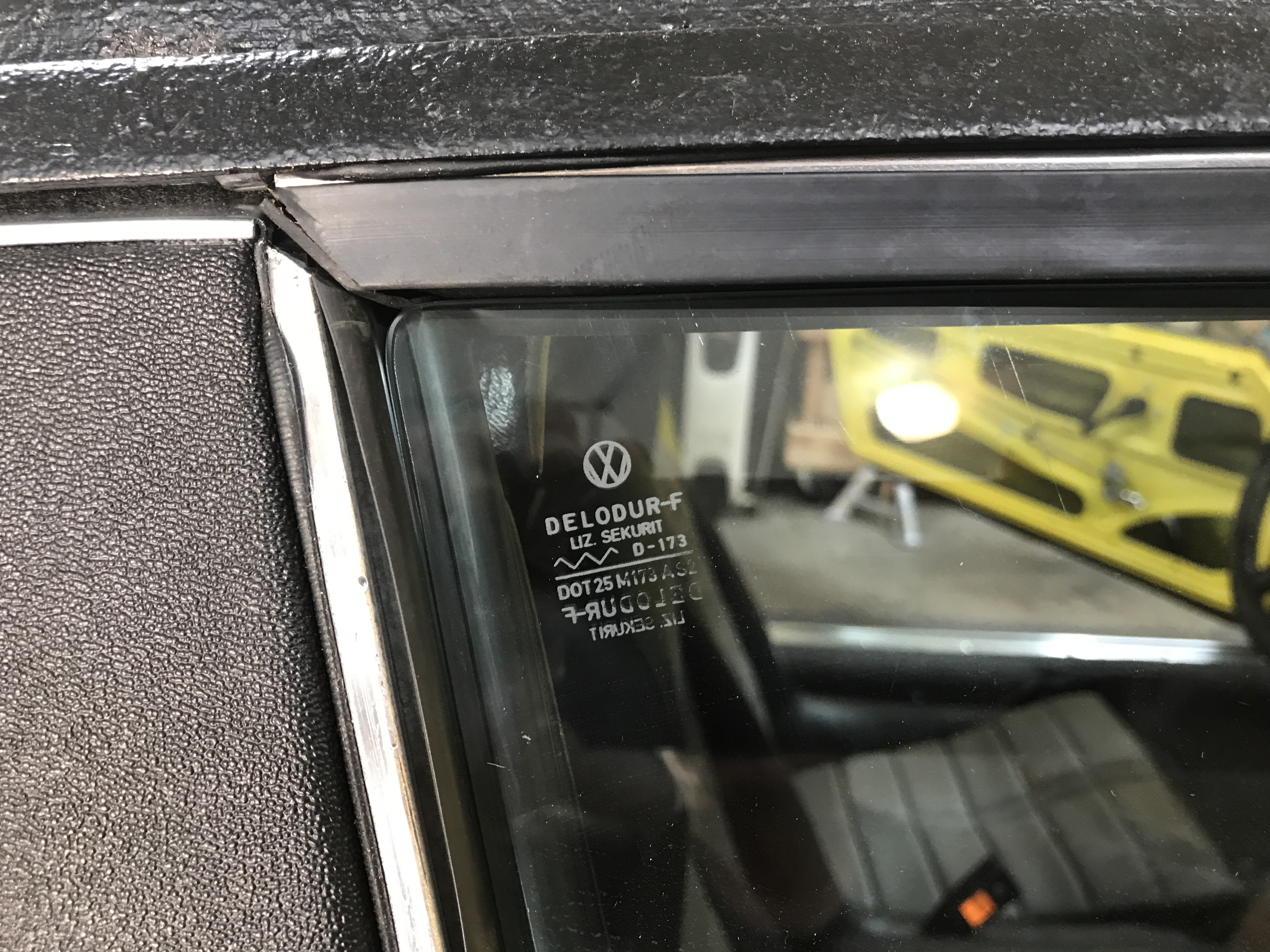

Then I did another round of side window adjustment. The left side is pretty good front and rear.
bkrantz
post May 24 2022, 08:17 PM
Post #5288
Posts: 8,343
Joined: 3-August 19
From: SW Colorado
Member No.: 23,343

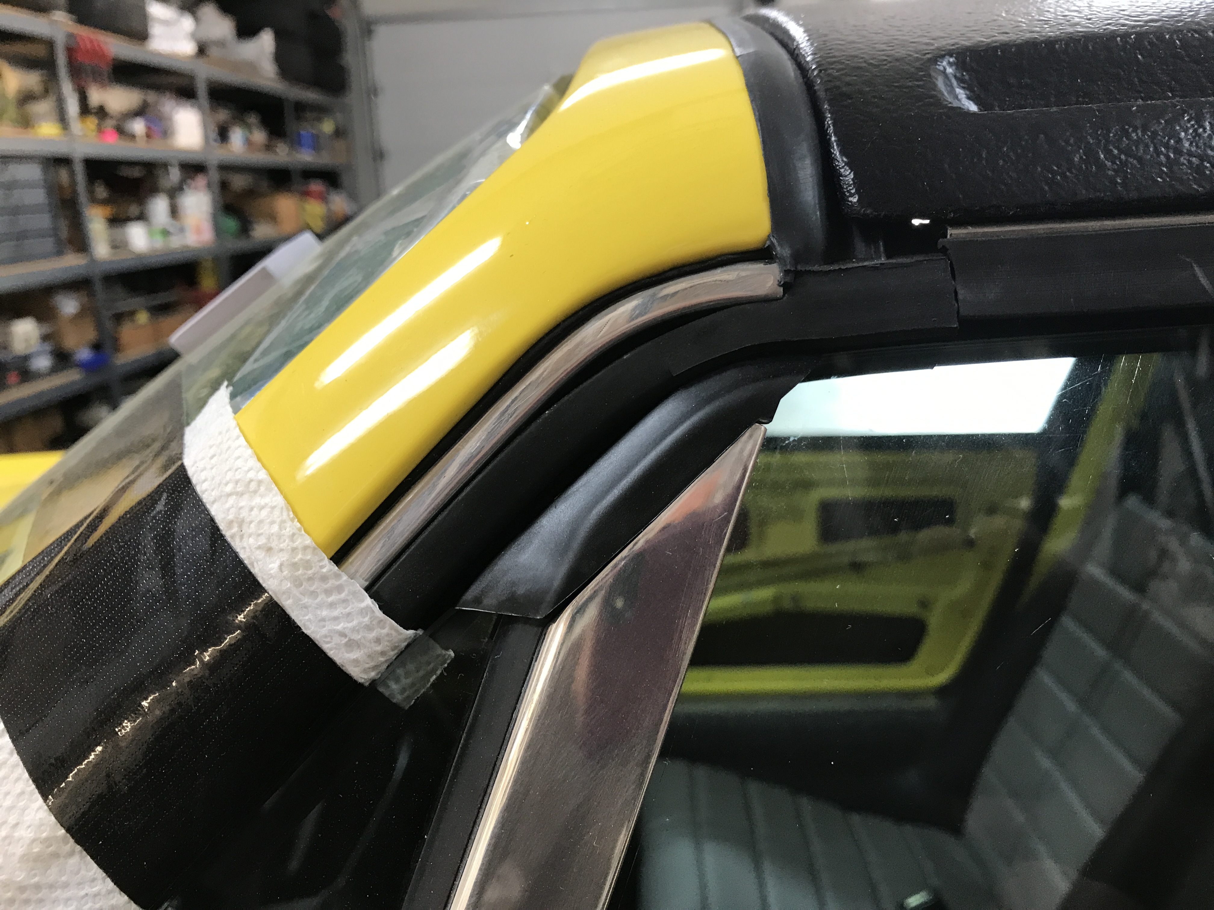

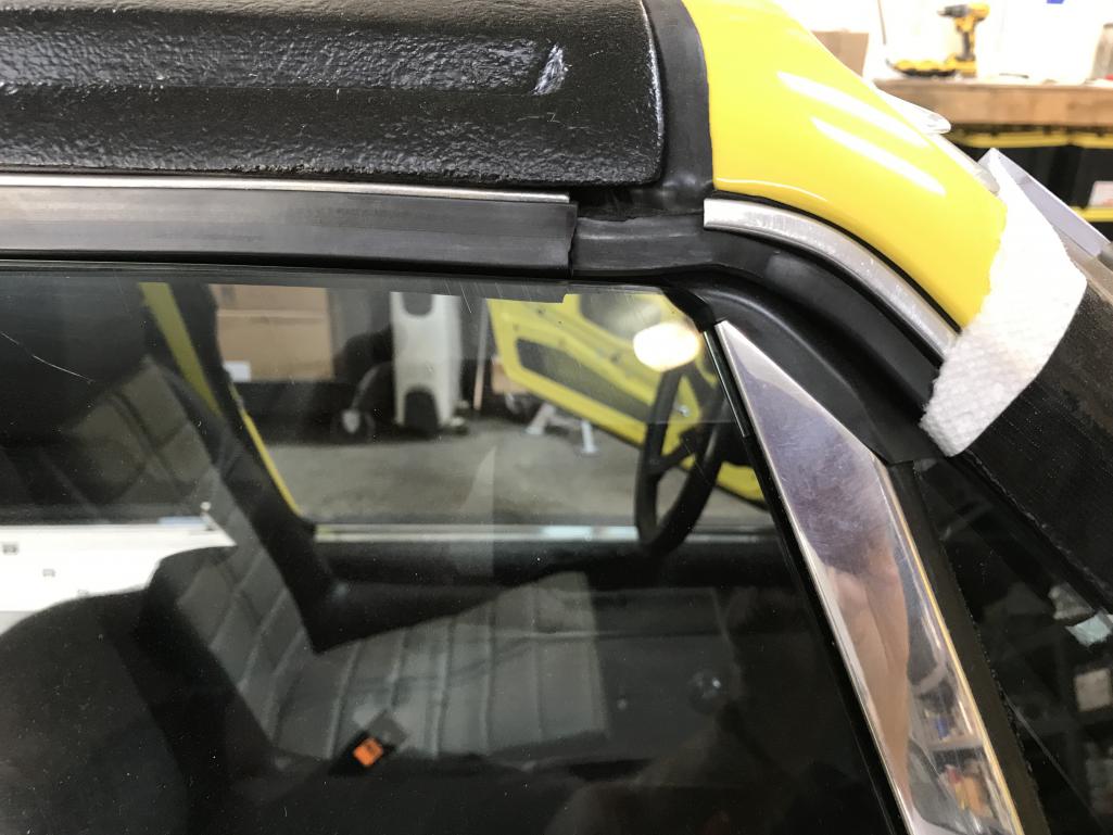

But the right side still gives me trouble. When I have the front high enough to seal...
bkrantz
post May 24 2022, 08:18 PM
Post #5289
Posts: 8,343
Joined: 3-August 19
From: SW Colorado
Member No.: 23,343
The rear is too high and too far back, and the glass hits the weatherstripping and will not close.
bkrantz
post May 24 2022, 08:19 PM
Post #5290
Posts: 8,343
Joined: 3-August 19
From: SW Colorado
Member No.: 23,343
I fooled a bit more, and got the rear to close, even if the fit is tight.
bkrantz
post May 24 2022, 08:20 PM
Post #5291
Posts: 8,343
Joined: 3-August 19
From: SW Colorado
Member No.: 23,343
And the front is OK.
Maybe this car will not go out in the rain. (IMG:style_emoticons/default/confused24.gif)

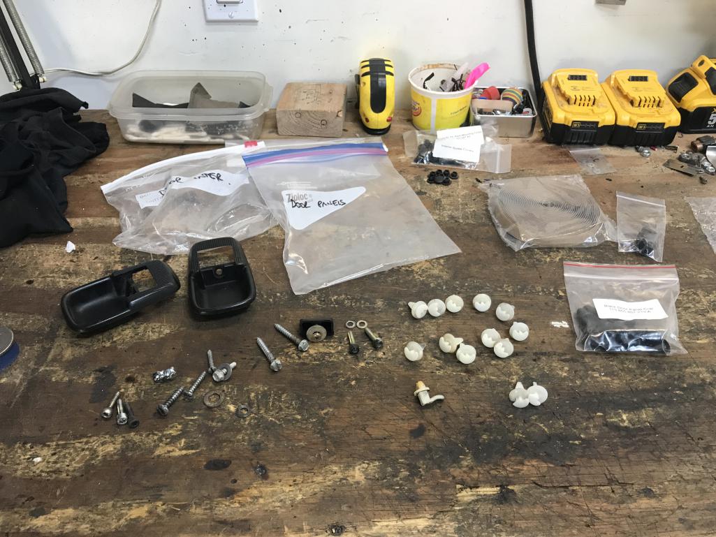

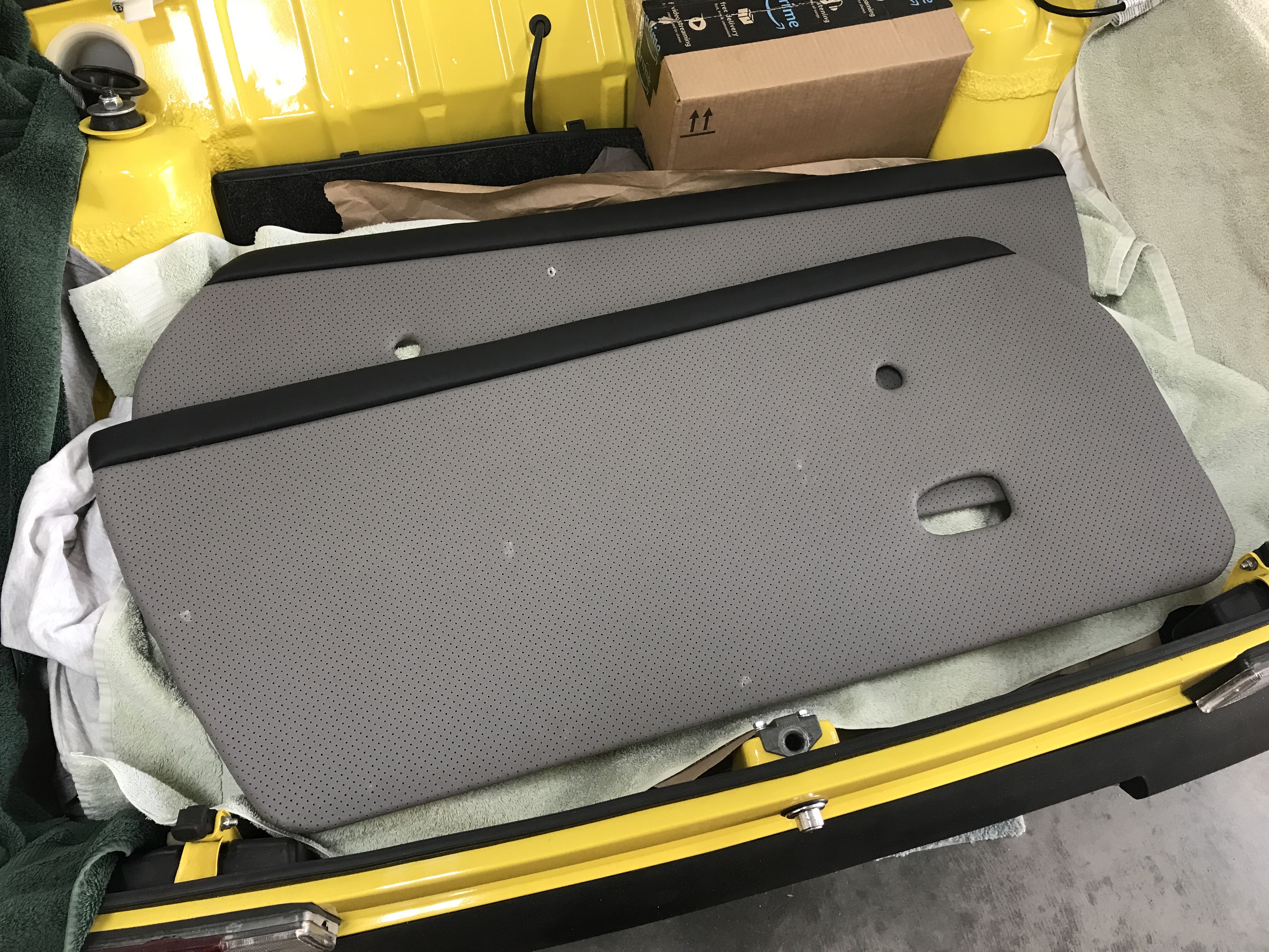

A got the door cards from the guest room. These are almost the last parts inside my house--only the trunk lid and the windshield frame remain.
bkrantz
post May 24 2022, 08:24 PM
Post #5294
Posts: 8,343
Joined: 3-August 19
From: SW Colorado
Member No.: 23,343

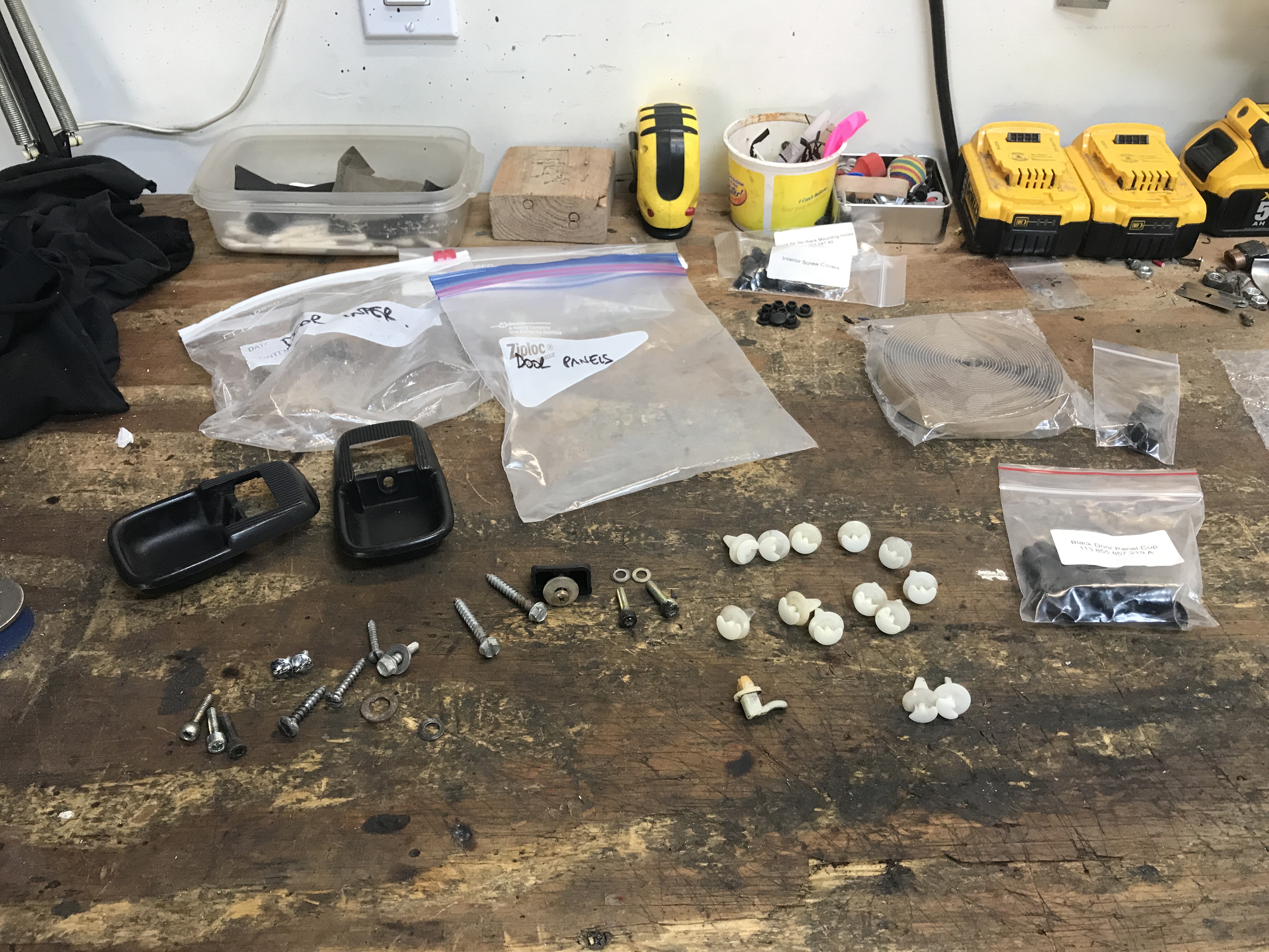

Time to sort out the original hardware--and time to order a few pieces (and get rid of some interesting PO hardware).

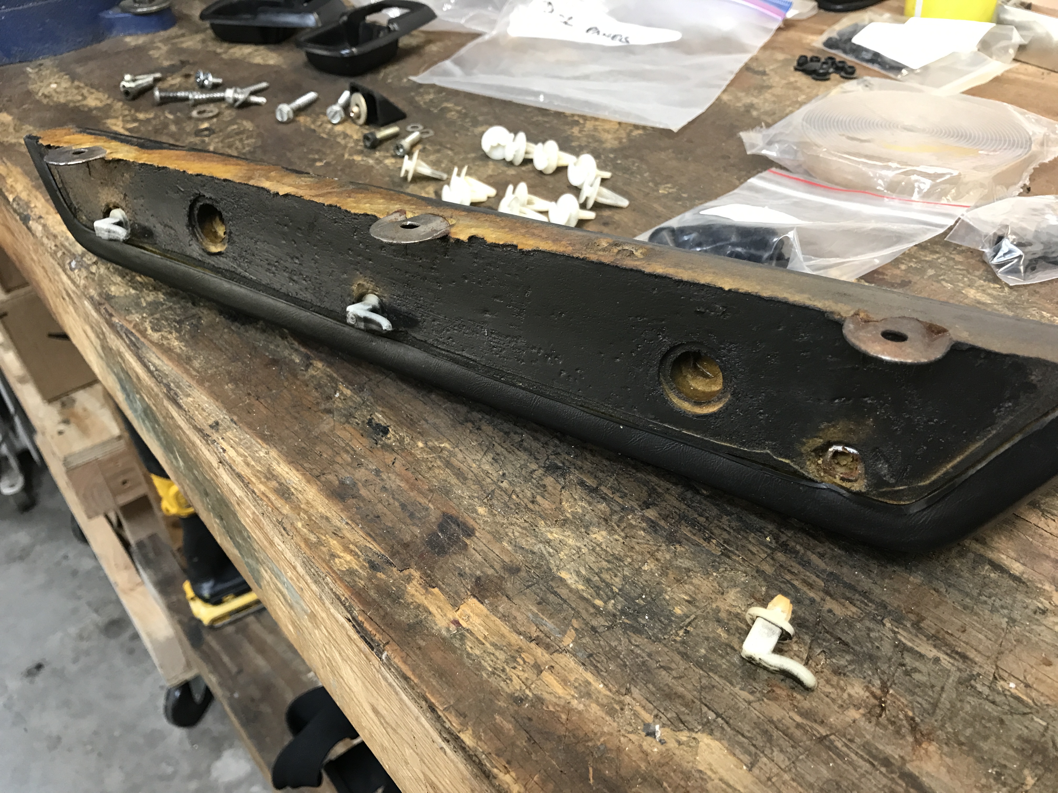

Getting more door parts ready. The strange little L-shape plug if for the underside of the passenger door arm rest.
