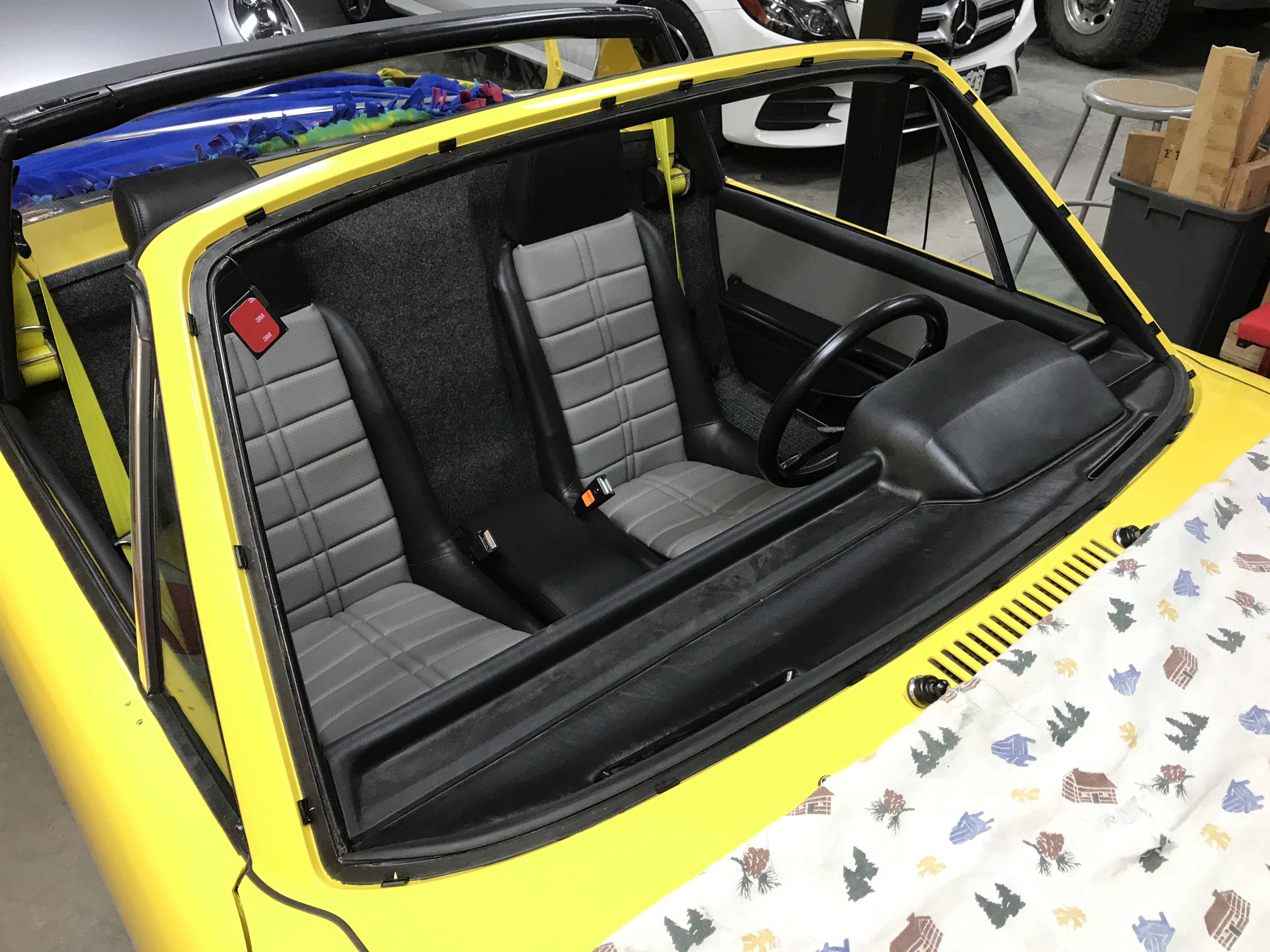

The next attempt worked. I learned to initially tap just hard enough to get the prongs into the hole, then a slightly harder tap to seat the body of the clip against the sheet metal--and then stop. In order to set the plastic pin, I tapped the punch just a little harder with a stiff mallet.
bkrantz
post Jun 5 2022, 08:50 PM
Post #5442
Posts: 8,343
Joined: 3-August 19
From: SW Colorado
Member No.: 23,343
My luck held for all 19 clips.
bkrantz
post Jun 5 2022, 08:53 PM
Post #5443
Posts: 8,343
Joined: 3-August 19
From: SW Colorado
Member No.: 23,343

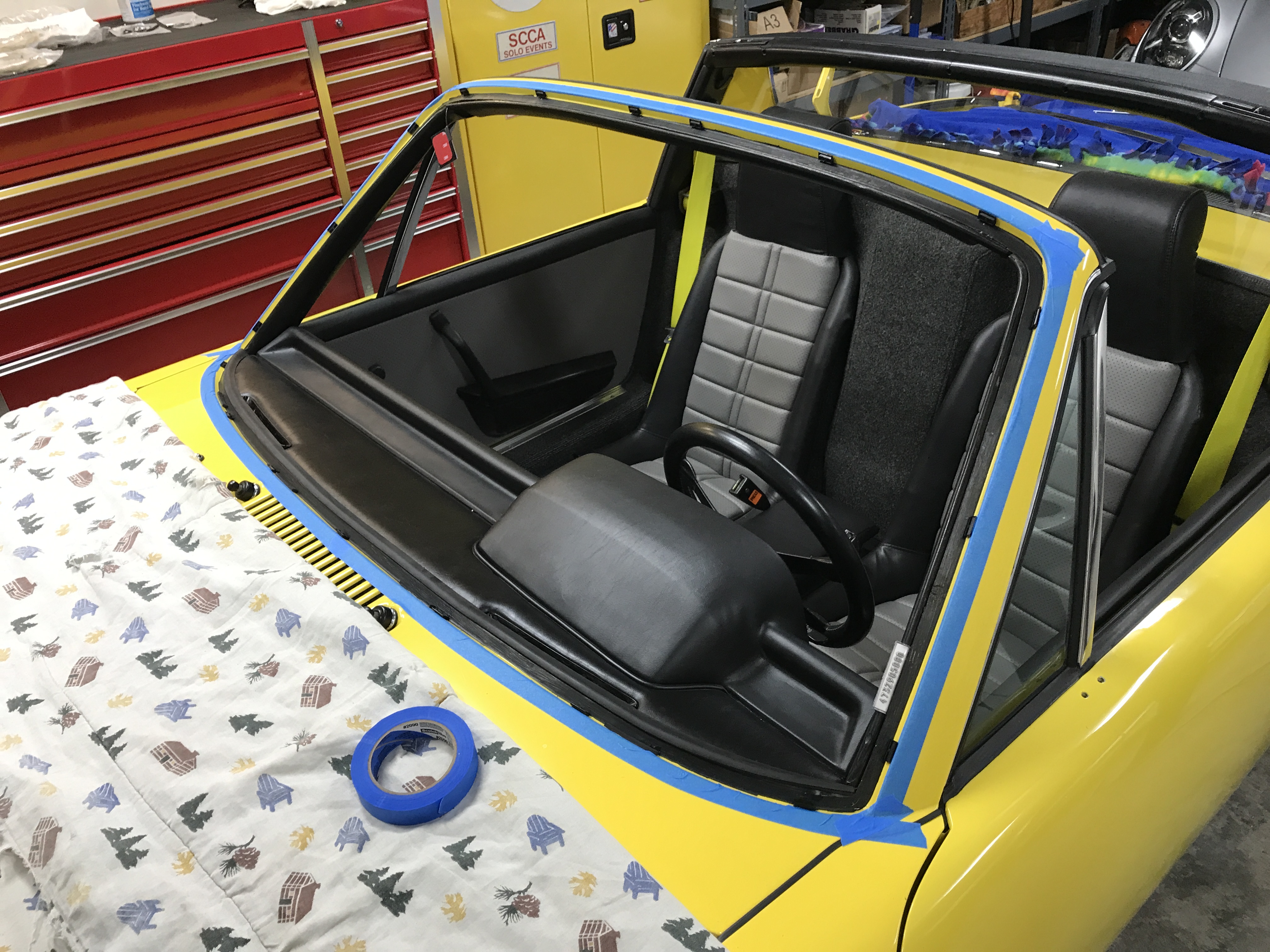

I then taped up around the recess to protect the paint from the edges of the glass, and from accidental touches of the butyl rope.
Now I am ready for 914 friends.

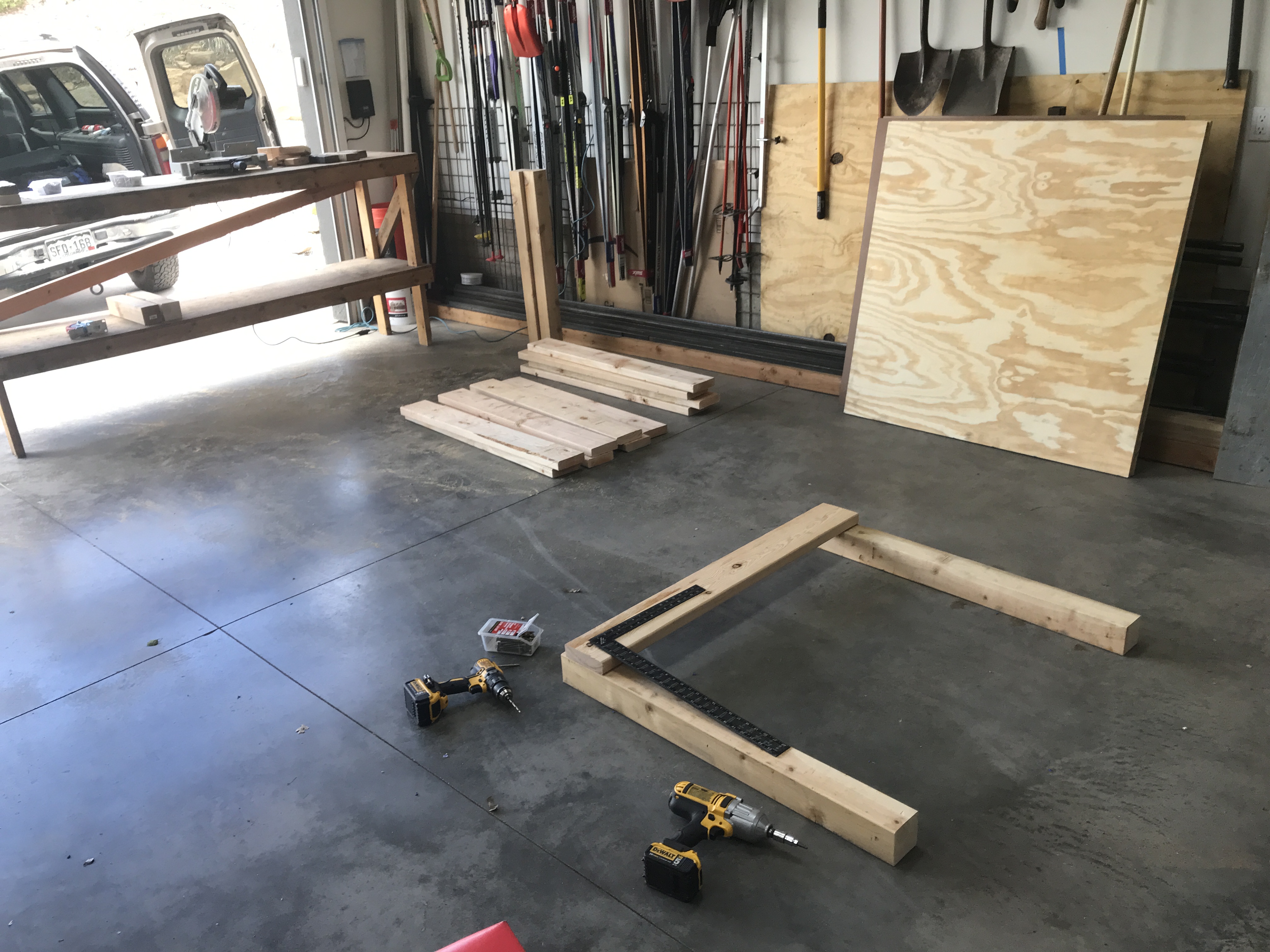

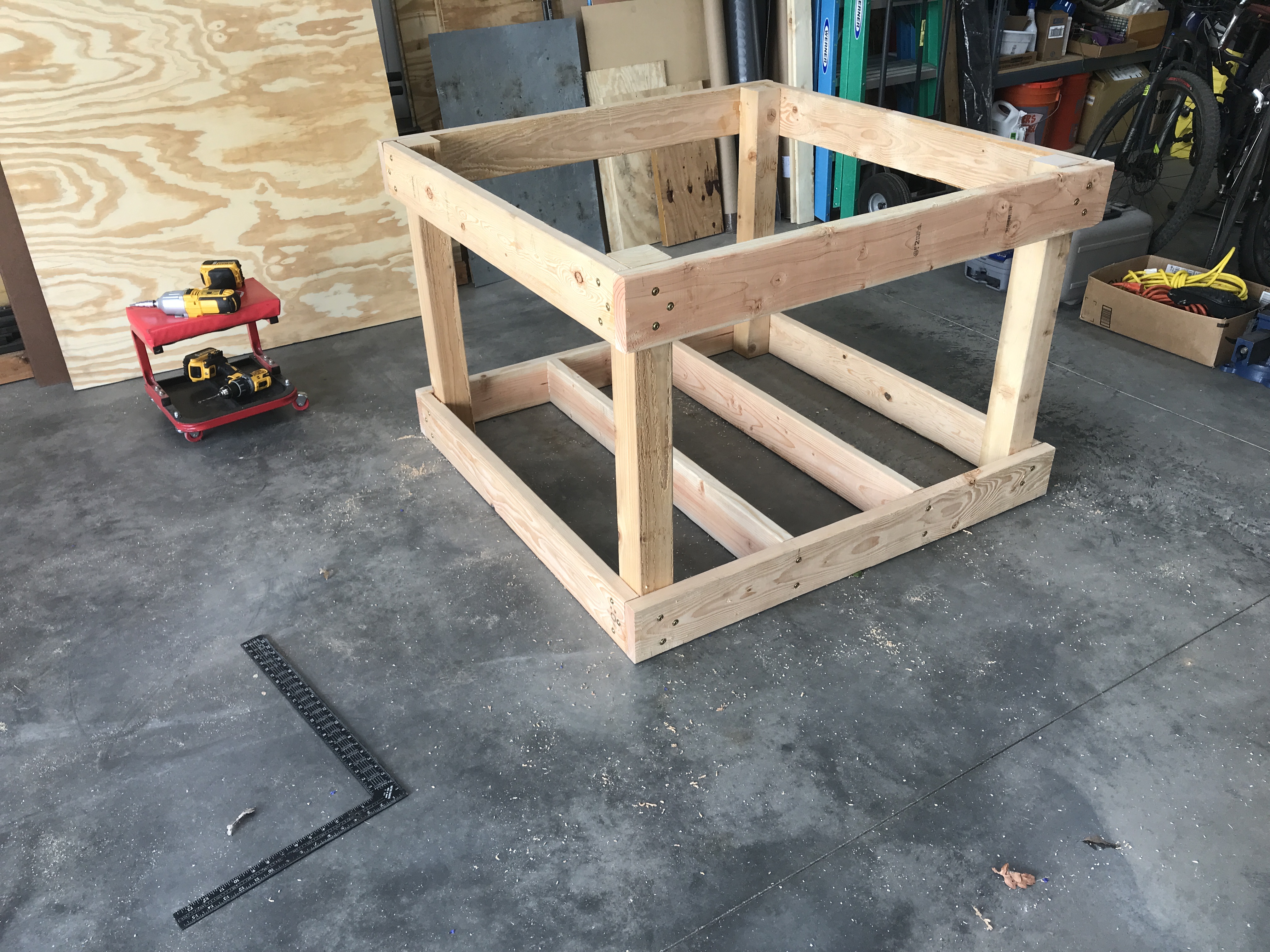

I took a break from 914 work today, to build a new shop table.
bkrantz
post Jun 6 2022, 07:18 PM
Post #5448
Posts: 8,343
Joined: 3-August 19
From: SW Colorado
Member No.: 23,343
Not fancy and probably overbuilt, but I figure heavy is a good thing.

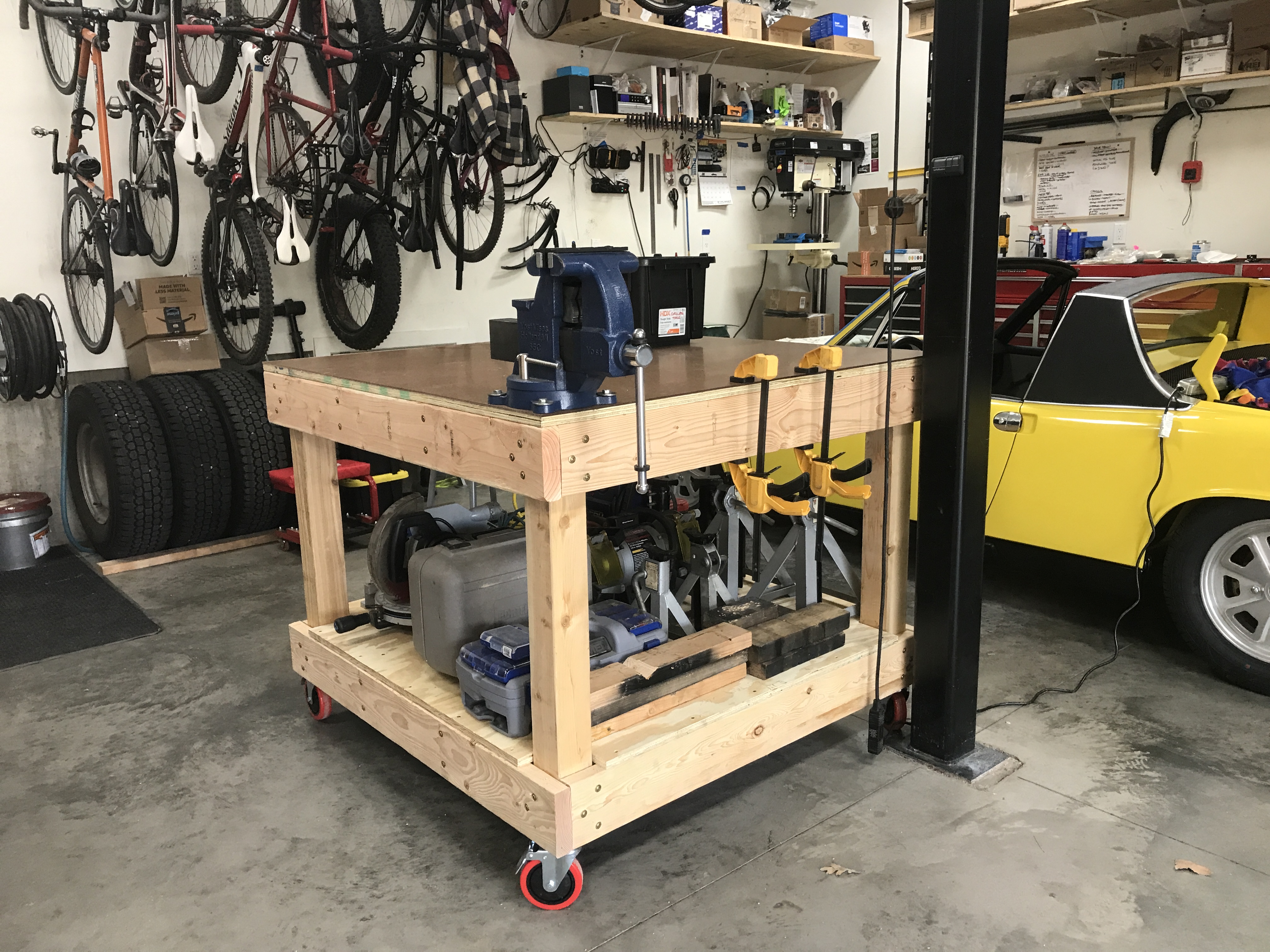

I topped it with a layer of replaceable masonite. Here it is as part of my new garage layout. Still more to do.
bkrantz
post Jun 6 2022, 07:24 PM
Post #5450
Posts: 8,343
Joined: 3-August 19
From: SW Colorado
Member No.: 23,343
And for now I moved out my old 2' x 8' workbench. I built this 30 years ago in the garage of the first house I owned, and dragged it from Texas to Alaska to Texas and then Colorado.

QUOTE(bkrantz @ Jun 6 2022, 06:21 PM) *
Thats an awesome table Bob, with the price of lumber these days that is easily a $10,000 investment.

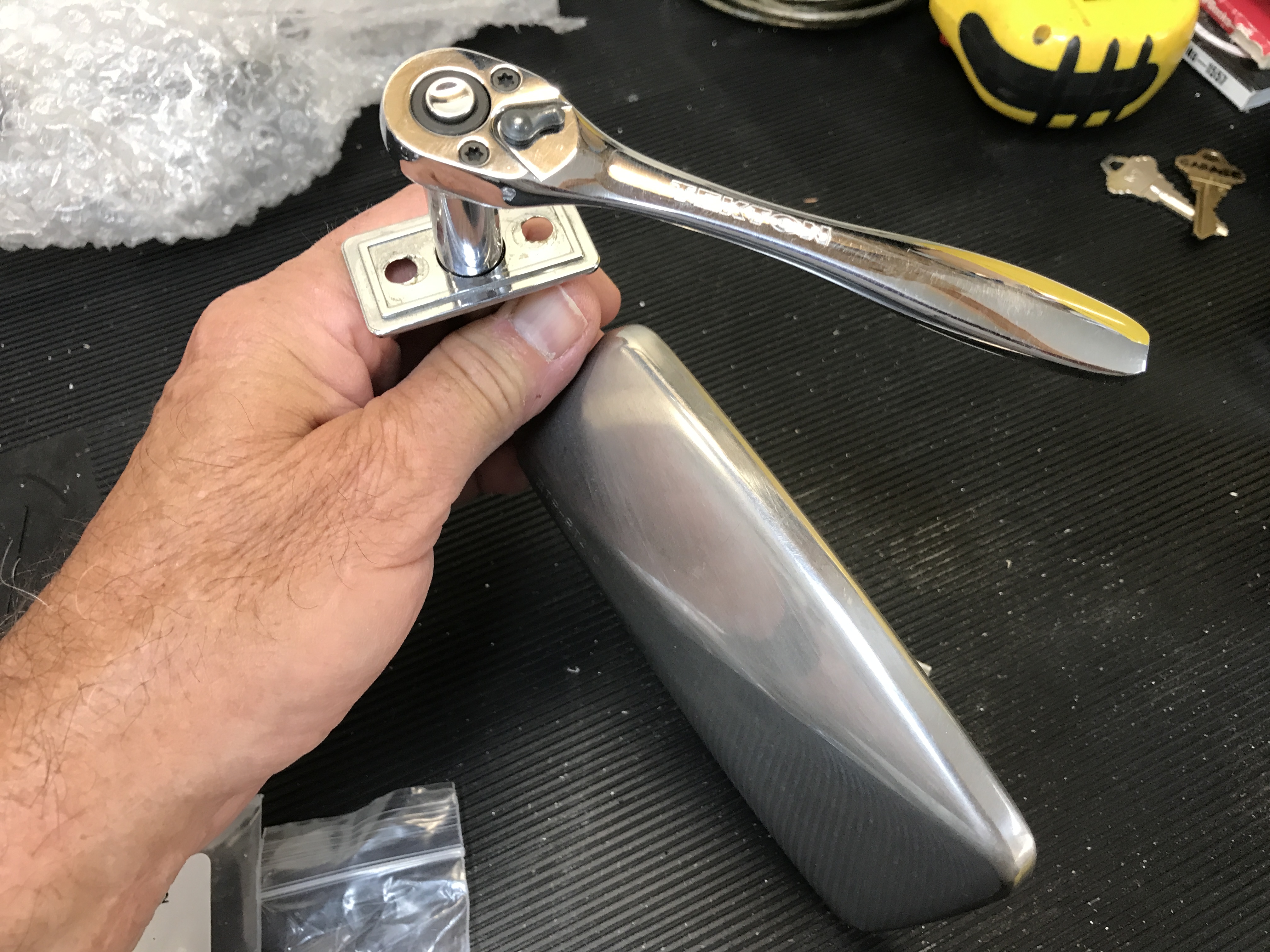

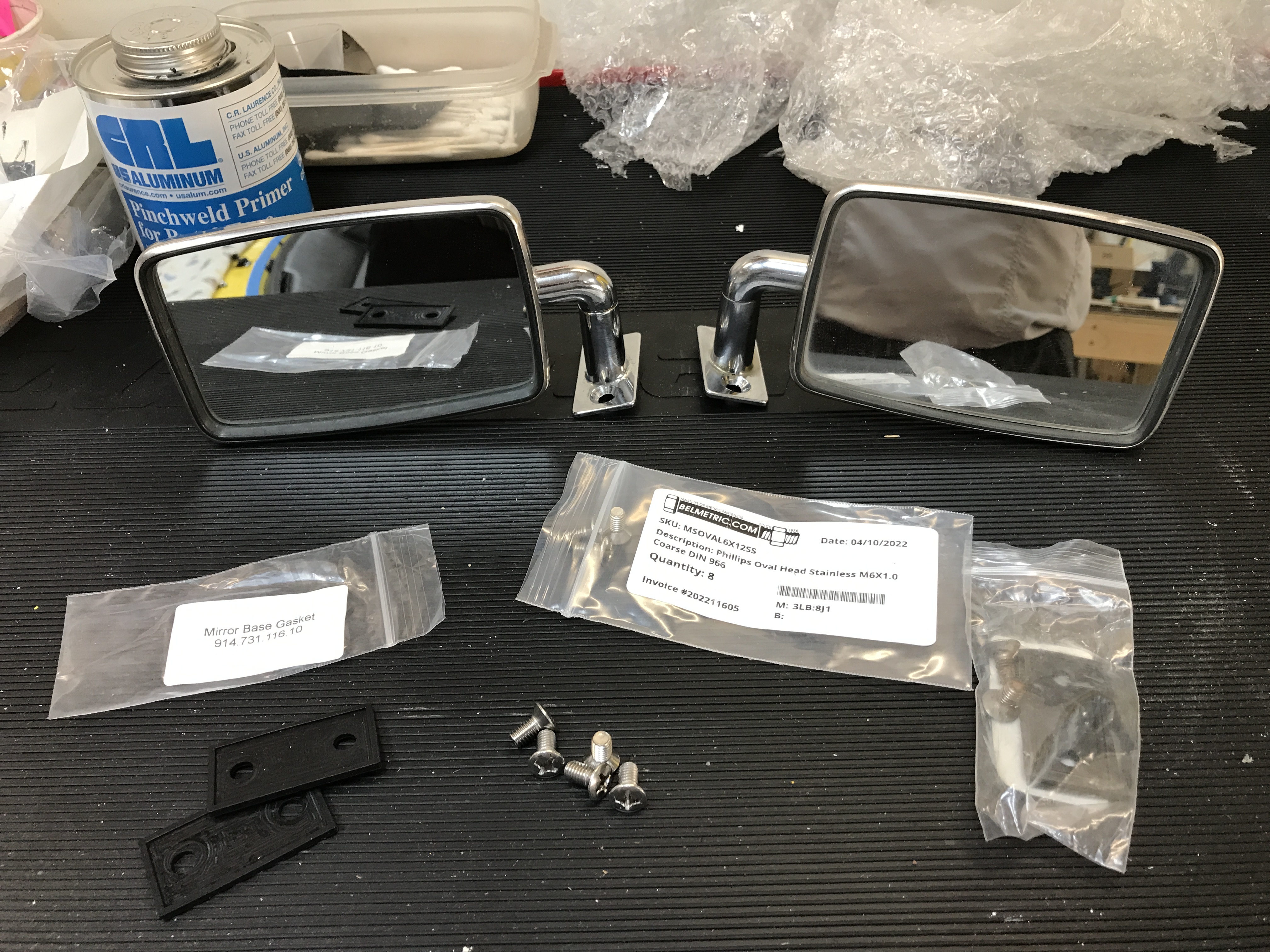

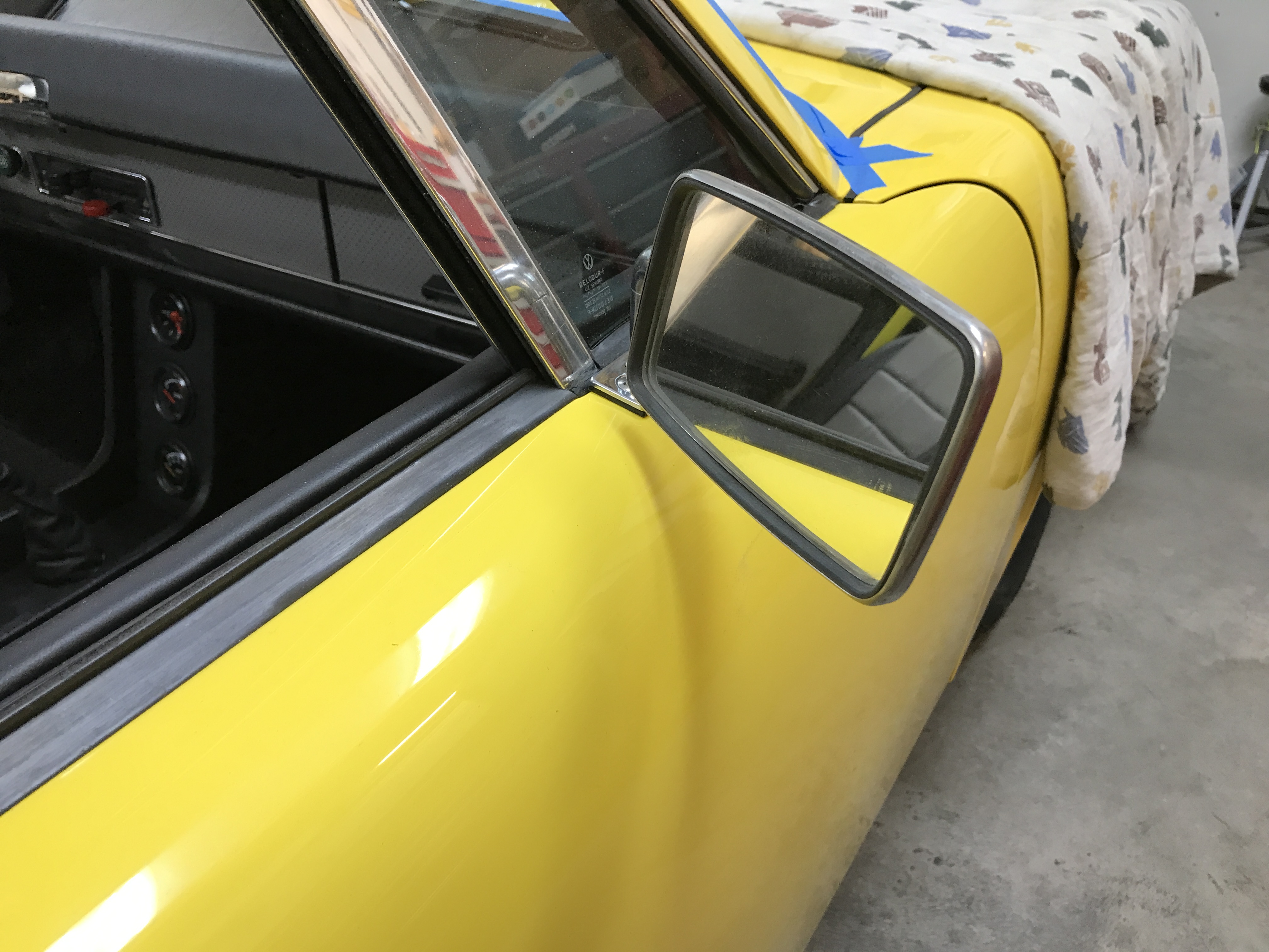

Mirror day. I found two original late mirrors, and gathered all new hardware, including stainless screws.
bkrantz
post Jun 7 2022, 08:23 PM
Post #5453
Posts: 8,343
Joined: 3-August 19
From: SW Colorado
Member No.: 23,343
One needed some tightening of the internal tension bolt. That requires a very thin wall 10mm socket.
bkrantz
post Jun 7 2022, 08:26 PM
Post #5454
Posts: 8,343
Joined: 3-August 19
From: SW Colorado
Member No.: 23,343
Mirrors installed, and aimed.
bkrantz
post Jun 7 2022, 08:27 PM
Post #5455
Posts: 8,343
Joined: 3-August 19
From: SW Colorado
Member No.: 23,343
One more off the list.

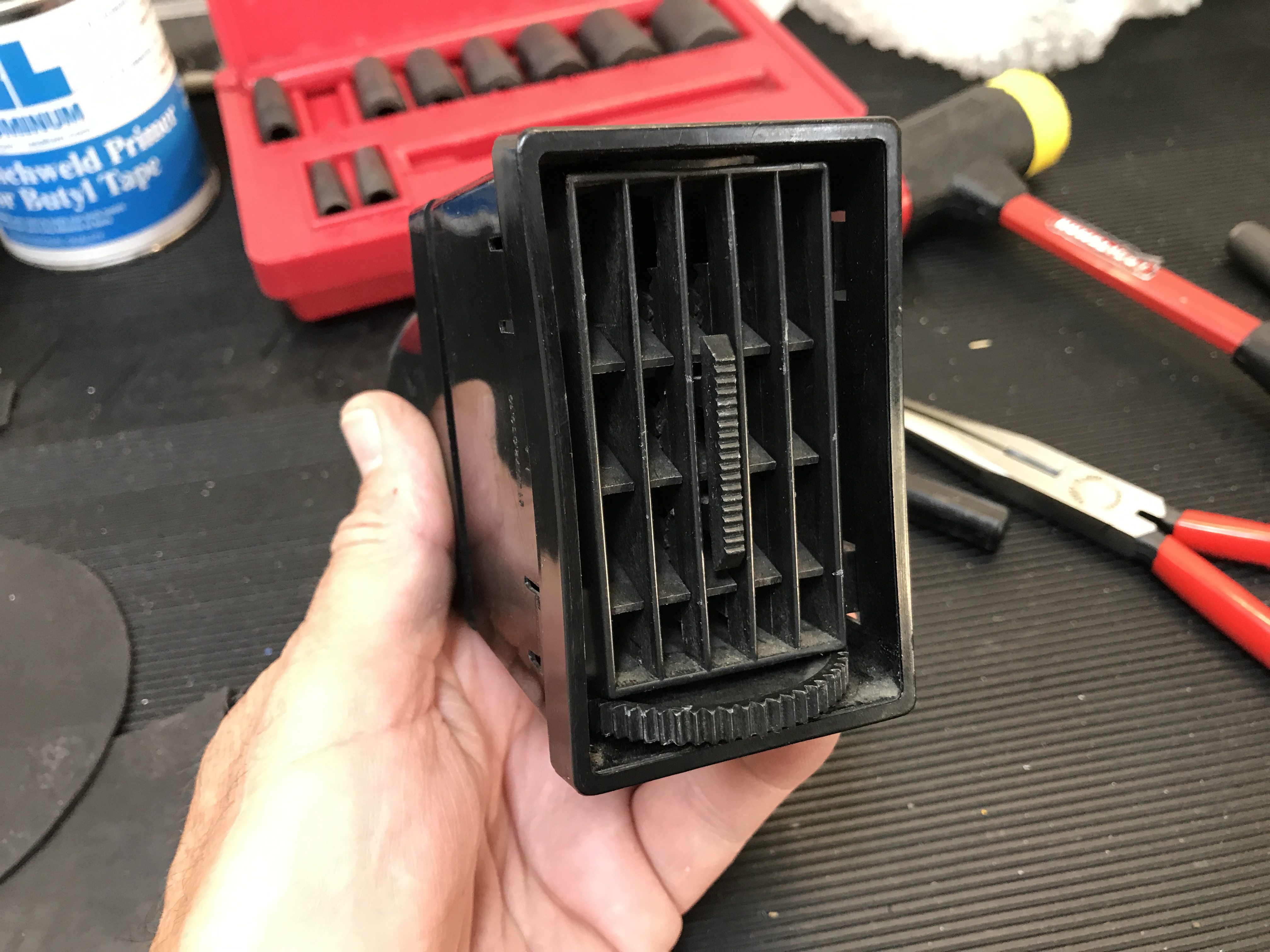

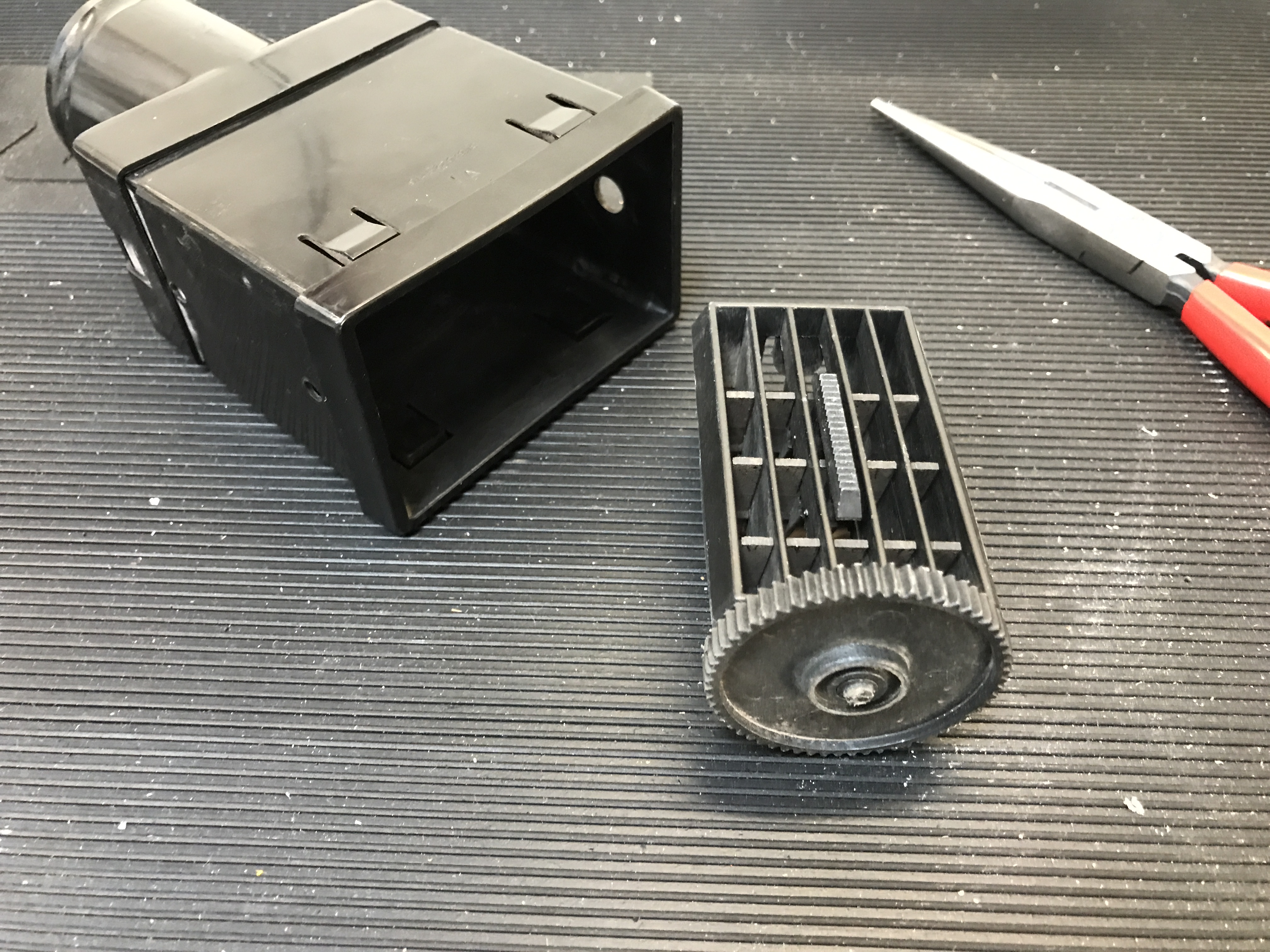

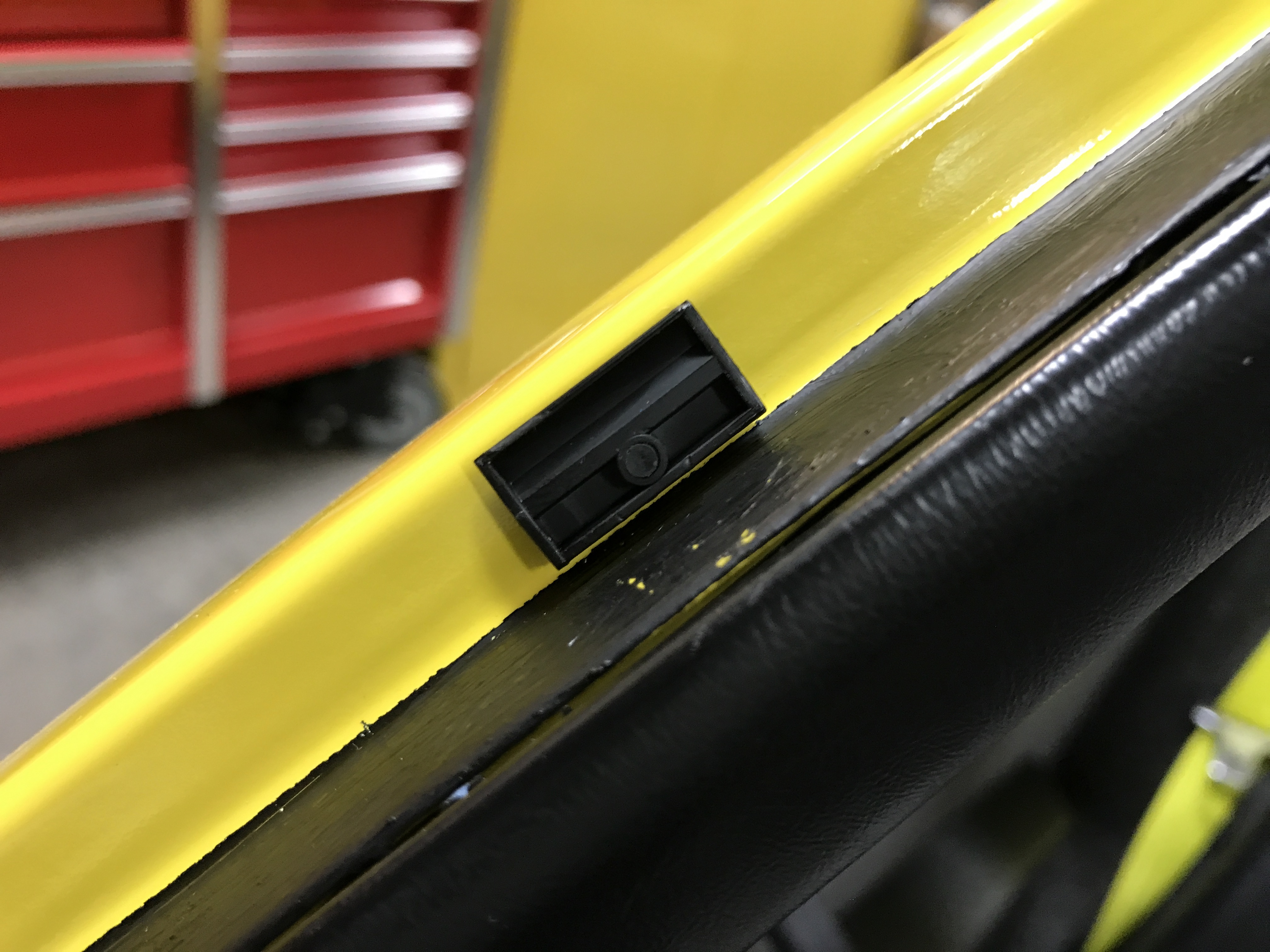

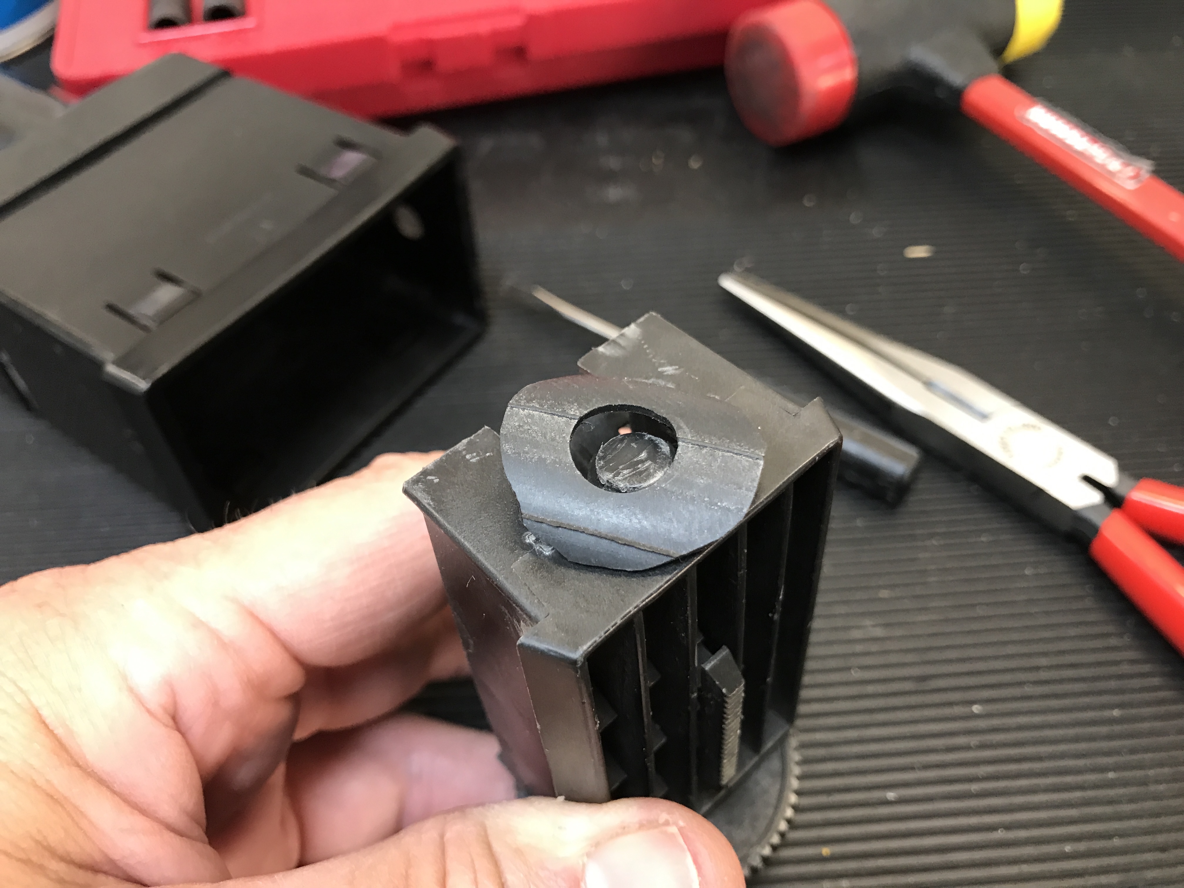

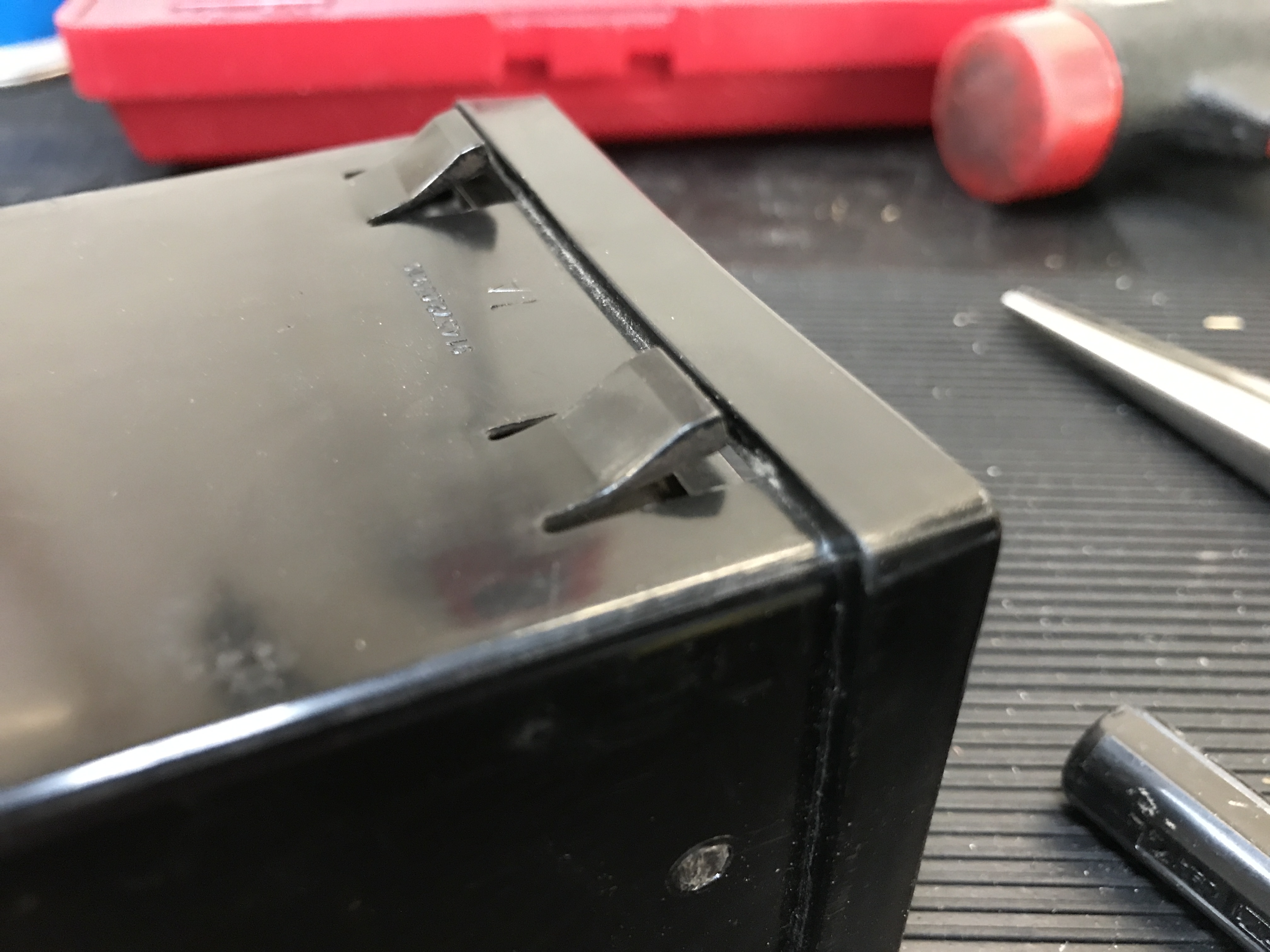

While I was in the car I remembered that the left side dash vent had two problems: it tends fall out of the dash, and the pivoting vertical vanes flop around.
bkrantz
post Jun 7 2022, 08:31 PM
Post #5457
Posts: 8,343
Joined: 3-August 19
From: SW Colorado

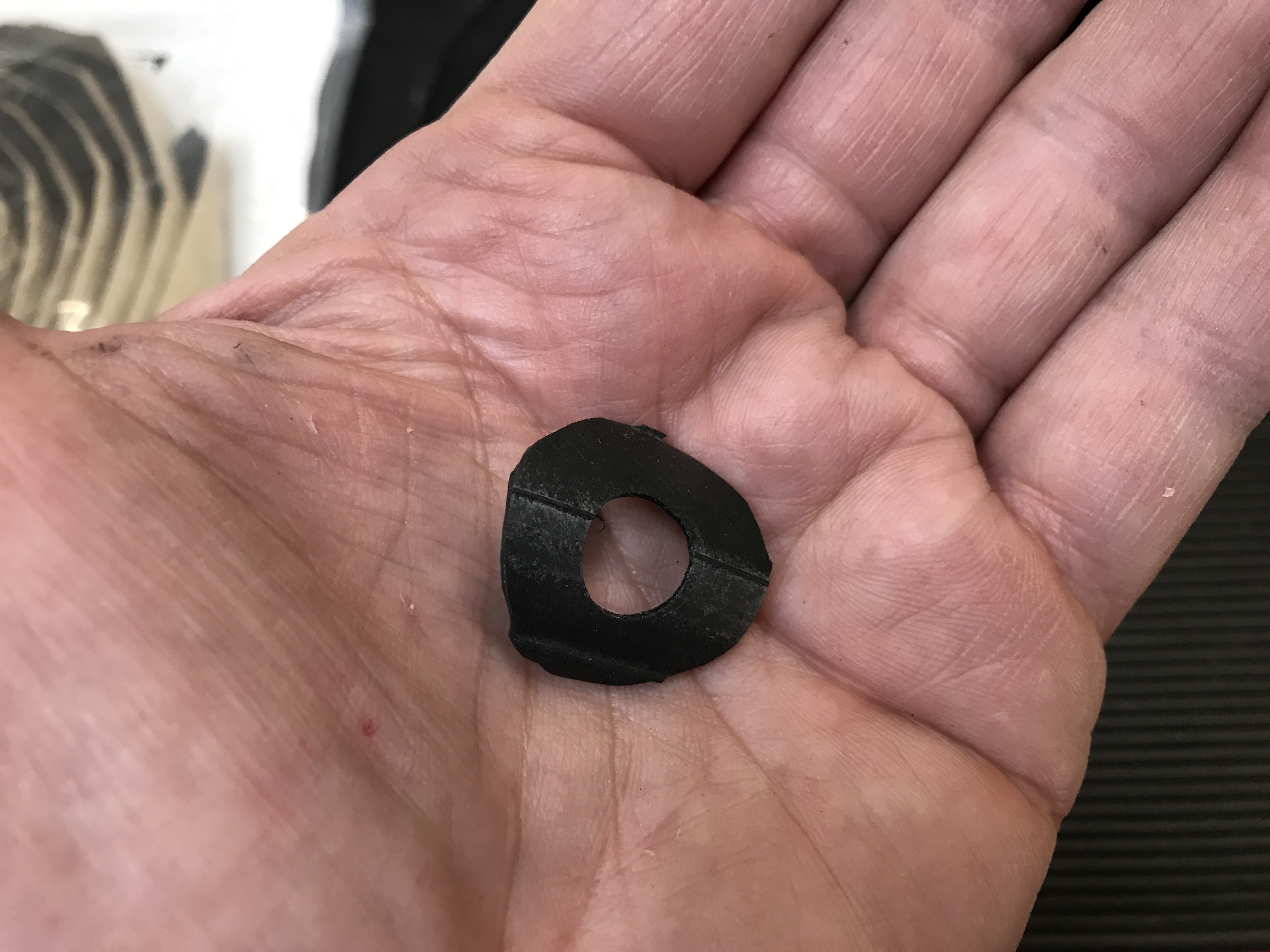

Member No.: 23,343
To provide some drag on the vane body, I cut a thin rubber washer from a bike inner tube.
bkrantz
post Jun 7 2022, 08:32 PM
Post #5458
Posts: 8,343
Joined: 3-August 19
From: SW Colorado
Member No.: 23,343
This can't be too thick, since the pivot peg on top is short.
bkrantz
post Jun 7 2022, 08:33 PM
Post #5459
Posts: 8,343
Joined: 3-August 19
From: SW Colorado
Member No.: 23,343
That tightened up the pivot nicely, with a small amount of drag.
bkrantz
post Jun 7 2022, 08:34 PM
Post #5460
Posts: 8,343
Joined: 3-August 19
From: SW Colorado
Member No.: 23,343
To make the vent lock into the dash, I pried all the retaining clips outward from the body--while holding my breath.
