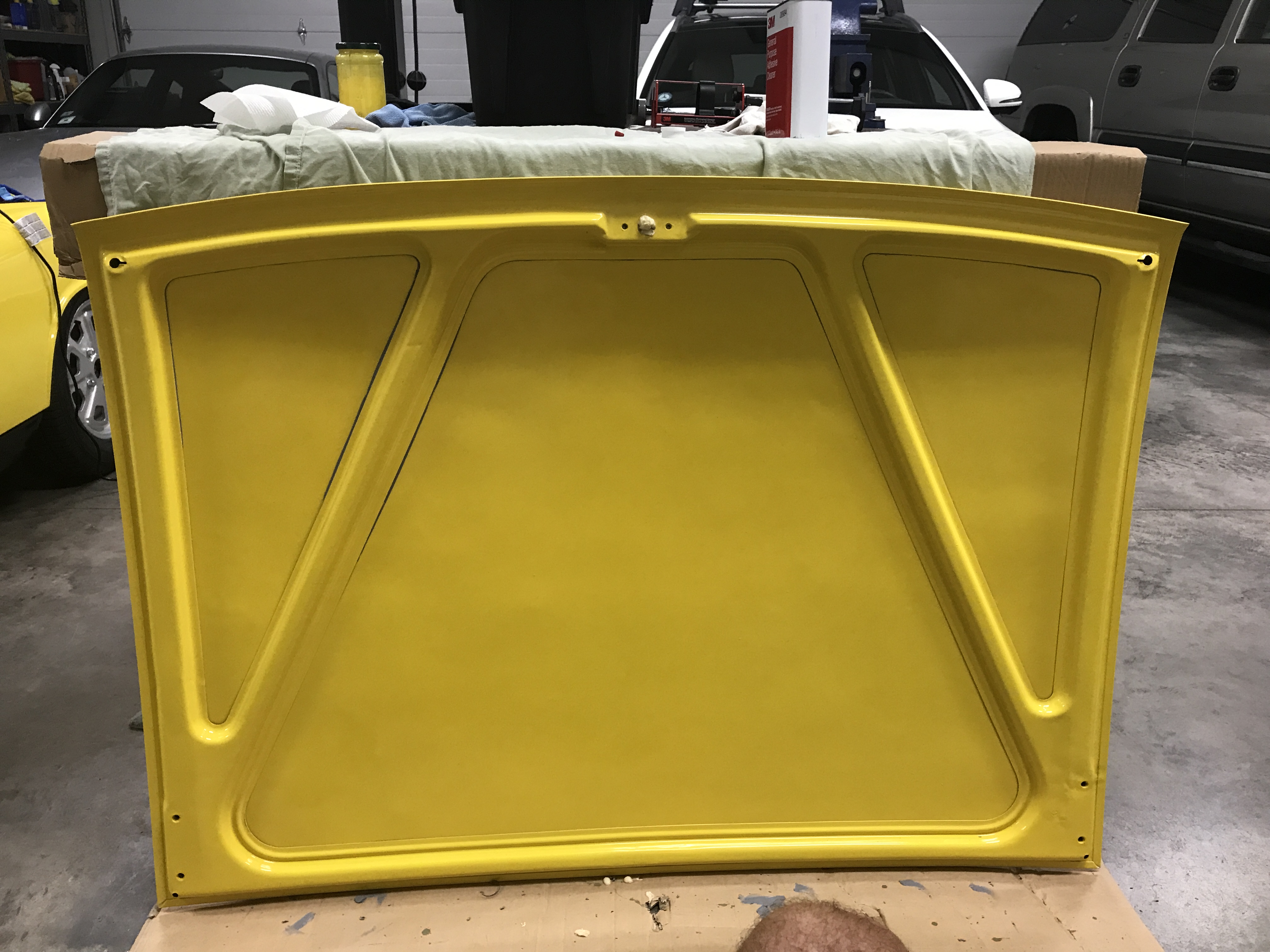

I decided to fill the trunk lid frame cavity with the 3M foam, at least around the center-rear near the latch.
But first, I found some leftover Eastwood cavity sealer.
Have you been able to clean and reuse those nozzle tubes? If so, what process to clean them for future use?
Thanks
I have not tried. Eastwood suggests attaching the nozzle to one of their cans of spray solvent.
bkrantz
post Jun 10 2022, 08:29 PM
Post #5482
Posts: 8,343
Joined: 3-August 19
From: SW Colorado
Member No.: 23,343
I cleaned the seam sealer as much as possible, and will probably leave this as is for now.

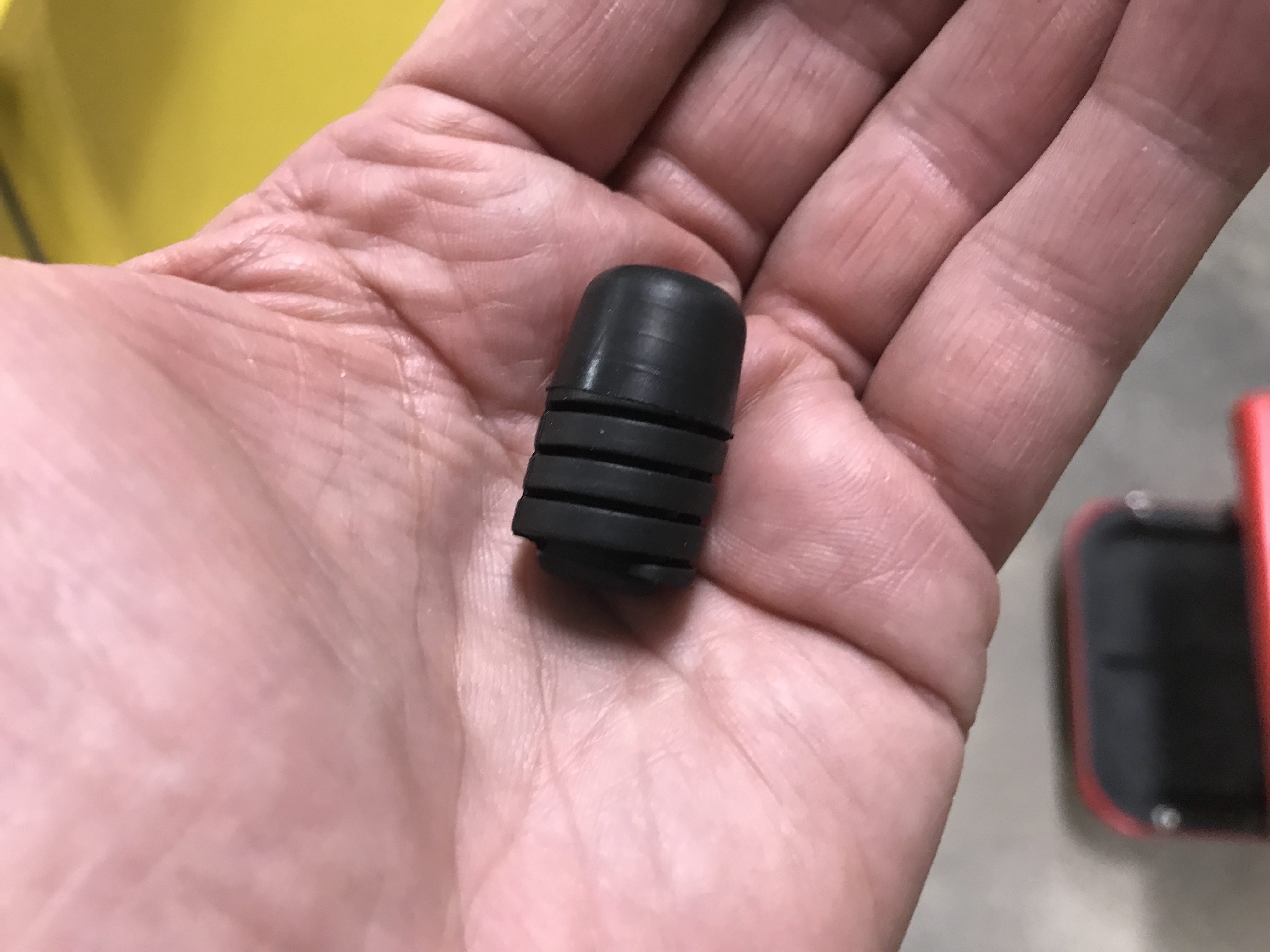

New rubber stand-offs.

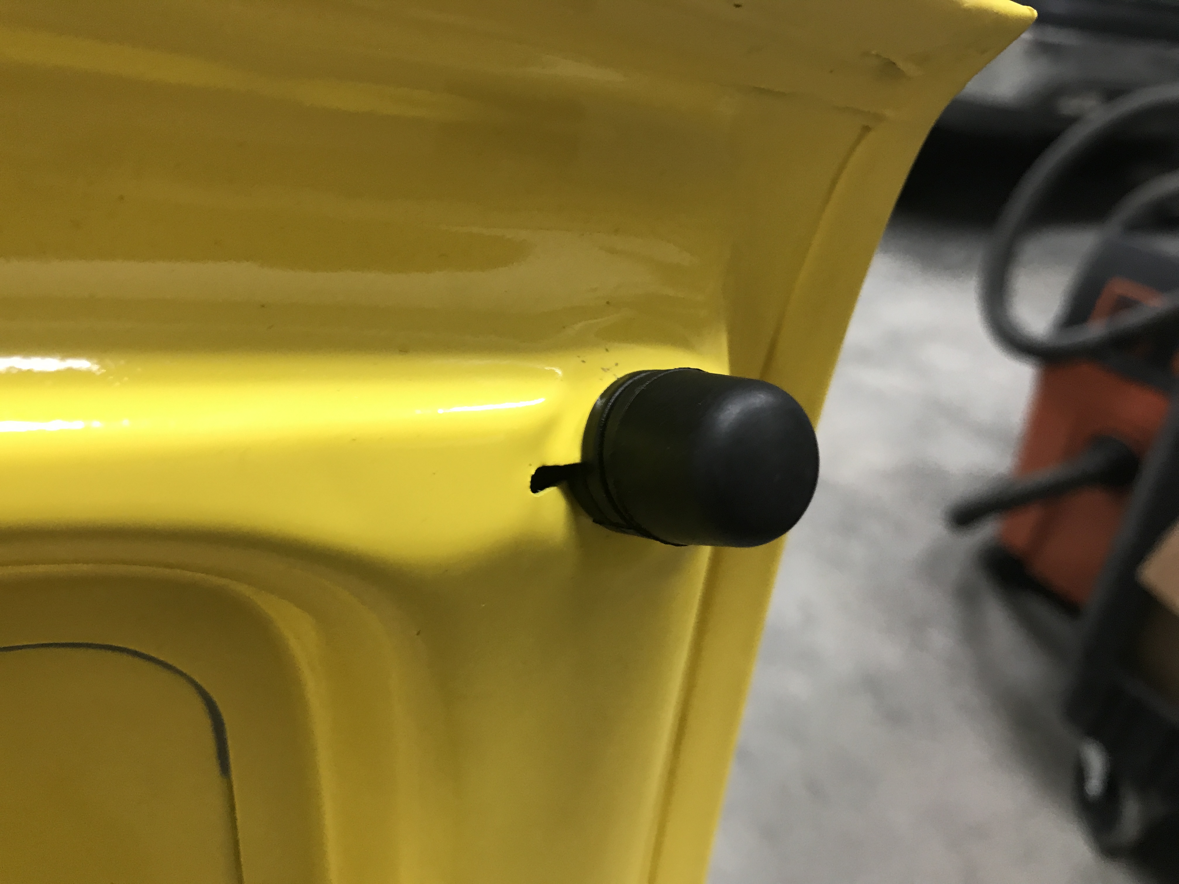

One in each rear corner.

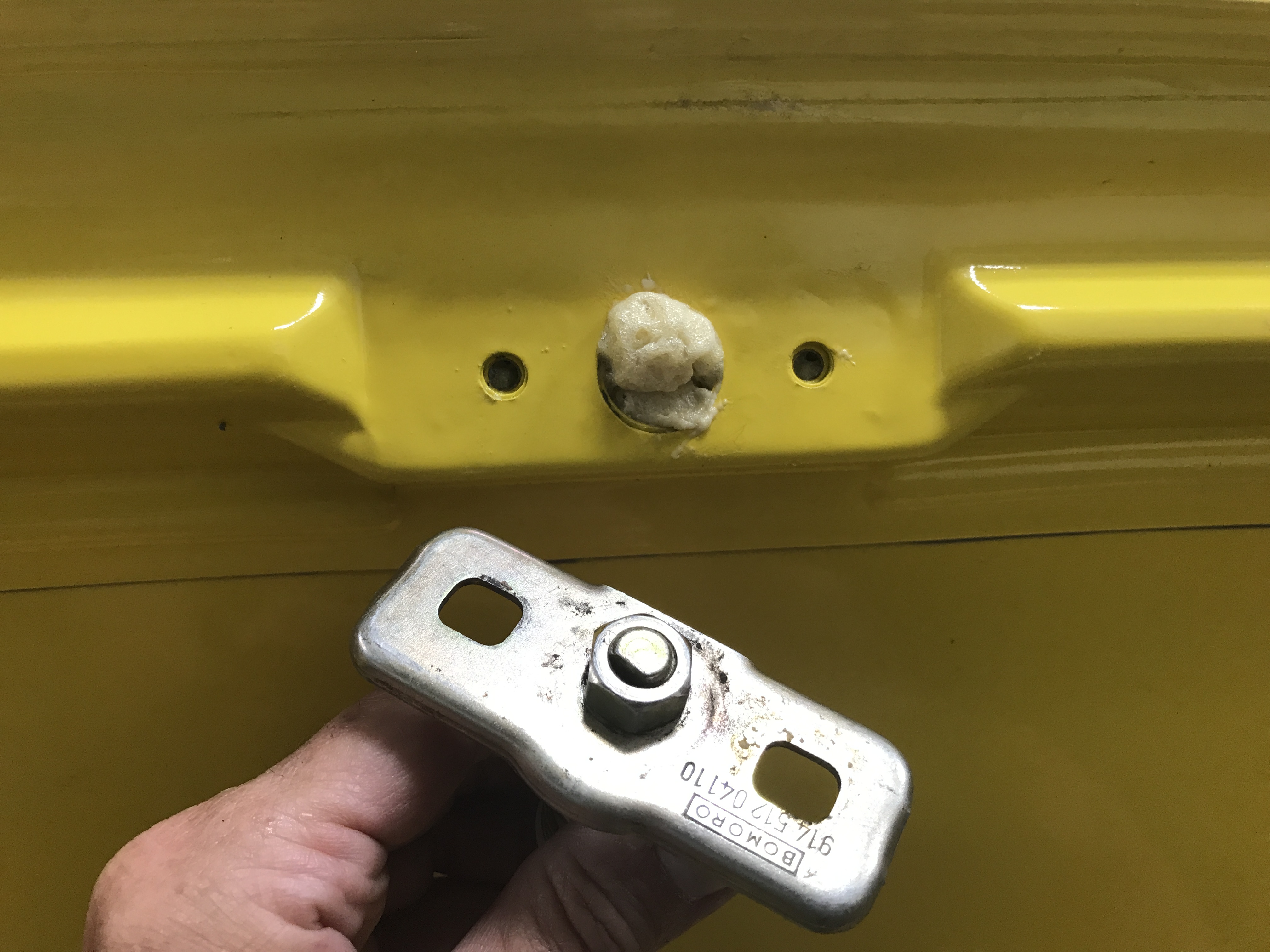

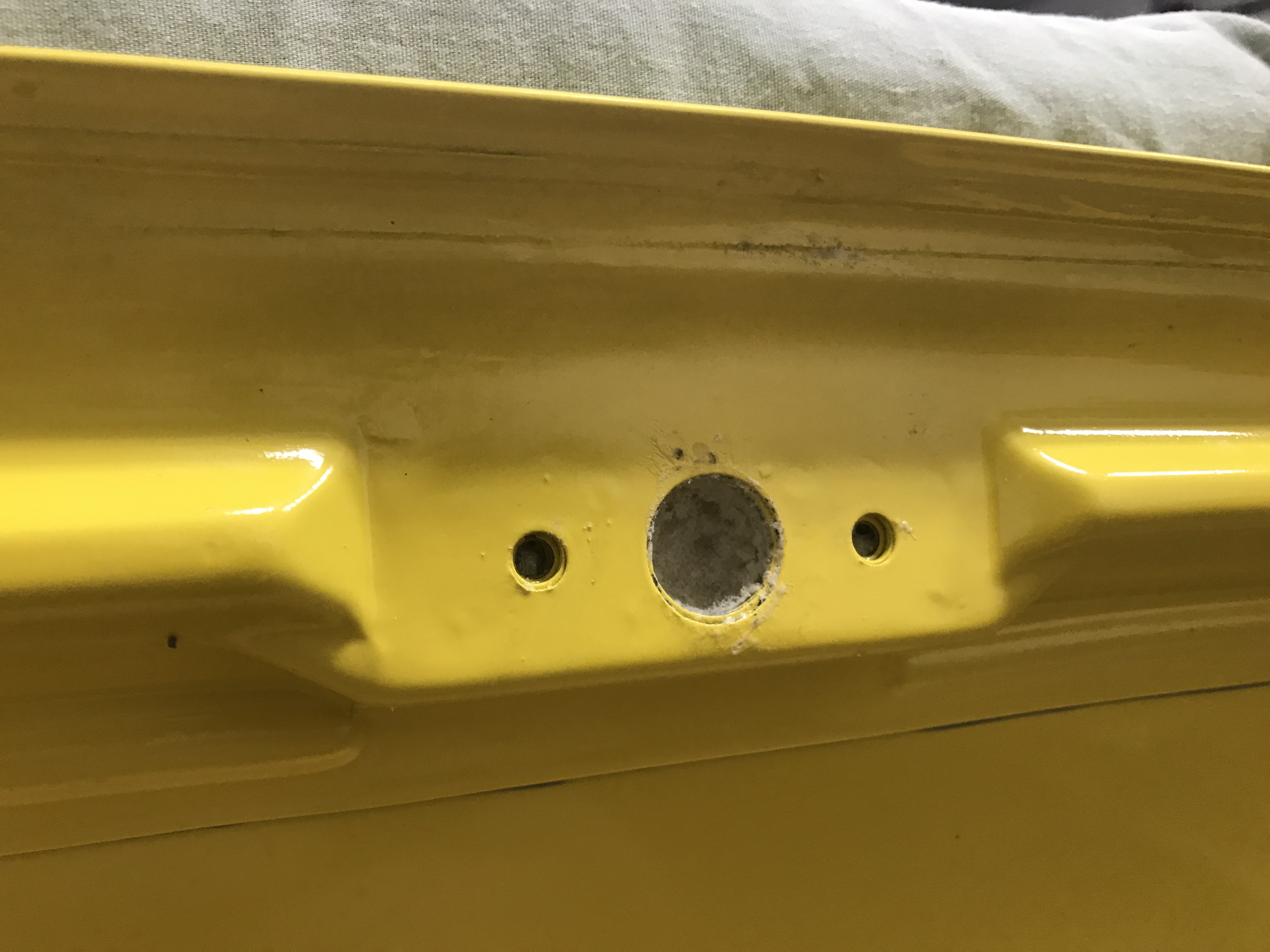

Then I made room for the adjuster bolt on top of the latch pin.
bkrantz
post Jun 10 2022, 08:32 PM
Post #5486
Posts: 8,343
Joined: 3-August 19
From: SW Colorado
Member No.: 23,343
I cut a round recess. But I will wait to install the latch until after the trunk lid is on the car.

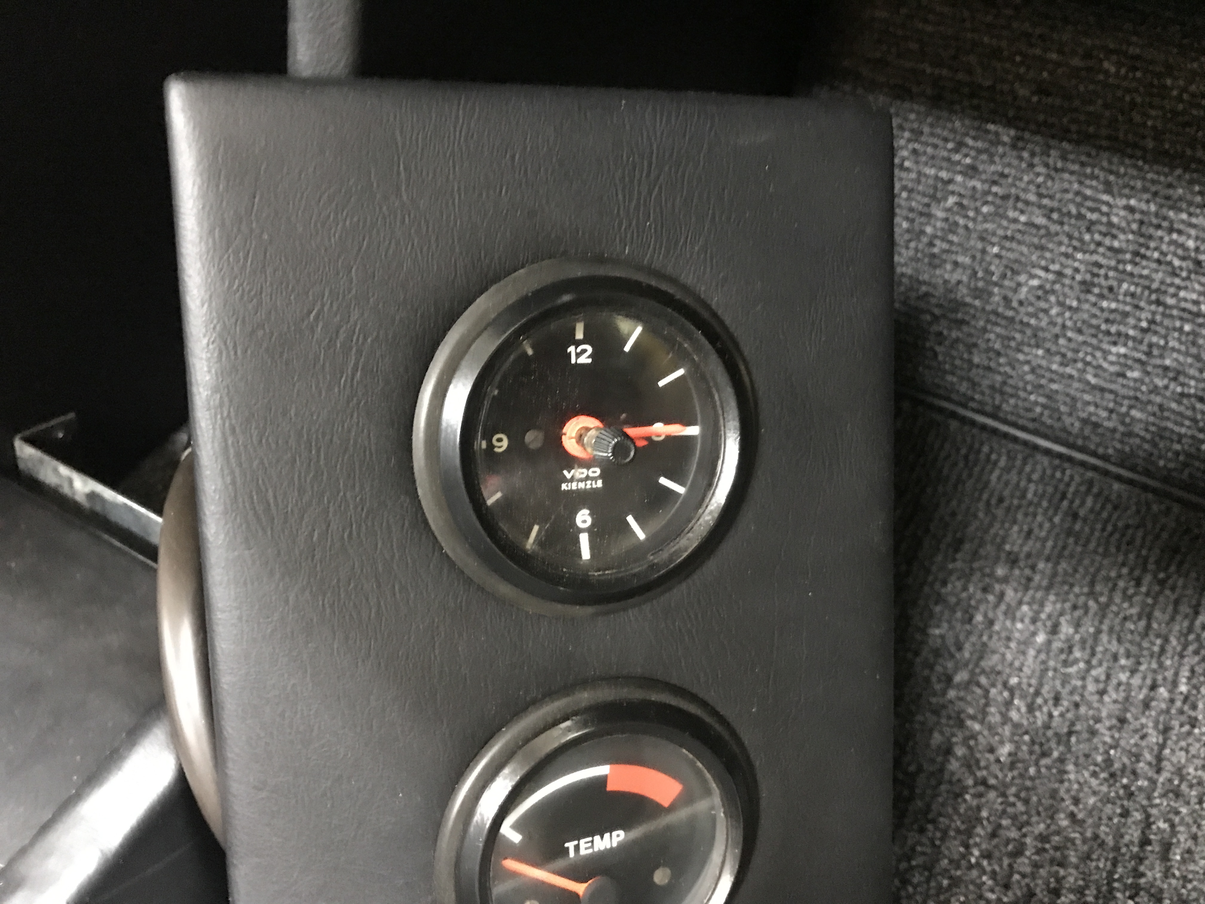

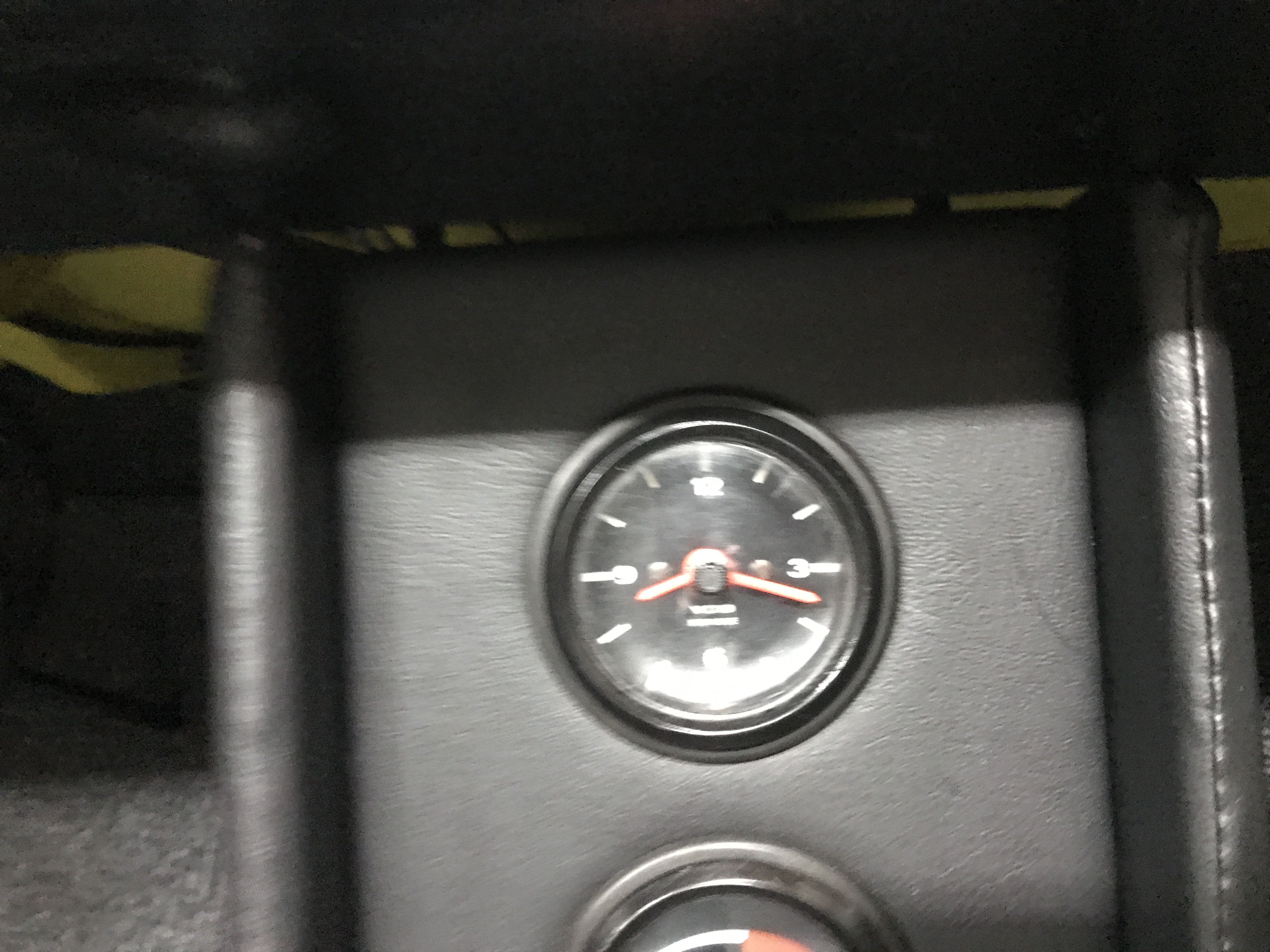

No, that's why I noted the slow running. The car has been connected to battery non-stop for at least 2 weeks (andmostly on a charger). I just reset the clock and will check it tomorrow.
After 48 hours the clock lost 4 minutes. I took this fuzzy photo at 8:22.
Anyone know if the clock running speed can be adjusted?

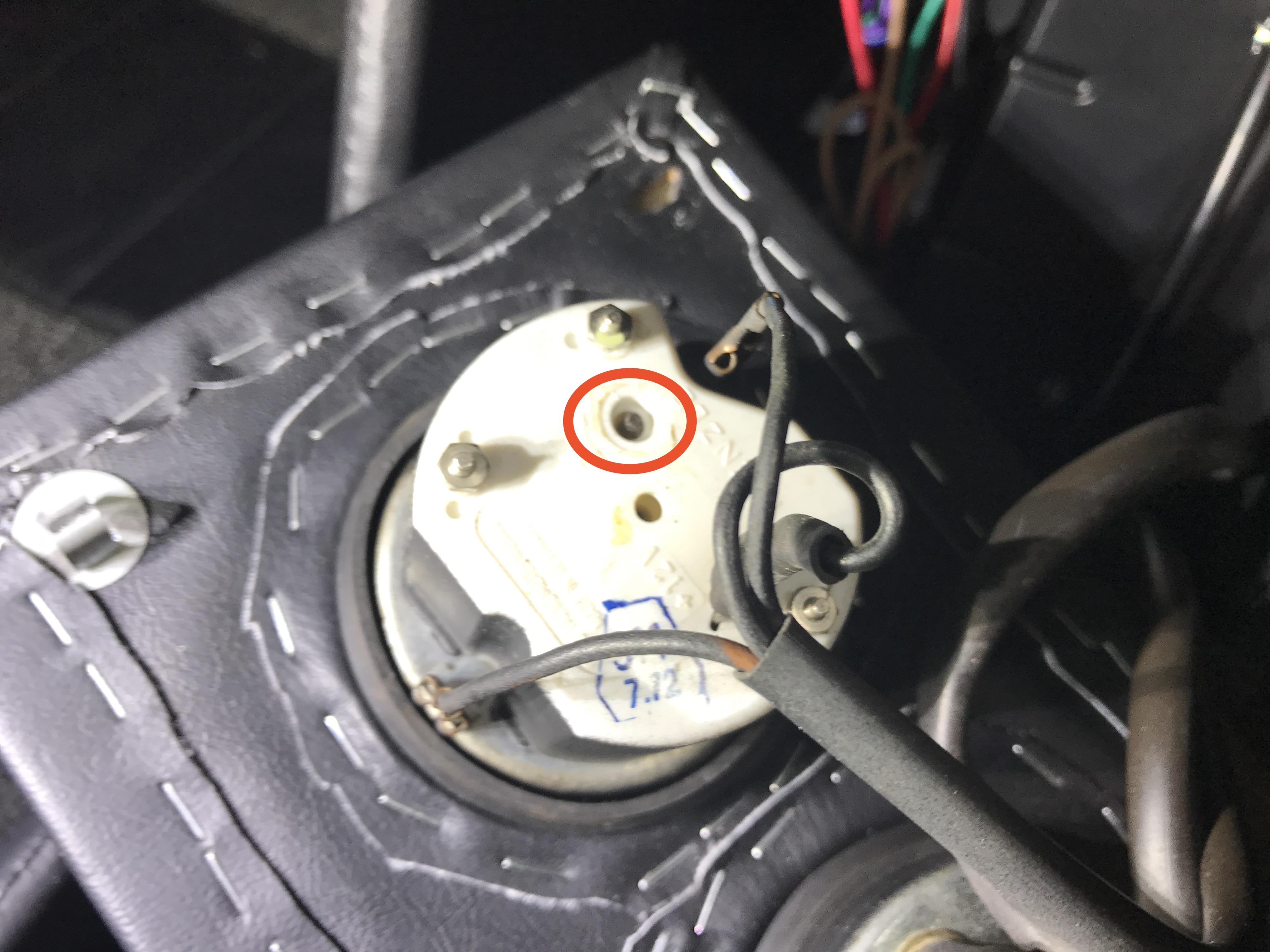

Yes, there is a small speed adjustment screw on the back. IIRC, counter clockwise to speed it up. That said, I've spent months trying to make small adjustments to dial mine in but it still loses or gains time over a week.
The clock is a self-winding clock so it is mechanical. The only thing the power does is periodically rewind the spring. I haven't timed how long it runs between winding events, but you can clearly hear when they happen. Seems like I've had the clock run for several minutes after disconnecting from power. It's a pretty neat contraption, but doesn't have the precision of a quartz crystal.

Thanks, Brent. Yeah, the 914 clock design has always tickled me. Not manual, not really electric. Do you think it was designed on a bet?

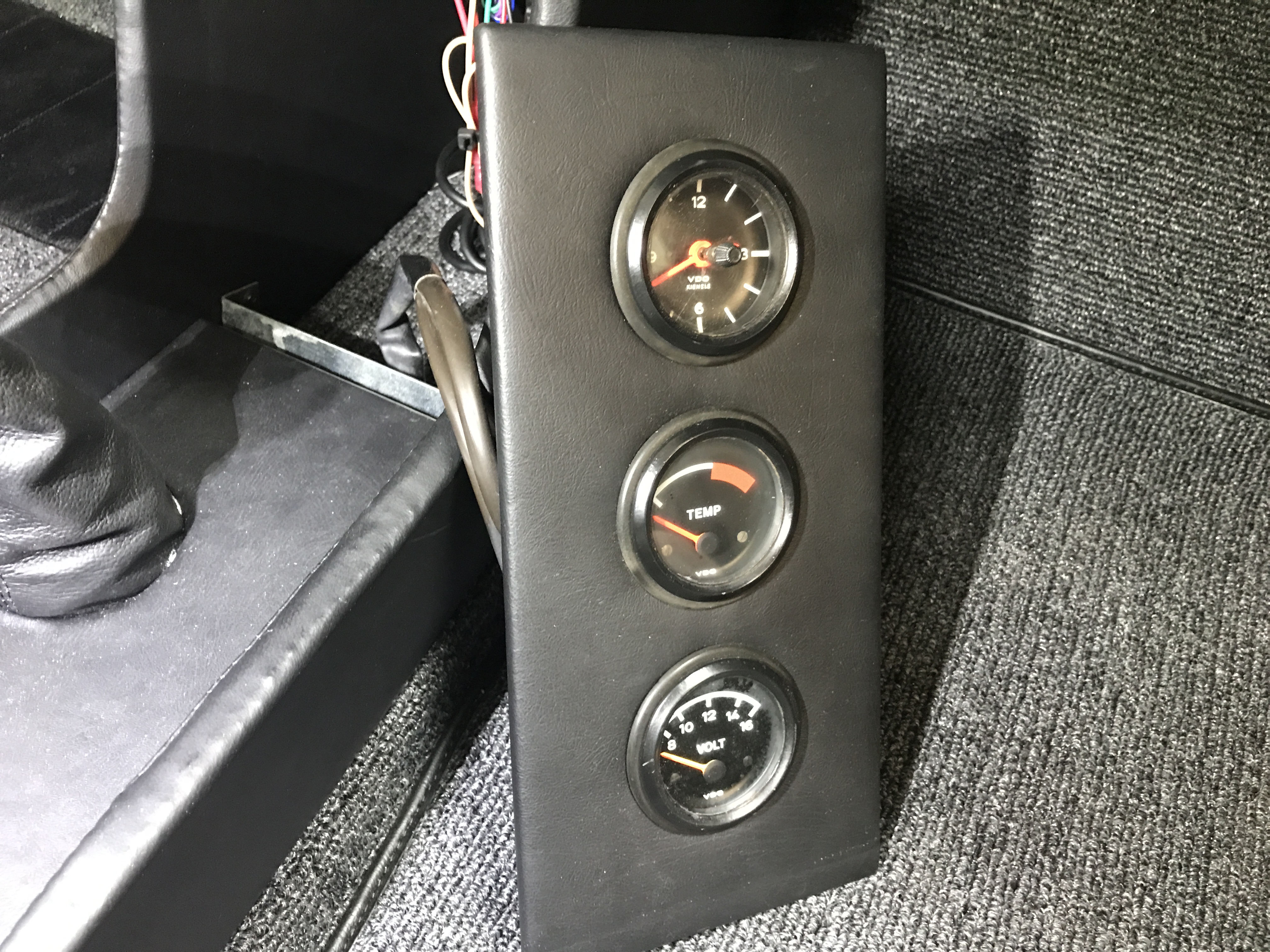

Anyway, I will attempt to adjust the running speed. On the back of the clock I found a very thin stud with a slotted end, and I turned this about 20° counterclockwise.
bkrantz
post Jun 11 2022, 09:07 PM
Post #5491
Posts: 8,343
Joined: 3-August 19
From: SW Colorado
Member No.: 23,343
I reset the time to match my phone, and will check again tomorrow.

I did check the clock, and after about 24 hours, it seems correct.

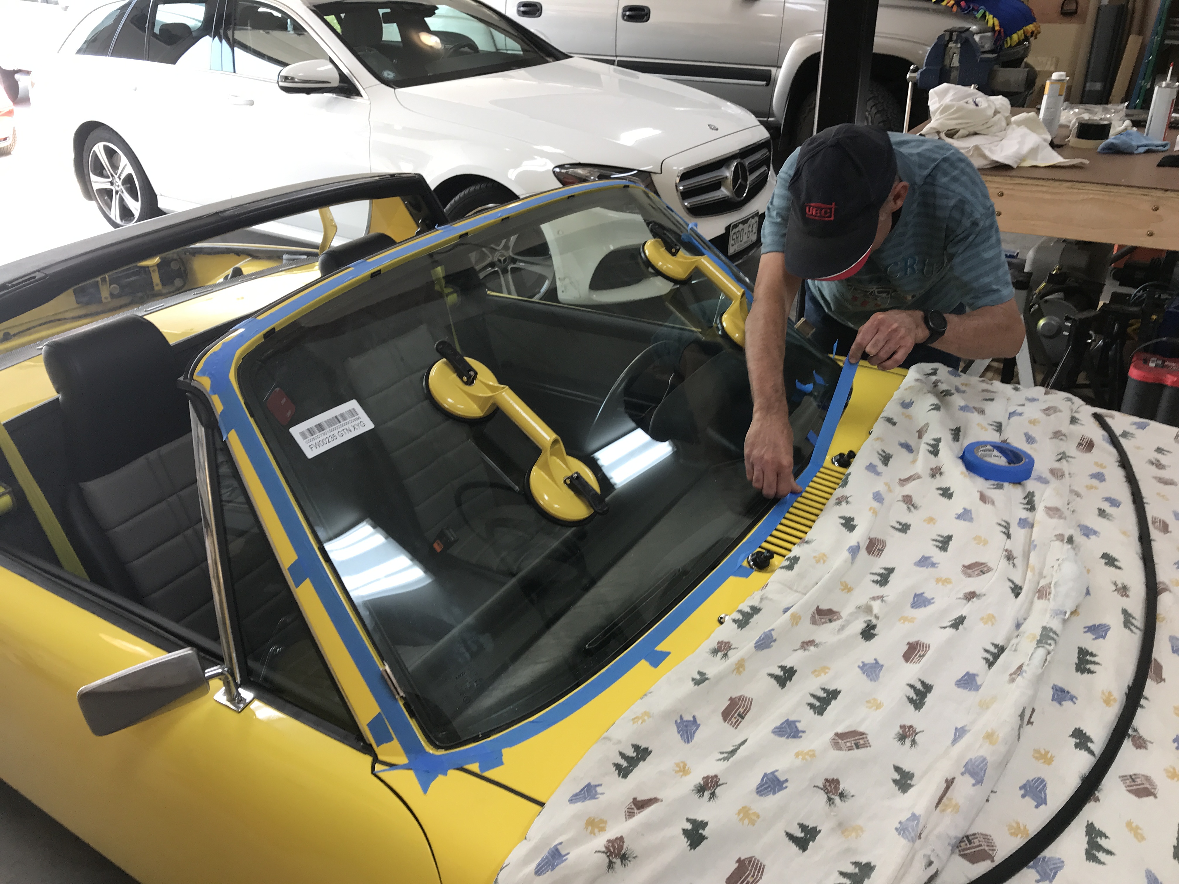

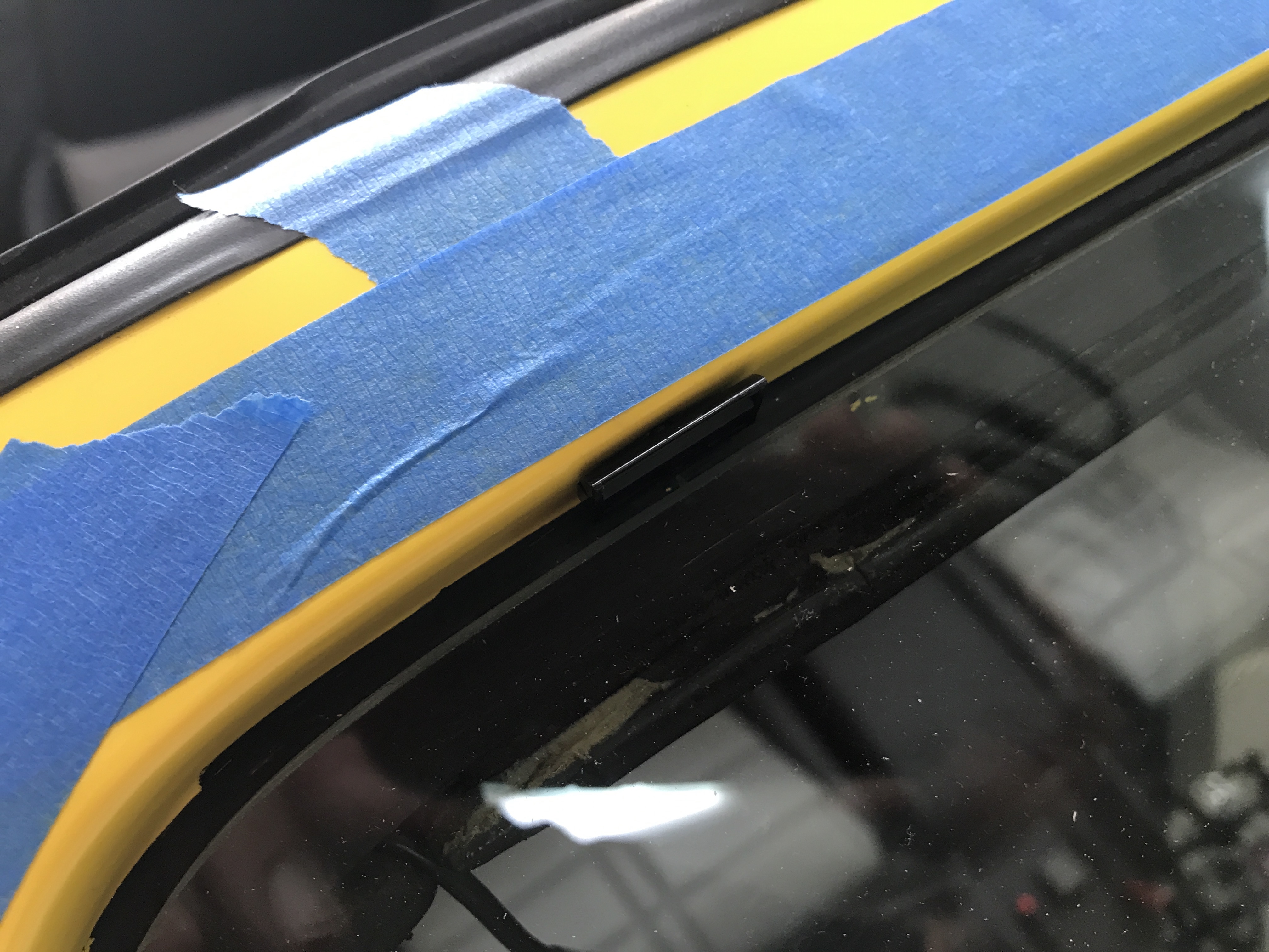

Big day today! Car friends Chuck and Mike (Kansas 914) came over to help with some jobs that need extra hands (thanks, guys!).
First up, the windshield. Here we are checking the fit and adjusting spacers. Note that I tried to find Speed Yellow suction cups, but had to settle for Sunflower.
bkrantz
post Jun 13 2022, 07:28 PM
Post #5499
Posts: 8,343
Joined: 3-August 19
From: SW Colorado
Member No.: 23,343

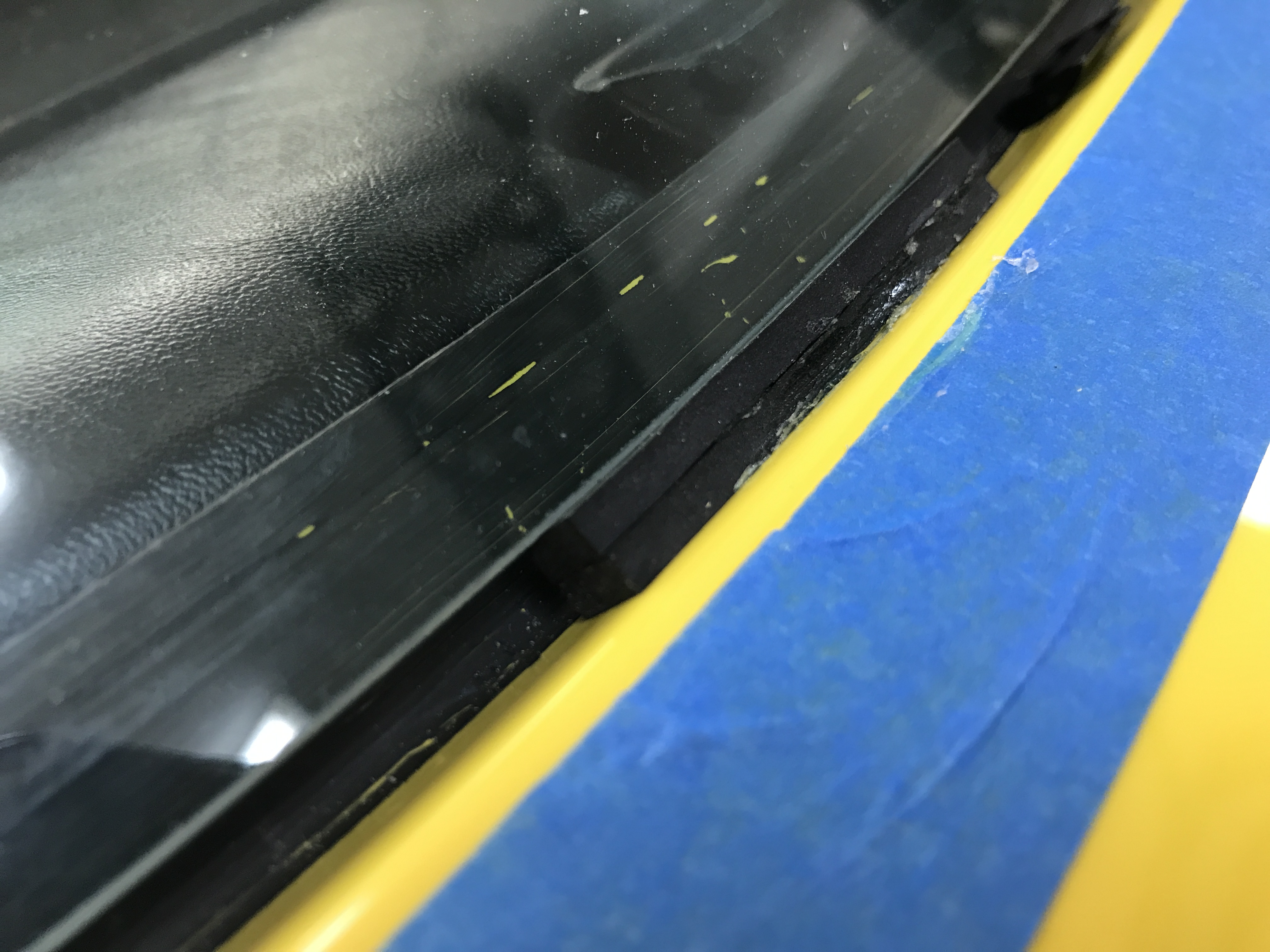

To get an even gap all around, I doubled up on the rubber spacers at the bottom.
bkrantz
post Jun 13 2022, 07:29 PM
Post #5500
Posts: 8,343
Joined: 3-August 19
From: SW Colorado
Member No.: 23,343
Gap at the top.
