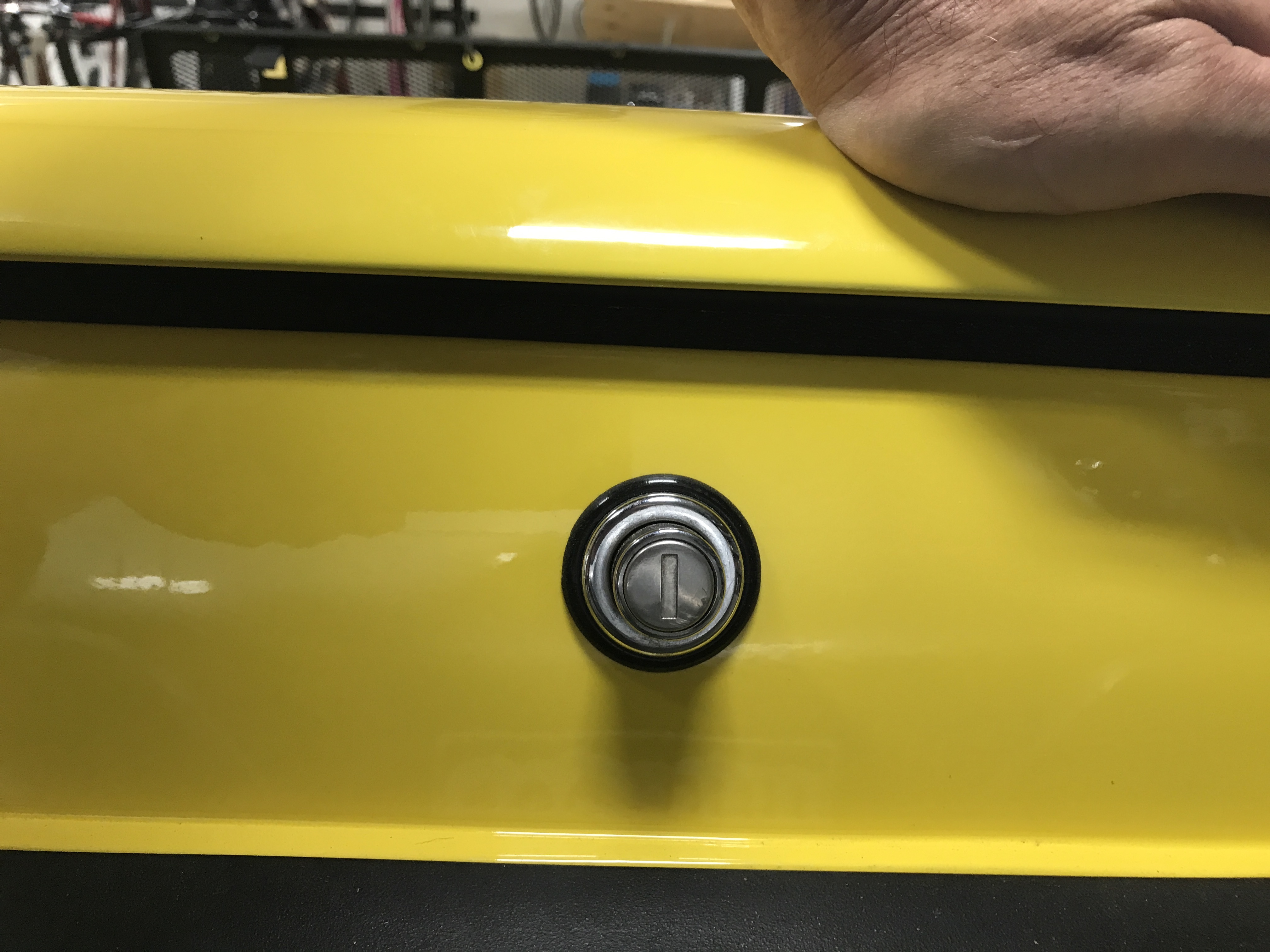

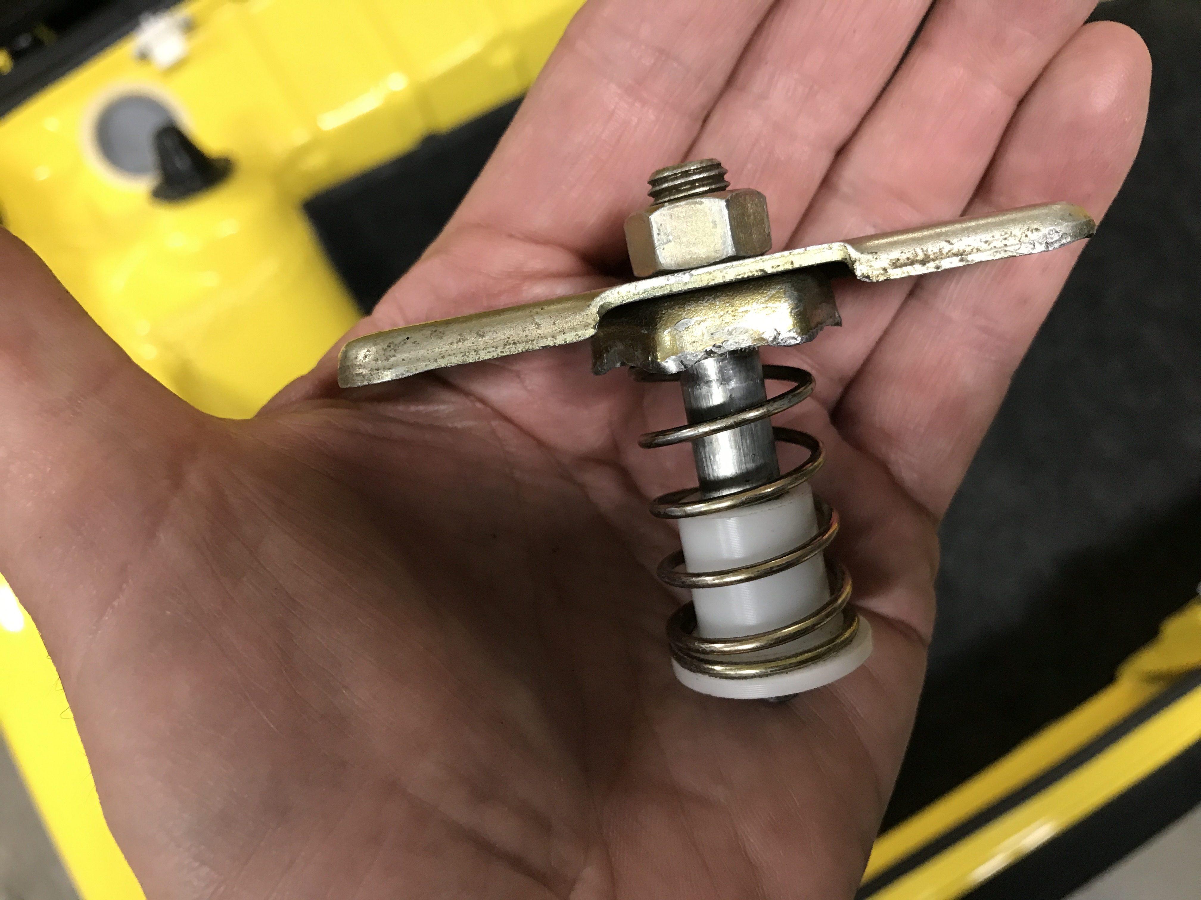

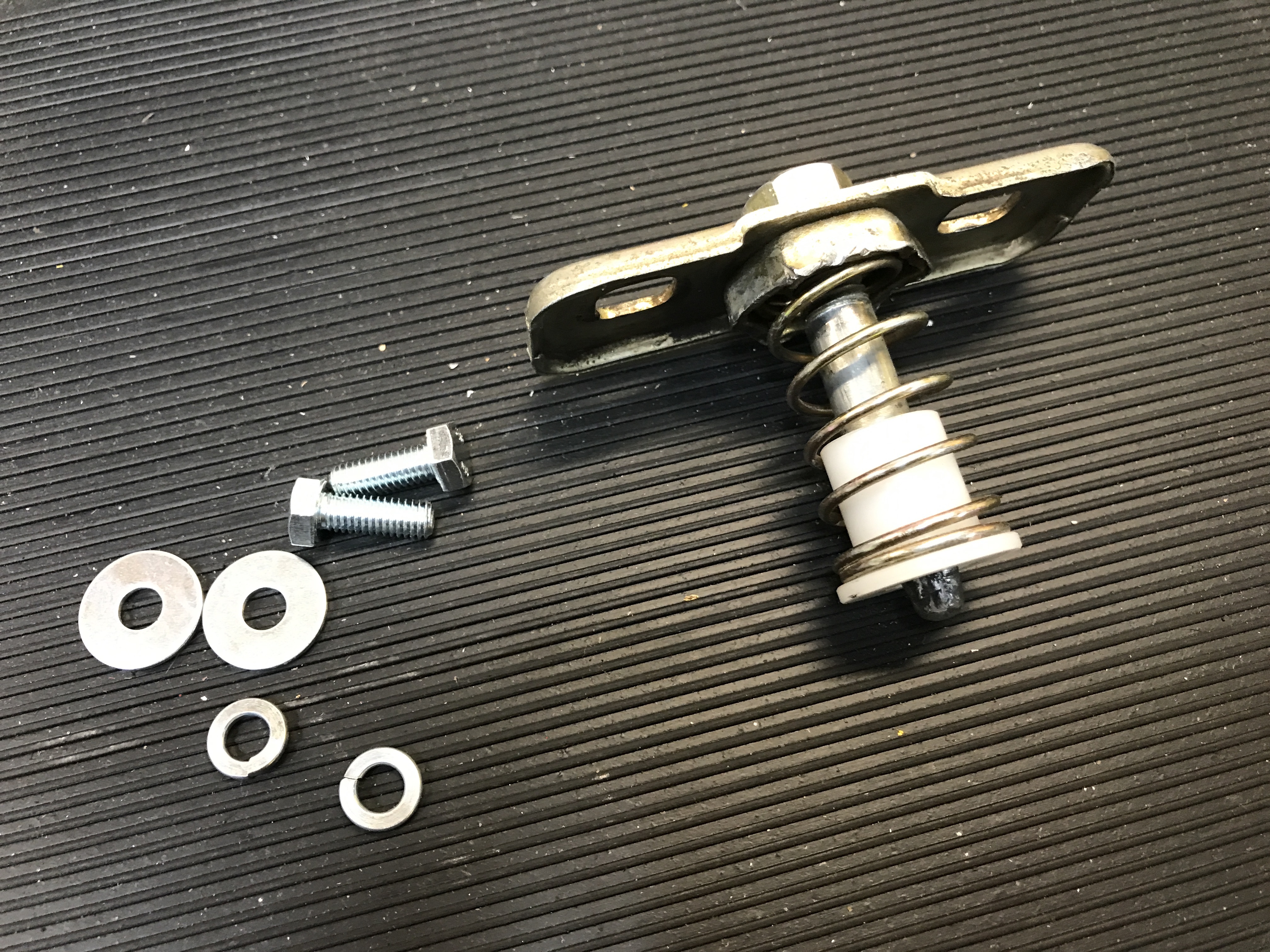

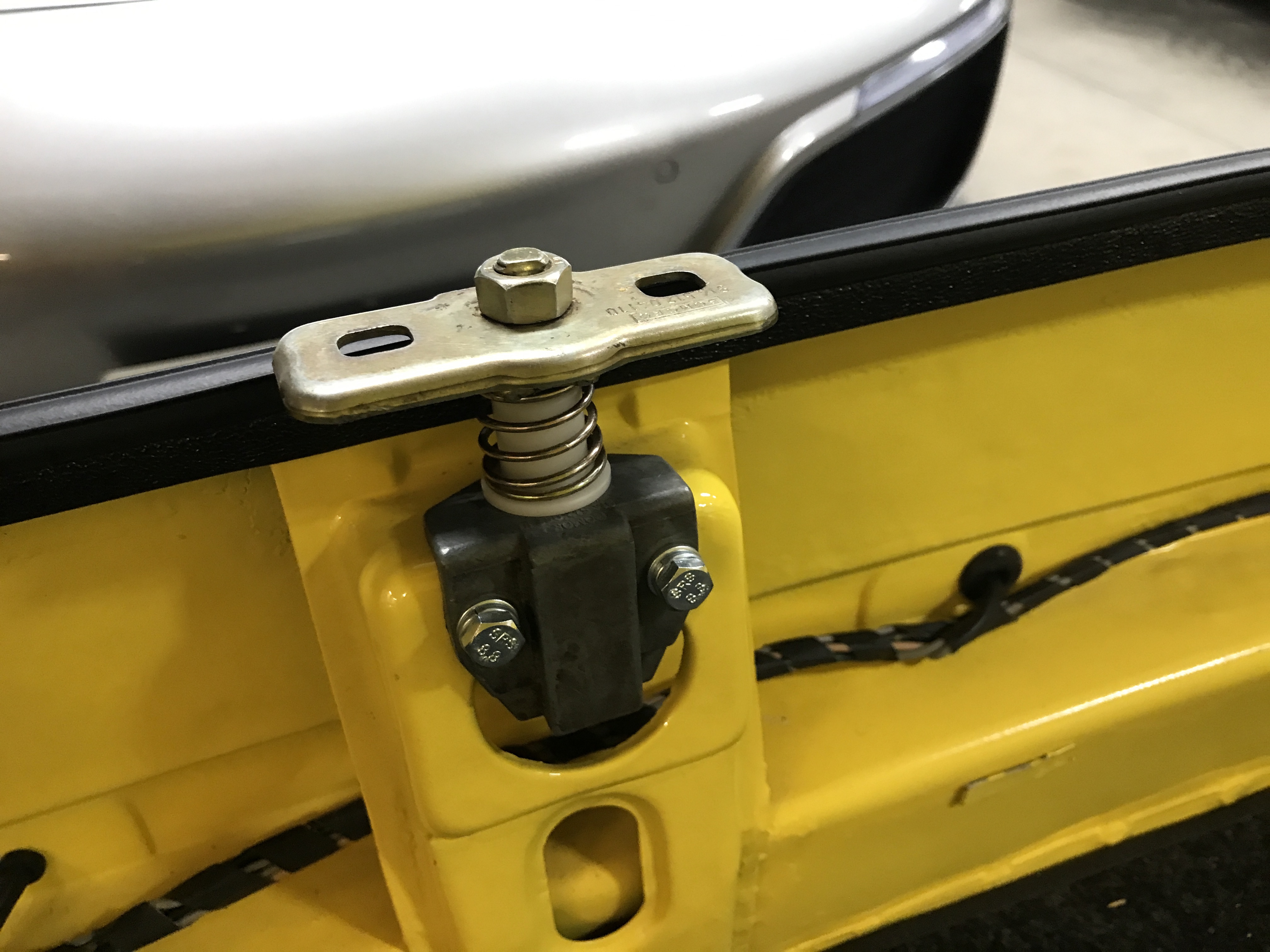

I got out the trunk lid pin.
bkrantz
post Jun 14 2022, 07:36 PM
Post #5525
Posts: 8,343
Joined: 3-August 19
From: SW Colorado
Member No.: 23,343
And did one more test in the latch, to make sure it will open.
bkrantz
post Jun 14 2022, 07:39 PM
Post #5526
Posts: 8,343
Joined: 3-August 19
From: SW Colorado
Member No.: 23,343
First attempt, with the pin installed. Good news: it latches. Better news: it opens.
But the level of the closed lid is too high.
bkrantz
post Jun 14 2022, 07:41 PM
Post #5527
Posts: 8,343
Joined: 3-August 19
From: SW Colorado
Member No.: 23,343
I took the pin off, and adjusted the exposed length to be shorter.
bkrantz
post Jun 14 2022, 07:42 PM
Post #5528
Posts: 8,343
Joined: 3-August 19
From: SW Colorado
Member No.: 23,343
After two attempts, I have the height where I want it.

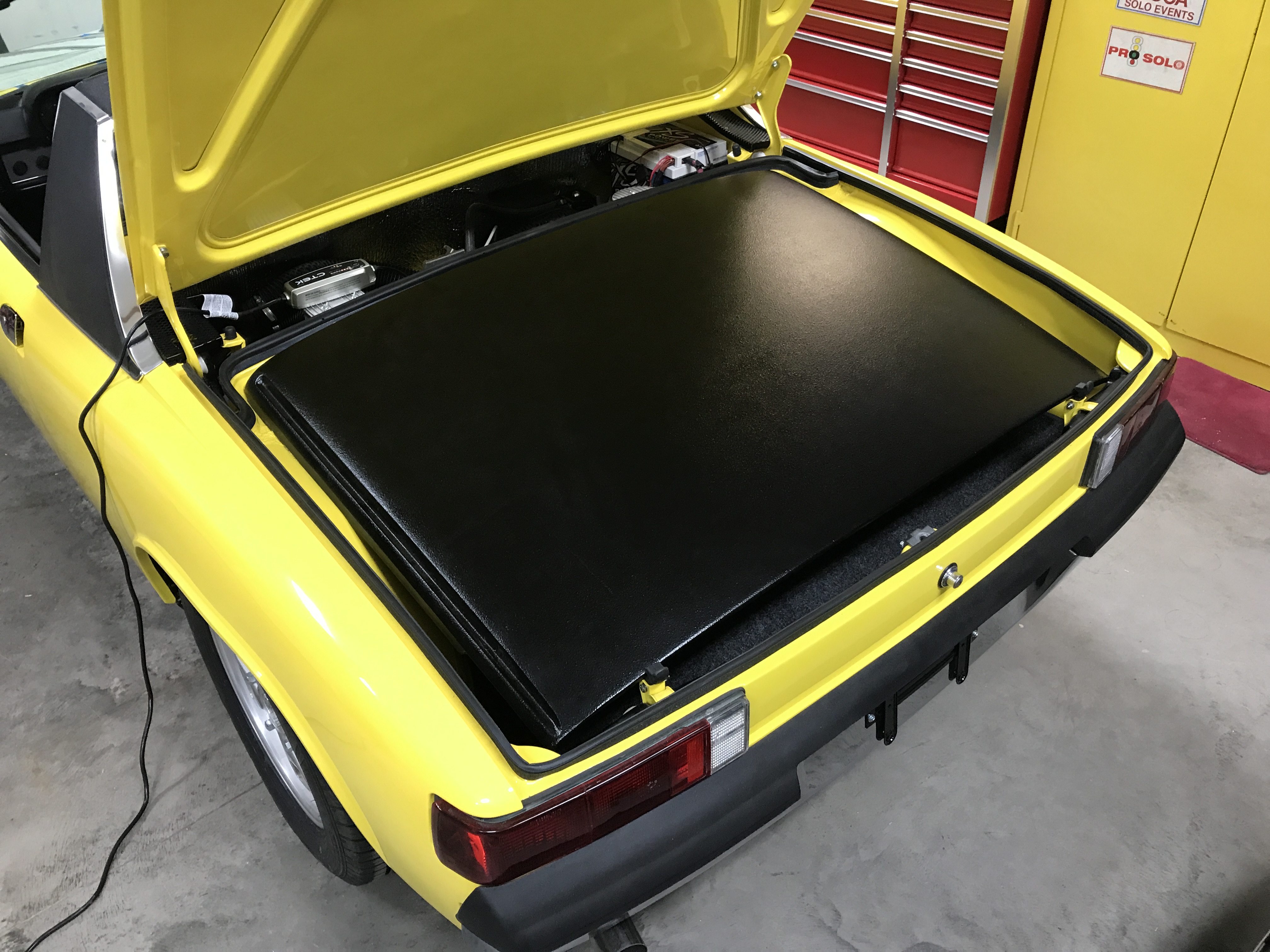

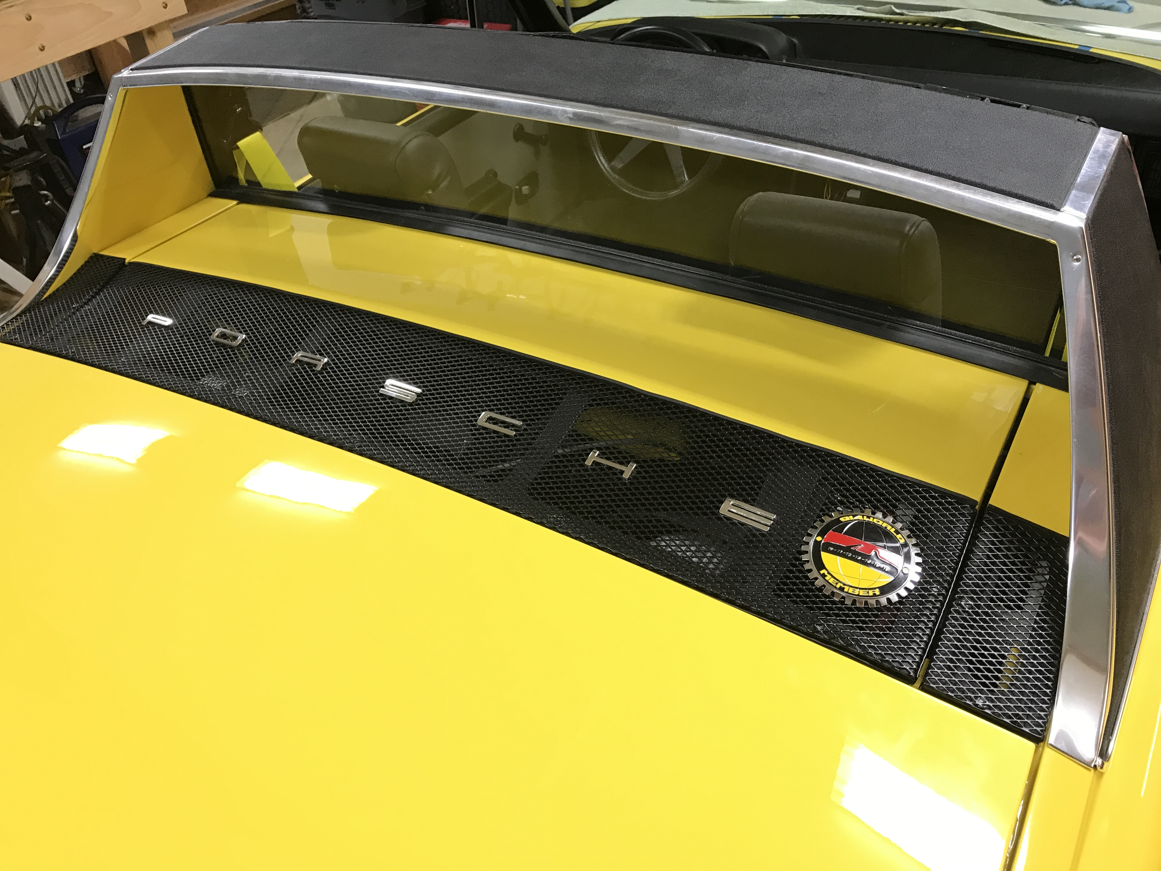

So then I tried putting the roof into the trunk with the lid on. It fits into the clips and rubber latches and looks good.
bkrantz
post Jun 14 2022, 07:45 PM
Post #5530
Posts: 8,343
Joined: 3-August 19
From: SW Colorado
Member No.: 23,343
But...the lid will not close. ARGH!

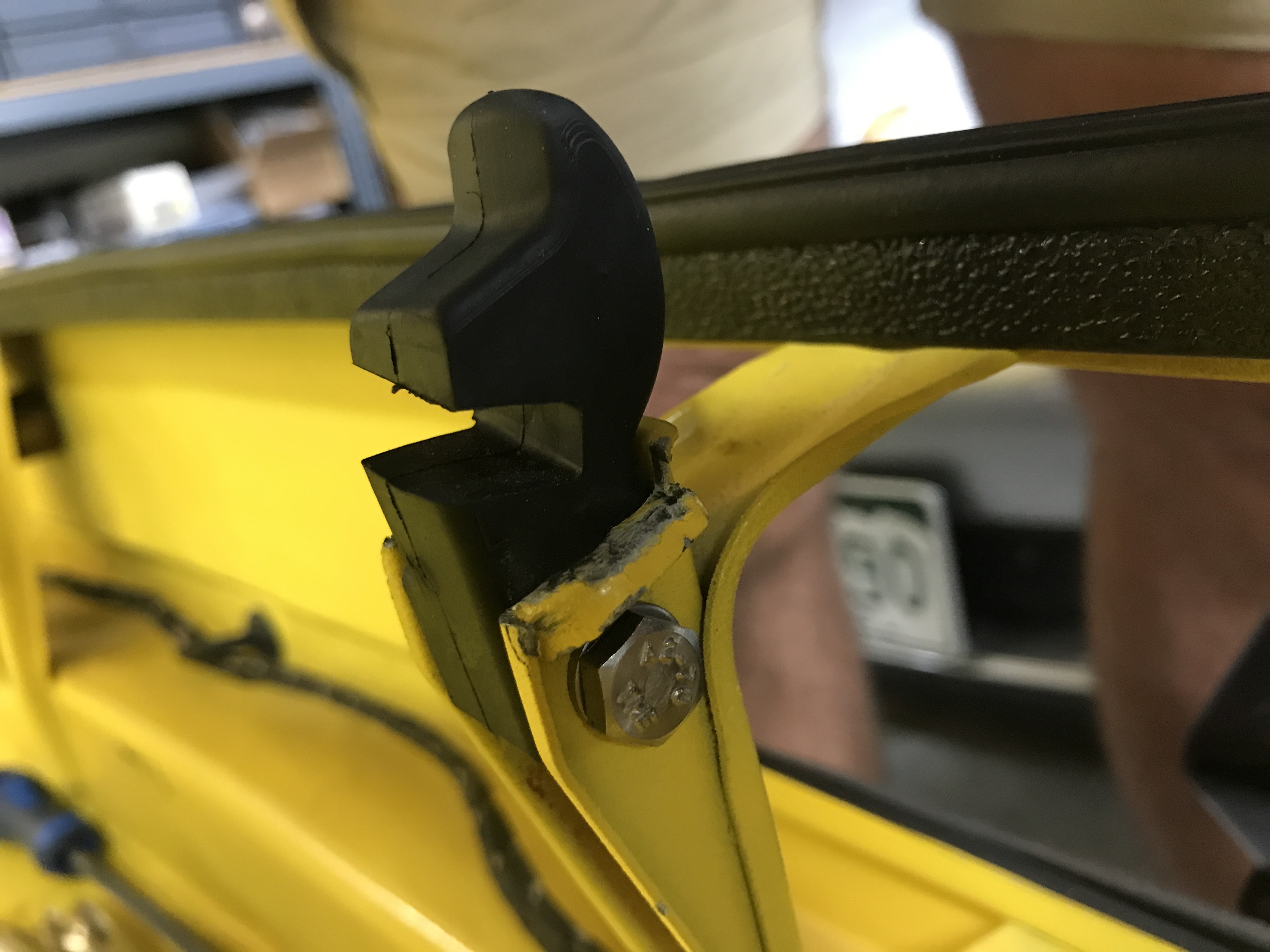

The rubber latches are already as far down as the stock adjustment allows.
bkrantz
post Jun 14 2022, 07:50 PM
Post #5532
Posts: 8,343
Joined: 3-August 19
From: SW Colorado
Member No.: 23,343

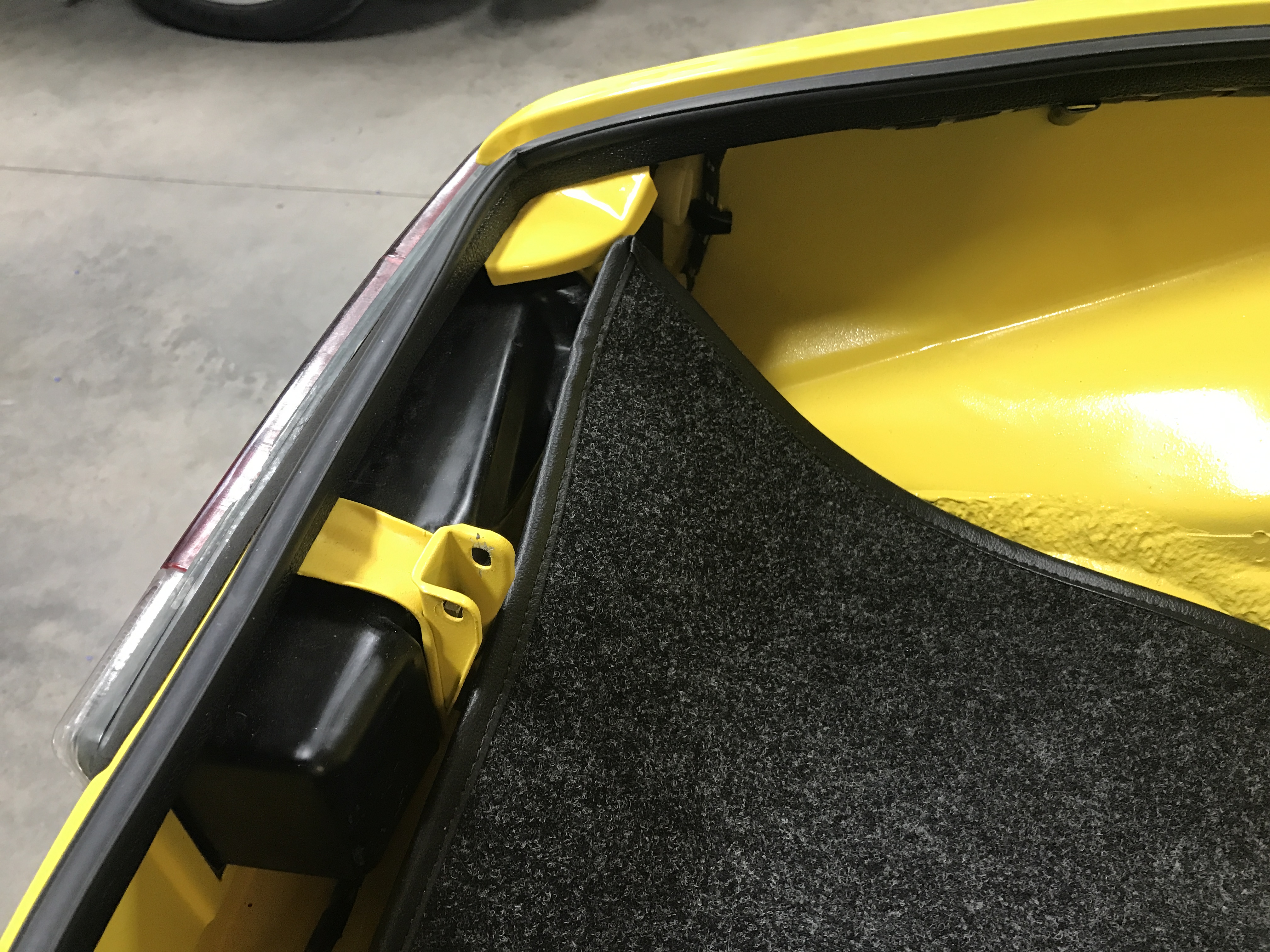

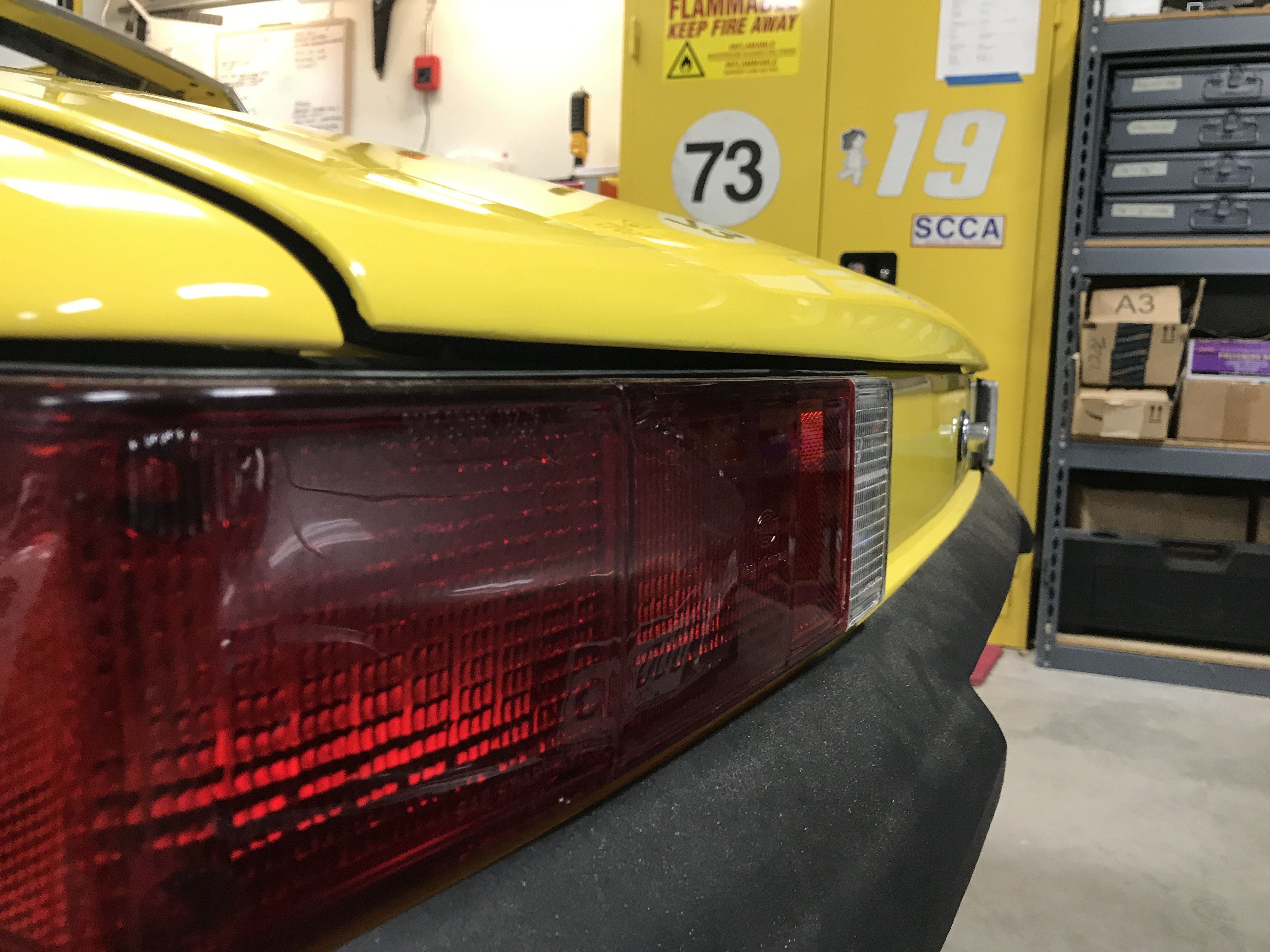

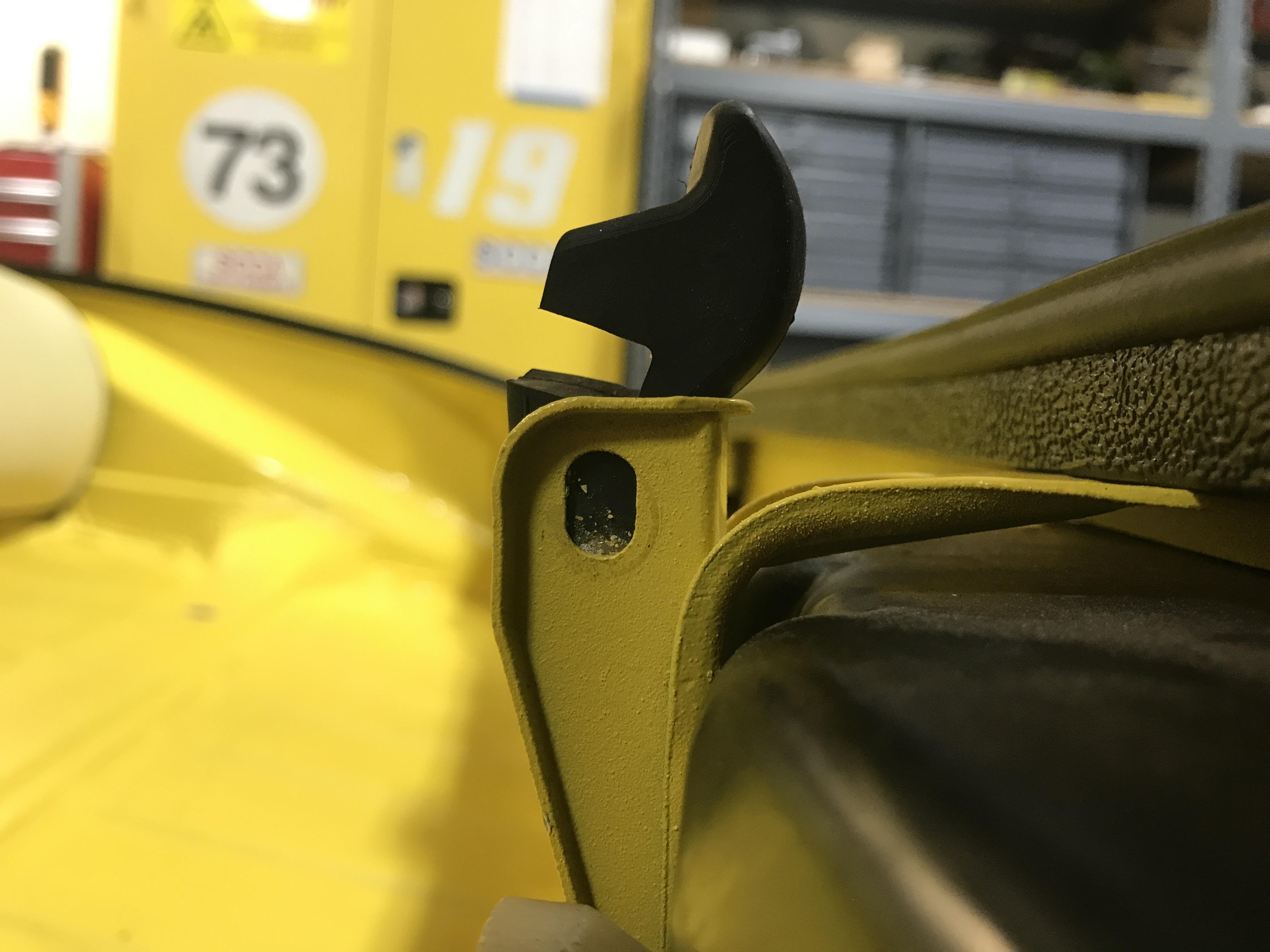

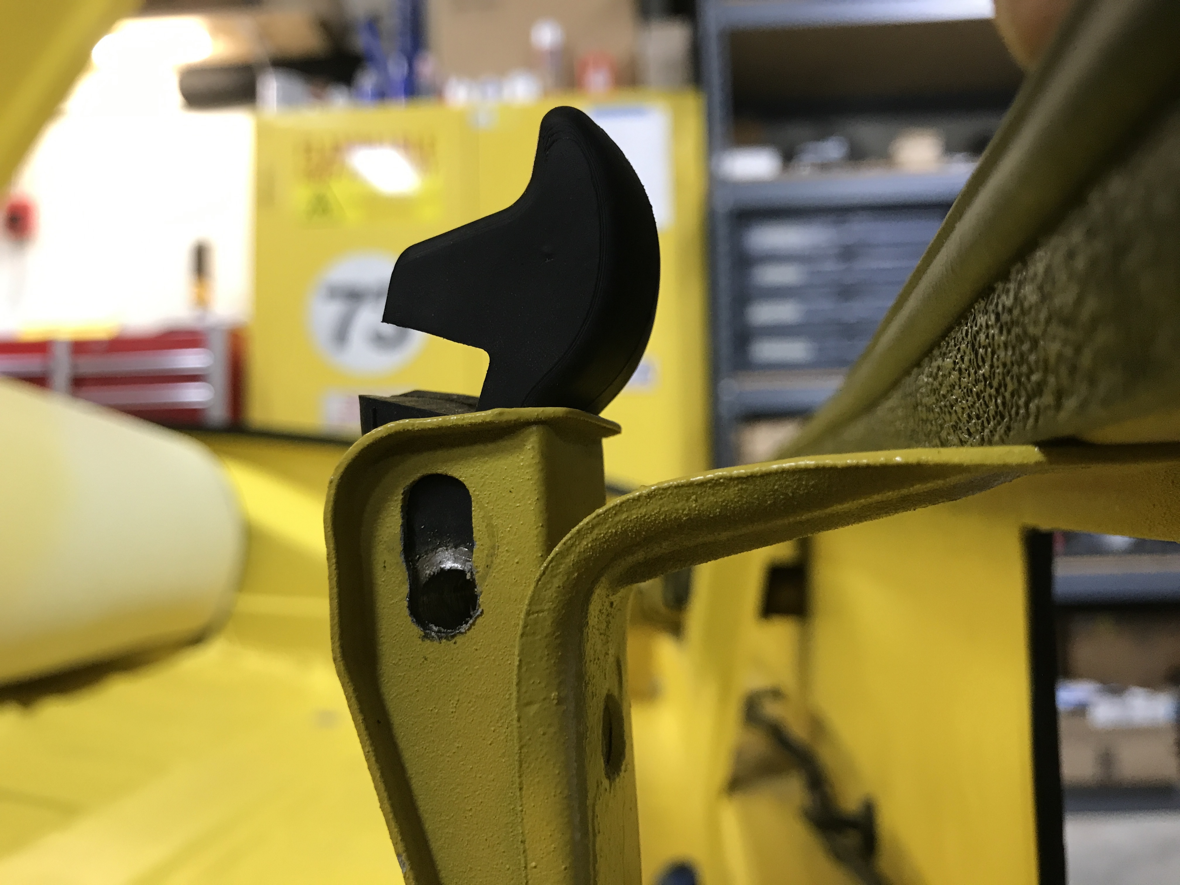

So I removed the latches, put the roof in, and the lid closes. The roof was sitting on the metal brackets that hold the latches, and the roof corners still had clearance above the tail light bodies.
bkrantz
post Jun 14 2022, 07:51 PM
Post #5533
Posts: 8,343
Joined: 3-August 19
From: SW Colorado
Member No.: 23,343

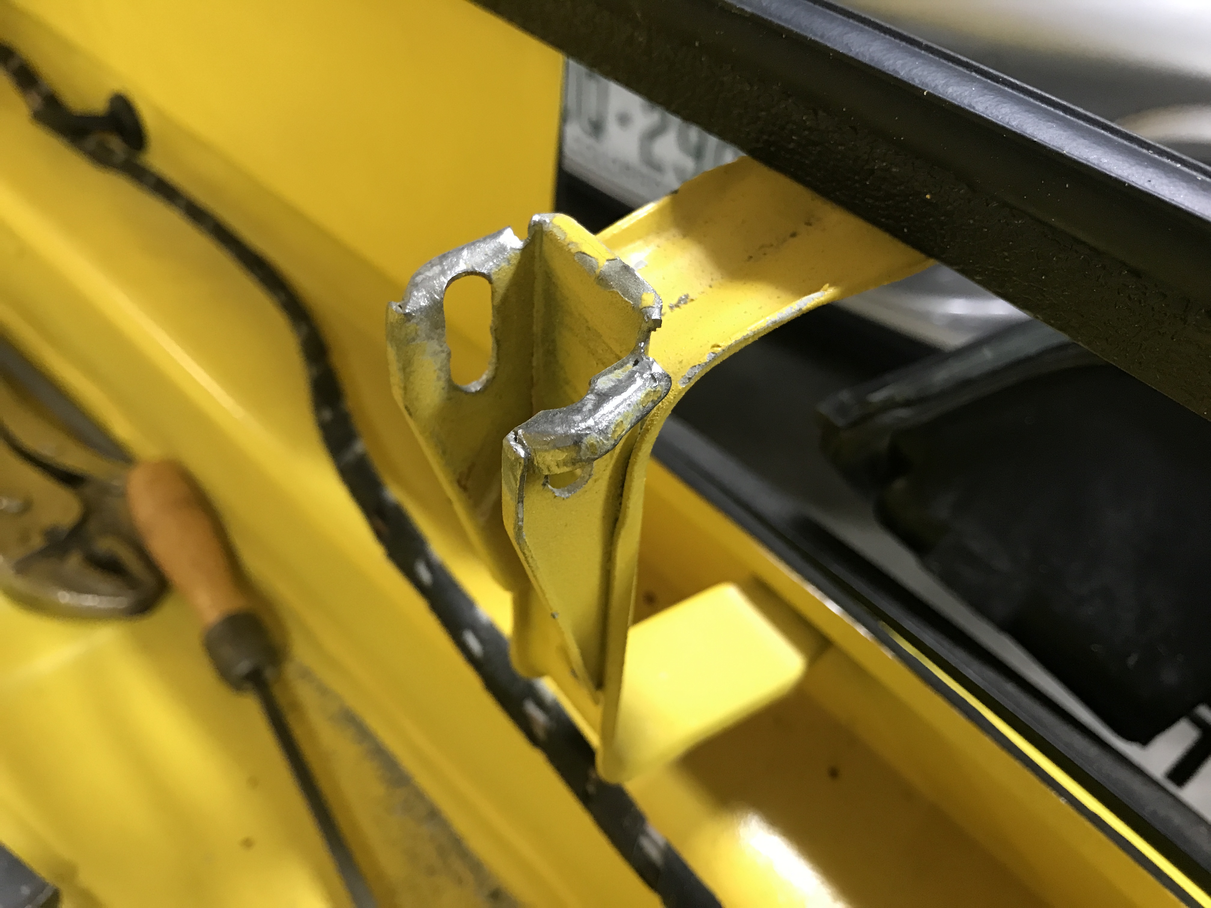

That means the latches have to sit about 3/16" lower, as shown here.

Do you have the top pushed all the way forward into the white clips up front?

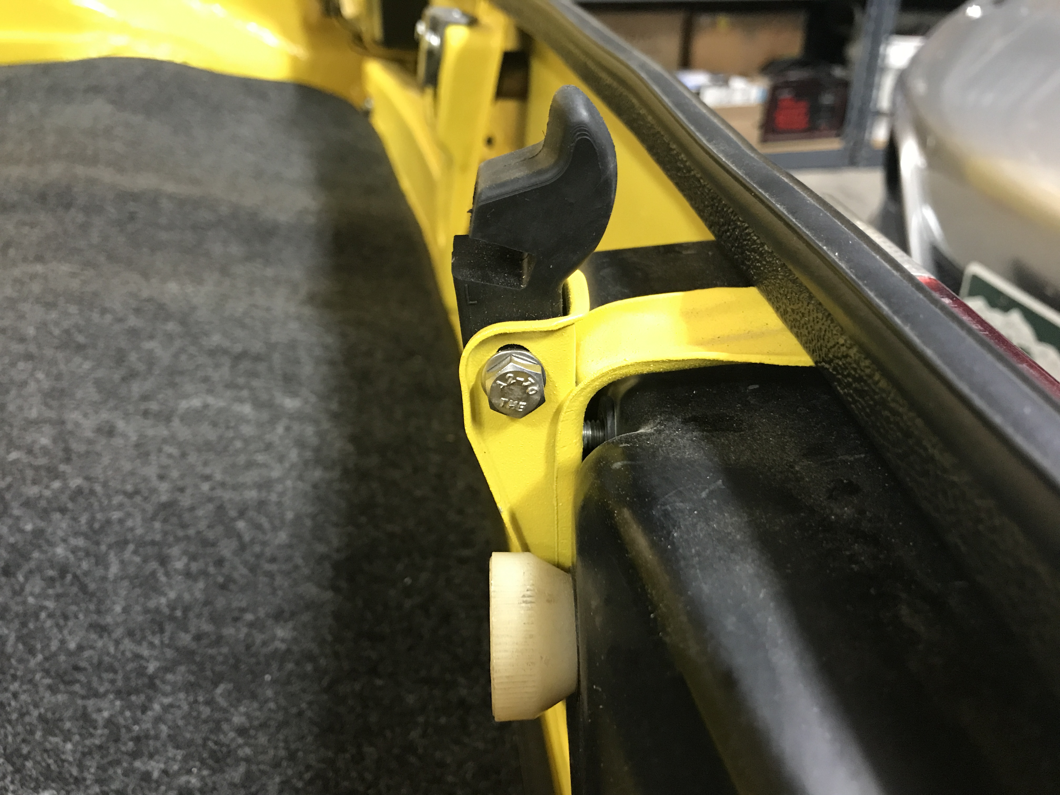

Trigger warning: purists might not want to look!
Step one: elongate the latch bolt holes.
bkrantz
post Jun 14 2022, 07:54 PM
Post #5536
Posts: 8,343
Joined: 3-August 19
From: SW Colorado
Member No.: 23,343
Step 2: modify the brackets so there is clearance between the notch for the roof edge and the top of the brackets.
bkrantz
post Jun 14 2022, 07:55 PM
Post #5537
Posts: 8,343
Joined: 3-August 19
From: SW Colorado
Member No.: 23,343
Here's my initial mod. I will neaten this up and make a couple of spot welds.

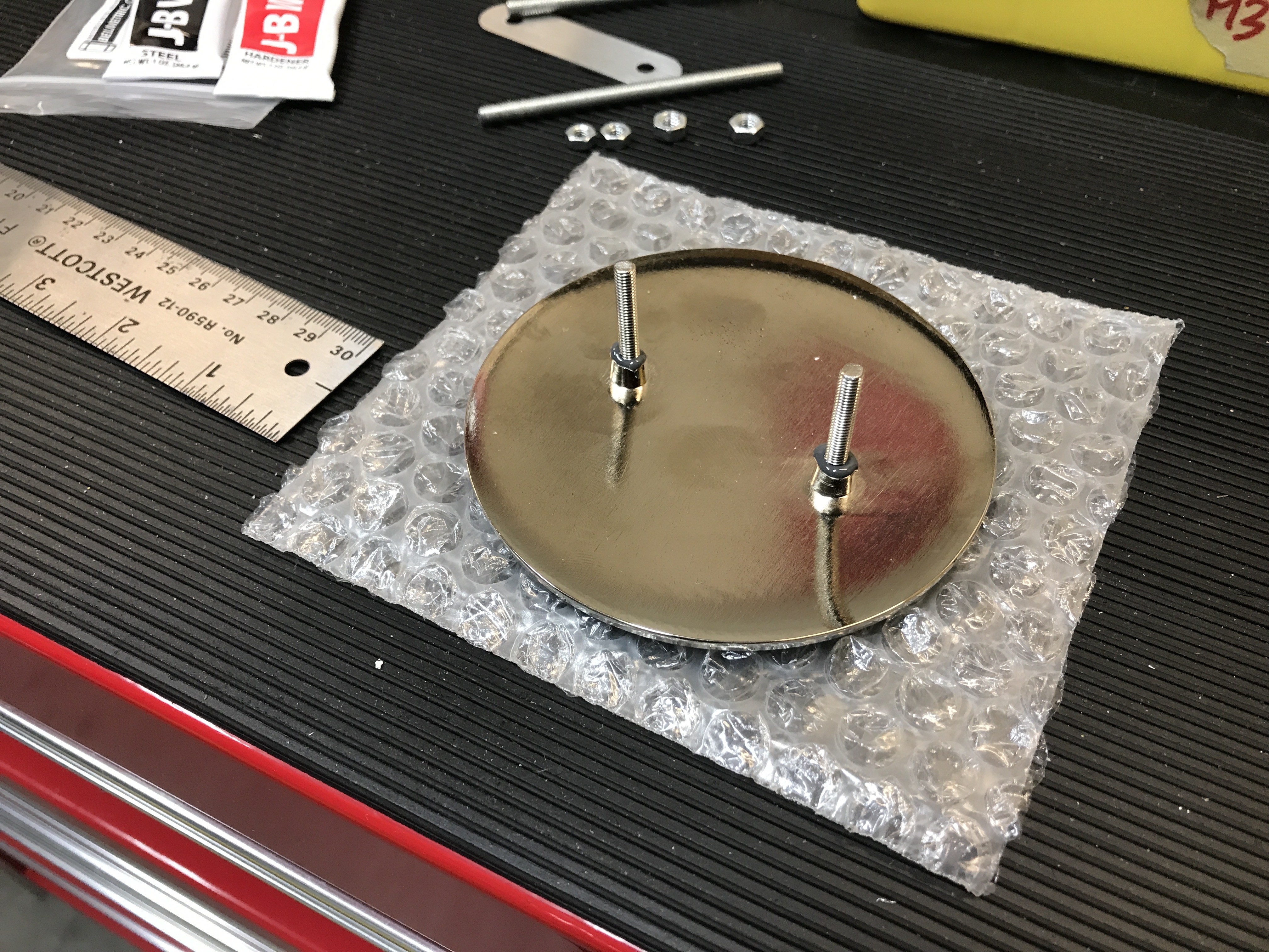

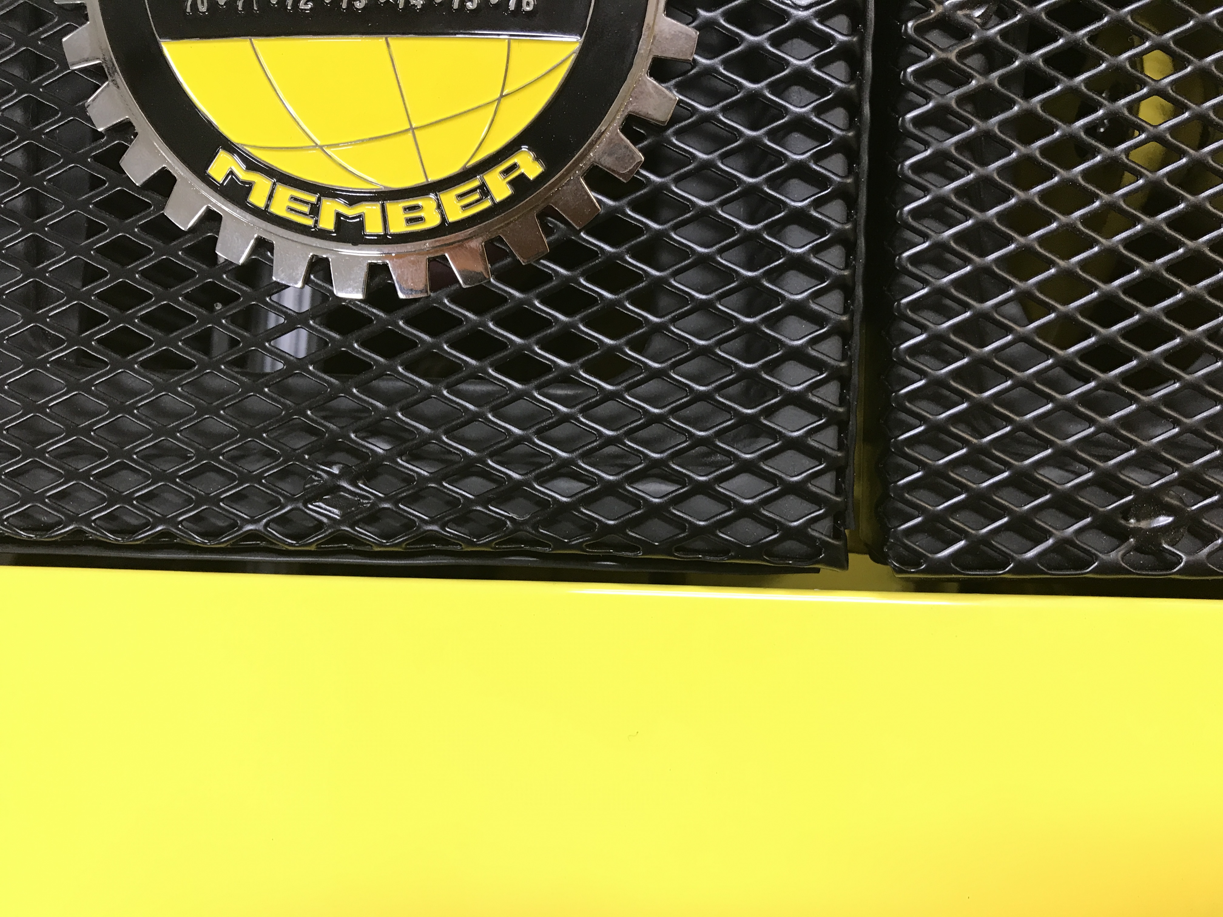

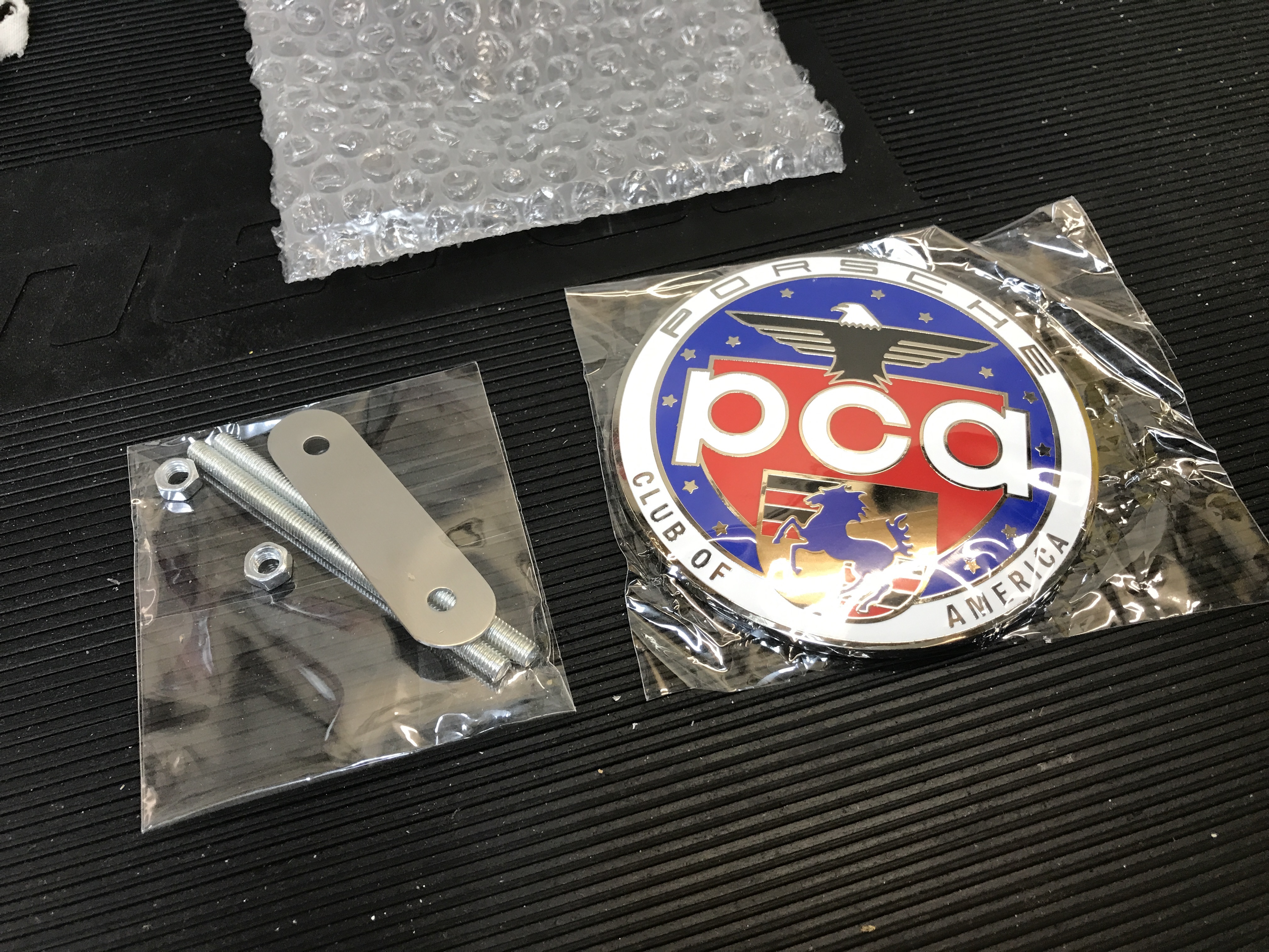

Meanwhile, I got out my new PCA badge.
bkrantz
post Jun 14 2022, 07:58 PM
Post #5539
Posts: 8,343
Joined: 3-August 19
From: SW Colorado
Member No.: 23,343

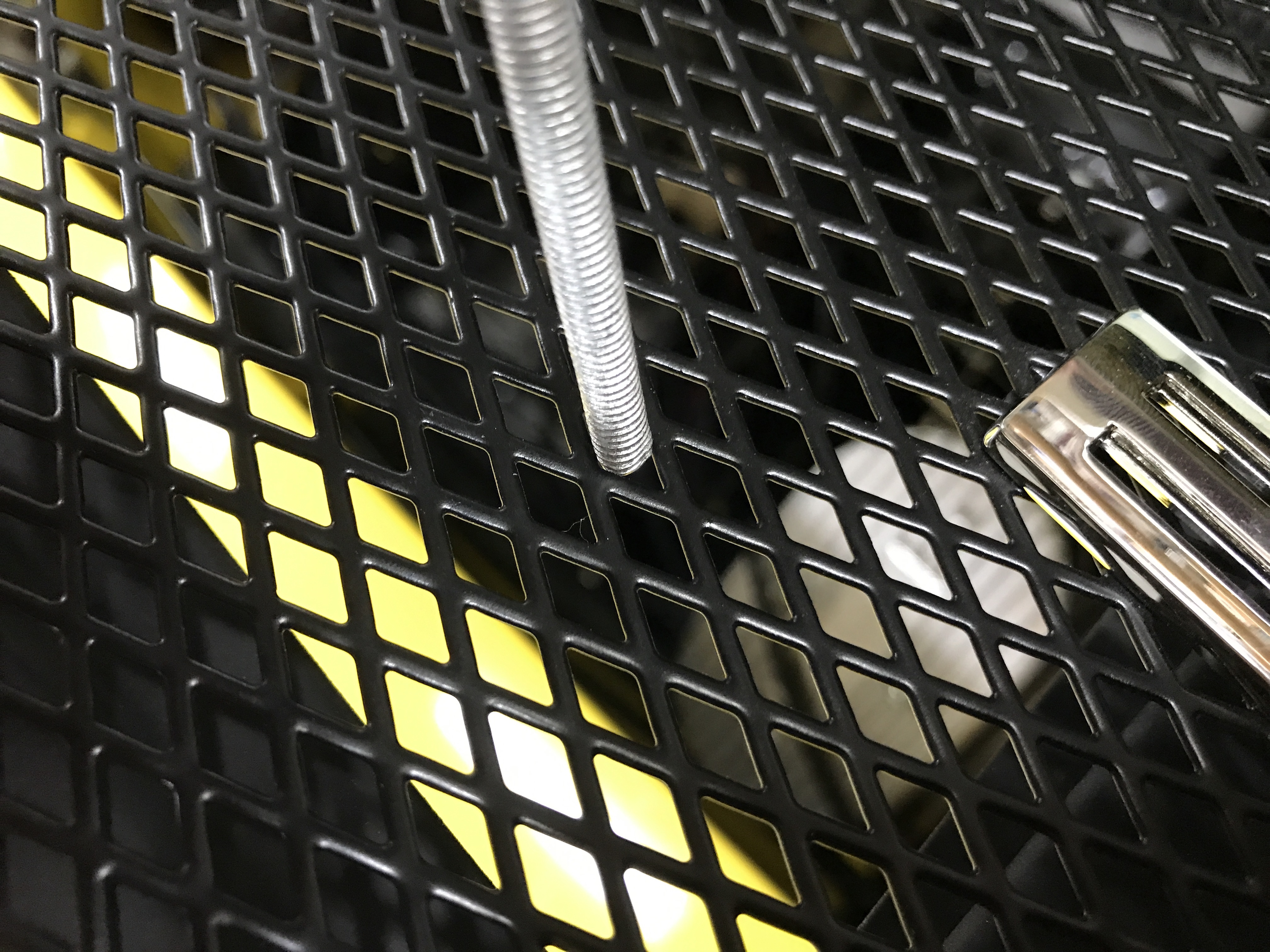

This has the same problem as the 914 World badge: the 5mm studs are too thick for the stock grill holes. And the stud spacing is not quite right.
bkrantz
post Jun 14 2022, 08:00 PM
Post #5540
Posts: 8,343
Joined: 3-August 19
From: SW Colorado
Member No.: 23,343
So I did some drilling and filing, and then stuck some 4mm studs into the holes with JB weld.
