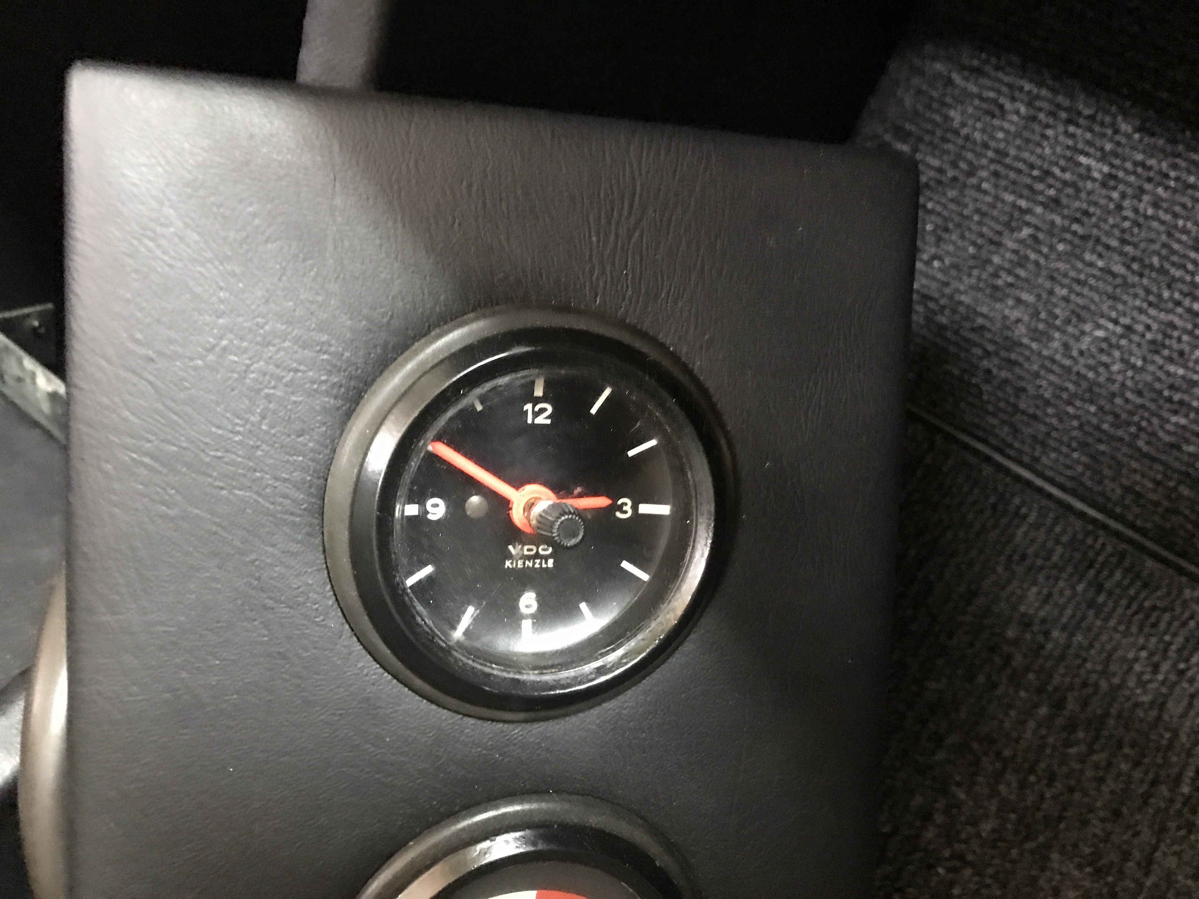

Before welding, I disconnected the battery, but first checked the clock: perfect after about 24 hours.

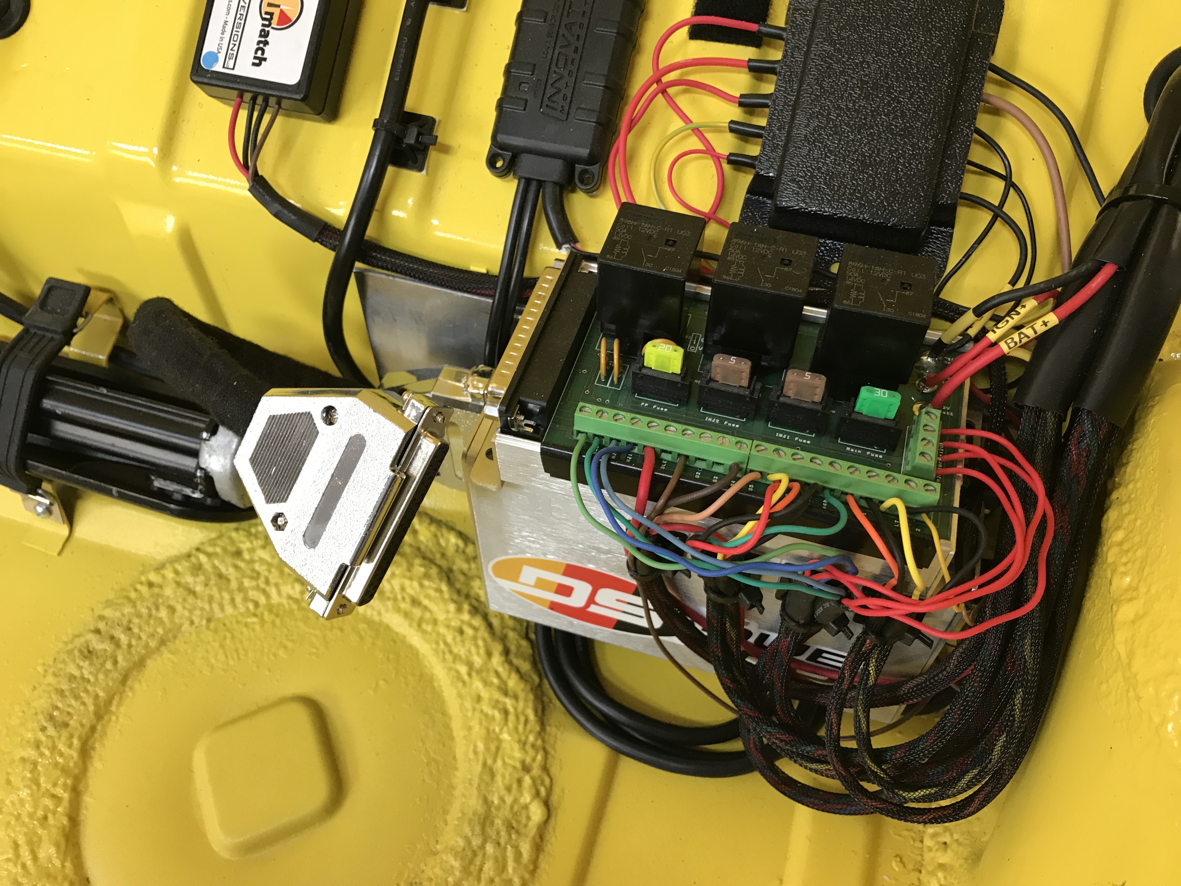

I also disconnected the Megasquirt brain.

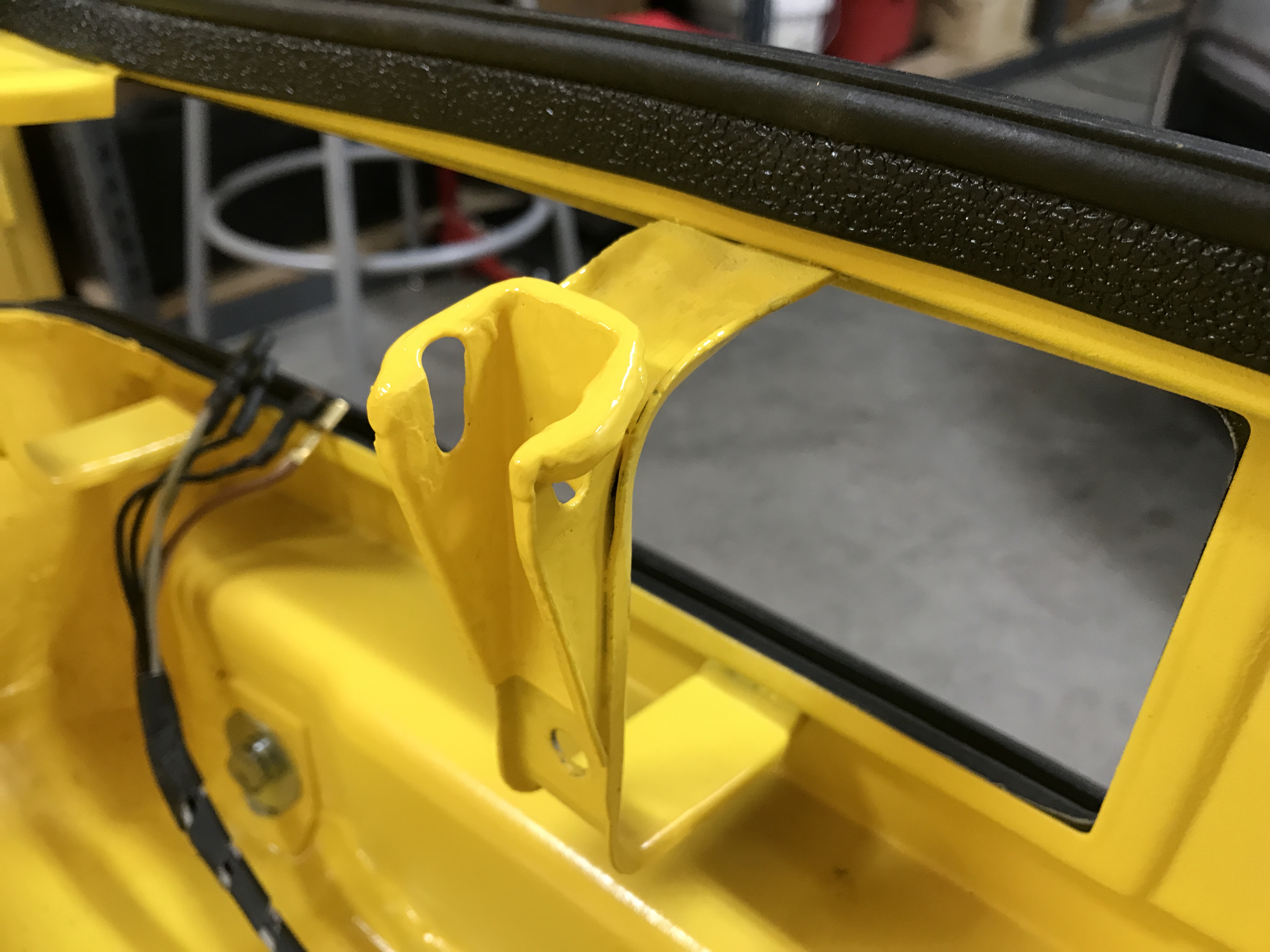

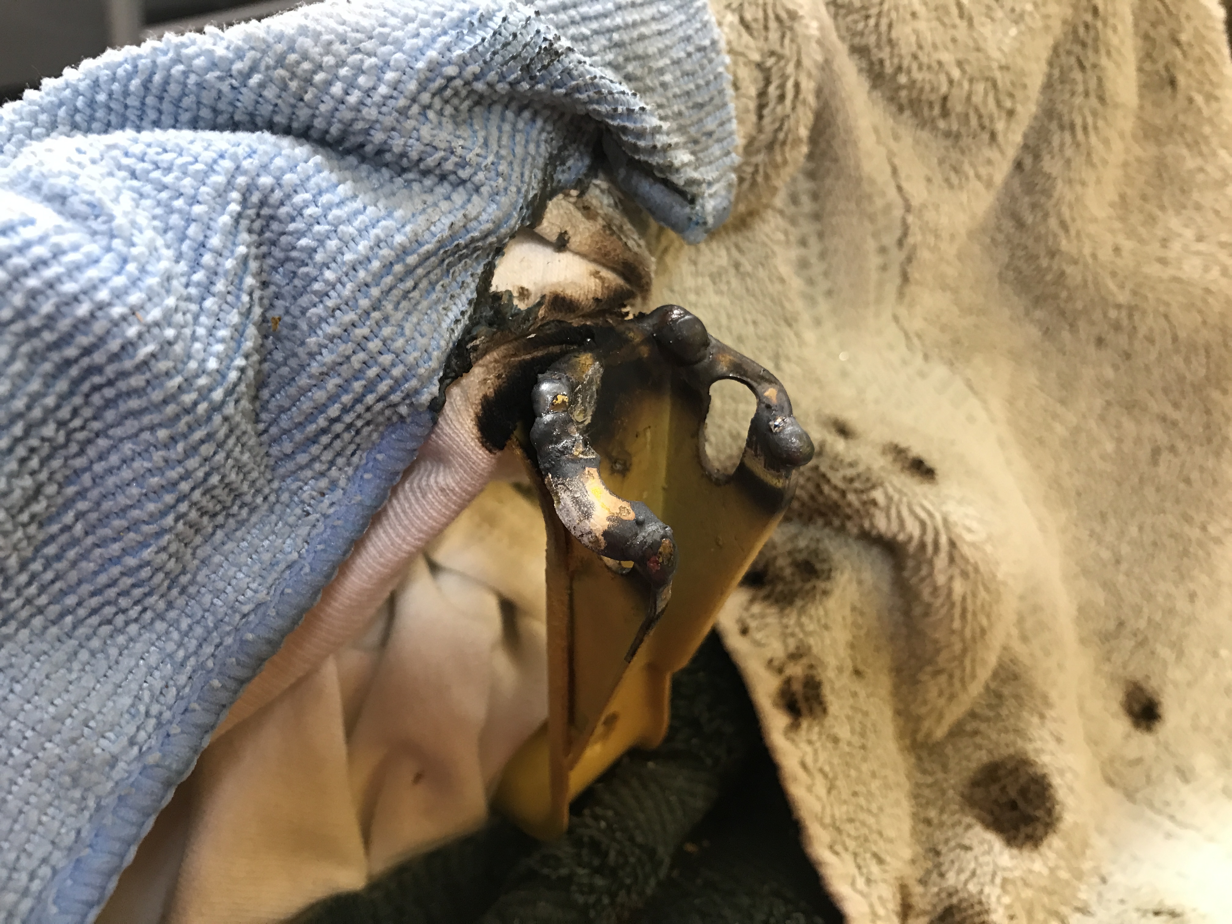

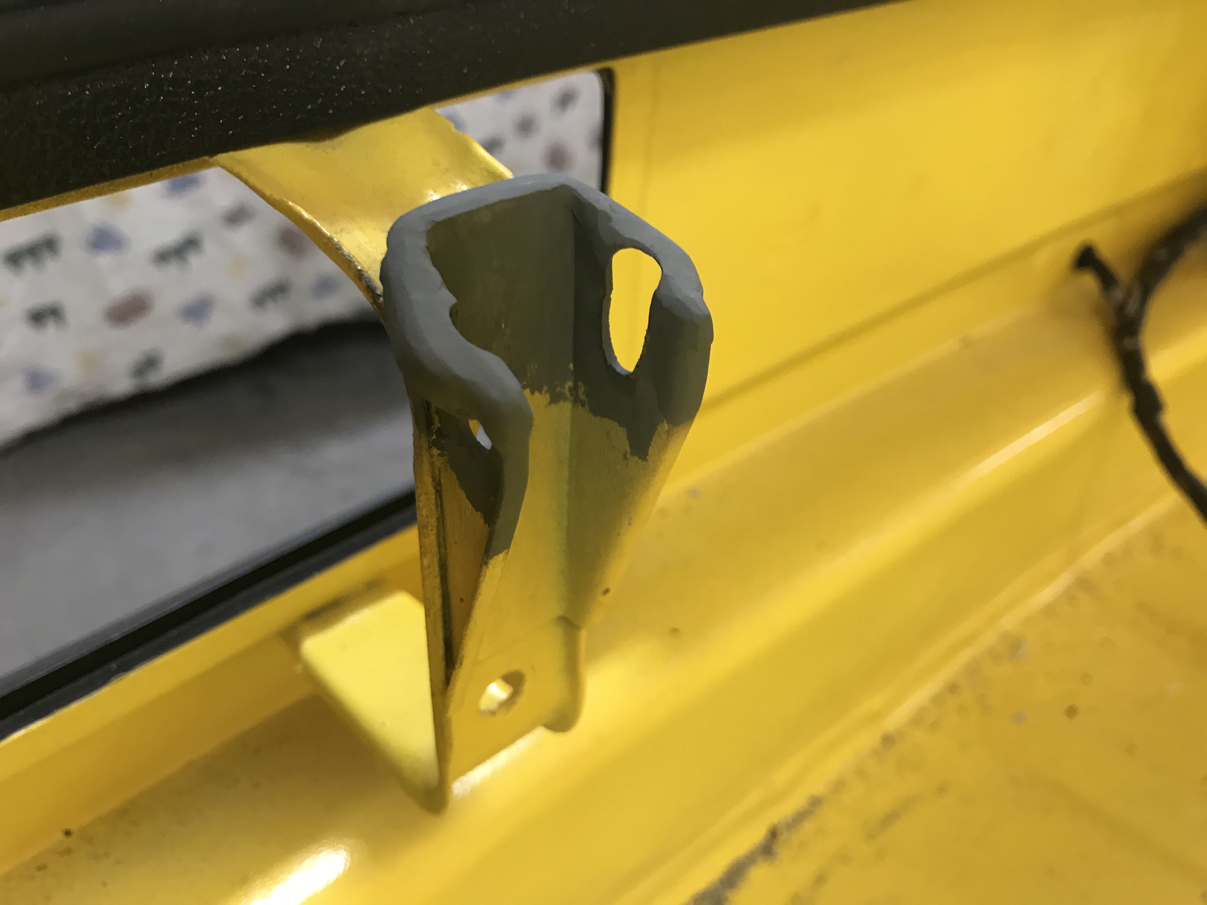

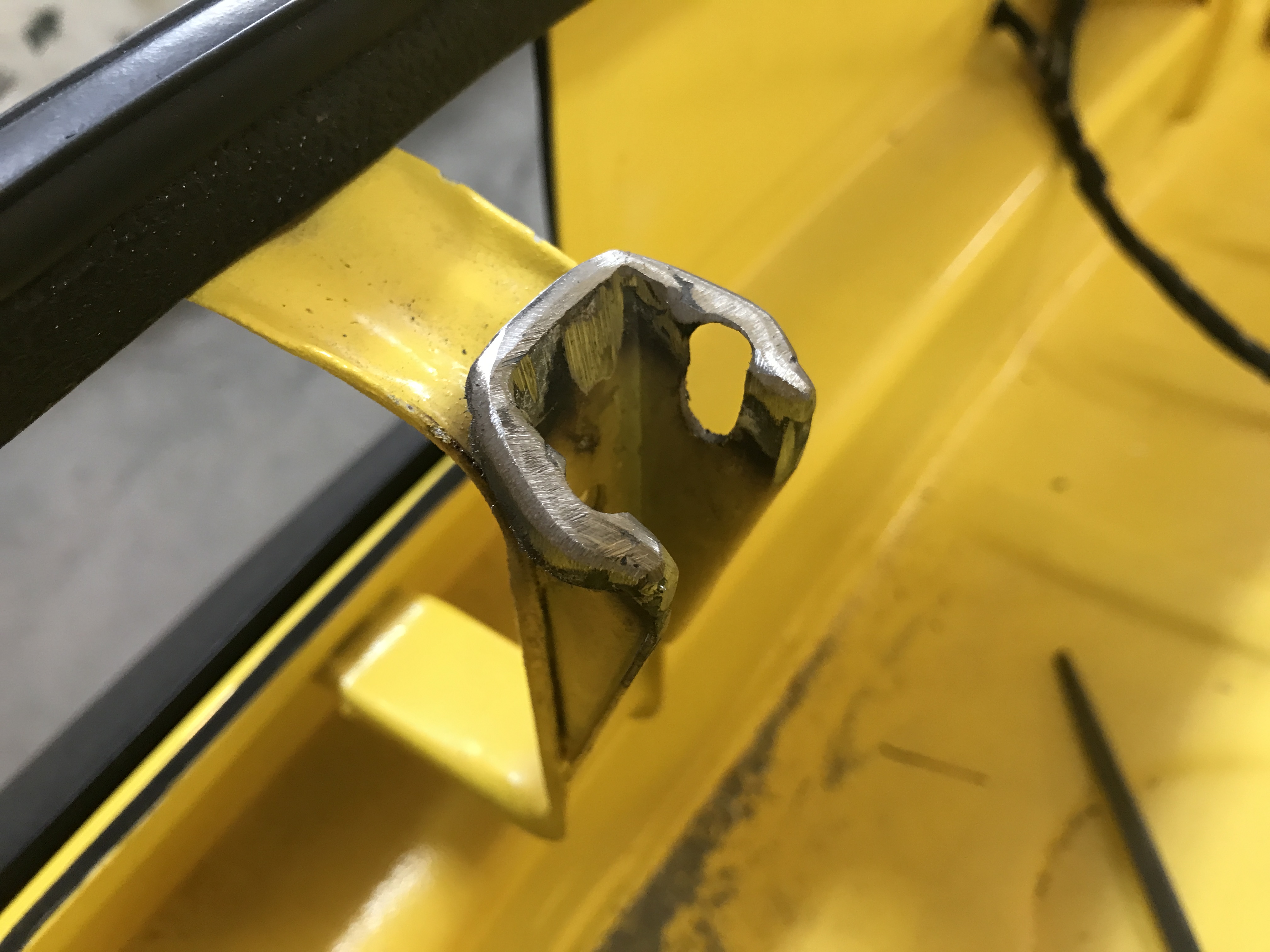

Then I welded the new corners on both brackets. I used all the rags I had handy to protect paint and other surfaces from splatter. Also a good way to set lots of little fires.
bkrantz
post Jun 15 2022, 07:36 PM
Post #5546
Posts: 8,343
Joined: 3-August 19
From: SW Colorado
Member No.: 23,343
Then some grinding followed by a flappy sanding wheel.
bkrantz
post Jun 15 2022, 07:37 PM
Post #5547
Posts: 8,343
Joined: 3-August 19
From: SW Colorado
Member No.: 23,343
Primed (with a brush, since I figured I could get a final paint finish at least as good as it was).
bkrantz
post Jun 15 2022, 07:39 PM
Post #5548
Posts: 8,343
Joined: 3-August 19
From: SW Colorado
Member No.: 23,343
And painted. Should be ready to reassemble tomorrow.

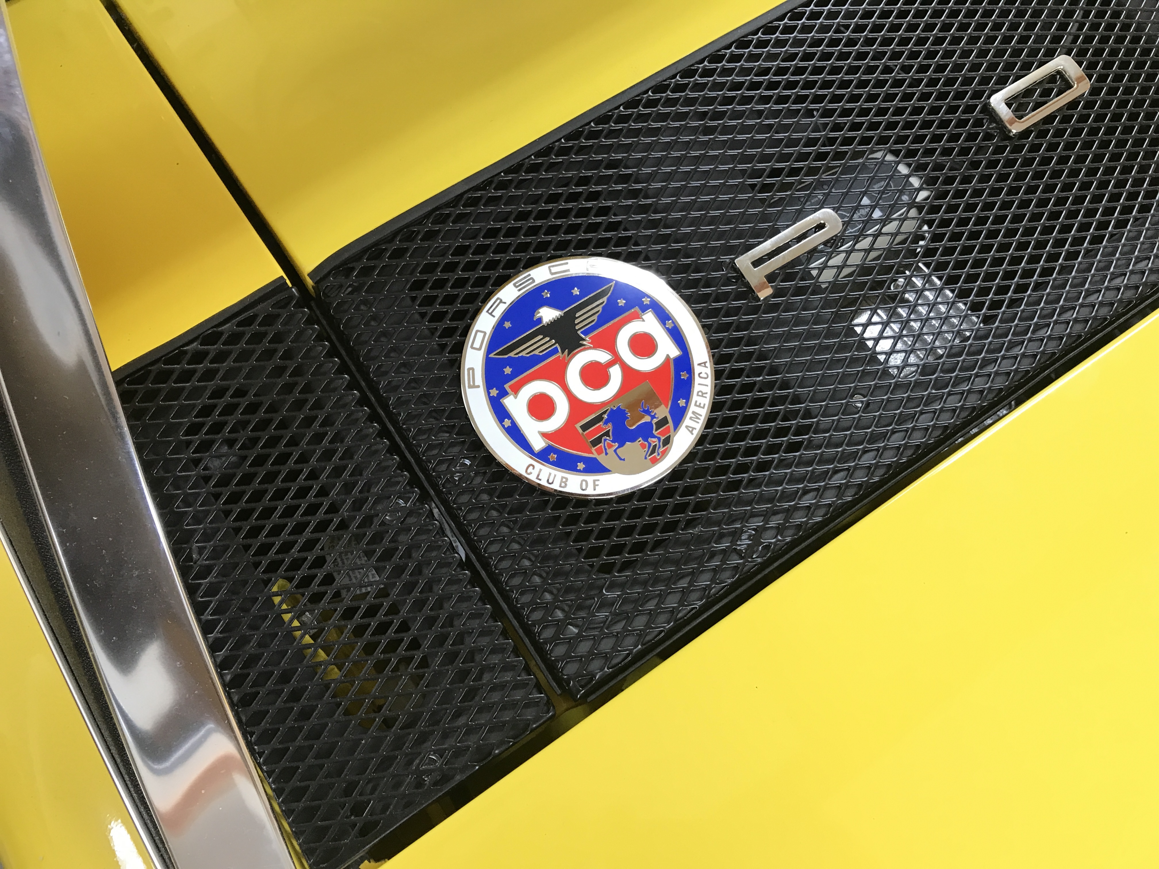

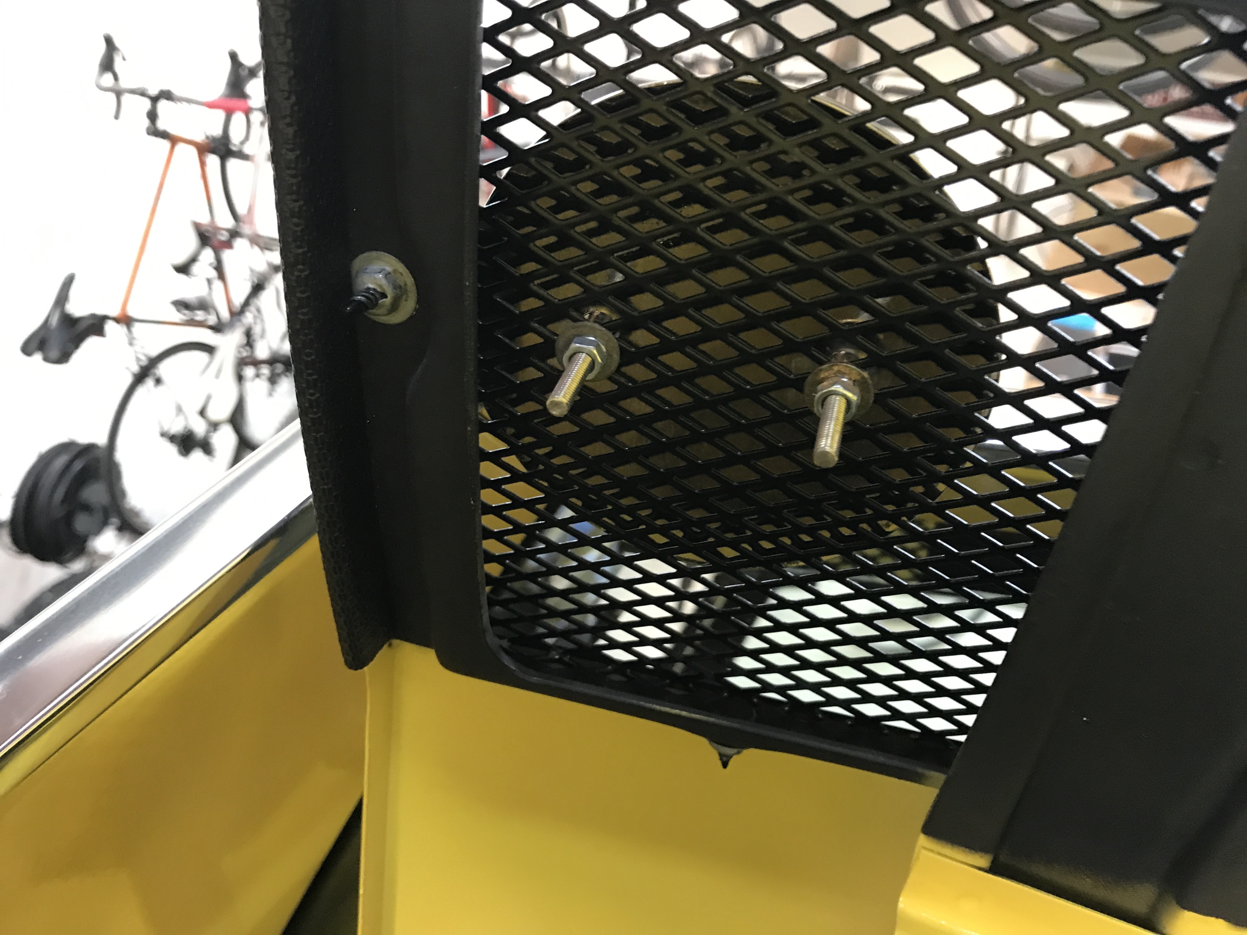

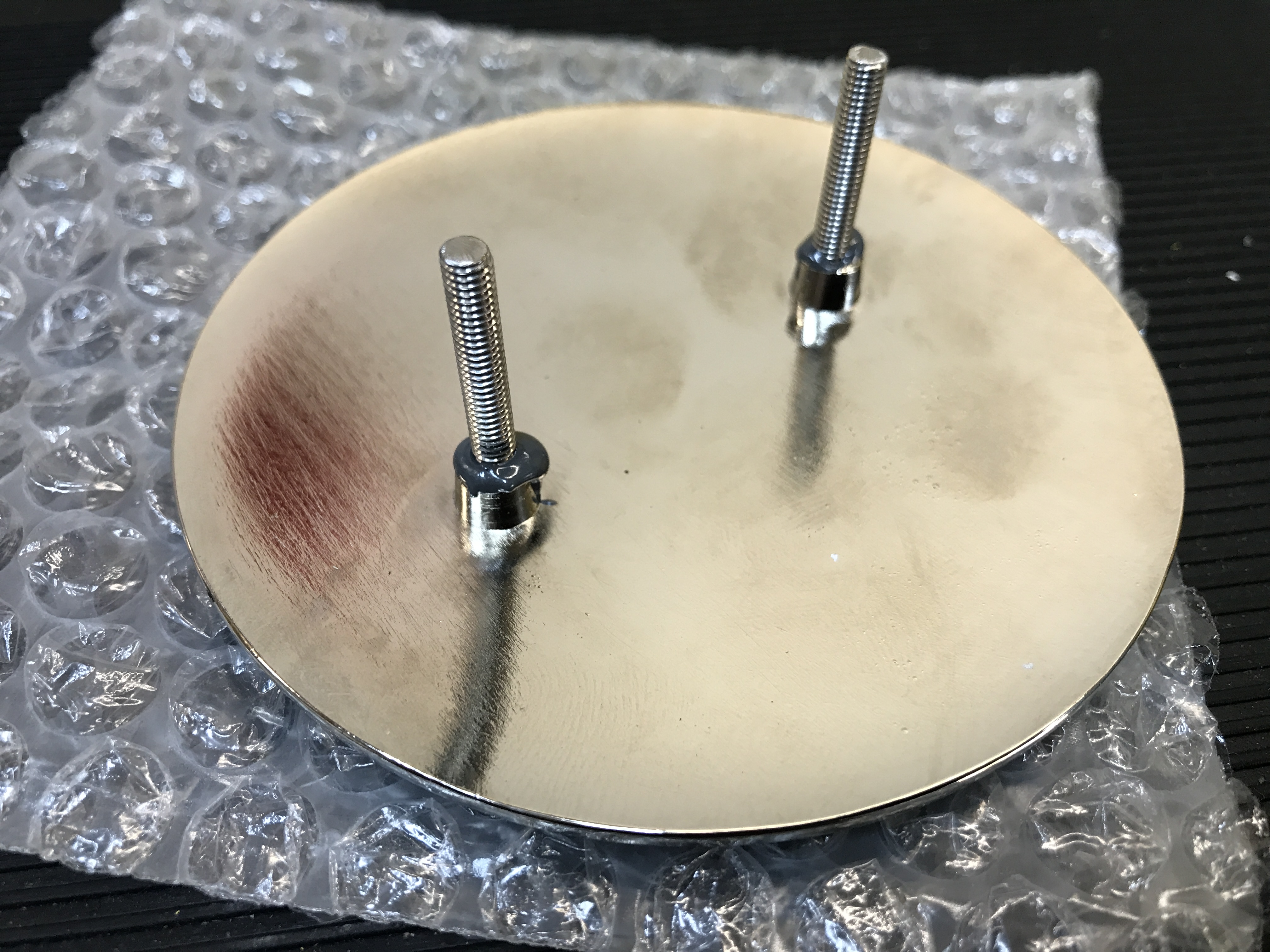

Meanwhile, I mounted the modified grille badge.
bkrantz
post Jun 15 2022, 07:41 PM
Post #5550
Posts: 8,343
Joined: 3-August 19
From: SW Colorado
Member No.: 23,343
Hardware below the grille.
bkrantz
post Jun 15 2022, 07:42 PM
Post #5551
Posts: 8,343
Joined: 3-August 19
From: SW Colorado
Member No.: 23,343
Badge from above. I know not everyone is a PCA fan, but I have been a member for 30 years, and enjoyed some good friendships and fun times.

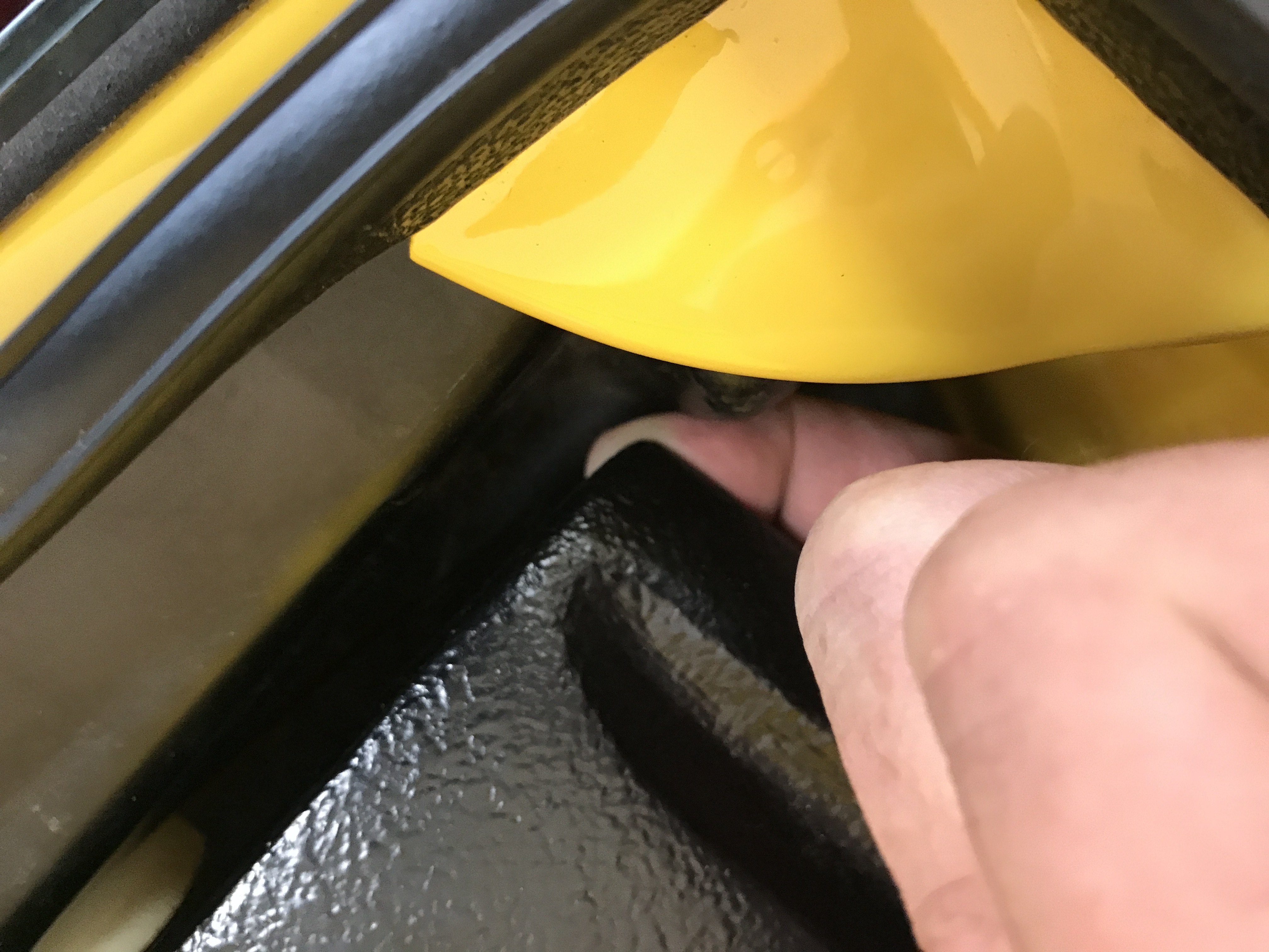

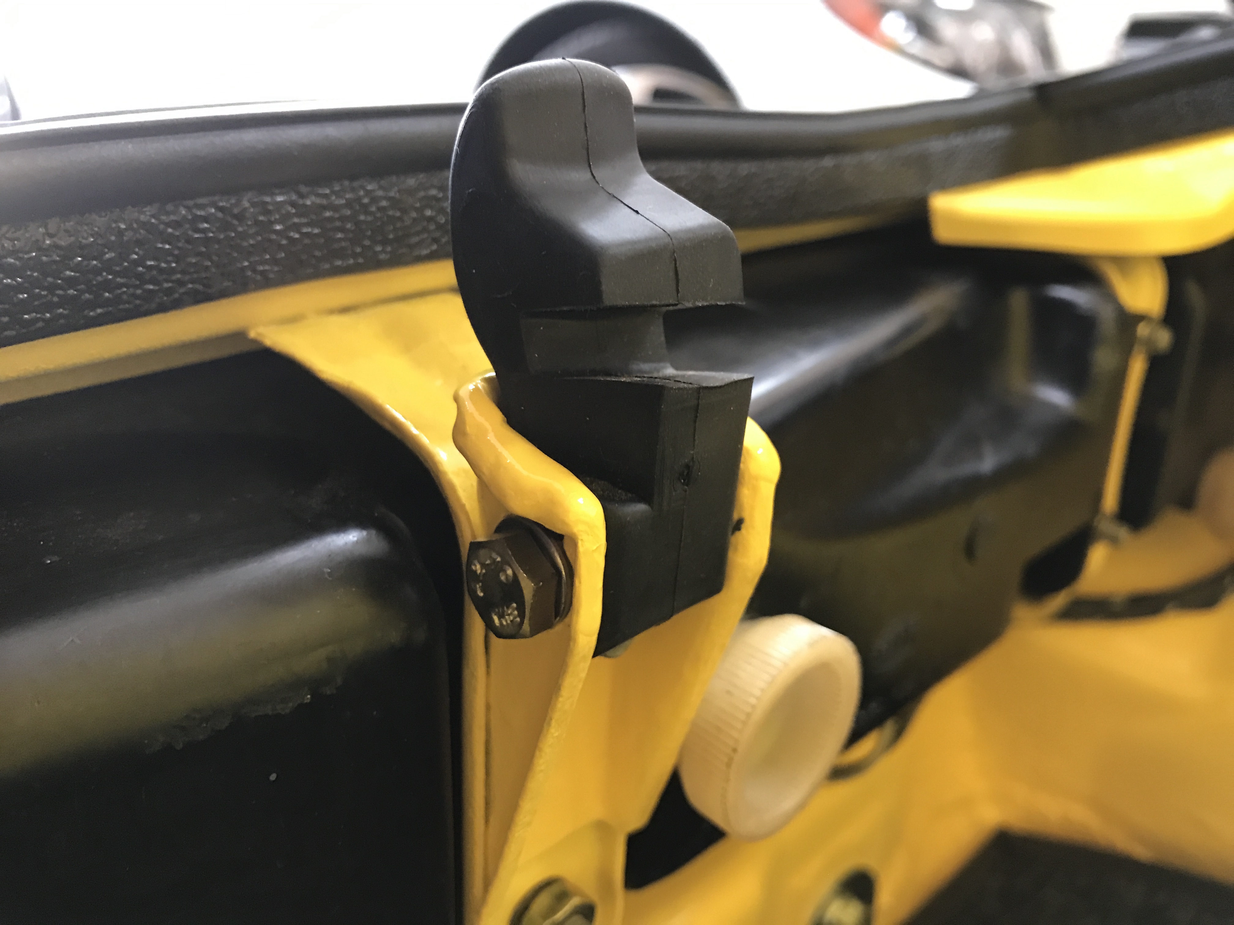

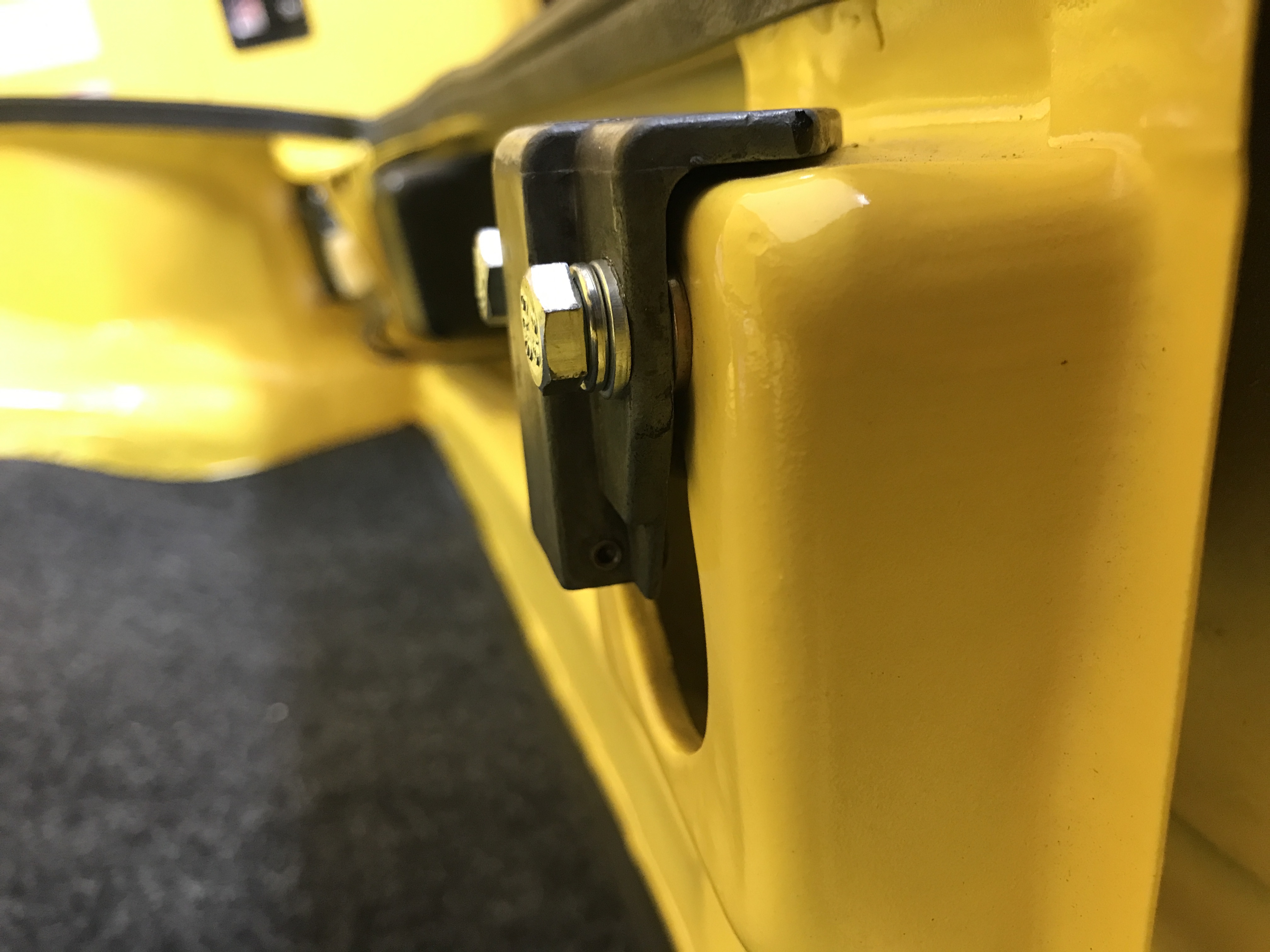

Here are the rubber catches installed in the lower positions.
bkrantz
post Jun 16 2022, 07:07 PM
Post #5553
Posts: 8,343
Joined: 3-August 19
From: SW Colorado
Member No.: 23,343

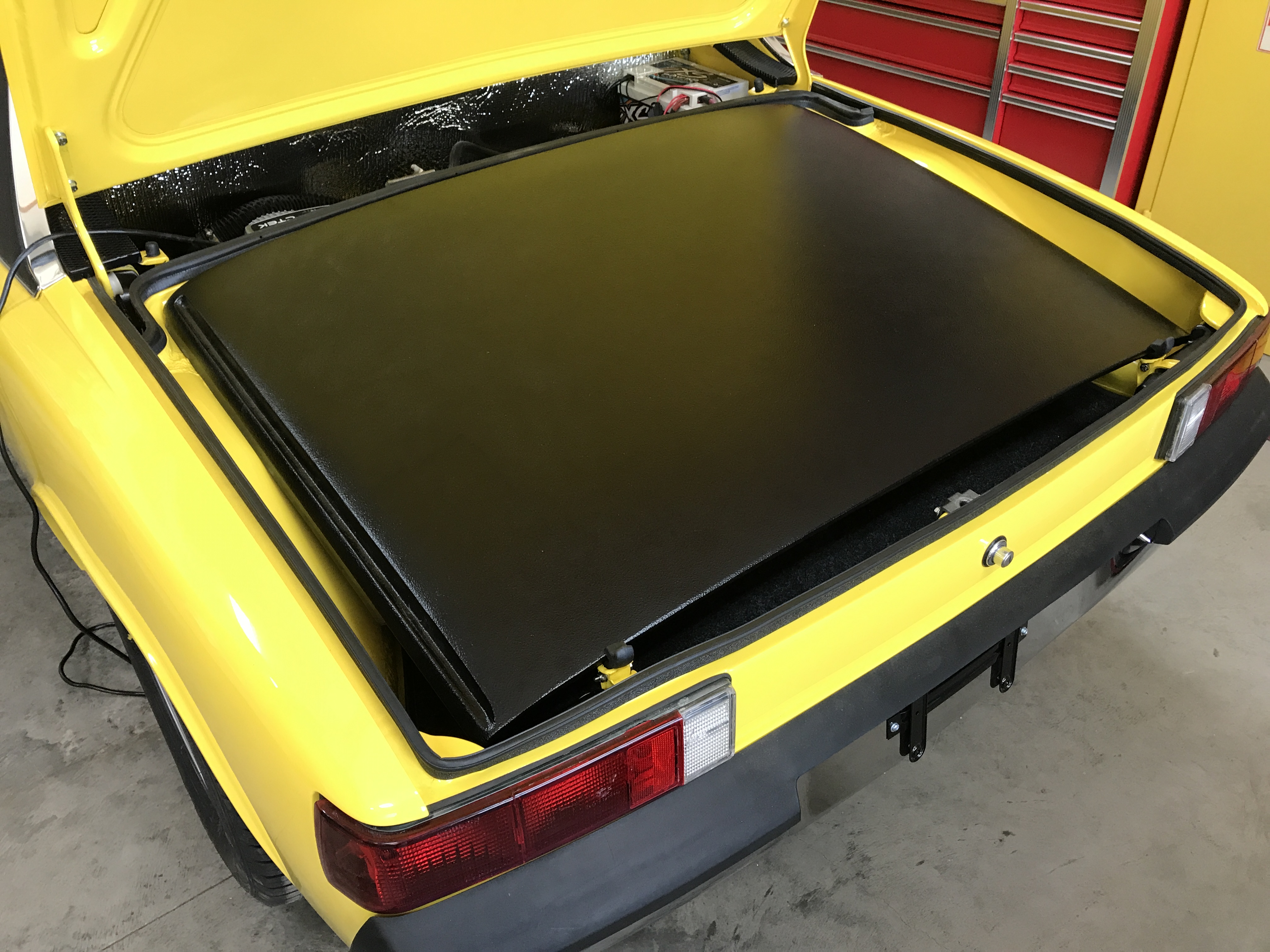

With the top in the trunk, the rear corners still have space above the tail light housings. The sides just make contact with the inner fenders.
bkrantz
post Jun 16 2022, 07:09 PM
Post #5554
Posts: 8,343
Joined: 3-August 19
From: SW Colorado
Member No.: 23,343

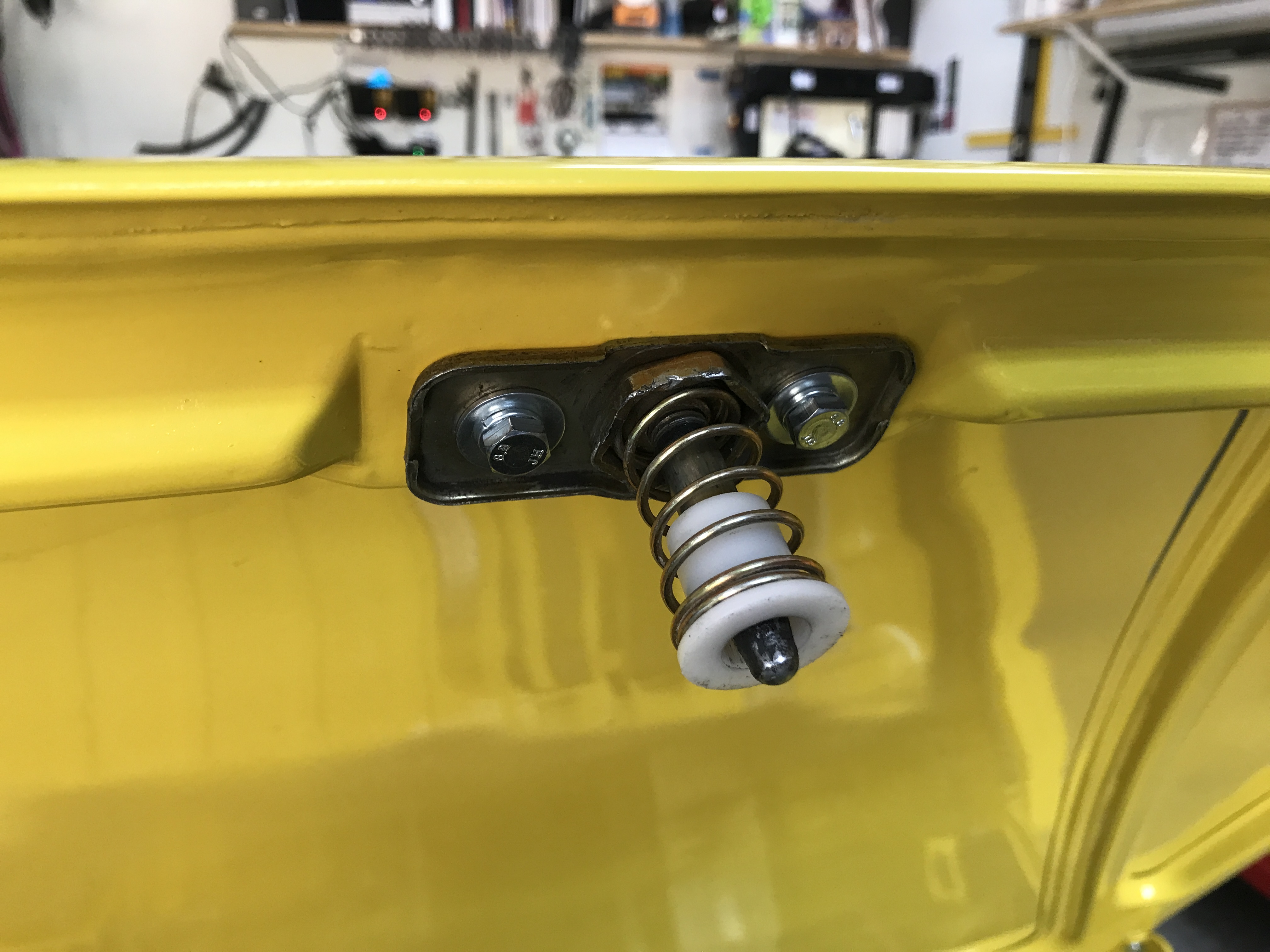

I did some fine tuning on the position and length of the latch pin.
bkrantz
post Jun 16 2022, 07:10 PM
Post #5555
Posts: 8,343
Joined: 3-August 19
From: SW Colorado
Member No.: 23,343
And the position of the latch, with a couple of washers. I did make sure the latch would still release before closing the lid.

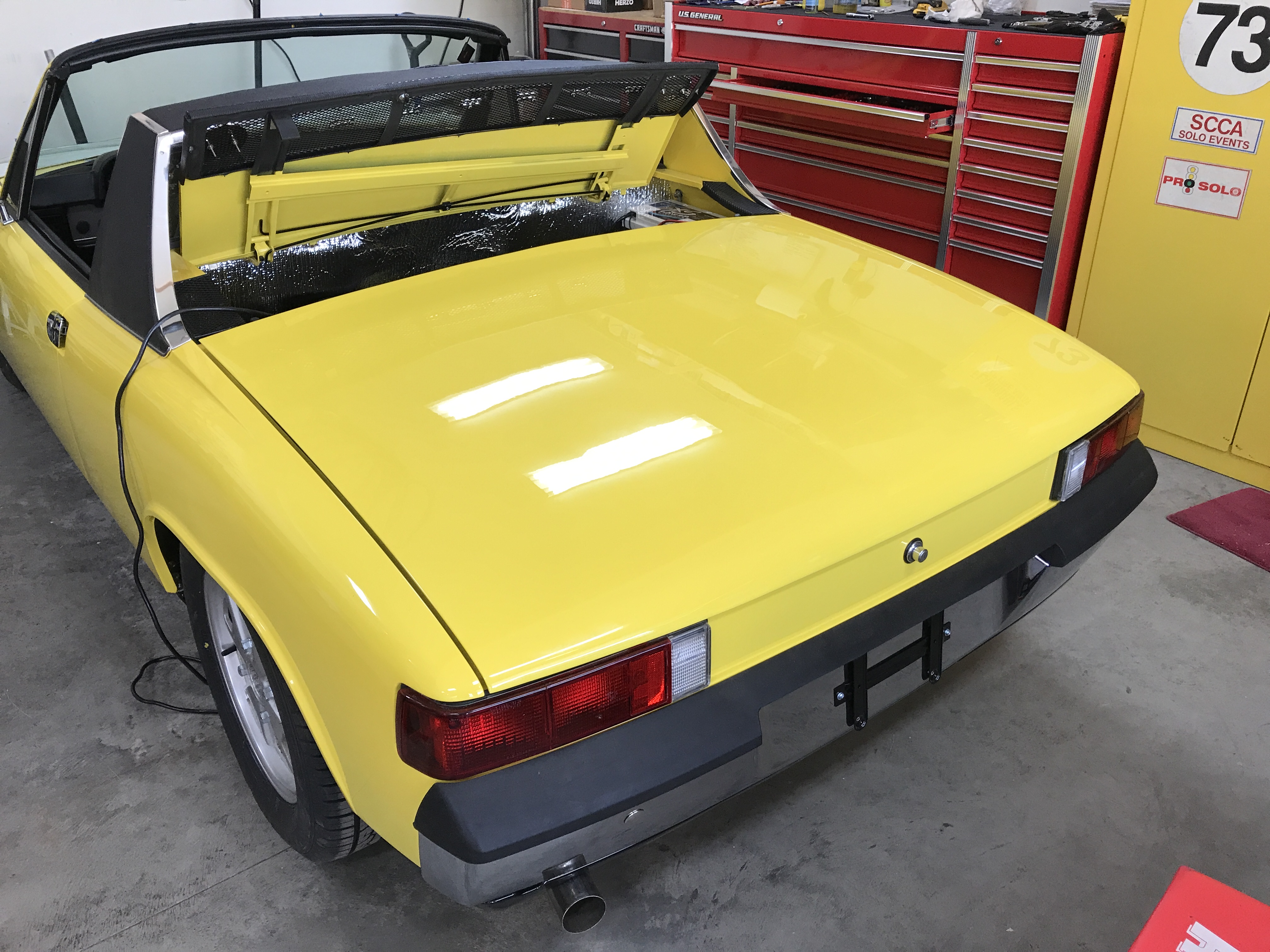

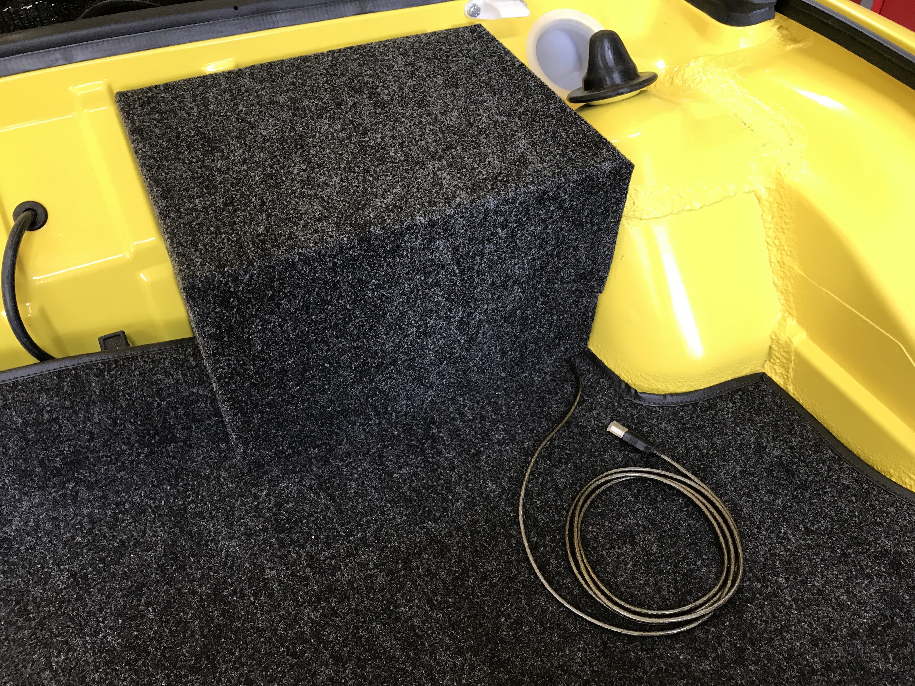

So, here we go: top panel in the trunk.
bkrantz
post Jun 16 2022, 07:14 PM
Post #5557
Posts: 8,343
Joined: 3-August 19
From: SW Colorado
Member No.: 23,343

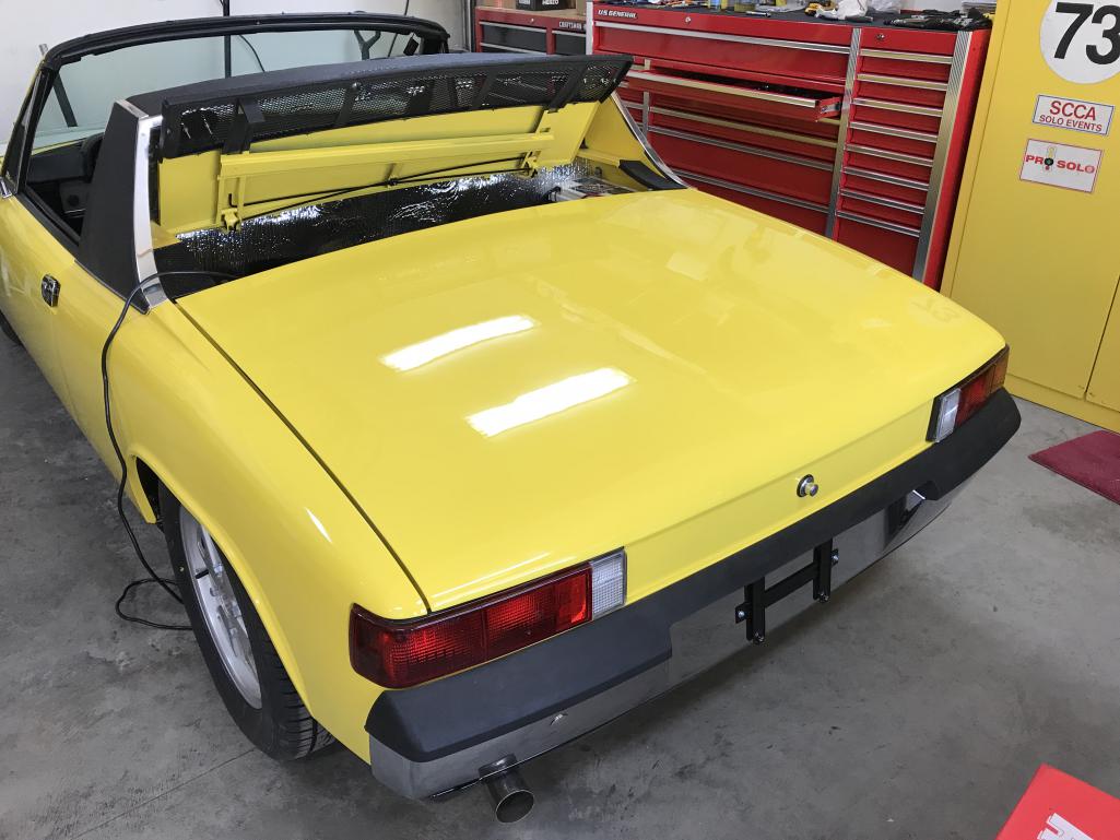

And the trunk lid closes without a fuss.
bkrantz
post Jun 16 2022, 07:17 PM
Post #5558
Posts: 8,343
Joined: 3-August 19
From: SW Colorado
Member No.: 23,343

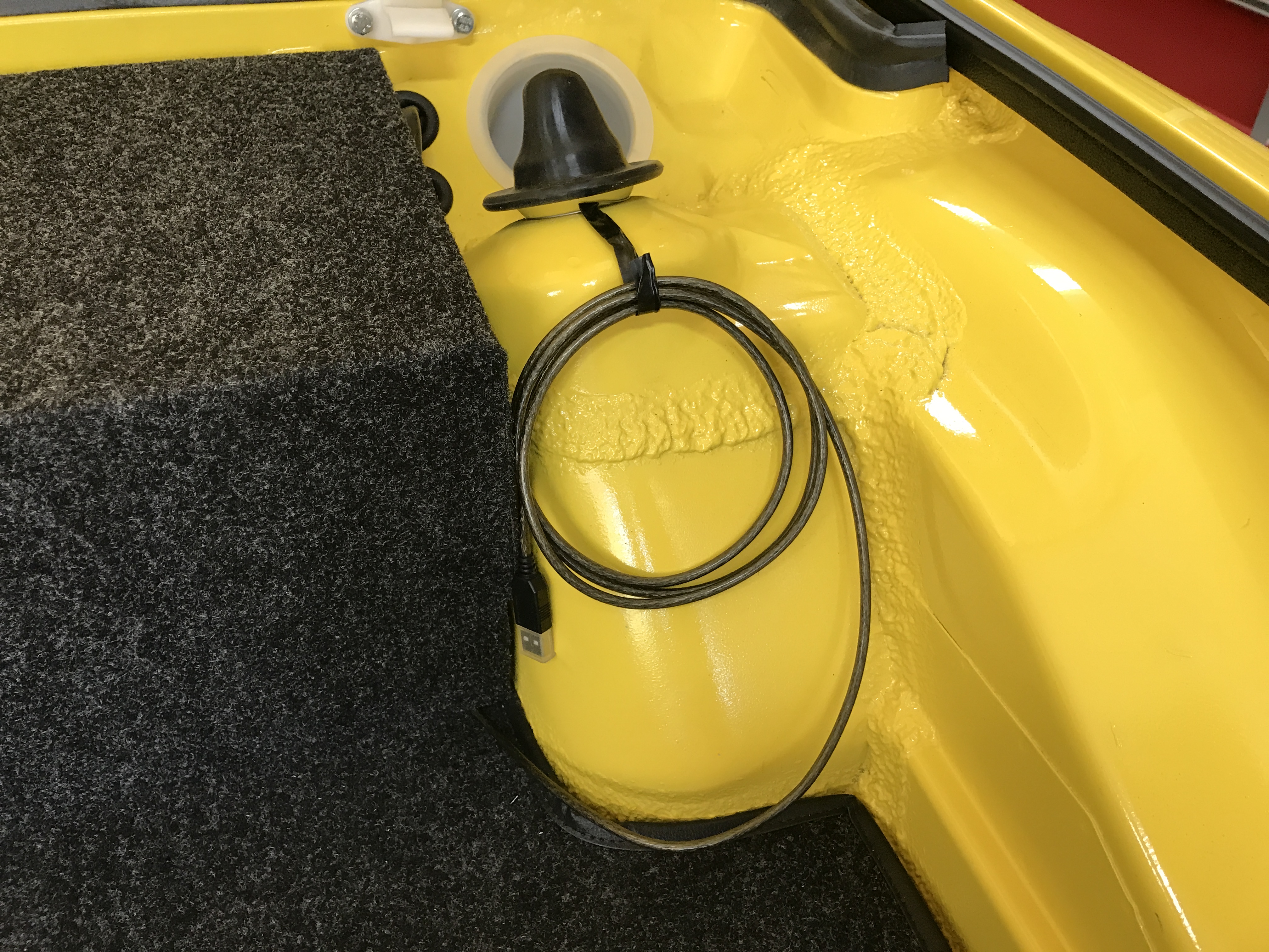

Before I closed things up, I attached the USB cable for the Megasquirt ECU.
bkrantz
Post #5559
Posts: 8,343
Joined: 3-August 19
From: SW Colorado
Member No.: 23,343
But can't leave it on the trunk floor, so I made a quick hook.
