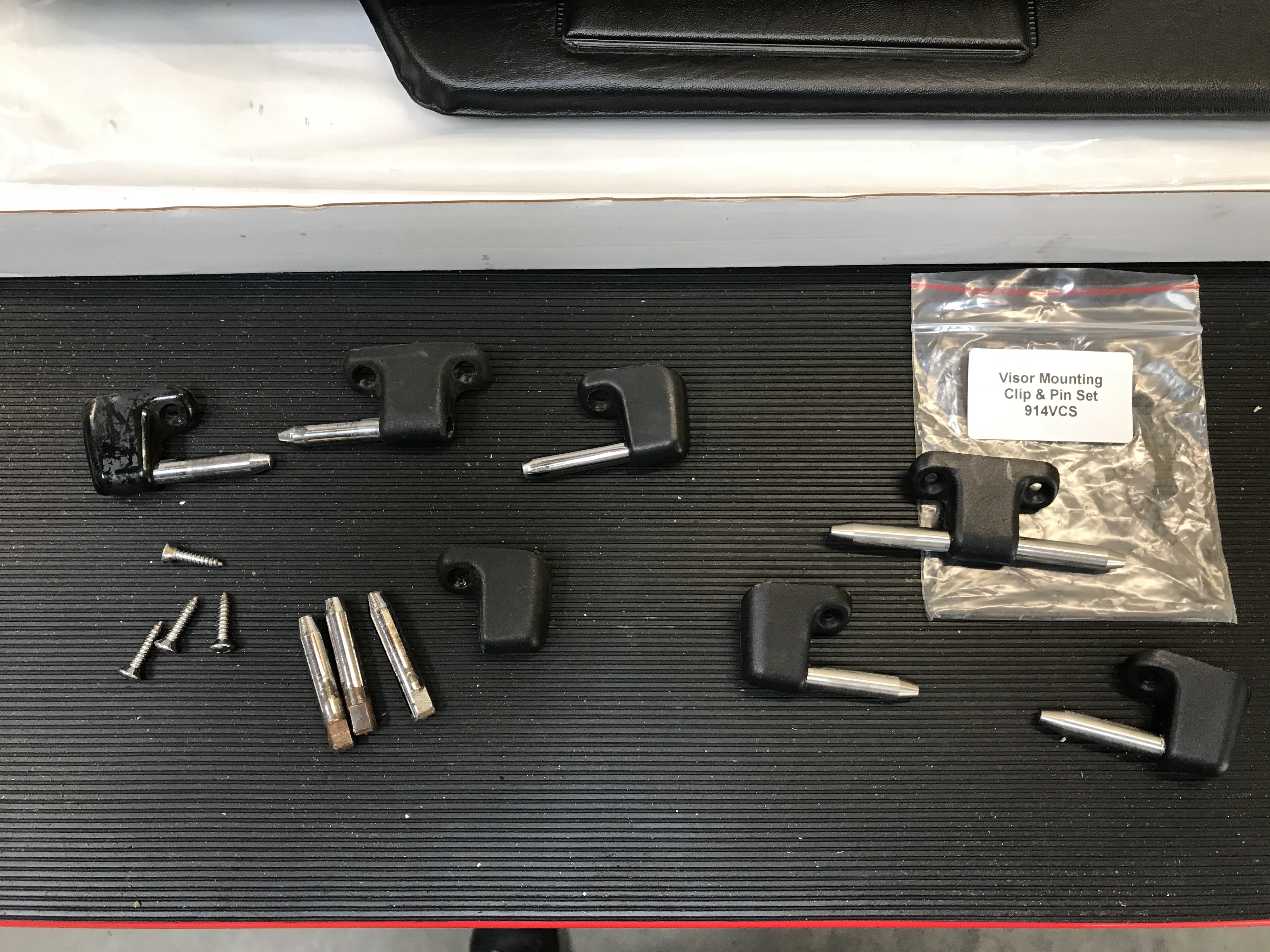

I also got out the mounting hardware. Some was on the car, other pieces I got from various sources, plus a new set. Let's go with that, so everything matches.
bkrantz
post Jun 18 2022, 08:10 PM
Post #5582
Posts: 8,343
Joined: 3-August 19
From: SW Colorado
Member No.: 23,343

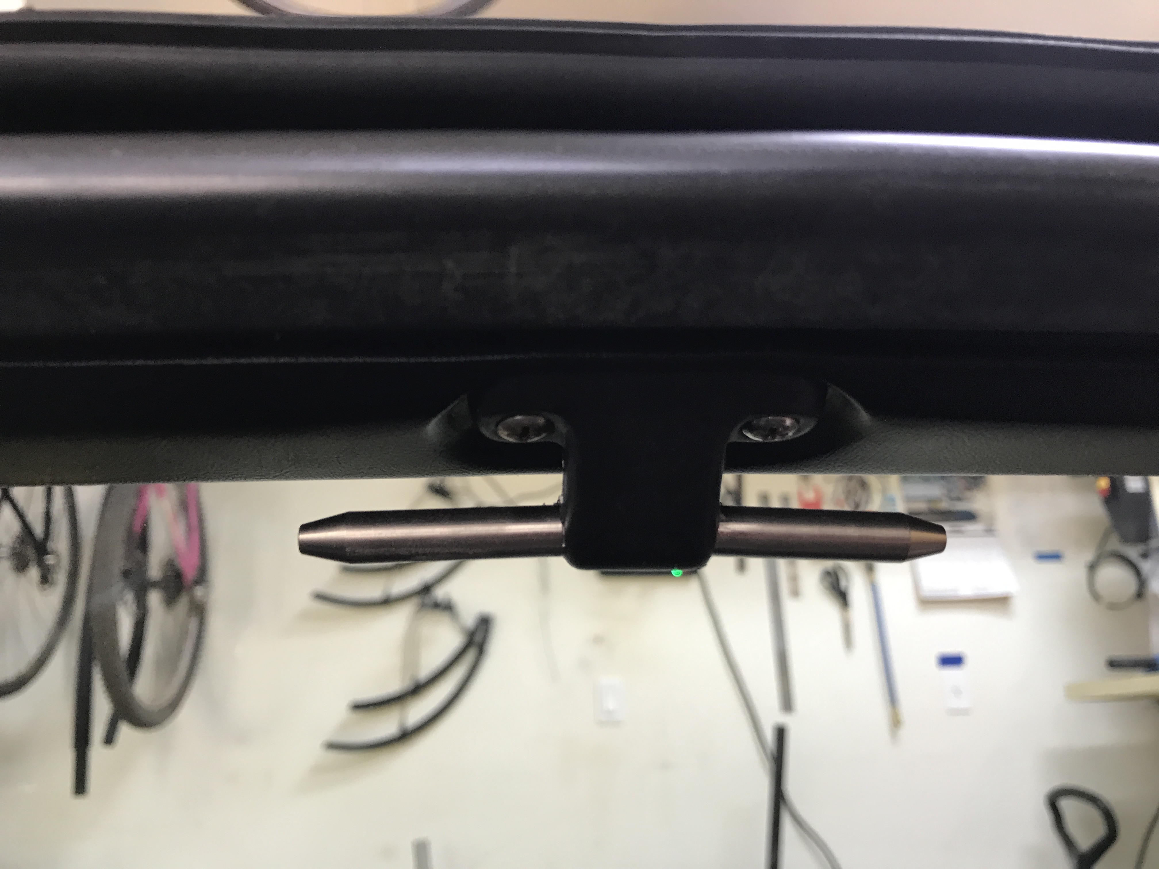

I started with the center mount.
bkrantz
post Jun 18 2022, 08:11 PM
Post #5583
Posts: 8,343
Joined: 3-August 19
From: SW Colorado
Member No.: 23,343

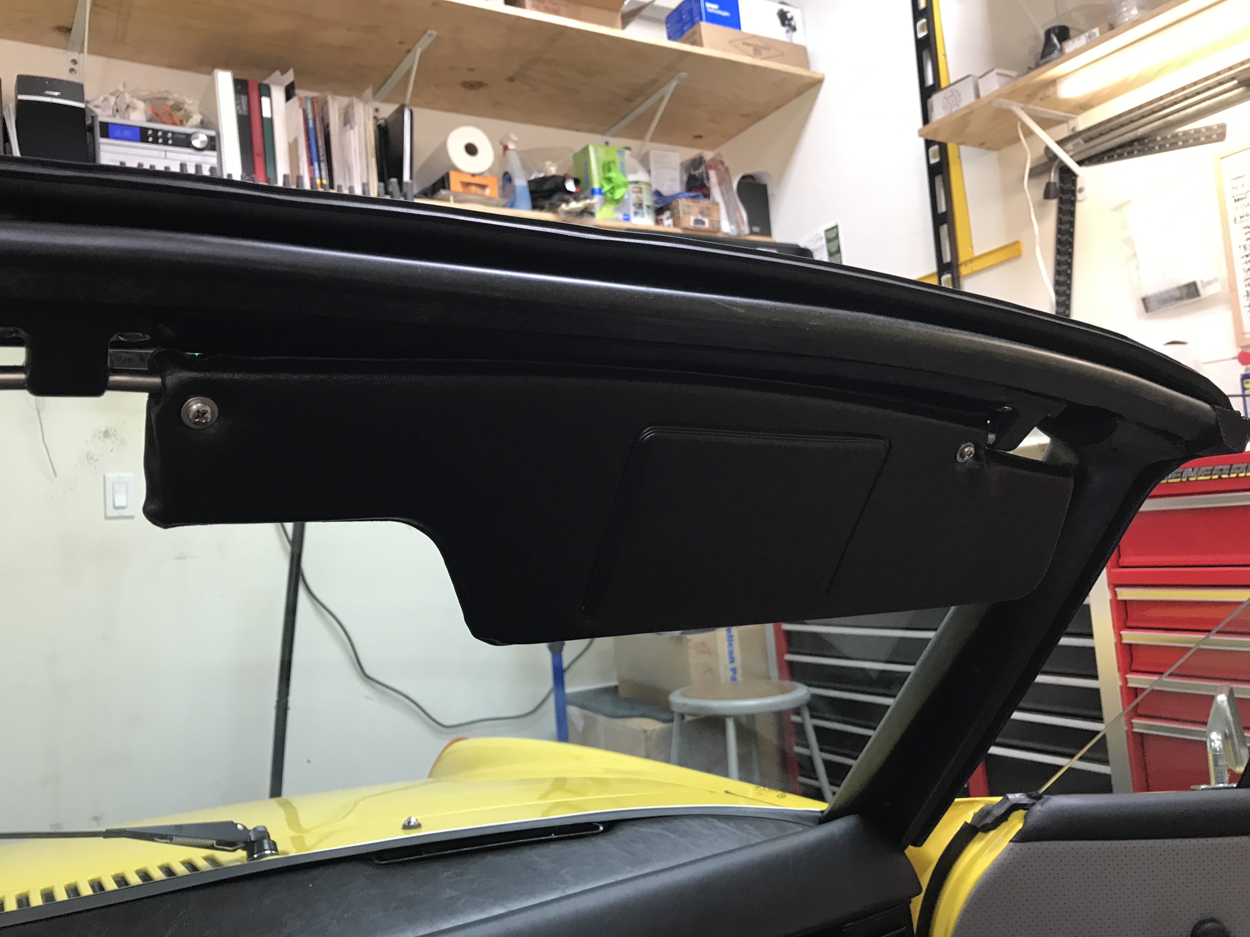

Then the right visor and mount.
bkrantz
post Jun 18 2022, 08:13 PM
Post #5584
Posts: 8,343
Joined: 3-August 19
From: SW Colorado
Member No.: 23,343

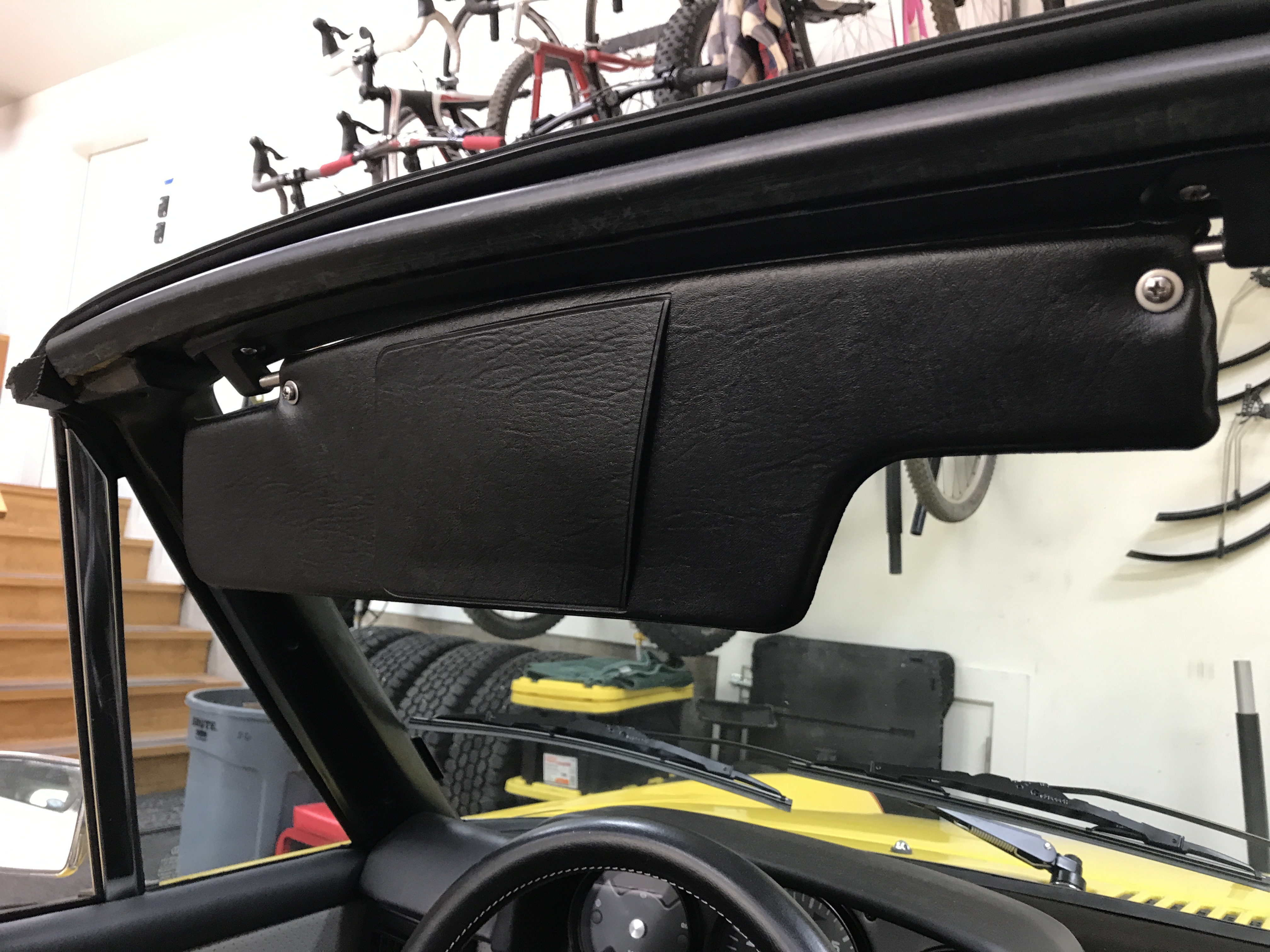

Followed by the left visor and mount. I then adjusted the tension on the visor clamp screws.
bkrantz
Post #5585
Posts: 8,343
Joined: 3-August 19
From: SW Colorado
Member No.: 23,343

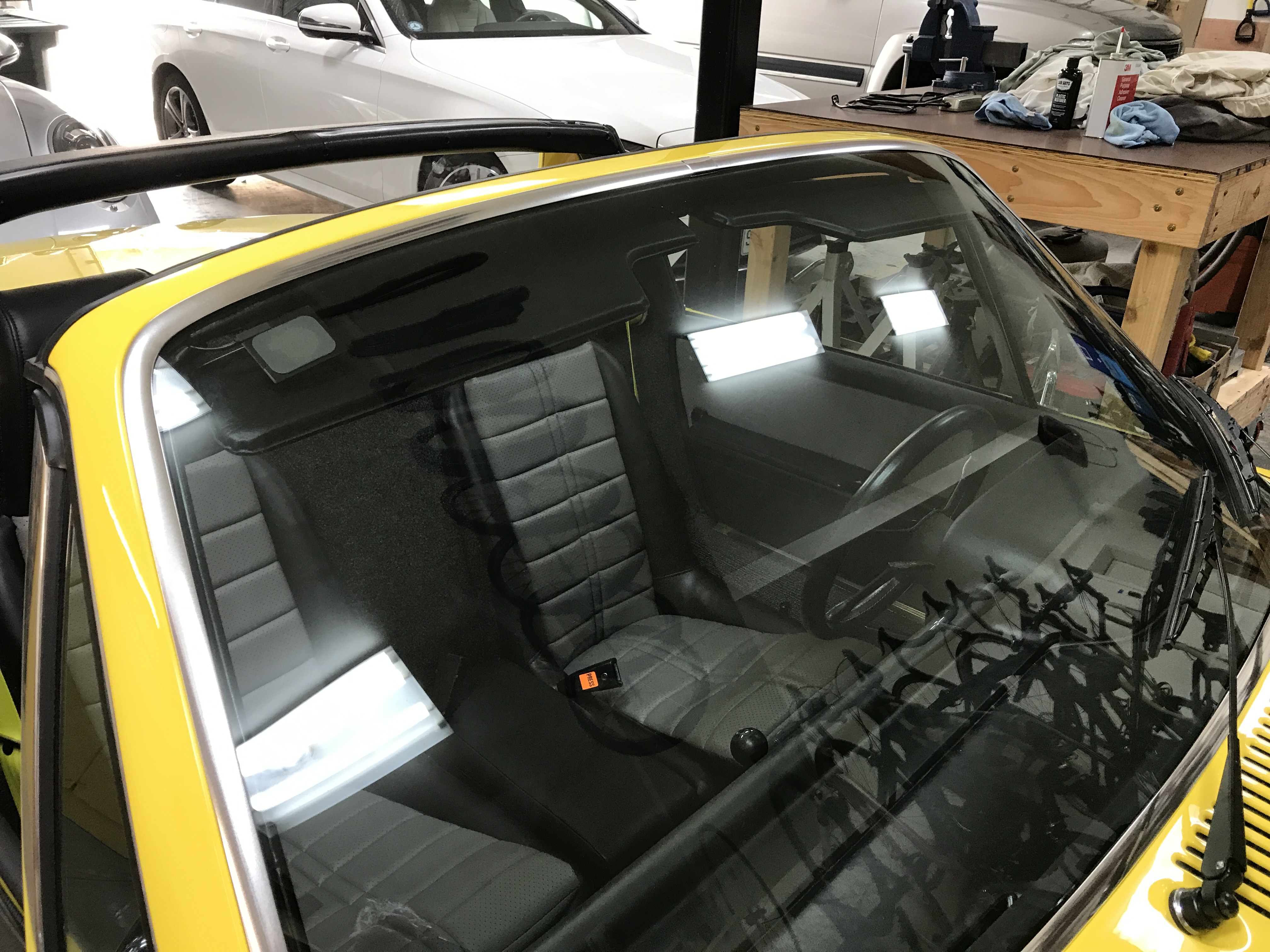

Visors on.

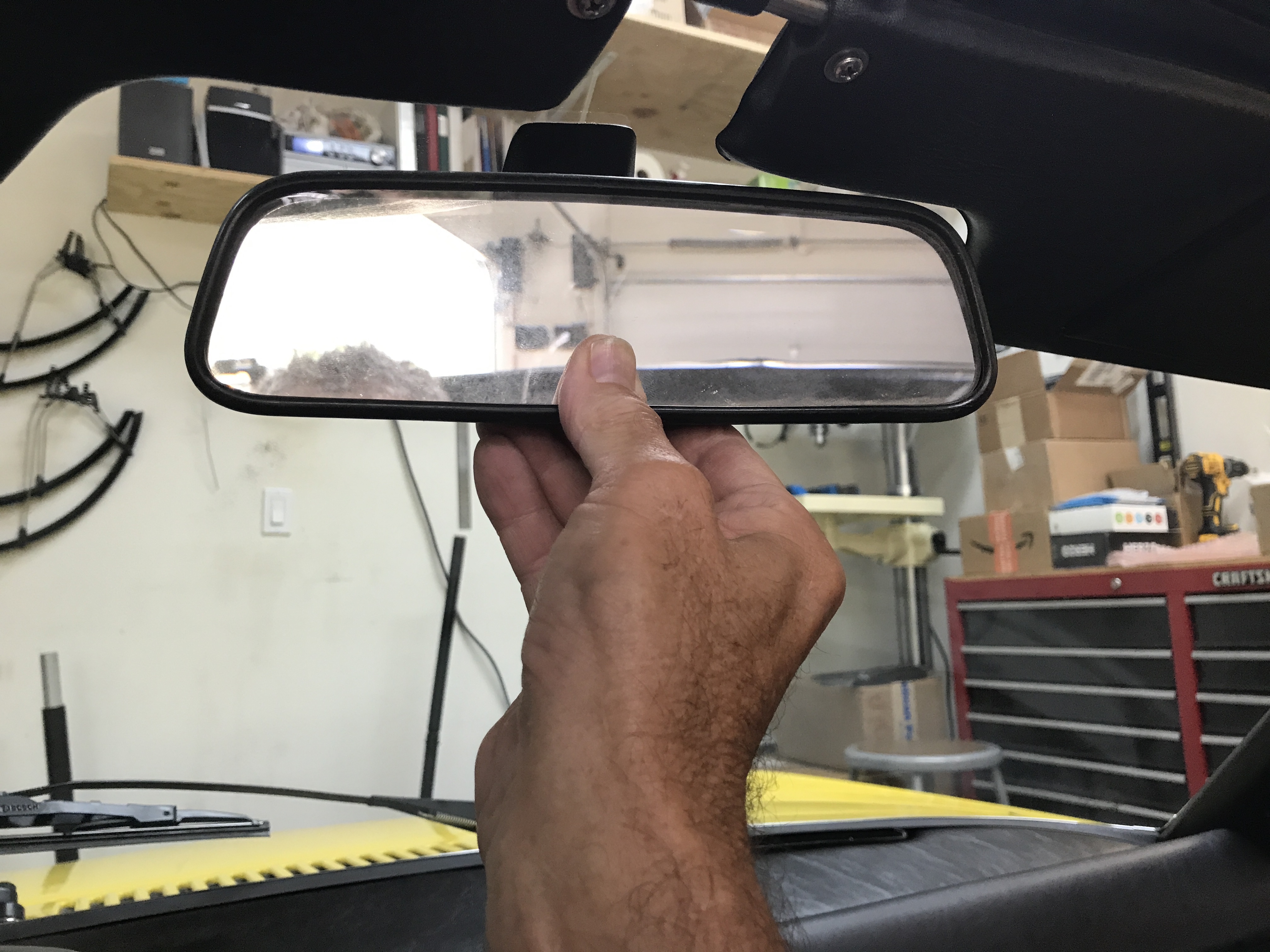

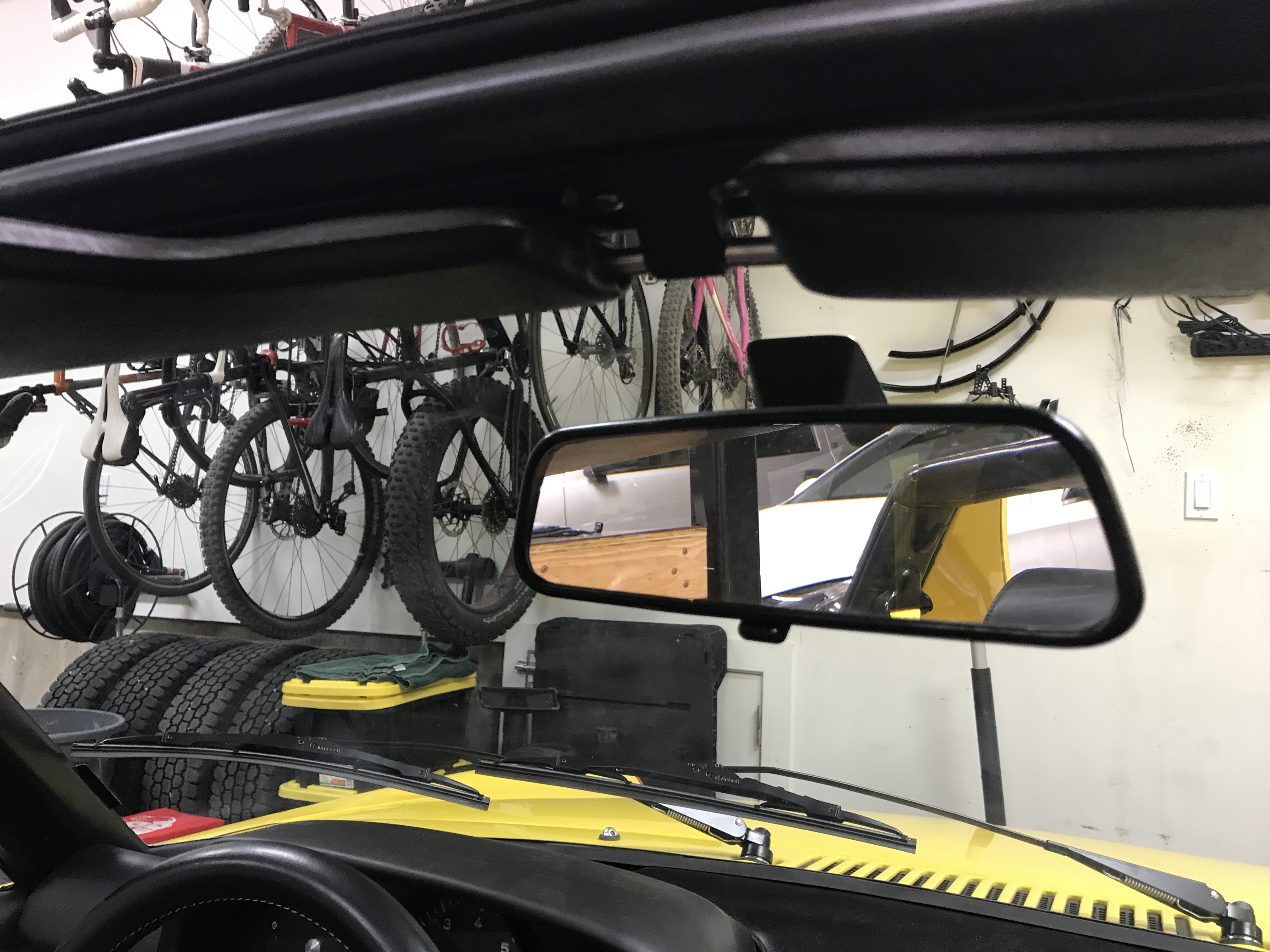

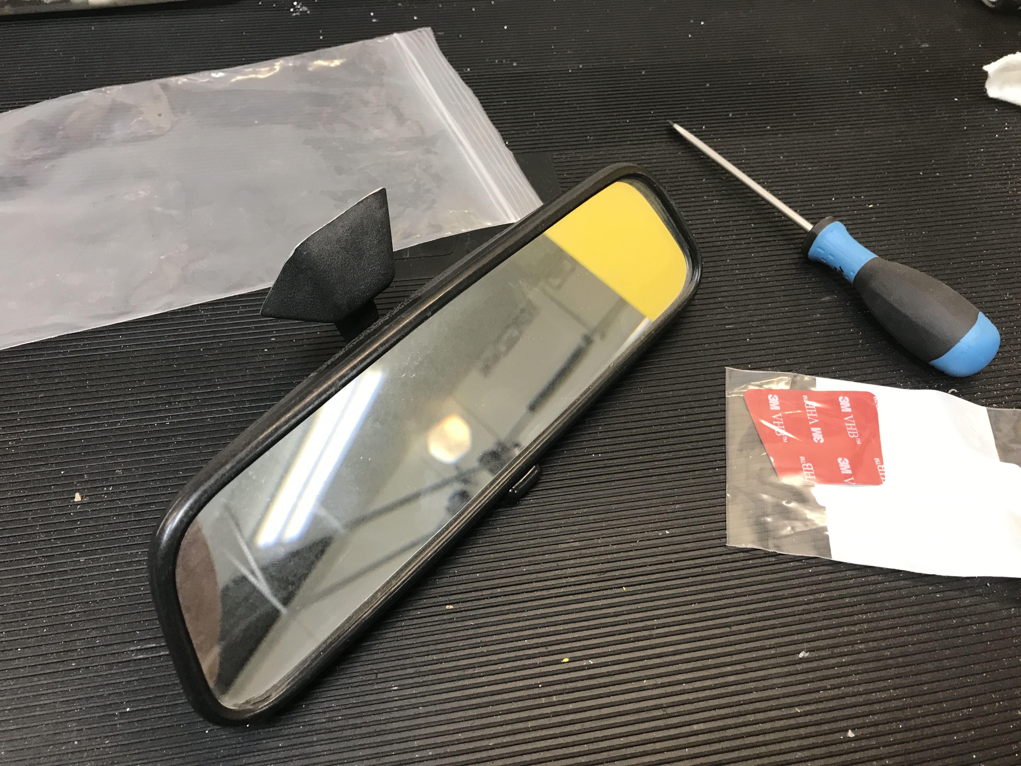

Then start checking mirror position. I am a bit concerned because the stock mirror arm does not adjust for height. As a tall guy, I want the mirror above my sightline out the windshield. But I know it must be low enough to see out the back window, below the targa bar, and low enough to clear the visors.

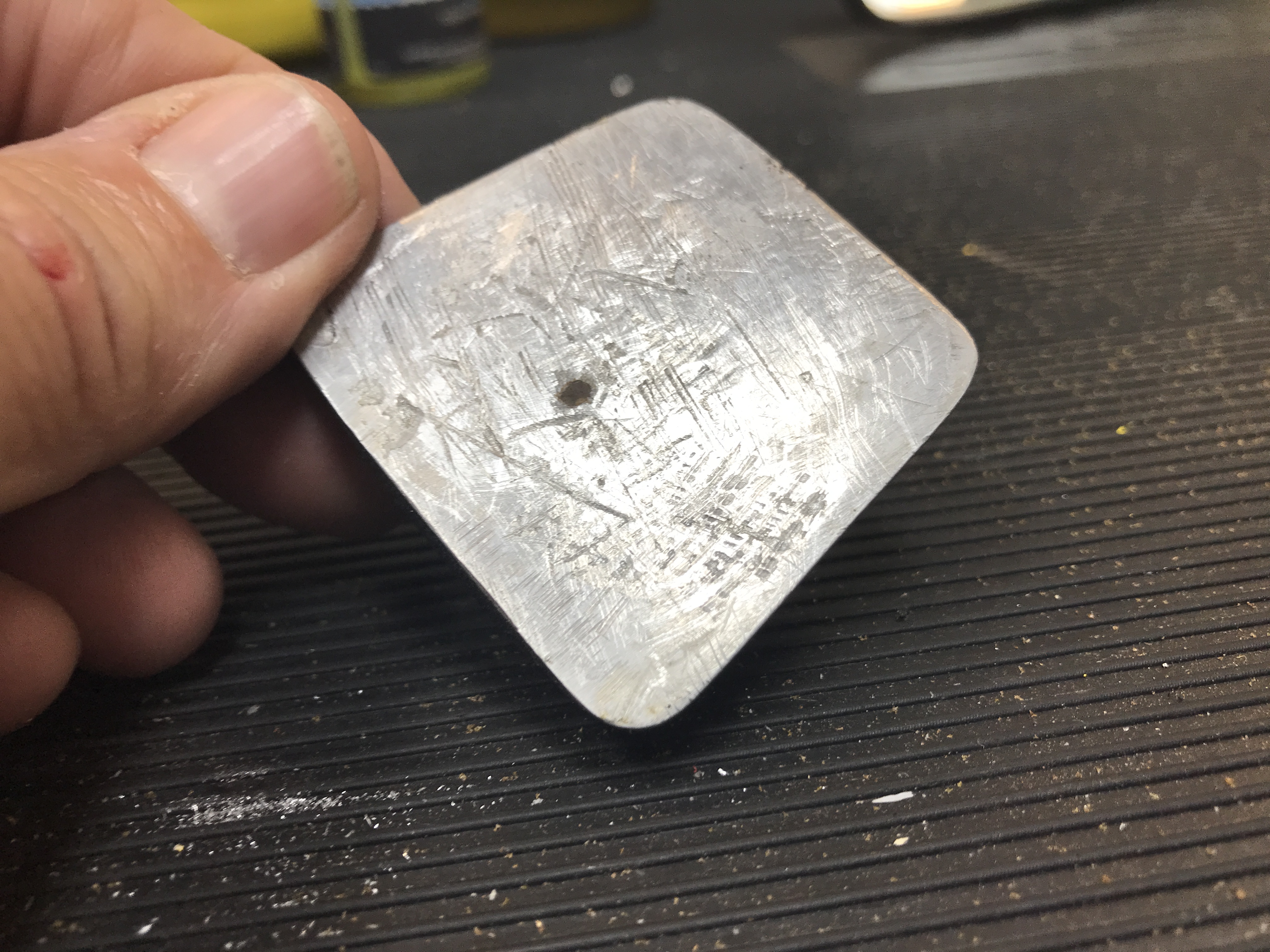

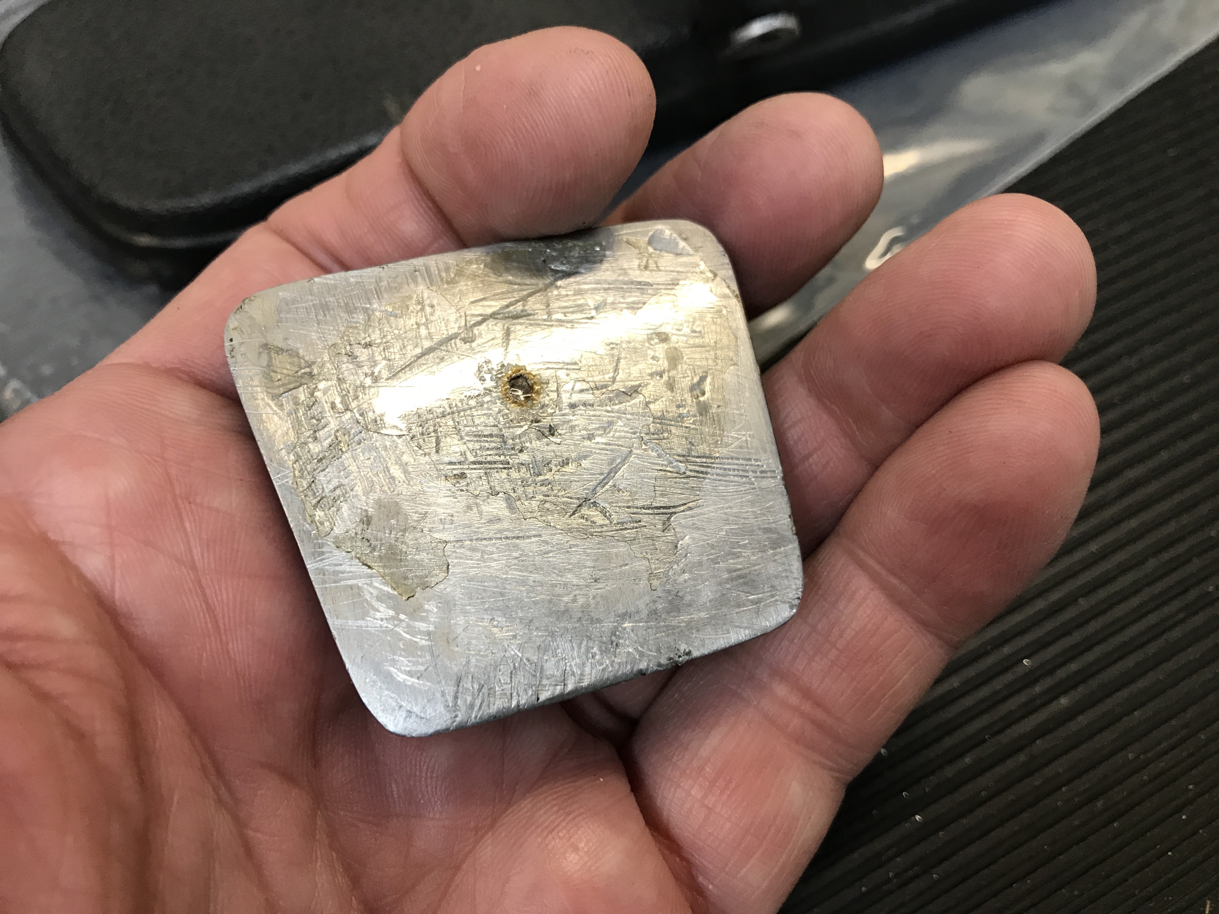

Before mounting, the mirror needs some work. The PO (of this mirror) used glue for mounting.
bkrantz
post Jun 18 2022, 08:20 PM
Post #5589
Posts: 8,343
Joined: 3-August 19
From: SW Colorado
Member No.: 23,343

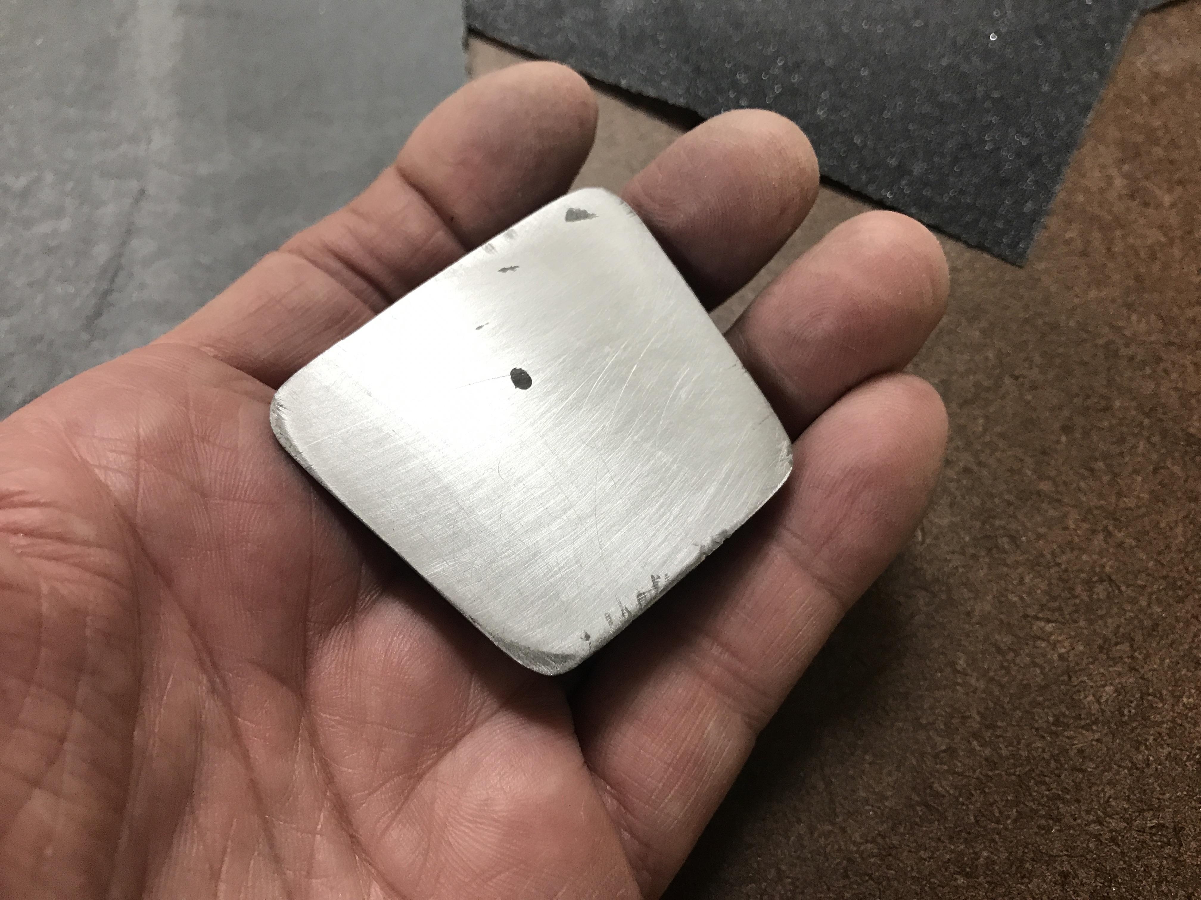

After shaving and dissolving off the glue, the mounting base still looks pretty nasty. What do yo think the PO was up to?
bkrantz
post Jun 18 2022, 08:21 PM
Post #5590
Posts: 8,343
Joined: 3-August 19
From: SW Colorado
Member No.: 23,343
I was able to sand out most of the scratches.

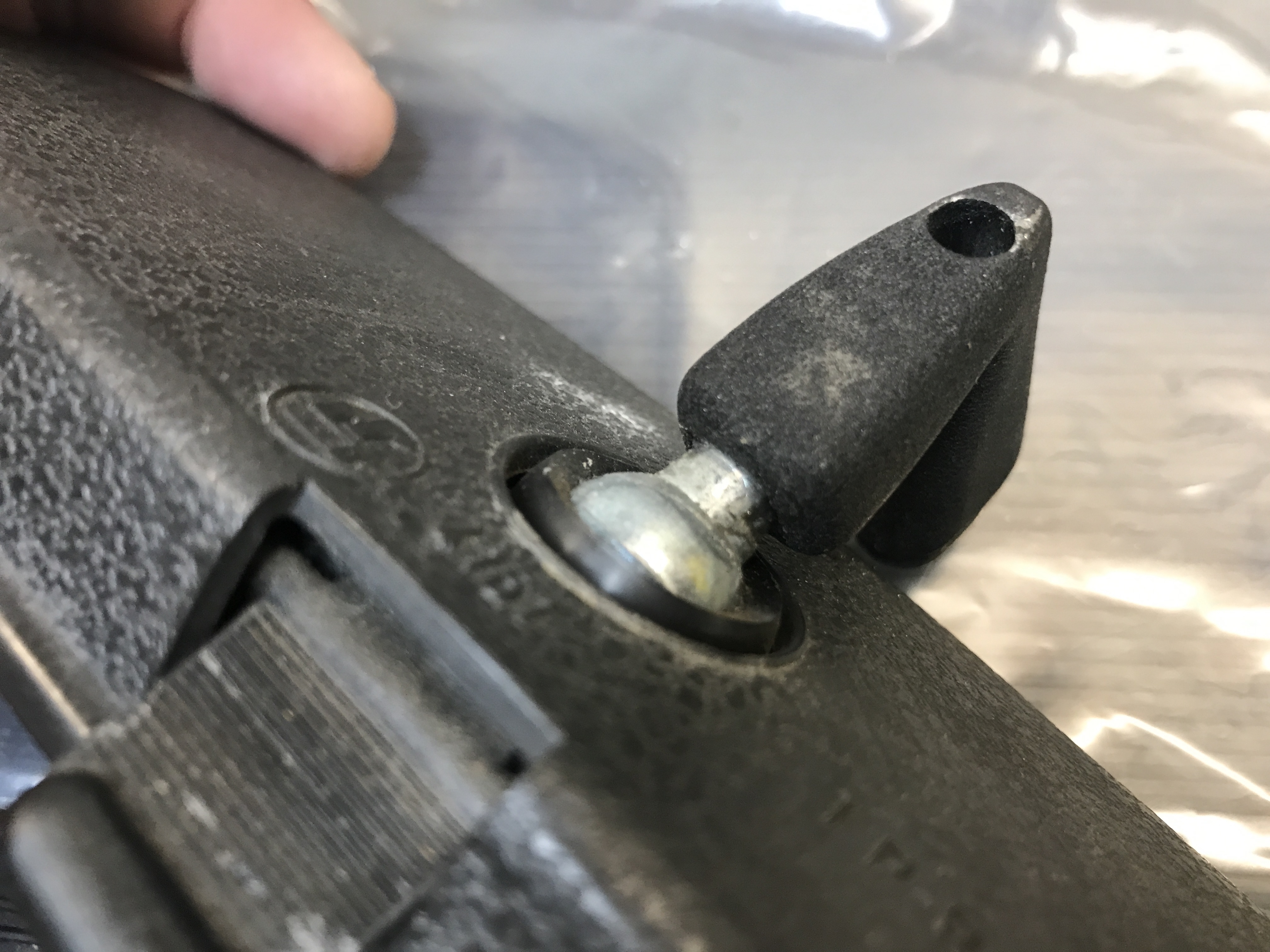

Meanwhile, I noticed that the stud from the mirror ball joint wobbles a bit in the arm.

Perhaps a bit of penetrating Loctite will fix that. Find out tomorrow.

The Loctite worked, and the mirror arm has no play, so time to install it.

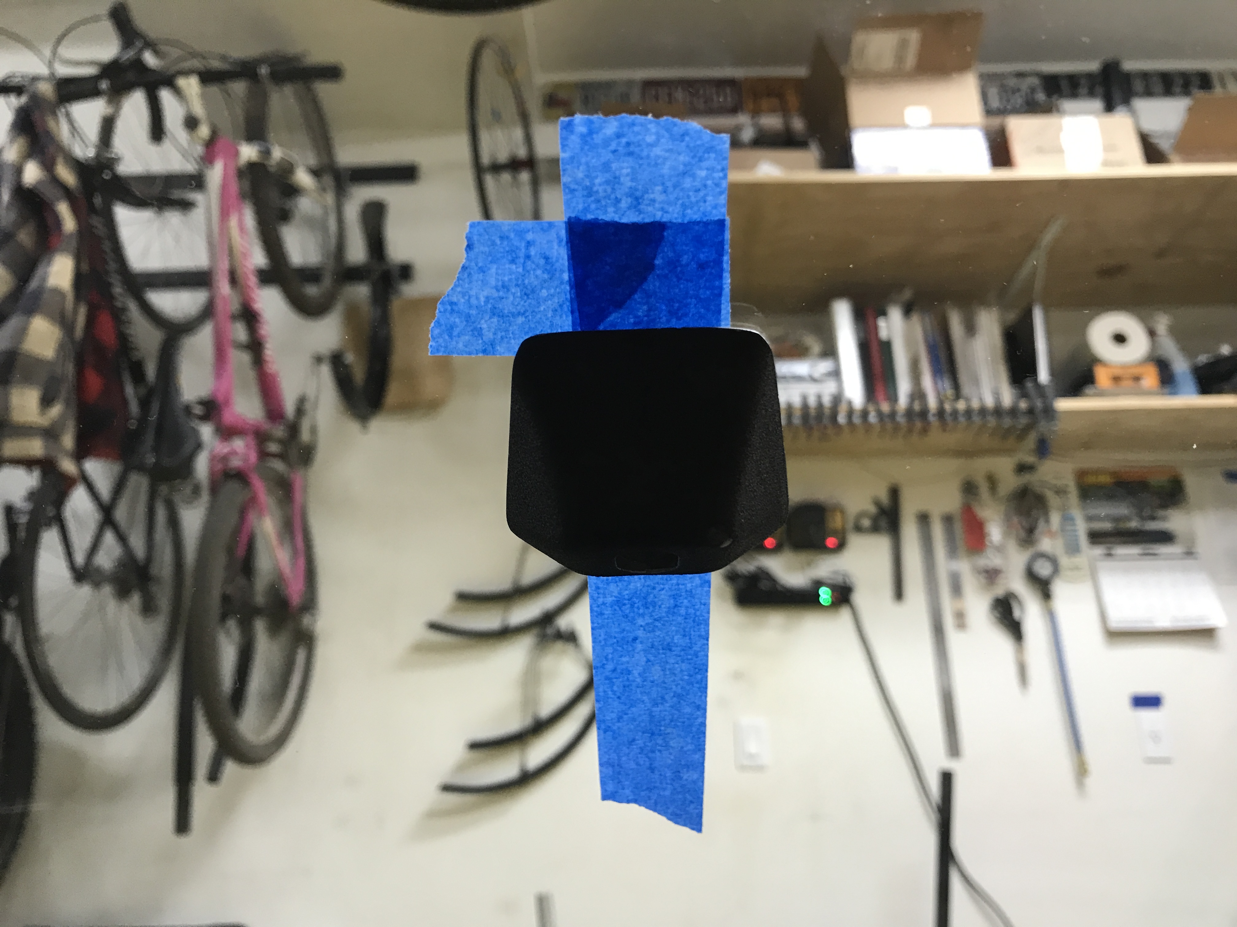

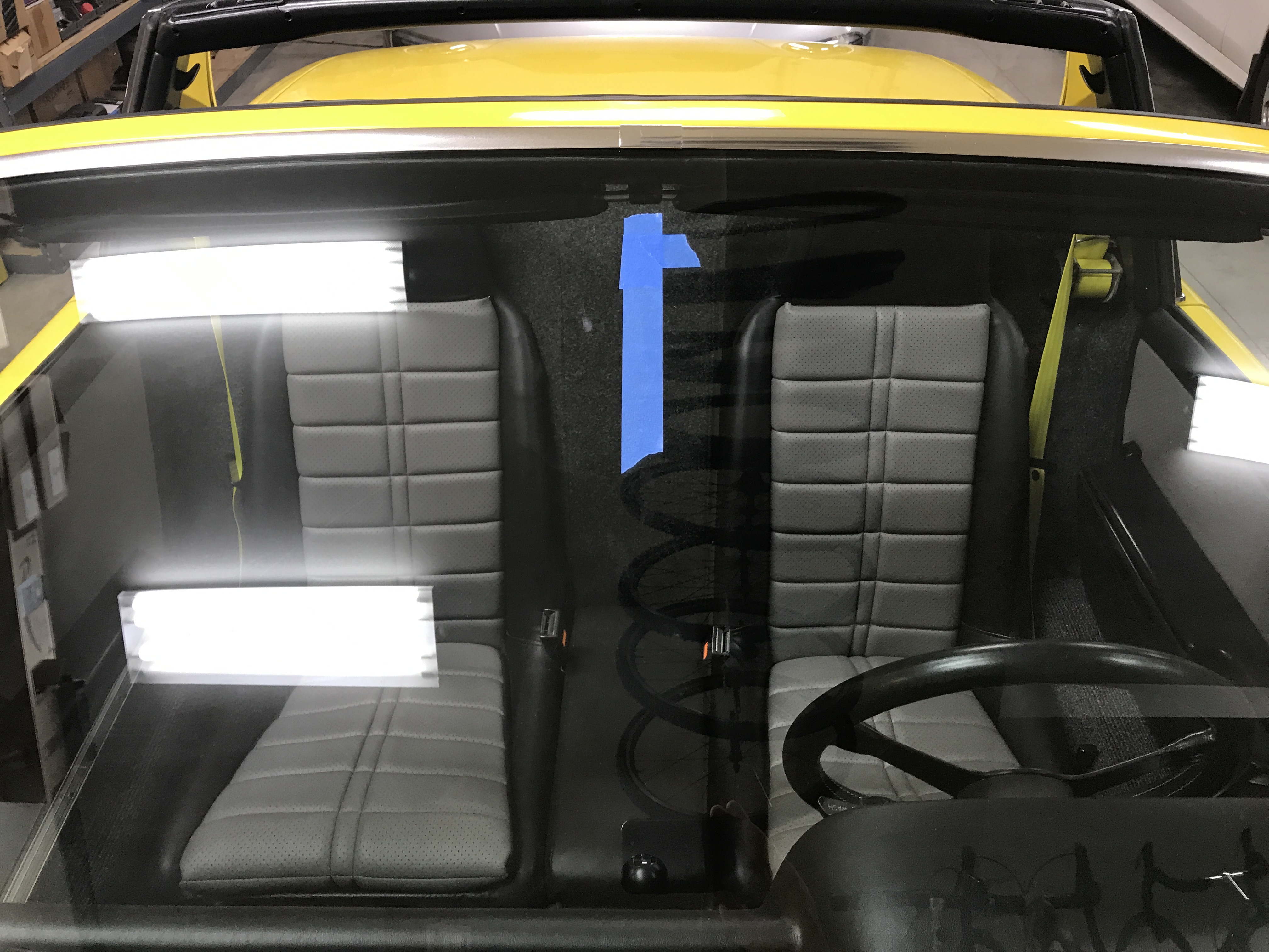

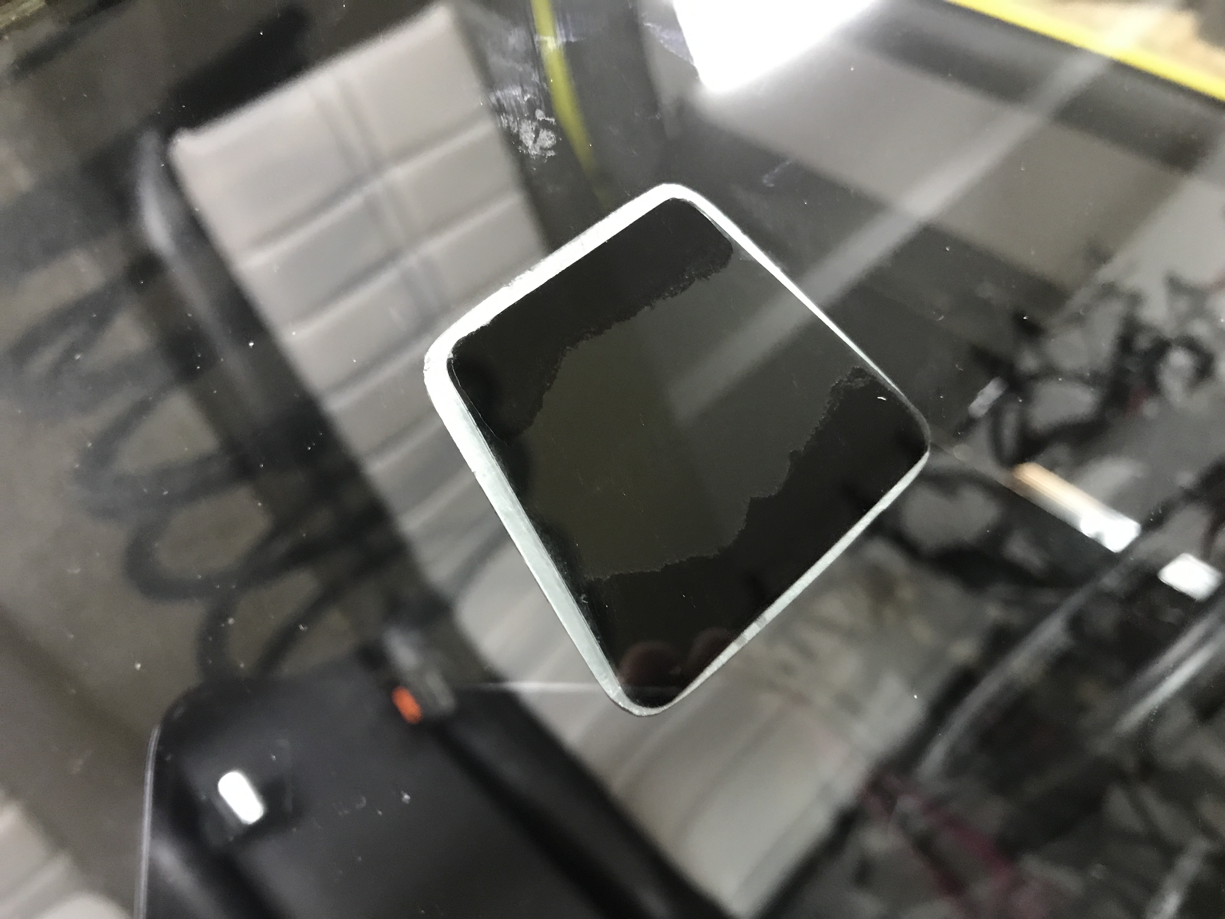

I marked the center, and the stock height.
bkrantz
post Jun 19 2022, 07:20 PM
Post #5595
Posts: 8,343
Joined: 3-August 19
From: SW Colorado
Member No.: 23,343

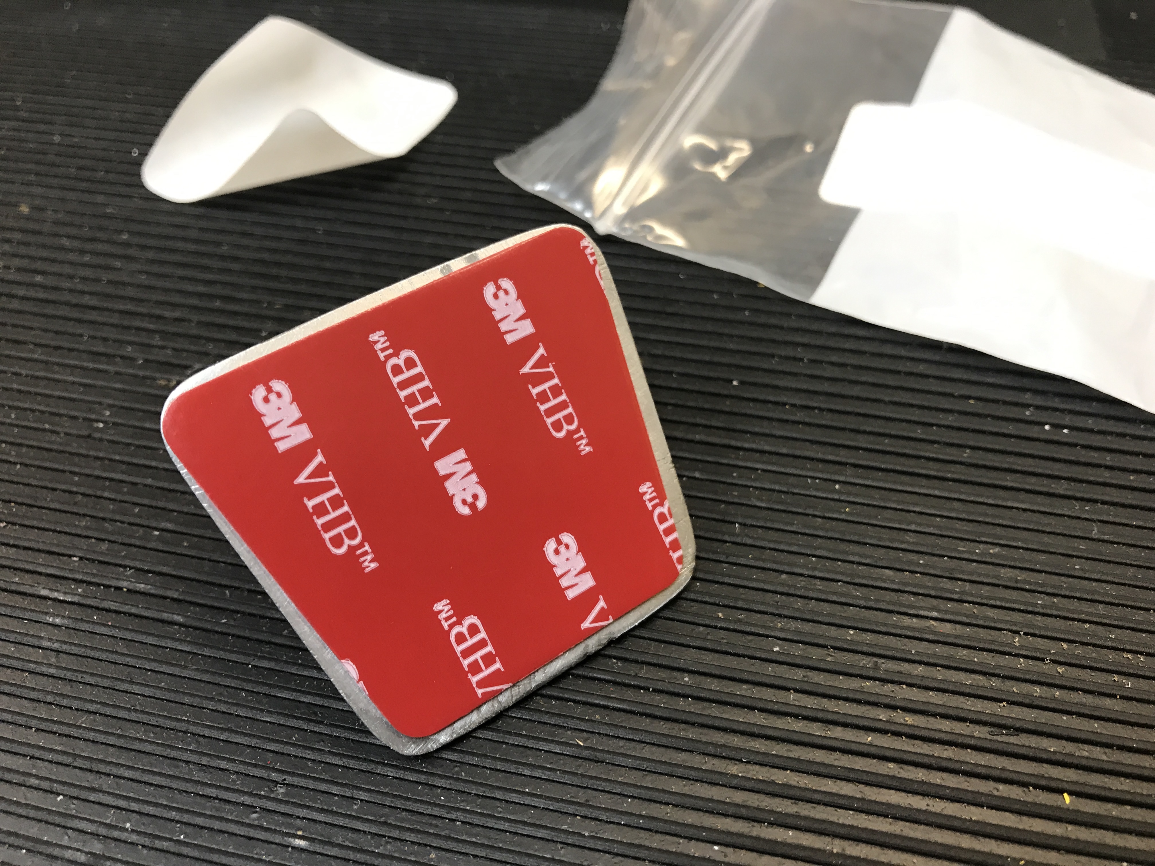

I removed the arm from the base, and stuck on the adhesive pad.
bkrantz
post Jun 19 2022, 07:21 PM
Post #5596
Posts: 8,343
Joined: 3-August 19
From: SW Colorado
Member No.: 23,343
I mounted the base just a bit higher than spec, just enough to provide clearance for the right visor to swing through to the inside of the windshield.
bkrantz
post Jun 19 2022, 07:25 PM
Post #5597
Posts: 8,343
Joined: 3-August 19
From: SW Colorado
Member No.: 23,343
But after pushing as hard as I dared, I could not get the entire base adhered. Essentially the base is too flat to match the curve of the glass. I did sand the base, but even before that is was flat.
Argh. I will order another adhesive pad, and try again after I sand a bit of a curve into the base.

Member No.: 23,343
Anyway, the mirror is stuck on for now. The position still seems OK, at least as far as I can tell sitting in the car in the garage.
