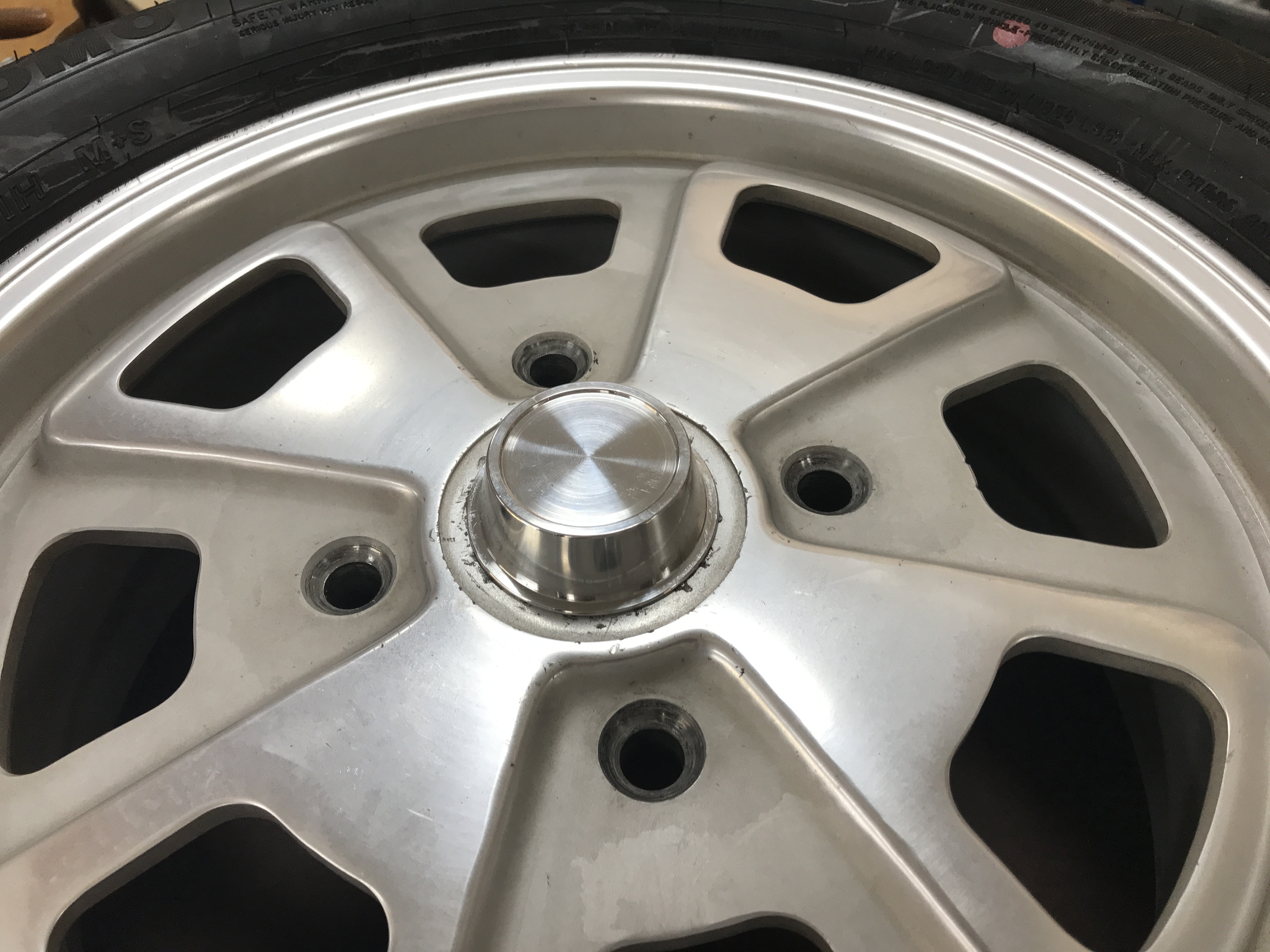

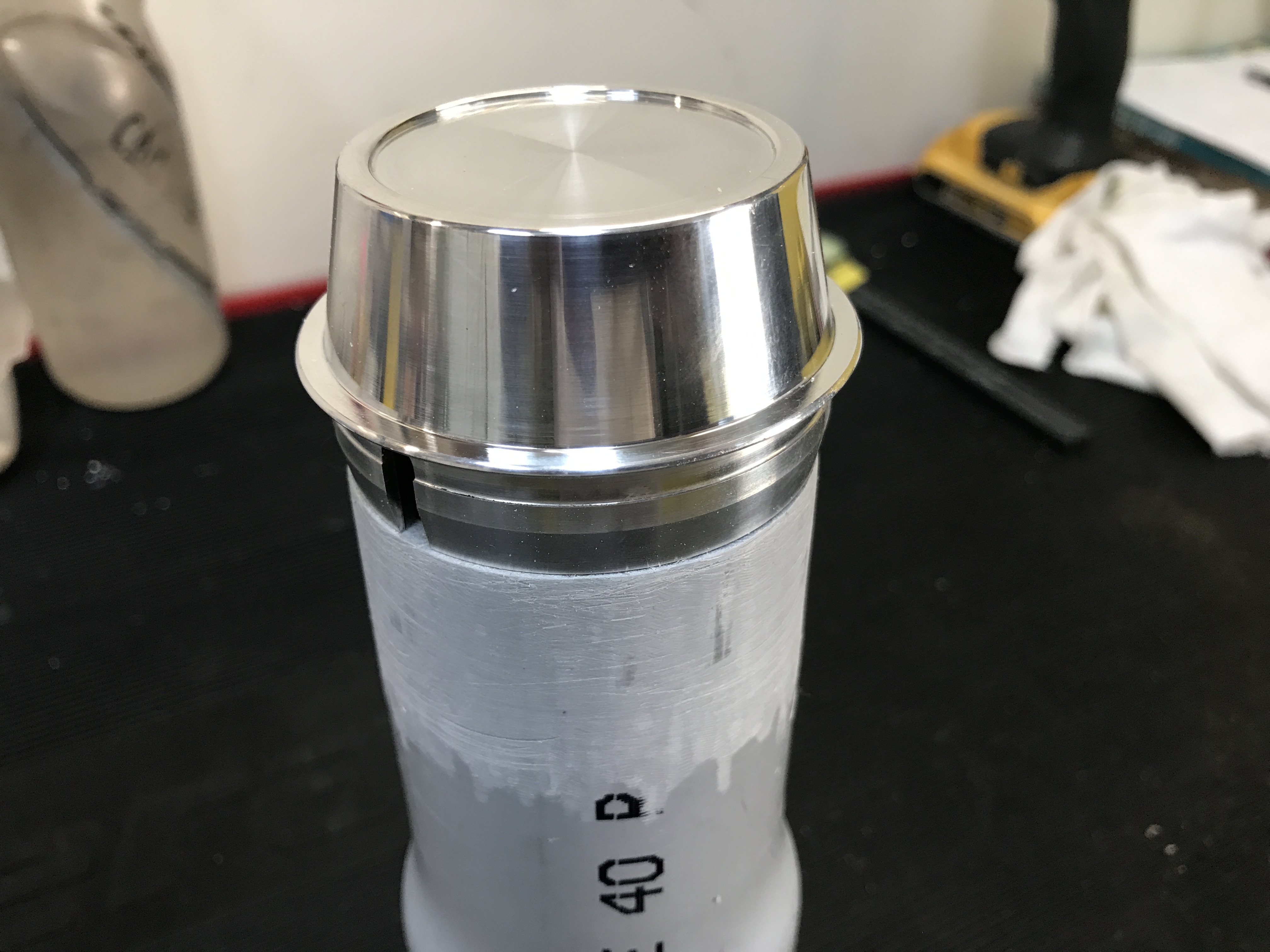

The big end is a perfect fit on the outside flange.
bkrantz
post Jun 21 2022, 07:55 PM
Post #5622
Posts: 8,343
Joined: 3-August 19
From: SW Colorado
Member No.: 23,343

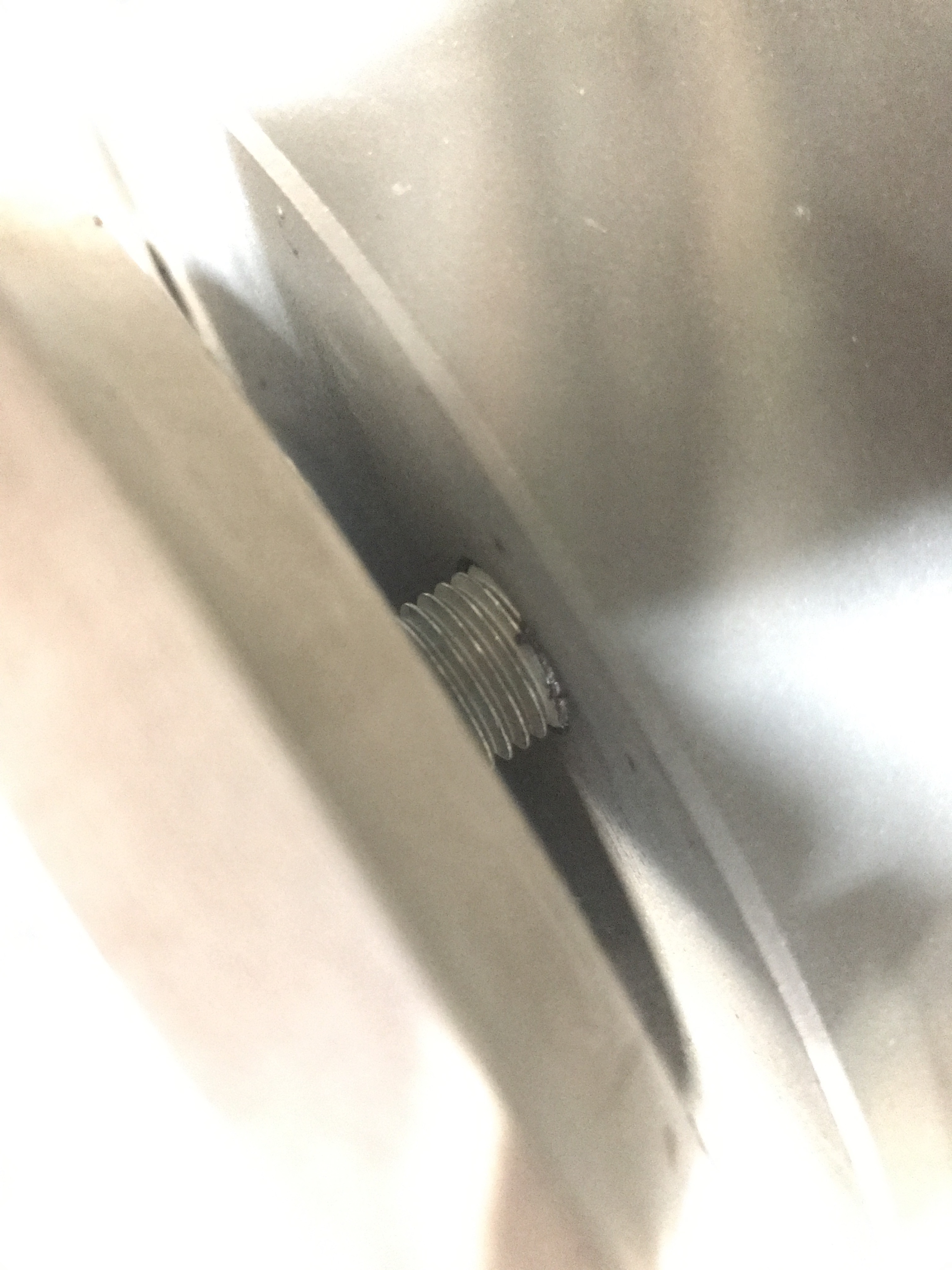

And the small end matches the internal flanges.
bkrantz
post Jun 21 2022, 07:57 PM
Post #5623
Posts: 8,343
Joined: 3-August 19
From: SW Colorado
Member No.: 23,343

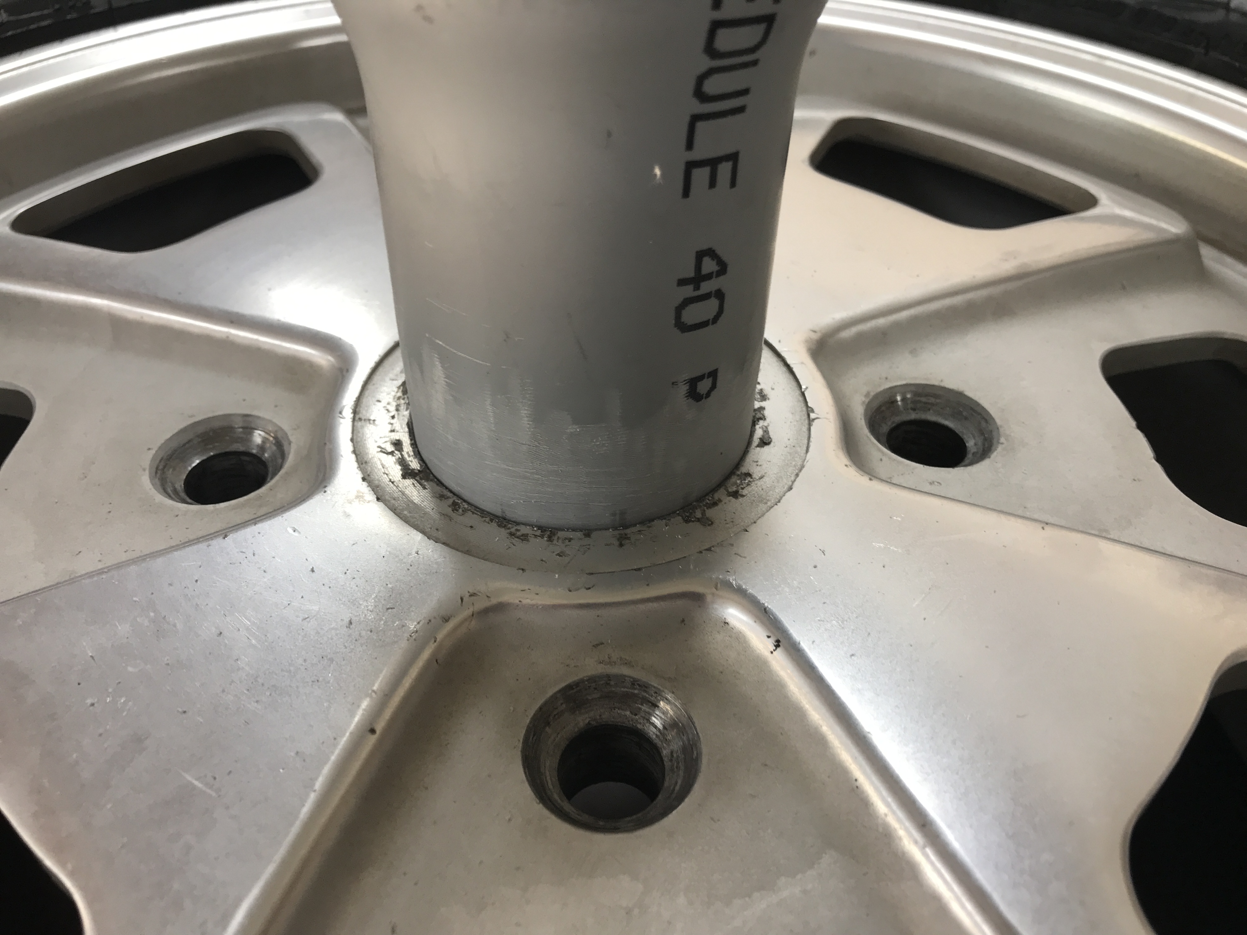

With just a bit of filing and sanding, it fits into the wheel center opening.
bkrantz
post Jun 21 2022, 07:58 PM
Post #5624
Posts: 8,343
Joined: 3-August 19
From: SW Colorado
Member No.: 23,343
First center cap installed--no marks on the cap.

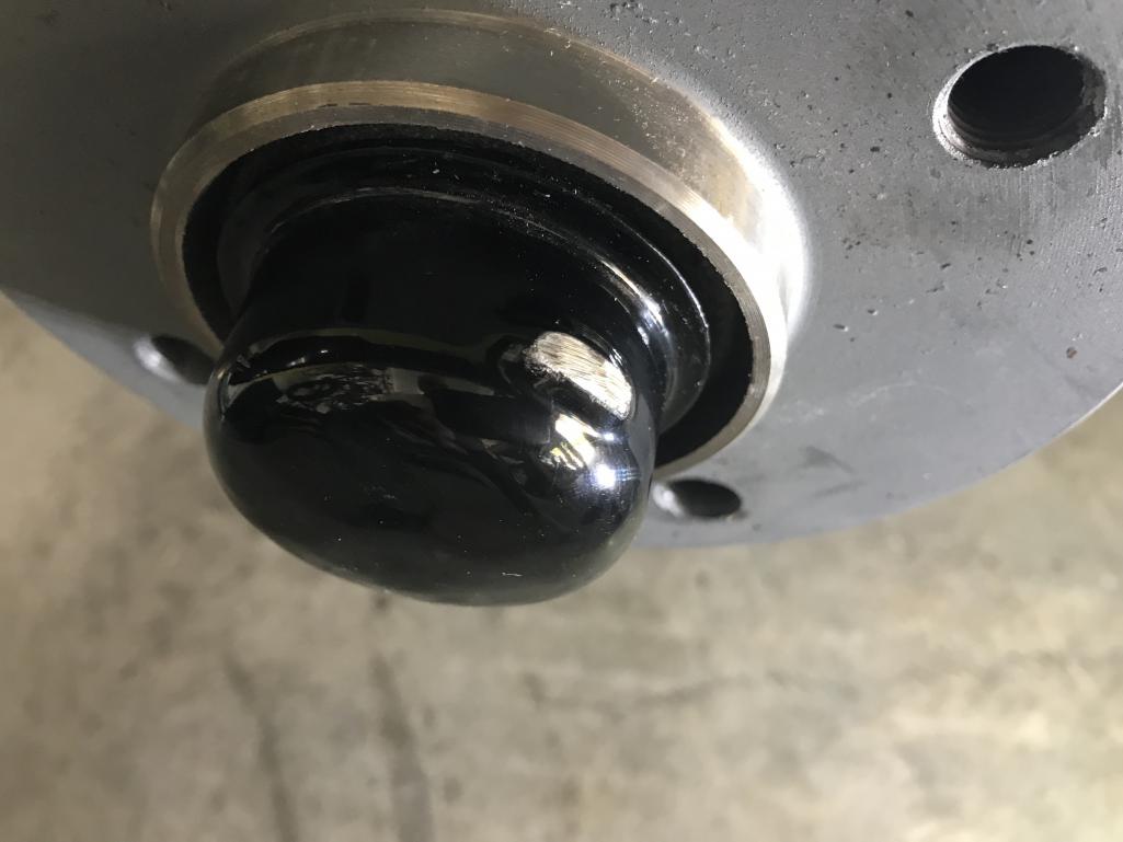

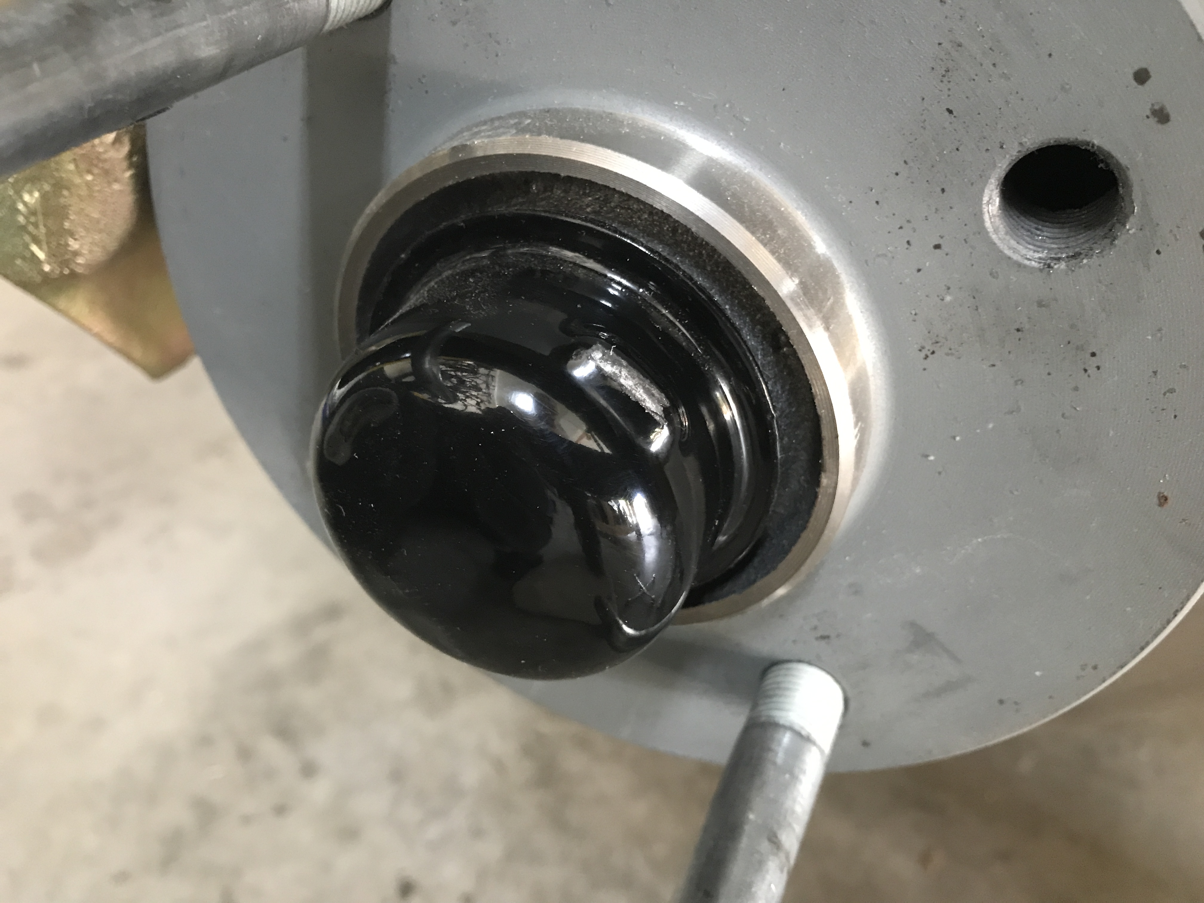

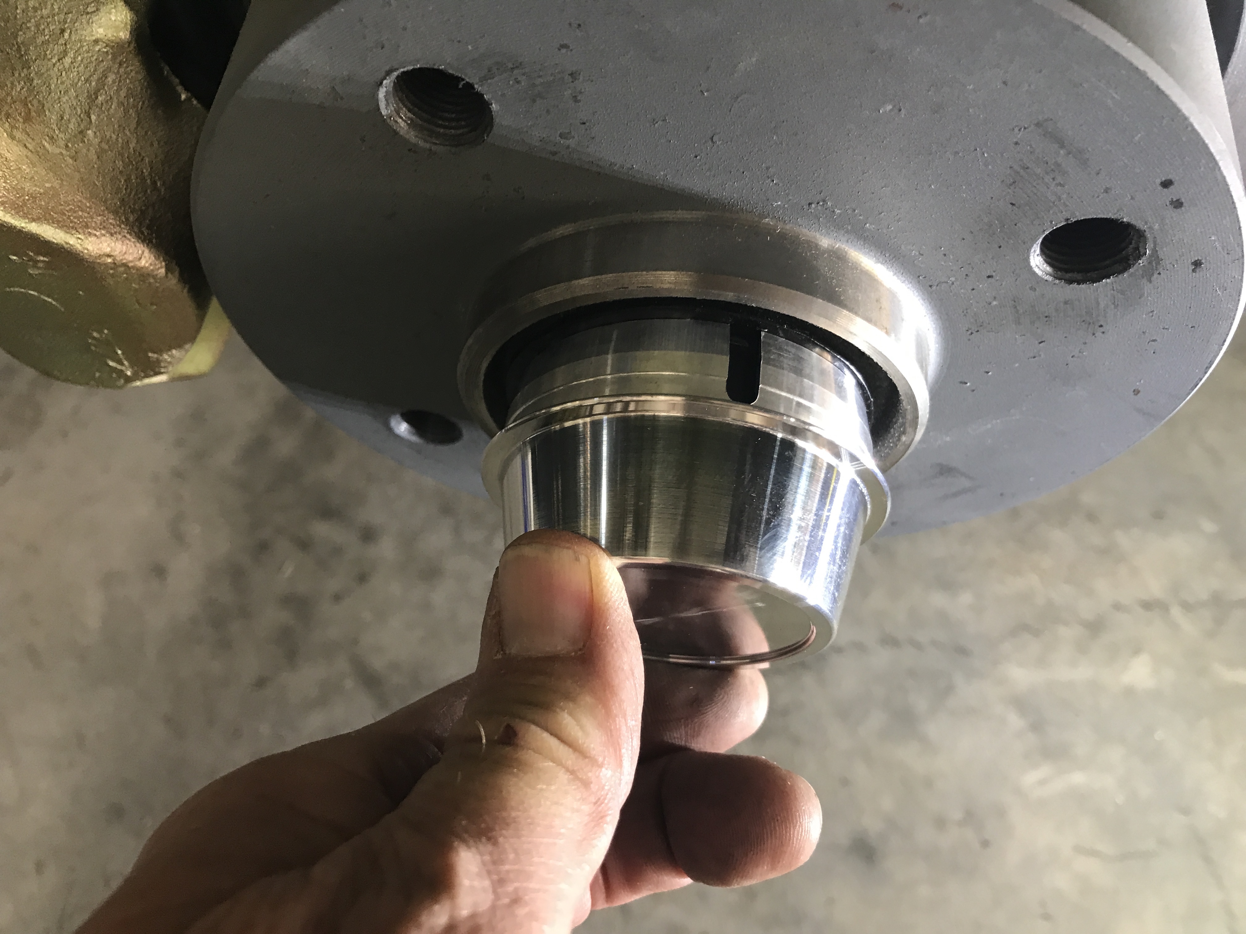

But then a small problem: I could not get the front left wheel to seat on the disk hub.
bkrantz
post Jun 21 2022, 08:03 PM
Post #5626
Posts: 8,343
Joined: 3-August 19
From: SW Colorado
Member No.: 23,343
Turns out the center cap ID is not big enough to clear the ears on the hub dust cap. And the cap on the left has bigger ears than the dust cap on the right (where the center cap clears fine).
bkrantz
post Jun 21 2022, 08:06 PM
Post #5627
Posts: 8,343
Joined: 3-August 19
From: SW Colorado
Member No.: 23,343
I dug out my angle grinder and took just a skim off the ears.
bkrantz
post Jun 21 2022, 08:07 PM
Post #5628
Posts: 8,343
Joined: 3-August 19
From: SW Colorado
Member No.: 23,343
Now the cap fits over the ears.

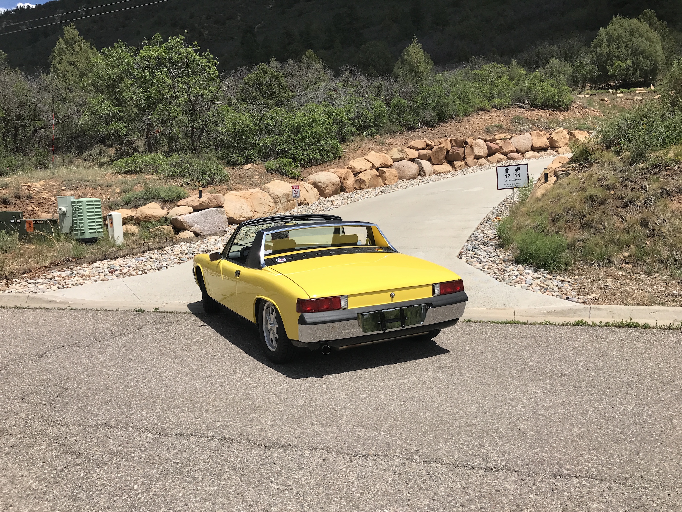

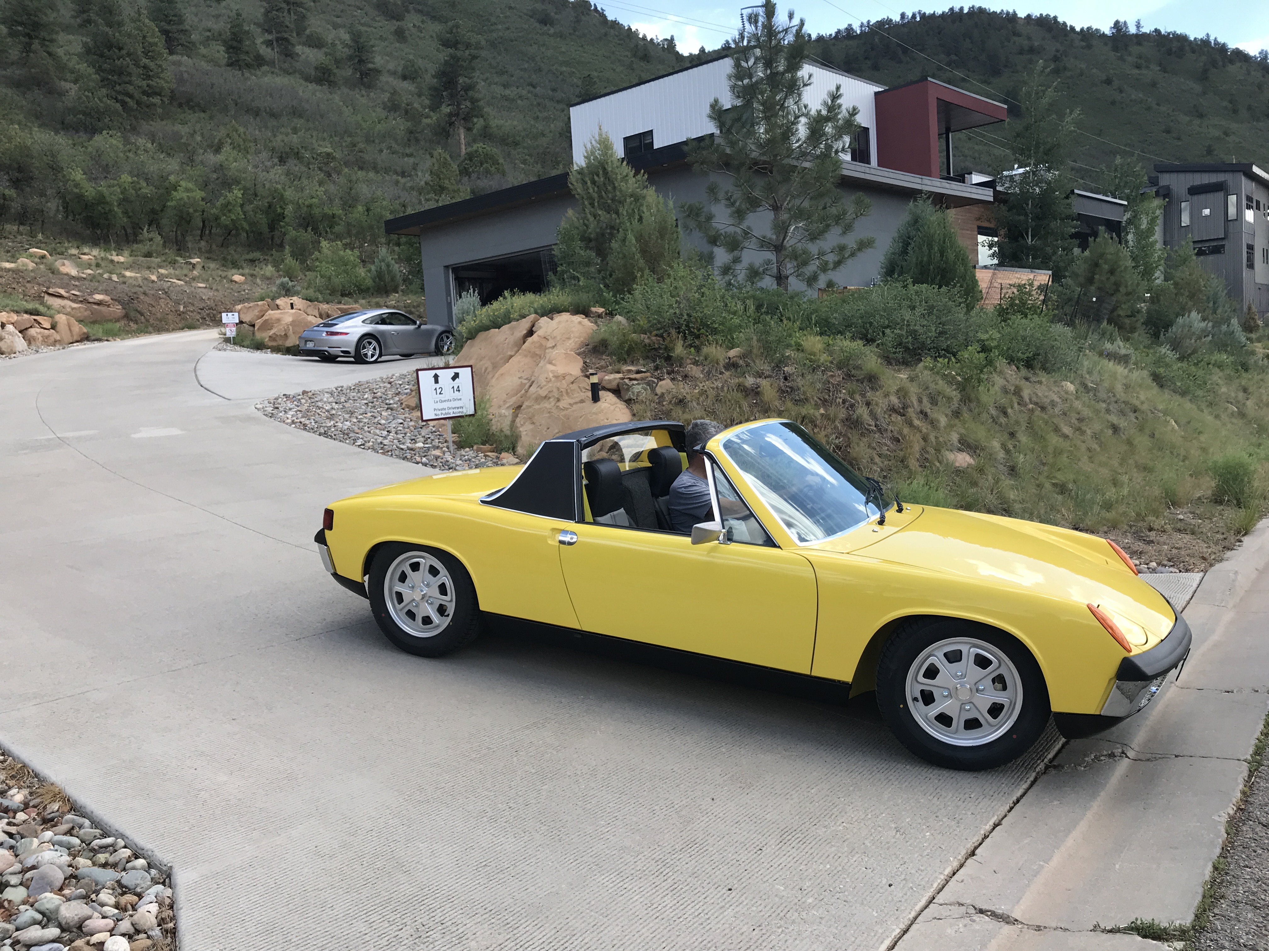

OK, with the brake pedal firm, and the wheels back on (and torqued), there is no reason not to try driving the car. Not a test drive on the road yet, but...
bkrantz
post Jun 21 2022, 08:15 PM
Post #5630
Posts: 8,343
Joined: 3-August 19
From: SW Colorado
Member No.: 23,343
How about a quick drive around the neighborhood?
bkrantz
post Jun 21 2022, 08:23 PM
Post #5631
Posts: 8,343
Joined: 3-August 19
From: SW Colorado
Member No.: 23,343
I went up and down the hill twice, anreven got into second gear. Seems to run pretty good, but not much bite in the brake pads yet.

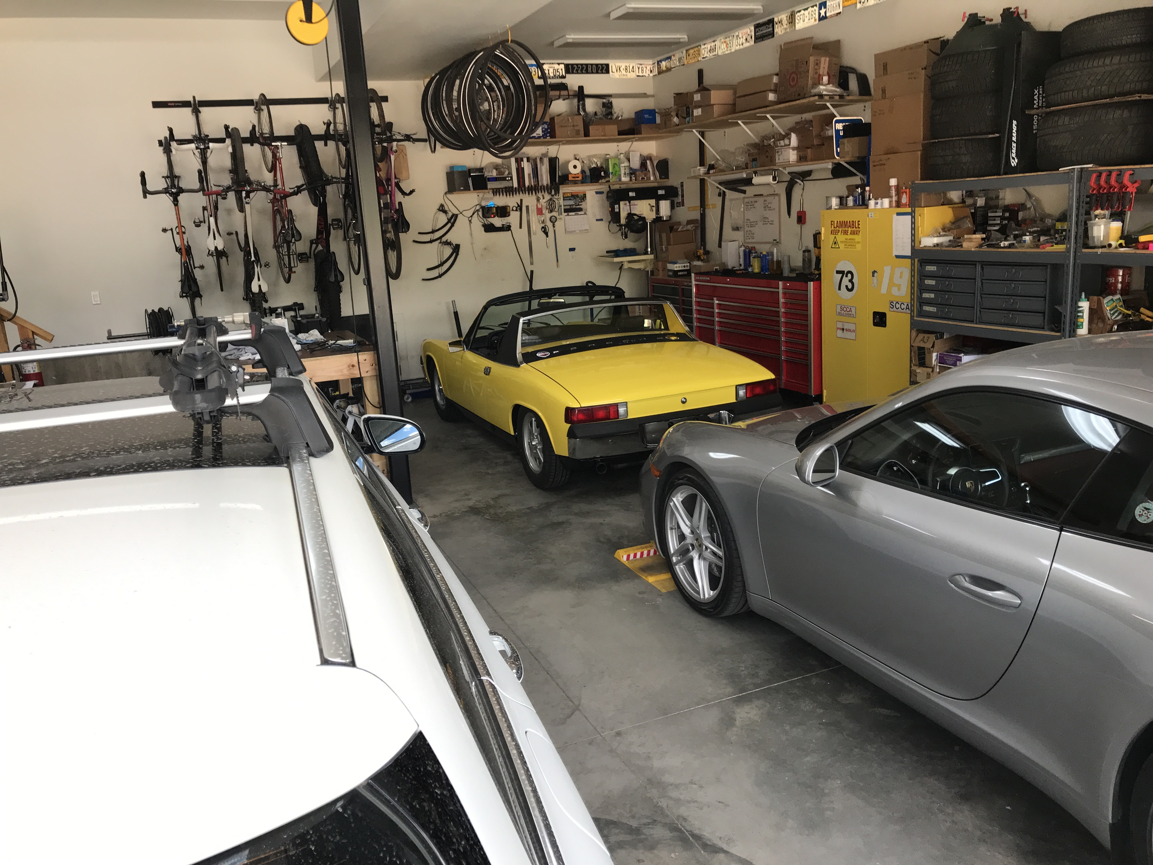

bkrantz
post Jun 21 2022, 08:24 PM
Post #5632
Posts: 8,343
Joined: 3-August 19
From: SW Colorado
Member No.: 23,343
And back in the garage.

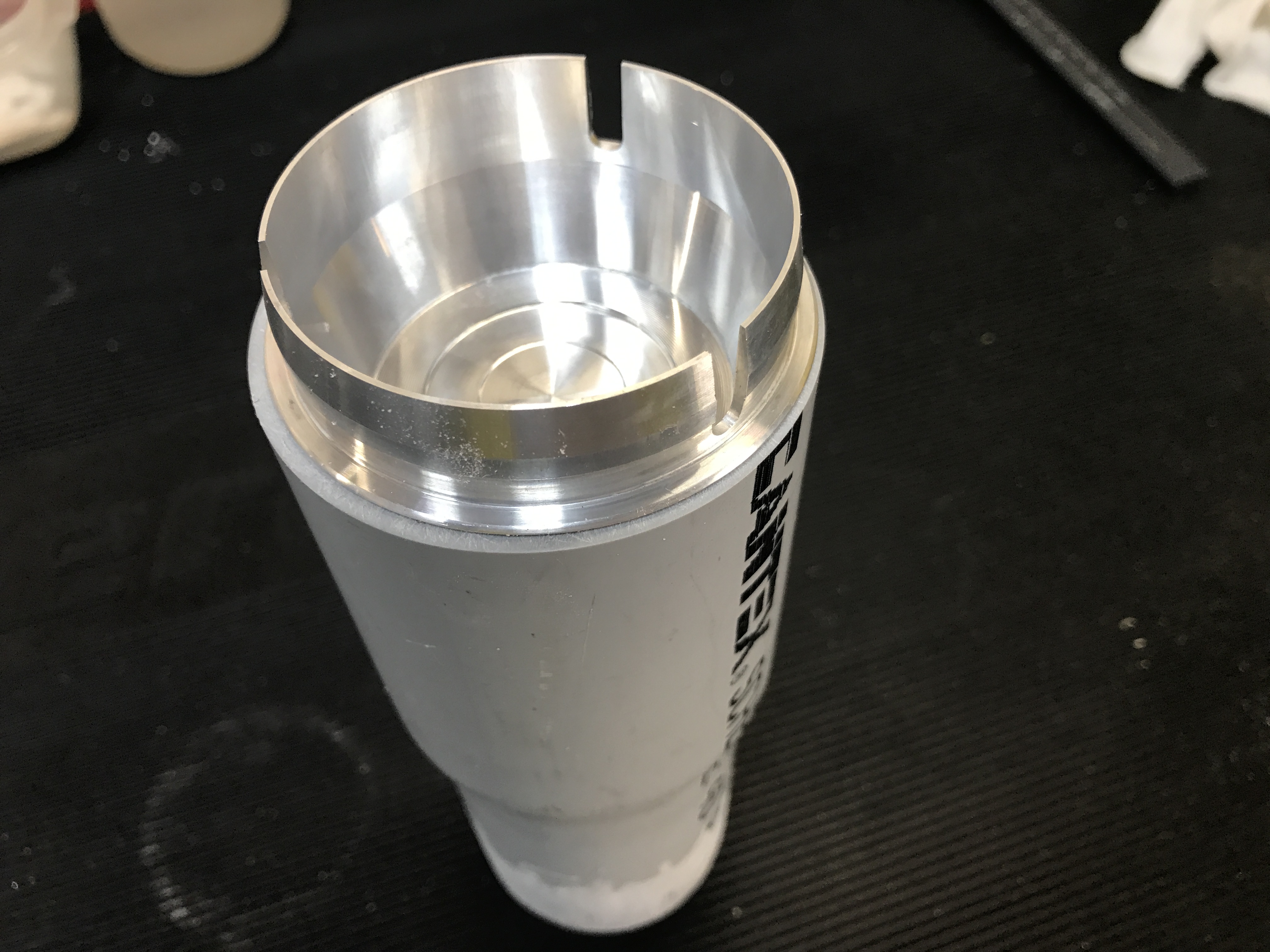

This is by far my favorite active thread - tons of great info here. Care to share size details on the PVC reducer "tool"?

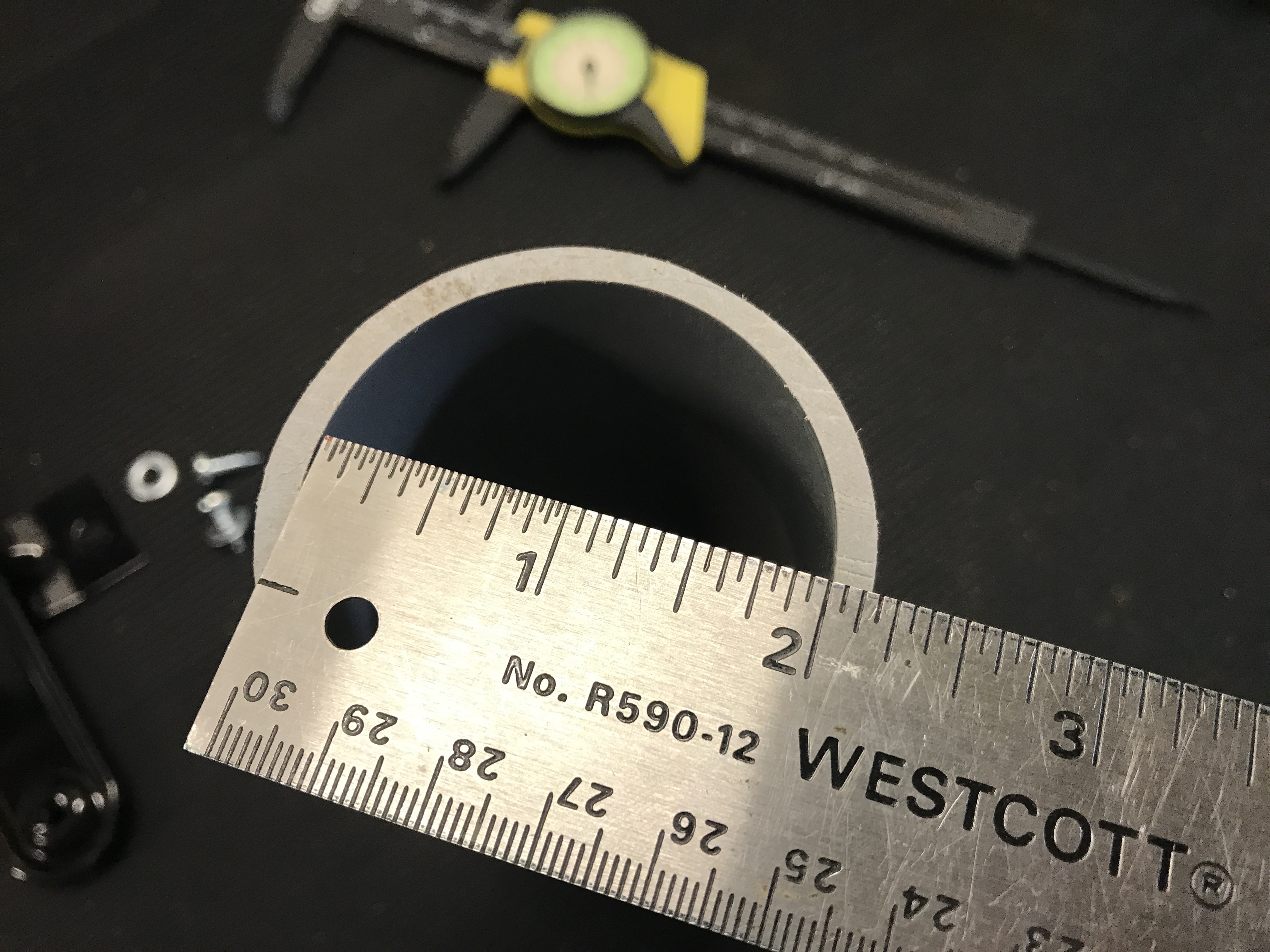

QUOTE(FlacaProductions @ Jun 22 2022, 07:44 AM) *
Thanks.
I got lucky and had a short piece of 2" Schedule 40 PVC conduit. The fat end is where each length of conduit inserts into the next.

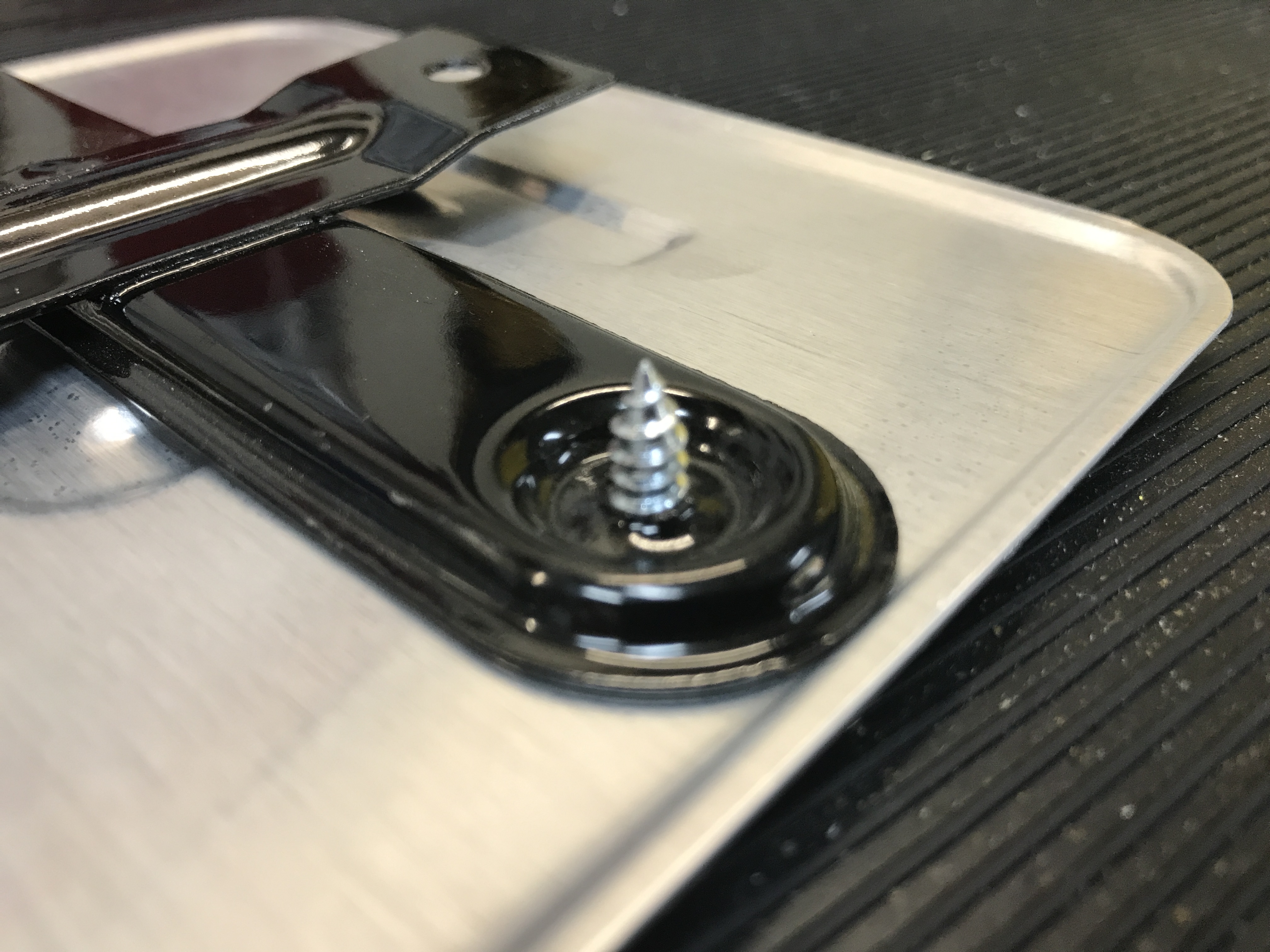

To mount the plates, I will have to shorten some M4.8 screws so that do not scratch the bumper. And perhaps some sort of security screw.
