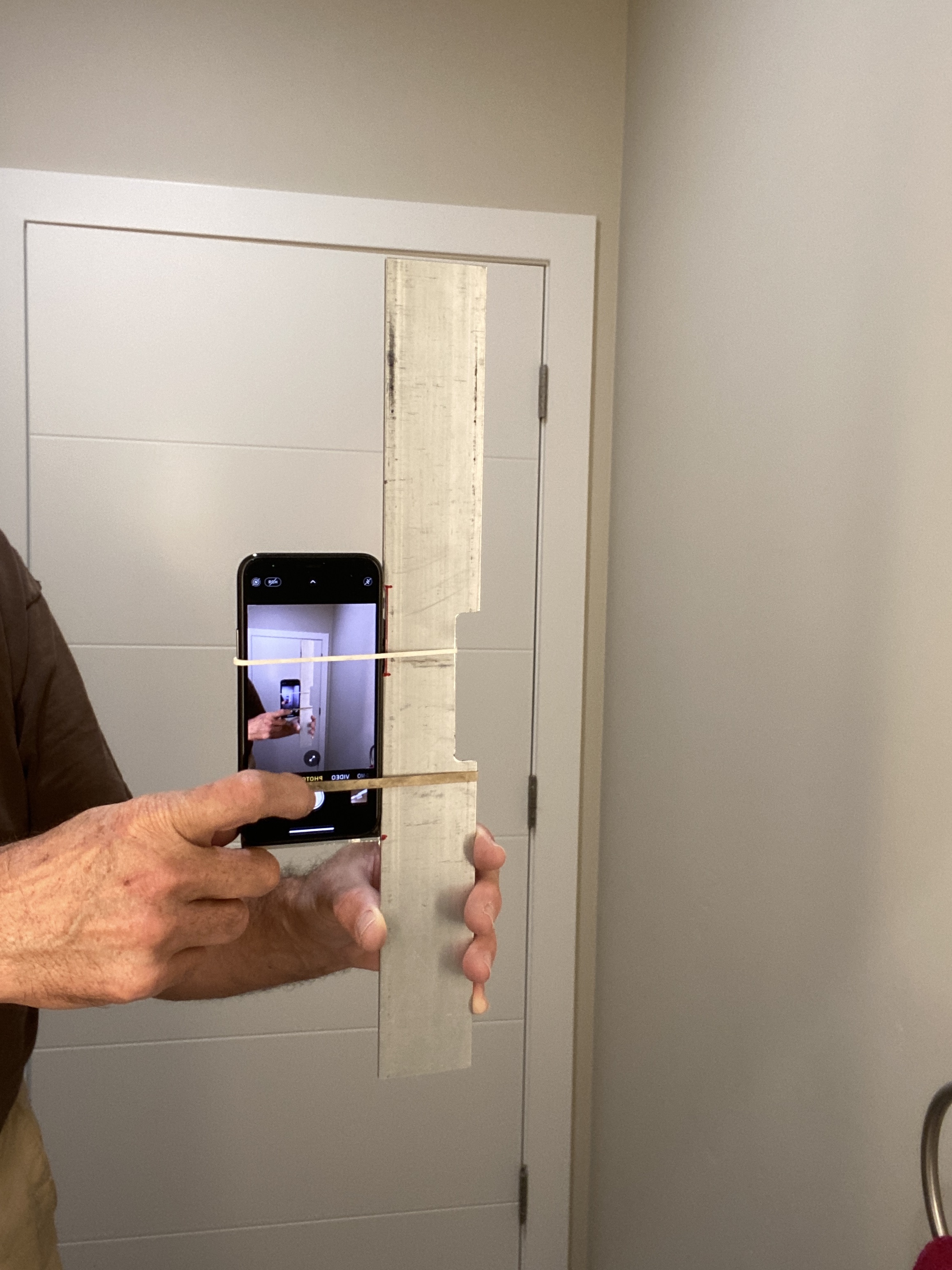

Here's my new camber gauge, without the phone. I was too lazy to find a mirror once I had the phone attached with a couple of rubber bands.
I checked the camber on the car again, and got the same numbers as yesterday, within 0.1°.

And here's the gauge with the phone attached.

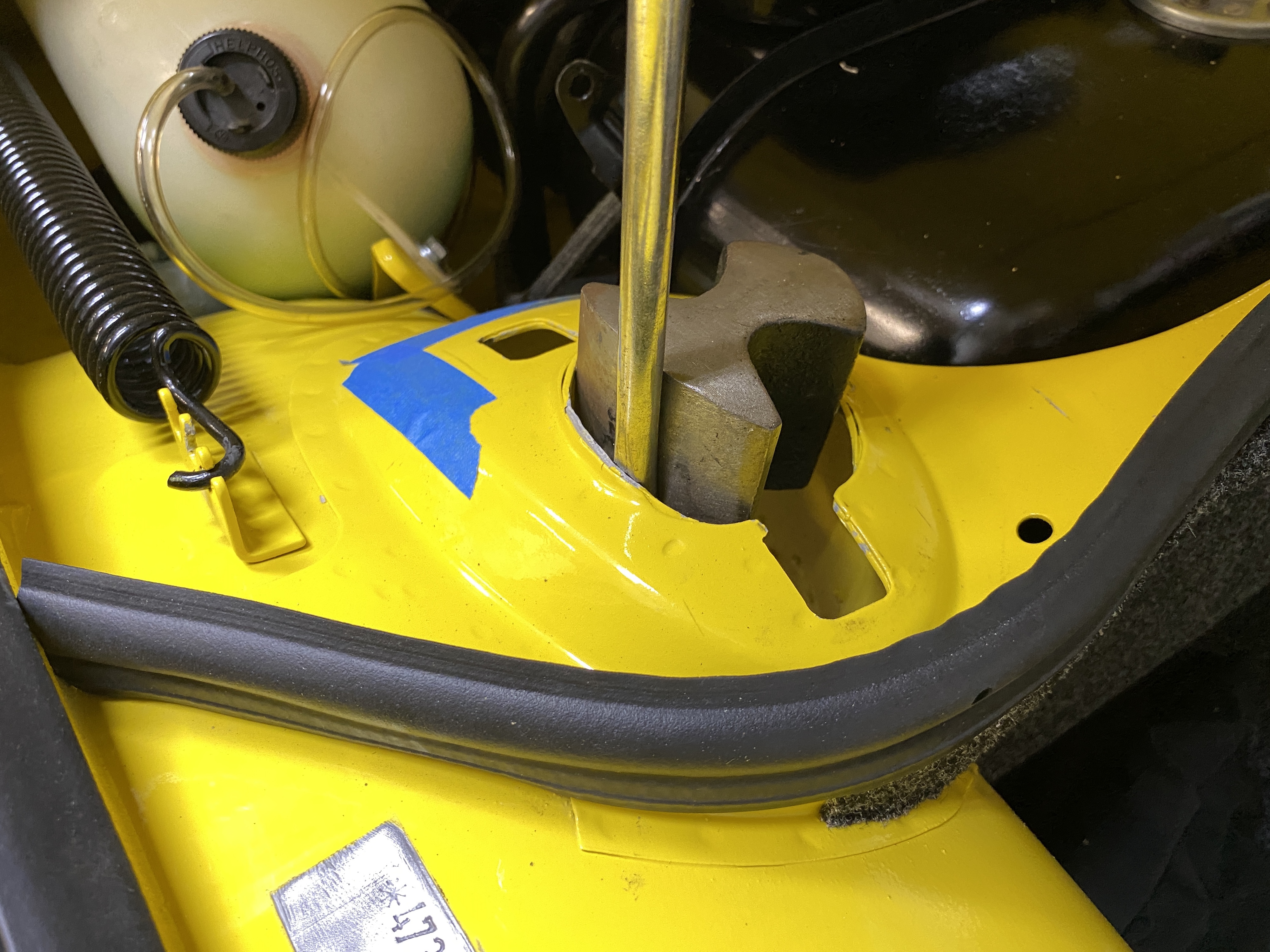

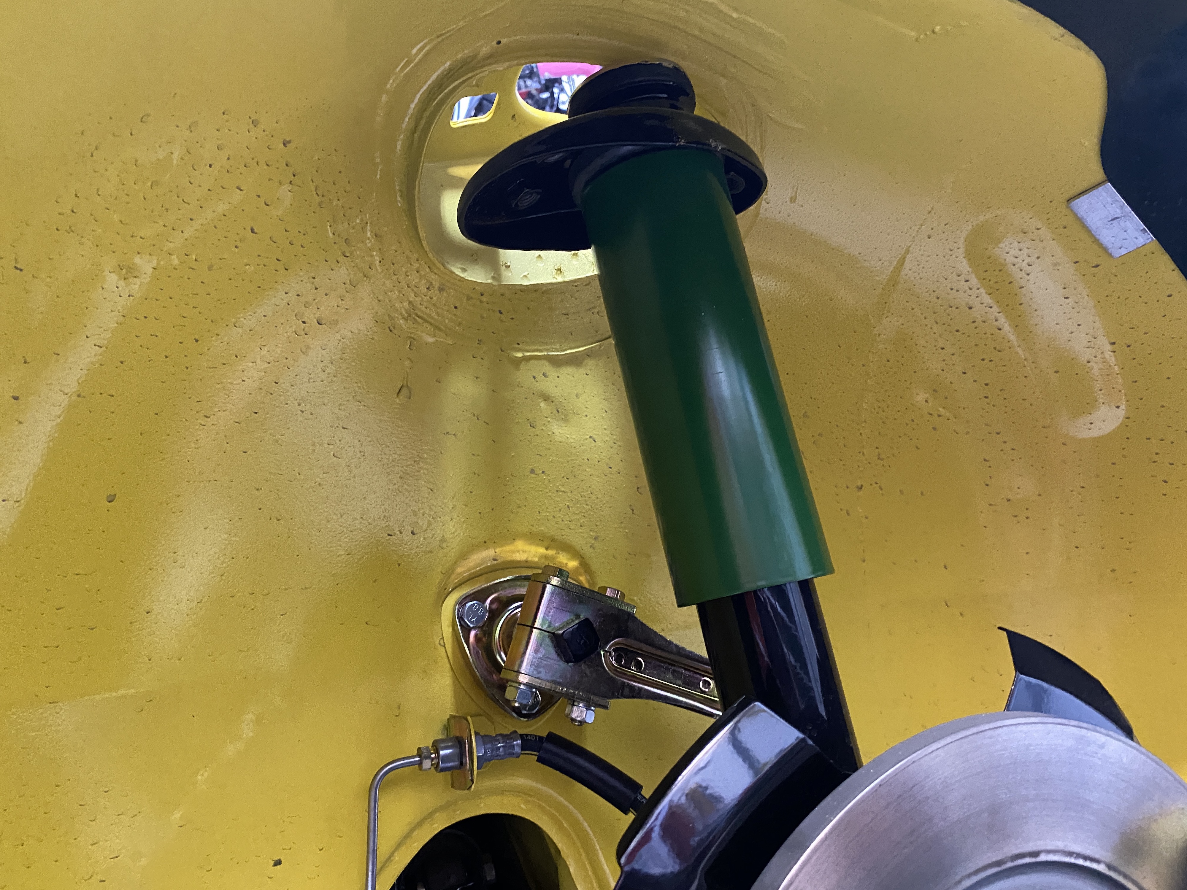

But...the front right strut top is already as far to the outside as possible. To reduce the camber by about 0.4° I need to get the strut top further out. I will also raise the ride height a bit.
bkrantz
post Jul 28 2022, 07:41 PM
Post #5766
Posts: 8,343
Joined: 3-August 19
From: SW Colorado
Member No.: 23,343
I dropped the strut top to make work space.
bkrantz
post Jul 28 2022, 07:42 PM
Post #5767
Posts: 8,343
Joined: 3-August 19
From: SW Colorado
Member No.: 23,343
Strut stashed inside the fender.
bkrantz
post Jul 28 2022, 07:46 PM
Post #5768
Posts: 8,343
Joined: 3-August 19
From: SW Colorado
Member No.: 23,343

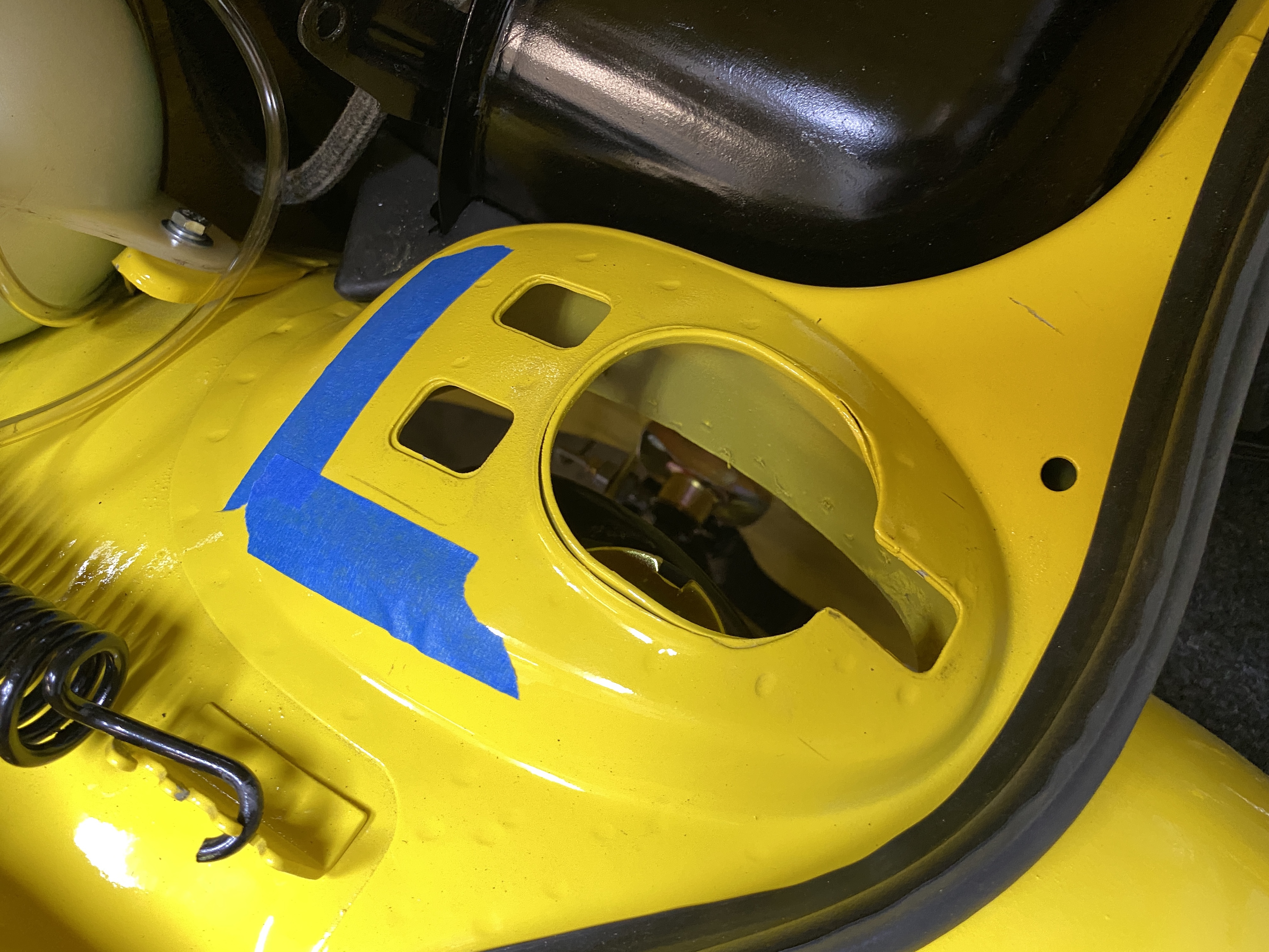

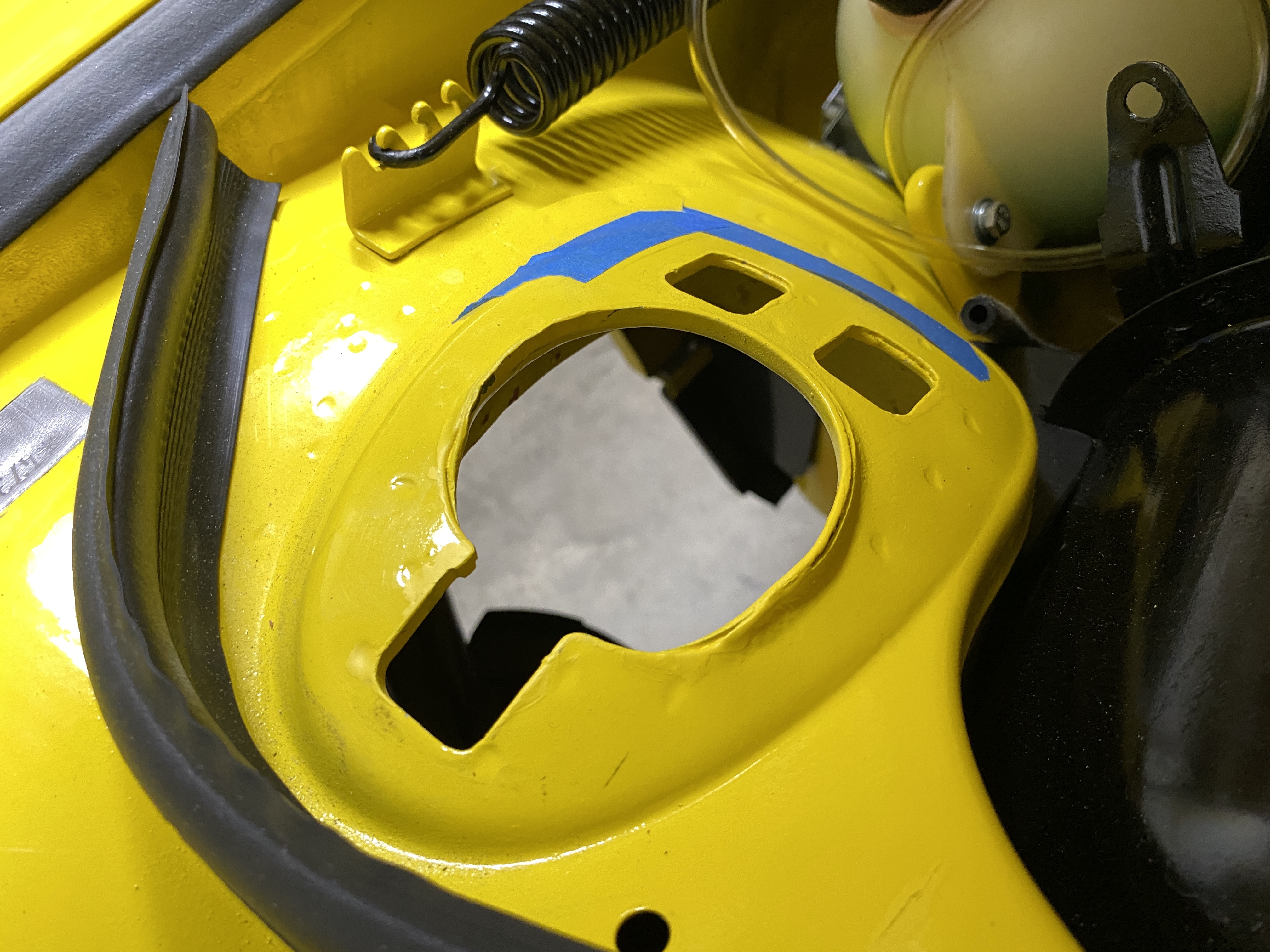

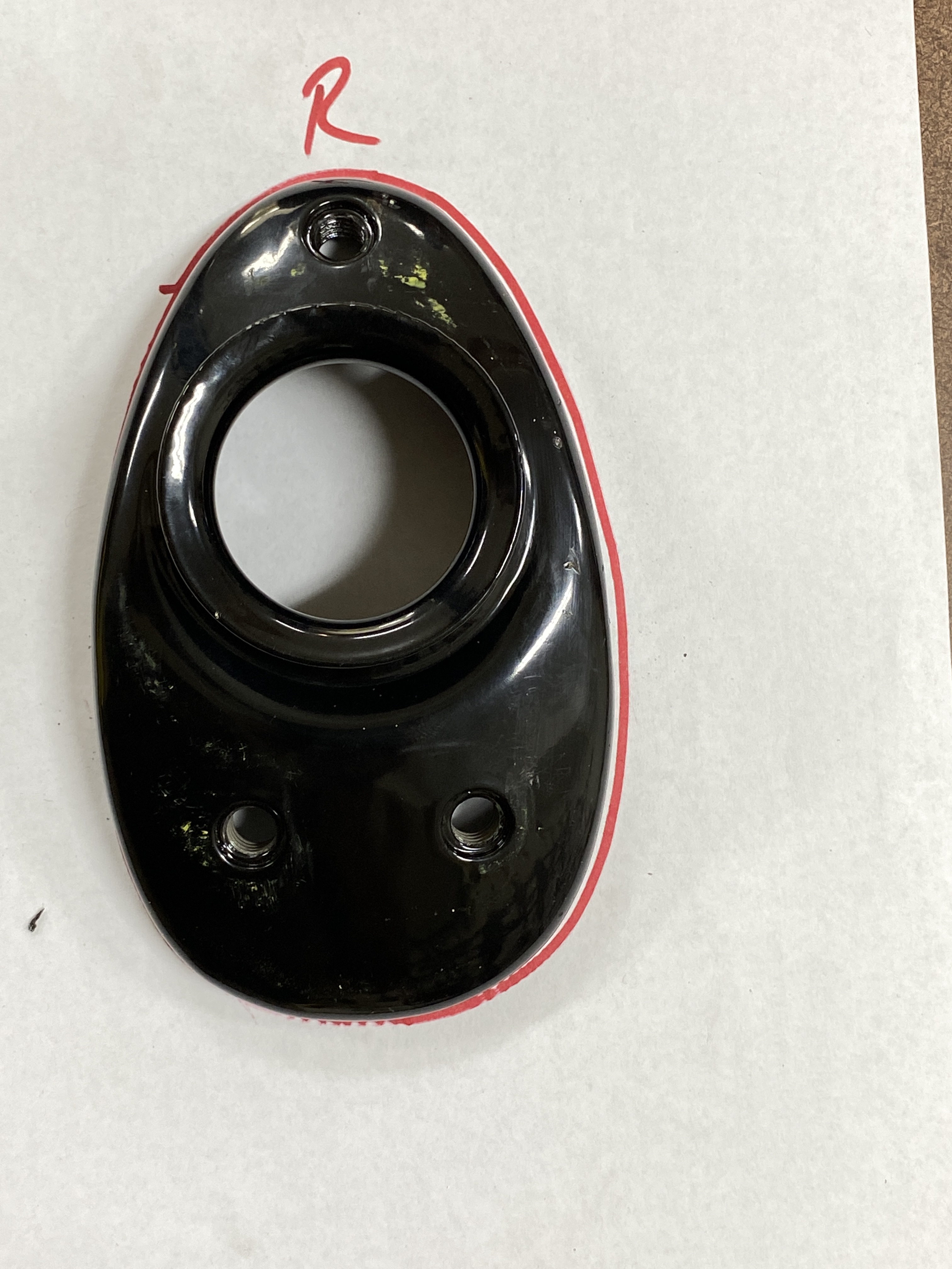

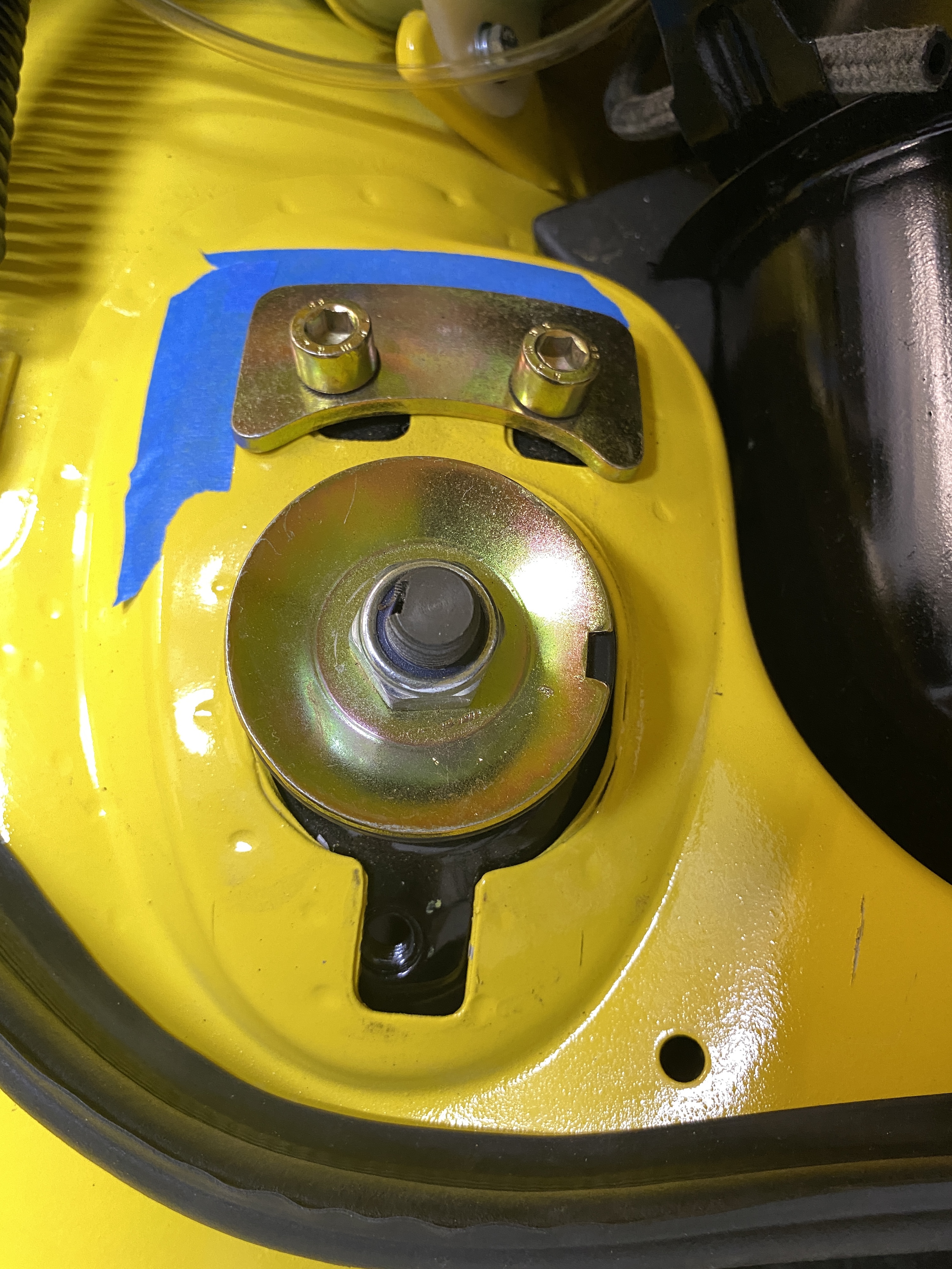

I first filed a bit less than 1/8" from the outside of the square holes. Then I expanded the flange for the central opening as much as I could without getting in deep.
bkrantz
post Jul 28 2022, 07:47 PM
Post #5769
Posts: 8,343
Joined: 3-August 19
From: SW Colorado
Member No.: 23,343
And then some touch-up painting.
bkrantz
post Jul 28 2022, 07:50 PM
Post #5770
Posts: 8,343
Joined: 3-August 19
From: SW Colorado
Member No.: 23,343
But then the strut mount made contact with the inside of the fender tower. I bit of work using my hydraulic press and a hammer and I narrowed the outer edge by almost 1/8". Along with rising the ride height a bit, I hope to get the camber down to my target.

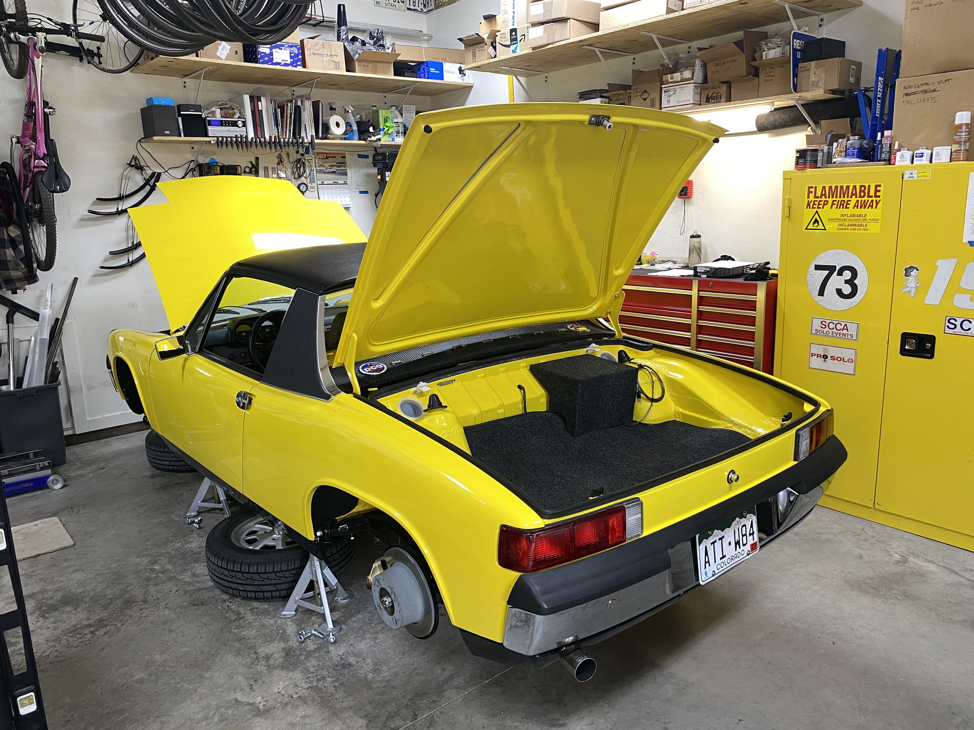

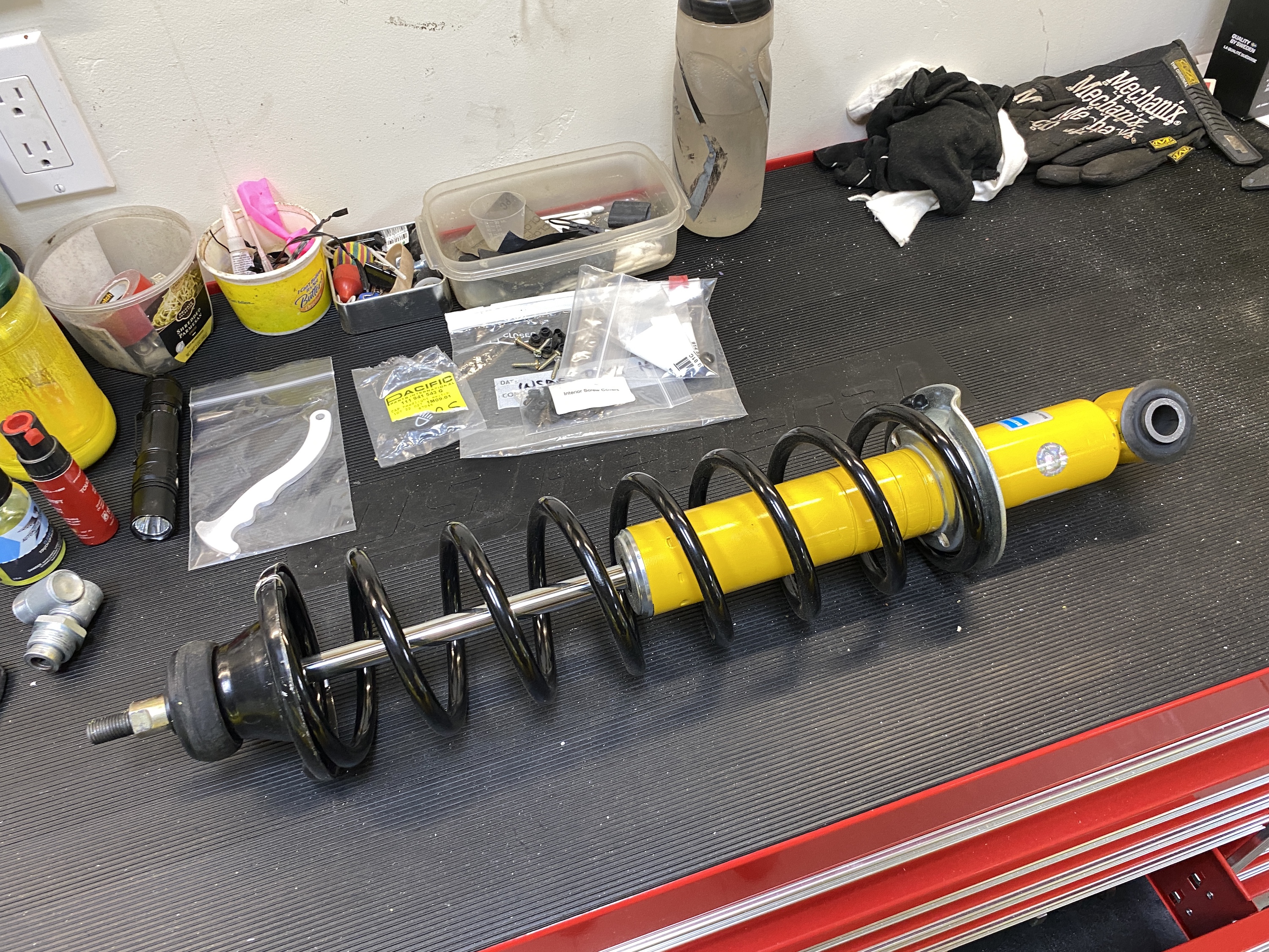

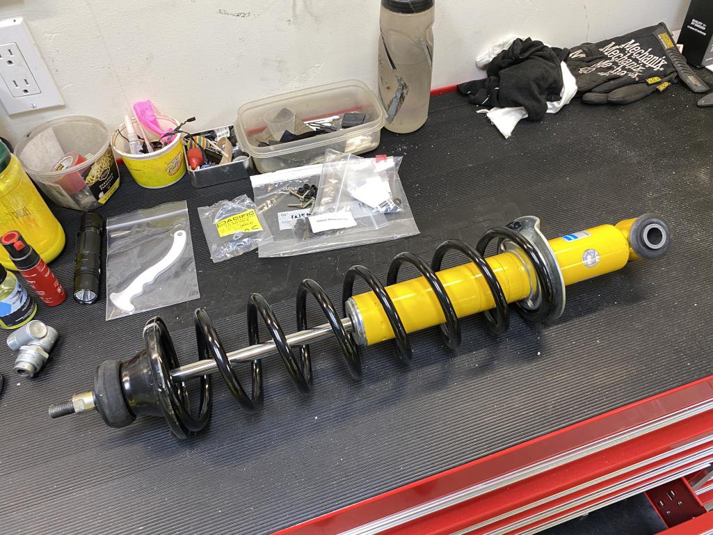

Meanwhile to keep the rear in sync with ride height changes, I pulled both shocks.
bkrantz
post Jul 28 2022, 07:55 PM
Post #5772
Posts: 8,343
Joined: 3-August 19
From: SW Colorado
Member No.: 23,343

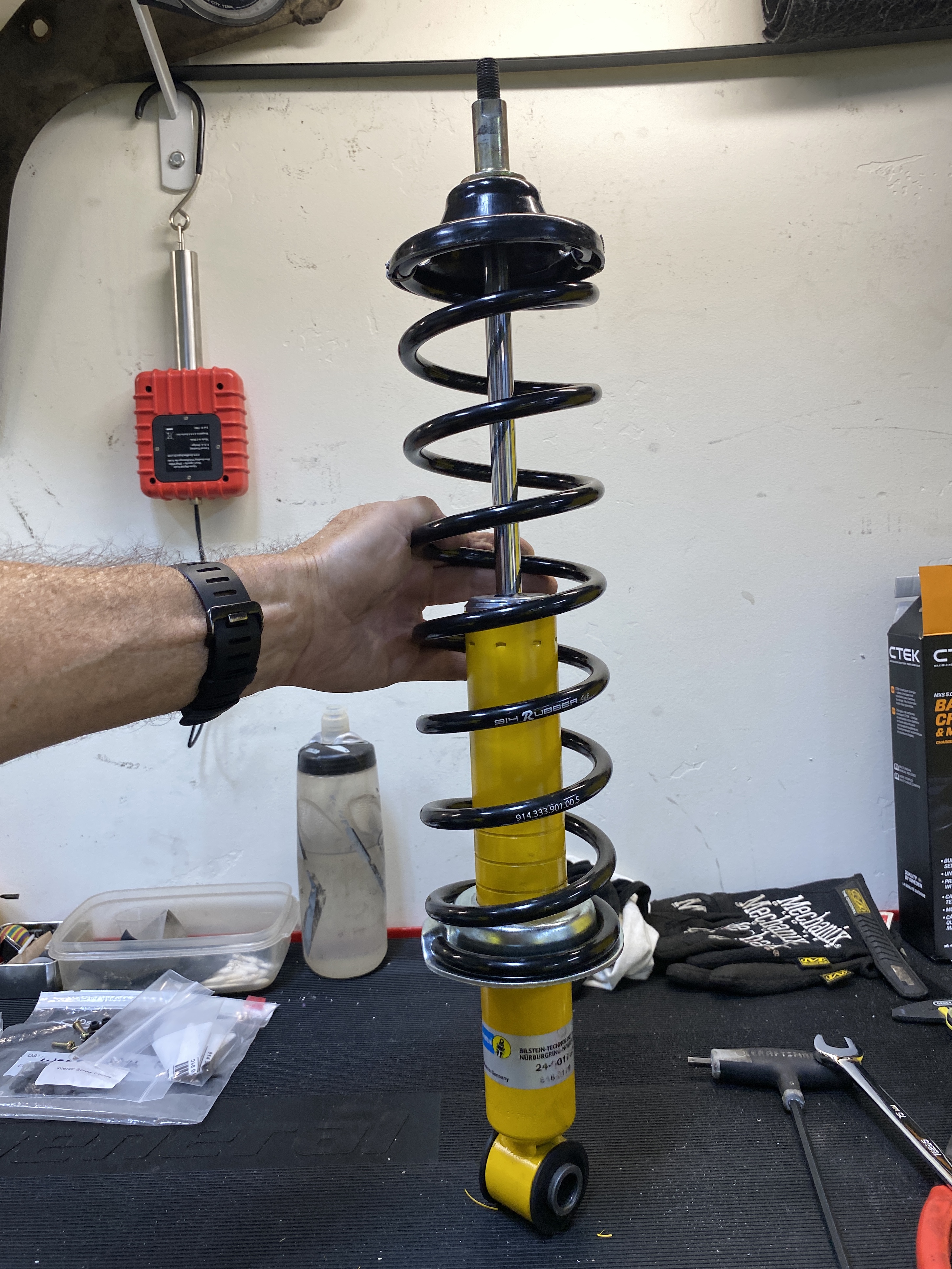

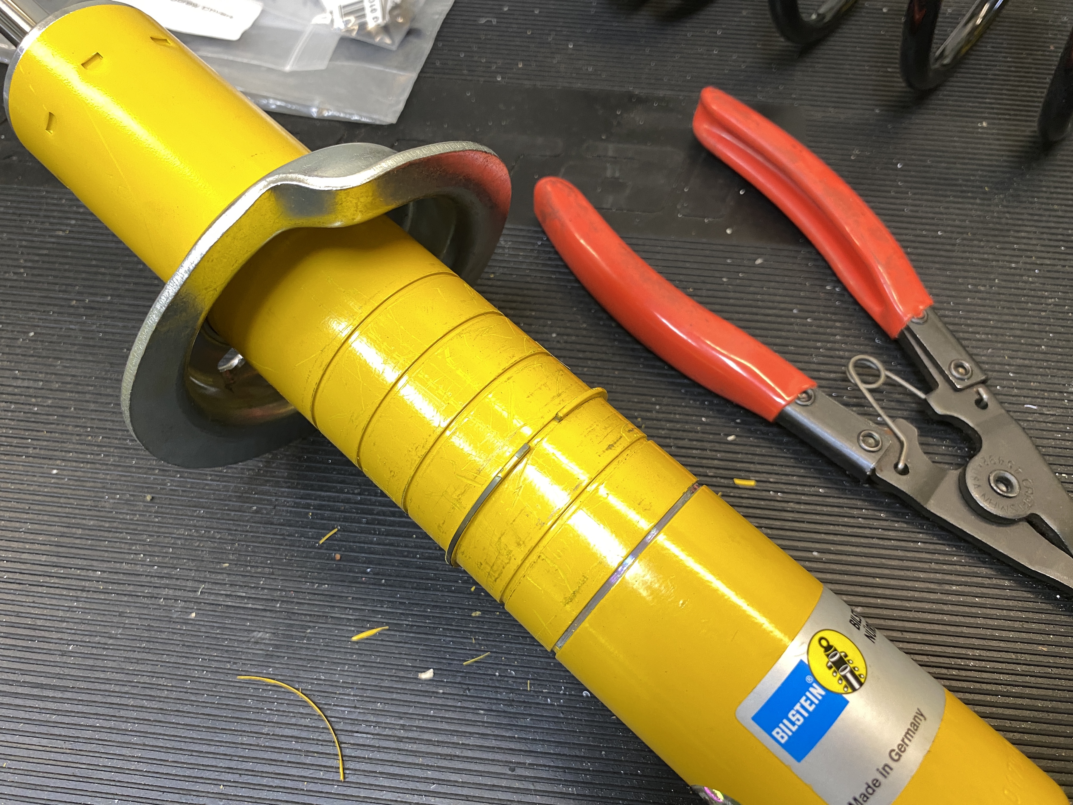

I changed the strut spring perch one notch higher, to the 3rd from the bottom. That's about 1/2" ride height increase.
bkrantz
post Jul 28 2022, 07:56 PM
Post #5773
Posts: 8,343
Joined: 3-August 19
From: SW Colorado
Member No.: 23,343
One side benefit: now the springs are barely in compression with the assembly back together.

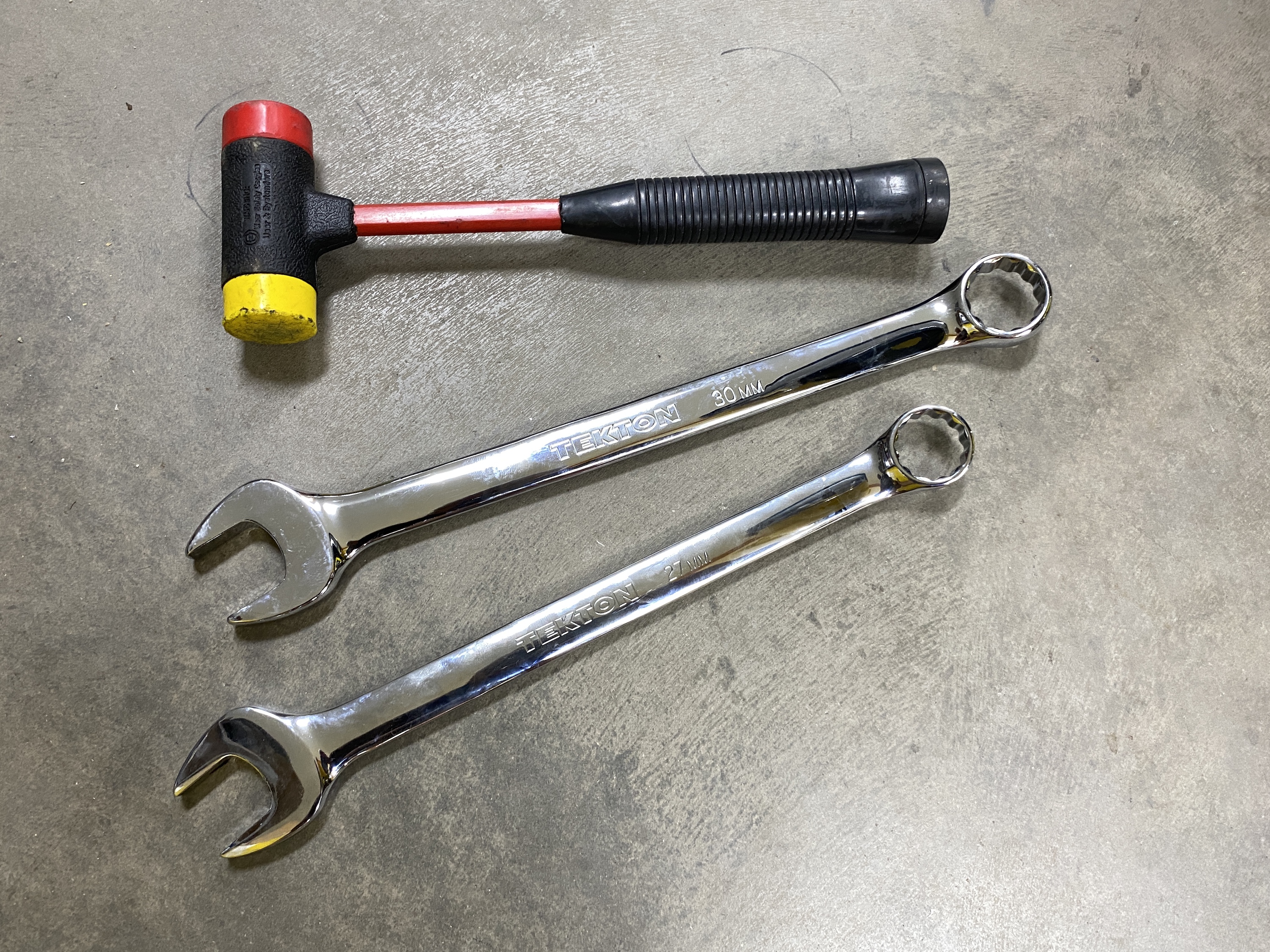

Another side benefit: I got to use my new large metric wrenches.

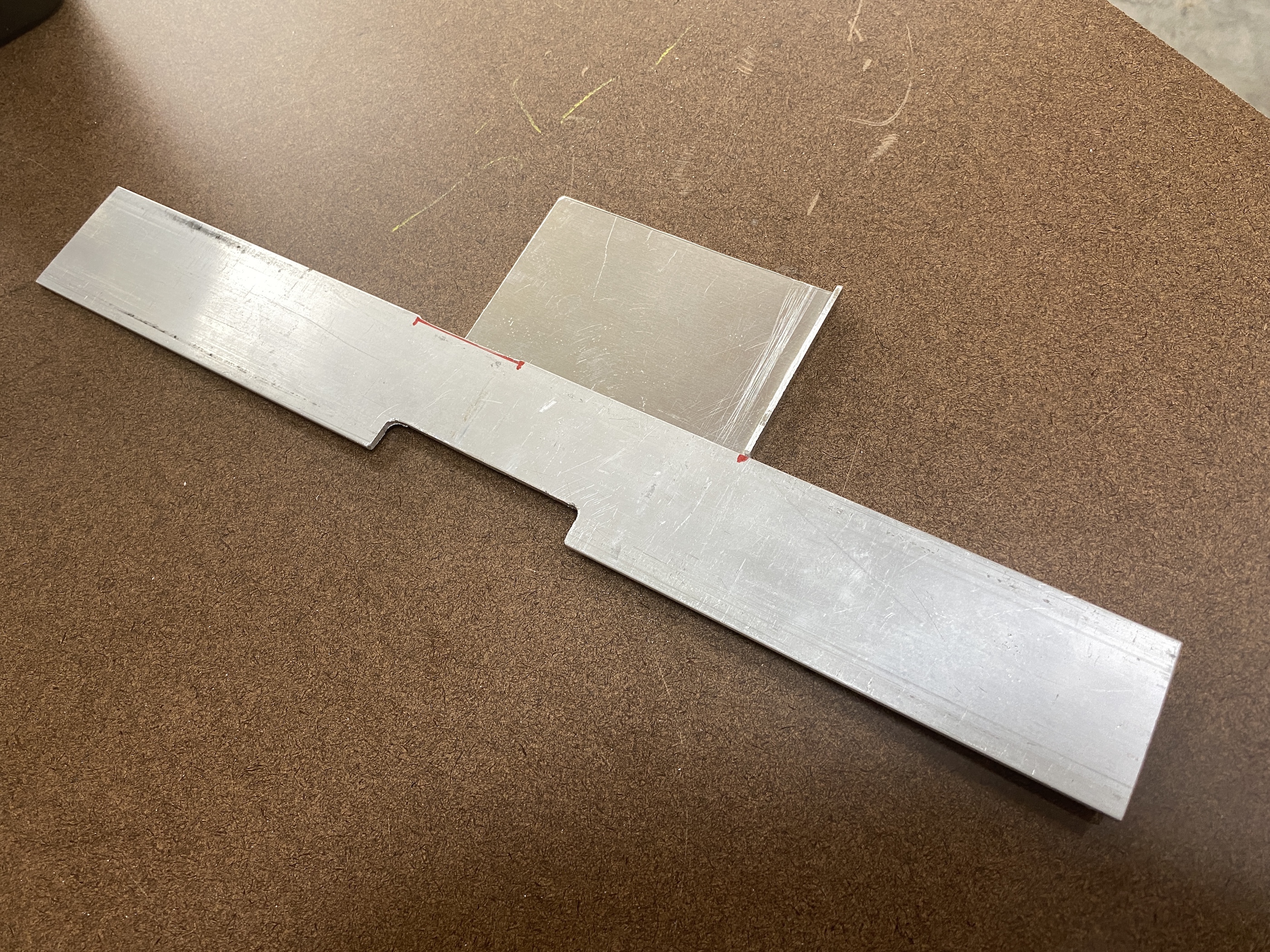

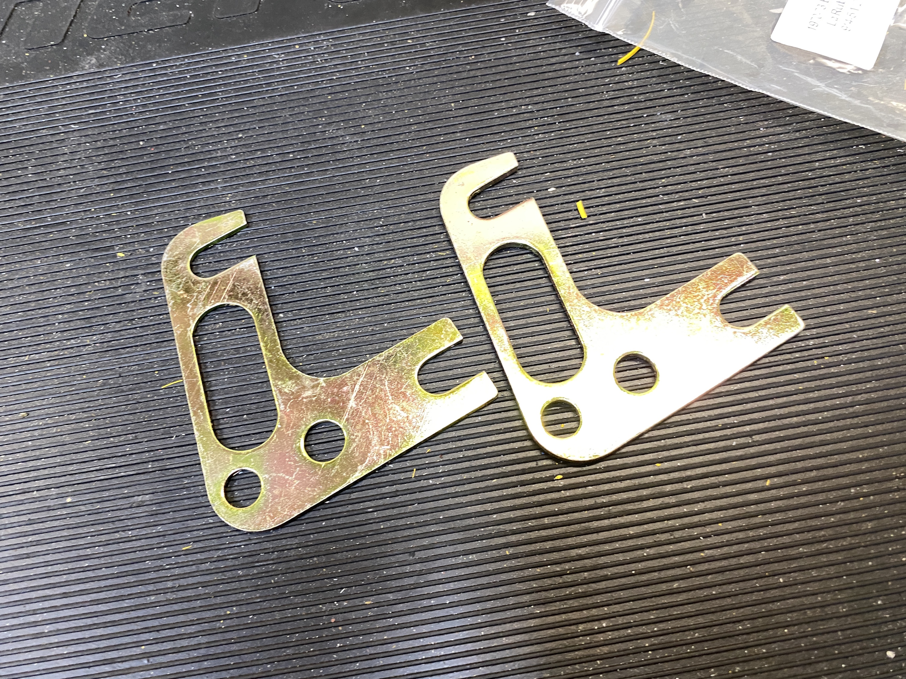

Then I installed the two remaining shims I have, 2mm and 3mm. Since the camber was more negative on the right, I put the thicker shim on that side.

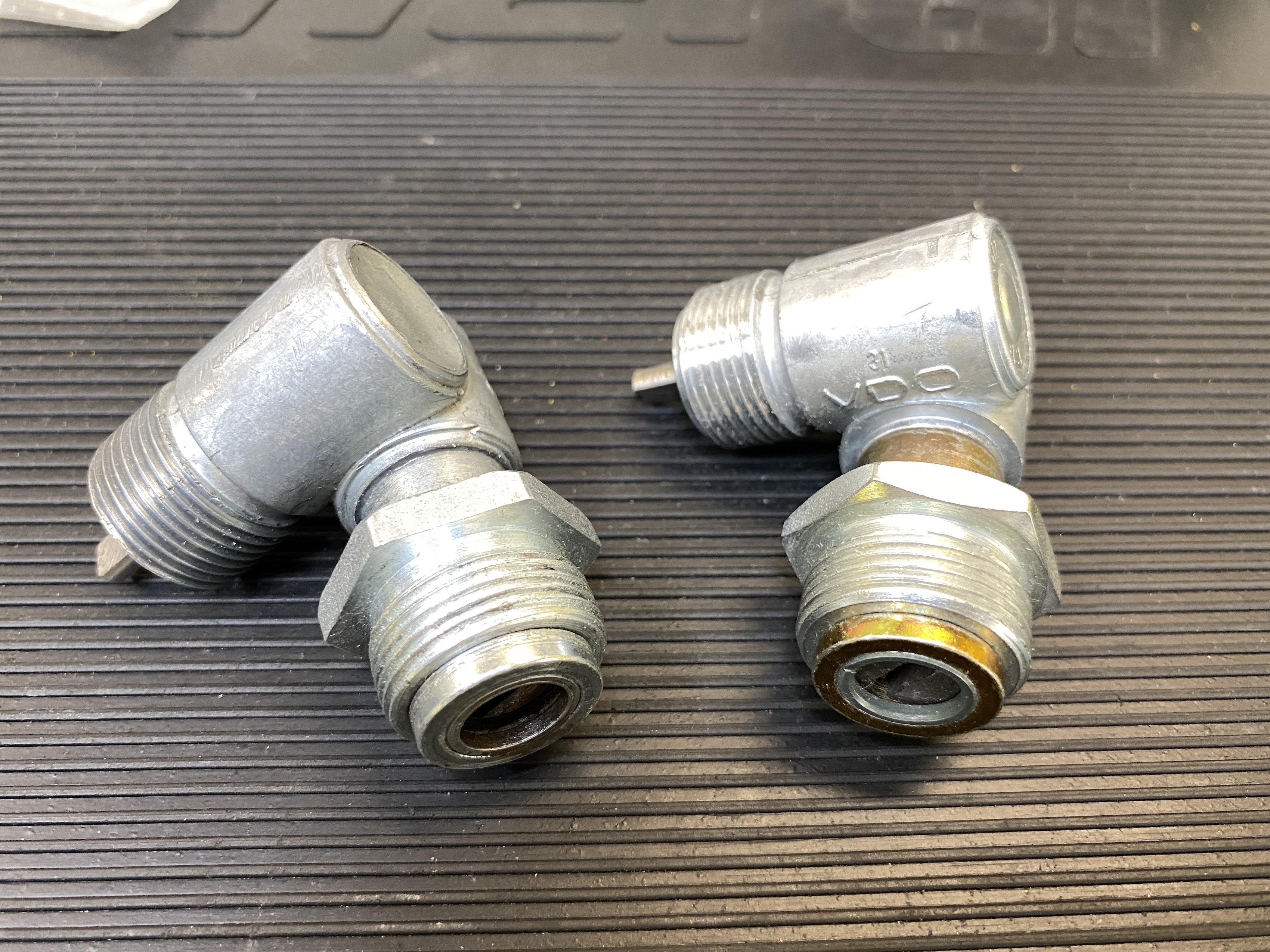

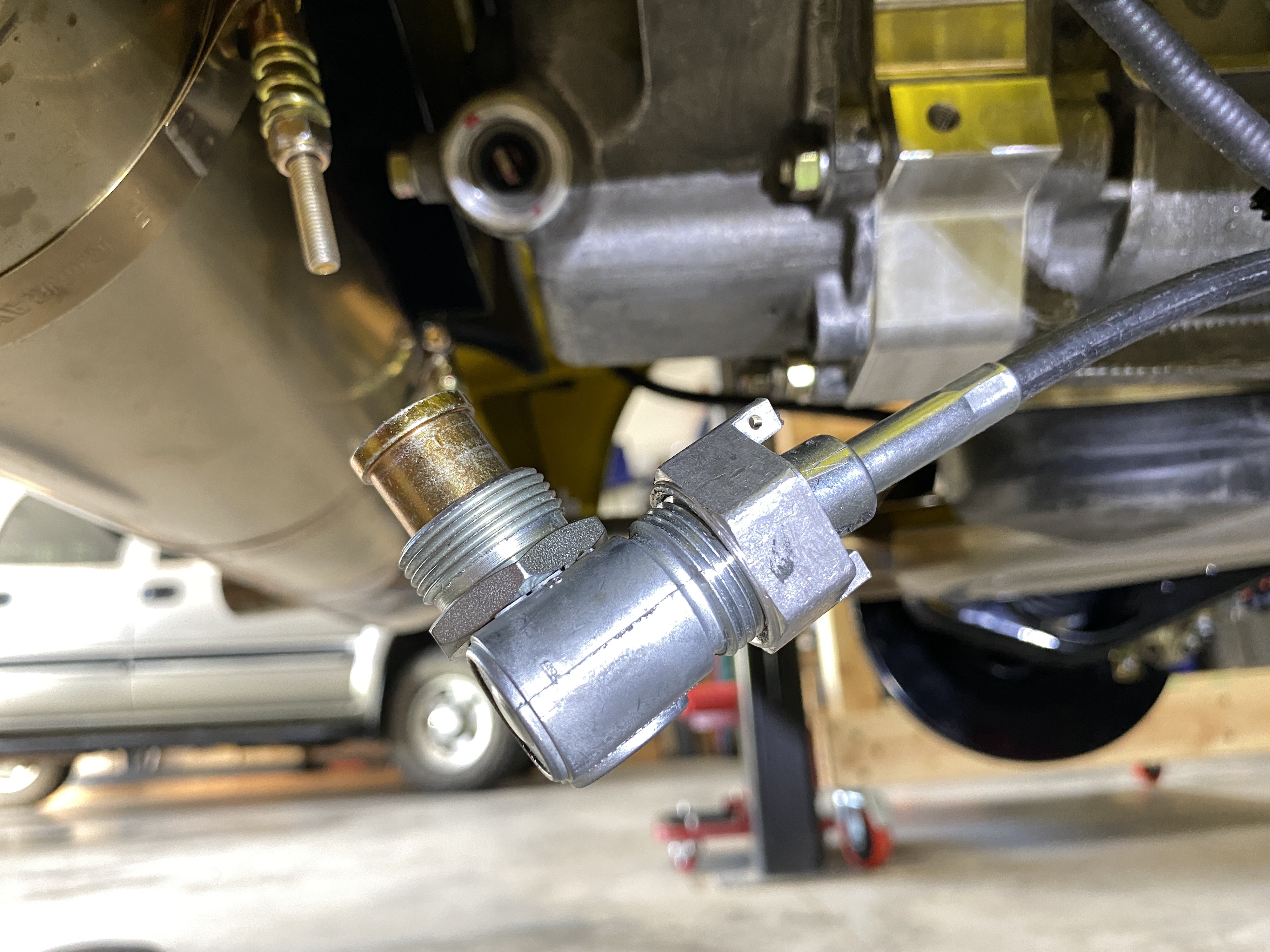

Back on the job. Before finishing the alignment, I installed my new speedometer angle drive. The new one (on the right) is by VDO, and has number markings, compared to the no-name unit on the left. Most important, the new drive spins correctly.
bkrantz
post Aug 2 2022, 09:43 PM
Post #5780
Posts: 8,343
Joined: 3-August 19
From: SW Colorado
Member No.: 23,343
I was hoping the cable would screw on correctly, but it still tends to cross-thread.
