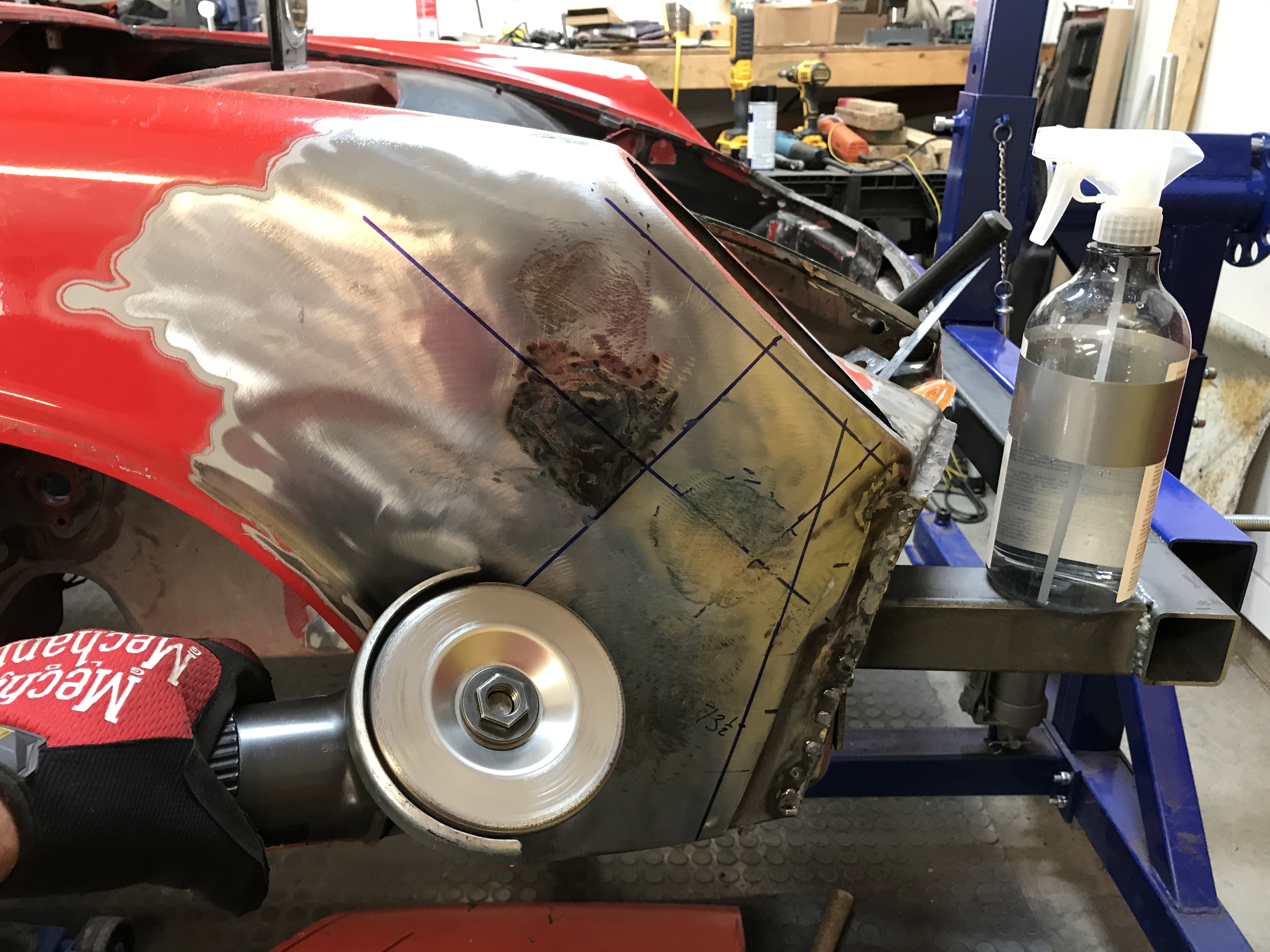

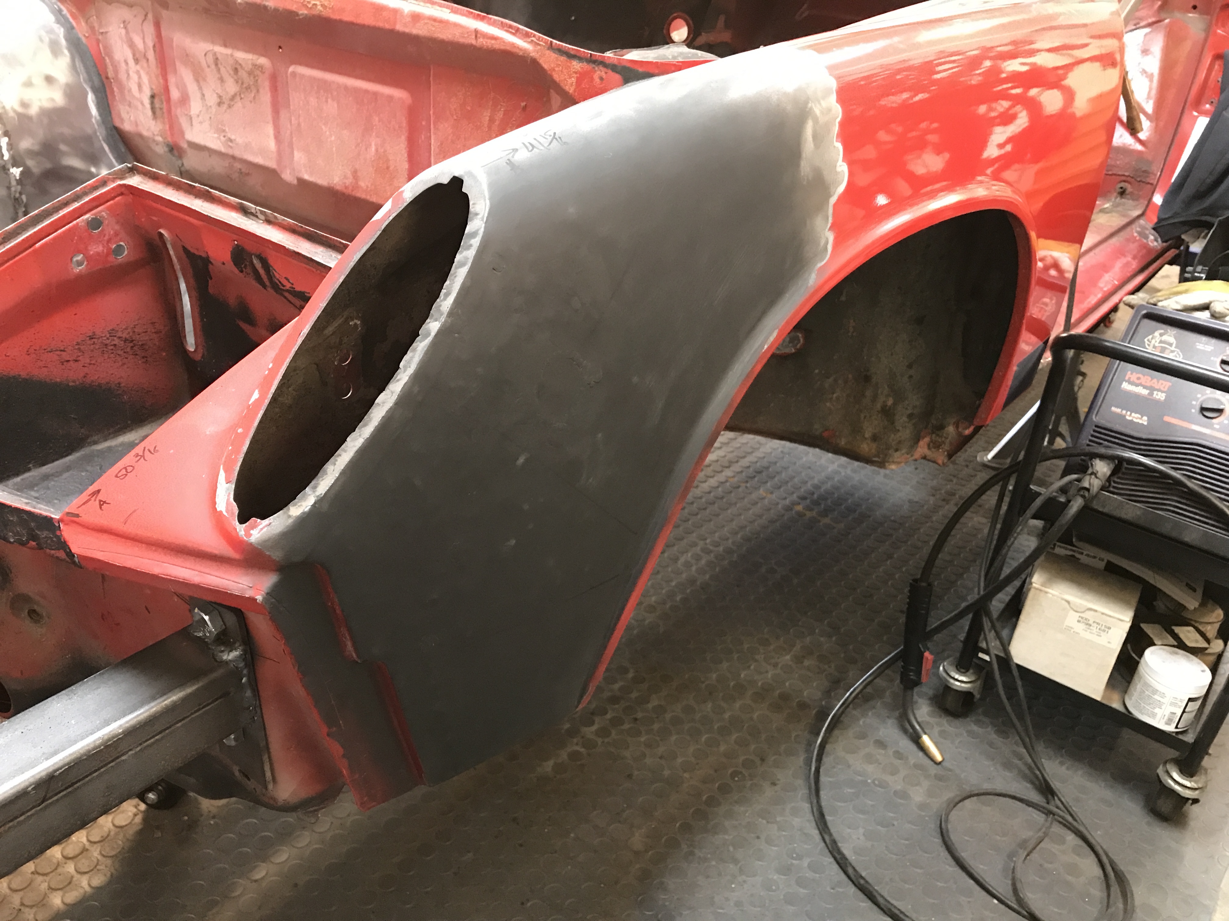

Got to use the magic tool again today (shrinking disk). The section I was working had some mild oil-canning.
bkrantz
post Apr 30 2020, 08:22 PM
Post #582
Posts: 8,342
Joined: 3-August 19
From: SW Colorado
Member No.: 23,343
Then I got on to shaping, and things are close to matching profiles.

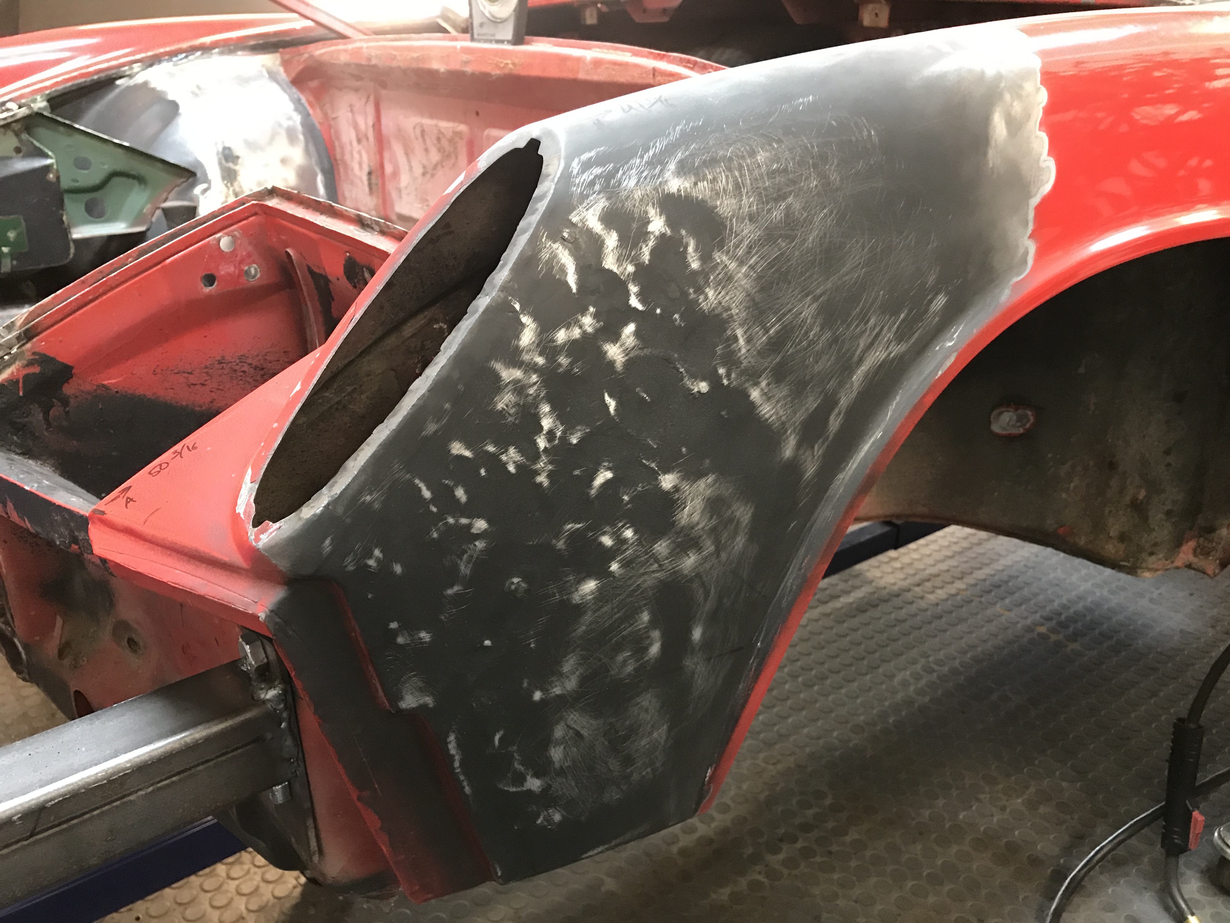

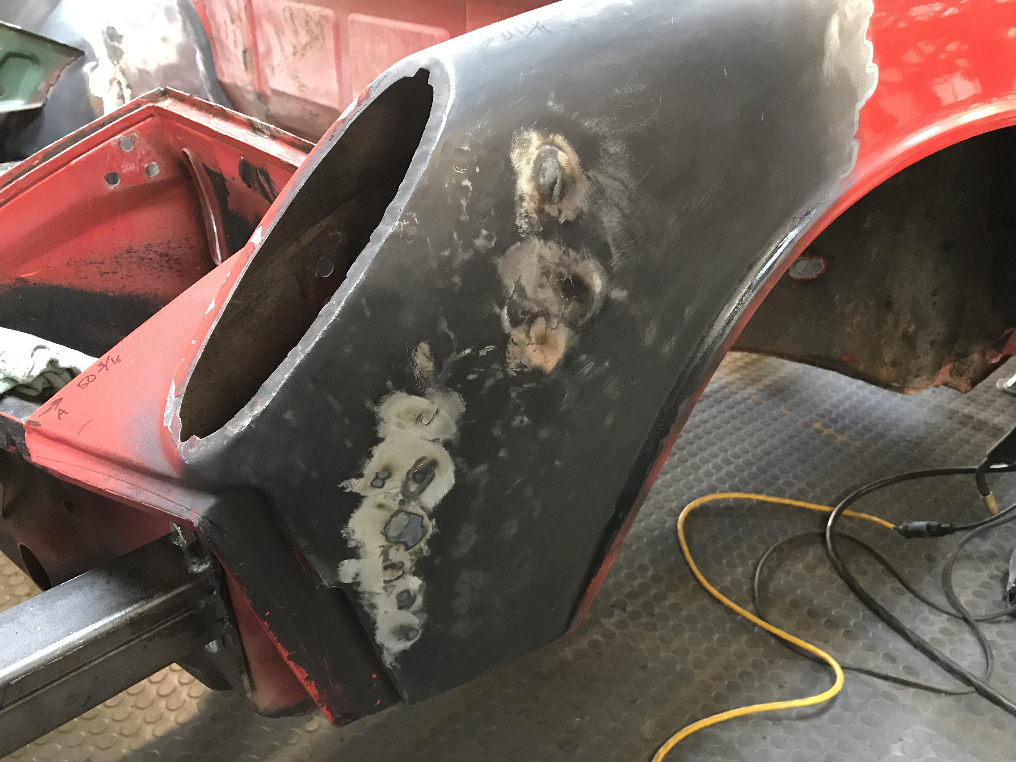

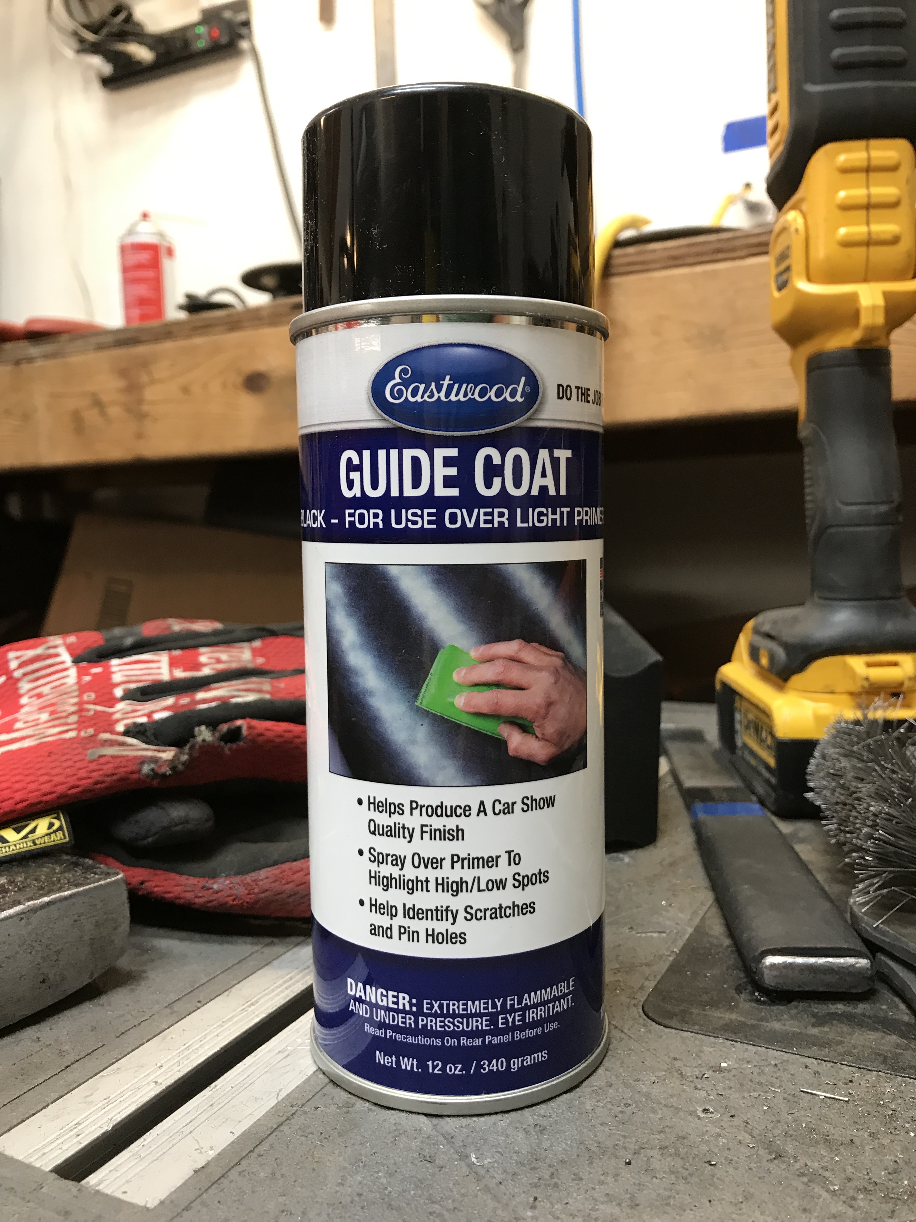

On the the next phase, trying to get the fender as smooth as possible. I might have fantasies about getting the metal ready for paint, but I can settle for a surface as smooth as possible, and then a minimum amount of filler.
First step is using some guide coat spray.
bkrantz
post May 1 2020, 08:55 PM
Post #586
Posts: 8,342
Joined: 3-August 19
From: SW Colorado
Member No.: 23,343

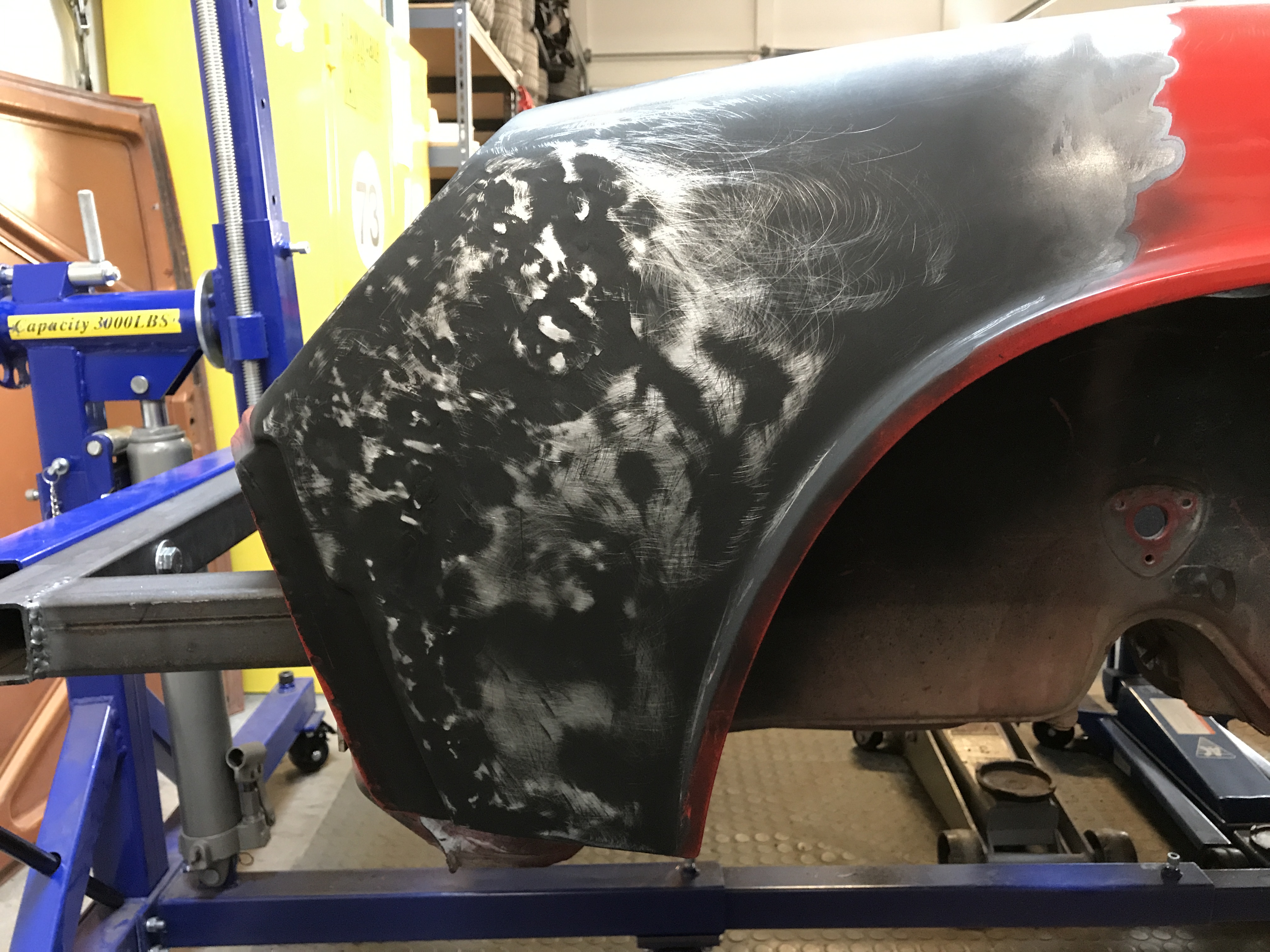

That provides a uniform matte black coat. The surface looks pretty good.
bkrantz
post May 1 2020, 08:57 PM
Post #587
Posts: 8,342
Joined: 3-August 19
From: SW Colorado
Member No.: 23,343
Then a a light sanding, to reveal the highs and lows--things look a little rougher now!
Now to raise the low spots and tap down or grind the highs.

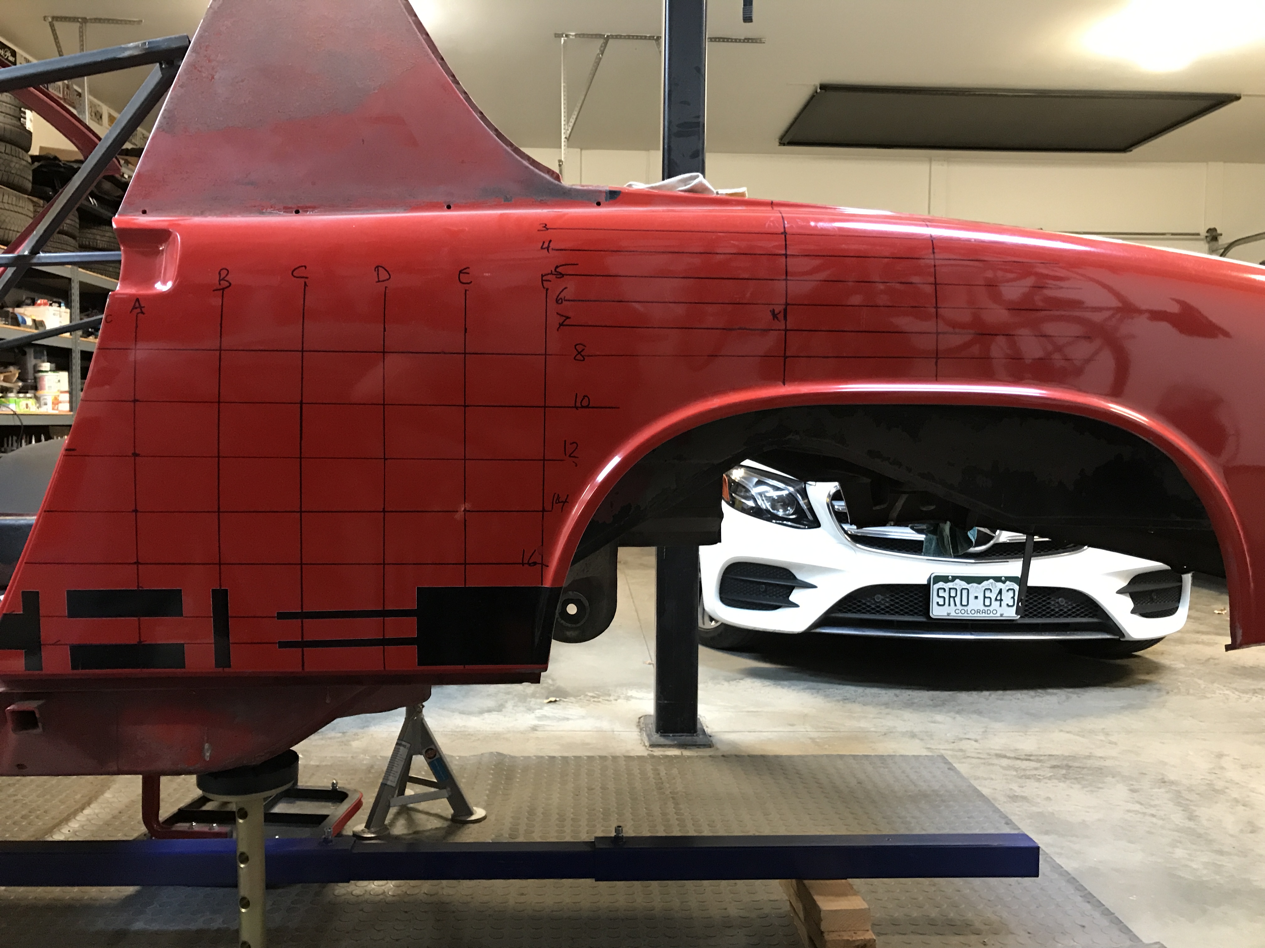

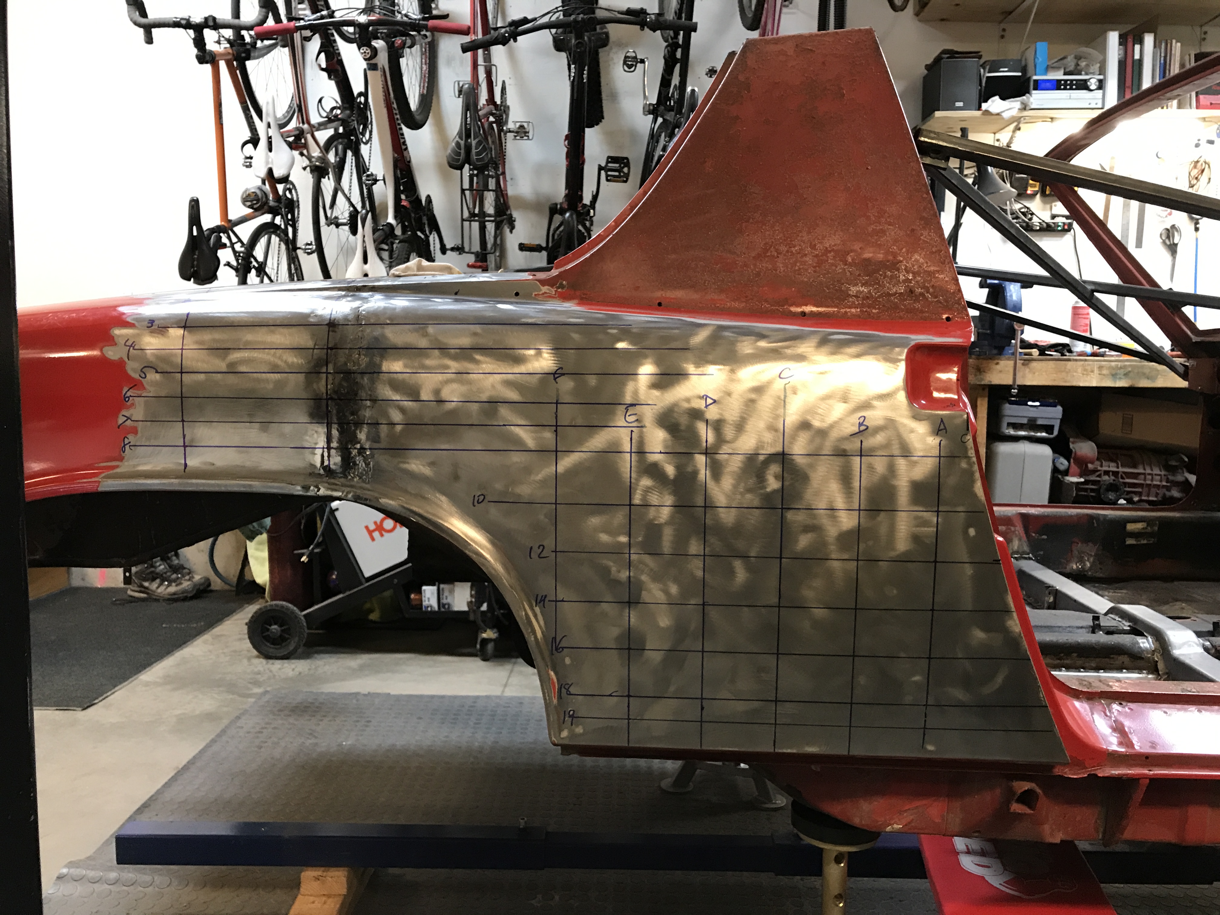

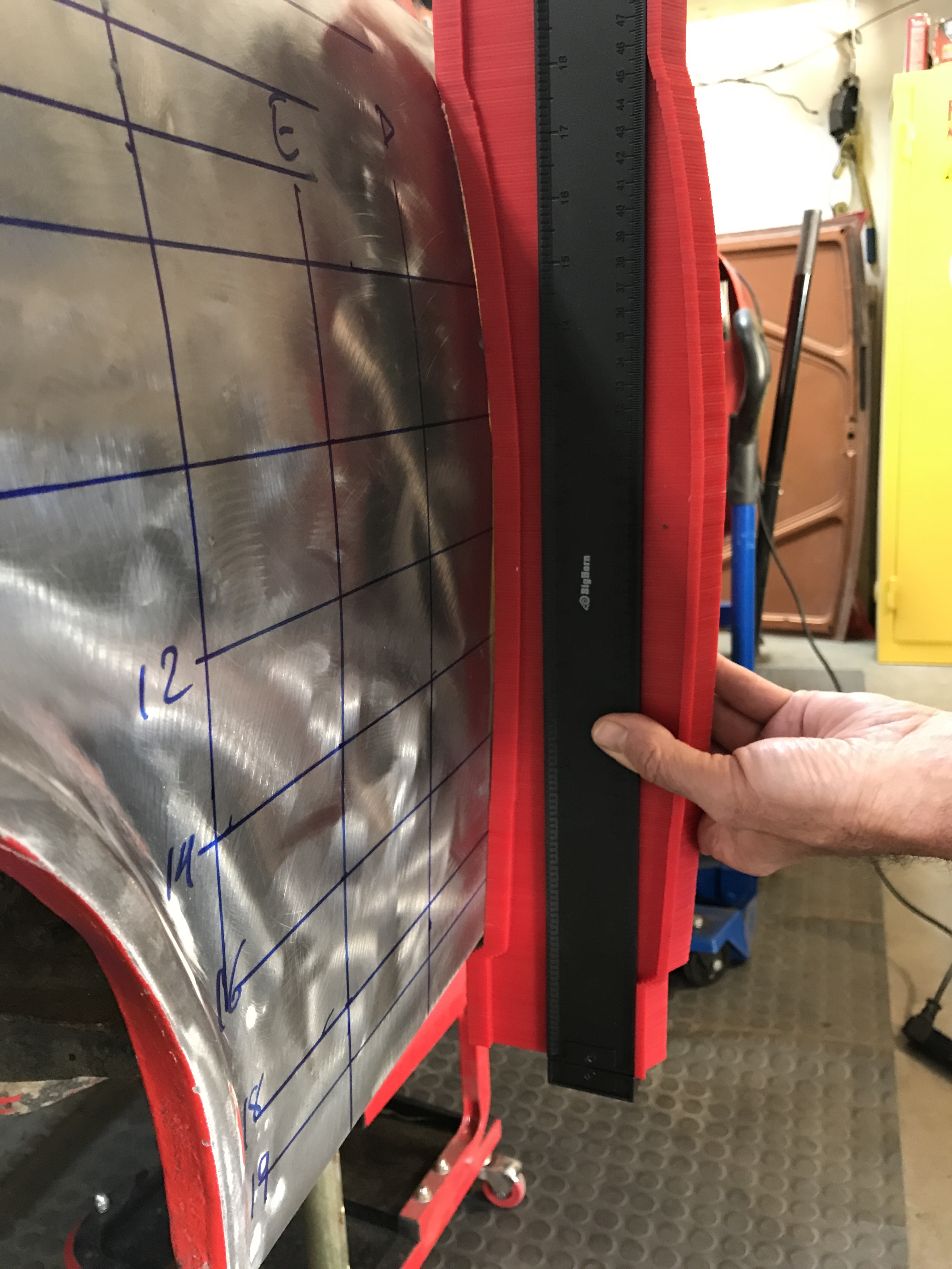

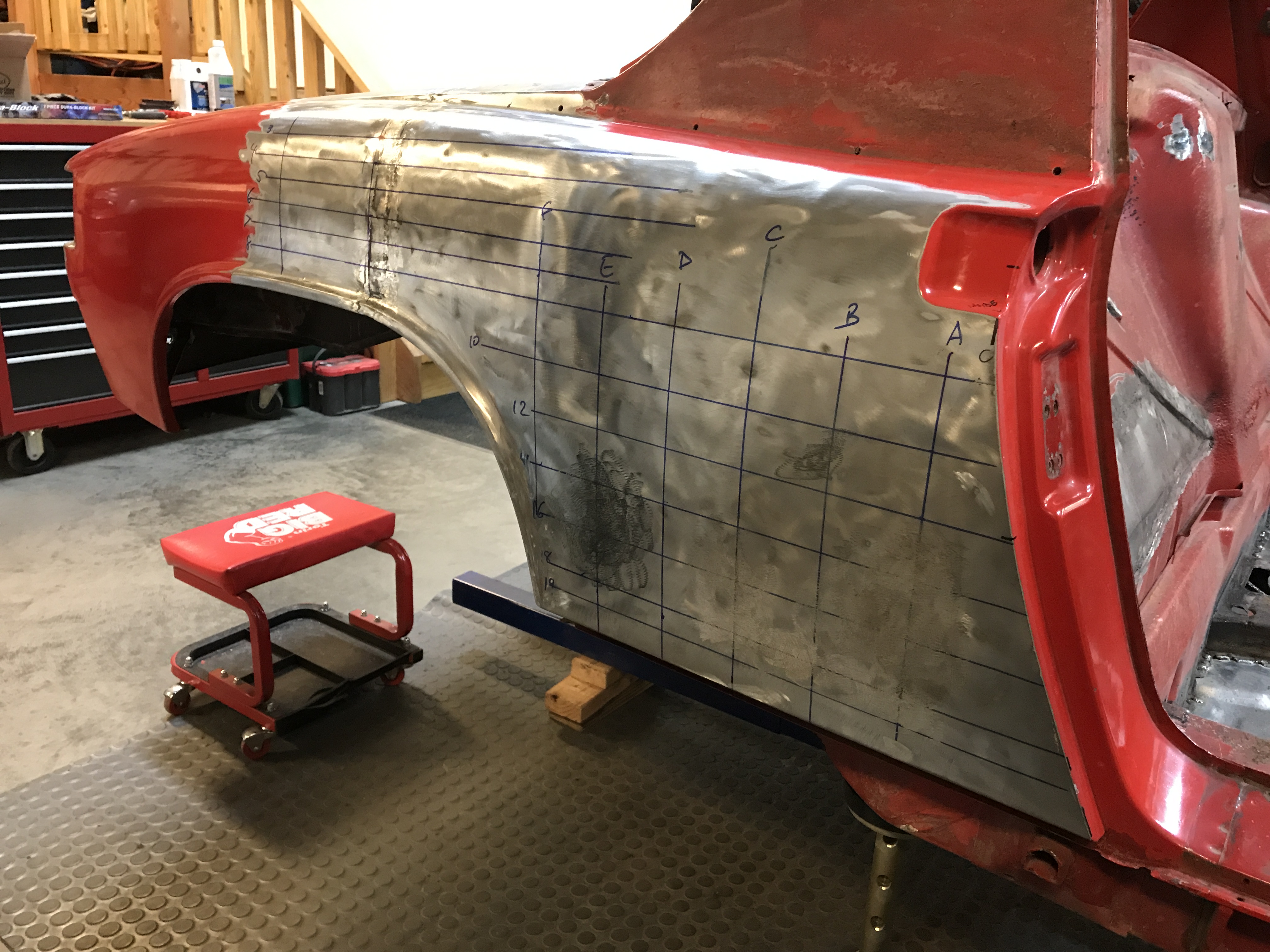

I also got started on the right rear fender, laying out guidelines to compare profiles.

Here are the some lines on the left side to use as profile models.

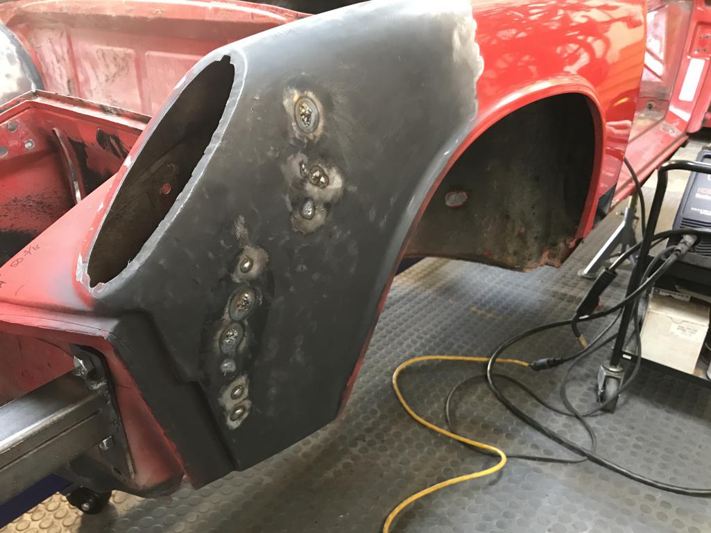

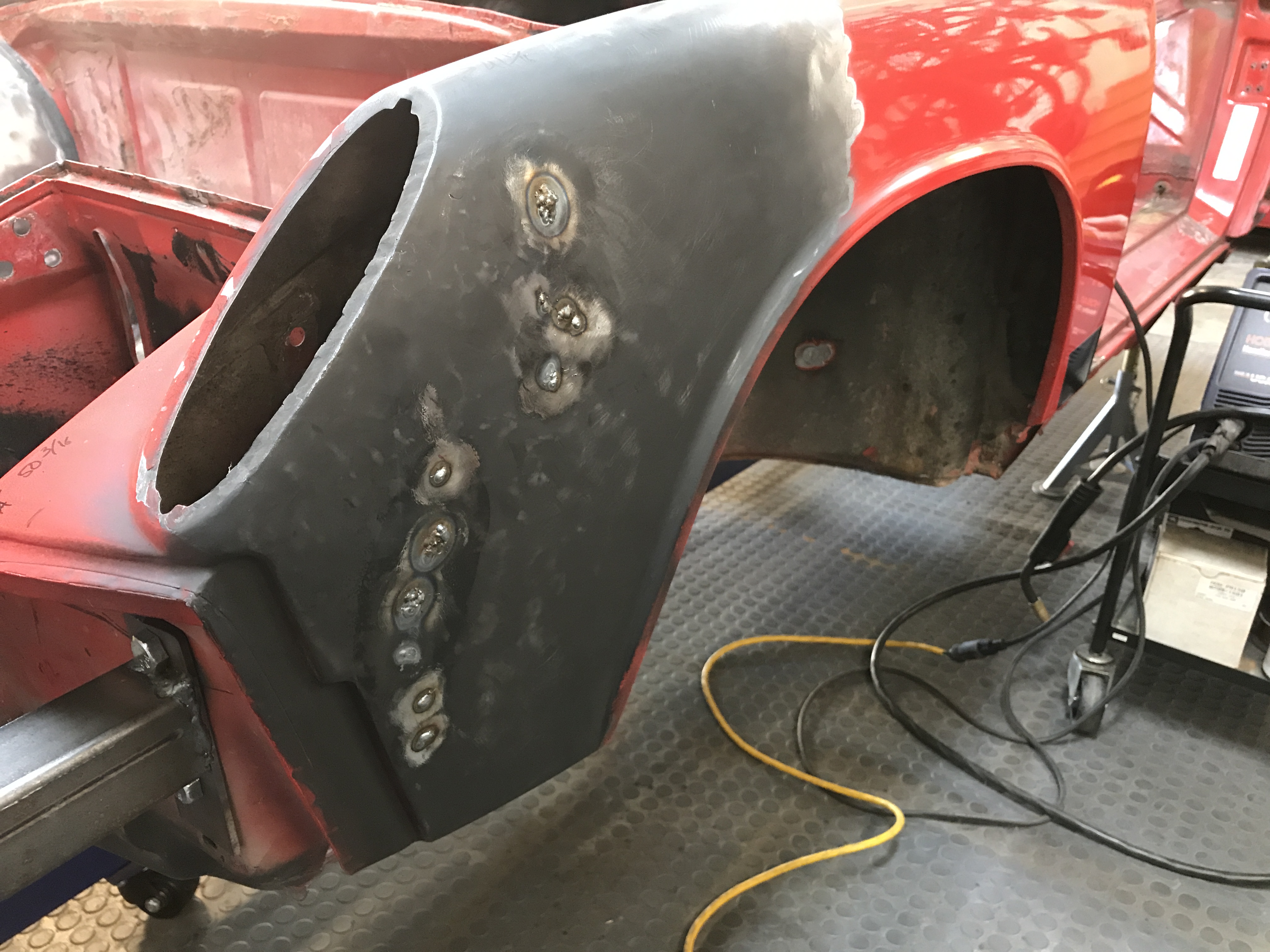

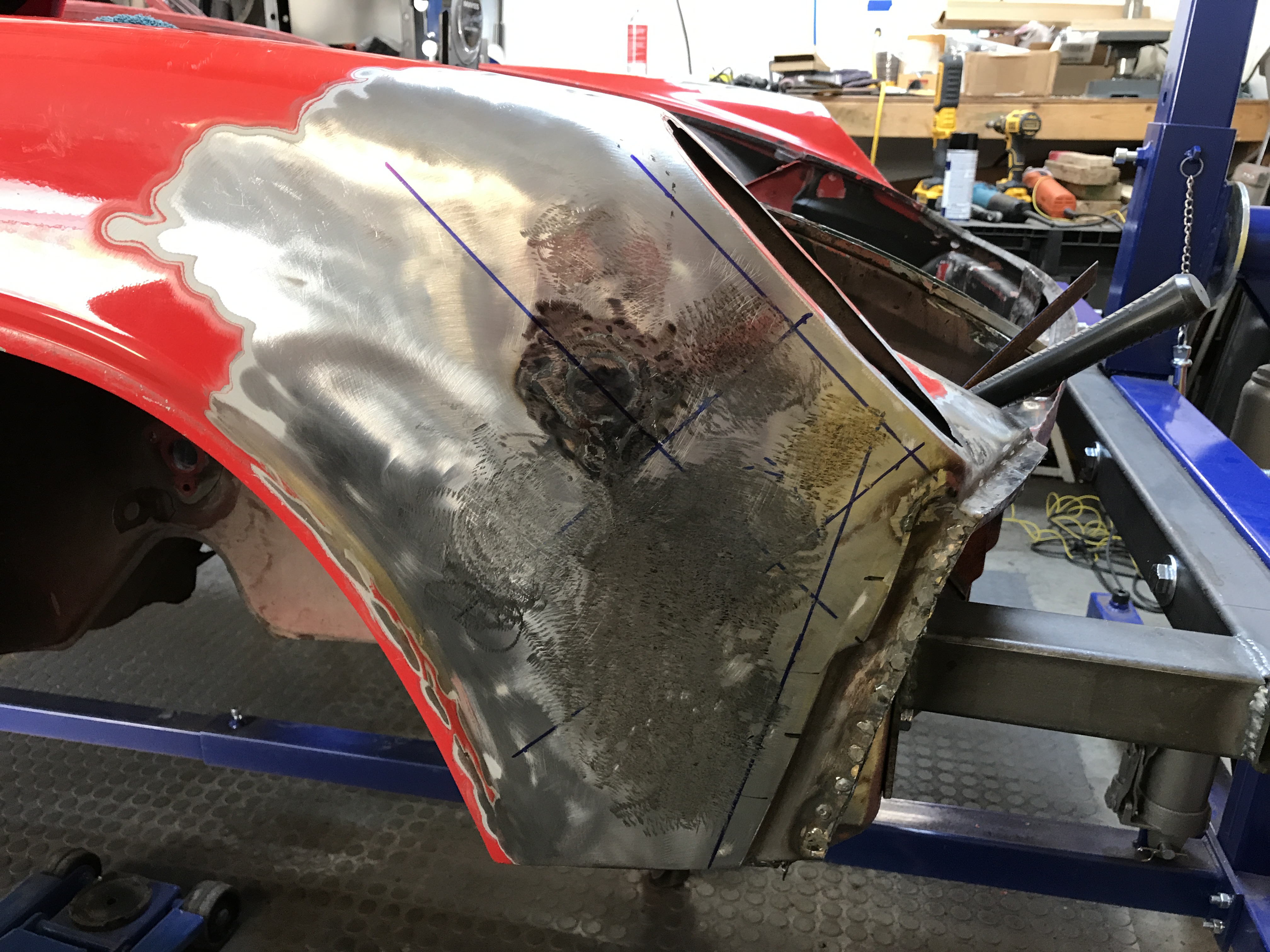

I then got back to work, but found that my grinding broke though some of the puller hole welds, so I took a few steps back, and re-welded.
bkrantz
post May 2 2020, 09:11 PM
Post #591
Posts: 8,342
Joined: 3-August 19
From: SW Colorado
Member No.: 23,343
Of course, that means re-grinding, re-shaping, and re-smoothing.

If it's not too much trouble at some point can you explain how you are using the index / guide lines on the fender? I get it conceptually, but this looks interesting and potentially helpful. And I need to get better at this...
Thanks.

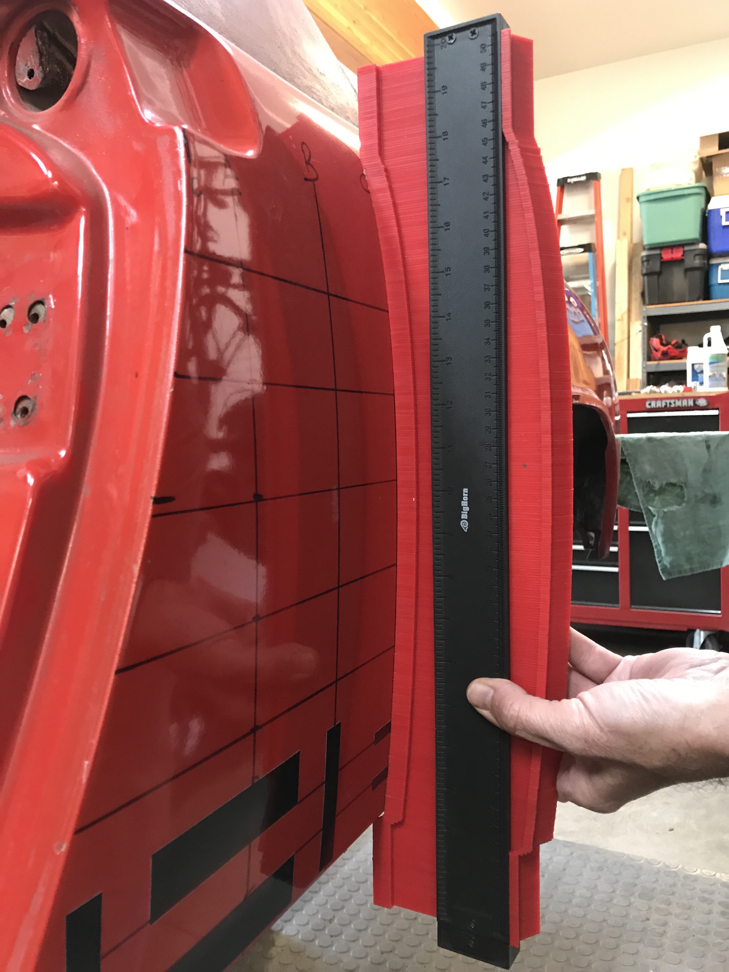

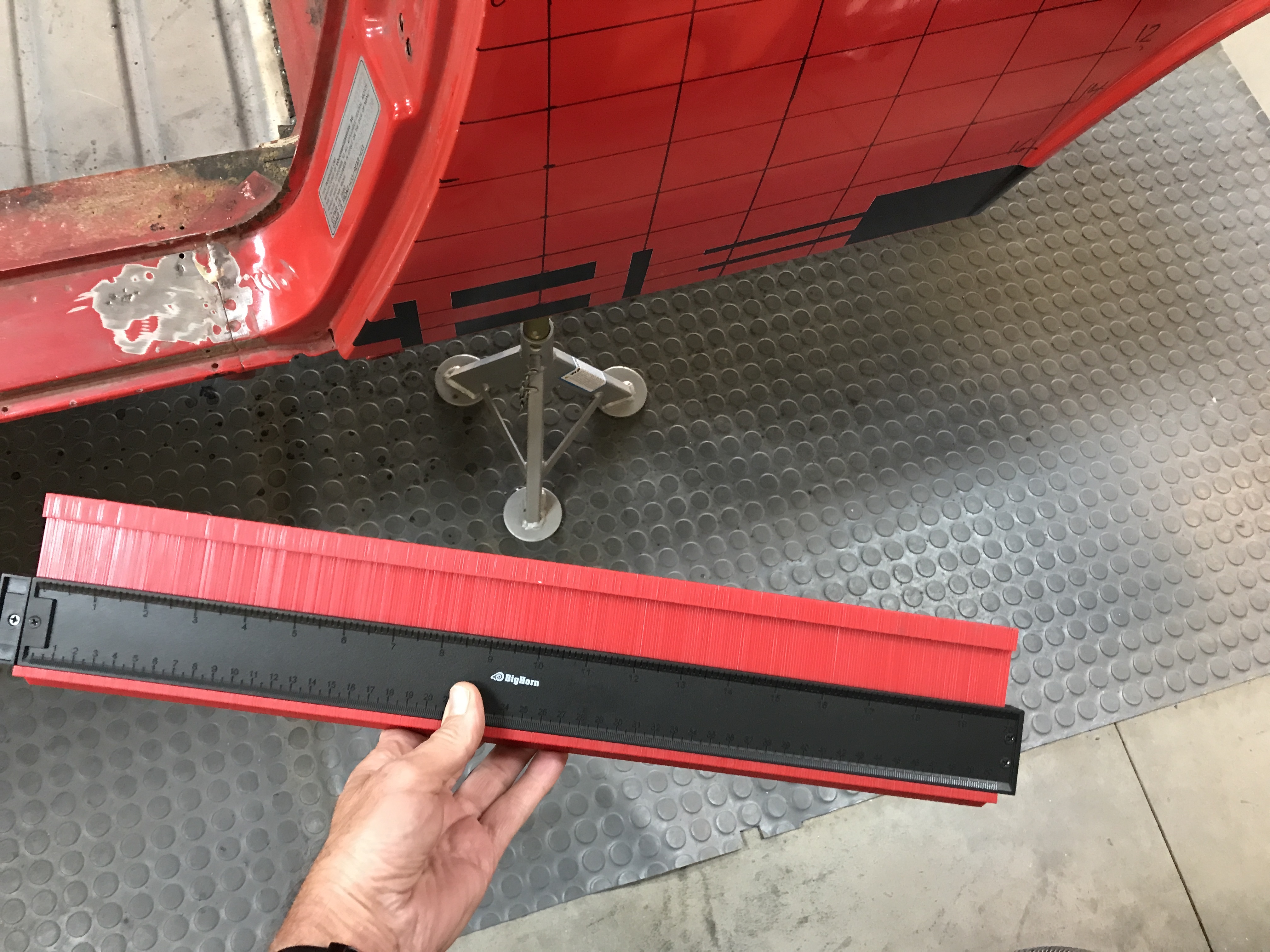

Just for you, Rob, I took some photos of my procedure with the template gauge.
Step 1: "zero" the gauge by pressing against something flat.
bkrantz
post May 4 2020, 08:19 PM
Post #595
Posts: 8,342
Joined: 3-August 19
From: SW Colorado
Member No.: 23,343
Step 2: press against the fender, holding the gauge perpendicular and along the selected line.
bkrantz
post May 4 2020, 08:21 PM
Post #596
Posts: 8,342
Joined: 3-August 19
From: SW Colorado
Member No.: 23,343
Step 3: Now hold the gauge (gently) along the same line on the other side, and note the misfit. Areas to be raised or lowered are obvious.
bkrantz
post May 4 2020, 08:22 PM
Post #597
Posts: 8,342
Joined: 3-August 19
From: SW Colorado
Member No.: 23,343
Step 4: repeat the process along all the lines. I start with the central vertical line, then the central horizontal line, and after that work my way out.
bkrantz
post May 4 2020, 08:23 PM
Post #598
Posts: 8,342
Joined: 3-August 19
From: SW Colorado
Member No.: 23,343
After about an hour, I got the right fender profiles pretty close to the left side.

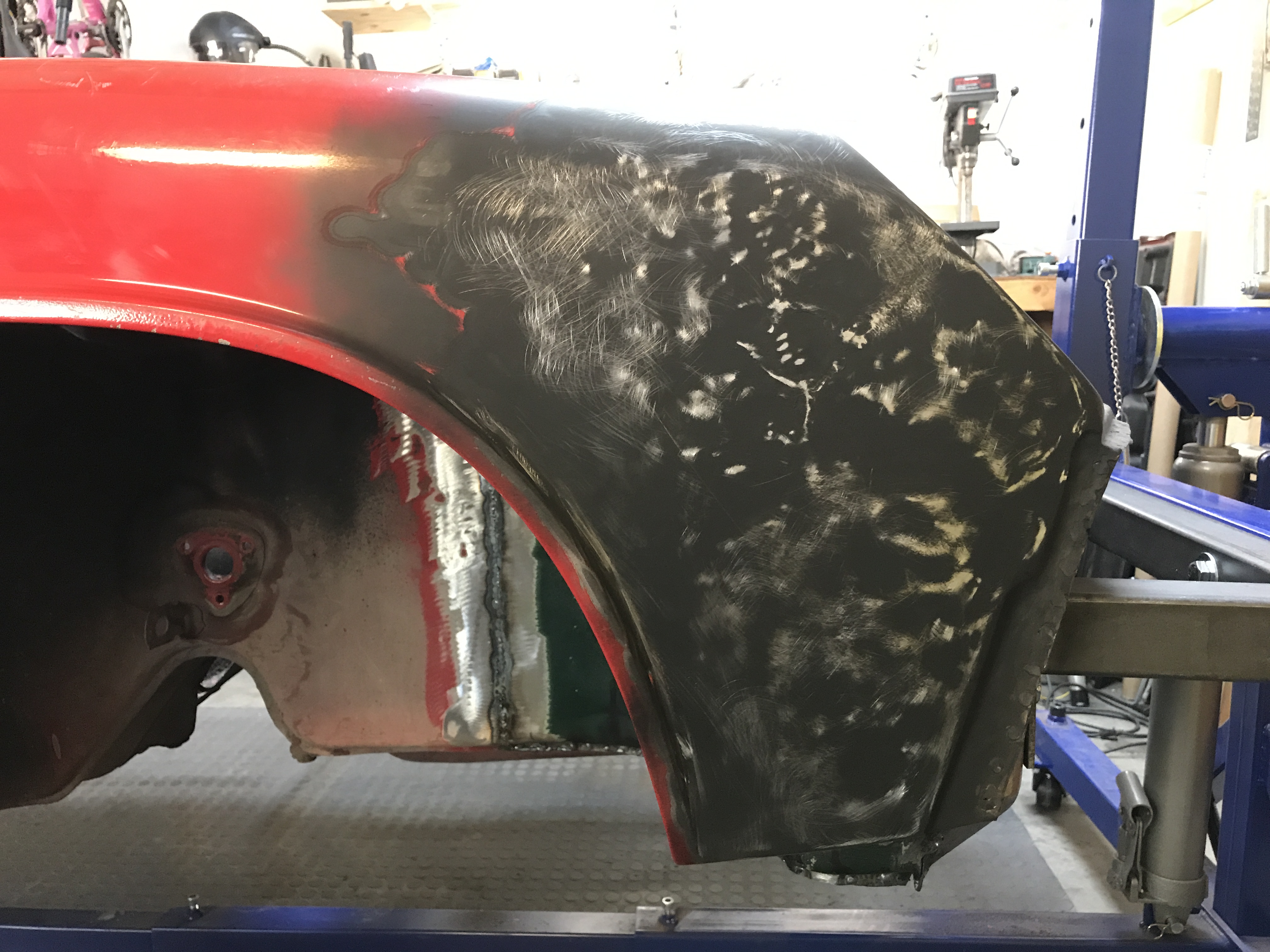

I then went back to the front fenders, trying to level out the high spots, followed by another guide coat and sanding. I might be getting as close as I can without going nuts.
Here's the left side.
bkrantz
post May 4 2020, 08:25 PM
Post #600
Posts: 8,342
Joined: 3-August 19
From: SW Colorado
Member No.: 23,343
And the right side.
