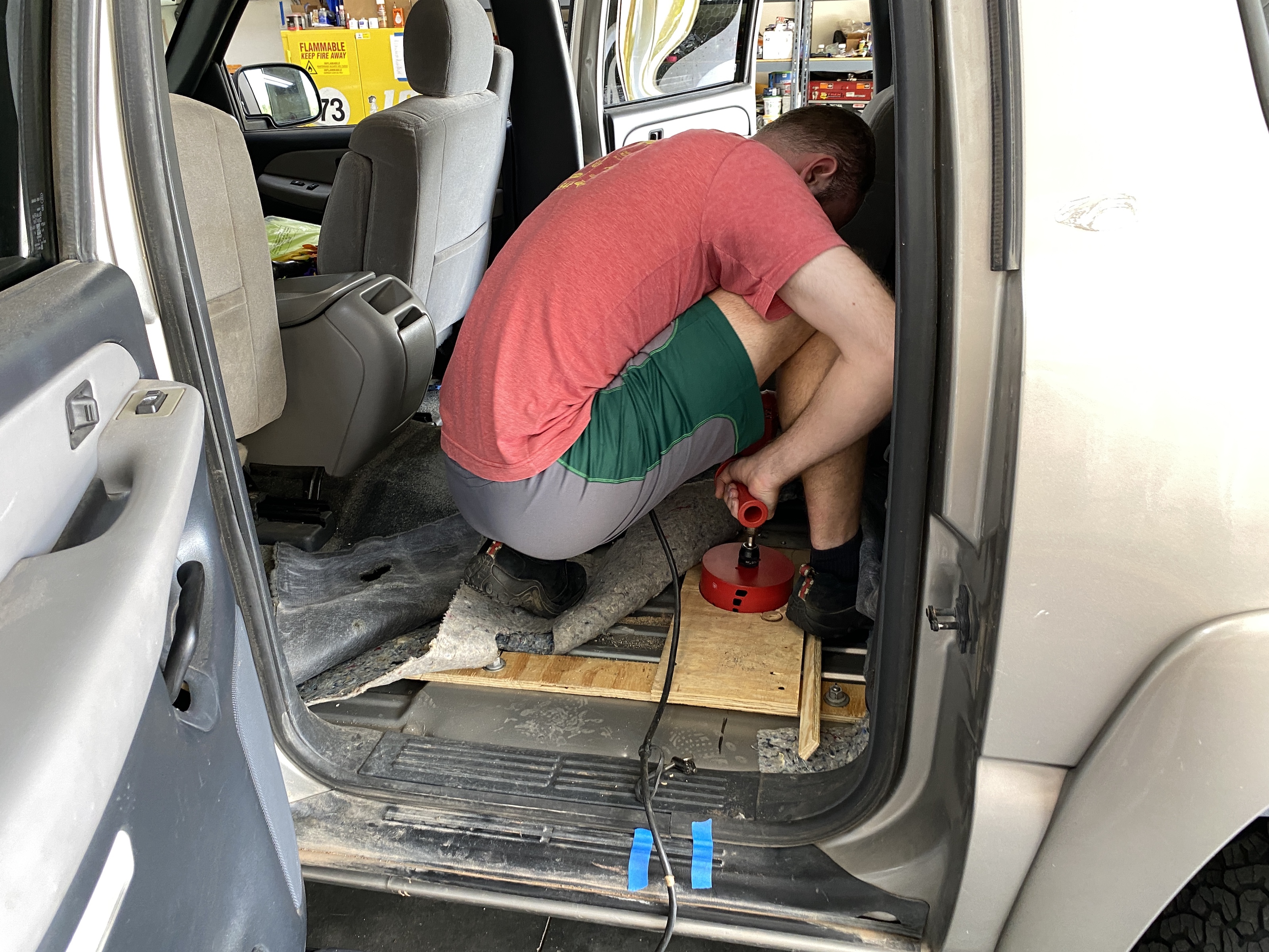

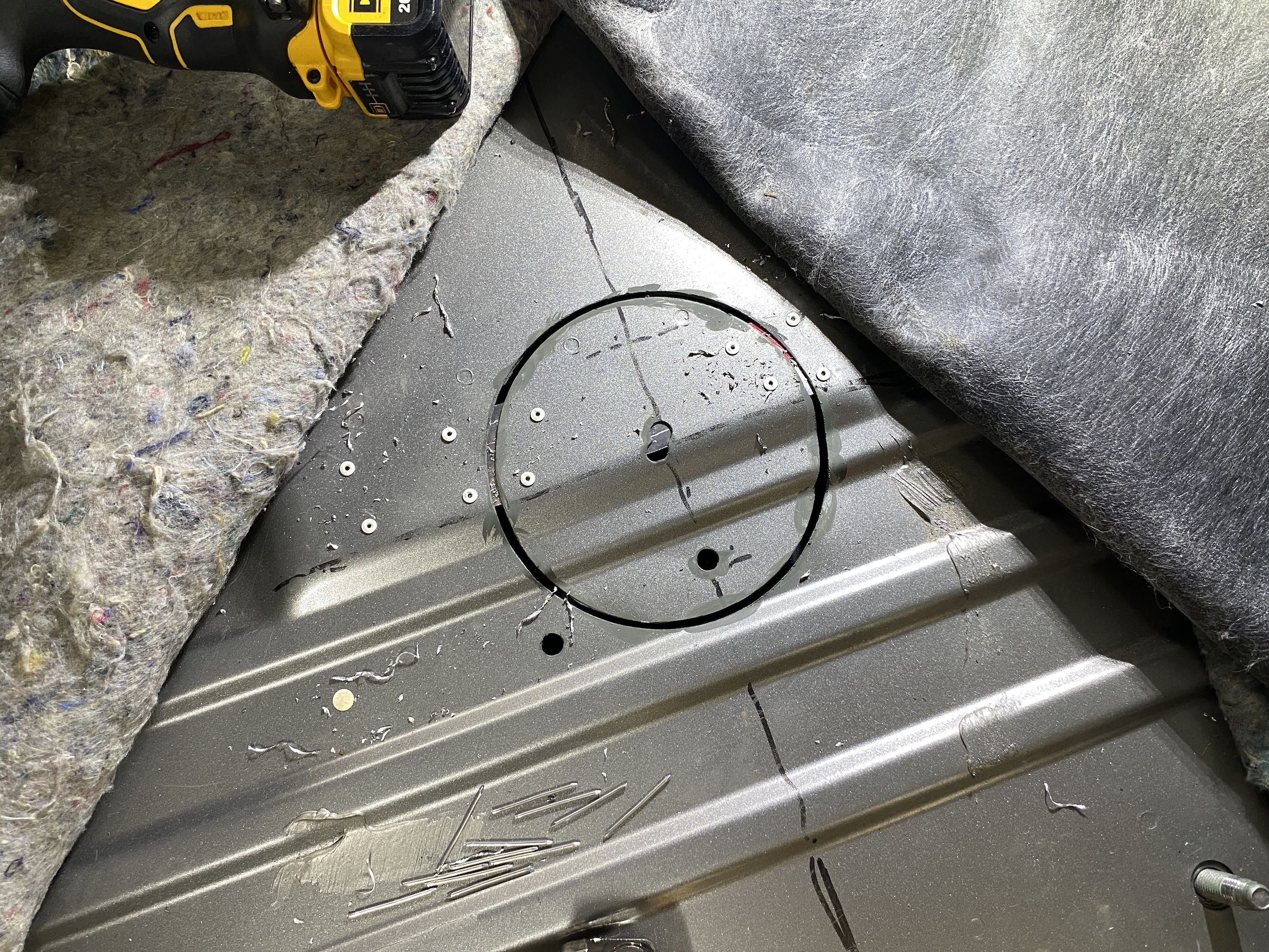

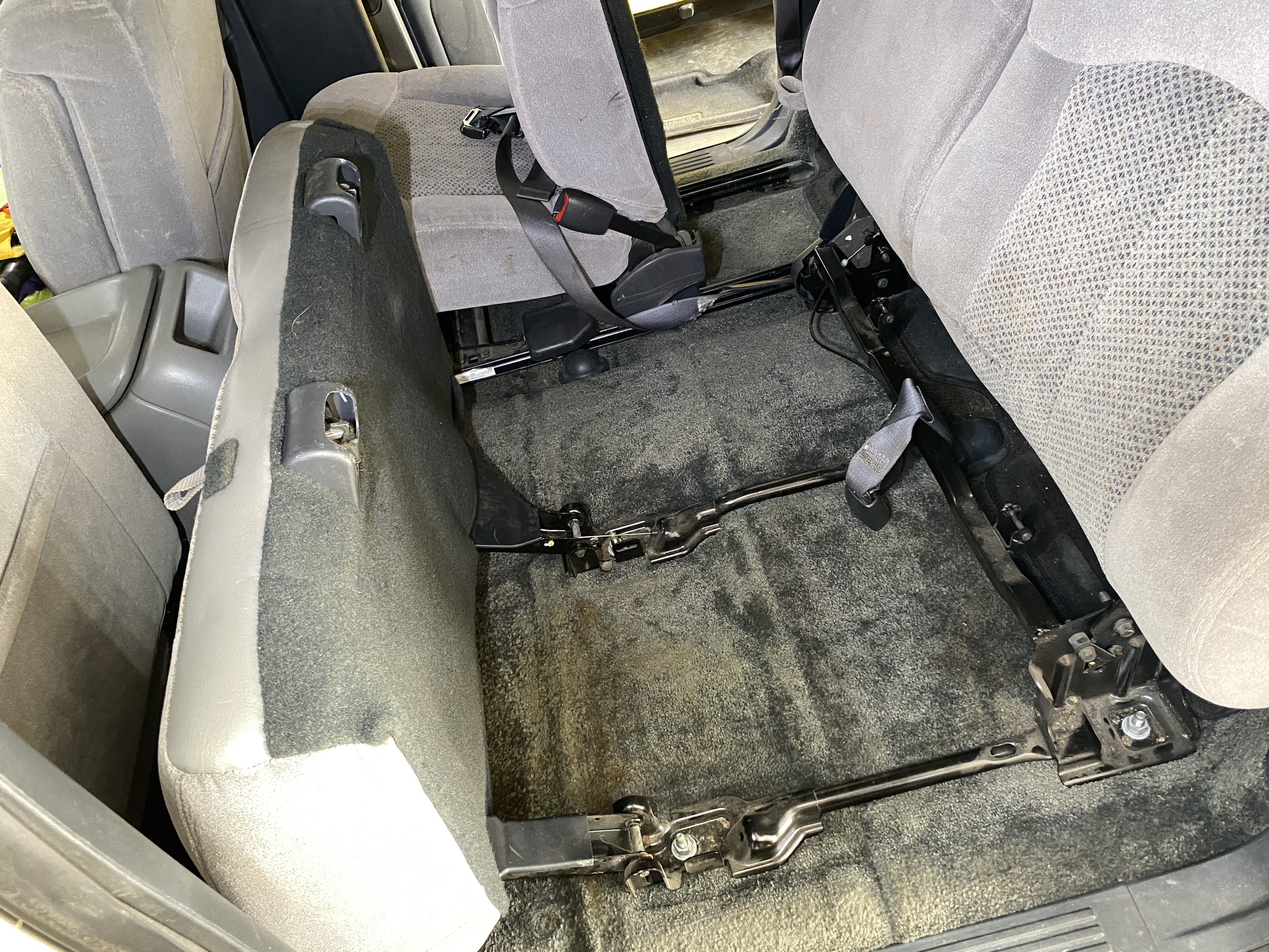

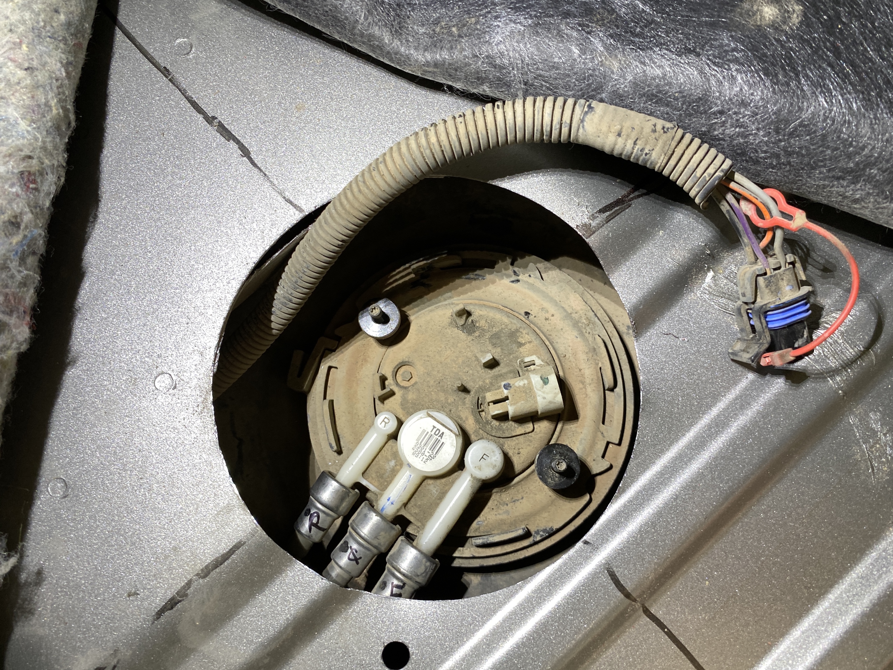

Going a bit OT, but garage time this weekend was dedicated to replacing the fuel pump and sender in my 2001 Suburban 2500. I like most things about the design, but the pump is accessed on top of the main tank. The official procedure requires dropping the tank, and lots of other stuff. The more common way is to cut a hole in the floor under the back seat. I wanted to make this look reasonably good, which requires a 6" hole saw, old school 1/2" electric drill that spins slow, a guide jig, and a willing young person.
We found the correct location by drilling 3 holes (in sequence, getting closer) and looking down with my borescope.
bkrantz
post Aug 8 2022, 07:29 PM
Post #5827
Posts: 8,343
Joined: 3-August 19
From: SW Colorado
Member No.: 23,343
Success! Here is the top of the pump-sender unit.

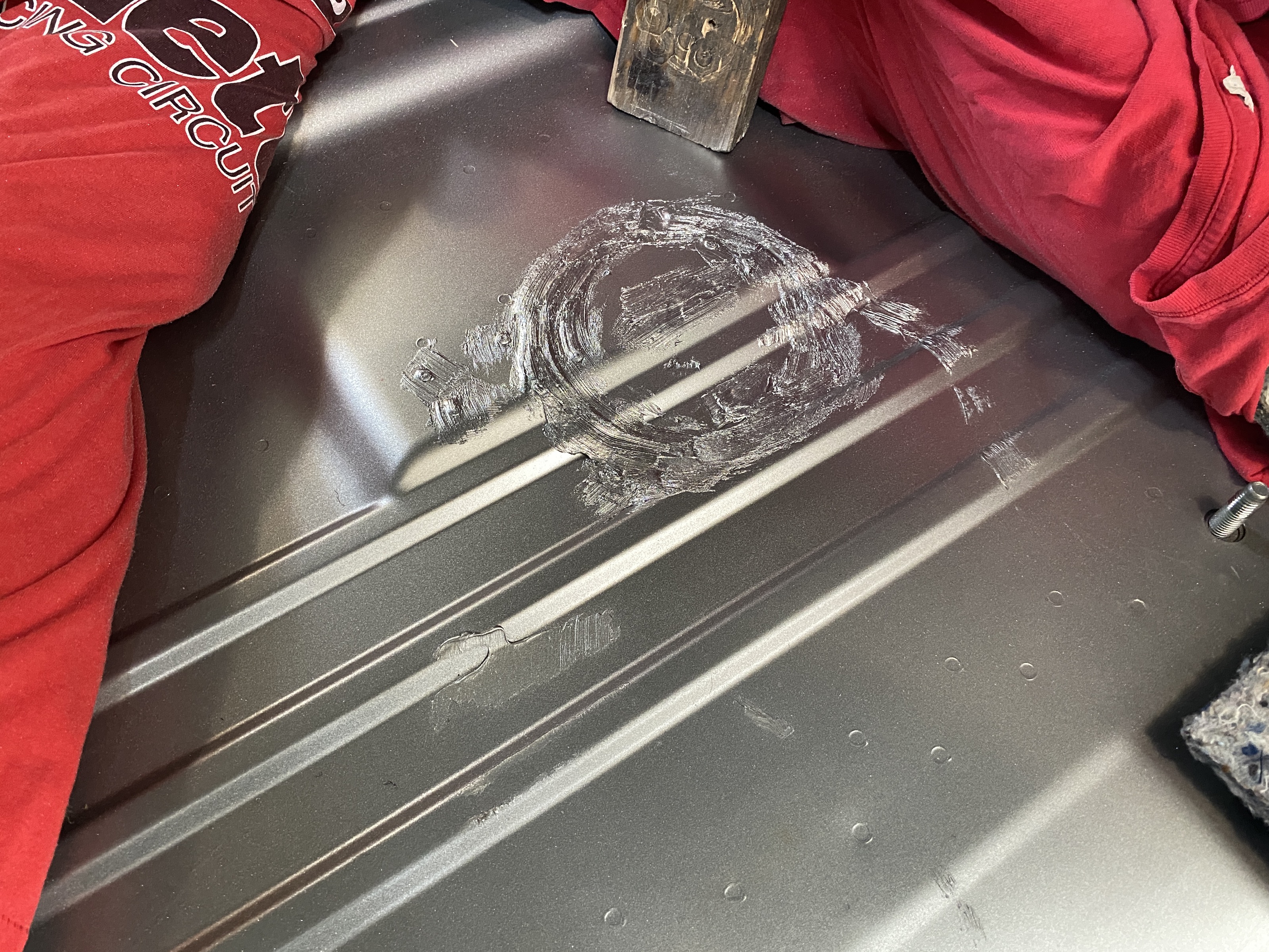

Funny you should ask. I had half a tube of 3M seam sealer left over from the 914, and a spray can of paint to match the Suburban. I tried to match some of the factory sealer smears on the floor.

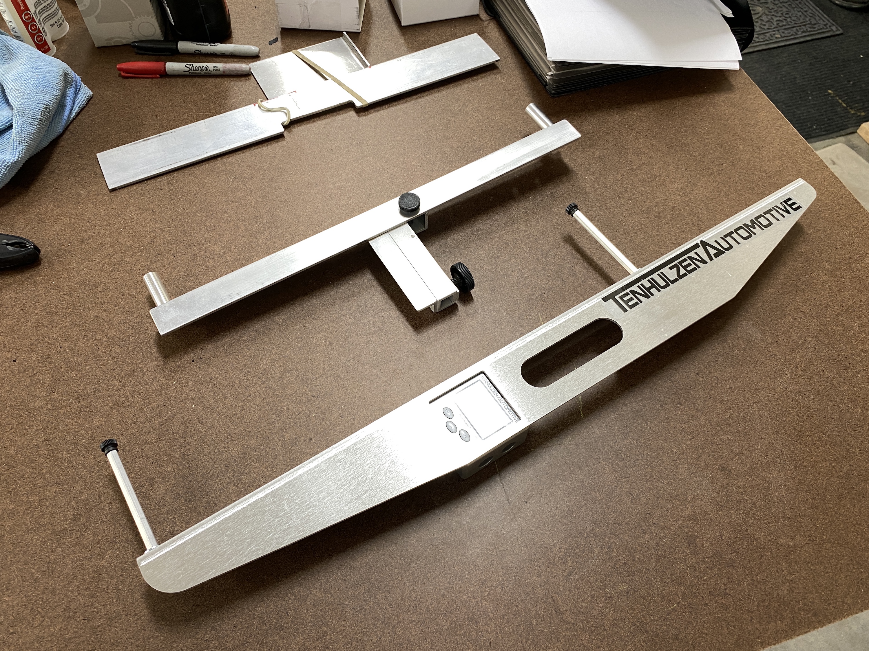

I tried out my new Tenhulzen camber gauge. I had ordered this a couple of weeks ago, but it was delayed. This has a simple adjustable frame with a digital angle gauge that is attached by magnets. It may not be more accurate than my old gauge with w bubble level, but it looks cooler.
bkrantz
post Aug 9 2022, 07:55 PM
Post #5833
Posts: 8,343
Joined: 3-August 19
From: SW Colorado
Member No.: 23,343
Final(?) camber numbers still look good, and are within 0.1° of what I measured last time.

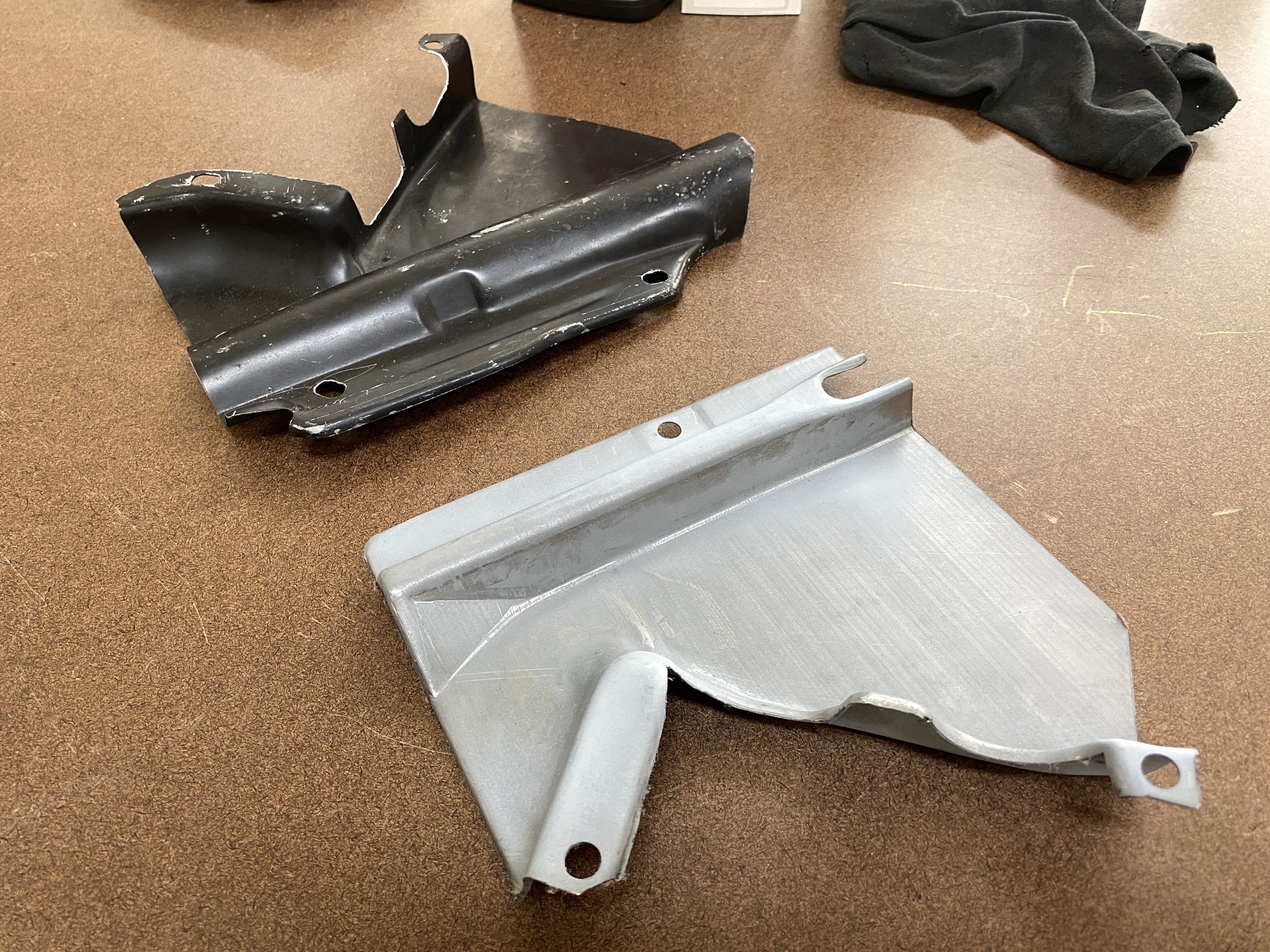

Finally, some 914 time.

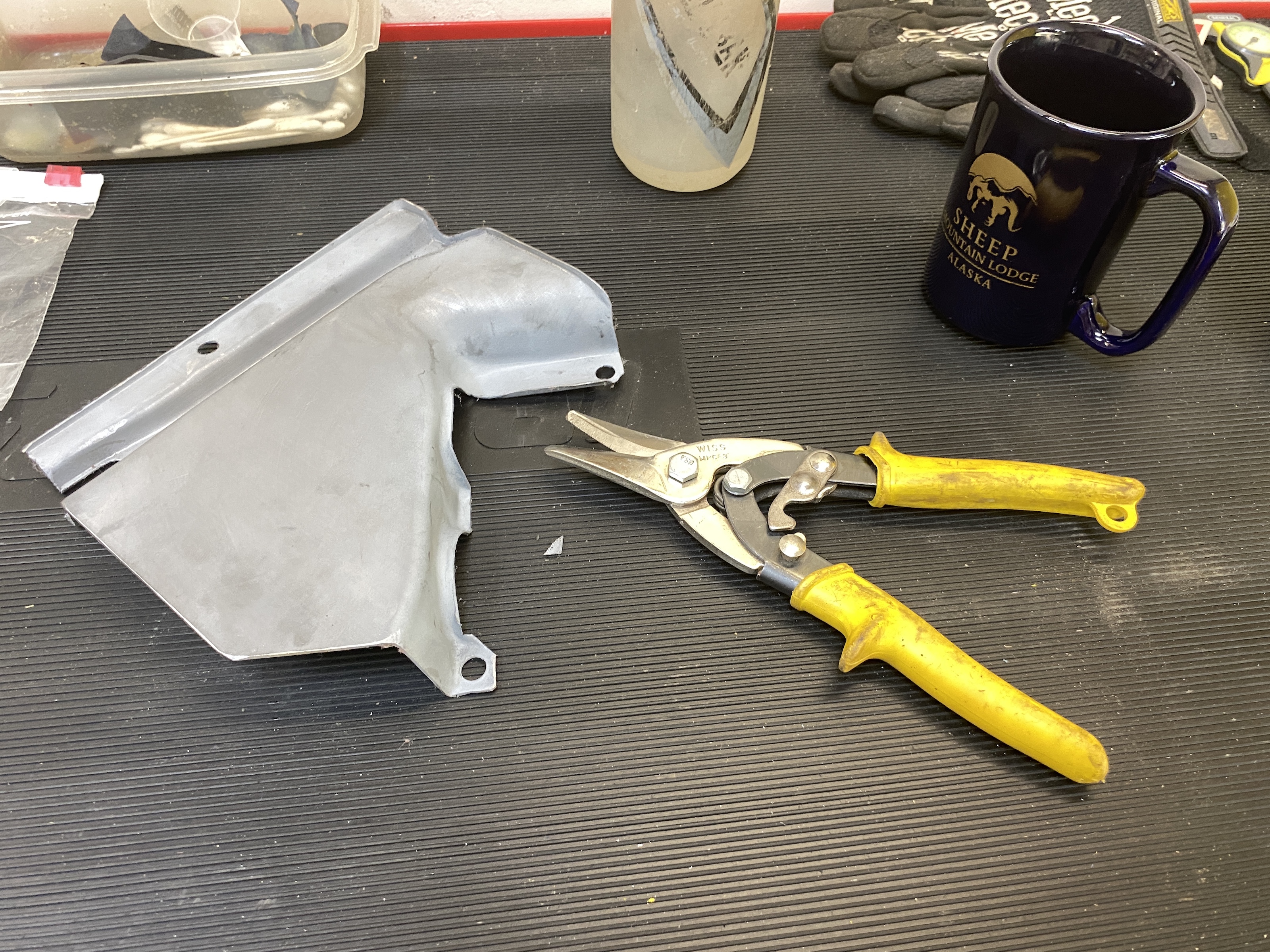

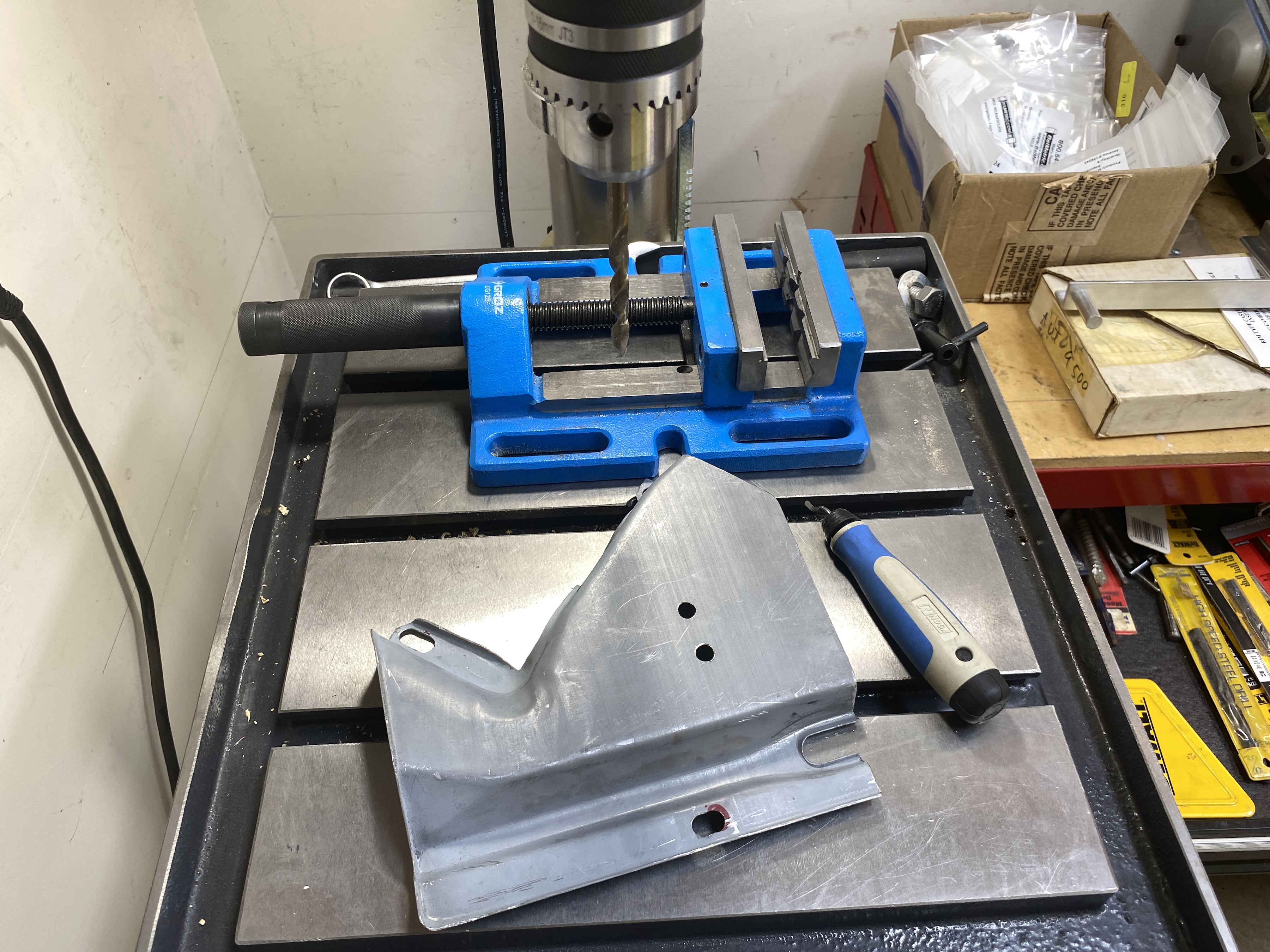

I got the new repro engine bottom sheet metal (right side) from Auto Atlanta. It looks like a nice piece, just a little rough on the edges.

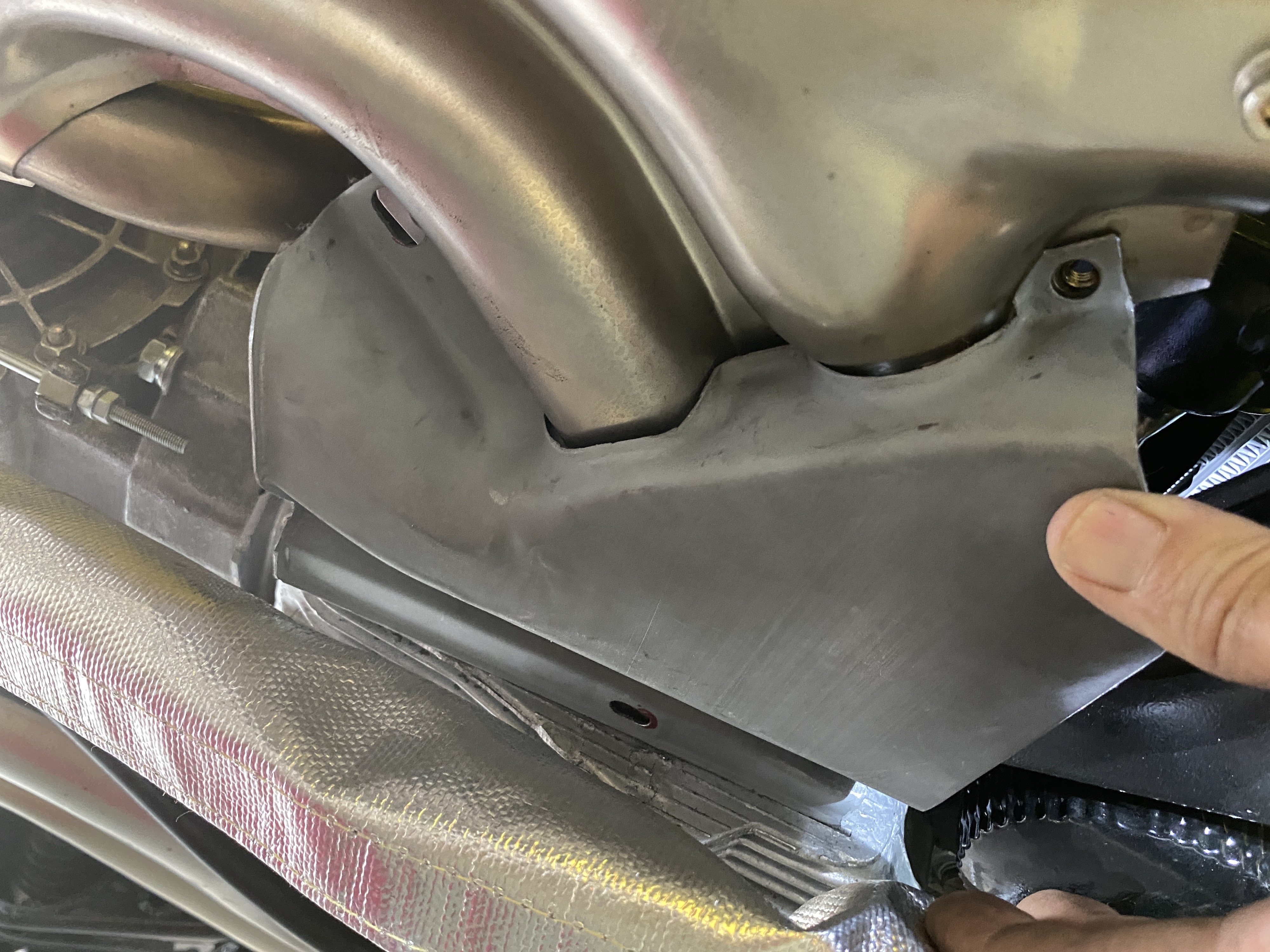

bkrantz
post Aug 13 2022, 07:59 PM
Post #5835
Posts: 8,343
Joined: 3-August 19
From: SW Colorado
Member No.: 23,343
The raw fit is close. BTW, I have aftermarket SS heat exchangers, so even an original sheet metal piece might not fit.

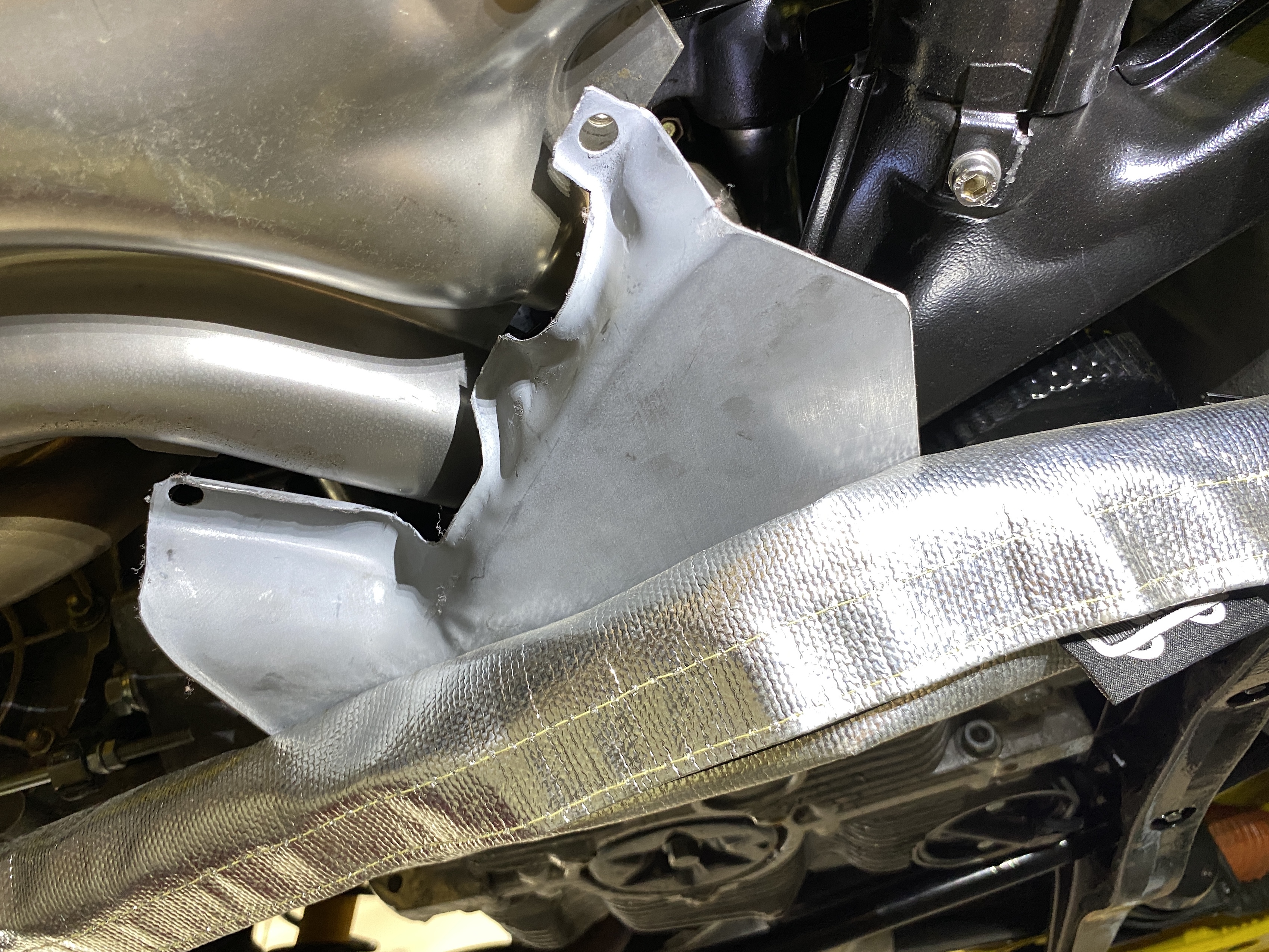

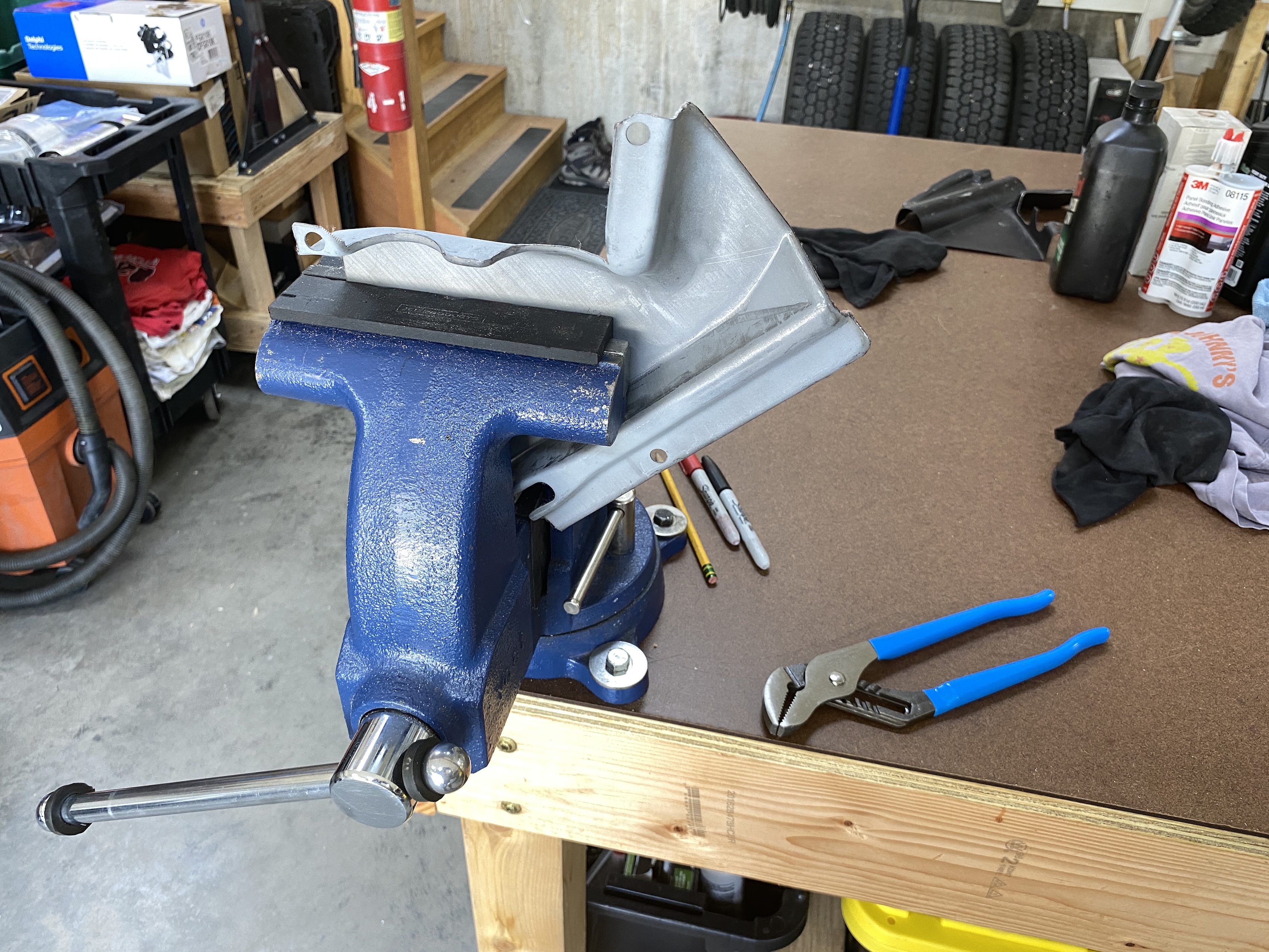

bkrantz
post Aug 13 2022, 08:00 PM
Post #5836
Posts: 8,343
Joined: 3-August 19
From: SW Colorado
Member No.: 23,343
A minor trim on one corner.
bkrantz
post Aug 13 2022, 08:01 PM
Post #5837
Posts: 8,343
Joined: 3-August 19
From: SW Colorado
Member No.: 23,343

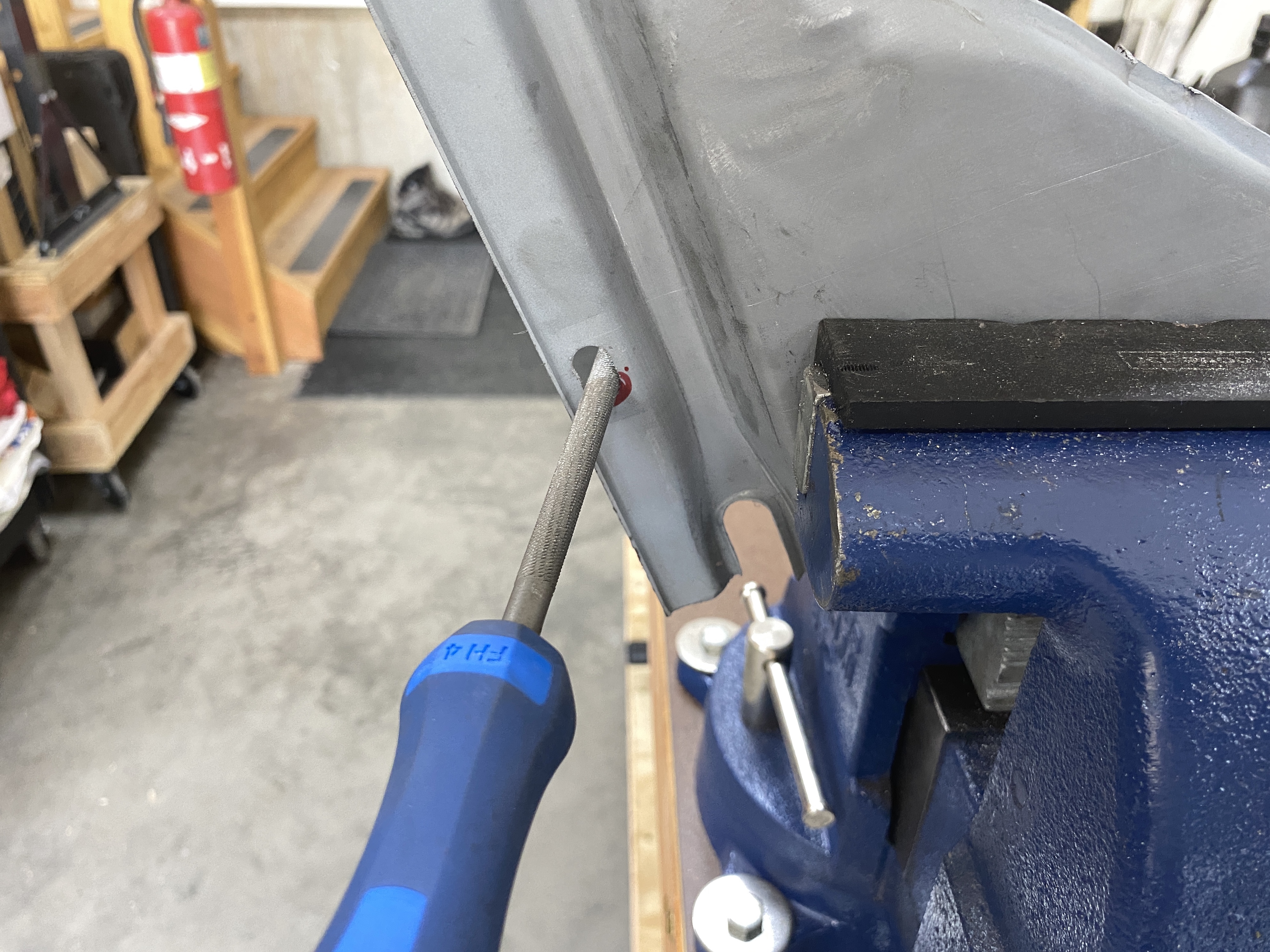

A bit of minor bending.
bkrantz
Post #5838
Posts: 8,343
Joined: 3-August 19
From: SW Colorado
Member No.: 23,343
And two elongated mounting holes.
bkrantz
post Aug 13 2022, 08:02 PM
Post #5839
Posts: 8,343
Joined: 3-August 19
From: SW Colorado
Member No.: 23,343
Excellent fit now.

I added a couple of holes so I can tie the clutch, speedo, and O2 cables to the underside.
