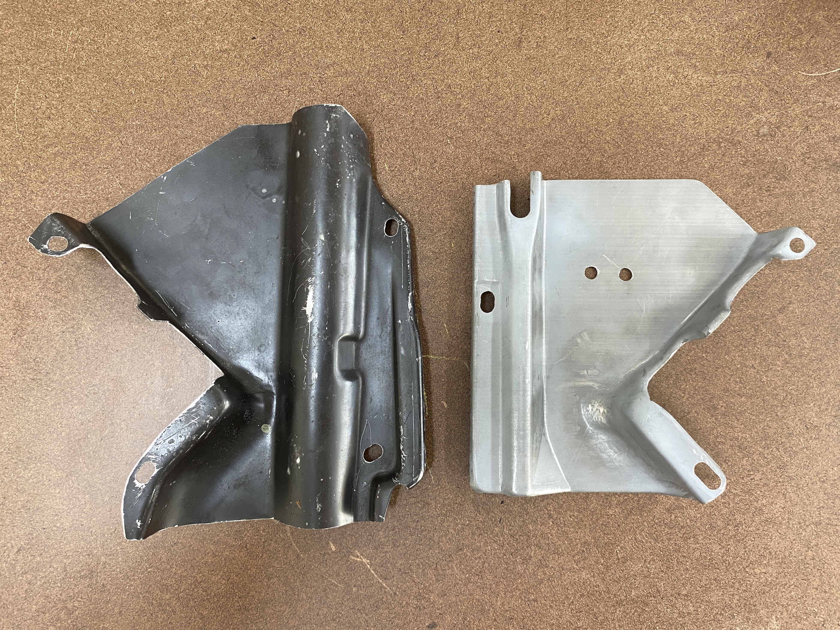

Both pieces ready for powder coating.

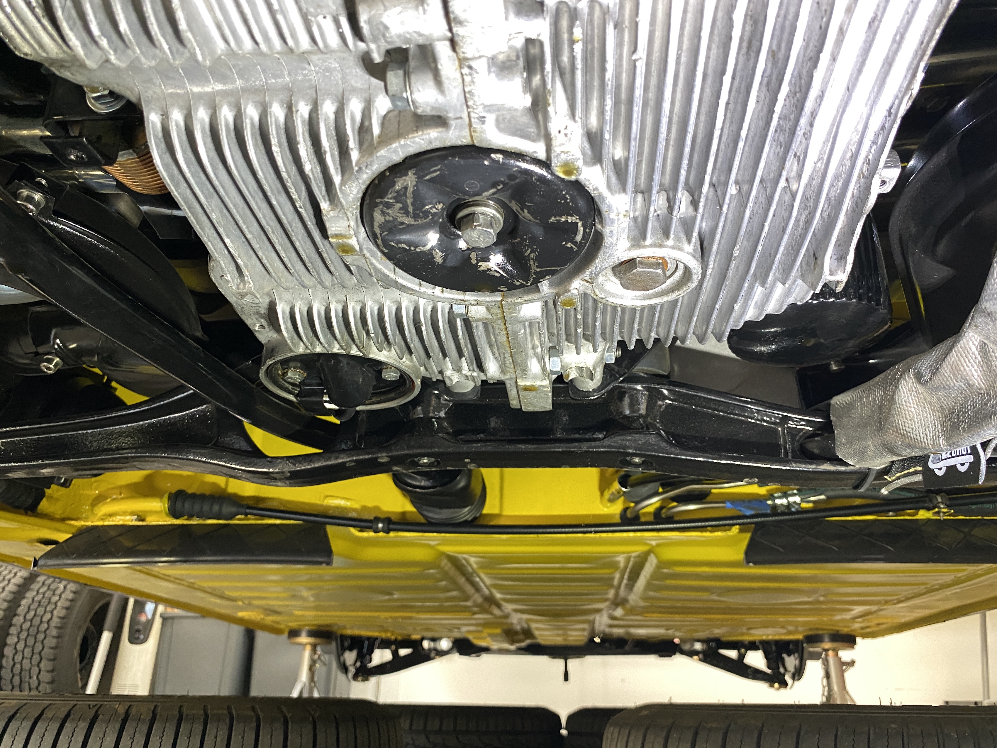

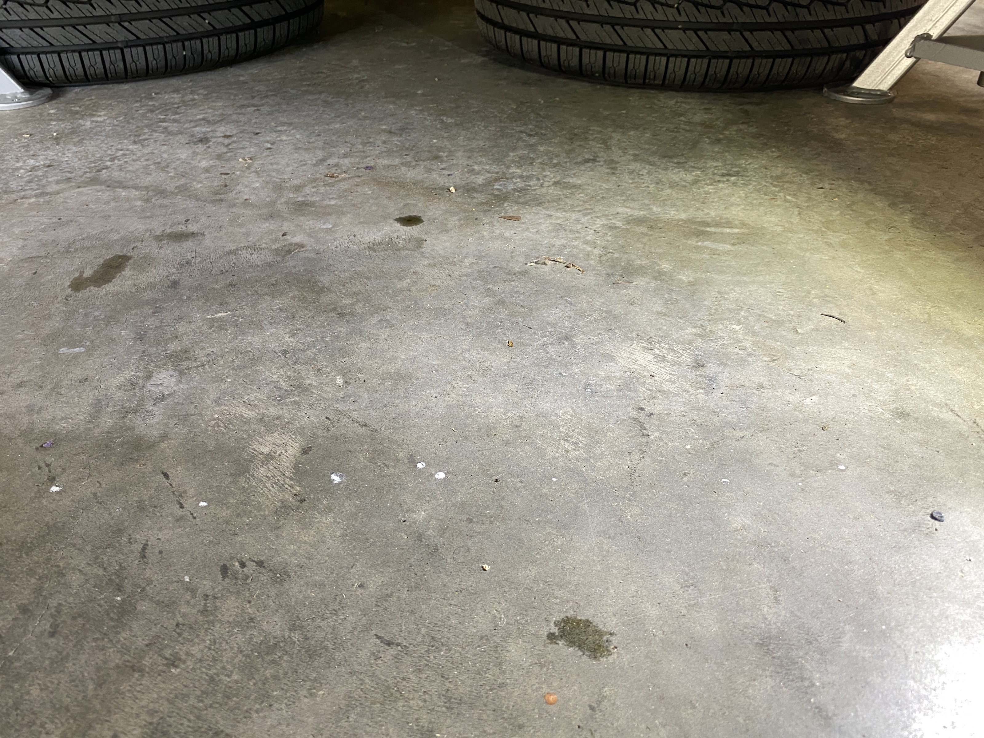

While under the car, I noticed a couple of oil spots.
bkrantz
post Aug 13 2022, 08:09 PM
Post #5843
Posts: 8,343
Joined: 3-August 19
From: SW Colorado
Member No.: 23,343
Not what I want to see. (IMG:style_emoticons/default/mad.gif)
It looks like a leak somewhere on the front. could be the oil filter mount, pressure spring cap, or oil pump.
This will have to wait until winter. From the beginning, I have expected to drop the engine to sort things out after the initial running.

QUOTE(bkrantz @ Aug 13 2022, 08:09 PM) *
In my case, I had a slight leak from the pressure spring cap. I had a heck of a time getting that tight enough. I wound up using a bit of aviation sealant on it and one of those coin style spark plug gappers to get it tight. Trashed the gapper but stopped the leak. (IMG:style_emoticons/default/biggrin.gif) Hopefully yours is the same thing. The other options sound progressively more of a pain to fix. And the other one I hear mentioned a lot, oil cooler seals.

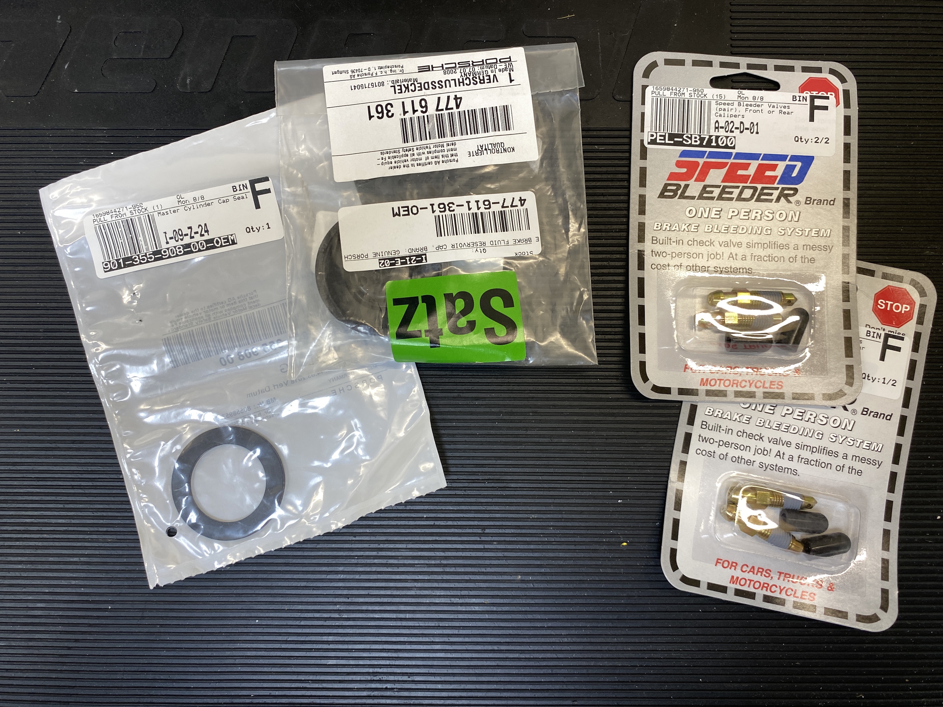

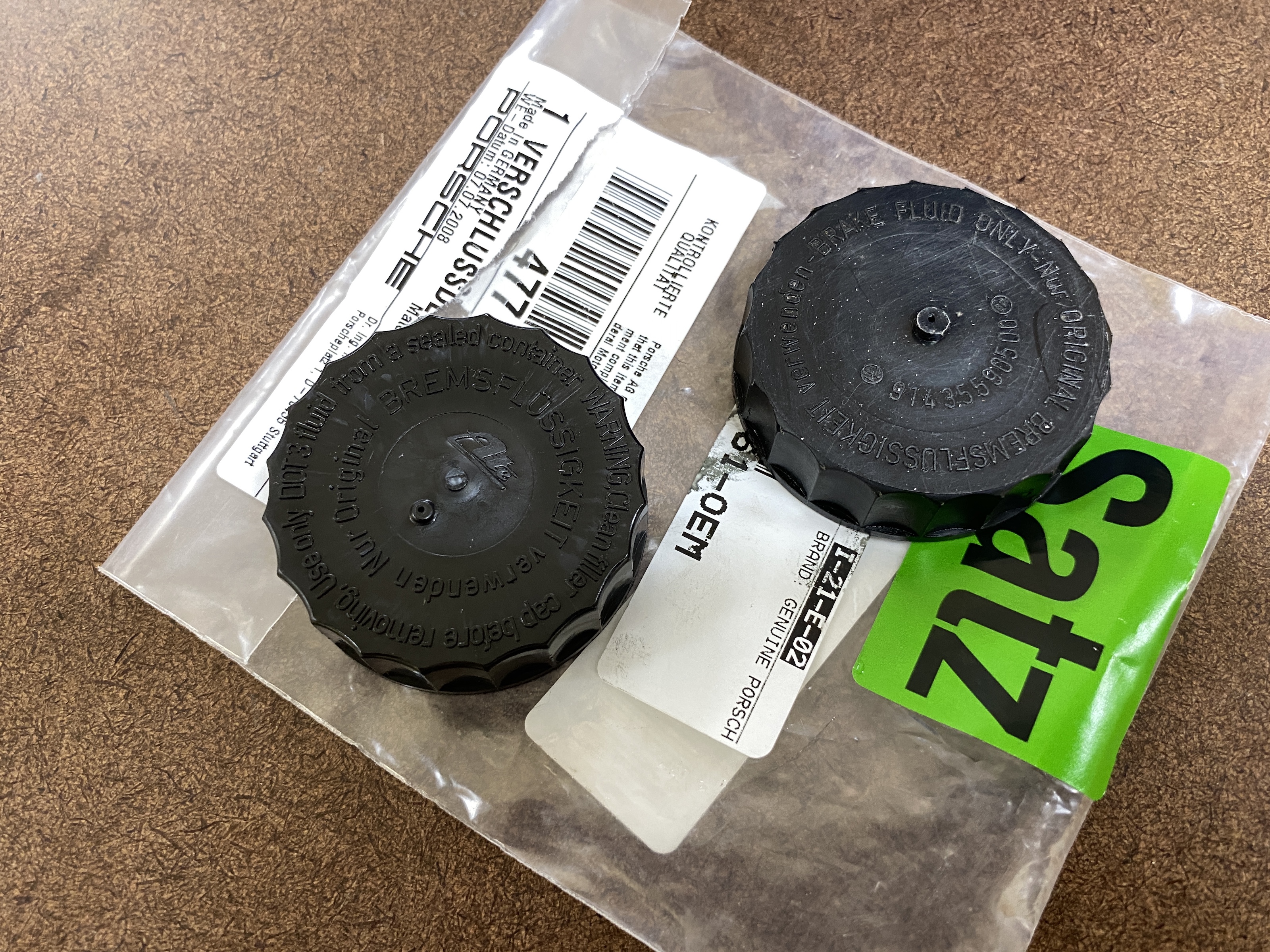

Next, some new brake parts: a reservoir cap, gasket, and set of Speed Bleeders.
bkrantz
post Aug 13 2022, 08:33 PM
Post #5846
Posts: 8,343
Joined: 3-August 19
From: SW Colorado
Member No.: 23,343

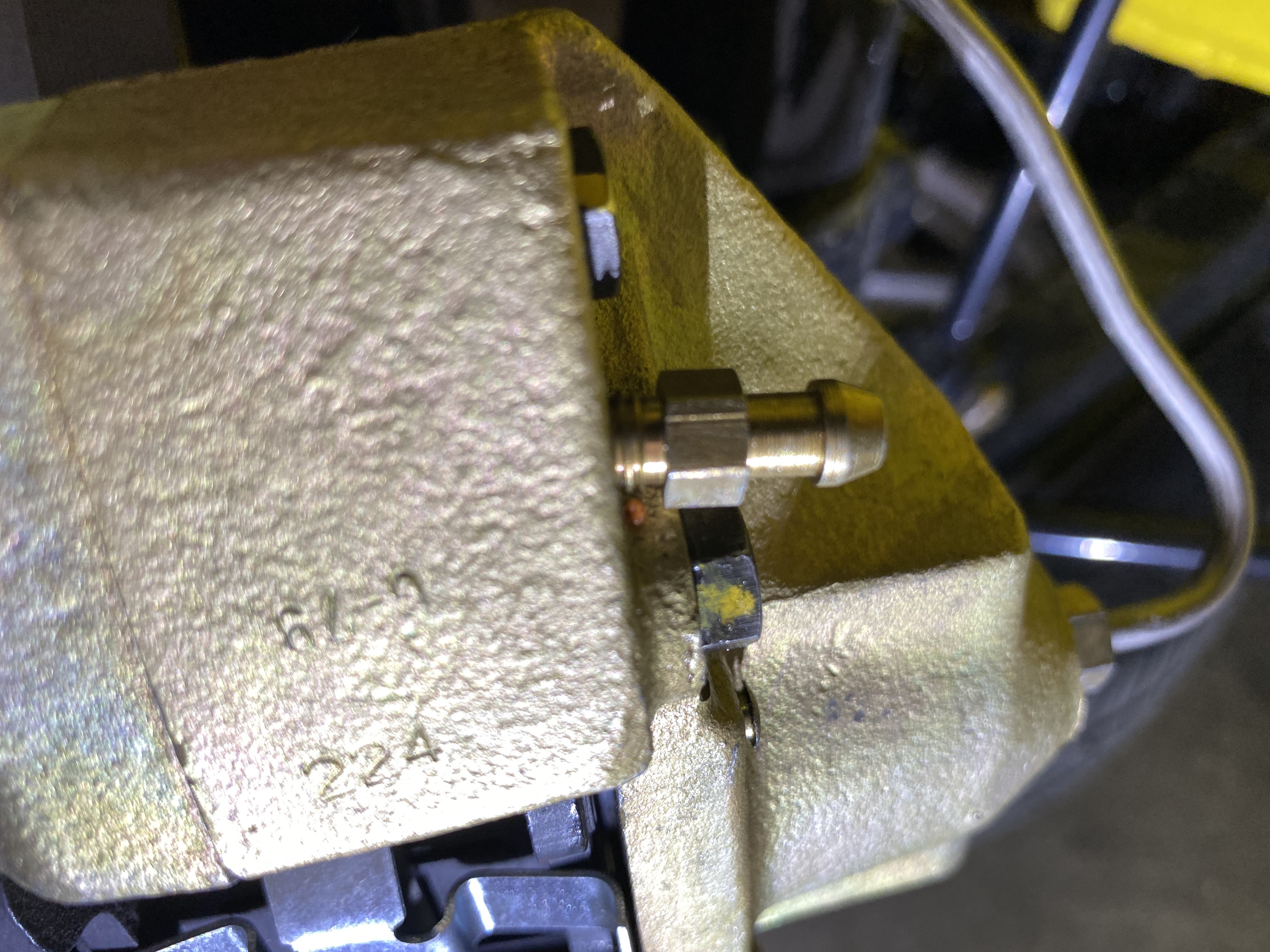

I installed the Speed Bleeders. I have heard a couple of people swear that these are the secret to getting the ultimate hard pedal. We'll see.
Anyway, here is a front caliper with a Speed Bleeder in the upper port. It almost bottomed out before it met the inner seal.

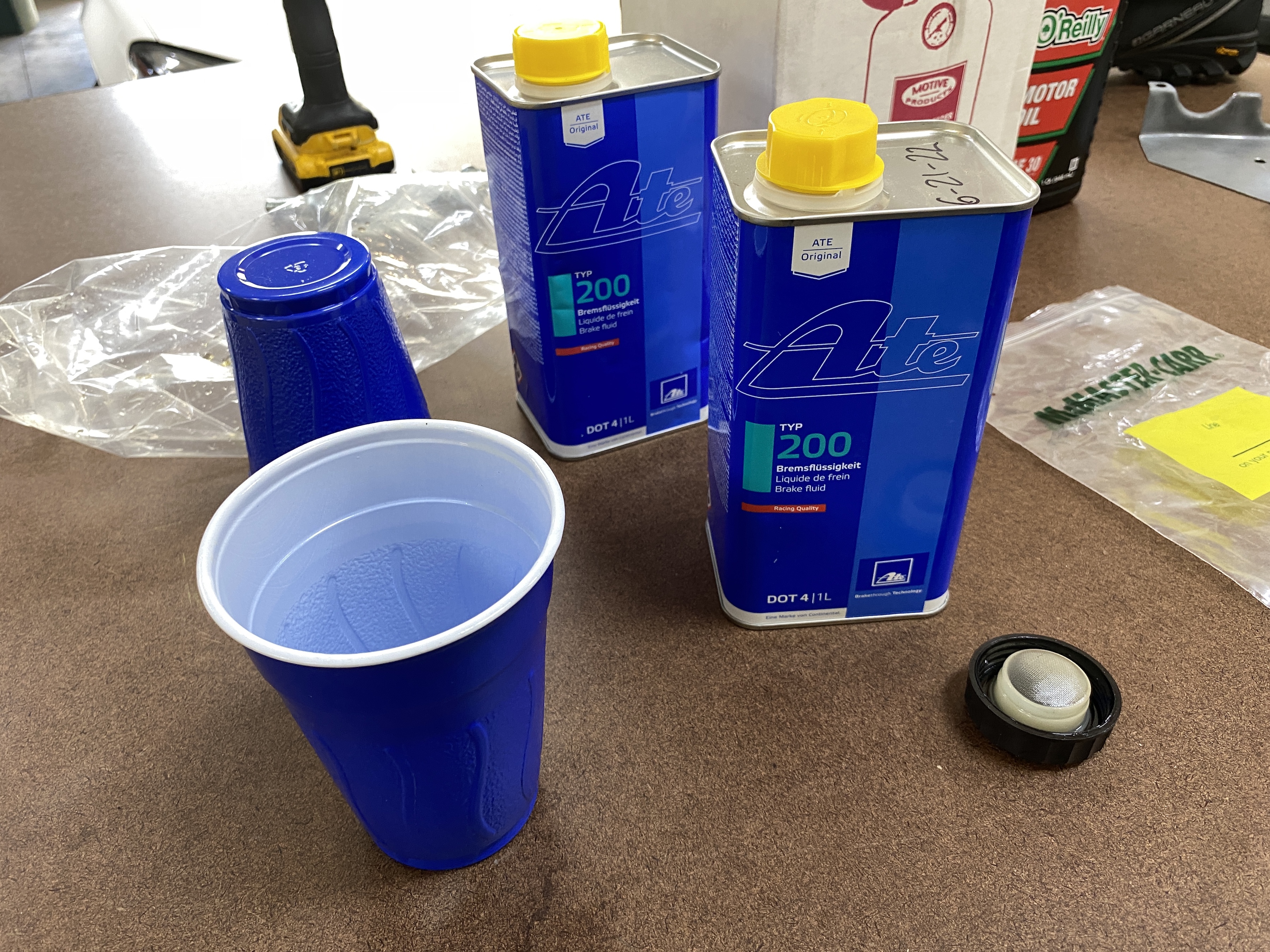

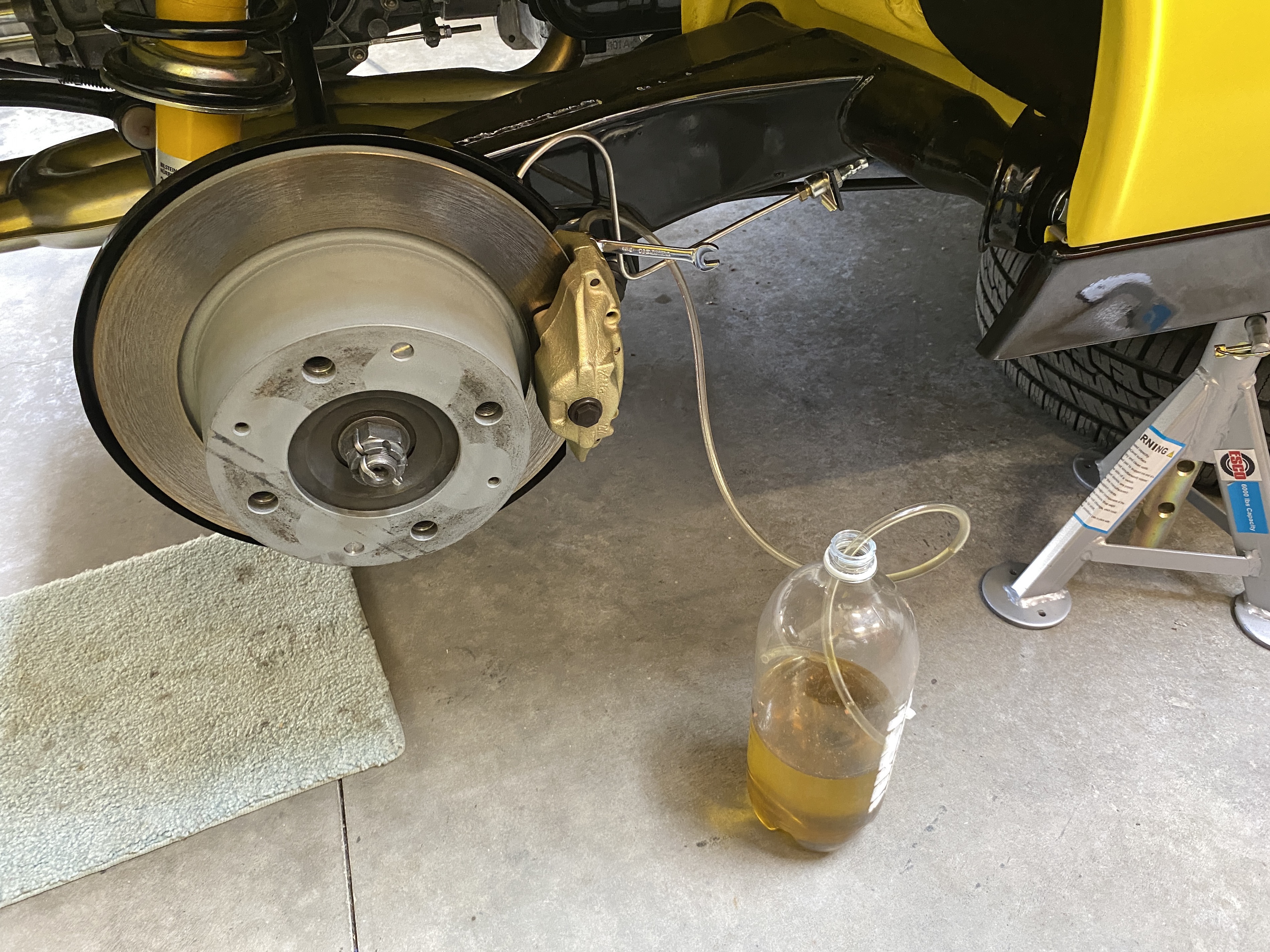

Onto bleeding. Another can of ATE fluid.
bkrantz
post Aug 14 2022, 09:02 PM
Post #5848
Posts: 8,343
Joined: 3-August 19
From: SW Colorado
Member No.: 23,343
Got to work bleeding each corner. With the Speed Bleeders, I just opened each bleeder and then pumped the pedal to expel about 1/3 of the reservoir volume--and (I hope) any remaining air bubbles.
At the end I "think" the pedal felt harder. We'll see next time on the road.

And then time for the new reservoir cap.

Hey Bob, sorry to see the oil leak issue, hope it is an easy fix. In your opinion, are the speed bleeders worth the money? It seems that it makes bleeding the brakes a 1 man job...Just wanting your opinion...Thanks

QUOTE(bkrantz @ Aug 13 2022, 08:06 PM) *
How many of us do not have the drips?
if you are lucky as you drive it more the drips might go away.
recommissioned mine after 16 years standing and initially back on the road i had a leak from the front of the engine. i thought oh no - front seal.
after about 1-2 months of good driving getting it nice and hot for extended periods it stopped.
fingers crossed. (IMG:style_emoticons/default/beerchug.gif)

Thanks for the leak optimism, guys. Like I said, I have a plan to drop the engine over the long winter here. I think I can ignore it until then.

QUOTE(Puebloswatcop @ Aug 15 2022, 08:11 AM) *
Yes, it turns the usual pedal-pumping method into a one man job (I think). In the past I have tried both gravity bleeding and pressure bleeding, both of which can also be done solo. Once on the road again, I will see how much difference it made.

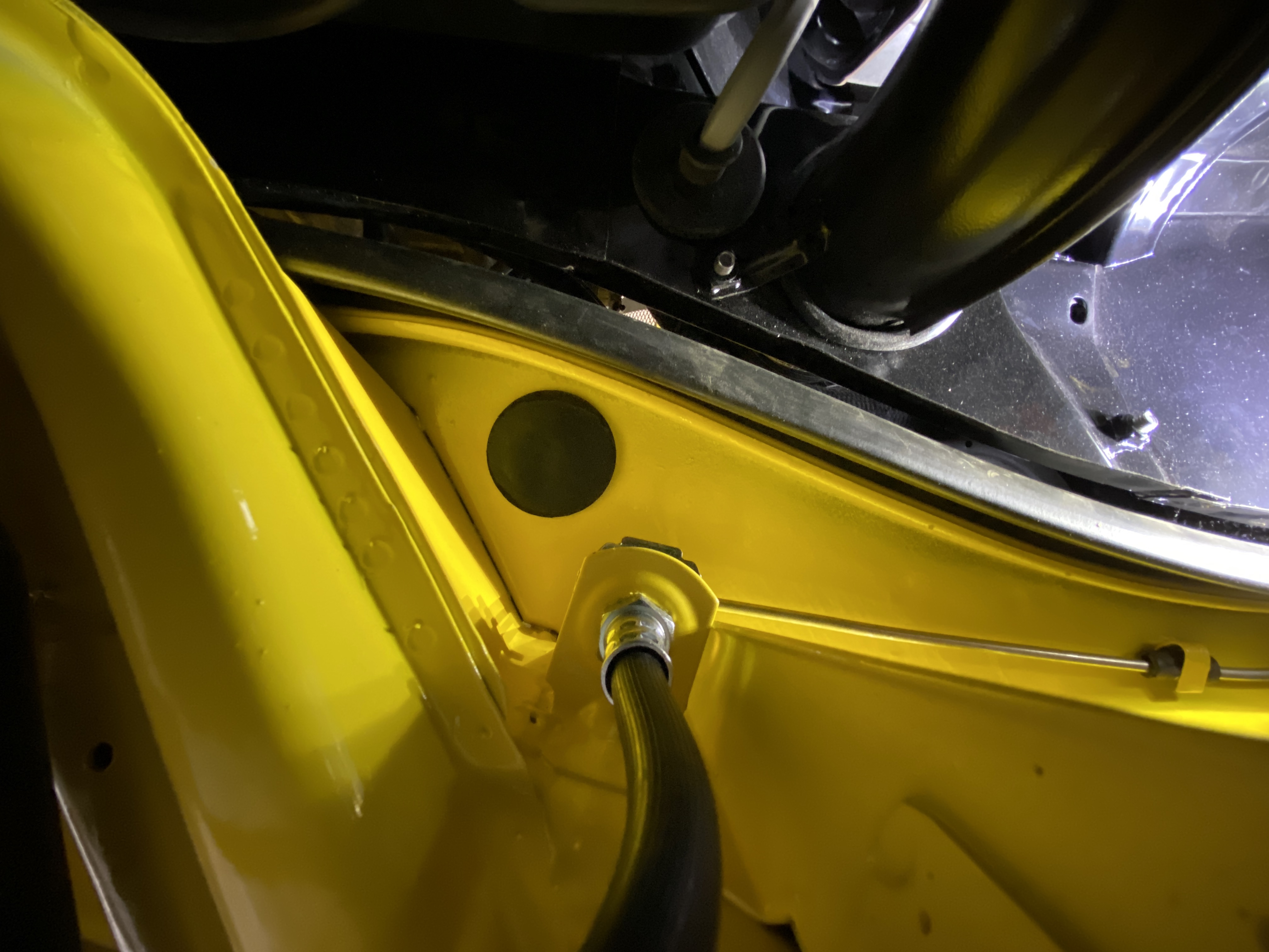

I was poking around underneath my car again, and I noticed the side seals had pulled away from the sheet metal.
bkrantz

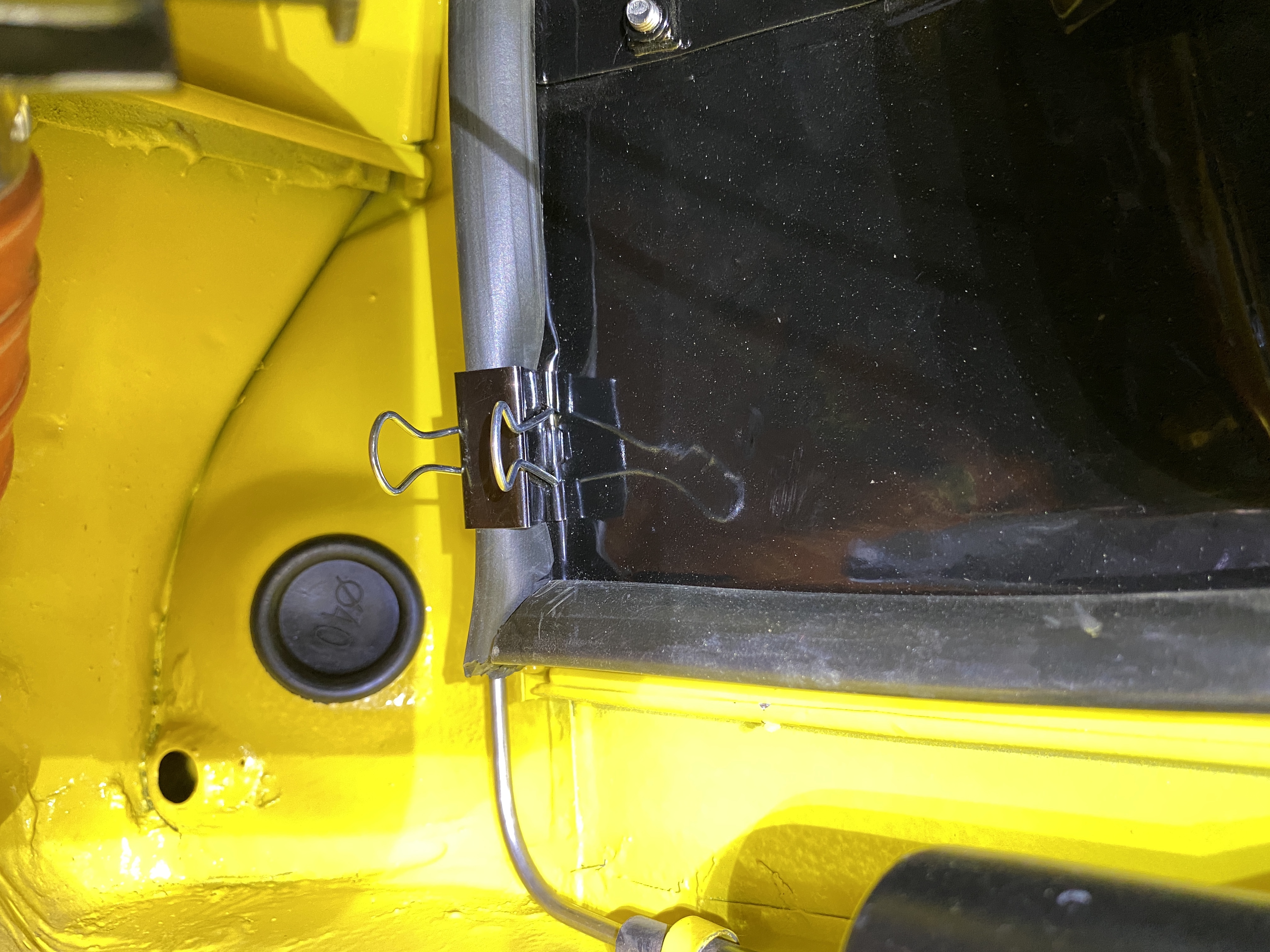

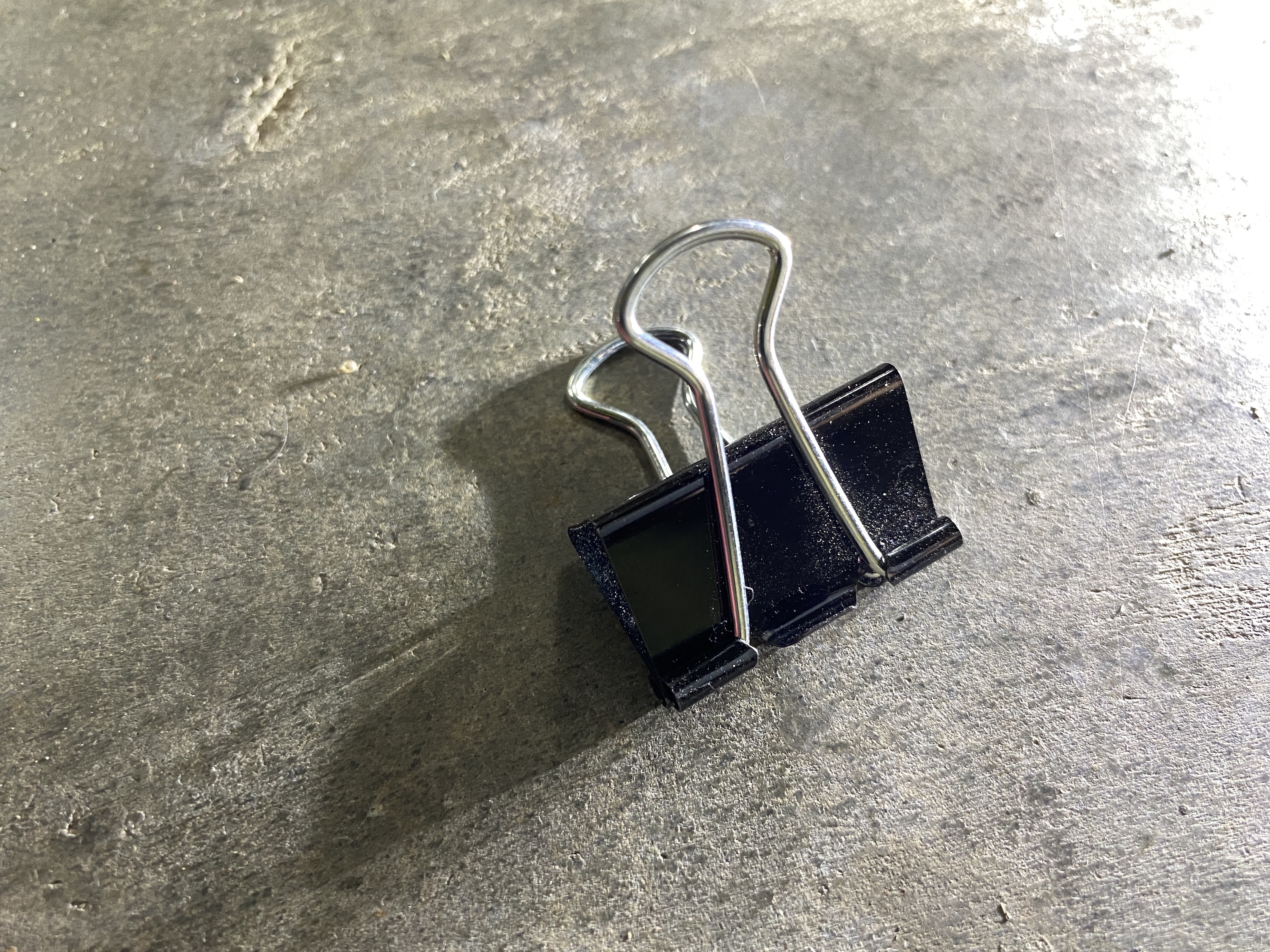

I know people have done different things to keep the rubber in place. I happened to have this clip on my bench.
bkrantz
post Aug 16 2022, 07:54 PM
Post #5857
Posts: 8,343
Joined: 3-August 19
From: SW Colorado
Member No.: 23,343
This might work. And could look neater if I removed the levers.

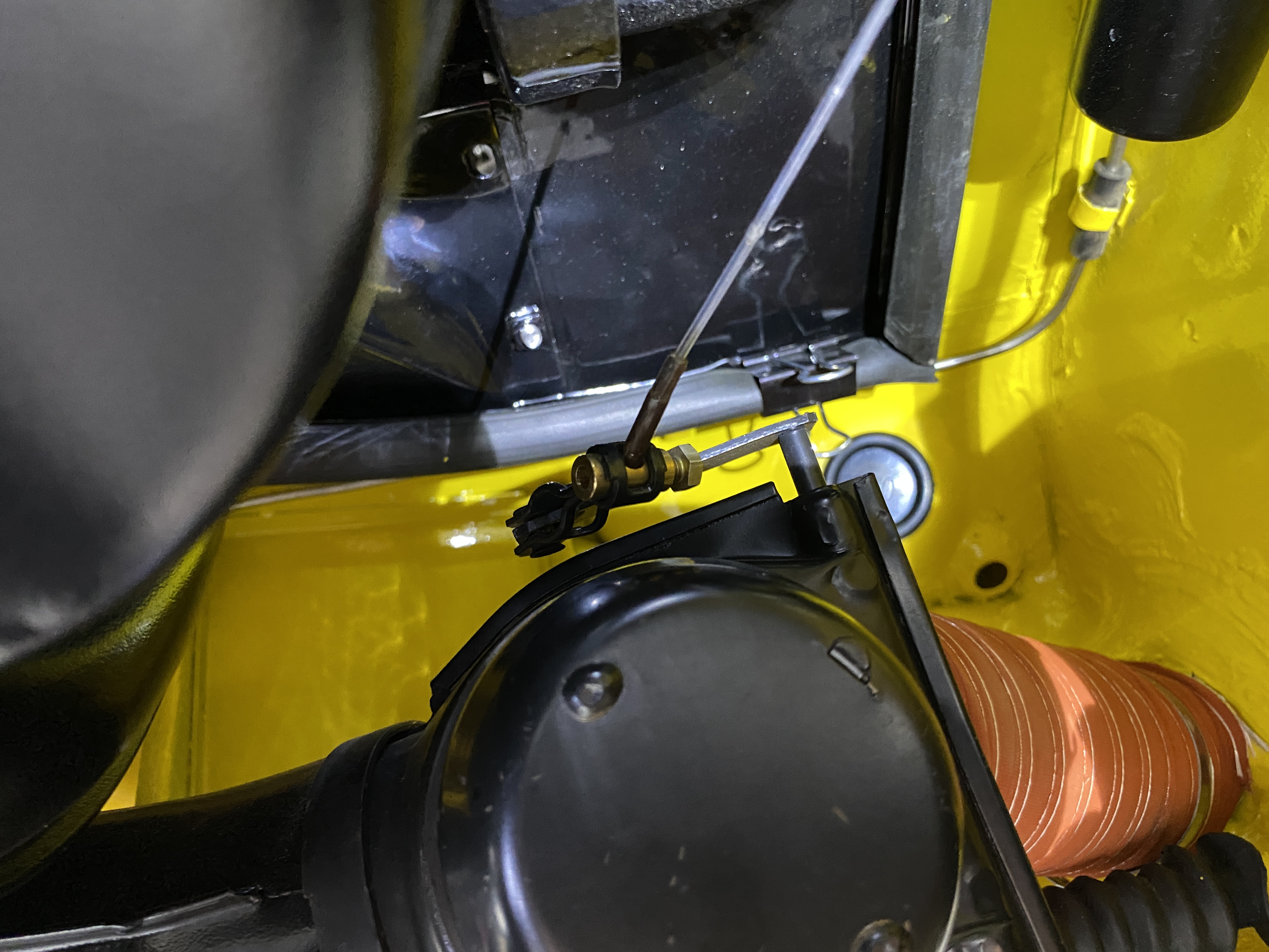

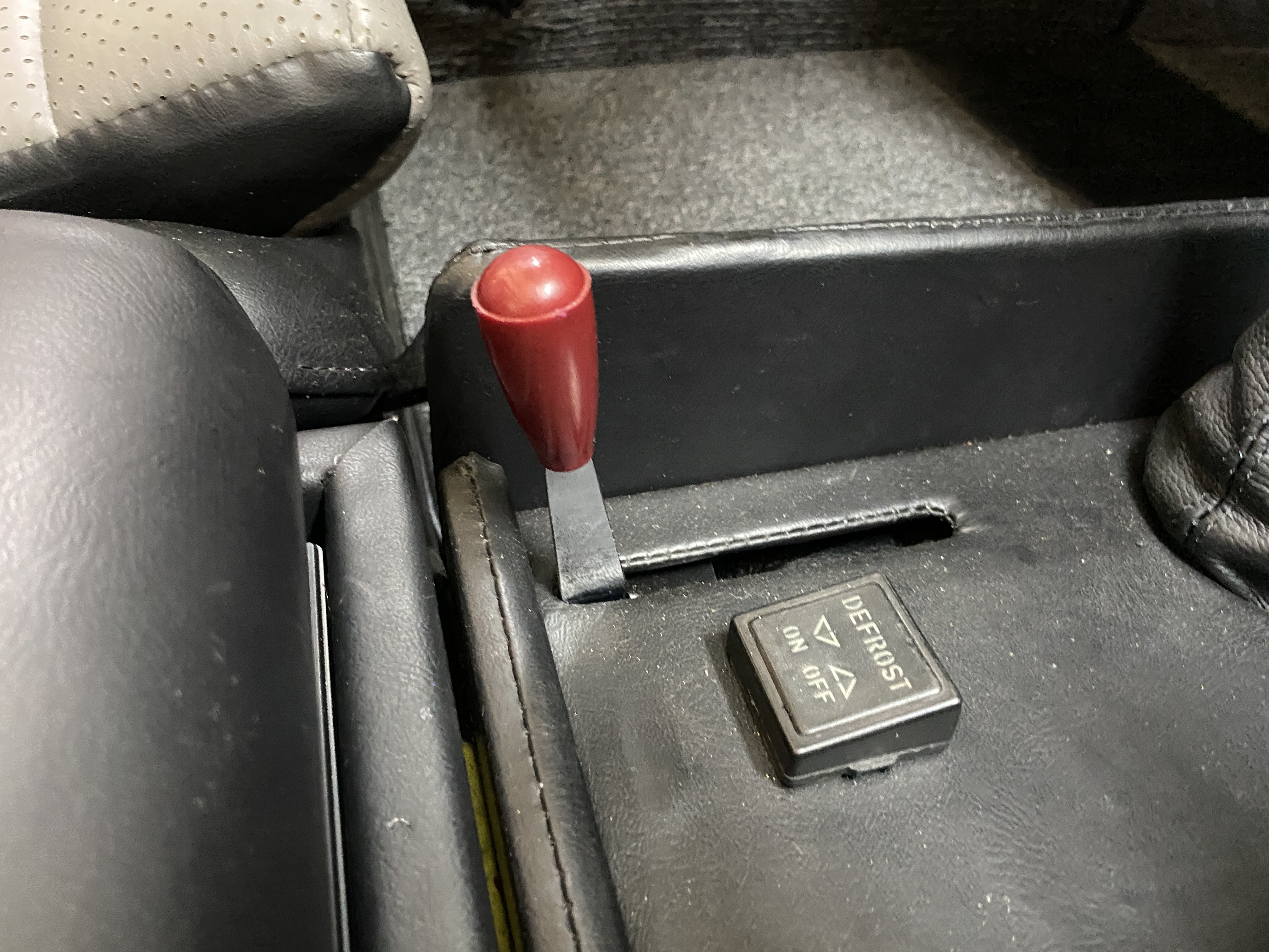

Another minor problem: the heater lever will not stay open (to the rear). When driving, it keeps flipping forward.
bkrantz
post Aug 20 2022, 07:50 PM
Post #5859
Posts: 8,343
Joined: 3-August 19
From: SW Colorado
Member No.: 23,343
So I increased the "slack" in the control cables for the heater valves.

QUOTE(bkrantz @ Aug 16 2022, 08:54 PM) *
I will admit to using a couple of those also... works well. (IMG:style_emoticons/default/smile.gif)
