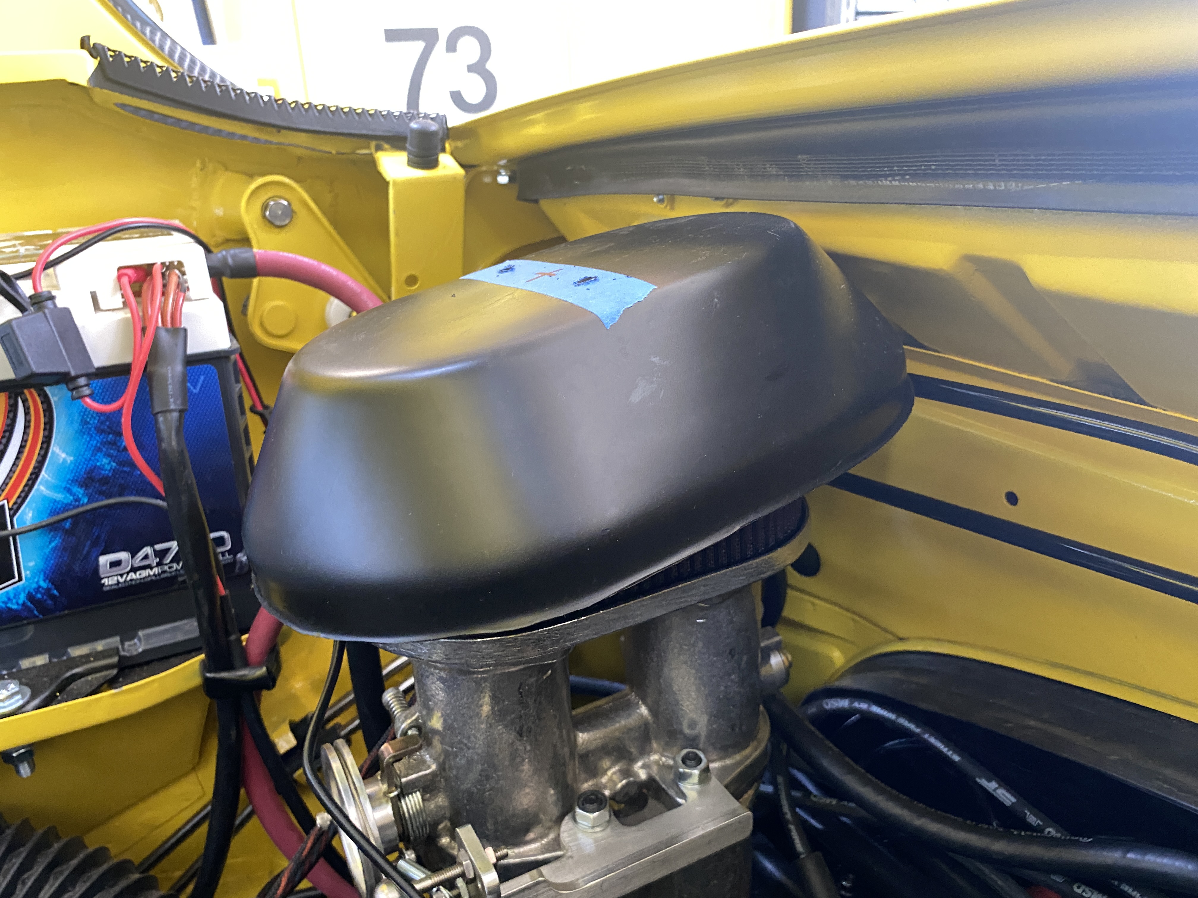

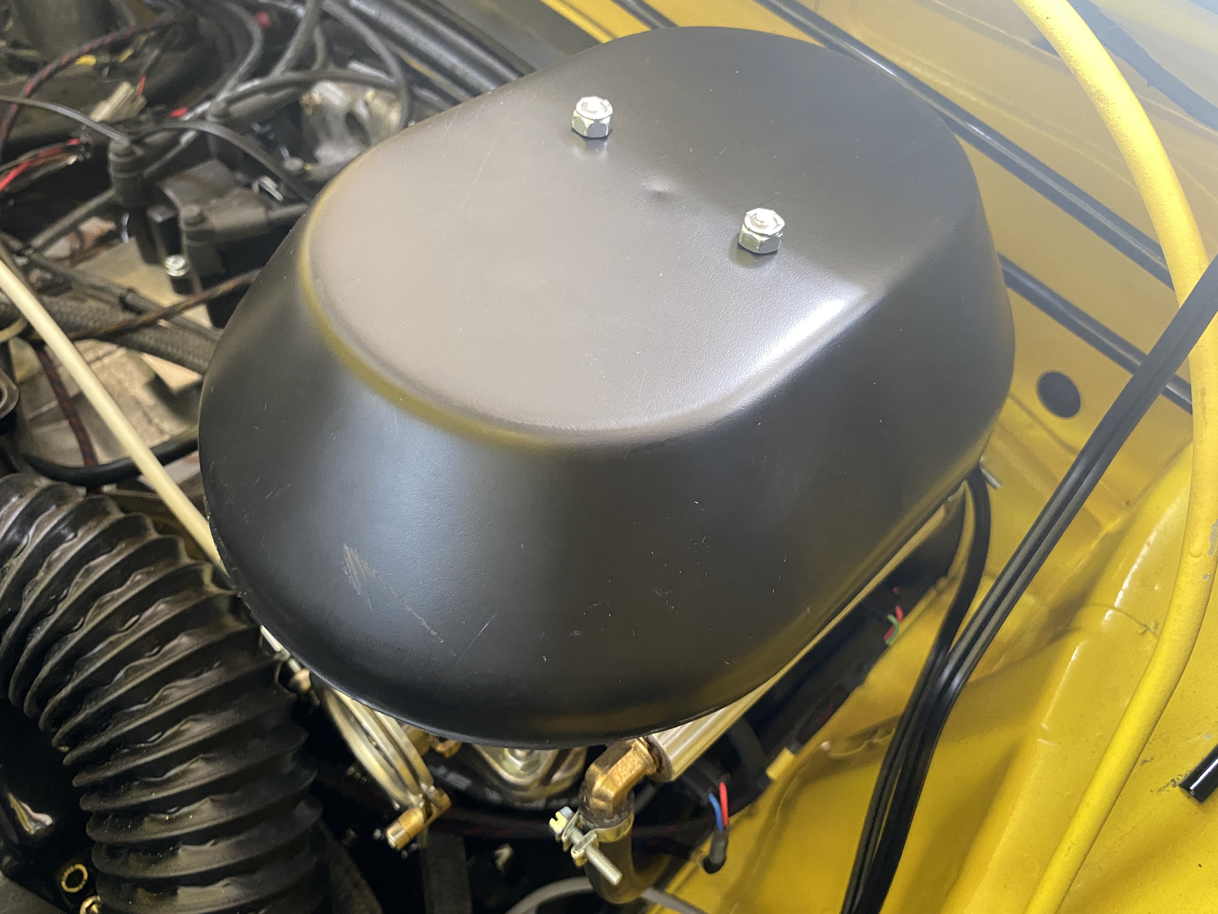

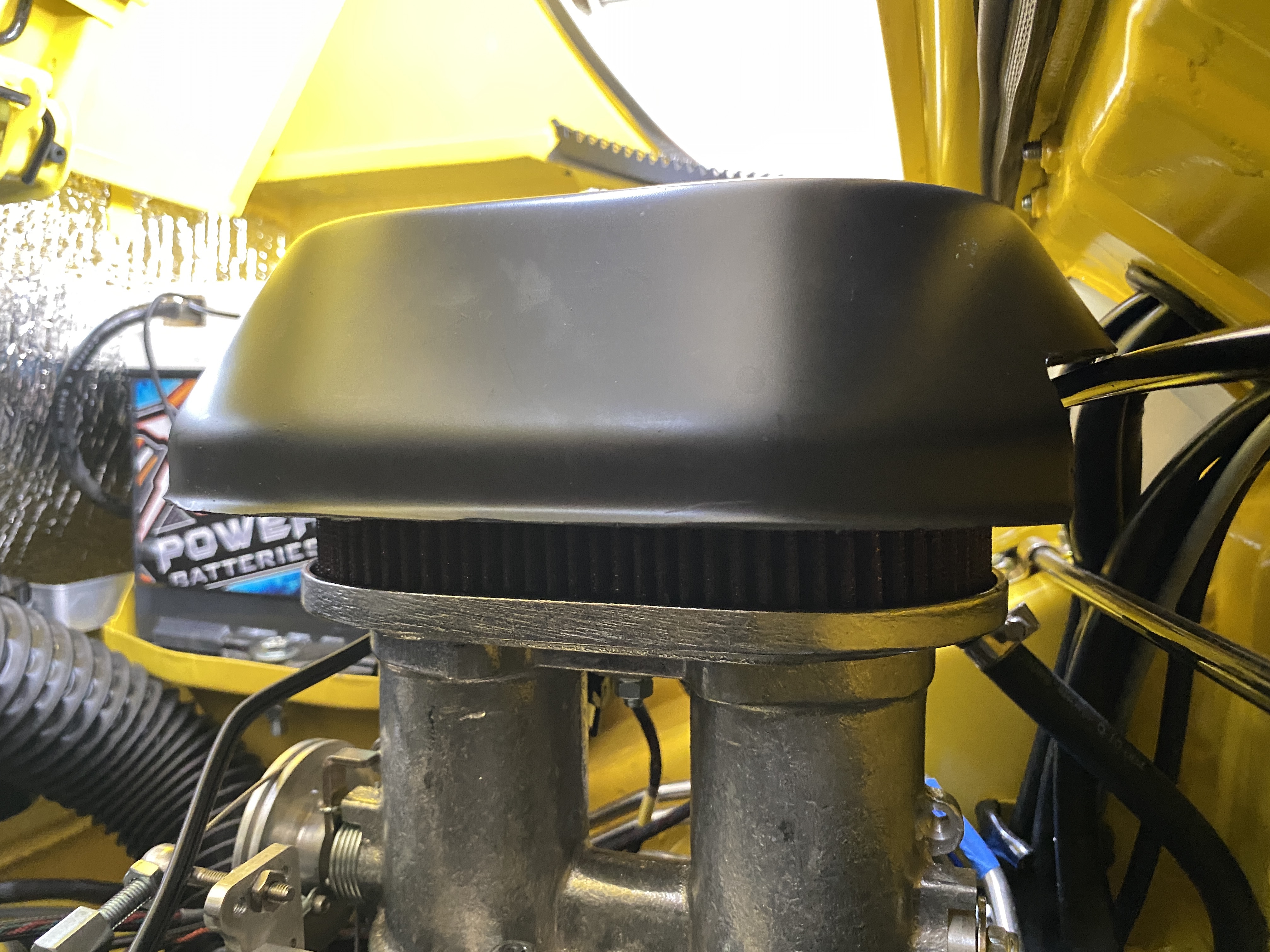

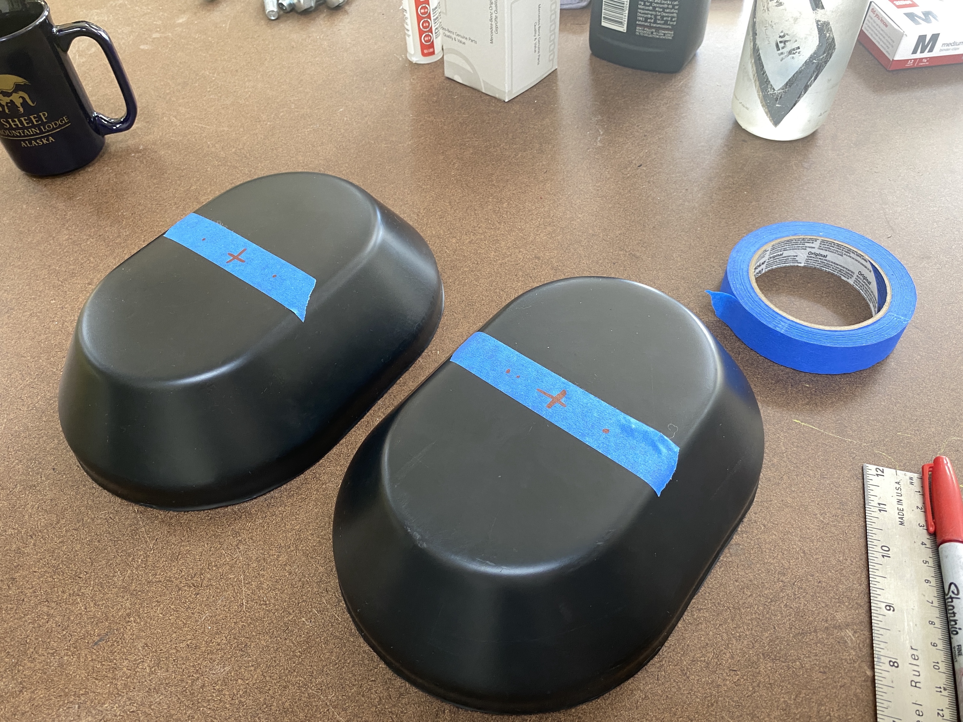

I decided to fit the rain hats, for the ITB air filters. These are from 914 Rubber, and substantial plastic (but no holes).
bkrantz
post Aug 21 2022, 03:30 PM
Post #5862
Posts: 8,343
Joined: 3-August 19
From: SW Colorado
Member No.: 23,343
Left side is easy.
bkrantz
post Aug 21 2022, 03:31 PM
Post #5863
Posts: 8,343
Joined: 3-August 19
From: SW Colorado
Member No.: 23,343

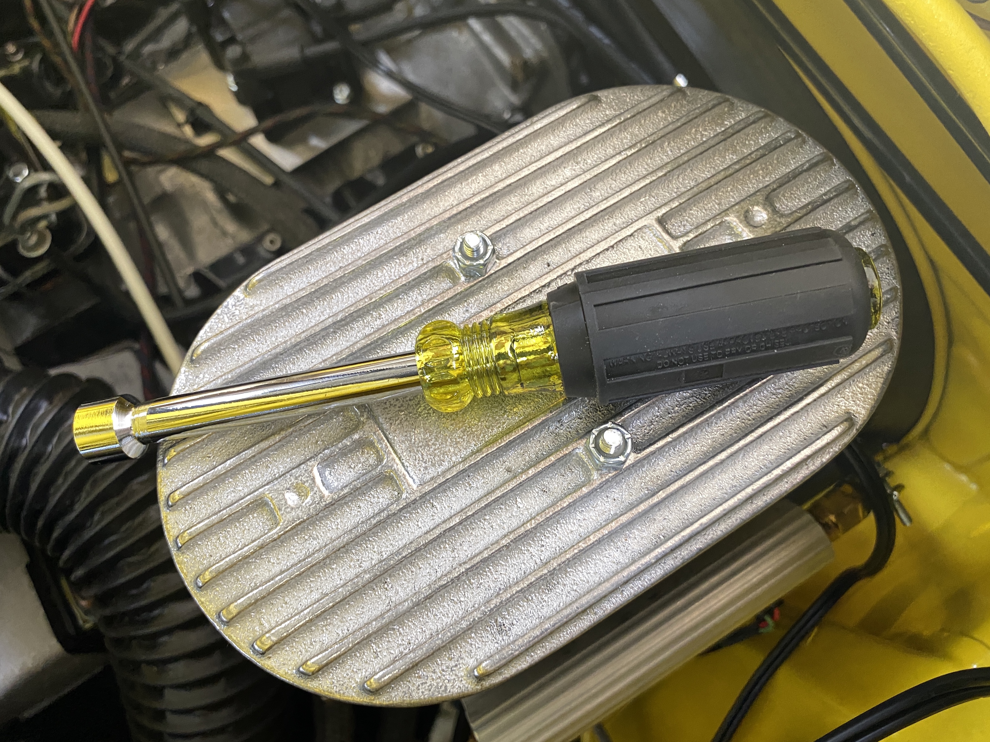

Got to use my new nut driver. This lives in the glove box.

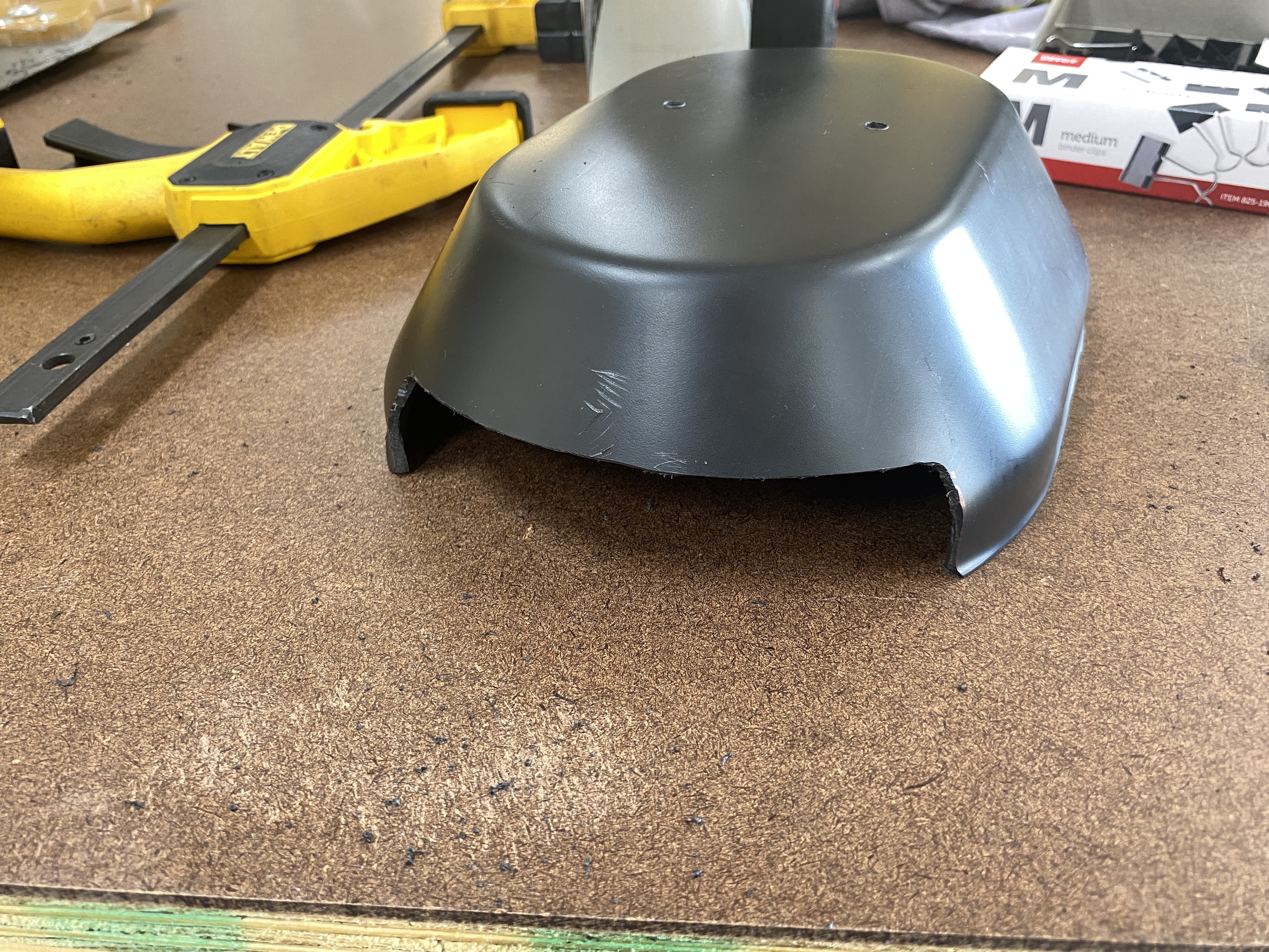

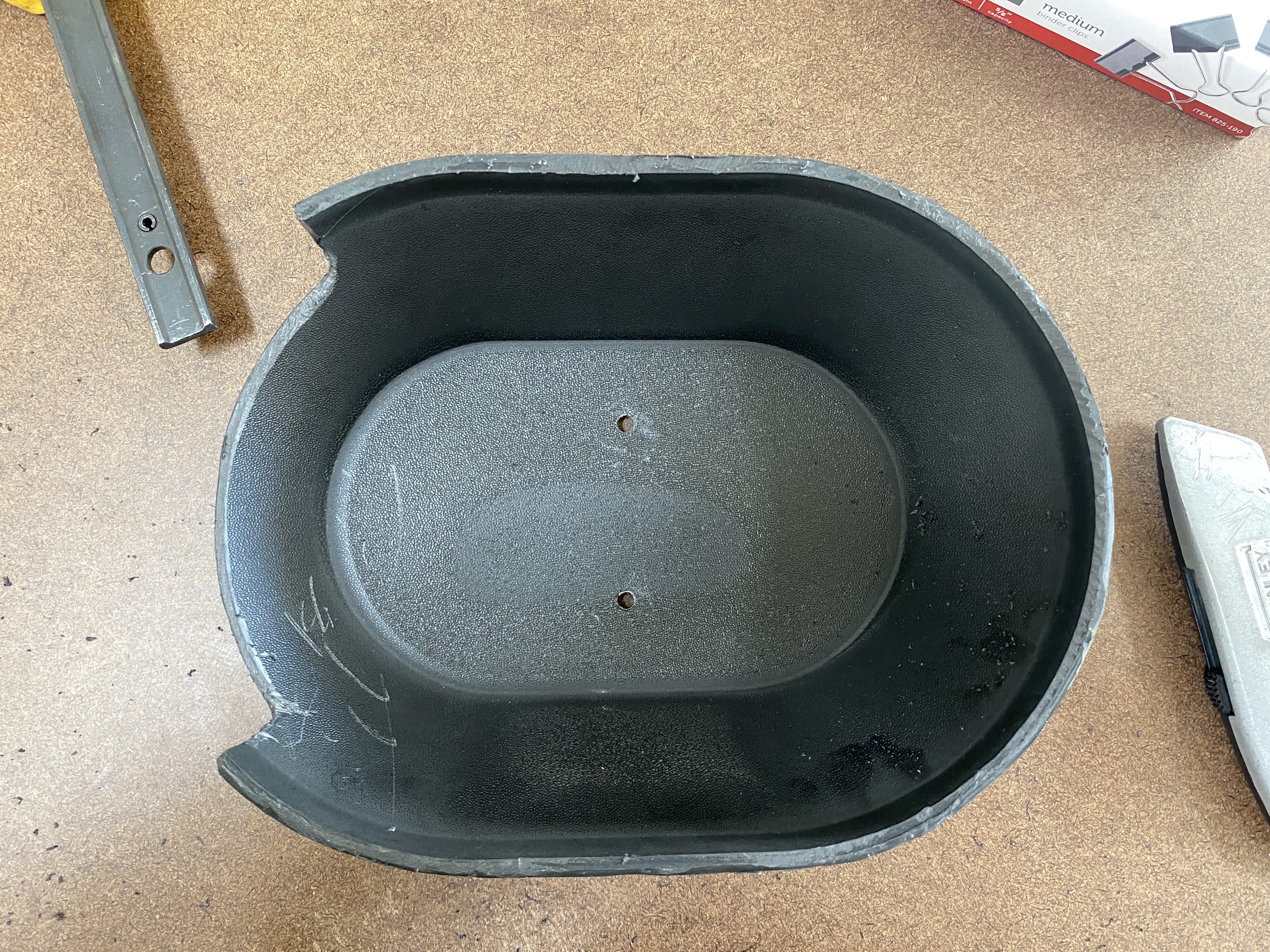

But the right side hat hits the upper trunk torsion bar--by at least about an inch.
bkrantz
post Aug 21 2022, 03:33 PM
Post #5865
Posts: 8,343
Joined: 3-August 19
From: SW Colorado
Member No.: 23,343
I cut out a section for clearance.
bkrantz
post Aug 21 2022, 03:34 PM
Post #5866
Posts: 8,343
Joined: 3-August 19
From: SW Colorado
Member No.: 23,343
Note that the cut is not equal, since the torsion bar does not run "straight across" the car.
bkrantz
post Aug 21 2022, 03:35 PM
Post #5867
Posts: 8,343
Joined: 3-August 19
From: SW Colorado
Member No.: 23,343
Better!

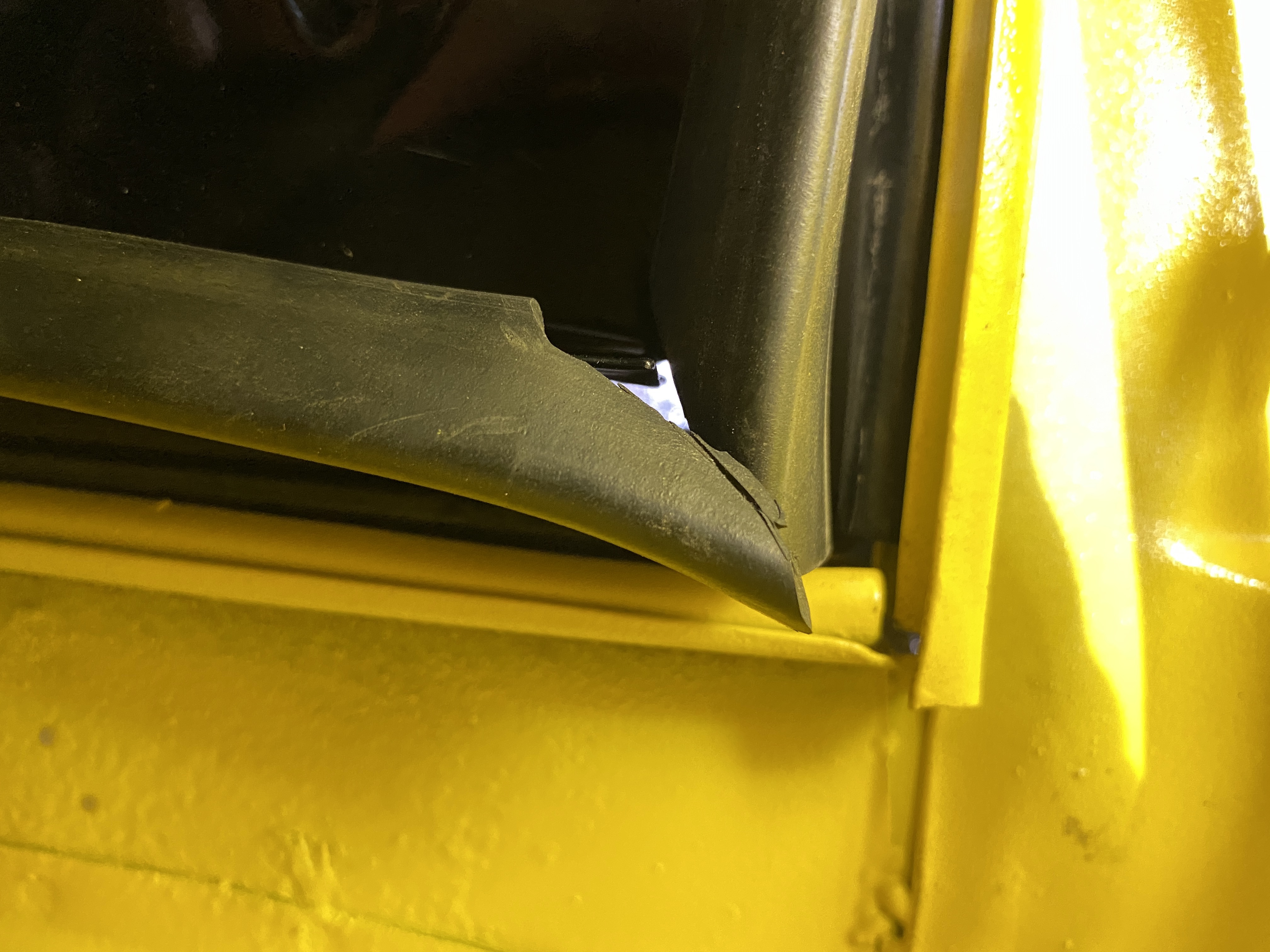

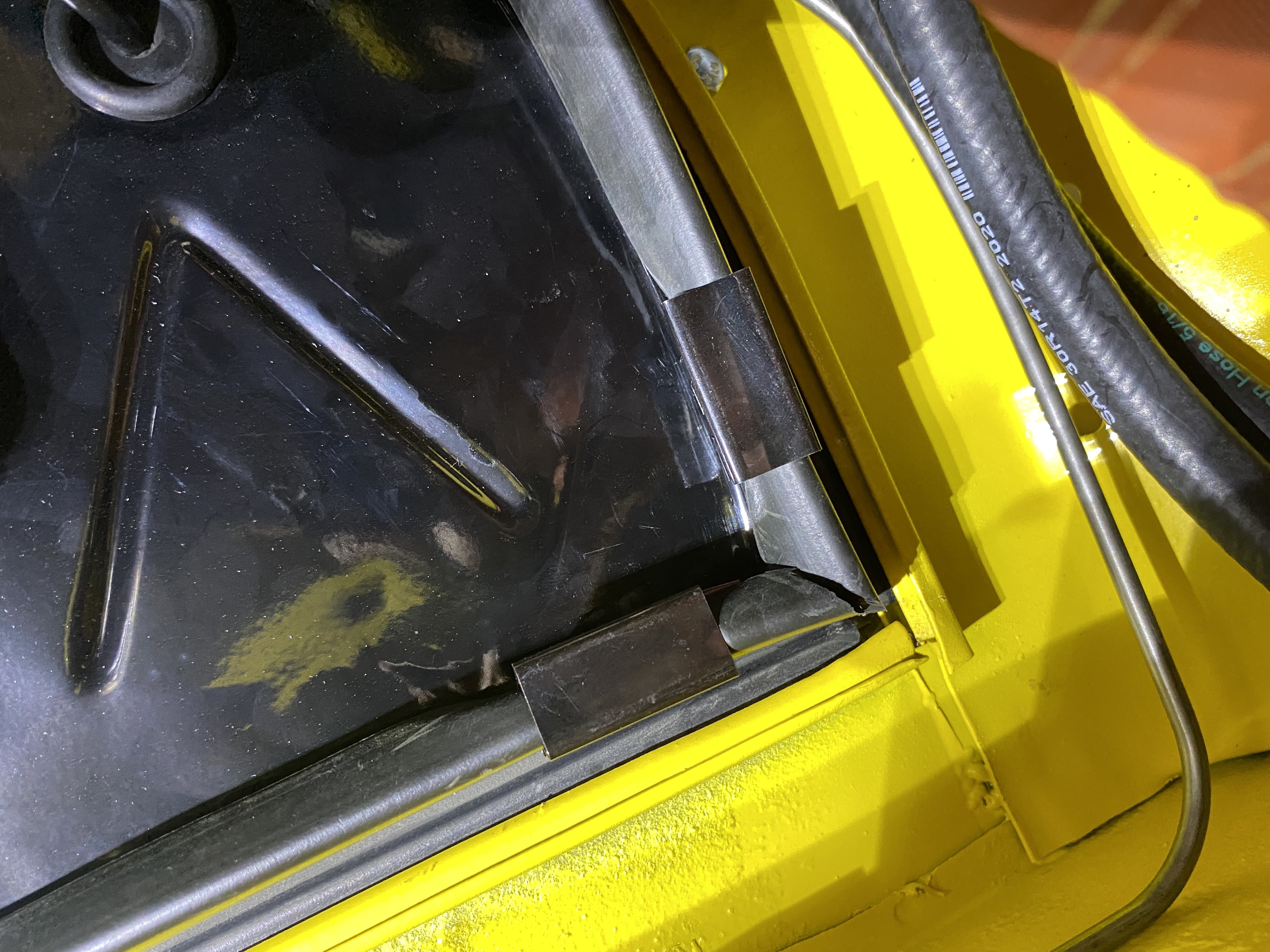

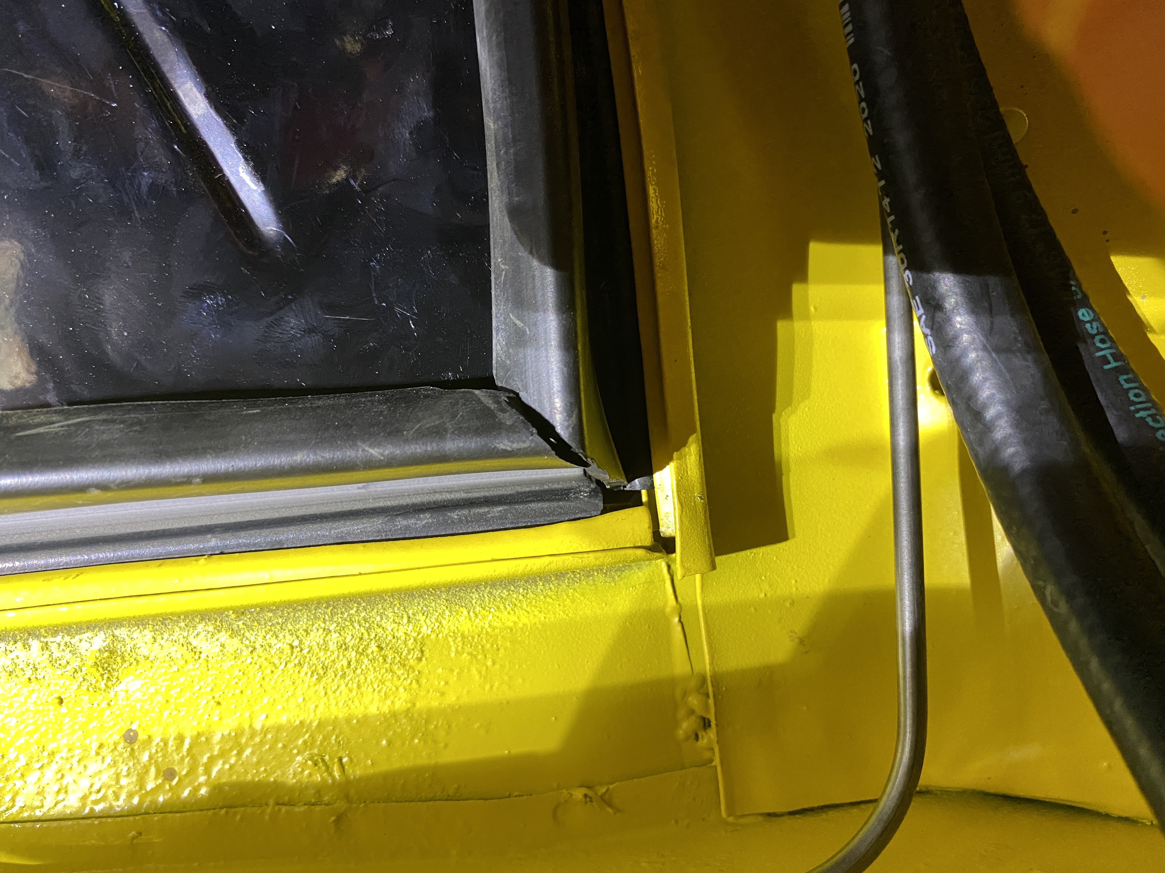

Then I messed with the engine sheet metal rubber surround, that does not like to stay in place. One problem: the corners are not neatly mitered.
bkrantz
post Aug 21 2022, 03:36 PM
Post #5869
Posts: 8,343
Joined: 3-August 19
From: SW Colorado
Member No.: 23,343
Better.

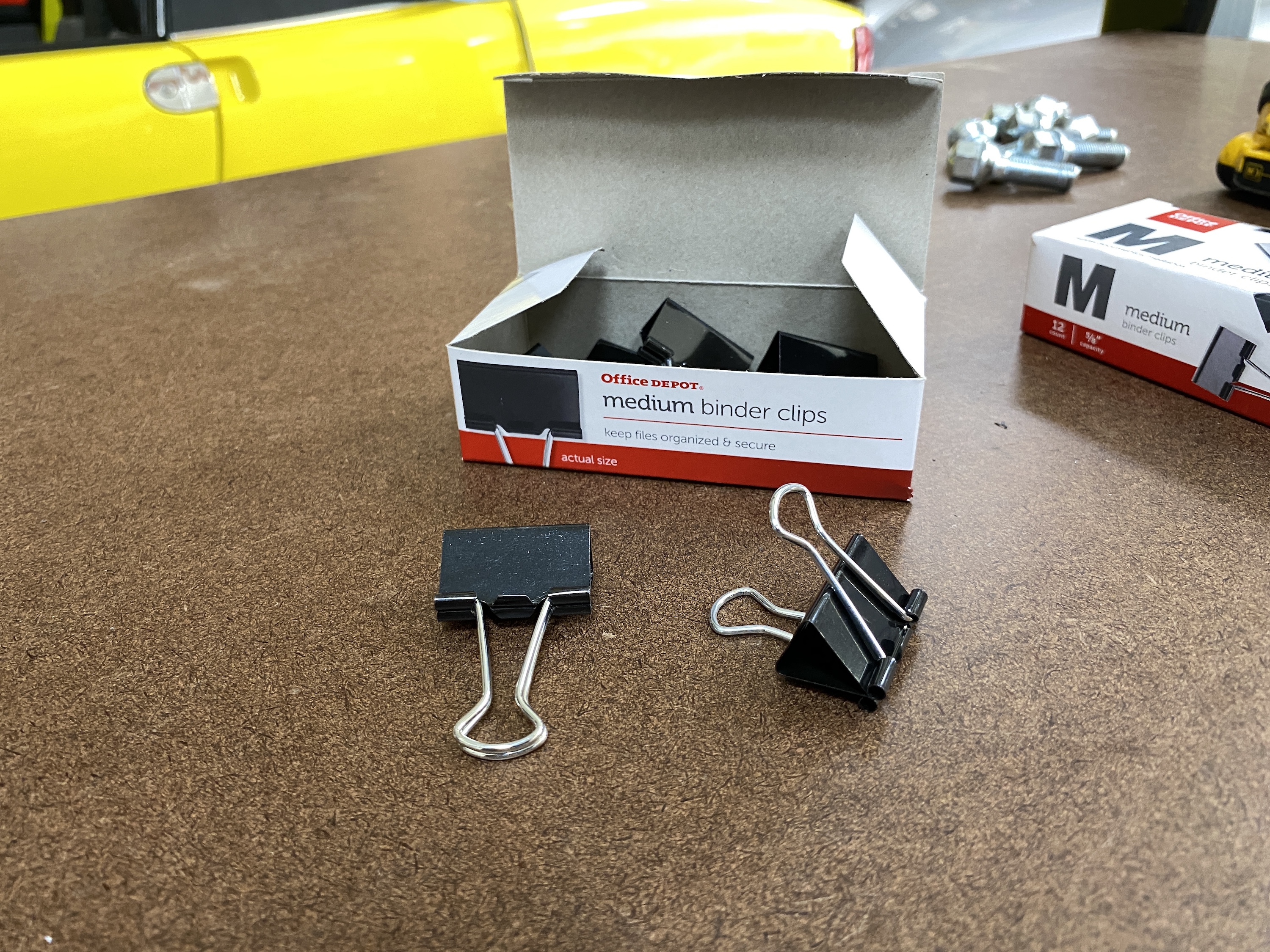

Now for the secret clips.
bkrantz
post Aug 21 2022, 03:38 PM
Post #5871
Posts: 8,343
Joined: 3-August 19
From: SW Colorado
Member No.: 23,343

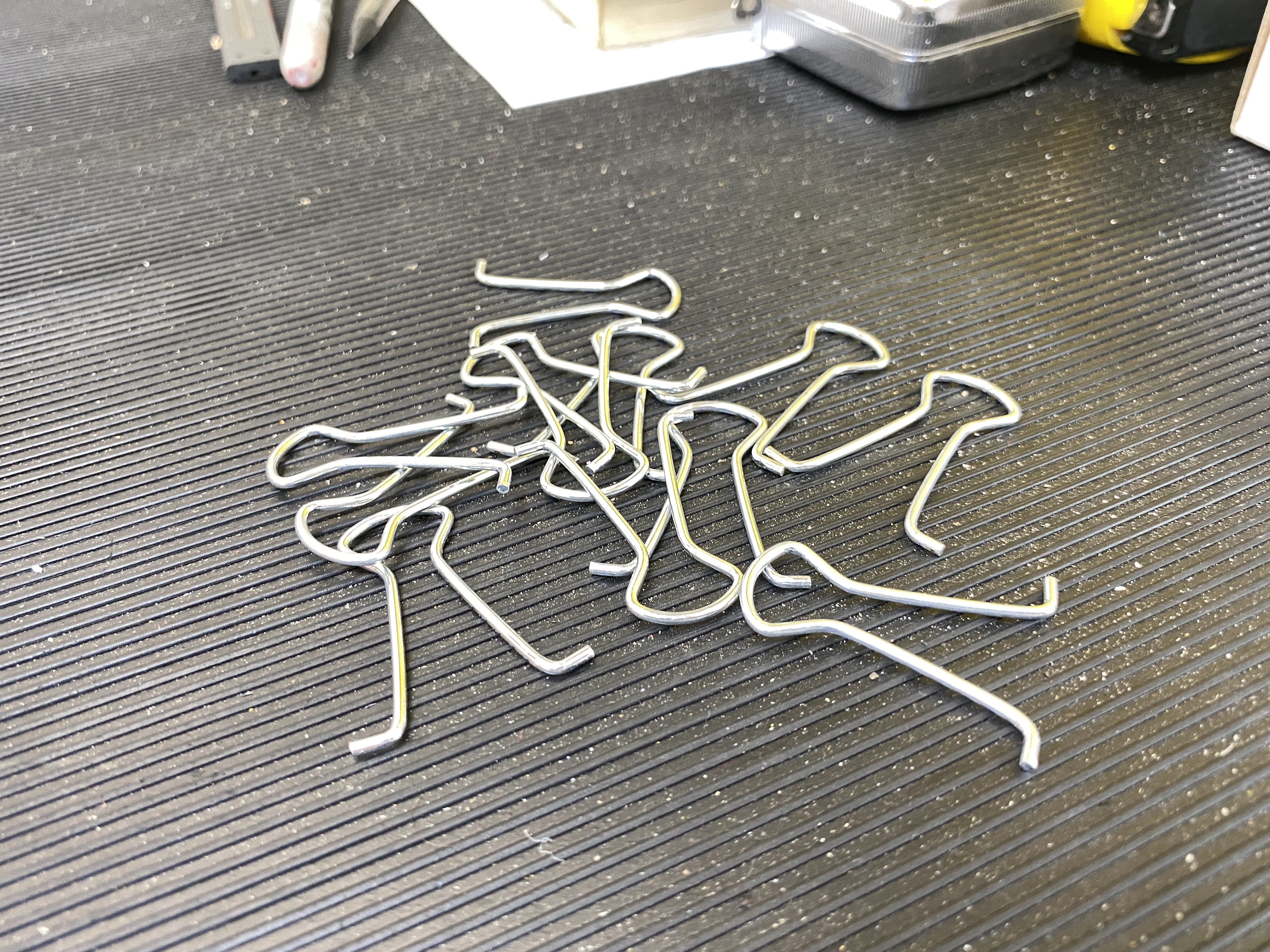

I put one at each end of each rubber section, and removed the wire handles.
bkrantz
Post #5872
Posts: 8,343
Joined: 3-August 19
From: SW Colorado
Member No.: 23,343
I wonder what these might be good for.

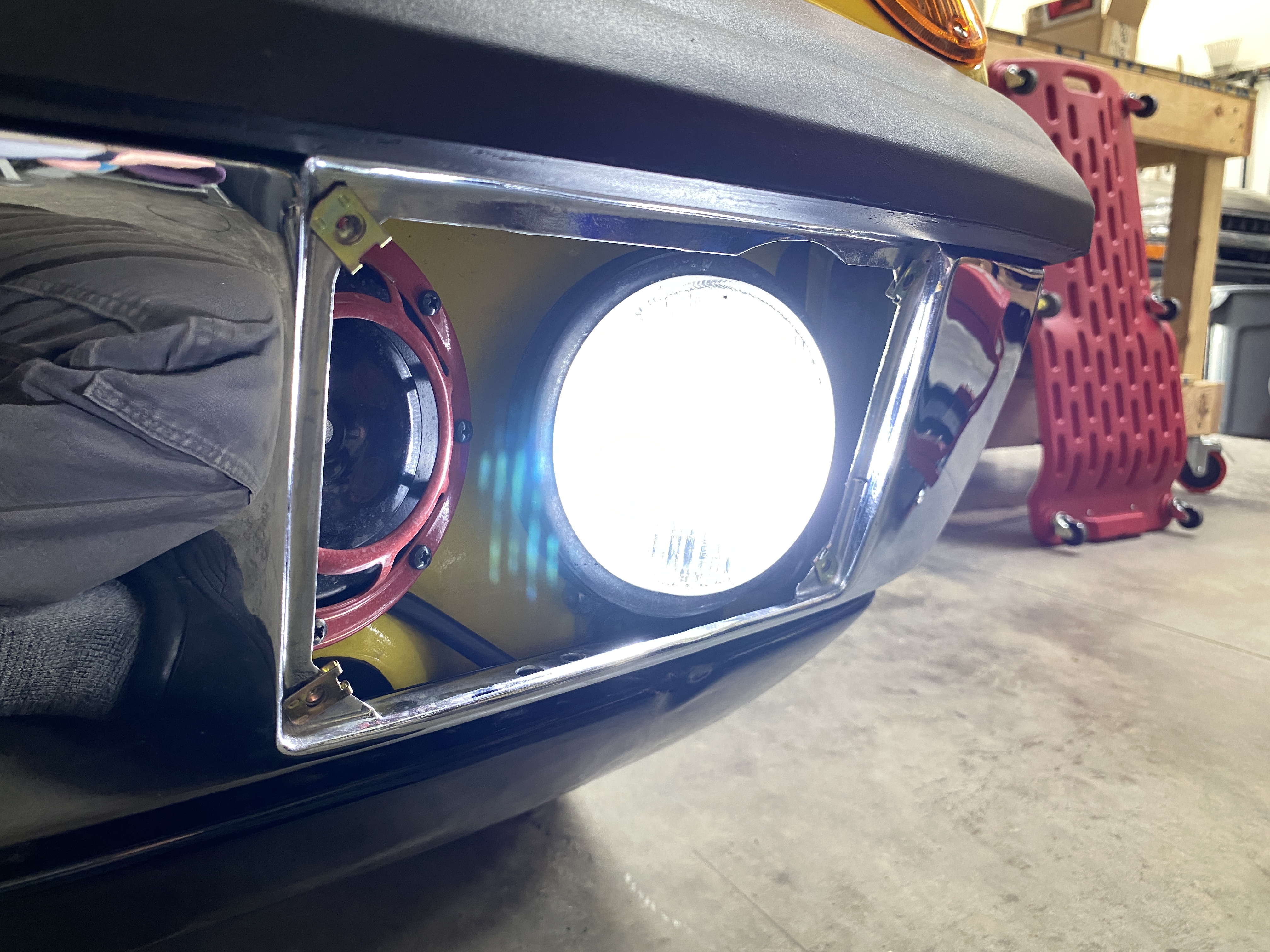

First, I adjusted the fog lights. I intend to use these as DRLs, and so I aimed them a bit higher. Note that these have my replacement LED bulbs installed.

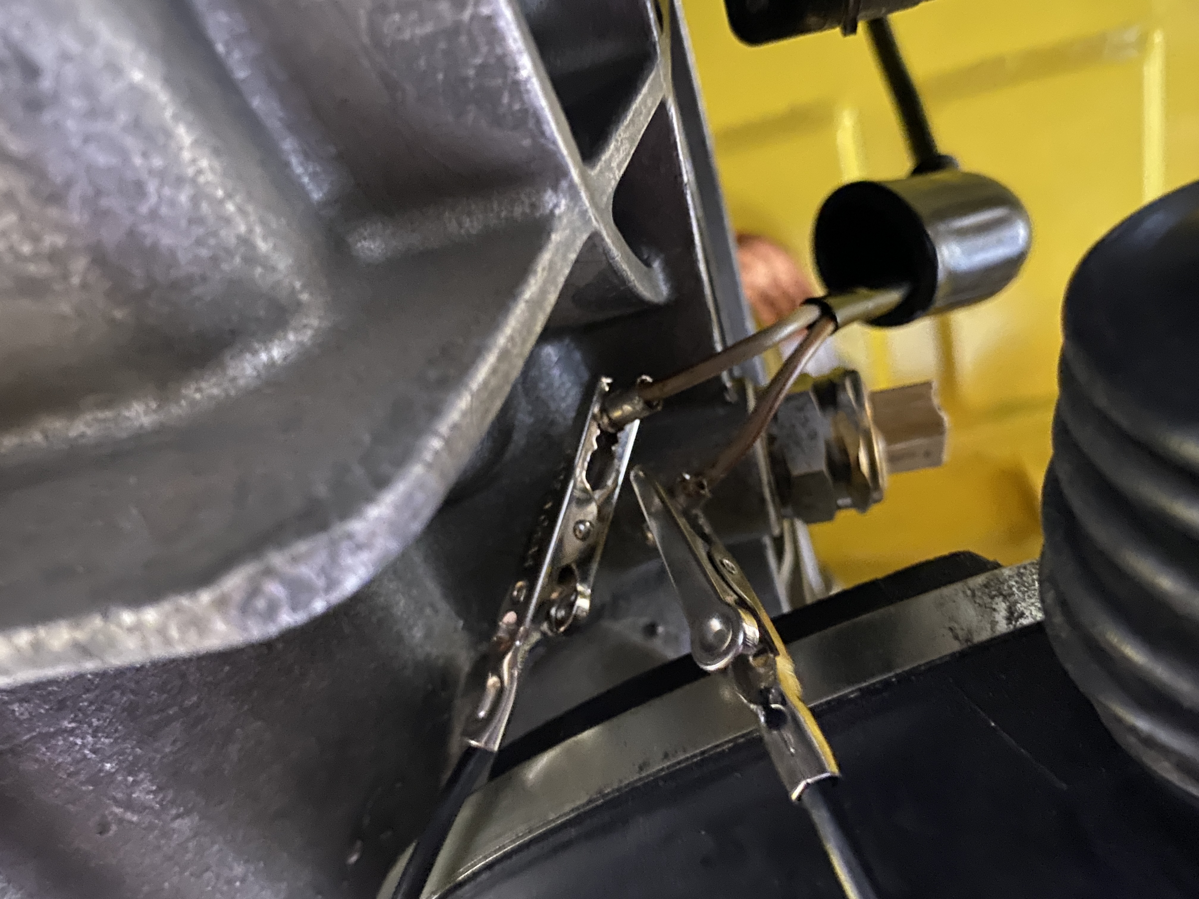

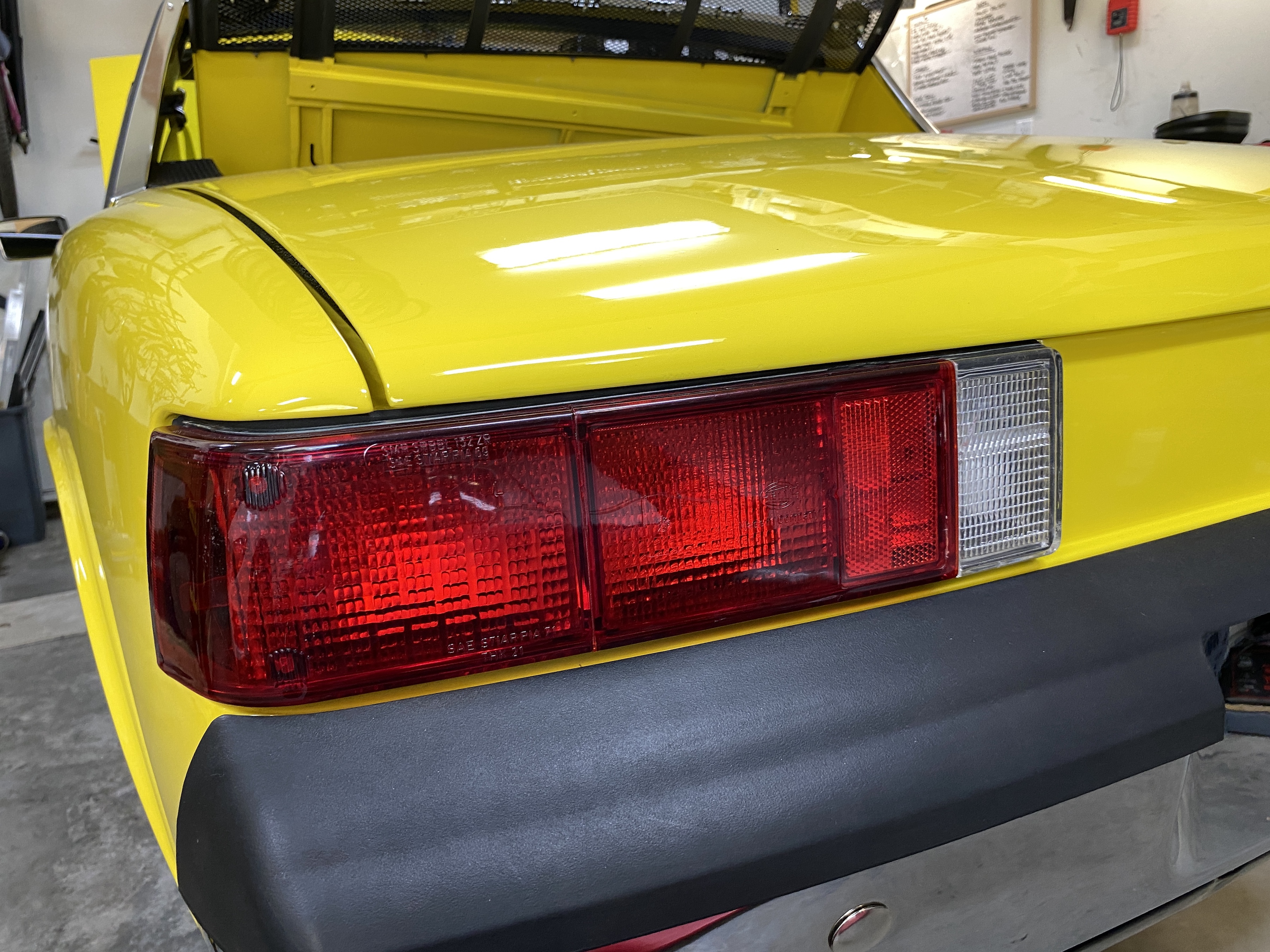

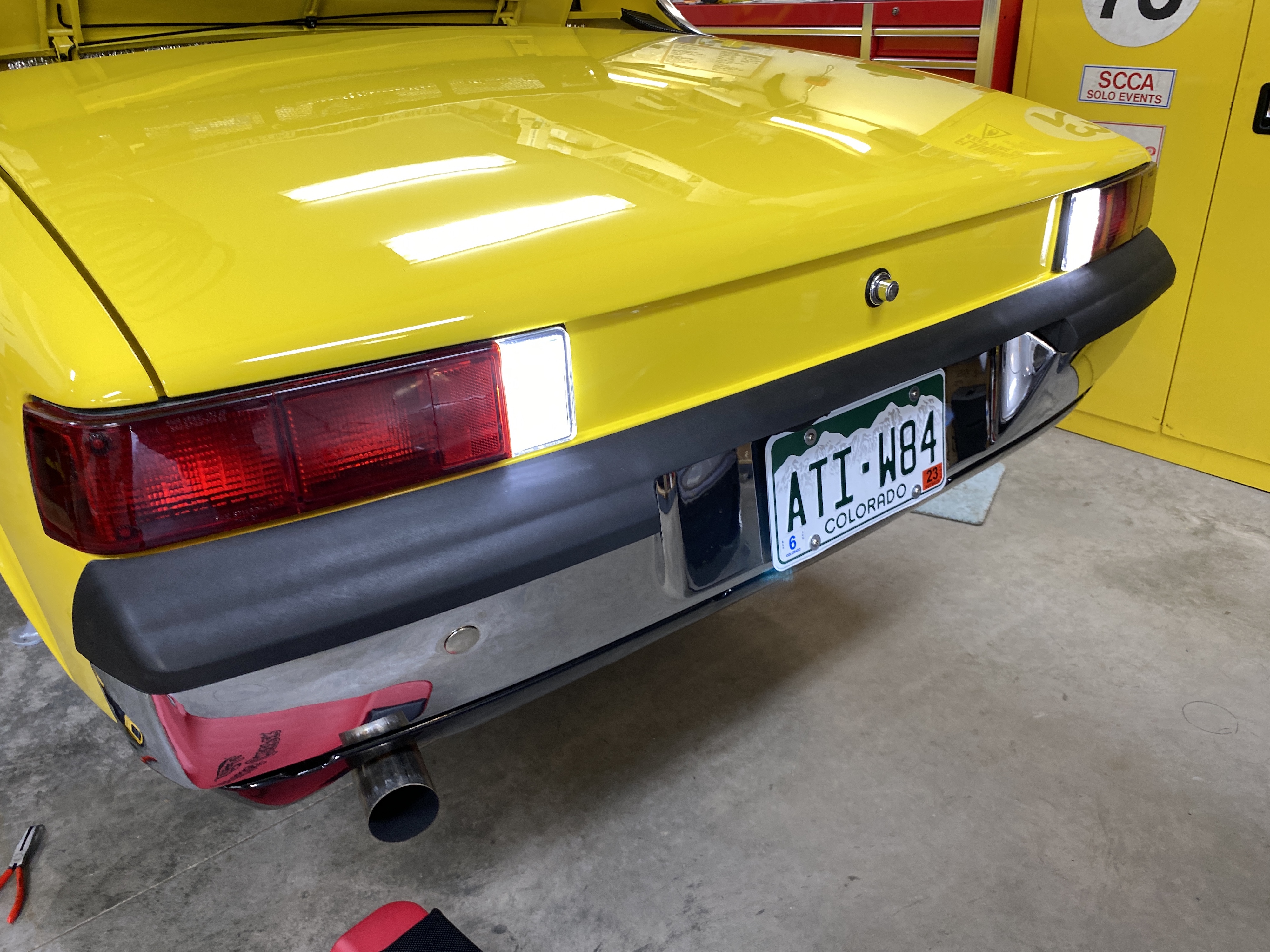

Speaking of lights, a friend pointed out that my reverse lights did not work. Sure enough, with the key and lights on, and the trans in R, no reverse lights in back.
bkrantz
post Sep 11 2022, 07:20 PM
Post #5876
Posts: 8,343
Joined: 3-August 19
From: SW Colorado
Member No.: 23,343
I pulled the connectors from the trans switch and jumped them.
bkrantz
post Sep 11 2022, 07:21 PM
Post #5877
Posts: 8,343
Joined: 3-August 19
From: SW Colorado
Member No.: 23,343
With the key on, the reverse lights work now. Must be a bad switch.

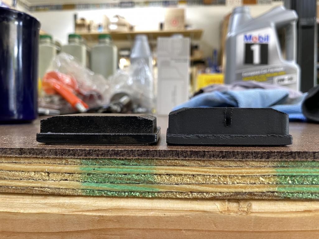

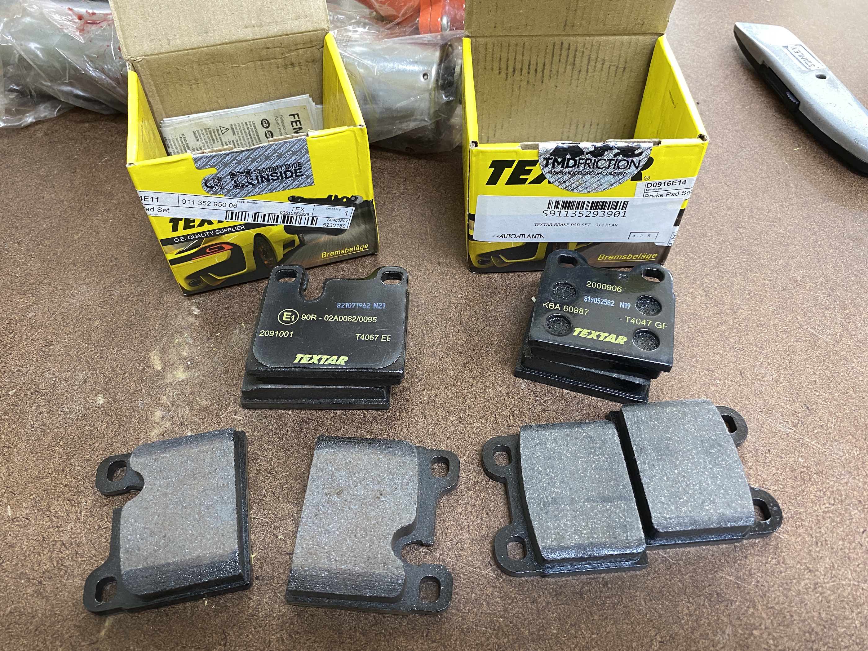

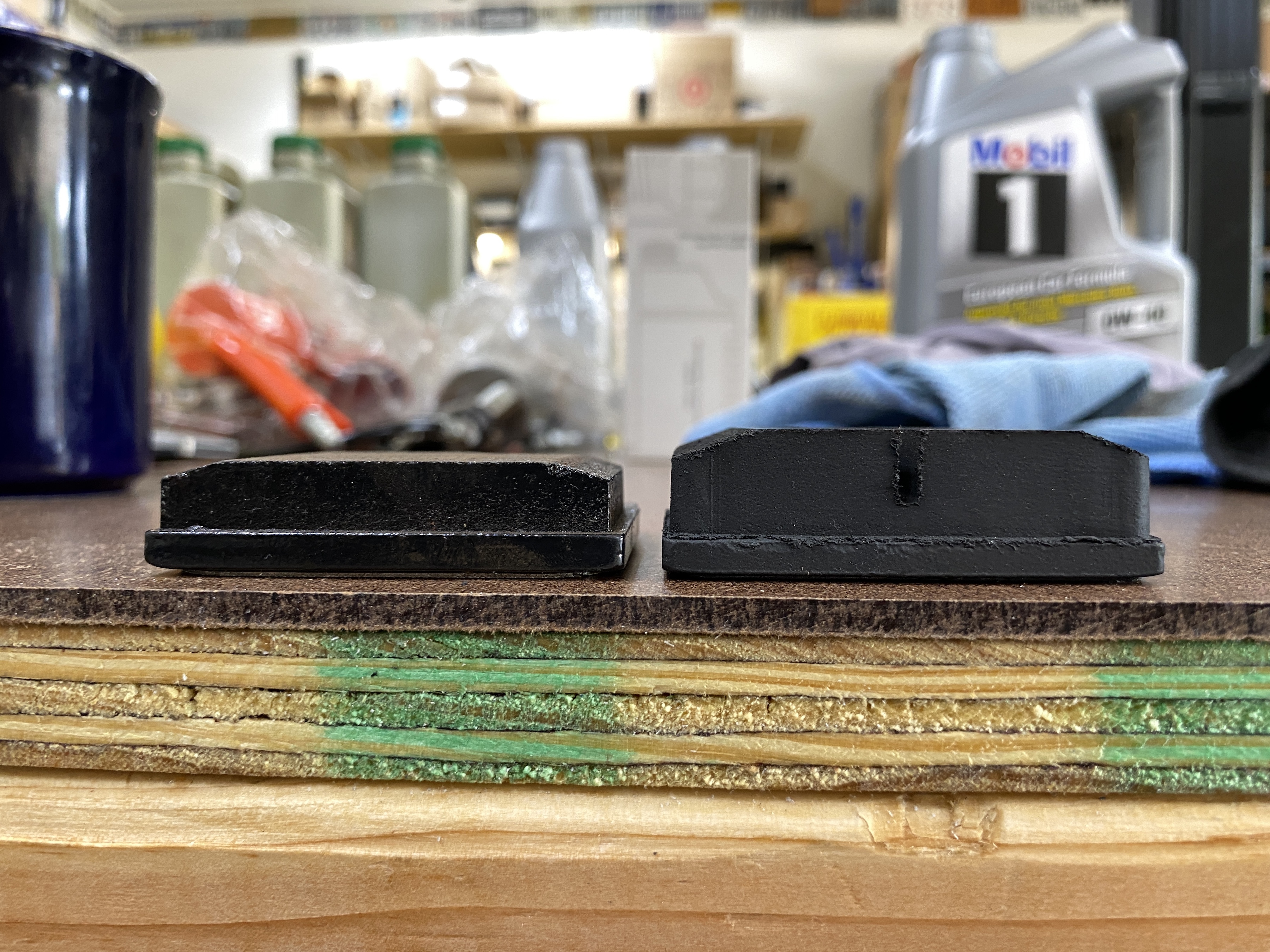

To address my brake issue, I ordered a set of Texture pads, with original style street compound. I initially installed Poterfield R4-S pads, a performance pad that might need more heat to work well.
bkrantz
post Sep 11 2022, 07:27 PM
Post #5879
Posts: 8,343
Joined: 3-August 19
From: SW Colorado
Member No.: 23,343

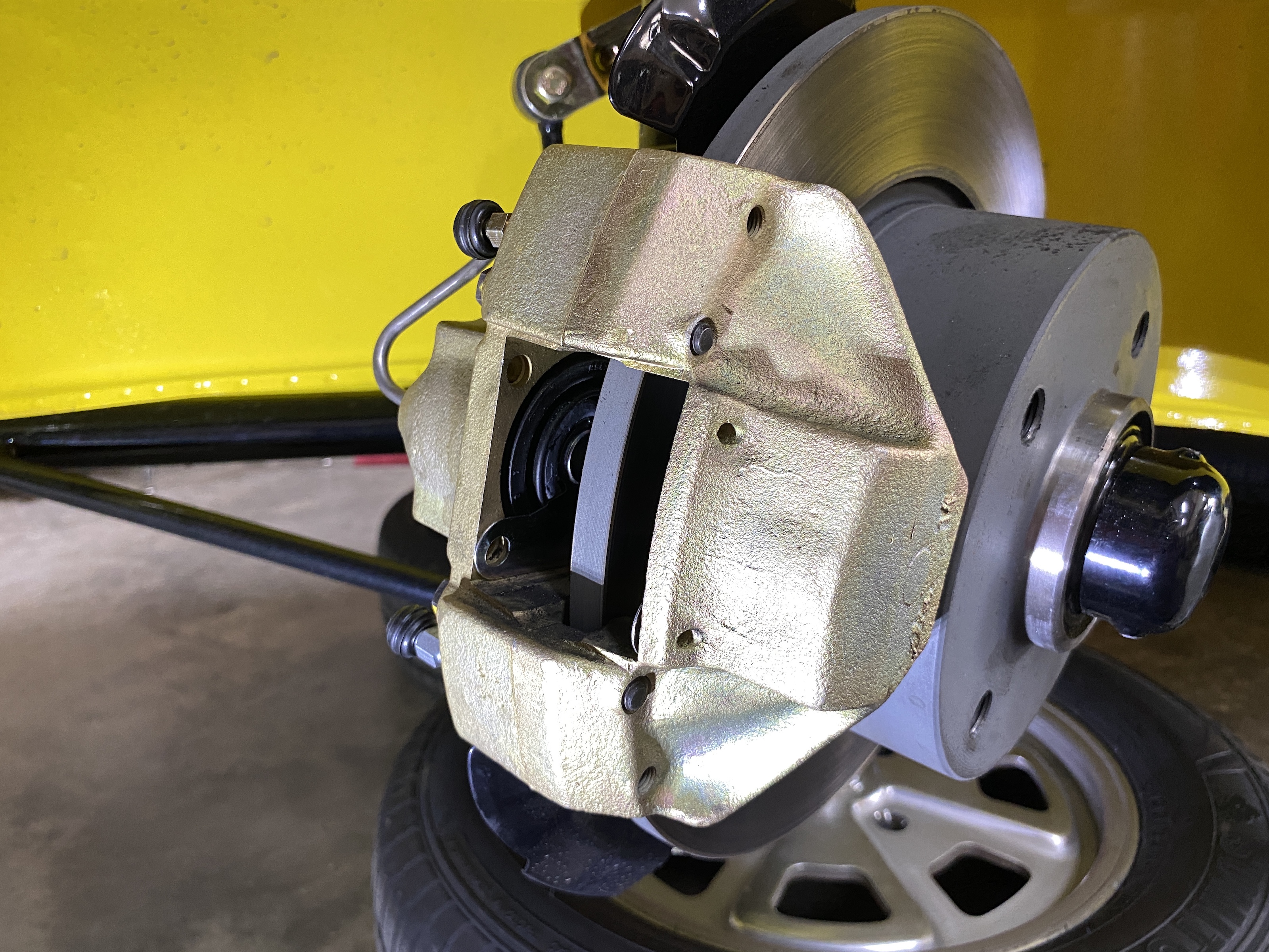

So, take the Porterfield pads out of the front calipers...
bkrantz
post Sep 11 2022, 07:28 PM
Post #5880
Posts: 8,343
Joined: 3-August 19
From: SW Colorado
Member No.: 23,343
And replace with Textar pads, which are quite a bit thinner.
