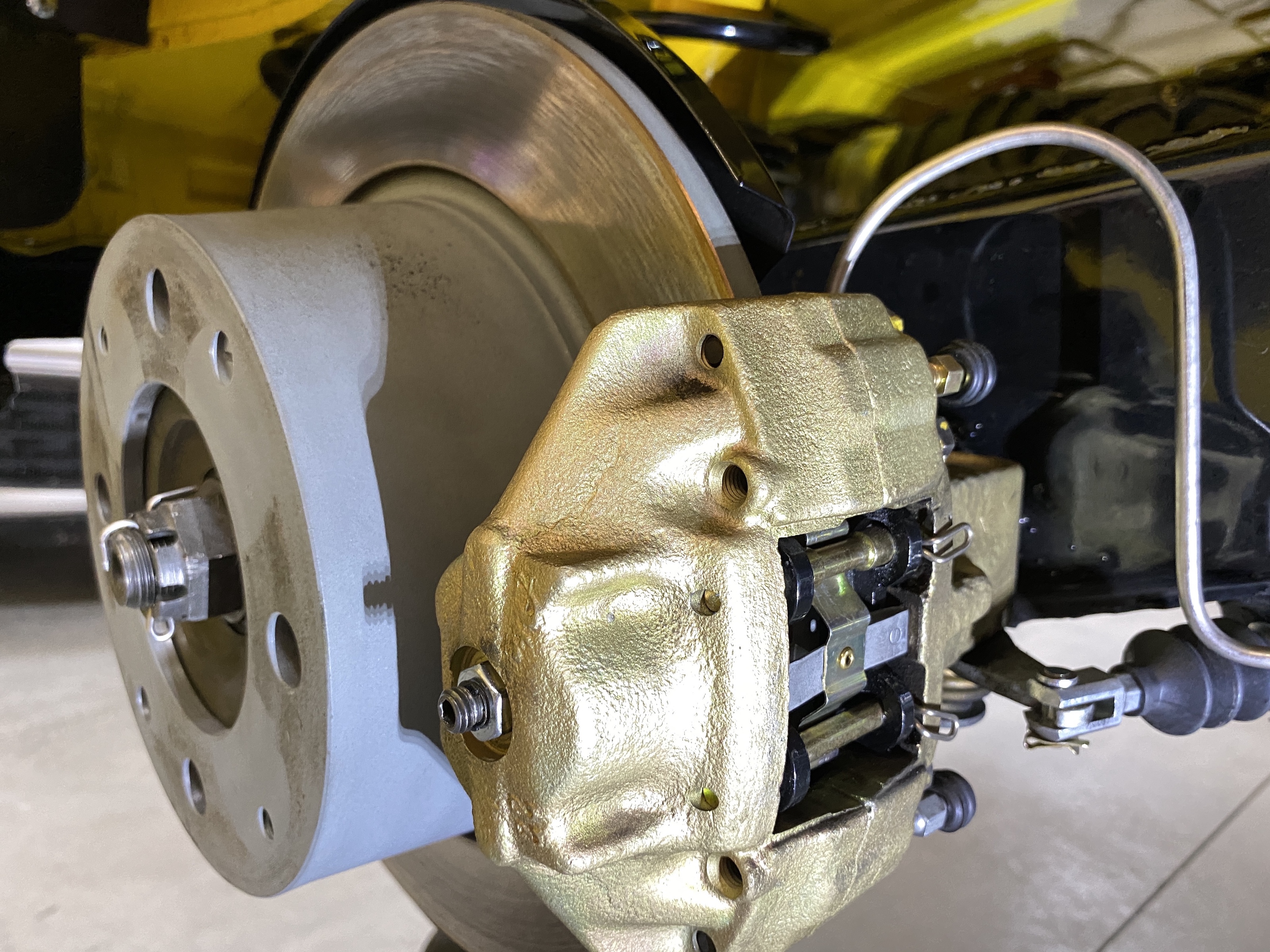

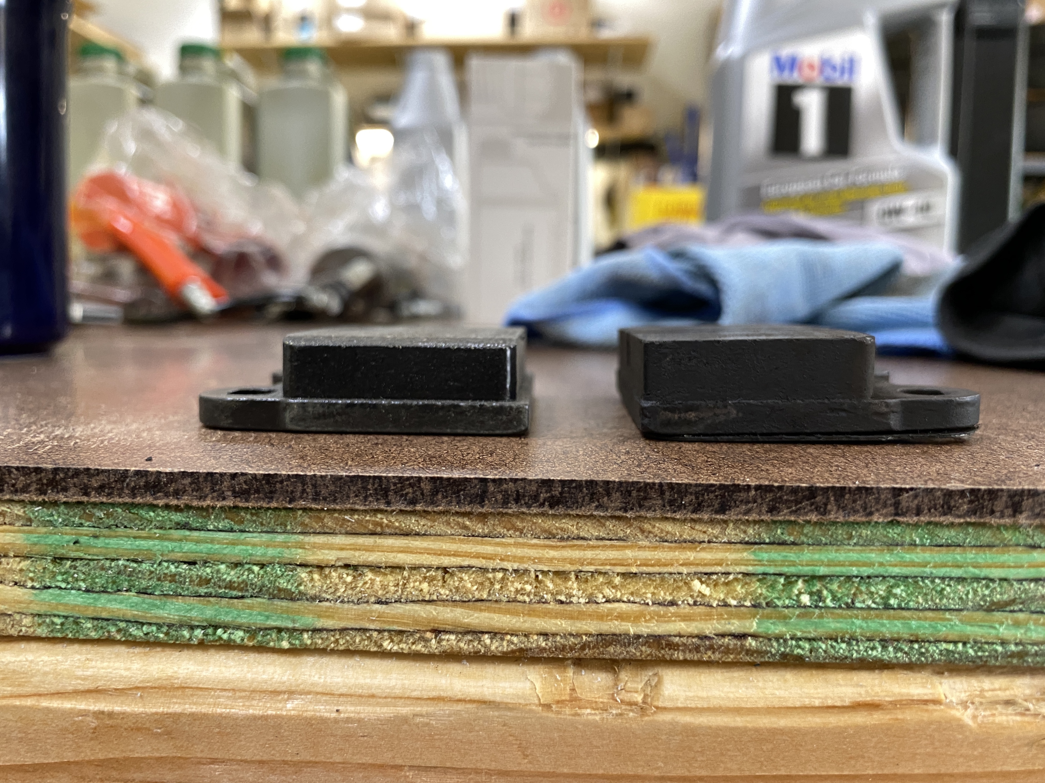

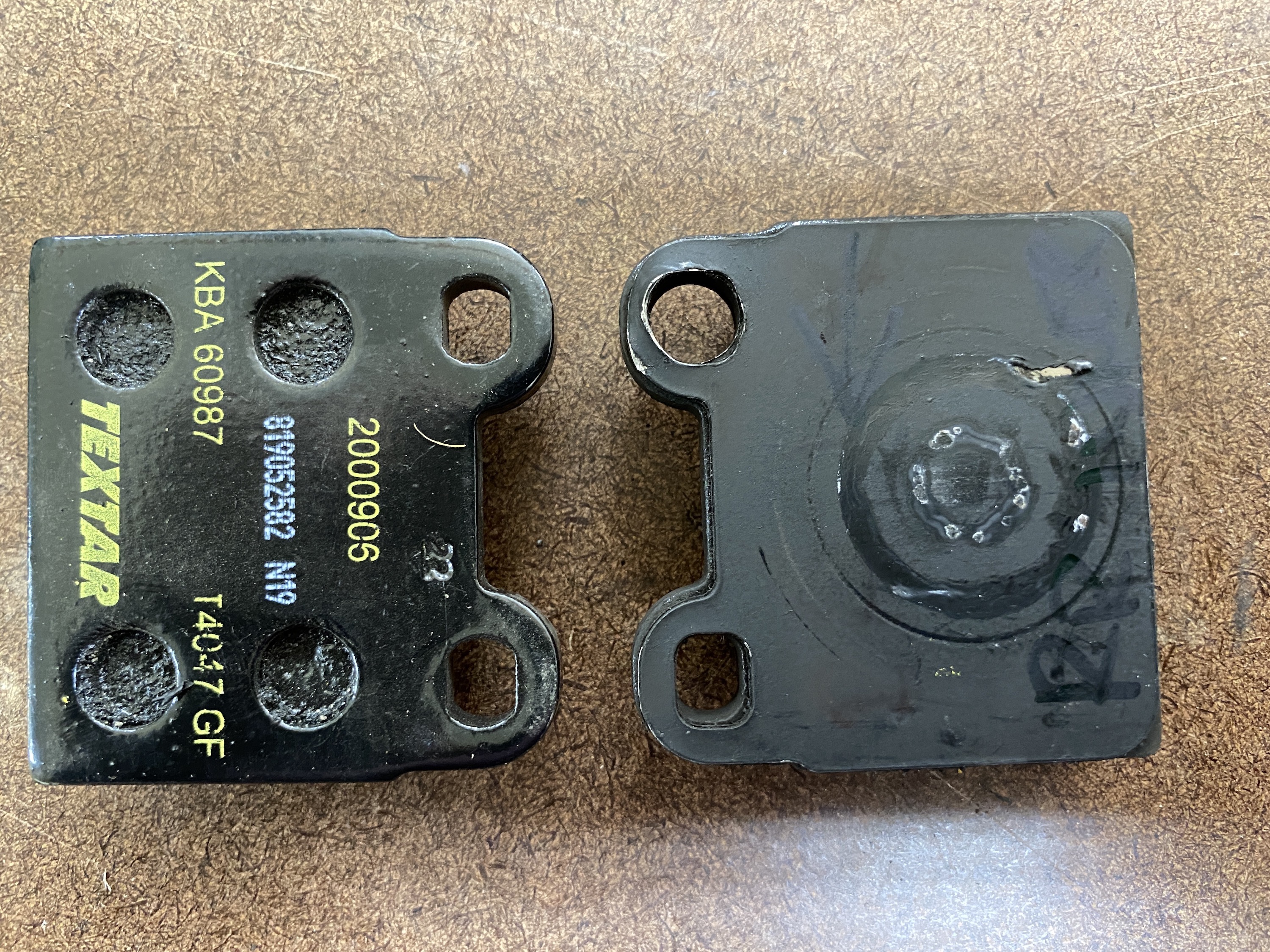

The rear pads are about the same thickness.
bkrantz
post Sep 11 2022, 07:31 PM
Post #5882
Posts: 8,343
Joined: 3-August 19
From: SW Colorado
Member No.: 23,343

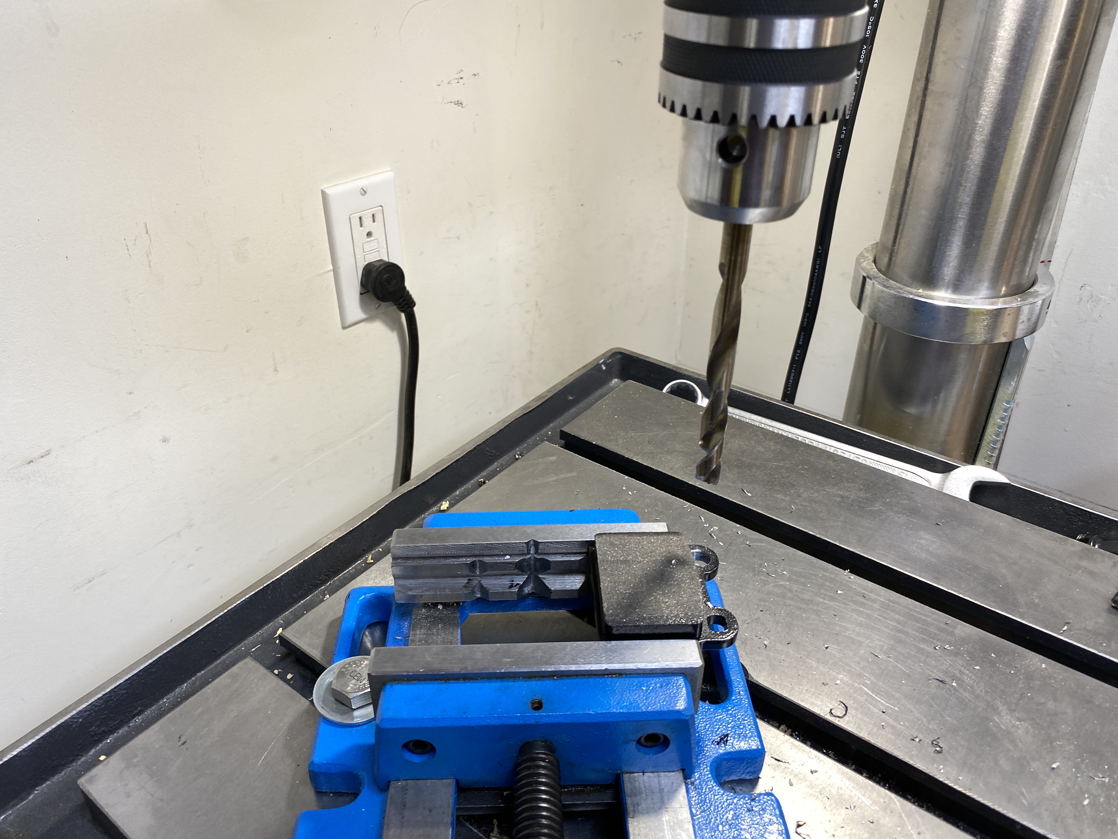

But they need to have one hole enlarged for the retaining pin.
bkrantz
post Sep 11 2022, 07:32 PM
Post #5883
Posts: 8,343
Joined: 3-August 19
From: SW Colorado
Member No.: 23,343
A few minutes of drill press action.
bkrantz
Post #5884
Posts: 8,343
Joined: 3-August 19
From: SW Colorado
Member No.: 23,343
And the new pads are ready to bed and try out.

Curious why the front pads are so much thinner??? Hate to see all the little things on your list, but makes me happy to keep watching your post.
bkrantz
post Sep 12 2022, 08:14 PM
Post #5887
Posts: 8,343
Joined: 3-August 19
From: SW Colorado
Member No.: 23,343
QUOTE(Puebloswatcop @ Sep 12 2022, 06:18 PM) *
Not sure, Howard. I think some of the part numbers for 914-4 front pads are also used for 911 rear pads. In any case, I do not expect to wear them out too quickly.

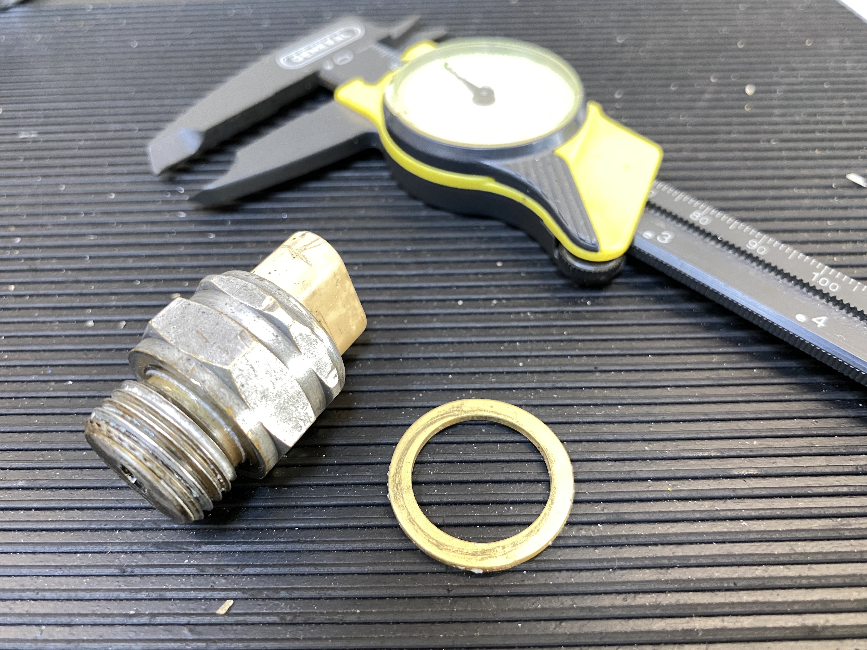

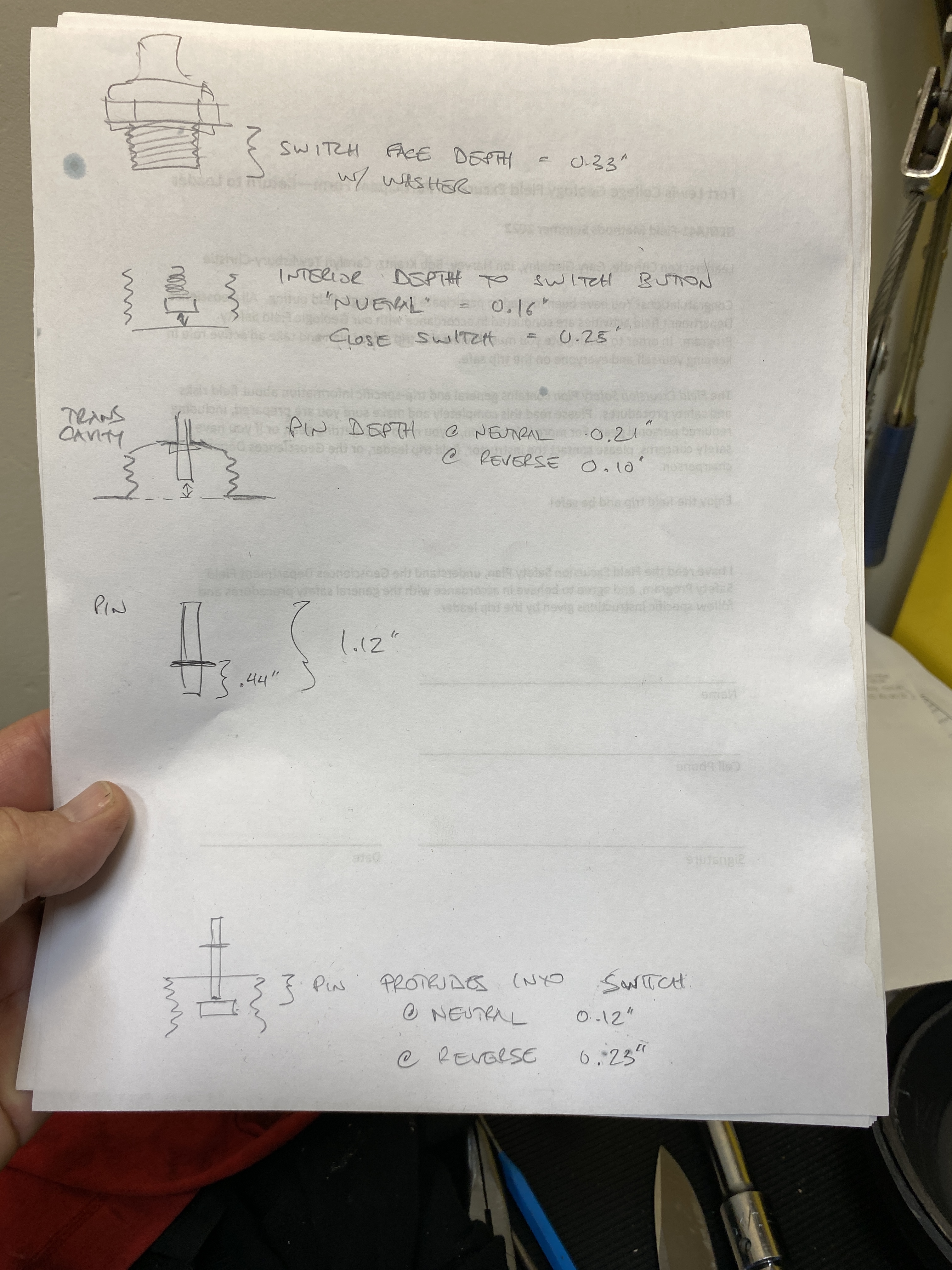

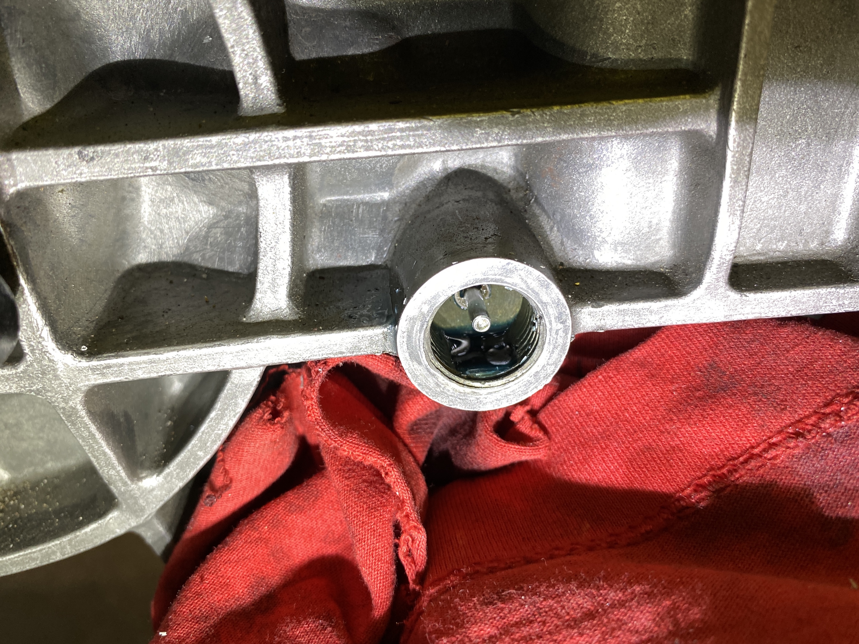

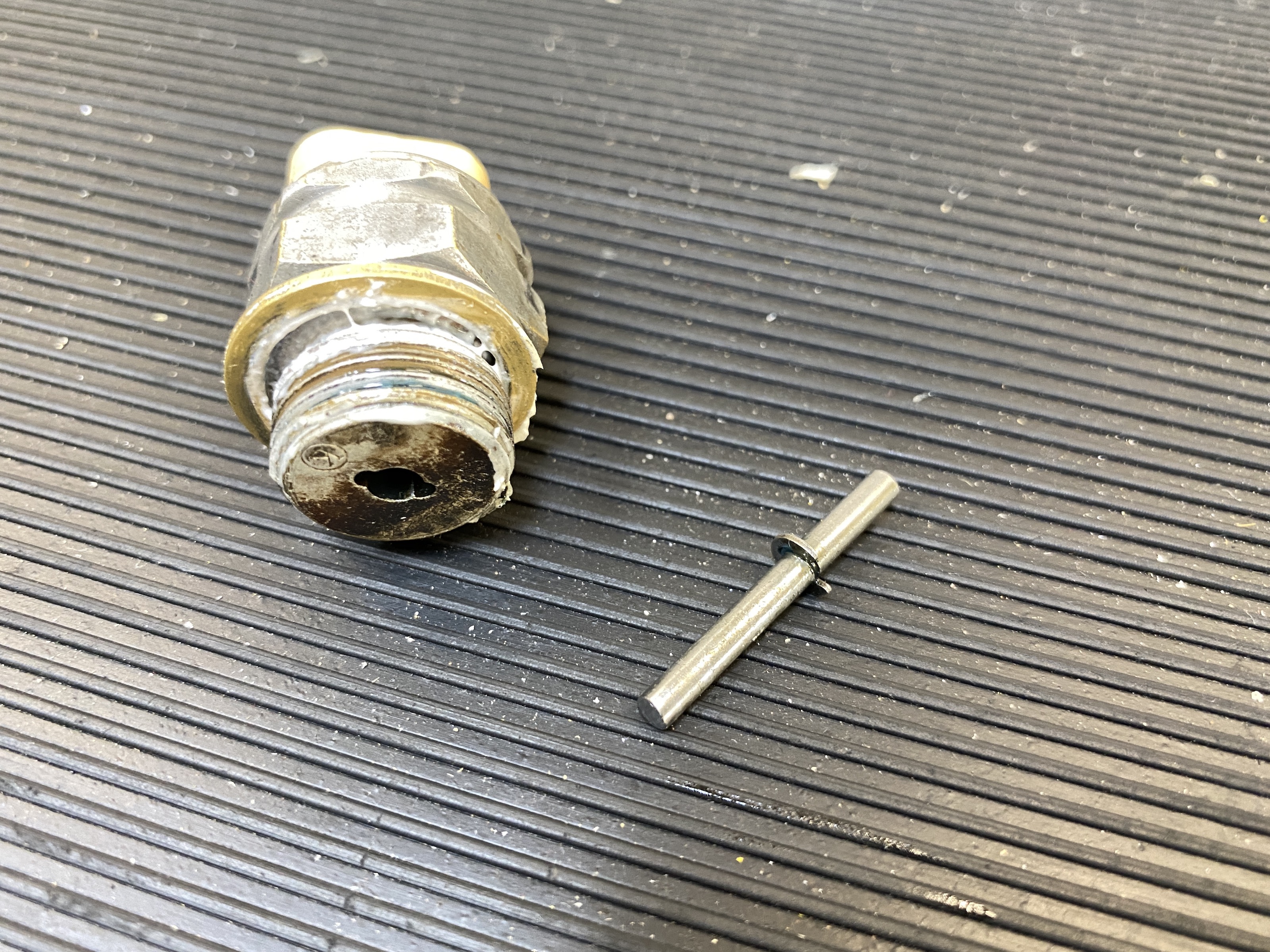

I removed the reverse switch from the transaxle, along with the actuating pin. Lube does leak from the small pin hole, but very slowly.
bkrantz
post Sep 12 2022, 08:18 PM
Post #5889
Posts: 8,343
Joined: 3-August 19
From: SW Colorado
Member No.: 23,343
Here's the pin, installed in the transaxle switch port. I confirmed that putting the trans in reverse did push the pin outward.
bkrantz
post Sep 12 2022, 08:20 PM
Post #5890
Posts: 8,343
Joined: 3-August 19
From: SW Colorado
Member No.: 23,343
Then I did a bunch of measuring. I figured out that the pin action was about 0.02" too short to actuate the switch.
bkrantz
post Sep 12 2022, 08:23 PM
Post #5891
Posts: 8,343
Joined: 3-August 19
From: SW Colorado
Member No.: 23,343
A simple fix: I removed the thick washer/spacer from the switch, and replaced it with some aviation gasket sealer. That moved the switch inward against the pin.

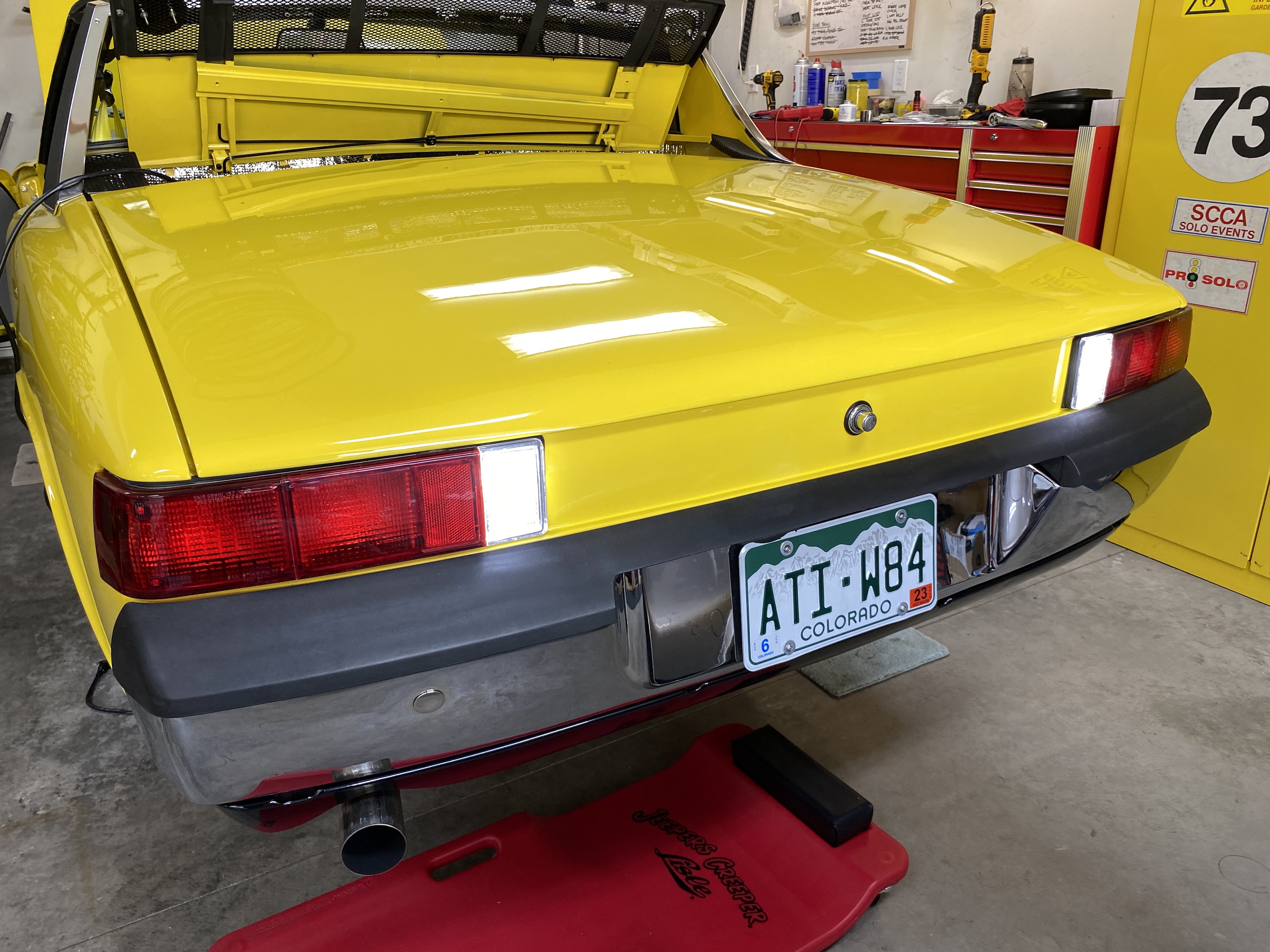

bkrantz
post Sep 12 2022, 08:24 PM
Post #5892
Posts: 8,343
Joined: 3-August 19
From: SW Colorado
Member No.: 23,343
Success! When the gear shift is in reverse, the lights come on. Another item off the list.

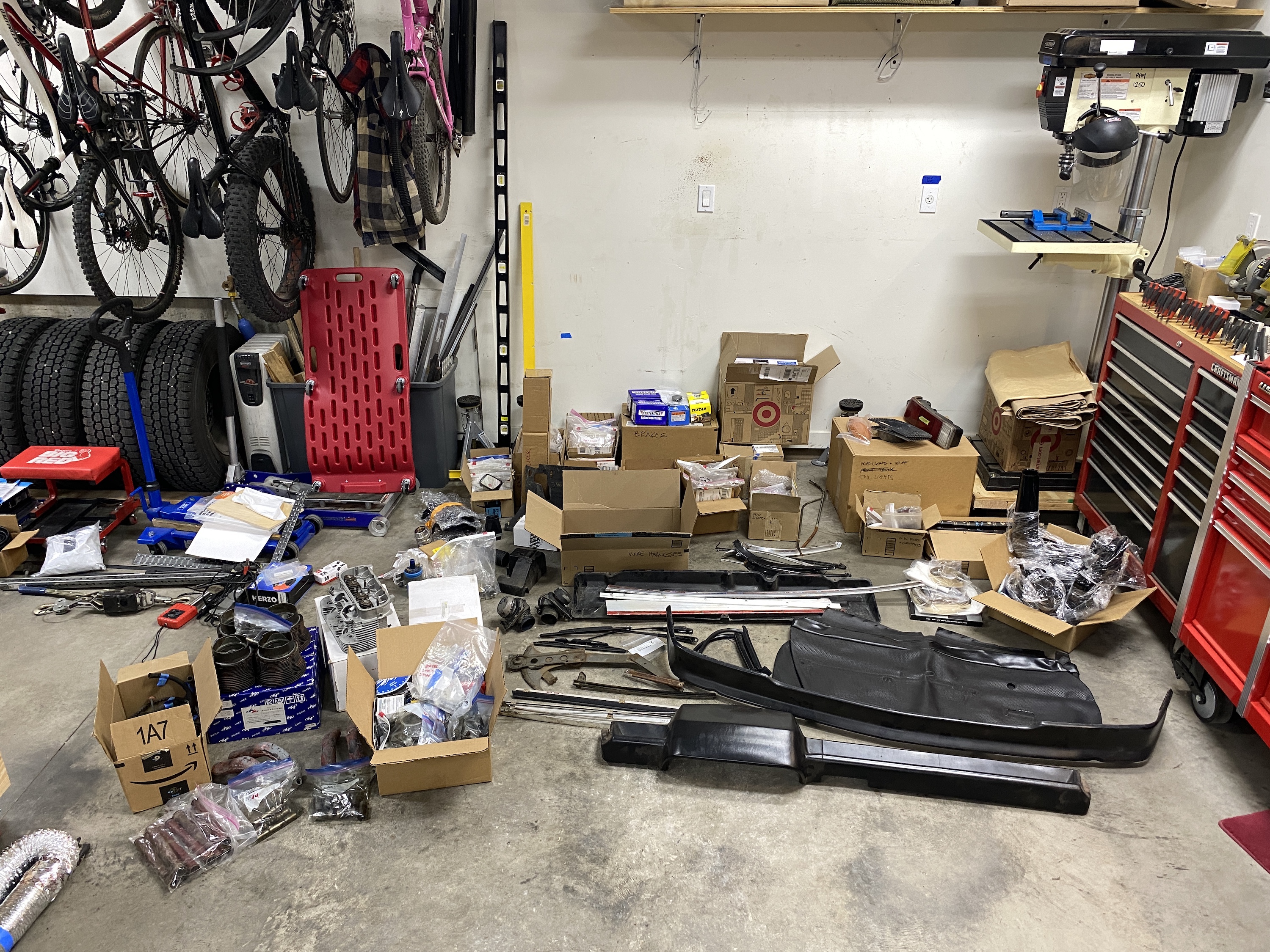

Sorry for the absence. (IMG:style_emoticons/default/sad.gif) Life got busy with lots of non-914 things.
Anyway, to get going on progress again, I took the car back to the paint shop. When I picked it up (2 years ago!) they promised to touch up and polish the paint when I got done.
When I got home, I decided to take advantage of the empty garage space, and sort through all the piles, bags, and boxes of parts. These came off the shelves.
bkrantz
post Oct 22 2022, 08:07 PM
Post #5895
Posts: 8,343
Joined: 3-August 19
From: SW Colorado
Member No.: 23,343

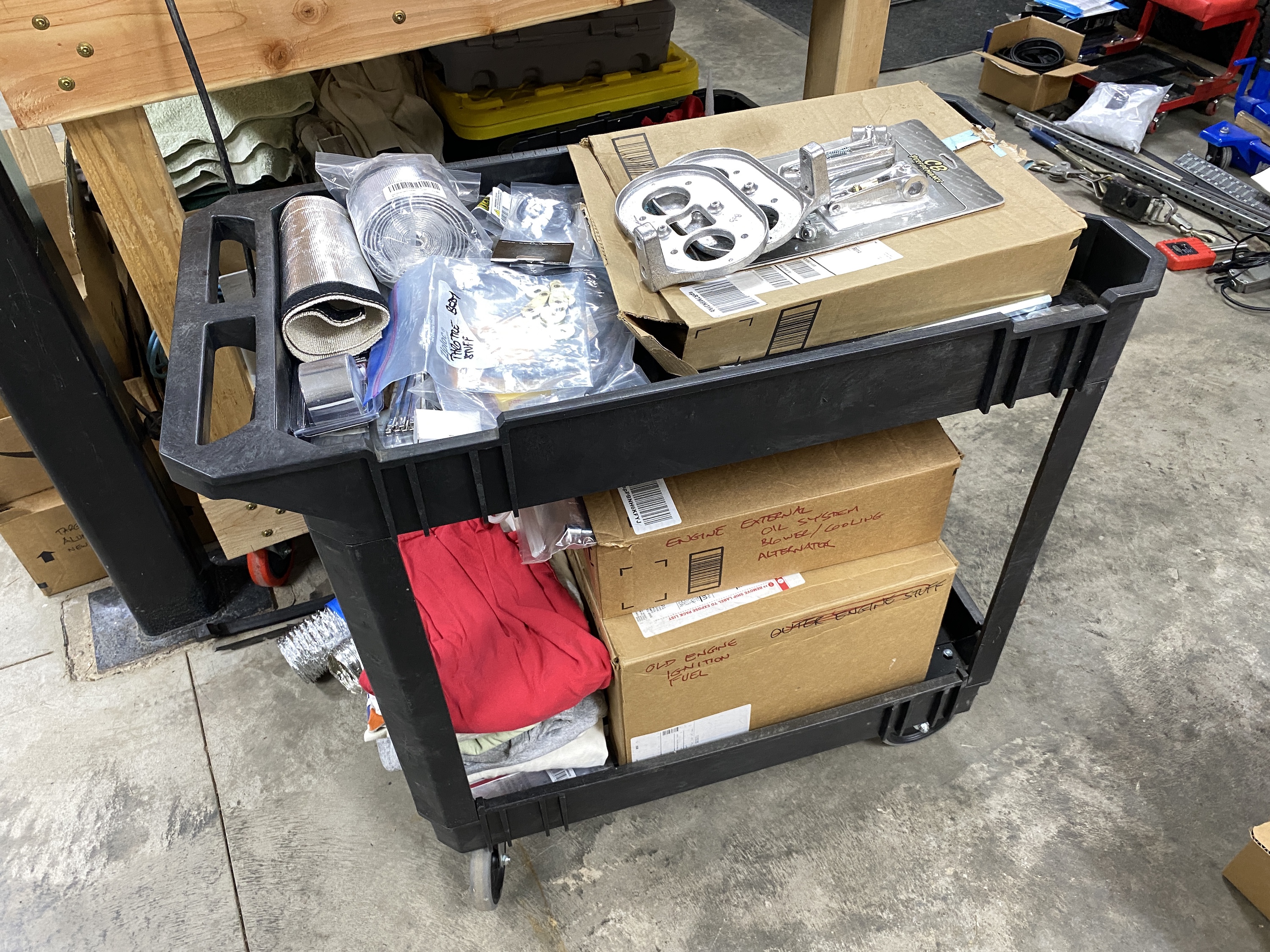

Plus these on my cart.
Once I make an inventory, I will separate the spares I want to keep, and then list all the stuff that might be useful to others (for sale or free). Stay tuned.

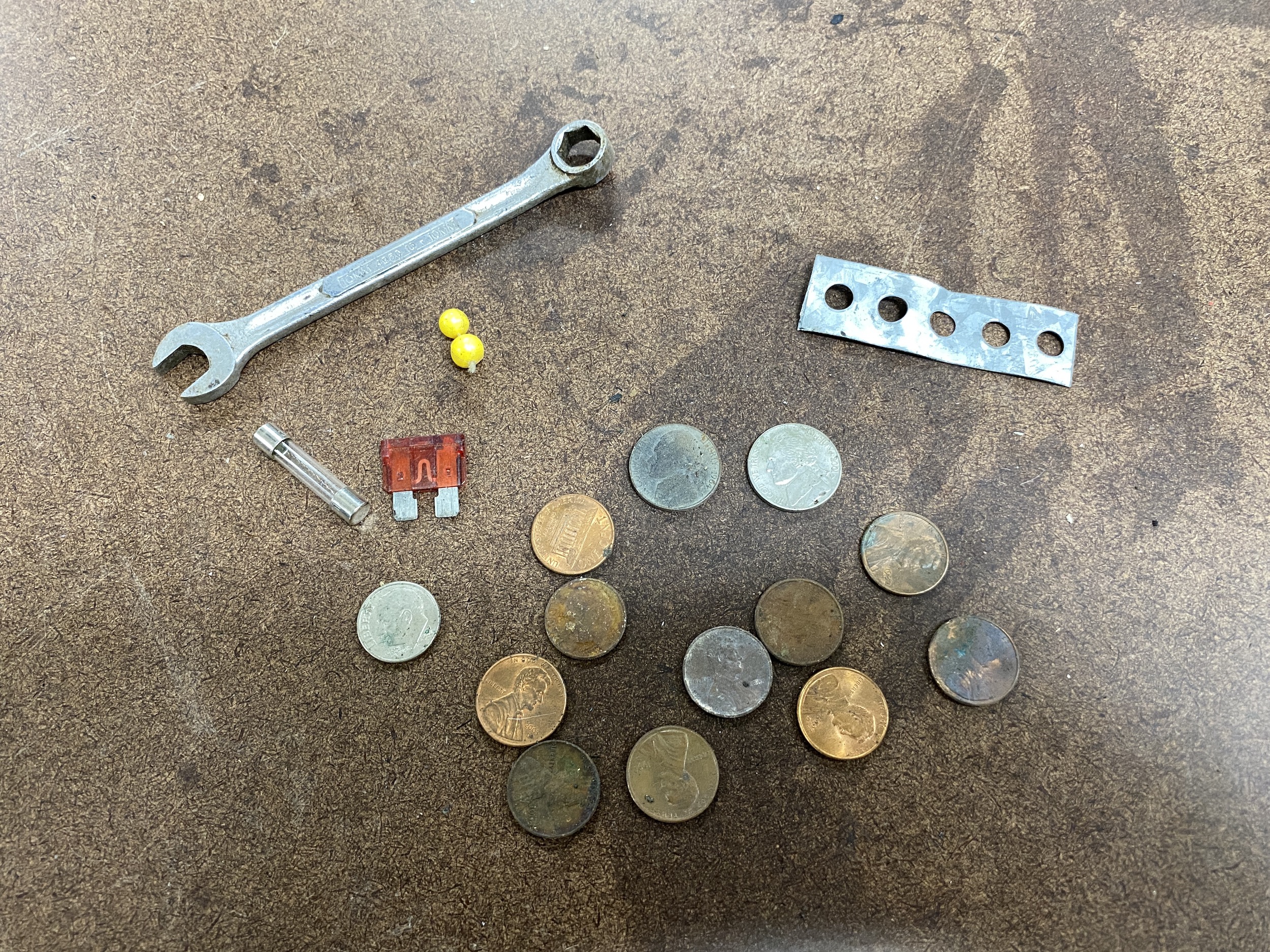

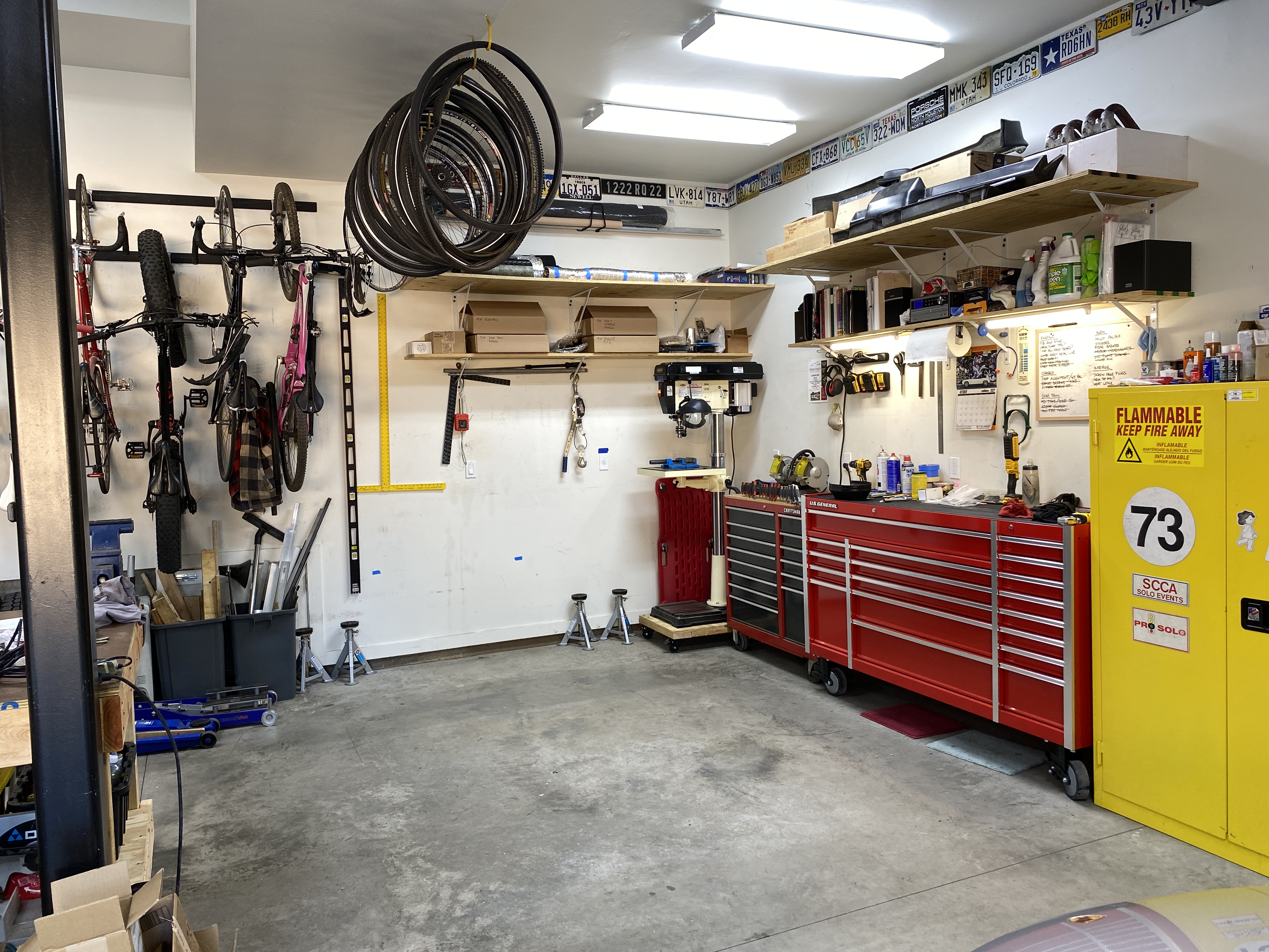

I sorted through about half the pile today, mostly engine parts. I will have an inventory and Fore Sale list up soon.
I did find the box of stuff that came from the interior. That's 39 cents and a cheap 10mm wrench!
bkrantz
post Oct 24 2022, 07:50 PM
Post #5900
Posts: 8,343
Joined: 3-August 19
From: SW Colorado
Member No.: 23,343
Mission accomplished! 3 shelves of 914 stuff down to 1-1/2, and separated into stuff to keep and stuff to divest. Now I need to figure out some fair values for the decent stuff.
