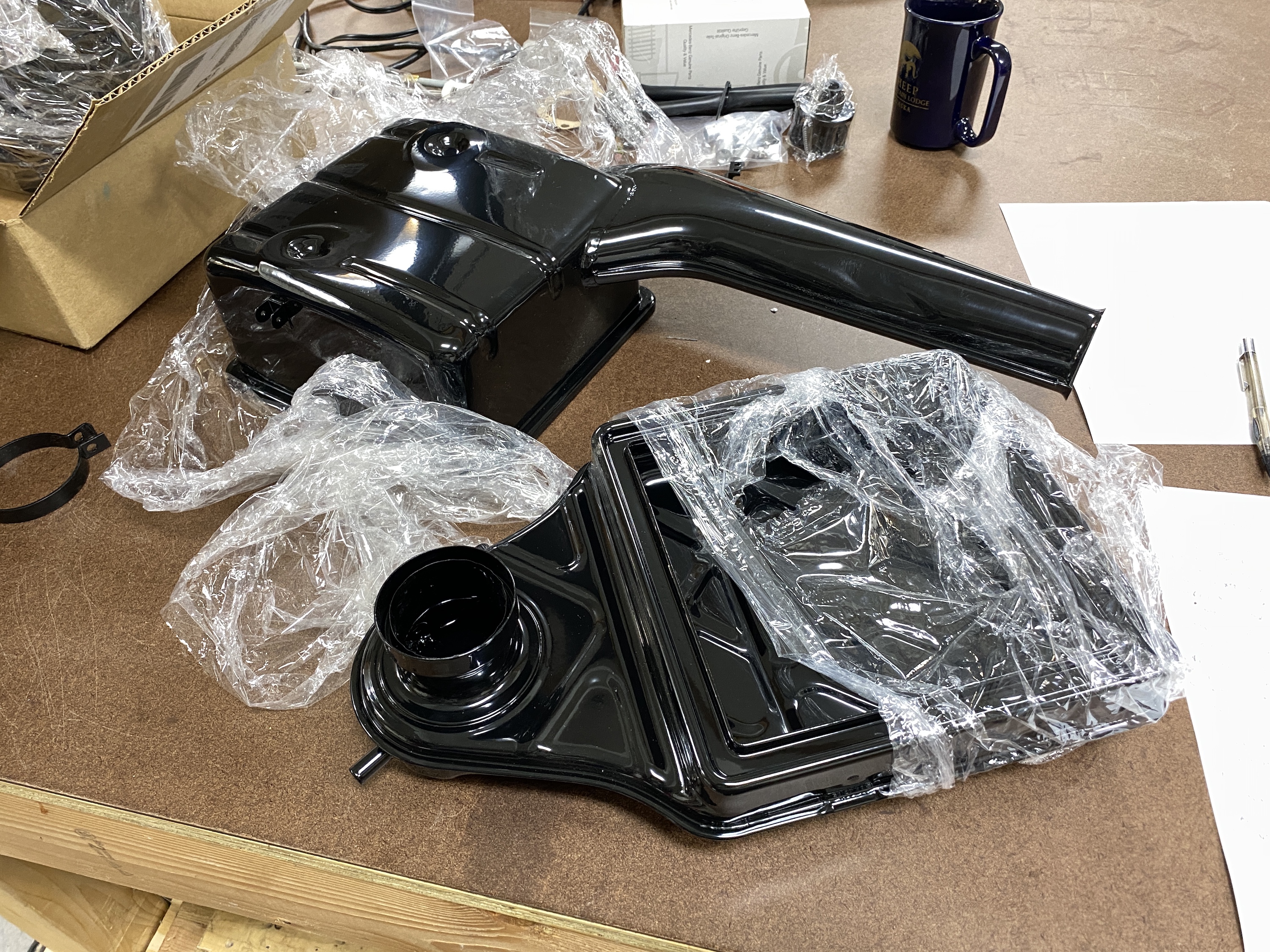

Powder-coated 2.0 air filter housing.

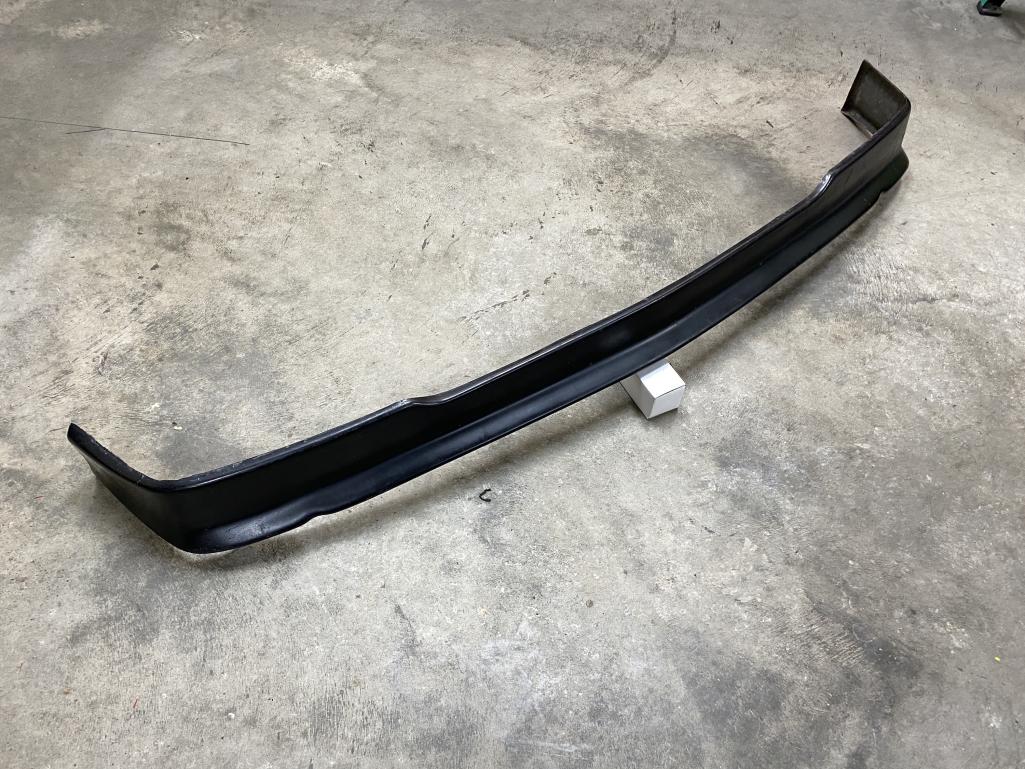

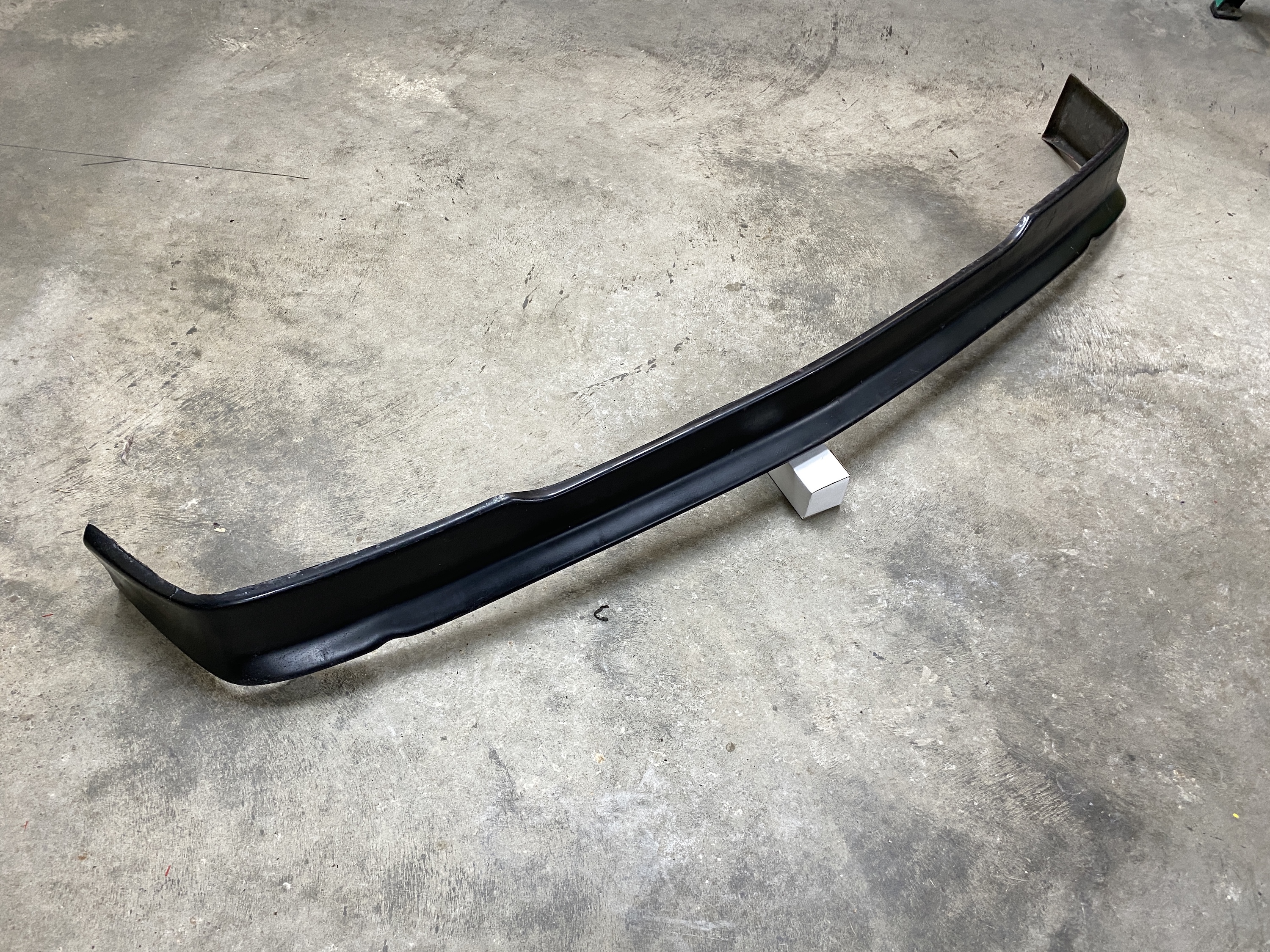

LE style front air dam, fiberglass (no indication that it is factory).

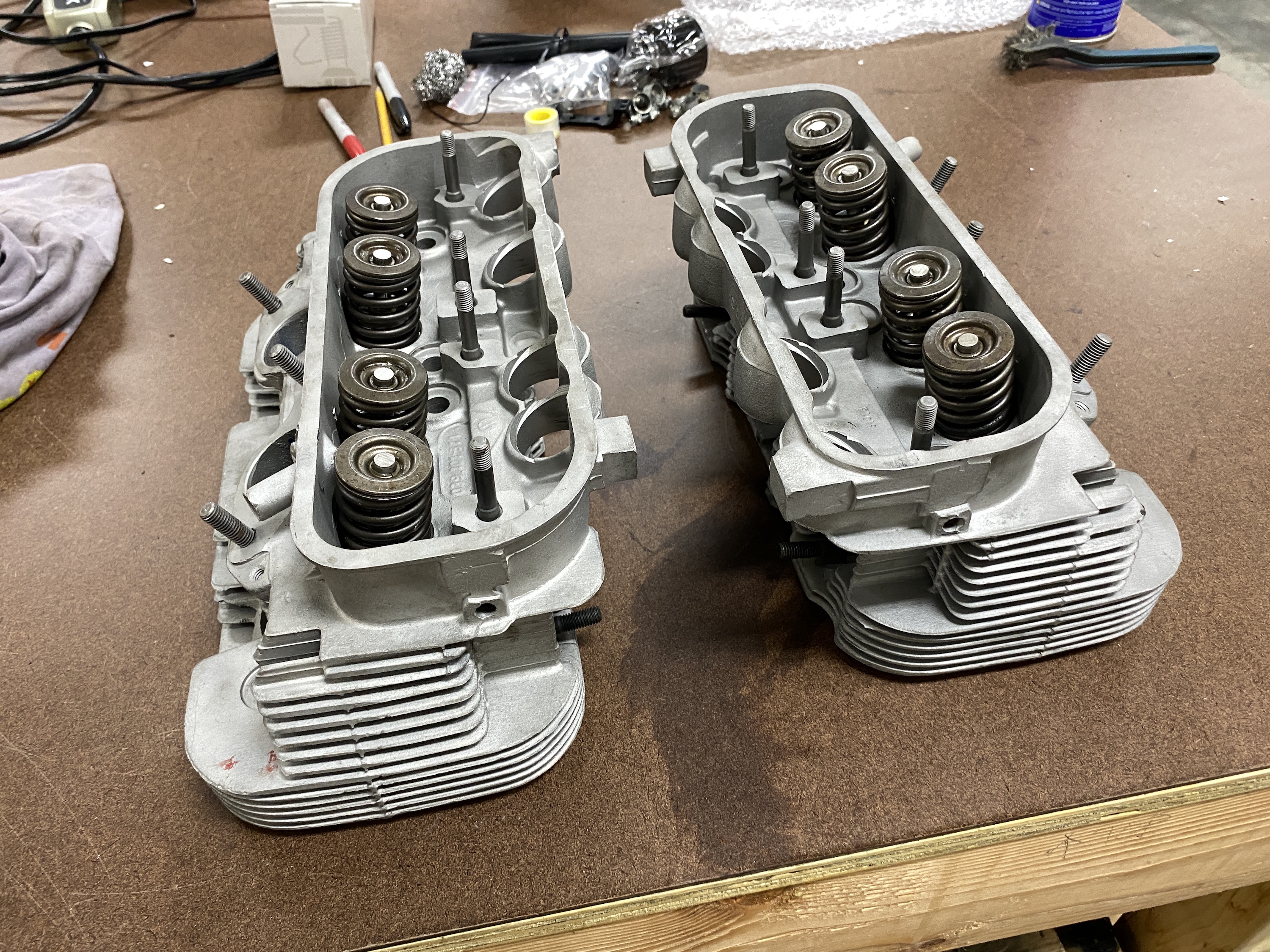

Rebuilt 2.0 cylinder heads.
Stay tuned for a listing in the classifieds.

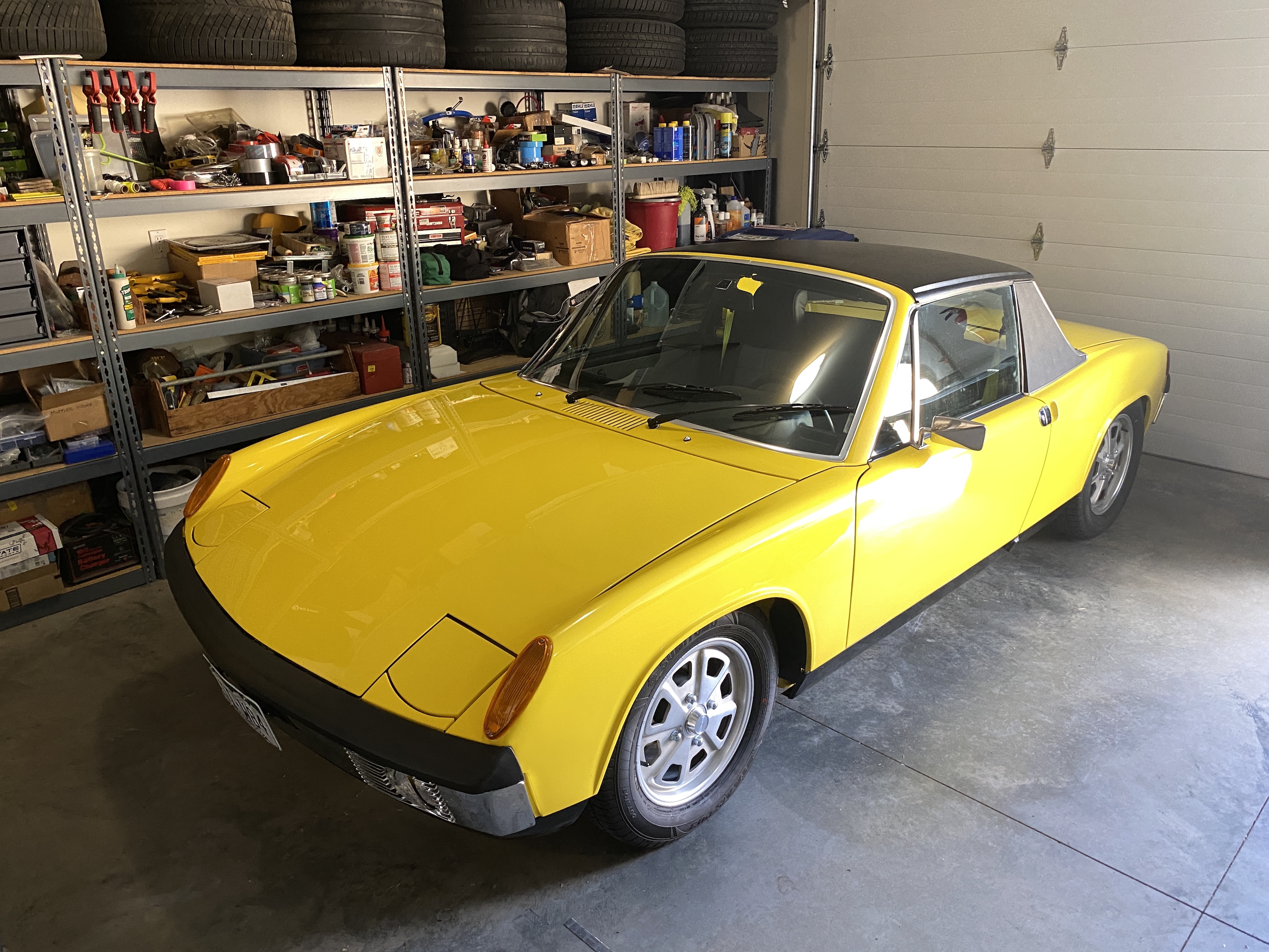

I brought the car home from the paint shop. They did a few local touch-ups, and polished the exterior. It looks very good. Rain was threatening, so I did not stop until I got home.

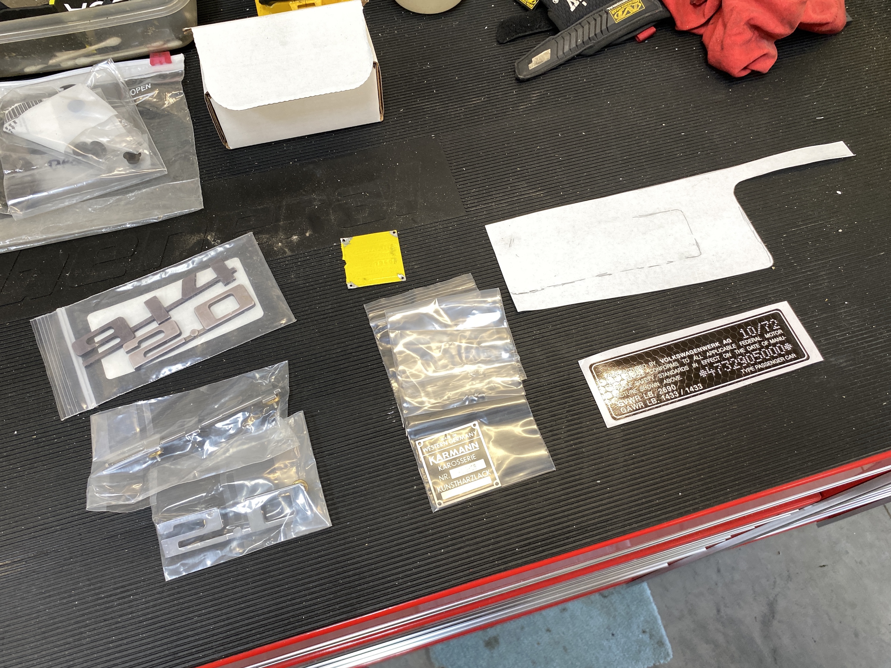

Today's task: miscellaneous badges and stickers. I have new insignia for the rear panel, a new chassis/color badge (with the updated color!), and a repro door frame build sticker.

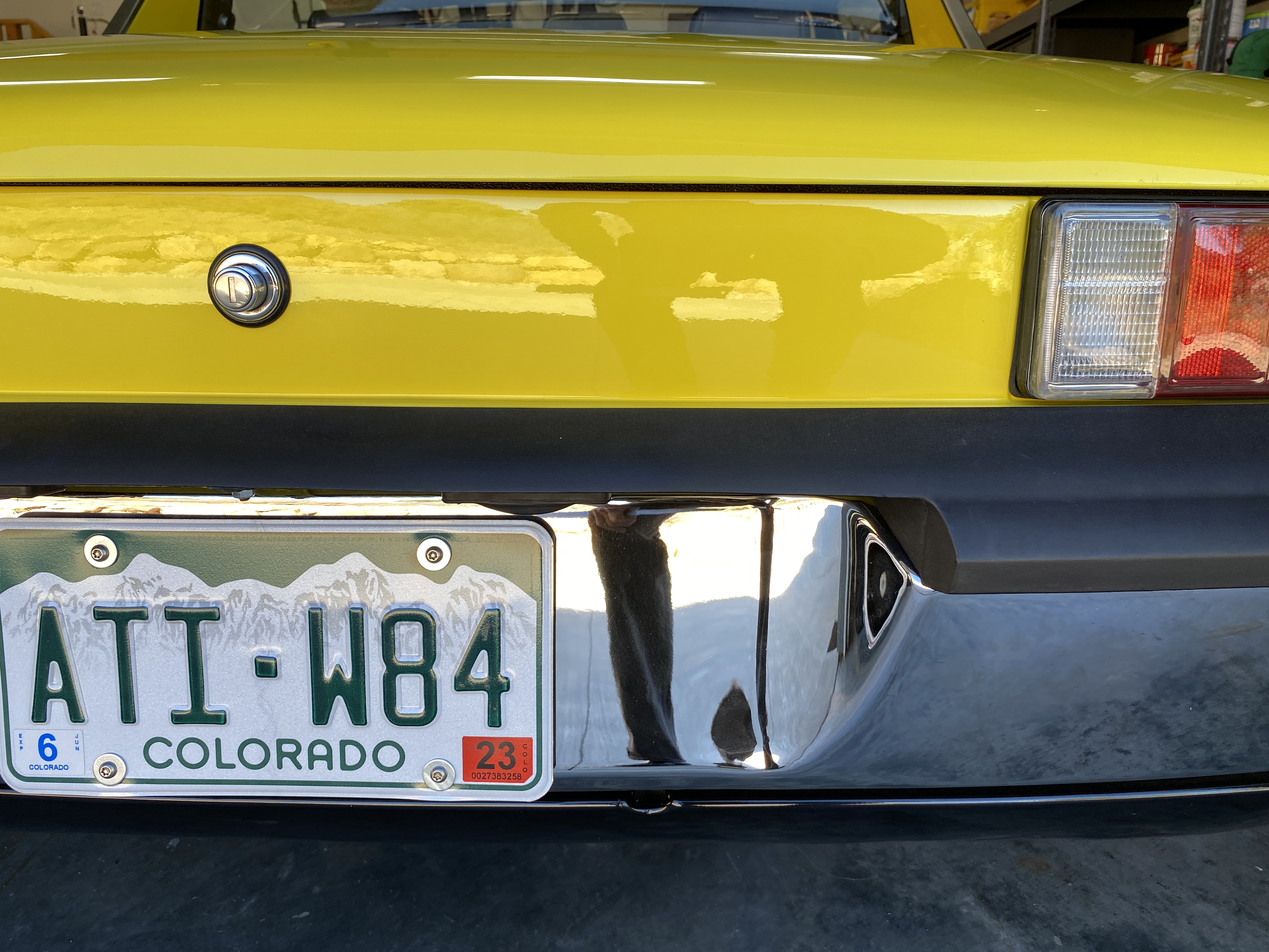

Here's the rear panel, with the original holes filled by the paint shop. I thought about drilling these out, but decided to leave the panel as-is. No potential leaks, and it gives me the option to shave the panel in the future.

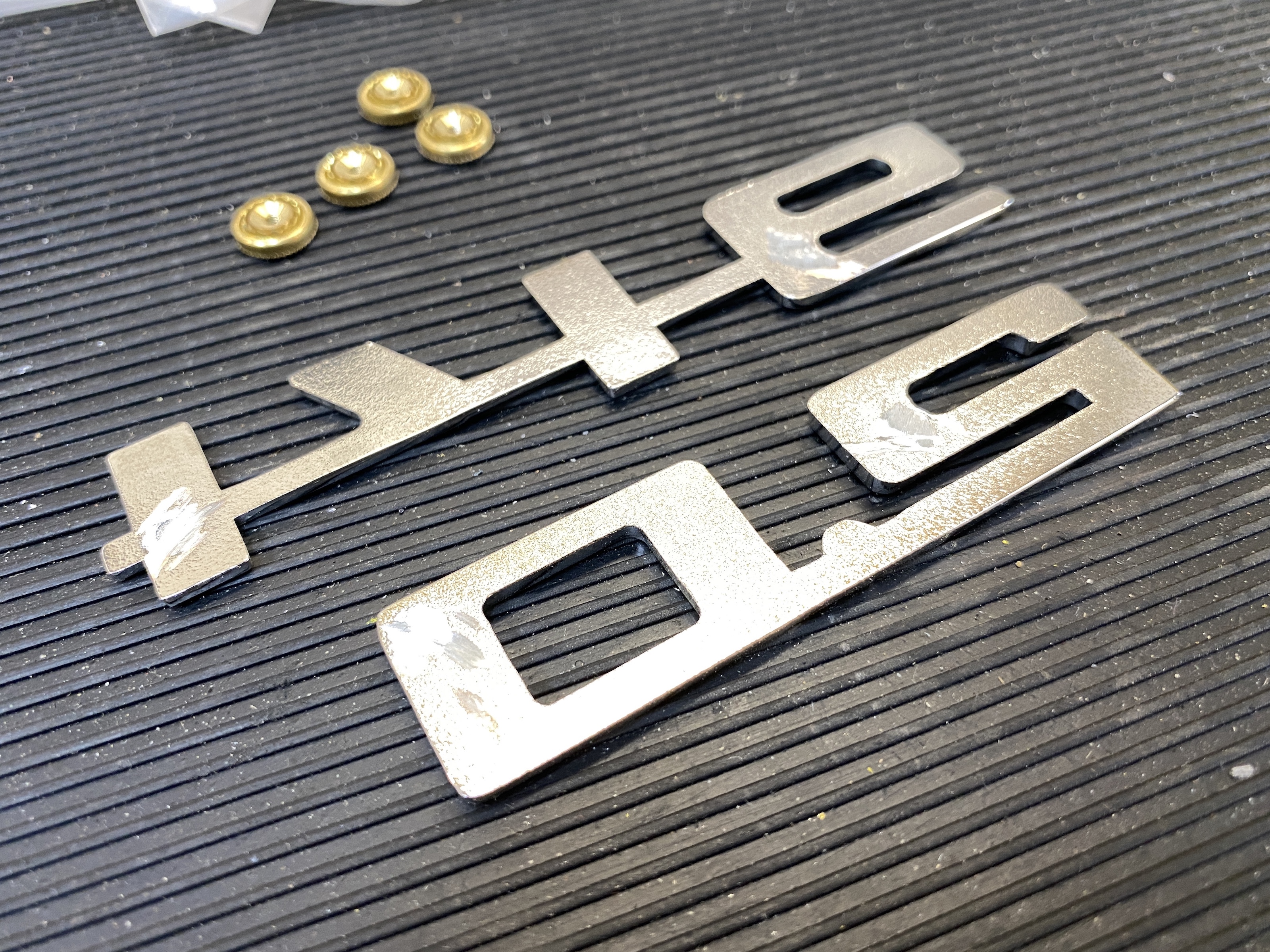

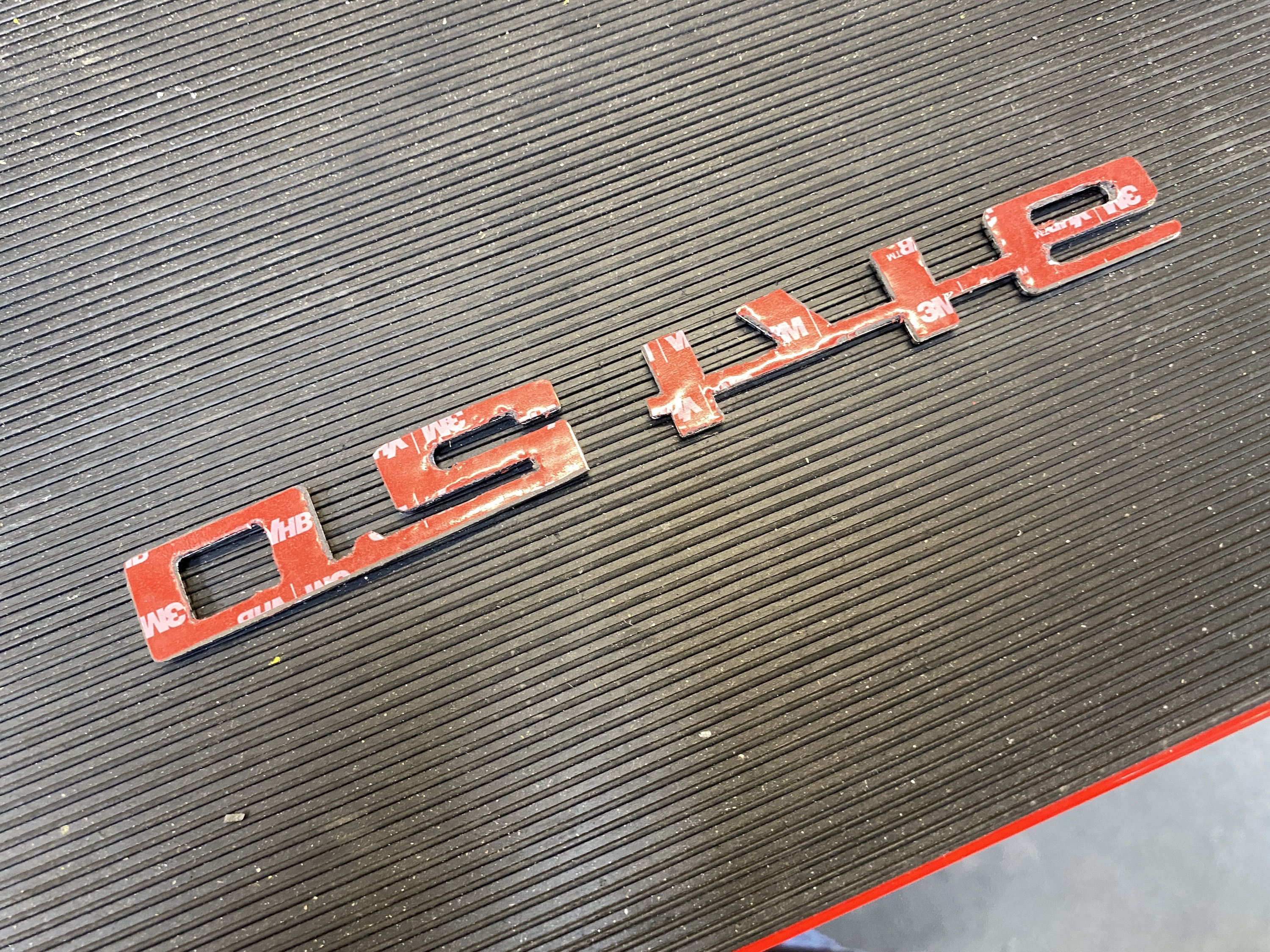

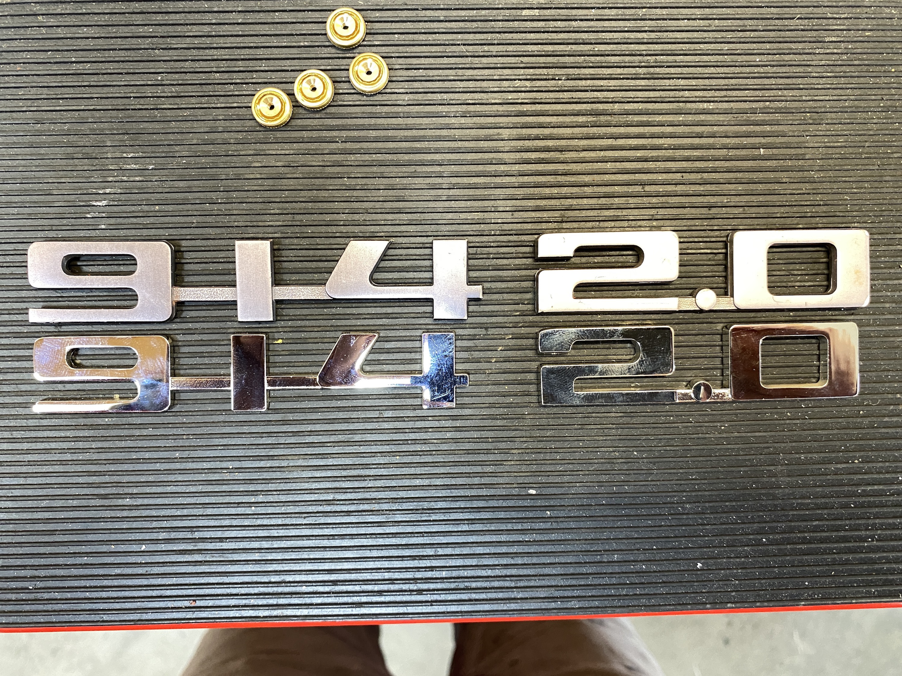

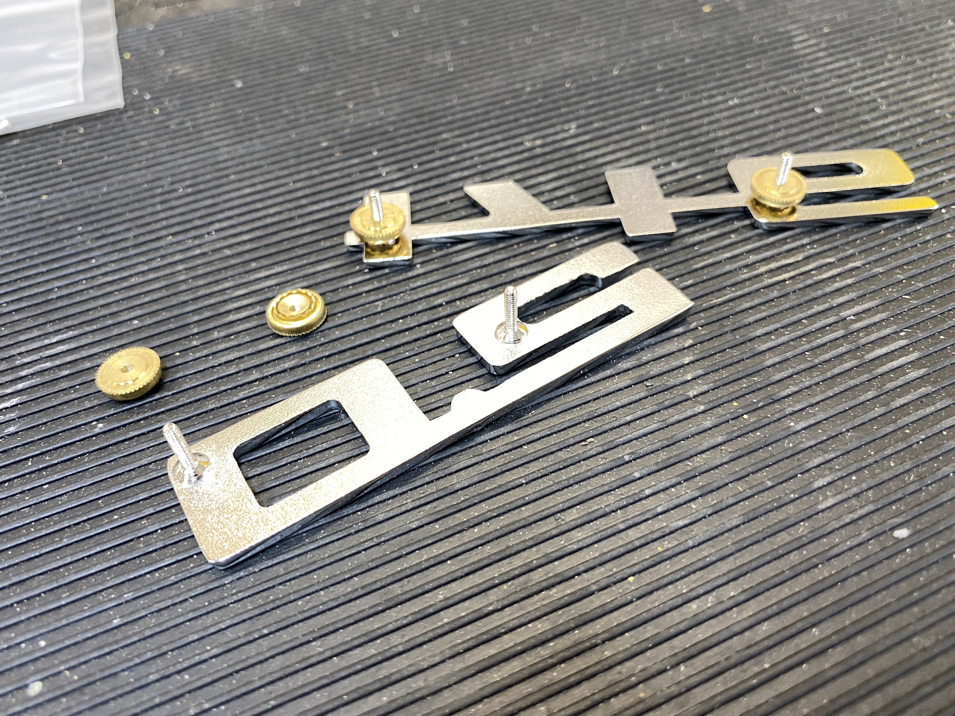

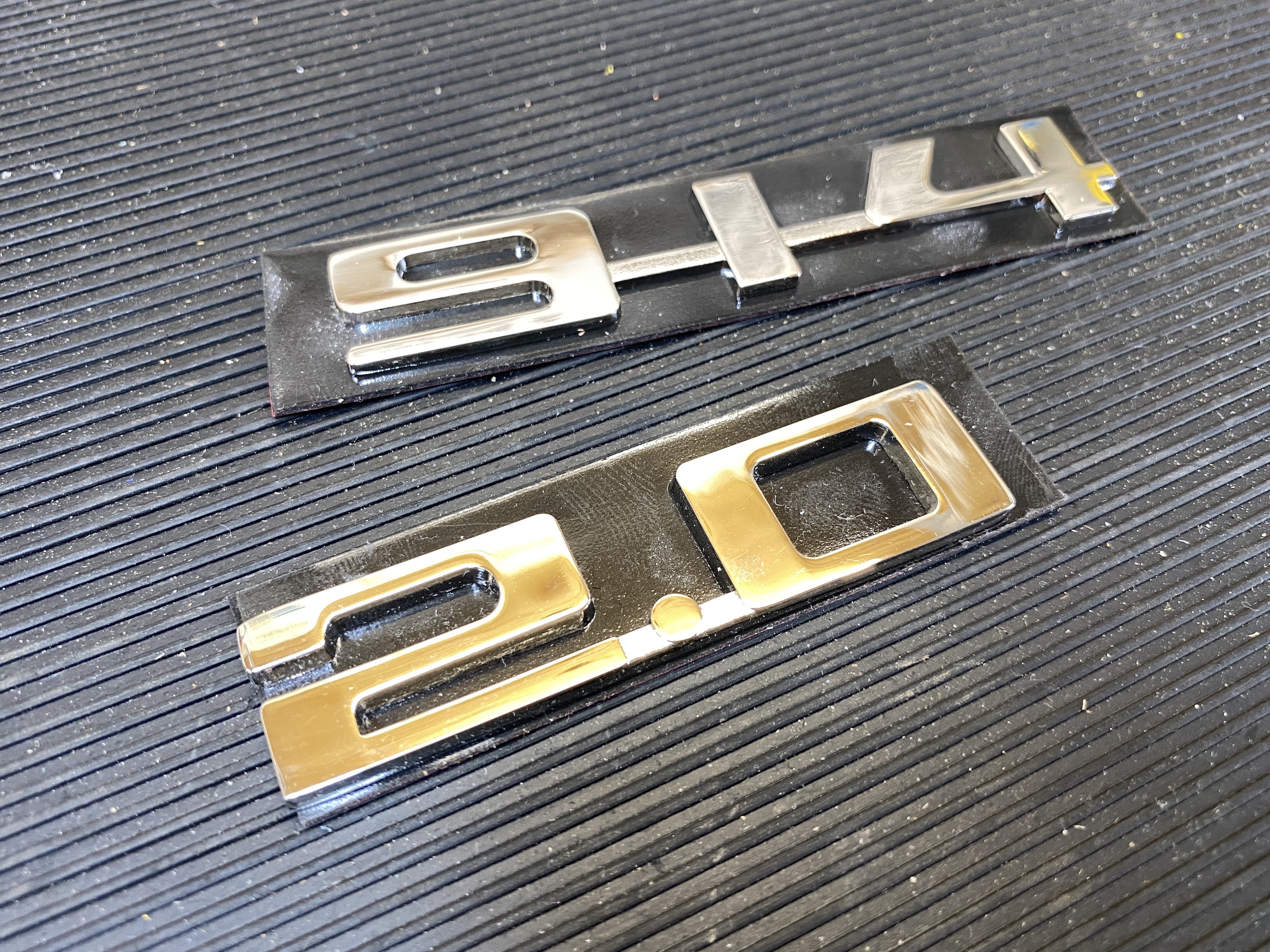

The new insignia are cast metal with screw posts. Done nicely, but not right for me.
bkrantz
post Oct 28 2022, 07:48 PM
Post #5912
Posts: 8,342
Joined: 3-August 19
From: SW Colorado
Member No.: 23,343
A few minutes with a Dremel tool and cut-off disk.

That's when I realized that the repros are about 5% smaller than the original. I adjusted the planned positions on the car.

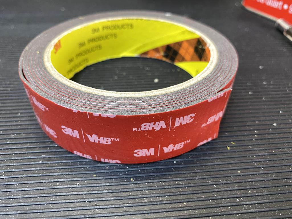

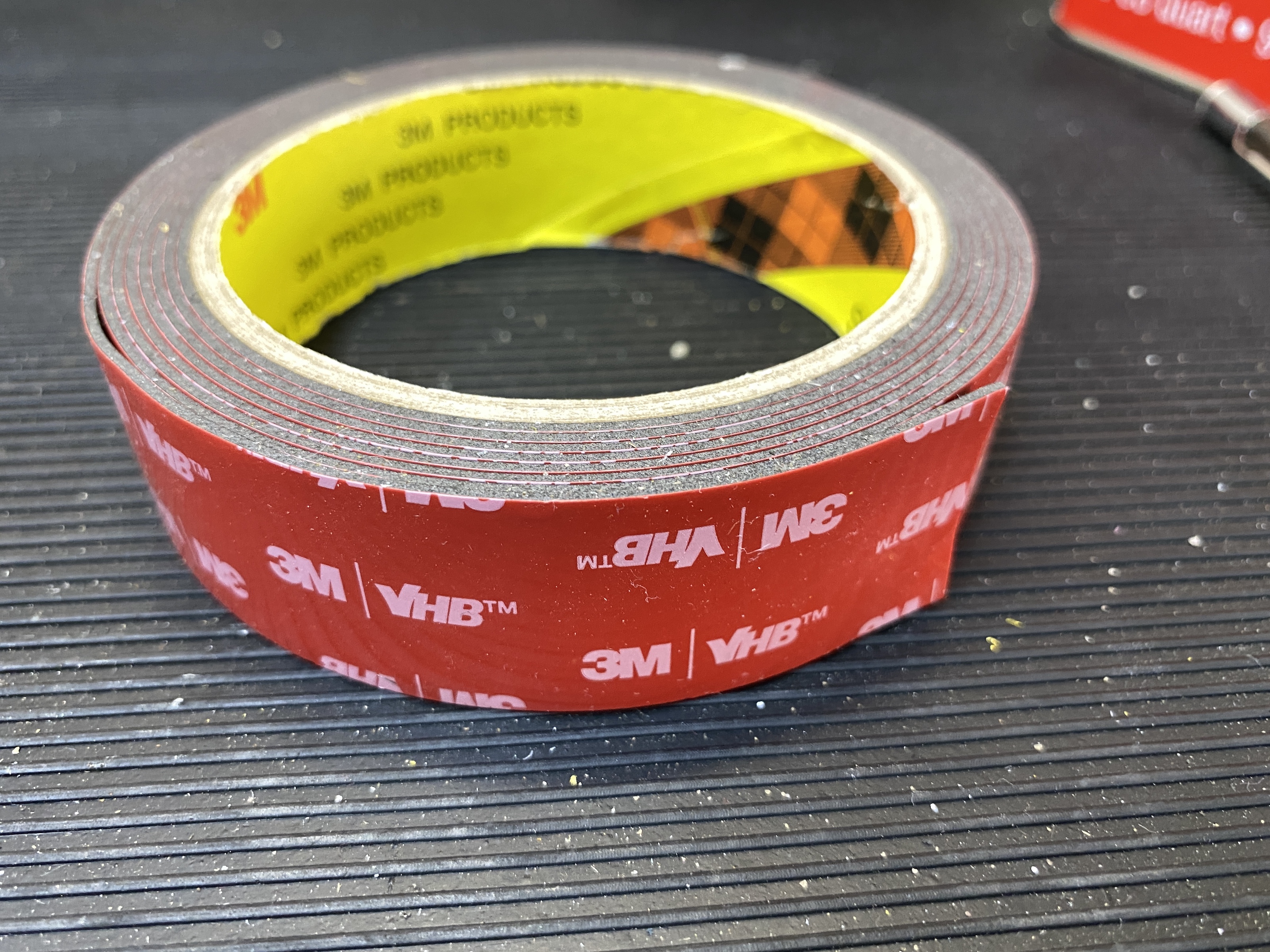

I decided to use trusty 3M adhesive tape.

The easy step: sticking lengths of tape to the insignia.

The harder step: timing the adhesive tape with a new blade, so it was just inside the metal edges.

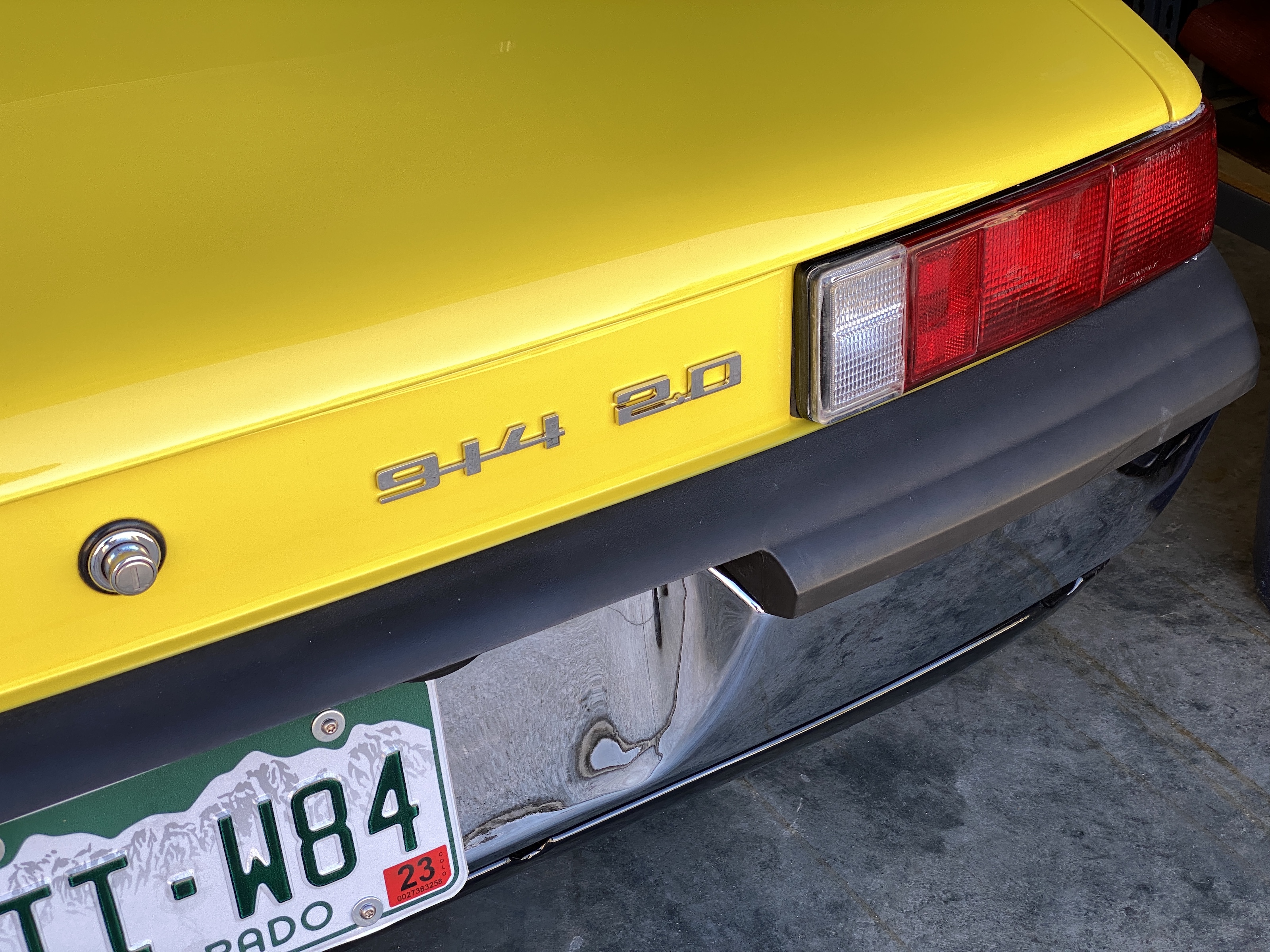

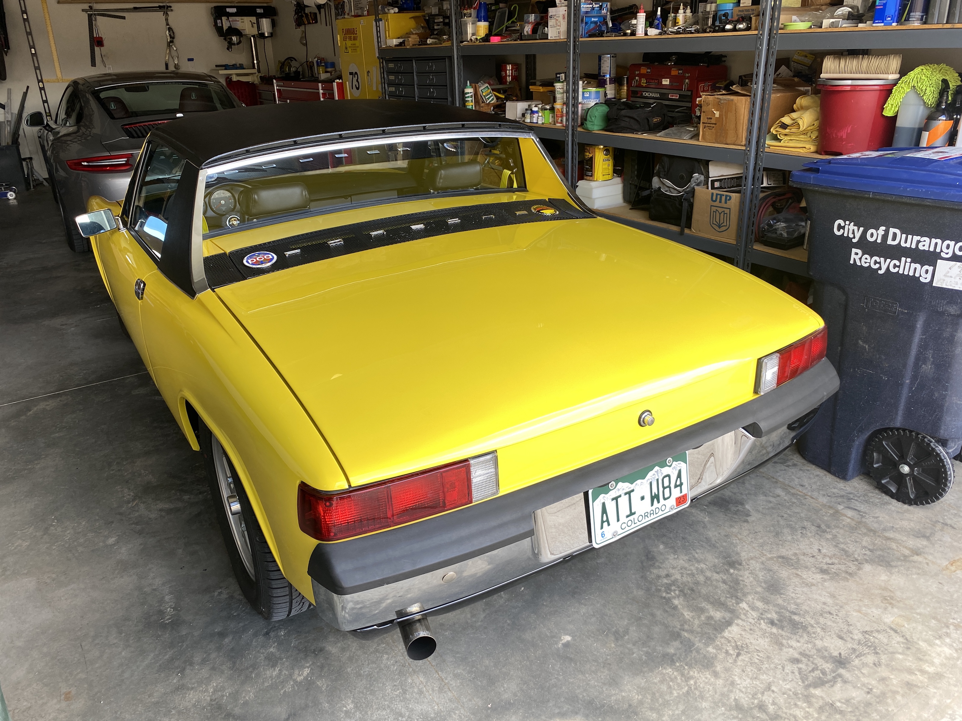

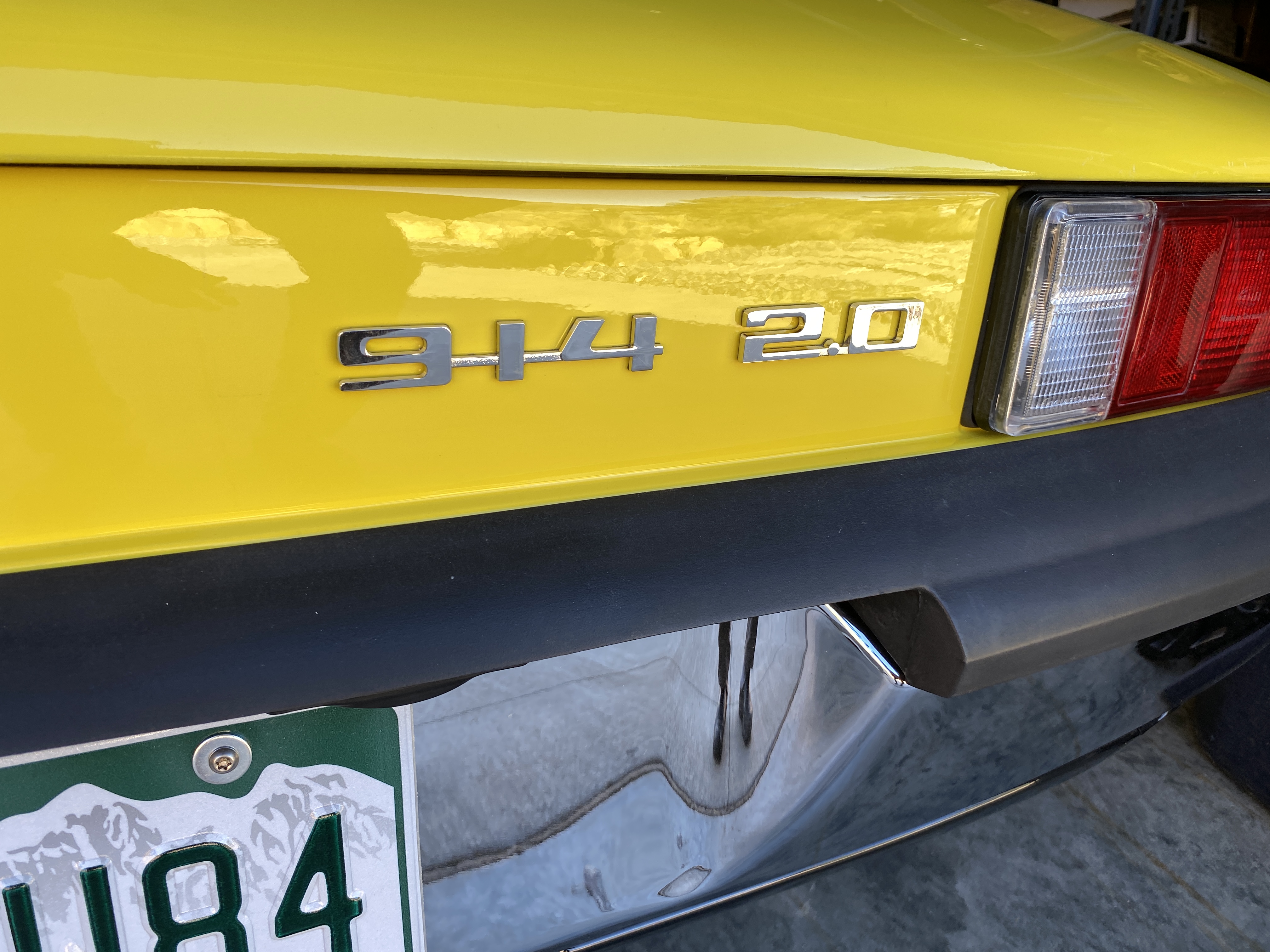

Final step: stick 'em on the car. It was a bit chilly today, so I used my heat gun to warm up the sheet metal first to encourage good adhesion.
bkrantz
post Oct 28 2022, 07:54 PM
Post #5918
Posts: 8,342
Joined: 3-August 19
From: SW Colorado
Member No.: 23,343

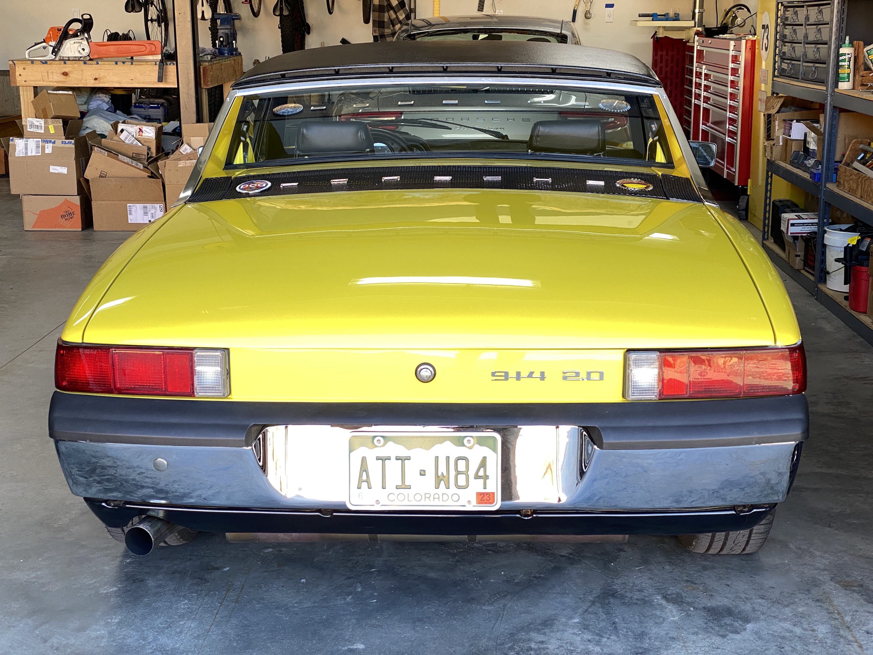

Wide view.
bkrantz
post Oct 28 2022, 07:55 PM
Post #5919
Posts: 8,342
Joined: 3-August 19
From: SW Colorado
Member No.: 23,343
I know the obvious choice for a yellow car is black insignia, but chrome fits my vision.

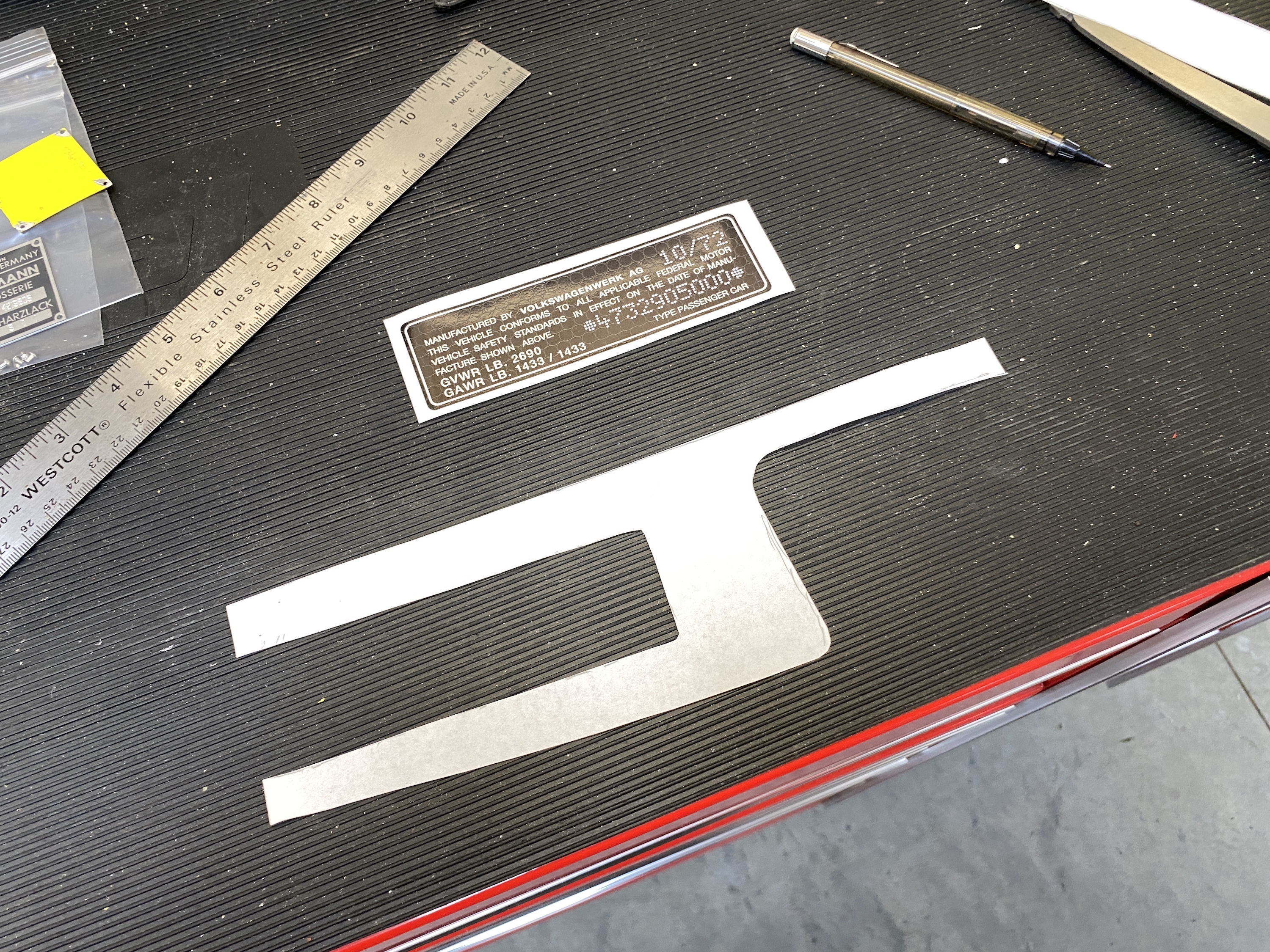

Next, I tackled the build sticker. I made the paper template from the original on the door jamb.
