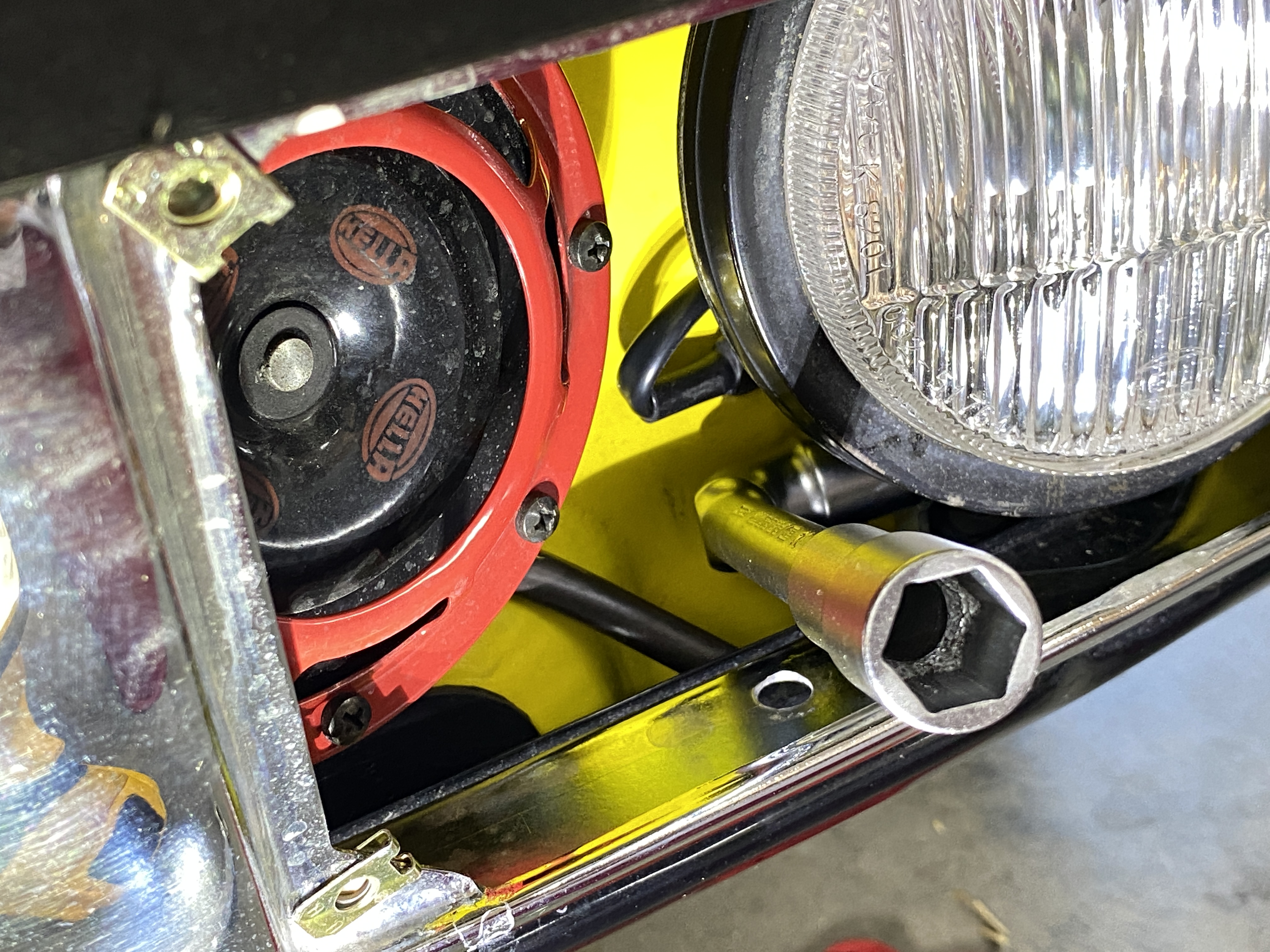

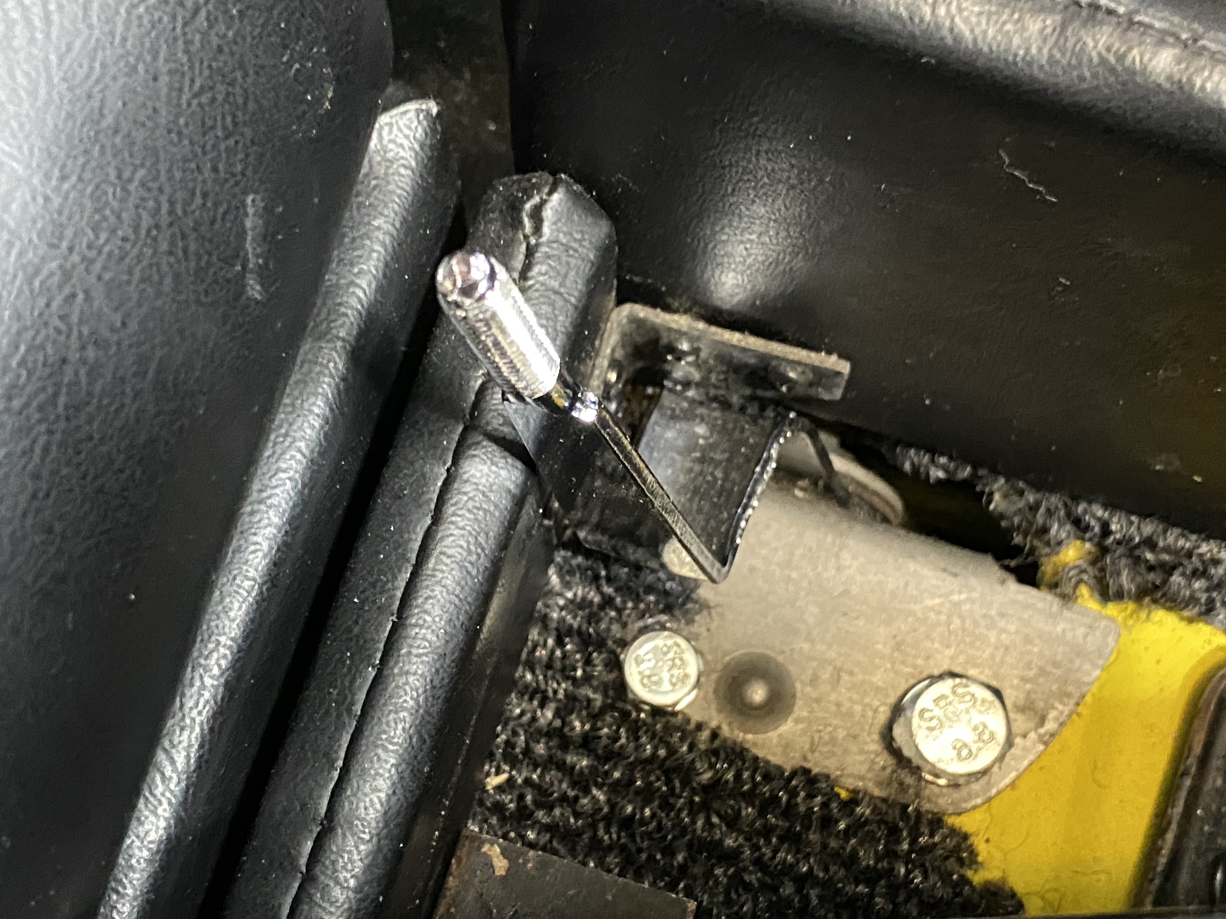

The angle and offset is perfect! I made the nut up tight in 30 sec.

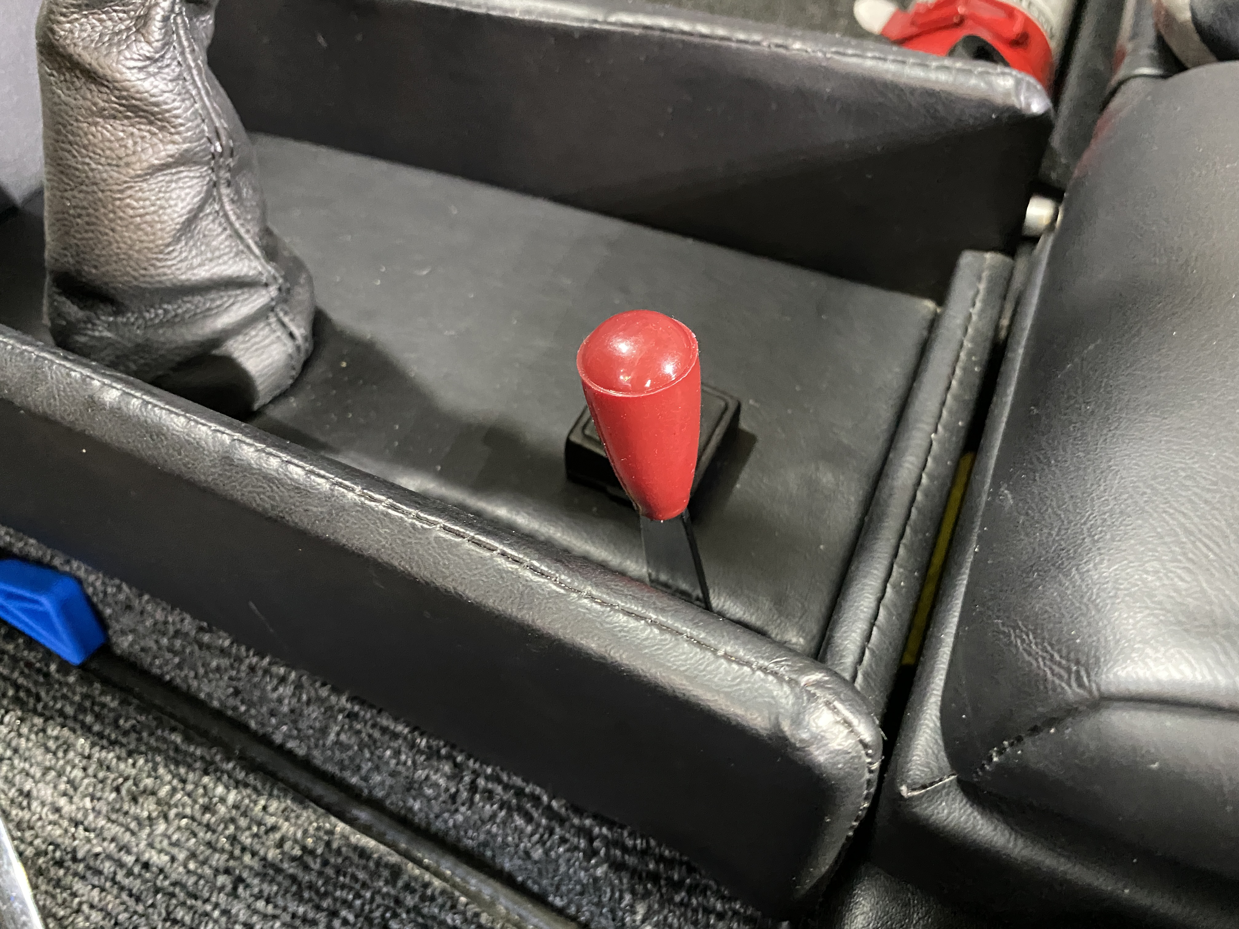

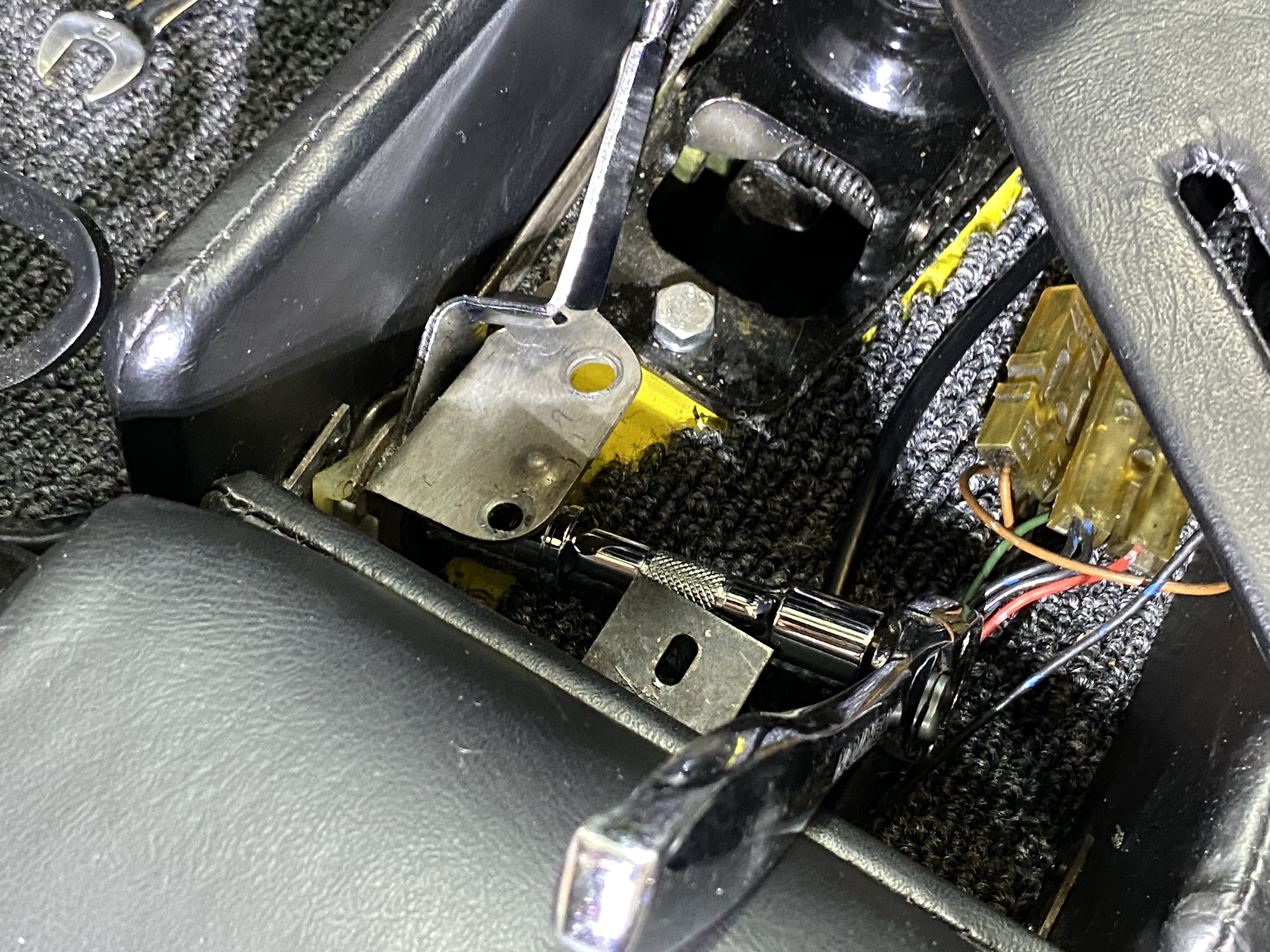

Next, another problem with something loose, in this case the heat duct control lever. If I place it half-way, it falls down to closed. Even all the way up (open), it drops down when driving.
bkrantz
post Oct 31 2022, 07:45 PM
Post #5944
Posts: 8,342
Joined: 3-August 19
From: SW Colorado
Member No.: 23,343

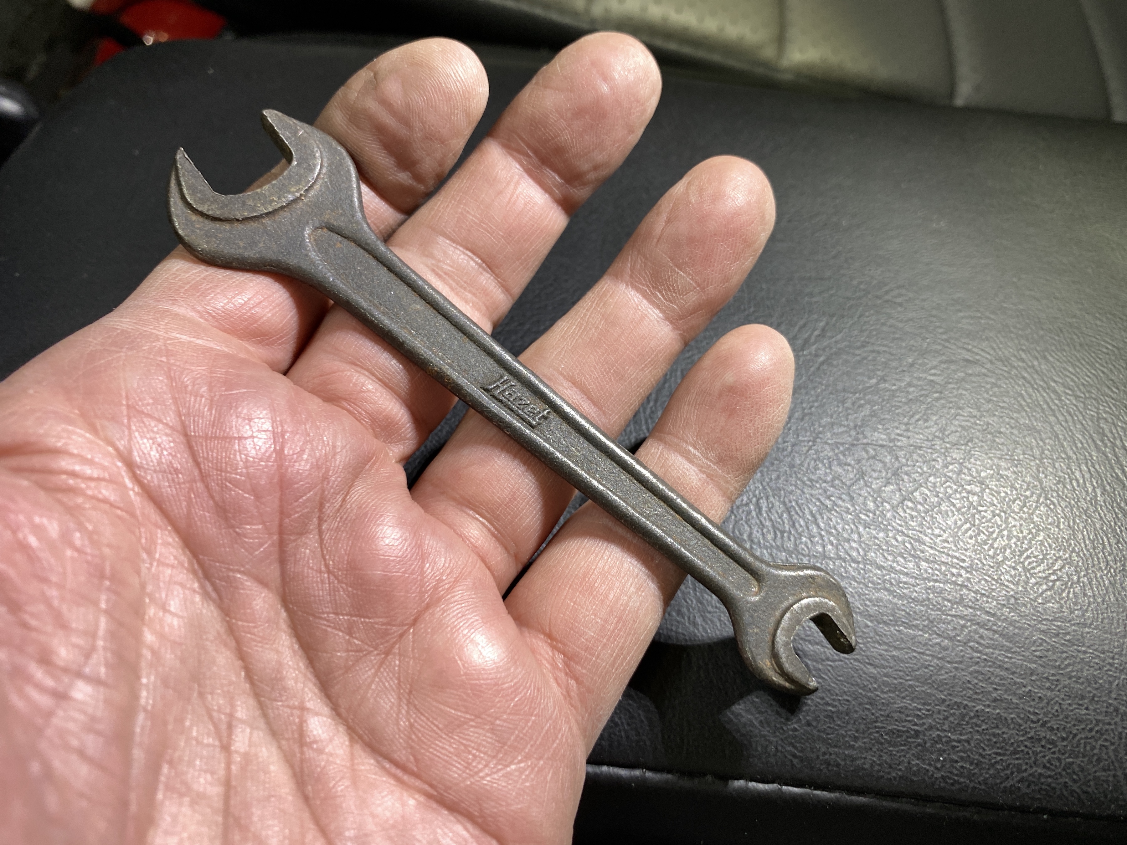

Time for another special tool, this one from the back of the tool chest: a vintage Hazet wrench from an old 914 tool kit. The head on the 13 mm end is thinner than any other wrench I own.
bkrantz
post Oct 31 2022, 07:50 PM
Post #5945
Posts: 8,342
Joined: 3-August 19
From: SW Colorado
Member No.: 23,343
That was just thin enough to hold the nut on the outside of the pivot bolt, with a socket on the bolt head. It took a couple of attempts to get the tightness just right.
bkrantz
post Oct 31 2022, 07:52 PM
Post #5946
Posts: 8,342
Joined: 3-August 19
From: SW Colorado
Member No.: 23,343
Success--maybe. The pivot bolt is tight enough to hold the lever in the middle, against the tension of the heat duct valve cables.

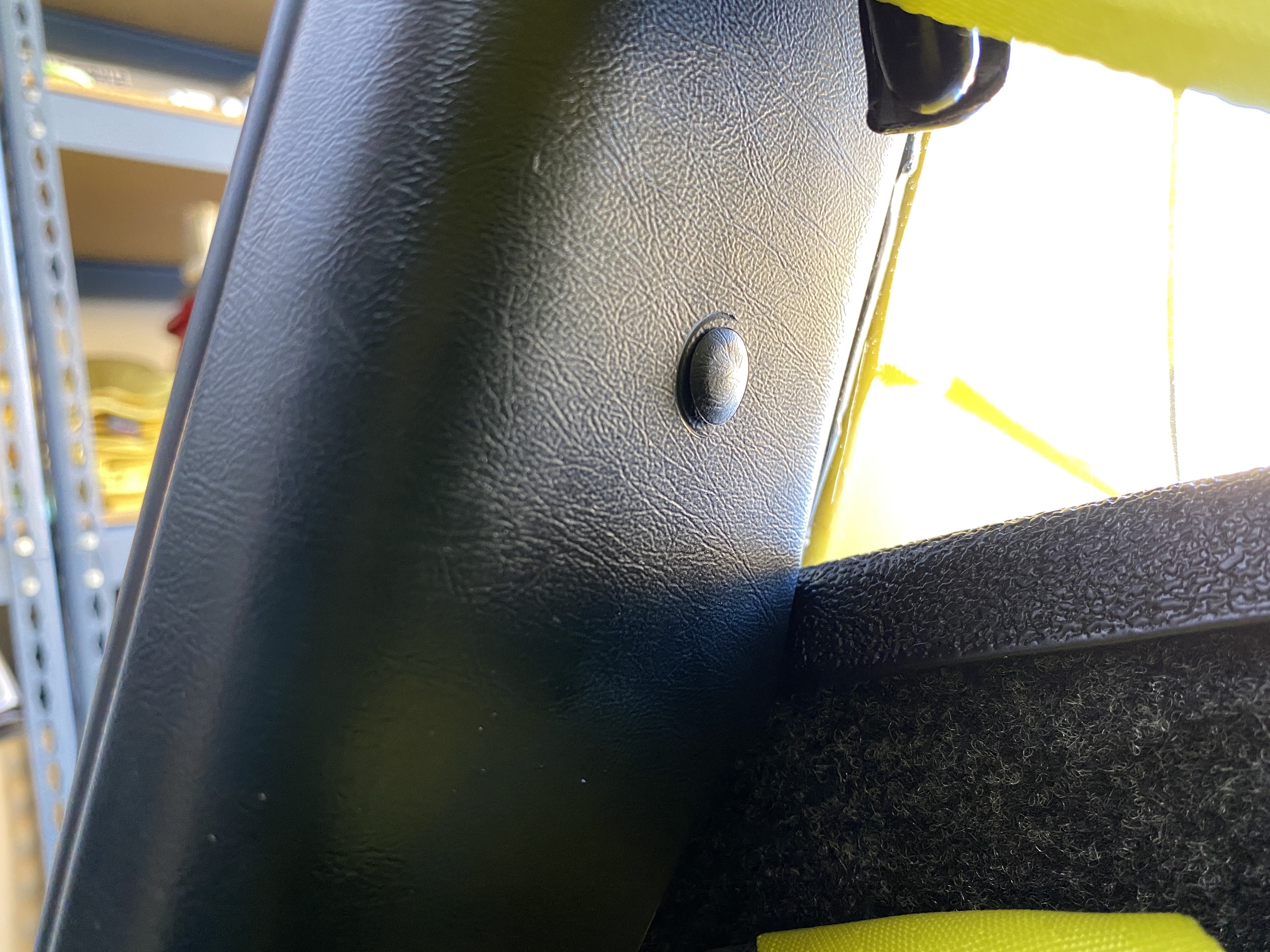

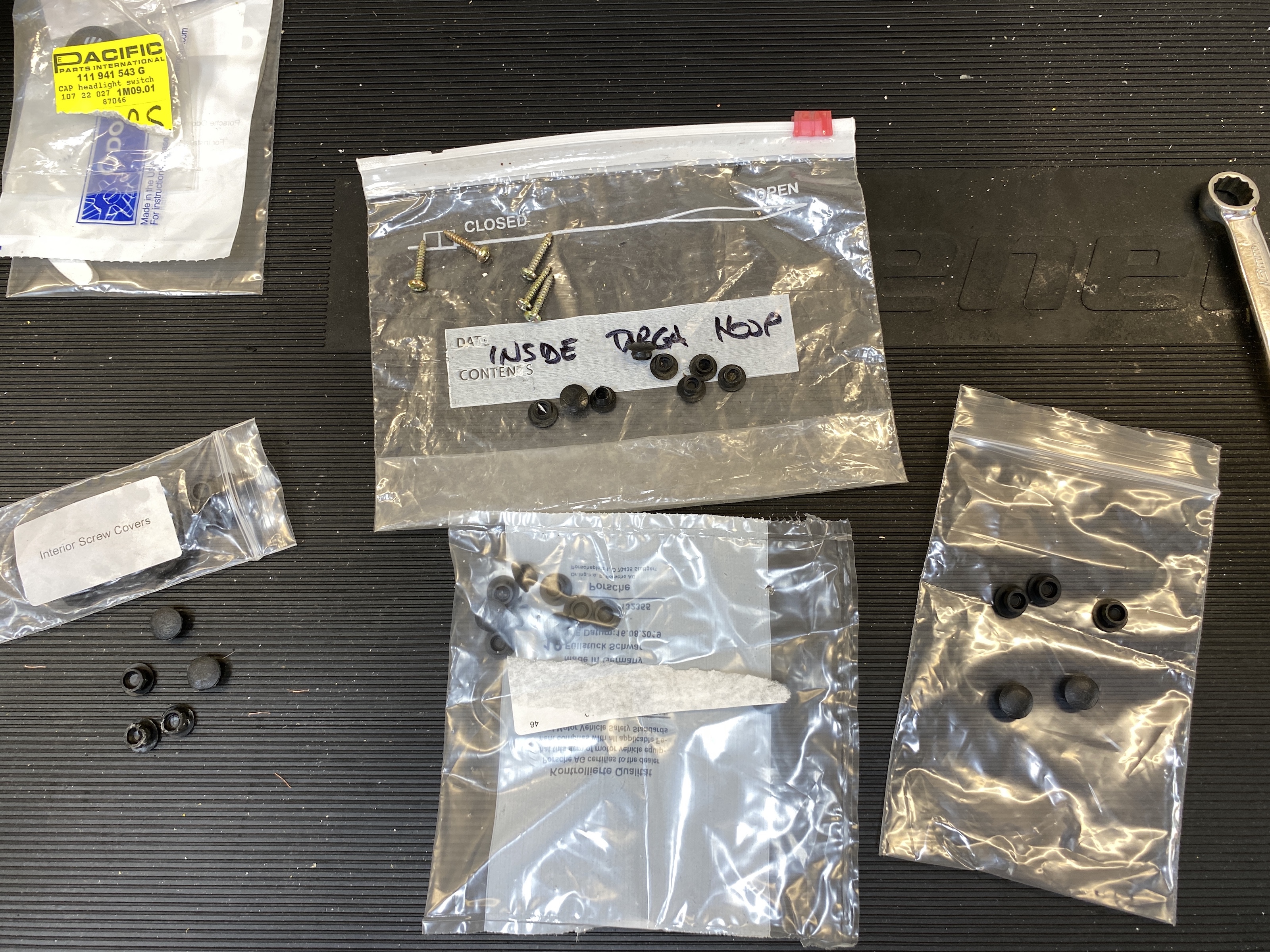

Last job today: filling all the interior trim screw holes with plugs.
bkrantz
post Oct 31 2022, 07:56 PM
Post #5948
Posts: 8,342
Joined: 3-August 19
From: SW Colorado
Member No.: 23,343
Here's my collection of plugs. The ones in the top center are the few I rescued from the car, and feel like hard plastic. Replacements are on the left, lower center, and right.
bkrantz
post Oct 31 2022, 07:59 PM
Post #5949
Posts: 8,342
Joined: 3-August 19
From: SW Colorado
Member No.: 23,343

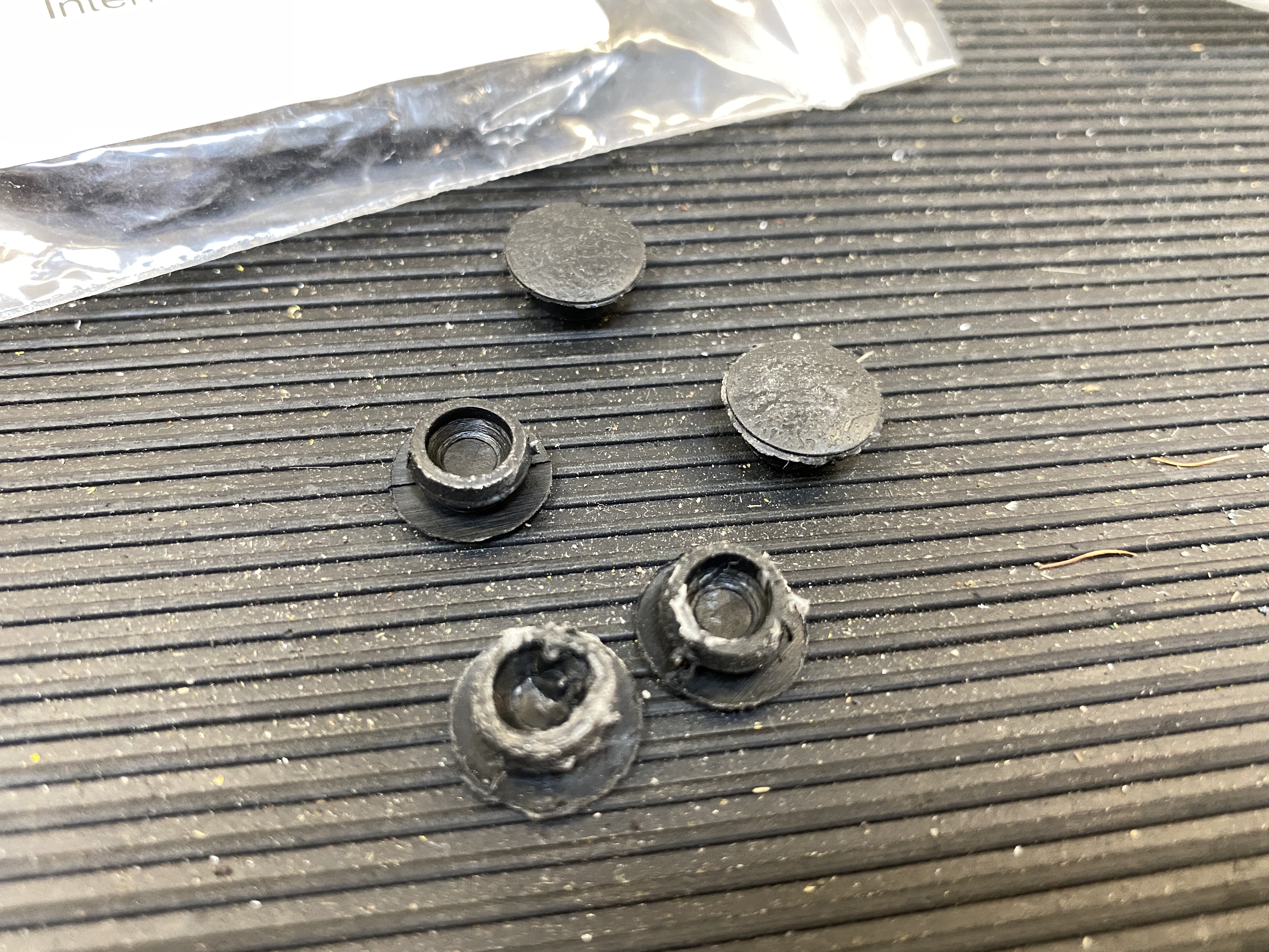

The first replacements I tried a few months ago feel like soft rubber, and I did not have much luck getting them in the trim holes without mangling them. I then ordered what are supposed to be factory plugs. They also feel like rubber, but much stiffer.
bkrantz
post Oct 31 2022, 08:01 PM
Post #5950
Posts: 8,342
Joined: 3-August 19
From: SW Colorado
Member No.: 23,343

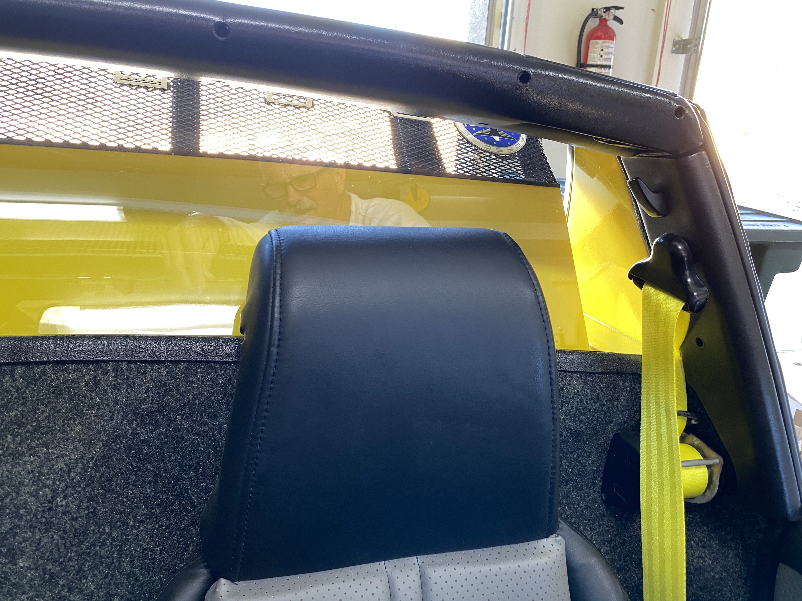

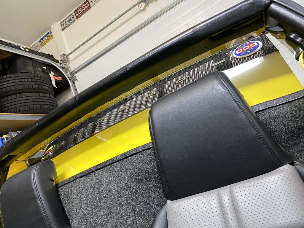

Pretty easy to plug all the holes, inside the targa hoop and along the A-pillars.
bkrantz
post Oct 31 2022, 08:02 PM
Post #5951
Posts: 8,342
Joined: 3-August 19
From: SW Colorado
Member No.: 23,343
All done, but...

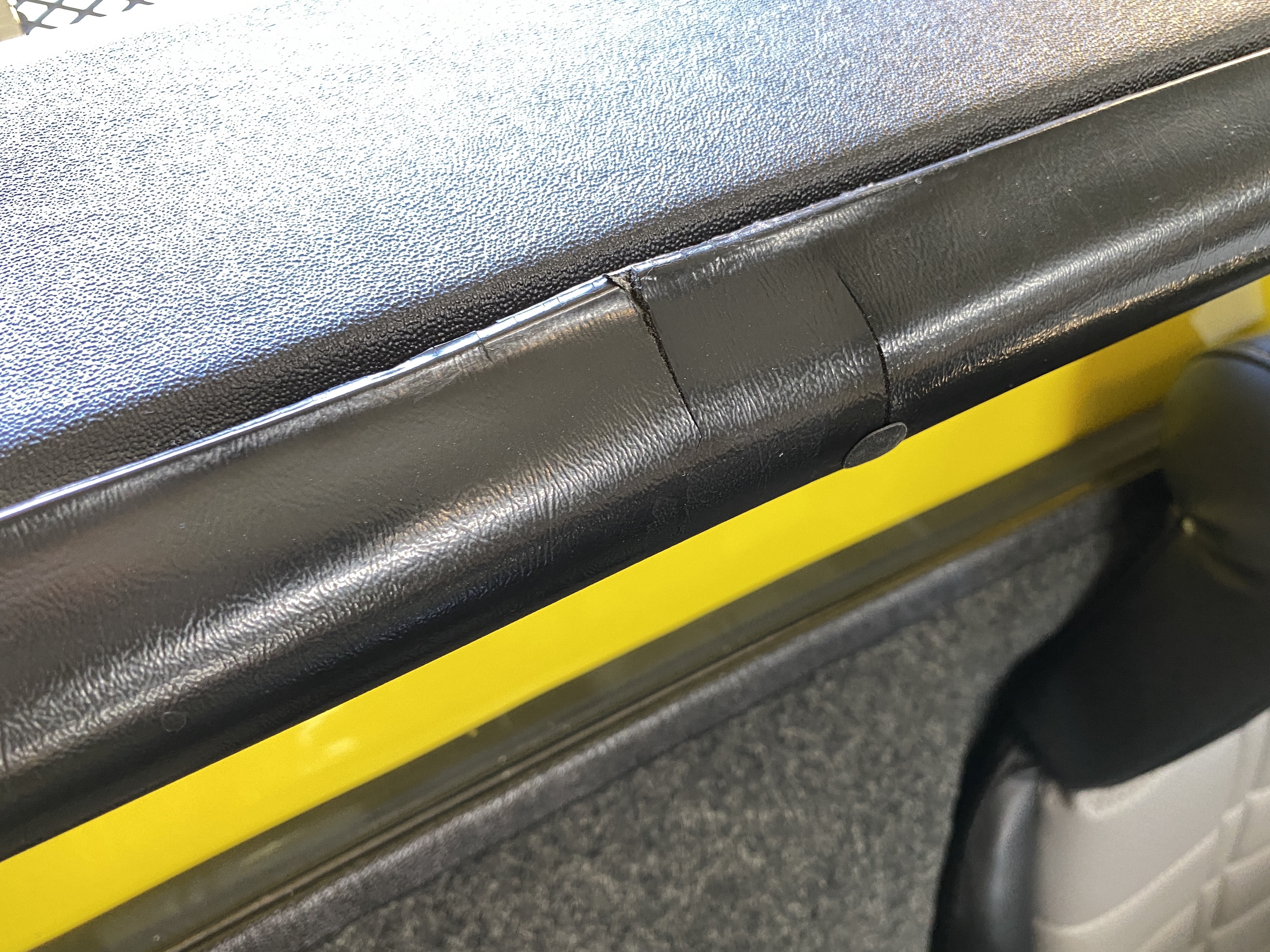

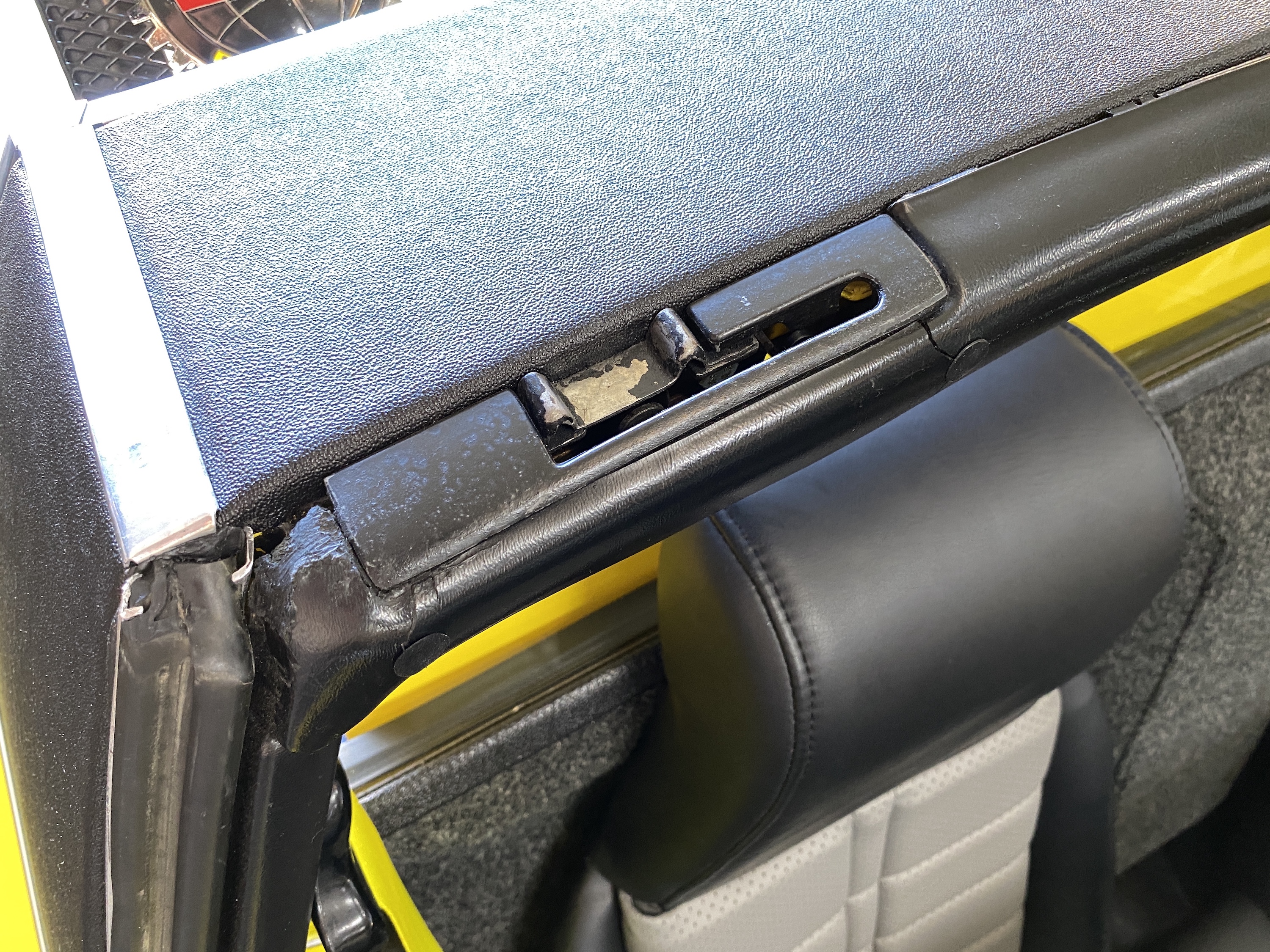

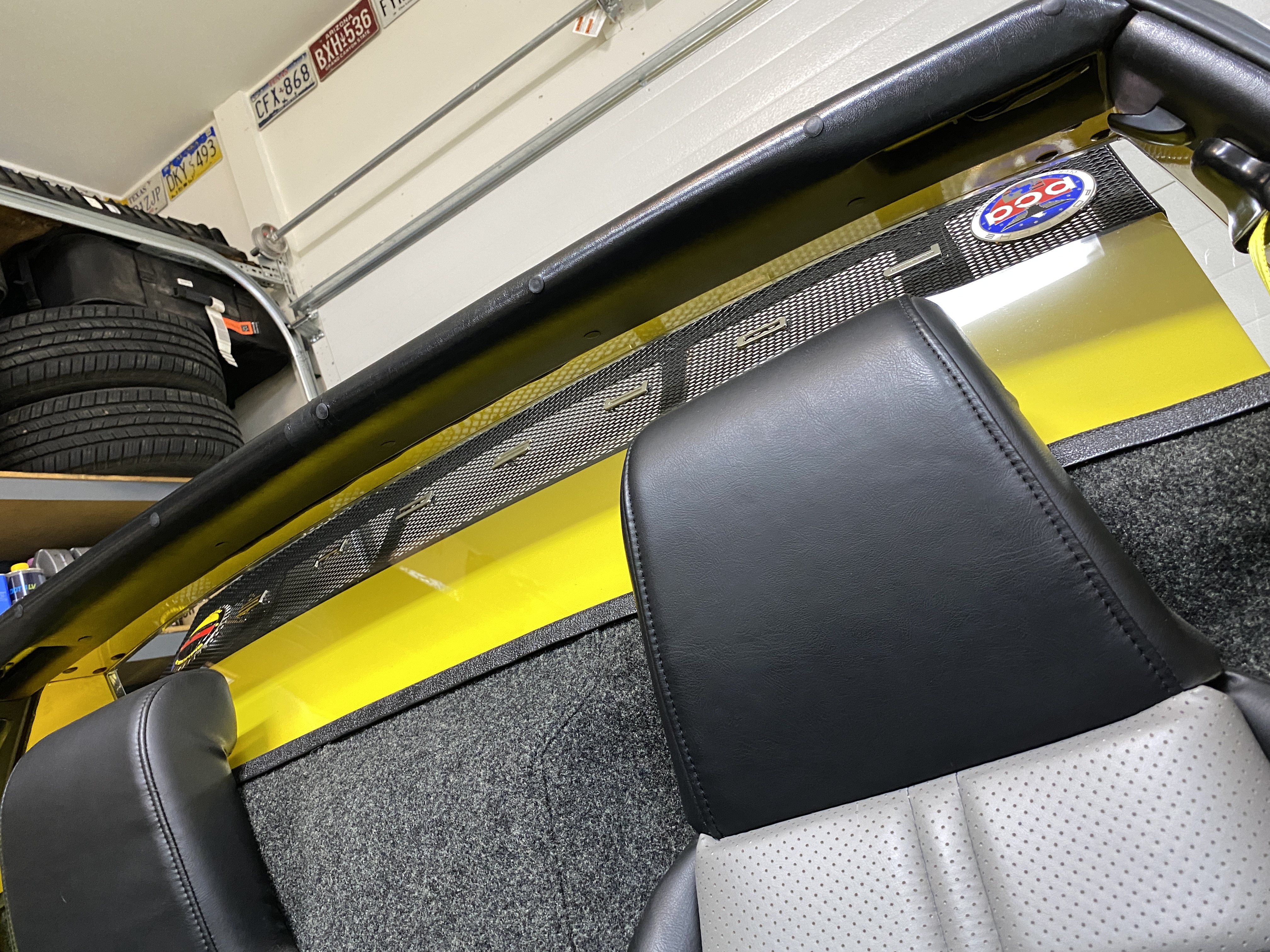

Working with the the targa trim pad reminded me that I really want a new one. The center has a couple of cracks.
bkrantz
post Oct 31 2022, 08:04 PM
Post #5953
Posts: 8,342
Joined: 3-August 19
From: SW Colorado
Member No.: 23,343
And the right end is pretty mangled.
