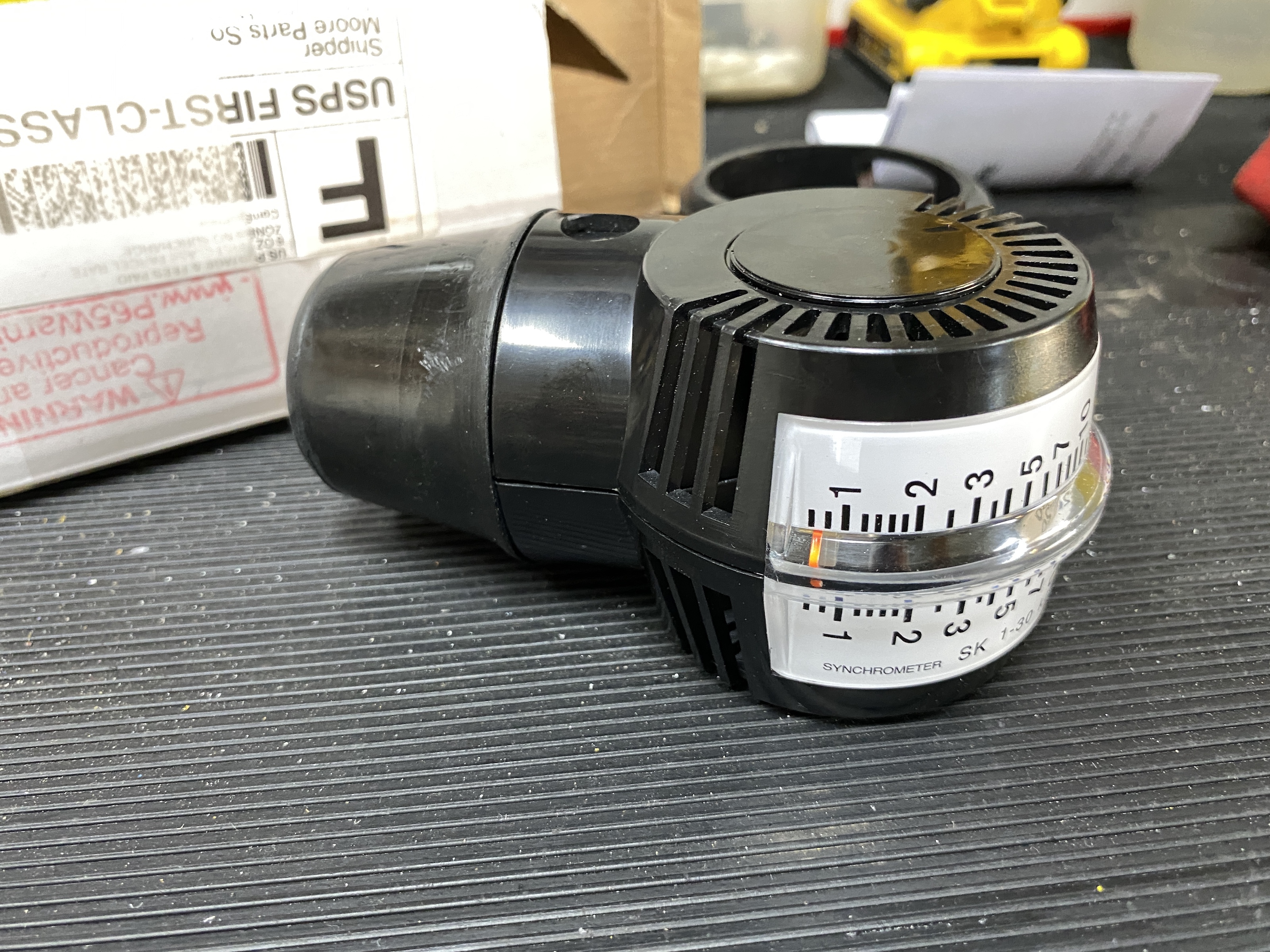

When I got home I got out my Empi synchronizer tool.

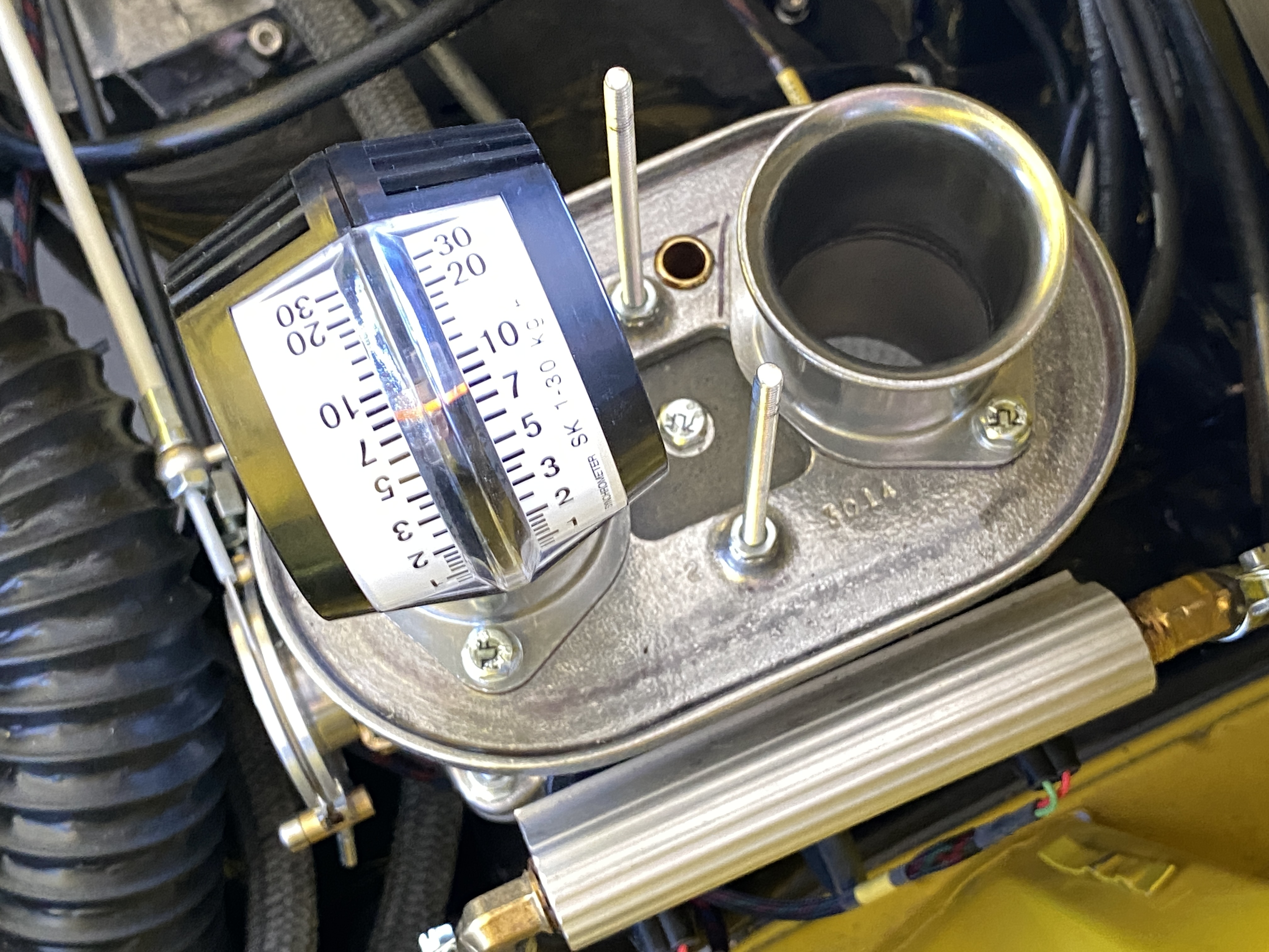

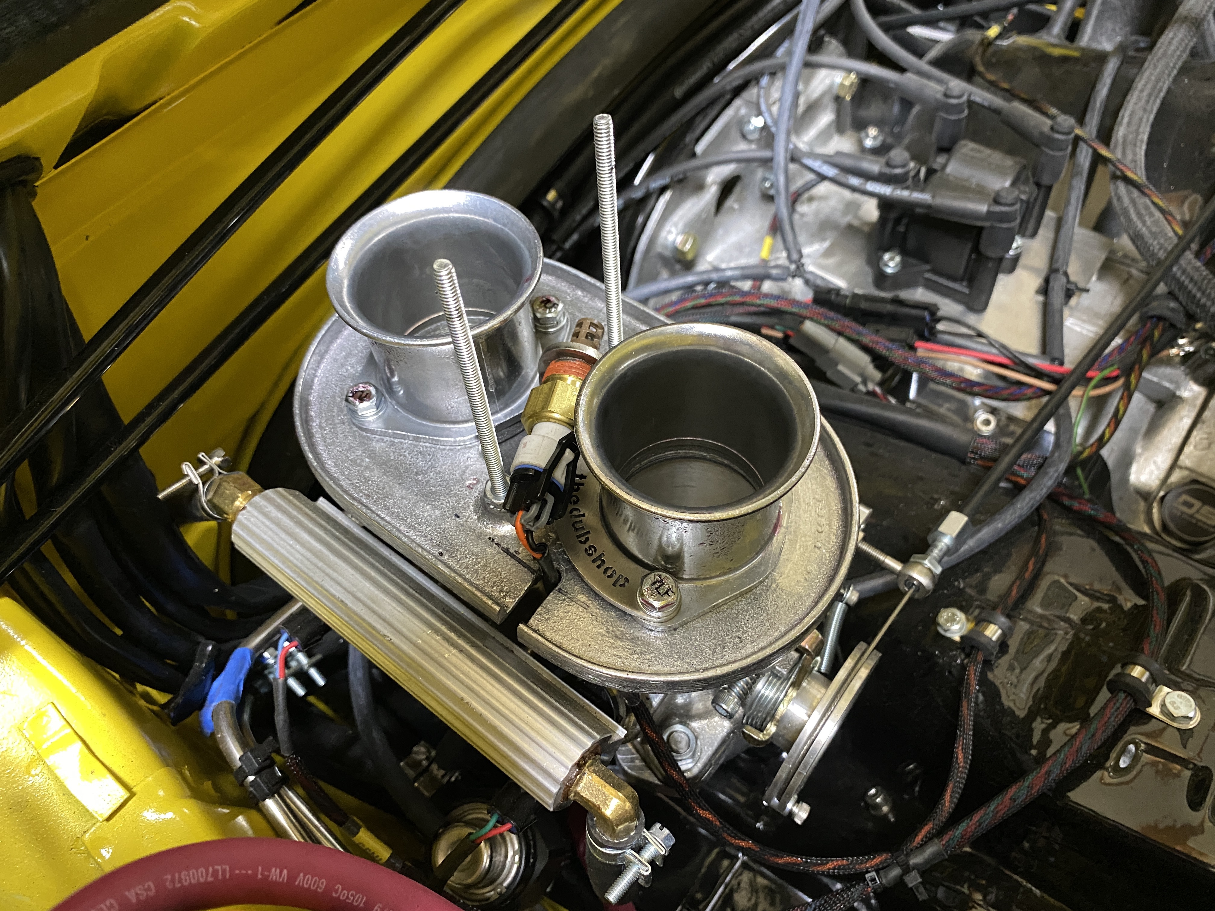

While the engine was warm, I checked the airflow in the dual ITBs. The right side was a tiny bit higher, and I closed the idle just a bit.

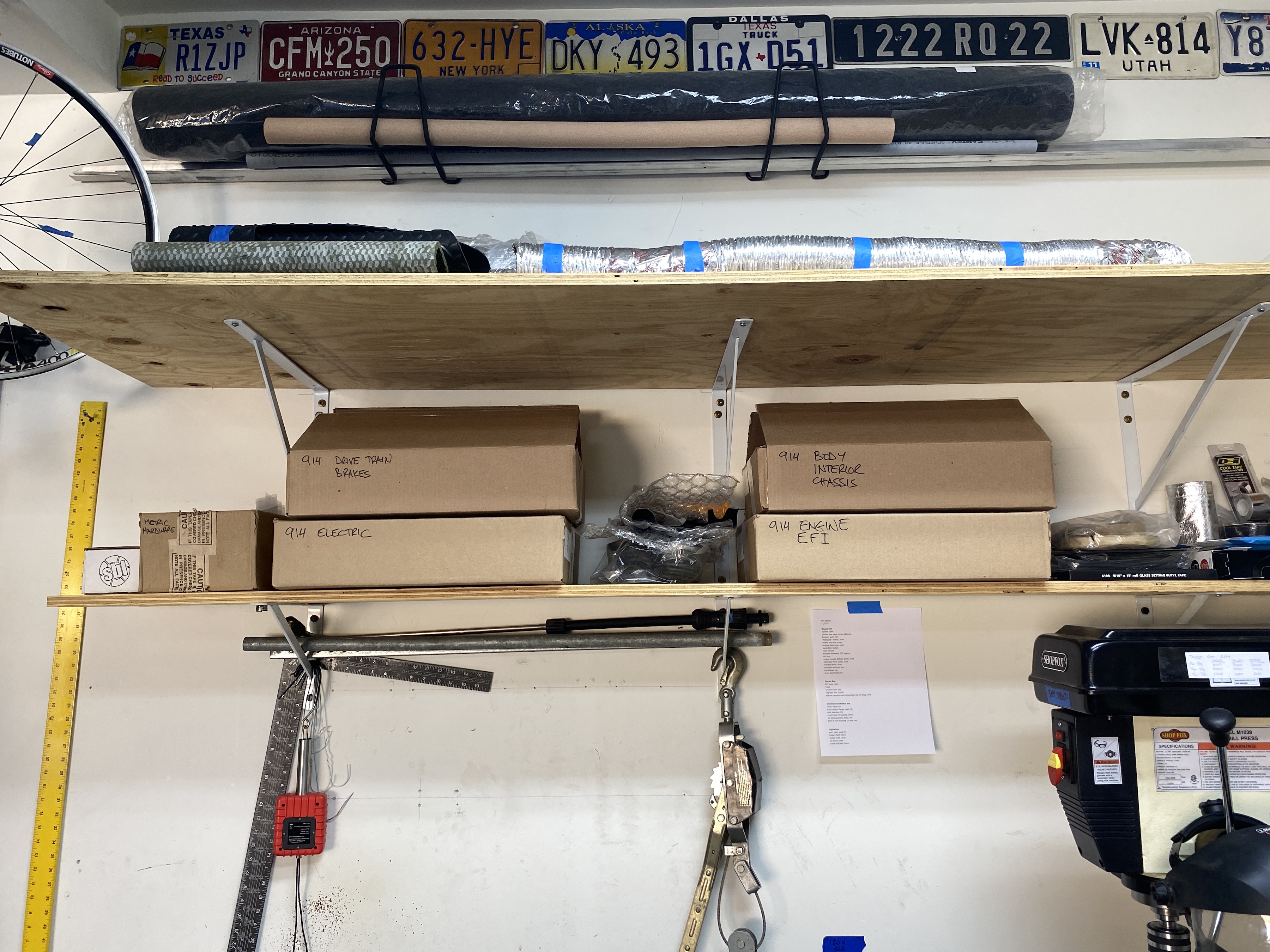

I did have a chance to organize things a bit. These 4 boxes now contain all my 914 spares, not including some oil filters. Quite a bit smaller than the dozens of large and small boxes I had before, plus stuff spread around the garage.
Did I overdo it?

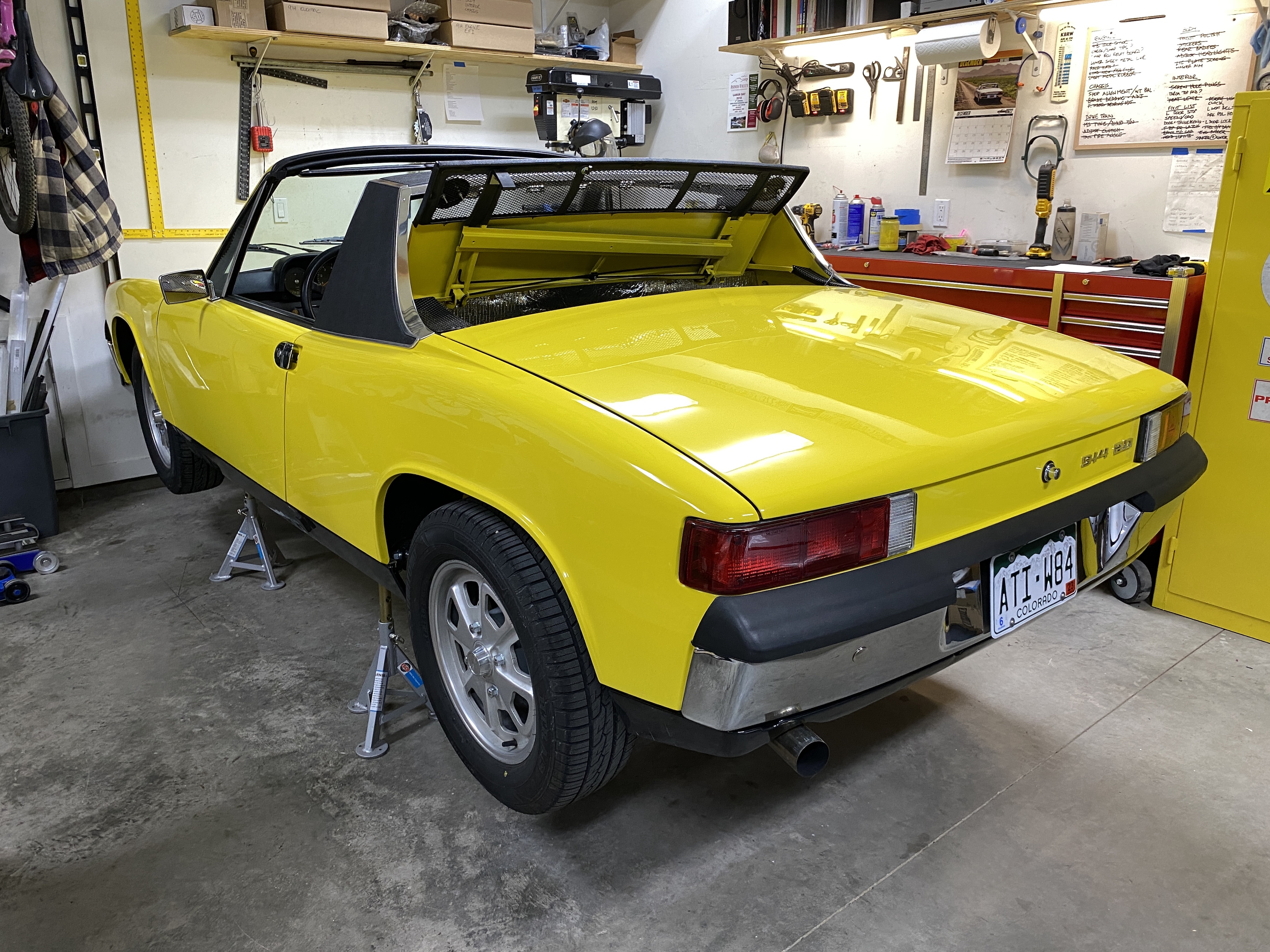

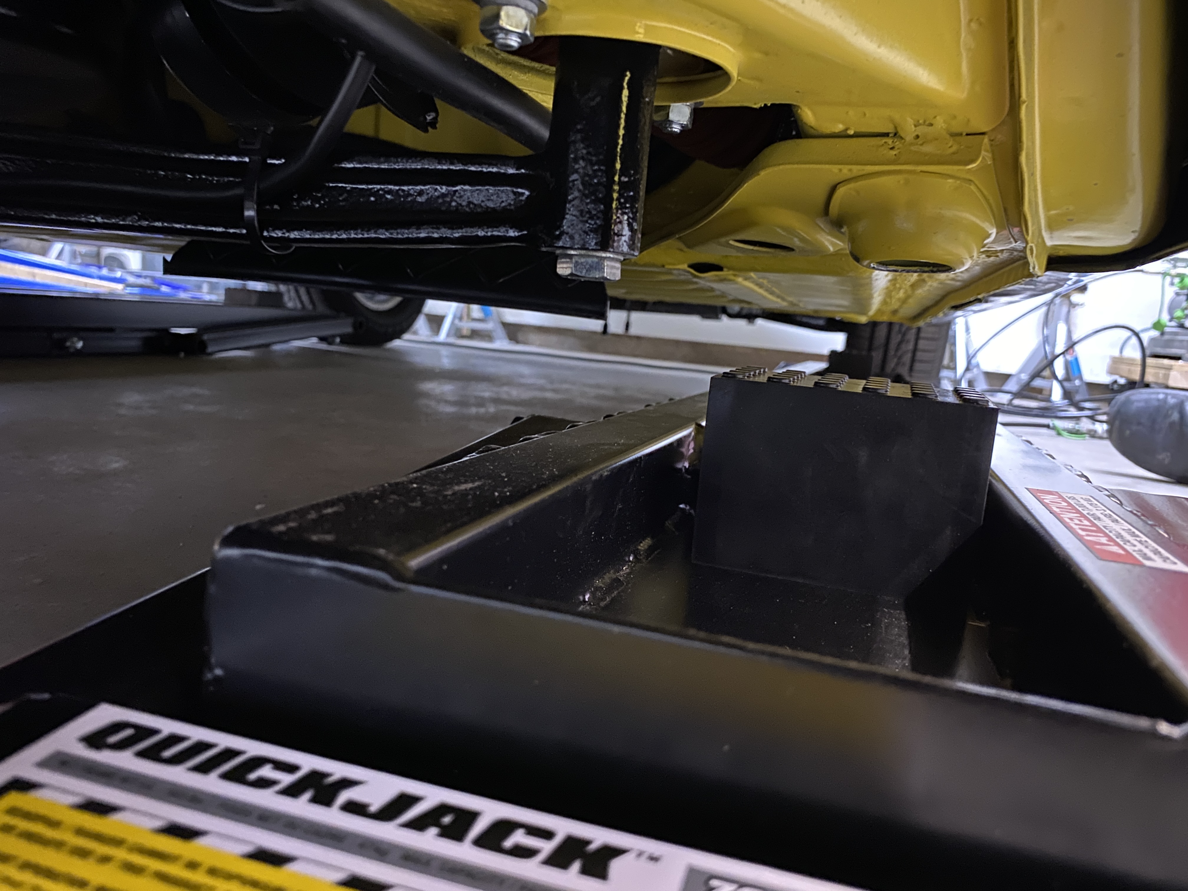

I recently got Quickjack 7000TLX. I chose the longer X model in order to reach the jack points on my wife's MB E400 Wagon. In the past weeks I have used it to change wheels and tires on the E400, my 991, and my 3/4 ton Suburban. It worked great for al of these, and way easier than using a floor jack.
But I struck out with my 914, at least trying to use the stock jack points. See the new thread I created the shows the misfit.
And given that I want to drop the engine, the Quickjacks seem too wide and will not allow the front cross bar to clear.

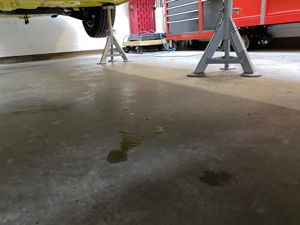

So, back to using jack stands. This is as high as I can get with my floor jack without getting creative (the same height when I installed the engine the first time).

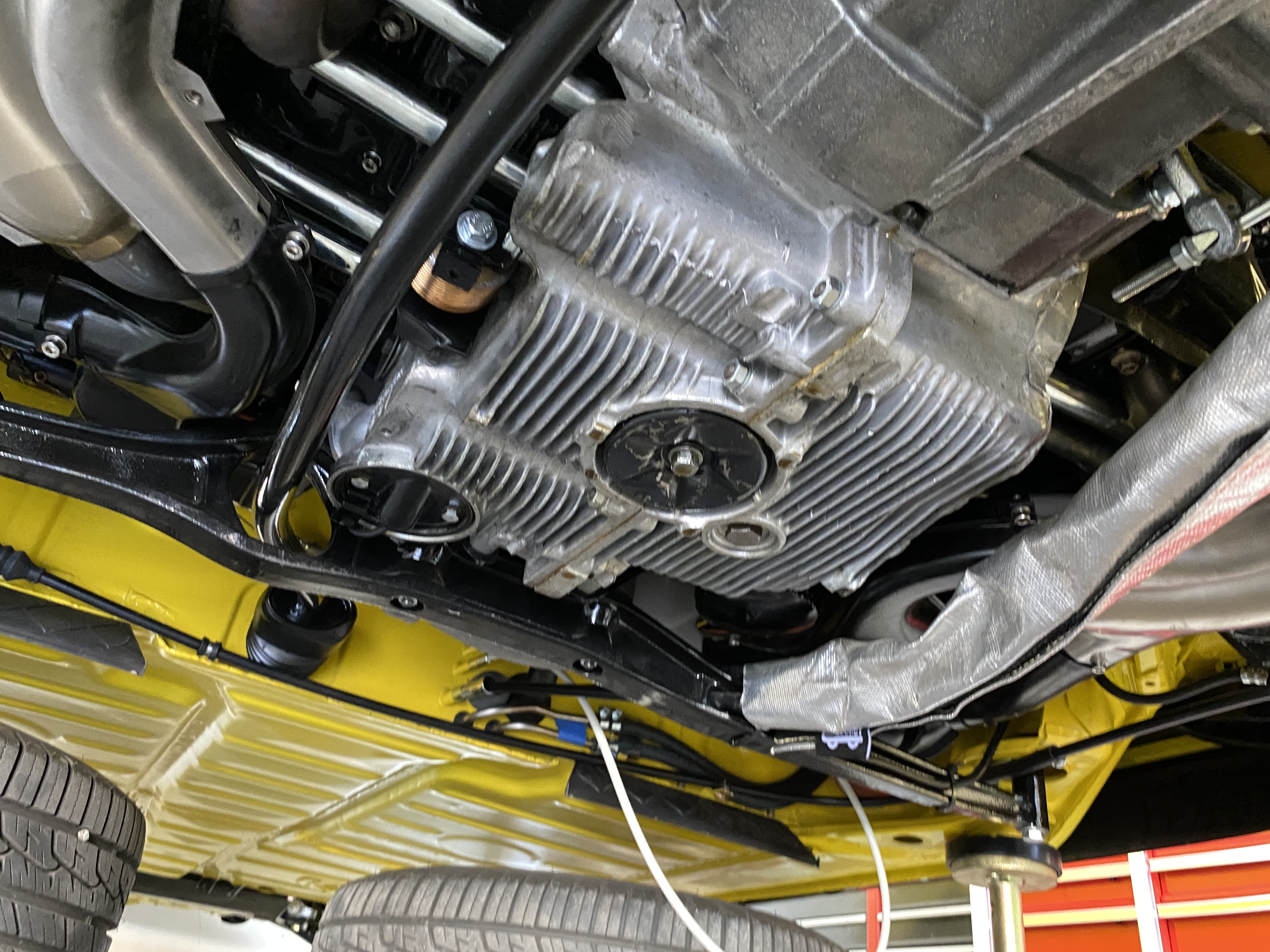

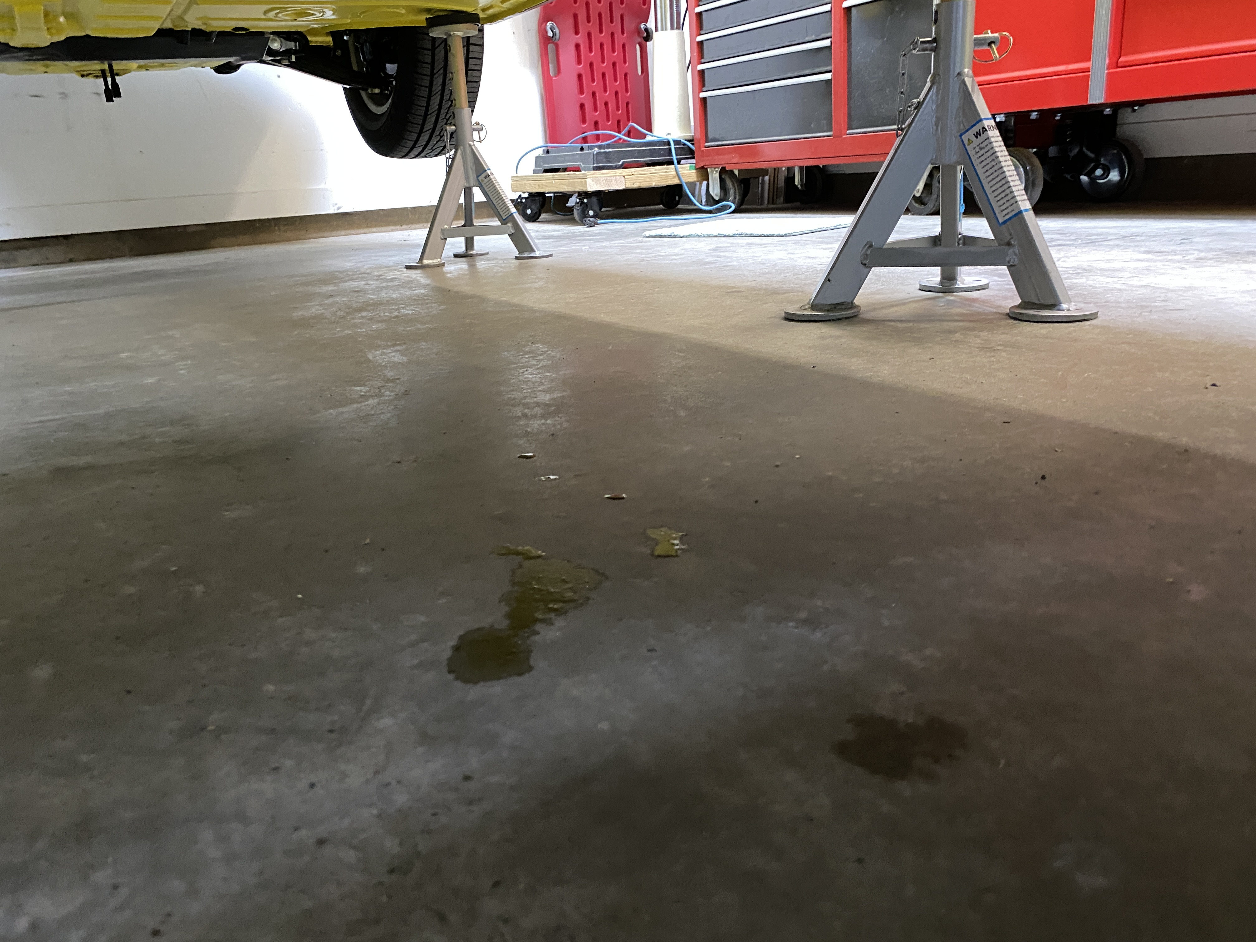

Here's part of the reason for dropping the engine: more than a few drips of oil, coming from the front of the case.

QUOTE(bkrantz @ Dec 12 2022, 09:31 PM) *
Keep us posted with your search/fix of the oil leak at the front of your new engine. they can be pesky to repair
bkrantz
post Dec 13 2022, 08:14 PM
Post #5975
Posts: 8,342
Joined: 3-August 19
From: SW Colorado
Member No.: 23,343
QUOTE(930cabman @ Dec 13 2022, 04:57 AM) *
Will do. I have a silly hope that the leak will be obvious when I get the engine out, and remove the blower housing. But realistically, I may just replace or reseal everything.

Have you tried turning the quickjack sideways? If the lifting frames won’t fit between the tires, you may be able to run them underneath the car. I’ve seen people do that, but I’d call BendPak and confirm its safe first.
Hoping the culprit will show it's face quickly/easily. Crank seal/oil cooler or seal/soft plugs/oil pump gasket/oil pressure sender or threads and perhaps other possible locations.

I got started today dropping the engine. Exactly a year ago I put the engine in.
Here's a view of the engine bottom, with oil dripping off most surfaces.
