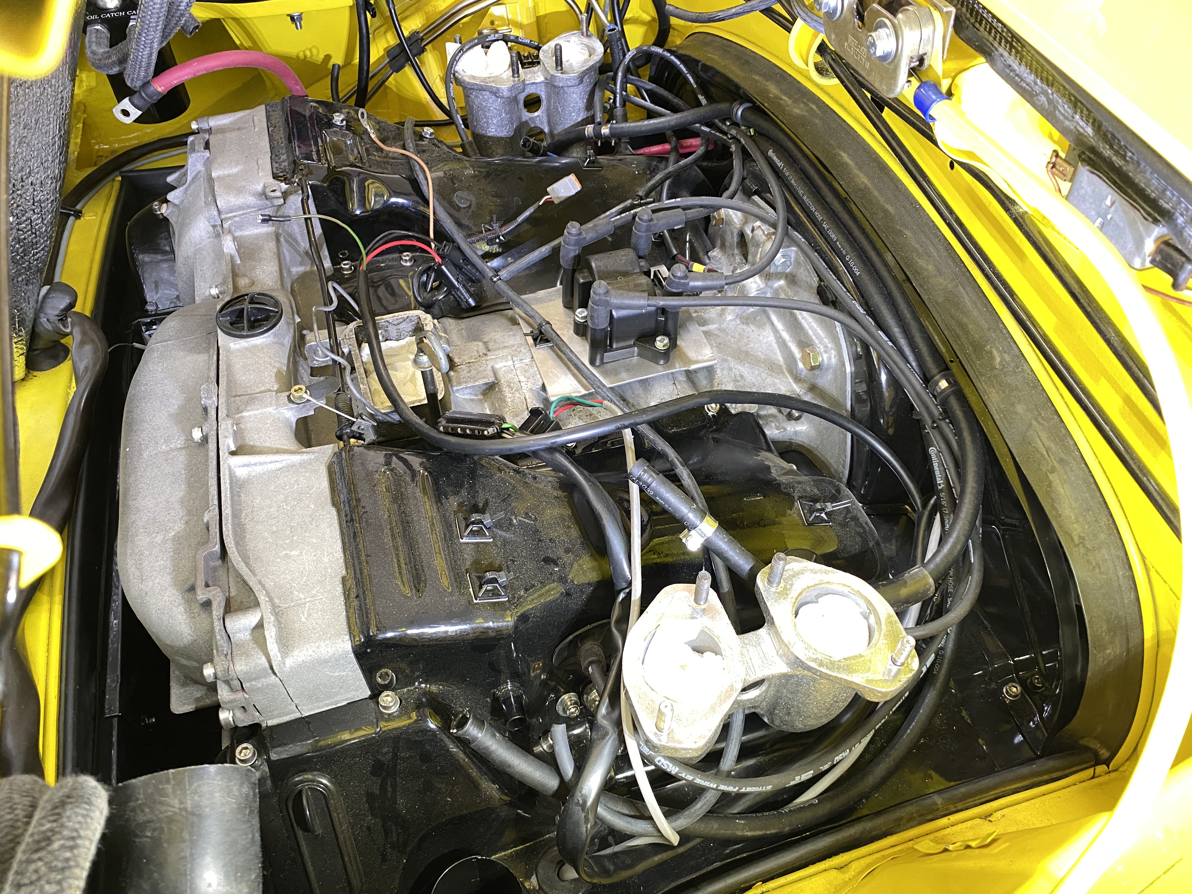

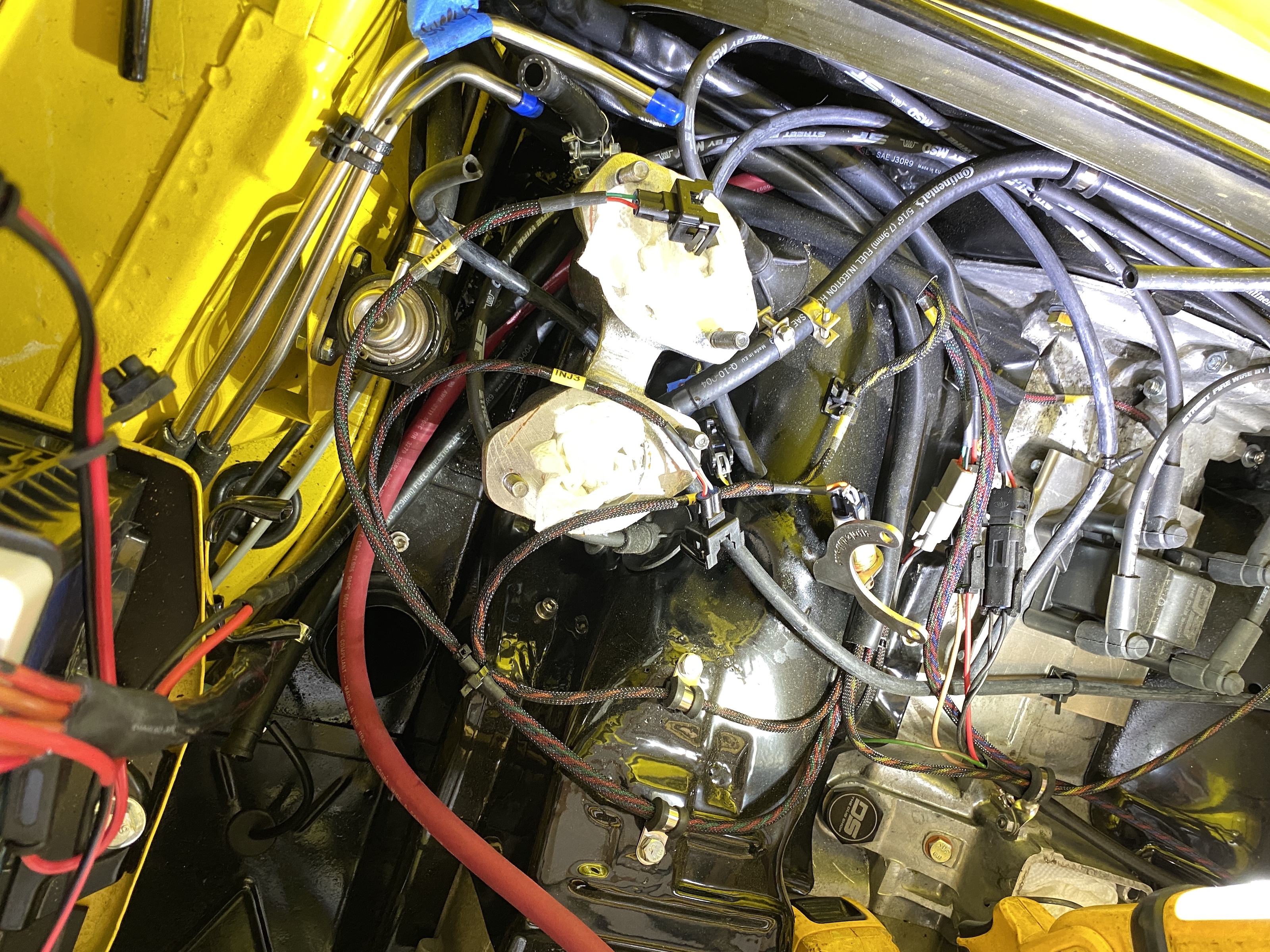

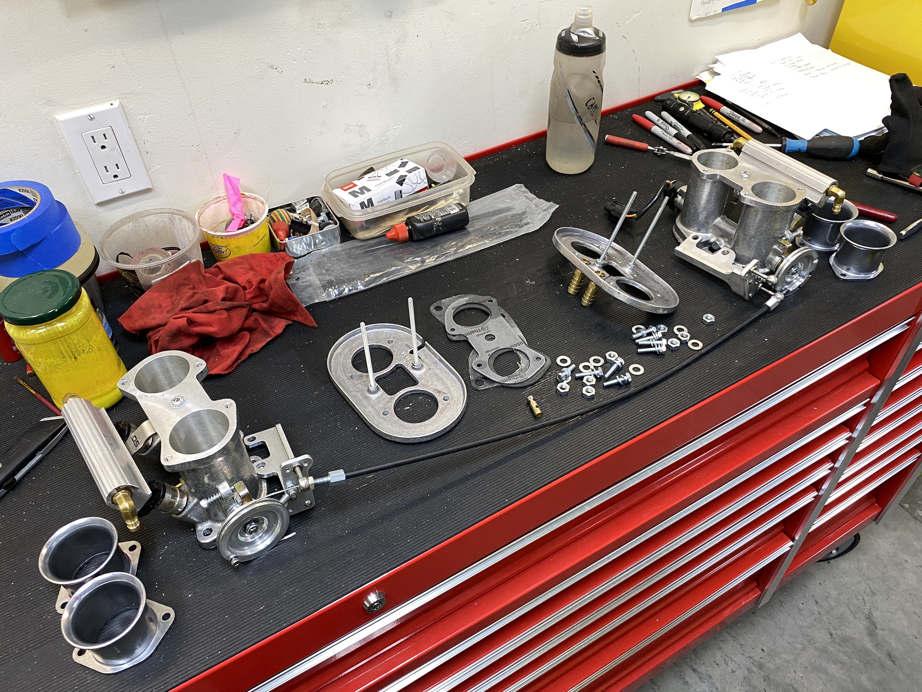

ITBs and cables out.
bkrantz
post Dec 16 2022, 08:45 PM
Post #5982
Posts: 8,342
Joined: 3-August 19
From: SW Colorado
Member No.: 23,343
Working on getting all the EFI cables disconnected.
bkrantz
post Dec 16 2022, 08:46 PM
Post #5983
Posts: 8,342
Joined: 3-August 19
From: SW Colorado
Member No.: 23,343
Wires, cables, fuel lines, and other things cleared from the top.

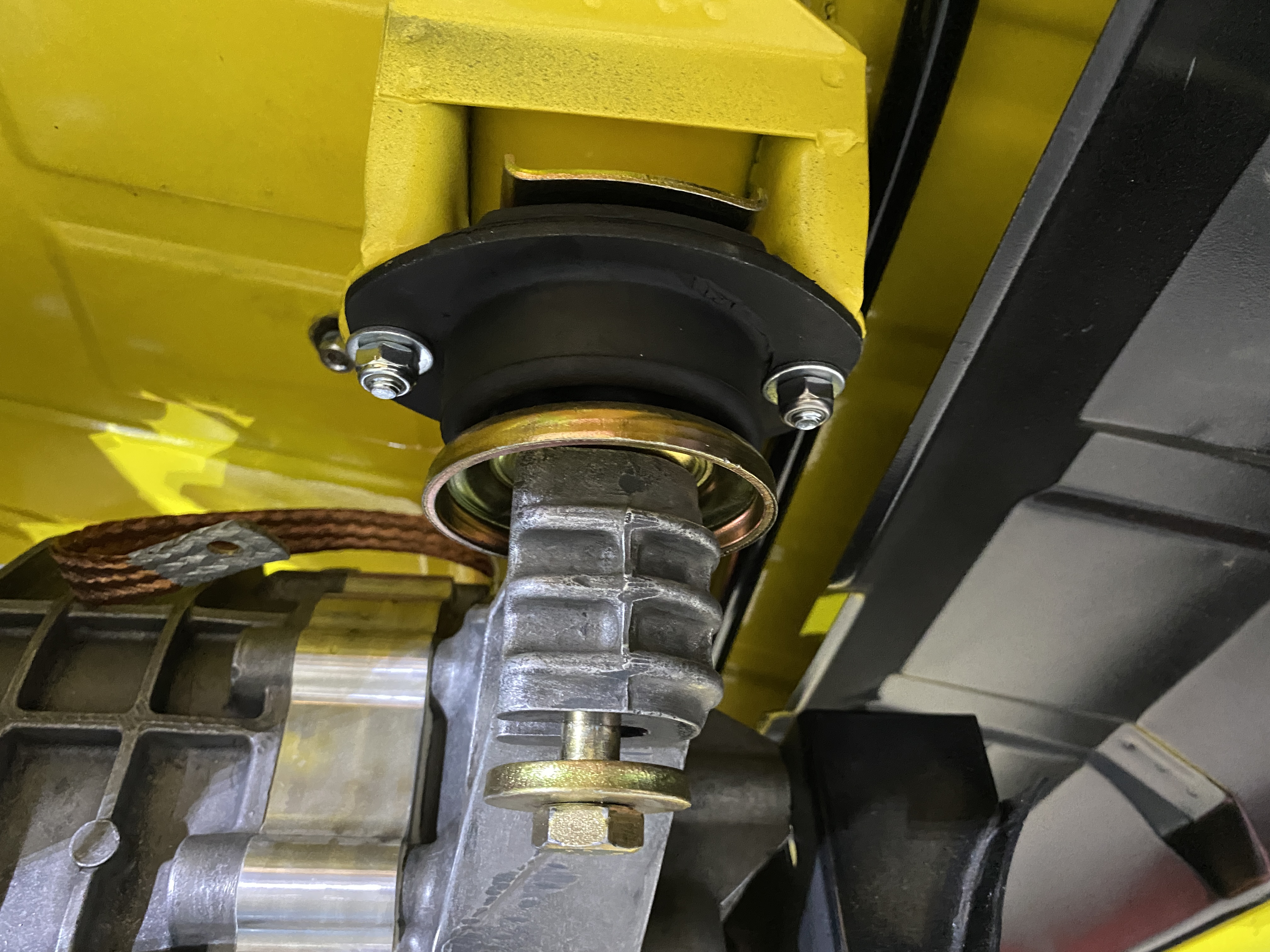

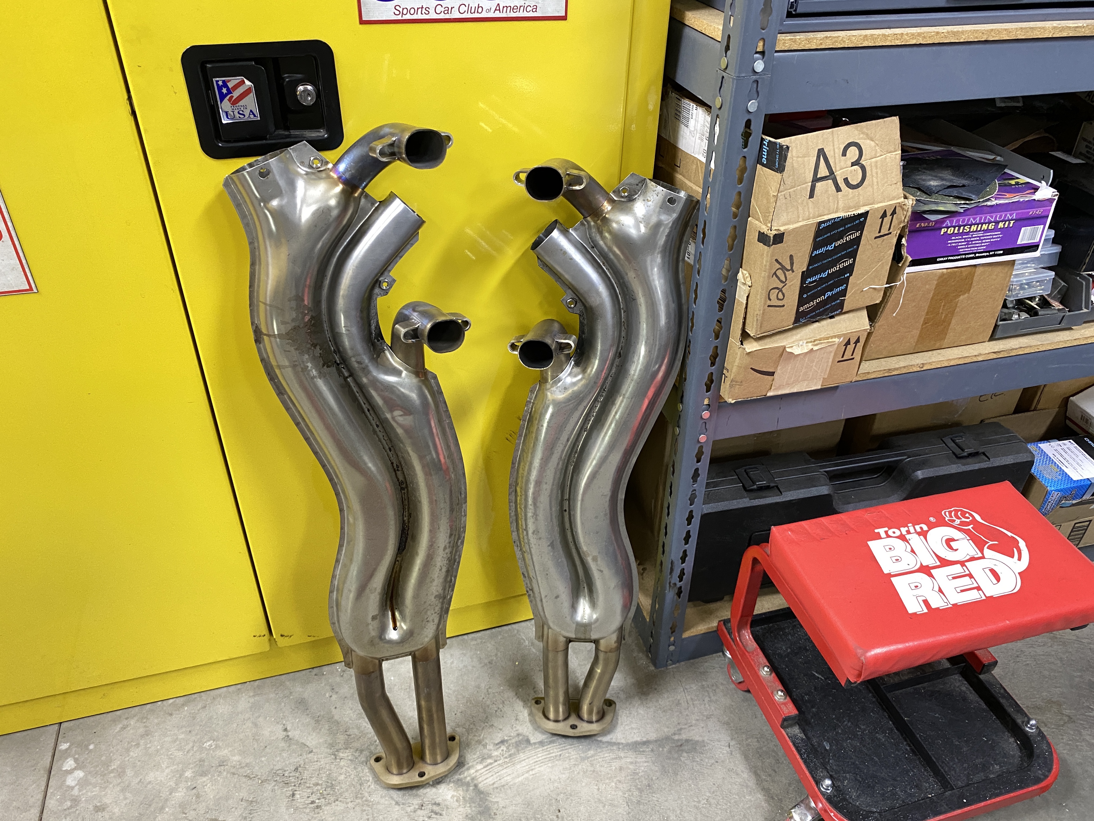

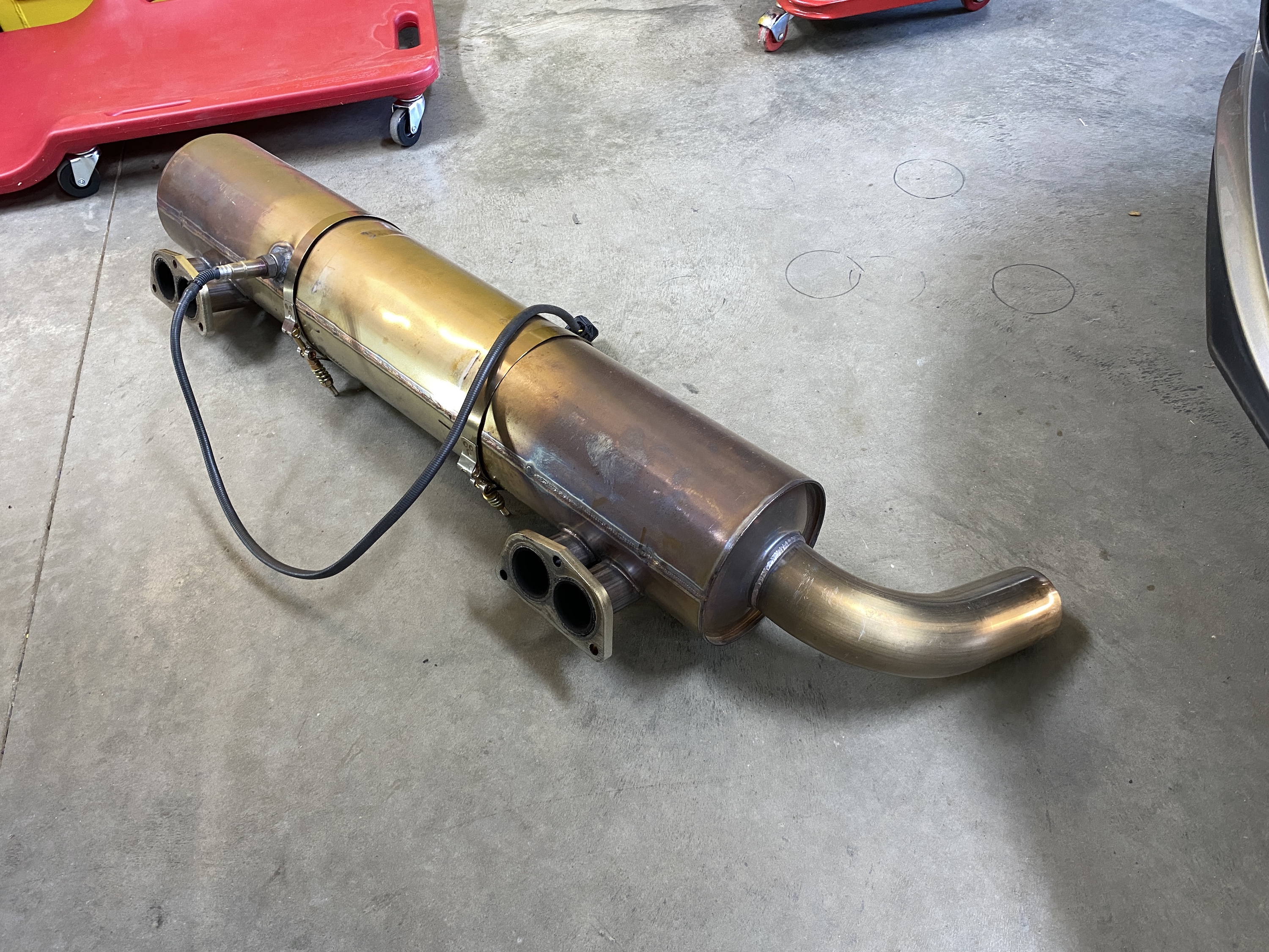

Starting on the bottom: muffler out.
bkrantz
post Dec 16 2022, 08:48 PM
Post #5985
Posts: 8,342
Joined: 3-August 19
From: SW Colorado
Member No.: 23,343
And then the shift rod.

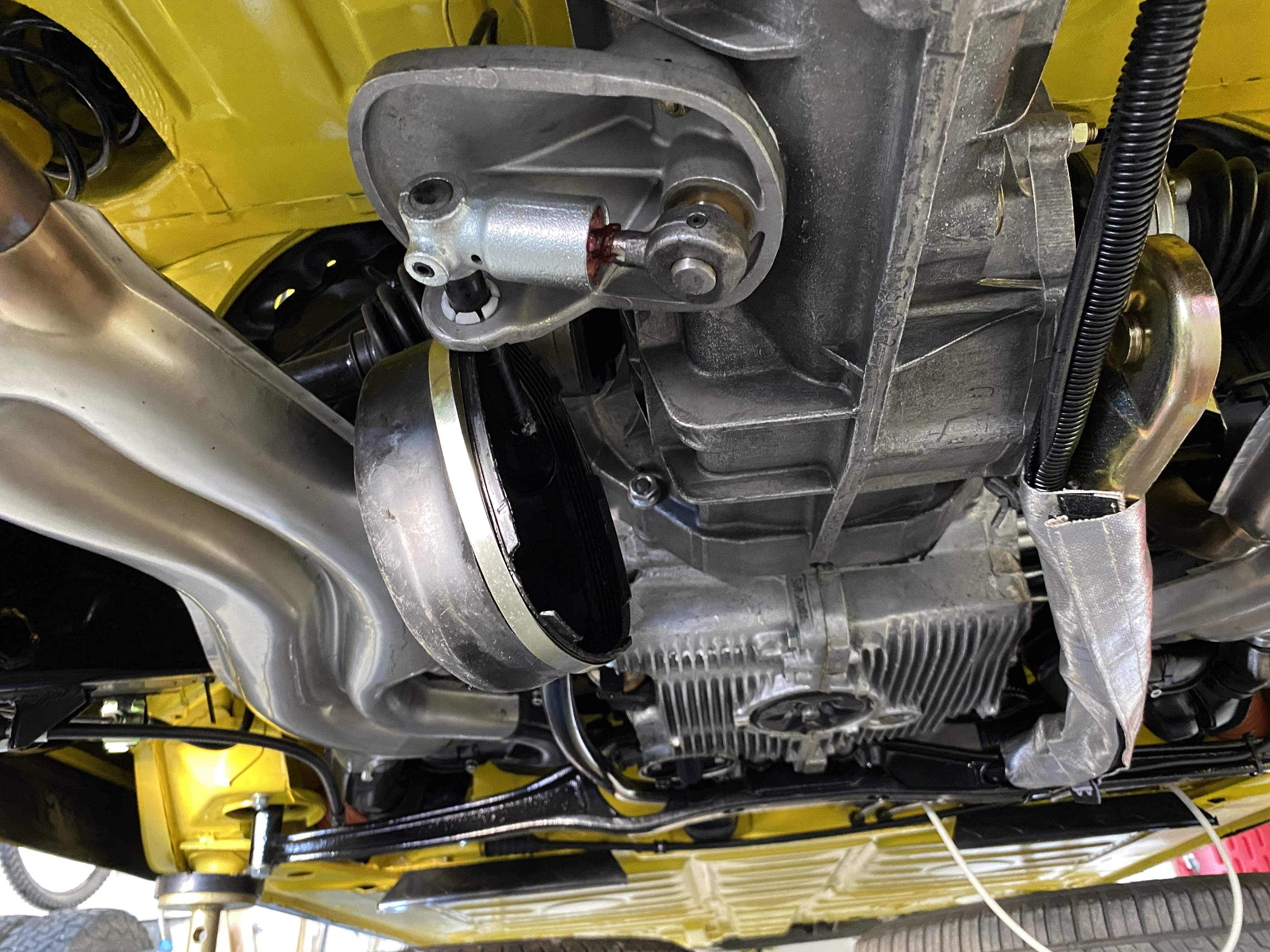

More prep for dropping the engine.
Heat exchangers out. (You can see evidence of oil dripping onto the left one.)

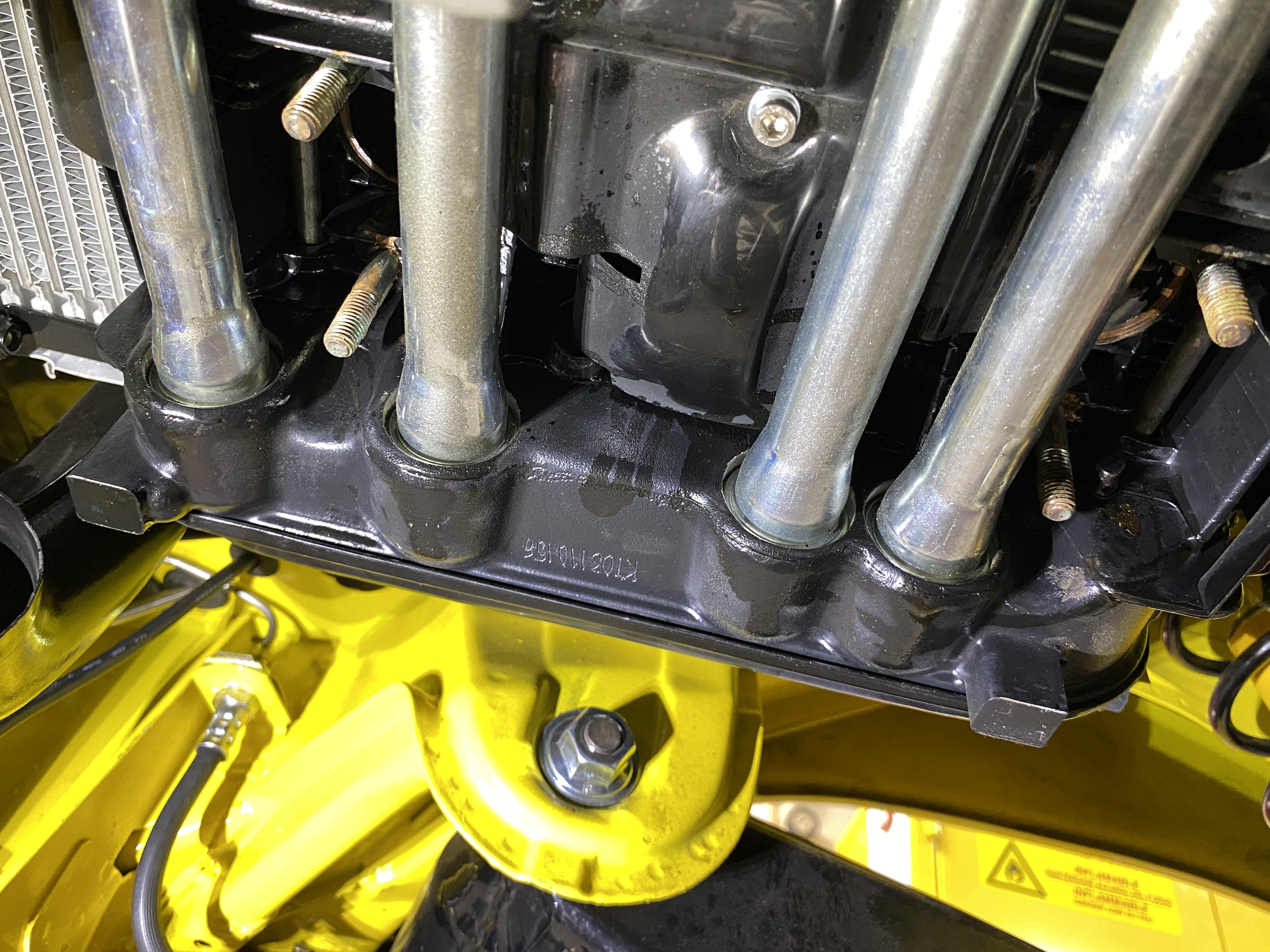

A view of the right cylinder head. Leaking pushrod seals?

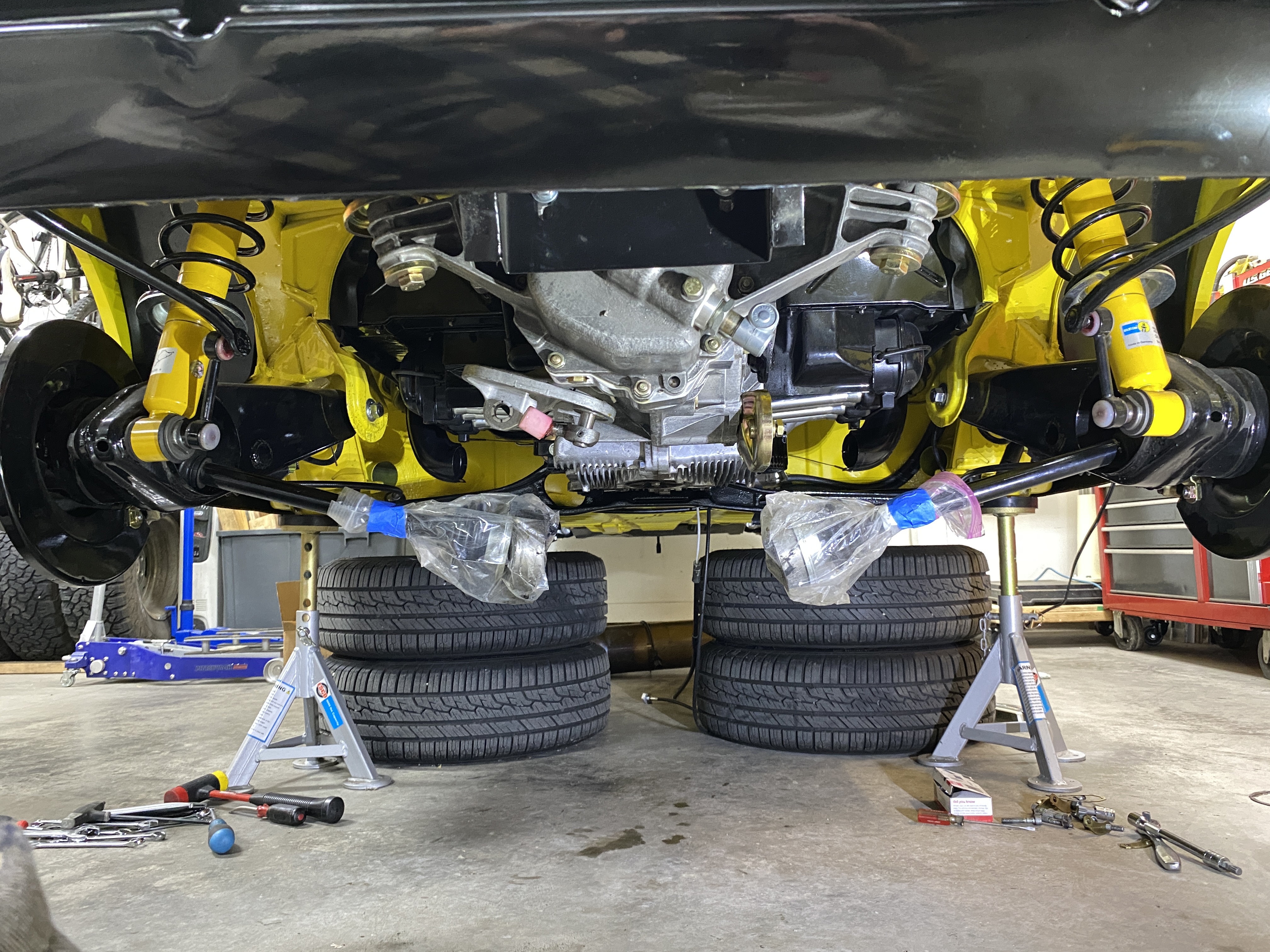

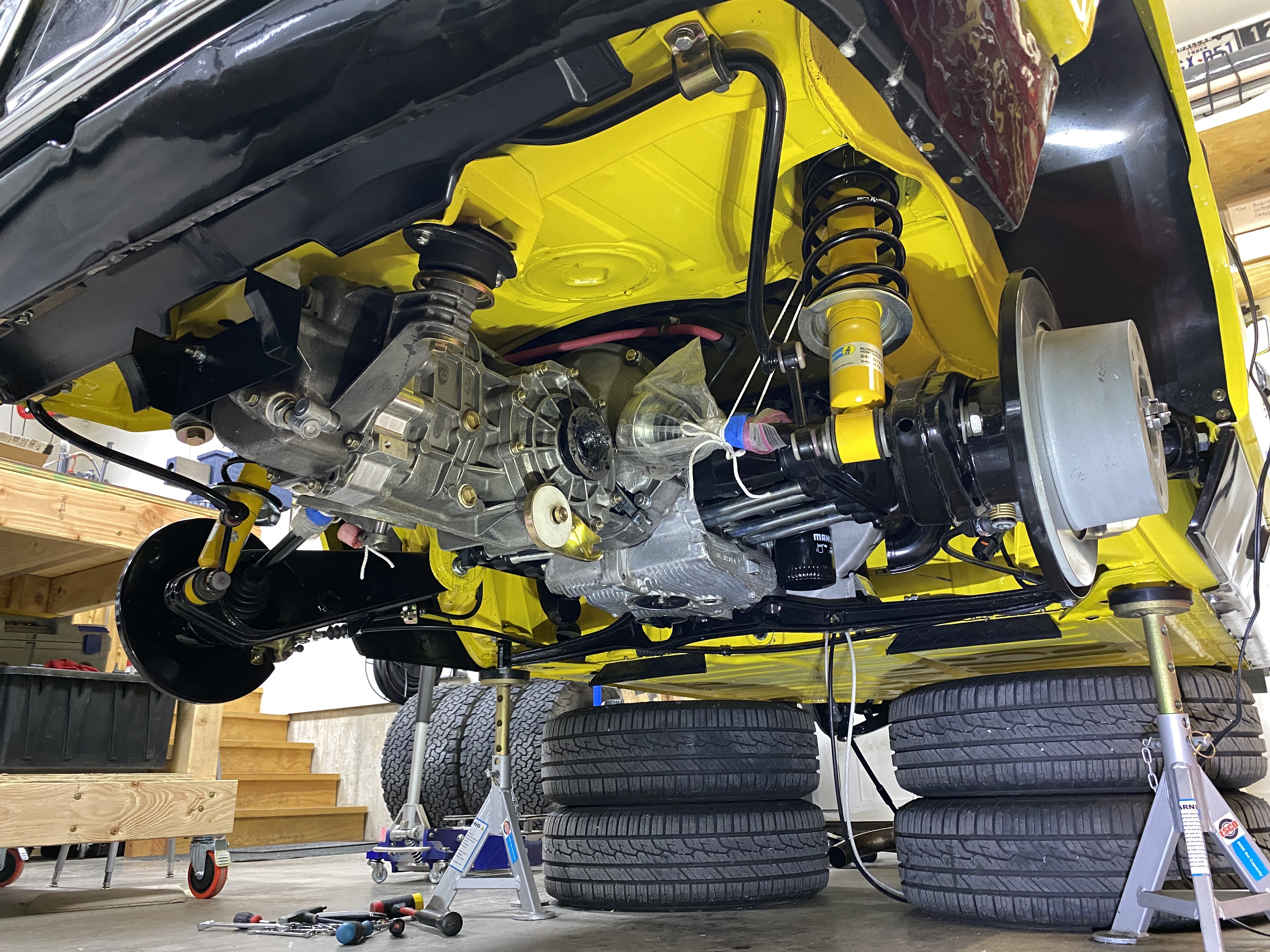

Half-shafts disconnected and CVs bagged.
bkrantz
post Dec 18 2022, 09:08 PM
Post #5992
Posts: 8,342
Joined: 3-August 19
From: SW Colorado
Member No.: 23,343
Everything underneath ready for the engine drop. Maybe tomorrow?

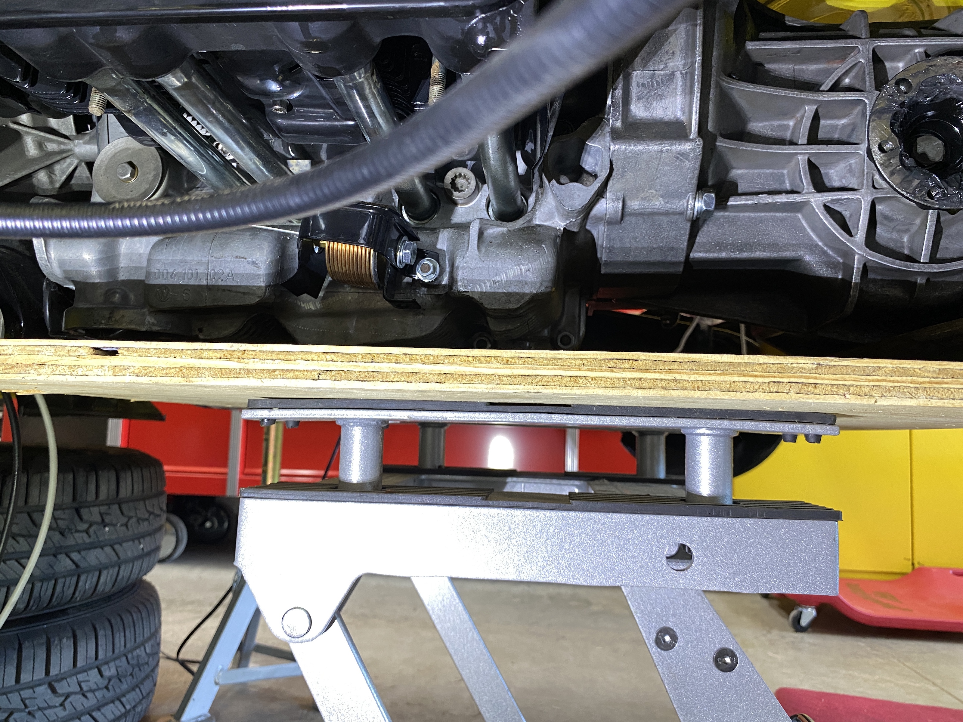

I got out my trusty 914 motor-trans support.
bkrantz
post Dec 19 2022, 07:37 PM
Post #5994
Posts: 8,342
Joined: 3-August 19
From: SW Colorado
Member No.: 23,343
And my HF motorcycle lift.
bkrantz
post Dec 19 2022, 07:38 PM
Post #5995
Posts: 8,342
Joined: 3-August 19
From: SW Colorado
Member No.: 23,343
And after removing the cross-bar bolts and the trans mount bolts, I started to lower.

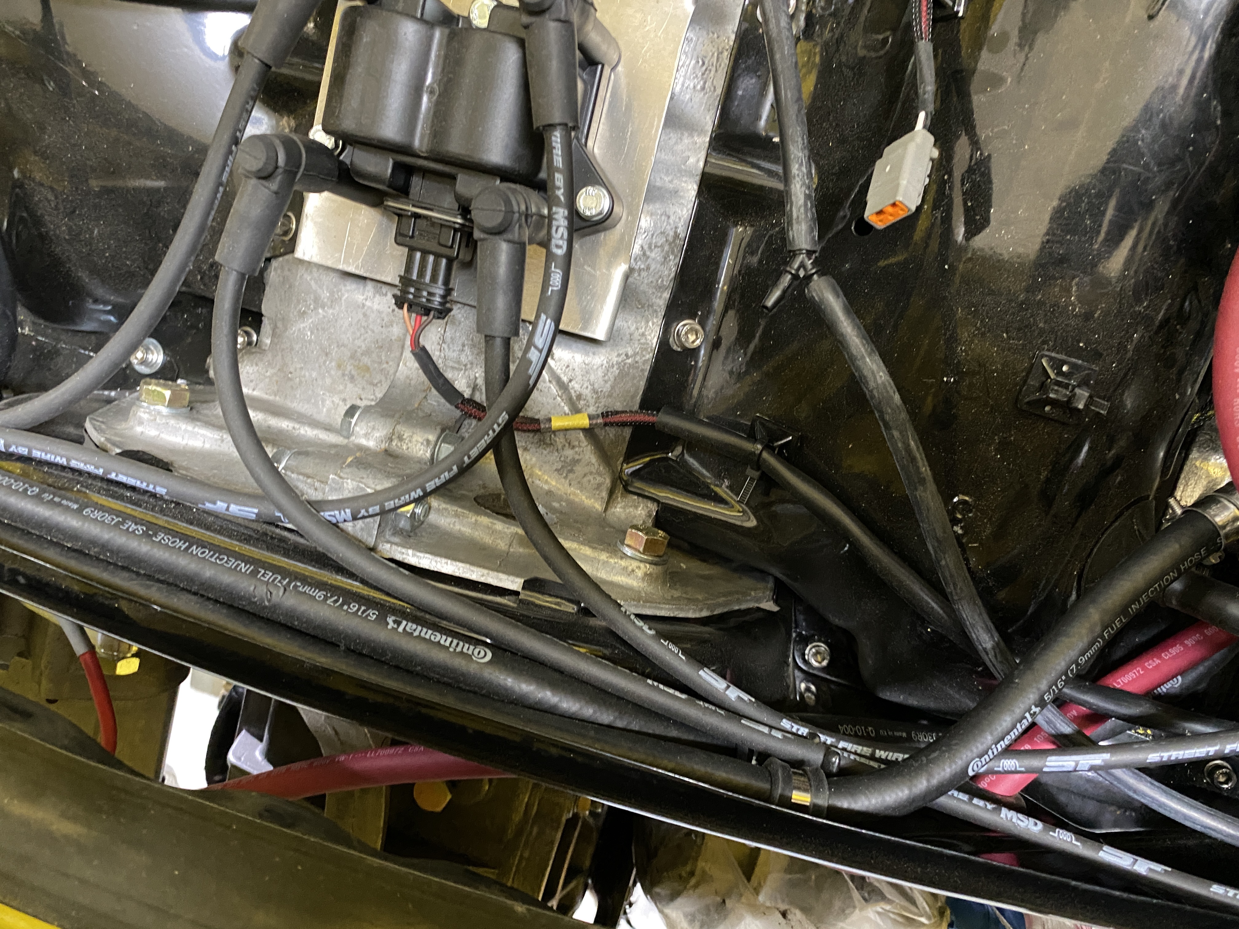

Member No.: 23,343
Of course I found one forgotten connection: the cable to the electronic coil. Fortunately, I spotted that before it took any tension.

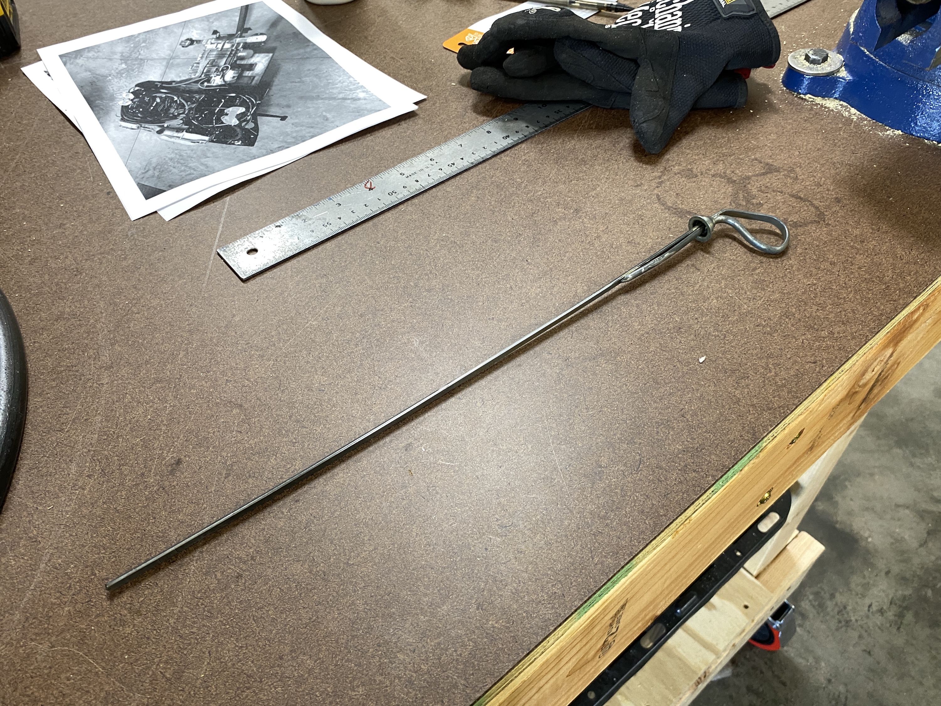

And the oil dipstick, which was the highest component at that point.
bkrantz
post Dec 19 2022, 07:46 PM
Post #5998
Posts: 8,342
Joined: 3-August 19
From: SW Colorado
Member No.: 23,343

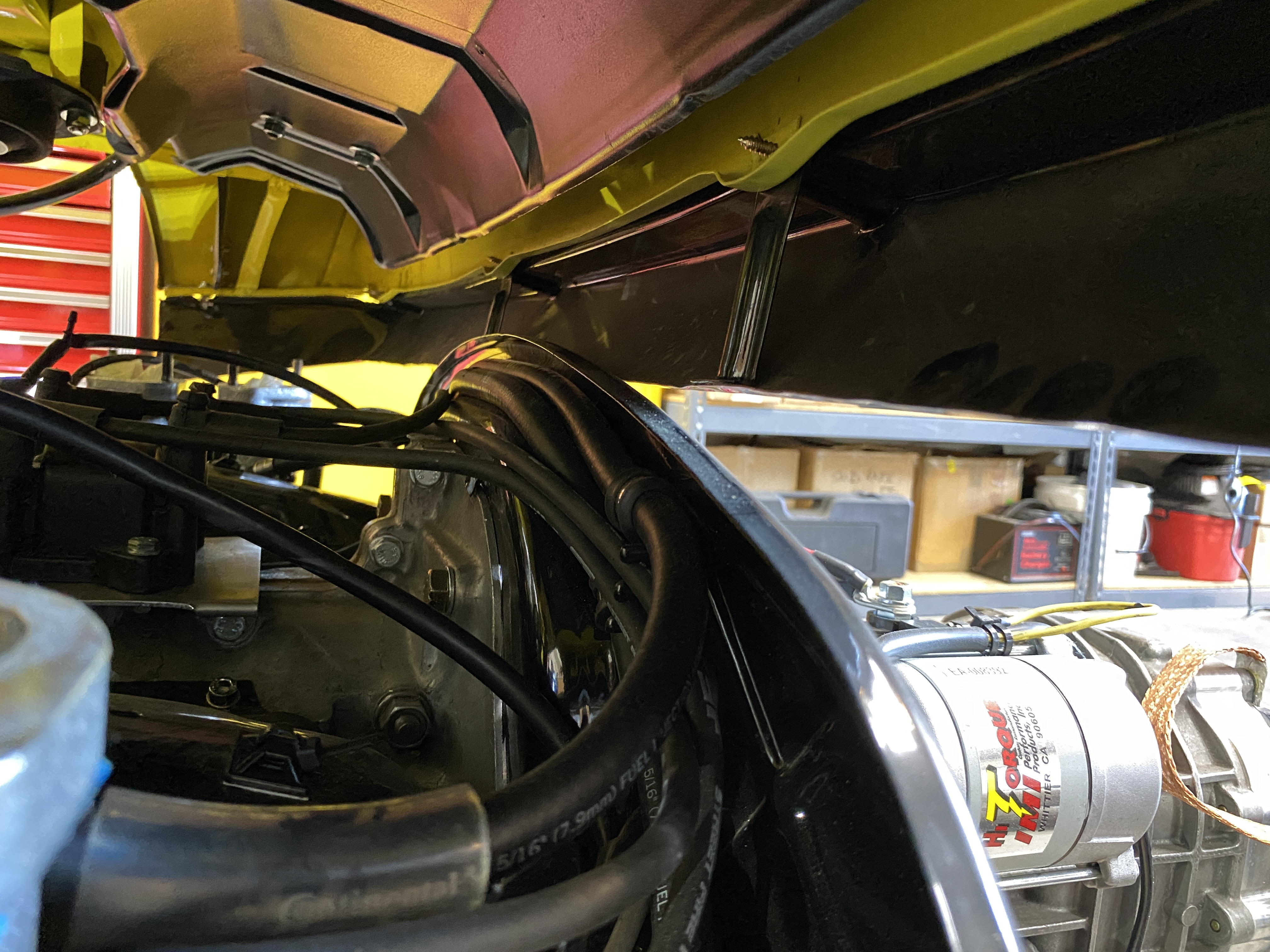

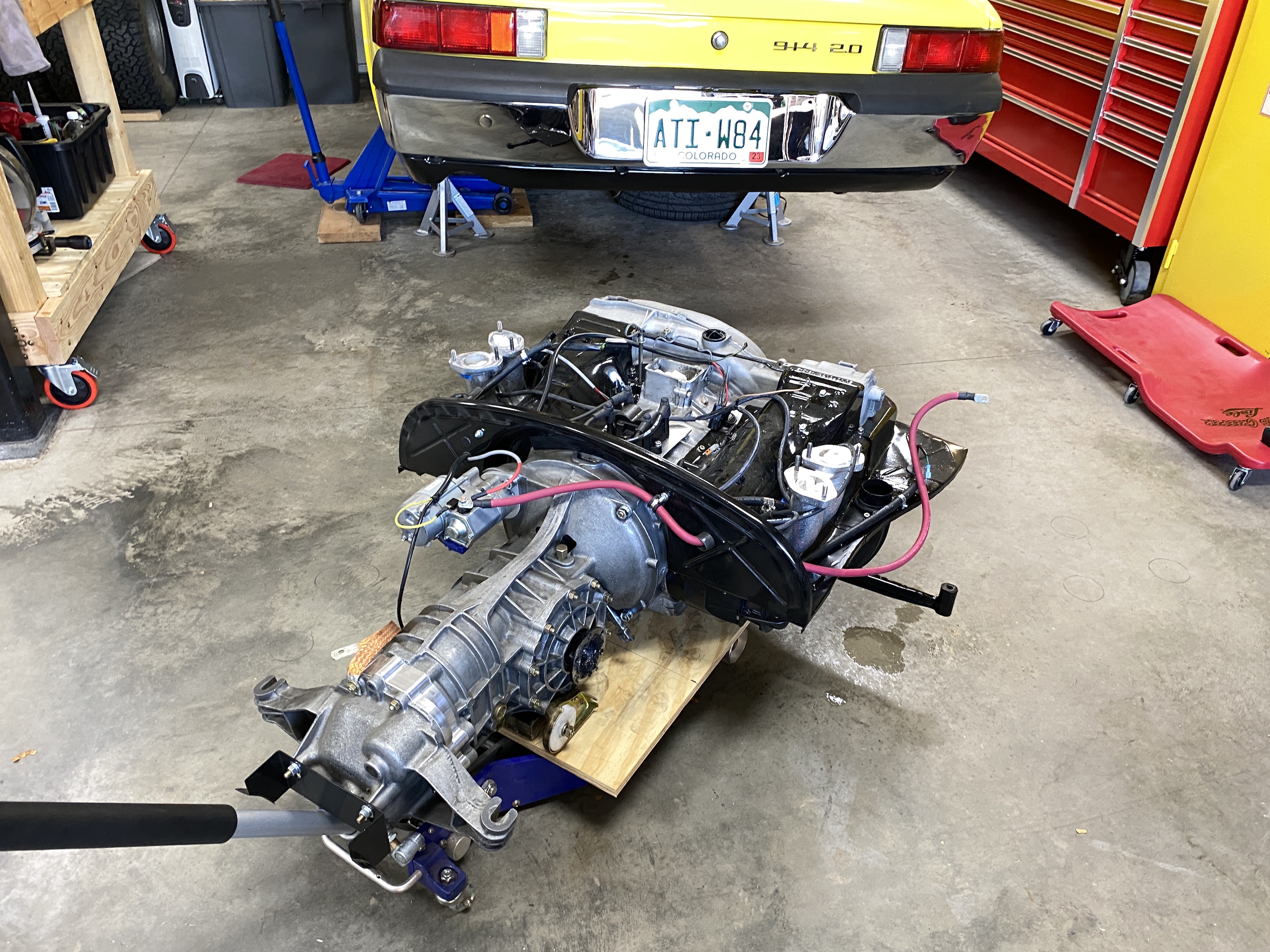

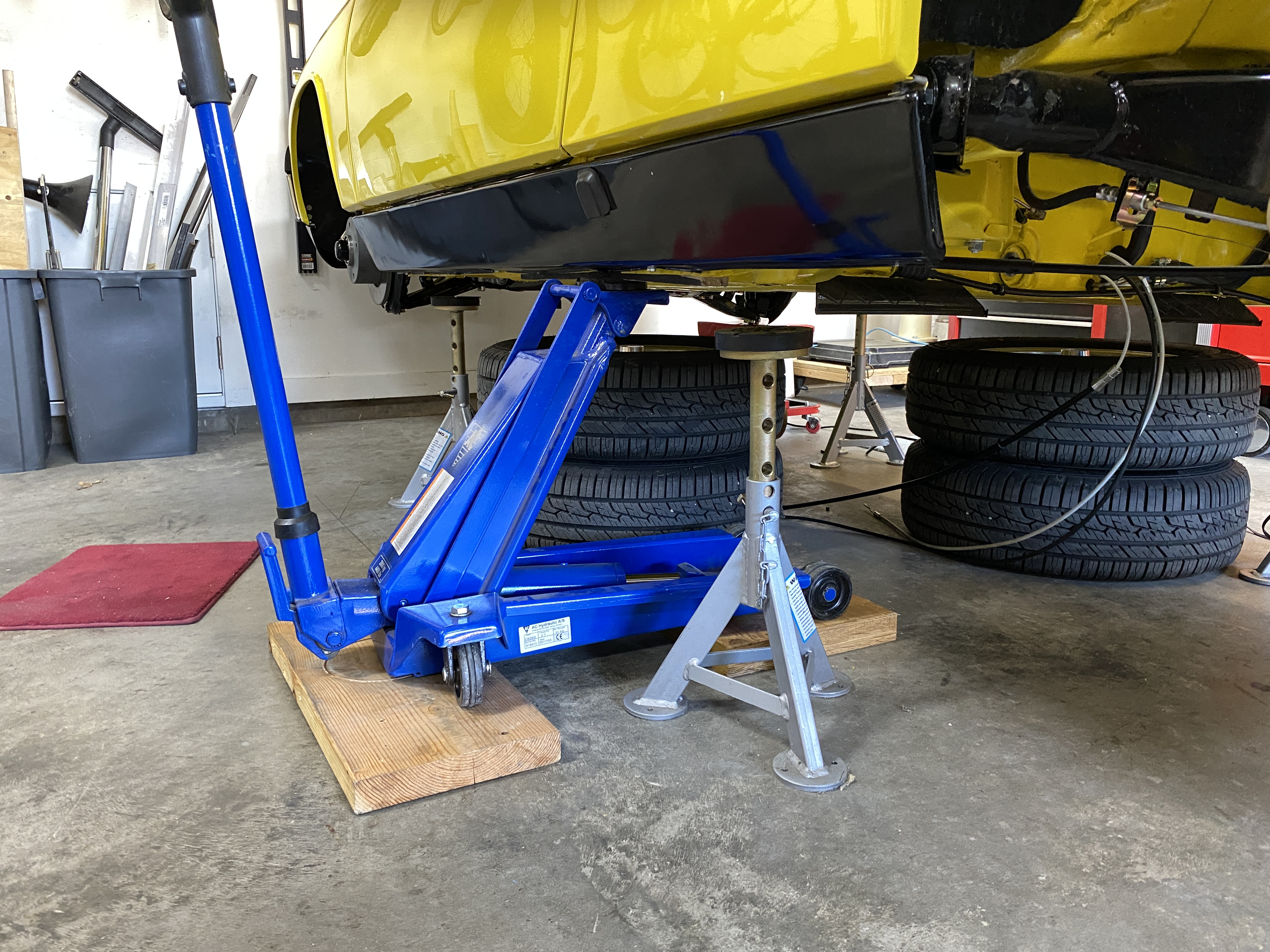

Anyway, I got the motor and trans fully lowered. But the rear sheet metal is about 3/4" too tall to clear the rear valance.
bkrantz
post Dec 19 2022, 07:48 PM
Post #5999
Posts: 8,342
Joined: 3-August 19
From: SW Colorado
Member No.: 23,343
Time to elevate the jack on one side.
bkrantz
post Dec 19 2022, 07:49 PM
Post #6000
Posts: 8,342
Joined: 3-August 19
From: SW Colorado
Member No.: 23,343
Success! (and also the 6000th post in this thread)
