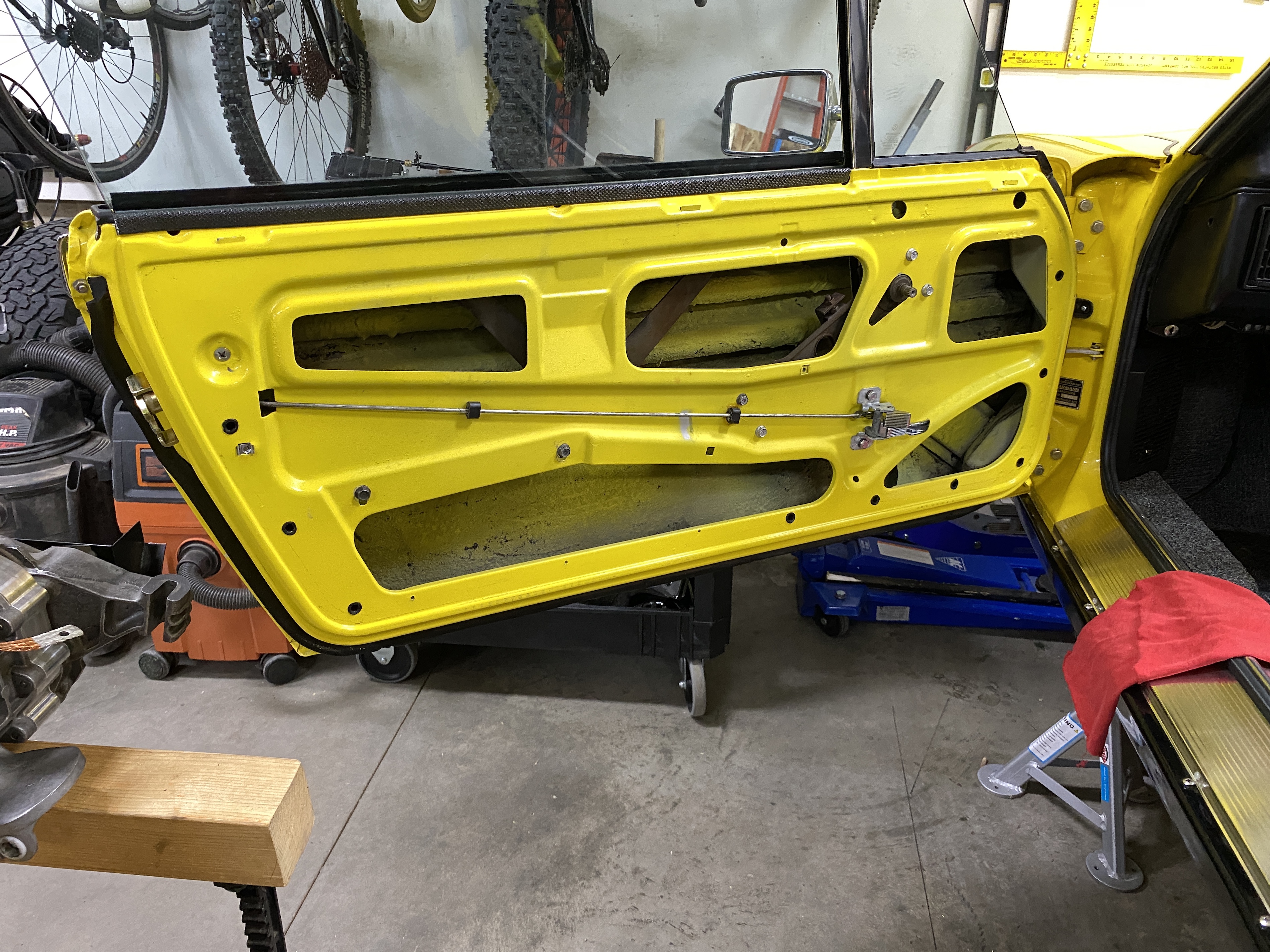

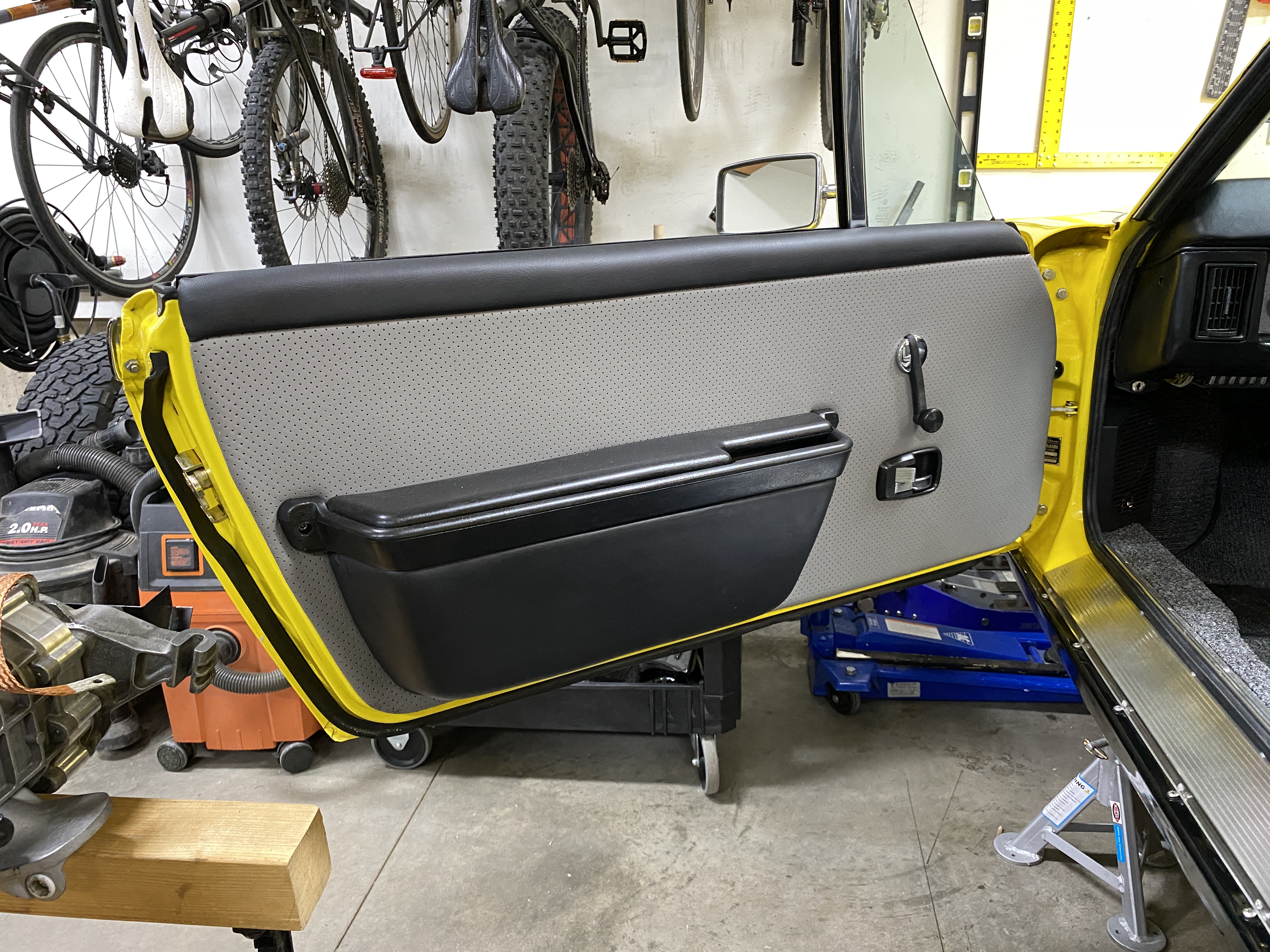

Let's tackle the problems with the left door. See my new thread about weird door lock behavior. The door stop also does not hold the door open.
bkrantz
post Jan 16 2023, 08:31 PM
Post #6044
Posts: 8,342
Joined: 3-August 19
From: SW Colorado
Member No.: 23,343
Interior hardware removed.
bkrantz
Post #6045
Posts: 8,342
Joined: 3-August 19
From: SW Colorado
Member No.: 23,343

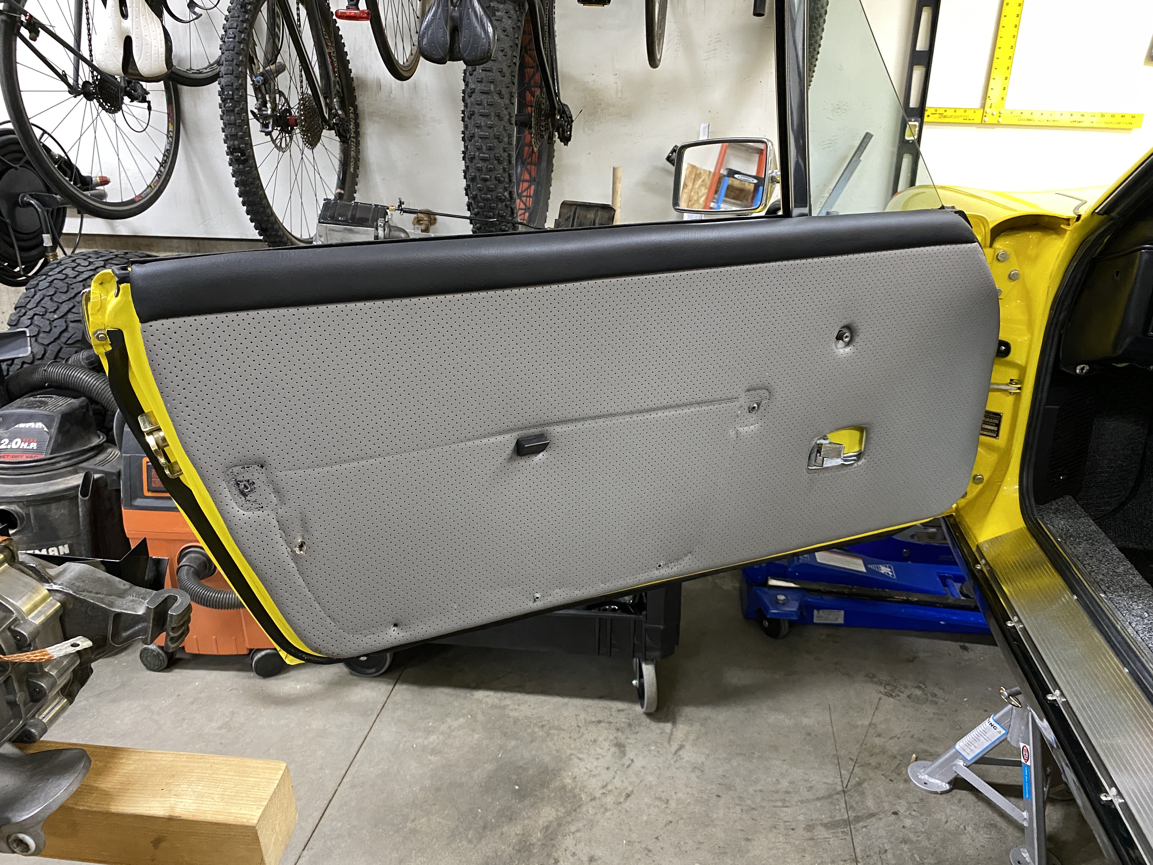

Door card removed.

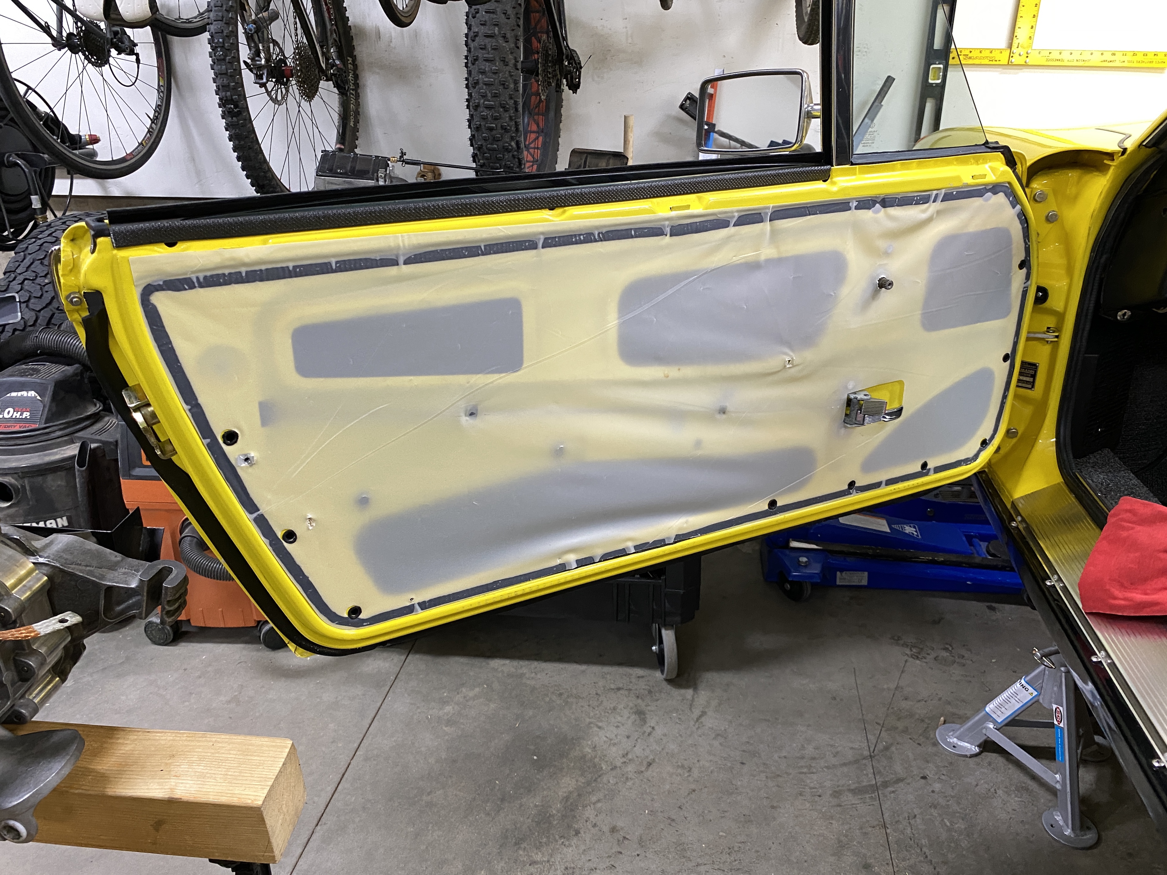

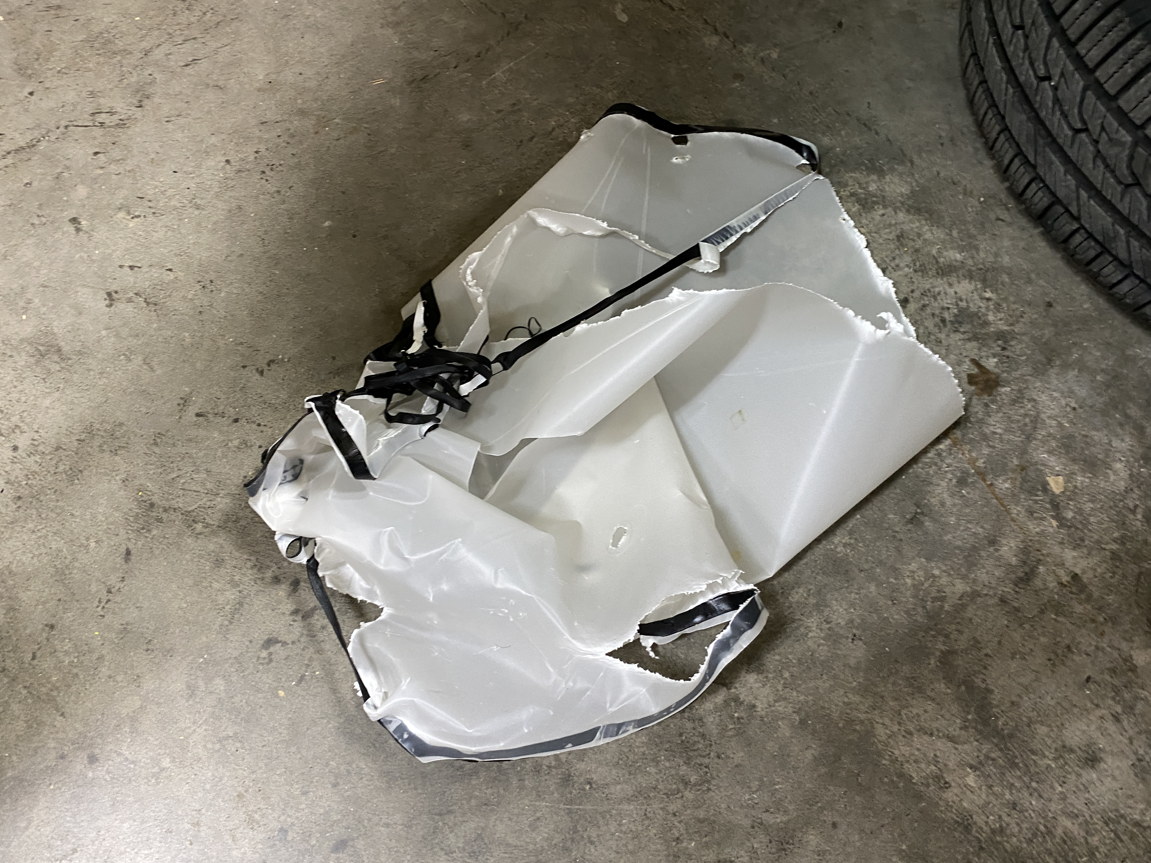

And plastic sheeting.
bkrantz
post Jan 16 2023, 08:33 PM
Post #6047
Posts: 8,342
Joined: 3-August 19
From: SW Colorado
Member No.: 23,343
I tried to be careful, but after several small tears, I gave up.

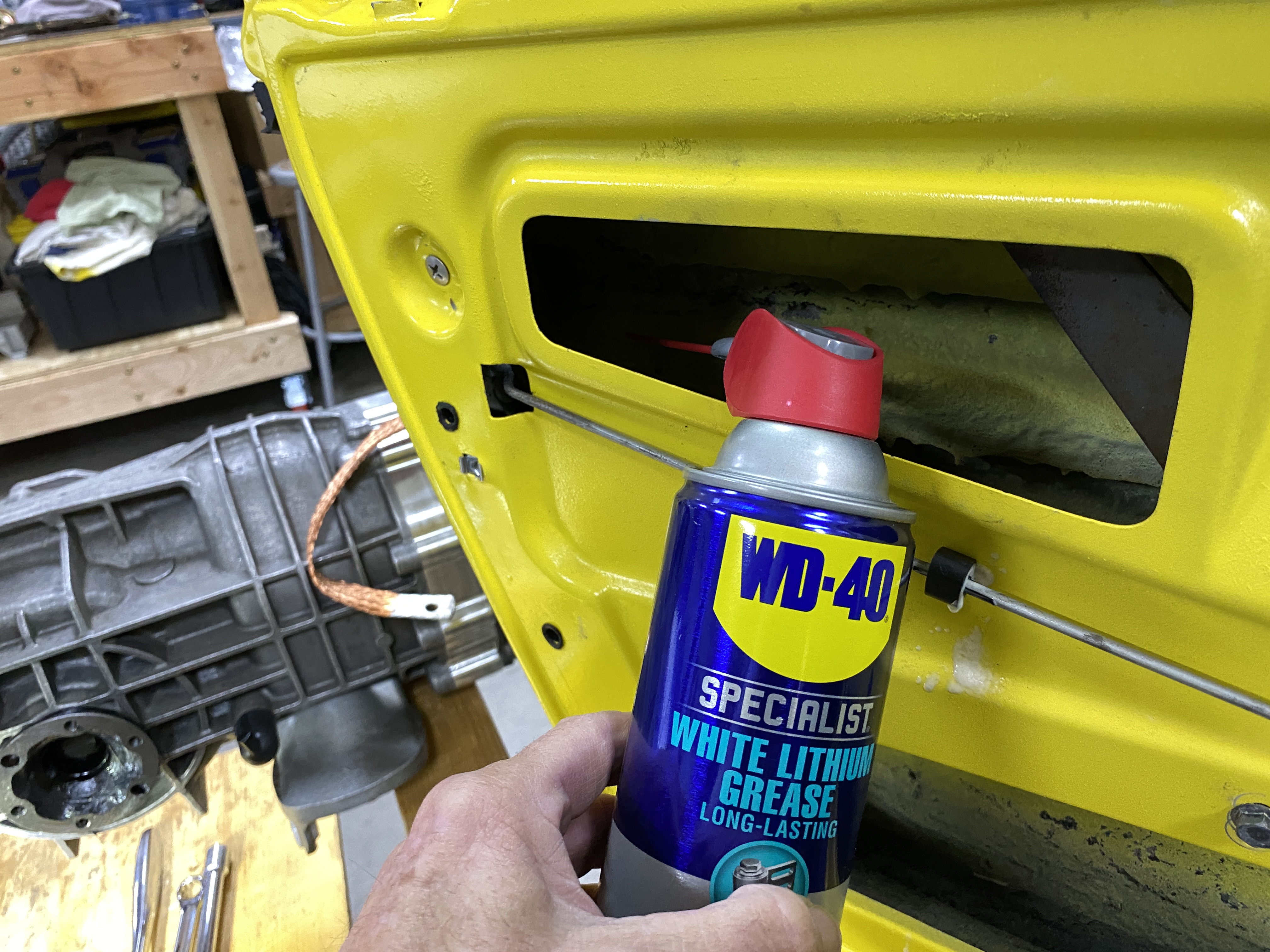

Some (or lots) of grease on the mechanism and linkage seems to get the lock working.

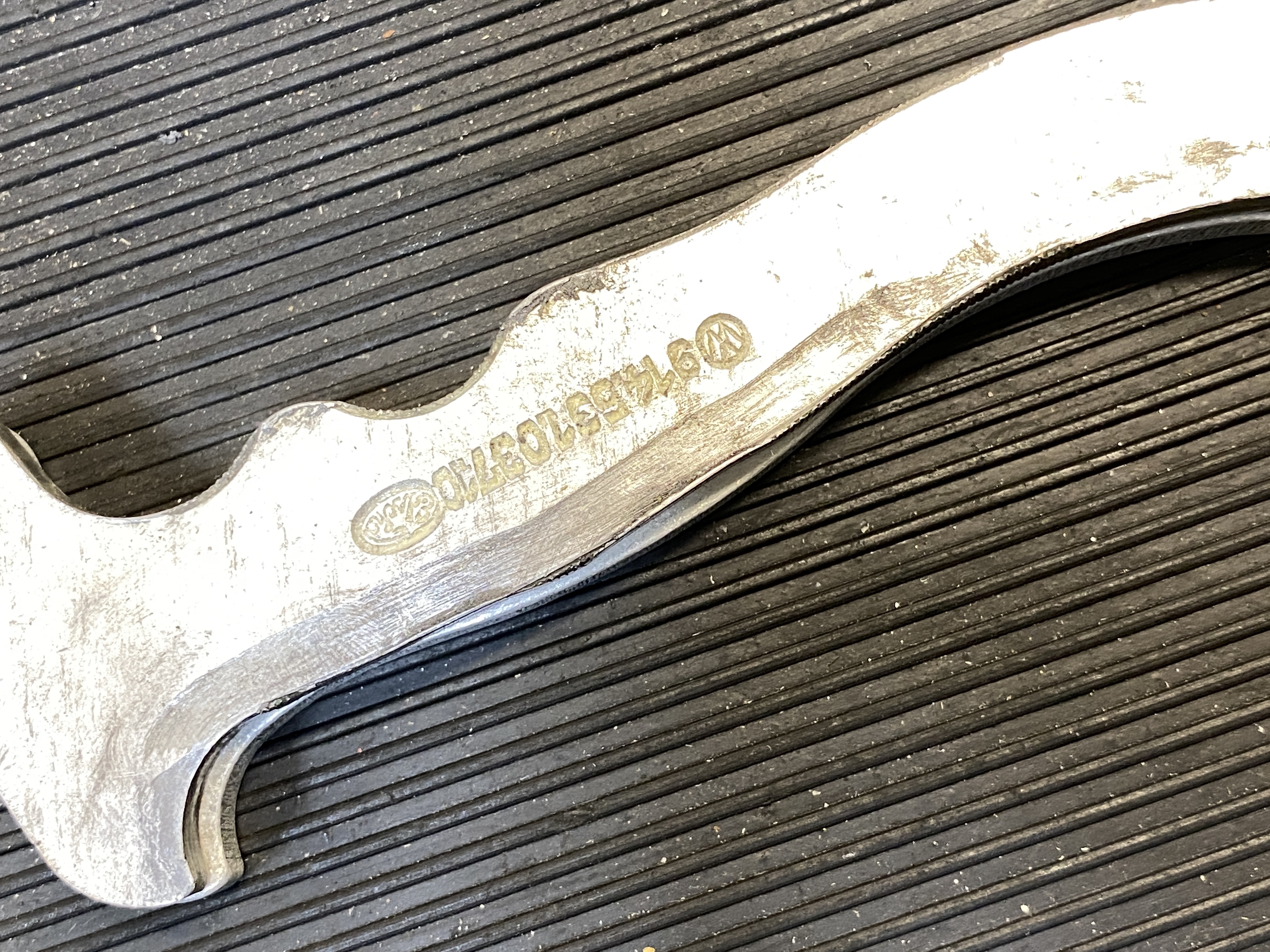

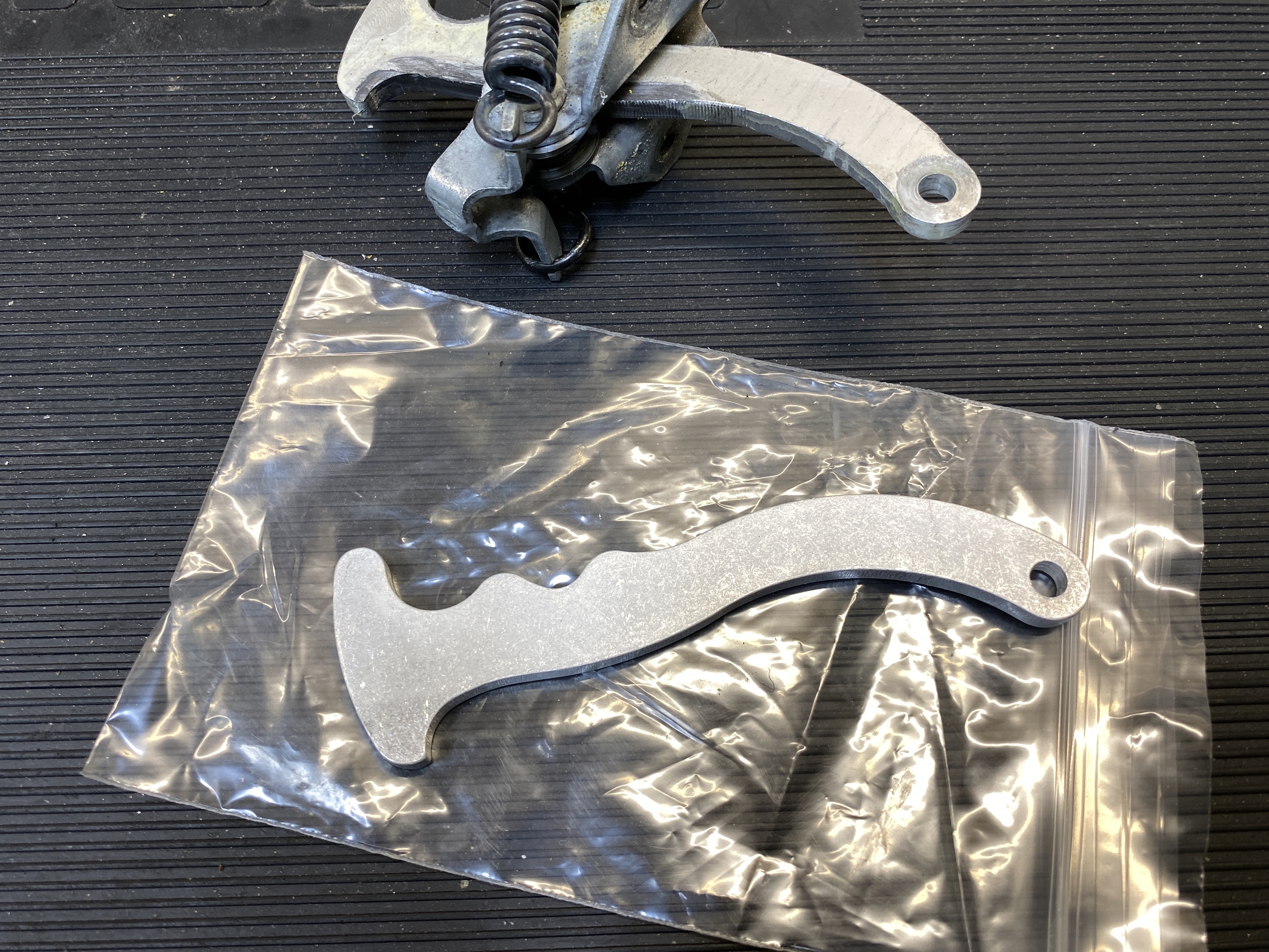

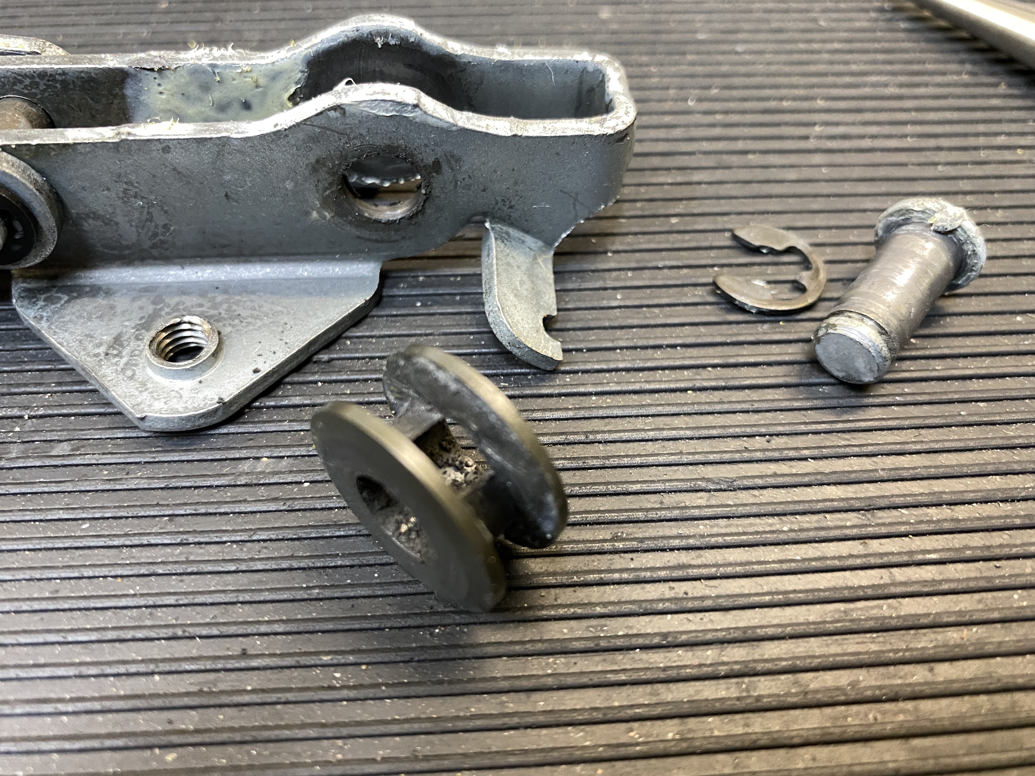

I took out the door stop. I expected the problem to be a worn aluminum arm, and have a replacement ready.
bkrantz
post Jan 16 2023, 08:38 PM
Post #6050
Posts: 8,342
Joined: 3-August 19
From: SW Colorado
Member No.: 23,343
Yup, the old arm has a fair amount of where.

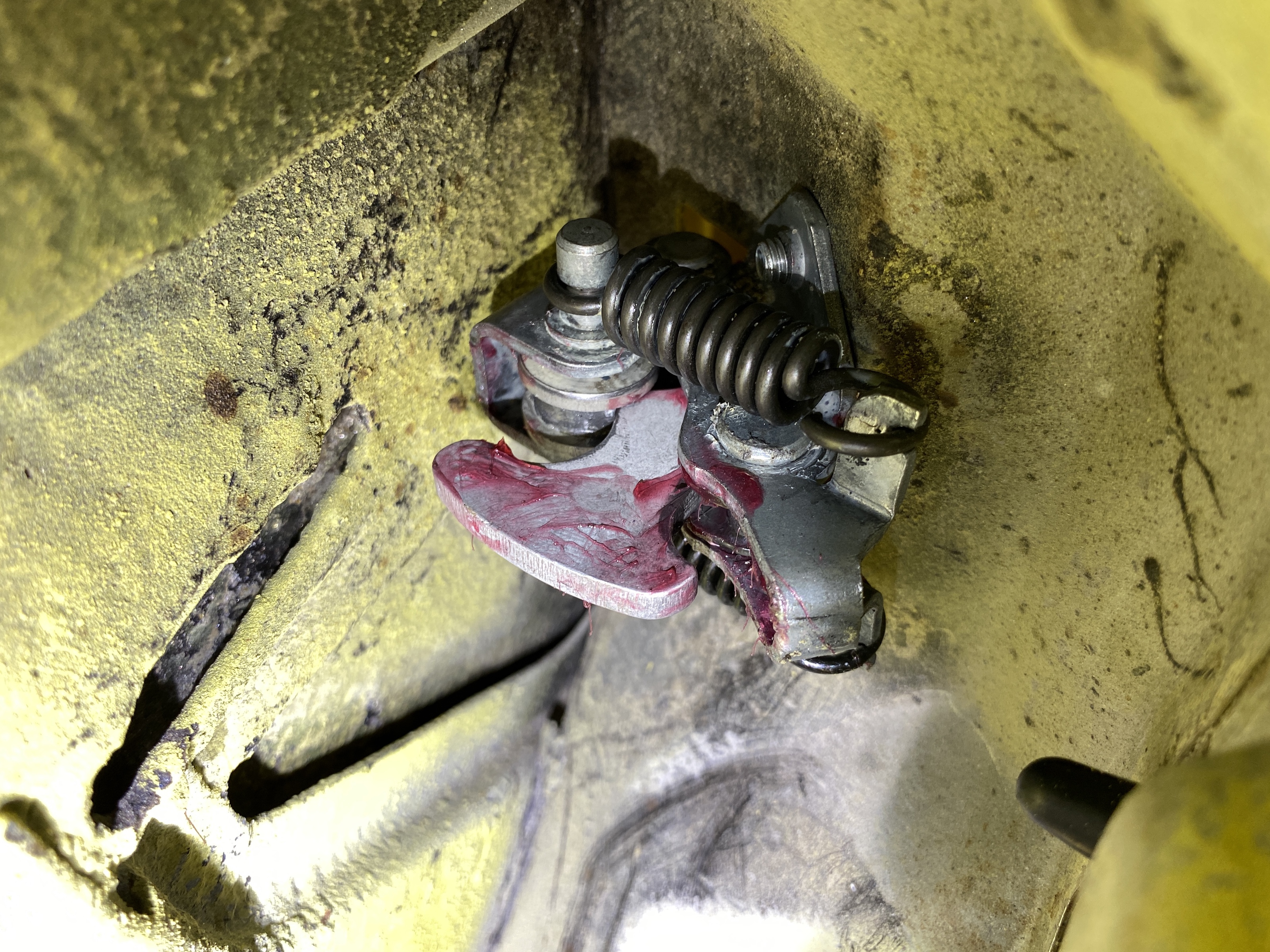

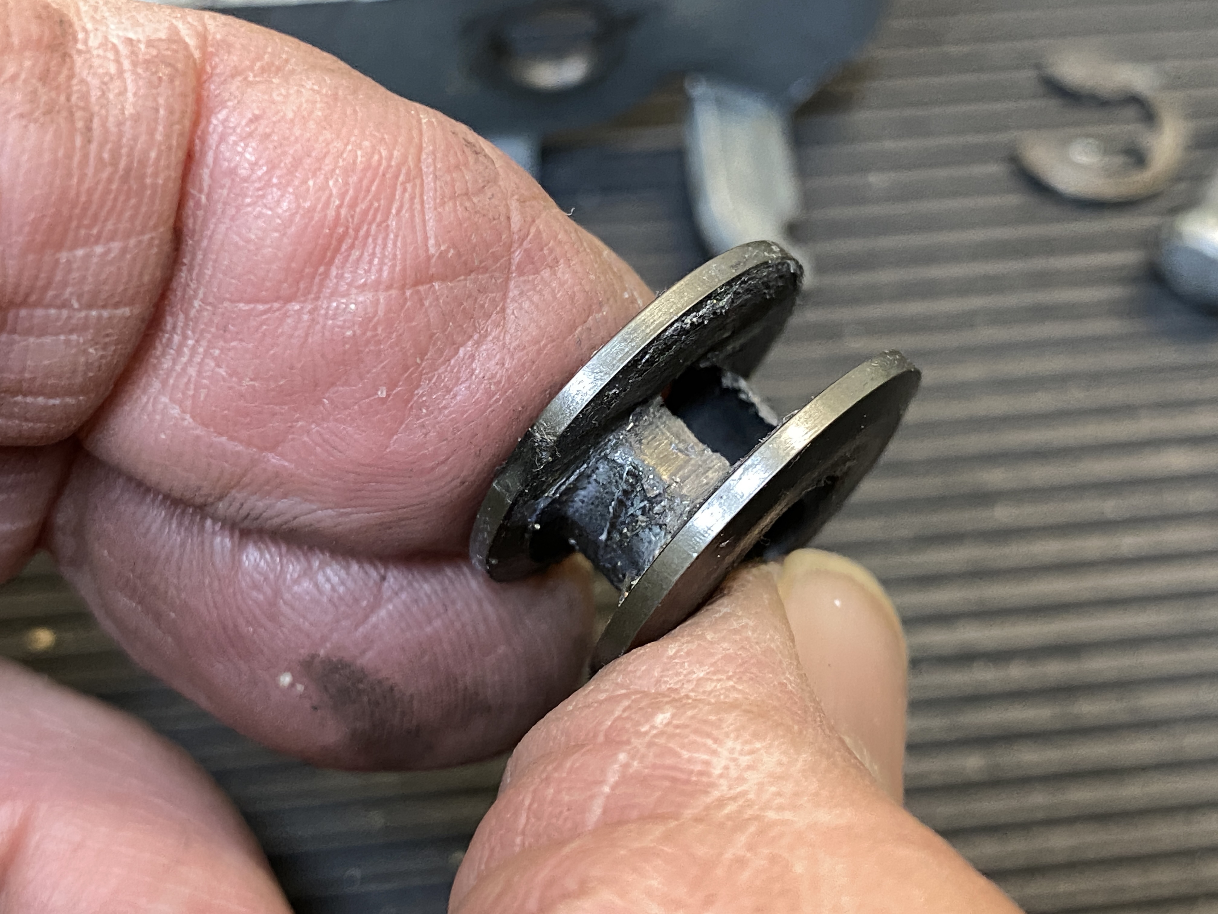

But the problem turns out to be one of the bushings.
bkrantz
post Jan 16 2023, 08:43 PM
Post #6052
Posts: 8,342
Joined: 3-August 19
From: SW Colorado
Member No.: 23,343
At some point the nylon(?) bushing stopped turned, and wore through on one side. This eliminates the pressure the bushings impose on the aluminum arm. Time for the rebuild kit with new bushings.
bkrantz
post Jan 16 2023, 08:45 PM
Post #6053
Posts: 8,342
Joined: 3-August 19
From: SW Colorado
Member No.: 23,343
But feeling optimistic, I tried to install the bushing rotated 180°. That worked for exactly 1 door closing and opening before the bushing spun around to the worn position.

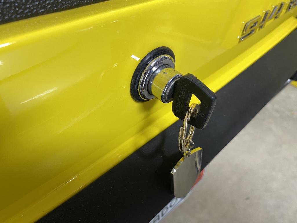

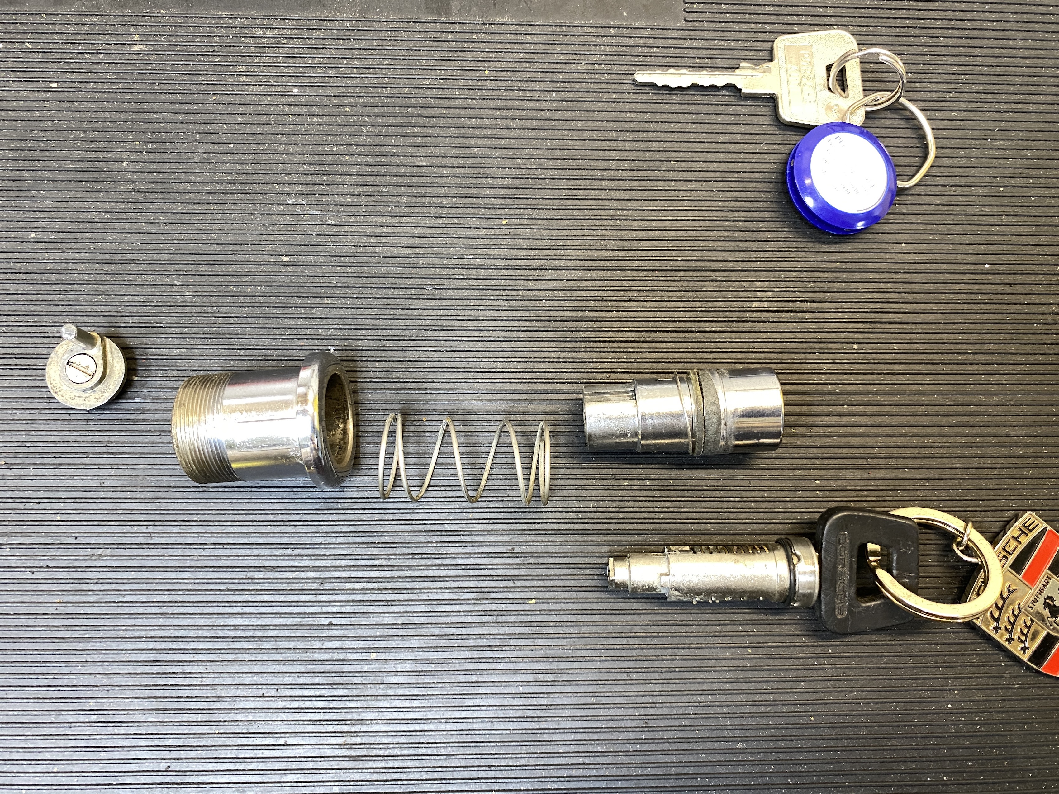

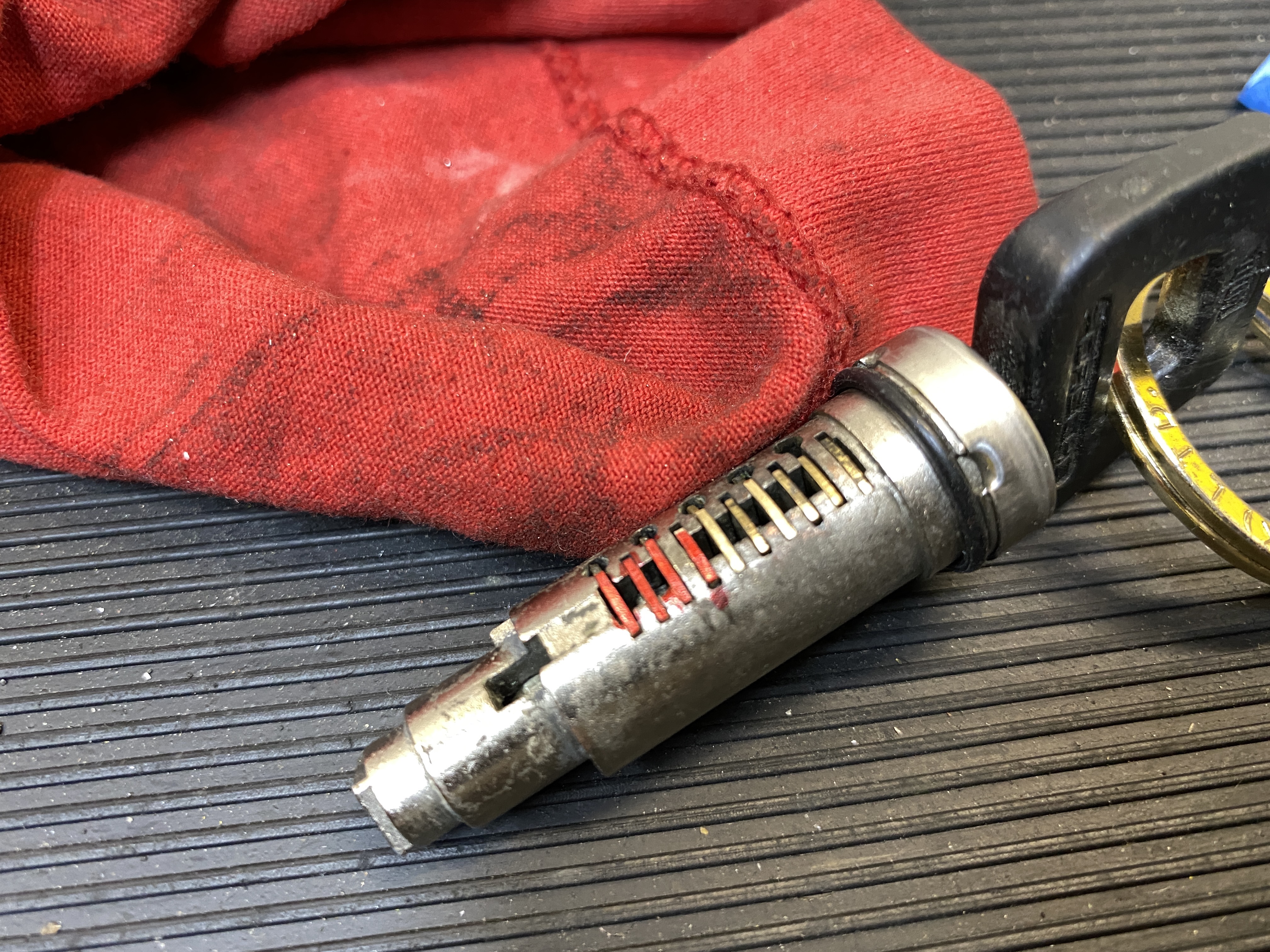

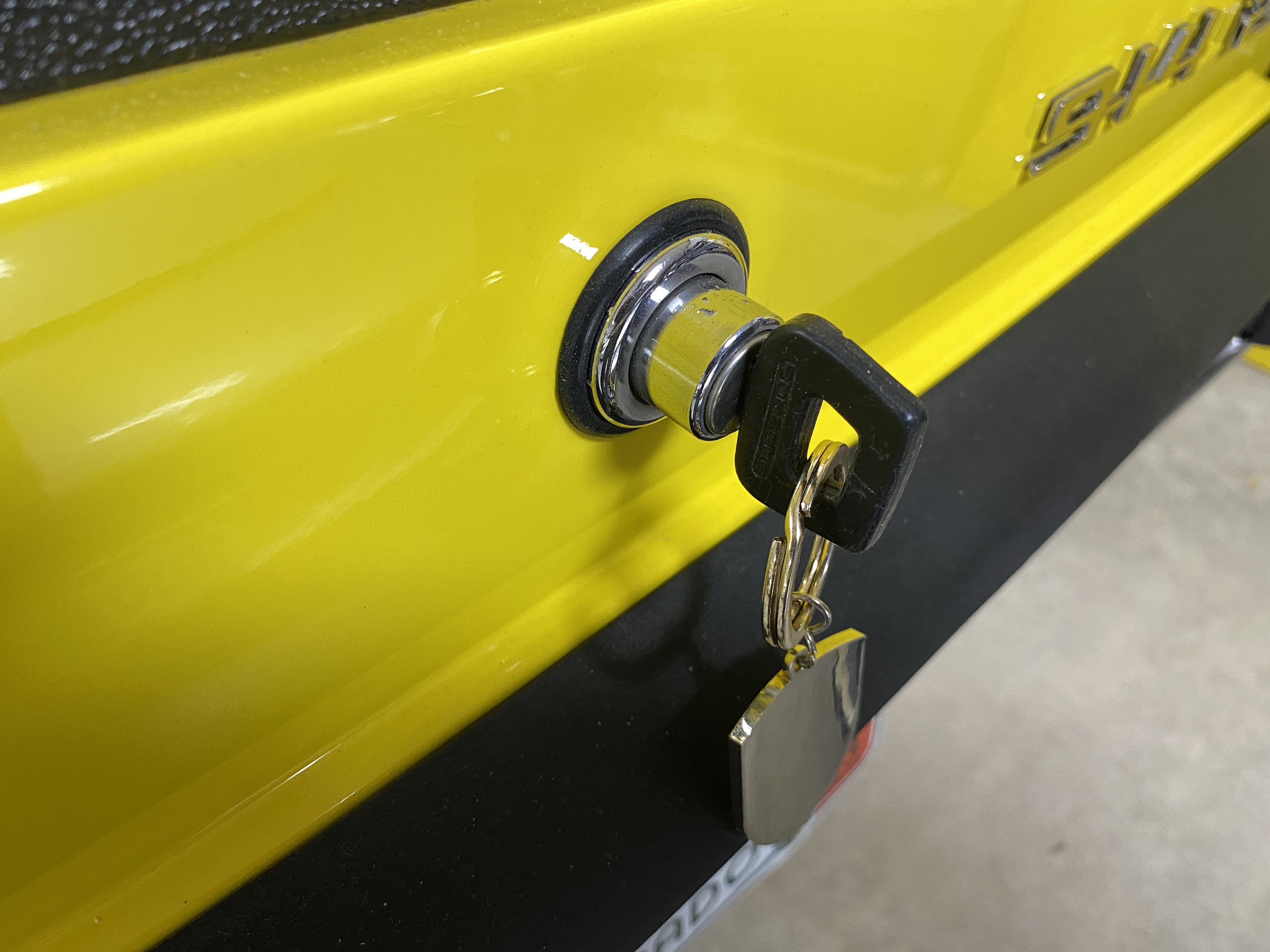

Then I dug into the trunk lock. When I set this up last year, the key worked fine with the lock on the bench. Now the key does not turn.
bkrantz
post Jan 16 2023, 08:47 PM
Post #6055
Posts: 8,342
Joined: 3-August 19
From: SW Colorado
Member No.: 23,343
Lock back on the bench. Still does not work.
bkrantz
post Jan 16 2023, 08:48 PM
Post #6056
Posts: 8,342
Joined: 3-August 19
From: SW Colorado
Member No.: 23,343

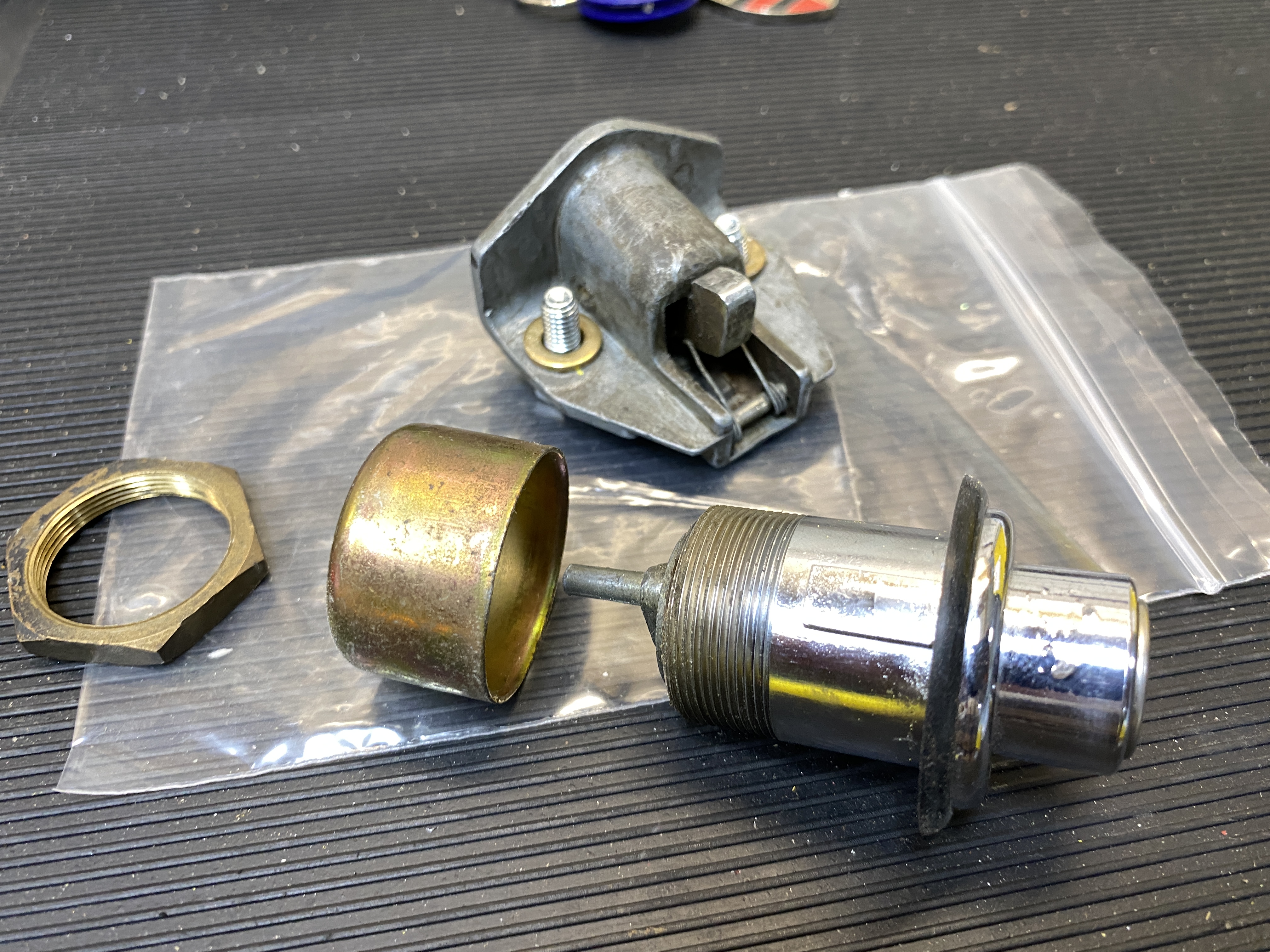

All apart.
bkrantz
post Jan 16 2023, 08:51 PM
Post #6057
Posts: 8,342
Joined: 3-August 19
From: SW Colorado
Member No.: 23,343
Time to fine-tune the lock sliding pins. When I got this lock last year, I moved the pins around to get the best fit possible, but then had to shorten a few. The red pins stick out just a bit.

QUOTE(bkrantz @ Jan 16 2023, 09:35 PM) *
I have found removing the latch/locking mechanism works well to clean the 1/2 century of crud and then lube. Adding lube seems to compound the issue
