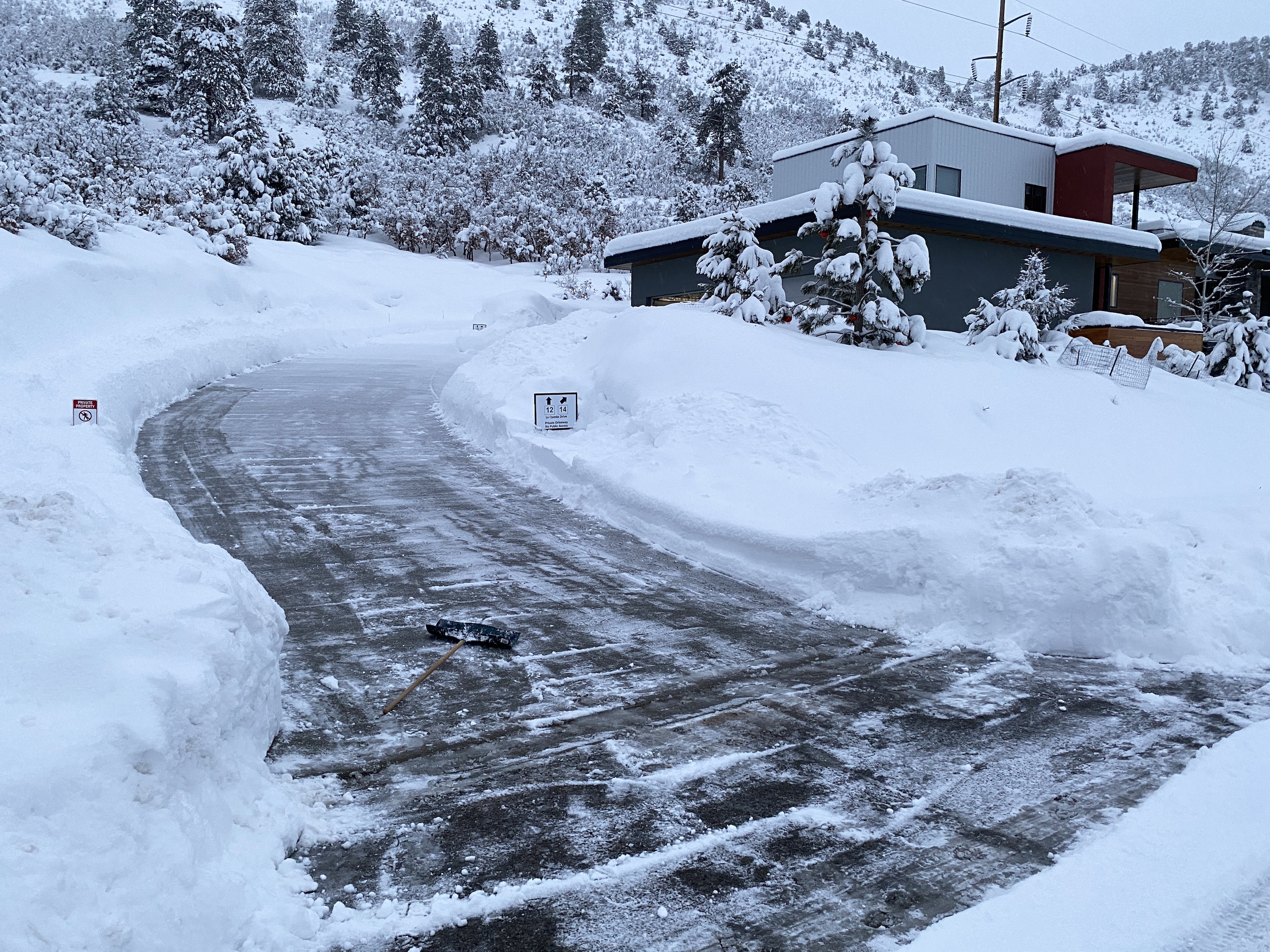

Back to 914 work today. I have been distracted all week by snow, with shoveling adventures on Sunday, Monday, Monday, Tuesday, Wednesday, and Friday. I have about 2500 sq ft of driveway, and feel stubborn enough to usually do it by hand. But this week I got the machine out.

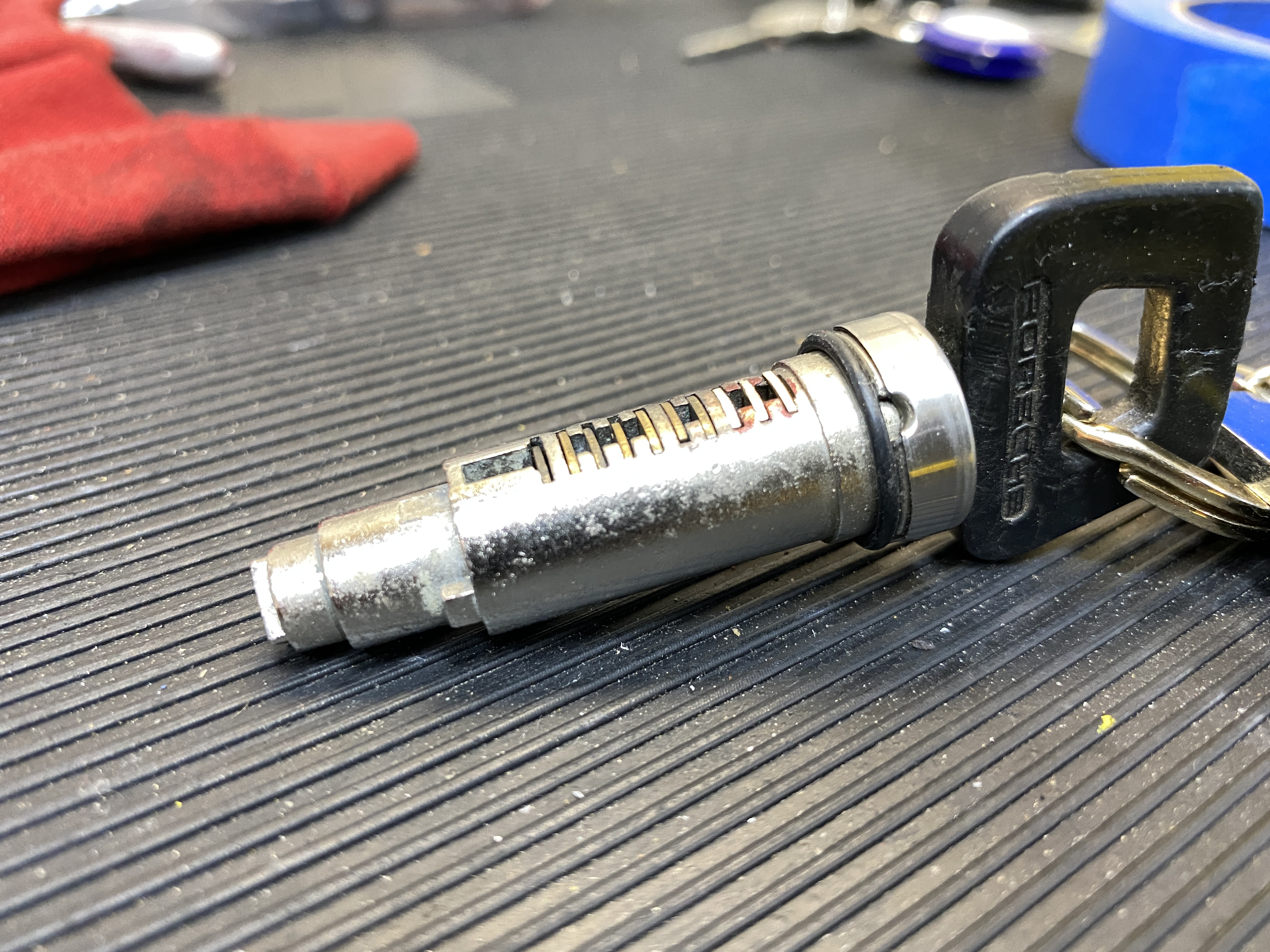

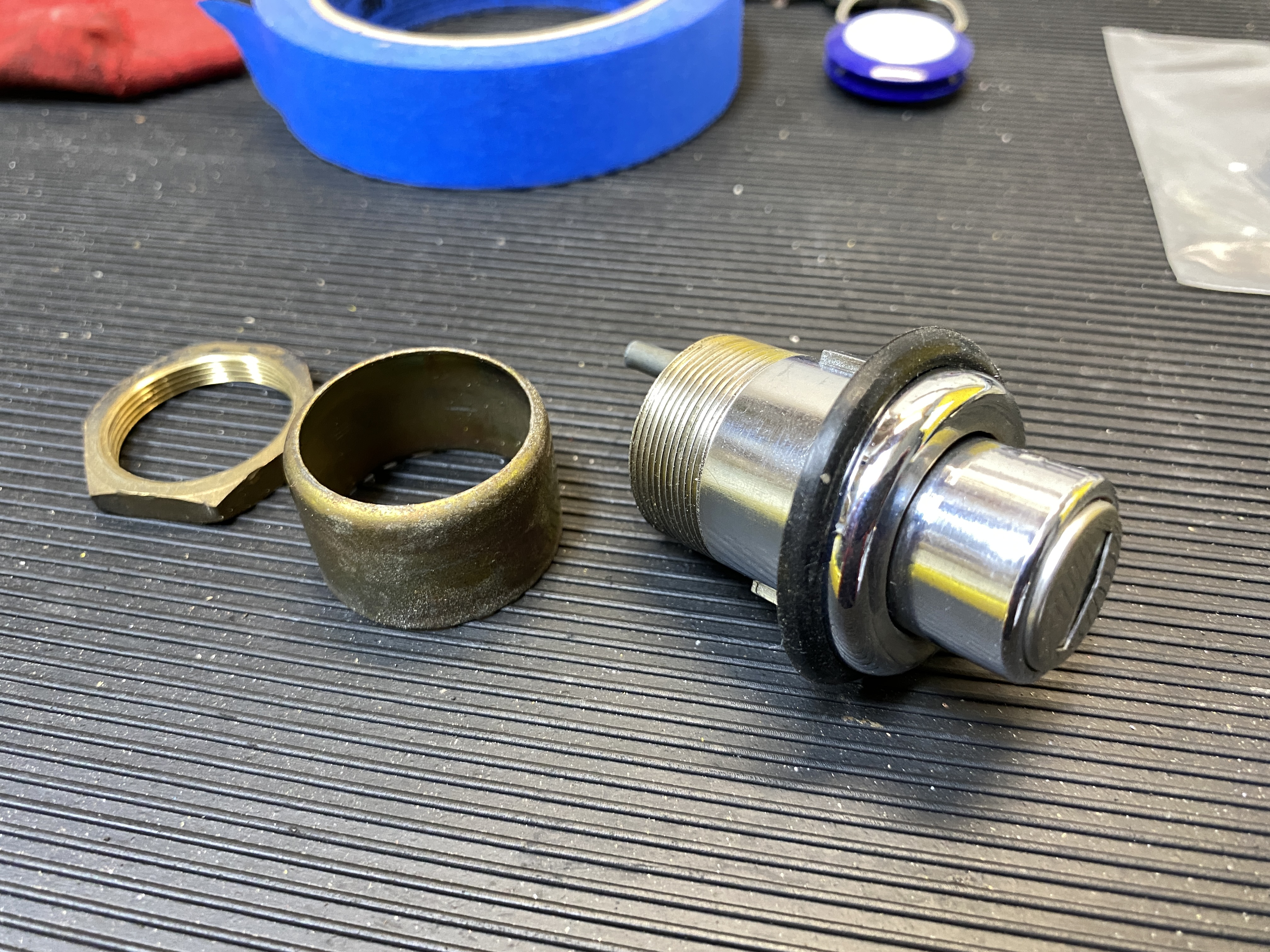

Anyway, I finished evening out the slide pins on the trunk lock.
bkrantz
post Jan 21 2023, 07:59 PM
Post #6069
Posts: 8,342
Joined: 3-August 19
From: SW Colorado
Member No.: 23,343

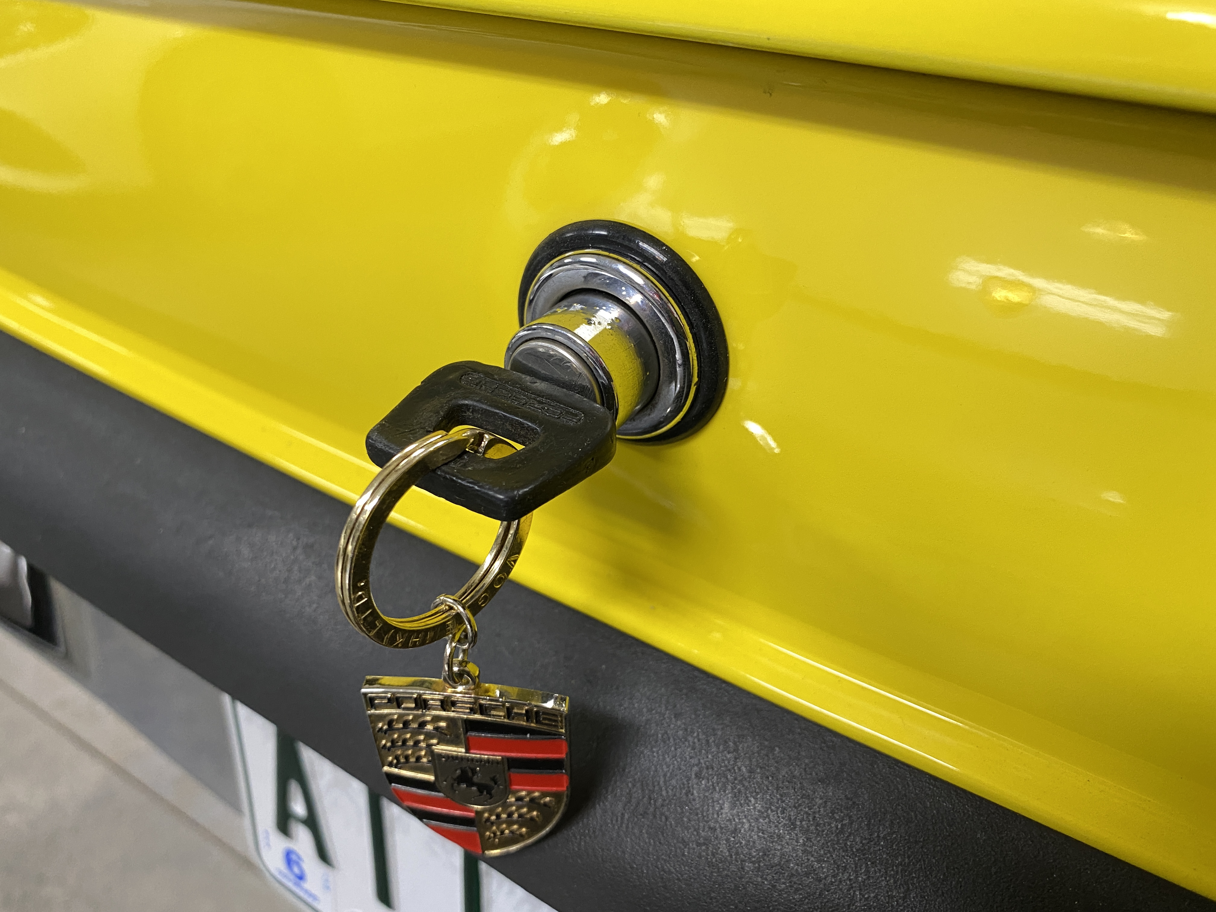

Here's the lock assembled.
bkrantz

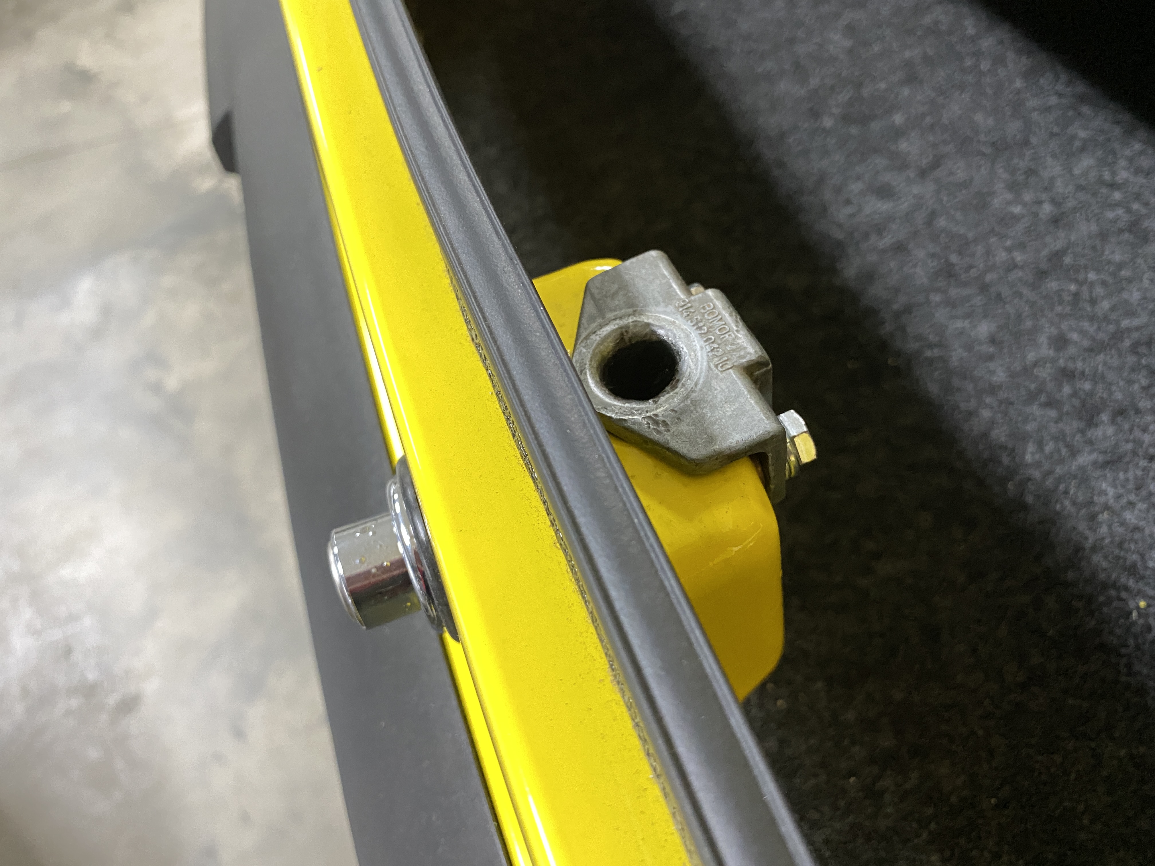

Post #6070
Posts: 8,342
Joined: 3-August 19
From: SW Colorado
Member No.: 23,343
And installed in the trunk wall.
bkrantz
post Jan 21 2023, 08:00 PM
Post #6071
Posts: 8,342
Joined: 3-August 19
From: SW Colorado
Member No.: 23,343
It works! Now I can lock (and unlock) the trunk.

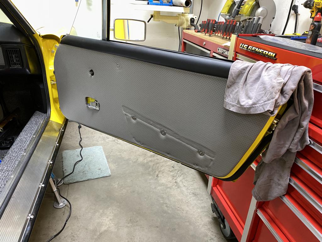

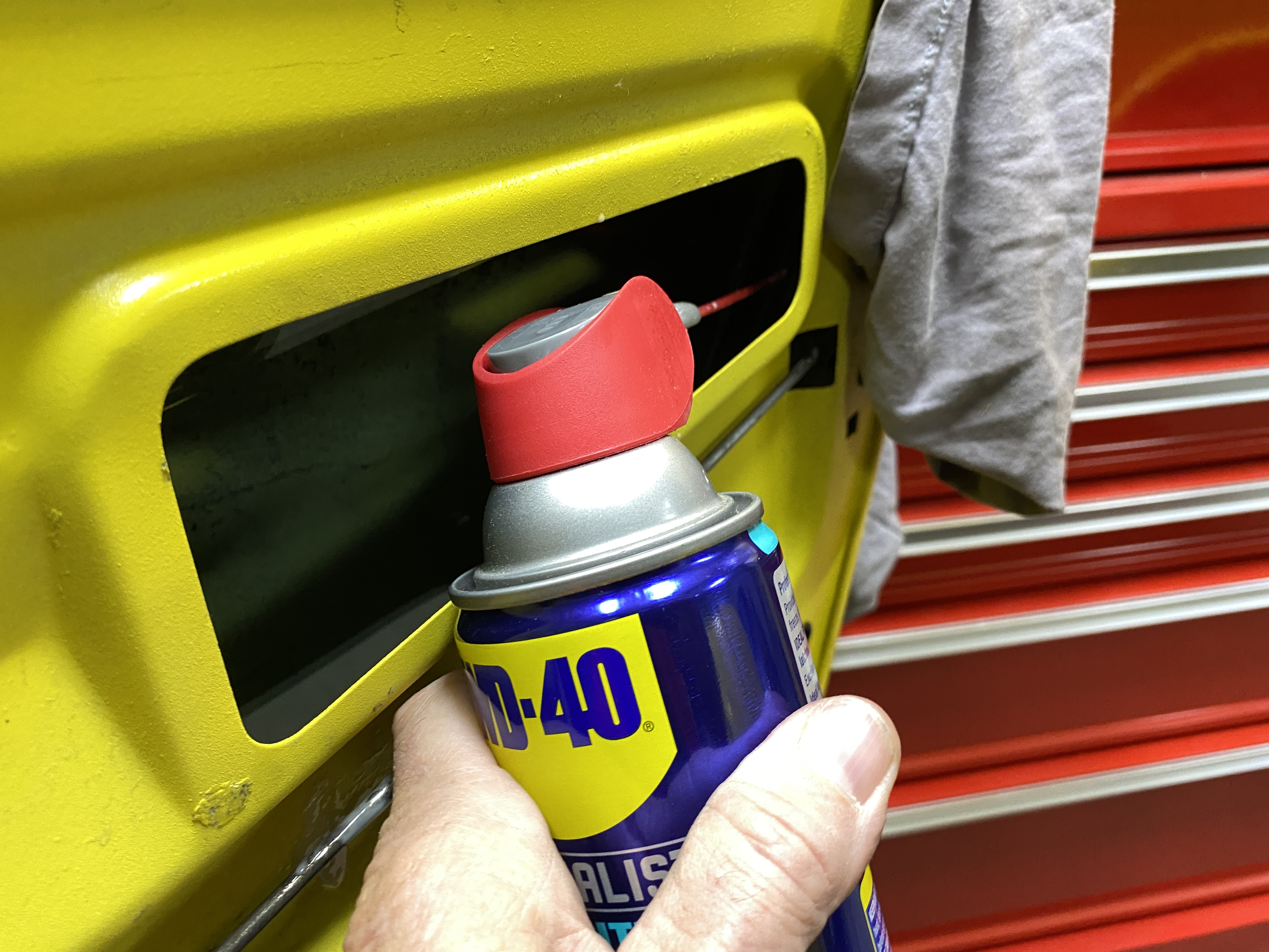

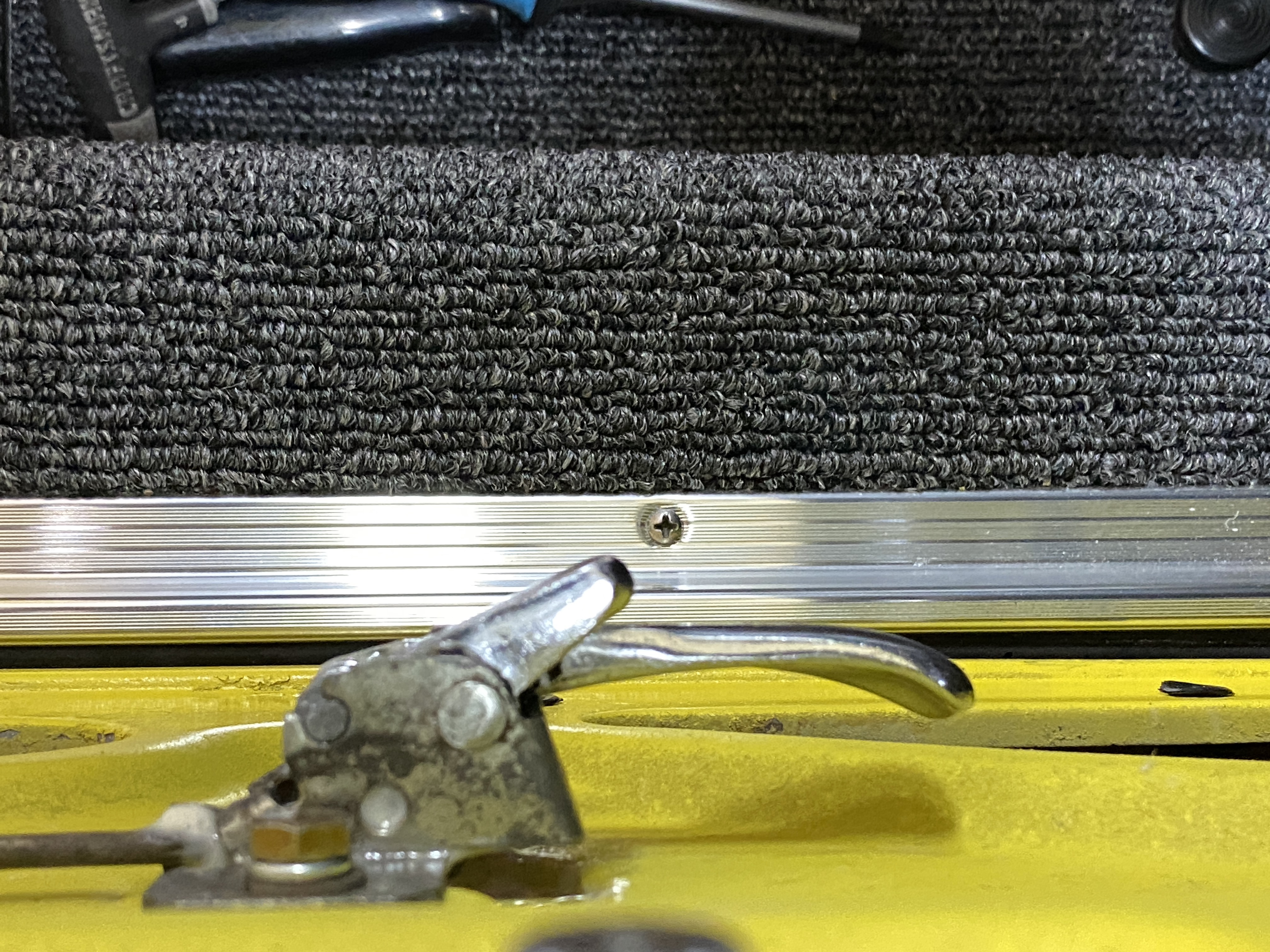

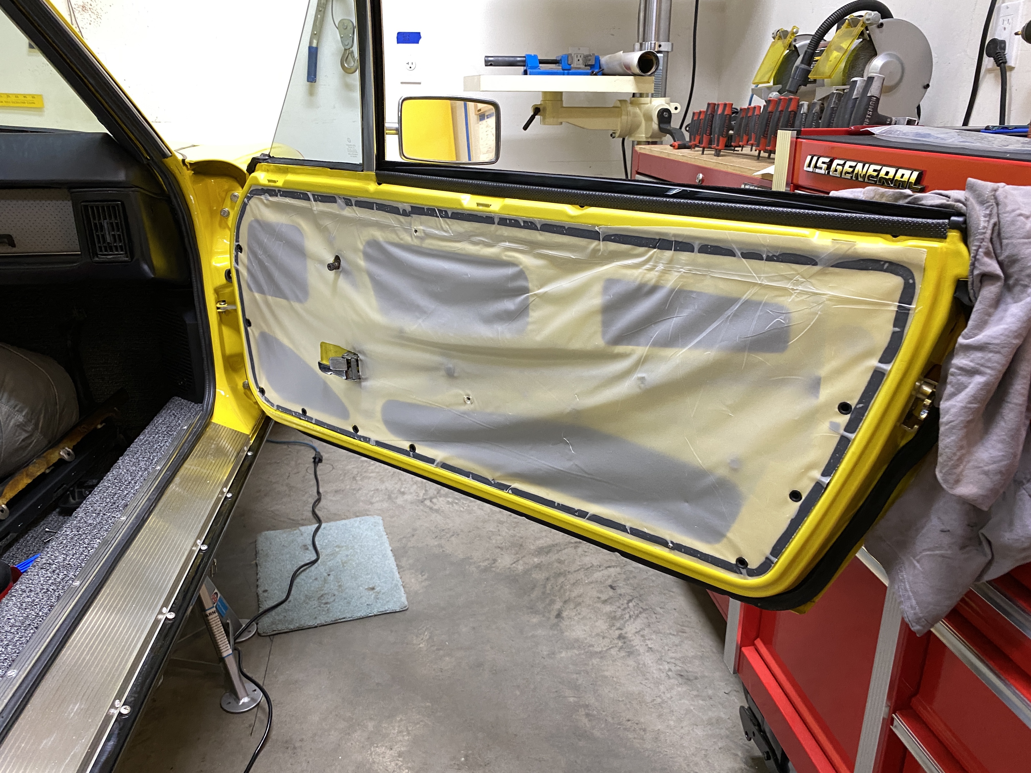

Back to working on the door locks. I removed the right door interior hardware and door card.
bkrantz
post Jan 21 2023, 08:03 PM
Post #6073
Posts: 8,342
Joined: 3-August 19
From: SW Colorado
Member No.: 23,343

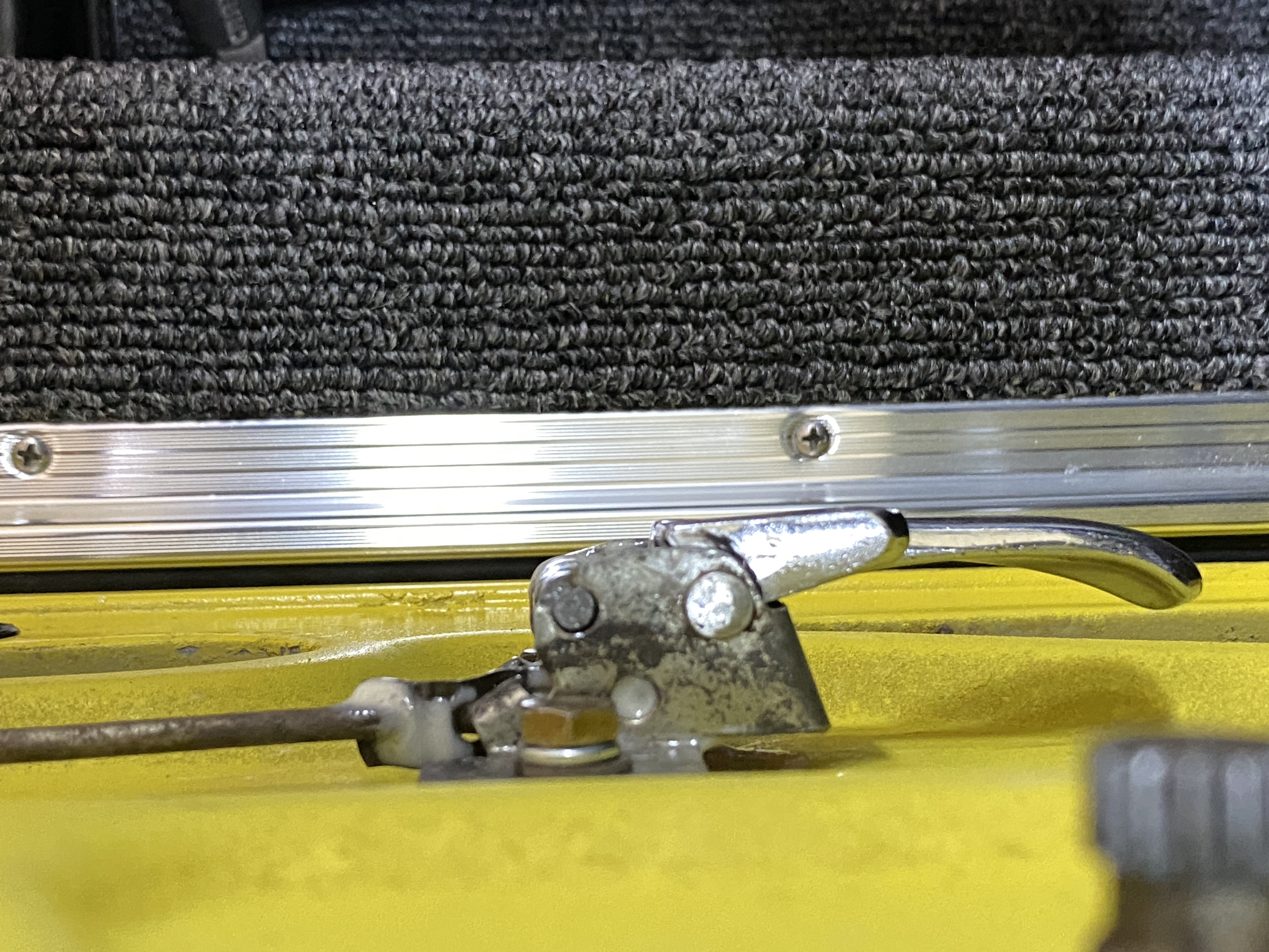

With the plastic sheet removed (and destroyed) I greased the lock mechanism. Really greased it.
bkrantz
post Jan 21 2023, 08:04 PM
Post #6074
Posts: 8,342
Joined: 3-August 19
From: SW Colorado
Member No.: 23,343

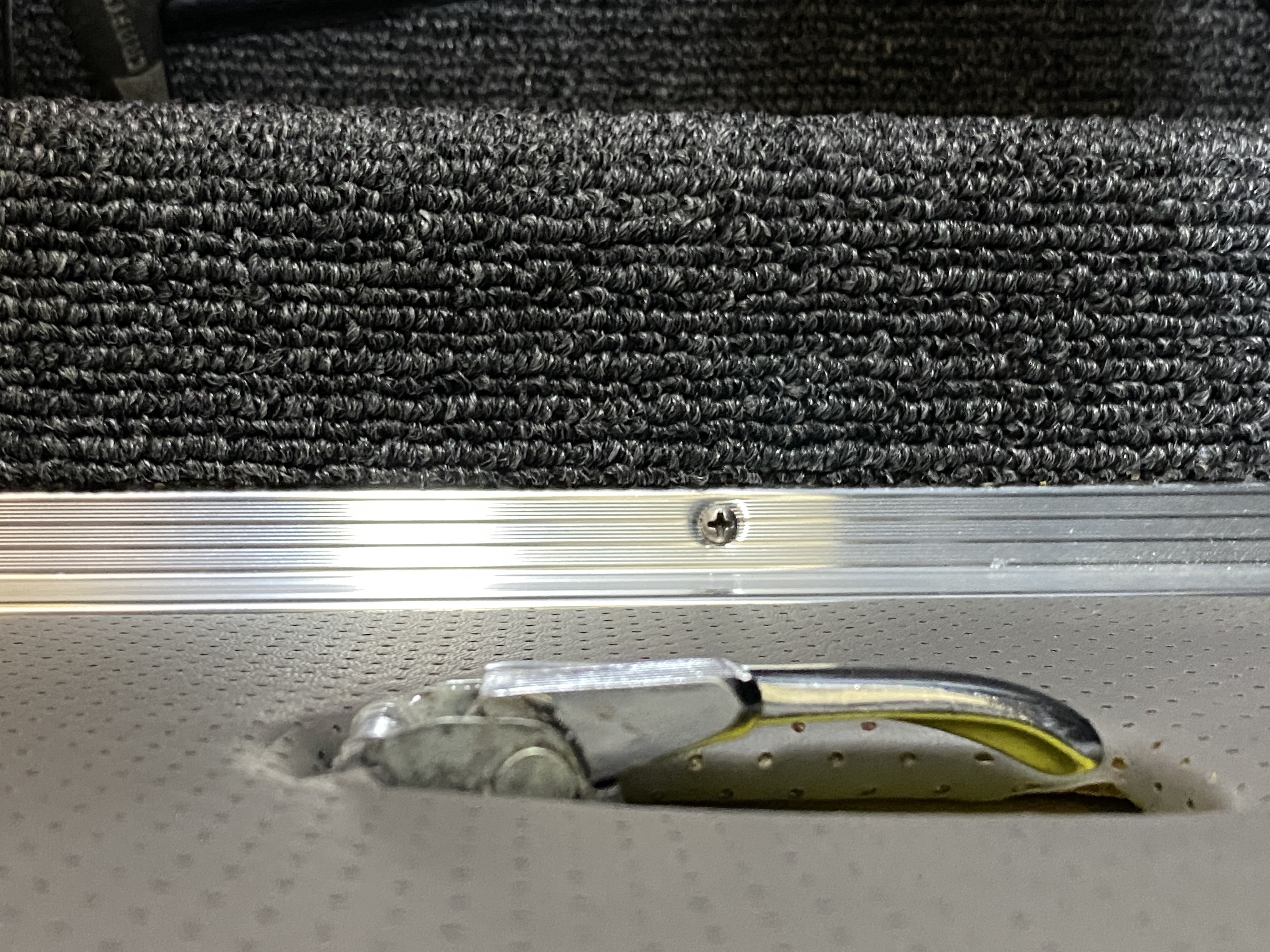

Just like the left side, the key in the exterior handle now locks the door (and the interior lock tab closes flush).
bkrantz
post Jan 21 2023, 08:05 PM
Post #6075
Posts: 8,342
Joined: 3-August 19
From: SW Colorado
Member No.: 23,343
And then the key easily unlocks the door.
bkrantz
post Jan 21 2023, 08:06 PM
Post #6076
Posts: 8,342
Joined: 3-August 19
From: SW Colorado
Member No.: 23,343
To see if the door card interferes with the locking rod, I temporarily reinstalled it.
bkrantz
post Jan 21 2023, 08:08 PM
Post #6077
Posts: 8,342
Joined: 3-August 19
From: SW Colorado
Member No.: 23,343
Still works!
And as others suggested, I checked for interference from the screw that holds the plastic surround for the interior lever. With the screw in place, the lock still works fine.
bkrantz
post Jan 21 2023, 08:09 PM
Post #6078
Posts: 8,342
Joined: 3-August 19
From: SW Colorado
Member No.: 23,343
OK, that's one more task done.

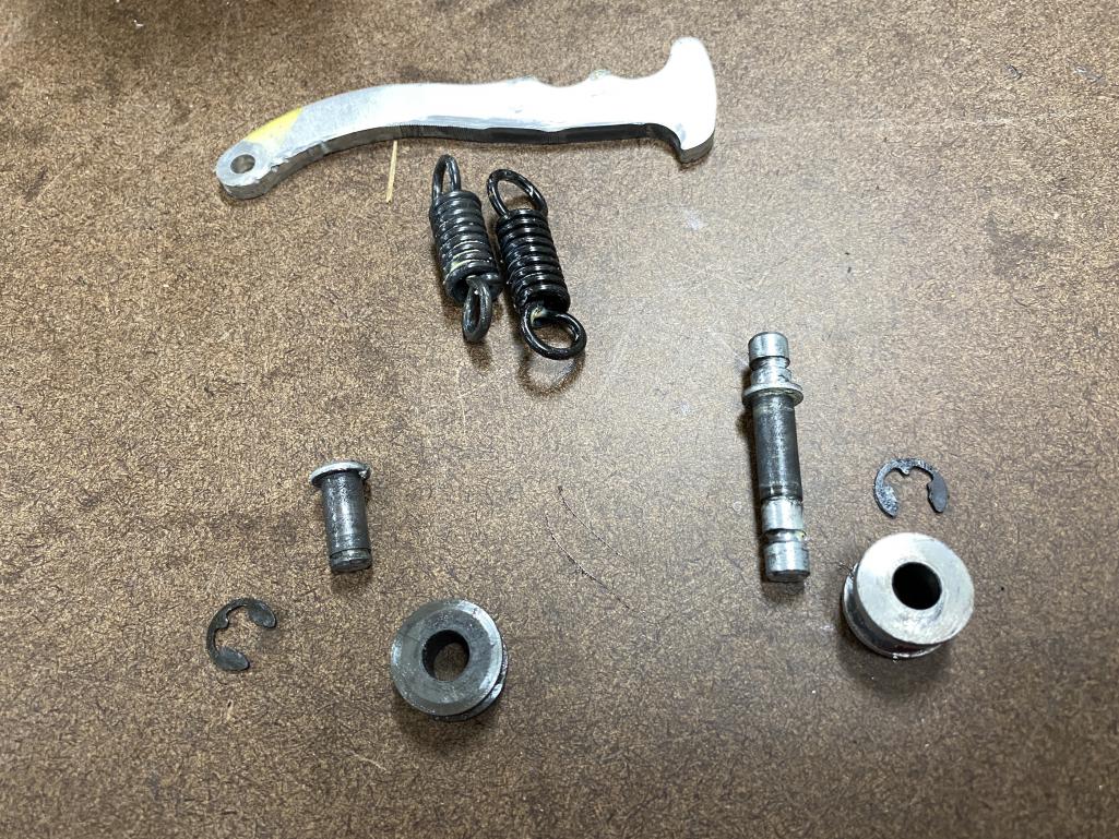

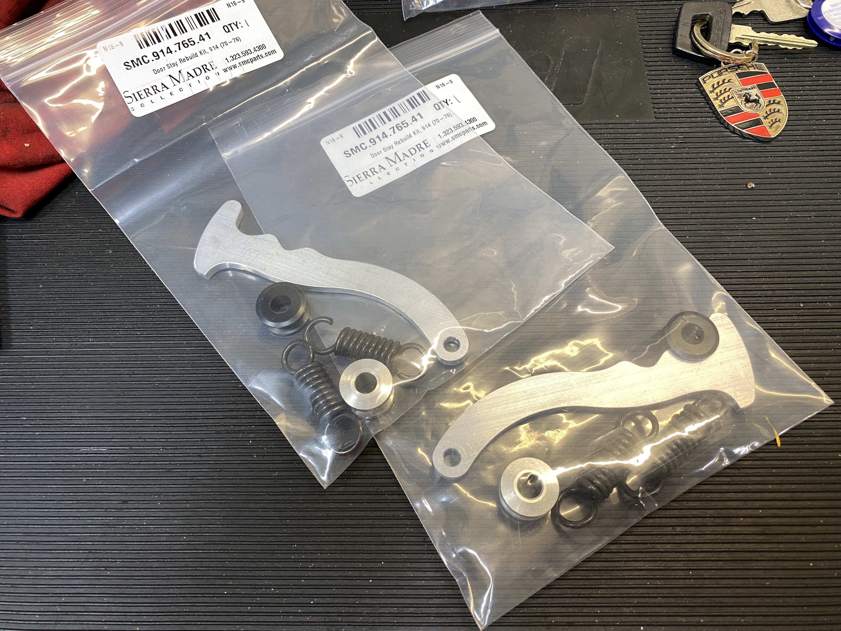

I got these door stay rebuild kits delivered yesterday.
bkrantz
post Jan 22 2023, 08:26 PM
Post #6080
Posts: 8,342
Joined: 3-August 19
From: SW Colorado
Member No.: 23,343
Pretty easy to strip the stays apart, and remove the old arms, springs, and rollers.
